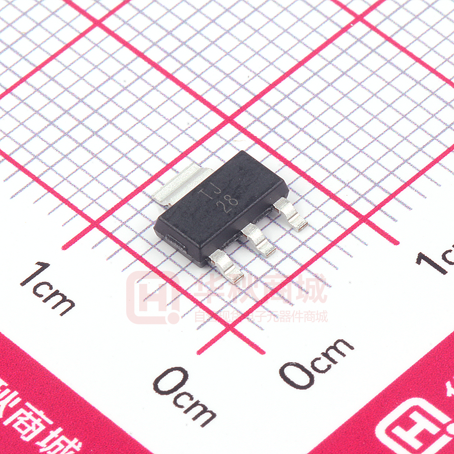

    1.5-A低噪声快速瞬态响应低跌落调节器 SOT223
TL1963A-33DCYR 数据手册
Product Folder Sample & Buy Support & Community Tools & Software Technical Documents TL1963A, TL1963A-15, TL1963A-18, TL1963A-25, TL1963A-33 SLVS719G – JUNE 2008 – REVISED JANUARY 2015 TL1963A-xx 1.5-A Low-Noise Fast-Transient-Response Low-Dropout Regulator 1 Features 3 Description • • • • • • • • • The TL1963A-xx devices are low-dropout (LDO) regulators optimized for fast transient response. The device can supply 1.5 A of output current with a dropout voltage of 340 mV. Operating quiescent current is 1 mA, dropping to less than 1 μA in shutdown. Quiescent current is well controlled; it does not rise in dropout as with many other regulators. In addition to fast transient response, the TL1963A-xx regulators have very low output noise, which makes them ideal for sensitive RF supply applications. 1 • • • • Optimized for Fast Transient Response Output Current: 1.5 A Dropout Voltage: 340 mV Low Noise: 40 μVRMS (10 Hz to 100 kHz) 1-mA Quiescent Current No Protection Diodes Needed Controlled Quiescent Current in Dropout Fixed Output Voltages: 1.5 V, 1.8 V, 2.5 V, 3.3 V Adjustable Output from 1.21 V to 20 V (TL1963A Only) Less Than 1-μA Quiescent Current in Shutdown Stable With 10-μF Ceramic Output Capacitor Reverse-Battery Protection Reverse-Current Protection Device Information(1) PART NUMBER TL1963A TL1963A-15 Industrial Wireless Infrastructure Radio-Frequency Systems 3.3-V to 2.5-V Logic Power Supplies Post Regulator for Switching Supplies TO-263 (5) 10.16 mm × 8.42 mm 6.50 mm × 3.50 mm SOT (4) TO-263 (5) 10.16 mm × 8.42 mm SOT (6) TL1963A-18 6.50 mm × 3.50 mm SOT (4) TO-263 (5) 10.16 mm × 8.42 mm SOT (6) TL1963A-25 6.50 mm × 3.50 mm SOT (4) TO-263 (5) 10.16 mm × 8.42 mm SOT (6) TL1963A-33 BODY SIZE (NOM) 6.50 mm × 3.50 mm SOT (6) 2 Applications • • • • • PACKAGE SOT (6) 6.50 mm × 3.50 mm SOT (4) TO-263 (5) 10.16 mm × 8.42 mm (1) For all available packages, see the orderable addendum at the end of the data sheet. Simplified Schematic Dropout Voltage vs Output Current 500 450 Dropout Voltage – mV 400 350 TA = 125°C 300 250 200 TA = 25°C 150 100 50 0 0 0.2 0.4 0.6 0.8 1 1.2 1.4 1.6 Output Current – A 1 An IMPORTANT NOTICE at the end of this data sheet addresses availability, warranty, changes, use in safety-critical applications, intellectual property matters and other important disclaimers. PRODUCTION DATA. TL1963A, TL1963A-15, TL1963A-18, TL1963A-25, TL1963A-33 SLVS719G – JUNE 2008 – REVISED JANUARY 2015 www.ti.com Table of Contents 1 2 3 4 5 6 7 8 9 Features .................................................................. Applications ........................................................... Description ............................................................. Revision History..................................................... Description (continued)......................................... Device Comparison Table..................................... Pin Configuration and Functions ......................... Specifications......................................................... 1 1 1 2 3 3 3 5 8.1 8.2 8.3 8.4 8.5 8.6 5 5 5 5 6 8 Absolute Maximum Ratings ..................................... ESD Ratings.............................................................. Recommended Operating Conditions....................... Thermal Information .................................................. Electrical Characteristics........................................... Typical Characteristics .............................................. Detailed Description ............................................ 13 9.1 Overview ................................................................. 13 9.2 Functional Block Diagram ....................................... 13 9.3 Feature Description................................................. 13 9.4 Device Functional Modes........................................ 15 10 Application and Implementation........................ 16 10.1 Application Information.......................................... 16 10.2 Typical Applications .............................................. 16 11 Power Supply Recommendations ..................... 21 12 Layout................................................................... 21 12.1 Layout Guidelines ................................................. 21 12.2 Layout Example .................................................... 22 12.3 Thermal Considerations ........................................ 24 13 Device and Documentation Support ................. 26 13.1 13.2 13.3 13.4 Related Links ........................................................ Trademarks ........................................................... Electrostatic Discharge Caution ............................ Glossary ................................................................ 26 26 26 26 14 Mechanical, Packaging, and Orderable Information ........................................................... 26 4 Revision History Changes from Revision F (January 2014) to Revision G • 2 Page Added ESD Ratings table, Feature Description section, Device Functional Modes, Application and Implementation section, Power Supply Recommendations section, Layout section, Device and Documentation Support section, and Mechanical, Packaging, and Orderable Information section ................................................................................................. 1 Submit Documentation Feedback Copyright © 2008–2015, Texas Instruments Incorporated Product Folder Links: TL1963A TL1963A-15 TL1963A-18 TL1963A-25 TL1963A-33 TL1963A, TL1963A-15, TL1963A-18, TL1963A-25, TL1963A-33 www.ti.com SLVS719G – JUNE 2008 – REVISED JANUARY 2015 5 Description (continued) Output voltage range is from 1.21 V to 20 V. The TL1963A-xx regulators are stable with output capacitance as low as 10 μF. Small ceramic capacitors can be used without the necessary addition of ESR as is common with other regulators. Internal protection circuitry includes reverse-battery protection, current limiting, thermal limiting, and reverse-current protection. The devices are available in fixed output voltages of 1.5 V, 1.8 V, 2.5 V, 3.3 V, and as an adjustable device with a 1.21-V reference voltage. 6 Device Comparison Table DEVICE OUTPUT VOLTAGE PIN 5 (DCQ AND KTT ONLY) TL1963A Adjustable ADJ TL1963A-15 1.5 V SENSE TL1963A-18 1.8 V SENSE TL1963A-25 2.5 V SENSE TL1963A-33 3.3 V SENSE 7 Pin Configuration and Functions GND DCQ PACKAGE (TOP VIEW) 5 4 3 2 1 6 SENSE/ADJ OUT GND IN SHDN GND DCY PACKAGE (TOP VIEW) 4 3 OUT 2 GND 1 IN KTT PACKAGE (TOP VIEW) 5 4 3 2 1 Copyright © 2008–2015, Texas Instruments Incorporated SENSE/ADJ OUT GND IN SHDN Submit Documentation Feedback Product Folder Links: TL1963A TL1963A-15 TL1963A-18 TL1963A-25 TL1963A-33 3 TL1963A, TL1963A-15, TL1963A-18, TL1963A-25, TL1963A-33 SLVS719G – JUNE 2008 – REVISED JANUARY 2015 www.ti.com Pin Functions PIN DESCRIPTION 5 I Adjust. For the adjustable TL1963A, this is the input to the error amplifier. This pin is clamped internally to ±7 V. It has a bias current of 3 μA that flows into the pin. The ADJ pin voltage is 1.21 V referenced to ground, and the output voltage range is 1.21 V to 20 V. 3 — DCQ DCY KTT ADJ 5 — GND 3, 6 2, 4 Ground IN 2 1 2 I Input. Power is supplied to the device through the IN pin. A bypass capacitor is required on this pin if the device is more than six inches away from the main input filter capacitor. In general, the output impedance of a battery rises with frequency, so it is advisable to include a bypass capacitor in battery-powered circuits. A bypass capacitor (ceramic) in the range of 1 μF to 10 μF is sufficient. The TL1963A-xx regulators are designed to withstand reverse voltages on the IN pin with respect to ground and the OUT pin. In the case of a reverse input, which can happen if a battery is plugged in backwards, the device acts as if there is a diode in series with its input. There is no reverse-current flow into the regulator, and no reverse voltage appears at the load. The device protects both itself and the load. OUT 4 3 4 O Output. The output supplies power to the load. A minimum output capacitor (ceramic) of 10 μF is required to prevent oscillations. Larger output capacitors are required for applications with large transient loads to limit peak voltage transients. I Sense. For fixed voltage versions of the TL1963A-xx (TL1963A-1.5, TL1963A-1.8, TL1963A2.5, and TL1963A-3.3), the SENSE pin is the input to the error amplifier. Optimum regulation is obtained at the point where the SENSE pin is connected to the OUT pin of the regulator. In critical applications, small voltage drops are caused by the resistance (RP) of PC traces between the regulator and the load. These may be eliminated by connecting the SENSE pin to the output at the load as shown in Figure 32. Note that the voltage drop across the external PCB traces adds to the dropout voltage of the regulator. The SENSE pin bias current is 600 μA at the rated output voltage. The SENSE pin can be pulled below ground (as in a dual supply system in which the regulator load is returned to a negative supply) and still allow the device to start and operate. Shutdown. The SHDN pin is used to put the TL1963A-xx regulators into a low-power shutdown state. The output is off when the SHDN pin is pulled low. The SHDN pin can be driven either by 5-V logic or open-collector logic with a pullup resistor. The pullup resistor is required to supply the pullup current of the open-collector gate, normally several microamperes, and the SHDN pin current, typically 3 μA. If unused, the SHDN pin must be connected to VIN. The device is in the low-power shutdown state if the SHDN pin is not connected. SENSE 4 I/O NAME 5 — 5 SHDN 1 — 1 I Thermal Pad — — — — Submit Documentation Feedback For the KTT package, the exposed thermal pad is connected to ground and must be soldered to the PCB for rated thermal performance. Copyright © 2008–2015, Texas Instruments Incorporated Product Folder Links: TL1963A TL1963A-15 TL1963A-18 TL1963A-25 TL1963A-33 TL1963A, TL1963A-15, TL1963A-18, TL1963A-25, TL1963A-33 www.ti.com SLVS719G – JUNE 2008 – REVISED JANUARY 2015 8 Specifications 8.1 Absolute Maximum Ratings over operating virtual-junction temperature range (unless otherwise noted) Input voltage, VIN (1) MIN MAX IN –20 20 OUT –20 20 Input-to-output differential (2) –20 20 SENSE –20 20 ADJ –7 7 SHDN –20 20 Output short-circuit duration, tshort UNIT V Indefinite Maximum lead temperature (10-s soldering time), Tlead 300 °C Maximum junction temperature, TJMAX 125 °C 150 °C Storage temperature, Tstg (1) (2) –65 Stresses beyond those listed under Absolute Maximum Ratings may cause permanent damage to the device. These are stress ratings only, and functional operation of the device at these or any other conditions beyond those indicated under Recommended Operating Conditions is not implied. Exposure to conditions beyond the recommended operating maximum for extended periods may affect device reliability. Absolute maximum input-to-output differential voltage cannot be achieved with all combinations of rated IN pin and OUT pin voltages. With the IN pin at 20 V, the OUT pin may not be pulled below 0 V. The total measured voltage from IN to OUT can not exceed ±20 V. 8.2 ESD Ratings VALUE V(ESD) (1) (2) Electrostatic discharge Human body model (HBM), per ANSI/ESDA/JEDEC JS-001 (1) ±2000 Charged-device model (CDM), per JEDEC specification JESD22C101 (2) ±1000 UNIT V JEDEC document JEP155 states that 500-V HBM allows safe manufacturing with a standard ESD control process. JEDEC document JEP157 states that 250-V CDM allows safe manufacturing with a standard ESD control process. 8.3 Recommended Operating Conditions over operating free-air temperature range (unless otherwise noted) VIN Input voltage range (1) VIH SHDN High-Level Input Voltage VIL SHDN Low-Level Input Voltage TJ Recommended operating junction temperature range (1) MIN MAX VOUT + VDO 20 V 2 20 V 0.25 V 125 °C –40 UNIT TL1963A, TL1963A-15, and TL1963A-18 may require a higher minimum input voltage under some output voltage/load conditions as indicated under Electrical Characteristics. 8.4 Thermal Information TL1963A-xx THERMAL METRIC (1) (2) KTT DCQ DCY 5 PINS 6 PINS 4 PINS RθJA Junction-to-ambient thermal resistance 32.9 50.5 57.9 RθJC(top) Junction-to-case (top) thermal resistance 37.6 31.1 38.6 RθJB Junction-to-board thermal resistance 18.9 5.1 7.1 ψJT Junction-to-top characterization parameter 5.7 1.0 1.7 ψJB Junction-to-board characterization parameter 17.3 5.0 7.0 RθJC(bot) Junction-to-case (bottom) thermal resistance 1.0 — — (1) (2) UNIT °C/W For more information about traditional and new thermal metrics, see the IC Package Thermal Metrics application report, SPRA953. For thermal estimates of this device based on PCB copper area, see the TI PCB Thermal Calculator. Copyright © 2008–2015, Texas Instruments Incorporated Submit Documentation Feedback Product Folder Links: TL1963A TL1963A-15 TL1963A-18 TL1963A-25 TL1963A-33 5 TL1963A, TL1963A-15, TL1963A-18, TL1963A-25, TL1963A-33 SLVS719G – JUNE 2008 – REVISED JANUARY 2015 www.ti.com 8.5 Electrical Characteristics Over recommended operating temperature range TJ = –40 to 125 °C (unless otherwise noted) (1) PARAMETER Minimum input voltage (3) (4) VIN TEST CONDITIONS 25°C 1.9 Full range 2.1 2.5 VIN = 2.5 V to 20 V, ILOAD = 1 mA to 1.5 A VIN = 2.3 V, ILOAD = 1 mA TL1963A-18 Regulated output voltage (5) VIN = 2.8 V to 20 V, ILOAD = 1 mA to 1.5 A VIN = 3 V, ILOAD = 1 mA TL1963A-25 VIN = 3.5 V to 20 V, ILOAD = 1 mA to 1.5 A VIN = 3.8 V, ILOAD = 1 mA TL1963A-33 VIN = 4.3 V to 20 V, ILOAD = 1 mA to 1.5 A VIN = 2.21 V, ILOAD = 1 mA ADJ pin voltage (3) (5) Line regulation Load regulation (1) (2) (3) (4) (5) 6 MAX ILOAD = 1.5 A VIN = 2.21 V, ILOAD = 1 mA VADJ MIN TYP (2) ILOAD = 0.5 A TL1963A-15 VOUT TJ 25°C 1.477 1.5 1.523 Full range 1.447 1.5 1.545 25°C 1.773 1.8 1.827 Full range 1.737 1.8 1.854 25°C 2.462 2.5 2.538 Full range 2.412 2.5 2.575 25°C 3.25 3.3 3.35 Full range 3.2 3.3 3.4 25°C 1.192 1.21 1.228 VIN = 2.5 V to 20 V, ILOAD = 1 mA to 1.5 A Full range 1.174 1.21 1.246 TL1963A-15 ΔVIN = 2.21 V to 20 V, ILOAD = 1 mA Full range 2 6 TL1963A-18 ΔVIN = 2.3 V to 20 V, ILOAD = 1 mA Full range 2.5 7 TL1963A-25 ΔVIN = 3 V to 20 V, ILOAD = 1 mA Full range 3 10 TL1963A-33 ΔVIN = 3.8 V to 20 V, ILOAD = 1 mA Full range 3.5 10 TL1963A (3) ΔVIN = 2.21 V to 20 V, ILOAD = 1 mA Full range 1.5 5 TL1963A-15 VIN = 2.5 V, ΔILOAD = 1 mA to 1.5 A Full range TL1963A-18 VIN = 2.8 V, ΔILOAD = 1 mA to 1.5 A Full range TL1963A 25°C 25°C 25°C TL1963A-25 VIN = 3.5 V, ΔILOAD = 1 mA to 1.5 A Full range TL1963A-33 VIN = 4.3 V, ΔILOAD = 1 mA to 1.5 A Full range TL1963A (3) VIN = 2.5 V, ΔILOAD = 1 mA to 1.5 A Full range 25°C 25°C 2 UNIT V V V mV 9 18 2 10 20 2.5 15 30 3 mV 20 70 2 8 18 The TL1963A-xx regulators are tested and specified under pulse load conditions such that TJ ≉ TA. They are fully tested at TA = 25°C. Performance at –40 and 125°C is specified by design, characterization, and correlation with statistical process controls. Typical values represent the likely parametric nominal values determined at the time of characterization. Typical values depend on the application and configuration and may vary over time. Typical values are not ensured on production material. The TL1963A is tested and specified for these conditions with the ADJ pin connected to the OUT pin. For the TL1963A, TL1963A-15 and TL1963A-18, dropout voltages are limited by the minimum input voltage specification under some output voltage/load conditions. Operating conditions are limited by maximum junction temperature. The regulated output voltage specification does not apply for all possible combinations of input voltage and output current. When operating at maximum input voltage, the output current range must be limited. When operating at maximum output current, the input voltage range must be limited. Submit Documentation Feedback Copyright © 2008–2015, Texas Instruments Incorporated Product Folder Links: TL1963A TL1963A-15 TL1963A-18 TL1963A-25 TL1963A-33 TL1963A, TL1963A-15, TL1963A-18, TL1963A-25, TL1963A-33 www.ti.com SLVS719G – JUNE 2008 – REVISED JANUARY 2015 Electrical Characteristics (continued) Over recommended operating temperature range TJ = –40 to 125 °C (unless otherwise noted)(1) PARAMETER TEST CONDITIONS Dropout voltage (4) (6) (7) VIN = VOUT(NOMINAL) eN IADJ Output voltage noise ADJ pin bias current ILOAD = 100 mA I SHDN 0.1 0.17 0.22 25°C 0.19 Full range 0.27 0.34 Full range 0.45 0.55 ILOAD = 0 mA Full range 1 1.5 ILOAD = 1 mA Full range 1.1 1.6 ILOAD = 100 mA Full range 3.8 5.5 ILOAD = 500 mA Full range 15 25 ILOAD = 1.5 A Full range 80 120 25°C 40 25°C VOUT = OFF to ON Full range VOUT = ON to OFF Full range 0.25 3 10 0.9 2 0.75 25°C 0.01 1 25°C 3 30 Quiescent current in shutdown VIN = 6 V, V SHDN = 0 V 25°C 0.01 1 Ripple rejection VIN – VOUT = 1.5 V (avg), VRIPPLE = 0.5 VP-P, fRIPPLE = 120 Hz, ILOAD = 0.75 A 25°C VIN = 7 V, VOUT = 0 V 25°C IIL Input reverse leakage current Reverse output current (10) VIN = VOUT(NOMINAL) + 1 Full range VIN = –20 V, VOUT = 0 V Full range 55 mA μVRMS V SHDN = 20 V Current limit V 0.35 25°C COUT = 10 μF, ILOAD = 1.5 A, BW = 10 Hz to 100 kHz UNIT 0.1 V SHDN = 0 V SHDN pin current ILIMIT IRO 0.06 Full range (3) (9) Shutdown threshold 0.02 25°C ILOAD = 1.5 A IGND MAX Full range ILOAD = 500 mA GND pin current (7) (8) VIN = VOUT(NOMINAL) + 1 MIN TYP (2) 25°C ILOAD = 1 mA VDO TJ 63 μA V μA μA dB 2 A 1.6 1 TL1963A-15 VOUT = 1.5 V, VIN < 1.5 V 25°C 600 1200 TL1963A-18 VOUT = 1.8 V, VIN < 1.8 V 25°C 600 1200 TL1963A-25 VOUT = 2.5 V, VIN < 2.5 V 25°C 600 1200 TL1963A-33 VOUT = 3.3 V, VIN < 3.3 V 25°C 600 1200 TL1963A VOUT = 1.21 V, VIN < 1.21 V 25°C 300 600 μA μA (6) Dropout voltage is the minimum input to output voltage differential needed to maintain regulation at a specified output current. In dropout, the output voltage is equal to: VIN – VDROPOUT. (7) To satisfy requirements for minimum input voltage, the TL1963A is tested and specified for these conditions with an external resistor divider (two 4.12-kΩ resistors) for an output voltage of 2.4 V. The external resistor divider adds a 300-µA DC load on the output. (8) GND pin current is tested with VIN = (VOUT(NOMINAL) + 1 V) and a current source load. The GND pin current decreases at higher input voltages. (9) ADJ pin bias current flows into the ADJ pin. (10) Reverse output current is tested with the IN pin grounded and the OUT pin forced to the rated output voltage. This current flows into the OUT pin and out the GND pin. Copyright © 2008–2015, Texas Instruments Incorporated Submit Documentation Feedback Product Folder Links: TL1963A TL1963A-15 TL1963A-18 TL1963A-25 TL1963A-33 7 TL1963A, TL1963A-15, TL1963A-18, TL1963A-25, TL1963A-33 SLVS719G – JUNE 2008 – REVISED JANUARY 2015 www.ti.com 8.6 Typical Characteristics Typical characteristics apply to all TL1963A-xx devices unless otherwise noted. 480 500 450 IOUT = 1.5 A 400 Dropout Voltage – mV Dropout Voltage – mV 360 350 TA = 125°C 300 250 200 TA = 25°C 150 240 IOUT = 0.5 A IOUT = 100 mA 120 100 50 IOUT = 1 mA 0 0 0.2 0.4 0.6 0.8 1 1.2 1.4 0 -50 1.6 -25 0 25 50 75 100 125 TA – Free-Air Temperature – °C Output Current – A Figure 1. Dropout Voltage vs Output Current Figure 2. Dropout Voltage vs Temperature 1.5 VIN = 6 V 1.4 IOUT = 0 A Quiescent Current – mA 1.3 VSHDN = VIN 1.2 1.1 TL1963A-3.3 VOUT Fixed 3.3 V 1 0.9 TL1963A (Adjustable) VOUT Adjustable 0.8 0.7 0.6 0.5 -50 -25 0 25 50 75 100 125 TA – Free-Air Temperature – °C VIN = 6 V IOUT = 0 A VSHDN = VIN Figure 3. Quiescent Current vs Temperature IOUT = 1 mA TL1963A-25 Figure 5. TL1963A-25 Output Voltage vs Temperature 8 Submit Documentation Feedback IOUT = 1 mA TL1963A-18 Figure 4. TL1963A-18 Output Voltage vs Temperature IOUT = 1 mA TL1963A-33 Figure 6. TL1963A-33 Output Voltage vs Temperature Copyright © 2008–2015, Texas Instruments Incorporated Product Folder Links: TL1963A TL1963A-15 TL1963A-18 TL1963A-25 TL1963A-33 TL1963A, TL1963A-15, TL1963A-18, TL1963A-25, TL1963A-33 www.ti.com SLVS719G – JUNE 2008 – REVISED JANUARY 2015 Typical Characteristics (continued) Typical characteristics apply to all TL1963A-xx devices unless otherwise noted. 1.2 1.23 1.225 Quiescent Current (mA) 1 Output Voltage (V) 1.22 1.215 1.21 1.205 1.2 0.8 0.6 0.4 0.2 1.195 1.19 -50 0 -25 0 25 50 75 Free-Air Temperature (qC) IOUT = 1 mA 100 0 125 2 D020 TJ = 25 °C VIN = 6 V Figure 7. TL1963A Output Voltage vs Temperature 4 6 8 10 12 Input Voltage (V) 14 ROUT = 4.3kΩ 16 18 20 D021 VSHDN = VIN Figure 8. Quiescent Current vs Input Voltage 10 IOUT = 10 mA IOUT = 100 mA IOUT = 300 mA 9 Ground Current (mA) 8 7 6 5 4 3 2 1 0 0 1 2 TJ = 25 °C 3 4 5 6 Input Voltage (V) 7 VOUT = 1.21 V 8 9 10 D022 VSHDN = VIN Figure 9. TL1963A Ground Current vs Input Voltage TJ = 25 °C VSHDN = VIN Figure 11. TL1963A-33 Ground Current vs Input Voltage Copyright © 2008–2015, Texas Instruments Incorporated TJ = 25 °C VOUT = 1.21 V VSHDN = VIN Figure 10. TL1963A Ground Current vs Input Voltage TJ = 25 °C VSHDN = VIN Figure 12. TL1963A-33 Ground Current vs Input Voltage Submit Documentation Feedback Product Folder Links: TL1963A TL1963A-15 TL1963A-18 TL1963A-25 TL1963A-33 9 TL1963A, TL1963A-15, TL1963A-18, TL1963A-25, TL1963A-33 SLVS719G – JUNE 2008 – REVISED JANUARY 2015 www.ti.com Typical Characteristics (continued) Typical characteristics apply to all TL1963A-xx devices unless otherwise noted. VSHDN = 0 V VIN = VOUT(nom) + 1 Figure 14. Quiescent Current in Shutdown vs Input Voltage Figure 13. Ground Current vs Output Current 2.5 1 2 0.75 SHDN Input Current – µA SHDN Input Current (PA) 2.25 0.5 0.25 1.75 1.5 1.25 1 0.75 0.5 0 -50 0.25 -25 0 25 50 75 Free-Air Temperature (qC) 100 125 D011 VSHON = 0 V 0 2 4 6 8 10 12 14 16 18 20 SHDN Input Voltage – V Figure 15. SHDN Pin Current (ISHDN) vs Temperature IOUT = 1 mA Figure 16. SHDN Pin Current (ISHDN) vs SHDN Input Voltage IOUT = 1 mA Figure 17. SHDN Threshold (OFF to ON) vs Temperature 10 0 Submit Documentation Feedback Figure 18. SHDN Threshold (ON to OFF) vs Temperature Copyright © 2008–2015, Texas Instruments Incorporated Product Folder Links: TL1963A TL1963A-15 TL1963A-18 TL1963A-25 TL1963A-33 TL1963A, TL1963A-15, TL1963A-18, TL1963A-25, TL1963A-33 www.ti.com SLVS719G – JUNE 2008 – REVISED JANUARY 2015 Typical Characteristics (continued) Typical characteristics apply to all TL1963A-xx devices unless otherwise noted. 5 4.5 ADJ Bias Current – µA 4 3.5 3 2.5 2 1.5 1 0.5 0 -50 -25 0 25 50 75 100 125 TA – Free-Air Temperature – °C ΔVOUT = 100 mV Figure 19. ADJ Bias Current vs Temperature Figure 20. Current Limit vs Input-to-Output Differential Voltage 12 TJ = 25°C Reverse Output Current – mA 10 VIN = 0 V Current flows into OUT pin 8 VOUT(Adjustable) Adjustable TL1963A VOUT =VVOUT ADJ = VADJ 6 4 2 0 TL1963A-3.3 VOUT Fixed 3.3 V V VOUT= =VVFB OUT FB -2 0 2 4 6 8 10 Output Voltage – V VIN = 7 V TJ = 25 °C VIN = 0 V Current flows into OUT pin VOUT = 0 V Figure 21. Current Limit vs Temperature Figure 22. Reverse Output Current vs Output Voltage 1000 Reverse Output Current – µA VIN = 0 V 800 600 VOUT Fixed 3.3V TL1963A-3.3 VOUT= =3.3 3.3VV VOUT 400 200 0 -50 V OUT Adjustable TL1963A (Adjustable) VOUT OUT = V = 1.21 1.21 VV -25 0 25 50 75 100 125 TA – Free-Air Temperature – °C VIN = 0 V Figure 23. Reverse Output Current vs Temperature Copyright © 2008–2015, Texas Instruments Incorporated VRIPPLE = 0.05 VPP VIN = 2.7 V CIN = 0 TA = 25 °C COUT = 10 µF (ceramic) Figure 24. Ripple Rejection vs Frequency Submit Documentation Feedback Product Folder Links: TL1963A TL1963A-15 TL1963A-18 TL1963A-25 TL1963A-33 11 TL1963A, TL1963A-15, TL1963A-18, TL1963A-25, TL1963A-33 SLVS719G – JUNE 2008 – REVISED JANUARY 2015 www.ti.com Typical Characteristics (continued) Typical characteristics apply to all TL1963A-xx devices unless otherwise noted. 20 1 IOUT = 1.5 A 15 10(ceramic) µF COUTC=OUT 10=µF IOUT =IOUT 1.5=A1.5 A TL1963A VOUT(Adjustable) Adjustable 5 Output Noise Hz Output NoiseVoltage Voltage––µV/ µVÖRMS Load Regulation – mV 10 0 -5 -10 TL1963A-1.8 VOUT Fixed 1.8 V -15 TL1963A-2.5 VOUT Fixed 2.5 V -20 -25 TL1963A-3.3 V OUT Fixed 3.3 V 0.1 TL1963A (Adjustable) VOUT Adjustable TL1963A-3.3 VOUT Fixed 3.3 V -30 -35 -50 -25 0 25 50 75 100 125 0.01 10 100 TA – Free-Air Temperature – °C IOUT = 1 mA to 1.5 A COUT = 10 µF (ceramic) Figure 25. Load Regulation vs Temperature VIN = 4.3 V CIN = 10 µF COUT = 10 µF (ceramic) 10k 100k IOUT = 1.5 A Figure 26. Output Noise Voltage vs Frequency VIN = 4.3 V CIN = 10 µF COUT = 10 µF (ceramic) Figure 27. Load Transient Response IOUT = 1.5 A 1k Frequency - Hz Figure 28. Load Transient Response CIN = 10 µF COUT = 10 µF (ceramic) Figure 29. Line Transient response 12 Submit Documentation Feedback Copyright © 2008–2015, Texas Instruments Incorporated Product Folder Links: TL1963A TL1963A-15 TL1963A-18 TL1963A-25 TL1963A-33 TL1963A, TL1963A-15, TL1963A-18, TL1963A-25, TL1963A-33 www.ti.com SLVS719G – JUNE 2008 – REVISED JANUARY 2015 9 Detailed Description 9.1 Overview The TL1963A-xx series are 1.5-A low-dropout regulators optimized for fast transient response. The devices can supply 1.5 A at a dropout voltage of 340 mV. The low operating quiescent current (1 mA) drops to less than 1 μA in shutdown. In addition to the low quiescent current, the TL1963A-xx regulators incorporate several protection features that make them ideal for use in battery-powered systems. The devices are protected against both reverse input and reverse output voltages. In battery-backup applications where the output can be held up by a backup battery when the input is pulled to ground, the TL1963A-xx acts as if it has a diode in series with its output and prevents reverse-current flow. Additionally, in dual-supply applications where the regulator load is returned to a negative supply, the output can be pulled below ground by as much as (20 V – VIN) and still allow the device to start and operate. 9.2 Functional Block Diagram 9.3 Feature Description 9.3.1 Overload Recovery Like many IC power regulators, the TL1963A-xx has safe operating area protection. The safe area protection decreases the current limit as input-to-output voltage increases and keeps the power transistor inside a safe operating region for all values of input-to-output voltage. The protection is designed to provide some output current at all values of input-to-output voltage up to the device breakdown. When power is first turned on, as the input voltage rises, the output follows the input, allowing the regulator to start up into very heavy loads. During start-up, as the input voltage is rising, the input-to-output voltage differential is small, allowing the regulator to supply large output currents. With a high input voltage, a problem can occur wherein removal of an output short does not allow the output voltage to recover. Other regulators also exhibit this phenomenon, so it is not unique to the TL1963A-xx. Copyright © 2008–2015, Texas Instruments Incorporated Submit Documentation Feedback Product Folder Links: TL1963A TL1963A-15 TL1963A-18 TL1963A-25 TL1963A-33 13 TL1963A, TL1963A-15, TL1963A-18, TL1963A-25, TL1963A-33 SLVS719G – JUNE 2008 – REVISED JANUARY 2015 www.ti.com Feature Description (continued) The problem occurs with a heavy output load when the input voltage is high and the output voltage is low. Common situations occur immediately after the removal of a short circuit or when the shutdown pin is pulled high after the input voltage has already been turned on. The load line for such a load may intersect the output current curve at two points. If this happens, there are two stable output operating points for the regulator. With this double intersection, the input power supply may need to be cycled down to zero and brought up again to make the output recover. 9.3.2 Output Voltage Noise The TL1963A-xx regulators have been designed to provide low output voltage noise over the 10-Hz to 100-kHz bandwidth while operating at full load. Output voltage noise is typically 35 nV/√Hz over this frequency bandwidth for the TL1963A (adjustable version). For higher output voltages (generated by using a resistor divider), the output voltage noise is gained up accordingly. This results in RMS noise over the 10-Hz to 100-kHz bandwidth of 14 μVRMS for the TL1963A, increasing to 38 μVRMS for the TL1963A-33. Higher values of output voltage noise may be measured when care is not exercised with regard to circuit layout and testing. Crosstalk from nearby traces can induce unwanted noise onto the output of the TL1963A-xx. Powersupply ripple rejection must also be considered; the TL1963A-xx regulators do not have unlimited power-supply rejection and pass a small portion of the input noise through to the output. 9.3.3 Protection Features The TL1963A-xx regulators incorporate several protection features which make them ideal for use in batterypowered circuits. In addition to the normal protection features associated with monolithic regulators, such as current limiting and thermal limiting, the devices are protected against reverse input voltages, reverse output voltages and reverse voltages from output to input. Current limit protection and thermal overload protection are intended to protect the device against current overload conditions at the output of the device. For normal operation, the junction temperature should not exceed 125°C. The input of the device withstands reverse voltages of 20 V. Current flow into the device is limited to less than 1 mA (typically less than 100 μA), and no negative voltage appears at the output. The device protects both itself and the load. This provides protection against batteries that can be plugged in backward. The output of the TL1963A-xx can be pulled below ground without damaging the device. If the input is left open circuit or grounded, the output can be pulled below ground by 20 V. For fixed voltage versions, the output acts like a large resistor, typically 5 kΩ or higher, limiting current flow to typically less than 600 μA. For adjustable versions, the output acts like an open circuit; no current flows out of the pin. If the input is powered by a voltage source, the output sources the short-circuit current of the device and protects itself by thermal limiting. In this case, grounding the SHDN pin turns off the device and stops the output from sourcing the short-circuit current. The ADJ pin of the adjustable device can be pulled above or below ground by as much as 7 V without damaging the device. If the input is left open circuit or grounded, the ADJ pin acts like an open circuit when pulled below ground and like a large resistor (typically 5 kΩ) in series with a diode when pulled above ground. In situations where the ADJ pin is connected to a resistor divider that would pull the ADJ pin above its 7-V clamp voltage if the output is pulled high, the ADJ pin input current must be limited to less than 5 mA. For example, a resistor divider is used to provide a regulated 1.5-V output from the 1.21-V reference when the output is forced to 20 V. The top resistor of the resistor divider must be chosen to limit the current into the ADJ pin to less than 5 mA when the ADJ pin is at 7 V. The 13-V difference between OUT and ADJ divided by the 5-mA maximum current into the ADJ pin yields a minimum top resistor value of 2.6 kΩ. In circuits where a backup battery is required, several different input/output conditions can occur. The output voltage may be held up while the input is either pulled to ground, pulled to some intermediate voltage, or is left open circuit. When the IN pin of the TL1963A-xx is forced below the OUT pin or the OUT pin is pulled above the IN pin, input current typically drops to less than 2 μA. This can happen if the input of the device is connected to a discharged (low voltage) battery and the output is held up by either a backup battery or a second regulator circuit. The state of the SHDN pin has no effect on the reverse output current when the output is pulled above the input. 14 Submit Documentation Feedback Copyright © 2008–2015, Texas Instruments Incorporated Product Folder Links: TL1963A TL1963A-15 TL1963A-18 TL1963A-25 TL1963A-33 TL1963A, TL1963A-15, TL1963A-18, TL1963A-25, TL1963A-33 www.ti.com SLVS719G – JUNE 2008 – REVISED JANUARY 2015 9.4 Device Functional Modes Table 1. Device States SHDN DEVICE STATE H Regulated Voltage L Shutdown Copyright © 2008–2015, Texas Instruments Incorporated Submit Documentation Feedback Product Folder Links: TL1963A TL1963A-15 TL1963A-18 TL1963A-25 TL1963A-33 15 TL1963A, TL1963A-15, TL1963A-18, TL1963A-25, TL1963A-33 SLVS719G – JUNE 2008 – REVISED JANUARY 2015 www.ti.com 10 Application and Implementation NOTE Information in the following applications sections is not part of the TI component specification, and TI does not warrant its accuracy or completeness. TI’s customers are responsible for determining suitability of components for their purposes. Customers should validate and test their design implementation to confirm system functionality. 10.1 Application Information This section will highlight some of the design considerations when implementing this device in various applications. 10.1.1 Output Capacitance and Transient Response The TL1963A-xx regulators are designed to be stable with a wide range of output capacitors. The ESR of the output capacitor affects stability, most notably with small capacitors. A minimum output capacitor of 10 μF with an ESR of 3 Ω or less is recommended to prevent oscillations. Larger values of output capacitance can decrease the peak deviations and provide improved transient response for larger load current changes. Bypass capacitors, used to decouple individual components powered by the TL1963A-xx, increase the effective output capacitor value. Extra consideration must be given to the use of ceramic capacitors. Ceramic capacitors are manufactured with a variety of dielectrics, each with different behavior over temperature and applied voltage. The most common dielectrics used are Z5U, Y5V, X5R and X7R. The Z5U and Y5V dielectrics are good for providing high capacitances in a small package, but exhibit strong voltage and temperature coefficients. When used with a 5-V regulator, a 10-μF Y5V capacitor can exhibit an effective value as low as 1 μF to 2 μF over the operating temperature range. The X5R and X7R dielectrics result in more stable characteristics and are more suitable for use as the output capacitor. The X7R type has better stability across temperature, while the X5R is less expensive and is available in higher values. Voltage and temperature coefficients are not the only sources of problems. Some ceramic capacitors have a piezoelectric response. A piezoelectric device generates voltage across its terminals due to mechanical stress, similar to the way a piezoelectric accelerometer or microphone works. For a ceramic capacitor, the stress can be induced by vibrations in the system or thermal transients. 10.2 Typical Applications 10.2.1 Adjustable Output Operation NOTE: All capacitors are ceramic. Figure 30. Adjustable Output Voltage Operation 16 Submit Documentation Feedback Copyright © 2008–2015, Texas Instruments Incorporated Product Folder Links: TL1963A TL1963A-15 TL1963A-18 TL1963A-25 TL1963A-33 TL1963A, TL1963A-15, TL1963A-18, TL1963A-25, TL1963A-33 www.ti.com SLVS719G – JUNE 2008 – REVISED JANUARY 2015 Typical Applications (continued) 10.2.1.1 Design Requirements Table 2. Design Parameters DESIGN PARAMETER EXAMPLE VALUE Input Voltage (VIN) 5.0 V Output Voltage (VOUT) 2.5 V Output Current (IOUT) 0 A to 1 A Load Regulation 1% 10.2.1.2 Detailed Design Procedure The TL1963A has an adjustable output voltage range of 1.21 V to 20 V. The output voltage is set by the ratio of two external resistors R1 and R2 as shown in Figure 30. The device maintains the voltage at the ADJ pin at 1.21 V referenced to ground. The current in R1 is then equal to (1.21 V/R1), and the current in R2 is the current in R1 plus the ADJ pin bias current. The ADJ pin bias current, 3 µA at 25°C, flows through R2 into the ADJ pin. The output voltage can be calculated using Equation 1. R2 VOUT = 1.21V(1 + ) + IADJ ´ R2 (1) R1 The value of R1 should be less than 4.17 kΩ to minimize errors in the output voltage caused by the ADJ pin bias current. Note that in shutdown the output is turned off, and the divider current is zero. For an output voltage of 2.50 V, R1 will be set to 4.0 kΩ. R2 is then found to be 4.22 kΩ using the equation above. 4.22kW VOUT = 1.21V(1 + ) + 3µA ´ 4.22kW 4.0kW (2) VOUT = 2.50 V (3) The adjustable device is tested and specified with the ADJ pin tied to the OUT pin for an output voltage of 1.21 V. Specifications for output voltages greater than 1.21 V are proportional to the ratio of the desired output voltage to 1.21 V: VOUT/1.21 V. For example, load regulation for an output current change of 1 mA to 1.5 A is –2 mV (typ) at VOUT = 1.21 V. At VOUT = 2.50 V, the typical load regulation is: (2.50 V/1.21 V)(–2 mV) = –4.13 mV (4) Figure 33 shows the actual change in output is ~3 mV for a 1A load step. The maximum load regulation at 25 °C is –8 mV. At VOUT = 2.50 V, the maximum load regulation is: (2.50 V/1.21 V)(–8 mV) = –16.53 mV (5) Since 16.53 mV is only 0.7% of the 2.5 V output voltage, the load regulation will meet the design requirements. 10.2.1.2.1 Fixed Operation The TL1963A-xx can be used in a fixed voltage configuration. The SENSE/ADJ pin should be connected to OUT for proper operation. An example of this is shown in Figure 31. The TL1963A can also be used in this configuration for a fixed output voltage of 1.21 V. IN VIN > 3 V 10 µF (ceramic) TL1963A-2.5 SHDN 2.5 V at 1.5 A OUT 10 µF (ceramic) SENSE GND Figure 31. 3.3-V to 2.5-V Regulator During fixed voltage operation, the SENSE/ADJ pin can be used for a Kelvin connection if routed separately to the load. This allows the regulator to compensate for voltage drop across parasitic resistances (RP) between the output and the load. This becomes more crucial with higher load currents. Copyright © 2008–2015, Texas Instruments Incorporated Submit Documentation Feedback Product Folder Links: TL1963A TL1963A-15 TL1963A-18 TL1963A-25 TL1963A-33 17 TL1963A, TL1963A-15, TL1963A-18, TL1963A-25, TL1963A-33 SLVS719G – JUNE 2008 – REVISED JANUARY 2015 www.ti.com RP IN OUT TL1963A VIN SHDN SENSE Load GND RP Figure 32. Kelvin Sense Connection 10.2.1.3 Application Curve Figure 33. 1-A Load Transient Response (COUT = 10 uF) 18 Submit Documentation Feedback Copyright © 2008–2015, Texas Instruments Incorporated Product Folder Links: TL1963A TL1963A-15 TL1963A-18 TL1963A-25 TL1963A-33 TL1963A, TL1963A-15, TL1963A-18, TL1963A-25, TL1963A-33 www.ti.com SLVS719G – JUNE 2008 – REVISED JANUARY 2015 10.2.2 Paralleling Regulators for Higher Output Current NOTE: All capacitors are ceramic. Figure 34. Paralleling Regulators For Higher Output Current 10.2.2.1 Design Requirements Table 3. Design Parameters DESIGN PARAMETER EXAMPLE VALUE Input Voltage (VIN) 6.0 V Output Voltage (VOUT) 3.3 V Output Current (IOUT) 3.0 A 10.2.2.2 Detailed Design Procedure In an application requiring higher output current, an adjustable output regular can be placed in parallel with a fixed output regulator to increase the current capacity. Two sense resistors and a comparator can be used to control the feedback loop of the adjustable regulator in order to balance the current between the two regulators. In Figure 34 resistors R1 and R2 are used to sense the current flowing into each regulator and should have a very low resistance to avoid unnecessary power loss. R1 and R2 should have the same value and a tolerance of 1% or better so the current is shared equally between the regulators. For this example, a value of 0.01 Ω will be used. Copyright © 2008–2015, Texas Instruments Incorporated Submit Documentation Feedback Product Folder Links: TL1963A TL1963A-15 TL1963A-18 TL1963A-25 TL1963A-33 19 TL1963A, TL1963A-15, TL1963A-18, TL1963A-25, TL1963A-33 SLVS719G – JUNE 2008 – REVISED JANUARY 2015 www.ti.com The TLV3691 rail-to-rail nanopower comparator output will alternate between VIN and GND depending on the currents flowing into each of the two regulators. To design this control circuit, begin by looking at the case where the two output currents are approximately equal and the comparator output is low. In this case, the output of the TL1963A should be set the same as the fixed voltage regulator. The TL1963A-33 has a 3.3 V fixed output, so this will be the set point for the adjustable regulator. Begin by selecting a R7 value less than 4.17 kΩ. In this example, 3.3 kΩ will be used. R5 will need to have a high resistance to satisfy Equation 10, for this example 100 kΩ was chosen. Then find the parallel resistance of R5 and R7 since they are both connected from the ADJ pin to GND using Equation 6. R5 ´ R7 = 3.19kΩ (R5 | |R7) =   R5 + R7 (6) Once the R5 and R7 parallel resistance in calculated, the value for R6 can be found using Equation 7. V R6 = OUT (R5 | |R7) - (R5 || R7) 1.22V 3.3V R6 = (3.19kW ) - (3.19kW ) 1.22V R6 = 5.45 kΩ (7) (8) (9) In the case where the TL1963A-33 is sourcing more current than TL1963A, the comparator output will go high. This will lower the voltage at the ADJ pin causing the TL1963A to try and raise the output voltage by sourcing more current. The TL1963A-33 will then react by sourcing less current to try and keep the output from rising. When the current through the TL1963A-33 becomes less than the TL1963A, the comparator output will return to GND. In order for this to happen, Equation 10 must be satisfied: æ R7 ö æ R6 ö VIN ç ÷ + (VIN - VOUT )ç R5 + R6 ÷ < Vref R5 R7 + è ø è ø (10) 3.3kW 5.45kW æ ö æ ö 6V ç ÷ + (2.7V) ç 100kW + 5.45kW ÷ < 1.21V è 100kW + 3.3kW ø è ø (11) (12) (13) 0.19 V + 0.14 V < 1.21 V 0.33 V < 1.21 V 10.2.2.3 Application Curve Figure 35. Parallel Regulators Sharing Load Current 20 Submit Documentation Feedback Copyright © 2008–2015, Texas Instruments Incorporated Product Folder Links: TL1963A TL1963A-15 TL1963A-18 TL1963A-25 TL1963A-33 TL1963A, TL1963A-15, TL1963A-18, TL1963A-25, TL1963A-33 www.ti.com SLVS719G – JUNE 2008 – REVISED JANUARY 2015 11 Power Supply Recommendations The device is designed to operate with an input voltage supply up to 20 V. The minimum input voltage should provide adequate headroom greater than the dropout voltage in order for the device to have a regulated output. If the input supply is noisy, additional input capacitors with low ESR can help improve the output noise performance. 12 Layout 12.1 Layout Guidelines • • • • • • For best performance, all traces should be as short as possible. Use wide traces for IN, OUT, and GND to minimize the parasitic electrical effects. A minimum output capacitor of 10 μF with an ESR of 3 Ω or less is recommended to prevent oscillations. X5R and X7R dielectrics are preferred. Place the Output Capacitor as close as possible to the OUT pin of the device. The tab of the DCQ package should be connected to ground. The exposed thermal pad of the KTT package should be connected to a wide ground plane for effective heat dissipation. Copyright © 2008–2015, Texas Instruments Incorporated Submit Documentation Feedback Product Folder Links: TL1963A TL1963A-15 TL1963A-18 TL1963A-25 TL1963A-33 21 TL1963A, TL1963A-15, TL1963A-18, TL1963A-25, TL1963A-33 SLVS719G – JUNE 2008 – REVISED JANUARY 2015 www.ti.com 12.2 Layout Example Figure 36. TO-263 Layout Example (KTT) 22 Submit Documentation Feedback Copyright © 2008–2015, Texas Instruments Incorporated Product Folder Links: TL1963A TL1963A-15 TL1963A-18 TL1963A-25 TL1963A-33 TL1963A, TL1963A-15, TL1963A-18, TL1963A-25, TL1963A-33 www.ti.com SLVS719G – JUNE 2008 – REVISED JANUARY 2015 Layout Example (continued) Figure 37. 6SOT-223 Layout Example (DCQ) Copyright © 2008–2015, Texas Instruments Incorporated Submit Documentation Feedback Product Folder Links: TL1963A TL1963A-15 TL1963A-18 TL1963A-25 TL1963A-33 23 TL1963A, TL1963A-15, TL1963A-18, TL1963A-25, TL1963A-33 SLVS719G – JUNE 2008 – REVISED JANUARY 2015 www.ti.com Layout Example (continued) Figure 38. 4SOT-223 Layout Example (DCY) 12.3 Thermal Considerations The power handling capability of the device is limited by the recommended maximum operating junction temperature (125°C). The power dissipated by the device is made up of two components: • Output current multiplied by the input/output voltage differential: IOUT(VIN – VOUT) • GND pin current multiplied by the input voltage: IGNDVIN The GND pin current can be found using the GND Pin Current graphs in Typical Characteristics. Power dissipation is equal to the sum of the two components listed above. 24 Submit Documentation Feedback Copyright © 2008–2015, Texas Instruments Incorporated Product Folder Links: TL1963A TL1963A-15 TL1963A-18 TL1963A-25 TL1963A-33 TL1963A, TL1963A-15, TL1963A-18, TL1963A-25, TL1963A-33 www.ti.com SLVS719G – JUNE 2008 – REVISED JANUARY 2015 Thermal Considerations (continued) The TL1963A-xx series regulators have internal thermal limiting designed to protect the device during overload conditions. For continuous normal conditions, the recommended maximum operating junction temperature is 125 °C. It is important to give careful consideration to all sources of thermal resistance from junction to ambient. Additional heat sources mounted nearby must also be considered. For surface-mount devices, heat sinking is accomplished by using the heat-spreading capabilities of the PC board and its copper traces. Copper board stiffeners and plated through-holes can also be used to spread the heat generated by power devices. Table 4 lists thermal resistance for several different board sizes and copper areas. All measurements were taken in still air on 1/16" FR-4 board with 1-oz copper. Table 4. Thermal Data for KTT Package (5-Pin TO-263) COPPER AREA TOPSIDE (1) BACKSIDE THERMAL RESISTANCE (JUNCTION TO AMBIENT) 2500 mm2 2500 mm2 2500 mm2 23°C/W 2 2 2500 mm2 25°C/W 2 2 33°C/W 1000 mm 2500 mm 2 125 mm (1) BOARD AREA 2500 mm 2500 mm Device is mounted on topside. 12.3.1 Calculating Junction Temperature Example: Given an output voltage of 3.3 V, an input voltage range of 4 V to 6 V, an output current range of 0 mA to 500 mA, and a maximum ambient temperature of 50°C, what is the operating junction temperature? The power dissipated by the device is equal to: IOUT(MAX)(VIN(MAX) – VOUT) + IGND(VIN(MAX)) where • • • IOUT(MAX) = 500 mA VIN(MAX) = 6 V IGND at (IOUT = 500 mA, VIN = 6 V) = 10 mA (14) So, P = 500 mA × (6 V – 3.3 V) + 10 mA × 6 V = 1.41 W (15) Using a KTT package, the thermal resistance is in the range of 23°C/W to 33°C/W, depending on the copper area. So the junction temperature rise above ambient is approximately equal to: 1.41 W × 28°C/W = 39.5°C (16) The junction temperature rise can then be added to the maximum ambient temperature to find the operating junction temperature (TJ): TJ = 50°C + 39.5°C = 89.5°C Copyright © 2008–2015, Texas Instruments Incorporated (17) Submit Documentation Feedback Product Folder Links: TL1963A TL1963A-15 TL1963A-18 TL1963A-25 TL1963A-33 25 TL1963A, TL1963A-15, TL1963A-18, TL1963A-25, TL1963A-33 SLVS719G – JUNE 2008 – REVISED JANUARY 2015 www.ti.com 13 Device and Documentation Support 13.1 Related Links The table below lists quick access links. Categories include technical documents, support and community resources, tools and software, and quick access to sample or buy. Table 5. Related Links PARTS PRODUCT FOLDER SAMPLE & BUY TECHNICAL DOCUMENTS TOOLS & SOFTWARE SUPPORT & COMMUNITY TL1963A Click here Click here Click here Click here Click here TL1963A-15 Click here Click here Click here Click here Click here TL1963A-18 Click here Click here Click here Click here Click here TL1963A-25 Click here Click here Click here Click here Click here TL1963A-33 Click here Click here Click here Click here Click here 13.2 Trademarks All trademarks are the property of their respective owners. 13.3 Electrostatic Discharge Caution These devices have limited built-in ESD protection. The leads should be shorted together or the device placed in conductive foam during storage or handling to prevent electrostatic damage to the MOS gates. 13.4 Glossary SLYZ022 — TI Glossary. This glossary lists and explains terms, acronyms, and definitions. 14 Mechanical, Packaging, and Orderable Information The following pages include mechanical, packaging, and orderable information. This information is the most current data available for the designated devices. This data is subject to change without notice and revision of this document. For browser-based versions of this data sheet, refer to the left-hand navigation. 26 Submit Documentation Feedback Copyright © 2008–2015, Texas Instruments Incorporated Product Folder Links: TL1963A TL1963A-15 TL1963A-18 TL1963A-25 TL1963A-33 PACKAGE OPTION ADDENDUM www.ti.com 6-Feb-2020 PACKAGING INFORMATION Orderable Device Status (1) Package Type Package Pins Package Drawing Qty Eco Plan Lead/Ball Finish MSL Peak Temp (2) (6) (3) Op Temp (°C) Device Marking (4/5) TL1963A-15DCQR ACTIVE SOT-223 DCQ 6 2500 Green (RoHS & no Sb/Br) NIPDAU Level-2-260C-1 YEAR -40 to 125 1963A-15 TL1963A-15DCQT ACTIVE SOT-223 DCQ 6 250 Green (RoHS & no Sb/Br) NIPDAU Level-2-260C-1 YEAR -40 to 125 1963A-15 TL1963A-15DCYR ACTIVE SOT-223 DCY 4 2500 Green (RoHS & no Sb/Br) SN Level-2-260C-1 YEAR -40 to 125 TF TL1963A-15DCYT ACTIVE SOT-223 DCY 4 250 Green (RoHS & no Sb/Br) SN Level-2-260C-1 YEAR -40 to 125 TF TL1963A-15KTTR ACTIVE DDPAK/ TO-263 KTT 5 500 Green (RoHS & no Sb/Br) SN Level-3-245C-168 HR -40 to 125 TL1963A-15 TL1963A-18DCQR ACTIVE SOT-223 DCQ 6 2500 Green (RoHS & no Sb/Br) NIPDAU Level-2-260C-1 YEAR -40 to 125 1963A-18 TL1963A-18DCQT ACTIVE SOT-223 DCQ 6 250 Green (RoHS & no Sb/Br) NIPDAU Level-2-260C-1 YEAR -40 to 125 1963A-18 TL1963A-18DCYR ACTIVE SOT-223 DCY 4 2500 Green (RoHS & no Sb/Br) SN Level-2-260C-1 YEAR -40 to 125 TG TL1963A-18KTTR ACTIVE DDPAK/ TO-263 KTT 5 500 Green (RoHS & no Sb/Br) SN Level-3-245C-168 HR -40 to 125 TL1963A-18 TL1963A-25DCQR ACTIVE SOT-223 DCQ 6 2500 Green (RoHS & no Sb/Br) NIPDAU Level-2-260C-1 YEAR -40 to 125 1963A-25 TL1963A-25DCQT ACTIVE SOT-223 DCQ 6 250 Green (RoHS & no Sb/Br) NIPDAU Level-2-260C-1 YEAR -40 to 125 1963A-25 TL1963A-25DCYR ACTIVE SOT-223 DCY 4 2500 Green (RoHS & no Sb/Br) SN Level-2-260C-1 YEAR -40 to 125 TH TL1963A-25DCYT ACTIVE SOT-223 DCY 4 250 Green (RoHS & no Sb/Br) SN Level-2-260C-1 YEAR -40 to 125 TH TL1963A-25KTTR ACTIVE DDPAK/ TO-263 KTT 5 500 Green (RoHS & no Sb/Br) SN Level-3-245C-168 HR -40 to 125 TL1963A-25 TL1963A-33DCQR ACTIVE SOT-223 DCQ 6 2500 Green (RoHS & no Sb/Br) NIPDAU Level-2-260C-1 YEAR -40 to 125 1963A-33 TL1963A-33DCQT ACTIVE SOT-223 DCQ 6 250 Green (RoHS & no Sb/Br) NIPDAU Level-2-260C-1 YEAR -40 to 125 1963A-33 TL1963A-33DCYR ACTIVE SOT-223 DCY 4 2500 Green (RoHS & no Sb/Br) SN Level-2-260C-1 YEAR -40 to 125 TJ Addendum-Page 1 Samples PACKAGE OPTION ADDENDUM www.ti.com Orderable Device 6-Feb-2020 Status (1) Package Type Package Pins Package Drawing Qty Eco Plan Lead/Ball Finish MSL Peak Temp (2) (6) (3) Op Temp (°C) Device Marking (4/5) TL1963A-33KTTR ACTIVE DDPAK/ TO-263 KTT 5 500 Green (RoHS & no Sb/Br) SN Level-3-245C-168 HR -40 to 125 TL1963A-33 TL1963ADCQR ACTIVE SOT-223 DCQ 6 2500 Green (RoHS & no Sb/Br) NIPDAU Level-2-260C-1 YEAR -40 to 125 TL1963A TL1963ADCQT ACTIVE SOT-223 DCQ 6 250 Green (RoHS & no Sb/Br) NIPDAU Level-2-260C-1 YEAR -40 to 125 TL1963A TL1963AKTTR ACTIVE DDPAK/ TO-263 KTT 5 500 Green (RoHS & no Sb/Br) SN Level-3-245C-168 HR -40 to 125 TL1963A TL1963AKTTRG3 ACTIVE DDPAK/ TO-263 KTT 5 500 Green (RoHS & no Sb/Br) SN Level-3-245C-168 HR -40 to 125 TL1963A (1) The marketing status values are defined as follows: ACTIVE: Product device recommended for new designs. LIFEBUY: TI has announced that the device will be discontinued, and a lifetime-buy period is in effect. NRND: Not recommended for new designs. Device is in production to support existing customers, but TI does not recommend using this part in a new design. PREVIEW: Device has been announced but is not in production. Samples may or may not be available. OBSOLETE: TI has discontinued the production of the device. (2) RoHS: TI defines "RoHS" to mean semiconductor products that are compliant with the current EU RoHS requirements for all 10 RoHS substances, including the requirement that RoHS substance do not exceed 0.1% by weight in homogeneous materials. Where designed to be soldered at high temperatures, "RoHS" products are suitable for use in specified lead-free processes. TI may reference these types of products as "Pb-Free". RoHS Exempt: TI defines "RoHS Exempt" to mean products that contain lead but are compliant with EU RoHS pursuant to a specific EU RoHS exemption. Green: TI defines "Green" to mean the content of Chlorine (Cl) and Bromine (Br) based flame retardants meet JS709B low halogen requirements of
