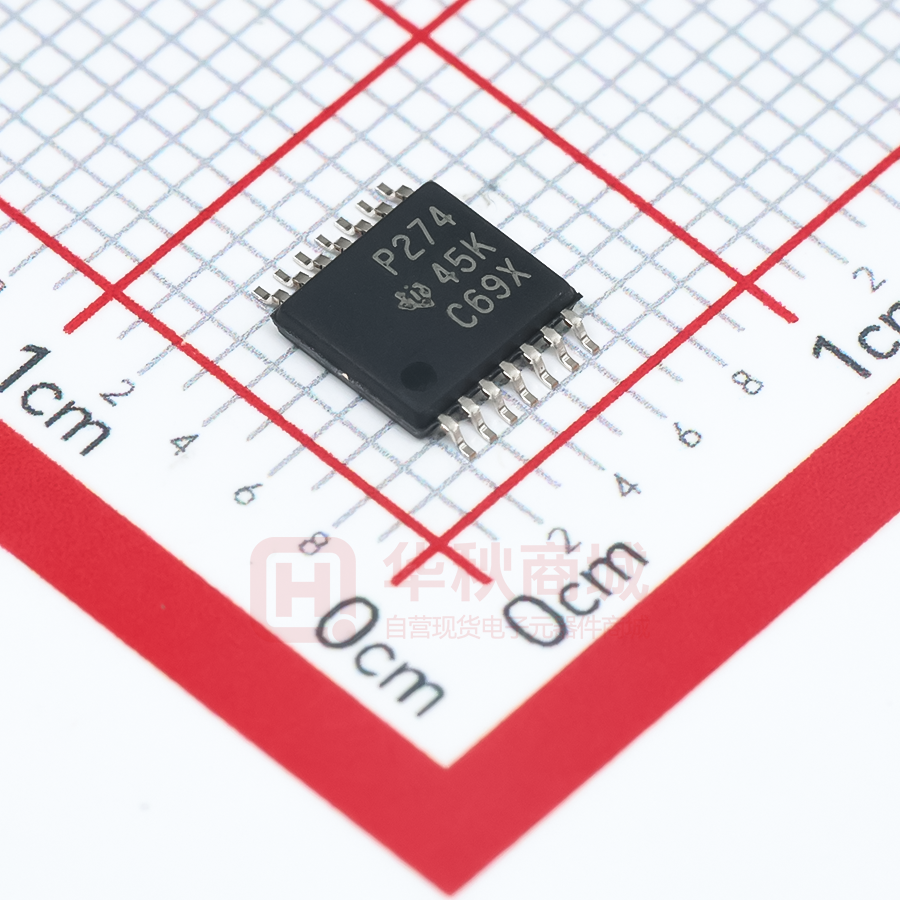

             SLOS092D − SEPTEMBER 1987 − REVISED MARCH 2001 D Trimmed Offset Voltage: D D D D D D D D 1OUT 1IN − 1IN + VDD 2IN + 2IN − 2OUT 1 14 2 13 3 12 4 11 5 10 6 9 7 8 4OUT 4IN − 4IN + GND 3IN + 3IN − 3OUT FK PACKAGE (TOP VIEW) 1IN − 1OUT NC 4OUT 4IN − D D, J, N, OR PW PACKAGE (TOP VIEW) 1IN + NC VDD NC 2IN + 4 3 2 1 20 19 18 5 17 6 16 7 15 8 14 9 10 11 12 13 4IN + NC GND NC 3IN + 2IN − 2OUT NC 3OUT 3IN − D TLC279 . . . 900 µV Max at 25°C, VDD = 5 V Input Offset Voltage Drift . . . Typically 0.1 µV/Month, Including the First 30 Days Wide Range of Supply Voltages Over Specified Temperature Range: 0°C to 70°C . . . 3 V to 16 V −40°C to 85°C . . . 4 V to 16 V −55°C to 125°C . . . 4 V to 16 V Single-Supply Operation Common-Mode Input Voltage Range Extends Below the Negative Rail (C-Suffix and I-Suffix Versions) Low Noise . . . Typically 25 nV/√Hz at f = 1 kHz Output Voltage Range Includes Negative Rail High Input Impedance . . . 1012 Ω Typ ESD-Protection Circuitry Small-Outline Package Option Also Available in Tape and Reel Designed-In Latch-Up Immunity description NC − No internal connection The TLC274 and TLC279 quad operational amplifiers combine a wide range of input offset voltage grades with low offset voltage drift, high input impedance, low noise, and speeds approaching that of general-purpose BiFET devices. The extremely high input impedance, low bias currents, and high slew rates make these cost-effective devices ideal for applications which have previously been reserved for BiFET and NFET products. Four offset voltage grades are available (C-suffix and I-suffix types), ranging from the low-cost TLC274 (10 mV) to the highprecision TLC279 (900 µV). These advantages, in combination with good common-mode rejection and supply voltage rejection, make these devices a good choice for new state-of-the-art designs as well as for upgrading existing designs. 30 25 Percentage of Units − % These devices use Texas Instruments silicongate LinCMOS technology, which provides offset voltage stability far exceeding the stability available with conventional metal-gate processes. DISTRIBUTION OF TLC279 INPUT OFFSET VOLTAGE 290 Units Tested From 2 Wafer Lots VDD = 5 V TA = 25°C N Package 20 15 10 5 0 −1200 −600 0 600 VIO − Input Offset Voltage − µV 1200 LinCMOS is a trademark of Texas Instruments. Copyright  2001, Texas Instruments Incorporated     ! "#$  !  %#&' "  ($) (#"! "   !%$"  "  ! %$ *$ $!  $+!  !#$ ! ! (( , -) (#"  %"$!! . ($!  $"$!! '- "'#($ $! .  '' %$$!) POST OFFICE BOX 655303 • DALLAS, TEXAS 75265 1              SLOS092D − SEPTEMBER 1987 − REVISED MARCH 2001 description (continued) In general, many features associated with bipolar technology are available on LinCMOS operational amplifiers, without the power penalties of bipolar technology. General applications such as transducer interfacing, analog calculations, amplifier blocks, active filters, and signal buffering are easily designed with the TLC274 and TLC279. The devices also exhibit low voltage single-supply operation, making them ideally suited for remote and inaccessible battery-powered applications. The common-mode input voltage range includes the negative rail. A wide range of packaging options is available, including small-outline and chip-carrier versions for high-density system applications. The device inputs and outputs are designed to withstand −100-mA surge currents without sustaining latch-up. The TLC274 and TLC279 incorporate internal ESD-protection circuits that prevent functional failures at voltages up to 2000 V as tested under MIL-STD-883C, Method 3015.2; however, care should be exercised in handling these devices as exposure to ESD may result in the degradation of the device parametric performance. The C-suffix devices are characterized for operation from 0°C to 70°C. The I-suffix devices are characterized for operation from − 40°C to 85°C. The M-suffix devices are characterized for operation over the full military temperature range of −55°C to 125°C. AVAILABLE OPTIONS PACKAGED DEVICES TA VIOmax AT 25°C SMALL OUTLINE (D) CHIP CARRIER (FK) CERAMIC DIP (J) PLASTIC DIP (N) TSSOP (PW) CHIP FORM (Y) 0°C to 70°C 900 µV 2 mV 5 mV 10 mV TLC279CD TLC274BCD TLC274ACD TLC274CD — — — — — — — — TLC279CN TLC274BCN TLC274ACN TLC274CN — — — TLC274CPW — — — TLC274Y −40°C to 85°C 900 µV 2 mV 5 mV 10 mV TLC279ID TLC274BID TLC274AID TLC274ID — — — — — — — — TLC279IN TLC274BIN TLC274AIN TLC274IN — — — — — — — — −55°C to 125°C 900 µV 10 mV TLC279MD TLC274MD TLC279MFK TLC274MFK TLC279MJ TLC274MJ TLC279MN TLC274MN — — — — The D package is available taped and reeled. Add R suffix to the device type (e.g., TLC279CDR). 2 POST OFFICE BOX 655303 • DALLAS, TEXAS 75265              SLOS092D − SEPTEMBER 1987 − REVISED MARCH 2001 equivalent schematic (each amplifier) VDD P3 P4 R6 R1 R2 IN − N5 P5 P6 P2 P1 IN + C1 R5 OUT N3 N1 R3 N4 N2 D1 R4 N6 N7 R7 D2 GND POST OFFICE BOX 655303 • DALLAS, TEXAS 75265 3              SLOS092D − SEPTEMBER 1987 − REVISED MARCH 2001 TLC274Y chip information These chips, when properly assembled, display characteristics similar to the TLC274C. Thermal compression or ultrasonic bonding may be used on the doped-aluminum bonding pads. Chips may be mounted with conductive epoxy or a gold-silicon preform. BONDING PAD ASSIGNMENTS (14) (13) (12) (11) (10) (9) (8) (3) 1IN + 1IN − (2) VDD (4) + (1) 1OUT − (5) + (7) 2OUT (10) 68 3IN + (9) 3IN − 4OUT (6) − + 2IN + 2IN − (8) 3OUT − + (14) − (12) (13) 4IN + 4IN − 11 (1) (2) (3) (4) (5) (6) (7) GND 108 CHIP THICKNESS: 15 TYPICAL BONDING PADS: 4 × 4 MINIMUM TJmax = 150°C TOLERANCES ARE ± 10%. ALL DIMENSIONS ARE IN MILS. PIN (11) IS INTERNALLY CONNECTED TO BACK SIDE OF CHIP. 4 POST OFFICE BOX 655303 • DALLAS, TEXAS 75265              SLOS092D − SEPTEMBER 1987 − REVISED MARCH 2001 absolute maximum ratings over operating free-air temperature range (unless otherwise noted)† Supply voltage, VDD (see Note 1) . . . . . . . . . . . . . . . . . . . . . . . . . . . . . . . . . . . . . . . . . . . . . . . . . . . . . . . . . . . . 18 V Differential input voltage, VID (see Note 2) . . . . . . . . . . . . . . . . . . . . . . . . . . . . . . . . . . . . . . . . . . . . . . . . . . . ± VDD Input voltage range, VI (any input) . . . . . . . . . . . . . . . . . . . . . . . . . . . . . . . . . . . . . . . . . . . . . . . . . . . −0.3 V to VDD Input current, II . . . . . . . . . . . . . . . . . . . . . . . . . . . . . . . . . . . . . . . . . . . . . . . . . . . . . . . . . . . . . . . . . . . . . . . . . . ± 5 mA Output current, lO (each output) . . . . . . . . . . . . . . . . . . . . . . . . . . . . . . . . . . . . . . . . . . . . . . . . . . . . . . . . . . ± 30 mA Total current into VDD . . . . . . . . . . . . . . . . . . . . . . . . . . . . . . . . . . . . . . . . . . . . . . . . . . . . . . . . . . . . . . . . . . . . 45 mA Total current out of GND . . . . . . . . . . . . . . . . . . . . . . . . . . . . . . . . . . . . . . . . . . . . . . . . . . . . . . . . . . . . . . . . . . 45 mA Duration of short-circuit current at (or below) 25°C (see Note 3) . . . . . . . . . . . . . . . . . . . . . . . . . . . . . . unlimited Continuous total dissipation . . . . . . . . . . . . . . . . . . . . . . . . . . . . . . . . . . . . . . . . . . . See Dissipation Rating Table Operating free-air temperature, TA: C suffix . . . . . . . . . . . . . . . . . . . . . . . . . . . . . . . . . . . . . . . . . . . . 0°C to 70°C I suffix . . . . . . . . . . . . . . . . . . . . . . . . . . . . . . . . . . . . . . . . . . . −40°C to 85°C M suffix . . . . . . . . . . . . . . . . . . . . . . . . . . . . . . . . . . . . . . . . . −55°C to 125°C Storage temperature range . . . . . . . . . . . . . . . . . . . . . . . . . . . . . . . . . . . . . . . . . . . . . . . . . . . . . . . . −65°C to 150°C Case temperature for 60 seconds: FK package . . . . . . . . . . . . . . . . . . . . . . . . . . . . . . . . . . . . . . . . . . . . . . 260°C Lead temperature 1,6 mm (1/16 inch) from case for 10 seconds: D, N, or PW package . . . . . . . . . . . . 260°C Lead temperature 1,6 mm (1/16 inch) from case for 60 seconds: J package . . . . . . . . . . . . . . . . . . . . . 300°C † Stresses beyond those listed under “absolute maximum ratings” may cause permanent damage to the device. These are stress ratings only, and functional operation of the device at these or any other conditions beyond those indicated under “recommended operating conditions” is not implied. Exposure to absolute-maximum-rated conditions for extended periods may affect device reliability. NOTES: 1. All voltage values, except differential voltages, are with respect to network ground. 2. Differential voltages are at the noninverting input with respect to the inverting input. 3. The output may be shorted to either supply. Temperature and/or supply voltages must be limited to ensure that the maximum dissipation rating is not exceeded (see application section). DISSIPATION RATING TABLE PACKAGE TA ≤ 25°C POWER RATING DERATING FACTOR ABOVE TA = 25°C TA = 70°C POWER RATING TA = 85°C POWER RATING TA = 125°C POWER RATING D 950 mW 7.6 mW/°C 608 mW 494 mW — FK 1375 mW 11.0 mW/°C 880 mW 715 mW 275 mW J 1375 mW 11.0 mW/°C 880 mW 715 mW 275 mW N 1575 mW 12.6 mW/°C 1008 mW 819 mW — PW 700 mW 5.6 mW/°C 448 mW — — recommended operating conditions Supply voltage, VDD Common-mode input voltage, VIC VDD = 5 V VDD = 10 V Operating free-air temperature, TA POST OFFICE BOX 655303 C SUFFIX I SUFFIX M SUFFIX MIN MAX MIN MAX MIN MAX 3 16 4 16 4 16 −0.2 3.5 −0.2 3.5 0 3.5 −0.2 8.5 −0.2 8.5 0 8.5 0 70 −40 85 −55 125 • DALLAS, TEXAS 75265 UNIT V V °C 5              SLOS092D − SEPTEMBER 1987 − REVISED MARCH 2001 electrical characteristics at specified free-air temperature, VDD = 5 V (unless otherwise noted) PARAMETER TEST CONDITIONS TA† TLC274C, TLC274AC, TLC274BC, TLC279C MIN TLC274C VIO VO = 1.4 V, RS = 50 Ω, VIC = 0, RL = 10 kΩ TLC274AC VO = 1.4 V, RS = 50 Ω, VIC = 0, RL = 10 kΩ TLC274BC VO = 1.4 V, RS = 50 Ω, VIC = 0, RL = 10 kΩ TLC279C VO = 1.4 V, RS = 50 Ω, VIC = 0, RL = 10 kΩ Input offset voltage αVIO Average temperature coefficient of input offset voltage IIO Input offset current (see Note 4) IIB Input bias current (see Note 4) VO = 2.5 V, VICR VOH VOL VIC = 2.5 V 25°C Low-level output voltage VID = 100 mV, RL = 10 kΩ VID = − 100 mV, IOL = 0 CMRR kSVR Large-signal differential voltage amplification Common-mode rejection ratio VO = 0.25 V to 2 V, RL = 10 kΩ VIC = VICRmin Supply-voltage rejection ratio (∆VDD /∆VIO) VDD = 5 V to 10 V, Supply current (four amplifiers) VO = 2.5 V, No load VO = 1.4 V 1.1 10 0.9 5 340 2000 Full range Full range 3000 25°C 320 Full range 900 1.8 25°C 0.1 60 70°C 7 300 25°C 0.6 60 70°C 40 600 25°C −0.2 to 4 Full range −0.2 to 3.5 25°C 3.2 3.8 0°C 3 3.8 70°C 3 3.8 µV/°C −0.3 to 4.2 V 25°C 0 50 0°C 0 50 0 50 25°C 5 23 0°C 4 27 70°C 4 20 25°C 65 80 0°C 60 84 70°C 60 85 25°C 65 95 0°C 60 94 70°C 60 96 mV V/mV dB dB 3.1 7.2 70°C 2.3 † Full range is 0°C to 70°C. NOTES: 4. The typical values of input bias current and input offset current below 5 pA were determined mathematically. 5. This range also applies to each input individually. 5.2 • DALLAS, TEXAS 75265 pA V 0°C POST OFFICE BOX 655303 pA V 6.4 6 µV V 1500 25°C to 70°C 2.7 VIC = 2.5 V, mV 6.5 25°C 25°C IDD UNIT 12 25°C 70°C AVD MAX Full range Common-mode input voltage range (see Note 5) High-level output voltage TYP mA              SLOS092D − SEPTEMBER 1987 − REVISED MARCH 2001 electrical characteristics at specified free-air temperature, VDD = 10 V (unless otherwise noted) PARAMETER TEST CONDITIONS TA† TLC274C, TLC274AC, TLC274BC, TLC279C MIN TLC274C VIO VO = 1.4 V, RS = 50 Ω, TLC274AC VO = 1.4 V, RS = 50 Ω, VIC = 0, RL = 10 kΩ TLC274BC VO = 1.4 V, RS = 50 Ω, VIC = 0, RL = 10 kΩ TLC279C VO = 1.4 V, RS = 50 Ω, VIC = 0, RL = 10 kΩ Input offset voltage αVIO Average temperature coefficient of input offset voltage IIO Input offset current (see Note 4) IIB Input bias current (see Note 4) VOH VOL 25°C VIC = 5 V Low-level output voltage VID = 100 mV, VID = − 100 mV, RL = 10 kΩ IOL = 0 CMRR kSVR Large-signal differential voltage amplification Common-mode rejection ratio VO = 1 V to 6 V, RL = 10 kΩ VIC = VICRmin Supply-voltage rejection ratio (∆VDD /∆VIO) VDD = 5 V to 10 V, Supply current (four amplifiers) VO = 5 V, No load VO = 1.4 V 10 0.9 5 390 2000 Full range Full range 3000 25°C 370 Full range 1200 µV/°C 2 25°C 0.1 60 70°C 7 300 25°C 0.7 60 70°C 50 600 25°C −0.2 to 9 Full range −0.2 to 8.5 −0.3 to 9.2 25°C 8 8.5 0°C 7.8 8.5 70°C 7.8 8.4 V 25°C 0 50 0°C 0 50 0 50 25°C 10 36 0°C 7.5 42 70°C 7.5 32 25°C 65 85 0°C 60 88 70°C 60 88 25°C 65 95 0°C 60 94 70°C 60 96 mV V/mV dB dB 0°C 4.5 8.8 70°C 3.2 † Full range is 0°C to 70°C. NOTES: 4. The typical values of input bias current and input offset current below 5 pA were determined mathematically. 5. This range also applies to each input individually. 6.8 • DALLAS, TEXAS 75265 pA V 8 POST OFFICE BOX 655303 pA V 3.8 VIC = 5 V, µV V 1900 25°C IDD mV 6.5 25°C 70°C AVD 1.1 UNIT 12 25°C Common-mode input voltage range (see Note 5) High-level output voltage MAX Full range 25°C to 70°C VO =.5 V, VICR VIC = 0, RL = 10 kΩ TYP mA 7              SLOS092D − SEPTEMBER 1987 − REVISED MARCH 2001 electrical characteristics at specified free-air temperature, VDD = 5 V (unless otherwise noted) PARAMETER TEST CONDITIONS TA† TLC274I, TLC274AI, TLC274BI, TLC279I MIN TLC274I VIO VO = 1.4 V, RS = 50 Ω, VIC = 0, RL = 10 kΩ TLC274AI VO = 1.4 V, RS = 50 Ω, VIC = 0, RL = 10 kΩ TLC274BI VO = 1.4 V, RS = 50 Ω, VIC = 0, RL = 10 kΩ TLC279I VO = 1.4 V, RS = 50 Ω, VIC = 0, RL = 10 kΩ Input offset voltage αVIO Average temperature coefficient of input offset voltage IIO Input offset current (see Note 4) IIB Input bias current (see Note 4) VO = 2.5 V, VICR VOH VOL VIC = 2.5 V 25°C Low-level output voltage VID = 100 mV, RL = 10 kΩ VID = −100 mV, IOL = 0 CMRR kSVR IDD Large-signal differential voltage amplification Common-mode rejection ratio VO = 0.25 V to 2 V, RL = 10 kΩ VIC = VICRmin Supply-voltage rejection ratio (∆VDD /∆VIO) VDD = 5 V to 10 V, Supply current (four amplifiers) VO = 2.5 V, No load VO = 1.4 V VIC = 2.5 V, 1.1 10 0.9 5 340 2000 Full range POST OFFICE BOX 655303 • DALLAS, TEXAS 75265 mV 7 25°C Full range 3500 25°C 320 Full range 900 µV V 2000 25°C to 85°C 1.8 25°C 0.1 60 85°C 24 1000 25°C 0.6 60 85°C 200 2000 25°C −0.2 to 4 Full range −0.2 to 3.5 µV/°C −0.3 to 4.2 pA pA V V 25°C 3.2 3.8 −40°C 3 3.8 85°C 3 3.8 V 25°C 0 50 −40°C 0 50 0 50 25°C 5 23 −40°C 3.5 32 85°C 3.5 19 25°C 65 80 −40°C 60 81 85°C 60 86 25°C 65 95 −40°C 60 92 85°C 60 96 mV V/mV dB dB 25°C 2.7 6.4 −40°C 3.8 8.8 85°C 2.1 4.8 † Full range is − 40°C to 85°C. NOTES: 4. The typical values of input bias current and input offset current below 5 pA were determined mathematically. 5. This range also applies to each input individually. 8 UNIT 13 25°C 85°C AVD MAX Full range Common-mode input voltage range (see Note 5) High-level output voltage TYP mA              SLOS092D − SEPTEMBER 1987 − REVISED MARCH 2001 electrical characteristics at specified free-air temperature, VDD = 10 V (unless otherwise noted) PARAMETER TEST CONDITIONS TA† TLC274I, TLC274AI, TLC274BI, TLC279I MIN TLC274I VIO VO = 1.4 V, RS = 50 Ω, VIC = 0, RL = 10 kΩ TLC274AI VO = 1.4 V, RS = 50 Ω, VIC = 0, RL = 10 kΩ TLC274BI VO = 1.4 V, RS = 50 Ω, VIC = 0, RL = 10 kΩ TLC279I VO = 1.4 V, RS = 50 Ω, VIC = 0, RL = 10 kΩ Input offset voltage αVIO Average temperature coefficient of input offset voltage IIO Input offset current (see Note 4) IIB Input bias current (see Note 4) VO = 5 V, VICR VOH VOL VIC = 5 V 25°C Low-level output voltage VID = 100 mV, RL = 10 kΩ VID = − 100 mV, IOL = 0 CMRR kSVR Large-signal differential voltage amplification Common-mode rejection ratio VO = 1 V to 6 V, RL = 10 kΩ VIC = VICRmin Supply-voltage rejection ratio (∆VDD /∆VIO) VDD = 5 V to 10 V, Supply current (four amplifiers) VO = 5 V, No load VO = 1.4 V 1.1 10 0.9 5 390 2000 Full range Full range 3500 25°C 370 Full range 1200 2 25°C 0.1 60 85°C 26 1000 25°C 0.7 60 85°C 220 2000 25°C −0.2 to 9 Full range −0.2 to 8.5 µV/°C −0.3 to 9.2 pA V 25°C 8 8.5 −40°C 7.8 8.5 85°C 7.8 8.5 V 25°C 0 50 −40°C 0 50 0 50 25°C 10 36 −40°C 7 47 85°C 7 31 25°C 65 85 −40°C 60 87 85°C 60 88 25°C 65 95 −40°C 60 92 85°C 60 96 mV V/mV dB dB −40°C 5.5 10 85°C 2.9 † Full range is − 40°C to 85°C. NOTES: 4. The typical values of input bias current and input offset current below 5 pA were determined mathematically. 5. This range also applies to each input individually. 6.4 • DALLAS, TEXAS 75265 pA V 8 POST OFFICE BOX 655303 µV V 2900 25°C to 85°C 3.8 VIC = 5 V, mV 7 25°C 25°C IDD UNIT 13 25°C 85°C AVD MAX Full range Common-mode input voltage range (see Note 5) High-level output voltage TYP mA 9              SLOS092D − SEPTEMBER 1987 − REVISED MARCH 2001 electrical characteristics at specified free-air temperature, VDD = 5 V (unless otherwise noted) PARAMETER VIO TEST CONDITIONS VO = 1.4 V, RS = 50 Ω, VIC = 0, RL = 10 kΩ Full range TLC279M VO = 1.4 V, RS = 50 Ω, VIC = 0, RL = 10 kΩ Full range Input offset voltage Average temperature coefficient of input offset voltage IIO Input offset current (see Note 4) VO = 2.5 V, VICR VOH VOL VIC = 2.5 V Input bias current (see Note 4) Low-level output voltage VID = 100 mV, RL = 10 kΩ VID = − 100 mV, IOL = 0 MIN CMRR kSVR Large-signal differential voltage amplification Common-mode rejection ratio VO = 0.25 V to 2 V, RL = 10 kΩ VIC = VICRmin Supply-voltage rejection ratio (∆VDD /∆VIO) VDD = 5 V to 10 V, Supply current (four amplifiers) VO = 2.5 V, No load VO = 1.4 V MAX 1.1 10 320 900 3750 25°C 0.1 60 pA 125°C 1.4 15 nA 25°C 0.6 60 pA 125°C 9 35 nA 25°C 0 to 4 Full range 0 to 3.5 −0.3 to 4.2 V V 25°C 3.2 3.8 −55°C 3 3.8 125°C 3 3.8 V 25°C 0 50 −55°C 0 50 0 50 25°C 5 23 −55°C 3.5 35 125°C 3.5 16 25°C 65 80 −55°C 60 81 125°C 60 84 25°C 65 95 −55°C 60 90 125°C 60 97 dB dB −55°C 4 10 125°C 1.9 † Full range is − 55°C to 125°C. NOTES: 4. The typical values of input bias current and input offset current below 5 pA were determined mathematically. 5. This range also applies to each input individually. 4.4 POST OFFICE BOX 655303 • DALLAS, TEXAS 75265 mV V/mV 6.4 10 µV V µV/°C 2.7 VIC = 2.5 V, mV 2.1 25°C IDD UNIT 25°C to 125°C 125°C AVD TYP 12 25°C Common-mode input voltage range (see Note 5) High-level output voltage TLC274M, TLC279M 25°C TLC274M αVIO IIB TA† mA              SLOS092D − SEPTEMBER 1987 − REVISED MARCH 2001 electrical characteristics at specified free-air temperature, VDD = 10 V (unless) otherwise noted) PARAMETER VIO TEST CONDITIONS TLC274M VO = 1.4 V, RS = 50 Ω, VIC = 0, RL = 10 kΩ TLC279M VO = 1.4 V, RS = 50 Ω, VIC = 0, RL = 10 kΩ Input offset voltage αVIO Average temperature coefficient of input offset voltage IIO Input offset current (see Note 4) VO = 5 V, IIB VICR VOH VOL AVD CMRR kSVR VIC = 5 V Input bias current (see Note 4) TA† Low-level output voltage Large-signal differential voltage amplification Common-mode rejection ratio Supply-voltage rejection ratio (∆VDD /∆VIO) VID = 100 mV, RL = 10 kΩ VID = − 100 mV, VO = 1 V to 6 V, IOL = 0 RL = 10 kΩ VIC = VICRmin VDD = 5 V to 10 V, VO = 1.4 V MIN 25°C TYP MAX 1.1 10 Full range 12 25°C 370 Full range 1200 4300 25°C to 125°C 2.2 0.1 60 pA 1.8 15 nA 25°C 0.7 60 pA 125°C 10 35 nA 25°C 0 to 9 Full range 0 to 8.5 −0.3 to 9.2 V V 25°C 8 8.5 −55°C 7.8 8.5 125°C 7.8 8.4 V 25°C 0 50 −55°C 0 50 125°C 0 50 25°C 10 36 −55°C 7 50 125°C 7 27 25°C 65 85 −55°C 60 87 125°C 60 86 25°C 65 95 −55°C 60 90 125°C 60 dB dB 97 8 6.0 12 125°C 2.5 † Full range is − 55°C to 125°C. NOTES: 4. The typical values of input bias current and input offset current below 5 pA were determined mathematically. 5. This range also applies to each input individually. 5.6 POST OFFICE BOX 655303 VIC = 5 V, • DALLAS, TEXAS 75265 mV V/mV −55°C VO = 5 V, No load µV V 25°C 3.8 Supply current (four amplifiers) mV µV/°C 25°C IDD UNIT 125°C Common-mode input voltage range (see Note 5) High-level output voltage TLC274M, TLC279M mA 11              SLOS092D − SEPTEMBER 1987 − REVISED MARCH 2001 operating characteristics at specified free-air temperature, VDD = 5 V PARAMETER TEST CONDITIONS TA TLC274C, TLC274AC, TLC274AC, TLC274BC, TLC279C MIN SR Slew rate at unity gain RL = 10 Ω,, CL = 20 PF, See Figure 1 VIPP = 1 V VIPP = 2.5 V Vn BOM B1 φm Equivalent input noise voltage f = 1 kHz, See Figure 2 RS = 20 Ω , Maximum output-swing bandwidth VO = VOH, RL = 10 kΩ, CL = 20 PF, See Figure 1 VI = 10 mV, See Figure 3 CL = 20 PF, Unity-gain bandwidth Phase margin VI = 10 mV, CL = 20 PF, f = B1, TYP 25°C 3.6 0°C 4 70°C 3 25°C 2.9 0°C 3.1 70°C 2.5 25°C 25 25°C 320 0°C 340 70°C 260 25°C 1.7 0°C 2 70°C 1.3 25°C 46° 0°C 47° 70°C 44° UNIT MAX V/ s V/µs nV/√Hz kHz MHz operating characteristics at specified free-air temperature, VDD = 10 V PARAMETER TEST CONDITIONS TA TLC274C, TLC274AC, TLC274AC, TLC274BC, TLC279C MIN SR Slew rate at unity gain RL = 10 Ω,, CL = 20 PF, See Figure 1 VIPP = 1 V VIPP = 5.5 V Vn BOM B1 φm 12 Equivalent input noise voltage f = 1 kHz, See Figure 2 RS = 20 Ω, Maximum output-swing bandwidth VO = VOH, RL = 10 kΩ, CL = 20 PF, See Figure 1 VI = 10 mV, See Figure 3 CL = 20 PF, Unity-gain bandwidth Phase margin VI = 10 mV, CL = 20 PF, POST OFFICE BOX 655303 f = B1, See Figure 3 • DALLAS, TEXAS 75265 TYP 25°C 5.3 0°C 5.9 70°C 4.3 25°C 4.6 0°C 5.1 70°C 3.8 25°C 25 25°C 200 0°C 220 70°C 140 25°C 2.2 0°C 2.5 70°C 1.8 25°C 49° 0°C 50° 70°C 46° UNIT MAX V/ s V/µs nV/√Hz kHz MHz              SLOS092D − SEPTEMBER 1987 − REVISED MARCH 2001 operating characteristics at specified free-air temperature, VDD = 5 V PARAMETER TEST CONDITIONS TA TLC274I, TLC274AI, TLC274BI, TLC279I MIN VIPP = 1 V SR Slew rate at unity gain RL = 10 kΩ, k , CL = 20 PF, See Figure 1 VIPP = 2.5 V Vn Equivalent input noise voltage f = 1 kHz, See Figure 2 RS = 20 Ω, BOM Maximum output-swing bandwidth VO = VOH, RL = 10 kΩ, CL = 20 PF, See Figure 1 VI = 10 mV, See Figure 3 CL = 20 PF, B1 φm Unity-gain bandwidth Phase margin VI = 10 mV, CL = 20 PF, f = B1, See Figure 3 TYP 25°C 3.6 −40°C 4.5 85°C 2.8 25°C 2.9 −40°C 3.5 85°C 2.3 25°C 25 25°C 320 −40°C 380 85°C 250 25°C 1.7 −40°C 2.6 85°C 1.2 25°C 46° −40°C 49° 85°C 43° UNIT MAX V/ s V/µs nV/√Hz kHz MHz operating characteristics at specified free-air temperature, VDD = 10 V PARAMETER TEST CONDITIONS TA TLC274I, TLC274AI, TLC274BI, TLC279I MIN SR Slew rate at unity gain RL = 10 Ω,, CL = 20 PF, See Figure 1 VIPP = 1 V VIPP = 5.5 V Vn BOM B1 φm Equivalent input noise voltage f = 1 kHz, See Figure 2 RS = 20 Ω, Maximum output-swing bandwidth VO = VOH, RL = 10 kΩ, CL = 20 PF, See Figure 1 VI = 10 mV, See Figure 3 CL = 20 PF, Unity-gain bandwidth Phase margin VI = 10 mV, CL = 20 PF, POST OFFICE BOX 655303 f = B1, See Figure 3 • DALLAS, TEXAS 75265 TYP 25°C 5.3 −40°C 6.7 85°C 4 25°C 4.6 −40°C 5.8 85°C 3.5 25°C 25 25°C 200 −40°C 260 85°C 130 25°C 2.2 −40°C 3.1 85°C 1.7 25°C 49° −40°C 52° 85°C 46° UNIT MAX V/ s V/µs nV/√Hz kHz MHz 13              SLOS092D − SEPTEMBER 1987 − REVISED MARCH 2001 operating characteristics at specified free-air temperature, VDD = 5 V PARAMETER TLC274M, TLC279M TEST CONDITIONS VIPP = 1 V SR Slew rate at unity gain RL = 10 kΩ, k , CL = 20 PF, See Figure 1 VIPP = 2.5 V Vn BOM B1 φm Equivalent input noise voltage f = 1 kHz, See Figure 2 RS = 20 Ω, Maximum output-swing bandwidth VO = VOH, RL = 10 kΩ, CL = 20 PF, See Figure 1 Unity-gain bandwidth VI = 10 mV, See Figure 3 VI = 10 mV, CL = 20 PF, Phase margin CL = 20 PF, f = B1, See Figure 3 TA MIN TYP 25°C 3.6 −55°C 4.7 125°C 2.3 25°C 2.9 −55°C 3.7 125°C 2 25°C 25 25°C 320 −55°C 400 125°C 230 25°C 1.7 −55°C 2.9 125°C 1.1 25°C 46° −55°C 49° 125°C 41° MAX UNIT V/ s V/µs nV/√Hz kHz MHz operating characteristics at specified free-air temperature, VDD = 10 V PARAMETER SR Slew rate at unity gain TLC274M, TLC279M TEST CONDITIONS RL = 10 Ω , CL = 20 PF, See Figure 1 VIPP = 1 V VIPP = 5.5 V Vn BOM B1 φm 14 Equivalent input noise voltage f = 1 kHz, See Figure 2 RS = 20 Ω, Maximum output-swing bandwidth VO = VOH, RL = 10 kΩ, CL = 20 PF, See Figure 1 VI = 10 mV, See Figure 3 CL = 20 PF, Unity-gain bandwidth Phase margin VI = 10 mV, CL = 20 PF, POST OFFICE BOX 655303 f = B1, See Figure 3 • DALLAS, TEXAS 75265 TA MIN TYP 25°C 5.3 −55°C 7.1 125°C 3.1 25°C 4.6 −55°C 6.1 125°C 2.7 25°C 25 25°C 200 −55°C 280 125°C 110 25°C 2.2 −55°C 3.4 125°C 1.6 25°C 49° −55°C 52° 125°C 44° MAX UNIT V/ s V/µs nV/√Hz kHz MHz              SLOS092D − SEPTEMBER 1987 − REVISED MARCH 2001 electrical characteristics, VDD = 5 V, TA = 25°C (unless otherwise noted) TLC274Y PARAMETER TEST CONDITIONS VIO Input offset voltage IIO IIB Input offset current (see Note 4) VICR Common-mode input voltage range (see Note 5) VOH VOL High-level output voltage AVD CMRR Large-signal differential voltage amplification kSVR Supply-voltage rejection ratio (∆VDD /∆VIO) IDD Supply current (four amplifiers) Input bias current (see Note 4) VO = 1.4 V, RS = 50 Ω, VIC = 0, RL = 10 kΩ VO = 2.5 V, VIC = 2.5 V VID = 100 mV, VID = −100 mV, Low-level output voltage Common-mode rejection ratio VO = 0.25 V to 2 V, VIC = VICRmin VDD = 5 V to 10 V, VO = 2.5 V, No load RL = 10 kΩ IOL = 0 RL = 10 kΩ VO = 1.4 V VIC = 2.5 V, MIN TYP MAX 1.1 10 UNIT mV 0.1 pA 0.6 pA −0.2 to 4 −0.3 to 4.2 V 3.2 3.8 0 V 50 mV 5 23 V/mV 65 80 dB 65 95 dB 2.7 6.4 mA electrical characteristics, VDD = 10 V, TA = 25°C (unless otherwise noted) TLC274Y PARAMETER VIO Input offset voltage IIO IIB Input offset current (see Note 4) TEST CONDITIONS Input bias current (see Note 4) VICR Common-mode input voltage range (see Note 5) VOH VOL High-level output voltage AVD CMRR Large-signal differential voltage amplification kSVR Supply-voltage rejection ratio (∆VDD /∆VIO) IDD Supply current (four amplifiers) VO = 1.4 V, RS = 50 Ω, VIC = 0, RL = 10 kΩ VO = 5 V, VIC = 5 V VID = 100 mV, VID = −100 mV, Low-level output voltage Common-mode rejection ratio VO = 1 V to 6 V, VIC = VICRmin VDD = 5 V to 10 V, VO = 5 V, No load RL = 10 kΩ IOL = 0 RL = 10 kΩ VO = 1.4 V VIC = 5 V, MIN TYP MAX 1.1 10 UNIT mV 0.1 pA 0.7 pA −0.2 to 9 −0.3 to 9.2 V 8 8.5 0 V 50 mV 10 36 V/mV 65 85 dB 65 95 dB 3.8 8 mA NOTES: 4. The typical values of input bias current and input offset current below 5 pA were determined mathematically. 5. This range also applies to each input individually. POST OFFICE BOX 655303 • DALLAS, TEXAS 75265 15              SLOS092D − SEPTEMBER 1987 − REVISED MARCH 2001 operating characteristics, VDD = 5 V, TA = 25°C TLC274Y PARAMETER TEST CONDITIONS MAX UNIT 3.6 RS = 20 Ω, See Figure 2 25 nV/√Hz CL = 20 PF, RL = 10 kΩ, 320 kHz CL = 20 PF, See Figure 3 1.7 MHz f = B1, CL = 20 PF, 46° Slew rate at unity gain RL = 10 kΩ, See Figure 1 CL = 20 PF, Vn Equivalent input noise voltage f = 1 kHz, BOM Maximum output-swing bandwidth VO = VOH, See Figure 1 B1 Unity-gain bandwidth VI = 10 mV, VI = 10 mV, See Figure 3 Phase margin TYP VIPP = 1 V VIPP = 2.5 V SR φm MIN V/ s V/µs 2.9 operating characteristics, VDD = 10 V, TA = 25°C TLC274Y PARAMETER TEST CONDITIONS See Figure 2 25 nV/√Hz CL = 20 PF, RL = 10 kΩ, 200 kHz CL = 20 PF, See Figure 3 2.2 MHz f = B1, CL = 20 PF, 49° CL = 20 PF, Vn Equivalent input noise voltage f = 1 kHz, BOM Maximum output-swing bandwidth VO = VOH, See Figure 1 B1 Unity-gain bandwidth VI = 10 mV, VI = 10 mV, See Figure 3 POST OFFICE BOX 655303 UNIT RS = 20 Ω, RL = 10 kΩ, See Figure 1 16 MAX 5.3 Slew rate at unity gain Phase margin TYP VIPP = 1 V VIPP = 5.5 V SR φm MIN • DALLAS, TEXAS 75265 4.6 V/ s V/µs              SLOS092D − SEPTEMBER 1987 − REVISED MARCH 2001 PARAMETER MEASUREMENT INFORMATION single-supply versus split-supply test circuits Because the TLC274 and TLC279 are optimized for single-supply operation, circuit configurations used for the various tests often present some inconvenience since the input signal, in many cases, must be offset from ground. This inconvenience can be avoided by testing the device with split supplies and the output load tied to the negative rail. A comparison of single-supply versus split-supply test circuits is shown below. The use of either circuit gives the same result. VDD VDD + − − VO + CL VO VI RL + VI CL RL VDD − (a) SINGLE SUPPLY (b) SPLIT SUPPLY Figure 1. Unity-Gain Amplifier 2 kΩ VDD + VDD − 20 Ω − VO VO 20 Ω + + 1/2 VDD 2 kΩ 20 Ω 20 Ω VDD − (a) SINGLE SUPPLY (b) SPLIT SUPPLY Figure 2. Noise-Test Circuit 10 kΩ VDD − VI 100 Ω VDD + − VI 100 Ω 10 kΩ VO VO + + 1/2 VDD CL CL VDD − (a) SINGLE SUPPLY (b) SPLIT SUPPLY Figure 3. Gain-of-100 Inverting Amplifier POST OFFICE BOX 655303 • DALLAS, TEXAS 75265 17              SLOS092D − SEPTEMBER 1987 − REVISED MARCH 2001 PARAMETER MEASUREMENT INFORMATION input bias current Because of the high input impedance of the TLC274 and TLC279 operational amplifiers, attempts to measure the input bias current can result in erroneous readings. The bias current at normal room ambient temperature is typically less than 1 pA, a value that is easily exceeded by leakages on the test socket. Two suggestions are offered to avoid erroneous measurements: 1. Isolate the device from other potential leakage sources. Use a grounded shield around and between the device inputs (see Figure 4). Leakages that would otherwise flow to the inputs are shunted away. 2. Compensate for the leakage of the test socket by actually performing an input bias current test (using a picoammeter) with no device in the test socket. The actual input bias current can then be calculated by subtracting the open-socket leakage readings from the readings obtained with a device in the test socket. One word of caution: many automatic testers as well as some bench-top operational amplifier testers use the servo-loop technique with a resistor in series with the device input to measure the input bias current (the voltage drop across the series resistor is measured and the bias current is calculated). This method requires that a device be inserted into the test socket to obtain a correct reading; therefore, an open-socket reading is not feasible using this method. 7 1 V = VIC 8 14 Figure 4. Isolation Metal Around Device Inputs (J and N packages) low-level output voltage To obtain low-supply-voltage operation, some compromise was necessary in the input stage. This compromise results in the device low-level output being dependent on both the common-mode input voltage level as well as the differential input voltage level. When attempting to correlate low-level output readings with those quoted in the electrical specifications, these two conditions should be observed. If conditions other than these are to be used, please refer to Figures 14 through 19 in the Typical Characteristics of this data sheet. input offset voltage temperature coefficient Erroneous readings often result from attempts to measure temperature coefficient of input offset voltage. This parameter is actually a calculation using input offset voltage measurements obtained at two different temperatures. When one (or both) of the temperatures is below freezing, moisture can collect on both the device and the test socket. This moisture results in leakage and contact resistance, which can cause erroneous input offset voltage readings. The isolation techniques previously mentioned have no effect on the leakage since the moisture also covers the isolation metal itself, thereby rendering it useless. It is suggested that these measurements be performed at temperatures above freezing to minimize error. 18 POST OFFICE BOX 655303 • DALLAS, TEXAS 75265              SLOS092D − SEPTEMBER 1987 − REVISED MARCH 2001 PARAMETER MEASUREMENT INFORMATION full-power response Full-power response, the frequency above which the operational amplifier slew rate limits the output voltage swing, is often specified two ways: full-linear response and full-peak response. The full-linear response is generally measured by monitoring the distortion level of the output while increasing the frequency of a sinusoidal input signal until the maximum frequency is found above which the output contains significant distortion. The full-peak response is defined as the maximum output frequency, without regard to distortion, above which full peak-to-peak output swing cannot be maintained. Because there is no industry-wide accepted value for significant distortion, the full-peak response is specified in this data sheet and is measured using the circuit of Figure 1. The initial setup involves the use of a sinusoidal input to determine the maximum peak-to-peak output of the device (the amplitude of the sinusoidal wave is increased until clipping occurs). The sinusoidal wave is then replaced with a square wave of the same amplitude. The frequency is then increased until the maximum peak-to-peak output can no longer be maintained (Figure 5). A square wave is used to allow a more accurate determination of the point at which the maximum peak-to-peak output is reached. (a) f = 1 kHz (b) BOM > f > 1 kHz (c) f = BOM (d) f > BOM Figure 5. Full-Power-Response Output Signal test time Inadequate test time is a frequent problem, especially when testing CMOS devices in a high-volume, short-test-time environment. Internal capacitances are inherently higher in CMOS than in bipolar and BiFET devices and require longer test times than their bipolar and BiFET counterparts. The problem becomes more pronounced with reduced supply levels and lower temperatures. POST OFFICE BOX 655303 • DALLAS, TEXAS 75265 19              SLOS092D − SEPTEMBER 1987 − REVISED MARCH 2001 TYPICAL CHARACTERISTICS Table of Graphs FIGURE 20 VIO αVIO Input offset voltage Distribution 6, 7 Temperature coefficient of input offset voltage Distribution 8, 9 VOH High-level output voltage vs High-level output current vs Supply voltage vs Free-air temperature 10, 11 12 13 VOL Low-level output voltage vs Common-mode input voltage vs Differential input voltage vs Free-air temperature vs Low-level output current 14, 15 16 17 18, 19 AVD Large-signal differential voltage amplification vs Supply voltage vs Free-air temperature vs Frequency 20 21 32, 33 IIB IIO Input bias current vs Free-air temperature 22 Input offset current vs Free-air temperature 22 VIC Common-mode input voltage vs Supply voltage 23 IDD Supply current vs Supply voltage vs Free-air temperature 24 25 SR Slew rate vs Supply voltage vs Free-air temperature 26 27 Normalized slew rate vs Free-air temperature 28 VO(PP) Maximum peak-to-peak output voltage vs Frequency 29 B1 Unity-gain bandwidth vs Free-air temperature vs Supply voltage 30 31 φm Phase margin vs Supply voltage vs Free-air temperature vs Load capacitance 34 35 36 Vn Equivalent input noise voltage vs Frequency 37 Phase shift vs Frequency 32, 33 POST OFFICE BOX 655303 • DALLAS, TEXAS 75265              SLOS092D − SEPTEMBER 1987 − REVISED MARCH 2001 TYPICAL CHARACTERISTICS DISTRIBUTION OF TLC274 INPUT OFFSET VOLTAGE DISTRIBUTION OF TLC274 INPUT OFFSET VOLTAGE Percentage of Units − % 50 ÑÑÑÑÑÑÑÑÑÑÑÑ ÑÑÑÑÑÑÑÑÑÑÑÑ ÑÑÑÑÑÑÑÑÑÑÑÑ ÑÑÑÑÑÑÑÑÑÑÑÑ 60 753 Amplifiers Tested From 6 Wafer Lots VDD = 5 V TA= 25°C N Package 753 Amplifiers Tested From 6 Wafer Lots VDD = 10 V TA = 25°C N Package 50 Percentage of Units − % 60 40 30 20 40 30 20 10 10 0 0 −5 −4 −3 −2 −1 0 1 2 3 VIO − Input Offset Voltage − mV 4 −5 5 −4 Figure 6 40 5 DISTRIBUTION OF TLC274 AND TLC279 INPUT OFFSET VOLTAGE TEMPERATURE COEFFICIENT ÑÑÑÑÑÑÑÑÑÑÑÑ ÑÑÑÑÑÑÑÑÑÑÑÑ ÑÑÑÑÑÑÑÑÑÑÑÑ ÑÑÑÑÑÑÑÑÑÑÑÑ 60 324 Amplifiers Tested From 8 Wafer Lots VDD = 5 V TA = 25°C to 125°C N Package Outliers: (1) 20.5 V/°C 50 Percentage of Units − % Percentage of Units − % 50 4 Figure 7 DISTRIBUTION OF TLC274 AND TLC279 INPUT OFFSET VOLTAGE TEMPERATURE COEFFICIENT 60 −3 −2 −1 0 1 2 3 VIO − Input Offset Voltage − mV 30 20 10 40 324 Amplifiers Tested From 8 Wafer Lots VDD = 10 V TA = 25°C to 125°C N Package Outliers: (1) 21.2 V/C 30 20 10 0 2 4 6 8 −10 −8 −6 −4 −2 0 αVIO − Temperature Coefficient − µV/°C 10 0 −10 −8 −6 −4 −2 0 2 4 6 8 αVIO − Temperature Coefficient − µV/°C 10 Figure 9 Figure 8 POST OFFICE BOX 655303 • DALLAS, TEXAS 75265 21              SLOS092D − SEPTEMBER 1987 − REVISED MARCH 2001 TYPICAL CHARACTERISTICS† HIGH-LEVEL OUTPUT VOLTAGE vs HIGH-LEVEL OUTPUT CURRENT Q HIGH-LEVEL OUTPUT VOLTAGE vs HIGH-LEVEL OUTPUT CURRENT 16 VID = 100 mV TA = 25°C 4 VDD = 5 V 3 VDD = 4 V VDD = 3 V 2 1 0 VDD = 16 V 12 10 8 VDD = 10 V 6 4 2 0 0 −2 −4 −6 −8 −10 0 −10 −15 −5 IOH − High-Level Output Current − mA −20 −25 −30 −35 Figure 11 HIGH-LEVEL OUTPUT VOLTAGE vs FREE-AIR TEMPERATURE HIGH-LEVEL OUTPUT VOLTAGE vs SUPPLY VOLTAGE VDD −1.6 16 12 VOH − High-Level Output Voltage − V VID = 100 mV RL = 10 kΩ TA = 25°C 14 10 8 6 4 2 0 0 2 4 6 8 10 12 14 16 IOH = − 5 mA VID = 100 mA VDD −1.7 VDD = 5 V VDD −1.8 VDD −1.9 VDD −2 VDD = 10 V VDD −2.1 VDD −2.2 VDD −2.3 VDD −2.4 −75 −50 −25 0 25 50 75 100 TA − Free-Air Temperature − °C VDD − Supply Voltage − V Figure 12 Figure 13 † Data at high and low temperatures are applicable only within the rated operating free-air temperature ranges of the various devices. 22 −40 IOH − High-Level Output Current − mA Figure 10 VOH − High-Level Output Voltage − V VID = 100 mV TA = 25°C 14 VOH − High-Level Output Voltage − V VOH − High-Level Output Voltage − V 5 POST OFFICE BOX 655303 • DALLAS, TEXAS 75265 125              SLOS092D − SEPTEMBER 1987 − REVISED MARCH 2001 TYPICAL CHARACTERISTICS† LOW-LEVEL OUTPUT VOLTAGE vs COMMON-MODE INPUT VOLTAGE LOW-LEVEL OUTPUT VOLTAGE vs COMMON-MODE INPUT VOLTAGE 500 VDD = 5 V IOL = 5 mA TA = 25°C 650 VOL − Low-Level Output Voltage − mV VOL − Low-Level Output Voltage − mV 700 600 550 VID = − 100 mV 500 450 400 VID = − 1 V 350 450 400 VID = − 100 mV 0 1 2 3 VIC − Common-Mode Input Voltage − V VID = − 1 V 350 VID = − 2.5 V 300 250 300 VDD = 10 V IOL = 5 mA TA = 25°C 4 0 2 4 6 8 1 3 5 7 9 VIC − Common-Mode Input Voltage − V Figure 15 Figure 14 LOW-LEVEL OUTPUT VOLTAGE vs FREE-AIR TEMPERATURE LOW-LEVEL OUTPUT VOLTAGE vs DIFFERENTIAL INPUT VOLTAGE 800 900 IOL = 5 mA VIC = |VID/2| TA = 25°C 700 VOL − Low-Level Output Voltage − mV VOL − Low-Level Output Voltage − mV 10 600 500 VDD = 5 V 400 300 VDD = 10 V 200 100 0 0 −1 −2 −3 −4 −5 −6 −7 −8 −9 VID − Differential Input Voltage − V −10 800 700 IOL = 5 mA VID = − 1 V VIC = 0.5 V VDD = 5 V 600 500 400 VDD = 10 V 300 200 100 0 −75 −50 −25 0 25 50 75 100 TA − Free-Air Temperature − °C 125 Figure 17 Figure 16 † Data at high and low temperatures are applicable only within the rated operating free-air temperature ranges of the various devices. POST OFFICE BOX 655303 • DALLAS, TEXAS 75265 23              SLOS092D − SEPTEMBER 1987 − REVISED MARCH 2001 TYPICAL CHARACTERISTICS† LOW-LEVEL OUTPUT VOLTAGE vs LOW-LEVEL OUTPUT CURRENT LOW-LEVEL OUTPUT VOLTAGE vs LOW-LEVEL OUTPUT CURRENT 1 3 VOL − Low-Level Output Voltage − V 0.9 0.8 VOL − Low-Level Output Voltage − V VID = − 1 V VIC = 0.5 V TA = 25°C VDD = 5 V 0.7 VDD = 4 V 0.6 VDD = 3 V 0.5 0.4 0.3 0.2 0.1 0 0 1 2 3 4 5 6 7 IOL − Low-Level Output Current − mA 2.5 VDD = 10 V 1.5 1 0.5 0 8 0 5 10 15 20 25 IOL − Low-Level Output Current − mA 50 ÑÑÑ TA = 0°C 40 ÑÑÑÑ ÑÑÑÑ ÁÁ ÑÑÑÑ ÁÁ ÁÁ 30 TA = 25°C TA = 85°C 20 TA = 125°C 10 0 0 2 4 6 8 10 12 VDD − Supply Voltage − V 14 16 RL = 10 kΩ 45 AVD AVD − Large-Signal Differential Voltage Amplification − V/mV AVD AVD − Large-Signal Differential Voltage Amplification − V/mV ÁÁ ÁÁ ÁÁ LARGE-SIGNAL DIFFERENTIAL VOLTAGE AMPLIFICATION vs FREE-AIR TEMPERATURE TA = − 55°C RL = 10 kΩ 40 VDD = 10 V 35 30 25 20 VDD = 5 V 15 10 5 0 −75 −50 Figure 20 −25 0 25 50 75 100 TA − Free-Air Temperature − °C Figure 21 † Data at high and low temperatures are applicable only within the rated operating free-air temperature ranges of the various devices. 24 30 Figure 19 LARGE-SIGNAL DIFFERENTIAL VOLTAGE AMPLIFICATION vs SUPPLY VOLTAGE 50 VDD = 16 V 2 Figure 18 60 ÑÑÑÑÑ ÑÑÑÑÑ VID = − 1 V VIC = 0.5 V TA = 25°C POST OFFICE BOX 655303 • DALLAS, TEXAS 75265 125              SLOS092D − SEPTEMBER 1987 − REVISED MARCH 2001 TYPICAL CHARACTERISTICS† COMMON-MODE INPUT VOLTAGE POSITIVE LIMIT vs SUPPLY VOLTAGE 10000 VDD = 10 V VIC = 5 V See Note A 16 ÑÑÑ ÑÑÑ 1000 IIB 100 VIC − Common-Mode Input Voltage − V I IB and I IO − Input Bias and Offset Currents − pA INPUT BIAS CURRENT AND INPUT OFFSET CURRENT vs FREE-AIR TEMPERATURE ÑÑ ÑÑ IIO 10 1 0.1 25 45 65 85 105 TA − Free-Air Temperature − °C 125 TA = 25°C 14 12 10 8 6 4 2 0 0 2 4 6 8 10 12 VDD − Supply Voltage − V NOTE A: The typical values of input bias current and input offset current below 5 pA were determined mathematically. 16 Figure 23 Figure 22 SUPPLY CURRENT vs SUPPLY VOLTAGE SUPPLY CURRENT vs FREE-AIR TEMPERATURE 10 8 VO = VDD/2 No Load 9 7 VO = VDD/2 No Load TA = − 55°C 8 7 ÑÑÑÑ ÑÑÑÑ 6 TA = 25°C 5 4 3 ÑÑÑ TA = 0°C ÑÑÑÑ ÑÑÑÑ ÑÑÑÑÑ ÑÑÑÑÑ 2 TA = 70°C 1 I DD − Supply Current − mA I DD − Supply Current − mA 14 6 5 VDD = 10 V 4 3 VDD = 5 V 2 1 TA = 125°C 0 0 2 4 6 8 10 12 VDD − Supply Voltage − V 14 16 0 −75 −50 −25 0 25 50 75 100 TA − Free-Air Temperature − °C Figure 24 125 Figure 25 † Data at high and low temperatures are applicable only within the rated operating free-air temperature ranges of the various devices. POST OFFICE BOX 655303 • DALLAS, TEXAS 75265 25              SLOS092D − SEPTEMBER 1987 − REVISED MARCH 2001 TYPICAL CHARACTERISTICS† SLEW RATE vs SUPPLY VOLTAGE SLEW RATE vs FREE-AIR TEMPERATURE 8 6 5 7 VDD = 10 V VIPP = 5.5 V 6 SR − Slew Rate − V/ µs 7 SR − Slew Rate − V/ µs ÑÑÑÑÑ ÑÑÑÑÑ 8 AV = 1 VIPP = 1 V RL = 10 k Ω CL = 20 pF TA = 25°C See Figure 1 4 3 2 VDD = 10 V VIPP = 1 V 5 4 3 VDD = 5 V VIPP = 1 V 2 1 VDD = 5 V VIPP = 2.5 V 1 0 0 2 4 6 8 10 12 VDD − Supply Voltage − V 14 0 −75 16 −50 −25 0 25 50 75 100 TA − Free-Air Temperature − °C MAXIMUM PEAK-TO-PEAK OUTPUT VOLTAGE vs FREQUENCY VO(PP) − Maximum Peak-to-Peak Output Voltage − V NORMALIZED SLEW RATE vs FREE-AIR TEMPERATURE 1.5 VDD = 10 V Normalized Slew Rate 1.3 AV = 1 VIPP = 1 V RL = 10 kΩ CL = 20 pF 1.2 1.1 VDD = 5 V 1 0.9 0.8 0.7 0.6 0.5 −75 −50 125 Figure 27 Figure 26 1.4 AV = 1 RL = 10 k Ω CL = 20 pF See Figure 1 −25 0 25 50 75 100 TA − Free-Air Temperature − °C 125 10 VDD = 10 V 9 8 TA = 125°C TA = 25°C TA = − 55°C 7 6 5 VDD = 5 V 4 3 RL = 10 k Ω See Figure 1 2 1 0 10 Figure 28 100 1000 f − Frequency − kHz 10000 Figure 29 † Data at high and low temperatures are applicable only within the rated operating free-air temperature ranges of the various devices. 26 POST OFFICE BOX 655303 • DALLAS, TEXAS 75265              SLOS092D − SEPTEMBER 1987 − REVISED MARCH 2001 TYPICAL CHARACTERISTICS† UNITY-GAIN BANDWIDTH vs FREE-AIR TEMPERATURE UNITY-GAIN BANDWIDTH vs SUPPLY VOLTAGE 3 2.5 B1 − Unity-Gain Bandwidth − MHz B1 − Unity-Gain Bandwidth − MHz VDD = 5 V VI = 10 mV CL = 20 pF See Figure 3 2.5 2 1.5 1 −75 VI = 10 mV CL = 20 pF TA = 25°C See Figure 3 2 1.5 1 −50 −25 0 25 50 75 100 TA − Free-Air Temperature − °C 0 125 2 4 6 8 10 12 VDD − Supply Voltage − V Figure 30 14 16 Figure 31 LARGE-SIGNAL DIFFERENTIAL VOLTAGE AMPLIFICATION AND PHASE SHIFT vs FREQUENCY 107 VDD = 5 V RL = 10 k Ω TA = 25°C ÁÁ ÁÁ 105 0° 104 30° AVD 103 60° 102 90° Phase Shift 10 120° 1 150° 0.1 10 100 1k 10 k 100 k f − Frequency − Hz 1M Phase Shift AVD AVD − Large-Signal Differential Voltage Amplification 106 180° 10 M Figure 32 † Data at high and low temperatures are applicable only within the rated operating free-air temperature ranges of the various devices. POST OFFICE BOX 655303 • DALLAS, TEXAS 75265 27              SLOS092D − SEPTEMBER 1987 − REVISED MARCH 2001 TYPICAL CHARACTERISTICS† LARGE-SIGNAL DIFFERENTIAL VOLTAGE AMPLIFICATION AND PHASE SHIFT vs FREQUENCY 107 VDD = 10 V RL = 10 k Ω TA = 25°C ÁÁ ÁÁ ÁÁ 105 0° 104 30° AVD 103 60° 102 90° Phase Shift 10 120° 1 150° 0.1 10 100 1k 10 k 100 k f − Frequency − Hz 1M Phase Shift AVD AVD − Large-Signal Differential Voltage Amplification 106 180° 10 M Figure 33 PHASE MARGIN vs SUPPLY VOLTAGE PHASE MARGIN vs FREE-AIR TEMPERATURE 53° 50° VDD = 5 V VI = 10 mV CL = 20 pF See Figure 3 52° 48° φ m − Phase Margin φ m − Phase Margin 51° 50° 49° 48° VI = 10 mV CL = 20 pF TA = 25°C See Figure 3 47° 46° 2 4 6 8 10 12 VDD − Supply Voltage − V 14 44° 42° 45° 0 46° 16 40° −75 −50 −25 0 25 50 75 100 TA − Free-Air Temperature − °C 125 Figure 35 Figure 34 † Data at high and low temperatures are applicable only within the rated operating free-air temperature ranges of the various devices. 28 POST OFFICE BOX 655303 • DALLAS, TEXAS 75265              SLOS092D − SEPTEMBER 1987 − REVISED MARCH 2001 TYPICAL CHARACTERISTICS PHASE MARGIN vs LOAD CAPACITANCE EQUIVALENT INPUT NOISE VOLTAGE vs FREQUENCY VDD = 5 V VI = 10 mV TA = 25°C See Figure 3 φ m − Phase Margin 45° 40° 35° 30° 25° 0 10 20 30 40 50 60 70 80 CL − Capacitive Load − pF 90 100 Vn − Equivalent Input Noise Voltage − nV/ Hz 400 50° VDD = 5 V RS = 20 Ω TA = 25°C See Figure 2 300 200 100 0 1 10 100 f − Frequency − Hz 1000 Figure 37 Figure 36 POST OFFICE BOX 655303 • DALLAS, TEXAS 75265 29              SLOS092D − SEPTEMBER 1987 − REVISED MARCH 2001 APPLICATION INFORMATION single-supply operation While the TLC274 and TLC279 perform well using dual power supplies (also called balanced or split supplies), the design is optimized for single-supply operation. This design includes an input common-mode voltage range that encompasses ground as well as an output voltage range that pulls down to ground. The supply voltage range extends down to 3 V (C-suffix types), thus allowing operation with supply levels commonly available for TTL and HCMOS; however, for maximum dynamic range, 16-V single-supply operation is recommended. Many single-supply applications require that a voltage be applied to one input to establish a reference level that is above ground. A resistive voltage divider is usually sufficient to establish this reference level (see Figure 38). The low input bias current of the TLC274 and TLC279 permits the use of very large resistive values to implement the voltage divider, thus minimizing power consumption. The TLC274 and TLC279 work well in conjunction with digital logic; however, when powering both linear devices and digital logic from the same power supply, the following precautions are recommended: 1. Power the linear devices from separate bypassed supply lines (see Figure 39); otherwise the linear device supply rails can fluctuate due to voltage drops caused by high switching currents in the digital logic. 2. Use proper bypass techniques to reduce the probability of noise-induced errors. Single capacitive decoupling is often adequate; however, high-frequency applications may require RC decoupling. VDD R4 R1 VREF = VDD R2 VI − R3 R4 + V VO = (VREF − VI ) REF R2 VO + VREF R3 R1 + R3 C 0.01 µF Figure 38. Inverting Amplifier With Voltage Reference − VO Logic Logic Logic Power Supply + (a) COMMON SUPPLY RAILS − Logic Logic Logic + VO (b) SEPARATE BYPASSED SUPPLY RAILS (preferred) Figure 39. Common Versus Separate Supply Rails 30 POST OFFICE BOX 655303 • DALLAS, TEXAS 75265 Power Supply              SLOS092D − SEPTEMBER 1987 − REVISED MARCH 2001 APPLICATION INFORMATION input characteristics The TLC274 and TLC279 are specified with a minimum and a maximum input voltage that, if exceeded at either input, could cause the device to malfunction. Exceeding this specified range is a common problem, especially in single-supply operation. Note that the lower range limit includes the negative rail, while the upper range limit is specified at VDD − 1 V at TA = 25°C and at VDD − 1.5 V at all other temperatures. The use of the polysilicon-gate process and the careful input circuit design gives the TLC274 and TLC279 very good input offset voltage drift characteristics relative to conventional metal-gate processes. Offset voltage drift in CMOS devices is highly influenced by threshold voltage shifts caused by polarization of the phosphorus dopant implanted in the oxide. Placing the phosphorus dopant in a conductor (such as a polysilicon gate) alleviates the polarization problem, thus reducing threshold voltage shifts by more than an order of magnitude. The offset voltage drift with time has been calculated to be typically 0.1 µV/month, including the first month of operation. Because of the extremely high input impedance and resulting low bias current requirements, the TLC274 and TLC279 are well suited for low-level signal processing; however, leakage currents on printed-circuit boards and sockets can easily exceed bias current requirements and cause a degradation in device performance. It is good practice to include guard rings around inputs (similar to those of Figure 4 in the Parameter Measurement Information section). These guards should be driven from a low-impedance source at the same voltage level as the common-mode input (see Figure 40). Unused amplifiers should be connected as grounded unity-gain followers to avoid possible oscillation. noise performance The noise specifications in operational amplifier circuits are greatly dependent on the current in the first-stage differential amplifier. The low input bias current requirements of the TLC274 and TLC279 result in a very low noise current, which is insignificant in most applications. This feature makes the devices especially favorable over bipolar devices when using values of circuit impedance greater than 50 kΩ, since bipolar devices exhibit greater noise currents. VO + (b) INVERTING AMPLIFIER VI + − − + (a) NONINVERTING AMPLIFIER VI − VI VO VO (c) UNITY-GAIN AMPLIFIER Figure 40. Guard-Ring Schemes output characteristics The output stage of the TLC274 and TLC279 is designed to sink and source relatively high amounts of current (see typical characteristics). If the output is subjected to a short-circuit condition, this high current capability can cause device damage under certain conditions. Output current capability increases with supply voltage. All operating characteristics of the TLC274 and TLC279 were measured using a 20-pF load. The devices drive higher capacitive loads; however, as output load capacitance increases, the resulting response pole occurs at lower frequencies, thereby causing ringing, peaking, or even oscillation (see Figure 41). In many cases, adding a small amount of resistance in series with the load capacitance alleviates the problem. POST OFFICE BOX 655303 • DALLAS, TEXAS 75265 31              SLOS092D − SEPTEMBER 1987 − REVISED MARCH 2001 APPLICATION INFORMATION output characteristics (continued) (a) CL = 20 pF, RL = NO LOAD (b) CL = 130 pF, RL = NO LOAD 2.5 V − VO + VI CL TA = 25°C f = 1 kHz VIPP = 1 V −2.5 V (c) CL = 150 pF, RL = NO LOAD (d) TEST CIRCUIT Figure 41. Effect of Capacitive Loads and Test Circuit Although the TLC274 and TLC279 possess excellent high-level output voltage and current capability, methods for boosting this capability are available, if needed. The simplest method involves the use of a pullup resistor (RP) connected from the output to the positive supply rail (see Figure 42). There are two disadvantages to the use of this circuit. First, the NMOS pulldown transistor N4 (see equivalent schematic) must sink a comparatively large amount of current. In this circuit, N4 behaves like a linear resistor with an on-resistance between approximately 60 Ω and 180 Ω, depending on how hard the op amp input is driven. With very low values of RP, a voltage offset from 0 V at the output occurs. Second, pullup resistor RP acts as a drain load to N4 and the gain of the operational amplifier is reduced at output voltage levels where N5 is not supplying the output current. 32 POST OFFICE BOX 655303 • DALLAS, TEXAS 75265              SLOS092D − SEPTEMBER 1987 − REVISED MARCH 2001 APPLICATION INFORMATION output characteristics (continued) VDD C + IP RP VO − − VI IF Rp = + R2 R1 VO IL RL VDD − VO IF + IL + IP Figure 43. Compensation for Input Capacitance IP = Pullup current required by the operational amplifier (typically 500 µA) Figure 42. Resistive Pullup to Increase VOH feedback Operational amplifier circuits nearly always employ feedback, and since feedback is the first prerequisite for oscillation, some caution is appropriate. Most oscillation problems result from driving capacitive loads (discussed previously) and ignoring stray input capacitance. A small-value capacitor connected in parallel with the feedback resistor is an effective remedy (see Figure 43). The value of this capacitor is optimized empirically. electrostatic discharge protection The TLC274 and TLC279 incorporate an internal electrostatic discharge (ESD) protection circuit that prevents functional failures at voltages up to 2000 V as tested under MIL-STD-883C, Method 3015.2. Care should be exercised, however, when handling these devices as exposure to ESD may result in the degradation of the device parametric performance. The protection circuit also causes the input bias currents to be temperature-dependent and have the characteristics of a reverse-biased diode. latch-up Because CMOS devices are susceptible to latch-up due to their inherent parasitic thyristors, the TLC274 and TLC279 inputs and outputs were designed to withstand − 100-mA surge currents without sustaining latch-up; however, techniques should be used to reduce the chance of latch-up whenever possible. Internal protection diodes should not, by design, be forward biased. Applied input and output voltage should not exceed the supply voltage by more than 300 mV. Care should be exercised when using capacitive coupling on pulse generators. Supply transients should be shunted by the use of decoupling capacitors (0.1 µF typical) located across the supply rails as close to the device as possible. The current path established if latch-up occurs is usually between the positive supply rail and ground and can be triggered by surges on the supply lines and/or voltages on either the output or inputs that exceed the supply voltage. Once latch-up occurs, the current flow is limited only by the impedance of the power supply and the forward resistance of the parasitic thyristor and usually results in the destruction of the device. The chance of latch-up occurring increases with increasing temperature and supply voltages. POST OFFICE BOX 655303 • DALLAS, TEXAS 75265 33              SLOS092D − SEPTEMBER 1987 − REVISED MARCH 2001 APPLICATION INFORMATION 10 kΩ 10 kΩ 0.016 µF − 10 kΩ 1/4 TLC274 10 kΩ 1/4 TLC274 5V − 10 kΩ − VI 0.016 µF 1/4 TLC274 Low Pass + + + HIgh Pass 5 kΩ Band Pass R = 5 kΩ (3/d−1) (see Note A) NOTE A: d = damping factor, 1/Q Figure 44. State-Variable Filter 12 V VI + 1/4 TLC274 H.P. 5082 - 2835 + 1/4 TLC274 − 0.5 µF Mylar N.O. Reset − Figure 45. Positive-Peak Detector 34 POST OFFICE BOX 655303 VO • DALLAS, TEXAS 75265 100 kΩ              SLOS092D − SEPTEMBER 1987 − REVISED MARCH 2001 APPLICATION INFORMATION VI (see Note A) 100 kΩ 1.2 kΩ 4.7 kΩ − TL431 1 kΩ 1/4 TLC274 20 kΩ 0.1 µF 0.47 µF TIP31 15 Ω + TIS193 250 µF, 25 V + − VO (see Note B) 10 kΩ 47 kΩ 0.01 µF 110 Ω 22 kΩ NOTES: B. VI = 3.5 V to 15 V C. VO = 2 V, 0 to 1 A Figure 46. Logic-Array Power Supply VO (see Note A) 9V 10 kΩ 0.1 µF 9V C 100 kΩ − 1/4 TLC274 R2 1/4 TLC274 10 kΩ VO (see Note B) + 100 kΩ fO = R1 47 kΩ R1 1 4C(R2) R2 R3 NOTES: A. VO(PP) = 8 V B. VO(PP) = 4 V Figure 47. Single-Supply Function Generator POST OFFICE BOX 655303 • DALLAS, TEXAS 75265 35              SLOS092D − SEPTEMBER 1987 − REVISED MARCH 2001 APPLICATION INFORMATION 5V VI − + 10 kΩ 1/4 TLC279 100 kΩ − − 1/4 TLC279 VO + 10 kΩ − 10 kΩ 1/4 TLC279 R1, 10 kΩ (see Note A) + VI + 95 kΩ −5 V NOTE C: CMRR adjustment must be noninductive. Figure 48. Low-Power Instrumentation Amplifier 5V − R 10 MΩ R 10 MΩ 1/4 TLC274 VO + VI 2C 540 pF f NOTCH + R/2 5 MΩ C 270 pF 1 2pRC C 270 pF Figure 49. Single-Supply Twin-T Notch Filter 36 POST OFFICE BOX 655303 • DALLAS, TEXAS 75265 PACKAGE OPTION ADDENDUM www.ti.com 14-Oct-2022 PACKAGING INFORMATION Orderable Device Status (1) Package Type Package Pins Package Drawing Qty Eco Plan (2) Lead finish/ Ball material MSL Peak Temp Op Temp (°C) Device Marking (3) Samples (4/5) (6) TLC274ACD ACTIVE SOIC D 14 50 RoHS & Green Call TI | NIPDAU Level-1-260C-UNLIM 0 to 70 TLC274AC Samples TLC274ACDR ACTIVE SOIC D 14 2500 RoHS & Green NIPDAU Level-1-260C-UNLIM 0 to 70 TLC274AC Samples TLC274ACN ACTIVE PDIP N 14 25 RoHS & Green NIPDAU N / A for Pkg Type 0 to 70 TLC274ACN Samples TLC274ACNE4 ACTIVE PDIP N 14 25 RoHS & Green NIPDAU N / A for Pkg Type 0 to 70 TLC274ACN Samples TLC274AID ACTIVE SOIC D 14 50 RoHS & Green Call TI | NIPDAU Level-1-260C-UNLIM -40 to 85 TLC274AI Samples TLC274AIDR ACTIVE SOIC D 14 2500 RoHS & Green NIPDAU Level-1-260C-UNLIM -40 to 85 TLC274AI Samples TLC274AIN ACTIVE PDIP N 14 25 RoHS & Green NIPDAU N / A for Pkg Type -40 to 85 TLC274AIN Samples TLC274BCD ACTIVE SOIC D 14 50 RoHS & Green NIPDAU Level-1-260C-UNLIM 0 to 70 TLC274BC Samples TLC274BCDG4 ACTIVE SOIC D 14 50 RoHS & Green NIPDAU Level-1-260C-UNLIM 0 to 70 TLC274BC Samples TLC274BCDR ACTIVE SOIC D 14 2500 RoHS & Green NIPDAU Level-1-260C-UNLIM 0 to 70 TLC274BC Samples TLC274BCN ACTIVE PDIP N 14 25 RoHS & Green NIPDAU N / A for Pkg Type 0 to 70 TLC274BCN Samples TLC274BCNE4 ACTIVE PDIP N 14 25 RoHS & Green NIPDAU N / A for Pkg Type 0 to 70 TLC274BCN Samples TLC274BCNS ACTIVE SO NS 14 50 RoHS & Green NIPDAU Level-1-260C-UNLIM 0 to 70 TLC274B Samples TLC274BID ACTIVE SOIC D 14 50 RoHS & Green NIPDAU Level-1-260C-UNLIM -40 to 85 TLC274BI Samples TLC274BIDR ACTIVE SOIC D 14 2500 RoHS & Green NIPDAU Level-1-260C-UNLIM -40 to 85 TLC274BI Samples TLC274BIDRG4 ACTIVE SOIC D 14 2500 RoHS & Green NIPDAU Level-1-260C-UNLIM -40 to 85 TLC274BI Samples TLC274BIN ACTIVE PDIP N 14 25 RoHS & Green NIPDAU N / A for Pkg Type -40 to 85 TLC274BIN Samples TLC274CD ACTIVE SOIC D 14 50 RoHS & Green NIPDAU Level-1-260C-UNLIM 0 to 70 TLC274C Samples TLC274CDB ACTIVE SSOP DB 14 80 RoHS & Green NIPDAU Level-1-260C-UNLIM 0 to 70 P274 Samples TLC274CDBR ACTIVE SSOP DB 14 2000 RoHS & Green NIPDAU Level-1-260C-UNLIM 0 to 70 P274 Samples Addendum-Page 1 PACKAGE OPTION ADDENDUM www.ti.com 14-Oct-2022 Orderable Device Status (1) Package Type Package Pins Package Drawing Qty Eco Plan (2) Lead finish/ Ball material MSL Peak Temp Op Temp (°C) Device Marking (3) Samples (4/5) (6) TLC274CDG4 ACTIVE SOIC D 14 50 RoHS & Green NIPDAU Level-1-260C-UNLIM 0 to 70 TLC274C Samples TLC274CDR ACTIVE SOIC D 14 2500 RoHS & Green NIPDAU Level-1-260C-UNLIM 0 to 70 TLC274C Samples TLC274CN ACTIVE PDIP N 14 25 RoHS & Green NIPDAU N / A for Pkg Type 0 to 70 TLC274CN Samples TLC274CNE4 ACTIVE PDIP N 14 25 RoHS & Green NIPDAU N / A for Pkg Type 0 to 70 TLC274CN Samples TLC274CNS ACTIVE SO NS 14 50 RoHS & Green NIPDAU Level-1-260C-UNLIM 0 to 70 TLC274 Samples TLC274CNSR ACTIVE SO NS 14 2000 RoHS & Green NIPDAU Level-1-260C-UNLIM 0 to 70 TLC274 Samples TLC274CPW ACTIVE TSSOP PW 14 90 RoHS & Green NIPDAU Level-1-260C-UNLIM 0 to 70 P274 Samples TLC274CPWR ACTIVE TSSOP PW 14 2000 RoHS & Green NIPDAU Level-1-260C-UNLIM 0 to 70 P274 Samples TLC274CPWRG4 ACTIVE TSSOP PW 14 2000 RoHS & Green NIPDAU Level-1-260C-UNLIM 0 to 70 P274 Samples TLC274ID ACTIVE SOIC D 14 50 RoHS & Green NIPDAU Level-1-260C-UNLIM -40 to 85 TLC274I Samples TLC274IDG4 ACTIVE SOIC D 14 50 RoHS & Green NIPDAU Level-1-260C-UNLIM -40 to 85 TLC274I Samples TLC274IDR ACTIVE SOIC D 14 2500 RoHS & Green NIPDAU Level-1-260C-UNLIM -40 to 85 TLC274I Samples TLC274IN ACTIVE PDIP N 14 25 RoHS & Green NIPDAU N / A for Pkg Type -40 to 85 TLC274IN Samples TLC274INE4 ACTIVE PDIP N 14 25 RoHS & Green NIPDAU N / A for Pkg Type -40 to 85 TLC274IN Samples TLC274IPW ACTIVE TSSOP PW 14 90 RoHS & Green NIPDAU Level-1-260C-UNLIM -40 to 85 P274 Samples TLC274IPWR ACTIVE TSSOP PW 14 2000 RoHS & Green NIPDAU Level-1-260C-UNLIM -40 to 85 Y274 Samples TLC274MD ACTIVE SOIC D 14 50 RoHS & Green NIPDAU Level-1-260C-UNLIM -55 to 125 TLC274M Samples TLC274MDG4 ACTIVE SOIC D 14 50 RoHS & Green NIPDAU Level-1-260C-UNLIM -55 to 125 TLC274M Samples TLC274MDRG4 ACTIVE SOIC D 14 2500 RoHS & Green NIPDAU Level-1-260C-UNLIM -55 to 125 TLC274M Samples TLC279CD ACTIVE SOIC D 14 50 RoHS & Green NIPDAU Level-1-260C-UNLIM 0 to 70 TLC279C Samples TLC279CDG4 ACTIVE SOIC D 14 50 RoHS & Green NIPDAU Level-1-260C-UNLIM 0 to 70 TLC279C Samples Addendum-Page 2 PACKAGE OPTION ADDENDUM www.ti.com 14-Oct-2022 Orderable Device Status (1) Package Type Package Pins Package Drawing Qty Eco Plan (2) Lead finish/ Ball material MSL Peak Temp Op Temp (°C) Device Marking (3) Samples (4/5) (6) TLC279CDR ACTIVE SOIC D 14 2500 RoHS & Green NIPDAU Level-1-260C-UNLIM 0 to 70 TLC279C Samples TLC279CN ACTIVE PDIP N 14 25 RoHS & Green NIPDAU N / A for Pkg Type 0 to 70 TLC279CN Samples TLC279ID ACTIVE SOIC D 14 50 RoHS & Green NIPDAU Level-1-260C-UNLIM -40 to 85 TLC279I Samples TLC279IDR ACTIVE SOIC D 14 2500 RoHS & Green NIPDAU Level-1-260C-UNLIM -40 to 85 TLC279I Samples TLC279IN ACTIVE PDIP N 14 25 RoHS & Green NIPDAU N / A for Pkg Type -40 to 85 TLC279IN Samples (1) The marketing status values are defined as follows: ACTIVE: Product device recommended for new designs. LIFEBUY: TI has announced that the device will be discontinued, and a lifetime-buy period is in effect. NRND: Not recommended for new designs. Device is in production to support existing customers, but TI does not recommend using this part in a new design. PREVIEW: Device has been announced but is not in production. Samples may or may not be available. OBSOLETE: TI has discontinued the production of the device. (2) RoHS: TI defines "RoHS" to mean semiconductor products that are compliant with the current EU RoHS requirements for all 10 RoHS substances, including the requirement that RoHS substance do not exceed 0.1% by weight in homogeneous materials. Where designed to be soldered at high temperatures, "RoHS" products are suitable for use in specified lead-free processes. TI may reference these types of products as "Pb-Free". RoHS Exempt: TI defines "RoHS Exempt" to mean products that contain lead but are compliant with EU RoHS pursuant to a specific EU RoHS exemption. Green: TI defines "Green" to mean the content of Chlorine (Cl) and Bromine (Br) based flame retardants meet JS709B low halogen requirements of

物料型号: - TLC274 和 TLC279 是德州仪器(Texas Instruments)生产的四运放放大器。
器件简介: - TLC274 和 TLC279 四运放放大器结合了多种输入偏置电压等级、低偏置电压漂移、高输入阻抗、低噪声和接近通用BiFET设备的速度。 - 这些设备使用了德州仪器的硅门LinCMOS®技术,提供了远超传统金属门工艺的偏置电压稳定性。
引脚分配: - 文档提供了不同封装类型的引脚分配图,例如D、J、N、PW封装,每个封装类型都有其特定的引脚布局。
参数特性: - 包括输入偏置电压、输入偏置电压漂移、供电电压范围、单电源运行、共模输入电压范围、低噪声、输出电压范围、高输入阻抗、ESD保护电路等。
功能详解: - TLC274 和 TLC279 适用于多种通用应用,如传感器接口、模拟计算、放大器模块、有源滤波器和信号缓冲。 - 设备还具有低电压单电源运行能力,非常适合用于远程和难以接触的电池供电应用。
应用信息: - 设备适用于电池供电的应用、高密度系统应用等,提供了多种封装选项,包括小型外型和芯片载体版本。
封装信息: - 提供了多种封装选项,包括小型外型(Small Outline, SO)、塑料双列直插封装(Plastic Dual In-Line Package, PDIP)、芯片载体(Chip Carrier, FK)和薄型小外型封装(Thin Small Outline Package, TSSOP)等。
