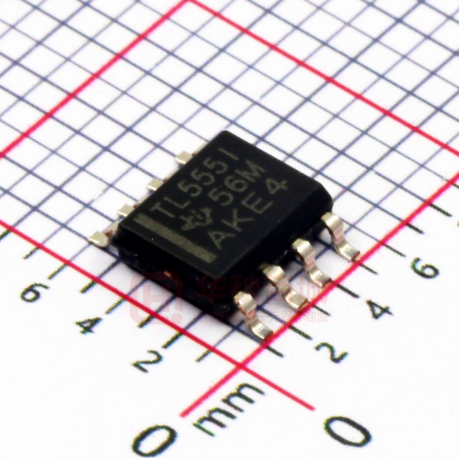

TLC555IDR 数据手册
Product Folder Order Now Support & Community Tools & Software Technical Documents Reference Design TLC555 SLFS043I – SEPTEMBER 1983 – REVISED JULY 2019 TLC555 LinCMOS™ Timer 1 Features • 1 • • • • • • • • • Very low power consumption: – 1-mW typical at VDD = 5 V Capable of operation in astable mode CMOS output capable of swinging rail to rail High output current capability – Sink: 100-mA typical – Source: 10-mA typical Output fully compatible with CMOS, TTL, and MOS Low supply current reduces spikes during output transitions Single-supply operation from 2 V to 15 V Functionally interchangeable with the NE555; has same pinout ESD protection exceeds 2000 V per MIL-STD883C, method 3015.2 Available in Q-temp automotive – High-reliability automotive applications – Configuration control and print support – Qualification to automotive standards 2 Applications • • • • • • • Precision timing Pulse generation Sequential timing Time delay generation Pulse width modulation Pulse position modulation Linear ramp generator Like the NE555, the TLC555 has a trigger level equal to approximately one-third of the supply voltage and a threshold level equal to approximately two-thirds of the supply voltage. These levels can be altered by use of the control voltage terminal (CONT). When the trigger input (TRIG) falls below the trigger level, the flip-flop is set and the output goes high. If TRIG is above the trigger level and the threshold input (THRES) is above the threshold level, the flip-flop is reset and the output is low. The reset input (RESET) can override all other inputs and can be used to initiate a new timing cycle. If RESET is low, the flipflop is reset and the output is low. Whenever the output is low, a low-impedance path is provided between the discharge terminal (DISCH) and GND. All unused inputs must be tied to an appropriate logic level to prevent false triggering. Device Information(1) PART NUMBER TLC555C TLC555I TLC555M TLC555Q BODY SIZE (NOM) SOIC (8) 4.90 mm × 3.91 mm PDIP (8) 9.81 mm × 6.38 mm SOP (8) 6.20 mm × 5.30 mm TSSOP (14) 5.00 mm × 4.40 mm SOIC (8) 4.90 mm × 3.91 mm PDIP (8) 9.81 mm × 6.38 mm LCCC (20) 8.89 mm × 8.89 mm CDIP (8) 9.60 mm × 6.67 mm SOIC (8) 4.90 mm × 3.91 mm (1) For all available packages, see the orderable addendum at the end of the data sheet. Simplified Schematic CONT 5 RESET 4 VDD 8 3 Description The TLC555 is a monolithic timing circuit fabricated using the TI LinCMOS™ process. The timer is fully compatible with CMOS, TTL, and MOS logic and operates at frequencies up to 2 MHz. Because of its high input impedance, this device supports smaller timing capacitors than those supported by the NE555 or LM555. As a result, more accurate time delays and oscillations are possible. Power consumption is low across the full range of power-supply voltage. PACKAGE R THRES R1 6 3 R OUT 1 S R TRIG 2 R 7 DISCH 1 GND 1 An IMPORTANT NOTICE at the end of this data sheet addresses availability, warranty, changes, use in safety-critical applications, intellectual property matters and other important disclaimers. PRODUCTION DATA. TLC555 SLFS043I – SEPTEMBER 1983 – REVISED JULY 2019 www.ti.com Table of Contents 1 2 3 4 5 6 Features .................................................................. Applications ........................................................... Description ............................................................. Revision History..................................................... Pin Configuration and Functions ......................... Specifications......................................................... 6.1 6.2 6.3 6.4 6.5 6.6 6.7 6.8 7 1 1 1 2 4 6 Absolute Maximum Ratings ...................................... 6 Recommended Operating Conditions....................... 6 Thermal Information .................................................. 6 Electrical Characteristics: VDD = 2 V for TLC555C, VDD = 3 V for TLC555I ............................................... 7 Electrical Characteristics: VDD = 5 V......................... 8 Electrical Characteristics: VDD = 15 V....................... 9 Operating Characteristics........................................ 11 Typical Characteristics ............................................ 12 Detailed Description ............................................ 14 7.1 Overview ................................................................. 14 7.2 Functional Block Diagram ....................................... 14 7.3 Feature Description................................................. 14 7.4 Device Functional Modes........................................ 19 8 Application and Implementation ........................ 20 8.1 Application Information............................................ 20 8.2 Typical Applications ................................................ 20 9 Power Supply Recommendations...................... 26 10 Layout................................................................... 27 10.1 Layout Guidelines ................................................. 27 10.2 Layout Example .................................................... 27 11 Device and Documentation Support ................. 28 11.1 11.2 11.3 11.4 11.5 Receiving Notification of Documentation Updates Community Resources.......................................... Trademarks ........................................................... Electrostatic Discharge Caution ............................ Glossary ................................................................ 28 28 28 28 28 12 Mechanical, Packaging, and Orderable Information ........................................................... 28 4 Revision History Changes from Revision H (August 2016) to Revision I Page • Added MIN value for input voltage in Absolute Maximum Ratings ........................................................................................ 6 • Added discharge pin in Absolute Maximum Ratings .............................................................................................................. 6 • Changed MIN supply voltage based on part number in Recommended Operating Conditions............................................. 6 • Added power dissipation capacitance TYP value in Electrical Characteristics: VDD = 2 V for TLC555C, VDD = 3 V for TLC555I .................................................................................................................................................................................. 7 • Added trigger, threshold capacitance TYP value in Electrical Characteristics: VDD = 5 V ..................................................... 8 • Changed VOH test condition current to –1 mA in Electrical Characteristics: VDD = 5 V.......................................................... 8 • Added power dissipation capacitance TYP value in Electrical Characteristics: VDD = 5 V .................................................... 9 • Added trigger, threshold capacitance TYP value in Electrical Characteristics: VDD = 15 V ................................................... 9 • Added power dissipation capacitance TYP value in Electrical Characteristics: VDD = 15 V ................................................ 10 • Added Operating Characteristics to the Specifications section............................................................................................ 11 • Added Supply Current vs Supply Voltage chart to the Typical Characteristics section ....................................................... 12 • Added Control Impedance vs Temperature chart to the Typical Characteristics section .................................................... 12 • Added Output Low Resistance vs Temperature chart to the Typical Characteristics section.............................................. 12 • Added Output High Resistance vs Temperature chart to the Typical Characteristics section............................................. 12 • Added Propagation Delay vs Control Voltage chart, VDD = 2 V to the Typical Characteristics section ............................... 12 • Added Propagation Delay vs Control Voltage chart, VDD = 5 V to the Typical Characteristics section ............................... 12 • Changed trigger high hold time to 1 µs in the Monostable Operation section ..................................................................... 15 • Changed minimum monostable pulse width to 1 µs in the Monostable Operation section.................................................. 15 • Changed Output Pulse Duration vs Capacitance chart scale down to 0.001 ms in the Monostable Operation section...... 15 • Added more astable frequency formulas to the Astable Operation section ......................................................................... 17 • Changed scale on Free-Running Frequency vs Timing Capacitance chart up to 2 MHz in the Astable Operation section 18 • Added CONT pin table note to the Function Table in the Device Functional Modes section .............................................. 19 • Changed the application curve chart in the Pulse-Width Modulation section ...................................................................... 22 • Changed the application curve charts in the Pulse-Position Modulation section ................................................................. 23 • Added clamping diodes to Sequential Timer Circuit in the Sequential Timer section.......................................................... 24 2 Submit Documentation Feedback Copyright © 1983–2019, Texas Instruments Incorporated Product Folder Links: TLC555 TLC555 www.ti.com SLFS043I – SEPTEMBER 1983 – REVISED JULY 2019 Revision History (continued) • Added Designing for Improved ESD Performance section to the Application Information section ...................................... 25 Changes from Revision G (November 2008) to Revision H Page • Added Feature Description section, Device Functional Modes, Application and Implementation section, Power Supply Recommendations section, Layout section, Device and Documentation Support section, and Mechanical, Packaging, and Orderable Information section ...................................................................................................................... 1 • Changed values in the Thermal Information table to align with JEDEC standards................................................................ 6 • Deleted Dissipation Ratings table .......................................................................................................................................... 6 Submit Documentation Feedback Copyright © 1983–2019, Texas Instruments Incorporated Product Folder Links: TLC555 3 TLC555 SLFS043I – SEPTEMBER 1983 – REVISED JULY 2019 www.ti.com 5 Pin Configuration and Functions D, P, PS, and JG Packages 8-Pin SOIC, PDIP, SOP, CDIP Top View 1 8 VDD TRIG 2 7 DISCH OUT 3 6 THRES RESET 4 5 CONT GND Pin Functions: D, P, PS, and JG Packages PIN I/O DESCRIPTION NAME SOIC, PDIP, SOP, CDIP CONT 5 I Controls comparator thresholds. Outputs 2/3 VDD and allows bypass capacitor connection. DISCH 7 O Open collector output to discharge timing capacitor. GND 1 — Ground. NC — — No internal connection. OUT 3 O High current timer output signal. RESET 4 I Active low reset input forces output and discharge low. THRES 6 I End of timing input. THRES > CONT sets output low and discharge low. TRIG 2 I Start of timing input. TRIG < 1/2 CONT sets output high and discharge open. VDD 8 — 4 Power-supply voltage. Submit Documentation Feedback Copyright © 1983–2019, Texas Instruments Incorporated Product Folder Links: TLC555 TLC555 www.ti.com SLFS043I – SEPTEMBER 1983 – REVISED JULY 2019 PW Package 14-Pin TSSOP Top View OUT 5 THRES 10 NC 6 9 NC RESET 7 8 CONT 19 NC NC 4 18 NC TRIG 5 17 DISCH NC 6 16 NC OUT 7 15 THRES NC 8 14 NC 13 NC NC 11 NC 4 1 NC 20 VDD DISCH 11 12 12 3 NC TRIG CONT NC NC 13 GND 2 2 NC 9 VDD 10 14 NC 1 RESET GND 3 FK Package 20-Pin LCCC Top View Pin Functions: PW and FK PIN NAME I/O DESCRIPTION TSSOP LCCC CONT 8 12 I Controls comparator thresholds. Outputs 2/3 VDD and allows bypass capacitor connection. DISCH 12 17 O Open-collector output to discharge timing capacitor. GND 1 2 — Ground. 2, 4, 6, 9, 11, 13 1, 3, 4, 6, 8, 9, 11, 13, 14, 16, 18, 19 — No internal connection. NC OUT 5 7 O High current timer output signal. RESET 7 10 I Active low reset input forces output and discharge low. THRES 10 15 I End of timing input. THRES > CONT sets output low and discharge low. TRIG 3 5 I Start of timing input. TRIG < 1/2 CONT sets output high and discharge open. VDD 14 20 — Power-supply voltage. Submit Documentation Feedback Copyright © 1983–2019, Texas Instruments Incorporated Product Folder Links: TLC555 5 TLC555 SLFS043I – SEPTEMBER 1983 – REVISED JULY 2019 www.ti.com 6 Specifications 6.1 Absolute Maximum Ratings over operating free-air temperature range (unless otherwise noted) (1)Continuous total power dissipation and lead temperature parameters from Absolute Maximum Ratings Voltage Current MIN MAX Supply, VDD (2) –0.3 18 Input, any input –0.3 VDD Discharge –0.3 18 Sink, discharge or output 150 Source, output, IO 15 Operating, TA Temperature Case, for 60 seconds C-suffix 0 I-suffix –40 85 Q-suffix –40 125 M-suffix –55 125 FK package –65 150 –65 150 Storage, Tstg (1) (2) UNIT V mA 70 °C Stresses beyond those listed under Absolute Maximum Ratings may cause permanent damage to the device. These are stress ratings only, which do not imply functional operation of the device at these or any other conditions beyond those indicated under Recommended Operating Conditions. Exposure to absolute-maximum-rated conditions for extended periods may affect device reliability. All voltage values are with respect to network GND. 6.2 Recommended Operating Conditions over operating free-air temperature range (unless otherwise noted) Supply voltage, VDD Operating free-air temperature, TA MIN MAX TLC555C 2 15 TLC555I 3 15 TLC555M 5 15 TLC555Q 5 15 TLC555C 0 70 TLC555I –40 85 TLC555M –55 125 TLC555Q –40 125 UNIT V °C 6.3 Thermal Information TLC555 THERMAL METRIC (1) D (SOIC) FK (LCCC) JG (CDIP) P (PDIP) PS (SOP) PW (TSSOP) UNIT 8 PINS 20 PINS 8 PINS 8 PINS 8 PINS 14 PINS RθJA Junction-to-ambient thermal resistance 113 n/a 120 58 120 135 °C/W RθJC(top) Junction-to-case (top) thermal resistance 58 37 81 48 72 61 °C/W RθJB Junction-to-board thermal resistance 55 36 110 35 69 77 °C/W ψJT Junction-to-top characterization parameter 11 n/a 45 26 32 12 °C/W ψJB Junction-to-board characterization parameter 54 n/a 103 35 68 77 °C/W RθJC(bot) Junction-to-case (bottom) thermal resistance n/a 4.3 31 n/a n/a n/a °C/W (1) 6 For more information about traditional and new thermal metrics, see the Semiconductor and IC Package Thermal Metrics application report. Submit Documentation Feedback Copyright © 1983–2019, Texas Instruments Incorporated Product Folder Links: TLC555 TLC555 www.ti.com SLFS043I – SEPTEMBER 1983 – REVISED JULY 2019 6.4 Electrical Characteristics: VDD = 2 V for TLC555C, VDD = 3 V for TLC555I over operating free-air temperature range (unless otherwise noted) TEST CONDITIONS (1) PARAMETER TLC555C 25°C VIT Threshold voltage Full range 25°C IIT Threshold current Max Trigger voltage Full range 25°C II(TRIG) Trigger current Max Reset voltage Full range Control voltage (open-circuit) as a Max percentage of supply voltage IOL = 1 mA, 25°C Discharge switch on-stage voltage IOL = 1 mA, Full range 25°C Discharge switch off-stage current Max IOH = –300 µA, 25°C VOH High-level output voltage IOH = –300 µA, Full range IOL = 1 mA, 25°C VOL Low-level output voltage IOL = 1 mA, Full range 25°C IDD Supply current (2) Full range CPD (1) (2) (3) (4) Power dissipation capacitance (3) (4) 25°C MAX 1.33 1.65 TLC555I 1.6 2.4 TLC555C 0.85 1.75 TLC555I 1.5 UNIT V 2.5 TLC555C 10 TLC555I 10 TLC555C 75 pA 150 TLC555C 0.4 0.67 0.95 TLC555I 0.71 1 1.29 TLC555C 0.3 TLC555I 0.61 V 1.05 1.39 TLC555C 10 TLC555I 10 TLC555C 75 TLC555I 25°C VI(RESET) TYP TLC555I 25°C VI(TRIG) MIN 0.95 pA 150 TLC555C 0.4 1.1 1.5 TLC555I 0.4 1.1 1.5 TLC555C 0.3 TLC555I 0.3 V 2 1.8 TLC555C 66.7% TLC555I 66.7% TLC555C 0.03 TLC555I 0.03 TLC555C 0.2 0.2 V 0.25 TLC555I 0.375 TLC555C 0.1 TLC555I 0.1 TLC555C 0.5 TLC555I 120 TLC555C 1.5 1.9 TLC555I 2.5 2.85 TLC555C 1.5 TLC555I 2.5 TLC555C 0.07 TLC555I 0.07 TLC555C nA V 0.3 0.3 V 0.35 TLC555I 0.4 TLC555C 250 TLC555I 250 TLC555C 400 TLC555I µA 500 TLC555C 80 TLC555I 90 pF Full range is 0°C to 70°C the for TLC555C, and –40°C to 85°C for the TLC555I. For conditions shown as Max, use the appropriate value specified in the Recommended Operating Conditions table. These values apply for the expected operating configurations in which THRES is connected directly to DISCH or to TRIG. CPD is used to determine the dynamic power consumption. PD = VDD2 fo (CPD + CL) where fo = output frequency, CL = output load capacitance, VDD = supply voltage Submit Documentation Feedback Copyright © 1983–2019, Texas Instruments Incorporated Product Folder Links: TLC555 7 TLC555 SLFS043I – SEPTEMBER 1983 – REVISED JULY 2019 www.ti.com 6.5 Electrical Characteristics: VDD = 5 V over operating free-air temperature range (unless otherwise noted) TEST CONDITIONS (1) PARAMETER VIT MIN TYP MAX 25°C TLC555C, TLC555I, TLC555M, TLC555Q 2.8 3.3 3.8 Full range TLC555C, TLC555I, TLC555M, TLC555Q 2.7 25°C TLC555C, TLC555I, TLC555M, TLC555Q Threshold voltage IIT Threshold current Max V II(TRIG) TLC555C 75 TLC555I 150 25°C 1.36 Full range TLC555C, TLC555I, TLC555M, TLC555Q 1.26 25°C TLC555C, TLC555I, TLC555M, TLC555Q 10 TLC555C 75 TLC555I 150 Trigger current Max CI VI(RESET) Reset voltage II(RESET) Discharge switch off-stage current VOH VOL (1) 8 High-level output voltage Low-level output voltage V 5000 25°C 2.1 25°C TLC555C, TLC555I, TLC555M, TLC555Q 0.4 Full range TLC555C, TLC555I, TLC555M, TLC555Q 0.3 25°C TLC555C, TLC555I, TLC555M, TLC555Q 1.1 1.5 10 TLC555C 75 TLC555I 150 5000 66.7% IOL = 10 mA, 25°C TLC555C, TLC555I, TLC555M, TLC555Q 0.14 IOL = 10 mA, Full range TLC555C, TLC555I, TLC555M, TLC555Q 25°C TLC555C, TLC555I, TLC555M, TLC555Q pA 0.5 V 0.6 0.1 TLC555C 0.5 TLC555I 120 TLC555M, TLC555Q 120 IOH = –1 mA, 25°C TLC555C, TLC555I, TLC555M, TLC555Q 4.1 IOH = –1 mA, Full range TLC555C, TLC555I, TLC555M, TLC555Q 4.1 IOL = 8 mA, 25°C TLC555C, TLC555I, TLC555M, TLC555Q IOL = 8 mA, Full range pF V TLC555C, TLC555I, TLC555M, TLC555Q Max pA 1.8 TLC555M, TLC555Q Control voltage (open circuit) as a Max percentage of supply voltage 1.96 2.06 TLC555C, TLC555I, TLC555M, TLC555Q Max Discharge switch on-stage voltage 1.66 TLC555M, TLC555Q Reset current pA 5000 TLC555C, TLC555I, TLC555M, TLC555Q Trigger voltage Trigger, threshold capacitance (each pin) 3.9 10 TLC555M, TLC555Q VI(TRIG) UNIT nA 4.8 V 0.21 0.4 TLC555C 0.5 TLC555I 0.5 TLC555M, TLC555Q 0.6 V Full range is 0°C to 70°C the for TLC555C, –40°C to 85°C for the TLC555I, –40°C to 125°C for the TLC555Q, and –55°C to 125°C for the TLC555M. For conditions shown as Max, use the appropriate value specified in the Recommended Operating Conditions table. Submit Documentation Feedback Copyright © 1983–2019, Texas Instruments Incorporated Product Folder Links: TLC555 TLC555 www.ti.com SLFS043I – SEPTEMBER 1983 – REVISED JULY 2019 Electrical Characteristics: VDD = 5 V (continued) over operating free-air temperature range (unless otherwise noted) TEST CONDITIONS (1) PARAMETER IOL = 5 mA, 25°C MIN TLC555C, TLC555I, TLC555M, TLC555Q TYP MAX 0.13 0.3 TLC555C IOL = 5 mA, Full range VOL 0.4 TLC555I 0.4 TLC555M, TLC555Q Low-level output voltage IOL = 3.2 mA, 25°C IOL = 3.2 mA, Full range 0.45 TLC555C, TLC555I, TLC555M, TLC555Q 0.08 TLC555C 0.35 TLC555I 0.35 IDD Supply current Full range Power dissipation capacitance (3) (4) CPD (2) (3) (4) 0.4 TLC555C, TLC555I, TLC555M, TLC555Q (2) 170 350 TLC555C 500 TLC555I 600 TLC555M, TLC555Q 700 TLC555C, TLC555I, TLC555M, TLC555Q 25°C V 0.3 TLC555M, TLC555Q 25°C UNIT 115 µA pF These values apply for the expected operating configurations in which THRES is connected directly to DISCH or to TRIG. CPD is used to determine the dynamic power consumption. PD = VDD2 fo (CPD + CL) where fo = output frequency, CL = output load capacitance, VDD = supply voltage 6.6 Electrical Characteristics: VDD = 15 V over operating free-air temperature range (unless otherwise noted) TEST CONDITIONS (1) PARAMETER VIT MIN TYP MAX 25°C TLC555C, TLC555I, TLC555M, TLC555Q 9.45 10 10.55 Full range TLC555C, TLC555I, TLC555M, TLC555Q 9.35 25°C TLC555C, TLC555I, TLC555M, TLC555Q Threshold voltage IIT Threshold current Max V TLC555C 75 TLC555I 150 II(TRIG) 25°C 4.65 Full range TLC555C, TLC555I, TLC555M, TLC555Q 4.55 25°C TLC555C, TLC555I, TLC555M, TLC555Q Trigger current Max Trigger, threshold capacitance (each pin) CI VI(RESET) II(RESET) V 10 TLC555C 75 TLC555I 150 5000 25°C 1.8 25°C TLC555C, TLC555I, TLC555M, TLC555Q 0.4 Full range TLC555C, TLC555I, TLC555M, TLC555Q 0.3 25°C TLC555C, TLC555I, TLC555M, TLC555Q Reset current 1.1 pA pF 1.5 V 1.8 10 TLC555C 75 TLC555I 150 TLC555M, TLC555Q 5.35 5.45 TLC555C, TLC555I, TLC555M, TLC555Q Max (1) 5 TLC555M, TLC555Q Reset voltage pA 5000 TLC555C, TLC555I, TLC555M, TLC555Q Trigger voltage 10.65 10 TLC555M, TLC555Q VI(TRIG) UNIT pA 5000 Full range is 0°C to 70°C for TLC555C, –40°C to 85°C for TLC555I, –40°C to 125°C for the TLC555Q, and –55°C to 125°C for TLC555M. For conditions shown as Max, use the appropriate value specified in the Recommended Operating Conditions table. Submit Documentation Feedback Copyright © 1983–2019, Texas Instruments Incorporated Product Folder Links: TLC555 9 TLC555 SLFS043I – SEPTEMBER 1983 – REVISED JULY 2019 www.ti.com Electrical Characteristics: VDD = 15 V (continued) over operating free-air temperature range (unless otherwise noted) TEST CONDITIONS (1) PARAMETER Control voltage (open circuit) as a Max percentage of supply voltage Discharge switch on-stage voltage Discharge switch off-stage current VOH High-level output voltage IOL = 100 mA, 25°C TLC555C, TLC555I, TLC555M, TLC555Q 0.77 IOL = 100 mA, Full range TLC555C, TLC555I, TLC555M, TLC555Q 25°C TLC555C, TLC555I, TLC555M, TLC555Q Max 0.5 TLC555I 120 TLC555M, TLC555Q 120 12.5 IOH = –10 mA, Full range TLC555C, TLC555I, TLC555M, TLC555Q 12.5 IOH = –5 mA, 25°C TLC555C, TLC555I, TLC555M, TLC555Q 13.5 IOH = –5 mA, Full range TLC555C, TLC555I, TLC555M, TLC555Q 13.5 IOH = –1 mA, 25°C TLC555C, TLC555I, TLC555M, TLC555Q 14.2 IOH = –1 mA, Full range TLC555C, TLC555I, TLC555M, TLC555Q 14.2 IOL = 100 mA, 25°C TLC555C, TLC555I, TLC555M, TLC555Q IOL = 10 mA, 25°C 14.6 V 14.9 1.28 IDD Supply current (2) Full range 3.6 TLC555I 3.7 TLC555M, TLC555Q 3.8 0.63 CPD (2) (3) (4) 10 25°C 1 TLC555C 1.3 TLC555I 1.4 TLC555M, TLC555Q 1.5 TLC555C, TLC555I, TLC555M, TLC555Q 0.12 TLC555C, TLC555I, TLC555M, TLC555Q 0.3 0.4 0.45 360 600 TLC555C 800 TLC555I 900 TLC555C, TLC555I, TLC555M, TLC555Q V 0.4 TLC555I TLC555M, TLC555Q Power dissipation capacitance (3) (4) 3.2 TLC555C TLC555M, TLC555Q 25°C nA 14.2 TLC555C IOL = 10 mA, Full range 1.7 0.1 TLC555C TLC555C, TLC555I, TLC555M, TLC555Q UNIT V IOH = –10 mA, 25°C IOL = 50 mA, Full range MAX 1.8 TLC555C, TLC555I, TLC555M, TLC555Q IOL = 50 mA, 25°C Low-level output voltage TYP 66.7% IOL = 100 mA, Full range VOL MIN TLC555C, TLC555I, TLC555M, TLC555Q µA 1000 140 pF These values apply for the expected operating configurations in which THRES is connected directly to DISCH or TRIG. CPD is used to determine the dynamic power consumption. PD = VDD2 fo (CPD + CL) where fo = output frequency, CL = output load capacitance, VDD = supply voltage Submit Documentation Feedback Copyright © 1983–2019, Texas Instruments Incorporated Product Folder Links: TLC555 TLC555 www.ti.com SLFS043I – SEPTEMBER 1983 – REVISED JULY 2019 6.7 Operating Characteristics VDD = 5 V, TA = 25°C (unless otherwise noted) PARAMETER TYP MAX VDD = 5 V to 15 V, CT = 0.1 μF RA = RB = 1 kΩ to 100 kΩ (2) 1% 3% Supply voltage sensitivity of timing interval VDD = 5 V to 15 V, CT = 0.1 μF RA = RB = 1 kΩ to 100 kΩ (2) 0.1 0.5 %/V tr Output pulse rise time RL = 10 MΩ, CL = 10 pF 20 75 ns tf Output pulse fall time RL = 10 MΩ, CL = 10 pF 15 60 fmax Maximum frequency in a-stable mode RA = 470 Ω, CT = 200 pF RB = 200 Ω Initial error of timing interval (1) (2) TEST CONDITIONS (1) MIN (2) 1.2 2.1 UNIT ns MHz Timing interval error is defined as the difference between the measured value and the average value of a random sample from each process run. RA, RB, and CT are as defined in Figure 12. Submit Documentation Feedback Copyright © 1983–2019, Texas Instruments Incorporated Product Folder Links: TLC555 11 TLC555 SLFS043I – SEPTEMBER 1983 – REVISED JULY 2019 www.ti.com 600 100 70 VDD = 2 V, IO = 1 mA Propagation Delay Times (ns) Discharge Switch On-State Resistance (W) 6.8 Typical Characteristics 40 VDD = 5 V, IO = 10 mA 20 10 7 VDD = 15 V, IO = 100 mA 4 2 IO(on) ³ 1 mA CL » 0 TA = 25°C 500 400 300 tPHL 200 100 tPLH 1 (1) 0 -75 -50 -25 0 25 50 75 100 0 125 4 2 6 8 10 12 14 16 18 20 Supply Voltage (V) Temperature (°C) Figure 1. Discharge Switch On-State Resistance vs Free-Air Temperature (1) The effects of the load resistance on these values must be taken into account separately. Figure 2. Propagation Delay Times to Discharge Output From Trigger and Threshold Shorted Together vs Supply Voltage 90 300 -55qC -40qC 0qC 25qC 70qC 85qC 125qC 200 VDD VDD VDD VDD 80 70 Impedance (k:) Supply Current (PA) 250 150 100 60 50 40 50 30 0 0 2 4 6 8 10 Supply Voltage (V) 12 14 20 -75 16 -25 0 25 50 Temperature (qC) 75 100 125 D002 Figure 4. Control Impedance vs Temperature 90 450 70 = 2V, I O = 1mA = 3V, I O = 1mA = 5V, I O = 10mA = 15V, I O = 100mA VDD VDD VDD VDD 400 Output Resistance (:) VDD VDD VDD VDD 80 Output Resistance (:) -50 D001 Figure 3. Supply Current vs Supply Voltage 60 50 40 30 20 350 = 2V, I O = 300PA = 3V, I O = 300PA = 5V, I O = 1mA = 15V, I O = 10mA 300 250 200 150 100 10 0 -75 -50 -25 0 25 50 Temperature (qC) 75 100 125 50 -75 D003 Figure 5. Output Low Resistance vs Temperature 12 = 2V = 3V = 5V = 15V -50 -25 0 25 50 Temperature (qC) 75 100 125 D004 Figure 6. Output High Resistance vs Temperature Submit Documentation Feedback Copyright © 1983–2019, Texas Instruments Incorporated Product Folder Links: TLC555 TLC555 www.ti.com SLFS043I – SEPTEMBER 1983 – REVISED JULY 2019 Typical Characteristics (continued) 100 TPLH VDD = 2V TPHL VDD = 2V 50 30 20 Propogation Delay (Ps) Propogation Delay (Ps) 100 10 5 3 2 1 0.5 0.3 0.2 0.1 0.4 0.6 0.8 1.0 1.2 1.4 Control Voltage (V) 1.6 1.8 2.0 TPLH VDD = 5V TPHL VDD = 5V 50 30 20 10 5 3 2 1 0.5 0.3 0.2 0.1 0.5 1.0 D007 Figure 7. Propagation Delay vs Control Voltage VDD = 2 V 1.5 2.0 2.5 3.0 3.5 Control Voltage (V) 4.0 4.5 5.0 D009 Figure 8. Propagation Delay vs Control Voltage VDD = 5 V Submit Documentation Feedback Copyright © 1983–2019, Texas Instruments Incorporated Product Folder Links: TLC555 13 TLC555 SLFS043I – SEPTEMBER 1983 – REVISED JULY 2019 www.ti.com 7 Detailed Description 7.1 Overview The TLC555 is a precision timing device used for general-purpose timing applications up to 2.1 MHz. All inputs are level sensitive not edge triggered inputs. 7.2 Functional Block Diagram CONT 5 RESET 4 VDD 8 R THRES R1 6 3 R OUT 1 S R TRIG 2 R 7 DISCH 1 GND Pin numbers are for all packages except the PW and FK package. RESET can override TRIG, which can override THRES (when CONT pin is 2/3 VDD). The resistance of “R" resistors vary with VDD and temperature. The resistors match each other very well across VDD and temperature for a temperature stable control voltage ratio. 7.3 Feature Description 7.3.1 Monostable Operation For monostable operation, any of these timers can be connected as shown in Figure 9. If the output is low, application of a negative-going pulse to the trigger (TRIG) sets the internal latch; the output goes high, and discharge pin (DISCH) becomes open drain. Capacitor C then is charged through RA until the voltage across the capacitor reaches the threshold voltage of the threshold (THRES) input. If TRIG has returned to a high level, the output of the threshold comparator resets the internal latch, the output goes low, the discharge pin goes low which quickly discharges capacitor C. 14 Submit Documentation Feedback Copyright © 1983–2019, Texas Instruments Incorporated Product Folder Links: TLC555 TLC555 www.ti.com SLFS043I – SEPTEMBER 1983 – REVISED JULY 2019 Feature Description (continued) V DD (5 V to 15 V) 5 8 CONT V DD RA 4 7 6 2 Input RESET DISCH OUT 3 Output THRES TRIG GND C 1 Figure 9. Circuit for Monostable Operation Monostable operation is initiated when TRIG voltage falls below the trigger threshold. Once initiated, the sequence ends only if TRIG is high for at least 1 µs before the end of the timing interval. When the trigger is grounded, the comparator storage time can be as long as 1 µs, which limits the minimum monostable pulse width to 1 µs. The output pulse duration is approximately tw = 1.1 × RAC. Figure 11 is a plot of the time constant for various values of RA and C. The threshold levels and charge rates both are directly proportional to the supply voltage, VDD. The timing interval is, therefore, independent of the supply voltage, so long as the supply voltage is constant during the time interval. Applying a negative-going trigger pulse simultaneously to RESET and TRIG during the timing interval discharges capacitor C and reinitiates the cycle, commencing on the positive edge of the reset pulse. The output is held low as long as the reset pulse is low. To prevent false triggering, when RESET is not used it must be connected to VDD. 10000 5000 1k: 10k: 100k: 1M: 10M: 2000 1000 500 Input Voltage Time (ms) Voltage − 2 V/div 200 100 50 20 10 5 2 1 0.5 0.2 0.1 0.05 Output Voltage 0.02 0.01 0.005 0.002 0.001 0.01 Capacitor Voltage Time − 0.1 ms/div RA = 9.1 kΩ CL = 0.01 µF 0.1 0.2 0.5 1 2 3 5 710 20 Capacitance (nF) 50 100 1000 D006 Figure 11. Output Pulse Duration vs Capacitance See Figure 9 Figure 10. Typical Monostable Waveforms Submit Documentation Feedback Copyright © 1983–2019, Texas Instruments Incorporated Product Folder Links: TLC555 15 TLC555 SLFS043I – SEPTEMBER 1983 – REVISED JULY 2019 www.ti.com Feature Description (continued) 7.3.2 Astable Operation As shown in Figure 12, adding a second resistor, RB, to the circuit of Figure 9 and connecting the trigger input to the threshold input causes the timer to self-trigger and run as a multi-vibrator. The capacitor C charges through RA and RB and then discharges through RB only. Therefore, the duty cycle is controlled by the values of RA and RB. This astable connection results in capacitor C charging and discharging between the threshold-voltage level (≈ 0.67 × VCC) and the trigger-voltage level (≈ 0.33 × VCC). As in the monostable circuit, charge and discharge times (and, therefore, the frequency and duty cycle) are independent of the supply voltage. VDD (5 V t o 15 V) RA RB PF Open (see Note A) 5 CONT 4 RESET 7 DISCH 6 2 8 VDD OUT 3 Output t H THRES TRIG C Voltage − 1 V/div 0.01 Output Voltage tL GND 1 Decoupling CONT voltage to ground with a capacitor can improve operation. This should be evaluated for individual applications. Figure 12. Circuit for Astable Operation Capacitor Voltage RA = 5 kΩ See Figure 12 Time − 0.5 ms/div RB = 3 kΩ C = 0.15 µF Figure 13. Typical Astable Waveforms Figure 13 shows typical waveforms generated during astable operation. The output high-level duration tH and low-level duration tL for frequencies below 100 kHz can be calculated as follows: tH = 0.693 (R A + RB )C (1) tL = 0.693 (RB )C (2) Other useful relationships are shown below: 16 period = tH + tL = 0.693 (R A + 2RB )C (3) 1.44 frequency » (R A +2RB )C (4) tL RB Output driver duty cycle = = tH + tL R A + 2RB (5) tH RB Output waveform duty cycle = = 1tH + tL R A + 2RB (6) t RB Low-to-high ratio = L = tH R A + RB (7) Submit Documentation Feedback Copyright © 1983–2019, Texas Instruments Incorporated Product Folder Links: TLC555 TLC555 www.ti.com SLFS043I – SEPTEMBER 1983 – REVISED JULY 2019 Feature Description (continued) The formulas (1-7) do not account for any propagation delay times from the TRIG and THRES inputs to DISCH output. These delay times add directly to the period and overcharge the capacitor which creates differences between calculated and actual values that increase with frequency. In addition, the internal on-state resistance ron during discharge adds to RB to provide another source of timing error in the calculation when RB is very low. The equations below provide better agreement with measured values. The formulas Equation 8 represent the actual low and high times when used at higher frequencies because propagation delay and discharge on resistance is added to the formulas. Because the formulas are complex, a calculation tool, TLC555 Design Calculator can be used to calculate the component values. é æ öù -tPLH t c(H) = CT (R A + RB ) In ê3 - exp ç ÷ ú + tPHL è CT (RB + ron ) ø ûú ëê é æ öù -tPHL t c(L) = CT (RB + ron ) In ê3 - exp ç ÷ ú + tPLH êë è CT (R A + RB ) ø úû tc(H) (8) tc(L) VDD tPHL 2/3 VDD 1/3 VDD GND tPLH Figure 14. Trigger and Threshold Voltage Waveform Submit Documentation Feedback Copyright © 1983–2019, Texas Instruments Incorporated Product Folder Links: TLC555 17 TLC555 SLFS043I – SEPTEMBER 1983 – REVISED JULY 2019 www.ti.com Feature Description (continued) 2000 1k: 10k: 100k: 1M: 10M: 1000 500 200 100 Frequency (kHz) 50 20 10 5 2 1 0.5 0.2 0.1 0.05 0.02 0.01 0.1 0.2 0.5 1 2 3 5 710 20 50 100 Capacitance (nF) 1000 10000 D012 Figure 15. Free-Running Frequency vs Timing Capacitance Resistance = RA + 2 × RB 7.3.3 Frequency Divider Voltage − 2 V/div By adjusting the length of the timing cycle, the basic circuit of Figure 9 can be made to operate as a frequency divider. Figure 16 shows a divide-by-three circuit that makes use of the fact that re-triggering cannot occur during the timing cycle. Input Voltage Output Voltage Capacitor Voltage Time − 0.1 ms/div VCC = 5 V See Figure 9 RA = 1250 Ω C = 0.02 µF Figure 16. Divide-by-Three Circuit Waveforms 18 Submit Documentation Feedback Copyright © 1983–2019, Texas Instruments Incorporated Product Folder Links: TLC555 TLC555 www.ti.com SLFS043I – SEPTEMBER 1983 – REVISED JULY 2019 7.4 Device Functional Modes Table 1 shows the device truth table. Table 1. Function Table RESET VOLTAGE (1) TRIGGER VOLTAGE (1) THRESHOLD VOLTAGE (1) OUTPUT DISCHARGE SWITCH MAX MAX >MAX >MAX >MAX >MAX [maximum normal input high time]. 20 Submit Documentation Feedback Copyright © 1983–2019, Texas Instruments Incorporated Product Folder Links: TLC555 TLC555 www.ti.com SLFS043I – SEPTEMBER 1983 – REVISED JULY 2019 Typical Applications (continued) Voltage − 2 V/div 8.2.1.3 Application Curve Input Voltage Output Voltage Capacitor Voltage Time − 0.1 ms/div VDD = 5 V See Figure 18 RA = 1 kΩ C = 0.1 µF Figure 19. Timing Waveforms for Missing-Pulse Detector 8.2.2 Pulse-Width Modulation The operation of the timer can be modified by modulating the internal threshold and trigger voltages, which is accomplished by applying an external voltage (or current) to CONT. Figure 20 shows a circuit for pulse-width modulation. A continuous input pulse train triggers the monostable circuit, and a control signal modulates the threshold voltage. Figure 21 shows the resulting duty cycle versus control voltage transfer function. Attempting to run under 10% duty cycle could result in inconsistent output pulses. Attempting to run close to 100% duty cycle will result in frequency division by 2, then 3, then 4. VDD (5 V to 15 V) 4 RESET Clock Input 2 RA 8 VDD OUT TRIG 3 Output 7 DISCH Modulation Input (see Note A) 5 CONT THRES 6 GND 1 A. C The modulating signal can be direct or capacitively coupled to CONT. For direct coupling, consider the effects of modulation source voltage and impedance on the bias of the timer. Figure 20. Circuit for Pulse-Width Modulation Submit Documentation Feedback Copyright © 1983–2019, Texas Instruments Incorporated Product Folder Links: TLC555 21 TLC555 SLFS043I – SEPTEMBER 1983 – REVISED JULY 2019 www.ti.com Typical Applications (continued) 8.2.2.1 Design Requirements The clock input must have VOL and VOH levels that are less than and greater than 1/3 VDD, respectively. Clock input VOL time must be less than minimum output high time, therefore a high (positive) duty cycle clock is recommended. Minimum recommended modulation voltage is 1 V. Lower CONT voltage can greatly increase threshold comparator’s propagation delay and storage time. The application must be tolerant of a nonlinear transfer function; the relationship between modulation input and pulse width is not linear because the capacitor charge is RC based with an negative exponential curve. 8.2.2.2 Detailed Design Procedure Choose RA and C so that RA × C is same or less than clock input period. Figure 21 shows the non linear relationship between control voltage and output duty cycle. Duty cycle is function of control voltage and clock period relative to RC time constant. 8.2.2.3 Application Curve 100 Clock period = 1 RC Clock period = 2.5 RC Output Duty Cycle (%) 80 60 40 20 0 0.5 1.0 1.5 2.0 2.5 3.0 Control Voltage (V) 3.5 4.0 4.5 D015 Figure 21. Pulse-Width-Modulation vs Control Voltage Clock Duty Cycle 98%, VDD = 5 V 8.2.3 Pulse-Position Modulation As shown in Figure 22, any of these timers can be used as a pulse-position modulator. This application modulates the threshold voltage and thereby the time delay of a free-running oscillator. Figure 23 and Figure 24 shows the output frequency and duty cycle versus control voltage. 22 Submit Documentation Feedback Copyright © 1983–2019, Texas Instruments Incorporated Product Folder Links: TLC555 TLC555 www.ti.com SLFS043I – SEPTEMBER 1983 – REVISED JULY 2019 Typical Applications (continued) VDD (5 V to 15 V) 4 RESET 2 RA 8 VDD OUT 3 Output TRIG 7 DISCH Modulation Input 5 (see Note A) CONT RB 6 THRES GND C A. The modulating signal can be direct or capacitively coupled to CONT. For direct coupling, consider the effects of modulation source voltage and impedance on the bias of the timer. RA = 3 kΩ RB = 309 kΩ C = 1 nF Figure 22. Circuit for Pulse-Position Modulation 8.2.3.1 Design Requirements Both DC- and AC-coupled modulation input changes the upper and lower voltage thresholds for the timing capacitor. Both frequency and duty cycle vary with the modulation voltage. Control voltage below 1 V could result in output glitches instead of a steady output pulse stream 8.2.3.2 Detailed Design Procedure The nominal output frequency and duty cycle for control voltage set to 2/3 of VDD can be determined using formulas in Astable Operation section. 8.2.3.3 Application Curves 4 100 80 Output Duty Cycle (%) Output Frequency (kHz) 3.5 3 2.5 2 1.5 60 40 20 1 0.5 0.5 1.0 1.5 2.0 2.5 3.0 3.5 Control Voltage (V) 4.0 4.5 5.0 0 0.5 D013 Figure 23. Pulse-Position-Modulation Frequency vs Control Voltage, VDD = 5 V 1.0 1.5 2.0 2.5 3.0 3.5 Control Voltage (V) 4.0 4.5 5.0 D014 Figure 24. Pulse-Position-Modulation Duty Cycle vs Control Voltage, VDD = 5 V Submit Documentation Feedback Copyright © 1983–2019, Texas Instruments Incorporated Product Folder Links: TLC555 23 TLC555 SLFS043I – SEPTEMBER 1983 – REVISED JULY 2019 www.ti.com Typical Applications (continued) 8.2.4 Sequential Timer Many applications, such as computers, require signals for initializing conditions during start-up. Other applications, such as test equipment, require activation of test signals in sequence. These timing circuits can be connected to provide such sequential control. The timers can be used in various combinations of astable or monostable circuit connections, with or without modulation, for extremely flexible waveform control. Figure 25 shows a sequencer circuit with possible applications in many systems, and Figure 26 shows the output waveforms. VDD 4 RESET 33 k: 2 1N4148 VDD 3 OUT TRIG S DISCH 5 0.01 PF CONT 33 k: RA 8 2 0.001 PF 7 1 6 0.01 PF CA CA = 10 PF RA = 100 k: TRIG RB 8 VDD 3 OUT DISCH 7 5 THRES GND 4 RESET CONT THRES GND 1 CB Out pu t A 33 k: 1N4148 2 0.001 PF 4 RESET 8 VDD 3 OUT TRIG DISCH 5 6 CONT 0.01 PF Out pu t B CB = 4.7 PF RB = 100 k: THRES GND 1 RC 7 6 CC CC = 14.7 PF RC = 100 k: Out pu t C NOTE: S closes momentarily at t = 0. Figure 25. Sequential Timer Circuit 8.2.4.1 Design Requirements The sequential timer application chains together multiple monostable timers. The joining components are the 33-kΩ resistors and 0.001-µF capacitors. The output high to low edge passes a 10-µs start pulse to the next monostable. A diode is needed to prevent over voltage on the trigger input when on the previous output's low to high edge. 8.2.4.2 Detailed Design Procedure The timing resistors and capacitors can be chosen using this formula: tw = 1.1 × R × C. 24 Submit Documentation Feedback Copyright © 1983–2019, Texas Instruments Incorporated Product Folder Links: TLC555 TLC555 www.ti.com SLFS043I – SEPTEMBER 1983 – REVISED JULY 2019 Typical Applications (continued) 8.2.4.3 Application Curve twA Output A twA = 1.1 RACA Voltage − 5 V/div twB Output B twB = 1.1 RBCB Output C twC twC = 1.1 RCCC t=0 t − Time − 1 s/div See Figure 25 Figure 26. Sequential Timer Waveforms 8.2.5 Designing for Improved ESD Performance The TLC555 internal HBM and CDM protection allows for safe assembly in ESD controlled environments. In applications that may expose pins of the TLC555 to ESD, additional protection is highly recommended. The test board schematic below has bypass capacitors, current-limiting resistors, and voltage clamping TVS diodes to provide additional protection for commonly exposed pins [Reset, Trig, and Output] against ESD. C5 R1 100k TP1 50V 1000pF D1 BAT54WSTR R2 Reset C9 2.20k C1 50V 1000pF D2 BAT54WSTR R3 10.0k 50V 1000pF D6 BAT54WSTR U1 3 VDD R5 10.0k TLC555CP R6 100k C4 50V 0.1uF C3 50V 1000pF 1 TRIG 10.0 D7 BAT54WSTR TP3 Output C10 50V 1000pF C8 100V 0.01uF 50V D4 1000pF BAT54WSTR TP2 Trig 10.0 5 THRES C7 R4 RESET DISCH C6 50V 1000pF R9 J1 R7 10.0k Vcc D5 BAT54WSTR R8 10.0k J2 C11 50V 10uF C12 50V 0.1uF D3 SMBJ15A-13-F GND Figure 27. ESD Test Schematic Submit Documentation Feedback Copyright © 1983–2019, Texas Instruments Incorporated Product Folder Links: TLC555 25 TLC555 SLFS043I – SEPTEMBER 1983 – REVISED JULY 2019 www.ti.com Typical Applications (continued) The table below gives the ESD protection levels recorded for different supply voltages and external components populated. Using only passive components to protect the TLC555 with a single 15-V supply is not recommended because the higher voltage allows for an unacceptable amount of current to flow through the device. Table 2. ESD test result table Supply Voltage (1) Just passive components populated. D1..D7 not populated (1) All components populated 5V 8 kV 12 kV 15 V Not recommended 12 kV (1) Sample results. Results may vary with populated components, board layout, and samples used. 9 Power Supply Recommendations The TLC555 requires a voltage supply greater than or equal to 2 V, 3 V, or 5 V based the coldest ambient temperature supported and a supply voltage less than or equal to 15 V. Adequate power supply bypassing is necessary to protect associated circuitry and provide stable output pulses. Minimum recommended is 0.1-μF ceramic in parallel with 1-μF electrolytic. Place the bypass capacitors as close as possible to the TLC555 and minimize the trace length. 26 Submit Documentation Feedback Copyright © 1983–2019, Texas Instruments Incorporated Product Folder Links: TLC555 TLC555 www.ti.com SLFS043I – SEPTEMBER 1983 – REVISED JULY 2019 10 Layout 10.1 Layout Guidelines Standard PCB rules apply to routing the TLC555. The 0.1-μF ceramic capacitor in parallel with a 1-μF electrolytic capacitor must be as close as possible to the TLC555. The capacitor used for the time delay must also be placed as close to the discharge pin. A ground plane on the bottom layer can be used to provide better noise immunity and signal integrity. Figure 28 is the basic layout for various applications. • C1—based on time delay calculations • C2—0.01-μF bypass capacitor for control voltage pin • C3—0.1-μF bypass ceramic capacitor • C4—1-μF electrolytic bypass capacitor • R1—based on time-delay calculations 10.2 Layout Example C4 C3 GND VDD OUT TLC555 R1 TRIG DISCH THRES C1 RESET CONT C2 Figure 28. Layout Example Submit Documentation Feedback Copyright © 1983–2019, Texas Instruments Incorporated Product Folder Links: TLC555 27 TLC555 SLFS043I – SEPTEMBER 1983 – REVISED JULY 2019 www.ti.com 11 Device and Documentation Support 11.1 Receiving Notification of Documentation Updates To receive notification of documentation updates, navigate to the device product folder on ti.com. In the upper right corner, click on Alert me to register and receive a weekly digest of any product information that has changed. For change details, review the revision history included in any revised document. 11.2 Community Resources The following links connect to TI community resources. Linked contents are provided "AS IS" by the respective contributors. They do not constitute TI specifications and do not necessarily reflect TI's views; see TI's Terms of Use. TI E2E™ Online Community TI's Engineer-to-Engineer (E2E) Community. Created to foster collaboration among engineers. At e2e.ti.com, you can ask questions, share knowledge, explore ideas and help solve problems with fellow engineers. Design Support TI's Design Support Quickly find helpful E2E forums along with design support tools and contact information for technical support. 11.3 Trademarks LinCMOS, E2E are trademarks of Texas Instruments. All other trademarks are the property of their respective owners. 11.4 Electrostatic Discharge Caution These devices have limited built-in ESD protection. The leads should be shorted together or the device placed in conductive foam during storage or handling to prevent electrostatic damage to the MOS gates. 11.5 Glossary SLYZ022 — TI Glossary. This glossary lists and explains terms, acronyms, and definitions. 12 Mechanical, Packaging, and Orderable Information The following pages include mechanical, packaging, and orderable information. This information is the most current data available for the designated devices. This data is subject to change without notice and revision of this document. For browser-based versions of this data sheet, refer to the left-hand navigation. 28 Submit Documentation Feedback Copyright © 1983–2019, Texas Instruments Incorporated Product Folder Links: TLC555 PACKAGE OPTION ADDENDUM www.ti.com 7-Sep-2018 PACKAGING INFORMATION Orderable Device Status (1) Package Type Package Pins Package Drawing Qty Eco Plan Lead/Ball Finish MSL Peak Temp (2) (6) (3) Op Temp (°C) Device Marking (4/5) TLC555CD ACTIVE SOIC D 8 75 Green (RoHS & no Sb/Br) CU NIPDAU Level-1-260C-UNLIM 0 to 70 TL555C TLC555CDG4 ACTIVE SOIC D 8 75 Green (RoHS & no Sb/Br) CU NIPDAU Level-1-260C-UNLIM 0 to 70 TL555C TLC555CDR ACTIVE SOIC D 8 2500 Green (RoHS & no Sb/Br) CU NIPDAU Level-1-260C-UNLIM 0 to 70 TL555C TLC555CDRG4 ACTIVE SOIC D 8 2500 Green (RoHS & no Sb/Br) CU NIPDAU Level-1-260C-UNLIM 0 to 70 TL555C TLC555CP ACTIVE PDIP P 8 50 Green (RoHS & no Sb/Br) CU NIPDAU N / A for Pkg Type 0 to 70 TLC555CP TLC555CPE4 ACTIVE PDIP P 8 50 Green (RoHS & no Sb/Br) CU NIPDAU N / A for Pkg Type 0 to 70 TLC555CP TLC555CPSR ACTIVE SO PS 8 2000 Green (RoHS & no Sb/Br) CU NIPDAU Level-1-260C-UNLIM 0 to 70 P555 TLC555CPW ACTIVE TSSOP PW 14 90 Green (RoHS & no Sb/Br) CU NIPDAU Level-1-260C-UNLIM 0 to 70 P555 TLC555CPWR ACTIVE TSSOP PW 14 2000 Green (RoHS & no Sb/Br) CU NIPDAU Level-1-260C-UNLIM 0 to 70 P555 TLC555CPWRG4 ACTIVE TSSOP PW 14 2000 Green (RoHS & no Sb/Br) CU NIPDAU Level-1-260C-UNLIM 0 to 70 P555 TLC555ID ACTIVE SOIC D 8 75 Green (RoHS & no Sb/Br) CU NIPDAU Level-1-260C-UNLIM -40 to 85 TL555I TLC555IDG4 ACTIVE SOIC D 8 75 Green (RoHS & no Sb/Br) CU NIPDAU Level-1-260C-UNLIM -40 to 85 TL555I TLC555IDR ACTIVE SOIC D 8 2500 Green (RoHS & no Sb/Br) CU NIPDAU Level-1-260C-UNLIM -40 to 85 TL555I TLC555IDRG4 ACTIVE SOIC D 8 2500 Green (RoHS & no Sb/Br) CU NIPDAU Level-1-260C-UNLIM -40 to 85 TL555I TLC555IP ACTIVE PDIP P 8 50 Green (RoHS & no Sb/Br) CU NIPDAU N / A for Pkg Type -40 to 85 TLC555IP TLC555IPE4 ACTIVE PDIP P 8 50 Green (RoHS & no Sb/Br) CU NIPDAU N / A for Pkg Type -40 to 85 TLC555IP TLC555QDR ACTIVE SOIC D 8 2500 Green (RoHS & no Sb/Br) CU NIPDAU Level-1-260C-UNLIM -40 to 125 TL555Q Addendum-Page 1 Samples PACKAGE OPTION ADDENDUM www.ti.com Orderable Device 7-Sep-2018 Status (1) TLC555QDRG4 Package Type Package Pins Package Drawing Qty ACTIVE SOIC D 8 2500 Eco Plan Lead/Ball Finish MSL Peak Temp (2) (6) (3) Green (RoHS & no Sb/Br) CU NIPDAU Level-1-260C-UNLIM Op Temp (°C) Device Marking (4/5) TL555Q (1) The marketing status values are defined as follows: ACTIVE: Product device recommended for new designs. LIFEBUY: TI has announced that the device will be discontinued, and a lifetime-buy period is in effect. NRND: Not recommended for new designs. Device is in production to support existing customers, but TI does not recommend using this part in a new design. PREVIEW: Device has been announced but is not in production. Samples may or may not be available. OBSOLETE: TI has discontinued the production of the device. (2) RoHS: TI defines "RoHS" to mean semiconductor products that are compliant with the current EU RoHS requirements for all 10 RoHS substances, including the requirement that RoHS substance do not exceed 0.1% by weight in homogeneous materials. Where designed to be soldered at high temperatures, "RoHS" products are suitable for use in specified lead-free processes. TI may reference these types of products as "Pb-Free". RoHS Exempt: TI defines "RoHS Exempt" to mean products that contain lead but are compliant with EU RoHS pursuant to a specific EU RoHS exemption. Green: TI defines "Green" to mean the content of Chlorine (Cl) and Bromine (Br) based flame retardants meet JS709B low halogen requirements of
TLC555IDR
### 物料型号 - TLC555
### 器件简介 TLC555 是一款使用 Texas Instruments 的 LinCMOS™ 工艺制造的单片定时电路。
它与 CMOS、TTL 和 MOS 逻辑完全兼容,并且能够在高达 2 MHz 的频率下工作。
由于其高输入阻抗,该设备支持比 NE555 或 LM555 支持的更小的定时电容,从而实现更精确的时间延迟和振荡。
在电源电压的整个范围内,功耗都很低。
### 引脚分配 - GND: 接地 - VDD: 电源电压 - TRIG: 触发输入 - THRES: 阈值输入 - OUT: 定时器输出信号 - DISCH: 放电引脚 - RESET: 复位输入 - CONT: 控制电压引脚
### 参数特性 - 非常低的功耗:典型值在 5V 电源电压下为 1mW - 能够在振荡模式下工作 - CMOS 输出能够达到电源电压的全摆幅 - 高输出电流能力:典型值下拉电流为 100mA,上拉电流为 10mA - 输出完全兼容 CMOS、TTL 和 MOS - 低电源电流减少了输出转换时的尖峰 - 单电源操作从 2V 到 15V - 功能上与 NE555 互换,具有相同的引脚排列
### 功能详解 TLC555 可以用于精确定时、脉冲生成、顺序定时、时间延迟生成、脉宽调制、脉冲位置调制、线性斜坡发生器等多种功能。
### 应用信息 - 单片定时电路 - 适用于高达 2 MHz 的频率 - 低功耗操作 - 适用于各种定时和振荡应用
### 封装信息 TLC555 有多种封装选项,包括但不限于: - SOIC(8) - PDIP(8) - SOP(8) - TSSOP(14) - LCCC(20) - CDIP(8)
每种封装的尺寸和引脚排列可能会有所不同。
具体选择应根据应用需求和 PCB 设计来确定。
