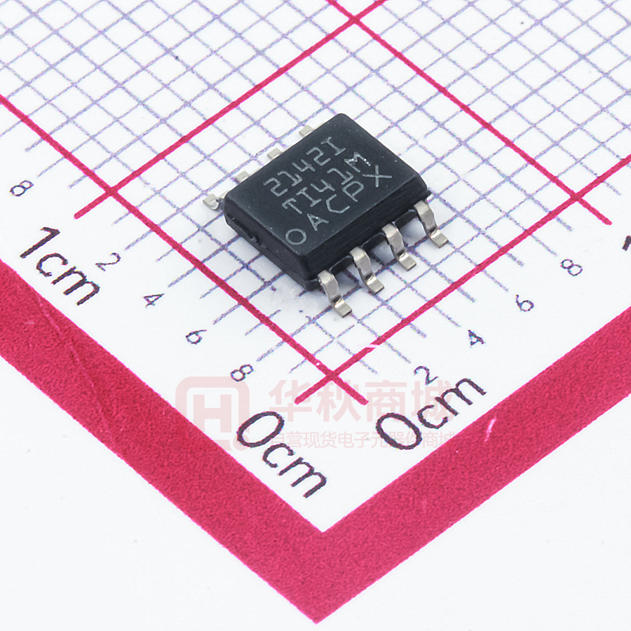

TLE214x, TLE214xA EXCALIBUR LOW-NOISE HIGH-SPEED PRECISION OPERATIONAL AMPLIFIERS  SLOS183D − FEBRUARY 1997 − REVISED OCTOBER 2012 D Low Noise D D D D D 10 Hz . . . 15 nV/√Hz 1 kHz . . . 10.5 nV/√Hz 10 000-pF Load Capability 20-mA Min Short-Circuit Output Current 27-V/μs Min Slew Rate High Gain-Bandwidth Product . . . 5.9 MHz Low VIO . . . 500 μV Max at 25°C D Single or Split Supply . . . 4 V to 44 V D Fast Settling Time D D 340 ns to 0.1% 400 ns to 0.01% Saturation Recovery . . . 150 ns Large Output Swing VCC − + 0.1 V to VCC + − 1 V description The TLE214x and TLE214xA devices are high-performance, internally compensated operational amplifiers built using Texas Instruments complementary bipolar Excalibur process. The TLE214xA is a tighter offset voltage grade of the TLE214x. Both are pin-compatible upgrades to standard industry products. The design incorporates an input stage that simultaneously achieves low audio-band noise of 10.5 nV/√Hz with a 10-Hz 1/f corner and symmetrical 40-V/μs slew rate typically with loads up to 800 pF. The resulting low distortion and high power bandwidth are important in high-fidelity audio applications. A fast settling time of 340 ns to 0.1% of a 10-V step with a 2-kΩ/100-pF load is useful in fast actuator/positioning drivers. Under similar test conditions, settling time to 0.01% is 400 ns. The devices are stable with capacitive loads up to 10 nF, although the 6-MHz bandwidth decreases to 1.8 MHz at this high loading level. As such, the TLE214x and TLE214xA are useful for low-droop sample-and-holds and direct buffering of long cables, including 4-mA to 20-mA current loops. The special design also exhibits an improved insensitivity to inherent integrated circuit component mismatches as is evidenced by a 500-μV maximum offset voltage and 1.7-μV/°C typical drift. Minimum common-mode rejection ratio and supply-voltage rejection ratio are 85 dB and 90 dB, respectively. Device performance is relatively independent of supply voltage over the ± 2-V to ± 22-V range. Inputs can operate between VCC − − 0.3 to VCC + − 1.8 V without inducing phase reversal, although excessive input current may flow out of each input exceeding the lower common-mode input range. The all-npn output stage provides a nearly rail-to-rail output swing of VCC − − 0.1 to VCC + − 1 V under light current-loading conditions. The device can sustain shorts to either supply since output current is internally limited, but care must be taken to ensure that maximum package power dissipation is not exceeded. Both versions can also be used as comparators. Differential inputs of VCC ± can be maintained without damage to the device. Open-loop propagation delay with TTL supply levels is typically 200 ns. This gives a good indication as to output stage saturation recovery when the device is driven beyond the limits of recommended output swing. Both the TLE214x and TLE214xA are available in a wide variety of packages, including both the industry-standard 8-pin small-outline version and chip form for high-density system applications. The C-suffix devices are characterized for operation from 0°C to 70°C, I-suffix devices from − 40°C to 105°C, and M-suffix devices over the full military temperature range of − 55°C to 125°C. Please be aware that an important notice concerning availability, standard warranty, and use in critical applications of Texas Instruments semiconductor products and disclaimers thereto appears at the end of this data sheet. Copyright © 1997 − 2006, Texas Instruments Incorporated PRODUCTION DATA information is current as of publication date. Products conform to specifications per the terms of Texas Instruments standard warranty. Production processing does not necessarily include testing of all parameters. POST OFFICE BOX 655303 • DALLAS, TEXAS 75265 1 TLE214x, TLE214xA EXCALIBUR LOW-NOISE HIGH-SPEED PRECISION OPERATIONAL AMPLIFIERS  SLOS183D − FEBRUARY 1997 − REVISED OCTOBER 2012 TLE2141 AVAILABLE OPTIONS PACKAGED DEVICES † TA VIOmax AT 25°C SMALL OUTLINE† (D) CERAMIC DIP (JG) PLASTIC DIP (P) 0°C to 70°C 500 μV 900 μV TLE2141ACD TLE2141CD — TLE2141ACP TLE2141CP −40°C to 105°C 500 μV 900 μV TLE2141AID TLE2141ID — TLE2141AIP TLE2141IP −55°C to 125°C 500 μV 900 μV — TLE2141MD TLE2141AMJG TLE2141MJG — — The D packages are available taped and reeled. Add R suffix to device type (e.g., TLE2141ACDR). TLE2142 AVAILABLE OPTIONS PACKAGED DEVICES TA 0°C to 70°C −40°C 40°C to 105°C −55°C 55°C to 125°C VIOmax AT 25°C SMALL OUTLINE† (D) CHIP CARRIER (FK) CERAMIC DIP (JG) PLASTIC DIP (P) 750 μV TSSOP‡ (PW) CERAMIC FLAT PACK (U) TLE2142ACD — — TLE2142ACP — — 1200 μV TLE2142CD — — TLE2142CP TLE2142CPWLE — 750 μV TLE2142AID — — TLC2142AIP — — TLE2142ID — — TLC2142IP — TLE2142AMD TLE2142AMFK TLE2142AMJG — — TLE2142AMU TLE2142MD TLE2142MFK TLE2142MJG — — TLE2142MU 1200 μV 750 μV 1200 μV — † The D packages are available taped and reeled. Add R suffix to device type (e.g., TLC2142ACDR). ‡ The PW packages are available left-ended taped and reeled. Add LE the suffix to device type (e.g., TLC2142CPWLE). TLE2144 AVAILABLE OPTIONS † TA VIOmax AT 25°C 0°C to 70°C 1.5 mV 2.4 mV −40°C to 105°C −55°C to 125°C PACKAGED DEVICES OUTLINE† SMALL (DW) CHIP CARRIER (FK) CERAMIC DIP (J) PLASTIC DIP (N) — TLE2144CDW — — — — TLE2144ACN TLE2144CN 1.5 mV 2.4 mV — TLE2144IDW — — — — TLE2144AIN TLE2144IN 1.5 mV 2.5 mV — TLE2144MDW TLE2144AMFK TLE2144MFK TLE2144AMJ TLE2144MJ — — The DW packages are available taped and reeled. Add R suffix to device type (e.g., TLE2144CDWR). symbol OFFSET N1 (see Note A) IN + + IN − − OUT OFFSET N2 (see Note A) NOTES: A. OFFSET N1 AND OFFSET N2 are only availiable on the TLE2241x devices. 2 POST OFFICE BOX 655303 • DALLAS, TEXAS 75265 TLE214x, TLE214xA EXCALIBUR LOW-NOISE HIGH-SPEED PRECISION OPERATIONAL AMPLIFIERS  SLOS183D − FEBRUARY 1997 − REVISED OCTOBER 2012 1 8 2 7 3 6 4 5 NC 1OUT 1OUT 1IN − 1IN+ VCC − VCC − NC NC VCC + OUT OFFSET N2 NC OFFSET N1 NC NC NC TLE2141 FK PACKAGE (TOP VIEW) 4 3 2 1 20 19 18 5 17 6 16 7 15 8 14 9 10 11 12 13 16 2 15 3 14 4 13 5 12 6 11 7 10 8 9 NC VCC+ VCC+ 2OUT 2IN − 2IN+ 2IN+ NC TLE2142 U PACKAGE (TOP VIEW) NC VCC + NC OUT NC NC 1OUT 1IN− 1IN+ VCC− 1 10 2 9 3 8 4 7 5 6 1OUT 1IN − 1IN + VCC − 1OUT 1IN − 1IN + VCC + 2IN + 2IN − 2OUT NC 1 16 2 15 3 14 4 13 5 12 6 11 7 8 10 9 4OUT 4IN − 4IN + VCC − 3IN + 3IN − 3OUT NC NC VCC+ 2OUT 2IN− 2IN+ NC 1IN − NC 1IN + NC TLE2144 J OR N PACKAGE (TOP VIEW) 1OUT 1IN − 1IN + VCC + 2IN + 2IN − 2OUT 1 14 2 13 3 12 4 11 5 10 6 9 7 8 8 2 7 3 6 4 5 VCC + 2OUT 2IN − 2IN + 4OUT 4IN − 4IN + VCC − 3IN + 3IN − 3OUT 3 2 1 20 19 18 5 17 6 16 7 15 8 14 9 10 11 12 13 NC 2OUT NC 2IN − NC TLE2144 FK PACKAGE (TOP VIEW) 1IN + NC VCC + NC 2IN + 4 3 2 1 20 19 18 5 17 6 16 7 15 8 14 9 10 11 12 13 4IN + NC VCC − NC 3IN + 2IN − 2OUT NC 3OUT 3IN − NC − No internal connection 4 1IN − 1OUT NC 4OUT 4IN − TLE2144 DW PACKAGE (TOP VIEW) 1 TLE2142 FK PACKAGE (TOP VIEW) NC VCC − NC OFFSET N2 NC NC IN − NC IN + NC 1 TLE2142 D, JG, OR P PACKAGE (TOP VIEW) NC 1OUT NC VCC + NC OFFSET N1 IN − IN + VCC − TLE2142 PW PACKAGE (TOP VIEW) NC VCC − NC 2IN + NC TLE2141 D, JG, OR P PACKAGE (TOP VIEW) POST OFFICE BOX 655303 • DALLAS, TEXAS 75265 3 R1 R14 R7 R4 R18 R19 R21 Q3 Q5 Q8 Q10 Q30 Q22 Q13 D1 R24 Q34 Q26 Q37 D2 R2 POST OFFICE BOX 655303 • DALLAS, TEXAS 75265 IN − IN + D3 R8 R6 Q6 Q1 Q27 Q23 R3 D4 Q36 Q11 R15 Q14 Q4 Q15 R13 Q25 OUT Q28 Q31 Q16 C3 Q9 C1 R17 R16 R9 Q2 R23 D8 R10 C4 Q19 C2 Q18 D6 Q24 Q35 Q32 D7 Q20 R22 OFFSET N1 (see Note A) OFFSET N2 (see Note A) Q7 Q12 Q17 R11 R12 R5 Q29 Q21 D5 VCC − NOTE A: OFFSET N1 AND OFFSET N2 are only availiable on the TLE2141x devices. ACTUAL DEVICE COMPONENT COUNT TLE2141 TLE2142 TLE2144 Transistors COMPONENT 46 65 130 Resistors 24 43 86 Diodes 8 14 28 Capacitors 4 8 16 Epi-FET 1 1 2 Q33 R20 TLE214x, TLE214xA, TLE214xY EXCALIBUR LOW-NOISE HIGH-SPEED PRECISION OPERATIONAL AMPLIFIERS VCC + SLOS183D − FEBRUARY 1997 − REVISED OCTOBER 2012 4 equivalent schematic TLE214x, TLE214xA EXCALIBUR LOW-NOISE HIGH-SPEED PRECISION OPERATIONAL AMPLIFIERS SLOS183D − FEBRUARY 1997 − REVISED OCTOBER 2012 absolute maximum ratings over operating free-air temperature range (unless otherwise noted)† Supply voltage, VCC + (see Note 1) . . . . . . . . . . . . . . . . . . . . . . . . . . . . . . . . . . . . . . . . . . . . . . . . . . . . . . . . . . . 22 V Supply voltage, VCC − . . . . . . . . . . . . . . . . . . . . . . . . . . . . . . . . . . . . . . . . . . . . . . . . . . . . . . . . . . . . . . . . . . . . . . −22 V Differential input voltage, VID (see Note 2) . . . . . . . . . . . . . . . . . . . . . . . . . . . . . . . . . . . . . . . . . . . . . . . . . . . . ± 44 V Input voltage range, VI (any input) . . . . . . . . . . . . . . . . . . . . . . . . . . . . . . . . . . . . . . . . . . . . . VCC + to VCC − − 0.3 V Input current, II (each input) . . . . . . . . . . . . . . . . . . . . . . . . . . . . . . . . . . . . . . . . . . . . . . . . . . . . . . . . . . . . . . . ± 1 mA Output current, IO . . . . . . . . . . . . . . . . . . . . . . . . . . . . . . . . . . . . . . . . . . . . . . . . . . . . . . . . . . . . . . . . . . . . . . . ± 80 mA Total current into VCC + . . . . . . . . . . . . . . . . . . . . . . . . . . . . . . . . . . . . . . . . . . . . . . . . . . . . . . . . . . . . . . . . . . . . 80 mA Total current out of VCC − . . . . . . . . . . . . . . . . . . . . . . . . . . . . . . . . . . . . . . . . . . . . . . . . . . . . . . . . . . . . . . . . . . 80 mA Duration of short-circuit current at (or below) 25 °C (see Note 3) . . . . . . . . . . . . . . . . . . . . . . . . . . . . . . unlimited Package thermal impedance, θJA (see Notes 4 and 5): D package . . . . . . . . . . . . . . . . . . . . . . . . . . 97.1°C/W DW package . . . . . . . . . . . . . . . . . . . . . . . . 57.3°C/W N package . . . . . . . . . . . . . . . . . . . . . . . . . . 79.7°C/W P package . . . . . . . . . . . . . . . . . . . . . . . . . . 84.6°C/W PW package . . . . . . . . . . . . . . . . . . . . . . . 108.4°C/W Package thermal impedance, θJC (see Notes 4 and 5): FK package . . . . . . . . . . . . . . . . . . . . . . . . . . . 5.6°C/W J package . . . . . . . . . . . . . . . . . . . . . . . . . . 15.1°C/W JG package . . . . . . . . . . . . . . . . . . . . . . . . . 14.5°C/W U package . . . . . . . . . . . . . . . . . . . . . . . . . . 14.7°C/W Operating free-air temperature range, TA: C suffix . . . . . . . . . . . . . . . . . . . . . . . . . . . . . . . . . . . . . . . 0°C to 70°C I suffix . . . . . . . . . . . . . . . . . . . . . . . . . . . . . . . . . . . . . −40°C to 105°C M suffix . . . . . . . . . . . . . . . . . . . . . . . . . . . . . . . . . . . . −55°C to 125°C Storage temperature range . . . . . . . . . . . . . . . . . . . . . . . . . . . . . . . . . . . . . . . . . . . . . . . . . . . . . . . . −65°C to 150 °C Case temperature for 60 seconds: FK package . . . . . . . . . . . . . . . . . . . . . . . . . . . . . . . . . . . . . . . . . . . . . . 260°C Lead temperature 1,6 mm (1/16 inch) from case for 10 seconds: D, DW, N, P, or PW package . . . . . 260°C Lead temperature 1,6 mm (1/16 inch) from case for 60 seconds: J or JG package . . . . . . . . . . . . . . . . 300°C † Stresses beyond those listed under “absolute maximum ratings” may cause permanent damage to the device. These are stress ratings only, and functional operation of the device at these or any other conditions beyond those indicated under “recommended operating conditions” is not implied. Exposure to absolute-maximum-rated conditions for extended periods may affect device reliability. NOTES: 1. All voltage values, except differential voltages, are with respect to the midpoint between VCC+ and VCC − . 2. Differential voltages are at IN+ with respect to IN −. Excessive current flows, if input, are brought below VCC − − 0.3 V. 3. The output may be shorted to either supply. Temperature and /or supply voltages must be limited to ensure that the maximum dissipation rating is not exceeded. 4. Maximum power dissipation is a function of TJ(max), θJA, and TA. The maximum allowable power dissipation at any allowable ambient temperature is PD = (TJ(max) − TA)/θJA. Operating at the absolute maximum TJ of 150°C can affect reliability. 5. The package thermal impedance is calculated in accordance with JESD 51-7 (plastic) or MIL-STD-883 Method 1012 (ceramic). recommended operating conditions Supply voltage, VCC ± Common mode input voltage, voltage VIC Common-mode VCC = 5 V VCC ± = ± 15 V Operating free-air temperature, TA POST OFFICE BOX 655303 C SUFFIX I SUFFIX M SUFFIX MIN MAX MIN MAX MIN MAX ±2 ± 22 ±2 ± 22 ±2 ± 22 0 2.9 0 2.7 0 2.7 −15 12.9 −15 12.7 −15 12.7 0 70 −40 105 −55 125 • DALLAS, TEXAS 75265 UNIT V V °C 5 TLE214x, TLE214xA EXCALIBUR LOW-NOISE HIGH-SPEED PRECISION OPERATIONAL AMPLIFIERS SLOS183D − FEBRUARY 1997 − REVISED OCTOBER 2012 TLE2141C electrical characteristics at specified free-air temperature, VCC = 5 V (unless otherwise noted) PARAMETER VIO Input offset voltage αVIO Temperature coefficient of input offset voltage IIO Input offset current IIB Input bias current VICR Common-mode Common mode input voltage range TEST CONDITIONS High level output voltage High-level VO = 2.5 V VIC = 2.5 V RS = 50 Ω, 225 1400 25°C 8 25°C −0.8 25°C 25 C 0 to 3 Full range 0 to 2.9 25°C 3.9 Full range 3.8 25°C 3.8 Full range 3.7 25°C 3.2 Full range 3.2 1000 1300 100 8 −0.8 −0.3 to 3.2 3.9 4 3.8 3.7 4 V 3.2 3.7 3.2 1.2 Full range 125 75 150 225 mV 250 1.6 220 125 150 225 1.2 1.7 25 A μA 4.1 250 Full range nA V 3.7 Full range 50 μV V 3.8 150 25°C −2 −2.1 0 to 3 4.1 150 25°C 100 150 −2 UNIT μV/°C V/°C 0 to 2.9 75 25°C 1.6 1.7 50 220 V AVD Large signal differential Large-signal voltage amplification ri Input resistance 25°C 70 70 MΩ ci Input capacitance 25°C 2.5 2.5 pF zo Open-loop output impedance f = 1 MHz 25°C 30 30 Ω CMRR Common-mode Common mode rejection ratio min RS = 50 Ω VIC = VICRmin, kSVR Supply voltage rejection Supply-voltage ratio (ΔVCC ± /ΔVIO) VCC ± = ± 2.5 V to ± 15 V, RS = 50 Ω ICC Supply current VO = 2.5 V, VIC = 2.5 V † 6 VCC = ± 2.5 V, RL = 2 kΩ, VO = 1 V to − 1.5 V 200 17 1.7 −0.3 to 3.2 Full range IOL = 15 mA MAX −2.1 25°C 5 mA IOL = 1 1.5 TYP 150 Full range IOH = − 1.5 1 5 mA MIN 17 1.7 Full range IOL = 150 μA A Low level output voltage Low-level MAX 1700 Full range RS = 50 Ω TLE2141AC TYP Full range IOH = − 15 mA VOL TLE2141C MIN 25°C IOH = − 150 μA A VOH TA† 25°C 85 Full range 80 25°C 90 Full range 85 25°C No load, Full range Full range is 0°C to 70°C. POST OFFICE BOX 655303 • DALLAS, TEXAS 75265 V/mV 25 118 85 118 dB 80 106 90 106 dB 85 3.4 4.4 4.6 3.4 4.4 4.6 mA TLE214x, TLE214xA EXCALIBUR LOW-NOISE HIGH-SPEED PRECISION OPERATIONAL AMPLIFIERS SLOS183D − FEBRUARY 1997 − REVISED OCTOBER 2012 TLE2141C operating characteristics, VCC = 5 V, TA = 25°C PARAMETER † TLE2141C TEST CONDITIONS MIN SR + Positive slew rate SR − Negative slew rate ts Settling time Vn Equivalent input noise voltage VN(PP) Peak to peak equivalent input Peak-to-peak noise voltage In Equivalent input noise current THD + N Total harmonic distortion plus noise VO = 1 V to 3 V, AVD = 2, RL = 2 kΩ†, f = 10 kHz B1 Unity gain bandwidth Unity-gain RL = 2 kΩ†, CL = 100 pF† kΩ†, pF†, TYP TLE2141AC MAX MIN TYP 45 45 42 42 To 0.1% 0.16 0.16 To 0.01% 0.22 0.22 f = 10 Hz 15 15 f = 1 kHz 10.5 10.5 AVD = − 1, CL = 500 pF†, RL = 2 kΩ,†, AVD = − 1, 2.5-V step RS = 20 Ω, RS = 20 Ω, f = 0.1 Hz to 1 Hz 0.48 0.48 f = 0.1 Hz to 10 Hz 0.51 0.51 f = 10 Hz 1.92 1.92 f = 1 kHz 0.5 0.5 0 0052% 0.0052% MAX UNIT V/ s V/μs μss nV/√Hz μV V pA/√Hz 0 0052% 0.0052% 59 5.9 59 5.9 MHz 58 5.8 58 5.8 MHz kHz Gain bandwidth product Gain-bandwidth RL = 2 f = 100 kHz CL = 100 BOM Maximum output output-swing swing bandwidth VO(PP) = 2 V, AVD = 1, RL = 2 kΩ†, CL = 100 pF† 660 660 φm Phase margin at unity gain RL = 2 kΩ†, CL = 100 pF† 57° 57° RL and CL terminated to 2.5 V. POST OFFICE BOX 655303 • DALLAS, TEXAS 75265 7 TLE214x, TLE214xA EXCALIBUR LOW-NOISE HIGH-SPEED PRECISION OPERATIONAL AMPLIFIERS SLOS183D − FEBRUARY 1997 − REVISED OCTOBER 2012 TLE2141C electrical characteristics at specified free-air temperature, VCC ± = ±15 V (unless otherwise noted) PARAMETER VIO Input offset voltage αVIO Temperature coefficient of input offset voltage IIO Input offset current IIB Input bias current VICR Common-mode Common mode input voltage range Maximum positive peak output voltage swing VIC = 0, VO = 0 RS = 50 Ω, Full range Large signal differential Large-signal voltage amplification VO = ± 10 V ri Input resistance RL = 2 kΩ ci Input capacitance zo Open-loop output impedance f = 1 MHz CMRR Common-mode Common mode rejection ratio min, VIC = VICRmin kSVR Supply-voltage rejection ratio (ΔVCC ± /ΔVIO) VCC ± = ± 2.5 V to ± 15 V, RS = 50 Ω IOS Short circuit output Short-circuit current VO = 0 ICC Supply current VO = 0 0, RS = 50 Ω 175 500 7 17 1.7 100 7 150 −0.7 −1.5 −0.7 −1.6 −15 to 13 −15.3 to 13.2 Full range −15 to 12.9 −15.3 to 13.1 −15 to 12.9 −15.3 to 13.1 14.1 13.8 14.1 25°C 13.8 Full range 13.7 25°C 13.7 Full range 13.6 25°C 13.1 −14.7 Full range −14.6 25°C −14.5 Full range −14.4 25°C −13.4 Full range −13.3 25°C 100 Full range 75 A μA V 14 13.7 14 V 13.6 13.7 13.1 13.7 13 −14.9 −14.7 −14.9 −14.6 −14.8 −14.5 −14.8 V −14.4 −13.8 −13.4 −13.8 −13.3 450 100 450 V/mV 75 65 65 MΩ 25°C 2.5 2.5 pF 25°C 30 30 Ω 25°C 85 80 25°C 90 Full range 85 25°C 108 85 108 106 90 106 −25 −50 20 31 20 31 Full range is 0°C to 70°C. • DALLAS, TEXAS 75265 dB 85 −50 25°C dB 80 −25 Full range POST OFFICE BOX 655303 −1.5 nA 25°C Full range VID = − 1 V μV V 13.7 13 25°C 100 −1.6 −15.3 to 13.2 UNIT μV/°C V/°C 150 −15 to 13 VID = 1 V No load MAX 25°C 25 C Full range 5 mA IO = 1 1.5 TYP 800 17 1.7 25°C RS = 50 Ω AVD 8 900 MIN 1300 25°C IO = 15 mA † 200 Full range IO = 150 μA A VOM − MAX Full range IO = − 1.5 1 5 mA TLE2141AC TYP Full range IO = − 15 mA Maximum negative peak output voltage swing TLE2141C MIN 25°C IO = − 150 μA A VOM + TA† TEST CONDITIONS 3.5 4.5 4.7 3.5 mA 4.5 4.7 mA TLE214x, TLE214xA EXCALIBUR LOW-NOISE HIGH-SPEED PRECISION OPERATIONAL AMPLIFIERS SLOS183D − FEBRUARY 1997 − REVISED OCTOBER 2012 TLE2141C operating characteristics, VCC ± = ±15 V, TA = 25°C PARAMETER TEST CONDITIONS SR + Positive slew rate SR − Negative slew rate ts Settling time Vn Equivalent input noise voltage VN(PP) Peak to peak equivalent input Peak-to-peak noise voltage In Equivalent input noise current THD + N Total harmonic distortion plus noise VO(PP) = 20 V, AVD = 10, RL = 2 kΩ, f = 10 kHz B1 Unity-gain bandwidth RL = 2 kΩ, CL = 100 pF Gain bandwidth product Gain-bandwidth RL = 2 kΩ, f = 100 kHz CL = 100 pF, BOM Maximum output output-swing swing bandwidth VO(PP) = 20 V, AVD = 1, φm Phase margin at unity gain RL = 2 kΩ, TLE2141C MIN TYP 27 27 TLE2141AC MAX MIN TYP 45 27 45 42 27 42 MAX UNIT AVD = − 1, CL = 500 pF RL = 2 kΩ, AVD = − 1, 10-V step To 0.1% 0.34 0.34 To 0.01% 0.4 0.4 RS = 20 Ω, f = 10 Hz 15 15 RS = 20 Ω, f = 1 kHz 10.5 10.5 f = 0.1 Hz to 1 Hz 0.48 0.48 f = 0.1 Hz to 10 Hz 0.51 0.51 f = 10 Hz 1.89 1.89 f = 1 kHz 0.47 0.47 0 01% 0.01% 0 01% 0.01% 6 6 MHz 59 5.9 59 5.9 MHz RL = 2 kΩ, CL = 100 pF 668 668 kHz CL = 100 pF 58° 58° POST OFFICE BOX 655303 • DALLAS, TEXAS 75265 V/ s V/μs μss nV/√Hz μV V pA/√Hz 9 TLE214x, TLE214xA EXCALIBUR LOW-NOISE HIGH-SPEED PRECISION OPERATIONAL AMPLIFIERS SLOS183D − FEBRUARY 1997 − REVISED OCTOBER 2012 TLE2142C electrical characteristics at specified free-air temperature, VCC = 5 V (unless otherwise noted) PARAMETER VIO Input offset voltage αVIO Temperature coefficient of input offset voltage IIO Input offset current IIB Input bias current VICR Common-mode Common mode input voltage range High level output voltage High-level VO = 2.5 V, VIC = 2.5 V RS = 50 Ω, 1900 25°C 8 −0.8 25°C 25 C 0 to 3 200 1500 1800 17 1.7 100 8 −0.8 Full range 0 to 2.9 25°C 3.9 Full range 3.8 25°C 3.8 Full range 3.7 25°C 3.4 Full range 3.4 4.1 3.9 −0.3 to 3.2 4 3.8 4 3.7 3.4 1.2 Full range 3.7 125 75 150 225 mV 250 1.4 220 125 150 225 1.2 1.5 25 V 3.4 250 Full range A μA V 3.7 Full range 50 nA 4.1 150 25°C μV V 3.8 150 25°C −2 0 to 2.9 75 25°C 100 −2.1 0 to 3 UNIT μV/°C V/°C 150 −2 −0.3 to 3.2 Full range VCC = ± 2.5 V, RL = 2 kΩ, VO = 1 V to − 1.5 V MAX −2.1 25°C 5 mA IOL = 1 1.5 TYP 150 25°C IOH = − 1.5 1 5 mA MIN 17 1.7 Full range IOL = 15 mA † 220 Full range IOL = 150 μA A Low level output voltage Low-level MAX 2200 Full range RS = 50 Ω TLE2142AC TYP Full range IOH = − 15 mA VOL TLE2142C MIN 25°C IOH = − 150 μA A VOH TA† TEST CONDITIONS 1.4 1.5 50 220 V AVD Large signal differential Large-signal voltage amplification ri Input resistance 25°C 70 70 MΩ ci Input capacitance 25°C 2.5 2.5 pF zo Open-loop output impedance f = 1 MHz 25°C 30 30 Ω CMRR Common-mode Common mode rejection ratio VIC = VICRmin min, RS = 50 Ω kSVR Supply voltage rejection Supply-voltage ratio (ΔVCC ± /ΔVIO) VCC ± = ± 2.5 V to ± 15 V, RS = 50 Ω ICC Supply current VO = 2.5 V, VIC = 2.5 V 25°C 85 Full range 80 25°C 90 Full range 85 25°C No load, Full range Full range is 0°C to 70°C. 10 POST OFFICE BOX 655303 • DALLAS, TEXAS 75265 V/mV 25 118 85 118 dB 80 106 90 106 dB 85 6.6 8.8 9.2 6.6 8.8 9.2 mA TLE214x, TLE214xA EXCALIBUR LOW-NOISE HIGH-SPEED PRECISION OPERATIONAL AMPLIFIERS SLOS183D − FEBRUARY 1997 − REVISED OCTOBER 2012 TLE2142C operating characteristics, VCC = 5 V, TA = 25°C PARAMETER † TEST CONDITIONS SR + Positive slew rate SR − Negative slew rate ts Settling time Vn Equivalent input noise voltage VN(PP) Peak to peak equivalent Peak-to-peak input noise voltage In Equivalent input noise current THD + N Total harmonic distortion plus noise VO = 1 V to 3 V, AVD = 2, B1 Unity-gain bandwidth TLE2142C MIN TYP TLE2142AC MAX MIN TYP MAX UNIT 45 45 42 42 To 0.1% 0.16 0.16 To 0.01% 0.22 0.22 RS = 20 Ω, f = 10 Hz 15 15 RS = 20 Ω, f = 1 kHz 10.5 10.5 f = 0.1 Hz to 1 Hz 0.48 0.48 f = 0.1 Hz to 10 Hz 0.51 0.51 f = 10 Hz 1.92 1.92 f = 1 kHz 0.5 0.5 RL = 2 kΩ†, f = 10 kHz 0.0052% 0 0052% 0 0052% 0.0052% RL = 2 kΩ†, CL = 100 pF 5.9 5.9 MHz kΩ†, 58 5.8 58 5.8 MHz kHz AVD = − 1, CL = 500 pF RL = 2 kΩ†, AVD = − 1, 2.5-V step Gain bandwidth product Gain-bandwidth RL = 2 f = 100 kHz CL = 100 pF, BOM Maximum output output-swing swing bandwidth VO(PP) = 2 V, AVD = 1, RL = 2 kΩ†, CL = 100 pF 660 660 φm Phase margin at unity gain RL = 2 kΩ†, CL = 100 pF 57° 57° V/ s V/μs μss nV/√Hz μV V pA/√Hz RL terminates at 2.5 V. POST OFFICE BOX 655303 • DALLAS, TEXAS 75265 11 TLE214x, TLE214xA EXCALIBUR LOW-NOISE HIGH-SPEED PRECISION OPERATIONAL AMPLIFIERS SLOS183D − FEBRUARY 1997 − REVISED OCTOBER 2012 TLE2142C electrical characteristics at specified free-air temperature, VCC ± = ±15 V (unless otherwise noted) PARAMETER VIO Input offset voltage αVIO Temperature coefficient of input offset voltage IIO Input offset current IIB Input bias current VICR Common-mode Common mode input voltage range Maximum positive peak output voltage swing VIC = 0, VO = 0 RS = 50 Ω, Full range 25°C 7 275 750 17 1.7 100 7 150 −0.7 −1.5 −0.7 −15.3 to 13.2 −15 to 13 −15.3 to 13.2 Full range −15 to 12.9 −15.3 to 13.1 −15 to 12.9 −15.3 to 13.1 14.1 13.8 14.1 25°C 13.8 Full range 13.7 25°C 13.7 Full range 13.6 25°C 13.3 Full range 13.2 25°C −14.7 Full range −14.6 25°C −14.5 Full range −14.4 25°C −13.4 Full range −13.3 25°C 100 Full range 75 VO = ± 10 V ri Input resistance RL = 2 kΩ ci Input capacitance zo Open-loop output impedance f = 1 MHz CMRR Common-mode Common mode rejection ratio VIC = VICRmin, RS = 50 Ω 25°C 85 Full range 80 kSVR Supply voltage rejection Supply-voltage ratio (ΔVCC ± /ΔVIO) VCC ± = ± 2.5 V to ± 15 V, RS = 50 Ω 25°C 90 Full range 85 IOS Short circuit output current Short-circuit VO = 0 ICC Supply current VO = 0 0, VID = 1 V −1.5 nA A μA V 13.7 14 13.7 14 V 13.6 13.7 13.3 13.7 13.2 −14.9 −14.7 −14.9 −14.6 −14.8 −14.5 −14.8 V −14.4 −13.8 −13.4 −13.8 −13.3 450 100 450 V/mV 75 65 65 MΩ 25°C 2.5 2.5 pF 25°C 30 30 Ω 108 85 108 106 90 106 −25 −50 20 31 20 31 Full range is 0°C to 70°C. • DALLAS, TEXAS 75265 dB 85 −50 25°C dB 80 −25 Full range POST OFFICE BOX 655303 μV V 25°C 25°C VID = − 1 V 100 −1.6 −15 to 13 UNIT μV/°C V/°C 150 −1.6 Large signal differential Large-signal voltage amplification No load MAX 25°C 25 C RS = 50 Ω 5 mA 1.5 IO = 1 TYP 1200 17 1.7 AVD 12 1200 MIN 1600 25°C IO = 15 mA † 290 Full range IO = 150 μA A VOM − MAX Full range IO = − 1.5 1 5 mA TLE2142AC TYP Full range IO = − 15 mA Maximum negative peak output voltage swing TLE2142C MIN 25°C IO = − 150 μA A VOM + TA† TEST CONDITIONS 6.9 9 9.4 6.9 mA 9 9.4 mA TLE214x, TLE214xA EXCALIBUR LOW-NOISE HIGH-SPEED PRECISION OPERATIONAL AMPLIFIERS SLOS183D − FEBRUARY 1997 − REVISED OCTOBER 2012 TLE2142C operating characteristics, VCC ± = ±15 V, TA = 25°C PARAMETER TEST CONDITIONS SR + Positive slew rate SR − Negative slew rate ts Settling time Vn Equivalent input noise voltage VN(PP) Peak to peak equivalent input Peak-to-peak noise voltage In Equivalent input noise current THD + N Total harmonic distortion plus noise VO(PP) = 20 V, AVD = 10, RL = 2 kΩ, f = 10 kHz B1 Unity-gain bandwidth RL = 2 kΩ, CL = 100 pF Gain bandwidth product Gain-bandwidth RL = 2 kΩ,, f =100 kHz CL = 100 pF, BOM Maximum output output-swing swing bandwidth VO(PP) = 20 V, AVD = 1, φm Phase margin at unity gain RL = 2 kΩ, TLE2142C MIN TYP 27 27 TLE2142AC MAX MIN TYP 45 27 45 42 27 42 MAX UNIT AVD = − 1, CL = 500 pF RL = 2 kΩ, AVD = − 1, 10-V step To 0.1% 0.34 0.34 To 0.01% 0.4 0.4 RS = 20 Ω, f = 10 Hz 15 15 RS = 20 Ω, f = 1 kHz 10.5 10.5 f = 0.1 Hz to 1 Hz 0.48 0.48 f = 0.1 Hz to 10 Hz 0.51 0.51 f = 10 Hz 1.89 1.89 f = 1 kHz 0.47 0.47 0 01% 0.01% 0 01% 0.01% 6 6 MHz 59 5.9 59 5.9 MHz RL = 2 kΩ, CL = 100 pF 668 668 kHz CL = 100 pF 58° 58° POST OFFICE BOX 655303 • DALLAS, TEXAS 75265 V/ s V/μs μss nV/√Hz μV V pA/√Hz 13 TLE214x, TLE214xA EXCALIBUR LOW-NOISE HIGH-SPEED PRECISION OPERATIONAL AMPLIFIERS SLOS183D − FEBRUARY 1997 − REVISED OCTOBER 2012 TLE2144C electrical characteristics at specified free-air temperature, VCC = 5 V (unless otherwise noted) PARAMETER VIO I Input t offset ff t voltage lt αVIO Temperature coefficient of input offset voltage IIO Input offset current IIB Input bias current VICR Common mode input Common-mode voltage range High level output High-level voltage g 25°C RS = 50 Ω Ω, 3.8 1 5 mA IOH = − 1.5 8 25°C −0.8 0.5 25°C 25 C 0 to 3 Full range 0 to 2.9 25°C 3.9 Full range 3.8 25°C 3.8 Full range 3.7 25°C 3.4 Full range 3.4 100 8 −2 −0.8 4.1 3.9 4 −0.3 to 3.2 μA A 4.1 3.8 4 3.7 3.4 V 3.7 3.4 125 75 Full range 225 150 225 mV 250 1.6 1.2 1.7 95 125 150 250 25 nA V 3.7 1.2 Full range mV 3.8 Full range 50 −2 0 to 2.9 150 25°C 100 −2.1 0 to 3 UNIT μV/°C V/°C 150 150 25°C 3 17 1.7 −0.3 to 3.2 75 25°C MAX 3.6 −2.1 Full range VCC = ± 2.5 V, RL = 2 kΩ, VO = 1 V to − 1.5 V TYP 150 25°C 5 mA 1.5 IOL = 1 MIN 17 1.7 25°C IOL = 15 mA † 0.5 Full range IOL = 150 μA A VOL MAX Full range RS = 50 Ω TLE2144AC TYP 4.4 Full range VO = 2.5 V, VIC = 2.5 V IOH = − 15 mA Low-level Low level output voltage g TLE2144C MIN Full range IOH = − 150 μA A VOH TA† TEST CONDITIONS 1.6 1.7 50 95 V AVD Large signal differential Large-signal voltage amplification ri Input resistance 25°C 70 70 MΩ ci Input capacitance 25°C 2.5 2.5 pF zo Open-loop output impedance f = 1 MHz 25°C 30 30 Ω CMRR Common-mode Common mode rejection ratio min, VIC = VICRmin kSVR Supply-voltage rejection ratio (ΔVCC ± /ΔVIO) VCC ± = ± 2.5 V to ± 15 V, RS = 50 Ω ICC Supply current VO = 2.5 V, VIC = 2.5 V Full range RS = 50 Ω 25°C 85 Full range 80 25°C 90 Full range 85 25°C No load, Full range is 0°C to 70°C. 14 POST OFFICE BOX 655303 • DALLAS, TEXAS 75265 V/mV 25 118 85 118 dB 80 106 90 106 dB 85 13.2 17.6 18.5 13.2 17.6 18.5 mA TLE214x, TLE214xA EXCALIBUR LOW-NOISE HIGH-SPEED PRECISION OPERATIONAL AMPLIFIERS SLOS183D − FEBRUARY 1997 − REVISED OCTOBER 2012 TLE2144C operating characteristics, VCC = 5 V, TA = 25°C PARAMETER † TEST CONDITIONS AVD = − 1,, CL = 500 pF RL = 2 kΩ†, AVD = − 1, 2.5-V step Equivalent input noise voltage VN(PP) Peak to peak equivalent Peak-to-peak input noise voltage In SR + Positive slew rate SR − Negative slew rate ts Settling time Vn TLE2144C MIN TYP TLE2144AC MAX MIN TYP MAX UNIT 45 45 42 42 To 0.1% 0.16 0.16 To 0.01% 0.22 0.22 RS = 20 Ω, f = 10 Hz 15 15 RS = 20 Ω, f = 1 kHz 10.5 10.5 f = 0.1 Hz to 1 Hz 0.48 0.48 f = 0.1 Hz to 10 Hz 0.51 0.51 Equivalent input noise current f = 10 Hz 1.92 1.92 f = 1 kHz 0.5 0.5 THD + N Total harmonic distortion plus noise VO = 1 V to 3 V, AVD = 2, RL = 2 kΩ†, f = 10 kHz 0 0052% 0.0052% 0 0052% 0.0052% B1 Unity-gain bandwidth RL = 2 kΩ†, CL = 100 pF 5.9 5.9 MHz kΩ†, 58 5.8 58 5.8 MHz kHz Gain bandwidth product Gain-bandwidth RL = 2 f = 100 kHz CL = 100 pF, BOM Maximum output output-swing swing bandwidth VO(PP) = 2 V, AVD = 1, RL = 2 kΩ†, CL = 100 pF 660 660 φm Phase margin at unity gain RL = 2 kΩ†, CL = 100 pF 57° 57° V/ s V/μs μss nV/√Hz μV V pA/√Hz RL terminates at 2.5 V POST OFFICE BOX 655303 • DALLAS, TEXAS 75265 15 TLE214x, TLE214xA EXCALIBUR LOW-NOISE HIGH-SPEED PRECISION OPERATIONAL AMPLIFIERS SLOS183D − FEBRUARY 1997 − REVISED OCTOBER 2012 TLE2144C electrical characteristics at specified free-air temperature, VCC ± = ±15 V (unless otherwise noted) PARAMETER VIO I Input t offset ff t voltage lt αVIO Temperature coefficient of input offset voltage IIO Input offset current IIB Input bias current VICR Common mode input Common-mode voltage range Maximum positive peak output p voltage g swing g 25°C VIC = 0, VO = 0 RS = 50 Ω, Full range 5 mA IO = 1 1.5 Large signal differential Large-signal voltage amplification VO = ± 10 V ri Input resistance RL = 2 kΩ ci Input capacitance zo Open-loop output impedance f = 1 MHz CMRR Common-mode Common mode rejection ratio min, VIC = VICRmin kSVR Supply-voltage rejection ratio (ΔVCC ± /ΔVIO) VCC ± = ± 2.5 V to ± 15 V, RS = 50 Ω IOS Short circuit output Short-circuit current VO = 0 ICC Supply current VO = 0 0, RS = 50 Ω MAX 0.5 1.5 2.4 7 17 1.7 100 7 150 −0.7 −1.5 −0.7 −1.6 −15 to 13 −15.3 to 13.2 Full range −15 to 12.9 −15.3 to 13.1 −15 to 12.9 −15 to 13.1 14.1 13.8 14.1 25°C 13.8 Full range 13.7 25°C 13.7 Full range 13.6 25°C 13.1 −14.7 Full range −14.6 25°C −14.5 Full range −14.4 25°C −13.4 Full range −13.3 25°C 100 Full range 75 μA A V 14 13.7 14 V 13.6 13.7 13.1 −14.9 −14.7 13.7 13 −14.9 −14.6 −14.8 −14.5 −14.8 V −14.4 −13.8 −13.4 −13.8 −13.3 170 100 170 V/mV 75 65 65 MΩ 25°C 2.5 2.5 pF 25°C 30 30 Ω 25°C 85 80 25°C 90 Full range 85 25°C 108 85 108 106 90 106 −50 −25 −50 31 20 31 Full range is 0°C to 70°C. • DALLAS, TEXAS 75265 dB 85 20 25°C dB 80 −25 Full range POST OFFICE BOX 655303 −1.5 nA 25°C Full range VID = − 1 V mV 13.7 13 25°C 100 −1.6 −15.3 to 13.2 UNIT μV/°C V/°C 150 −15 to 13 VID = 1 V No load TYP 25°C 25 C Full range AVD 16 2.4 17 1.7 25°C RS = 50 Ω IO = 15 mA † 0.6 MIN 3.2 25°C IO = 150 μA A Maximum negative peak output voltage swing MAX Full range 1 5 mA IO = − 1.5 TLE2144AC TYP Full range IO = − 15 mA VOM − TLE2144C MIN Full range IO = − 150 μA A VOM + TA† TEST CONDITIONS 13.8 18 18.8 13.8 mA 18 18.8 mA TLE214x, TLE214xA EXCALIBUR LOW-NOISE HIGH-SPEED PRECISION OPERATIONAL AMPLIFIERS SLOS183D − FEBRUARY 1997 − REVISED OCTOBER 2012 TLE2144C operating characteristics, VCC ± = ±15 V, TA = 25°C PARAMETER TEST CONDITIONS SR + Positive slew rate SR − Negative slew rate ts Settling time Vn Equivalent input noise voltage VN(PP) Peak to peak equivalent input Peak-to-peak noise voltage In Equivalent input noise current THD + N Total harmonic distortion plus noise VO(PP) = 20 V, AVD = 10, RL = 2 kΩ, f = 10 kHz B1 Unity-gain bandwidth RL = 2 kΩ, CL = 100 pF Gain bandwidth product Gain-bandwidth RL = 2 kΩ, f = 100 kHz CL = 100 pF, BOM Maximum output output-swing swing bandwidth VO(PP) = 20 V, AVD = 1, φm Phase margin at unity gain RL = 2 kΩ, TLE2144C MIN TYP TLE2144AC MAX MIN TYP 27 45 27 45 27 42 27 42 MAX UNIT AVD = − 1, CL = 500 pF RL = 2 kΩ, AVD = − 1, 10-V step To 0.1% 0.34 0.34 To 0.01% 0.4 0.4 RS = 20 Ω, f = 10 Hz 15 15 RS = 20 Ω, f = 1 kHz 10.5 10.5 f = 0.1 Hz to 1 Hz 0.48 0.48 f = 0.1 Hz to 10 Hz 0.51 0.51 f = 10 Hz 1.89 1.89 f = 1 kHz 0.47 0.47 0 01% 0.01% 0 01% 0.01% 6 6 MHz 59 5.9 59 5.9 MHz RL = 2 kΩ, CL = 100 pF 668 668 kHz CL = 100 pF 58° 58° POST OFFICE BOX 655303 • DALLAS, TEXAS 75265 V/ s V/μs μss nV/√Hz μV V pA/√Hz 17 TLE214x, TLE214xA EXCALIBUR LOW-NOISE HIGH-SPEED PRECISION OPERATIONAL AMPLIFIERS SLOS183D − FEBRUARY 1997 − REVISED OCTOBER 2012 TLE2141I electrical characteristics at specified free-air temperature, VCC = 5 V (unless otherwise noted) PARAMETER VIO Input offset voltage αVIO Temperature coefficient of input offset voltage IIO Input offset current IIB Input bias current VICR VOH Common-mode Common mode input voltage range High level output voltage High-level TA† TEST CONDITIONS TLE2141I MIN 25°C RS = 50 Ω, 1400 TYP MAX 200 1000 1500 17 1.7 25°C 8 17 1.7 100 8 200 25°C −0.8 Full range −2 −0.8 0 to 3 −0.3 to 3.2 0 to 3 −0.3 to 3.2 Full range 0 to 2.7 −0.3 to 2.9 0 to 2.7 −0.3 to 2.9 IOH = − 150 μA 3.9 4.1 3.9 4.1 IOH = − 1.5 mA 3.8 4 3.8 4 IOH = − 15 mA 3.2 3.7 3.2 3.7 IOH = − 100 μA 3.8 3.8 3.7 3.7 RS = 50 Ω 25°C 25 C Full range 3.3 IOL = 1.5 μA 25°C 25 C IOL = 15 mA 125 150 225 150 225 1.6 1.2 10 1.6 175 175 225 225 1.4 Full range A μA V 75 IOL = 10 mA VCC = ± 2.5 V, RL = 2 kΩ, VO = 1 V to − 1.5 V nA 3.3 Full range 50 μV V V 125 1.2 25°C −2 75 IOL = 100 μA IOL = 1 mA 100 −2.2 25°C 25 C UNIT μV/°C V/°C 200 −2.2 IOL = 150 μA † MIN 1900 Full range IOH = − 10 mA Low level output voltage Low-level 225 Full range IOH = − 1 mA VOL MAX Full range VO = 2.5 V, VIC = 2.5 V TLE2141AI TYP 220 1.4 50 220 mV V mV V AVD Large signal differential Large-signal voltage amplification ri Input resistance 25°C 70 70 MΩ ci Input capacitance 25°C 2.5 2.5 pF zo Open-loop output impedance f = 1 MHz 25°C 30 30 Ω CMRR Common-mode Common mode rejection ratio min, RS = 50 Ω VIC = VICRmin kSVR Supply voltage rejection Supply-voltage ratio (ΔVCC ± /ΔVIO) VCC ± = ± 2.5 V to ± 15 V, RS = 50 Ω ICC Supply current VO = 2.5 V, VIC = 2.5 V 25°C 85 Full range 80 25°C 90 Full range 85 25°C No load, Full range Full range is − 40°C to 105°C. 18 POST OFFICE BOX 655303 • DALLAS, TEXAS 75265 V/mV 10 118 85 118 dB 80 106 90 106 dB 85 3.4 4.4 4.6 3.4 4.4 4.6 mA TLE214x, TLE214xA EXCALIBUR LOW-NOISE HIGH-SPEED PRECISION OPERATIONAL AMPLIFIERS SLOS183D − FEBRUARY 1997 − REVISED OCTOBER 2012 TLE2141I operating characteristics, VCC = 5 V, TA = 25°C PARAMETER † TLE2141I TEST CONDITIONS MIN SR + Positive slew rate SR − Negative slew rate ts Settling time Vn Equivalent input noise voltage VN(PP) Peak to peak equivalent input Peak-to-peak noise voltage In Equivalent input noise current THD + N Total harmonic distortion plus noise VO = 1 V to 3 V, AVD = 2, RL = 2 kΩ†, f = 10 kHz B1 Unity-gain bandwidth RL = 2 kΩ†, CL = 100 pF† kΩ† pF†, TYP TLE2141AI MAX MIN TYP 45 45 42 42 To 0.1% 0.16 0.16 To 0.01% 0.22 0.22 f = 10 Hz 15 15 f = 1 kHz 10.5 10.5 AVD = − 1, CL = 500 pF RL = 2 kΩ†, AVD = − 1, 2.5-V step RS = 20 Ω, RS = 20 Ω, f = 0.1 Hz to 1 Hz 0.48 0.48 f = 0.1 Hz to 10 Hz 0.51 0.51 f = 10 Hz 1.92 1.92 f = 1 kHz 0.5 0.5 0 0052% 0.0052% MAX UNIT V/ s V/μs μss nV/√Hz μV V pA/√Hz 0 0052% 0.0052% 5.9 5.9 MHz 58 5.8 58 5.8 MHz kHz Gain bandwidth product Gain-bandwidth RL = 2 f = 100 kHz CL = 100 BOM Maximum output-swing bandwidth VO(PP) = 2 V, AVD = 1, RL = 2 kΩ†, CL = 100 pF† 660 660 φm Phase margin at unity gain RL = 2 kΩ†, CL = 100 pF† 57° 57° RL and CL terminated to 2.5 V. POST OFFICE BOX 655303 • DALLAS, TEXAS 75265 19 TLE214x, TLE214xA EXCALIBUR LOW-NOISE HIGH-SPEED PRECISION OPERATIONAL AMPLIFIERS SLOS183D − FEBRUARY 1997 − REVISED OCTOBER 2012 TLE2141I electrical characteristics at specified free-air temperature, VCC ± = ±15 V (unless otherwise noted) PARAMETER VIO Input offset voltage αVIO Temperature coefficient of input offset voltage IIO Input offset current IIB Input bias current VICR VOM + Common-mode Common mode input voltage range Maximum positive peak output voltage swing TA† TEST CONDITIONS 25°C VIC = 0, VO = 0 RS = 50 Ω, 200 900 MIN TYP MAX 175 500 1000 17 1.7 25°C 7 Full range 17 1.7 100 7 200 25°C −0.7 Full range −1.5 −0.7 −1.7 −15.3 to 13.2 −15 to 13 −15.3 to 13.2 Full range −15 to 12.7 −15.3 to 12.9 −15 to 12.7 −15.3 to 12.9 IO = − 150 μA 13.8 14.1 13.8 14.1 IO = − 1.5 mA 13.7 14 13.7 14 IO = − 15 mA 13.1 13.7 13.1 13.7 IO = − 100 μA 13.7 13.7 13.6 13.6 RS = 50 Ω 25°C 25 C Full range IO = − 10 mA 13.1 IO = 150 μA −14.7 −14.9 −14.7 −14.9 −14.5 −14.8 −14.5 −14.8 −13.4 −13.8 −13.4 −13.8 IO = 100 μA −14.6 −14.6 −14.5 −14.5 Full range IO = 10 mA −13.4 25°C 100 Full range 40 μV V −1.5 nA A μA V V 13.1 IO = 15 mA 25°C 25 C 100 −1.7 −15 to 13 UNIT μV/°C V/°C 200 25°C 25 C IO = 1 mA † MAX 1500 Full range IO = 1.5 mA VOM − TLE2141AI TYP Full range IO = − 1 mA Maximum negative peak output voltage swing TLE2141I MIN V −13.4 450 100 450 AVD Large signal differential Large-signal voltage amplification ri Input resistance 25°C 65 65 MΩ ci Input capacitance 25°C 2.5 2.5 pF zo Open-loop output impedance f = 1 MHz 25°C 30 30 Ω CMRR Common-mode Common mode rejection ratio VIC = VICRmin min, RS = 50 Ω kSVR Supply voltage rejection Supply-voltage ratio (ΔVCC ± /ΔVIO) VCC ± = ± 2.5 V to ± 15 V, RS = 50 Ω IOS Short circuit output Short-circuit current VO = 0 ICC Supply current VO = 0 0, VO = ± 10 V, V RL = 2 kΩ 25°C 85 Full range 80 25°C 90 Full range 85 VID = 1 V 25°C VID = − 1 V No load 108 106 90 106 dB 85 −50 20 31 20 31 • DALLAS, TEXAS 75265 dB 80 −25 25°C POST OFFICE BOX 655303 85 −50 Full range is − 40°C to 105°C. 20 108 −25 Full range V/mV 40 3.5 4.5 4.7 3.5 mA 4.5 4.7 mA TLE214x, TLE214xA EXCALIBUR LOW-NOISE HIGH-SPEED PRECISION OPERATIONAL AMPLIFIERS SLOS183D − FEBRUARY 1997 − REVISED OCTOBER 2012 TLE2141I operating characteristics, VCC ± = ±15 V, TA = 25°C PARAMETER TEST CONDITIONS SR + Positive slew rate SR − Negative slew rate ts Settling time Vn Equivalent input noise voltage VN(PP) Peak to peak equivalent input Peak-to-peak noise voltage In Equivalent input noise current THD + N Total harmonic distortion plus noise VO(PP) = 20 V, AVD = 10, RL = 2 kΩ, f = 10 kHz B1 Unity gain bandwidth Unity-gain kΩ RL = 2 kΩ, CL = 100 pF Gain bandwidth product Gain-bandwidth RL = 2 kΩ, f = 100 kHz CL = 100 pF, BOM Maximum output output-swing swing bandwidth VO(PP) = 20 V, AVD = 1, φm Phase margin at unity gain RL = 2 kΩ, TLE2141I MIN TYP 27 27 TLE2141AI MAX MIN TYP 45 27 45 42 27 42 MAX UNIT AVD = − 1, CL = 500 pF RL = 2 kΩ, AVD = − 1, 10-V step To 0.1% 0.34 0.34 To 0.01% 0.4 0.4 RS = 20 Ω, f = 10 Hz 15 15 RS = 20 Ω, f = 1 kHz 10.5 10.5 f = 0.1 Hz to 1 Hz 0.48 0.48 f = 0.1 Hz to 10 Hz 0.51 0.51 f = 10 Hz 1.89 1.89 f = 1 kHz 0.47 0.47 0 01% 0.01% 0 01% 0.01% 6 6 MHz 59 5.9 59 5.9 MHz RL = 2 kΩ, CL = 100 pF 668 668 kHz CL = 100 pF 58° 58° POST OFFICE BOX 655303 • DALLAS, TEXAS 75265 V/ s V/μs μss nV/√Hz μV V pA/√Hz 21 TLE214x, TLE214xA EXCALIBUR LOW-NOISE HIGH-SPEED PRECISION OPERATIONAL AMPLIFIERS SLOS183D − FEBRUARY 1997 − REVISED OCTOBER 2012 TLE2142I electrical characteristics at specified free-air temperature, VCC = 5 V (unless otherwise noted) PARAMETER VIO Input offset voltage αVIO Temperature coefficient of input offset voltage IIO Input offset current IIB Input bias current VICR Common-mode Common mode input voltage range TA† TEST CONDITIONS 25°C VO = 2.5 V, VIC = 2.5 V RS = 50 Ω, 1900 8 TYP MAX 220 1500 2000 17 1.7 100 8 200 25°C −0.8 Full range −2 −0.8 0 to 3 −0.3 to 3.2 0 to 3 −0.3 to 3.2 Full range 0 to 2.7 −0.3 to 2.9 0 to 2.7 −0.3 to 2.9 3.9 4.1 3.9 4.1 3.8 4 3.8 4 IOH = − 15 mA 3.4 3.7 3.4 3.7 IOH = 100 μA 3.8 3.8 3.7 3.7 RS = 50 Ω 25°C Full range 3.5 IOL = 1.5 mA 25°C IOL = 15 mA 125 150 225 150 225 1.4 1.2 10 1.4 175 175 225 225 1.2 Full range A μA V 75 IOL = 10 mA VIC = ± 2.5 V, RL = 2 kΩ, VO = 1 V to − 1.5 V nA 3.5 Full range 50 μV V V 125 1.2 25°C −2 75 IOL = 100 μA IOL = 1 mA 100 −2.2 25°C 25 C UNIT μV/°C V/°C 200 −2.2 IOl = 150 μA † MIN 17 1.7 25°C IOH = 10 mA Low level output voltage Low-level 220 Full range IOH = 1 mA VOL MAX 2400 Full range IOH = − 1.5 mA High level output voltage High-level TLE2142AI TYP Full range IOH = − 150 μA VOH TLE2142I MIN 220 1.2 50 220 mV V mV V AVD Large signal differential Large-signal voltage amplification ri Input resistance 25°C 70 70 MΩ ci Input capacitance 25°C 2.5 2.5 pF zo Open-loop output impedance f = 1 MHz 25°C 30 30 Ω CMRR Common-mode Common mode rejection ratio VIC = VICRmin min, kSVR Supply voltage rejection Supply-voltage ratio (ΔVCC ± /ΔVIO) VCC ± = ± 2.5 V to ± 15 V, RS = 50 Ω ICC Supply current VO = 2.5 V, VIC = 2.5 V RS = 50 Ω 25°C 85 Full range 80 25°C 90 Full range 85 25°C No load, Full range Full range is − 40°C to 105°C. 22 POST OFFICE BOX 655303 • DALLAS, TEXAS 75265 V/mV 10 118 85 118 dB 80 106 90 106 dB 85 6.6 8.8 9.2 6.6 8.8 9.2 mA TLE214x, TLE214xA EXCALIBUR LOW-NOISE HIGH-SPEED PRECISION OPERATIONAL AMPLIFIERS SLOS183D − FEBRUARY 1997 − REVISED OCTOBER 2012 TLE2142I operating characteristics, VCC = 5 V, TA = 25°C PARAMETER † SR + Positive slew rate SR − Negative slew rate ts Settling time Vn TLE2142I TEST CONDITIONS MIN TYP TLE2142AI MAX MIN TYP MAX UNIT 45 45 42 42 To 0.1% 0.16 0.16 To 0.01% 0.22 0.22 RS = 20 Ω, f = 10 Hz 15 15 RS = 20 Ω, f = 1 kHz 10.5 10.5 f = 0.1 Hz to 1 Hz 0.48 0.48 f = 0.1 Hz to 10 Hz 0.51 0.51 Equivalent input noise current f = 10 Hz 1.92 1.92 f = 1 kHz 0.5 0.5 THD + N Total harmonic distortion plus noise VO = 1 V to 3 V, AVD = 2, RL = 2 kΩ†, f = 10 kHz B1 Unity-gain bandwidth RL = 2 kΩ†, CL = 100 pF 5.9 5.9 MHz kΩ†, 58 5.8 58 5.8 MHz kHz AVD = − 1, CL = 500 pF RL = 2 kΩ†, AVD = − 1, 2.5-V step Equivalent input noise voltage VN(PP) Peak-to-peak equivalent input noise voltage In 0 0052% 0.0052% V/ s V/μs μss nV/√Hz μV V pA/√Hz 0 0052% 0.0052% Gain bandwidth product Gain-bandwidth RL = 2 f = 100 kHz CL = 100 pF, BOM output-swing Maximum output swing bandwidth VO(PP) = 2 V, AVD = 1, RL = 2 kΩ†, CL = 100 pF 660 660 φm Phase margin at unity gain RL = 2 kΩ†, CL = 100 pF 57° 57° RL terminates at 2.5 V. POST OFFICE BOX 655303 • DALLAS, TEXAS 75265 23 TLE214x, TLE214xA EXCALIBUR LOW-NOISE HIGH-SPEED PRECISION OPERATIONAL AMPLIFIERS SLOS183D − FEBRUARY 1997 − REVISED OCTOBER 2012 TLE2142I electrical characteristics at specified free-air temperature, VCC ± = ±15 V (unless otherwise noted) PARAMETER VIO Input offset voltage αVIO Temperature coefficient of input offset voltage IIO Input offset current IIB Input bias current VICR VOM + Common-mode Common mode input voltage range Maximum positive peak output voltage swing TA† TEST CONDITIONS 25°C VIC = 0, VO = 0 RS = 50 Ω, 290 1200 MIN TYP MAX 275 750 1400 17 1.7 25°C 7 Full range 17 1.7 100 7 200 25°C −0.7 Full range −1.5 −0.7 −1.7 −15.3 to 13.2 −15 to 13 −15.3 to 13.2 Full range −15 to 12.7 −15.3 to 12.9 −15 to 12.7 −15.3 to 12.9 IO = − 150 μA 13.8 14.1 13.8 14.1 IO = − 1.5 mA 13.7 14 13.7 14 IO = − 15 mA 13.3 13.7 13.3 13.7 IO = − 100 μA 13.7 13.7 13.6 13.6 RS = 50 Ω 25°C 25 C Full range IO = − 10 mA 13.3 IO = 150 μA −14.7 −14.9 −14.7 −14.9 −14.5 −14.8 −14.5 −14.8 −13.4 −13.8 −13.4 −13.8 IO = 100 μA −14.6 −14.6 −14.5 −14.5 Full range IO = 10 mA −13.4 25°C 100 Full range 40 μV V −1.5 nA A μA V V 13.3 IO = 15 mA 25°C 25 C 100 −1.7 −15 to 13 UNIT μV/°C V/°C 200 25°C 25 C IO = 1 mA † MAX 1800 Full range IO = 1.5 mA VOM − TLE2142I TYP Full range IO = − 1 mA Maximum negative peak output voltage swing TLE2142I MIN V −13.4 450 100 450 AVD Large signal differential Large-signal voltage amplification ri Input resistance 25°C 65 65 MΩ ci Input capacitance 25°C 2.5 2.5 pF zo Open-loop output impedance 25°C 30 30 Ω CMRR Common-mode Common mode rejection ratio VIC = VICRmin 25°C 85 RS = 50 Ω Full range 80 kSVR Supply voltage rejection Supply-voltage ratio (ΔVCC ± /ΔVIO) VCC ± = ± 2.5 V to ± 15 V, RS = 50 Ω 25°C 90 Full range 85 IOS Short circuit output current Short-circuit VO = 0 ICC Supply current VO = 0 0, VO = ± 10 V, V RL = 2 kΩ f = 1 MHz VID = 1 V 25°C VID = − 1 V No load 108 106 90 106 dB 85 −50 20 31 20 31 • DALLAS, TEXAS 75265 dB 80 −25 25°C POST OFFICE BOX 655303 85 −50 Full range is − 40°C to 105°C. 24 108 −25 Full range V/mV 40 6.9 9 9.4 6.9 mA 9 9.4 mA TLE214x, TLE214xA EXCALIBUR LOW-NOISE HIGH-SPEED PRECISION OPERATIONAL AMPLIFIERS SLOS183D − FEBRUARY 1997 − REVISED OCTOBER 2012 TLE2142I operating characteristics, VCC ± = ±15 V, TA = 25°C PARAMETER TEST CONDITIONS SR + Positive slew rate SR − Negative slew rate ts Settling time Vn Equivalent input noise voltage VN(PP) Peak to peak equivalent input Peak-to-peak noise voltage In Equivalent input noise current THD + N Total harmonic distortion plus noise VO(PP) = 20 V, AVD = 10, RL = 2 kΩ, f = 10 kHz B1 Unity-gain bandwidth RL = 2 kΩ, CL = 100 pF Gain bandwidth product Gain-bandwidth RL = 2 kΩ, f =100 kHz CL = 100 pF, BOM Maximum output output-swing swing bandwidth VO(PP) = 20 V, AVD = 1, φm Phase margin at unity gain RL = 2 kΩ, TLE2142I MIN TYP 30 30 TLE2142AI MAX MIN TYP 45 30 45 42 30 42 AVD = − 1, CL = 500 pF RL = 2 kΩ, AVD = − 1, 10-V step To 0.1% 0.34 0.34 To 0.01% 0.4 0.4 RS = 20 Ω, f = 10 Hz 15 15 RS = 20 Ω, f = 1 kHz 10.5 10.5 MAX UNIT V/ s V/μs μss nV/√Hz f = 0.1 Hz to 1 Hz 0.48 0.48 f = 0.1 Hz to 10 Hz 0.51 0.51 f = 10 Hz 1.89 1.89 f = 1 kHz 0.47 0.47 0 01% 0.01% 0 01% 0.01% 6 6 MHz 59 5.9 59 5.9 MHz RL = 2 kΩ, CL = 100 pF 668 668 kHz CL = 100 pF 58° 58° POST OFFICE BOX 655303 • DALLAS, TEXAS 75265 μV V pA/√Hz 25 TLE214x, TLE214xA EXCALIBUR LOW-NOISE HIGH-SPEED PRECISION OPERATIONAL AMPLIFIERS SLOS183D − FEBRUARY 1997 − REVISED OCTOBER 2012 TLE2144I electrical characteristics at specified free-air temperature, VCC = 5 V (unless otherwise noted) PARAMETER VIO I Input t offset ff t voltage lt αVIO Temperature coefficient of input offset voltage IIO Input offset current IIB Input bias current VICR Common-mode Common mode input voltage range TA† TEST CONDITIONS 25°C VIC = 0, VO = 0 RS = 50 Ω, 3.8 8 TYP MAX 0.5 3 4 17 1.7 100 8 200 25°C −0.8 Full range −2 −0.8 0 to 3 −0.3 to 3.2 0 to 3 −0.3 to 3.2 Full range 0 to 2.7 −0.3 to 2.9 0 to 2.7 −0.3 to 2.9 3.9 4.1 3.9 4.1 3.8 4 3.8 4 IOH = − 15 mA 3.4 3.7 3.4 3.7 IOH = 100 μA 3.8 3.8 3.7 3.7 RS = 50 Ω 25°C Full range 3.5 IOL = 1.5 μA 25°C IOL = 15 mA 125 150 225 150 225 1.6 1.2 10 1.6 175 175 225 225 1.4 Full range A μA V 75 IOL = 10 mA VIC = ± 2.5 V, RL = 2 kΩ, VO = 1 V to − 1.5 V nA 3.5 Full range 50 mV V 125 1.2 25°C −2 75 IOL = 100 μA IOL = 1 mA 100 −2.2 25°C 25 C UNIT μV/°C V/°C 200 −2.2 IOL = 150 μA † MIN 17 1.7 25°C IOH = 10 mA Low-level Low level output p voltage g 0.5 Full range IOH = 1 mA VOL MAX 4.8 Full range IOH = − 1.5 mA High level High-level output p voltage g TLE2144AI TYP Full range IOH = − 150 μA VOH TLE2144I MIN 95 1.4 50 95 mV V mV V AVD Large signal differential Large-signal voltage amplification ri Input resistance 25°C 70 70 MΩ ci Input capacitance 25°C 2.5 2.5 pF zo Open-loop output impedance f = 1 MHz 25°C 30 30 Ω CMRR Common-mode Common mode rejection ratio min, VIC = VICRmin kSVR Supply-voltage rejection ratio (ΔVCC ± /ΔVIO) VCC ± = ± 2.5 V to ± 15 V, RS = 50 Ω ICC Supply current VO = 2.5 V, VIC = 2.5 V RS = 50 Ω 25°C 85 Full range 80 25°C 90 Full range 85 25°C No load, Full range Full range is − 40°C to 105°C. 26 POST OFFICE BOX 655303 • DALLAS, TEXAS 75265 V/mV 10 118 85 118 dB 80 106 90 106 dB 85 13.2 17.6 18.4 13.2 17.6 18.4 mA TLE214x, TLE214xA EXCALIBUR LOW-NOISE HIGH-SPEED PRECISION OPERATIONAL AMPLIFIERS SLOS183D − FEBRUARY 1997 − REVISED OCTOBER 2012 TLE2144I operating characteristics, VCC = 5 V, TA = 25°C PARAMETER † TEST CONDITIONS SR + Positive slew rate SR − Negative slew rate ts Settling time Vn Equivalent input noise voltage VN(PP) Peak to peak equivalent input Peak-to-peak noise voltage In Equivalent input noise current THD + N Total harmonic distortion plus noise VO = 1 V to 3 V, AVD = 2, RL = 2 kΩ†, f = 10 kHz B1 Unity-gain bandwidth RL = 2 kΩ†, CL = 100 pF kΩ†, TLE2144I MIN TYP TLE2144AI MAX MIN TYP 45 45 42 42 To 0.1% 0.16 0.16 To 0.01% 0.22 0.22 MAX UNIT AVD = − 1, CL = 500 pF RL = 2 kΩ†, AVD = − 1, 2.5-V step RS = 20 Ω, f = 10 Hz 15 15 RS = 20 Ω, f = 1 kHz 10.5 10.5 f = 0.1 Hz to 1 Hz 0.48 0.48 f = 0.1 Hz to 10 Hz 0.51 0.51 f = 10 Hz 1.92 1.92 f = 10 kHz 0.5 0.5 0.0052% 0 0052% 0 0052% 0.0052% 5.9 5.9 MHz 58 5.8 58 5.8 MHz kHz Gain bandwidth product Gain-bandwidth RL = 2 f = 100 kHz CL = 100 pF, BOM Maximum output output-swing swing bandwidth VO(PP) = 2 V, AVD = 1, RL = 2 kΩ†, CL = 100 pF 660 660 φm Phase margin at unity gain RL = 2 kΩ†, CL = 100 pF 57° 57° V/ s V/μs μss nV/√Hz μV V pA/√Hz RL terminates at 2.5 V POST OFFICE BOX 655303 • DALLAS, TEXAS 75265 27 TLE214x, TLE214xA EXCALIBUR LOW-NOISE HIGH-SPEED PRECISION OPERATIONAL AMPLIFIERS SLOS183D − FEBRUARY 1997 − REVISED OCTOBER 2012 TLE2144I electrical characteristics at specified free-air temperature, VCC ± = ±15 V (unless otherwise noted) PARAMETER VIO I Input t offset ff t voltage lt αVIO Temperature coefficient of input offset voltage IIO Input offset current IIB Input bias current VICR VOM + Common-mode Common mode input voltage range Maximum positive peak output p voltage g swing g TEST CONDITIONS VOM − VIC = 0, VO = 0 RS = 50 Ω, TLE2144AI TYP MAX 0.6 2.4 Full range MIN TYP MAX 0.5 1.5 3.2 Full range 2.8 17 1.7 25°C 7 Full range 17 1.7 100 7 200 25°C −0.7 Full range −1.5 −0.7 −1.7 −15.3 to 13.2 −15 to 13 −15.3 to 13.2 Full range −15 to 12.7 −15.3 to 12.9 −15 to 12.7 −15.3 to 12.9 IO = − 150 μA 13.8 14.1 13.8 14.1 IO = − 1.5 mA 13.7 14 13.7 14 IO = − 15 mA 13.1 13.7 13.1 13.7 IO = − 100 μA 13.7 13.7 13.6 13.6 RS = 50 Ω 25°C 25 C Full range IO = − 10 mA 13.1 IO = 150 μA −14.7 −14.9 −14.7 −14.9 IO = 1.5 mA −14.5 −14.8 −14.5 −14.8 −13.4 −13.8 −13.4 −13.8 IO = 100 μA −14.6 −14.6 −14.5 −14.5 IO = 1 mA Full range −13.4 25°C 100 Full range 40 mV −1.5 nA A μA V V 13.1 IO = 15 mA 25°C 25 C 100 −1.7 −15 to 13 UNIT μV/°C V/°C 200 25°C 25 C IO = 10 mA † TLE2144I MIN 25°C IO = − 1 mA Maximum negative peak output voltage swing TA† V −13.4 170 100 170 AVD Large signal differential Large-signal voltage amplification ri Input resistance 25°C 65 65 MΩ ci Input capacitance 25°C 2.5 2.5 pF zo Open-loop output impedance f = 1 MHz 25°C 30 30 Ω CMRR Common-mode Common mode rejection ratio min, VIC = VICRmin kSVR Supply-voltage rejection ratio (ΔVCC ± /ΔVIO) VCC ± = ± 2.5 V to ± 15 V, RS = 50 Ω IOS Short circuit output Short-circuit current VO = 0 ICC Supply current VO = 0 0, V VO = ± 10 V, RL = 2 kΩ RS = 50 Ω VID = 1 V VID = − 1 V No load 25°C 85 Full range 80 25°C 90 Full range 85 25°C POST OFFICE BOX 655303 85 108 106 90 106 −50 20 31 20 31 • DALLAS, TEXAS 75265 dB 85 −25 25°C dB 80 −50 Full range is − 40°C to 105°C. 28 108 −25 Full range V/mV 40 13.8 18 18.8 13.8 mA 18 18.8 mA TLE214x, TLE214xA EXCALIBUR LOW-NOISE HIGH-SPEED PRECISION OPERATIONAL AMPLIFIERS SLOS183D − FEBRUARY 1997 − REVISED OCTOBER 2012 TLE2144I operating characteristics, VCC ± = ±15 V, TA = 25°C PARAMETER TEST CONDITIONS SR + Positive slew rate SR − Negative slew rate ts Settling time Vn Equivalent input noise voltage VN(PP) Peak to peak equivalent Peak-to-peak input noise voltage In Equivalent input noise current THD + N Total harmonic distortion plus noise VO(PP) = 20 V, AVD = 10, RL = 2 kΩ, f = 10 kHz B1 Unity-gain bandwidth RL = 2 kΩ, CL = 100 pF Gain bandwidth product Gain-bandwidth RL = 2 kΩ, f = 100 kHz CL = 100 pF, BOM Maximum output output-swing swing bandwidth VO(PP) = 20 V, AVD = 1, φm Phase margin at unity gain RL = 2 kΩ, TLE2144I MIN TYP 27 27 TLE2144AI MAX MIN TYP 45 27 45 42 27 42 MAX UNIT AVD = − 1, CL = 500 pF RL = 2 kΩ, AVD = − 1, 10-V step To 0.1% 0.34 0.34 To 0.01% 0.4 0.4 RS = 20 Ω, f = 10 Hz 15 15 RS = 20 Ω, f = 1 kHz 10.5 10.5 f = 0.1 Hz to 1 Hz 0.48 0.48 f = 0.1 Hz to 10 Hz 0.51 0.51 f = 10 Hz 1.89 1.89 f = 1 kHz 0.47 0.47 0 01% 0.01% 0 01% 0.01% 6 6 MHz 59 5.9 59 5.9 MHz RL = 2 kΩ, CL = 100 pF 668 668 kHz CL = 100 pF 58° 58° POST OFFICE BOX 655303 • DALLAS, TEXAS 75265 V/ s V/μs μss nV/√Hz μV V pA/√Hz 29 TLE214x, TLE214xA EXCALIBUR LOW-NOISE HIGH-SPEED PRECISION OPERATIONAL AMPLIFIERS SLOS183D − FEBRUARY 1997 − REVISED OCTOBER 2012 TLE2141M electrical characteristics at specified free-air temperature, VCC = 5 V (unless otherwise noted) PARAMETER VIO Input offset voltage αVIO Temperature coefficient of input offset voltage IIO Input offset current IIB Input bias current VICR VOH Common-mode Common mode input voltage range High level output High-level voltage TA† TEST CONDITIONS TLE2141M MIN 25°C RS = 50 Ω, 1400 TYP MAX 200 1000 1700 17 1.7 25°C 8 17 1.7 100 8 250 25°C −0.8 Full range −2 −0.8 0 to 3 −0.3 to 3.2 0 to 3 −0.3 to 3.2 Full range 0 to 2.7 −0.3 to 2.9 0 to 2.7 −0.3 to 2.9 IOH = − 150 μA 3.9 4.1 3.9 4.1 IOH = − 1.5 mA 3.8 4 3.8 4 IOH = − 15 mA 3.2 3.7 3.2 3.7 IOH = − 100 μA 3.75 3.75 3.65 3.65 RS = 50 Ω 25°C 25 C Full range 3.25 IOL = 1.5 μA 25°C 25 C IOL = 15 mA 125 150 225 150 225 1.4 1.2 5 1.4 200 200 250 225 1.25 Full range A μA V 75 IOL = 10 mA VIC = ± 2.5 V, RL = 2 kΩ, VO = 1 V to − 1.5 V nA 3.25 Full range 50 μV V V 125 1.2 25°C −2 75 IOL = 100 μA IOL = 1 mA 100 −2.3 25°C 25 C UNIT μV/°C V/°C 250 −2.3 IOL = 150 μA † MIN 2100 Full range IOH = − 10 mA Low-level Low level output voltage 225 Full range IOH = − 1 mA VOL MAX Full range VO = 2.5 V VIC = 2.5 V TLE2141AM TYP 220 1.25 50 220 mV V mV V AVD Large signal differential Large-signal voltage amplification ri Input resistance 25°C 70 70 MΩ ci Input capacitance 25°C 2.5 2.5 pF zo Open-loop output impedance f = 1 MHz 25°C 30 30 Ω CMRR Common-mode Common mode rejection ratio min, VIC = VICRmin kSVR Supply voltage rejection Supply-voltage ratio (ΔVCC ± /ΔVIO) VCC ± = ± 2.5 V to ± 15 V, RS = 50 Ω ICC Supply current VO = 2.5 V, VIC = 2.5 V RS = 50 Ω 25°C 85 Full range 80 25°C 90 Full range 85 25°C No load, Full range Full range is − 55°C to 125°C. 30 POST OFFICE BOX 655303 • DALLAS, TEXAS 75265 V/mV 5 118 85 118 dB 80 106 90 106 dB 85 3.4 4.4 4.6 3.4 4.4 4.6 mA TLE214x, TLE214xA EXCALIBUR LOW-NOISE HIGH-SPEED PRECISION OPERATIONAL AMPLIFIERS SLOS183D − FEBRUARY 1997 − REVISED OCTOBER 2012 TLE2141M operating characteristics, VCC = 5 V, TA = 25°C PARAMETER † TEST CONDITIONS TLE2141M MIN TYP TLE2141AM MAX MIN TYP 45 45 42 42 To 0.1% 0.16 0.16 To 0.01% 0.22 0.22 RS = 20 Ω, f = 10 Hz 15 15 RS = 20 Ω, f = 1 kHz 10.5 10.5 MAX UNIT SR + Positive slew rate SR − Negative slew rate ts Settling time Vn Equivalent input noise voltage VN(PP) Peak to peak equivalent input Peak-to-peak noise voltage In Equivalent input noise current THD + N Total harmonic distortion plus noise VO = 1 V to 3 V, AVD = 2, RL = 2 kΩ†, f = 10 kHz B1 Unity-gain bandwidth RL = 2 kΩ†, CL = 100 pF† 5.9 5.9 MHz Gain-bandwidth product kΩ†, RL = 2 f = 100 kHz CL = 100 pF†, 5.8 5.8 MHz BOM Maximum output-swing bandwidth VO(PP) = 2 V, AVD = 1 RL = 2 kΩ†, 660 660 kHz φm Phase margin at unity gain RL = 2 kΩ†, CL = 100 pF† 57° 57° AVD = − 1, CL = 500 pF RL = 2 kΩ†, AVD = − 1, 2.5-V step f = 0.1 Hz to 1 Hz 0.48 0.48 f = 0.1 Hz to 10 Hz 0.51 0.51 f = 10 Hz 1.92 1.92 f = 1 kHz 0.5 0.5 0.0052% V/ s V/μs μss nV/√Hz μV V pA/√Hz 0.0052% RL and CL terminated to 2.5 V. POST OFFICE BOX 655303 • DALLAS, TEXAS 75265 31 TLE214x, TLE214xA EXCALIBUR LOW-NOISE HIGH-SPEED PRECISION OPERATIONAL AMPLIFIERS SLOS183D − FEBRUARY 1997 − REVISED OCTOBER 2012 TLE2141M electrical characteristics at specified free-air temperature, VCC ± = ±15 V (unless otherwise noted) PARAMETER VIO Input offset voltage αVIO Temperature coefficient of input offset voltage IIO Input offset current IIB Input bias current VICR VOM + Common-mode Common mode input voltage range Maximum positive peak output voltage swing TA† TEST CONDITIONS 25°C RS = 50 Ω 900 7 Full range TYP MAX 175 500 1200 17 1.7 100 7 250 25°C −0.7 Full range −1.5 −0.7 −1.8 −15.3 to 13.2 −15 to 13 −15.3 to 13.2 Full range −15 to 12.7 −15.3 to 12.9 −15 to 12.7 −15.3 to 12.9 IO = − 150 μA 13.8 14.1 13.8 14.1 IO = − 1.5 mA 13.7 14 13.7 14 IO = − 15 mA 13.1 13.7 13.1 13.7 IO = − 100 μA 13.7 13.7 13.6 13.6 RS = 50 Ω 25°C 25 C Full range IO = − 10 mA 13.1 IO = 150 μA −14.7 −14.9 −14.7 −14.9 −14.5 −14.8 −14.5 −14.8 −13.4 −13.8 −13.4 −13.8 IO = 100 μA −14.6 −14.6 −14.5 −14.5 Full range IO = 10 mA −13.4 25°C 100 Full range 20 μV V −1.5 nA A μA V V 13.1 IO = 15 mA 25°C 25 C 100 −1.8 −15 to 13 UNIT μV/°C V/°C 250 25°C 25 C IO = 1 mA † 200 MIN 17 1.7 25°C IO = 1.5 mA VOM − MAX 1700 Full range VIC = 0 0, TLE2141AM TYP Full range IO = − 1 mA Maximum negative peak output voltage swing TLE2141M MIN V −13.4 450 100 450 AVD Large signal differential Large-signal voltage amplification ri Input resistance 25°C 65 65 MΩ ci Input capacitance 25°C 2.5 2.5 pF zo Open-loop output impedance f = 1 MHz 25°C 30 30 Ω CMRR Common-mode Common mode rejection ratio VIC = VICRmin min, kSVR Supply voltage rejection Supply-voltage ratio (ΔVCC ± /ΔVIO) VCC ± = ± 2.5 V to ± 15 V, RS = 50 Ω IOS Short circuit output Short-circuit current VO = 0 ICC Supply current VO = 0, VIC = 2.5 V VO = ± 10 V, V RL = 2 kΩ RS = 50 Ω 25°C 85 Full range 80 25°C 90 Full range 85 VID = 1 V 25°C VID = − 1 V 108 106 90 106 dB 85 −50 20 31 20 31 • DALLAS, TEXAS 75265 dB 80 −25 Full range POST OFFICE BOX 655303 85 −50 Full range is − 55°C to 125°C. 32 108 −25 25°C No load, V/mV 20 3.5 4.5 4.7 3.5 mA 4.5 4.7 mA TLE214x, TLE214xA EXCALIBUR LOW-NOISE HIGH-SPEED PRECISION OPERATIONAL AMPLIFIERS SLOS183D − FEBRUARY 1997 − REVISED OCTOBER 2012 TLE2141M operating characteristics, VCC ± = ±15 V, TA = 25°C PARAMETER TEST CONDITIONS SR + Positive slew rate SR − Negative slew rate ts Settling time Vn Equivalent input noise voltage VN(PP) Peak to peak equivalent input Peak-to-peak noise voltage In Equivalent input noise current THD + N Total harmonic distortion plus noise VO(PP) = 20 V, AVD = 10, RL = 2 kΩ, f = 10 kHz B1 Unity gain bandwidth Unity-gain kΩ RL = 2 kΩ, CL = 100 pF Gain bandwidth product Gain-bandwidth RL = 2 kΩ, f = 100 kHz CL = 100 pF, BOM Maximum output output-swing swing bandwidth VO(PP) = 20 V, AVD = 1, φm Phase margin at unity gain RL = 2 kΩ, TLE2141M MIN TYP 27 27 TLE2141AM MAX MIN TYP 45 27 45 42 27 42 MAX UNIT AVD = − 1, CL = 100 pF RL = 2 kΩ, AVD = − 1, 10-V step To 0.1% 0.34 0.34 To 0.01% 0.4 0.4 RS = 20 Ω, f = 10 Hz 15 15 RS = 20 Ω, f = 1 kHz 10.5 10.5 f = 0.1 Hz to 1 Hz 0.48 0.48 f = 0.1 Hz to 10 Hz 0.51 0.51 f = 10 Hz 1.89 1.89 f = 1 kHz 0.47 0.47 0 01% 0.01% 0 01% 0.01% 6 6 MHz 59 5.9 59 5.9 MHz RL = 2 kΩ, CL = 100 pF 668 668 kHz CL = 100 pF 58° 58° POST OFFICE BOX 655303 • DALLAS, TEXAS 75265 V/ s V/μs μss nV/√Hz μV V pA/√Hz 33 TLE214x, TLE214xA EXCALIBUR LOW-NOISE HIGH-SPEED PRECISION OPERATIONAL AMPLIFIERS SLOS183D − FEBRUARY 1997 − REVISED OCTOBER 2012 TLE2142M electrical characteristics at specified free-air temperature, VCC = 5 V (unless otherwise noted) PARAMETER VIO Input offset voltage αVIO Temperature coefficient of input offset voltage IIO Input offset current IIB Input bias current VICR Common mode input Common-mode voltage range TA† TEST CONDITIONS 25°C VO = 2.5 V, VIC = 2.5 V RS = 50 Ω, 1900 8 TYP MAX 200 1500 2200 17 1.7 100 8 200 25°C −0.8 Full range −2 −0.8 −2.3 −0.3 to 3.2 0 to 3 −0.3 to 3.2 Full range 0 to 2.7 −0.3 to 2.9 0 to 2.7 −0.3 to 2.9 3.9 4.1 3.9 4.1 3.8 4 3.8 4 IOH = − 15 mA 3.4 3.7 3.4 3.7 IOH = 100 μA 3.75 3.75 3.65 3.65 RS = 50 Ω 25°C 25 C Full range 3.45 100 −2 −2.3 0 to 3 75 125 IOL = 1.5 mA 150 225 150 225 1.4 1.2 1.2 IOL = 100 μA Full range IOL = 10 mA VIC = ± 2.5 V, RL = 2 kΩ, VO = 1 V to − 1.5 V Full range 5 1.4 200 200 250 250 1.25 50 μA A 3.45 125 25°C nA V 75 IOL = 15 mA μV V V IOL = 150 μA 25°C 25 C UNIT μV/°C V/°C 200 25°C 25 C IOL = 1 mA † MIN 17 1.7 25°C IOH = 10 mA Low-level Low level output voltage 220 Full range IOH = 1 mA VOL MAX 2600 Full range IOH = − 1.5 mA High level output High-level voltage TLE2142AM TYP Full range IOH = − 150 μA VOH TLE2142M MIN 220 1.25 50 220 mV V mV V AVD Large signal differential Large-signal voltage amplification ri Input resistance 25°C 70 70 MΩ ci Input capacitance 25°C 2.5 2.5 pF zo Open-loop output impedance f = 1 MHz 25°C 30 30 Ω CMRR Common-mode Common mode rejection ratio VIC = VICRmin min, kSVR Supply voltage rejec Supply-voltage rejection ratio (ΔVCC ± /ΔVIO) VCC ± = ± 2.5 V to ± 15 V, RS = 50 Ω ICC Supply current VO = 2.5 V, VIC = 2.5 V RS = 50 Ω 25°C 85 Full range 80 25°C 90 Full range 85 25°C No load, Full range Full range is − 55°C to 125°C. 34 POST OFFICE BOX 655303 • DALLAS, TEXAS 75265 V/mV 5 118 85 118 dB 80 106 90 106 dB 85 6.6 8.8 9.2 6.6 8.8 9.2 mA TLE214x, TLE214xA EXCALIBUR LOW-NOISE HIGH-SPEED PRECISION OPERATIONAL AMPLIFIERS SLOS183D − FEBRUARY 1997 − REVISED OCTOBER 2012 TLE2142M operating characteristics, VCC = 5 V, TA = 25°C PARAMETER † SR + Positive slew rate SR − Negative slew rate ts Settling time Vn TLE2142M TEST CONDITIONS MIN TYP TLE2142AM MAX MIN TYP 45 45 42 42 To 0.1% 0.16 0.16 To 0.01% 0.22 0.22 MAX UNIT AVD = − 1, CL = 500 pF RL = 2 kΩ†, AVD = − 1, 2.5-V step Equivalent input noise volt voltage RS = 20 Ω, f = 10 Hz 15 15 RS = 20 Ω, f = 1 kHz 10.5 10.5 VN(PP) Peak to peak equivalent Peak-to-peak input noise voltage f = 0.1 Hz to 1 Hz 0.48 0.48 f = 0.1 Hz to 10 Hz 0.51 0.51 In curEquivalent input noise cur rent f = 10 Hz 1.92 1.92 f = 1 kHz 0.5 0.5 THD + N Total harmonic distortion plus noise VO = 1 V to 3 V, AVD = 2, RL = 2 kΩ†, f = 10 kHz B1 Unity-gain bandwidth RL = 2 kΩ†, CL = 100 pF 5.9 5.9 MHz kΩ†, 58 5.8 58 5.8 MHz kHz 0 0052% 0.0052% V/ s V/μs μss nV/√Hz μV V pA/√Hz 0 0052% 0.0052% Gain bandwidth product Gain-bandwidth RL = 2 f = 100 kHz CL = 100 pF BOM Maximum output output-swing swing bandwidth VO(PP) = 2 V, AVD = 1, RL = 2 kΩ†, CL = 100 pF 660 660 φm Phase margin RL = 2 kΩ†, CL = 100 pF 57° 57° RL terminates at 2.5 V. POST OFFICE BOX 655303 • DALLAS, TEXAS 75265 35 TLE214x, TLE214xA EXCALIBUR LOW-NOISE HIGH-SPEED PRECISION OPERATIONAL AMPLIFIERS SLOS183D − FEBRUARY 1997 − REVISED OCTOBER 2012 TLE2142M electrical characteristics at specified free-air temperature, VCC ± = ±15 V (unless otherwise noted) PARAMETER VIO Input offset voltage αVIO Temperature coefficient of input offset voltage IIO Input offset current IIB Input bias current VICR Common mode input Common-mode voltage range TA† TEST CONDITIONS 25°C RS = 50 Ω Maximum negative peak output voltage swing MIN TYP 275 7 25°C 100 7 −1.5 −0.7 −1.8 −15.3 to 13.2 −15 to 13 −15.3 to 13.2 Full range −15 to 12.7 −15.3 to 12.9 −15 to 12.7 −15.3 to 12.9 13.8 14.1 13.8 14.1 13.7 14 13.7 14 IO = − 15 mA 13.3 13.7 13.3 13.7 IO = − 100 μA 13.7 13.7 13.6 13.6 25°C 25 C Full range IO = − 10 mA 13.3 IO = 150 μA −14.7 −14.9 −14.7 −14.9 IO = 1.5 mA −14.5 −14.8 −14.5 −14.8 IO = 15 mA −13.4 −13.8 −13.4 −13.8 IO = 100 μA −14.6 −14.6 −14.5 −14.5 25°C 25 C Full range IO = 10 mA 100 Full range 20 μV V −1.5 nA μA A V V 13.3 −13.4 25°C 100 −1.8 −15 to 13 UNIT μV/°C V/°C 250 25°C 25 C RS = 50 Ω 750 17 1.7 250 −0.7 MAX 1600 17 1.7 25°C IO = 1 mA † 1200 Full range IO = − 1 mA VOM − 290 Full range IO = − 1.5 mA Maximum positive peak output voltage swing MAX 2000 Full range VIC = 0 0, TLE2142AM TYP Full range IO = − 150 μA VOM + TLE2142M MIN V −13.4 450 100 450 AVD Large signal differential Large-signal voltage amplification ri Input resistance 25°C 65 65 MΩ ci Input capacitance 25°C 2.5 2.5 pF zo Open-loop output impedance f = 1 MHz 25°C 30 30 Ω CMRR Common-mode Common mode rejection ratio VIC = VICRmin, RS = 50 Ω kSVR Supply voltage rejection Supply-voltage ratio (ΔVCC ± /ΔVIO) VCC ± = ± 2.5 V to ± 15 V, RS = 50 Ω IOS Short circuit output current Short-circuit VO = 0 ICC Supply current VO = 0, VIC = 2.5 V VO = ± 10 V, V RL = 2 kΩ 25°C 85 Full range 80 25°C 90 Full range 85 VID = 1 V 25°C VID = − 1 V 108 106 90 106 dB 85 −50 20 31 20 31 • DALLAS, TEXAS 75265 dB 80 −25 Full range POST OFFICE BOX 655303 85 −50 Full range is − 55°C to 125°C. 36 108 −25 25°C No load, V/mV 20 6.9 9 9.4 6.9 mA 9 9.4 mA TLE214x, TLE214xA EXCALIBUR LOW-NOISE HIGH-SPEED PRECISION OPERATIONAL AMPLIFIERS SLOS183D − FEBRUARY 1997 − REVISED OCTOBER 2012 TLE2142M operating characteristics, VCC ± = ±15 V, TA = 25°C PARAMETER TEST CONDITIONS SR + Positive slew rate SR − Negative slew rate ts Settling time Vn Equivalent input noise voltage VN(PP) Peak to peak equivalent input Peak-to-peak noise voltage In Equivalent input noise current THD + N Total harmonic distortion plus noise VO(PP) = 20 V, AVD = 10, RL = 2 kΩ, f = 10 kHz B1 Unity-gain bandwidth RL = 2 kΩ, CL = 100 pF Gain bandwidth product Gain-bandwidth RL = 2 kΩ, f = 100 kHz CL = 100 pF, BOM Maximum output output-swing swing band bandwidth VO(PP) = 20 V, AVD = 1, φm Phase margin at unity gain RL = 2 kΩ, TLE2142M MIN TYP 27 27 TLE2142AM MAX MIN TYP 45 27 45 42 27 42 MAX UNIT RL = 2 kΩ, CL = 100 pF AVD = − 1, AVD = − 1, 10-V step To 0.1% 0.34 0.34 To 0.01% 0.4 0.4 RS = 20 Ω, f = 10 Hz 15 15 RS = 20 Ω, f = 1 kHz 10.5 10.5 f = 0.1 Hz to 1 Hz 0.48 0.48 f = 0.1 Hz to 10 Hz 0.51 0.51 f = 10 Hz 1.89 1.89 f = 1 kHz 0.47 0.47 0 01% 0.01% 0 01% 0.01% 6 6 MHz 59 5.9 59 5.9 MHz RL = 2 kΩ, CL = 100 pF 668 668 kHz CL = 100 pF 58° 58° POST OFFICE BOX 655303 • DALLAS, TEXAS 75265 V/ s V/μs μss nV/√Hz μV V pA/√Hz 37 TLE214x, TLE214xA EXCALIBUR LOW-NOISE HIGH-SPEED PRECISION OPERATIONAL AMPLIFIERS SLOS183D − FEBRUARY 1997 − REVISED OCTOBER 2012 TLE2144M electrical characteristics at specified free-air temperature, VCC = 5 V (unless otherwise noted) PARAMETER VIO I Input t offset ff t voltage lt αVIO Temperature coefficient of input offset voltage IIO Input offset current IIB Input bias current VICR Common mode input Common-mode voltage range TA† TEST CONDITIONS 25°C VO = 2.5 V, VIC = 2.5 V RS = 50 Ω, 3.8 8 TYP 0.5 25°C −0.8 Full range 100 8 −2 −0.8 −2.3 0 to 3 −0.3 to 3.2 Full range 0 to 2.7 −0.3 to 2.9 0 to 2.7 −0.3 to 2.9 3.9 4.1 3.9 4.1 3.8 4 3.8 4 IOH = − 15 mA 3.4 3.7 3.4 3.7 IOH = 100 μA 3.75 3.75 3.65 3.65 Full range 3.45 IOL = 1.5 μA 25°C IOL = 15 mA 75 125 225 150 225 1.6 1.2 5 1.6 200 200 250 250 1.45 Full range μA A V 150 IOL = 10 mA VIC = ± 2.5 V, RL = 2 kΩ, VO = 1 V to − 1.5 V nA 3.45 Full range 50 mV V 125 1.2 25°C −2 75 IOL = 100 μA IOL = 1 mA 100 −2.3 −0.3 to 3.2 UNIT μV/°C V/°C 250 0 to 3 25°C 3 17 1.7 25°C 25 C RS = 50 Ω MAX 4.4 250 IOL = 150 μA † MIN 17 1.7 25°C IOH = 10 mA Low-level Low level output voltage g 0.5 Full range IOH = 1 mA VOL MAX 5.2 Full range IOH = − 1.5 mA High level output High-level voltage g TLE2144AM TYP Full range IOH = − 150 μA VOH TLE2144M MIN 95 1.45 50 95 mV V mV V AVD Large signal differential Large-signal voltage amplification ri Input resistance 25°C 70 70 MΩ ci Input capacitance 25°C 2.5 2.5 pF zo Open-loop output impedance f = 1 MHz 25°C 30 30 Ω CMRR Common-mode Common mode rejection ratio min, VIC = VICRmin kSVR Supply-voltage rejection ratio (ΔVCC ± /ΔVIO) VCC ± = ± 2.5 V to ± 15 V, RS = 50 Ω ICC Supply current VO = 2.5 V, VIC = 2.5 V Full range RS = 50 Ω 25°C 85 Full range 80 25°C 90 Full range 85 25°C No load, Full range is − 55°C to 125°C. 38 POST OFFICE BOX 655303 • DALLAS, TEXAS 75265 V/mV 5 118 85 118 dB 80 106 90 106 dB 85 13.2 17.6 18.4 13.2 17.6 18.4 mA TLE214x, TLE214xA EXCALIBUR LOW-NOISE HIGH-SPEED PRECISION OPERATIONAL AMPLIFIERS SLOS183D − FEBRUARY 1997 − REVISED OCTOBER 2012 TLE2144M operating characteristics, VCC = 5 V, TA = 25°C PARAMETER † TEST CONDITIONS SR + Positive slew rate SR − Negative slew rate ts Settling time Vn Equivalent input noise voltage VN(PP) Peak to peak equivalent input Peak-to-peak noise voltage In Equivalent input noise current THD + N Total harmonic distortion plus noise VO = 1 V to 3 V, AVD = 2, RL = 2 kΩ†, f = 10 kHz B1 Unity gain bandwidth Unity-gain RL = 2 kΩ†, CL = 100 pF kΩ†, TLE2144M MIN TYP TLE2144AM MAX MIN TYP 45 45 42 42 To 0.1% 0.16 0.16 To 0.01% 0.22 0.22 MAX UNIT AVD = − 1, CL = 500 pF RL = 2 kΩ†, AVD = − 1, 2.5-V step RS = 20 Ω, f = 10 Hz 15 15 RS = 20 Ω, f = 1 kHz 10.5 10.5 f = 0.1 Hz to 1 Hz 0.48 0.48 f = 0.1 Hz to 10 Hz 0.51 0.51 f = 10 Hz 1.92 1.92 f = 1 kHz 0.5 0.5 0.0052% 0 0052% 0 0052% 0.0052% 59 5.9 59 5.9 MHz 58 5.8 58 5.8 MHz kHz Gain bandwidth product Gain-bandwidth RL = 2 f = 100 kHz CL = 100 pF, BOM Maximum output output-swing swing bandwidth VO(PP) = 2 V, AVD = 1 RL = 2 kΩ†, 660 660 φm Phase margin RL = 2 kΩ†, CL = 100 pF 57° 57° V/ s V/μs μss nV/√Hz μV V pA/√Hz RL terminates at 2.5 V POST OFFICE BOX 655303 • DALLAS, TEXAS 75265 39 TLE214x, TLE214xA EXCALIBUR LOW-NOISE HIGH-SPEED PRECISION OPERATIONAL AMPLIFIERS SLOS183D − FEBRUARY 1997 − REVISED OCTOBER 2012 TLE2144M electrical characteristics at specified free-air temperature, VCC ± = ±15 V (unless otherwise noted) PARAMETER VIO I Input t offset ff t voltage lt αVIO Temperature coefficient of input offset voltage IIO Input offset current IIB Input bias current VICR Common mode input Common-mode voltage range TA† TEST CONDITIONS 25°C RS = 50 Ω Maximum negative peak output voltage swing MIN TYP MAX 0.5 1.5 3.2 17 1.7 7 25°C 17 1.7 100 7 250 25°C −0.7 −1.5 −0.7 −1.8 −15.3 to 13.2 −15 to 13 −15.3 to 13.2 Full range −15 to 12.7 −15.3 to 12.9 −15 to 12.7 −15.3 to 12.9 13.8 14.1 13.8 14.1 13.7 14 13.7 14 IO = − 15 mA 13.1 13.7 13.1 13.7 IO = − 100 μA 13.7 13.7 13.6 13.6 RS = 50 Ω 25°C 25 C Full range IO = − 10 mA 13.1 IO = 150 μA −14.7 −14.9 −14.7 −14.9 IO = 1.5 mA −14.5 −14.8 −14.5 −14.8 IO = 15 mA −13.4 −13.8 −13.4 −13.8 IO = 100 μA −14.6 −14.6 −14.5 −14.5 25°C 25 C IO = 1 mA Full range 100 Full range 20 mV −1.5 nA μA A V V 13.1 −13.4 25°C 100 −1.8 −15 to 13 UNIT μV/°C V/°C 250 25°C 25 C IO = 10 mA † 2.4 Full range IO = − 1 mA VOM − 0.6 Full range IO = − 1.5 mA Maximum positive peak output p voltage g swing g MAX 4 Full range VIC = 0 0, TLE2144AM TYP Full range IO = − 150 μA VOM + TLE2144M MIN V −13.4 170 100 170 AVD Large signal differential Large-signal voltage amplification ri Input resistance 25°C 65 65 MΩ ci Input capacitance 25°C 2.5 2.5 pF zo Open-loop output impedance f = 1 MHz 25°C 30 30 Ω CMRR Common-mode Common mode rejection ratio min, VIC = VICRmin kSVR Supply-voltage rejection ratio (ΔVCC ± /ΔVIO) VCC ± = ± 2.5 V to ± 15 V, RS = 50 Ω IOS Short circuit output Short-circuit current VO = 0 ICC Supply current VO = 0, VIC = 2.5 V V VO = ± 10 V, RL = 2 kΩ RS = 50 Ω 25°C 85 Full range 80 25°C 90 Full range 85 VID = 1 V 25°C VID = − 1 V 108 106 90 106 dB 85 −25 −50 31 20 31 • DALLAS, TEXAS 75265 dB 80 −50 Full range POST OFFICE BOX 655303 85 20 Full range is − 55°C to 125°C 40 108 −25 25°C No load, V/mV 20 13.8 18 18.8 13.8 mA 18 18.8 mA TLE214x, TLE214xA EXCALIBUR LOW-NOISE HIGH-SPEED PRECISION OPERATIONAL AMPLIFIERS SLOS183D − FEBRUARY 1997 − REVISED OCTOBER 2012 TLE2144M operating characteristics, VCC ± = ±15 V, TA = 25°C PARAMETER TEST CONDITIONS SR + Positive slew rate SR − Negative slew rate ts Settling time Vn Equivalent input noise voltage VN(PP) Peak to peak equivalent input Peak-to-peak noise voltage In Equivalent input noise current THD + N Total harmonic distortion plus noise VO(PP) = 20 V, AVD = 10, RL = 2 kΩ, f = 10 kHz B1 Unity-gain bandwidth RL = 2 kΩ, CL = 100 pF Gain bandwidth product Gain-bandwidth RL = 2 kΩ, f = 100 kHz CL = 100 pF, BOM Maximum output output-swing swing bandwidth VO(PP) = 20 V, AVD = 1, φm Phase margin at unity gain RL = 2 kΩ, TLE2144M MIN TYP TLE2144AM MAX MIN TYP 27 45 27 45 27 42 27 42 MAX UNIT RL = 2 kΩ, CL = 100 pF AVD = − 1, AVD = − 1, To 0.1% 10-V step To 0.01% RS = 20 Ω, f = 10 Hz 15 15 RS = 20 Ω, f = 1 kHz 10.5 10.5 f = 0.1 Hz to 1 Hz 0.48 0.48 f = 0.1 Hz to 10 Hz 0.51 0.51 f = 10 Hz 1.89 1.89 f = 10 kHz 0.47 0.47 0 01% 0.01% 0 01% 0.01% 6 6 MHz 59 5.9 59 5.9 MHz RL = 2 kΩ, CL = 100 pF 668 668 kHz CL = 100 pF 58° 58° POST OFFICE BOX 655303 • DALLAS, TEXAS 75265 0.34 0.34 .4 .4 V/ s V/μs μss nV/√Hz μV V pA/√Hz 41 TLE214x, TLE214xA EXCALIBUR LOW-NOISE HIGH-SPEED PRECISION OPERATIONAL AMPLIFIERS SLOS183D − FEBRUARY 1997 − REVISED OCTOBER 2012 TLE2141Y electrical characteristics at specified free-air temperature, VCC ± = ±15 V, TA = 25°C (unless otherwise noted) PARAMETER VIO Input offset voltage IIO Input offset current IIB Input bias current TEST CONDITIONS VIC = 0 0, VO = 0 VICR Common-mode Common mode input voltage range VOM + Maximum positive peak output voltage swing VOM − Maximum negative peak output voltage swing AVD Large signal differential voltage amplification Large-signal ri Input resistance ci Input capacitance zo Open-loop output impedance RS = 50 Ω Ω, MAX 200 1000 μV 7 100 nA −0.7 −1.5 μA RS = 50 Ω −15.3 to 13.2 IO = − 150 μA 13.8 14.1 IO = − 1.5 mA 13.7 14 V V IO = − 15 mA 13.3 13.7 IO = 150 μA −14.7 −14.9 IO = 1.5 mA −14.5 −14.8 IO = 15 mA −13.4 −13.8 100 450 V/mV 65 MΩ 2.5 pF 30 Ω 80 108 dB 85 106 dB −25 −50 20 31 VO = ± 10 V V, RL = 2 kΩ f = 1 MHz VIC = VICRmin, kSVR Supply voltage rejection ratio (ΔVCC ± /ΔVIO) Supply-voltage VCC ± = ± 2.5 V to ± 15 V, RS = 50 Ω IOS Short circuit output current Short-circuit VO = 0 ICC Supply current VO = 0, POST OFFICE BOX 655303 UNIT TYP −15 to 13 CMRR Common-mode rejection ratio 42 TLE2141Y MIN • DALLAS, TEXAS 75265 RS = 50 Ω VID = 1 V VID = − 1 V No load 3.5 V mA 4.5 mA TLE214x, TLE214xA EXCALIBUR LOW-NOISE HIGH-SPEED PRECISION OPERATIONAL AMPLIFIERS SLOS183D − FEBRUARY 1997 − REVISED OCTOBER 2012 TLE2142Y electrical characteristics at specified free-air temperature, VCC ± = ±15 V, TA = 25°C PARAMETER VIO Input offset voltage IIO Input offset current IIB Input bias current VICR Common-mode Common mode input voltage range VOM + VOM − TEST CONDITIONS VIC = 0 0, VO = 0 Maximum positive peak output voltage swing Maximum negative peak output voltage swing TLE2142Y MIN RS = 50 Ω Ω, TYP MAX 150 875 7 100 nA −1.5 μA −15 to 13 −15.3 to 13.2 IO = − 150 μA 13.8 14.1 IO = − 1.5 mA 13.7 14 IO = − 15 mA 13.3 13.7 IO = 150 μA −14.7 −14.9 IO = 1.5 mA −14.5 −14.8 IO = 15 mA −13.4 −13.8 100 RL = 2 kΩ μV −0.7 RS = 50 Ω VO = ± 10 V V, UNIT V V V AVD Large signal differential voltage amplification Large-signal 450 V/mV ri Input resistance 65 MΩ ci Input capacitance 2.5 pF zo Open-loop output impedance 30 Ω 80 108 dB 85 106 dB −25 −50 20 31 f = 1 MHz CMRR Common-mode rejection ratio VIC = VICRmin, kSVR Supply voltage rejection ratio (ΔVCC ± /ΔVIO) Supply-voltage VCC ± = ± 2.5 V to ± 15 V, RS = 50 Ω IOS Short circuit output current Short-circuit VO = 0 ICC Supply current VO = 0, POST OFFICE BOX 655303 RS = 50 Ω VID = 1 V VID = − 1 V No load • DALLAS, TEXAS 75265 6.9 mA 9 mA 43 TLE214x, TLE214xA EXCALIBUR LOW-NOISE HIGH-SPEED PRECISION OPERATIONAL AMPLIFIERS SLOS183D − FEBRUARY 1997 − REVISED OCTOBER 2012 TLE2144Y electrical characteristics at VCC ± = ±15 V, TA = 25°C (unless otherwise noted) PARAMETER VIO Input offset voltage IIO Input offset current IIB Input bias current TEST CONDITIONS VIC = 0,, VO = 0 TLE2144Y MIN RS = 50 Ω,, TYP 1.8 mV 7 100 nA −0.7 −1.5 μA VICR Common-mode Common mode input voltage range RS = 50 Ω IO = − 150 μA 13.8 VOM + Maximum positive peak output voltage swing IO = − 1.5 mA 13.7 14 IO = − 15 mA 13.3 13.7 Maximum negative peak output voltage swing AVD Large-signal differential voltage amplification ri Input resistance ci Input capacitance zo Open-loop output impedance −15.3 to 13.2 14.1 V IO = 150 μA −14.7 −14.9 −14.5 −14.8 IO = 15 mA −13.4 −13.8 100 450 V/mV 65 MΩ 2.5 pF VO = ± 10 V, RL = 2 kΩ Ω 108 dB dB VIC = VICRmin, RS = 50 Ω kSVR VCC ± = ± 2.5 V to ± 15 V, RS = 50 Ω 85 106 VID = 1 V −25 −50 20 31 IOS Short circuit output current Short-circuit VO = 0 ICC Supply current VO = 0, POST OFFICE BOX 655303 VID = − 1 V • DALLAS, TEXAS 75265 No load 80 V 30 CMRR Common-mode rejection ratio 44 V IO = 1.5 mA f = 1 MHz Supply-voltage rejection ratio (ΔVCC ± /ΔVIO) UNIT 0.3 −15 to 13 VOM − MAX 13.8 mA 18 mA TLE214x, TLE214xA EXCALIBUR LOW-NOISE HIGH-SPEED PRECISION OPERATIONAL AMPLIFIERS SLOS183D − FEBRUARY 1997 − REVISED OCTOBER 2012 TYPICAL CHARACTERISTICS Table of Graphs FIGURE VIO Input offset voltage Distribution IIO Input offset current vs Free-air temperature 4 IIB Input bias current vs Common Common-mode mode input voltage vs Free-air temperature 5 6 Maximum positive peak output voltage vs Supply voltage Free-air vs Free air temperature vs Output current vs Settling time 7 8 9 11 VOM − Maximum negative peak output voltage vs Supply voltage vs Free Free-air air temperature vs Output current vs Settling time 7 8 10 11 VO(PP) Maximum peak-to-peak output voltage vs Frequency 12 VOH High-level output voltage vs Output current 13 VOL Low-level output voltage vs Output current 14 AVD Large signal differential voltage amplification Large-signal vs Frequency vs Free-air temperature 15 16 zo Closed-loop output impedance vs Frequency 17 IOS Short-circuit output current vs Free-air temperature 18 CMRR Common mode rejection ratio Common-mode vs Frequency vs Free-air temperature 19 20 kSVR Supply voltage rejection ratio Supply-voltage vs Frequency vs Free-air temperature 21 22 ICC Supply current vs Supply voltage vs Free-air temperature 23 24 Vn Equivalent input noise voltage vs Frequency 25 Vn Input noise voltage Over a 10-second period 26 In Noise current vs Frequency 27 THD + N Total harmonic distortion plus noise vs Frequency 28 SR Slew rate vs Free Free-air air temperature vs Load capacitance 29 30 VOM + Pulse response B1 φm 1, 2, 3 Noninverting large signal vs Time 31 Inverting large signal vs Time 32 Small signal vs Time 33 Unity-gain bandwidth vs Load capacitance 34 Gain margin vs Load capacitance 35 Phase margin vs Load capacitance 36 Phase shift vs Frequency 15 POST OFFICE BOX 655303 • DALLAS, TEXAS 75265 45 TLE214x, TLE214xA EXCALIBUR LOW-NOISE HIGH-SPEED PRECISION OPERATIONAL AMPLIFIERS SLOS183D − FEBRUARY 1997 − REVISED OCTOBER 2012 TYPICAL CHARACTERISTICS TLE2141 DISTRIBUTION OF INPUT OFFSET VOLTAGE Percentage of Units − % 20 24 236 Units Tested From 1 Wafer Lot VCC ± = ± 15 V TA = 25°C P Package 16 12 8 16 12 8 4 4 0 236 Units Tested From 1 Wafer Lot VCC ± = ± 15 V TA = 25°C P Package 20 Percentage of Units − % 24 TLE2142 DISTRIBUTION OF INPUT OFFSET VOLTAGE −800 0 −400 400 0 −800 −600 −400 −200 800 VIO − Input Offset Voltage − μV Figure 1 400 600 800 INPUT OFFSET CURRENT† vs FREE-AIR TEMPERATURE 20 24 250 Units Tested From 1 Wafer Lot VCC ± = ± 15 V TA = 25°C N Package 18 IIIO IO − Input Offset Current − nA Percentage of Units − % 200 Figure 2 TLE2144 DISTRIBUTION OF INPUT OFFSET VOLTAGE 20 0 VIO − Input Offset Voltage − μV 16 12 8 4 VO = 0 VIC = 0 16 14 12 10 8 6 VCC ± = ± 2.5 V VCC ± = ± 15 V 4 2 0 − 2 −1.6 −1.2 −0.8 −0.4 0 0.4 0.8 1.2 1.6 2 VIO − Input Offset Voltage − mV 0 −75 −50 −25 0 25 50 75 100 125 150 TA − Free-Air Temperature − °C Figure 3 † 46 Figure 4 Data at high and low temperatures are applicable only within the rated operating free-air temperature ranges of the various devices. POST OFFICE BOX 655303 • DALLAS, TEXAS 75265 TLE214x, TLE214xA EXCALIBUR LOW-NOISE HIGH-SPEED PRECISION OPERATIONAL AMPLIFIERS SLOS183D − FEBRUARY 1997 − REVISED OCTOBER 2012 TYPICAL CHARACTERISTICS INPUT BIAS CURRENT† vs FREE-AIR TEMPERATURE INPUT BIAS CURRENT† vs COMMON-MODE INPUT VOLTAGE −1000 0 VCC ± = ± 2.5 V VO = 0 VIC = 0 IIIB IB − Input Bias Current − nA uA IIIB IB − Input Bias Current − μA −0.2 −0.4 −0.6 TA = 125°C −0.8 TA = 25°C −1 TA = − 55°C −1.2 −1.4 −3 −1.5 −1 −0.5 −2.5 −2 0 0.5 VIC − Common-Mode Input Voltage − V 1 −900 −800 VCC ± = ± 2.5 V −700 VCC ± = ± 15 V −600 −500 −75 −50 −25 0 25 50 75 100 125 150 TA − Free-Air Temperature − °C Figure 5 Figure 6 MAXIMUM PEAK OUTPUT VOLTAGE vs SUPPLY VOLTAGE 15 RL = 2 kΩ TA = 25°C 18 V OM − Maximum Peak Output Voltage − V V OM − Maximum Peak Output Voltage − V 24 MAXIMUM PEAK OUTPUT VOLTAGE vs FREE-AIR TEMPERATURE 12 VOM + 6 0 −6 VOM − −12 −18 − 24 0 3 6 9 12 15 18 21 24 VCC ± − Supply Voltage − V VCC ± = ± 15 V 14.6 VOM + 13.8 RL = 2 kΩ −13.8 −14.2 −14.6 RL = 2 kΩ VOM − RL = ∞ −15 −75 −50 −25 0 25 50 75 100 125 150 TA − Free-Air Temperature − °C Figure 8 Figure 7 † RL = ∞ 14.2 Data at high and low temperatures are applicable only within the rated operating free-air temperature ranges of the various devices. POST OFFICE BOX 655303 • DALLAS, TEXAS 75265 47 TLE214x, TLE214xA EXCALIBUR LOW-NOISE HIGH-SPEED PRECISION OPERATIONAL AMPLIFIERS SLOS183D − FEBRUARY 1997 − REVISED OCTOBER 2012 TYPICAL CHARACTERISTICS MAXIMUM NEGATIVE PEAK OUTPUT VOLTAGE† vs OUTPUT CURRENT 14.6 VCC ± = ± 15 V 14.4 14.2 TA = 125°C 14 TA = 25°C TA = − 55°C 13.8 13.6 −0.1 −0.4 −1 −10 −4 − 40 −100 V OM − − Maximum Negative Peak Output Voltage − V V OM + − Maximum Positive Peak Output Voltage − V MAXIMUM POSITIVE PEAK OUTPUT VOLTAGE† vs OUTPUT CURRENT −13.4 −13.6 VCC ± = ± 15 V −13.8 TA = 125°C −14 −14.2 TA = − 55°C −14.4 TA = 25°C −14.6 −14.8 − 15 0.1 0.4 1 Figure 9 0.01% 5 Rising 0 Falling −2.5 0.01% −5 0.1% −7.5 −10 −12.5 0 100 200 300 400 500 V O(PP) − Maximum Peak-to-Peak Output Voltage − V VOM V OM − Maximum Peak Output Voltage − V 0.1% 2.5 30 VCC ± = ± 15 V RL = 2 kΩ 25 TA = 25°C 20 TA = 125°C 15 10 TA = − 55°C 5 0 100 k Figure 11 48 400 k 1M 4M f − Frequency − Hz ts − Settling Time − ns † 100 MAXIMUM PEAK-TO-PEAK OUTPUT VOLTAGE† vs FREQUENCY AVD = −1 VCC ± = ± 15 V TA = 25°C 7.5 40 Figure 10 MAXIMUM PEAK OUTPUT VOLTAGE vs SETTLING TIME 10 10 IO − Output Current − mA IO − Output Current − mA 12.5 4 Figure 12 Data at high and low temperatures are applicable only within the rated operating free-air temperature ranges of the various devices. POST OFFICE BOX 655303 • DALLAS, TEXAS 75265 10 M TLE214x, TLE214xA EXCALIBUR LOW-NOISE HIGH-SPEED PRECISION OPERATIONAL AMPLIFIERS SLOS183D − FEBRUARY 1997 − REVISED OCTOBER 2012 TYPICAL CHARACTERISTICS HIGH-LEVEL OUTPUT VOLTAGE† vs OUTPUT CURRENT LOW-LEVEL OUTPUT VOLTAGE† vs OUTPUT CURRENT 4.6 1400 VCC = 5 V 4.4 VOL V OL − Low-Level Output Voltage − mV V OH − High-Level Output Voltage − V VCC = 5 V TA = 125°C 4.2 TA = 25°C 4 TA = − 55°C 3.8 3.6 1200 TA = 125°C 1000 800 600 TA = 25°C 400 200 TA = − 55°C 3.4 −0.1 −1 0 0.1 −100 −10 1 IO − Output Current − mA 10 100 IO − Output Current − mA Figure 13 Figure 14 120 0° 110 20° 100 40° 90 60° 80 Phase Shift 80° 70 100° 60 120° AVD 50 140° 40 160° 30 180° VCC ± = ± 15 V RL = 2 kΩ CL = 100 pF TA = 25°C 20 10 0 − 10 1 10 100 Phase Shift A AVD VD − Large-Signal Differential Voltage Amplification − dB LARGE-SIGNAL DIFFERENTIAL VOLTAGE AMPLIFICATION AND PHASE SHIFT vs FREQUENCY 200° 220° 240° 1k 10 k 100 k f − Frequency − Hz 1M 260° 10 M Figure 15 † Data at high and low temperatures are applicable only within the rated operating free-air temperature ranges of the various devices. POST OFFICE BOX 655303 • DALLAS, TEXAS 75265 49 TLE214x, TLE214xA EXCALIBUR LOW-NOISE HIGH-SPEED PRECISION OPERATIONAL AMPLIFIERS SLOS183D − FEBRUARY 1997 − REVISED OCTOBER 2012 TYPICAL CHARACTERISTICS LARGE-SIGNAL DIFFERENTIAL VOLTAGE AMPLIFICATION† vs FREE-AIR TEMPERATURE 140 A AVD VD − Large-Signal Differential Voltage Amplification − dB VCC ± = ± 15 V VO = ± 10 V RL = 10 kΩ 120 RL = 2 kΩ 100 80 −75 −50 −25 0 25 50 75 100 125 150 TA − Free-Air Temperature − °C Figure 16 SHORT-CIRCUIT OUTPUT CURRENT† vs FREE-AIR TEMPERATURE CLOSED-LOOP OUTPUT IMPEDANCE vs FREQUENCY 60 100 VCC ± = ± 15 V VO = 0 IOS − Short-Circuit Output Current − mA z o − Closed-Loop Output Impedance − Ω 30 Ω 10 1 AVD = 100 0.1 AVD = 10 AVD = 1 0.01 0.001 1k 10 k 100 k 1M 10 M f − Frequency − Hz 50 40 30 VID = − 1 20 −75 −50 −25 0 25 50 75 100 125 150 TA − Free-Air Temperature − °C Figure 18 Figure 17 † 50 VID = 1 Data at high and low temperatures are applicable only within the rated operating free-air temperature ranges of the various devices. POST OFFICE BOX 655303 • DALLAS, TEXAS 75265 TLE214x, TLE214xA EXCALIBUR LOW-NOISE HIGH-SPEED PRECISION OPERATIONAL AMPLIFIERS SLOS183D − FEBRUARY 1997 − REVISED OCTOBER 2012 TYPICAL CHARACTERISTICS COMMON-MODE REJECTION RATIO† vs FREE-AIR TEMPERATURE COMMON-MODE REJECTION RATIO vs FREQUENCY 120 VCC ± = ± 15 V TA = 25°C 120 CMRR − Common-Mode Rejection Ratio − dB CMRR − Common-Mode Rejection Ratio − dB 140 100 80 60 40 20 0 100 1k 100 k 10 k f − Frequency − Hz VIC = VICRmin 116 112 108 VCC ± = ± 15 V 104 100 −75 −50 −25 0 25 50 75 100 125 150 TA − Free-Air Temperature − °C 1M Figure 20 Figure 19 SUPPLY-VOLTAGE REJECTION RATIO† vs FREE-AIR TEMPERATURE SUPPLY-VOLTAGE REJECTION RATIO vs FREQUENCY 110 kSVR k SVR − Supply-Voltage Rejection Ratio − dB kSVR k SVR − Supply-Voltage Rejection Ratio − dB 160 140 kSVR + 120 kSVR − 100 80 60 40 20 VCC ± = ± 2.5 V to ± 15 V TA = 25°C 0 10 k 10 100 1k 100 k 1M 10 M f − Frequency − Hz VCC ± = ± 2.5 V to ± 15 V 108 106 104 102 100 −75 −50 −25 0 25 50 75 100 125 150 TA − Free-Air Temperature − °C Figure 22 Figure 21 † VCC = 5 V Data at high and low temperatures are applicable only within the rated operating free-air temperature ranges of the various devices. POST OFFICE BOX 655303 • DALLAS, TEXAS 75265 51 TLE214x, TLE214xA EXCALIBUR LOW-NOISE HIGH-SPEED PRECISION OPERATIONAL AMPLIFIERS SLOS183D − FEBRUARY 1997 − REVISED OCTOBER 2012 TYPICAL CHARACTERISTICS SUPPLY CURRENT† vs FREE-AIR TEMPERATURE SUPPLY CURRENT† vs SUPPLY VOLTAGE 3.8 4 VO = 0 No Load TA = 125°C IIDD CC − Supply Current − mA IDD I CC − Supply Current − mA 3.6 3.5 TA = 25°C 3 TA = − 55°C 2.5 VCC ± = ± 15 V 3.4 VCC ± = ± 2.5 V 3.2 3 VO = 0 No Load 2 0 4 8 12 16 20 |VCC ±| − Supply Voltage − V 2.8 −75 −50 −25 0 25 50 75 100 125 150 TA − Free-Air Temperature − °C 24 Figure 23 Figure 24 EQUIVALENT INPUT NOISE VOLTAGE† vs FREQUENCY INPUT NOISE VOLTAGE OVER A 10-SECOND PERIOD 750 VCC ± = ± 15 V f = 0.1 to 10 Hz TA = 25°C VCC ± = ± 15 V RS = 20 Ω 500 200 TA = − 55°C Input Noise Voltage − nV Vn − Equivalent Input Noise Voltage − nV/ Hz 250 150 TA = 125°C 100 TA = 25°C 50 0 250 0 −250 −500 −750 1 10 100 1k 10 k 0 Figure 25 † 52 2 4 6 8 t − Time − s f − Frequency − Hz Figure 26 Data at high and low temperatures are applicable only within the rated operating free-air temperature ranges of the various devices. POST OFFICE BOX 655303 • DALLAS, TEXAS 75265 10 TLE214x, TLE214xA EXCALIBUR LOW-NOISE HIGH-SPEED PRECISION OPERATIONAL AMPLIFIERS SLOS183D − FEBRUARY 1997 − REVISED OCTOBER 2012 TYPICAL CHARACTERISTICS TOTAL HARMONIC DISTORTION PLUS NOISE vs FREQUENCY NOISE CURRENT† vs FREQUENCY THD + N − Total Harmonic Distortion + Noise − % In − Noise Current − pA/ Hz 8 6 TA = − 55°C 4 TA = 25°C 2 TA = 125°C 0 1 10 100 1k 10 k 1% VO(PP) = 20 V VCC ± = ± 15 V TA = 25°C 0.1% AV = 10 RL = 600 Ω AV = 10 RL = 2 kΩ 0.001% 10 100 Figure 27 50 40 SR + SR − Slew Rate − V/ μ s SR − Slew Rate − V/ μ s 100 k SLEW RATE vs LOAD CAPACITANCE 60 40 SR − 30 20 VCC ± = ± 15 V AVD = − 1 RL = 2 kΩ CL = 500 pF SR+ 30 20 SR − 10 VCC ± = ± 15 V AVD = − 1 TA = 25°C 0 −75 −50 −25 0 25 50 75 100 125 150 TA − Free-Air Temperature − °C 0 0.01 Figure 29 † 1k 10 k f − Frequency − Hz Figure 28 SLEW RATE† vs FREE-AIR TEMPERATURE 10 AV = 100 RL = 2 kΩ 0.01% f − Frequency − Hz 50 AV = 100 RL = 600 Ω 0.1 1 CL − Load Capacitance − nF 10 Figure 30 Data at high and low temperatures are applicable only within the rated operating free-air temperature ranges of the various devices. POST OFFICE BOX 655303 • DALLAS, TEXAS 75265 53 TLE214x, TLE214xA EXCALIBUR LOW-NOISE HIGH-SPEED PRECISION OPERATIONAL AMPLIFIERS SLOS183D − FEBRUARY 1997 − REVISED OCTOBER 2012 TYPICAL CHARACTERISTICS NONINVERTING LARGE-SIGNAL PULSE RESPONSE† INVERTING LARGE-SIGNAL PULSE RESPONSE† 15 15 TA = 125°C TA = 25°C 10 TA = 25°C 5 VO − Output Voltage − V VO VO − Output Voltage − V VO 10 TA = − 55°C 0 TA = − 55°C −5 TA = 25°C VCC ± = ± 15 V AVD = 1 RL = 2 kΩ CL = 300 pF −10 −15 0 1 TA = − 55°C TA = 125°C 5 0 TA = 125°C −5 2 3 4 −15 5 0 1 t − Time − μs 2 7 VCC ± = ± 15 V RL = 2 kΩ B1 B 1 − Unity-Gain Bandwidth − MHz VO − Output Voltage − mV VO TA = − 55°C 50 0 VCC ± = ± 15 V AVD = −1 RL = 2 kΩ CL = 300 pF TA = 25°C 400 800 1200 1600 6 TA = 25°C 5 TA = 125°C 4 3 2 1 10 1000 10000 Figure 34 Figure 33 54 100 CL − Load Capacitance − pF t − Time − ns † 5 UNITY-GAIN BANDWIDTH† vs LOAD CAPACITANCE 100 0 4 Figure 32 SMALL-SIGNAL PULSE RESPONSE −100 3 t − Time − μs Figure 31 −50 TA = 25°C VCC ± = ± 15 V AVD = −1 RL = 2 kΩ CL = 300 pF −10 TA = 125°C TA = − 55°C Data at high and low temperatures are applicable only within the rated operating free-air temperature ranges of the various devices. POST OFFICE BOX 655303 • DALLAS, TEXAS 75265 TLE214x, TLE214xA EXCALIBUR LOW-NOISE HIGH-SPEED PRECISION OPERATIONAL AMPLIFIERS SLOS183D − FEBRUARY 1997 − REVISED OCTOBER 2012 TYPICAL CHARACTERISTICS PHASE MARGIN† vs LOAD CAPACITANCE GAIN MARGIN† vs LOAD CAPACITANCE 14 12 TA = − 55°C 8 6 TA = 125°C 50° 40° TA = 125°C 30° 10° 2 TA = 25°C 100 1000 CL − Load Capacitance − pF TA = 25°C 20° 4 0 10 TA = − 55°C 60° φ m − Phase Margin Gain Margin − dB 10 70° VCC ± = ± 15 V AVD = 1 RL = 2 kΩ to ∞ VO = − 10 V to 10 V 10000 0° 10 VCC ± = ± 15 V RL = 2 kΩ Figure 35 † 100 1000 CL − Load Capacitance − pF 10000 Figure 36 Data at high and low temperatures are applicable only within the rated operating free-air temperature ranges of the various devices. POST OFFICE BOX 655303 • DALLAS, TEXAS 75265 55 TLE214x, TLE214xA EXCALIBUR LOW-NOISE HIGH-SPEED PRECISION OPERATIONAL AMPLIFIERS SLOS183D − FEBRUARY 1997 − REVISED OCTOBER 2012 APPLICATION INFORMATION input offset voltage nulling The TLE2141 series offers external null pins that can be used to further reduce the input offset voltage. If this feature is desired, connect the circuit of Figure 37 as shown. If external nulling is not needed, the null pins may be left unconnected. IN + IN − 3 2 5 OFFSET N2 + 6 OUT − 5 kΩ 1 OFFSET N1 1 kΩ VCC − (split supply) GND (single supply) Figure 37. Input Offset Voltage Null Circuit 56 POST OFFICE BOX 655303 • DALLAS, TEXAS 75265 PACKAGE OPTION ADDENDUM www.ti.com 14-Oct-2022 PACKAGING INFORMATION Orderable Device Status (1) Package Type Package Pins Package Drawing Qty Eco Plan (2) Lead finish/ Ball material MSL Peak Temp Op Temp (°C) Device Marking (3) Samples (4/5) (6) 5962-9321603Q2A ACTIVE LCCC FK 20 1 Non-RoHS & Green SNPB N / A for Pkg Type -55 to 125 59629321603Q2A TLE2142MFKB 5962-9321603QHA ACTIVE CFP U 10 1 Non-RoHS & Green SNPB N / A for Pkg Type -55 to 125 9321603QHA TLE2142M Samples 5962-9321603QPA ACTIVE CDIP JG 8 1 Non-RoHS & Green SNPB N / A for Pkg Type -55 to 125 9321603QPA TLE2142M Samples 5962-9321604Q2A ACTIVE LCCC FK 20 1 Non-RoHS & Green SNPB N / A for Pkg Type -55 to 125 59629321604Q2A TLE2142 AMFKB 5962-9321604QHA ACTIVE CFP U 10 1 Non-RoHS & Green SNPB N / A for Pkg Type -55 to 125 9321604QHA TLE2142AM Samples 5962-9321604QPA ACTIVE CDIP JG 8 1 Non-RoHS & Green SNPB N / A for Pkg Type -55 to 125 9321604QPA TLE2142AM Samples 5962-9321605Q2A ACTIVE LCCC FK 20 1 Non-RoHS & Green SNPB N / A for Pkg Type -55 to 125 59629321605Q2A TLE2144MFKB 5962-9321605QCA ACTIVE CDIP J 14 1 Non-RoHS & Green SNPB N / A for Pkg Type -55 to 125 5962-9321605QC A TLE2144MJB 5962-9321606Q2A ACTIVE LCCC FK 20 1 Non-RoHS & Green SNPB N / A for Pkg Type -55 to 125 59629321606Q2A TLE2144 AMFKB 5962-9321606QCA ACTIVE CDIP J 14 1 Non-RoHS & Green SNPB N / A for Pkg Type -55 to 125 5962-9321606QC A TLE2144AMJB TLE2141ACD ACTIVE SOIC D 8 75 RoHS & Green NIPDAU Level-1-260C-UNLIM TLE2141ACP ACTIVE PDIP P 8 50 RoHS & Green NIPDAU N / A for Pkg Type TLE2141AID ACTIVE SOIC D 8 75 RoHS & Green NIPDAU TLE2141AIDR ACTIVE SOIC D 8 2500 RoHS & Green NIPDAU Addendum-Page 1 Samples Samples Samples Samples Samples Samples 2141AC Samples TLE2141AC Samples Level-1-260C-UNLIM 2141AI Samples Level-1-260C-UNLIM 2141AI Samples PACKAGE OPTION ADDENDUM www.ti.com 14-Oct-2022 Orderable Device Status (1) Package Type Package Pins Package Drawing Qty Eco Plan (2) Lead finish/ Ball material MSL Peak Temp Op Temp (°C) Device Marking (3) Samples (4/5) (6) TLE2141AIP ACTIVE PDIP P 8 50 RoHS & Green NIPDAU N / A for Pkg Type TLE2141CD ACTIVE SOIC D 8 75 RoHS & Green NIPDAU TLE2141CDR ACTIVE SOIC D 8 2500 RoHS & Green TLE2141CDRG4 ACTIVE SOIC D 8 2500 TLE2141CP ACTIVE PDIP P 8 TLE2141ID ACTIVE SOIC D TLE2141IDR ACTIVE SOIC TLE2141IP ACTIVE TLE2141MD TLE2141AI Samples Level-1-260C-UNLIM 2141C Samples NIPDAU Level-1-260C-UNLIM 2141C Samples RoHS & Green NIPDAU Level-1-260C-UNLIM 2141C Samples 50 RoHS & Green NIPDAU N / A for Pkg Type TLE2141CP Samples 8 75 RoHS & Green NIPDAU Level-1-260C-UNLIM 2141I Samples D 8 2500 RoHS & Green NIPDAU Level-1-260C-UNLIM 2141I Samples PDIP P 8 50 RoHS & Green NIPDAU N / A for Pkg Type TLE2141IP Samples ACTIVE SOIC D 8 75 RoHS & Green NIPDAU Level-1-260C-UNLIM -55 to 125 2141M Samples TLE2141MDR ACTIVE SOIC D 8 2500 RoHS & Green NIPDAU Level-1-260C-UNLIM -55 to 125 2141M Samples TLE2142ACD ACTIVE SOIC D 8 75 RoHS & Green NIPDAU Level-1-260C-UNLIM 0 to 70 2142AC Samples TLE2142ACDG4 ACTIVE SOIC D 8 75 RoHS & Green NIPDAU Level-1-260C-UNLIM 0 to 70 2142AC Samples TLE2142ACDR ACTIVE SOIC D 8 2500 RoHS & Green NIPDAU Level-1-260C-UNLIM 2142AC Samples TLE2142AID ACTIVE SOIC D 8 75 RoHS & Green NIPDAU Level-1-260C-UNLIM 2142AI Samples TLE2142AIDR ACTIVE SOIC D 8 2500 RoHS & Green NIPDAU Level-1-260C-UNLIM 2142AI Samples TLE2142AMD ACTIVE SOIC D 8 75 RoHS & Green NIPDAU Level-1-260C-UNLIM E2142A Samples TLE2142AMDG4 ACTIVE SOIC D 8 75 RoHS & Green NIPDAU Level-1-260C-UNLIM E2142A Samples TLE2142AMDR ACTIVE SOIC D 8 2500 RoHS & Green NIPDAU Level-1-260C-UNLIM E2142A Samples TLE2142AMDRG4 ACTIVE SOIC D 8 2500 RoHS & Green NIPDAU Level-1-260C-UNLIM E2142A Samples TLE2142AMFKB ACTIVE LCCC FK 20 1 Non-RoHS & Green SNPB N / A for Pkg Type Addendum-Page 2 0 to 70 -40 to 85 -55 to 125 -55 to 125 -55 to 125 59629321604Q2A TLE2142 AMFKB Samples PACKAGE OPTION ADDENDUM www.ti.com 14-Oct-2022 Orderable Device Status (1) Package Type Package Pins Package Drawing Qty Eco Plan (2) Lead finish/ Ball material MSL Peak Temp Op Temp (°C) Device Marking (3) Samples (4/5) (6) TLE2142AMJG ACTIVE CDIP JG 8 1 Non-RoHS & Green SNPB N / A for Pkg Type TLE2142AMJG Samples TLE2142AMJGB ACTIVE CDIP JG 8 1 Non-RoHS & Green SNPB N / A for Pkg Type -55 to 125 9321604QPA TLE2142AM Samples TLE2142AMUB ACTIVE CFP U 10 1 Non-RoHS & Green SNPB N / A for Pkg Type -55 to 125 9321604QHA TLE2142AM Samples TLE2142CD ACTIVE SOIC D 8 75 RoHS & Green NIPDAU Level-1-260C-UNLIM 0 to 70 2142C Samples TLE2142CDG4 ACTIVE SOIC D 8 75 RoHS & Green NIPDAU Level-1-260C-UNLIM 0 to 70 2142C Samples TLE2142CDR ACTIVE SOIC D 8 2500 RoHS & Green NIPDAU Level-1-260C-UNLIM 0 to 70 2142C Samples TLE2142CDRG4 ACTIVE SOIC D 8 2500 RoHS & Green NIPDAU Level-1-260C-UNLIM 0 to 70 2142C Samples TLE2142CP ACTIVE PDIP P 8 50 RoHS & Green NIPDAU N / A for Pkg Type 0 to 70 TLE2142CP Samples TLE2142CPWR ACTIVE TSSOP PW 16 2000 RoHS & Green NIPDAU Level-1-260C-UNLIM 0 to 70 Q2142 Samples TLE2142ID ACTIVE SOIC D 8 75 RoHS & Green NIPDAU Level-1-260C-UNLIM -40 to 105 2142I Samples TLE2142IDR ACTIVE SOIC D 8 2500 RoHS & Green NIPDAU Level-1-260C-UNLIM -40 to 105 2142I Samples TLE2142IP ACTIVE PDIP P 8 50 RoHS & Green NIPDAU N / A for Pkg Type -40 to 105 TLE2142IP Samples TLE2142MD ACTIVE SOIC D 8 75 RoHS & Green NIPDAU Level-1-260C-UNLIM -55 to 125 2142M Samples TLE2142MDG4 ACTIVE SOIC D 8 75 RoHS & Green NIPDAU Level-1-260C-UNLIM 2142M Samples TLE2142MDR ACTIVE SOIC D 8 2500 RoHS & Green NIPDAU Level-1-260C-UNLIM 2142M Samples TLE2142MDRG4 ACTIVE SOIC D 8 2500 RoHS & Green NIPDAU Level-1-260C-UNLIM 2142M Samples TLE2142MFKB ACTIVE LCCC FK 20 1 Non-RoHS & Green SNPB N / A for Pkg Type -55 to 125 59629321603Q2A TLE2142MFKB TLE2142MJGB ACTIVE CDIP JG 8 1 Non-RoHS & Green SNPB N / A for Pkg Type -55 to 125 9321603QPA TLE2142M Samples TLE2142MUB ACTIVE CFP U 10 1 Non-RoHS & Green SNPB N / A for Pkg Type -55 to 125 9321603QHA TLE2142M Samples Addendum-Page 3 -55 to 125 Samples PACKAGE OPTION ADDENDUM www.ti.com 14-Oct-2022 Orderable Device Status (1) Package Type Package Pins Package Drawing Qty Eco Plan (2) Lead finish/ Ball material MSL Peak Temp Op Temp (°C) Device Marking (3) Samples (4/5) (6) TLE2144ACN ACTIVE PDIP N 14 25 RoHS & Green NIPDAU N / A for Pkg Type 0 to 70 TLE2144ACN Samples TLE2144AIN ACTIVE PDIP N 14 25 RoHS & Green NIPDAU N / A for Pkg Type -40 to 85 TLE2144AIN Samples TLE2144AMFKB ACTIVE LCCC FK 20 1 Non-RoHS & Green SNPB N / A for Pkg Type -55 to 125 59629321606Q2A TLE2144 AMFKB TLE2144AMJB ACTIVE CDIP J 14 1 Non-RoHS & Green SNPB N / A for Pkg Type -55 to 125 5962-9321606QC A TLE2144AMJB TLE2144CDW ACTIVE SOIC DW 16 40 RoHS & Green NIPDAU Level-1-260C-UNLIM 0 to 70 TLE2144C Samples TLE2144CDWR ACTIVE SOIC DW 16 2000 RoHS & Green NIPDAU Level-1-260C-UNLIM 0 to 70 TLE2144C Samples TLE2144CN ACTIVE PDIP N 14 25 RoHS & Green NIPDAU N / A for Pkg Type 0 to 70 TLE2144CN Samples TLE2144IDW ACTIVE SOIC DW 16 40 RoHS & Green NIPDAU Level-1-260C-UNLIM -40 to 105 TLE2144I Samples TLE2144IDWR ACTIVE SOIC DW 16 2000 RoHS & Green NIPDAU Level-1-260C-UNLIM -40 to 105 TLE2144I Samples TLE2144IN ACTIVE PDIP N 14 25 RoHS & Green NIPDAU N / A for Pkg Type -40 to 105 TLE2144IN Samples TLE2144MDW ACTIVE SOIC DW 16 40 RoHS & Green NIPDAU Level-1-260C-UNLIM -55 to 125 TLE2144M Samples TLE2144MDWG4 ACTIVE SOIC DW 16 40 RoHS & Green NIPDAU Level-1-260C-UNLIM TLE2144M Samples TLE2144MFKB ACTIVE LCCC FK 20 1 Non-RoHS & Green SNPB N / A for Pkg Type -55 to 125 59629321605Q2A TLE2144MFKB TLE2144MJB ACTIVE CDIP J 14 1 Non-RoHS & Green SNPB N / A for Pkg Type -55 to 125 5962-9321605QC A TLE2144MJB (1) The marketing status values are defined as follows: ACTIVE: Product device recommended for new designs. LIFEBUY: TI has announced that the device will be discontinued, and a lifetime-buy period is in effect. NRND: Not recommended for new designs. Device is in production to support existing customers, but TI does not recommend using this part in a new design. PREVIEW: Device has been announced but is not in production. Samples may or may not be available. OBSOLETE: TI has discontinued the production of the device. Addendum-Page 4 Samples Samples Samples Samples PACKAGE OPTION ADDENDUM www.ti.com 14-Oct-2022 (2) RoHS: TI defines "RoHS" to mean semiconductor products that are compliant with the current EU RoHS requirements for all 10 RoHS substances, including the requirement that RoHS substance do not exceed 0.1% by weight in homogeneous materials. Where designed to be soldered at high temperatures, "RoHS" products are suitable for use in specified lead-free processes. TI may reference these types of products as "Pb-Free". RoHS Exempt: TI defines "RoHS Exempt" to mean products that contain lead but are compliant with EU RoHS pursuant to a specific EU RoHS exemption. Green: TI defines "Green" to mean the content of Chlorine (Cl) and Bromine (Br) based flame retardants meet JS709B low halogen requirements of
TLE2142IDR
物料型号: - TLE2141、TLE2142、TLE2144
器件简介: - TLE214x和TLE214xA系列是高性能、内部补偿的运算放大器,采用Texas Instruments互补双极型Excalibur工艺制造。TLE214xA是TLE214x更严格的偏置电压等级。两者都是标准工业产品的引脚兼容升级。
引脚分配: - 引脚分配在文档中有详细的图表说明,例如TLE2141的引脚从1到8分别为:OUT, IN−, IN+, VCC−, VCC+, OFFSET N2, NC, NC。
参数特性: - 低噪声:10 Hz时为15 nV/√Hz,1 kHz时为10.5 nV/√Hz。 - 高增益带宽积:5.9 MHz。 - 快速建立时间:340 ns至0.1%,400 ns至0.01%。 - 大输出摆幅:VCC− +0.1 V到VCC+ − 1 V。 - 低VIO:最大500 μV,25°C时。
功能详解: - 设计结合了低音频带噪声和快速建立时间,适用于高保真音频应用。 - 快速建立时间和高保真度使其适用于快速执行器/定位驱动器。 - 设备在高达10 nF的电容负载下稳定,适用于低下降采样和保持以及直接缓冲长电缆。
应用信息: - 适用于高保真音频、快速执行器/定位驱动器、低下降采样和保持、长电缆直接缓冲等应用。
封装信息: - 提供多种封装选项,包括8引脚小外形(SOS)、芯片载体(FK)、陶瓷双列直插(JG)、塑料双列直插(P)、以及用于高密度系统应用的塑料小外形(PW)等。
