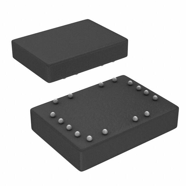

TLV5614IYER 数据手册
 www.ti.com SLAS391A − JULY 2003 − REVISED AUGUST 2003               FEATURES D Four 12-Bit D/A Converters D Programmable Settling Time of Either 3 µs or D 9 µs Typ TMS320 DSP Family, (Q)SPI, and Microwire Compatible Serial Interface Internal Power-On Reset D D Low Power Consumption: APPLICATIONS D D D D D D Battery Powered Test Instruments Digital Offset and Gain Adjustment Industrial Process Controls Machine and Motion Control Devices Communications Arbitrary Waveform Generation − 8 mW, Slow Mode − 5-V Supply − 3.6 mW, Slow Mode − 3-V Supply Reference Input Buffer WCS PACKAGE (BOTTOM VIEW) OUTA OUTB D D Voltage Output Range . . . 2× the Reference Input Voltage Monotonic Over Temperature D D Dual 2.7-V to 5.5-V Supply (Separate Digital and Analog Supplies) D Hardware Power Down (10 nA) D Software Power Down (10 nA) D Simultaneous Update REFINAB 14 13 15 AVDD 16 DVDD 1 PD 2 3 LDAC OUTC OUTD 12 4 DIN 11 10 5 SCLK REFINCD 9 AGND 8 DGND 7 FS 6 CS DESCRIPTION The TLV5614IYE is a quadruple 12-bit voltage output digital-to-analog converter (DAC) with a flexible 4-wire serial interface. The serial interface allows glueless interface to TMS320, SPI, QSPI, and Microwire serial ports. The TLV5614IYE is programmed with a 16-bit serial word comprised of a DAC address, individual DAC control bits, and a 12-bit DAC value. The device has provision for two supplies: one digital supply for the serial interface (via pins DVDD and DGND), and one for the DACs, reference buffers, and output buffers (via pins AVDD and AGND). Each supply is independent of the other, and can be any value between 2.7 V and 5.5 V. The dual supplies allow a typical application where the DAC is controlled via a microprocessor operating on a 3 V supply (also used on pins DVDD and DGND), with the DACs operating on a 5 V supply. Of course, the digital and analog supplies can be tied together. The resistor string output voltage is buffered by a x2 gain rail-to-rail output buffer. The buffer features a Class AB output stage to improve stability and reduce settling time. A rail-to-rail output stage and a power-down mode makes it ideal for single voltage, battery based applications. The settling time of the DAC is programmable to allow the designer to optimize speed versus power dissipation. The settling time is chosen by the control bits within the 16-bit serial input string. A high-impedance buffer is integrated on the REFINAB and REFINCD terminals to reduce the need for a low source impedance drive to the terminal. REFINAB and REFINCD allow DACs A and B to have a different reference voltage then DACs C and D. The TLV5614IYE is implemented with a CMOS process and is available in a 16-terminal WCS package. The TLV5614IYE is characterized for operation from −40°C to 85°C in a wire-bonded small outline (SOIC) package. Please be aware that an important notice concerning availability, standard warranty, and use in critical applications of Texas Instruments semiconductor products and disclaimers thereto appears at the end of this data sheet. TMS320 DSP is a trademark of Texas Instruments. SPI and QSPI are trademarks of Motorola, Inc. Microwire is a trademark of National Semiconductor Corporation.   !"#$%&'(!$" !) *+%%,"( ') $# -+./!*'(!$" 0'(, %$0+*() *$"#$%& ($ )-,*!#!*'(!$") -,% (1, (,%&) $# ,2') ")(%+&,"() )('"0'%0 3'%%'"(4 %$0+*(!$" -%$*,))!"5 0$,) "$( ",*,))'%!/4 !"*/+0, (,)(!"5 $# '// -'%'&,(,%) Copyright  2003, Texas Instruments Incorporated  www.ti.com SLAS391A − JULY 2003 − REVISED AUGUST 2003 These devices have limited built-in ESD protection. The device should be placed in conductive foam during storage or handling to prevent electrostatic damage to the MOS gates. AVAILABLE OPTIONS PACKAGE TA WCS(1) (YE) −40°C to 85°C TLV5614IYE (1) Wafer chip scale package. See Figure 17. FUNCTIONAL BLOCK DIAGRAM AVDD REFINAB 15 DVDD 16 1 DAC A + _ Power-On Reset DIN 4 Serial Input Register 14 + _ 14-Bit Data and Control Register 12 12-Bit DAC Latch 2 2-Bit Control Data Latch 14 OUTA 10 2 2 Power-Down/ Speed Control 2 7 FS SCLK CS REFINCD 5 6 DAC Select/ Control Logic DAC C 12 DAC D 11 OUTB OUTC 10 3 9 AGND 2 13 DAC B 2 8 DGND LDAC PD OUTD  www.ti.com SLAS391A − JULY 2003 − REVISED AUGUST 2003 Terminal Functions TERMINAL NAME NO. AGND 9 AVDD CS 16 DGND 8 DIN 4 DVDD 1 I/O 6 DESCRIPTION Analog ground Analog supply I Chip select. This terminal is active low. Digital ground I Serial data input Digital supply 7 I Frame sync input. The falling edge of the frame sync pulse indicates the start of a serial data frame shifted out to the TLV5614IYE. 2 I Power down pin. Powers down all DACs (overriding their individual power down settings), and all output stages. This terminal is active low. 3 I Load DAC. When the LDAC signal is high, no DAC output updates occur when the input digital data is read into the serial interface. The DAC outputs are only updated when LDAC is low. REFINAB 15 I Voltage reference input for DACs A and B. REFINCD 10 I Voltage reference input for DACs C and D. FS PD LDAC SCLK 5 I Serial clock input OUTA 14 O DACA output OUTB 13 O DACB output OUTC 12 O DACC output OUTD 11 O DACD output ABSOLUTE MAXIMUM RATINGS over operating free-air temperature range unless otherwise noted(1) UNIT Supply voltage, (DVDD, AVDD to GND) 7V Supply voltage difference, (AVDD to DVDD) −2.8 V to 2.8 V Digital input voltage range −0.3 V to DVDD + 0.3 V Reference input voltage range −0.3 V to AVDD + 0.3 V Operating free-air temperature range, TA −40°C to 85°C (1) Stresses beyond those listed under “absolute maximum ratings” may cause permanent damage to the device. These are stress ratings only, and functional operation of the device at these or any other conditions beyond those indicated under “recommended operating conditions” is not implied. Exposure to absolute-maximum-rated conditions for extended periods may affect device reliability. RECOMMENDED OPERATING CONDITIONS Supply voltage, AVDD, DVDD High-level digital input voltage, VIH Low-level digital input voltage, VIL Reference voltage, Vref to REFINAB, REFINCD terminal MIN NOM MAX 5-V supply 4.5 5 5.5 3-V supply 2.7 3 3.3 DVDD = 2.7 V DVDD = 5.5 V V 2.4 0 3-V supply(1) 0 0.6 1 2 Load capacitance, CL Serial clock rate, SCLK Operating free-air temperature TLV5614IYE (1) Voltages greater than AVDD/2 cause output saturation for large DAC codes. V 2 DVDD = 2.7 V DVDD = 5.5 V 5-V supply(1) Load resistance, RL UNIT −40 2.048 VDD−1.5 1.024 VDD−1.5 10 V V kΩ 100 pF 20 MHz 85 °C 3  www.ti.com SLAS391A − JULY 2003 − REVISED AUGUST 2003 ELECTRICAL CHARACTERISTICS over recommended operating free-air temperature range, supply voltages, and reference voltages (unless otherwise noted) STATIC DAC SPECIFICATIONS PARAMETER TEST CONDITIONS MIN Resolution EZS EG MAX UNIT ±4 LSB bits Integral nonlinearity (INL), end point adjusted See Note 1 ±1.5 Differential nonlinearity (DNL) See Note 2 ±0.5 Zero scale error (offset error at zero scale) See Note 3 Zero scale error temperature coefficient See Note 4 Gain error See Note 5 Gain error temperature coefficient See Note 6 Power supply rejection ratio Full scale ±1 LSB ±12 mV ±0.6 % of FS voltage 10 Zero scale PSRR TYP 12 See Notes 7 and 8 ppm/°C 10 ppm/°C −80 dB −80 dB INDIVIDUAL DAC OUTPUT SPECIFICATIONS VO Voltage output range Output load regulation accuracy RL = 10 kΩ 0 RL = 2 kΩ vs 10 kΩ AVDD−0.4 0.1 0.25 V % of FS voltage REFERENCE INPUTS (REFINAB, REFINCD) VI RI Input voltage range CI Input capacitance See Note 9 0 Input resistance Reference feed through REFIN = 1 Vpp at 1 kHz + 1.024 V dc (see Note 10) Reference input bandwidth REFIN = 0.2 Vpp + 1.024 V dc large signal AVDD−1.5 V 10 MΩ 5 pF −75 dB Slow 0.5 Fast 1 MHz DIGITAL INPUTS (DIN, CS, LDAC, PD IIH IIL High-level digital input current Low-level digital input current VI = VDD VI = 0 V CI Input capacitance POWER SUPPLY IDD Power supply current ±1 µA ±1 µA 3 pF 5-V supply, No load, Clock running, All inputs 0 V or VDD Slow 1.6 2.4 Fast 3.8 5.6 3-V supply, No load, Clock running, All inputs 0 V or DVDD Slow 1.2 1.8 Fast 3.2 4.8 mA mA Power down supply current (see Figure 12) 10 nA (1) The relative accuracy or integral nonlinearity (INL) sometimes referred to as linearity error, is the maximum deviation of the output from the line between zero and full scale excluding the effects of zero code and full-scale errors. (2) The differential nonlinearity (DNL) sometimes referred to as differential error, is the difference between the measured and ideal 1 LSB amplitude change of any two adjacent codes. Monotonic means the output voltage changes in the same direction (or remains constant) as a change in the digital input code. (3) Zero-scale error is the deviation from zero voltage output when the digital input code is zero. (4) Zero-scale-error temperature coefficient is given by: EZS TC = [EZS (Tmax) − EZS (Tmin)]/Vref × 106/(Tmax − Tmin). (5) Gain error is the deviation from the ideal output (2 Vref − 1 LSB) with an output load of 10 kΩ excluding the effects of the zero-error. (6) Gain temperature coefficient is given by: EG TC = [EG(Tmax) − EG (Tmin)]/Vref × 106/(Tmax − Tmin). (7) Zero-scale-error rejection ratio (EZS−RR) is measured by varying the AVDD from 5 ± 0.5 V and 3 ± 0.3 V dc, and measuring the proportion of this signal imposed on the zero-code output voltage. (8) Full-scale rejection ratio (EG-RR) is measured by varying the AVDD from 5 ± 0.5 V and 3 ± 0.3 V dc and measuring the proportion of this signal imposed on the full-scale output voltage after subtracting the zero scale change. (9) Reference input voltages greater than VDD/2 cause output saturation for large DAC codes (10) Reference feedthrough is measured at the DAC output with an input code = 000 hex and a Vref (REFINAB or REFINCD) input = 1.024 Vdc + 1 Vpp at 1 kHz. 4  www.ti.com SLAS391A − JULY 2003 − REVISED AUGUST 2003 ELECTRICAL CHARACTERISTICS (CONTINUED) over recommended operating free-air temperature range, supply voltages, and reference voltages (unless otherwise noted) ANALOG OUTPUT DYNAMIC PERFORMANCE PARAMETER TEST CONDITIONS MIN TYP MAX 5 V/µs Slow 1 V/µs SR Output slew rate 3 5.5 Output settling time To ± 0.5 LSB, CL = 100 pF, RL = 10 kΩ, See Notes 1 and 3 Fast ts Slow 9 20 Output settling time, code to code To ± 0.5 LSB, CL = 100 pF, RL = 10 kΩ, See Note 2 Fast 1 ts(c) Slow 2 Glitch energy Code transition from 7FF to 800 SNR Signal-to-noise ratio S/(N+D) Signal to noise + distortion THD Total harmonic distortion SFDR Spurious free dynamic range UNIT Fast CL = 100 pF, RL = 10 kΩ, VO = 10% to 90%, Vref = 2.048 V, 1024 V 10 µss µss nV-sec 74 Sinewave generated by DAC, Reference voltage = 1.024 at 3 V and 2.048 at 5 V, fs = 400 KSPS, fOUT = 1.1 kHz sinewave, CL = 100 pF, RL = 10 kΩ, BW = 20 kHz 66 −68 dB 70 DIGITAL INPUT TIMING REQUIREMENTS tsu(CS−FS) tsu(FS−CK) Setup time, CS low before FS↓ Setup time, FS low before first negative SCLK edge 10 ns 8 ns tsu(C16−FS) Setup time, sixteenth negative SCLK edge after FS low on which bit D0 is sampled before rising edge of FS 10 ns tsu(C16−CS) Setup time. The first positive SCLK edge after D0 is sampled before CS rising edge. If FS is used instead of the SCLK positive edge to update the DAC, then the setup time is between the FS rising edge and CS rising edge. 10 ns twH twL Pulse duration, SCLK high 25 ns Pulse duration, SCLK low 25 ns tsu(D) th(D) Setup time, data ready before SCLK falling edge 8 ns Hold time, data held valid after SCLK falling edge 5 ns twH(FS) Pulse duration, FS high 20 ns (1) Settling time is the time for the output signal to remain within ±0.5 LSB of the final measured value for a digital input code change ofFFF hex to 080 hex for 080 hex to FFF hex. (2) Settling time is the time for the output signal to remain within ±0.5 LSB of the final measured value for a digital input code change of one count. (3) Limits are ensured by design and characterization, but are not production tested. 5  www.ti.com SLAS391A − JULY 2003 − REVISED AUGUST 2003 PARAMETER MEASUREMENT INFORMATION ÓÓÓÓÓ ÓÓÓÓÓ ÓÓÓÓ ÓÓÓÓ SCLK 1 2 tsu(D) DIN twH twL 3 4 5 15 16 th(D) D15 D14 D13 D12 tsu(FS-CK) D1 D0 tsu(C16-CS) tsu(CS-FS) CS twH(FS) tsu(C16-FS) FS Figure 1. Timing Diagram 6 ÓÓÓ ÓÓÓ ÓÓÓÓ ÓÓÓÓ  www.ti.com SLAS391A − JULY 2003 − REVISED AUGUST 2003 TYPICAL CHARACTERISTICS LOAD REGULATION LOAD REGULATION 0.2 0.35 VDD = 3 V, Vref = 1 V, VO = Full Scale 0.18 0.16 0.30 0.25 VO − Output − V 0.14 VO − Output − V VDD = 5 V, Vref = 2 V, VO = Full Scale 3 V Slow Mode, Sink 0.12 0.10 3 V Fast Mode, Sink 0.08 0.06 5 V Slow Mode, Sink 0.20 5 V Fast Mode, Sink 0.15 0.10 0.04 0.05 0.02 0 0 0 0.01 0.02 0.05 0.1 0.2 0.5 0.8 1 2 0 Load Current − mA Figure 2 0.02 0.04 0.1 0.2 0.4 0.8 Load Current − mA 1 2 4 Figure 3 LOAD REGULATION LOAD REGULATION 4.01 2.0015 5 V Slow Mode, Source 3 V Slow Mode, Source 2.001 4.005 2.0005 VO − Output − V VO − Output − V 2.000 4 5 V Fast Mode, Source 3.995 3 V Fast Mode, Source 1.9995 1.999 1.9985 1.998 3.99 VDD = 5 V, Vref = 2 V, VO = Full Scale 1.9975 VDD = 3 V, Vref = 1 V, VO = Full Scale 1.997 3.985 1.9965 0 0.02 0.04 0.1 0.2 0.4 0.8 Load Current − mA Figure 4 1 2 4 0 0.01 0.02 0.05 0.1 0.2 0.5 Load Current − mA 0.8 1 2 Figure 5 7  www.ti.com SLAS391A − JULY 2003 − REVISED AUGUST 2003 SUPPLY CURRENT vs TEMPERATURE SUPPLY CURRENT vs TEMPERATURE 4 3.5 I DD − Supply Current − mA 3.5 I DD − Supply Current − mA 4 VDD = 3 V, Vref = 1.024 V, VO Full Scale (Worst Case For IDD) Fast Mode 3 2.5 2 1.5 1 3 −20 0 20 VDD = 5 V, Vref = 1.024 V, VO Full Scale (Worst Case For IDD) 2.5 2 1.5 Slow Mode 0.5 −40 Fast Mode Slow Mode 1 40 60 80 0.5 −40 100 −20 T − Temperature − °C Figure 6 100 TOTAL HARMONIC DISTORTION vs FREQUENCY 0 0 Vref = 1 V dc + 1 V p/p Sinewave, Output Full Scale −10 THD − Total Harmonic Distortion − dB THD − Total Harmonic Distortion − dB 80 Figure 7 TOTAL HARMONIC DISTORTION vs FREQUENCY −20 −30 −−40 −50 −60 Fast Mode −70 −80 0 5 10 20 30 f − Frequency − kHz Figure 8 8 0 20 40 60 T − Temperature − °C 50 100 Vref = 1 V dc + 1 V p/p Sinewave, Output Full Scale −10 −20 −30 −−40 −50 −60 Slow Mode −70 −80 0 5 10 20 30 f − Frequency − kHz Figure 9 50 100  www.ti.com SLAS391A − JULY 2003 − REVISED AUGUST 2003 Vref = 1 V dc + 1 V p/p Sinewave, Output Full Scale −10 TOTAL HARMONIC DISTORTION AND NOISE vs FREQUENCY THD − Total Harmonic Distortion And Noise − dB 0 −20 −30 −−40 −50 Fast Mode −60 −70 0 Vref = 1 V dc + 1 V p/p Sinewave, Output Full Scale −10 −20 −30 −−40 −80 −50 Slow Mode −60 −70 −80 0 5 10 20 30 50 100 0 5 10 f − Frequency − kHz 20 30 50 100 f − Frequency − kHz Figure 10 Figure 11 SUPPLY CURRENT vs TIME (WHEN ENTERING POWER-DOWN MODE) 4000 3500 I DD − Supply Current − µ A THD − Total Harmonic Distortion And Noise − dB TOTAL HARMONIC DISTORTION AND NOISE vs FREQUENCY 3000 2500 2000 1500 1000 500 0 0 200 400 600 800 1000 t − Time − ns Figure 12 9  www.ti.com SLAS391A − JULY 2003 − REVISED AUGUST 2003 DNL − Differential Nonlinearity − LSB DIFFERENTIAL NONLINEARITY 0.3 0.25 0.2 0.15 0.1 0.05 0 −0.05 −0.1 −0.15 −0.2 −0.25 −0.3 VCC = 5 V, Vref = 2 V, SCLK = 1 MHz) 0 256 512 768 1024 1280 1536 1792 2048 2304 2560 2816 3072 3328 3584 3840 4096 Digital Code Figure 13 INL − Integral Nonlinearity − LSB INTEGRAL NONLINEARITY 1 VCC = 5 V, Vref = 2 V, SCLK = 1 MHz 0.5 0 −0.5 −1 −1.5 0 256 512 768 1024 1280 1536 1792 2048 2304 2560 2816 3072 3328 3584 3840 4096 Digital Code Figure 14 10  www.ti.com SLAS391A − JULY 2003 − REVISED AUGUST 2003 APPLICATION INFORMATION GENERAL FUNCTION The TLV5614IYE is a 12-bit single supply DAC based on a resistor string architecture. The device consists of a serial interface, speed and power down control logic, a reference input buffer, a resistor string, and a rail-to-rail output buffer. The output voltage (full scale determined by external reference) is given by: 2 REF CODE [V] 2n where REF is the reference voltage and CODE is the digital input value within the range of 010 to 2n−1, where n=12 (bits). The 16-bit data word, consisting of control bits and the new DAC value, is illustrated in the data format section. A power-on reset initially resets the internal latches to a defined state (all bits zero). SERIAL INTERFACE Explanation of data transfer: First, the device has to be enabled with CS set to low. Then, a falling edge of FS starts shifting the data bit-per-bit (starting with the MSB) to the internal register on the falling edges of SCLK. After 16 bits have been transferred or FS rises, the content of the shift register is moved to the DAC latch, which updates the voltage output to the new level. The serial interface of the TLV5614IYE can be used in two basic modes: D Four wire (with chip select) D Three wire (without chip select) Using chip select (four wire mode), it is possible to have more than one device connected to the serial port of the data source (DSP or microcontroller). The interface is compatible with the TMS320 DSP family. Figure 15 shows an example with two TLV5614IYEs connected directly to a TMS320 DSP. TLV5614IYE CS FS DIN SCLK TLV5614IYE CS FS DIN SCLK TMS320 DSP XF0 XF1 FSX DX CLKX Figure 15. TMS320 Interface TMS320 is a trademark of Texas Instruments. 11  www.ti.com SLAS391A − JULY 2003 − REVISED AUGUST 2003 If there is no need to have more than one device on the serial bus, then CS can be tied low. Figure 16 shows an example of how to connect the TLV5614IYE to a TMS320, SPI, or Microwire port using only three pins. TMS320 DSP TLV5614IYE FSX SPI SS FS DIN SCLK DX CLKX TLV5614IYE Microwire I/O FS DIN SCLK MOSI SCLK CS TLV5614I YE FS DIN SCLK SO SK CS CS Figure 16. Three-Wire Interface Notes on SPI and Microwire: Before the controller starts the data transfer, the software has to generate a falling edge on the I/O pin connected to FS. If the word width is 8 bits (SPI and Microwire), two write operations must be performed to program the TLV5614IYE. After the write operation(s), the DAC output is updated automatically on the next positive clock edge following the sixteenth falling clock edge. SERIAL CLOCK FREQUENCY AND UPDATE RATE The maximum serial clock frequency is given by: f SCLKmax + t wH(min) 1 )t + 20 MHz wL(min) The maximum update rate is: f UPDATEmax + 1 ǒ wH(min) ) twL(min)Ǔ + 1.25 MHz 16 t Note that the maximum update rate is a theoretical value for the serial interface since the settling time of the TLV5614IYE has to be considered also. DATA FORMAT The 16-bit data word for the TLV5614IYE consists of two parts: D Control bits (D15 . . . D12) D New DAC value (D11 . . . D0) D15 D14 D13 D12 A1 A0 PWR SPD X: don’t care SPD: Speed control bit. PWR: Power control bit. D11 1 → fast mode 1 → power down D10 D9 D8 D7 D6 D5 D4 D3 D2 D1 D0 New DAC value (12 bits) 0 → slow mode 0 → normal operation In power-down mode, all amplifiers within the TLV5614IYE are disabled. A particular DAC (A, B, C, D) of the TLV5614IYE is selected by A1 and A0 within the input word. 12 A1 A0 DAC 0 0 A 0 1 B 1 0 C 1 1 D  www.ti.com SLAS391A − JULY 2003 − REVISED AUGUST 2003 USING TLV5614IYE, WAFER CHIP SCALE PACKAGE (WCSP) D TLV5614 DIE qualification was done using a wire-bonded small outline (SOIC) package and includes: steady state life, thermal shock, ESD, latch-up, and characterization. This qualified device is orderable as TLV5614ID. D The wafer chip-scale package (WCS), TLV5614IYE, uses the same DIE as TLV5614ID, but is not qualified. WCS qualification, including board level reliability (BLR), is the responsibility of the customer. D It is recommended that underfill be used for increased reliability. BLR is application dependent, but may include test such as: temperature cycling, drop test, key push, bend, vibration, and package shear. The following WCSP information provides the user of the TLV5614IYE with some general guidelines for board assembly. D Melting point of eutectic solder is 183°C. D Recommended peak reflow temperatures are in the 220°C to 230°C range. D The use of underfill is required. The use of underfill greatly reduces the risk of thermal mismatch fails. Underfill is an epoxy/adhesive that may be added during the board assembly process to improve board level/system level reliability. The process is to dispense the epoxy under the dice after die attach reflow. The epoxy adheres to the body of the device and to the printed-circuit board. It reduces stress placed upon the solder joints due to the thermal coefficient of expansion (TCE) mismatch between the board and the component. Underfill material is highly filled with silica or other fillers to increase an epoxy’s modulus, reduce creep sensitivity, and decrease the material’s TCE. The recommendation for peak flow temperatures of 220°C to 230°C is based on general empirical results that indicate that this temperature range is needed to facilitate good wetting of the solder bump to the substrate or circuit board pad. Lower peak temperatures may cause nonwets (cold solder joints). Bottom View Top View NOTES:A. All linear dimensions are in millimeters. B. This drawing is subject to change without notice. Figure 17. TLV5614IYE Wafer Chip Scale Package 13  www.ti.com SLAS391A − JULY 2003 − REVISED AUGUST 2003 TLV5614IYE INTERFACED TO TMS320C203 DSP Hardware Interfacing Figure 18 shows an example of how to connect the TLV5614IYE to a TMS320C203 DSP. The serial port is configured in burst mode, with FSX generated by the TMS320C203 to provide the frame sync (FS) input to the TLV5614IYE. Data is transmitted on the DX line, with the serial clock input on the CLKX line. The general-purpose input/output port bits IO0 and IO1 are used to generate the chip select (CS) and DAC latch update (LDAC) inputs to the TLV5614IYE. The active low power down (PD) is pulled high all the time to ensure the DACs are enabled. TMS320C203 TLV5614IYE SDIN DX SCLK CLKX FSX FS I/O 0 CS I/O 1 LDAC VDD PD VOUTA VOUTB REF REFINAB VOUTC REFINCD VOUTD VSS Figure 18. TLV5614IYE Interfaced With TMS320C203 Software The application example outputs a differential in-phase (sine) signal between the VOUTA and VOUTB pins, and its quadrature (cosine) signal as the differential signal between VOUTC and VOUTD. The on-chip timer is used to generate interrupts at a fixed frequency. The related interrupt service routine pulses LDAC low to update all 4 DACs simultaneously, then fetches and writes the next sample to all 4 DACs. The samples are stored in a look-up table, which describes two full periods of a sine wave. The synchronous serial port of the DSP is used in burst mode. In this mode, the processor generates an FS pulse preceding the MSB of every data word. If multiple, contiguous words are transmitted, a violation of the tsu(C16−FS) timing requirement occurs. To avoid this, the program waits until the transmission of the previous word has been completed. ;−−−−−−−−−−−−−−−−−−−−−−−−−−−−−−−−−−−−−−−−−−−−−−−−−−−−−−−−−−−−−−−−−−−−−−−−−−−−−−−−−−−−−−− ; Processor: TMS320C203 runnning at 40 MHz ; ; Description: ; ; This program generates a differential in−phase (sine) on (OUTA−OUTB) and it’s quadrature (cosine) as a differential signal on (OUTC−OUTD). ; ; The DAC codes for the signal samples are stored as a table of 64 12−bit values, describing ; 2 periods of a sine function. A rolling pointer is used to address the table location in ; the first period of this waveform, from which the DAC A samples are read. The samples for ; the other 3 DACs are read at an offset to this rolling pointer ; DAC Function Offset from rolling pointer ; A sine 0 ; B inverse sine 16 ; C cosine 8 ; D inverse cosine24 ; ; The on−chip timer is used to generate interrupts at a fixed rate. The interrupt service ; routine first pulses LDAC low to update all DACs simultaneously with the values which ; were written to them in the previous interrupt. Then all 4 DAC values are fetched and ; written out through the synchronous serial interface. Finally, the rolling pointer is ; incremented to address the next sample, ready for the next interrupt. ;  1998, Texas Instruments Inc. ;−−−−−−−−−−−−−−−−−−−−−−−−−−−−−−−−−−−−−−−−−−−−−−−−−−−−−−−−−−−−−−−−−−−−−−−−−−−−−−−−−−−−−−− 14 www.ti.com  SLAS391A − JULY 2003 − REVISED AUGUST 2003 ;−−−−−−−−−−−−−−−−−−−−−−−−−−−−−− I/O and memory mapped regs −−−−−−−−−−−−−−−−−−−−−−−−−−−−− .include ”regs.asm” ;−−−−−−−jump vectors −−−−−−−−−−−−−−−−−−−−−−−−−−−−−−−−−−−−−−−−−−−−−−−−−−−−−−−−−−−−−−−−−−− .ps 0h b start b int1 b int23 b timer_isr; −−−−−−−−−−− variables −−−−−−−−−−−−−−−−−−−−−−−−−−−−−−−−−−−−−−−−−−−−−−−−−−−−−−−−−−−−−−−−−− temp .equ 0060h r_ptr .equ 0061h iosr_stat .equ 0062h DACa_ptr .equ 0063h DACb_ptr .equ 0064h DACc_ptr .equ 0065h DACd_ptr .equ 0066h ;−−−−−−−−−−−constants−−−−−−−−−−−−−−−−−−−−−−−−−−−−−−−−−−−−−−−−−−−−−−−−−−−−−−−−−−−−−−−−−− ; DAC control bits to be OR’ed onto data ; all fast mode DACa_control .equ 01000h DACb_control .equ 05000h DACc_control .equ 09000h DACd_control .equ 0d000h ;−−−−−−−−−−− tables −−−−−−−−−−−−−−−−−−−−−−−−−−−−−−−− .ds 02000h sinevals .word 00800h .word 0097Ch .word 00AE9h .word 00C3Ah .word 00D61h .word 00E53h .word 00F07h .word 00F76h .word 00F9Ch .word 00F76h .word 00F07h .word 00E53h .word 00D61h .word 00C3Ah .word 00AE9h .word 0097Ch .word 00800h .word 00684h .word 00517h .word 003C6h .word 0029Fh .word 001ADh .word 000F9h .word 0008Ah .word 00064h .word 0008Ah .word 000F9h .word 001ADh .word 0029Fh .word 003C6h .word 00517h .word 00684h .word 00800h .word 0097Ch .word 00AE9h .word 00C3Ah .word 00D61h .word 00E53h .word 00F07h .word 00F76h .word 00F9Ch .word 00F76h .word 00F07h .word 00E53h .word 00D61h .word 00C3Ah .word 00AE9h 15  www.ti.com SLAS391A − JULY 2003 − REVISED AUGUST 2003 .word .word .word .word .word .word .word .word .word .word .word .word .word .word .word .word .word 0097Ch 00800h 00684h 00517h 003C6h 0029Fh 001ADh 000F9h 0008Ah 00064h 0008Ah 000F9h 001ADh 0029Fh 003C6h 00517h 00684h ;−−−−−−−−−−−−−−−−−−−−−−−−−−−−−−−−−−−−−−−−−−−−−−−−−−−−−−−−−−−−−−−−−−−−−−−−−−−−−−−−−−−−−−−−−−−−− ; Main Program ;−−−−−−−−−−−−−−−−−−−−−−−−−−−−−−−−−−−−−−−−−−−−−−−−−−−−−−−−−−−−−−−−−−−−−−−−−−−−−−−−−−−−−−−−−−−− .ps 1000h .entry start ;−−−−−−−−−−−−−−−−−−−−−−−−−−−−−−−−−−−−−−−−−−−−−−−−−−−−−−−−−−−−−−−−−−−−−−−−−−−−−−−−−−−−−−−−−−−− ; disable interrupts ;−−−−−−−−−−−−−−−−−−−−−−−−−−−−−−−−−−−−−−−−−−−−−−−−−−−−−−−−−−−−−−−−−−−−−−−−−−−−−−−−−−−−−−−−−−−− setc INTM ; disable maskable interrupts splk #0ffffh, IFR; clear all interrupts splk #0004h, IMR; timer interrupts unmasked ;−−−−−−−−−−−−−−−−−−−−−−−−−−−−−−−−−−−−−−−−−−−−−−−−−−−−−−−−−−−−−−−−−−−−−−−−−−−−−−−−−−−−−−−−−−−−− ; set up the timer ; timer period set by values in PRD and TDDR ; period = (CLKOUT1 period) x (1+PRD) x (1+TDDR) ; examples for TMS320C203 with 40MHz main clock ; Timer rate TDDR PRD ; 80 kHz 9 24 (18h) ; 50 kHz 9 39 (27h) ;−−−−−−−−−−−−−−−−−−−−−−−−−−−−−−−−−−−−−−−−−−−−−−−−−−−−−−−−−−−−−−−−−−−−−−−−−−−−−−−−−−−−−−−−−−−− prd_val.equ 0018h tcr_val.equ 0029h splk #0000h, temp; clear timer out temp, TIM splk #prd_val, temp; set PRD out temp, PRD splk #tcr_val, temp; set TDDR, and TRB=1 for auto−reload out temp, TCR ;−−−−−−−−−−−−−−−−−−−−−−−−−−−−−−−−−−−−−−−−−−−−−−−−−−−−−−−−−−−−−−−−−−−−−−−−−−−−−−−−−−−−−−−−−−− ; Configure IO0/1 as outputs to be : ; IO0 CS − and set high ; IO1 LDAC − and set high ;−−−−−−−−−−−−−−−−−−−−−−−−−−−−−−−−−−−−−−−−−−−−−−−−−−−−−−−−−−−−−−−−−−−−−−−−−−−−−−−−−−−−−−−−−−− in temp, ASPCR; configure as output lacl temp or #0003h sacl temp out temp, ASPCR in temp, IOSR; set them high lacl temp or #0003h sacl temp out temp, IOSR ;−−−−−−−−−−−−−−−−−−−−−−−−−−−−−−−−−−−−−−−−−−−−−−−−−−−−−−−−−−−−−−−−−−−−−−−−−−−−−−−−−−−−−−−−−−− ; set up serial port for ; SSPCR.TXM=1 Transmit mode − generate FSX ; SSPCR.MCM=1 Clock mode − internal clock source ; SSPCR.FSM=1 Burst mode ;−−−−−−−−−−−−−−−−−−−−−−−−−−−−−−−−−−−−−−−−−−−−−−−−−−−−−−−−−−−−−−−−−−−−−−−−−−−−−−−−−−−−−−−−−−− splk #0000Eh, temp out temp, SSPCR; reset transmitter splk #0002Eh, temp out temp,SSPCR ;−−−−−−−−−−−−−−−−−−−−−−−−−−−−−−−−−−−−−−−−−−−−−−−−−−−−−−−−−−−−−−−−−−−−−−−−−−−−−−−−−−−−−−−−−− 16 www.ti.com  SLAS391A − JULY 2003 − REVISED AUGUST 2003 ; reset the rolling pointer ;−−−−−−−−−−−−−−−−−−−−−−−−−−−−−−−−−−−−−−−−−−−−−−−−−−−−−−−−−−−−−−−−−−−−−−−−−−−−−−−−−−−−−−− lacl #000h sacl r_ptr ;−−−−−−−−−−−−−−−−−−−−−−−−−−−−−−−−−−−−−−−−−−−−−−−−−−−−−−−−−−−−−−−−−−−−−−−−−−−−−−−−−−−−−−− ; enable interrupts ;−−−−−−−−−−−−−−−−−−−−−−−−−−−−−−−−−−−−−−−−−−−−−−−−−−−−−−−−−−−−−−−−−−−−−−−−−−−−−−−−−−−−−−− clrc INTM ; enable maskable interrupts ;−−−−−−−−−−−−−−−−−−−−−−−−−−−−−−−−−−−−−−−−−−−−−−−−−−−−−−−−−−−−−−−−−−−−−−−−−−−−−−−−−−−−−−− ; loop forever! ;−−−−−−−−−−−−−−−−−−−−−−−−−−−−−−−−−−−−−−−−−−−−−−−−−−−−−−−−−−−−−−−−−−−−−−−−−−−−−−−−−−−−−−− next idle ;wait for interrupt b next ;−−−−−−−−−−−−−−−−−−−−−−−−−−−−−−−−−−−−−−−−−−−−−−−−−−−−−−−−−−−−−−−−−−−−−−−−−−−−−−−−−−−− ;all else fails stop here ;−−−−−−−−−−−−−−−−−−−−−−−−−−−−−−−−−−−−−−−−−−−−−−−−−−−−−−−−−−−−−−−−−−−−−−−−−−−−−−−−−−−− done b done ;hang there ;−−−−−−−−−−−−−−−−−−−−−−−−−−−−−−−−−−−−−−−−−−−−−−−−−−−−−−−−−−−−−−−−−−−−−−−−−−−−−−−−−−−− ; Interrupt Service Routines ;−−−−−−−−−−−−−−−−−−−−−−−−−−−−−−−−−−−−−−−−−−−−−−−−−−−−−−−−−−−−−−−−−−−−−−−−−−−−−−−−−−− int1 ret ; do nothing and return int23 ret ; do nothing and return timer_isr: in iosr_stat, IOSR; store IOSR value into variable space lacl iosr_stat ; load acc with iosr status and #0FFFDh ; reset IO1 − LDAC low sacl temp ; out temp, IOSR; or #0002h ; set IO1 − LDAC high sacl temp ; out temp, IOSR; and #0FFFEh ; reset IO0 − CS low sacl temp ; out temp, IOSR; lacl r_ptr ; load rolling pointer to accumulator add #sinevals ; add pointer to table start sacl DACa_ptr ; to get a pointer for next DAC a sample add #08h ; add 8 to get to DAC C pointer sacl DACc_ptr add #08h ; add 8 to get to DAC B pointer sacl DACb_ptr add #08h ; add 8 to get to DAC D pointer sacl DACd_ptr mar *,ar0 ; set ar0 as current AR ; DAC A lar ar0, DACa_ptr ; ar0 points to DAC a sample lacl * ; get DAC a sample into accumulator or #DACa_control ; OR in DAC A control bits sacl temp ; out temp, SDTR; send data ;−−−−−−−−−−−−−−−−−−−−−−−−−−−−−−−−−−−−−−−−−−−−−−−−−−−−−−−−−−−−−−−−−−−−−−−−−−−−−−−−−−−−−−−; We must wait for transmission to complete before writing next word to the SDTR.; TLV5614/04 interface does not allow the use of burst mode with the full packet; rate, as we need a CLKX −ve edge to clock in last bit before FS goes high again,; to allow SPI compatibility. ;−−−−−−−−−−−−−−−−−−−−−−−−−−−−−−−−−−−−−−−−−−−−−−−−−−−−−−−−−−−−−−−−−−−−−−−−−−−−−−−−−−−−−−− 17  www.ti.com SLAS391A − JULY 2003 − REVISED AUGUST 2003 rpt nop #016h ; wait long enough for this configuration ; of MCLK/CLKOUT1 rate ; DAC B lar ar0, dacb_ptr ; ar0 points to DAC a sample lacl * ; get DAC a sample into accumulator or #DACb_control ; OR in DAC B control bits sacl temp ; out temp, SDTR; send data rpt #016h ; wait long enough for this configuration nop ; of MCLK/CLKOUT1 rate ; DAC C lar lacl or sacl out rpt nop ar0, dacc_ptr ; * ; #DACc_control ; temp ; temp, SDTR; #016h ; ; ; DAC D lar lacl or sacl out ar0, dacd_ptr; ar0 points to DAC a sample * ; get DAC a sample into accumulator #dacd_control ; OR in DAC D control bits temp ; temp, SDTR; send data lacl add and sacl rpt nop r_ptr #1h #001Fh r_ptr #016h ; ; ; ; ; ; ; now take CS high again lacl iosr_stat ; or #0001h ; sacl temp ; out temp, IOSR; clrc intm ; ret ; .end 18 ar0 points to dac a sample get DAC a sample into accumulator OR in DAC C control bits send data wait long enough for this configuration of MCLK/CLKOUT1 rate load rolling pointer to accumulator increment rolling pointer count 0−31 then wrap back round store rolling pointer wait long enough for this configuration of MCLK/CLKOUT1 rate load acc with iosr status set IO0 − CS high re-enable interrupts return from interrupt  www.ti.com SLAS391A − JULY 2003 − REVISED AUGUST 2003 TLV5614IYE INTERFACED TO MCS51 MICROCONTROLLER Hardware Interfacing Figure 19 shows an example of how to connect the TLV5614IYE to an MCS51 Microcontroller. The serial DAC input data and external control signals are sent via I/O Port 3 of the controller. The serial data is sent on the RxD line, with the serial clock output on the TxD line. Port 3 bits 3, 4, and 5 are configured as outputs to provide the DAC latch update (LDAC), chip select (CS) and frame sync (FS) signals for the TLV5614IYE. The active low power down pin (PD) of the TLV5614IYE is pulled high to ensure that the DACs are enabled. MCS®51 TLV5614IYE RxD SDIN TxD SCLK P3.3 LDAC P3.4 CS P3.4 FS VDD PD VOUTA VOUTB REF REFINAB VOUTC REFINCD VOUTD VSS Figure 19. TLV5614IYE Interfaced With MCS51 Software The example is the same as for the TMS320C203 in this data sheet, but adapted for a MCS51 controller. It generates a differential in-phase (sine) signal between the VOUTA and VOUTB pins, and its quadrature (cosine) signal is the differential signal between VOUTC and VOUTD. The on-chip timer is used to generate interrupts at a fixed frequency. The related interrupt service routine pulses LDAC low to update all 4 DACs simultaneously, then fetches and writes the next sample to all 4 DACs. The samples are stored as a look-up table, which describes one full period of a sine wave. The serial port of the controller is used in Mode 0, which transmits 8 bits of data on RxD, accompanied by a synchronous clock on TxD. Two writes concatenated together are required to write a complete word to the TLV5614IYE. The CS and FS signals are provided in the required fashion through control of IO port 3, which has bit addressable outputs. ;−−−−−−−−−−−−−−−−−−−−−−−−−−−−−−−−−−−−−−−−−−−−−−−−−−−−−−−−−−−−−−−−−−−−−−−−−−−−−−− −−−−−−−−−−−−−− ; Processor: 80C51 ; ; Description: ; ; This program generates a differential in-phase (sine) on (OUTA−OUTB) ; and it’s quadrature (cosine) as a differential signal on (OUTC−OUTD). ; ;  1998, Texas Instruments Inc. ;−−−−−−−−−−−−−−−−−−−−−−−−−−−−−−−−−−−−−−−−−−−−−−−−−−−−−−−−−−−−−−−−−−−−−−−−−−−−−−−−−−−−−−−−− NAME GENIQ MAIN SEGMENT CODE ISR SEGMENT CODE SINTBL SEGMENT CODE VAR1 SEGMENT DATA STACK SEGMENT IDATA ;−−−−−−−−−−−−−−−−−−−−−−−−−−−−−−−−−−−−−−−−−−−−−−−−−−−−−−−−−−−−−−−−−−−−−−−−−−−−−−−−−−−−−−−−− ; Code start at address 0, jump to start ;−−−−−−−−−−−−−−−−−−−−−−−−−−−−−−−−−−−−−−−−−−−−−−−−−−−−−−−−−−−−−−−−−−−−−−−−−−−−−−−−−−−−−−−−− CSEG AT 0 LJMP start ; Execution starts at address 0 on power−up. ;−−−−−−−−−−−−−−−−−−−−−−−−−−−−−−−−−−−−−−−−−−−−−−−−−−−−−−−−−−−−−−−−−−−−−−−−−−−−−−−−−−−−−−−−− 19  www.ti.com SLAS391A − JULY 2003 − REVISED AUGUST 2003 ; Code in the timer0 interrupt vector ;−−−−−−−−−−−−−−−−−−−−−−−−−−−−−−−−−−−−−−−−−−−−−−−−−−−−−−−−−−−−−−−−−−−−−−−−−−−−−−−−−−−−−−−−− CSEG AT 0BH LJMP timer0isr ; Jump vector for timer 0 interrupt is 000Bh ;−−−−−−−−−−−−−−−−−−−−−−−−−−−−−−−−−−−−−−−−−−−−−−−−−−−−−−−−−−−−−−−−−−−−−−−−−−−−−−−−−−−−−−−−− ; Global variables need space allocated ;−−−−−−−−−−−−−−−−−−−−−−−−−−−−−−−−−−−−−−−−−−−−−−−−−−−−−−−−−−−−−−−−−−−−−−−−−−−−−−−−−−−−−−−−− RSEG VAR1 temp_ptr: DS 1 rolling_ptr: DS 1 ;−−−−−−−−−−−−−−−−−−−−−−−−−−−−−−−−−−−−−−−−−−−−−−−−−−−−−−−−−−−−−−−−−−−−−−−−−−−−−−−−−−−−−−−−− ; Interrupt service routine for timer 0 interrupts ;−−−−−−−−−−−−−−−−−−−−−−−−−−−−−−−−−−−−−−−−−−−−−−−−−−−−−−−−−−−−−−−−−−−−−−−−−−−−−−−−−−−−−−−−− RSEG ISR timer0isr: PUSH PSW PUSH ACC CLR INT1 ; pulse LDAC low SETB INT1 ; to latch all 4 previous values at the same time ; 1st thing done in timer isr => fixed period CLR T0 ; set CS low ; ; ; ; The signal to be output on each DAC is a sine function. One cycle of a sine wave is held in a table @ sinevals as 32 samples of msb, lsb pairs (64 bytes). We have ; one pointer which rolls round this table, rolling_ptr incrementing by 2 bytes (1 sample) on each interrupt (at the end of this routine). ; The DAC samples are read at an offset to this rolling pointer: ; DAC Function Offset from rolling_ptr ; A sine 0 ; B inverse sine 32 ; C cosine 16 ; D inverse cosine48 MOV DPTR,#sinevals; set DPTR to the start of the table of sine signal values MOV R7,rolling_ptr; R7 holds the pointer into the sine table MOV A,R7 ; get DAC A msb MOVC A,@A+DPTR ; msb of DAC A is in the ACC CLR MOV T1 SBUF,A INC R7 MOV A,R7 MOVC A,@A+DPTR A_MSB_TX: JNB TI,A_MSB_TX CLR TI MOV SBUF,A ; transmit it − set FS low ; send it out the serial port ; increment the pointer in R7 ; to get the next byte from the table ; which is the lsb of this sample, now in ACC ; wait for transmit to complete ; clear for new transmit ; and send out the lsb of DAC A ; DAC C next ; DAC C codes should be taken from 16 bytes (8 samples) further on ; in the sine table − this gives a cosine function MOV A,R7 ; pointer in R7 ADD A,#0FH ; add 15 − already done one INC ANL A,#03FH ; wrap back round to 0 if > 64 MOV R7,A ; pointer back in R7 MOVC ORL A_LSB_TX: JNB SETB CLR T1 CLR MOV INC MOV MOVC C_MSB_TX: JNB CLR MOV 20 A,@A+DPTR A,#01H ; get DAC C msb from the table ; set control bits to DAC C address TI,A_LSB_TX T1 ; wait for DAC A lsb transmit to complete ; toggle FS TI SBUF,A R7 A,R7 A,@A+DPTR ; ; ; ; ; TI,C_MSB_TX TI SBUF,A ; wait for transmit to complete ; clear for new transmit ; and send out the lsb of DAC C clear for new transmit and send out the msb of DAC C increment the pointer in R7 to get the next byte from the table which is the lsb of this sample, now in ACC  www.ti.com SLAS391A − JULY 2003 − REVISED AUGUST 2003 ; DAC B next ; DAC B codes should be taken from 16 bytes (8 samples) further on ; in the sine table − this gives an inverted sine function MOV A,R7 ; pointer in R7 ADD A,#0FH ; add 15 − already done one INC ANL A,#03FH ; wrap back round to 0 if > 64 MOV R7,A ; pointer back in R7 MOVC ORL C_LSB_TX: JNB SETB CLR CLR MOV A,@A+DPTR A,#02H ; get DAC B msb from the table ; set control bits to DAC B address TI,C_LSB_TX T1 T1 TI SBUF,A ; wait for DAC C lsb transmit to complete ; toggle FS ; get DAC B LSB INC R7 MOV A,R7 MOVC A,@A+DPTR B_MSB_TX: JNB TI,B_MSB_TX CLR TI MOV SBUF,A ; clear for new transmit ; and send out the msb of DAC B ; increment the pointer in R7 ; to get the next byte from the table ; which is the lsb of this sample, now in ACC ; wait for transmit to complete ; clear for new transmit ; and send out the lsb of DAC B ; DAC D next ; DAC D codes should be taken from 16 bytes (8 samples) further on ; in the sine table − this gives an inverted cosine function MOV A,R7 ; pointer in R7 ADD A,#0FH ; add 15 − already done one INC ANL A,#03FH ; wrap back round to 0 if > 64 MOV R7,A ; pointer back in R7 MOVC A,@A+DPTR ; get DAC D msb from the table ORL A,#03H ; set control bits to DAC D address B_LSB_TX: JNB TI,B_LSB_TX ; SETB T1 ; CLR T1 CLR TI ; clear for MOV SBUF,A ; INC MOV MOVC D_MSB_TX: JNB CLR MOV wait for DAC B lsb transmit to complete toggle FS new transmit and send out the msb of DAC D R7 A,R7 A,@A+DPTR ; increment the pointer in R7 ; to get the next byte from the table ; which is the lsb of this sample, now in ACC TI,D_MSB_TX TI SBUF,A ; wait for transmit to complete ; clear for new transmit ; and send out the lsb of DAC D ; increment the rolling pointer to point to the next sample ; ready for the next interrupt MOV A,rolling_ptr ADD A,#02H ; add 2 to the rolling pointer ANL A,#03FH ; wrap back round to 0 if > 64 MOV rolling_ptr,A ; store in memory again D_LSB_TX: JNB TI,D_LSB_TX ; wait for DAC D lsb transmit to complete CLR TI ; clear for next transmit SETB T1 ; FS high SETB T0 ; CS high POP ACC POP PSW RETI ;−−−−−−−−−−−−−−−−−−−−−−−−−−−−−−−−−−−−−−−−−−−−−−−−−−−−−−−−−−−−−−−−−−−−−−−−−−−−−−− ; Stack needs definition ;−−−−−−−−−−−−−−−−−−−−−−−−−−−−−−−−−−−−−−−−−−−−−−−−−−−−−−−−−−−−−−−−−−−−−−−−−−−−−−− RSEG STACK DS 10h ; 16 Byte Stack! 21  SLAS391A − JULY 2003 − REVISED AUGUST 2003 ;−−−−−−−−−−−−−−−−−−−−−−−−−−−−−−−−−−−−−−−−−−−−−−−−−−−−−−−−−−−−−−−−−−−−−−−−−−−−−−− ; Main program code ;−−−−−−−−−−−−−−−−−−−−−−−−−−−−−−−−−−−−−−−−−−−−−−−−−−−−−−−−−−−−−−−−−−−−−−−−−−−−−−− RSEG MAIN start: MOV SP,#STACK−1 ; first set Stack Pointer CLR A MOV SCON,A ; set serial port 0 to mode 0 MOV TMOD,#02H ; set timer 0 to mode 2 − auto−reload MOV TH0,#038H ; set TH0 for 5kHs interrupts SETB INT1 ; set LDAC = 1 SETB T1 ; set FS = 1 SETB T0 ; set CS = 1 SETB ET0 ; enable timer 0 interrupts SETB EA ; enable all interrupts MOV rolling_ptr,A ; set rolling pointer to 0 SETB TR0 ; start timer 0 always: SJMP always ; while(1) ! RET ;−−−−−−−−−−−−−−−−−−−−−−−−−−−−−−−−−−−−−−−−−−−−−−−−−−−−−−−−−−−−−−−−−−−−−−−−−−−−−−− ; Table of 32 sine wave samples used as DAC data ;−−−−−−−−−−−−−−−−−−−−−−−−−−−−−−−−−−−−−−−−−−−−−−−−−−−−−−−−−−−−−−−−−−−−−−−−−−−−−−− RSEG SINTBL sinevals: DW 01000H DW 0903EH DW 05097H DW 0305CH DW 0B086H DW 070CAH DW 0F0E0H DW 0F06EH DW 0F039H DW 0F06EH DW 0F0E0H DW 070CAH DW 0B086H DW 0305CH DW 05097H DW 0903EH DW 01000H DW 06021H DW 0A0E8H DW 0C063H DW 040F9H DW 080B5H DW 0009FH DW 00051H DW 00026H DW 00051H DW 0009FH DW 080B5H DW 040F9H DW 0C063H DW 0A0E8H DW 06021H END 22 www.ti.com PACKAGE OPTION ADDENDUM www.ti.com 17-Sep-2009 PACKAGING INFORMATION Orderable Device Status (1) Package Type Package Drawing Pins Package Eco Plan (2) Qty TLV5614IYE ACTIVE DIESALE YE 16 120 TBD Call TI N / A for Pkg Type TLV5614IYER ACTIVE DIESALE YE 16 3000 TBD Call TI N / A for Pkg Type Lead/Ball Finish MSL Peak Temp (3) (1) The marketing status values are defined as follows: ACTIVE: Product device recommended for new designs. LIFEBUY: TI has announced that the device will be discontinued, and a lifetime-buy period is in effect. NRND: Not recommended for new designs. Device is in production to support existing customers, but TI does not recommend using this part in a new design. PREVIEW: Device has been announced but is not in production. Samples may or may not be available. OBSOLETE: TI has discontinued the production of the device. (2) Eco Plan - The planned eco-friendly classification: Pb-Free (RoHS), Pb-Free (RoHS Exempt), or Green (RoHS & no Sb/Br) - please check http://www.ti.com/productcontent for the latest availability information and additional product content details. TBD: The Pb-Free/Green conversion plan has not been defined. Pb-Free (RoHS): TI's terms "Lead-Free" or "Pb-Free" mean semiconductor products that are compatible with the current RoHS requirements for all 6 substances, including the requirement that lead not exceed 0.1% by weight in homogeneous materials. Where designed to be soldered at high temperatures, TI Pb-Free products are suitable for use in specified lead-free processes. Pb-Free (RoHS Exempt): This component has a RoHS exemption for either 1) lead-based flip-chip solder bumps used between the die and package, or 2) lead-based die adhesive used between the die and leadframe. The component is otherwise considered Pb-Free (RoHS compatible) as defined above. Green (RoHS & no Sb/Br): TI defines "Green" to mean Pb-Free (RoHS compatible), and free of Bromine (Br) and Antimony (Sb) based flame retardants (Br or Sb do not exceed 0.1% by weight in homogeneous material) (3) MSL, Peak Temp. -- The Moisture Sensitivity Level rating according to the JEDEC industry standard classifications, and peak solder temperature. Important Information and Disclaimer:The information provided on this page represents TI's knowledge and belief as of the date that it is provided. TI bases its knowledge and belief on information provided by third parties, and makes no representation or warranty as to the accuracy of such information. Efforts are underway to better integrate information from third parties. TI has taken and continues to take reasonable steps to provide representative and accurate information but may not have conducted destructive testing or chemical analysis on incoming materials and chemicals. TI and TI suppliers consider certain information to be proprietary, and thus CAS numbers and other limited information may not be available for release. In no event shall TI's liability arising out of such information exceed the total purchase price of the TI part(s) at issue in this document sold by TI to Customer on an annual basis. Addendum-Page 1 IMPORTANT NOTICE Texas Instruments Incorporated and its subsidiaries (TI) reserve the right to make corrections, modifications, enhancements, improvements, and other changes to its products and services at any time and to discontinue any product or service without notice. Customers should obtain the latest relevant information before placing orders and should verify that such information is current and complete. All products are sold subject to TI’s terms and conditions of sale supplied at the time of order acknowledgment. TI warrants performance of its hardware products to the specifications applicable at the time of sale in accordance with TI’s standard warranty. Testing and other quality control techniques are used to the extent TI deems necessary to support this warranty. Except where mandated by government requirements, testing of all parameters of each product is not necessarily performed. TI assumes no liability for applications assistance or customer product design. Customers are responsible for their products and applications using TI components. To minimize the risks associated with customer products and applications, customers should provide adequate design and operating safeguards. TI does not warrant or represent that any license, either express or implied, is granted under any TI patent right, copyright, mask work right, or other TI intellectual property right relating to any combination, machine, or process in which TI products or services are used. Information published by TI regarding third-party products or services does not constitute a license from TI to use such products or services or a warranty or endorsement thereof. Use of such information may require a license from a third party under the patents or other intellectual property of the third party, or a license from TI under the patents or other intellectual property of TI. Reproduction of TI information in TI data books or data sheets is permissible only if reproduction is without alteration and is accompanied by all associated warranties, conditions, limitations, and notices. Reproduction of this information with alteration is an unfair and deceptive business practice. TI is not responsible or liable for such altered documentation. Information of third parties may be subject to additional restrictions. Resale of TI products or services with statements different from or beyond the parameters stated by TI for that product or service voids all express and any implied warranties for the associated TI product or service and is an unfair and deceptive business practice. TI is not responsible or liable for any such statements. TI products are not authorized for use in safety-critical applications (such as life support) where a failure of the TI product would reasonably be expected to cause severe personal injury or death, unless officers of the parties have executed an agreement specifically governing such use. Buyers represent that they have all necessary expertise in the safety and regulatory ramifications of their applications, and acknowledge and agree that they are solely responsible for all legal, regulatory and safety-related requirements concerning their products and any use of TI products in such safety-critical applications, notwithstanding any applications-related information or support that may be provided by TI. Further, Buyers must fully indemnify TI and its representatives against any damages arising out of the use of TI products in such safety-critical applications. TI products are neither designed nor intended for use in military/aerospace applications or environments unless the TI products are specifically designated by TI as military-grade or "enhanced plastic." Only products designated by TI as military-grade meet military specifications. Buyers acknowledge and agree that any such use of TI products which TI has not designated as military-grade is solely at the Buyer's risk, and that they are solely responsible for compliance with all legal and regulatory requirements in connection with such use. TI products are neither designed nor intended for use in automotive applications or environments unless the specific TI products are designated by TI as compliant with ISO/TS 16949 requirements. Buyers acknowledge and agree that, if they use any non-designated products in automotive applications, TI will not be responsible for any failure to meet such requirements. Following are URLs where you can obtain information on other Texas Instruments products and application solutions: Products Amplifiers Data Converters DLP® Products DSP Clocks and Timers Interface Logic Power Mgmt Microcontrollers RFID RF/IF and ZigBee® Solutions amplifier.ti.com dataconverter.ti.com www.dlp.com dsp.ti.com www.ti.com/clocks interface.ti.com logic.ti.com power.ti.com microcontroller.ti.com www.ti-rfid.com www.ti.com/lprf Applications Audio Automotive Broadband Digital Control Medical Military Optical Networking Security Telephony Video & Imaging Wireless www.ti.com/audio www.ti.com/automotive www.ti.com/broadband www.ti.com/digitalcontrol www.ti.com/medical www.ti.com/military www.ti.com/opticalnetwork www.ti.com/security www.ti.com/telephony www.ti.com/video www.ti.com/wireless Mailing Address: Texas Instruments, Post Office Box 655303, Dallas, Texas 75265 Copyright © 2009, Texas Instruments Incorporated
