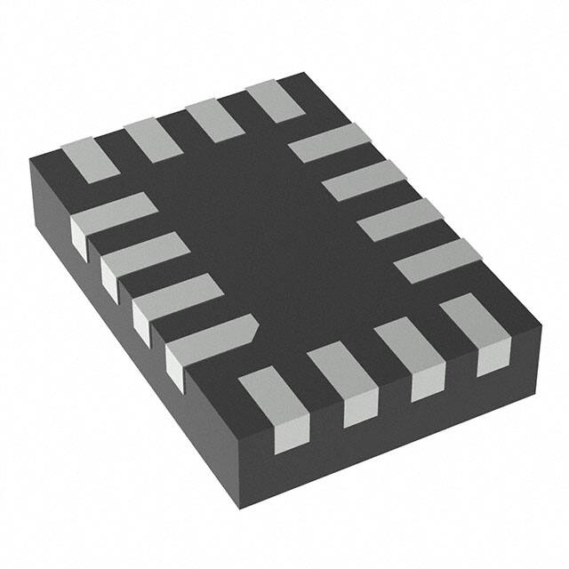

    TMUX111X 5V、低泄漏电流、1:1(SPST)、4通道精密开关
TMUX1113RSVR 数据手册
Order Now Product Folder Support & Community Tools & Software Technical Documents TMUX1111, TMUX1112, TMUX1113 SCDS408B – FEBRUARY 2019 – REVISED AUGUST 2019 TMUX111x 5-V, Low-Leakage-Current, 1:1 (SPST), 4-Channel Precision Switches 1 Features 3 Description • • • • • • • • • • • The TMUX1111, TMUX1112, and TMUX1113 are precision complementary metal-oxide semiconductor (CMOS) devices that have four independently selectable 1:1, single-pole, single-throw (SPST) switches. Wide operating supply of 1.08 V to 5.5 V allows for use in a broad array of applications from medical equipment to industrial systems. The device supports bidirectional analog and digital signals on the source (Sx) and drain (Dx) pins ranging from GND to VDD. 1 Wide supply range: 1.08 V to 5.5 V Low leakage current: 3 pA Low charge injection: -1.5 pC Low on-resistance: 2 Ω -40°C to +125°C operating temperature 1.8 V Logic compatible Fail-safe logic Rail to rail operation Bidirectional signal path Break-before-make switching ESD protection HBM: 2000 V The switches of the TMUX1111 are turned on with Logic 0 on the appropriate logic control inputs, while Logic 1 is required to turn on switches in the TMUX1112. The four channels of the TMUX1113 are split with two switches supporting Logic 0, while the other two switches support Logic 1. The TMUX1113 exhibits break-before-make switching, allowing the device to be used in cross-point switching applications. 2 Applications • • • • • • • • • • • • • • • • Sample-and-hold circuits Feedback gain switching Signal isolation Field transmitters Programmable logic controllers (PLC) Factory automation and control Ultrasound scanners Patient monitoring & diagnostics Electrocardiogram (ECG) Data acquisition systems (DAQ) ATE test equipment Battery test equipment Instrumentation: lab, analytical, portable Smart meters: Water and Gas Optical networking Optical test equipment The TMUX111x devices are part of the precision switches and multiplexers family. These devices have very low on and off leakage currents and low charge injection, allowing them to be used in high precision measurement applications. A low supply current of 8 nA and small package options enable use in portable applications. Device Information(1) PART NUMBER PACKAGE TMUX1111 TMUX1112 TMUX1113 BODY SIZE (NOM) TSSOP (16) (PW) 5.00 mm × 4.40 mm UQFN (16) (RSV) 2.60 mm x 1.80 mm (1) For all available packages, see the package option addendum at the end of the data sheet. TMUX111x Block Diagrams CHANNEL 1 CHANNEL 1 CHANNEL 1 S1 D1 S1 CHANNEL 2 D1 CHANNEL 2 S2 D2 S2 D3 S3 CHANNEL 3 S3 D2 S2 D3 S3 D2 CHANNEL 3 D3 CHANNEL 4 D4 S4 CHANNEL 4 D4 S4 SEL1 SEL1 SEL1 SEL2 SEL2 SEL2 SEL3 SEL3 SEL3 SEL4 SEL4 SEL4 TMUX1111 D1 CHANNEL 2 CHANNEL 3 CHANNEL 4 S4 S1 TMUX1112 D4 TMUX1113 ALL SWITCHES SHOWN FOR A LOGIC 0 INPUT 1 An IMPORTANT NOTICE at the end of this data sheet addresses availability, warranty, changes, use in safety-critical applications, intellectual property matters and other important disclaimers. PRODUCTION DATA. TMUX1111, TMUX1112, TMUX1113 SCDS408B – FEBRUARY 2019 – REVISED AUGUST 2019 www.ti.com Table of Contents 1 2 3 4 5 6 7 Features .................................................................. Applications ........................................................... Description ............................................................. Revision History..................................................... Device Comparison Table..................................... Pin Configuration and Functions ......................... Specifications......................................................... 7.1 7.2 7.3 7.4 7.5 7.6 7.7 7.8 7.9 8 Absolute Maximum Ratings ...................................... 4 ESD Ratings.............................................................. 4 Recommended Operating Conditions....................... 4 Thermal Information .................................................. 4 Electrical Characteristics (VDD = 5 V ±10 %) ............ 5 Electrical Characteristics (VDD = 3.3 V ±10 %) ......... 7 Electrical Characteristics (VDD = 1.8 V ±10 %) ......... 9 Electrical Characteristics (VDD = 1.2 V ±10 %) ....... 11 Typical Characteristics ............................................ 13 Parameter Measurement Information ................ 16 8.1 8.2 8.3 8.4 8.5 8.6 8.7 8.8 8.9 9 1 1 1 2 3 3 4 On-resistance.......................................................... Off-leakage current ................................................. On-leakage current ................................................. Transition time......................................................... Break-before-make ................................................. Charge injection ...................................................... Off isolation ............................................................. Channel-to-Channel Crosstalk ................................ Bandwidth ............................................................... 16 16 17 17 18 18 19 19 20 Detailed Description ............................................ 21 9.1 Overview ................................................................. 21 9.2 9.3 9.4 9.5 Functional Block Diagram ....................................... Feature Description................................................. Device Functional Modes........................................ Truth Tables ............................................................ 21 21 23 23 10 Application and Implementation........................ 24 10.1 10.2 10.3 10.4 10.5 10.6 10.7 10.8 10.9 Application Information.......................................... 24 Typical Application - Sample-and-Hold Circuit .... 24 Design Requirements............................................ 25 Detailed Design Procedure ................................... 25 Application Curve .................................................. 26 Typical Application - Switched Gain Amplifier ..... 26 Design Requirements............................................ 27 Detailed Design Procedure ................................... 27 Application Curve .................................................. 27 11 Power Supply Recommendations ..................... 28 12 Layout................................................................... 28 12.1 Layout Guidelines ................................................. 28 12.2 Layout Example .................................................... 29 13 Device and Documentation Support ................. 30 13.1 13.2 13.3 13.4 13.5 13.6 13.7 Documentation Support ........................................ Related Links ........................................................ Receiving Notification of Documentation Updates Community Resources.......................................... Trademarks ........................................................... Electrostatic Discharge Caution ............................ Glossary ................................................................ 30 30 30 30 30 30 31 14 Mechanical, Packaging, and Orderable Information ........................................................... 31 4 Revision History NOTE: Page numbers for previous revisions may differ from page numbers in the current version. Changes from Revision A (June 2019) to Revision B Page • Deleted the Product Preview note from: TMUX1113, TMUX1112 and the RSV package in the Device Information table... 1 • Deleted the Product Preview note from: TMUX1113, TMUX1112 in the Device Comparison Table table............................ 3 • Deleted the Product Preview note from:the RSV package in the Pin Configuration and Functions secton .......................... 3 • Added RSV (UQFN) thermal values to Thermal Information ................................................................................................. 4 Changes from Original (February 2019) to Revision A • 2 Page Changed The document From: Advanced Information To: Mixed Status. ............................................................................ 1 Submit Documentation Feedback Copyright © 2019, Texas Instruments Incorporated Product Folder Links: TMUX1111 TMUX1112 TMUX1113 TMUX1111, TMUX1112, TMUX1113 www.ti.com SCDS408B – FEBRUARY 2019 – REVISED AUGUST 2019 5 Device Comparison Table PRODUCT DESCRIPTION TMUX1111 Low-Leakage-Current, Precision, 4-Channel, 1:1 (SPST) Switches (Normally Closed) TMUX1112 Low-Leakage-Current, Precision, 4-Channel, 1:1 (SPST) Switches (Normally Open) TMUX1113 Low-Leakage-Current, Precision, 4-Channel, 1:1 (SPST) Switches (Dual Open + Dual Closed) 6 Pin Configuration and Functions PW Package 16-Pin TSSOP Top View 15 D2 3 14 S2 4 13 VDD S1 GND 5 12 N.C. N.C. S4 6 11 S3 D4 7 10 D3 SEL4 8 9 16 S1 N.C. 1 D2 2 13 D1 SEL2 SEL2 14 16 SEL1 1 15 SEL1 D1 RSV Package 16-Pin UQFN Top View 12 S2 2 11 VDD GND 3 10 N.C. S4 4 9 S3 8 7 6 5 SEL3 Not to scale D3 SEL3 SEL4 D4 Not to scale Pin Functions PIN TYPE (1) DESCRIPTION NAME TSSOP UQFN SEL1 1 15 I D1 2 16 I/O Drain pin 1. Can be an input or output. S1 3 1 I/O Source pin 1. Can be an input or output. N.C. 4 2 - No internal connection. GND 5 3 P Ground (0 V) reference S4 6 4 I/O Source pin 4. Can be an input or output. D4 7 5 I/O Drain pin 4. Can be an input or output. SEL4 8 6 I Logic control input 4. Controls channel 4 state as shown in Truth Tables. SEL3 9 7 I Logic control input 3. Controls channel 3 state as shown in Truth Tables. D3 10 8 I/O Drain pin 3. Can be an input or output. S3 11 9 I/O Source pin 3. Can be an input or output. N.C. 12 10 - No internal connection. VDD 13 11 P Positive power supply. This pin is the most positive power-supply potential. For reliable operation, connect a decoupling capacitor ranging from 0.1 µF to 10 µF between VDD and GND. S2 14 12 I/O Source pin 2. Can be an input or output. D2 15 13 I/O Drain pin 2. Can be an input or output. SEL2 16 14 I (1) Logic control input 1. Controls channel 1 state as shown in Truth Tables. Logic control input 2. Controls channel 2 state as shown in Truth Tables. I = input, O = output, I/O = input and output, P = power Copyright © 2019, Texas Instruments Incorporated Submit Documentation Feedback Product Folder Links: TMUX1111 TMUX1112 TMUX1113 3 TMUX1111, TMUX1112, TMUX1113 SCDS408B – FEBRUARY 2019 – REVISED AUGUST 2019 www.ti.com 7 Specifications 7.1 Absolute Maximum Ratings over operating free-air temperature range (unless otherwise noted) (1) (2) (3) MIN MAX VDD Supply voltage –0.5 6 V VSEL Logic control input pin voltage (SELx) –0.5 6 V ISEL Logic control input pin current (SELx) –30 30 mA VS or VD Source or drain voltage (Sx, Dx) –0.5 VDD+0.5 IS or ID (CONT) Source or drain continuous current (Sx, Dx) –30 30 mA Tstg Storage temperature –65 150 °C TJ Junction temperature 150 °C (1) (2) (3) UNIT V Stresses beyond those listed under Absolute Maximum Rating may cause permanent damage to the device. These are stress ratings only, which do not imply functional operation of the device at these or any other conditions beyond those indicated under Recommended Operating Condition. Exposure to absolute-maximum-rated conditions for extended periods may affect device reliability. The algebraic convention, whereby the most negative value is a minimum and the most positive value is a maximum. All voltages are with respect to ground, unless otherwise specified. 7.2 ESD Ratings VALUE V(ESD) (1) (2) Electrostatic discharge Human body model (HBM), per ANSI/ESDA/JEDEC JS-001, all pins (1) ±2000 Charged device model (CDM), per JEDEC specification JESD22-C101 or ANSI/ESDA/JEDEC JS-002, all pins (2) ±750 UNIT V JEDEC document JEP155 states that 500-V HBM allows safe manufacturing with a standard ESD control process. JEDEC document JEP157 states that 250-V CDM allows safe manufacturing with a standard ESD control process. 7.3 Recommended Operating Conditions over operating free-air temperature range (unless otherwise noted) MIN VDD Positive power supply voltage VS or VD Signal path input/output voltage (source or drain pin) (Sx, Dx) VSEL Logic control input pin voltage (SELx) TA Ambient temperature NOM MAX UNIT 1.08 5.5 V 0 VDD V 0 5.5 V –40 125 °C 7.4 Thermal Information TMUX1111 / TMUX1112 / TMUX1113 THERMAL METRIC (1) PW (TSSOP) RSV (QFN) UNIT 16 PINS 16 PINS RθJA Junction-to-ambient thermal resistance 124.7 146.8 °C/W RθJC(top) Junction-to-case (top) thermal resistance 54.8 83.5 °C/W RθJB Junction-to-board thermal resistance 70.9 75.5 °C/W ΨJT Junction-to-top characterization parameter 10.8 9.0 °C/W ΨJB Junction-to-board characterization parameter 70.3 73.4 °C/W RθJC(bot) Junction-to-case (bottom) thermal resistance N/A N/A °C/W (1) 4 For more information about traditional and new thermal metrics, see the Semiconductor and IC Package Thermal Metrics application report. Submit Documentation Feedback Copyright © 2019, Texas Instruments Incorporated Product Folder Links: TMUX1111 TMUX1112 TMUX1113 TMUX1111, TMUX1112, TMUX1113 www.ti.com SCDS408B – FEBRUARY 2019 – REVISED AUGUST 2019 7.5 Electrical Characteristics (VDD = 5 V ±10 %) at TA = 25°C, VDD = 5 V (unless otherwise noted) PARAMETER TEST CONDITIONS TA MIN TYP MAX UNIT ANALOG SWITCH RON On-resistance ΔRON RON On-resistance matching between channels On-resistance flatness FLAT IS(OFF) ID(OFF) ID(ON) IS(ON) ID(ON) IS(ON) Source off leakage current (1) Drain off leakage current (1) Channel on leakage current Channel on leakage current VS = 0 V to VDD ISD = 10 mA Refer to On-resistance 25°C 4 Ω –40°C to +85°C VS = 0 V to VDD ISD = 10 mA Refer to On-resistance 25°C VS = 0 V to VDD ISD = 10 mA Refer to On-resistance 25°C VDD = 5 V Switch Off VD = 4.5 V / 1.5 V VS = 1.5 V / 4.5 V Refer to Off-leakage current 25°C VDD = 5 V Switch Off VD = 4.5 V / 1.5 V VS = 1.5 V / 4.5 V Refer to Off-leakage current 25°C VDD = 5 V Switch On VD = VS = 2.5 V Refer to On-leakage current 25°C VDD = 5 V Switch On VD = VS = 4.5 V / 1.5 V Refer to On-leakage current 25°C 2 4.5 Ω –40°C to +125°C 4.9 Ω 0.13 Ω –40°C to +85°C 0.4 Ω –40°C to +125°C 0.5 Ω 0.85 Ω –40°C to +85°C 1.6 Ω –40°C to +125°C 1.6 Ω 0.08 nA –40°C to +85°C –0.08 –0.3 0.3 nA –40°C to +125°C –0.9 0.9 nA –0.08 ±0.005 0.08 nA –40°C to +85°C –0.3 0.3 nA –40°C to +125°C –0.9 0.9 nA 0.025 nA –0.025 ±0.005 ±0.003 –40°C to +85°C –0.2 0.2 nA –40°C to +125°C –0.95 0.95 nA 0.1 nA –0.35 –0.1 0.35 nA –40°C to +125°C –2 2 nA –40°C to +85°C ±0.01 LOGIC INPUTS (SELx) VIH Input logic high –40°C to +125°C 1.49 5.5 V VIL Input logic low –40°C to +125°C 0 0.87 V IIH IIL Input leakage current 25°C IIH IIL Input leakage current –40°C to +125°C CIN Logic input capacitance 25°C CIN Logic input capacitance –40°C to +125°C ±0.005 µA ±0.06 1 µA pF 2 pF POWER SUPPLY IDD (1) VDD supply current Logic inputs = 0 V or 5.5 V 25°C 0.008 –40°C to +125°C µA 1 µA When VS is 4.5 V, VD is 1.5 V or when VS is 1.5 V, VD is 4.5 V. Copyright © 2019, Texas Instruments Incorporated Submit Documentation Feedback Product Folder Links: TMUX1111 TMUX1112 TMUX1113 5 TMUX1111, TMUX1112, TMUX1113 SCDS408B – FEBRUARY 2019 – REVISED AUGUST 2019 www.ti.com Electrical Characteristics (VDD = 5 V ±10 %) (continued) at TA = 25°C, VDD = 5 V (unless otherwise noted) PARAMETER TEST CONDITIONS TA MIN TYP MAX UNIT DYNAMIC CHARACTERISTICS tTRAN tOPEN (BBM) QC OISO XTALK Transition time between channels Break before make time (TMUX1113 Only) Charge Injection Off Isolation Crosstalk VS = 3 V RL = 200 Ω, CL = 15 pF Refer to Transition time 25°C VS = 3 V RL = 200 Ω, CL = 15 pF Refer to Break-before-make 25°C 12 –40°C to +85°C –40°C to +125°C 8 ns 18 ns 19 ns ns –40°C to +85°C 1 ns –40°C to +125°C 1 ns VS = 1 V RS = 0 Ω, CL = 1 nF Refer to Charge injection 25°C –1.5 pC RL = 50 Ω, CL = 5 pF f = 1 MHz Refer to Off isolation 25°C –62 dB RL = 50 Ω, CL = 5 pF f = 10 MHz Refer to Off isolation 25°C –40 dB RL = 50 Ω, CL = 5 pF f = 1 MHz Refer to Channel-to-Channel Crosstalk 25°C –100 dB RL = 50 Ω, CL = 5 pF f = 10 MHz Refer to Channel-to-Channel Crosstalk 25°C –90 dB 300 MHz BW Bandwidth RL = 50 Ω, CL = 5 pF Refer to Bandwidth 25°C CSOFF Source off capacitance f = 1 MHz 25°C 7 pF CDOFF Drain off capacitance f = 1 MHz 25°C 10 pF CSON CDON On capacitance f = 1 MHz 25°C 17 pF 6 Submit Documentation Feedback Copyright © 2019, Texas Instruments Incorporated Product Folder Links: TMUX1111 TMUX1112 TMUX1113 TMUX1111, TMUX1112, TMUX1113 www.ti.com SCDS408B – FEBRUARY 2019 – REVISED AUGUST 2019 7.6 Electrical Characteristics (VDD = 3.3 V ±10 %) at TA = 25°C, VDD = 3.3 V (unless otherwise noted) PARAMETER TEST CONDITIONS TA MIN TYP MAX 3.7 UNIT ANALOG SWITCH RON On-resistance ΔRON RON On-resistance matching between channels On-resistance flatness FLAT IS(OFF) ID(OFF) ID(ON) IS(ON) Source off leakage current (1) Drain off leakage current (1) Channel on leakage current VS = 0 V to VDD ISD = 10 mA Refer to On-resistance 25°C 8.8 Ω –40°C to +85°C 9.5 Ω –40°C to +125°C 9.8 Ω VS = 0 V to VDD ISD = 10 mA Refer to On-resistance 25°C VS = 0 V to VDD ISD = 10 mA Refer to On-resistance 25°C VDD = 3.3 V Switch Off VD = 3 V / 1 V VS = 1 V / 3 V Refer to Off-leakage current 25°C VDD = 3.3 V Switch Off VD = 3 V / 1 V VS = 1 V / 3 V Refer to Off-leakage current 25°C VDD = 3.3 V Switch On VD = VS = 3 V / 1 V Refer to On-leakage current 0.13 Ω –40°C to +85°C 0.4 Ω –40°C to +125°C 0.5 Ω –40°C to +85°C –40°C to +125°C –0.05 1.9 Ω 2 Ω 2.2 Ω 0.05 nA –40°C to +85°C –0.2 0.2 nA –40°C to +125°C –0.9 0.9 nA –0.05 ±0.001 0.05 nA –40°C to +85°C –0.2 0.2 nA –40°C to +125°C –0.9 0.9 nA 25°C –0.1 0.1 nA –40°C to +85°C ±0.001 ±0.005 –0.35 0.35 nA –40°C to +125°C –2 2 nA LOGIC INPUTS (SELx) VIH Input logic high –40°C to +125°C 1.35 5.5 V VIL Input logic low –40°C to +125°C 0 0.8 V IIH IIL Input leakage current 25°C IIH IIL Input leakage current –40°C to +125°C CIN Logic input capacitance 25°C CIN Logic input capacitance –40°C to +125°C ±0.005 µA ±0.05 1 µA pF 2 pF POWER SUPPLY IDD (1) VDD supply current Logic inputs = 0 V or 5.5 V 25°C 0.005 –40°C to +125°C µA 1 µA When VS is 3 V, VD is 1 V or when VS is 1 V, VD is 3 V. Copyright © 2019, Texas Instruments Incorporated Submit Documentation Feedback Product Folder Links: TMUX1111 TMUX1112 TMUX1113 7 TMUX1111, TMUX1112, TMUX1113 SCDS408B – FEBRUARY 2019 – REVISED AUGUST 2019 www.ti.com Electrical Characteristics (VDD = 3.3 V ±10 %) (continued) at TA = 25°C, VDD = 3.3 V (unless otherwise noted) PARAMETER TEST CONDITIONS TA MIN TYP MAX UNIT DYNAMIC CHARACTERISTICS tTRAN tOPEN (BBM) QC OISO XTALK Transition time between channels Break before make time (TMUX1113 Only) Charge Injection Off Isolation Crosstalk VS = 2 V RL = 200 Ω, CL = 15 pF Refer to Transition time 25°C VS = 2 V RL = 200 Ω, CL = 15 pF Refer to Break-before-make 25°C 14 –40°C to +85°C –40°C to +125°C 9 ns 20 ns 22 ns ns –40°C to +85°C 1 ns –40°C to +125°C 1 ns VS = 1 V RS = 0 Ω, CL = 1 nF Refer to Charge injection 25°C –1.5 pC RL = 50 Ω, CL = 5 pF f = 1 MHz Refer to Off isolation 25°C –62 dB RL = 50 Ω, CL = 5 pF f = 10 MHz Refer to Off isolation 25°C –40 dB RL = 50 Ω, CL = 5 pF f = 1 MHz Refer to Channel-to-Channel Crosstalk 25°C –100 dB RL = 50 Ω, CL = 5 pF f = 10 MHz Refer to Channel-to-Channel Crosstalk 25°C –90 dB 300 MHz BW Bandwidth RL = 50 Ω, CL = 5 pF Refer to Bandwidth 25°C CSOFF Source off capacitance f = 1 MHz 25°C 7 pF CDOFF Drain off capacitance f = 1 MHz 25°C 10 pF CSON CDON On capacitance f = 1 MHz 25°C 17 pF 8 Submit Documentation Feedback Copyright © 2019, Texas Instruments Incorporated Product Folder Links: TMUX1111 TMUX1112 TMUX1113 TMUX1111, TMUX1112, TMUX1113 www.ti.com SCDS408B – FEBRUARY 2019 – REVISED AUGUST 2019 7.7 Electrical Characteristics (VDD = 1.8 V ±10 %) at TA = 25°C, VDD = 1.8 V (unless otherwise noted) PARAMETER TEST CONDITIONS TA MIN TYP MAX UNIT ANALOG SWITCH RON On-resistance ΔRON IS(OFF) ID(OFF) ID(ON) IS(ON) On-resistance matching between channels Source off leakage current (1) Drain off leakage current (1) Channel on leakage current VS = 0 V to VDD ISD = 10 mA Refer to On-resistance 25°C VS = 0 V to VDD ISD = 10 mA Refer to On-resistance 25°C VDD = 1.98 V Switch Off VD = 1.62 V / 1 V VS = 1 V / 1.62 V Refer to Off-leakage current 25°C VDD = 1.98 V Switch Off VD = 1.62 V / 1 V VS = 1 V / 1.62 V Refer to Off-leakage current 25°C VDD = 1.98 V Switch On VD = VS = 1.62 V / 1 V Refer to On-leakage current 40 Ω –40°C to +85°C 80 Ω –40°C to +125°C 80 Ω 0.4 Ω –40°C to +85°C 1.5 Ω –40°C to +125°C 1.5 Ω 0.05 nA –40°C to +85°C –0.05 –0.2 0.2 nA –40°C to +125°C –0.9 0.9 nA –0.05 ±0.001 0.05 nA –40°C to +85°C –0.2 0.2 nA –40°C to +125°C –0.9 0.9 nA 25°C –0.1 0.1 nA –40°C to +85°C ±0.001 ±0.005 –0.35 0.35 nA –40°C to +125°C –2 2 nA LOGIC INPUTS (SELx) VIH Input logic high –40°C to +125°C 1.07 5.5 V VIL Input logic low –40°C to +125°C 0 0.68 V IIH IIL Input leakage current 25°C IIH IIL Input leakage current –40°C to +125°C CIN Logic input capacitance 25°C CIN Logic input capacitance –40°C to +125°C ±0.005 µA ±0.05 1 µA pF 2 pF POWER SUPPLY IDD (1) VDD supply current Logic inputs = 0 V or 5.5 V 25°C 0.001 –40°C to +125°C µA 0.85 µA When VS is 1.62 V, VD is 1 V or when VS is 1 V, VD is 1.62 V. Copyright © 2019, Texas Instruments Incorporated Submit Documentation Feedback Product Folder Links: TMUX1111 TMUX1112 TMUX1113 9 TMUX1111, TMUX1112, TMUX1113 SCDS408B – FEBRUARY 2019 – REVISED AUGUST 2019 www.ti.com Electrical Characteristics (VDD = 1.8 V ±10 %) (continued) at TA = 25°C, VDD = 1.8 V (unless otherwise noted) PARAMETER TEST CONDITIONS TA MIN TYP MAX UNIT DYNAMIC CHARACTERISTICS tTRAN tOPEN (BBM) QC OISO XTALK Transition time between channels Break before make time (TMUX1113 Only) Charge Injection Off Isolation Crosstalk VS = 1 V RL = 200 Ω, CL = 15 pF Refer to Transition time 25°C VS = 1 V RL = 200 Ω, CL = 15 pF Refer to Break-before-make 25°C 25 –40°C to +85°C –40°C to +125°C 17 ns 44 ns 44 ns ns –40°C to +85°C 1 ns –40°C to +125°C 1 ns VS = 1 V RS = 0 Ω, CL = 1 nF Refer to Charge injection 25°C –0.5 pC RL = 50 Ω, CL = 5 pF f = 1 MHz Refer to Off isolation 25°C –62 dB RL = 50 Ω, CL = 5 pF f = 10 MHz Refer to Off isolation 25°C –40 dB RL = 50 Ω, CL = 5 pF f = 1 MHz Refer to Channel-to-Channel Crosstalk 25°C –100 dB RL = 50 Ω, CL = 5 pF f = 10 MHz Refer to Channel-to-Channel Crosstalk 25°C –90 dB 300 MHz BW Bandwidth RL = 50 Ω, CL = 5 pF Refer to Bandwidth 25°C CSOFF Source off capacitance f = 1 MHz 25°C 7 pF CDOFF Drain off capacitance f = 1 MHz 25°C 10 pF CSON CDON On capacitance f = 1 MHz 25°C 17 pF 10 Submit Documentation Feedback Copyright © 2019, Texas Instruments Incorporated Product Folder Links: TMUX1111 TMUX1112 TMUX1113 TMUX1111, TMUX1112, TMUX1113 www.ti.com SCDS408B – FEBRUARY 2019 – REVISED AUGUST 2019 7.8 Electrical Characteristics (VDD = 1.2 V ±10 %) PARAMETER TEST CONDITIONS TA MIN TYP MAX UNIT ANALOG SWITCH RON VS = 0 V to VDD ISD = 10 mA Refer to On-resistance 25°C On-resistance matching between channels VS = 0 V to VDD ISD = 10 mA Refer to On-resistance 25°C 25°C Source off leakage current (1) VDD = 1.32 V Switch Off VD = 1 V / 0.8 V VS = 0.8 V / 1 V Refer to Off-leakage current VDD = 1.32 V Switch Off VD = 1 V / 0.8 V VS = 0.8 V / 1 V Refer to Off-leakage current 25°C VDD = 1.32 V Switch On VD = VS = 1 V / 0.8 V Refer to On-leakage current 25°C On-resistance ΔRON IS(OFF) ID(OFF) ID(ON) IS(ON) Drain off leakage current (1) Channel on leakage current 70 –40°C to +85°C –40°C to +125°C Ω 105 Ω 105 Ω 0.4 –40°C to +85°C Ω 1.5 –40°C to +125°C –0.05 ±0.001 Ω 1.5 Ω 0.05 nA –40°C to +85°C –0.2 0.2 nA –40°C to +125°C –0.9 0.9 nA 0.05 nA –0.05 ±0.001 –40°C to +85°C –0.2 0.2 nA –40°C to +125°C –0.9 0.9 nA 0.1 nA –0.35 –0.1 0.35 nA –40°C to +125°C –2 2 nA –40°C to +85°C ±0.005 LOGIC INPUTS (SELx) VIH Input logic high –40°C to +125°C 0.96 5.5 V VIL Input logic low –40°C to +125°C 0 0.36 V IIH IIL Input leakage current 25°C IIH IIL Input leakage current –40°C to +125°C CIN Logic input capacitance 25°C CIN Logic input capacitance –40°C to +125°C ±0.005 µA ±0.05 1 µA pF 2 pF POWER SUPPLY IDD (1) VDD supply current Logic inputs = 0 V or 5.5 V 25°C 0.001 –40°C to +125°C µA 0.7 µA When VS is 1 V, VD is 0.8 V or when VS is 0.8 V, VD is 1 V. Copyright © 2019, Texas Instruments Incorporated Submit Documentation Feedback Product Folder Links: TMUX1111 TMUX1112 TMUX1113 11 TMUX1111, TMUX1112, TMUX1113 SCDS408B – FEBRUARY 2019 – REVISED AUGUST 2019 www.ti.com Electrical Characteristics (VDD = 1.2 V ±10 %) (continued) PARAMETER TEST CONDITIONS TA MIN TYP MAX UNIT DYNAMIC CHARACTERISTICS tTRAN tOPEN (BBM) QC OISO XTALK VS = 1 V RL = 200 Ω, CL = 15 pF Refer to Transition time 25°C Break before make time (TMUX1113 Only) VS = 1 V RL = 200 Ω, CL = 15 pF Refer to Break-before-make 25°C Charge Injection VS = 1 V RS = 0 Ω, CL = 1 nF Refer to Charge injection 25°C –0.5 pC RL = 50 Ω, CL = 5 pF f = 1 MHz Refer to Off isolation 25°C –62 dB RL = 50 Ω, CL = 5 pF f = 10 MHz Refer to Off isolation 25°C –40 dB RL = 50 Ω, CL = 5 pF f = 1 MHz Refer to Channel-to-Channel Crosstalk 25°C –100 dB RL = 50 Ω, CL = 5 pF f = 10 MHz Refer to Channel-to-Channel Crosstalk 25°C –90 dB 300 MHz Transition time between channels Off Isolation Crosstalk 55 ns –40°C to +85°C 190 ns –40°C to +125°C 190 ns 28 ns –40°C to +85°C 1 ns –40°C to +125°C 1 ns BW Bandwidth RL = 50 Ω, CL = 5 pF Refer to Bandwidth 25°C CSOFF Source off capacitance f = 1 MHz 25°C 8 pF CDOFF Drain off capacitance f = 1 MHz 25°C 11 pF CSON CDON On capacitance f = 1 MHz 25°C 18 pF 12 Submit Documentation Feedback Copyright © 2019, Texas Instruments Incorporated Product Folder Links: TMUX1111 TMUX1112 TMUX1113 TMUX1111, TMUX1112, TMUX1113 www.ti.com SCDS408B – FEBRUARY 2019 – REVISED AUGUST 2019 7.9 Typical Characteristics at TA = 25°C, VDD = 5 V (unless otherwise noted) 6 5 VDD = 3 V 4.5 5 4 On Resistance (:) On Resistance (:) VDD = 3.63 V 4 VDD = 4.5 V 3 VDD = 5.5 V 2 TA = 85qC TA = 125qC TA = -40qC TA = 25qC 3.5 3 2.5 2 1.5 1 1 0.5 0 0 0 1 2 3 4 VS or VD - Source or Drain Voltage (V) 5 5.5 0 1 2 3 4 VS or VD - Source or Drain Voltage (V) D001 TA = 25°C Figure 1. On-Resistance vs Source or Drain Voltage 7 70 TA = 125qC VDD = 1.08 V 60 On Resistance (:) On Resistance (:) Figure 2. On-Resistance vs Temperature 80 TA = 85qC 5 4 3 2 VDD = 1.32 V 50 40 VDD = 1.62 V 30 20 1 TA = -40qC VDD = 1.98 V 10 TA = 25qC 0 0 0 0.5 1 1.5 2 2.5 3 VS or VD - Source or Drain Voltage (V) 3.5 0 D003 0.2 0.4 0.6 0.8 1 1.2 1.4 1.6 VS or VD - Source or Drain Voltage (V) VDD = 3.3 V 80 15 60 VDD = 1.98 V D004 40 VDD = 3.63 V On-Leakage (pA) VDD = 1.32 V 2 Figure 4. On-Resistance vs Source or Drain Voltage 20 10 1.8 TA = 25°C Figure 3. On-Resistance vs Temperature On-Leakage (pA) D002 VDD = 5 V 8 6 5 5 0 -5 20 0 -20 -10 -40 -15 -60 -20 -80 0 0.5 1 1.5 2 2.5 3 3.5 VS or VD - Source or Drain Voltage (V) 4 D005 0 1 2 3 4 VS or VD - Source or Drain Voltage (V) TA = 25°C 5 D006 VDD = 5 V Figure 5. On-Leakage vs Source or Drain Voltage Copyright © 2019, Texas Instruments Incorporated Figure 6. On-Leakage vs Source or Drain Voltage Submit Documentation Feedback Product Folder Links: TMUX1111 TMUX1112 TMUX1113 13 TMUX1111, TMUX1112, TMUX1113 SCDS408B – FEBRUARY 2019 – REVISED AUGUST 2019 www.ti.com Typical Characteristics (continued) 1 3 2 0.5 Leakage Current (nA) Leakage Current (nA) 0.75 IS(OFF) 0.25 0 -0.25 -0.5 IS(ON) -20 0 20 40 60 Temperature (qC) 0 -1 IS(ON) -2 -0.75 -1 -40 IS(OFF) 1 80 100 -3 -40 120 -20 0 D007 20 40 60 Temperature (qC) VDD = 3.3 V 100 120 D008 VDD = 5 V Figure 7. Leakage Current vs Temperature Figure 8. Leakage Current vs Temperature 1400 0.5 VDD = 5 V VDD = 3.3 V VDD = 1.8 V VDD = 1.2 V 1200 0.4 VDD = 5 V Supply Current (PA) Supply Current (PA) 80 0.3 VDD = 3.3 V 0.2 VDD = 1.8 V 0.1 0 1000 800 600 400 200 VDD = 1.2 V -0.1 -40 0 -20 0 20 40 60 80 Temperature (qC) 100 120 0 140 0.5 1 1.5 D009 20 8 15 6 10 Charge Injection (pC) Charge Injection (pC) 4.5 5 D010 Figure 10. Supply Current vs Logic Voltage Figure 9. Supply Current vs Temperature VDD = 3.3 V VDD = 5 V 0 -5 -10 -15 4 VDD = 1.2 V 2 0 -2 VDD = 1.8 V -4 -6 -20 -8 0 1 2 3 VS - Source Voltage (V) 4 TA = -40°C to 125°C Figure 11. Charge Injection vs Source Voltage 14 4 TA = 25°C VSEL = 5.5 V 5 2 2.5 3 3.5 Logic Voltage (V) Submit Documentation Feedback 5 D011 0 0.25 0.5 0.75 1 1.25 Source Voltage (V) 1.5 1.75 2 D012 TA = -40°C to 125°C Figure 12. Charge Injection vs Source Voltage Copyright © 2019, Texas Instruments Incorporated Product Folder Links: TMUX1111 TMUX1112 TMUX1113 TMUX1111, TMUX1112, TMUX1113 www.ti.com SCDS408B – FEBRUARY 2019 – REVISED AUGUST 2019 Typical Characteristics (continued) 30 25 Rising Magnitude (dB) Time (ns) 20 15 10 Falling 5 0 0.5 1.5 2.5 3.5 VDD - Supply Voltage (V) 4.5 5.5 10 0 -10 -20 -30 -40 -50 -60 -70 -80 -90 -100 -110 -120 -130 100k Off-Isolation Crosstalk 1M 10M Frequency (Hz) D013 TA = -40°C to +125°C 100M D014 TA = -40°C to +125°C Figure 13. Output TTRANSITION vs Supply Voltage Figure 14. Xtalk and Off-Isolation vs Frequency 0 -1 Gain (dB) -2 -3 -4 -5 -6 1M 10M Frequency (Hz) 100M D015 TA = -40°C to +125°C Figure 15. On Response vs Frequency Copyright © 2019, Texas Instruments Incorporated Submit Documentation Feedback Product Folder Links: TMUX1111 TMUX1112 TMUX1113 15 TMUX1111, TMUX1112, TMUX1113 SCDS408B – FEBRUARY 2019 – REVISED AUGUST 2019 www.ti.com 8 Parameter Measurement Information 8.1 On-resistance The on-resistance of a device is the ohmic resistance between the source (Sx) and drain (Dx) pins of the device. The on-resistance varies with input voltage and supply voltage. The symbol RON is used to denote on-resistance. The measurement setup used to measure RON is shown in Figure 16. Voltage (V) and current (ISD) are measured using this setup, and RON is computed with RON = V / ISD: V ISD Sx Dx VS Figure 16. On-Resistance measurement setup 8.2 Off-leakage current There are two types of leakage currents associated with a switch during the off state: 1. Source off-leakage current 2. Drain off-leakage current Source leakage current is defined as the leakage current flowing into or out of the source pin when the switch is off. This current is denoted by the symbol IS(OFF). Drain leakage current is defined as the leakage current flowing into or out of the drain pin when the switch is off. This current is denoted by the symbol ID(OFF). The setup used to measure both off-leakage currents is shown in Figure 17. VDD VDD VDD D1 S1 A A VD VS D1 VD IS (OFF) A A VD VS S1 VS ID (OFF) D4 S4 VDD IS (OFF) ID (OFF) S4 D4 VS VD GND GND Figure 17. Off-leakage measurement setup 16 Submit Documentation Feedback Copyright © 2019, Texas Instruments Incorporated Product Folder Links: TMUX1111 TMUX1112 TMUX1113 TMUX1111, TMUX1112, TMUX1113 www.ti.com SCDS408B – FEBRUARY 2019 – REVISED AUGUST 2019 8.3 On-leakage current Source on-leakage current is defined as the leakage current flowing into or out of the source pin when the switch is on. This current is denoted by the symbol IS(ON). Drain on-leakage current is defined as the leakage current flowing into or out of the drain pin when the switch is on. This current is denoted by the symbol ID(ON). Either the source pin or drain pin is left floating during the measurement. Figure 18 shows the circuit used for measuring the on-leakage current, denoted by IS(ON) or ID(ON). VDD VDD VDD N.C. A A VD S4 N.C. S1 D1 S4 D4 N.C. VS IS (ON) ID (ON) D4 VDD IS (ON) ID (ON) D1 S1 A A VD N.C. VS GND GND Figure 18. On-leakage measurement setup 8.4 Transition time Transition time is defined as the time taken by the output of the device to rise or fall 10% after the address signal has risen or fallen past the logic threshold. The 10% transition measurement is utilized to provide the timing of the device. System level timing can then account for the time constant added from the load resistance and load capacitance. Figure 19 shows the setup used to measure transition time, denoted by the symbol tTRANSITION. VDD 0.1 F VDD ADDRESS DRIVE (VSEL) VDD tf < 5ns tr < 5ns VIH VIL 0V VS S1 D1 OUTPUT RL CL tTRANSITION tTRANSITION VS S4 D4 90% OUTPUT RL CL SEL1 - SEL4 OUTPUT 10% VSEL GND 0V Figure 19. Transition-time measurement setup Copyright © 2019, Texas Instruments Incorporated Submit Documentation Feedback Product Folder Links: TMUX1111 TMUX1112 TMUX1113 17 TMUX1111, TMUX1112, TMUX1113 SCDS408B – FEBRUARY 2019 – REVISED AUGUST 2019 www.ti.com 8.5 Break-before-make The TMUX1113 has break-before-make delay which allows the device to be used in cross-point switching application. The output first breaks from the on-state switch before making the connection with the next on-state switch. The time delay between the break and the make is known as break-before-make delay. Figure 20 shows the setup used to measure break-before-make delay, denoted by the symbol tOPEN(BBM). VDD 0.1 F VDD VDD VIH VSEL VIL 0V S1, S4 VS 90% OUTPUT 1 D1, D4 90% CL RL Output 2 0V S2, S3 VS 90% 90% OUTPUT 2 D2, D3 tBBM2 Output 1 RL tBBM1 CL SEL1 - SEL4 0V VSEL tBBM= min (tBBM1, tBBM2) GND Figure 20. Break-before-make delay measurement setup 8.6 Charge injection The TMUX111x devices have a transmission-gate topology. Any mismatch in capacitance between the NMOS and PMOS transistors results in a charge injected into the drain or source during the falling or rising edge of the gate signal. The amount of charge injected into the source or drain of the device is known as charge injection, and is denoted by the symbol QC. Figure 21 shows the setup used to measure charge injection from source (Sx) to drain (Dx). VDD 0.1 F VDD VDD VSEL VS S1 D1 OUTPUT VOUT 0V CL Output VOUT VS QC = CL × VOUT VS S4 D4 SEL1 - SEL4 VSEL OUTPUT VOUT CL GND Figure 21. Charge-injection measurement setup 18 Submit Documentation Feedback Copyright © 2019, Texas Instruments Incorporated Product Folder Links: TMUX1111 TMUX1112 TMUX1113 TMUX1111, TMUX1112, TMUX1113 www.ti.com SCDS408B – FEBRUARY 2019 – REVISED AUGUST 2019 8.7 Off isolation Off isolation is defined as the ratio of the signal at the drain pin (Dx) of the device when a signal is applied to the source pin (Sx) of an off-channel. The characteristic impedance, Z0, for the measurement is 50 Ω. Figure 22 shows the setup used to measure off isolation. Use off isolation equation to compute off isolation. 0.1µF NETWORK VDD ANALYZER VS 50Ÿ S VSIG D VOUT RL 50Ÿ SX/DX GND RL 50Ÿ Figure 22. Off isolation measurement setup Off Isolation §V · 20 ˜ Log ¨ OUT ¸ V © S ¹ (1) 8.8 Channel-to-Channel Crosstalk Crosstalk is defined as the ratio of the signal at the drain pin (Dx) of a different channel, when a signal is applied at the source pin (Sx) of an on-channel. The characteristic impedance, Z0, for the measurement is 50 Ω. Figure 23 shows the setup used to measure, and the equation used to compute crosstalk. VDD 0.1µF NETWORK VDD ANALYZER VOUT S1 D1 S2 D2 RL 50Ÿ RL 50Ÿ VS RL 50Ÿ 50Ÿ SX / D X VSIG = 200 mVpp VBIAS = VDD / 2 RL 50Ÿ GND Figure 23. Channel-to-Channel Crosstalk Measurement Setup Channel-to-Channel Crosstalk §V · 20 ˜ Log ¨ OUT ¸ V © S ¹ Copyright © 2019, Texas Instruments Incorporated (2) Submit Documentation Feedback Product Folder Links: TMUX1111 TMUX1112 TMUX1113 19 TMUX1111, TMUX1112, TMUX1113 SCDS408B – FEBRUARY 2019 – REVISED AUGUST 2019 www.ti.com 8.9 Bandwidth Bandwidth is defined as the range of frequencies that are attenuated by less than 3 dB when the input is applied to the source pin (Sx) of an on-channel, and the output is measured at the drain pin (Dx) of the device. The characteristic impedance, Z0, for the measurement is 50 Ω. Figure 24 shows the setup used to measure bandwidth. VDD 0.1µF NETWORK VDD VS S ANALYZER 50Ÿ VSIG D VOUT RL 50Ÿ GND Figure 24. Bandwidth measurement setup 20 Submit Documentation Feedback Copyright © 2019, Texas Instruments Incorporated Product Folder Links: TMUX1111 TMUX1112 TMUX1113 TMUX1111, TMUX1112, TMUX1113 www.ti.com SCDS408B – FEBRUARY 2019 – REVISED AUGUST 2019 9 Detailed Description 9.1 Overview The TMUX1111, TMUX1112, and TMUX1113 are 1:1 (SPST), 4-Channel switches. The devices have four independently selectable single-pole, single-throw switches that are turned-on or turned-off based on the state of the corresponding select pin. 9.2 Functional Block Diagram CHANNEL 1 CHANNEL 1 CHANNEL 1 S1 D1 S1 D2 S2 CHANNEL 2 D1 S1 D2 S2 D1 CHANNEL 2 S2 CHANNEL 3 CHANNEL 2 D2 CHANNEL 3 S3 S3 D3 D3 CHANNEL 4 S4 CHANNEL 3 S3 D3 CHANNEL 4 S4 D4 CHANNEL 4 D4 S4 SEL1 SEL1 SEL1 SEL2 SEL2 SEL2 SEL3 SEL3 SEL3 SEL4 SEL4 SEL4 D4 TMUX1112 TMUX1111 TMUX1113 ALL SWITCHES SHOWN FOR A LOGIC 0 INPUT Figure 25. TMUX111x Functional Block Diagram 9.3 Feature Description 9.3.1 Bidirectional operation The TMUX111x conducts equally well from source (Sx) to drain (Dx) or from drain (Dx) to source (Sx). Each channel has very similar characteristics in both directions and supports both analog and digital signals. 9.3.2 Rail to rail operation The valid signal path input/output voltage for TMUX111x ranges from GND to VDD. 9.3.3 1.8 V Logic compatible inputs The TMUX111x devices have 1.8-V logic compatible control for all logic control inputs. The logic input thresholds scale with supply but still provide 1.8-V logic control when operating at 5.5 V supply voltage. 1.8-V logic level inputs allows the TMUX111x devices to interface with processors that have lower logic I/O rails and eliminates the need for an external translator, which saves both space and BOM cost. The current consumption of the TMUX111x devices increase when using 1.8V logic with higher supply voltage as shown in Figure 10. For more information on 1.8 V logic implementations refer to Simplifying Design with 1.8 V logic Muxes and Switches 9.3.4 Fail-safe logic The TMUX111x supports Fail-Safe Logic on the control input pins (EN, A0, A1) allowing for operation up to 5.5 V, regardless of the state of the supply pin. This feature allows voltages on the control pins to be applied before the supply pin, protecting the device from potential damage. Fail-Safe Logic minimizes system complexity by removing the need for power supply sequencing on the logic control pins. For example, the Fail-Safe Logic feature allows the select pins of the TMUX111x to be ramped to 5.5 V while VDD = 0 V. Additionally, the feature enables operation of the TMUX111x with VDD = 1.2 V while allowing the select pins to interface with a logic level of another device up to 5.5 V. Copyright © 2019, Texas Instruments Incorporated Submit Documentation Feedback Product Folder Links: TMUX1111 TMUX1112 TMUX1113 21 TMUX1111, TMUX1112, TMUX1113 SCDS408B – FEBRUARY 2019 – REVISED AUGUST 2019 www.ti.com Feature Description (continued) 9.3.5 Ultra-low Leakage Current The TMUX111x devices provide extremely low on-leakage and off-leakage currents. The TMUX111x devices are capable of switching signals from high source-impedance inputs into a high input-impedance op amp with minimal offset error because of the ultra-low leakage currents. Figure 26 shows typical leakage currents of the TMUX111x devices versus temperature at VDD = 5V. 3 2 Leakage Current (nA) IS(OFF) 1 0 -1 IS(ON) -2 -3 -40 -20 0 20 40 60 Temperature (qC) 80 100 120 D008 Figure 26. Leakage Current vs Temperature 9.3.6 Ultra-low Charge Injection The TMUX111x devices have a transmission gate topology, as shown in Figure 27. Any mismatch in the stray capacitance associated with the NMOS and PMOS causes an output level change whenever the switch is opened or closed. The TMUX111x devices have special charge-injection cancellation circuitry that reduces the source-to-drain charge injection to -1.5 pC at VS = 1 V as shown in Figure 28. 20 OFF ON CGDN CGSN D S CGDP CGSP Charge Injection (pC) 15 10 VDD = 3.3 V 5 VDD = 5 V 0 -5 -10 -15 -20 0 1 2 3 VS - Source Voltage (V) OFF ON Figure 27. Transmission Gate Topology 22 Submit Documentation Feedback 4 5 D011 Figure 28. Charge Injection vs Source Voltage Copyright © 2019, Texas Instruments Incorporated Product Folder Links: TMUX1111 TMUX1112 TMUX1113 TMUX1111, TMUX1112, TMUX1113 www.ti.com SCDS408B – FEBRUARY 2019 – REVISED AUGUST 2019 9.4 Device Functional Modes The TMUX111x devices have four independently selectable single-pole, single-throw switches that are turned-on or turned-off based on the state of the corresponding select pin. The control pins can be as high as 5.5 V. The TMUX111x devices can be operated without any external components except for the supply decoupling capacitors. Unused logic control pins should be tied to GND or VDD in order to ensure the device does not consume additional current as highlighted in Implications of Slow or Floating CMOS Inputs. Unused signal path inputs (Sx or Dx) should be connection to GND. 9.5 Truth Tables Table 1, Table 2, and Table 3 show the truth tables for the TMUX1111, TMUX1112, and TMUX1113, respectively. Table 1. TMUX1111 Truth table (1) (1) SEL x CHANNEL x 0 Channel x ON 1 Channel x OFF x denotes 1, 2, 3 , or 4 for the corresponding channel. Table 2. TMUX1112 Truth table (1) (1) SEL x CHANNEL x 0 Channel x OFF 1 Channel x ON x denotes 1, 2, 3 , or 4 for the corresponding channel. Table 3. TMUX1113 Truth table (1) (1) SEL1 SEL2 SEL3 SEL4 ON / OFF CHANNELS 0 X X X CHANNEL 1 OFF CHANNEL 1 ON 1 X X X X 0 X X CHANNEL 2 ON X 1 X X CHANNEL 2 OFF X X 0 X CHANNEL 3 ON X X 1 X CHANNEL 3 OFF X X X 0 CHANNEL 4 OFF X X X 1 CHANNEL 4 ON X denotes don't care. Copyright © 2019, Texas Instruments Incorporated Submit Documentation Feedback Product Folder Links: TMUX1111 TMUX1112 TMUX1113 23 TMUX1111, TMUX1112, TMUX1113 SCDS408B – FEBRUARY 2019 – REVISED AUGUST 2019 www.ti.com 10 Application and Implementation NOTE Information in the following applications sections is not part of the TI component specification, and TI does not warrant its accuracy or completeness. TI’s customers are responsible for determining suitability of components for their purposes. Customers should validate and test their design implementation to confirm system functionality. 10.1 Application Information The TMUX11xx family offers ulta-low input/output leakage currents and low charge injection. These devices operate up to 5.5 V, and offer true rail-to-rail input and output of both analog and digital signals. The TMUX111x have a low on-capacitance which allows faster settling time when multiplexing inputs in the time domain. These features make the TMUX11xx devices a family of precision, high-performance switches and multiplexers for lowvoltage applications. 10.2 Typical Application - Sample-and-Hold Circuit One useful application to take advantage of the TMUX1111, TMUX1112, and TMUX1113's performance is the sample-and-hold circuit. A sample-and-hold circuit can be useful for an analog to digital converter (ADC) to sample a varying input voltage with improved reliability and stability. It can also be used to store the output samples from a single digital-to-analog converter (DAC) in a multi-output application. A simple sample-and-hold circuit can be realized using an analog switch such as the TMUX1111, TMUX1112, and TMUX1113 analog switches. Figure 29 shows a single channel sample-and hold circuit using only 1 of 4 channels in the TMUX111x devices. TMUX111x DAC + OP AMP ± + CH SEL1 4 Channels RL OP AMP VOUT CL ± (1.8V Capable Control Logic) SEL4 Figure 29. Single Channel Sample-and-Hold Circuit Example An optional op amp is used before the switch since buffered DACs typically have limitations in driving capacitive loads. The additional buffer stage is included following the DAC to prevent potential stability problems from driving a large capacitive load. Ideally, the switch delivers only the input signals to the holding capacitors. However, when the switch gets toggled, some amount of charge also gets transferred to the switch output in the form of charge injection, resulting in a pedestal sampling error. The TMUX1111, TMUX1112, and TMUX1113 switches have excellent charge injection performance of only -1.5 pC, making them ideal choices for this implementation to minimize sampling error. The pedestal error voltage is indirectly related to the size of the capacitance on the output, for better precision a larger capacitor is required due to charge injection. Larger capacitance limits the system settling time which may not be acceptable in some applications. Figure 30 shows a TMUX111x device configured for a 2-channel sample-and-hold circuit with pedestal error compensation. 24 Submit Documentation Feedback Copyright © 2019, Texas Instruments Incorporated Product Folder Links: TMUX1111 TMUX1112 TMUX1113 TMUX1111, TMUX1112, TMUX1113 www.ti.com SCDS408B – FEBRUARY 2019 – REVISED AUGUST 2019 Typical Application - Sample-and-Hold Circuit (continued) 5V VDD 5V DAC9881 VIN1 SW1 5V + SW2 CH 5V ± CC RC + OPA2192 ± ± 5V 0V 5V SEL1/ SEL2 SEL3/ SEL4 RL OPA2192 VOUT1 CL 0V CH CH 5V OPA2192 DAC9881 VIN2 SW3 + 0V SW4 + RC RL OPA2192 CC ± VOUT2 CL 0V CH TMUX111x Figure 30. 2-Channel Sample-and-Hold Circuit with Pedestal Error Compensation 10.3 Design Requirements The purpose of this precision design is to implement an optimized 2-output sample-and-hold circuit using a 4channel SPST switch. The sample and hold circuit needs to be capable of supporting high accuracy with minimized pedestal error and fast settling time.. 10.4 Detailed Design Procedure 10.4.1 Detailed Design Procedure The TMUX1111, TMUX1112, or TMUX1113 switch is used in conjunction with the voltage holding capacitors (CH) to implement the sample-and-hold circuit. The basic operation is: 1. When the switch (SW2 or SW3) is closed, it samples the input voltage and charges the holding capacitors (CH) to the input voltages values. 2. When the switch (SW2 or SW3) is open, the holding capacitors (CH) holds its previous value, maintaining stable voltage at the amplifier output (VOUT). Due to switch and capacitor leakage current, as well as amplifier bias current, the voltage on the hold capacitors droops with time. The TMUX1111, TMUX1112, or TMUX1113 minimize the droops due to its ultra-low leakage performance. At 25°C, the TMUX1111, TMUX1112, andTMUX1113 have extremely low leakage current at 3pA typical. A second switch SW1 (or SW4) is also included to operate in parallel with SW2 (or SW3) to reduce pedestal error during switch toggling. Because both switches are driven at the same potential, they act as common-mode signal to the op-amp, thereby minimizing the charge injection effects caused by the switch toggling action. Compensation network consisting of RC and CC is also added to further reduce the pedestal error, whiling reducing the hold-time glitch and improving the settling time of the circuit. Refer to Sample & Hold Glitch Reduction for Precision Outputs Reference Design for more information on sample-and-hold circuits. Copyright © 2019, Texas Instruments Incorporated Submit Documentation Feedback Product Folder Links: TMUX1111 TMUX1112 TMUX1113 25 TMUX1111, TMUX1112, TMUX1113 SCDS408B – FEBRUARY 2019 – REVISED AUGUST 2019 www.ti.com 10.5 Application Curve 20 80 15 60 10 40 On-Leakage (pA) Charge Injection (pC) TMUX1111, TMUX1112, andTMUX1113 have excellent charge injection performance and ultra-low leakage current, making them ideal choices to minimize sampling error for the sample and hold application. VDD = 3.3 V 5 VDD = 5 V 0 -5 20 0 -20 -10 -40 -15 -60 -80 -20 0 1 2 3 VS - Source Voltage (V) 4 0 5 1 2 3 4 VS or VD - Source or Drain Voltage (V) D011 5 D006 TA = -40°C to +125°C VDD= 5 V Figure 31. Charge Injection vs Source Voltage Figure 32. On-Leakage vs Source or Drain Voltage 10.6 Typical Application - Switched Gain Amplifier Switches and multiplexers are commonly used in the feedback path of amplifier circuits to provide configurable gain control. By using various resistor values on each switch path the TMUX111x allows the system to have multiple gain settings. An external resistor, or utilizing 1 channel always being closed, ensures the amplifier isn't operating in an open loop configuration. A transimpedance amplifier (TIA) for photodiode inputs is a common circuit that requires gain control using a multi-channel switch to convert the output current of the photodiode into a voltage for the MCU or processor. The leakage current, capacitance, and charge injection performance of the TMUX111x are key specifications to evaluate when selecting a device for gain control. VI/O VDD VDD 0.1µF Processor SEL1 SEL2 SEL3 SEL4 RF_1 1.8V Logic I/O RF_2 Digital Processing RF_3 RF_4 VDD VDD IPD + OP AMP Gain / Filter Network ADC Figure 33. Switching Gain Settings of a TIA circuit 26 Submit Documentation Feedback Copyright © 2019, Texas Instruments Incorporated Product Folder Links: TMUX1111 TMUX1112 TMUX1113 TMUX1111, TMUX1112, TMUX1113 www.ti.com SCDS408B – FEBRUARY 2019 – REVISED AUGUST 2019 10.7 Design Requirements For this design example, use the parameters listed in Table 4. Table 4. Design parameters PARAMETERS VALUES Supply (VDD) 3.3 V Input / Output signal range 0 µA to 10 µA Control logic thresholds 1.8 V compatible 10.8 Detailed Design Procedure The TMUX111x devices can be operated without any external components except for the supply decoupling capacitors. All inputs signals passing through the switch must fall within the recommend operating conditions of the TMUX111x including signal range and continuous current. For this design example, with a supply of 3.3 V, the signals can range from 0 V to 3.3 V when the device is powered. The max continuous current can be 30 mA. Photodiodes commonly have a current output that ranges from a few hundred picoamps to tens of microamps based on the amount of light being absorbed. The TMUX111x have a typical On-leakage current of less than 10 pA which would lead to an accuracy well within 1% of a full scale 10 µA signal. The low ON and OFF capacitance of the TMUX111x improves system stability by minimizing the total capacitance on the output of the amplifier. Lower capacitance leads to less overshoot and ringing in the system which can cause the amplifier circuit to go unstable if the phase margin is not at least 45°. Refer to Improve Stability Issues with Low CON Multiplexers for more information on calculating the phase margin vs. percent overshoot. 10.9 Application Curve The TMUX1111 is capable of switching signals from high source-impedance inputs into a high input-impedance op amp with minimal offset error because of the ultra-low leakage currents. 20 15 On-Leakage (pA) 10 VDD = 1.32 V VDD = 1.98 V VDD = 3.63 V 5 0 -5 -10 -15 -20 0 0.5 1 1.5 2 2.5 3 3.5 VS or VD - Source or Drain Voltage (V) 4 D005 TA = 25°C Figure 34. On-Leakage vs Source or Drain Voltage Copyright © 2019, Texas Instruments Incorporated Submit Documentation Feedback Product Folder Links: TMUX1111 TMUX1112 TMUX1113 27 TMUX1111, TMUX1112, TMUX1113 SCDS408B – FEBRUARY 2019 – REVISED AUGUST 2019 www.ti.com 11 Power Supply Recommendations The TMUX111x operate across a wide supply range of 1.08 V to 5.5 V. Do not exceed the absolute maximum ratings because stresses beyond the listed ratings can cause permanent damage to the devices. Power-supply bypassing improves noise margin and prevents switching noise propagation from the VDD supply to other components. Good power-supply decoupling is important to achieve optimum performance. For improved supply noise immunity, use a supply decoupling capacitor ranging from 0.1 μF to 10 μF from VDD to ground. Place the bypass capacitors as close to the power supply pins of the device as possible using low-impedance connections. TI recommends using multi-layer ceramic chip capacitors (MLCCs) that offer low equivalent series resistance (ESR) and inductance (ESL) characteristics for power-supply decoupling purposes. For very sensitive systems, or for systems in harsh noise environments, avoiding the use of vias for connecting the capacitors to the device pins may offer superior noise immunity. The use of multiple vias in parallel lowers the overall inductance and is beneficial for connections to ground planes. 12 Layout 12.1 Layout Guidelines 12.1.1 Layout Information When a PCB trace turns a corner at a 90° angle, a reflection can occur. A reflection occurs primarily because of the change of width of the trace. At the apex of the turn, the trace width increases to 1.414 times the width. This increase upsets the transmission-line characteristics, especially the distributed capacitance and self–inductance of the trace which results in the reflection. Not all PCB traces can be straight and therefore some traces must turn corners.Figure 35 shows progressively better techniques of rounding corners. Only the last example (BEST) maintains constant trace width and minimizes reflections. BETTER BEST 2W WORST 1W min. W Figure 35. Trace example Route high-speed signals using a minimum of vias and corners which reduces signal reflections and impedance changes. When a via must be used, increase the clearance size around it to minimize its capacitance. Each via introduces discontinuities in the signal’s transmission line and increases the chance of picking up interference from the other layers of the board. Be careful when designing test points, throughhole pins are not recommended at high frequencies. 28 Submit Documentation Feedback Copyright © 2019, Texas Instruments Incorporated Product Folder Links: TMUX1111 TMUX1112 TMUX1113 TMUX1111, TMUX1112, TMUX1113 www.ti.com SCDS408B – FEBRUARY 2019 – REVISED AUGUST 2019 Layout Guidelines (continued) Figure 36 illustrates an example of a PCB layout with the TMUX111x. Some key considerations are: • • • • Decouple the VDD pin with a 0.1-µF capacitor, placed as close to the pin as possible. Make sure that the capacitor voltage rating is sufficient for the VDD supply. Keep the input lines as short as possible. Use a solid ground plane to help reduce electromagnetic interference (EMI) noise pickup. Do not run sensitive analog traces in parallel with digital traces. Avoid crossing digital and analog traces if possible, and only make perpendicular crossings when necessary. 12.2 Layout Example Via to GND plane SEL1 SEL2 D1 D2 S1 S2 N.C. TMUX111x GND VDD C Wide (low inductance) trace for power N.C. S4 S3 D4 D3 SEL4 SEL3 Figure 36. TMUX111x Layout example Copyright © 2019, Texas Instruments Incorporated Submit Documentation Feedback Product Folder Links: TMUX1111 TMUX1112 TMUX1113 29 TMUX1111, TMUX1112, TMUX1113 SCDS408B – FEBRUARY 2019 – REVISED AUGUST 2019 www.ti.com 13 Device and Documentation Support 13.1 Documentation Support 13.1.1 Related Documentation Texas Instruments, Sample & Hold Glitch Reduction for Precision Outputs Reference Design. Texas Instruments, True Differential, 4 x 2 MUX, Analog Front End, Simultaneous-Sampling ADC Circuit. Texas Instruments, Improve Stability Issues with Low CON Multiplexers. Texas Instruments, Simplifying Design with 1.8 V logic Muxes and Switches. Texas Instruments, Eliminate Power Sequencing with Powered-off Protection Signal Switches. Texas Instruments, System-Level Protection for High-Voltage Analog Multiplexers. Texas Instruments, QFN/SON PCB Attachment. Texas Instruments, Quad Flatpack No-Lead Logic Packages. 13.2 Related Links The table below lists quick access links. Categories include technical documents, support and community resources, tools and software, and quick access to order now. Table 5. Related Links PARTS PRODUCT FOLDER ORDER NOW TECHNICAL DOCUMENTS TOOLS & SOFTWARE SUPPORT & COMMUNITY TMUX1111 Click here Click here Click here Click here Click here TMUX1112 Click here Click here Click here Click here Click here TMUX1113 Click here Click here Click here Click here Click here 13.3 Receiving Notification of Documentation Updates To receive notification of documentation updates, navigate to the device product folder on ti.com. In the upper right corner, click on Alert me to register and receive a weekly digest of any product information that has changed. For change details, review the revision history included in any revised document. 13.4 Community Resources The following links connect to TI community resources. Linked contents are provided "AS IS" by the respective contributors. They do not constitute TI specifications and do not necessarily reflect TI's views; see TI's Terms of Use. TI E2E™ Online Community TI's Engineer-to-Engineer (E2E) Community. Created to foster collaboration among engineers. At e2e.ti.com, you can ask questions, share knowledge, explore ideas and help solve problems with fellow engineers. Design Support TI's Design Support Quickly find helpful E2E forums along with design support tools and contact information for technical support. 13.5 Trademarks E2E is a trademark of Texas Instruments. 13.6 Electrostatic Discharge Caution This integrated circuit can be damaged by ESD. Texas Instruments recommends that all integrated circuits be handled with appropriate precautions. Failure to observe proper handling and installation procedures can cause damage. ESD damage can range from subtle performance degradation to complete device failure. Precision integrated circuits may be more susceptible to damage because very small parametric changes could cause the device not to meet its published specifications. 30 Submit Documentation Feedback Copyright © 2019, Texas Instruments Incorporated Product Folder Links: TMUX1111 TMUX1112 TMUX1113 TMUX1111, TMUX1112, TMUX1113 www.ti.com SCDS408B – FEBRUARY 2019 – REVISED AUGUST 2019 13.7 Glossary SLYZ022 — TI Glossary. This glossary lists and explains terms, acronyms, and definitions. 14 Mechanical, Packaging, and Orderable Information The following pages include mechanical, packaging, and orderable information. This information is the most current data available for the designated devices. This data is subject to change without notice and revision of this document. For browser-based versions of this data sheet, refer to the left-hand navigation. Copyright © 2019, Texas Instruments Incorporated Submit Documentation Feedback Product Folder Links: TMUX1111 TMUX1112 TMUX1113 31 PACKAGE OPTION ADDENDUM www.ti.com 10-Dec-2020 PACKAGING INFORMATION Orderable Device Status (1) Package Type Package Pins Package Drawing Qty Eco Plan (2) Lead finish/ Ball material MSL Peak Temp Op Temp (°C) Device Marking (3) (4/5) (6) TMUX1111PWR ACTIVE TSSOP PW 16 2000 RoHS & Green NIPDAU Level-1-260C-UNLIM -40 to 125 TM1111 TMUX1111RSVR ACTIVE UQFN RSV 16 3000 RoHS & Green NIPDAUAG Level-1-260C-UNLIM -40 to 125 1FC TMUX1112PWR ACTIVE TSSOP PW 16 2000 RoHS & Green NIPDAU Level-1-260C-UNLIM -40 to 125 TM1112 TMUX1112RSVR ACTIVE UQFN RSV 16 3000 RoHS & Green NIPDAUAG Level-1-260C-UNLIM -40 to 125 1FD TMUX1113PWR ACTIVE TSSOP PW 16 2000 RoHS & Green NIPDAU Level-1-260C-UNLIM -40 to 125 TM1113 TMUX1113RSVR ACTIVE UQFN RSV 16 3000 RoHS & Green NIPDAUAG Level-1-260C-UNLIM -40 to 125 1FE (1) The marketing status values are defined as follows: ACTIVE: Product device recommended for new designs. LIFEBUY: TI has announced that the device will be discontinued, and a lifetime-buy period is in effect. NRND: Not recommended for new designs. Device is in production to support existing customers, but TI does not recommend using this part in a new design. PREVIEW: Device has been announced but is not in production. Samples may or may not be available. OBSOLETE: TI has discontinued the production of the device. (2) RoHS: TI defines "RoHS" to mean semiconductor products that are compliant with the current EU RoHS requirements for all 10 RoHS substances, including the requirement that RoHS substance do not exceed 0.1% by weight in homogeneous materials. Where designed to be soldered at high temperatures, "RoHS" products are suitable for use in specified lead-free processes. TI may reference these types of products as "Pb-Free". RoHS Exempt: TI defines "RoHS Exempt" to mean products that contain lead but are compliant with EU RoHS pursuant to a specific EU RoHS exemption. Green: TI defines "Green" to mean the content of Chlorine (Cl) and Bromine (Br) based flame retardants meet JS709B low halogen requirements of
