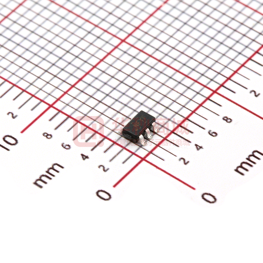

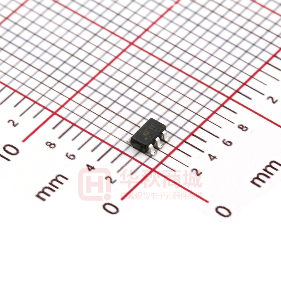

TPD4E001DBVR
TPD4E001DBVR
    BURR-BROWN(德州仪器)
    SOT23-6
    ESD抑制器/TVS二极管 VRWM=5.5V VBR(min)=11V SOT23-6
TPD4E001DBVR 数据手册
Product Folder Order Now Support & Community Tools & Software Technical Documents TPD4E001 SLLS682O – JULY 2006 – REVISED JULY 2019 TPD4E001 Low-Capacitance 4-Channel ESD-Protection for High-Speed Data Interfaces 1 Features 3 Description • The TPD4E001 is a four-channel Transient Voltage Suppressor (TVS) based Electrostatic Discharge (ESD) protection diode array. The TPD4E001 is rated to dissipate ESD strikes at the maximum level specified in the IEC 61000-4-2 international standard (Level 4). This device has a 1.5-pF IO capacitance per channel, making it ideal for use in high-speed data IO interfaces. The ultra low leakage current (< 1 nA maximum) is suitable for precision analog measurements in applications like glucose meters and heart rate monitors. 1 • • • • • • • IEC 61000-4-2 ESD Protection (Level 4) – ±8-kV Contact Discharge – ±15-kV Air-Gap Discharge 5.5-A Peak Pulse Current (8/20-µs Pulse) IO Capacitance: 1.5 pF (Typical) Low Leakage Current: 1 nA (Maximum) Low Supply Current: 1 nA 0.9-V to 5.5-V Supply-Voltage Range Space-Saving DRL, DBV, DCK, DPK, and DRS Package Options Alternate 2, 3, 6-Channel options Available: TPD2E001, TPD3E001, TPD6E001 The TPD4E001 is available in DRL(SOT), DBV (SOT23), DCK (SC-70), DRS (QFN), and DPK (PUSON) packages and is specified for –40°C to +85°C operation. See also the TPD4E1U06DCKR and TPD4E1U06DBVR which are p2p compatible with the TPD4E001DCKR and TPD4E001DBVR. These devices offer higher IEC protection, lower capacitance, lower clamping voltage, and eliminate the input capacitor requirement. 2 Applications • • • • • • USB 2.0 Ethernet FireWire™ Serial Bus LVDS SVGA Video Connections Glucose Meters Device Information(1) PART NUMBER PACKAGE SOT (6) TPD4E001 BODY SIZE (NOM) 1.60 mm × 1.20 mm 2.90 mm × 1.60 mm SC70 (6) 2.00 mm × 1.25 mm USON (6) 1.60 mm × 1.60 mm SON (6) 3.00 mm × 3.00 mm (1) For all available packages, see the orderable addendum at the end of the data sheet. Application Schematic VBUS 0.1 µF VCC D+ D– RT GND IO4 IO1 USB Controller D1 IO3 IO2 VBUS D+ GND D– GND 1 An IMPORTANT NOTICE at the end of this data sheet addresses availability, warranty, changes, use in safety-critical applications, intellectual property matters and other important disclaimers. PRODUCTION DATA. TPD4E001 SLLS682O – JULY 2006 – REVISED JULY 2019 www.ti.com Table of Contents 1 2 3 4 5 6 7 Features .................................................................. Applications ........................................................... Description ............................................................. Revision History..................................................... Pin Configuration and Functions ......................... Specifications......................................................... 1 1 1 2 4 5 6.1 6.2 6.3 6.4 6.5 6.6 6.7 5 5 5 5 6 6 7 Absolute Maximum Ratings ..................................... ESD Ratings—JEDEC Specification......................... ESD Ratings—IEC Specification .............................. Recommended Operating Conditions....................... Thermal Information .................................................. Electrical Characteristics........................................... Typical Characteristics .............................................. Detailed Description .............................................. 8 7.1 Overview ................................................................... 8 7.2 Functional Block Diagram ......................................... 8 7.3 Feature Description................................................... 8 7.4 Device Functional Modes.......................................... 8 8 Application and Implementation .......................... 9 8.1 Application Information.............................................. 9 8.2 Typical Application ................................................... 9 9 Power Supply Recommendations...................... 11 10 Layout................................................................... 11 10.1 Layout Guidelines ................................................. 11 10.2 Layout Example .................................................... 11 11 Device and Documentation Support ................. 12 11.1 11.2 11.3 11.4 11.5 11.6 11.7 Documentation Support ........................................ Related Links ........................................................ Receiving Notification of Documentation Updates Community Resources.......................................... Trademarks ........................................................... Electrostatic Discharge Caution ............................ Glossary ................................................................ 12 12 12 12 12 12 12 12 Mechanical, Packaging, and Orderable Information ........................................................... 12 4 Revision History NOTE: Page numbers for previous revisions may differ from page numbers in the current version. Changes from Revision N (March 2018) to Revision O • Added TPD4E001R DBV Package image and updated Pin Funtions table........................................................................... 4 Changes from Revision M (May 2017) to Revision N • Page Page TPD4E001DBVR Device Marking changed from NFY to NFYF ......................................................................................... 12 Changes from Revision L (May 2016) to Revision M Page • Updated Pin Functions table and DCK2 Package image....................................................................................................... 4 • Updated 'Surge Protection" to "IEC Specification" in ESD Ratings—IEC Specification table................................................ 5 Changes from Revision K (January 2015) to Revision L Page • Added frequency test condition to Channel input capacitance in the Electrical Characteristics table ................................... 6 • Added Community Resources ............................................................................................................................................. 12 Changes from Revision J (December 2013) to Revision K • Page Added Pin Configuration and Functions section, ESD Ratings table, Feature Description section, Device Functional Modes, Application and Implementation section, Power Supply Recommendations section, Layout section, Device and Documentation Support section, and Mechanical, Packaging, and Orderable Information section .............................. 1 Changes from Revision I (September 2012) to Revision J Page • Updated Description. .............................................................................................................................................................. 1 • Removed Ordering Information table. .................................................................................................................................... 4 2 Submit Documentation Feedback Copyright © 2006–2019, Texas Instruments Incorporated Product Folder Links: TPD4E001 TPD4E001 www.ti.com SLLS682O – JULY 2006 – REVISED JULY 2019 Changes from Revision H (August 2012) to Revision I Page • Added DCK2 package to Pin Out drawings. .......................................................................................................................... 4 • Updated Electrical Characteristics table................................................................................................................................. 6 Changes from Revision G (December 2011) to Revision H • Page Updated TOP-SIDE MARKING column in ORDERING INFORMATION table. ..................................................................... 4 Changes from Revision F (May 2011) to Revision G Page • Updated document formatting. ............................................................................................................................................... 1 • Added DPK (PUSON) package and package information. .................................................................................................... 4 Changes from Revision E (April 2011) to Revision F • Page Added Peak Pulse Waveform Graph to Typical Operating Characteristics. .......................................................................... 7 Changes from Revision C (April 2007) to Revision D • Page Added DBV (SOT-23) package and package information...................................................................................................... 4 Submit Documentation Feedback Copyright © 2006–2019, Texas Instruments Incorporated Product Folder Links: TPD4E001 3 TPD4E001 SLLS682O – JULY 2006 – REVISED JULY 2019 www.ti.com 5 Pin Configuration and Functions DRL Package 6-Pin SOT Top View DRS Package 6-Pin SON Top View IO1 1 6 VCC IO2 2 5 IO4 GND 3 4 IO3 IO1 1 IO2 2 6 VCC 5 IO4 4 IO3 GND GND DCK2 Package 6-Pin SC70 Top View IO1 1 6 VCC IO2 2 5 IO4 GND 3 4 IO3 DPK Package 6-Pin USON Top View DBV or DCK Package 6-Pin SOT or SC70 Top View IO1 1 6 IO4 GND 2 5 VCC IO2 3 4 IO3 3 IO1 1 6 VCC IO2 2 5 IO4 GND 3 4 IO3 TPD4E001R DBV Package 6-Pin SOT Top View IO1 1 6 IO3 VCC 2 5 GND IO2 3 4 IO4 Pin Functions PIN NAME GND IOx VCC DRS, DRL, DPK DBV, DCK TPD4E001R 3 2 5 1 1 1 2 3 3 4 4 4 5 6 6 6 5 2 Exposed thermal pad (DRS package only) 4 I/O — DESCRIPTION Ground I ESD-protected channel I Power-supply input. Bypass VCC to GND with a 0.1-μF ceramic capacitor — Exposed thermal pad. Connect to GND or leave floating Submit Documentation Feedback Copyright © 2006–2019, Texas Instruments Incorporated Product Folder Links: TPD4E001 TPD4E001 www.ti.com SLLS682O – JULY 2006 – REVISED JULY 2019 6 Specifications 6.1 Absolute Maximum Ratings over operating free-air temperature range (unless otherwise noted) (1) VCC MIN MAX UNIT –0.3 7 V –0.3 VCC + 0.3 V VI/O IO voltage tolerance I(Surge) IEC 61000-4-5 peak pulse current (TP = 8/20 µs), IOx pins 5.5 A P(Surge) IEC 61000-4-5 peak pulse power (TP = 8/20 µs), IOx pins 100 W TJ Junction temperature 150 °C Bump temperature (soldering) Infrared (15 s) 220 Vapor phase (60 s) 215 Lead temperature (soldering, 10 s) Tstg (1) Storage temperature –65 °C 300 °C 150 °C Stresses beyond those listed under Absolute Maximum Ratings may cause permanent damage to the device. These are stress ratings only, which do not imply functional operation of the device at these or any other conditions beyond those indicated under Recommended Operating Conditions. Exposure to absolute-maximum-rated conditions for extended periods may affect device reliability. 6.2 ESD Ratings—JEDEC Specification VALUE UNIT TPD4E001 in DRS, DRL, and DPK Packages Human-body model (HBM), per ANSI/ESDA/JEDEC JS-001 (1) V(ESD) Electrostatic discharge Charged-device model (CDM), per JEDEC specification JESD22-C101 (2) All pins except 1, 2, 4, and 5 ±2000 Pins 1, 2, 4, and 5 ±15000 All pins ±1000 All pins except 1, 3, 4, and 6 ±2000 Pins 1, 3, 4, and 6 ±15000 All pins ±1000 V TPD4E001 in DBV and DCK Packages V(ESD) Electrostatic discharge Human-body model (HBM), per ANSI/ESDA/JEDEC JS-001 (1) Charged-device model (CDM), per JEDEC specification JESD22-C101 (2) (1) (2) V JEDEC document JEP155 states that 500-V HBM allows safe manufacturing with a standard ESD control process. JEDEC document JEP157 states that 250-V CDM allows safe manufacturing with a standard ESD control process. 6.3 ESD Ratings—IEC Specification VALUE UNIT TPD4E001 in DRS, DRL, and DPK Packages V(ESD) Electrostatic discharge IEC 61000-4-2 contact discharge All pins ±8000 IEC 61000-4-2 air-gap discharge All pins ±15000 V TPD4E001 in DBV and DCK Packages V(ESD) Electrostatic discharge IEC 61000-4-2 contact discharge All pins ±8000 IEC 61000-4-2 air-gap discharge All pins ±15000 V 6.4 Recommended Operating Conditions over operating free-air temperature range (unless otherwise noted) TA Operating free-air temperature Operating voltage VCC pin IO1, IO2 pins MIN MAX –40 85 0.9 5.5 0 VCC Submit Documentation Feedback Copyright © 2006–2019, Texas Instruments Incorporated Product Folder Links: TPD4E001 UNIT °C V 5 TPD4E001 SLLS682O – JULY 2006 – REVISED JULY 2019 www.ti.com 6.5 Thermal Information TPD4E001 THERMAL METRIC (1) DRL (SOT) DBV (SOT) DCK (SC70) DPK (USON) DRS (SON) 6 PINS 6 PINS 6 PINS 6 PINS 6 PINS UNIT RθJA Junction-to-ambient thermal resistance 226.4 259.7 251.1 247.6 91.9 °C/W RθJC(top) Junction-to-case (top) thermal resistance 90.3 186.5 88.1 124.8 106.9 °C/W RθJB Junction-to-board thermal resistance 61.2 107.6 54.8 204.2 64.8 °C/W ψJT Junction-to-top characterization parameter 6.7 71.4 1.7 19.2 10.2 °C/W ψJB Junction-to-board characterization parameter 61 107.1 54.1 209.3 64.9 °C/W RθJC(bot) Junction-to-case (bottom) thermal resistance N/A N/A N/A N/A 29.9 °C/W (1) For more information about traditional and new thermal metrics, see the Semiconductor and IC Package Thermal Metrics application report. 6.6 Electrical Characteristics over operating free-air temperature range (unless otherwise noted), VCC = 5 V ± 10% PARAMETER TEST CONDITIONS VCC Supply voltage ICC Supply current VF Diode forward voltage IF = 10 mA VBR Breakdown Voltage IBR = 10 mA VC Channel clamp voltage MIN TYP (1) MAX 5.5 V 1 100 nA 0.95 V 0.9 0.65 11 TA = 25°C, ±15-kV HBM, IF = 10 A Positive transients TA = 25°C, ±8-kV contact discharge (IEC 61000-4-2), IF = 24 A Positive transients TA = 25°C, ±15-kV air-gap discharge (IEC 61000-4-2), IF = 45 A Positive transients Surge strike on IO pin, GND pin grounded, IPP = 5 A, 8/20 µs (2) V VCC + 25 Negative transients –25 VCC + 60 Negative transients –60 VCC + 100 Negative transients Positive transients UNIT V –100 17 VRWM Reverse stand-off voltage IO pin to GND pin 5.5 V II/O Channel leakage current Vi/o = GND to VCC ±1 nA CI/O Channel input capacitance VCC = 5 V, bias of VCC/2; ƒ = 10 MHz (1) (2) 6 1.5 pF Typical values are at VCC = 5 V and TA = 25°C. Non-repetitive current pulse 8/20 µs exponentially decaying waveform according to ICE61000-4-5. Submit Documentation Feedback Copyright © 2006–2019, Texas Instruments Incorporated Product Folder Links: TPD4E001 TPD4E001 www.ti.com SLLS682O – JULY 2006 – REVISED JULY 2019 6.7 Typical Characteristics 1000 2.20 IO Leakage Current (pA) 1.80 1.60 1.40 1.20 100 10 1.00 1 0.00 1.00 2.00 2.50 3.00 4.00 5.00 –40 25 IO Voltage (V) IPK (A) Figure 1. IO Capacitance vs IO Voltage (VCC = 5 V) 6.0 5.5 5.0 4.5 4.0 3.5 3.0 2.5 2.0 1.5 1.0 0.5 0.0 45 65 85 Temperature (°C) Figure 2. IO Leakage Current vs Temperature (VCC = 5.5 V) 100 90 80 70 Current (A) 60 50 40 PPK (W) IO Capacitance (pF) 2.00 30 Power (W) 20 10 0 5 10 15 20 25 30 Time (μs) 35 40 45 0 50 Figure 3. Peak Pulse Waveform, VCC = 5.5 V Submit Documentation Feedback Copyright © 2006–2019, Texas Instruments Incorporated Product Folder Links: TPD4E001 7 TPD4E001 SLLS682O – JULY 2006 – REVISED JULY 2019 www.ti.com 7 Detailed Description 7.1 Overview The TPD4E001 is a four-channel transient voltage suppressor (TVS) based ESD protection diode array. The TPD4E001 is rated to dissipate ESD strikes at the maximum level specified in the IEC 61000-4-2 international standard (Level 4). This device has a 1.5-pF IO capacitance per channel, making it ideal for use in high-speed data IO interfaces. The ultra-low leakage current (
