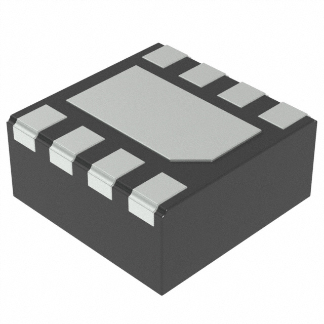

    TPS22965-Q1 具有可调节上升时间和输出放电功能的单通道、5.7V、4A、16mΩ 汽车负载开关
TPS22965NQWDSGRQ1 数据手册
TPS22965-Q1 SLVSCI3E – APRIL 2014 – REVISED JULY 2022 TPS22965x-Q1 5.5-V, 4-A, 16-mΩ On-Resistance Automotive Load Switch 1 Features 3 Description • The TPS22965x-Q1 is a small, ultra-low-RON, singlechannel load switch with controlled turn-on. The device contains an N-channel MOSFET that can operate over an input voltage range of 0.8 V to 5.5 V and can support a maximum continuous current of 4 A. The VOUT rise time is configurable so that inrush current can be reduced. The TPS22965-Q1 and TPS22965W-Q1 devices include a 225-Ω on-chip load resistor for quick output discharge when the switch is turned off. • • • • • • • • • Device Information (1) PART NUMBER PACKAGE TPS22965-Q1 2.00 mm × 2.00 mm TPS22965W-Q1 Automotive electronics Infotainment ADAS (Advanced Driver Assistance Systems) DSG0008B WSON (8) TPS22965NW-Q1 (1) BODY SIZE (NOM) DSG0008A WSON (8) TPS22965N-Q1 2 Applications • • • The TPS22965x-Q1 devices are available in a small, space-saving 2-mm × 2-mm 8-pin WSON package (DSG0008A) with integrated thermal pad allowing for high power dissipation. The TPS22965Q1 and TPS22965N-Q1 devices are characterized for operation over the free-air temperature range of –40°C to 105°C. Furthermore, the TPS22965WQ1 and TPS22965NW-Q1 devices feature wettable flanks in the same WSON package (DSG0008B) and it is characterized for operation over the free-air temperature range of –40°C to +125°C. For all available packages, see the orderable addendum at the end of the data sheet. 40 40qC 25qC 105qC 125qC VOUT VIN Power Supply 35 CIN ON ON CL 30 RL CT OFF GND GND VBIAS TPS22965x-Q1 Simplified Schematic RON (m:) • Qualified for automotive applications – AEC-Q100 qualified – Device temperature grade 2: –40°C to +105°C (TPS22965-Q1, TPS22965N-Q1) – Device temperature grade 1: –40°C to +125°C (TPS22965W-Q1, TPS22965NW-Q1) – Device HBM ESD classification level 3A – Device CDM ESD classification level C6 Functional Safety-Capable – Documentation available to aid functional safety system design Integrated single channel load switch Input voltage range: 0.8 V to 5.5 V Ultra-low on resistance (RON) – RON = 16 mΩ at VIN = 5 V (VBIAS = 5 V) – RON = 16 mΩ at VIN = 3.6 V (VBIAS = 5 V) – RON = 16 mΩ at VIN = 1.8 V (VBIAS = 5 V) 4-A maximum continuous switch current Low quiescent current (50 µA) Low control input threshold enables use of 1.2-, 1.8-, 2.5- and 3.3-V logic Configurable rise time Quick Output Discharge (QOD) (TPS22965-Q1 and TPS22965W-Q1 only) WSON 8-pin package with thermal pad 25 20 15 10 5 0 0 0.5 1 1.5 2 2.5 3 VIN (V) 3.5 4 4.5 5 5.5 D008 RON vs VIN (VBIAS = 5 V, IOUT = –200 mA) An IMPORTANT NOTICE at the end of this data sheet addresses availability, warranty, changes, use in safety-critical applications, intellectual property matters and other important disclaimers. PRODUCTION DATA. TPS22965-Q1 www.ti.com SLVSCI3E – APRIL 2014 – REVISED JULY 2022 Table of Contents 1 Features............................................................................1 2 Applications..................................................................... 1 3 Description.......................................................................1 4 Revision History.............................................................. 2 5 Device Comparison Table...............................................3 6 Pin Configuration and Functions...................................3 7 Specifications.................................................................. 4 7.1 Absolute Maximum Ratings........................................ 4 7.2 ESD Ratings............................................................... 4 7.3 Recommended Operating Conditions.........................4 7.4 Thermal Information....................................................5 7.5 Electrical Characteristics—VBIAS = 5 V....................... 5 7.6 Electrical Characteristics—VBIAS = 2.5 V.................... 7 7.7 Switching Characteristics............................................9 7.8 Typical Characteristics.............................................. 10 8 Parameter Measurement Information.......................... 15 9 Detailed Description......................................................16 9.1 Overview................................................................... 16 9.2 Functional Block Diagram......................................... 16 9.3 Feature Description...................................................17 9.4 Device Functional Modes..........................................17 10 Application and Implementation................................ 18 10.1 Application Information........................................... 18 10.2 Typical Application.................................................. 19 11 Power Supply Recommendations..............................21 12 Layout...........................................................................21 12.1 Layout Guidelines................................................... 21 12.2 Layout Example...................................................... 21 12.3 Thermal Consideration............................................21 13 Device and Documentation Support..........................22 13.1 Documentation Support.......................................... 22 13.2 Receiving Notification of Documentation Updates..22 13.3 Support Resources................................................. 22 13.4 Trademarks............................................................. 22 13.5 Electrostatic Discharge Caution..............................22 13.6 Glossary..................................................................22 14 Mechanical, Packaging, and Orderable Information.................................................................... 22 4 Revision History NOTE: Page numbers for previous revisions may differ from page numbers in the current version. Changes from Revision D (December 2019) to Revision E (July 2022) Page • Updated the numbering format for tables, figures and cross-references throughout the document ..................1 • Added the word “Automotive” to the document title ...........................................................................................1 • Updated the ESD Ratings table for automotive devices.....................................................................................4 • Added line item in the Recommended Operating Conditions table for VIL voltage at VBIAS = 2 V to 2.5 V......4 • Added line item in Electrical Characteristics—VBIAS = 2 V to 2.5 V for QOD resistance at VBIAS = 2 V........... 7 • Expanded VBIAS minimum rating from 2.5 V to 2 V.......................................................................................... 7 Changes from Revision C (September 2016) to Revision D (December 2019) Page • Added Functional safety capable link to the Features section ...........................................................................1 Changes from Revision B (December 2015) to Revision C (September 2016) Page • Added package designators in the Description section and Thermal Information table..................................... 1 Changes from Revision A (June 2015) to Revision B (December 2015) Page • Updated status of TPS22965W-Q1 part to ACTIVE........................................................................................... 1 • Added 125°C temperature performance to typical AC timing parameters........................................................12 Changes from Revision * (April 2014) to Revision A (June 2015) Page • Added TPS22965N-Q1 part number. .................................................................................................................1 • Updated Thermal Information table.................................................................................................................... 5 • Updated typical AC timing parameters (tables, graphs and scope captures) ..................................................12 2 Submit Document Feedback Copyright © 2022 Texas Instruments Incorporated Product Folder Links: TPS22965-Q1 TPS22965-Q1 www.ti.com SLVSCI3E – APRIL 2014 – REVISED JULY 2022 5 Device Comparison Table DEVICE RON AT 3.3 V (TYP) QUICK OUTPUT DISCHARGE PACKAGE WITH WETTABLE FLANKS MAXIMUM OUTPUT CURRENT TEMPERATURE RANGE TPS22965-Q1 16 mΩ Yes No 4A –40°C to +105°C TPS22965N-Q1 16 mΩ No No 4A –40°C to +105°C TPS22965W-Q1 16 mΩ Yes Yes 4A –40°C to +125°C TPS22965NW-Q1 16 mΩ No Yes 4A –40°C to +125°C 6 Pin Configuration and Functions VIN 1 VIN 2 8 VOUT 7 VOUT 6 CT 5 GND Thermal ON 3 VBIAS 4 Pad Figure 6-1. DSG Package 8-Pin WSON with Exposed Thermal Pad Top View Table 6-1. Pin Functions PIN I/O DESCRIPTION VIN I Switch input. Input bypass capacitor recommended for minimizing VIN dip. Must be connected to Pin 1 and Pin 2. See the Application and Implementation section for more information 3 ON I Active high switch control input. Do not leave floating 4 VBIAS I Bias voltage. Power supply to the device. Recommended voltage range for this pin is 2 V to 5.5 V. See the Application and Implementation section for more information 5 GND — Device ground 6 CT O Switch slew rate control. Can be left floating. See the Application and Implementation section for more information VOUT O Switch output Thermal pad — Thermal pad (exposed center pad) to alleviate thermal stress. Tie to GND. See the Layout section for layout guidelines NO. 1 2 7 8 — NAME Submit Document Feedback Copyright © 2022 Texas Instruments Incorporated Product Folder Links: TPS22965-Q1 3 TPS22965-Q1 www.ti.com SLVSCI3E – APRIL 2014 – REVISED JULY 2022 7 Specifications 7.1 Absolute Maximum Ratings over operating free-air temperature range (unless otherwise noted)(1) (2) MIN MAX UNIT (2) VIN Input voltage –0.3 6 V VOUT Output voltage –0.3 6 V VBIAS Bias voltage –0.3 6 V VON On voltage –0.3 6 V IMAX Maximum continuous switch current 4 A IPLS Maximum pulsed switch current, pulse < 300 µs, 2% duty cycle TJ Maximum junction temperature TSTG Storage temperature (1) (2) –65 6 A 150 °C 150 °C Stresses beyond those listed under Absolute Maximum Ratings may cause permanent damage to the device. These are stress ratings only, which do not imply functional operation of the device at these or any other conditions beyond those indicated under Recommended Operating Conditions. Exposure to absolute-maximum-rated conditions for extended periods may affect device reliability. All voltage values are with respect to network ground pin. 7.2 ESD Ratings VALUE Human body model (HBM), per AEC Q100- 002 HBM classification level 3A V(ESD) (1) Electrostatic discharge UNIT (1) Charged device model (CDM), per AEC Q100- 011 CDM classification level C6 ±4000 V ±1500 AEC Q100-002 indicates that HBM stressing shall be in accordance with the ANSI/ESDA/JEDEC JS-001 specification. 7.3 Recommended Operating Conditions over operating free-air temperature range (unless otherwise noted) MIN MAX UNIT VIN Input voltage 0.8 VBIAS V VBIAS Bias voltage 2 5.5 V VON ON voltage 0 5.5 V VOUT Output voltage VIH High-level input voltage, ON VIL Low-level input voltage, ON CIN Input capacitor TA Operating free-air temperature (2) (1) (2) 4 VIN V VBIAS = 2.5 V to 5.5 V 1.2 5.5 V VBIAS = 2.5 V to 5.5 V 0 0.5 V 0 0.45 VBIAS = 2 V to 2.5 V 1 (1) V µF TPS22965N-Q1, TPS22965-Q1 –40 105 TPS22965NW-Q1, TPS22965W-Q1 –40 125 °C See the Application and Implementation section. In applications where high power dissipation, poor package thermal resistance is present, the maximum ambient temperature can be derated. Maximum ambient temperature [TA(max)] is dependent on the maximum operating junction temperature [TJ(max)], the maximum power dissipation of the device in the application [PD(max)], and the junction-to-ambient thermal resistance of the part, package in the application (RJθA), as given by the following equation: TA(max) = TJ(max) – (RθJA × PD(max)). Submit Document Feedback Copyright © 2022 Texas Instruments Incorporated Product Folder Links: TPS22965-Q1 TPS22965-Q1 www.ti.com SLVSCI3E – APRIL 2014 – REVISED JULY 2022 7.4 Thermal Information TPS22965-Q1, TPS22965N-Q1 TPS22965W-Q1, TPS22965NW-Q1 DSG0008A (WSON) DSG0008B (WSON) THERMAL METRIC(1) UNIT 8 PINS 8 PINS RθJA Junction-to-ambient thermal resistance 72.3 67.6 °C/W RθJC(top) Junction-to-case (top) thermal resistance 96.1 95 °C/W RθJB Junction-to-board thermal resistance 42.1 37.4 °C/W ψJT Junction-to-top characterization parameter 3.3 2.9 °C/W ψJB Junction-to-board characterization parameter 42.5 37.7 °C/W RθJC(bot) Junction-to-case (bottom) thermal resistance 13.2 8 °C/W (1) For more information about traditional and new thermal metrics, see the Semiconductor and IC Package Thermal Metrics application report. 7.5 Electrical Characteristics—VBIAS = 5 V Unless otherwise noted, the specification in the following table applies over the operating ambient temperature: –40°C ≤ TA ≤ +105°C (TPS22965N-Q1, TPS22965-Q1), –40°C ≤ TA ≤ +125°C (TPS22965NW-Q1, TPS22965W-Q1). Typical values are for TA = 25°C. PARAMETER TEST CONDITIONS TA MIN TYP MAX UNIT POWER SUPPLIES AND CURRENTS IQ VBIAS VBIAS quiescent current IOUT = 0 mA, VIN = VON = VBIAS = 5 V ISD VBIAS VBIAS shutdown current VON = GND, VOUT = 0 V VIN = 5 V ISD VIN VIN off-state supply current VON = GND, VOUT = 0 V VIN = 3.3 V VIN = 1.8 V VIN = 0.8 V ION ON pin input leakage current VON = 5.5 V –40°C to +105°C 50 75 –40°C to +125°C 50 75 –40°C to +105°C 2 –40°C to +125°C 2 –40°C to +105°C 0.2 –40°C to +125°C –40°C to +105°C 8 3 13 0.01 –40°C to +125°C –40°C to +105°C µA 36 0.02 –40°C to +125°C –40°C to +105°C µA 2 µA 6 0.005 1 –40°C to +125°C 4 –40°C to +105°C 0.5 –40°C to +125°C 0.5 µA Submit Document Feedback Copyright © 2022 Texas Instruments Incorporated Product Folder Links: TPS22965-Q1 5 TPS22965-Q1 www.ti.com SLVSCI3E – APRIL 2014 – REVISED JULY 2022 7.5 Electrical Characteristics—VBIAS = 5 V (continued) Unless otherwise noted, the specification in the following table applies over the operating ambient temperature: –40°C ≤ TA ≤ +105°C (TPS22965N-Q1, TPS22965-Q1), –40°C ≤ TA ≤ +125°C (TPS22965NW-Q1, TPS22965W-Q1). Typical values are for TA = 25°C. PARAMETER TEST CONDITIONS TA MIN TYP MAX UNIT RESISTANCE CHARACTERISTICS 25°C VIN = 5 V 16 –40°C to +105°C 965N-Q1, 965-Q1 25 –40°C to +105°C 965NW-Q1, 965W-Q1 26 mΩ –40°C to +125°C 25°C VIN = 3.3 V RON ON-state resistance 28 16 25 –40°C to +105°C 965NW-Q1, 965W-Q1 26 –40°C to +125°C 27 mΩ 16 25 –40°C to +105°C 965NW-Q1, 965W-Q1 26 25°C VIN = 1.5 V mΩ 27 16 25 –40°C to +105°C 965NW-Q1, 965W-Q1 26 25°C mΩ 27 16 25 –40°C to +105°C 965NW-Q1, 965W-Q1 26 25°C RPD (1) (1) 6 Output pulldown resistance VIN = 5 V, VON = 0 V, IOUT = 1 mA 23 –40°C to +105°C 965N-Q1, 965-Q1 mΩ –40°C to +125°C VIN = 0.8 V 23 –40°C to +105°C 965N-Q1, 965-Q1 –40°C to +125°C VIN = 1.2 V 23 –40°C to +105°C 965N-Q1, 965-Q1 –40°C to +125°C IOUT = –200 mA, VBIAS = 5 V 23 –40°C to +105°C 965N-Q1, 965-Q1 25°C VIN = 1.8 V 23 27 16 23 –40°C to +105°C 965N-Q1, 965-Q1 25 –40°C to +105°C 965NW-Q1, 965W-Q1 26 –40°C to +125°C 27 mΩ –40°C to +105°C 225 300 –40°C to +125°C 225 300 Ω TPS22965-Q1 and TPS22965W-Q1 only. Submit Document Feedback Copyright © 2022 Texas Instruments Incorporated Product Folder Links: TPS22965-Q1 TPS22965-Q1 www.ti.com SLVSCI3E – APRIL 2014 – REVISED JULY 2022 7.6 Electrical Characteristics—VBIAS = 2.5 V Unless otherwise noted, the specification in the following table applies over the operating ambient temperature: –40°C ≤ TA ≤ +105°C (TPS22965N-Q1, TPS22965-Q1), –40°C ≤ TA ≤ +125°C (TPS22965NW-Q1, TPS22965W-Q1). Typical values are for TA = 25°C. PARAMETER TEST CONDITIONS TA MIN TYP MAX UNIT POWER SUPPLIES AND CURRENTS IQ VBIAS VBIAS quiescent current IOUT = 0 mA, VIN = VON = VBIAS = 2.5 V ISD VBIAS VBIAS shutdown current VON = GND, VOUT = 0 V VIN = 2.5 V ISD VIN VIN off-state supply current VON = GND, VOUT = 0 V VIN = 1.8 V VIN = 1.2 V VIN = 0.8 V ION ON pin input leakage current VON = 5.5 V –40°C to +105°C 20 30 –40°C to 125°C 20 30 –40°C to +105°C 2 –40°C to 125°C 2 –40°C to +105°C 0.01 –40°C to 125°C –40°C to +105°C 3 2 6 0.005 –40°C to 125°C –40°C to +105°C µA 13 0.01 –40°C to 125°C –40°C to +105°C µA 2 µA 6 0.003 1 –40°C to 125°C 4 –40°C to +105°C 0.5 –40°C to +125°C 0.5 µA RESISTANCE CHARACTERISTICS Submit Document Feedback Copyright © 2022 Texas Instruments Incorporated Product Folder Links: TPS22965-Q1 7 TPS22965-Q1 www.ti.com SLVSCI3E – APRIL 2014 – REVISED JULY 2022 7.6 Electrical Characteristics—VBIAS = 2.5 V (continued) Unless otherwise noted, the specification in the following table applies over the operating ambient temperature: –40°C ≤ TA ≤ +105°C (TPS22965N-Q1, TPS22965-Q1), –40°C ≤ TA ≤ +125°C (TPS22965NW-Q1, TPS22965W-Q1). Typical values are for TA = 25°C. PARAMETER TEST CONDITIONS TA MIN 25°C VIN = 2.5 V 20 28 –40°C to 105°C 965NW-Q1, 965W-Q1 32 –40°C to +125°C 34 mΩ 19 28 –40°C to +105°C 965NW-Q1, 965W-Q1 30 25°C RON ON-state resistance VIN = 1.5 V mΩ 32 18 27 –40°C to +105°C 965NW-Q1/965W-Q1 29 25°C mΩ RPD (1) (1) 8 Output pulldown resistance VBIAS = VIN = 2.5 V, VON = 0 V, IOUT = 1 mA VBIAS = VIN = 2 V, VON = 0 V, IOUT = 1 mA 31 18 25 –40°C to +105°C 965N-Q1, 965-Q1 27 –40°C to +105°C 965NW-Q1, 965W-Q1 28 –40°C to +125°C 30 25°C VIN = 0.8 V 25 –40°C to +105°C 965N-Q1, 965-Q1 –40°C to +125°C VIN = 1.2 V 26 –40°C to +105°C 965N-Q1, 965-Q1 –40°C to +125°C IOUT = –200 mA, VBIAS = 2.5 V 26 –40°C to +105°C 965N-Q1, 965-Q1 25°C VIN = 1.8 V TYP MAX UNIT mΩ 17 25 –40°C to +105°C 965N-Q1, 965-Q1 27 –40°C to +105°C 965NW-Q1, 965W-Q1 28 –40°C to +125°C 30 –40°C to +105°C mΩ 275 –40°C to +125°C –40°C to +125°C 325 330 310 470 Ω Ω TPS22965-Q1 and TPS22965W-Q1 only. Submit Document Feedback Copyright © 2022 Texas Instruments Incorporated Product Folder Links: TPS22965-Q1 TPS22965-Q1 www.ti.com SLVSCI3E – APRIL 2014 – REVISED JULY 2022 7.7 Switching Characteristics Over operating free-air temperature range (unless otherwise noted). These switching characteristics are only valid for the power-up sequence where VIN and VBIAS are already in steady state condition before the ON pin is asserted high. PARAMETER TEST CONDITIONS MIN TYP MAX UNIT VIN = VON = VBIAS = 5 V, TA = 25°C (unless otherwise noted) tON Turn-on time RL = 10 Ω, CL = 0.1 µF, CT = 1000 pF, CIN = 1 µF 1600 µs tOFF Turn-off time RL = 10 Ω, CL = 0.1 µF, CT = 1000 pF, CIN = 1 µF 9 µs tR VOUT rise time RL = 10 Ω, CL = 0.1 µF, CT = 1000 pF, CIN = 1 µF 1985 µs tF VOUT fall time RL = 10 Ω, CL = 0.1 µF, CT = 1000 pF, CIN = 1 µF 3 µs tD ON delay time RL = 10 Ω, CL = 0.1 µF, CT = 1000 pF, CIN = 1 µF 660 µs VIN = 0.8 V, VON = VBIAS = 5 V, TA = 25°C (unless otherwise noted) tON Turn-on time RL = 10 Ω, CL = 0.1 µF, CT = 1000 pF, CIN = 1 µF 730 µs tOFF Turn-off time RL = 10 Ω, CL = 0.1 µF, CT = 1000 pF, CIN = 1 µF 100 µs tR VOUT rise time RL = 10 Ω, CL = 0.1 µF, CT = 1000 pF, CIN = 1 µF 380 µs tF VOUT fall time RL = 10 Ω, CL = 0.1 µF, CT = 1000 pF, CIN = 1 µF 8 µs tD ON delay time RL = 10 Ω, CL = 0.1 µF, CT = 1000 pF, CIN = 1 µF 560 µs VIN = 2.5 V, VON = 5 V, VBIAS = 2.5 V, TA = 25°C (unless otherwise noted) tON Turn-on time RL = 10 Ω, CL = 0.1 µF, CT = 1000 pF, CIN = 1 µF 2435 µs tOFF Turn-off time RL = 10 Ω, CL = 0.1 µF, CT = 1000 pF, CIN = 1 µF 9 µs tR VOUT rise time RL = 10 Ω, CL = 0.1 µF, CT = 1000 pF, CIN = 1 µF 2515 µs tF VOUT fall time RL = 10 Ω, CL = 0.1 µF, CT = 1000 pF, CIN = 1 µF 4 µs tD ON delay time RL = 10 Ω, CL = 0.1 µF, CT = 1000 pF, CIN = 1 µF 1230 µs VIN = 0.8 V, VON = 5 V, VBIAS = 2.5 V, TA = 25°C (unless otherwise noted) tON Turn-on time RL = 10 Ω, CL = 0.1 µF, CT = 1000 pF, CIN = 1 µF 1565 µs tOFF Turn-off time RL = 10 Ω, CL = 0.1 µF, CT = 1000 pF, CIN = 1 µF 70 µs tR VOUT rise time RL = 10 Ω, CL = 0.1 µF, CT = 1000 pF, CIN = 1 µF 930 µs tF VOUT fall time RL = 10 Ω, CL = 0.1 µF, CT = 1000 pF, CIN = 1 µF 8 µs tD ON delay time RL = 10 Ω, CL = 0.1 µF, CT = 1000 pF, CIN = 1 µF 1110 µs Submit Document Feedback Copyright © 2022 Texas Instruments Incorporated Product Folder Links: TPS22965-Q1 9 TPS22965-Q1 www.ti.com SLVSCI3E – APRIL 2014 – REVISED JULY 2022 7.8 Typical Characteristics 7.8.1 Typical DC Characteristics TA = 125°C data is only applicable to TPS22965NW-Q1 and TPS22965W-Q1. 70 100 40qC 25qC 105qC 125qC 60 80 70 IO VBIAS (PA) IO VBIAS (PA) 50 40qC 25qC 105qC 125qC 90 40 30 60 50 40 30 20 20 10 10 0 0 2 2.5 3 3.5 4 4.5 5 5.5 VBIAS (V) VIN = 1.8 V 6 0 0.5 1 VON = 5 V VOUT = 0 V 2 2.5 VBIAS = 5 V Figure 7-1. VBIAS Quiescent Current vs VBIAS 3 3.5 VIN (V) 4 4.5 5 5.5 6 D002 VON = 5 V VOUT = 0 V Figure 7-2. IQ VBIAS vs VIN 0.9 5 40qC 25qC 105qC 125qC 0.8 0.7 40qC 25qC 105qC 125qC 4 0.6 3 ISD VIN (PA) ISD VBIAS (PA) 1.5 D001 0.5 0.4 0.3 2 1 0.2 0 0.1 0 -1 2 2.5 3 3.5 4 4.5 VBIAS (V) VIN = 5 V 5 5.5 6 0 0.5 VON = 0 V VOUT = 0 V 1.5 VBIAS = 5 V Figure 7-3. ISD VBIAS vs VBIAS 2 2.5 3 VIN (V) 3.5 4 4.5 5 5.5 D004 VON = 0 V VOUT = 0 V Figure 7-4. ISD VIN vs VIN 40 40 35 1 D003 VIN = 0.8 V VIN = 1.8 V VIN = 2.5 V VIN = 0.8 V VIN = 3.3 V VIN = 5 V 35 30 25 RON (m:) RON (m:) 30 20 15 25 20 10 15 5 0 -50 0 VBIAS = 2.5 V 50 Temperature (qC) 100 150 0 D005 IOUT = –200 mA VON = 5.5 V All three RON curves have the same values and hence only one line is visible. Figure 7-5. RON vs Ambient Temperature 10 10 -50 50 Temperature (qC) 100 150 D006 VBIAS = 5 V IOUT = –200 mA VON = 5.5 V Note: All three RON curves have the same values; therefore, only one line is visible. Figure 7-6. RON vs Ambient Temperature Submit Document Feedback Copyright © 2022 Texas Instruments Incorporated Product Folder Links: TPS22965-Q1 TPS22965-Q1 www.ti.com SLVSCI3E – APRIL 2014 – REVISED JULY 2022 7.8.1 Typical DC Characteristics (continued) 40 40 40qC 25qC 105qC 125qC 35 30 25 RON (m:) RON (m:) 30 40qC 25qC 105qC 125qC 35 20 15 10 25 20 15 10 5 5 0 0 0 0.5 1 VBIAS = 2.5 V 1.5 VIN (V) 2 2.5 3 0 0.5 1 1.5 2 2.5 3 VIN (V) D007 IOUT = –200 mA VON = 5.5 V VBIAS = 5 V Figure 7-7. RON vs VIN 3.5 4 4.5 5 5.5 D008 IOUT = –200 mA VON = 5.5 V Figure 7-8. RON vs VIN 320 300 VIN = 1.8V 22 VIN = 2.5V 20 280 VIN = 3.3V RPD (:) RON (mŸ) 40qC 25qC 105qC 125qC VIN = 0.8V 24 18 16 260 240 14 220 12 200 10 2 2.5 3 3.5 4 4.5 5 5.5 VBIAS (V) TA = 25°C 2 6 2.5 VON = 5.5 V 4 4.5 VBIAS (V) 5 5.5 6 D011 VON = 0 V Figure 7-10. RPD vs VBIAS Figure 7-9. RON vs VBIAS 2.5 30 -40ƒC 28 2 25ƒC 26 105ƒC 24 RON (mŸ) 1.5 VOUT (V) 3.5 VIN = 1.8 V C001 IOUT = –200 mA 3 1 VBIAS = 2.5V 0.5 20 18 16 VBIAS = 3.3V 0 22 14 VBIAS = 5V 12 VBIAS = 5.5V -0.5 10 0.5 0.6 0.7 0.8 0.9 1 1.1 VON (V) VIN = 2 V TA = 25°C 1.2 1.3 1.4 1.5 0 0.5 1 1.5 2 VIN (V) C001 VBIAS = 2.5 V Figure 7-11. VOUT vs VON IOUT = –4 A 2.5 3 C001 VON = 5.5 V Figure 7-12. RON vs VIN Submit Document Feedback Copyright © 2022 Texas Instruments Incorporated Product Folder Links: TPS22965-Q1 11 TPS22965-Q1 www.ti.com SLVSCI3E – APRIL 2014 – REVISED JULY 2022 7.8.1 Typical DC Characteristics (continued) 30 -40ƒC 28 25ƒC 26 105ƒC RON (mŸ) 24 22 20 18 16 14 12 10 0 1 2 3 4 5 6 VIN (V) VBIAS = 5 V C001 IOUT = –4 A VON = 5.5 V Figure 7-13. RON vs VIN 7.8.2 Typical Switching Characteristics TA = 25°C, CT = 1000 pF, CIN = 1 µF, CL = 0.1 µF, RL = 10 Ω (unless otherwise specified). TA = 125°C data is only applicable to TPS22965NW-Q1 and TPS22965W-Q1. 1600 900 -40°C -40°C 1400 25°C 105°C 700 105°C 125°C tD (µs) tD (µs) 1200 25°C 800 1000 800 125°C 600 500 400 600 300 400 200 0.0 0.5 1.0 1.5 2.0 2.5 VIN (V) VBIAS = 2.5 V 3.0 0.0 1.0 2.0 3.0 4.0 CT = 1000 pF VBIAS = 5 V Figure 7-14. tD vs VIN C001 CT = 1000 pF 12 -40°C -40°C 25°C 10 25°C 10 105°C 105°C 8 8 125°C tF (µs) tF (µs) 6.0 Figure 7-15. tD vs VIN 12 6 125°C 6 4 4 2 2 0 0 0.0 0.5 1.0 1.5 VIN (V) VBIAS = 2.5 V CT = 1000 pF 2.0 2.5 3.0 0.0 1.0 2.0 3.0 VIN (V) C001 VBIAS = 5 V Figure 7-16. tF vs VIN 12 5.0 VIN (V) C001 4.0 5.0 6.0 C001 CT = 1000 pF Figure 7-17. tF vs VIN Submit Document Feedback Copyright © 2022 Texas Instruments Incorporated Product Folder Links: TPS22965-Q1 TPS22965-Q1 www.ti.com SLVSCI3E – APRIL 2014 – REVISED JULY 2022 7.8.2 Typical Switching Characteristics (continued) 160 120 -40°C 25°C 105°C 120 105°C 125°C 100 125°C tOFF (µs) 80 tOFF (µs) -40°C 140 25°C 100 60 80 60 40 40 20 20 0 0 0.0 0.5 1.0 1.5 2.0 2.5 0.0 3.0 VIN (V) 1.0 3.0 4.0 5.0 6.0 VIN (V) VBIAS = 2.5 V CT = 1000 pF Note: The 105°C and 125°C curves have similar values; therefore, only one line is visible. C001 VBIAS = 5 V CT = 1000 pF Note: The 105°C and 125°C curves have similar values; therefore, only one line is visible. Figure 7-18. tOFF vs VIN Figure 7-19. tOFF vs VIN 3500 2000 -40°C 3000 25°C 2500 105°C 25°C 1600 105°C 1400 125°C 2000 -40°C 1800 tON (µs) tON (µs) 2.0 C001 1500 125°C 1200 1000 800 600 1000 400 500 200 0 0 0.0 0.5 1.0 1.5 2.0 2.5 VIN (V) VBIAS = 2.5 V 3.0 0.0 1.0 3.0 4.0 5.0 VIN (V) CT = 1000 pF VBIAS = 5 V Figure 7-20. tON vs VIN 6.0 C001 CT = 1000 pF Figure 7-21. tON vs VIN 2500 3500 -40°C 3000 25°C 2500 105°C -40°C 105°C 125°C 2000 25°C 2000 tR (µs) tR (µs) 2.0 C001 1500 125°C 1500 1000 1000 500 500 0 0 0.0 0.5 1.0 1.5 VIN (V) 2.0 2.5 3.0 0.0 VBIAS = 2.5 V CT = 1000 pF Note: The 105°C and 125°C curves have similar values; therefore, only one line is visible. 1.0 2.0 3.0 4.0 5.0 VIN (V) C001 6.0 C001 VBIAS = 5 V CT = 1000 pF Note: The 105°C and 125°C curves have similar values; therefore, only one line is visible. Figure 7-22. tR vs VIN Figure 7-23. tR vs VIN Submit Document Feedback Copyright © 2022 Texas Instruments Incorporated Product Folder Links: TPS22965-Q1 13 TPS22965-Q1 www.ti.com SLVSCI3E – APRIL 2014 – REVISED JULY 2022 7.8.2 Typical Switching Characteristics (continued) VIN = 0.8 V CL = 0.1 µF VBIAS = 2.5 V RL = 10 Ω CIN = 1 µF CT = 1000 pF Figure 7-24. Turn-On Response Time VIN = 2.5 V CL = 0.1 µF VBIAS = 2.5 V RL = 10 Ω CIN = 1 µF, CT = 1000 pF VBIAS = 2.5 V RL = 10 Ω 14 CIN = 1 µF CT = 1000 pF VIN = 5 V CL = 0.1 µF VBIAS = 5 V RL = 10 Ω CIN = 1 µF Figure 7-27. Turn-On Response Time CIN = 1 µF Figure 7-28. Turn-Off Response Time VBIAS = 5 V RL = 10 Ω Figure 7-25. Turn-On Response Time Figure 7-26. Turn-On Response Time VIN = 0.8 V CL = 0.1 µF VIN = 0.8 V CL = 0.1 µF VIN = 0.8 V CL = 0.1 µF VBIAS = 5 V RL = 10 Ω CIN = 1 µF Figure 7-29. Turn-Off Response Time Submit Document Feedback Copyright © 2022 Texas Instruments Incorporated Product Folder Links: TPS22965-Q1 TPS22965-Q1 www.ti.com SLVSCI3E – APRIL 2014 – REVISED JULY 2022 7.8.2 Typical Switching Characteristics (continued) VIN = 2.5 V CL = 0.1 µF VBIAS = 2.5 V RL = 10 Ω CIN = 1 µF VIN = 5 V CL = 0.1 µF Figure 7-30. Turn-Off Response Time VBIAS = 5 V RL = 10 Ω) CIN = 1 µF Figure 7-31. Turn-Off Response Time 8 Parameter Measurement Information VIN VOUT CIN = 1 µF ON + – (A) OFF CT ON CL RL VBIAS TPS22965x-Q1 GND GND A. GND Rise and fall times of the control signal are 100 ns. Figure 8-1. Test Circuit VON 50% 50% tOFF tON VOUT 50% 50% tF tR 90% VOUT 10% 10% 90% 10% tD Figure 8-2. tON and tOFF Waveforms Submit Document Feedback Copyright © 2022 Texas Instruments Incorporated Product Folder Links: TPS22965-Q1 15 TPS22965-Q1 www.ti.com SLVSCI3E – APRIL 2014 – REVISED JULY 2022 9 Detailed Description 9.1 Overview The TPS22965x-Q1 is a single-channel, 4-A load switch in an 8-pin WSON package. To reduce the voltage drop in high current rails, the device implements an ultra-low resistance N-channel MOSFET. The device has a programmable slew rate for applications that require specific rise time. The device has very low leakage current during OFF state. This low leakage prevents downstream circuits from pulling high standby current from the supply. Integrated control logic, driver, power supply, and output discharge FET eliminates the need for any external components, which reduces solution size and BOM count. 9.2 Functional Block Diagram VIN Charge Pump VBIAS ON Control Logic CT VOUT TPS22965-Q1 and TPS22965W-Q1 Only GND 16 Submit Document Feedback Copyright © 2022 Texas Instruments Incorporated Product Folder Links: TPS22965-Q1 TPS22965-Q1 www.ti.com SLVSCI3E – APRIL 2014 – REVISED JULY 2022 9.3 Feature Description 9.3.1 Adjustable Rise Time A capacitor to GND on the CT pin sets the slew rate. The voltage on the CT pin can be as high as 12 V. Therefore, the minimum voltage rating for the CT cap must be 25 V for optimal performance. The below equations shows an approximate formula for the relationship between CT and slew rate when VBIAS is set to 5 V. This equation accounts for 10% to 90% measurement on VOUT and does not apply for CT = 0 pF. Use the below equation to determine rise times for when CT = 0 pF. SR = 0.38 ´ CT + 34 (1) where • • • SR = slew rate (in µs/V). CT = the capacitance value on the CT pin (in pF). The units for the constant 34 are µs/V. The units for the constant 0.38 are µs/(V × pF). Rise time can be calculated by multiplying the input voltage by the slew rate. Table 9-1 contains rise time values measured on a typical device. The rise times listed in Table 9-1 are only valid for the power-up sequence where VIN and VBIAS are already in steady state condition before the ON pin is asserted high. Table 9-1. Rise Time vs CT Capacitor CT (pF) (1) RISE TIME (µs) 10% - 90%, CL = 0.1 µF, CIN = 1 µF, RL = 10 Ω, VBIAS = 5 V (1) VIN = 5 V VIN = 3.3 V VIN = 1.8 V VIN = 1.5 V VIN = 1.2 V VIN = 1.05 V VIN = 0.8 V 0 180 136 94 84 74 70 60 220 547 378 232 202 173 157 129 470 962 654 386 333 282 252 206 1000 1983 1330 765 647 533 476 382 2200 4013 2693 1537 1310 1077 959 766 4700 8207 5490 3137 2693 2200 1970 1590 10000 17700 11767 6697 5683 4657 4151 3350 Typical Values at 25°C with a 25-V X7R 10% Ceramic Capacitor on CT 9.3.2 Quick Output Discharge (TPS22965-Q1 and TPS22965W-Q1 Only) The TPS22965-Q1 and TPS22965W-Q1 include a Quick Output Discharge (QOD) feature. When the switch is disabled, a discharge resistor is connected between VOUT and GND. This resistor has a typical value of 225 Ω and prevents the output from floating while the switch is disabled. 9.3.3 Low Power Consumption During OFF State The ISD VIN supply current is 0.01-µA typical at 1.8 V VIN. Typically, the downstream loads must have a significantly higher off-state leakage current. The load switch allows system standby power consumption to be reduced. 9.4 Device Functional Modes The below table lists the VOUT pin state as determined by the ON pin. Table 9-2. Functional Table ON TPS22965N-Q1 AND TPS22965NW-Q1 TPS22965-Q1 AND TPS22965W-Q1 L Open GND H VIN VIN Submit Document Feedback Copyright © 2022 Texas Instruments Incorporated Product Folder Links: TPS22965-Q1 17 TPS22965-Q1 www.ti.com SLVSCI3E – APRIL 2014 – REVISED JULY 2022 10 Application and Implementation Note Information in the following applications sections is not part of the TI component specification, and TI does not warrant its accuracy or completeness. TI’s customers are responsible for determining suitability of components for their purposes, as well as validating and testing their design implementation to confirm system functionality. 10.1 Application Information This section highlights some of the design considerations when implementing this device in various applications. A PSPICE model for this device is also available in the product page of this device on www.ti.com for further aid. 10.1.1 VIN to VOUT Voltage Drop The VIN to VOUT voltage drop in the device is determined by the RON of the device and the load current. The RON of the device depends upon the VIN and VBIAS conditions of the device. Refer to the RON specification of the device in the Electrical Characteristics—VBIAS = 2 V to 2.5 V table of this data sheet. After the RON of the device is determined based upon the VIN and VBIAS conditions, use the following equation to calculate the VIN to VOUT voltage drop. DV = ILOAD ´ RON (2) where • • • ΔV = voltage drop from VIN to VOUT. ILOAD = load current. RON = On-resistance of the device for a specific VIN and VBIAS combination. An appropriate ILOAD must be chosen such that the IMAX specification of the device is not violated. 10.1.2 On and Off Control The ON pin controls the state of the switch. ON is active high and has a low threshold, making it capable of interfacing with low-voltage signals. The ON pin is compatible with standard GPIO logic thresholds. The ON pin can be used with any microcontroller with 1.2 V or higher GPIO voltage. This pin cannot be left floating and must be driven either high or low for proper functionality. 10.1.3 Input Capacitor (Optional) To limit the voltage drop on the input supply caused by transient inrush currents when the switch turns on into a discharged load capacitor or short circuit, a capacitor must be placed between VIN and GND. A 1-µF ceramic capacitor, CIN, placed close to the pins, is usually sufficient. Higher values of CIN can be used to further reduce the voltage drop during high current applications. When switching heavy loads, TI recommends to have an input capacitor about 10 times higher than the output capacitor to avoid excessive voltage drop. 10.1.4 Output Capacitor (Optional) Due to the integrated body diode in the NMOS switch, TI highly recommends a CI N greater than CL. A CL greater than CIN can cause VOUT to exceed VIN when the system supply is removed. This event can result in current flow through the body diode from VOUT to VIN. TI recommends a CIN to CL ratio of 10 to 1 for minimizing VIN dip caused by inrush currents during startup; however, a 10 to 1 ratio for capacitance is not required for proper functionality of the device. A ratio smaller than 10 to 1 (such as 1 to 1) can cause slightly more VIN dip upon turn-on due to inrush currents. This event can be mitigated by increasing the capacitance on the CT pin for a longer rise time (see the Adjustable Rise Time section). 10.1.5 VIN and VBIAS Voltage Range For optimal RON performance, make sure VIN ≤ VBIAS. The device is still functional if VIN > VBIAS but it exhibits RON greater than what is listed in the Electrical Characteristics—VBIAS = 2 V to 2.5 V table. See the following 18 Submit Document Feedback Copyright © 2022 Texas Instruments Incorporated Product Folder Links: TPS22965-Q1 TPS22965-Q1 www.ti.com SLVSCI3E – APRIL 2014 – REVISED JULY 2022 figure for an example of a typical device. Notice the increasing RON as VIN exceeds VBIAS voltage. Be sure to never exceed the maximum voltage rating for VIN and VBIAS. 80 VBIAS = 2.5V 70 VBIAS = 3.3V RON (mŸ) 60 VBIAS = 5V 50 40 30 20 10 0 0 1 2 3 4 5 6 VIN (V) IOUT = –200 mA C001 TA = 25°C Figure 10-1. RON vs VIN (VIN > VBIAS) 10.2 Typical Application This application demonstrates how the TPS22965x-Q1 can be used to power downstream modules. VOUT VIN Power Supply ON CIN ON CL RL CT OFF GND GND VBIAS Power Supply TPS22965x-Q1 Figure 10-2. Schematic for Powering a Downstream Module 10.2.1 Design Requirements Use the values listed in the following table as the design parameters. Table 10-1. Design Parameters DESIGN PARAMETER EXAMPLE VALUE VIN 3.3 V VBIAS 5V CL 22 µF Maximum acceptable inrush current 400 mA Submit Document Feedback Copyright © 2022 Texas Instruments Incorporated Product Folder Links: TPS22965-Q1 19 TPS22965-Q1 www.ti.com SLVSCI3E – APRIL 2014 – REVISED JULY 2022 10.2.2 Detailed Design Procedure 10.2.2.1 Inrush Current When the switch is enabled, the output capacitors must be charged up from 0 V to the set value (3.3 V in this example). This charge arrives in the form of inrush current. Use the following equation to calculate inrush current. Inrush Current = C × dV/dt (3) where • • • C = output capacitance dV = output voltage dt = rise time The TPS22965x-Q1 offers adjustable rise time for VOUT. This feature allows the user to control the inrush current during turn-on. The appropriate rise time can be calculated using the design requirements and the inrush current equation. See Equation 4 and Equation 5. 400 mA = 22 µF × 3.3 V / dt (4) dt = 181.5 µs (5) To ensure an inrush current of less than 400 mA, choose a CT value that yields a rise time of more than 181.5 µs. See the oscilloscope captures in the Application Curves section for an example of how the CT capacitor can be used to reduce inrush current. 10.2.3 Application Curves VBIAS = 5 V VIN = 3.3 V CL = 22 µF Figure 10-3. Inrush Current with CT = 0 pF 20 VBIAS = 5 V VIN = 3.3 V CL = 22 µF Figure 10-4. Inrush Current with CT = 220 pF Submit Document Feedback Copyright © 2022 Texas Instruments Incorporated Product Folder Links: TPS22965-Q1 TPS22965-Q1 www.ti.com SLVSCI3E – APRIL 2014 – REVISED JULY 2022 11 Power Supply Recommendations The device is designed to operate from a VBIAS range of 2 V to 5.5 V and a VIN range of 0.8 V to VBIAS. 12 Layout 12.1 Layout Guidelines For best performance, all traces must be as short as possible. To be most effective, the input and output capacitors must be placed close to the device to minimize the effects that parasitic trace inductances can have on normal operation. Using wide traces for VIN, VOUT, and GND helps minimize the parasitic electrical effects along with minimizing the case to ambient thermal impedance. The CT trace must be as short as possible to avoid parasitic capacitance. 12.2 Layout Example VIA to GND Pin 1 VIN (1) VIN VOUT VOUT GND CT ON GND VBIAS A. Thermal relief vias. Thermal relief vias connected to the exposed thermal pad. Figure 12-1. Layout Recommendation 12.3 Thermal Consideration The maximum IC junction temperature must be restricted to 150°C under normal operating conditions. Use the below equation as a guideline to calculate the maximum allowable dissipation, PD(max), for a given output current and ambient temperature. PD(max) = TJ(max) - TA θJA (6) where • • • • PD(max) = maximum allowable power dissipation. TJ(max) = maximum allowable junction temperature (150°C for the TPS22965x-Q1). TA = ambient temperature of the device. ΘJA = junction to air thermal impedance. See the Thermal Information table. This parameter is highly dependent upon board layout. Refer to Figure 12-1. Notice the thermal vias located under the exposed thermal pad of the device. The thermal vias allow for thermal diffusion away from the device. Submit Document Feedback Copyright © 2022 Texas Instruments Incorporated Product Folder Links: TPS22965-Q1 21 TPS22965-Q1 www.ti.com SLVSCI3E – APRIL 2014 – REVISED JULY 2022 13 Device and Documentation Support 13.1 Documentation Support 13.1.1 Related Documentation For related documentation see the following: • Texas Instruments, Load Switches: What Are They, Why Do You Need Them And How Do You Choose The Right One? application note • Texas Instruments, Load Switch Thermal Considerations application note • Texas Instruments, Managing Inrush Current application note • Texas Instruments, TPS22965WDSGQ1EVM 5.7-V, 4-A, 16-mΩ On-Resistance Load Switch user's guide 13.2 Receiving Notification of Documentation Updates To receive notification of documentation updates, navigate to the device product folder on ti.com. Click on Subscribe to updates to register and receive a weekly digest of any product information that has changed. For change details, review the revision history included in any revised document. 13.3 Support Resources TI E2E™ support forums are an engineer's go-to source for fast, verified answers and design help — straight from the experts. Search existing answers or ask your own question to get the quick design help you need. Linked content is provided "AS IS" by the respective contributors. They do not constitute TI specifications and do not necessarily reflect TI's views; see TI's Terms of Use. 13.4 Trademarks TI E2E™ is a trademark of Texas Instruments. All trademarks are the property of their respective owners. 13.5 Electrostatic Discharge Caution This integrated circuit can be damaged by ESD. Texas Instruments recommends that all integrated circuits be handled with appropriate precautions. Failure to observe proper handling and installation procedures can cause damage. ESD damage can range from subtle performance degradation to complete device failure. Precision integrated circuits may be more susceptible to damage because very small parametric changes could cause the device not to meet its published specifications. 13.6 Glossary TI Glossary This glossary lists and explains terms, acronyms, and definitions. 14 Mechanical, Packaging, and Orderable Information The following pages include mechanical, packaging, and orderable information. This information is the mostcurrent data available for the designated devices. This data is subject to change without notice and without revision of this document. For browser-based versions of this data sheet, see the left-hand navigation pane. 22 Submit Document Feedback Copyright © 2022 Texas Instruments Incorporated Product Folder Links: TPS22965-Q1 PACKAGE OPTION ADDENDUM www.ti.com 22-Jun-2022 PACKAGING INFORMATION Orderable Device Status (1) Package Type Package Pins Package Drawing Qty Eco Plan (2) Lead finish/ Ball material MSL Peak Temp Op Temp (°C) Device Marking (3) Samples (4/5) (6) TPS22965NQWDSGRQ1 ACTIVE WSON DSG 8 3000 RoHS & Green SN Level-2-260C-1 YEAR -40 to 125 11B Samples TPS22965NQWDSGTQ1 ACTIVE WSON DSG 8 250 RoHS & Green SN Level-2-260C-1 YEAR -40 to 125 11B Samples TPS22965NTDSGRQ1 ACTIVE WSON DSG 8 3000 RoHS & Green NIPDAU Level-2-260C-1 YEAR -40 to 105 ZDXI Samples TPS22965QWDSGRQ1 ACTIVE WSON DSG 8 3000 RoHS & Green SN Level-2-260C-1 YEAR -40 to 125 11A Samples TPS22965QWDSGTQ1 ACTIVE WSON DSG 8 250 RoHS & Green SN Level-2-260C-1 YEAR -40 to 125 11A Samples TPS22965TDSGRQ1 ACTIVE WSON DSG 8 3000 RoHS & Green NIPDAU Level-2-260C-1 YEAR -40 to 105 ZYE Samples TPS22965TDSGTQ1 ACTIVE WSON DSG 8 250 RoHS & Green NIPDAU Level-2-260C-1 YEAR -40 to 105 ZYE Samples (1) The marketing status values are defined as follows: ACTIVE: Product device recommended for new designs. LIFEBUY: TI has announced that the device will be discontinued, and a lifetime-buy period is in effect. NRND: Not recommended for new designs. Device is in production to support existing customers, but TI does not recommend using this part in a new design. PREVIEW: Device has been announced but is not in production. Samples may or may not be available. OBSOLETE: TI has discontinued the production of the device. (2) RoHS: TI defines "RoHS" to mean semiconductor products that are compliant with the current EU RoHS requirements for all 10 RoHS substances, including the requirement that RoHS substance do not exceed 0.1% by weight in homogeneous materials. Where designed to be soldered at high temperatures, "RoHS" products are suitable for use in specified lead-free processes. TI may reference these types of products as "Pb-Free". RoHS Exempt: TI defines "RoHS Exempt" to mean products that contain lead but are compliant with EU RoHS pursuant to a specific EU RoHS exemption. Green: TI defines "Green" to mean the content of Chlorine (Cl) and Bromine (Br) based flame retardants meet JS709B low halogen requirements of
