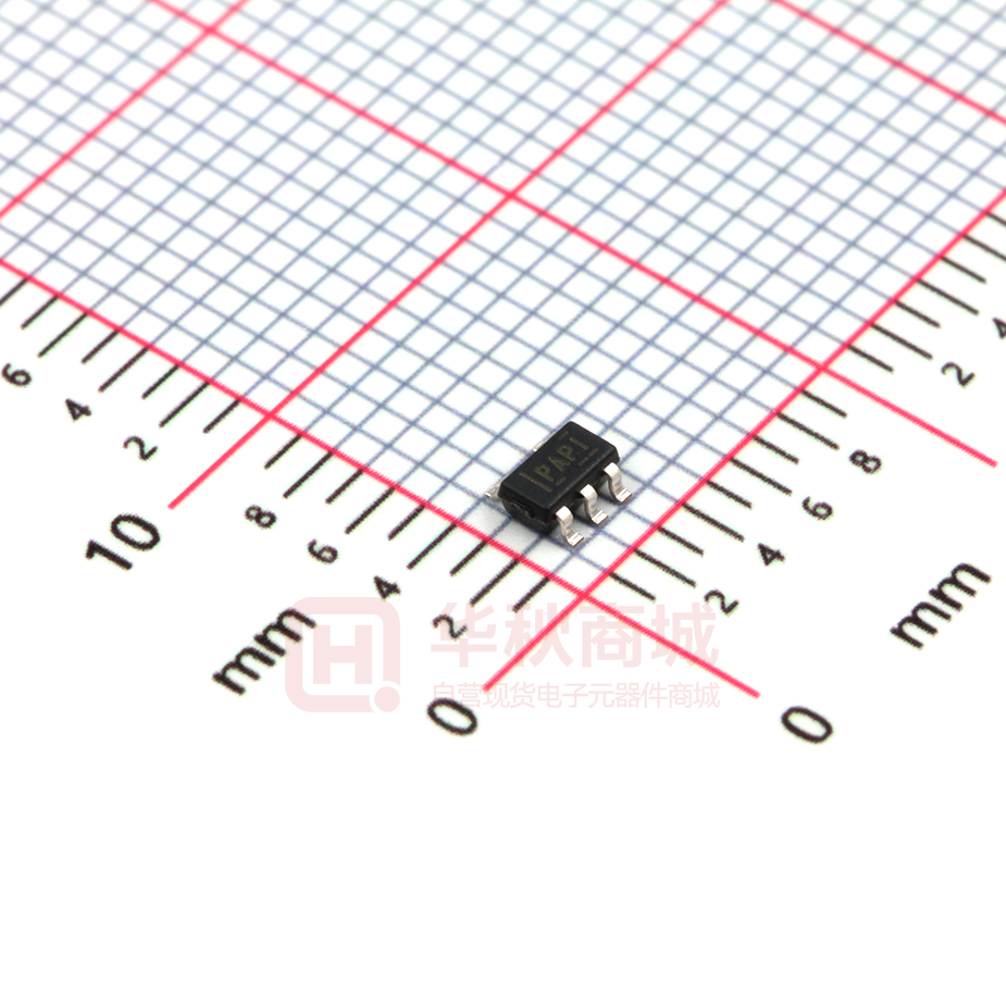

TPS3820, TPS3823, TPS3824, TPS3825, TPS3828 SLVS165N – APRIL 1998 – REVISED JULY 2022 TPS382x Voltage Monitor With Watchdog Timer 1 Features 3 Description • The TPS382x family of supervisors provide circuit initialization and timing supervision, primarily for DSP and processor-based systems. During power on, RESET asserts when the supply voltage VDD becomes greater than 1.1 V. Thereafter, the supply voltage supervisor monitors VDD and keeps RESET active low as long as VDD remains less than the threshold voltage, VIT−. An internal timer delays the return of the output to the inactive state (high) to ensure proper system reset. The delay time, td, starts after VDD has risen above the threshold voltage (VIT− + VHYS). When the supply voltage drops below the threshold voltage VIT−, the output becomes active (low) again. No external components are required. All the devices of this family have a fixed-sense threshold voltage, VIT–, set by an internal voltage divider. The TPS382x family also offers watchdog time out options of 200 ms (TPS3820) and 1.6 s (TPS3823, TPS3824, and TPS3828). • • • • • • 2 Applications • • • • • • • • DSPs, microcontrollers, or microprocessors Industrial equipment Programmable controls Automotive systems Portable and battery-powered equipment Intelligent instruments Wireless communications systems Notebook and desktop computers 3.3 V 100 nF VDD RESET VDD RESET TPS3823-33 WDI MR GND MSP430C325 I/O GND Typical Application Schematic PART NUMBER PACKAGE(1) BODY SIZE (NOM) TPS382x SOT-23 (5) 2.90 mm × 1.60 mm (1) Normalized Input Threshold Voltage −V IT (TA), VIT (25°C) • Power-on reset generator with a fixed delay time of 200 ms (TPS3823, TPS3824, TPS3825, and TPS3828) or 25 ms (TPS3820) Manual reset input (TPS3820, TPS3823, TPS3825, and TPS3828) Reset output available in active-low (TPS3820, TPS3823, TPS3824, and TPS3825), active-high (TPS3824 and TPS3825), and open drain (TPS3828) Supply voltage supervision range: 2.5 V, 3 V, 3.3 V, 5 V Watchdog timer (TPS3820, TPS3823, TPS3824, and TPS3828) Supply current of 15 μA (typical) 5-pin SOT-23 package Temperature range: −40°C to 85°C (−40°C to 125°C for TPS3823A-33) For all available packages, see the orderable addendum at the end of the data sheet. 1.001 1 0.999 0.998 0.997 0.996 0.995 −40 −15 10 35 60 85 TA − Free-Air Temperature − °C Normalized Input Threshold Voltage vs Free-Air Temperature An IMPORTANT NOTICE at the end of this data sheet addresses availability, warranty, changes, use in safety-critical applications, intellectual property matters and other important disclaimers. PRODUCTION DATA. TPS3820, TPS3823, TPS3824, TPS3825, TPS3828 www.ti.com SLVS165N – APRIL 1998 – REVISED JULY 2022 Table of Contents 1 Features............................................................................1 2 Applications..................................................................... 1 3 Description.......................................................................1 4 Revision History.............................................................. 2 5 Device Comparison Table...............................................3 6 Pin Configuration and Functions...................................4 7 Specifications.................................................................. 5 7.1 Absolute Maximum Ratings........................................ 5 7.2 ESD Ratings .............................................................. 5 7.3 Recommended Operating Conditions.........................5 7.4 Thermal Information....................................................5 7.5 Electrical Characteristics.............................................6 7.6 Electrical Characteristics for TPS3823A-33 only........ 7 7.7 Timing Requirements.................................................. 7 7.8 Switching Characteristics............................................7 7.9 Typical Characteristics................................................ 9 8 Detailed Description......................................................14 8.1 Overview................................................................... 14 8.2 Functional Block Diagram......................................... 14 8.3 Feature Description...................................................14 8.4 Device Functional Modes..........................................15 9 Application and Implementation.................................. 16 9.1 Application Information............................................. 16 9.2 Typical Applications.................................................. 16 10 Power Supply Recommendations..............................19 11 Layout........................................................................... 20 11.1 Layout Guidelines................................................... 20 11.2 Layout Example...................................................... 20 12 Device and Documentation Support..........................21 12.1 Device Support....................................................... 21 12.2 Documentation Support.......................................... 21 12.3 Receiving Notification of Documentation Updates..21 12.4 Support Resources................................................. 21 12.5 Trademarks............................................................. 22 12.6 Electrostatic Discharge Caution..............................22 12.7 Glossary..................................................................22 13 Mechanical, Packaging, and Orderable Information.................................................................... 23 4 Revision History NOTE: Page numbers for previous revisions may differ from page numbers in the current version. Changes from Revision M (July 2020) to Revision N (July 2022) Page • Updated the numbering format for tables, figures, and cross-references throughout the document..................1 Changes from Revision L (January 2018) to Revision M (July 2020) Page • Added Operating free-air, TA for TPS3823A-33 only .........................................................................................5 • Added Electrical Characteristics for TPS3823A-33 only Table .......................................................................... 7 • Added new typical performance curves Figure 7-9 through Figure 7-26 ...........................................................9 2 Submit Document Feedback Copyright © 2022 Texas Instruments Incorporated Product Folder Links: TPS3820 TPS3823 TPS3824 TPS3825 TPS3828 TPS3820, TPS3823, TPS3824, TPS3825, TPS3828 www.ti.com SLVS165N – APRIL 1998 – REVISED JULY 2022 5 Device Comparison Table RESET WDI MR TPS3820 DEVICE RESET Push-pull X X TPS3823 Push-pull X X TPS3823A Push-pull X X X TPS3824 Push-pull Push-pull TPS3825 Push-pull Push-pull TPS3828 Open-drain X X Copyright © 2022 Texas Instruments Incorporated Product Folder Links: TPS3820 TPS3823 TPS3824 TPS3825 TPS3828 X Submit Document Feedback 3 TPS3820, TPS3823, TPS3824, TPS3825, TPS3828 www.ti.com SLVS165N – APRIL 1998 – REVISED JULY 2022 6 Pin Configuration and Functions RESET 1 GND 2 MR 3 5 VDD 4 WDI Figure 6-1. 5-Pin SOT-23 TPS3820, TPS3823, TPS3823A, TPS3828: DBV Package (Top View) RESET 1 GND 2 RESET 3 5 VDD 4 WDI Figure 6-2. 5-Pin SOT-23 TPS3824: DBV Package (Top View) RESET 1 GND 2 RESET 3 5 VDD 4 MR Figure 6-3. 5-Pin SOT-23 TPS3825: DBV Package (Top View) Table 6-1. Pin Functions PIN TPS3820, TPS3823, TPS3823A, TPS3828 TPS3824 TPS3825 GND 2 2 2 — MR 3 — 4 I Manual-reset input. Pull low to force a reset. RESET remains low as long as MR is low and for the time-out period after MR goes high. Leave unconnected or connect to VDD when unused. RESET — 3 3 O Active-high reset output. Either push-pull or open-drain output stage. RESET 1 1 1 O Active-low reset output. Either push-pull or open-drain output stage. VDD 5 5 5 I Supply voltage. Powers the device and monitors its own voltage. I Watchdog timer input. If WDI remains high or low longer than the time-out period, then reset is triggered. The timer clears when reset is asserted or when WDI sees a rising edge or a falling edge. If unused, the WDI connection must be high impedance to prevent it from causing a reset event. NAME WDI 4 4 4 Submit Document Feedback — I/O DESCRIPTION Ground connection Copyright © 2022 Texas Instruments Incorporated Product Folder Links: TPS3820 TPS3823 TPS3824 TPS3825 TPS3828 TPS3820, TPS3823, TPS3824, TPS3825, TPS3828 www.ti.com SLVS165N – APRIL 1998 – REVISED JULY 2022 7 Specifications 7.1 Absolute Maximum Ratings over operating junction temperature range (unless otherwise noted)(1) (2) Voltage MIN MAX VDD –0.3 6 RESET, RESET, MR, WDI –0.3 (VDD + 0.3) –5 5 Maximum low output, IOL Current Maximum high output, IOH –5 5 Output range (VO < 0 or VO > VDD), IOK –10 10 Continuous total power dissipation Temperature (1) (2) UNIT V mA See Thermal Information Operating free-air, TA –40 85 Operating free-air, TA for TPS3823A-33 only –40 125 Storage, Tstg –65 150 °C Stresses beyond those listed under Absolute Maximum Ratings may cause permanent damage to the device. These are stress ratings only, which do not imply functional operation of the device at these or any other conditions beyond those indicated under Recommended Operating Conditions. Exposure to absolute-maximum-rated conditions for extended periods may affect device reliability. All voltage values are with respect to GND. 7.2 ESD Ratings VALUE V(ESD) (1) (2) Electrostatic discharge Human body model (HBM), per ANSI/ESDA/JEDEC JS-001(1) UNIT ±2000 Charged device model (CDM), per JEDEC specification JESD22-C101(2) V ±500 JEDEC document JEP155 states that 500-V HBM allows safe manufacturing with a standard ESD control process. JEDEC document JEP157 states that 250-V CDM allows safe manufacturing with a standard ESD control process. 7.3 Recommended Operating Conditions over operating junction temperature range (unless otherwise noted). MIN NOM MAX 1.1 5.5 UNIT VDD Supply voltage VIH High-level input voltage at MR and WDI VIL Low-level input voltage Δt/ΔV Input transition rise and fall rate at MR or WDI 100 ns/V TA Operating free-air temperature –40 85 °C TA Operating free-air temperature for TPS3823A-33 only –40 125 °C 0.7 × VDD V V 0.3 × VDD V 7.4 Thermal Information TPS382x THERMAL METRIC(1) DBV (SOT-23) UNIT 5 PINS RθJA Junction-to-ambient thermal resistance 209.1 °C/W RθJC(top) Junction-to-case (top) thermal resistance 72.8 °C/W RθJB Junction-to-board thermal resistance 36.7 °C/W ψJT Junction-to-top characterization parameter 2.1 °C/W Copyright © 2022 Texas Instruments Incorporated Product Folder Links: TPS3820 TPS3823 TPS3824 TPS3825 TPS3828 Submit Document Feedback 5 TPS3820, TPS3823, TPS3824, TPS3825, TPS3828 www.ti.com SLVS165N – APRIL 1998 – REVISED JULY 2022 7.4 Thermal Information (continued) TPS382x THERMAL METRIC(1) UNIT DBV (SOT-23) 5 PINS ψJB (1) Junction-to-board characterization parameter 35.8 °C/W For more information about traditional and new thermal metrics, see the Semiconductor and IC Package Thermal Metrics application report (SPRA953). over operating junction temperature range -40°C to 85°C (unless otherwise noted) 7.5 Electrical Characteristics PARAMETER TEST CONDITIONS RESET VOH High-level output voltage RESET TPS382x-25 VDD = VIT− + 0.2 V, IOH = –20 μA TPS382x-30 TPS382x-33 TPS382xA-33 VDD = VIT− + 0.2 V, IOH = –30 μA TPS382x-50 VDD = VIT− + 0.2 V IOH = –120 μA TPS3824-25 TPS3825-25 VDD ≥ 1.8 V, IOH = –100 μA MIN MAX UNIT 0.8 × VDD VDD − 1.5 V V TPS3824-30 TPS3825-30 TPS3824-33 TPS3825-33 TYP 0.8 × VDD VDD ≥ 1.8 V, IOH = –150 μA TPS3824-50 TPS3825-50 TPS3824-25 TPS3825-25 RESET VOL Low-level output voltage TPS3824-30 TPS3825-30 TPS3824-33 TPS3825-33 VDD = VIT− + 0.2 V, IOL = 1 mA 0.4 VDD = VIT− + 0.2 V, IOL = 1.2 mA TPS3824-50 TPS3825-50 VDD = VIT− + 0.2 V, IOL = 3 mA TPS382x-25 VDD = VIT− – 0.2 V, IOL = 1 mA V TPS382x-30 RESET TPS382x-33 TPS382xA-33 VDD = VIT− – 0.2 V, IOL = 1.2 mA TPS382x-50 VDD = VIT− – 0.2 V, IOL = 3 mA Power-up reset voltage(1) 0.4 0.4 VDD ≥ 1.1 V, IOL = 20 μA 0.4 TPS382x-25 2.21 2.25 2.30 2.59 2.63 2.69 2.88 2.93 3 TPS382x-50 4.49 4.55 4.64 TPS382x-25 2.20 2.25 2.30 2.57 2.63 2.69 2.86 2.93 3 4.46 4.55 4.64 TPS382x-30 TPS382x-33 TPS382xA-33 VIT− Negative-going input threshold voltage (2) TPS382x-30 TPS382x-33 TPS382xA-33 TPS382x-50 TA = 0°C to 85°C TA = –40°C to 85°C TA = –40°C to 85°C V V TPS382x-25 TPS382x-30 Vhys Hysteresis at VDD input 30 TPS382x-33 TPS382xA-33 TPS382x-50 6 IIH(AV) Average high-level input current IIL(AV) Average low-level input current Submit Document Feedback WDI mV 50 WDI = VDD, time average (DC = 88%) 120 WDI = 0.3 V, VDD = 5.5 V time average (DC = 12%) –15 µA Copyright © 2022 Texas Instruments Incorporated Product Folder Links: TPS3820 TPS3823 TPS3824 TPS3825 TPS3828 TPS3820, TPS3823, TPS3824, TPS3825, TPS3828 www.ti.com SLVS165N – APRIL 1998 – REVISED JULY 2022 7.5 Electrical Characteristics (continued) PARAMETER IIH High-level input current IIL Low-level input current TYP MAX WDI WDI = VDD TEST CONDITIONS MIN 140 190 MR MR = VDD × 0.7, VDD = 5.5 V –40 –60 WDI WDI = 0.3 V, VDD = 5.5 V 140 190 MR MR = 0.3 V, VDD = 5.5 V –110 –160 UNIT µA µA TPS382x-25 IOS Output short-circuit current(3) IDD Supply current TPS382x-30 RESET TPS382x-33 TPS382xA-33 –400 VDD = VIT, max + 0.2 V, VO = 0 V TPS382x-50 –800 WDI, MR, and outputs unconnected 15 Internal pullup resistor at MR Ci Input capacitance at MR, WDI (1) (2) (3) µA VI = 0 V to 5.5 V 25 µA 52 kΩ 5 pF The lowest supply voltage at which RESET becomes active. tr, VDD ≥ 15 μs/V. To ensure best stability of the threshold voltage, a bypass capacitor (ceramic, 0.1 μF) must be placed near the supply terminals. The RESET short-circuit current is the maximum pullup current when RESET is driven low by a microprocessor bidirectional reset pin. over operating junction temperature range -40°C to 125°C (unless otherwise noted) for TPS3823A-33 only 7.6 Electrical Characteristics for TPS3823A-33 only PARAMETER TEST CONDITIONS VOH High-level output voltage RESET VDD = VIT− + 0.2 V, IOH = –30 μA VOL Low-level output voltage VDD = VIT− – 0.2 V, IOL = 1.2 mA RESET Power-up reset voltage(1) MIN TYP VIT− Vhys Hysteresis at VDD input IIH(AV) Average high-level input current IIL(AV) Average low-level input current IIH High-level input current IIL Low-level input current IOS Output short-circuit current(3) IDD Supply current 2.83 (1) (2) (3) V 0.4 V 3 V 2.93 30 mV 120 WDI = 0.3 V, VDD = 5.5 V time average (DC = 12%) –15 WDI WDI = VDD 140 190 MR MR = VDD × 0.7, VDD = 5.5 V –40 –60 WDI WDI = 0.3 V, VDD = 5.5 V 140 190 MR MR = 0.3 V, VDD = 5.5 V –110 –160 RESET VDD = VIT, max + 0.2 V, VO = 0 V WDI, MR, and outputs unconnected Input capacitance at MR, WDI µA –400 15 Internal pullup resistor at MR Ci 0.45 WDI = VDD, time average (DC = 88%) WDI UNIT V VDD ≥ 1.1 V, IOL = 20 μA Negative-going input threshold voltage (2) MAX 0.8 × VDD VI = 0 V to 5.5 V 25 µA µA µA µA 52 kΩ 5 pF The lowest supply voltage at which RESET becomes active. tr, VDD ≥ 15 μs/V. To ensure best stability of the threshold voltage, a bypass capacitor (ceramic, 0.1 μF) must be placed near the supply terminals. The RESET short-circuit current is the maximum pullup current when RESET is driven low by a microprocessor bidirectional reset pin. 7.7 Timing Requirements At RL = 1 MΩ, CL = 50 pF, and TJ = 25°C, unless otherwise noted. MIN tw Pulse width TYP MAX UNIT at VDD VDD = VIT− + 0.2 V, VDD = VIT– – 0.2 V 6 μs at MR VDD ≥ VIT− + 0.2 V, VIL = 0.3 × VDD, VIH = 0.7 × VDD 1 μs at WDI VDD ≥ VIT− + 0.2 V, VIL = 0.3 × VDD, VIH = 0.7 × VDD 100 ns 7.8 Switching Characteristics At RL = 1 MΩ, CL = 50 pF, and TJ = 25°C, unless otherwise noted. Copyright © 2022 Texas Instruments Incorporated Product Folder Links: TPS3820 TPS3823 TPS3824 TPS3825 TPS3828 Submit Document Feedback 7 TPS3820, TPS3823, TPS3824, TPS3825, TPS3828 www.ti.com SLVS165N – APRIL 1998 – REVISED JULY 2022 PARAMETER ttout Watchdog time out TPS3823/4/8, TPS3823A TPS3820 td Delay time tPHL Propagation (delay) time, high-to-low-level output tPLH TPS3823/4/5/8, TPS3823A Propagation (delay) time, low-to-high-level output VDD TEST CONDITIONS TPS3820 MIN TYP MAX UNIT VDD ≥ VIT− + 0.2 V See Figure 7-1 112 200 300 ms 0.9 1.6 2.5 s VDD ≥ VIT− + 0.2 V See Figure 7-1 15 25 37 120 200 300 MR to RESET delay (TPS3820/3/5/8, TPS3823A) VDD ≥ VIT− + 0.2 V, VIL = 0.3 × VDD, VIH = 0.7 × VDD 0.1 VDD to RESET delay VIL = VIT– – 0.2 V, VIH = VIT– + 0.2 V 25 MR to RESET delay (TPS3824/5) VDD ≥ VIT− + 0.2 V, VIL = 0.3 × VDD, VIH = 0.7 × VDD 0.1 VDD to RESET delay (TPS3824/5) VIL = VIT– – 0.2 V, VIH = VIT– + 0.2 V 25 ms µs µs VIT1.1 V tt(out) td td td undefined undefined RESET WDI Figure 7-1. Timing Diagram 8 Submit Document Feedback Copyright © 2022 Texas Instruments Incorporated Product Folder Links: TPS3820 TPS3823 TPS3824 TPS3825 TPS3828 TPS3820, TPS3823, TPS3824, TPS3825, TPS3828 www.ti.com SLVS165N – APRIL 1998 – REVISED JULY 2022 19 1.001 15 1 0.999 0.998 0.997 13 TPS382x-33 11 9 7 5 3 0.996 1 0.995 −40 −15 10 60 35 −1 −0.5 85 TA − Free-Air Temperature − °C Figure 7-2. Normalized Input Threshold Voltage vs Free-Air Temperature at VDD −40°C −100 85°C −150 3.5 5.5 4.5 6.5 VDD = 2.66 V WDI = Open MR = Open 2.5 2 1.5 85°C 1 −40°C 0.5 0 0 1 2 3 4 5 0 6 2 1 3 4 5 6 7 8 9 10 IOL − Low-Level Output Current − mA VI − Input Voltage at MR − V Figure 7-4. Input Current vs Input Voltage at MR Figure 7-5. Low-Level Output Voltage vs Low-Level Output Current 6 3.5 VDD = 3.2 V WDI = Open MR = Open 3 VOH − High-Level Output Voltage − V VOH − High-Level Output Voltage − V 2.5 Figure 7-3. Supply Current vs Supply Voltage VOL − Low-Level Output Voltage − V 0 −200 −1 1.5 3 VDD = 5.5 V WDI = Open −50 0.5 VDD − Supply Voltage − V 50 I I − Input Current − µ A MR = Open WDI = Open TA = 25°C 17 I DD− Supply Current − µ A Normalized Input Threshold Voltage −V IT (TA), VIT (25°C) 7.9 Typical Characteristics 2.5 −40°C 2 1.5 85°C 1 0.5 0 VDD = 5.5 V WDI = Open MR = Open 5 4 −40°C 3 85°C 2 1 0 0 −50 −100 −150 −200 −250 IOH − High-Level Output Current − µA Figure 7-6. High-Level Output Voltage vs HighLevel Output Current 0 −100 −200 −300 −400 −500 −600 −700 IOH − High-Level Output Current − µA Figure 7-7. High-Level Output Voltage vs HighLevel Output Current Copyright © 2022 Texas Instruments Incorporated Product Folder Links: TPS3820 TPS3823 TPS3824 TPS3825 TPS3828 Submit Document Feedback 9 TPS3820, TPS3823, TPS3824, TPS3825, TPS3828 www.ti.com SLVS165N – APRIL 1998 – REVISED JULY 2022 8 10 t w − Minimum Pulse Duration at VDD − µs WDI = Open MR = Open 7 8 6 5 Count 6 4 4 3 2 2 1 0 0 200 400 600 800 0 120 1000 150 180 VDD − Threshold Overdrive − mV 8 8 7 7 6 6 5 5 4 3 2 2 1 1 180 210 240 270 7 6 6 5 5 Count Count 7 4 3 2 2 1 1 1.5 1.7 1.9 2.1 2.3 2.5 Watc Figure 7-12. Watchdog Timeout Histogram for TPS3823A-33 Devices at -40°C (Unit Count = 20) Submit Document Feedback 180 210 240 270 300 Rese 4 3 Watchdog Timeout tout [s] Rese Figure 7-11. Reset Delay Histogram for TPS3823A-33 Devices at 125°C (Unit Count = 20) 8 1.3 300 Reset Delay td [ms] 8 1.1 150 Rese Figure 7-10. Reset Delay Histogram for TPS3823A-33 Devices at 25°C (Unit Count = 20) 10 0 120 300 Reset Delay td [ms] 0 0.9 270 4 3 150 240 Figure 7-9. Reset Delay Histogram for TPS3823A-33 Devices at -40°C (Unit Count = 20) Count Count Figure 7-8. Minimum Pulse Duration at VDD vs VDD Threshold Overdrive 0 120 210 Reset Delay td [ms] 0 0.9 1.1 1.3 1.5 1.7 1.9 Watchdog Timeout tout [s] 2.1 2.3 2.5 Watc Figure 7-13. Watchdog Timeout Histogram for TPS3823A-33 Devices at 25°C (Unit Count = 20) Copyright © 2022 Texas Instruments Incorporated Product Folder Links: TPS3820 TPS3823 TPS3824 TPS3825 TPS3828 TPS3820, TPS3823, TPS3824, TPS3825, TPS3828 SLVS165N – APRIL 1998 – REVISED JULY 2022 8 8 7 7 6 6 5 5 Count Count www.ti.com 4 3 3 2 2 1 1 0 0.9 0 1.1 1.3 1.5 1.7 1.9 2.1 2.3 Watchdog Timeout tout [s] 7 9 13 15 17 19 21 23 25 tPHL Figure 7-15. VDD to Reset Delay Histogram for TPS3823A-33 Devices at -40°C (Unit Count = 20) 8 8 7 7 6 6 5 5 4 11 VDD to Reset Delay tPHL [µs] Watc Count Count 5 2.5 Figure 7-14. Watchdog Timeout Histogram for TPS3823A-33 Devices at 125°C (Unit Count = 20) 4 3 3 2 2 1 1 0 0 5 7 9 11 13 15 17 19 21 23 VDD to Reset Delay tPHL [µs] 25 5 9 8 8 7 7 6 6 Count 10 5 4 3 3 2 2 1 1 0 0 4.5 tW(VDD) [µs] 5 5.5 6 tw_V Figure 7-18. VDD Pulse Width Histogram for TPS3823A-33 Devices at -40°C (Unit Count = 20) 13 15 17 19 21 23 25 tPHL 5 4 4 11 Figure 7-17. VDD to Reset Delay Histogram for TPS3823A-33 Devices at 125°C (Unit Count = 20) 9 3.5 9 VDD to Reset Delay tPHL [µs] 10 3 7 tPHL Figure 7-16. VDD to Reset Delay Histogram for TPS3823A-33 Devices at 25°C (Unit Count = 20) Count 4 3 3.5 4 4.5 tW(VDD) [µs] 5 5.5 6 tw_V Figure 7-19. VDD Pulse Width Histogram for TPS3823A-33 Devices at 25°C (Unit Count = 20) Copyright © 2022 Texas Instruments Incorporated Product Folder Links: TPS3820 TPS3823 TPS3824 TPS3825 TPS3828 Submit Document Feedback 11 TPS3820, TPS3823, TPS3824, TPS3825, TPS3828 www.ti.com SLVS165N – APRIL 1998 – REVISED JULY 2022 10 12 9 11 10 8 9 7 8 Count Count 6 5 7 6 5 4 4 3 3 2 2 1 1 0 0 0.3 3 3.5 4 4.5 5 5.5 6 tW(VDD) [µs] 12 11 11 10 10 9 9 8 8 7 7 6 5 4 4 3 3 2 2 1 1 0 0.3 0 0.3 0.7 0.8 0.9 1 tW(MR) [µs] 14 13 13 12 12 11 11 10 10 9 9 Count Count 15 7 6 5 4 4 3 3 2 2 1 1 65 70 75 tW(WDI) [ns] 80 85 90 95 100 tw_w Figure 7-24. WDI Pulse Width Histogram for TPS3823A-33 Devices at -40°C (Unit Count = 20) 12 Submit Document Feedback tw_m 0.5 0.6 0.7 0.8 0.9 1 tw_m 7 5 60 1 8 6 55 0.9 Figure 7-23. Manual Reset Pulse Width Histogram for TPS3823A-33 Devices at 125°C (Unit Count = 20) 14 8 0.8 tW(MR) [µs] 15 0 50 0.4 tw_m Figure 7-22. Manual Reset Pulse Width Histogram for TPS3823A-33 Devices at 25°C (Unit Count = 20) 0.7 6 5 0.6 0.6 Figure 7-21. Manual Reset Pulse Width Histogram for TPS3823A-33 Devices at -40°C (Unit Count = 20) 12 0.5 0.5 tW(MR) [µs] Count Count Figure 7-20. VDD Pulse Width Histogram for TPS3823A-33 Devices at 125°C (Unit Count = 20) 0.4 0.4 tw_V 0 50 55 60 65 70 75 tW(WDI) [ns] 80 85 90 95 100 tw_w Figure 7-25. WDI Pulse Width Histogram for TPS3823A-33 Devices at 25°C (Unit Count = 20) Copyright © 2022 Texas Instruments Incorporated Product Folder Links: TPS3820 TPS3823 TPS3824 TPS3825 TPS3828 TPS3820, TPS3823, TPS3824, TPS3825, TPS3828 www.ti.com Count SLVS165N – APRIL 1998 – REVISED JULY 2022 18 17 16 15 14 13 12 11 10 9 8 7 6 5 4 3 2 1 0 50 55 60 65 70 75 tW(WDI) [ns] 80 85 90 95 100 tw_w Figure 7-26. WDI Pulse Width Histogram for TPS3823A-33 Devices at 125°C (Unit Count = 20) Copyright © 2022 Texas Instruments Incorporated Product Folder Links: TPS3820 TPS3823 TPS3824 TPS3825 TPS3828 Submit Document Feedback 13 TPS3820, TPS3823, TPS3824, TPS3825, TPS3828 www.ti.com SLVS165N – APRIL 1998 – REVISED JULY 2022 8 Detailed Description 8.1 Overview The TPS382x family of supervisors provide circuit initialization and timing supervision. Optional configurations include devices with active-high and active-low output signals (TPS3824/5), devices with a watchdog timer (TPS3820/3/4/8), and devices with manual reset (MR) pins (TPS3820/3/5/8). RESET asserts when the supply voltage, VDD, rises above 1.1 V. For devices with active-low output logic, the device monitors VDD and keeps RESET low as long as VDD remains below the negative threshold voltage, VIT−. For devices with active-high output logic, RESET remains high as long as VDD remains below VIT−. An internal timer delays the return of the output to the inactive state (high) to ensure proper system reset. The delay time, td, starts after VDD rises above the positive threshold voltage (VIT− + VHYS). When the supply voltage drops below VIT−, the output becomes active (low) again. All the devices of this family have a fixed-sense threshold voltage, VIT–, set by an internal voltage divider, so no external components are required. The TPS382x family is designed to monitor supply voltages of 2.5 V, 3 V, 3.3 V, and 5 V. The devices are available in a 5-pin SOT-23 package and are characterized for operation over a temperature range of −40°C to 85°C. Only TPS3823A-33 is characterized for operation over a temperature range −40°C to 125°C. 8.2 Functional Block Diagram VDD + _ 52 kW RESET RESET Logic (1) RESET VREF MR (2) Auto-Reset Oscillator 40 kW WDI A. B. C. Transition Detector (3) Watchdog Timer Logic TPS3824/5 TPS3820/3/5/8 TPS3820/3/4/8 8.3 Feature Description 8.3.1 Manual Reset (MR) The MR input allows an external logic signal from processors, logic circuits, and/or discrete sensors to force a reset signal regardless of VDD with respect to VIT– or the state of the watchdog timer. A low level at MR causes the reset signals to become active. 8.3.2 Active-High or Active-Low Output All TPS382x devices have an active-low logic output (RESET), while the TPS3824/5 devices also include an active-high logic output (RESET). 8.3.3 Push-Pull or Open-Drain Output All TPS382x devices, except for TPS3828, have push-pull outputs. TPS3828 devices have an open-drain output. 14 Submit Document Feedback Copyright © 2022 Texas Instruments Incorporated Product Folder Links: TPS3820 TPS3823 TPS3824 TPS3825 TPS3828 TPS3820, TPS3823, TPS3824, TPS3825, TPS3828 www.ti.com SLVS165N – APRIL 1998 – REVISED JULY 2022 8.3.4 Watchdog Timer (WDI) The TPS3820, TPS3823, TPS3824, and TPS3828 devices have a watchdog timer that must be periodically triggered by either a positive or negative transition at WDI to avoid a reset signal being issued. When the supervising system fails to retrigger the watchdog circuit within the time-out interval, ttout, RESET becomes active for the time period td. This event also reinitializes the watchdog timer. The watchdog timer can be disabled by disconnecting the WDI pin from the system. If the WDI pin detects that it is in a high-impedance state, the TPS3820, TPS3823, TPS3824, or TPS3828 will generate its own WDI pulse to ensure that RESET does not assert. If this behavior is not desired, place a 1-kΩ resistor from WDI to ground. This resistor will help ensure that the TPS3820, TPS3823, TPS3824, or TPS3828 detects that WDI is not in a high-impedance state. In applications where the input to the WDI pin is active (transitioning high and low) and the TPS3820, TPS3823, TPS3824, or TPS3828 is asserting RESET, RESET is stuck at a logic low after the input voltage returns above VIT–. If the application requires that input to WDI be active when the reset signal is asserted, then either the A version of the device or a FET should be used to decouple the WDI signal. The A version does not latch the reset signal to the asserted state if a WDI pulse is received while RESET is asserted. An external FET decouples the WDI signal by disconnecting the WDI input when RESET is asserted. For more details on this, see Decoupling WDI During Reset Event. The A version of the device does not require this FET, but it does operate in circuits that have it. Therefore, the A version is backwards-compatible with the non-A versions. 8.4 Device Functional Modes Table 8-1 lists the functional modes of the TPS382x devices. Table 8-1. Function Table INPUTS (1) (2) OUTPUTS MR (1) VDD > VIT RESET RESET(2) L 0 L H L 1 L H H 0 L H H 1 H L TPS3820/3/5/8 TPS3824/5 Copyright © 2022 Texas Instruments Incorporated Product Folder Links: TPS3820 TPS3823 TPS3824 TPS3825 TPS3828 Submit Document Feedback 15 TPS3820, TPS3823, TPS3824, TPS3825, TPS3828 www.ti.com SLVS165N – APRIL 1998 – REVISED JULY 2022 9 Application and Implementation Note Information in the following applications sections is not part of the TI component specification, and TI does not warrant its accuracy or completeness. TI’s customers are responsible for determining suitability of components for their purposes, as well as validating and testing their design implementation to confirm system functionality. 9.1 Application Information The TPS382x family of devices are very small supervisory circuits that monitor fixed supply voltages of 2.5 V, 3 V, 3.3 V, and 5 V. The TPS382x family operates from 1.1 V to 5.5 V. Orderable options include versions with either push-pull or open-drain outputs, versions that use active-high or active-low logic for output signals, versions with a manual reset pin, and versions with a watchdog timer. See the Device Comparison Table for an overview of device options. 9.2 Typical Applications 9.2.1 Supply Rail Monitoring With Watchdog Time-Out and 200-ms Delay The TPS3823A can be used to monitor the supply rail for devices such as microcontrollers. The downstream device is enabled by the TPS3823A once the voltage on the supply pin (VDD) is above the internal threshold voltage (VIT– + VHYS). The downstream device is disabled by the TPS3823A when VDD falls below the threshold voltage minus the hysteresis voltage (VIT–). The TPS3823A also issues a reset signal if the WDI input is not periodically triggered by a positive or negative transition at WDI. When the supervising system fails to retrigger the watchdog circuit within the time-out interval, ttout, RESET becomes active for the time period td. Some applications require a shorter reset signal than the 200 ms that most of the TPS382x family provide. In these cases, the TPS3820 is a good choice because it has a delay time of only 25 ms. If an open-drain output is required, replace the TPS3823A with the TPS3828 (if the WDI input must be active while RESET is low, see Decoupling WDI During Reset Event). Figure 9-1 shows the TPS3823A in a typical application. 3.3 V 100 nF VDD RESET VDD RESET TPS3823A-33 WDI MR GND MSP430C325 I/O GND Figure 9-1. Supply Rail Monitoring With Watchdog Time-Out 9.2.1.1 Design Requirements The TPS3823A must drive the enable pin of a MSP430C325 using a logic-high signal to signify that the supply voltage is above the minimum operating voltage of the device and monitor the I/O pin to determine if the microcontroller is operating correctly. 9.2.1.2 Detailed Design Procedure Determine which version of the TPS382x family best suits the functional performance required. If the input supply is noisy, include an input capacitor to help avoid unwanted changes to the reset signal. 16 Submit Document Feedback Copyright © 2022 Texas Instruments Incorporated Product Folder Links: TPS3820 TPS3823 TPS3824 TPS3825 TPS3828 TPS3820, TPS3823, TPS3824, TPS3825, TPS3828 www.ti.com SLVS165N – APRIL 1998 – REVISED JULY 2022 9.2.1.3 Application Curve t w − Minimum Pulse Duration at VDD − µs 10 WDI = Open MR = Open 8 6 4 2 0 0 200 400 600 800 1000 VDD − Threshold Overdrive − mV Figure 9-2. Minimum Pulse Duration at VDD vs VDD Threshold Overdrive 9.2.2 Decoupling WDI During Reset Event If the application requires that the input to WDI is active when the reset signal is asserted and the A version of the device cannot be used, Figure 9-3 shows how to decouple WDI from the active signal using an N-channel FET. The N-channel FET is placed in series with the WDI pin, with the gate of the FET connected to the RESET output. 3.3 V VDD VDD RESET TPS3820-33 MR WDI RESET Microprocessor I/O GND GND Figure 9-3. WDI Example 9.2.2.1 Design Requirements The TPS3820 must drive the enable pin of a microprocessor using a logic-high signal to signify that the supply voltage is above the minimum operating voltage of the device and monitor the I/O pin to determine if the microcontroller is operating correctly. The reset signal delay time should be greater than 10 ms but less than 50 ms to achieve the desired behavior. 9.2.2.2 Detailed Design Procedure Determine which version of the TPS3820 is best suited for monitoring the supply voltage. If the input supply is noisy, include an input capacitor to help avoid unwanted changes to the reset signal. 9.2.2.3 Application Curve Copyright © 2022 Texas Instruments Incorporated Product Folder Links: TPS3820 TPS3823 TPS3824 TPS3825 TPS3828 Submit Document Feedback 17 TPS3820, TPS3823, TPS3824, TPS3825, TPS3828 www.ti.com SLVS165N – APRIL 1998 – REVISED JULY 2022 t w − Minimum Pulse Duration at VDD − µs 10 WDI = Open MR = Open 8 6 4 2 0 0 200 400 600 800 1000 VDD − Threshold Overdrive − mV Figure 9-4. Minimum Pulse Duration at VDD vs VDD Threshold Overdrive 18 Submit Document Feedback Copyright © 2022 Texas Instruments Incorporated Product Folder Links: TPS3820 TPS3823 TPS3824 TPS3825 TPS3828 TPS3820, TPS3823, TPS3824, TPS3825, TPS3828 www.ti.com SLVS165N – APRIL 1998 – REVISED JULY 2022 10 Power Supply Recommendations These devices are designed to operate from an input supply with a voltage range from 1.1 V to 5.5 V. Though not required, it is good analog design practice to place a 0.1-μF ceramic capacitor close to the VDD pin if the input supply is noisy. Copyright © 2022 Texas Instruments Incorporated Product Folder Links: TPS3820 TPS3823 TPS3824 TPS3825 TPS3828 Submit Document Feedback 19 TPS3820, TPS3823, TPS3824, TPS3825, TPS3828 www.ti.com SLVS165N – APRIL 1998 – REVISED JULY 2022 11 Layout 11.1 Layout Guidelines Follow these guidelines to lay out the printed-circuit board (PCB) that is used for the TPS382x family of devices. • • Place the VDD decoupling capacitor (CVDD) close to the device. Avoid using long traces for the VDD supply node. The VDD capacitor (CVDD), along with parasitic inductance from the supply to the capacitor, can form an LC tank and create ringing with peak voltages above the maximum VDD voltage. 11.2 Layout Example Pullup Voltage CVDD RESET Flag TPS3828 1 5 2 MR Signal 3 WDI Signal 4 Figure 11-1. Example Layout (DBV Package) 20 Submit Document Feedback Copyright © 2022 Texas Instruments Incorporated Product Folder Links: TPS3820 TPS3823 TPS3824 TPS3825 TPS3828 TPS3820, TPS3823, TPS3824, TPS3825, TPS3828 www.ti.com SLVS165N – APRIL 1998 – REVISED JULY 2022 12 Device and Documentation Support 12.1 Device Support 12.1.1 Development Support 12.1.1.1 Spice Models Computer simulation of circuit performance using SPICE is often useful when analyzing the performance of analog circuits and systems. A SPICE model for the TPS382x is available through the product folders under Tools & Software. 12.1.2 Device Nomenclature Table 12-1. Ordering Information ORDERABLE DEVICE NAME(1) (2) (3) (1) (2) (3) (4) THRESHOLD VOLTAGE(4) MARKING TPS3820-33DBVT TPS3820-33DBVR 2.93 V PDEI TPS3820-50DBVT TPS3820-50DBVR 4.55 V PDDI TPS3823-25DBVT TPS3823-25DBVR 2.25 V PAPI TPS3823-30DBVT TPS3823-30DBVR 2.63 V PAQI TPS3823-33DBVT TPS3823-33DBVR 2.93 V PARI TPS3823-50DBVT TPS3823-50DBVR 4.55 V PASI TPS3824-25DBVT TPS3824-25DBVR 2.25 V PATI TPS3824-30DBVT TPS3824-30DBVR 2.63 V PAUI TPS3824-33DBVT TPS3824-33DBVR 2.93 V PAVI TPS3824-50DBVT TPS3824-50DBVR 4.55 V PAWI TPS3825-33DBVT TPS3825-33DBVR 2.93 V PDGI TPS3825-50DBVT TPS3825-50DBVR 4.55 V PDFI TPS3828-33DBVT TPS3828-33DBVR 2.93 V PDII TPS3828-50DBVT TPS3828-50DBVR 4.55 V PDHI TPS3823A-33DBVT TPS3823A-33DBVR 2.93 V PYPI For the most current package and ordering information see the Package Option Addendum at the end of this document, or see the TI website at www.ti.com. The DBVT package indicates tape and reel of 250 parts. The DBVR package indicates tape and reel of 3000 parts. For other threshold voltage versions, contact the local TI sales office. 12.2 Documentation Support 12.2.1 Related Documentation For related documentation, see the following: Disabling the Watchdog Timer for TI's Family of Supervisors (SLVA145) 12.3 Receiving Notification of Documentation Updates To receive notification of documentation updates, navigate to the device product folder on ti.com. Click on Subscribe to updates to register and receive a weekly digest of any product information that has changed. For change details, review the revision history included in any revised document. 12.4 Support Resources TI E2E™ support forums are an engineer's go-to source for fast, verified answers and design help — straight from the experts. Search existing answers or ask your own question to get the quick design help you need. Copyright © 2022 Texas Instruments Incorporated Product Folder Links: TPS3820 TPS3823 TPS3824 TPS3825 TPS3828 Submit Document Feedback 21 TPS3820, TPS3823, TPS3824, TPS3825, TPS3828 www.ti.com SLVS165N – APRIL 1998 – REVISED JULY 2022 Linked content is provided "AS IS" by the respective contributors. They do not constitute TI specifications and do not necessarily reflect TI's views; see TI's Terms of Use. 12.5 Trademarks TI E2E™ is a trademark of Texas Instruments. All trademarks are the property of their respective owners. 12.6 Electrostatic Discharge Caution This integrated circuit can be damaged by ESD. Texas Instruments recommends that all integrated circuits be handled with appropriate precautions. Failure to observe proper handling and installation procedures can cause damage. ESD damage can range from subtle performance degradation to complete device failure. Precision integrated circuits may be more susceptible to damage because very small parametric changes could cause the device not to meet its published specifications. 12.7 Glossary TI Glossary 22 This glossary lists and explains terms, acronyms, and definitions. Submit Document Feedback Copyright © 2022 Texas Instruments Incorporated Product Folder Links: TPS3820 TPS3823 TPS3824 TPS3825 TPS3828 TPS3820, TPS3823, TPS3824, TPS3825, TPS3828 www.ti.com SLVS165N – APRIL 1998 – REVISED JULY 2022 13 Mechanical, Packaging, and Orderable Information The following pages include mechanical, packaging, and orderable information. This information is the most current data available for the designated devices. This data is subject to change without notice and revision of this document. For browser-based versions of this data sheet, refer to the left-hand navigation. Copyright © 2022 Texas Instruments Incorporated Product Folder Links: TPS3820 TPS3823 TPS3824 TPS3825 TPS3828 Submit Document Feedback 23 PACKAGE OPTION ADDENDUM www.ti.com 14-Oct-2022 PACKAGING INFORMATION Orderable Device Status (1) Package Type Package Pins Package Drawing Qty Eco Plan (2) Lead finish/ Ball material MSL Peak Temp Op Temp (°C) Device Marking (3) Samples (4/5) (6) TPS3820-33DBVR ACTIVE SOT-23 DBV 5 3000 RoHS & Green NIPDAU Level-1-260C-UNLIM -40 to 85 PDEI Samples TPS3820-33DBVRG4 ACTIVE SOT-23 DBV 5 3000 RoHS & Green NIPDAU Level-1-260C-UNLIM -40 to 85 PDEI Samples TPS3820-33DBVT ACTIVE SOT-23 DBV 5 250 RoHS & Green NIPDAU Level-1-260C-UNLIM -40 to 85 PDEI Samples TPS3820-33DBVTG4 ACTIVE SOT-23 DBV 5 250 RoHS & Green NIPDAU Level-1-260C-UNLIM -40 to 85 PDEI Samples TPS3820-50DBVR ACTIVE SOT-23 DBV 5 3000 RoHS & Green NIPDAU Level-1-260C-UNLIM -40 to 85 PDDI Samples TPS3820-50DBVT ACTIVE SOT-23 DBV 5 250 RoHS & Green NIPDAU Level-1-260C-UNLIM -40 to 85 PDDI Samples TPS3823-25DBVR ACTIVE SOT-23 DBV 5 3000 RoHS & Green NIPDAU Level-1-260C-UNLIM -40 to 85 PAPI Samples TPS3823-25DBVT ACTIVE SOT-23 DBV 5 250 RoHS & Green NIPDAU Level-1-260C-UNLIM PAPI Samples TPS3823-30DBVR ACTIVE SOT-23 DBV 5 3000 RoHS & Green NIPDAU Level-1-260C-UNLIM PAQI Samples TPS3823-30DBVT ACTIVE SOT-23 DBV 5 250 RoHS & Green NIPDAU Level-1-260C-UNLIM PAQI Samples TPS3823-33DBVR ACTIVE SOT-23 DBV 5 3000 RoHS & Green NIPDAU Level-1-260C-UNLIM -40 to 85 PARI Samples TPS3823-33DBVRG4 ACTIVE SOT-23 DBV 5 3000 RoHS & Green NIPDAU Level-1-260C-UNLIM -40 to 85 PARI Samples TPS3823-33DBVT ACTIVE SOT-23 DBV 5 250 RoHS & Green NIPDAU Level-1-260C-UNLIM PARI Samples TPS3823-33DBVTG4 ACTIVE SOT-23 DBV 5 250 RoHS & Green NIPDAU Level-1-260C-UNLIM PARI Samples TPS3823-50DBVR ACTIVE SOT-23 DBV 5 3000 RoHS & Green NIPDAU Level-1-260C-UNLIM PASI Samples TPS3823-50DBVT ACTIVE SOT-23 DBV 5 250 RoHS & Green NIPDAU Level-1-260C-UNLIM PASI Samples TPS3823-50DBVTG4 ACTIVE SOT-23 DBV 5 250 RoHS & Green NIPDAU Level-1-260C-UNLIM PASI Samples TPS3823A-33DBVR ACTIVE SOT-23 DBV 5 3000 RoHS & Green NIPDAU Level-1-260C-UNLIM -40 to 125 PYPI Samples TPS3823A-33DBVT ACTIVE SOT-23 DBV 5 250 RoHS & Green NIPDAU Level-1-260C-UNLIM -40 to 125 PYPI Samples TPS3824-25DBVR ACTIVE SOT-23 DBV 5 3000 RoHS & Green NIPDAU Level-1-260C-UNLIM -40 to 85 PATI Samples Addendum-Page 1 -40 to 85 -40 to 85 PACKAGE OPTION ADDENDUM www.ti.com Orderable Device 14-Oct-2022 Status (1) Package Type Package Pins Package Drawing Qty Eco Plan (2) Lead finish/ Ball material MSL Peak Temp Op Temp (°C) Device Marking (3) Samples (4/5) (6) TPS3824-25DBVT ACTIVE SOT-23 DBV 5 250 RoHS & Green NIPDAU Level-1-260C-UNLIM PATI Samples TPS3824-30DBVR ACTIVE SOT-23 DBV 5 3000 RoHS & Green NIPDAU Level-1-260C-UNLIM -40 to 85 PAUI Samples TPS3824-30DBVRG4 ACTIVE SOT-23 DBV 5 3000 RoHS & Green NIPDAU Level-1-260C-UNLIM -40 to 85 PAUI Samples TPS3824-30DBVT ACTIVE SOT-23 DBV 5 250 RoHS & Green NIPDAU Level-1-260C-UNLIM PAUI Samples TPS3824-33DBVR ACTIVE SOT-23 DBV 5 3000 RoHS & Green NIPDAU Level-1-260C-UNLIM -40 to 85 PAVI Samples TPS3824-33DBVRG4 ACTIVE SOT-23 DBV 5 3000 RoHS & Green NIPDAU Level-1-260C-UNLIM -40 to 85 PAVI Samples TPS3824-33DBVT ACTIVE SOT-23 DBV 5 250 RoHS & Green NIPDAU Level-1-260C-UNLIM PAVI Samples TPS3824-50DBVR ACTIVE SOT-23 DBV 5 3000 RoHS & Green NIPDAU Level-1-260C-UNLIM PAWI Samples TPS3824-50DBVT ACTIVE SOT-23 DBV 5 250 RoHS & Green NIPDAU Level-1-260C-UNLIM PAWI Samples TPS3825-33DBVR ACTIVE SOT-23 DBV 5 3000 RoHS & Green NIPDAU Level-1-260C-UNLIM -40 to 85 PDGI Samples TPS3825-33DBVRG4 ACTIVE SOT-23 DBV 5 3000 RoHS & Green NIPDAU Level-1-260C-UNLIM -40 to 85 PDGI Samples TPS3825-33DBVT ACTIVE SOT-23 DBV 5 250 RoHS & Green NIPDAU Level-1-260C-UNLIM -40 to 85 PDGI Samples TPS3825-33DBVTG4 ACTIVE SOT-23 DBV 5 250 RoHS & Green NIPDAU Level-1-260C-UNLIM -40 to 85 PDGI Samples TPS3825-50DBVR ACTIVE SOT-23 DBV 5 3000 RoHS & Green NIPDAU Level-1-260C-UNLIM -40 to 85 PDFI Samples TPS3825-50DBVT ACTIVE SOT-23 DBV 5 250 RoHS & Green NIPDAU Level-1-260C-UNLIM -40 to 85 PDFI Samples TPS3825-50DBVTG4 ACTIVE SOT-23 DBV 5 250 RoHS & Green NIPDAU Level-1-260C-UNLIM -40 to 85 PDFI Samples TPS3828-33DBVR ACTIVE SOT-23 DBV 5 3000 RoHS & Green NIPDAU Level-1-260C-UNLIM -40 to 85 PDII Samples TPS3828-33DBVRG4 ACTIVE SOT-23 DBV 5 3000 RoHS & Green NIPDAU Level-1-260C-UNLIM -40 to 85 PDII Samples TPS3828-33DBVT ACTIVE SOT-23 DBV 5 250 RoHS & Green NIPDAU Level-1-260C-UNLIM -40 to 85 PDII Samples TPS3828-33DBVTG4 ACTIVE SOT-23 DBV 5 250 RoHS & Green NIPDAU Level-1-260C-UNLIM -40 to 85 PDII Samples TPS3828-50DBVR ACTIVE SOT-23 DBV 5 3000 RoHS & Green NIPDAU Level-1-260C-UNLIM -40 to 85 PDHI Samples Addendum-Page 2 -40 to 85 PACKAGE OPTION ADDENDUM www.ti.com Orderable Device 14-Oct-2022 Status (1) Package Type Package Pins Package Drawing Qty Eco Plan (2) Lead finish/ Ball material MSL Peak Temp Op Temp (°C) Device Marking (3) Samples (4/5) (6) TPS3828-50DBVRG4 ACTIVE SOT-23 DBV 5 3000 RoHS & Green NIPDAU Level-1-260C-UNLIM -40 to 85 PDHI Samples TPS3828-50DBVT ACTIVE SOT-23 DBV 5 250 RoHS & Green NIPDAU Level-1-260C-UNLIM -40 to 85 PDHI Samples TPS3828-50DBVTG4 ACTIVE SOT-23 DBV 5 250 RoHS & Green NIPDAU Level-1-260C-UNLIM -40 to 85 PDHI Samples (1) The marketing status values are defined as follows: ACTIVE: Product device recommended for new designs. LIFEBUY: TI has announced that the device will be discontinued, and a lifetime-buy period is in effect. NRND: Not recommended for new designs. Device is in production to support existing customers, but TI does not recommend using this part in a new design. PREVIEW: Device has been announced but is not in production. Samples may or may not be available. OBSOLETE: TI has discontinued the production of the device. (2) RoHS: TI defines "RoHS" to mean semiconductor products that are compliant with the current EU RoHS requirements for all 10 RoHS substances, including the requirement that RoHS substance do not exceed 0.1% by weight in homogeneous materials. Where designed to be soldered at high temperatures, "RoHS" products are suitable for use in specified lead-free processes. TI may reference these types of products as "Pb-Free". RoHS Exempt: TI defines "RoHS Exempt" to mean products that contain lead but are compliant with EU RoHS pursuant to a specific EU RoHS exemption. Green: TI defines "Green" to mean the content of Chlorine (Cl) and Bromine (Br) based flame retardants meet JS709B low halogen requirements of
TPS3823-25DBVR
物料型号: - TPS3820、TPS3823、TPS3824、TPS3825、TPS3828
器件简介: - 这些器件属于TPS382x系列电压监控器,具备看门狗定时器功能,用于电路初始化和定时监控,主要应用于基于DSP和处理器的系统。
引脚分配: - VDD:供电电压,用于为设备供电并监控自身电压。 - GND:地连接。 - RESET:复位输出,根据型号可能是推挽或开漏输出。 - MR:手动复位输入,拉低以强制复位。 - WDI:看门狗定时器输入,如果WDI长时间保持高或低电平,则触发复位。
参数特性: - 固定延迟时间:200ms(TPS3823、TPS3824、TPS3825和TPS3828)或25ms(TPS3820)。 - 供电电压监控范围:2.5V、3V、3.3V、5V。 - 典型供电电流:15μA。 - 温度范围:-40°C至85°C(TPS3823A-33为-40°C至125°C)。
功能详解: - 在电源开启时,当供电电压VDD大于1.1V时,RESET被激活。供电电压监控器将持续监控VDD,并保持RESET为活动低电平,只要VDD低于阈值电压VIT-。 - 内部定时器延迟输出返回非活动状态(高电平),以确保系统正确复位。 - 当供电电压低于阈值电压VIT-时,输出再次变为活动状态(低电平)。
应用信息: - 适用于DSP、微控制器或微处理器、工业设备、可编程控制器、汽车系统、便携式和电池供电设备、智能仪器、无线通信系统、笔记本电脑和桌面计算机。
封装信息: - 5引脚SOT-23封装,具体尺寸为2.90 mm x 1.60mm。
