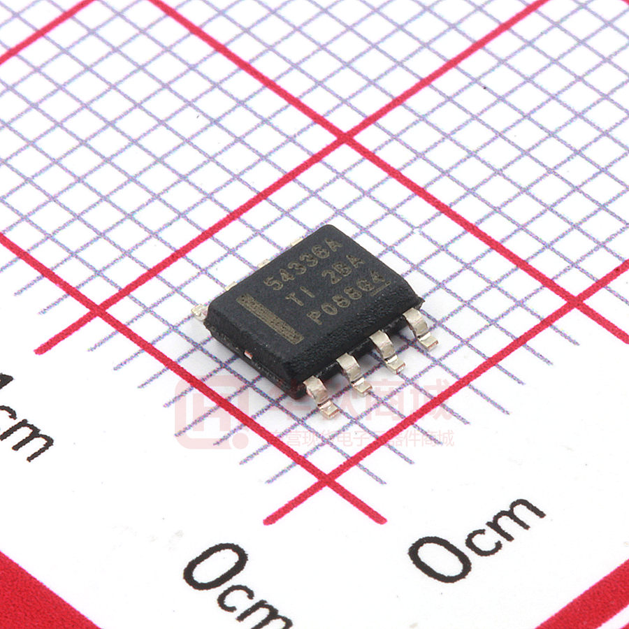

    TPS5433xA系列器件为同步转换器,输入电压范围介于4.5V和28V之间。该系列器件集成有低侧开关场效应晶体管(FET),免除了对外部二极管的需求,从而减少了组件数。通过使能引脚可以将关断电源电流...
TPS54336ADDAR 数据手册
Sample & Buy Product Folder Support & Community Tools & Software Technical Documents TPS54335A, TPS54335-1A, TPS54336A SLVSCD5D – NOVEMBER 2014 – REVISED FEBRUARY 2016 TPS5433xA 4.5-V to 28-V Input, 3-A Output, Synchronous Step-Down DC-DC Converter 1 Features 3 Description • The TPS5433xA family of devices are synchronous converters with an input-voltage range of 4.5 V to 28 V. These devices include This device has an integrated low-side switching FET that eliminates the need for an external diode which reduces component count. 1 • • • • • • • • • • • Synchronous 128-mΩ and 84-mΩ MOSFETs for 3-A Continuous Output Current TPS54335A: Internal 2-ms Soft-Start, 50-kHz to 1.5-MHz Adjustable Frequency TPS54336A: Adjustable Soft-Start, Fixed 340-kHz Frequency Low 2-µA Shutdown, Quiescent Current 0.8-V Voltage Reference with ±0.8% Accuracy Current Mode Control Monotonic Startup into Pre-Biased Outputs Pulse Skipping for Light-Load Efficiency Hiccup Mode Overcurrent Protection Thermal Shutdown (TSD) and Overvoltage Transition Protection 8-Pin SO PowerPAD™ and 10-Pin VSON Package Create a Custom Design Using the TPS54335A with the WEBENCH Power Designer Efficiency is maximized through the integrated 128mΩ and 84-mΩ MOSFETs, low IQ and pulse skipping at light loads. Using the enable pin, the shutdown supply current is reduced to 2 μA. This step-down (buck) converter provides accurate regulation for a variety of loads with a well-regulated voltage reference that is 1.5% over temperature. 2 Applications • • • • Consumer Applications such as a Digital TV (DTV), Set Top Box (STB, DVD/Blu-ray Player), LCD Display, CPE (Cable Modem, WiFi Router), DLP Projectors, Smart Meters Battery Chargers Industrial and Car Audio Power Supplies 5-V, 12-V, and 24-V Distributed Power Bus Supply Cycle-by-cycle current limiting on the high-side MOSFET protects the TPS5433xA family of devices in overload situations and is enhanced by a low-side sourcing current limit which prevents current runaway. A low-side sinking current-limit turns off the low-side MOSFET to prevent excessive reverse current. Hiccup protection is triggered if the overcurrent condition continues for longer than the preset time. Thermal shutdown disables the device when the die temperature exceeds the threshold and enables the device again after the built-in thermal hiccup time. Device Information(1) PART NUMBER PACKAGE TPS54335A TPS54336A BODY SIZE (NOM) SO PowerPAD (8) 4.89 mm × 3.90 mm VSON (10) 3.00 mm × 3.00 mm (2) TPS54335-1A VSON (10) 3.00 mm × 3.00 mm (1) For all available packages, see the orderable addendum at the end of the datasheet. (2) The DRC package for the TPS54335-1A device has a narrower heat-pad for more clearance between the pins and heat pad. See the Differences Between the Two DRC Packages section. Simplified Schematic VIN VIN VIN VIN C1 C1 TPS54335A TPS54336A BOOT EN C BOOT C BOOT LO PH RT R RT C2 SS COMP R O1 CC VSENSE RC GND C2 R O2 VOUT CO R O1 CC LO PH VOUT CO COMP BOOT EN C SS VSENSE R O2 RC GND 1 An IMPORTANT NOTICE at the end of this data sheet addresses availability, warranty, changes, use in safety-critical applications, intellectual property matters and other important disclaimers. PRODUCTION DATA. TPS54335A, TPS54335-1A, TPS54336A SLVSCD5D – NOVEMBER 2014 – REVISED FEBRUARY 2016 www.ti.com Table of Contents 1 2 3 4 5 6 7 Features .................................................................. Applications ........................................................... Description ............................................................. Revision History..................................................... Pin Configuration and Functions ......................... Specifications......................................................... 1 1 1 2 3 4 6.1 6.2 6.3 6.4 6.5 6.6 6.7 6.8 4 4 4 5 5 6 6 7 Absolute Maximum Ratings ..................................... ESD Ratings.............................................................. Recommended Operating Conditions....................... Thermal Information .................................................. Electrical Characteristics........................................... Timing Requirements ................................................ Switching Characteristics .......................................... Typical Characteristics .............................................. Detailed Description ............................................ 10 7.1 7.2 7.3 7.4 Overview ................................................................. Functional Block Diagram ....................................... Feature Description................................................. Device Functional Modes........................................ 10 11 11 21 8 Application and Implementation ........................ 22 8.1 Application Information............................................ 22 8.2 Typical Applications ................................................ 23 9 Power Supply Recommendations...................... 38 10 Layout................................................................... 39 10.1 Layout Guidelines ................................................. 39 10.2 Layout Example .................................................... 39 11 Device and Documentation Support ................. 40 11.1 11.2 11.3 11.4 11.5 11.6 11.7 11.8 11.9 Custom Design with WEBENCH Tools................. Receiving Notification of Documentation Updates Device Support...................................................... Documentation Support ........................................ Related Links ........................................................ Community Resource............................................ Trademarks ........................................................... Electrostatic Discharge Caution ............................ Glossary ................................................................ 40 40 40 40 40 40 41 41 41 12 Mechanical, Packaging, and Orderable Information ........................................................... 41 4 Revision History Changes from Revision C (March 2015) to Revision D • Page Deleted SWIFT™ from the data sheet title............................................................................................................................. 1 Changes from Revision B (August 2015) to Revision C • Page Added the TPS54335-1A device to the data sheet ............................................................................................................... 1 Changes from Revision A (December 2014) to Revision B Page • Deleted Selective Disclosure statement from data sheet and added the Related Links section ........................................... 1 • Changed the Device Functional Modes section .................................................................................................................. 21 • Changed the Power Supply Recommendations section ..................................................................................................... 38 Changes from Original (November 2014) to Revision A • 2 Page Changed the device status from Production Preview to Production Data.............................................................................. 1 Submit Documentation Feedback Copyright © 2014–2016, Texas Instruments Incorporated Product Folder Links: TPS54335A TPS54335-1A TPS54336A TPS54335A, TPS54335-1A, TPS54336A www.ti.com SLVSCD5D – NOVEMBER 2014 – REVISED FEBRUARY 2016 5 Pin Configuration and Functions DDA Package 8-Pin SO PowerPAD TPS54335A Top View BOOT 1 VIN 2 DDA Package 8-Pin SO PowerPAD TPS54336A Top View 8 RT BOOT 1 7 EN VIN 2 PowerPAD 3 6 COMP GND 4 5 VSENSE DRC Package 10-Pin VSON With Exposed Thermal Pad TPS54335A and TPS54335-1A Top View GND 3 GND 4 GND 5 EN PH 3 6 COMP GND 4 5 VSENSE VIN 1 9 BOOT Exposed Thermal Pad 7 DRC Package 10-Pin VSON With Exposed Thermal Pad TPS54336A Top View 10 RT PH 2 SS PowerPAD PH VIN 1 8 10 SS PH 2 8 EN GND 3 7 COMP GND 4 6 VSENSE GND 5 9 BOOT Exposed Thermal Pad 8 EN 7 COMP 6 VSENSE Table 1. Pin Functions PIN I/O DESCRIPTION 9 O A bootstrap capacitor is required between the BOOT and PH pins. If the voltage on this capacitor is below the minimum required by the output device, the output is forced to switch off until the capacitor is refreshed. 6 7 O This pin is the error-amplifier output and the input to the output switch-current comparator. Connect frequency compensation components to this pin. EN 7 8 I This pin is the enable pin. Float the EN pin to enable. GND 4 3 — Ground GND 4 4 — Ground GND 4 5 — Ground PH 3 2 O The PH pin is the source of the internal high-side power MOSFET. RT (TPS54335A and TPS54335-1A) 8 10 O Connect the RT pin to an external timing resistor to adjust the switching frequency of the device. SS (TPS54336A) 8 10 O The SS pin is the soft-start and tracking pin. An external capacitor connected to this pin sets the internal voltage-reference rise time. The voltage on this pin overrides the internal reference. VIN 2 1 — This pin is the 4.5- to 28-V input supply voltage. VSENSE 5 6 SO PowerPAD VSON BOOT 1 COMP NAME I PowerPAD (SO only) — Thermal pad (VSON only) — Copyright © 2014–2016, Texas Instruments Incorporated This pin is the inverting node of the transconductance (gm) error amplifier. For proper operation, connect the GND pin to the exposed thermal pad. This thermal pad should be connected to any internal PCB ground plane using multiple vias for good thermal performance. Submit Documentation Feedback Product Folder Links: TPS54335A TPS54335-1A TPS54336A 3 TPS54335A, TPS54335-1A, TPS54336A SLVSCD5D – NOVEMBER 2014 – REVISED FEBRUARY 2016 www.ti.com 6 Specifications 6.1 Absolute Maximum Ratings (1) Input voltage MIN MAX UNIT VIN –0.3 30 V EN –0.3 6 V BOOT –0.3 (VPH + 7.5) V VSENSE –0.3 3 V COMP –0.3 3 V RT –0.3 3 V SS –0.3 3 V BOOT-PH 0 7.5 V PH –1 30 V –3.5 30 V –0.2 0.2 V EN 100 100 µA RT 100 100 µA PH Current-limit A PH Current-limit A 200 200 µA Operating junction temperature –40 150 °C Storage temperature, Tstg –65 150 °C Output voltage PH, 10-ns transient VDIFF (GND to exposed thermal pad) Source current Sink current (1) COMP Stresses beyond those listed under the absolute maximum ratings may cause permanent damage to the device. These are stress ratings only, and functional operation of the device at these or any other conditions beyond those indicated under the recommended operating conditions is not implied. Exposure to absolute-maximum-rated conditions for extended periods may affect device reliability. 6.2 ESD Ratings VALUE V(ESD) (1) (2) Electrostatic discharge Human body model (HBM), per ANSI/ESDA/JEDEC JS–001, all pins (1) 2000 Charged device model (CDM), per JEDEC specification JESD22-C101, all pins (2) 500 UNIT V JEDEC document JEP155 states that 500-V HBM allows safe manufacturing with a standard ESD control process. JEDEC document JEP157 states that 250-V CDM allows safe manufacturing with a standard ESD control process. 6.3 Recommended Operating Conditions over operating free-air temperature range (unless otherwise noted) VSS Supply input voltage VOUT Output voltage IOUT TJ (1) 4 Output current Operating junction temperature (1) MIN MAX 4.5 28 UNIT V 0.8 24 V 0 3 A –40 150 °C The device must operate within 150°C to ensure continuous function and operation of the device. Submit Documentation Feedback Copyright © 2014–2016, Texas Instruments Incorporated Product Folder Links: TPS54335A TPS54335-1A TPS54336A TPS54335A, TPS54335-1A, TPS54336A www.ti.com SLVSCD5D – NOVEMBER 2014 – REVISED FEBRUARY 2016 6.4 Thermal Information over operating free-air temperature range (unless otherwise noted) TPS5433xA THERMAL METRIC RθJA Junction-to-ambient thermal resistance TPS5433xA and TPS54335-1A TPS54335-2A DDA (SO PowerPAD) DRC (VSON) DRC (VSON) 8 PINS 10 PINS 10 PINS UNIT 42.1 43.9 43.9 °C/W RθJC(top) Junction-to-case (top) thermal resistance 50.9 55.4 55.4 °C/W RθJB Junction-to-board thermal resistance 31.8 18.9 18.9 °C/W ψJT Junction-to-top characterization parameter 8 0.7 0.7 °C/W ψJB Junction-to-board characterization parameter 13.5 19.1 19.1 °C/W RθJC(bot) Junction-to-case (bottom) thermal resistance 7.1 5.3 5.3 °C/W 6.5 Electrical Characteristics The electrical ratings specified in this section apply to all specifications in this document unless otherwise noted. These specifications are interpreted as conditions that will not degrade the parametric or functional specifications of the device for the life of the product containing it. TJ = –40°C to 150°C, VIN = 4.5 to 28 V, (unless otherwise noted) PARAMETER TEST CONDITIONS MIN TYP MAX UNIT 4 4.5 V 180 400 mV 2 10 µA 310 800 µA 1.21 1.28 V SUPPLY VOLTAGE AND UVLO (VIN PIN) Operating input voltage 4.5 Input UVLO threshold Rising VIN Input UVLO hysteresis VIN-shutdown supply current VEN = 0 V VIN-operating non-switching supply current VVSENSE = 810 mV 28 V ENABLE (EN PIN) Enable threshold Rising Enable threshold Falling Input current Hysteresis current 1.1 1.17 V VEN = 1.1 V 1.15 µA VEN = 1.3 V 3.3 µA VOLTAGE REFERENCE TJ =25°C Reference 0.7936 0.788 0.8 0.8064 V 0.8 0.812 V(BOOT-PH) = 3 V 160 280 mΩ V(BOOT-PH) = 6 V 128 230 mΩ 84 170 mΩ MOSFET High-side switch resistance (1) Low-side switch resistance (1) VIN = 12 V ERROR AMPLIFIER Error-amplifier transconductance (gm) –2 µA < ICOMP < 2 µA, VCOMP = 1 V Error-amplifier source and sink VCOMP = 1 V, 100-mV overdrive Start switching peak current threshold 1300 µmhos 100 µA 0.5 COMP to ISWITCH gm A 8 A/V CURRENT-LIMIT High-side switch current-limit threshold Low-side switch sourcing current-limit Low-side switch sinking current-limit (1) 4 4.9 6.5 A 3.5 4.7 6.1 A 0 A Measured at pins Copyright © 2014–2016, Texas Instruments Incorporated Submit Documentation Feedback Product Folder Links: TPS54335A TPS54335-1A TPS54336A 5 TPS54335A, TPS54335-1A, TPS54336A SLVSCD5D – NOVEMBER 2014 – REVISED FEBRUARY 2016 www.ti.com Electrical Characteristics (continued) The electrical ratings specified in this section apply to all specifications in this document unless otherwise noted. These specifications are interpreted as conditions that will not degrade the parametric or functional specifications of the device for the life of the product containing it. TJ = –40°C to 150°C, VIN = 4.5 to 28 V, (unless otherwise noted) PARAMETER TEST CONDITIONS MIN TYP MAX UNIT 160 175 °C 10 °C THERMAL SHUTDOWN Thermal shutdown Thermal shutdown hysteresis BOOT PIN BOOT-PH UVLO 2.1 3 V SOFT START Soft-start charge current, TPS54336A 2.3 µA 6.6 Timing Requirements MIN TYP MAX UNIT CURRENT-LIMIT Hiccup wait time Hiccup time before restart 512 Cycles 16384 Cycles 32768 Cycles THERMAL SHUTDOWN Thermal shutdown hiccup time SOFT START Internal soft-start time, TPS54335A and TPS54335-1A 2 ms 6.7 Switching Characteristics over operating free-air temperature range (unless otherwise noted) PARAMETER TEST CONDITIONS MIN TYP MAX UNIT 145 ns 1500 kHz 576 kHz PH PIN Minimum on time Measured at 90% to 90% of VIN, IPH = 2 A Minimum off time V(BOOT-PH) ≥ 3 V 94 0% SWITCHING FREQUENCY 50 Switching frequency range, TPS54335A and TPS54335-1A R(RT) = 100 kΩ 384 R(RT) = 1000 kΩ, –40°C to 105°C R(RT) = 30 kΩ Internal switching frequency, TPS54336A 6 Submit Documentation Feedback 480 40 50 60 kHz 1200 1500 1800 kHz 272 340 408 kHz Copyright © 2014–2016, Texas Instruments Incorporated Product Folder Links: TPS54335A TPS54335-1A TPS54336A TPS54335A, TPS54335-1A, TPS54336A www.ti.com SLVSCD5D – NOVEMBER 2014 – REVISED FEBRUARY 2016 6.8 Typical Characteristics 140 210 130 190 On Resistance (m On Resistance (m 120 170 150 130 110 100 90 80 70 90 60 50 70 ±50 ±25 0 25 50 75 100 125 Junction Temperature (ƒC) ±50 150 ±25 0 25 50 75 100 125 Junction Temperature (ƒC) C001 150 C002 VIN = 12 V VIN = 12 V Figure 2. Low-Side MOSFET on Resistance vs Junction Temperature Figure 1. High-Side MOSFET on Resistance vs Junction Temperature 0.808 495 Oscillator Frequency (kHz) Voltage Reference (V) 110 0.804 0.800 0.796 0.792 490 485 480 475 470 465 ±50 ±25 0 25 50 75 100 125 Junction Temperature (ƒC) ±50 150 ±25 0 25 50 75 100 125 Junction Temperature (ƒC) C003 Figure 3. Voltage Reference vs Junction Temperature 150 C004 Figure 4. Oscillator Frequency vs Junction Temperature 1.230 3.50 Hysteresis Current ( A) EN-UVLO Threshold (V) 3.45 1.225 1.220 1.215 3.40 3.35 3.30 3.25 1.210 3.20 ±50 ±25 0 25 50 75 100 Junction Temperature (ƒC) 125 150 ±50 ±25 VIN = 12 V 0 25 50 75 100 125 Junction Temperature (ƒC) C005 150 C006 VIN = 12 V Figure 5. UVLO Threshold vs Junction Temperature Copyright © 2014–2016, Texas Instruments Incorporated Figure 6. Hysteresis Current vs Junction Temperature Submit Documentation Feedback Product Folder Links: TPS54335A TPS54335-1A TPS54336A 7 TPS54335A, TPS54335-1A, TPS54336A SLVSCD5D – NOVEMBER 2014 – REVISED FEBRUARY 2016 www.ti.com Typical Characteristics (continued) 400 Non-Switching Operating Quiescent Current ( A) Pullup Current ( A) 1.2 1.175 1.15 1.125 1.1 350 300 250 T TJ = ±40ƒC ±40ƒC J = T TJ = 25ƒC 25ƒC J = T TJ = 150ƒC 150ƒC J = 200 ±50 ±25 0 25 50 75 100 125 150 Junction Temperature (ƒC) 4 8 12 16 20 24 Input Voltage (V) C007 28 C008 VIN = 12 V Figure 7. Pullup Current vs Junction Temperature 2.40 ±40ƒC TTJ J ==±40ƒC 25ƒC TTJ J ==25ƒC TTJ 150ƒC J ==150ƒC 8 SS Charge Current ( A) Shutdown Quiescent Current ( A) 10 Figure 8. Non-Switching Operating Quiescent Current vs Input Voltage 6 4 2 0 2.35 2.30 2.25 2.20 4 8 12 16 20 24 Input Voltage (V) ±50 28 ±25 0 25 50 75 100 125 Junction Temperature (ƒC) C009 150 C010 VEN = 0 V Figure 9. Shutdown Quiescent Current vs Input Voltage Figure 10. SS Charge Current vs Junction Temperature 6.0 Minimum Controllable Duty Ratio (%) Minimum Controllable On Time (ns) 120 110 100 90 80 70 4.0 3.0 ±50 ±25 0 25 50 75 Junction Temperature (ƒ) 100 125 150 ±50 ±25 0 25 50 75 100 Junction Temperature (ƒC) C011 VIN = 12 V 125 150 C012 VIN = 12 V Figure 11. Minimum Controllable On Time vs Junction Temperature 8 5.0 Submit Documentation Feedback Figure 12. Minimum Controllable Duty Ratio vs Junction Temperature Copyright © 2014–2016, Texas Instruments Incorporated Product Folder Links: TPS54335A TPS54335-1A TPS54336A TPS54335A, TPS54335-1A, TPS54336A www.ti.com SLVSCD5D – NOVEMBER 2014 – REVISED FEBRUARY 2016 Typical Characteristics (continued) 6.0 Current-Limit Threshold (A) BOOT-PH UVLO Threshhold ( A) 2.3 2.2 2.1 = -40ƒ TJTJ = –40°C TJTJ = 25 °C = 25ƒ TJTJ = 150 °C = 150ƒ 5.5 5.0 4.5 4.0 2.0 ±50 ±25 0 25 50 75 100 Junction Temperature (ƒC) 125 150 8 12 16 20 24 Input Voltage (V) C013 Figure 13. BOOT-PH UVLO Threshold vs Junction Temperature Copyright © 2014–2016, Texas Instruments Incorporated 4 28 C014 Figure 14. Current Limit Threshold vs Input Voltage Submit Documentation Feedback Product Folder Links: TPS54335A TPS54335-1A TPS54336A 9 TPS54335A, TPS54335-1A, TPS54336A SLVSCD5D – NOVEMBER 2014 – REVISED FEBRUARY 2016 www.ti.com 7 Detailed Description 7.1 Overview The device is a 28-V, 3-A, synchronous step-down (buck) converter with two integrated n-channel MOSFETs. To improve performance during line and load transients the device implements a constant-frequency, peak currentmode control which reduces output capacitance and simplifies external frequency-compensation design. The device has been designed for safe monotonic startup into pre-biased loads. The device has a typical default startup voltage of 4 V. The EN pin has an internal pullup-current source that can provide a default condition when the EN pin is floating for the device to operate. The total operating current for the device is 310 µA (typical) when not switching and under no load. When the device is disabled, the supply current is less than 5 μA. The integrated 128-mΩ and 84-mΩ MOSFETs allow for high-efficiency power-supply designs with continuous output currents up to 3 A. The device reduces the external component count by integrating the boot recharge diode. The bias voltage for the integrated high-side MOSFET is supplied by a capacitor between the BOOT and PH pins. The boot capacitor voltage is monitored by an UVLO circuit and turns off the high-side MOSFET when the voltage falls below a preset threshold. The output voltage can be stepped down to as low as the 0.8-V reference voltage. The device minimizes excessive output overvoltage transients by taking advantage of the overvoltage powergood comparator. When the regulated output voltage is greater than 106% of the nominal voltage, the overvoltage comparator is activated, and the high-side MOSFET is turned off and masked from turning on until the output voltage is lower than 104%. The TPS54335A device has a wide switching frequency of 50 kHz to 1500 kHz which allows for efficiency and size optimization when selecting the output filter components. The internal 2-ms soft-start time is implemented to minimize inrush currents. The TPS54336A device has a fixed 340-kHz switching frequency. The device adjusts the soft-start time with the SS pin. 10 Submit Documentation Feedback Copyright © 2014–2016, Texas Instruments Incorporated Product Folder Links: TPS54335A TPS54335-1A TPS54336A TPS54335A, TPS54335-1A, TPS54336A www.ti.com SLVSCD5D – NOVEMBER 2014 – REVISED FEBRUARY 2016 7.2 Functional Block Diagram VIN EN Ip Ih Enable Comparator Thermal Hiccup UVLO Shutdown Logic Hiccup Shutdown Enable Threshold OV Boot Charge Current Sense Minimum Clamp Pulse Skip ERROR AMPLIFIER VSENSE SS (TPS54336A) BOOT Boot UVLO + + HS MOSFET Current Comparator Voltage Reference Power Stage and Deadtime Control Logic PH Slope Compensation VIN Hiccup Shutdown Overload Maximum Recovery Clamp Oscillator Regulator LS MOSFET Current-Limit Current Sense GND COMP RT (TPS54335A) EXPOSED THERMAL PAD 7.3 Feature Description 7.3.1 Fixed-Frequency PWM Control The device uses a fixed-frequency, peak current-mode control. The output voltage is compared through external resistors on the VSENSE pin to an internal voltage reference by an error amplifier which drives the COMP pin. An internal oscillator initiates the turn on of the high-side power switch. The error amplifier output is compared to the current of the high-side power switch. When the power-switch current reaches the COMP voltage level the high-side power switch is turned off and the low-side power switch is turned on. The COMP pin voltage increases and decreases as the output current increases and decreases. The device implements a current-limit by clamping the COMP pin voltage to a maximum level and also implements a minimum clamp for improved transient-response performance. 7.3.2 Light-Load Operation The device monitors the peak switch current of the high-side MOSFET. When the peak switch current is lower than 0.5 A (typical), the device stops switching to boost the efficiency until the peak switch current again rises higher than 0.5 A (typical). Copyright © 2014–2016, Texas Instruments Incorporated Submit Documentation Feedback Product Folder Links: TPS54335A TPS54335-1A TPS54336A 11 TPS54335A, TPS54335-1A, TPS54336A SLVSCD5D – NOVEMBER 2014 – REVISED FEBRUARY 2016 www.ti.com Feature Description (continued) 7.3.3 Voltage Reference The voltage-reference system produces a precise ±1.5% voltage-reference over temperature by scaling the output of a temperature-stable bandgap circuit. 7.3.4 Adjusting the Output Voltage The output voltage is set with a resistor divider from the output node to the VSENSE pin. Using divider resistors with 1% tolerance or better is recommended. Begin with a value of 10 kΩ for the upper resistor divider, R1, and use Equation 1 to calculate the value of R2. Consider using larger value resistors to improve efficiency at light loads. If the values are too high then the regulator is more susceptible to noise and voltage errors from the VSENSE input current are noticeable. VREF R2 = ´ R1 VOUT - VREF (1) 12 Submit Documentation Feedback Copyright © 2014–2016, Texas Instruments Incorporated Product Folder Links: TPS54335A TPS54335-1A TPS54336A TPS54335A, TPS54335-1A, TPS54336A www.ti.com SLVSCD5D – NOVEMBER 2014 – REVISED FEBRUARY 2016 Feature Description (continued) 7.3.5 Enabling and Adjusting Undervoltage Lockout The EN pin provides electrical on and off control of the device. When the EN pin voltage exceeds the threshold voltage, the device begins operation. If the EN pin voltage is pulled below the threshold voltage, the regulator stops switching and enters the low-quiescent (IQ) state. The EN pin has an internal pullup-current source which allows the user to float the EN pin to enable the device. If an application requires control of the EN pin, use open-drain or open-collector output logic to interface with the pin. The device implements internal undervoltage-lockout (UVLO) circuitry on the VIN pin. The device is disabled when the VIN pin voltage falls below the internal VIN UVLO threshold. The internal VIN UVLO threshold has a hysteresis of 180 mV. If an application requires a higher UVLO threshold on the VIN pin, then the EN pin can be configured as shown in Figure 15. When using the external UVLO function, setting the hysteresis at a value greater than 500 mV is recommended. The EN pin has a small pullup-current, Ip, which sets the default state of the pin to enable when no external components are connected. The pullup current is also used to control the voltage hysteresis for the UVLO function because it increases by Ih when the EN pin crosses the enable threshold. Use Equation 2, and Equation 3 to calculate the values of R1 and R2 for a specified UVLO threshold. Device VIN Ip Ih R1 R2 EN Figure 15. Adjustable VIN Undervoltage Lockout æ VENfalling ö VSTART ç ÷ - VSTOP ç VENrising ÷ è ø R1 = æ VENfalling ö Ip ç1 ÷ + Ih ç VENrising ÷ø è where • • • • IP = 1.15 μA IH = 3.3 μA VENfalling = 1.17 V VENrising = 1.21 V (2) R1´ VENfalling R2 = VSTOP - VENfalling + R1(Ip + Ih ) where • • • • IP = 1.15 μA IH = 3.3 μA VENfalling = 1.17 V VENrising = 1.21 V (3) Copyright © 2014–2016, Texas Instruments Incorporated Submit Documentation Feedback Product Folder Links: TPS54335A TPS54335-1A TPS54336A 13 TPS54335A, TPS54335-1A, TPS54336A SLVSCD5D – NOVEMBER 2014 – REVISED FEBRUARY 2016 www.ti.com Feature Description (continued) 7.3.6 Error Amplifier The device has a transconductance amplifier as the error amplifier. The error amplifier compares the VSENSE voltage to the lower of the internal soft-start voltage or the internal 0.8-V voltage reference. The transconductance of the error amplifier is 1300 μA/V (typical). The frequency compensation components are placed between the COMP pin and ground. 7.3.7 Slope Compensation and Output Current The device adds a compensating ramp to the signal of the switch current. This slope compensation prevents subharmonic oscillations as the duty cycle increases. The available peak inductor current remains constant over the full duty-cycle range. 7.3.8 Safe Startup into Pre-Biased Outputs The device has been designed to prevent the low-side MOSFET from discharging a pre-biased output. During monotonic pre-biased startup, both high-side and low-side MOSFETs are not allowed to be turned on until the internal soft-start voltage (TPS54335A), or SS pin voltage (TPS54336A) is higher than VSENSE pin voltage. 7.3.9 Bootstrap Voltage (BOOT) The device has an integrated boot regulator. The boot regulator requires a small ceramic capacitor between the BOOT and PH pins to provide the gate-drive voltage for the high-side MOSFET. The boot capacitor is charged when the BOOT pin voltage is less than the VIN voltage and when the BOOT-PH voltage is below regulation. The value of this ceramic capacitor should be 0.1 μF. A ceramic capacitor with an X7R or X5R grade dielectric with a voltage rating of 10 V or higher is recommended because of the stable characteristics over temperature and voltage. When the voltage between BOOT and PH pins drops below the BOOT-PH UVLO threshold, which is 2.1 V (typical), the high-side MOSFET turns off and the low-side MOSFET turns on, allowing the boot capacitor to recharge. 14 Submit Documentation Feedback Copyright © 2014–2016, Texas Instruments Incorporated Product Folder Links: TPS54335A TPS54335-1A TPS54336A TPS54335A, TPS54335-1A, TPS54336A www.ti.com SLVSCD5D – NOVEMBER 2014 – REVISED FEBRUARY 2016 Feature Description (continued) 7.3.10 Adjustable Switching Frequency (TPS54335A Only) To determine the RT resistance, RRT, for a given switching frequency, use or the curve in . To reduce the solution size, set the switching frequency as high as possible, but consider the tradeoffs of the supply efficiency and minimum controllable on time. RRT (kW) = 55300 ´ ƒSW -1.025 (kHz) (4) RT Set Resistance (k ) 1000 800 600 400 200 0 0 250 500 750 1000 Oscillator Frequency (kHz) 1250 1500 C026 Figure 16. RT Set Resistor vs Switching Frequency 7.3.11 Soft-Start (TPS54336A Only) The TPS54336A device uses the lower voltage of the internal voltage reference or the SS pin voltage as the reference voltage and regulates the output accordingly. A capacitor on the SS pin to ground implements a softstart time. The device has an internal pullup current source of 2.3 μA that charges the external soft-start capacitor. Use to calculate the soft time (tSS, 10% to 90%) and soft capacitor (CSS). C (nF) ´ VREF (V) t SS (ms) = SS ISS (µA) where • • VREF is the voltage reference (0.8 V) ISS is the soft-start charge current (2.3 μA) (5) When the input UVLO is triggered, the device stops switching and enters low-current operation when either the EN pin is pulled below 1.21 V or a thermal-shutdown event occurs. At the subsequent power-up, when the shutdown condition is removed, the device does not begin switching until it has discharged the SS pin to ground ensuring proper soft-start behavior. 7.3.12 Output Overvoltage Protection (OVP) The device incorporates an output overvoltage-protection (OVP) circuit to minimize output voltage overshoot. For example, when the power-supply output is overloaded, the error amplifier compares the actual output voltage to the internal reference voltage. If the VSENSE pin voltage is lower than the internal reference voltage for a considerable time, the output of the error amplifier demands maximum output current. When the condition is removed, the regulator output rises and the error-amplifier output transitions to the steady-state voltage. In some applications with small output capacitance, the power-supply output voltage can respond faster than the error amplifier which leads to the possibility of an output overshoot. The OVP feature minimizes the overshoot by comparing the VSENSE pin voltage to the OVP threshold. If the VSENSE pin voltage is greater than the OVP threshold, the high-side MOSFET is turned off which prevents current from flowing to the output and minimizes output overshoot. When the VSENSE voltage drops lower than the OVP threshold, the high-side MOSFET is allowed to turn on at the next clock cycle. Copyright © 2014–2016, Texas Instruments Incorporated Submit Documentation Feedback Product Folder Links: TPS54335A TPS54335-1A TPS54336A 15 TPS54335A, TPS54335-1A, TPS54336A SLVSCD5D – NOVEMBER 2014 – REVISED FEBRUARY 2016 www.ti.com Feature Description (continued) 7.3.13 Overcurrent Protection The device is protected from overcurrent conditions by cycle-by-cycle current limiting on both the high-side MOSFET and the low-side MOSFET. 16 Submit Documentation Feedback Copyright © 2014–2016, Texas Instruments Incorporated Product Folder Links: TPS54335A TPS54335-1A TPS54336A TPS54335A, TPS54335-1A, TPS54336A www.ti.com SLVSCD5D – NOVEMBER 2014 – REVISED FEBRUARY 2016 Feature Description (continued) 7.3.13.1 High-Side MOSFET Overcurrent Protection The device implements current mode control which uses the COMP pin voltage to control the turn off of the highside MOSFET and the turn on of the low-side MOSFET on a cycle-by-cycle basis. During each cycle, the switch current and the current reference generated by the COMP pin voltage are compared. When the peak switch current intersects the current reference the high-side switch turns off. 7.3.13.2 Low-Side MOSFET Overcurrent Protection While the low-side MOSFET is turned on, the conduction current is monitored by the internal circuitry. During normal operation the low-side MOSFET sources current to the load. At the end of every clock cycle, the low-side MOSFET sourcing current is compared to the internally set low-side sourcing current-limit. If the low-side sourcing current-limit is exceeded, the high-side MOSFET does not turn on and the low-side MOSFET stays on for the next cycle. The high-side MOSFET turns on again when the low-side current is below the low-side sourcing current-limit at the start of a cycle. The low-side MOSFET can also sink current from the load. If the low-side sinking current-limit is exceeded the low-side MOSFET turns off immediately for the remainder of that clock cycle. In this scenario, both MOSFETs are off until the start of the next cycle. Furthermore, if an output overload condition (as measured by the COMP pin voltage) occurs for more than the hiccup wait time, which is programmed for 512 switching cycles, the device shuts down and restarts after the hiccup time of 16384 cycles. The hiccup mode helps to reduce the device power dissipation under severe overcurrent conditions. 7.3.14 Thermal Shutdown The internal thermal-shutdown circuitry forces the device to stop switching if the junction temperature exceeds 175°C typically. When the junction temperature drops below 165°C typically, the internal thermal-hiccup timer begins to count. The device reinitiates the power-up sequence after the built-in thermal-shutdown hiccup time (32768 cycles) is over. 7.3.15 Small-Signal Model for Loop Response Figure 17 shows an equivalent model for the device control loop which can be modeled in a circuit-simulation program to check frequency and transient responses. The error amplifier is a transconductance amplifier with a gm of 1300 μA/V. The error amplifier can be modeled using an ideal voltage-controlled current source. The resistor, Roea (3.07 MΩ), and capacitor, Coea (20.7 pF), model the open-loop gain and frequency response of the error amplifier. The 1-mV AC-voltage source between the nodes a and b effectively breaks the control loop for the frequency response measurements. Plotting ac-c and c-b show the small-signal responses of the power stage and frequency compensation respectively. Plotting a-b shows the small-signal response of the overall loop. The dynamic loop response can be checked by replacing the load resistance, RL, with a current source with the appropriate load-step amplitude and step rate in a time-domain analysis. PH Power Stage 8 A/V VOUT a RESR b R1 c COMP RL VSENSE + VREF R3 C2 CO Coea C1 Roea gmea 1300 µA/V R2 Figure 17. Small-Signal Model For Loop Response Copyright © 2014–2016, Texas Instruments Incorporated Submit Documentation Feedback Product Folder Links: TPS54335A TPS54335-1A TPS54336A 17 TPS54335A, TPS54335-1A, TPS54336A SLVSCD5D – NOVEMBER 2014 – REVISED FEBRUARY 2016 www.ti.com Feature Description (continued) 7.3.16 Simple Small-Signal Model for Peak Current-Mode Control Figure 18 is a simple small-signal model that can be used to understand how to design the frequency compensation. The device power stage can be approximated to a voltage-controlled current-source (duty-cycle modulator) supplying current to the output capacitor and load resistor. The control-to-output transfer function is shown in Equation 6 and consists of a DC gain, one dominant pole and one ESR zero. The quotient of the change in switch current and the change in the COMP pin voltage (node c in Figure 17) is the power-stage transconductance (gmps) which is 8 A/V for the device. The DC gain of the power stage is the product of gmps and the load resistance, RL, with resistive loads as shown in Equation 7. As the load current increases, the DC gain decreases. This variation with load may seem problematic at first glance, but fortunately the dominant pole moves with the load current (see Equation 8). The combined effect is highlighted by the dashed line in Figure 19. As the load current decreases, the gain increases and the pole frequency lowers, keeping the 0-dB crossover frequency the same for the varying load conditions which makes designing the frequency compensation easier. VOUT VC RESR RL gmps CO Figure 18. Simplified Small-Signal Model for Peak Current-Mode Control VOUT Adc VC RESR ƒp RL gmps CO ƒz Figure 19. Simplified Frequency Response for Peak Current-Mode Control æ ö s ç1 + ÷ 2p ´ ƒ z ø VOUT è = Adc ´ VC æ ö s ç1 + ÷ ç 2p ´ ƒp ÷ø è Adc = gmps ´ RL (6) where • • ƒp = 18 gmps is the power stage gain (8 A/V) RL is the load resistance CO (7) 1 ´ RL ´ 2p Submit Documentation Feedback Copyright © 2014–2016, Texas Instruments Incorporated Product Folder Links: TPS54335A TPS54335-1A TPS54336A TPS54335A, TPS54335-1A, TPS54336A www.ti.com SLVSCD5D – NOVEMBER 2014 – REVISED FEBRUARY 2016 Feature Description (continued) where • CO is the output capacitance (8) 1 CO ´ RESR ´ 2p ƒz = where • RESR is the equivalent series resistance of the output capacitor (9) 7.3.17 Small-Signal Model for Frequency Compensation The device uses a transconductance amplifier for the error amplifier and readily supports two of the commonly used Type II compensation circuits and a Type III frequency compensation circuit, as shown in Figure 20. In Type 2A, one additional high frequency pole, C6, is added to attenuate high frequency noise. In Type III, one additional capacitor, C11, is added to provide a phase boost at the crossover frequency. See Designing Type III Compensation for Current Mode Step-Down Converters (SLVA352) for a complete explanation of Type III compensation. The following design guidelines are provided for advanced users who prefer to compensate using the general method. The following equations only apply to designs whose ESR zero is above the bandwidth of the control loop which is usually true with ceramic output capacitors. VOUT C11 R8 VSENSE COMP Type III R9 VREF Type 2A Type 2B + R4 gmea Roea Coea R4 C6 C4 C4 Figure 20. Types of Frequency Compensation Copyright © 2014–2016, Texas Instruments Incorporated Submit Documentation Feedback Product Folder Links: TPS54335A TPS54335-1A TPS54336A 19 TPS54335A, TPS54335-1A, TPS54336A SLVSCD5D – NOVEMBER 2014 – REVISED FEBRUARY 2016 www.ti.com Feature Description (continued) The general design guidelines for device loop compensation are as follows: 1. Determine the crossover frequency, ƒc. A good starting value for ƒc is 1/10th of the switching frequency, ƒSW. 2. Use Equation 10 to calculate the value of R4. 2p ´ ƒc ´ VOUT ´ CO R4 = gmea ´ VREF ´ gmps where • • • gmea is the GM amplifier gain (1300 μA/V) gmps is the power stage gain (8 A/V) VREF is the reference voltage (0.8 V) (10) 3. Place a compensation zero at the dominant pole and use Equation 11 to calculate the value of ƒp. æ ö 1 ç ƒp = ÷ CO ´ RL ´ 2p ø è (11) 4. Use Equation 12 to calculate the value of C4. R ´ CO C4 = L (12) R4 5. The use of C6 is optional. C6 can be used to cancel the zero from the ESR (equivalent series resistance) of the output capacitor CO. If used, use Equation 13 to calculate the value of C6. ´ CO R C6 = ESR (13) R4 6. Type III compensation can be implemented with the addition of one capacitor, C11. The use of C11 allows for slightly higher loop bandwidths and higher phase margins. If used, use Equation 14 to calculate the value of C11. 1 C11 = (2 ´ p ´ R8 ´ ƒC ) (14) 20 Submit Documentation Feedback Copyright © 2014–2016, Texas Instruments Incorporated Product Folder Links: TPS54335A TPS54335-1A TPS54336A TPS54335A, TPS54335-1A, TPS54336A www.ti.com SLVSCD5D – NOVEMBER 2014 – REVISED FEBRUARY 2016 7.4 Device Functional Modes 7.4.1 Operation With VI < 4.5 V (minimum VI) The device is designed to operate with input voltages above 4.5 V. The typical VIN UVLO threshold is 4V and if VIN falls below this threshold the device stops switching. If the EN pin voltage is above EN threshold the device becomes active when the VIN pin passes the UVLO threshold. . 7.4.2 Operation With EN Control The enable threshold is 1.2-V typical. If the EN pin voltage is below this threshold the device does not switch even though the Vin is above the UVLO threshold. The IC quiescent current is reduced in this state. Once the EN is above the threshold with VIN above UVLO threshold the device is active again and the soft-start sequence is initiated. Copyright © 2014–2016, Texas Instruments Incorporated Submit Documentation Feedback Product Folder Links: TPS54335A TPS54335-1A TPS54336A 21 TPS54335A, TPS54335-1A, TPS54336A SLVSCD5D – NOVEMBER 2014 – REVISED FEBRUARY 2016 www.ti.com 8 Application and Implementation NOTE Information in the following applications sections is not part of the TI component specification, and TI does not warrant its accuracy or completeness. TI’s customers are responsible for determining suitability of components for their purposes. Customers should validate and test their design implementation to confirm system functionality. 8.1 Application Information The TPS5433xA family of devices are step-down DC-DC converters. The devices are typically used to convert a higher DC voltage to a lower DC voltage with a maximum available output current of 3 A. Use the following design procedure to select component values for each device. Alternately, use the WEBENCH software to generate a complete design. The WEBENCH software uses an iterative design procedure and accesses a comprehensive database of components when generating a design. This section presents a simplified discussion of the design process. 8.1.1 Supplementary Guidance The device must operate within 150°C to ensure continuous function and operation of the device. 8.1.2 Differences Between the Two DRC Packages The TPS54335A and TPS54335-1A devices are packaged in the same 3-mm × 3-mm SON package family which is designated as DRC (see the Mechanical, Packaging, and Orderable Information section for all package options). However, these two DRC packages are not exactly the same. The difference between these two DRC packages is the clearance between the pins and heat pad. Figure 21 shows a side-by-side picture of these two packages. In some applications, controlling the amount of solder paste during the assembly process of an application board is difficult. The risk of a pin-to-heat pad short (solder bridge) is possible in such an assembly process. The TPS54335-1A device is intended to support this type of application by having wider clearance. NOTE This heat-pad shape is the only difference between the TPS54335A and TPS54335-1A devices. The electrical functions and performances of both devices are the same. The thermal resistance and parameter values between these two packages are almost the same with negligible differences. TPS54335A TPS54336A TPS54335-1A 1mm Figure 21. Difference Between the Two DRC Packages 22 Submit Documentation Feedback Copyright © 2014–2016, Texas Instruments Incorporated Product Folder Links: TPS54335A TPS54335-1A TPS54336A TPS54335A, TPS54335-1A, TPS54336A www.ti.com SLVSCD5D – NOVEMBER 2014 – REVISED FEBRUARY 2016 8.2 Typical Applications TPS5433xA and TPS54335-1A typical application. The application designs for the TPS54335A, TPS54335-1A, and TPS54336A devices are identical. The design for the TPS54336A device has small difference which is described in the section. U1 TPS54335ADDA VIN = 8 to 28 V 2 VIN C1 10 µF VSENSE C2 0.1 µF R1 220 kΩ 5 7 8 VIN VSENSE BOOT PH EN COMP RT GND PAD L1 15 µH C3 0.1 µF VOUT = 5 V, 3 A max 1 VOUT 3 C6 47 µF 6 C7 47 µF 4 R3 3.74 kΩ R5 100 kΩ C5 120 pF R2 43.2 kΩ R4 51.1 Ω R7 143 kΩ VSENSE C4 0.012 µF R6 19.1 kΩ Figure 22. Typical Application Schematic, TPS54335A and TPS54335-1A 8.2.1 Design Requirements For this design example, use the parameters listed in Table 2. Table 2. Design Parameters DESIGN PARAMETER EXAMPLE VALUE Input voltage range 8 to 28 V Output voltage 5V Transient response, 1.5-A load step ΔVO = ±5 % Input ripple voltage 400 mV Output ripple voltage 30 mV Output current rating 3A Operating Frequency 340 kHz Copyright © 2014–2016, Texas Instruments Incorporated Submit Documentation Feedback Product Folder Links: TPS54335A TPS54335-1A TPS54336A 23 TPS54335A, TPS54335-1A, TPS54336A SLVSCD5D – NOVEMBER 2014 – REVISED FEBRUARY 2016 www.ti.com 8.2.2 Detailed Design Procedure The following design procedure can be used to select component values for the TPS54335A and TPS54336A devices. Alternately, the WEBENCH® software may be used to generate a complete design. The WEBENCH software uses an iterative design procedure and accesses a comprehensive database of components when generating a design. This section presents a simplified discussion of the design process using the TPS54335A device. For this design example, use the input parameters listed in Table 2. 8.2.2.1 Custom Design with WEBENCH Tools Click here to create a custom design using the TPS54335A device with the WEBENCH® Power Designer. 1. Start by entering your VIN, VOUT and IOUT requirements. 2. Optimize your design for key parameters like efficiency, footprint and cost using the optimizer dial and compare this design with other possible solutions from Texas Instruments. 3. WEBENCH Power Designer provides you with a customized schematic along with a list of materials with real time pricing and component availability. 4. In most cases, you will also be able to: – Run electrical simulations to see important waveforms and circuit performance, – Run thermal simulations to understand the thermal performance of your board, – Export your customized schematic and layout into popular CAD formats, – Print PDF reports for the design, and share your design with colleagues. 5. Get more information about WEBENCH tools at www.ti.com/webench. 8.2.2.2 Switching Frequency The switching frequency of the TPS54335A device is set at 340 kHz to match the internally set frequency of the TPS54336A device for this design. Use to calculate the required value for R7. The calculated value is 140.6 kΩ. Use the next higher standard value of 143 kΩ for R7. 8.2.2.3 Output Voltage Set Point The output voltage of the TPS54335A device is externally adjustable using a resistor divider network. In the application circuit of , this divider network is comprised of R5 and R6. Use Equation 15 and Equation 16 to calculate the relationship of the output voltage to the resistor divider. R5 ´ Vref R6 = VOUT - Vref (15) é R5 ù VOUT = Vref ´ ê +1ú ë R6 û (16) Select a value of R5 to be approximately 100 kΩ. Slightly increasing or decreasing R5 can result in closer outputvoltage matching when using standard value resistors. In this design, R5 = 100 kΩ and R6 = 19.1 kΩ which results in a 4.988-V output voltage. The 51.1-Ω resistor, R4, is provided as a convenient location to break the control loop for stability testing. 8.2.2.4 Undervoltage Lockout Set Point The undervoltage lockout (UVLO) set point can be adjusted using the external-voltage divider network of R1 and R2. R1 is connected between the VIN and EN pins of the TPS54335A device. R2 is connected between the EN and GND pins. The UVLO has two thresholds, one for power up when the input voltage is rising and one for power down or brown outs when the input voltage is falling. For the example design, the minimum input voltage is 8 V, so the start-voltage threshold is set to 7.15 V with 1-V hysteresis. Use Equation 2 and Equation 3 to calculate the values for the upper and lower resistor values of R1 and R2. 24 Submit Documentation Feedback Copyright © 2014–2016, Texas Instruments Incorporated Product Folder Links: TPS54335A TPS54335-1A TPS54336A TPS54335A, TPS54335-1A, TPS54336A www.ti.com SLVSCD5D – NOVEMBER 2014 – REVISED FEBRUARY 2016 8.2.2.5 Input Capacitors The TPS54335A device requires an input decoupling capacitor and, depending on the application, a bulk input capacitor. The typical recommended value for the decoupling capacitor is 10 μF. A high-quality ceramic type X5R or X7R is recommended. The voltage rating should be greater than the maximum input voltage. A smaller value can be used as long as all other requirements are met; however a 10-μF capacitor has been shown to work well in a wide variety of circuits. Additionally, some bulk capacitance may be needed, especially if the TPS54335A circuit is not located within about 2 inches from the input voltage source. The value for this capacitor is not critical but should be rated to handle the maximum input voltage including ripple voltage, and should filter the output so that input ripple voltage is acceptable. For this design, a 10-μF, X7R dielectric capacitor rated for 35 V is used for the input decoupling capacitor. The ESR is approximately 2 mΩ, and the current rating is 3 A. Additionally, a small 0.1-μF capacitor is included for high frequency filtering. Use Equation 17 to calculate the input ripple voltage (ΔVIN). IOUT(MAX) ´ 0.25 DVIN = + IOUT(MAX) ´ ESRMAX CBULK ´ ƒSW ( ) where • • • • CBULK is the bulk capacitor value ƒSW is the switching frequency IOUT(MAX) is the maximum load current ESRMAX is the maximum series resistance of the bulk capacitor (17) The maximum RMS (root mean square) ripple current must also be checked. For worst case conditions, use Equation 18 to calculate ICIN(RMS). IO(MAX) ICIN(RMS) = (18) 2 In this case, the input ripple voltage is 227 mV and the RMS ripple current is 1.5 A. NOTE The actual input-voltage ripple is greatly affected by parasitics associated with the layout and the output impedance of the voltage source. The Design Requirements section shows the actual input voltage ripple for this circuit which is larger than the calculated value. This measured value is still below the specified input limit of 400 mV. The maximum voltage across the input capacitors is VIN(MAX) + ΔVIN / 2. The selected bypass capacitor is rated for 35 V and the ripple current capacity is greater than 3 A. Both values provide ample margin. The maximum ratings for voltage and current must not be exceeded under any circumstance. Copyright © 2014–2016, Texas Instruments Incorporated Submit Documentation Feedback Product Folder Links: TPS54335A TPS54335-1A TPS54336A 25 TPS54335A, TPS54335-1A, TPS54336A SLVSCD5D – NOVEMBER 2014 – REVISED FEBRUARY 2016 www.ti.com 8.2.2.6 Output Filter Components Two components must be selected for the output filter, the output inductor (LO) and CO. Because the TPS54335A device is an externally compensated device, a wide range of filter component types and values can be supported. 8.2.2.6.1 Inductor Selection Use Equation 19 to calculate the minimum value of the output inductor (LMIN). LMIN = VOUT ´ (VIN(MAX) - VOUT ) VIN(MAX) ´ KIND ´ IOUT ´ ƒSW where • KIND is a coefficient that represents the amount of inductor ripple current relative to the maximum output current (19) In general, the value of KIND is at the discretion of the designer; however, the following guidelines may be used. For designs using low-ESR output capacitors, such as ceramics, a value as high as KIND = 0.3 can be used. When using higher ESR output capacitors, KIND = 0.2 yields better results. For this design example, use KIND = 0.3. The minimum inductor value is calculated as 13.4 μH. For this design, a close standard value of 15 µH was selected for LMIN. For the output filter inductor, the RMS current and saturation current ratings must not be exceeded. Use Equation 20 to calculate the RMS inductor current (IL(RMS)). 2 IL(RMS) = IOUT(MAX) æ VOUT ´ VIN(MAX) - VOUT ö 1 ÷ ´ ç + ç VIN(MAX) ´ LOUT ´ ƒSW ´ 0.8 ÷ 12 è ø ( 2 ) (20) Use Equation 21 to calculate the peak inductor current (IL(PK)). IL(PK) = IOUT(MAX) + VOUT ´ (VIN(MAX) - VOUT ) 1.6 ´ VIN(MAX) ´ LOUT ´ ƒSW (21) For this design, the RMS inductor current is 3.002 A and the peak inductor current is 3.503 A. The selected inductor is a Coilcraft 15 μH, XAL6060-153MEB. This inductor has a saturation current rating of 5.8 A and an RMS current rating of 6 A which meets the requirements. Smaller or larger inductor values can be used depending on the amount of ripple current the designer wants to allow so long as the other design requirements are met. Larger value inductors have lower AC current and result in lower output voltage ripple. Smaller inductor values increase AC current and output voltage ripple. In general, for the TPS54335A device, use inductors with values in the range of 0.68 μH to 100 μH. 26 Submit Documentation Feedback Copyright © 2014–2016, Texas Instruments Incorporated Product Folder Links: TPS54335A TPS54335-1A TPS54336A TPS54335A, TPS54335-1A, TPS54336A www.ti.com SLVSCD5D – NOVEMBER 2014 – REVISED FEBRUARY 2016 8.2.2.6.2 Capacitor Selection Consider three primary factors when selecting the value of the output capacitor. The output capacitor determines the modulator pole, the output voltage ripple, and how the regulator responds to a large change in load current. The output capacitance must be selected based on the more stringent of these three criteria. The desired response to a large change in the load current is the first criterion. The output capacitor must supply the load with current when the regulator cannot. This situation occurs if the desired hold-up times are present for the regulator. In this case, the output capacitor must hold the output voltage above a certain level for a specified amount of time after the input power is removed. The regulator is also temporarily unable to supply sufficient output current if a large, fast increase occurs affecting the current requirements of the load, such as a transition from no load to full load. The regulator usually requires two or more clock cycles for the control loop to notice the change in load current and output voltage and to adjust the duty cycle to react to the change. The output capacitor must be sized to supply the extra current to the load until the control loop responds to the load change. The output capacitance must be large enough to supply the difference in current for 2 clock cycles while only allowing a tolerable amount of drop in the output voltage. Use Equation 22 to calculate the minimum required output capacitance. Copyright © 2014–2016, Texas Instruments Incorporated Submit Documentation Feedback Product Folder Links: TPS54335A TPS54335-1A TPS54336A 27 TPS54335A, TPS54335-1A, TPS54336A SLVSCD5D – NOVEMBER 2014 – REVISED FEBRUARY 2016 CO > www.ti.com 2 ´ DIOUT ƒSW ´ DVOUT where • • • ΔIOUT is the change in output current ƒSW is the switching frequency of the regulator ΔVOUT is the allowable change in the output voltage (22) For this example, the transient load response is specified as a 5% change in the output voltage, VOUT, for a load step of 1.5 A. For this example, ΔIOUT = 1.5 A and ΔVOUT = 0.05 × 5 = 0.25 V. Using these values results in a minimum capacitance of 35.3 μF. This value does not consider the ESR of the output capacitor in the output voltage change. For ceramic capacitors, the ESR is usually small enough to ignore in this calculation. Equation 23 calculates the minimum output capacitance required to meet the output voltage ripple specification. In this case, the maximum output voltage ripple is 30 mV. Under this requirement, Equation 23 yields 12.3 µF. 1 1 CO > ´ 8 ´ ƒSW VOUTripple Iripple where • • • ƒSW is the switching frequency VOUTripple is the maximum allowable output voltage ripple Iripple is the inductor ripple current (23) Use Equation 24 to calculate the maximum ESR an output capacitor can have to meet the output-voltage ripple specification. Equation 24 indicates the ESR should be less than 29.8 mΩ. In this case, the ESR of the ceramic capacitor is much smaller than 29.8 mΩ. VOUTripple RESR < Iripple (24) Additional capacitance deratings for aging, temperature, and DC bias should be considered which increases this minimum value. For this example, two 47-μF 10-V X5R ceramic capacitors with 3 mΩ of ESR are used. Capacitors generally have limits to the amount of ripple current they can handle without failing or producing excess heat. An output capacitor that can support the inductor ripple current must be specified. Some capacitor data sheets specify the RMS value of the maximum ripple current. Use Equation 25 to calculate the RMS ripple current that the output capacitor must support. For this application, Equation 25 yields 116.2 mA for each capacitor. ICOUT(RMS) = 28 æ VOUT ´ VIN(MAX) - VOUT ´ ç ç VIN(MAX) ´ LOUT ´ ƒSW ´ NC 12 è ( 1 Submit Documentation Feedback ) ö ÷ ÷ ø (25) Copyright © 2014–2016, Texas Instruments Incorporated Product Folder Links: TPS54335A TPS54335-1A TPS54336A TPS54335A, TPS54335-1A, TPS54336A www.ti.com SLVSCD5D – NOVEMBER 2014 – REVISED FEBRUARY 2016 8.2.2.7 Compensation Components Several possible methods exist to design closed loop compensation for DC-DC converters. For the ideal currentmode control, the design equations can be easily simplified. The power stage gain is constant at low frequencies, and rolls off at –20 dB/decade above the modulator pole frequency. The power stage phase is 0 degrees at low frequencies and begins to fall one decade below the modulator pole frequency reaching a minimum of –90 degrees which is one decade above the modulator pole frequency. Use Equation 26 to calculate the simple modulator pole (ƒp_mod). IOUT max ƒp_mod = 2p ´ VOUT ´ COUT (26) For the TPS54335A device, most circuits have relatively high amounts of slope compensation. As more slope compensation is applied, the power stage characteristics deviate from the ideal approximations. The phase loss of the power stage will now approach –180 degrees, making compensation more difficult. The power stage transfer function can be solved but it requires a tedious calculation. Use the PSpice model to accurately model the power-stage gain and phase so that a reliable compensation circuit can be designed. Alternately, a direct measurement of the power stage characteristics can be used which is the technique used in this design procedure. For this design, the calculated values are as follows: L1 = 15 µH C6 and C7 = 47 µF ESR = 3 mΩ Figure 23 shows the power stage characteristics. 60 180 40 120 20 60 0 0 –20 –60 –40 –120 Gain Phase –60 10 Phase (°) Gain (dB) Gain = 2.23 dB at ƒ = 31.62 kHz 100 1000 10000 –180 100000 Frequency (Hz) C020 Figure 23. Power Stage Gain and Phase Characteristics Copyright © 2014–2016, Texas Instruments Incorporated Submit Documentation Feedback Product Folder Links: TPS54335A TPS54335-1A TPS54336A 29 TPS54335A, TPS54335-1A, TPS54336A SLVSCD5D – NOVEMBER 2014 – REVISED FEBRUARY 2016 www.ti.com For this design, the intended crossover frequency is 31.62 kHz (an actual measured data point exists for that frequency). From the power stage gain and phase plots, the gain at 31.62 kHz is 2.23 dB and the phase is about -106 degrees. For 60 degrees of phase margin, additional phase boost from a feed-forward capacitor in parallel with the upper resistor of the voltage set point divider is not needed. R3 sets the gain of the compensated error amplifier to be equal and opposite the power stage gain at crossover. Use Equation 27 to calculate the required value of R3. R3 = 10 -GPWRSTG 20 gmea ´ VOUT VREF (27) To maximize phase gain, the compensator zero is placed one decade below the crossover frequency of 31.62 kHz. Use Equation 28 to calculate the required value for C4. 1 C4 = ƒ 2 ´ p ´ R3 ´ CO 10 (28) To maximize phase gain the high frequency pole is placed one decade above the crossover frequency of 31.62 kHz. The pole can also be useful to offset the ESR of aluminum electrolytic output capacitors. Use Equation 29 to calculate the value of C5. 1 C5 = 2 ´ p ´ R3 ´ 10 ´ ƒCO (29) For this design the calculated values for the compensation components are as follows: R3 = 3.74 kΩ C4 = 0.012 µF C5 = 120 pF 30 Submit Documentation Feedback Copyright © 2014–2016, Texas Instruments Incorporated Product Folder Links: TPS54335A TPS54335-1A TPS54336A TPS54335A, TPS54335-1A, TPS54336A www.ti.com SLVSCD5D – NOVEMBER 2014 – REVISED FEBRUARY 2016 8.2.2.8 Bootstrap Capacitor Every TPS54335A design requires a bootstrap capacitor, C3. The bootstrap capacitor value must 0.1 μF. The bootstrap capacitor is located between the PH and BOOT pins. The bootstrap capacitor should be a high-quality ceramic type with X7R or X5R grade dielectric for temperature stability. 8.2.2.9 Power Dissipation Estimate The following formulas show how to estimate the device power dissipation under continuous-conduction mode operations. These formulas should not be used if the device is working in the discontinuous conduction mode (DCM) or pulse-skipping Eco-mode™. The device power dissipation includes: 1. Conduction loss: PCON = IOUT2 × rDS(on) × VOUT / VIN where • • • • IOUT is the output current (A) rDS(on) is the on-resistance of the high-side MOSFET (Ω) VOUT is the output voltage (V) VIN is the input voltage (V) (30) 2. Switching loss: E = 0.5 × 10–9 × VIN 2 × IOUT × ƒSW where • ƒSW is the switching frequency (Hz) (31) 3. Gate charge loss: PG = 22.8 × 10–9 × ƒSW (32) 4. Quiescent current loss: PQ = 0.11 × 10-3 × VIN (33) Therefore: Ptot = PCON + E + PG + PQ where • Ptot is the total device power dissipation (W) (34) For given TA : TJ = TA + Rth × Ptot where • • • TA is the ambient temperature (°C) TJ is the junction temperature (°C) Rth is the thermal resistance of the package (°C/W) (35) For given TJmax = 150°C: TAmax = TJmax – Rth × Ptot where • • TAmax is the maximum ambient temperature (°C) TJmax is the maximum junction temperature (°C) Copyright © 2014–2016, Texas Instruments Incorporated (36) Submit Documentation Feedback Product Folder Links: TPS54335A TPS54335-1A TPS54336A 31 TPS54335A, TPS54335-1A, TPS54336A SLVSCD5D – NOVEMBER 2014 – REVISED FEBRUARY 2016 www.ti.com 100 100 90 90 80 80 70 70 Efficiency (%) 60 50 40 30 60 50 40 30 20 20 VIN = 12 V VIN = 24 V 10 0 0.0 0.5 1.0 1.5 2.0 2.5 Output Current (A) 0 0.001 3.0 1 10 C016 Figure 25. TPS54335A Low-Current Efficiency 0.10 IOUT = 1.5 A 0.08 0.3 0.06 Line Regulation (%) Load Regulation (%) 0.1 Output Current (A) VIN = 12 V VIN = 24 V 0.4 0.01 C015 Figure 24. TPS54335A Efficiency 0.5 VIN = 12 V VIN = 24 V 10 0.2 0.1 0.0 ±0.1 ±0.2 0.04 0.02 0.00 ±0.02 ±0.04 ±0.3 ±0.06 ±0.4 ±0.08 ±0.5 ±0.10 0.0 0.5 1.0 1.5 2.0 2.5 Output Current (A) 3.0 8 10 12 14 Figure 26. TPS54335A Load Regulation 18 20 22 24 26 C018 Gain (dB) 60 180 40 120 20 60 0 0 –20 –60 –40 –120 Gain Phase –60 10 Time = 200 µs/div 0.75- to 2.25-A load step Slew rate = 500 mA/µs Figure 28. TPS54335A Transient Response 32 Submit Documentation Feedback 28 Figure 27. TPS54335A Line Regulation VOUT = 200 mV/div (AC coupled) IOUT = 1 A/div 16 Input Voltage (V) C017 100 Phase (°) Efficiency (%) 8.2.3 Application Curves 1000 10000 100000 –180 1000000 Frequency (Hz) C019 Figure 29. TPS54335A Loop Response Copyright © 2014–2016, Texas Instruments Incorporated Product Folder Links: TPS54335A TPS54335-1A TPS54336A TPS54335A, TPS54335-1A, TPS54336A www.ti.com SLVSCD5D – NOVEMBER 2014 – REVISED FEBRUARY 2016 VOUT = 20 mV/div (AC coupled) VOUT = 20 mV/div (AC coupled) PH = 10 V/div PH = 10 V/div Time = 2 µs/div Time = 2 µs/div Figure 30. TPS54335A Full-Load Output Ripple Figure 31. TPS54335A 100-mA Output Ripple VIN = 200 mV/div (AC coupled) VOUT = 20 mV/div (AC coupled) PH = 10 V/div PH = 10 V/div Time = 100 µs/div Figure 32. TPS54335A No-Load Output Ripple Time = 2 µs/div Figure 33. TPS54335A Full-Load Input Ripple VIN = 10 V/div VIN = 10 V/div EN = 2 V/div EN = 2 V/div VOUT = 2 V/div VOUT = 2 V/div Time = 2 ms/div Figure 34. TPS54335A Startup Relative To VIN Copyright © 2014–2016, Texas Instruments Incorporated Time = 2 ms/div Figure 35. TPS54335A Startup Relative To Enable Submit Documentation Feedback Product Folder Links: TPS54335A TPS54335-1A TPS54336A 33 TPS54335A, TPS54335-1A, TPS54336A SLVSCD5D – NOVEMBER 2014 – REVISED FEBRUARY 2016 www.ti.com VIN = 10 V/div VIN = 10 V/div EN = 2 V/div EN = 2 V/div VOUT = 2 V/div VOUT = 2 V/div Time = 2 ms/div Time = 2 ms/div Figure 36. TPS54335A Shutdown Relative To VIN Figure 37. TPS54335A Shutdown Relative To EN 8.2.4 TPS54336A Typical Application U1 TPS54336ADDA VIN = 8 to 28 V 2 VIN C1 10 µF VSENSE C2 0.1 µF R1 220 kΩ 5 7 8 VIN VSENSE BOOT PH EN COMP SS GND PAD L1 15 µH C3 0.1 µF VOUT = 5 V, 3 A max 1 VOUT 3 C6 47 µF 6 R3 3.74 kΩ R5 100 kΩ VSENSE C4 0.012 µF C8 0.01 µF R4 51.1 Ω 4 C5 120 pF R2 43.2 kΩ C7 47 µF R6 19.1 kΩ Figure 38. Typical Application Schematic, TPS54336A 8.2.4.1 Design Requirements For this design example, use the parameters listed in . Table 3. Design Parameters 34 DESIGN PARAMETER EXAMPLE VALUE Input voltage range 8 to 28 V Output voltage 5V Transient response, 1.5-A load step ΔVOUT = ±5 % Input ripple voltage 400 mV Output ripple voltage 30 mV Output current rating 3A Soft-start time 3.5 ms Submit Documentation Feedback Copyright © 2014–2016, Texas Instruments Incorporated Product Folder Links: TPS54335A TPS54335-1A TPS54336A TPS54335A, TPS54335-1A, TPS54336A www.ti.com SLVSCD5D – NOVEMBER 2014 – REVISED FEBRUARY 2016 8.2.4.2 Detailed Design Procedure 8.2.4.2.1 TPS54336A Design The design procedure for the TPS54336A device is identical to the TPS54335A device, except that the TPS54336A device uses a soft-start circuit rather than an externally set switching frequency at pin 8. The switching frequency is internally set for 340 kHz. 8.2.4.2.2 Soft-Start Capacitor The soft-start capacitor determines the minimum amount of time required for the output voltage to reach the nominal programmed value during power up. This feature is useful if a load requires a controlled-voltage slew rate. This feature is also used if the output capacitance is very large and requires large amounts of current to quickly charge the capacitor to the output voltage level. The large currents required to charge the capacitor can cause the TPS54336A device to reach the current-limit. Excessive current draw from the input power supply can cause the input voltage rail to sag. Limiting the output voltage slew rate solves both of these problems. Use to calculate the value of the soft-start capacitor. For the example circuit, the soft-start time is not too critical because the output capacitor value is 2 × 47 μF which does not require much current to charge to 5 V. The example circuit has the soft-start time set to an arbitrary value of 3.5 ms which requires a 10-nF capacitor. For the TPS54336A device, the calculated values are as follows: ISS = 2.3 µA VREF = 0.8 V 100 100 90 90 80 80 70 70 Efficiency (%) Efficiency (%) 8.2.4.3 Application Curves 60 50 40 30 60 50 40 30 20 20 VIN = 12 V VIN = 24 V 10 0 0.0 0.5 1.0 1.5 2.0 2.5 Output Current (A) Figure 39. TPS54336A Efficiency Copyright © 2014–2016, Texas Instruments Incorporated 3.0 C021 VIN = 12 V VIN = 24 V 10 0 0.001 0.01 0.1 1 Output Current (A) 10 C022 Figure 40. TPS54336A Low-Current Efficiency Submit Documentation Feedback Product Folder Links: TPS54335A TPS54335-1A TPS54336A 35 TPS54335A, TPS54335-1A, TPS54336A SLVSCD5D – NOVEMBER 2014 – REVISED FEBRUARY 2016 www.ti.com 0.5 0.5 VIN = 12 V VIN = 24 V 0.4 0.3 Load Regulation (%) 0.3 Load Regulation (%) VIN = 12 V VIN = 24 V 0.4 0.2 0.1 0.0 ±0.1 ±0.2 0.2 0.1 0.0 –0.1 –0.2 ±0.3 –0.3 ±0.4 –0.4 –0.5 ±0.5 0.0 0.5 1.0 1.5 2.0 2.5 Output Current (A) 0.0 3.0 2.0 2.5 3.0 C023 0.10 0.08 0.06 Line Regulation (%) 0.06 Line Regulation (%) 1.5 Figure 42. TPS54336A DRC Load Regulation IOUT = 1.5 A 0.08 1.0 Output Current (A) Figure 41. TPS54336A DDA Load Regulation 0.10 0.5 C023 0.04 0.02 0.00 ±0.02 ±0.04 0.04 0.02 0.00 –0.02 –0.04 ±0.06 –0.06 ±0.08 –0.08 –0.10 ±0.10 8 12 16 20 24 Input Voltage (V) 8 28 10 12 16 14 18 20 22 24 26 28 C023 Input Voltage (V) C024 IOUT = 1.5 A Figure 44. TPS54336A DRC Line Regulation Gain (dB) VOUT = 200 mV/div (AC coupled) IOUT = 1 A/div 60 180 40 120 20 60 0 0 -20 -60 -40 -120 Gain Phase -60 10 Time = 200 µs/div 0.75- to 2.25-A load step Slew rate = 500 mA/µs Figure 45. TPS54336A Transient Response 36 Submit Documentation Feedback 100 Phase (°) Figure 43. TPS54336A DDA Line Regulation 1000 10000 100000 -180 1000000 Frequency (Hz) C025 Figure 46. TPS54336A Loop Response Copyright © 2014–2016, Texas Instruments Incorporated Product Folder Links: TPS54335A TPS54335-1A TPS54336A TPS54335A, TPS54335-1A, TPS54336A www.ti.com SLVSCD5D – NOVEMBER 2014 – REVISED FEBRUARY 2016 VOUT = 20 mV/div (AC coupled) VOUT = 20 mV/div (AC coupled) PH = 10 V/div PH = 10 V/div Time = 2 µs/div Figure 47. TPS54336A Full-Load Output Ripple Time = 2 µs/div Figure 48. TPS54336A 100-mA Output Ripple VIN = 200 mV/div (AC coupled) VOUT = 20 mV/div (AC coupled) PH = 10 V/div PH = 10 V/div Time = 2 µs/div Time = 100 µs/div Figure 49. TPS54336A No-Load Output Ripple Figure 50. TPS54336A Full- Load Input Ripple VIN = 20 V/div VIN = 20 V/div EN = 5 V/div EN = 5 V/div SS = 2 V/div SS = 2 V/div VOUT = 2 V/div VOUT = 2 V/div Time = 2 ms/div Figure 51. TPS54336A Startup Relative to VIN Copyright © 2014–2016, Texas Instruments Incorporated Time = 2 ms/div Figure 52. TPS54336A Startup Relative to Enable Submit Documentation Feedback Product Folder Links: TPS54335A TPS54335-1A TPS54336A 37 TPS54335A, TPS54335-1A, TPS54336A SLVSCD5D – NOVEMBER 2014 – REVISED FEBRUARY 2016 www.ti.com VIN = 20 V/div VIN = 20 V/div EN = 5 V/div EN = 5 V/div SS = 2 V/div SS = 2 V/div VOUT = 2 V/div VOUT = 2 V/div Time = 2 ms/div Figure 53. TPS54336A Shutdown Relative to VIN Time = 2 ms/div Figure 54. TPA54336A Shutdown Relative to EN 9 Power Supply Recommendations The devices are designed to operate from an input supply ranging from 4.5 V to 28 V. The input supply should be well regulated. If the input supply is located more than a few inches from the converter an additional bulk capacitance typically 100 µF may be required in addition to the ceramic bypass capacitors. 38 Submit Documentation Feedback Copyright © 2014–2016, Texas Instruments Incorporated Product Folder Links: TPS54335A TPS54335-1A TPS54336A TPS54335A, TPS54335-1A, TPS54336A www.ti.com SLVSCD5D – NOVEMBER 2014 – REVISED FEBRUARY 2016 10 Layout 10.1 Layout Guidelines The VIN pin should be bypassed to ground with a low-ESR ceramic bypass capacitor. Care should be taken to minimize the loop area formed by the bypass capacitor connection, the VIN pin, and the GND pin of the IC. The typical recommended bypass capacitance is 10-μF ceramic with a X5R or X7R dielectric and the optimum placement is closest to the VIN and GND pins of the device. See Figure 55 for a PCB layout example. The GND pin should be tied to the PCB ground plane at the pin of the IC. To facilitate close placement of the input bypass capacitors, the PH pin should be routed to a small copper area directly adjacent to the pin. Use vias to route the PH signal to the bottom side or an inner layer. If necessary, allow the top-side copper area to extend slightly under the body of the closest input bypass capacitor. Make the copper trace on the bottom or internal layer short and wide as practical to reduce EMI issues. Connect the trace with vias back to the top side to connect with the output inductor as shown after the GND pin. In the same way use a bottom or internal layer trace to route the PH signal across the VIN pin to connect to the boot capacitor as shown. Make the circulating loop from the PH pin to the output inductor and output capacitors and then back to GND as tight as possible while preserving adequate etch width to reduce conduction losses in the copper . For operation at a full rated load, the ground area near the IC must provide adequate heat dissipating area. Connect the exposed thermal pad to the bottom or internal layer ground plane using vias as shown. Additional vias may be used adjacent to the IC to tie top-side copper to the internal or bottom layer copper. The additional external components can be placed approximately as shown. Use a separate ground trace to connect the feedback, compensation, UVLO, and RT (SS for TPS54336A) returns. Connect this ground trace to the main power ground at a single point to minimize circulating currents. Obtaining acceptable performance with alternate layout schemes is possible; however this layout has been shown to produce good results and is intended as a guideline. 10.2 Layout Example Via to Power Ground Plane Via to SW Copper Pour on Bottom or Internal Layer Connect to VIN on internal or bottom layer Analog Ground Trace VIN VIN Input Bypass Capacitor VIN High-frequency Bypass Capacitor Frequency Set Resistor BOOT Capacitor BOOT RT VIN EN PH COMP GND VSENSE UVLO Resistors Compensation Network Exposed Thermal Pad Area Power Ground SW node copper pour area on internal or bottom layer Power Ground VOUT Note: Feedback Resistors Output Inductor Output Filter Capacitor Pin 8 for the TPS54336A device is SS. Connect an SS capacitor instead of an RT resistor from pin 8 to GND. Figure 55. TPS54335ADDA Board Layout Copyright © 2014–2016, Texas Instruments Incorporated Submit Documentation Feedback Product Folder Links: TPS54335A TPS54335-1A TPS54336A 39 TPS54335A, TPS54335-1A, TPS54336A SLVSCD5D – NOVEMBER 2014 – REVISED FEBRUARY 2016 www.ti.com 11 Device and Documentation Support 11.1 Custom Design with WEBENCH Tools Click here to create a custom design using the TPS54335A device with the WEBENCH® Power Designer. 1. Start by entering your VIN, VOUT and IOUT requirements. 2. Optimize your design for key parameters like efficiency, footprint and cost using the optimizer dial and compare this design with other possible solutions from Texas Instruments. 3. WEBENCH Power Designer provides you with a customized schematic along with a list of materials with real time pricing and component availability. 4. In most cases, you will also be able to: – Run electrical simulations to see important waveforms and circuit performance, – Run thermal simulations to understand the thermal performance of your board, – Export your customized schematic and layout into popular CAD formats, – Print PDF reports for the design, and share your design with colleagues. 5. Get more information about WEBENCH tools at www.ti.com/webench. 11.2 Receiving Notification of Documentation Updates To receive notification of documentation updates, navigate to the device product folder on ti.com. In the upper right corner, click on Alert me to register and receive a weekly digest of any product information that has changed. For change details, review the revision history included in any revised document. 11.3 Device Support 11.3.1 Development Support For the WEBENCH circuit design and selection simulation services, go to www.ti.com/WEBENCH. 11.4 Documentation Support 11.4.1 Related Documentation For related documentation see the following: Designing Type III Compensation for Current Mode Step-Down Converters (SLVA352) 11.5 Related Links The table below lists quick access links. Categories include technical documents, support and community resources, tools and software, and quick access to sample or buy. Table 4. Related Links PARTS PRODUCT FOLDER SAMPLE & BUY TECHNICAL DOCUMENTS TOOLS & SOFTWARE SUPPORT & COMMUNITY TPS54335A Click here Click here Click here Click here Click here TPS54335-1A Click here Click here Click here Click here Click here TPS54336A Click here Click here Click here Click here Click here 11.6 Community Resource The following links connect to TI community resources. Linked contents are provided "AS IS" by the respective contributors. They do not constitute TI specifications and do not necessarily reflect TI's views; see TI's Terms of Use. TI E2E™ Online Community TI's Engineer-to-Engineer (E2E) Community. Created to foster collaboration among engineers. At e2e.ti.com, you can ask questions, share knowledge, explore ideas and help solve problems with fellow engineers. Design Support TI's Design Support Quickly find helpful E2E forums along with design support tools and 40 Submit Documentation Feedback Copyright © 2014–2016, Texas Instruments Incorporated Product Folder Links: TPS54335A TPS54335-1A TPS54336A TPS54335A, TPS54335-1A, TPS54336A www.ti.com SLVSCD5D – NOVEMBER 2014 – REVISED FEBRUARY 2016 Community Resource (continued) contact information for technical support. 11.7 Trademarks PowerPAD, Eco-mode, E2E are trademarks of Texas Instruments. WEBENCH is a registered trademark of Texas Instruments. All other trademarks are the property of their respective owners. 11.8 Electrostatic Discharge Caution These devices have limited built-in ESD protection. The leads should be shorted together or the device placed in conductive foam during storage or handling to prevent electrostatic damage to the MOS gates. 11.9 Glossary SLYZ022 — TI Glossary. This glossary lists and explains terms, acronyms, and definitions. 12 Mechanical, Packaging, and Orderable Information The following pages include mechanical, packaging, and orderable information. This information is the most current data available for the designated devices. This data is subject to change without notice and revision of this document. For browser-based versions of this data sheet, refer to the left-hand navigation. Copyright © 2014–2016, Texas Instruments Incorporated Submit Documentation Feedback Product Folder Links: TPS54335A TPS54335-1A TPS54336A 41 PACKAGE OPTION ADDENDUM www.ti.com 11-Aug-2022 PACKAGING INFORMATION Orderable Device Status (1) Package Type Package Pins Package Drawing Qty Eco Plan (2) Lead finish/ Ball material MSL Peak Temp Op Temp (°C) Device Marking (3) Samples (4/5) (6) TPS54335-1ADRCR ACTIVE VSON DRC 10 3000 RoHS & Green NIPDAU Level-2-260C-1 YEAR -40 to 85 543351 Samples TPS54335-1ADRCT ACTIVE VSON DRC 10 250 RoHS & Green NIPDAU Level-2-260C-1 YEAR -40 to 85 543351 Samples TPS54335ADDAR ACTIVE SO PowerPAD DDA 8 2500 RoHS & Green SN Level-2-260C-1 YEAR -40 to 150 54335A Samples TPS54335ADRCR ACTIVE VSON DRC 10 3000 RoHS & Green NIPDAU Level-2-260C-1 YEAR -40 to 150 54335A Samples TPS54335ADRCT ACTIVE VSON DRC 10 250 RoHS & Green NIPDAU Level-2-260C-1 YEAR -40 to 150 54335A Samples TPS54336ADDA ACTIVE SO PowerPAD DDA 8 75 RoHS & Green NIPDAUAG Level-2-260C-1 YEAR -40 to 150 54336A Samples TPS54336ADDAR ACTIVE SO PowerPAD DDA 8 2500 RoHS & Green NIPDAUAG Level-2-260C-1 YEAR -40 to 150 54336A Samples TPS54336ADRCR ACTIVE VSON DRC 10 3000 RoHS & Green NIPDAU Level-1-260C-UNLIM -40 to 150 54336A Samples TPS54336ADRCT ACTIVE VSON DRC 10 250 RoHS & Green NIPDAU Level-1-260C-UNLIM -40 to 150 54336A Samples (1) The marketing status values are defined as follows: ACTIVE: Product device recommended for new designs. LIFEBUY: TI has announced that the device will be discontinued, and a lifetime-buy period is in effect. NRND: Not recommended for new designs. Device is in production to support existing customers, but TI does not recommend using this part in a new design. PREVIEW: Device has been announced but is not in production. Samples may or may not be available. OBSOLETE: TI has discontinued the production of the device. (2) RoHS: TI defines "RoHS" to mean semiconductor products that are compliant with the current EU RoHS requirements for all 10 RoHS substances, including the requirement that RoHS substance do not exceed 0.1% by weight in homogeneous materials. Where designed to be soldered at high temperatures, "RoHS" products are suitable for use in specified lead-free processes. TI may reference these types of products as "Pb-Free". RoHS Exempt: TI defines "RoHS Exempt" to mean products that contain lead but are compliant with EU RoHS pursuant to a specific EU RoHS exemption. Green: TI defines "Green" to mean the content of Chlorine (Cl) and Bromine (Br) based flame retardants meet JS709B low halogen requirements of
