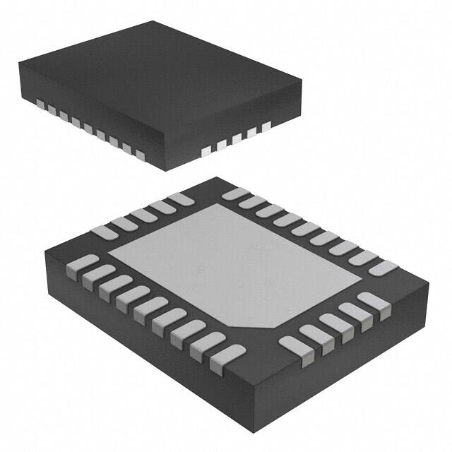

    TPS548A20是一款小型、同步降压转换器,采用自适应导通时间D-CAP3控制模式。该设备易于使用,外部元件数量少,适用于空间受限的电源系统。其特性包括高精度0.6V参考电压、集成MOSFET、自动...
TPS548A20RVER 数据手册
Sample & Buy Product Folder Support & Community Tools & Software Technical Documents TPS548A20 SLUSC78A – NOVEMBER 2015 – REVISED DECEMBER 2015 TPS548A20 1.5-V to 20-V (4.5-V to 25-V Bias) Input, 15-A Synchronous Step-Down SWIFT™ Converter 1 Features 2 Applications • • • • 1 • • • • • • • • • • • • Integrated SWIFT™ 9.9-mΩ and 4.3-mΩ MOSFETs Support 15-A Continuous IOUT Wide Conversion Input Voltage Range: 1.5 V to 20 V (with Snubber) Output Voltage Range from 0.6 V to 5.5 V Supports All Ceramic Output Capacitors Reference Voltage: 600 mV with ±0.5% Tolerance from –40°C to 85°C ambient temperature D-CAP3™ Control Mode With Fast Load-Step Response Hiccup Over Current Protection Auto-Skipping Eco-Mode™ for High Light-Load Efficiency FCCM for Tight Output Ripple and Voltage Tolerance Requirements Pre-charged Startup Capability Eight Selectable Frequency Settings from 200 kHz to 1 MHz 4.5 mm x 3.5 mm, 28-Pin, VQFN-CLIP Package Supported at the WEBENCH™ Design Center SWIFT™ Server, Cloud-Computing, Storage Telecom & Networking, Point-of-Load (POL) IPCs, Factory Automation, PLC, Test Measurement Performance DSPs, FPGAs • 3 Description The TPS548A20 is a small-sized, synchronous buck converter with an adaptive on-time D-CAP3 control mode. The device offers ease-of-use and low bill-ofmaterial count for space-conscious power systems. This device features high-performance integrated MOSFETs, accurate 0.6-V reference, and an integrated boost switch. Competitive features include very-low external-component count, fast loadtransient response, auto-skip mode operation, internal soft-start control, and no requirement for compensation. A forced continuous conduction mode helps meet tight voltage regulation accuracy requirements for performance DSPs and FPGAs. The TPS548A20 is available in a 28-pin VQFN-CLIP package and is specified from –40°C to 125°C ambient temperature. Device Information(1) PART NUMBER TPS548A20 PACKAGE BODY SIZE (NOM) VQFN-CLIP (28) 4.50 mm x 3.50 mm (1) For all available packages, see the orderable addendum at the end of the datasheet. Simplified Application PGOOD VIN 23 22 21 20 18 19 17 16 15 FB GND MODE VREG NC VDD VIN VIN VIN Thermal Pad PGND 14 TRIP PGND 13 NC PGND 12 PGND 11 PGND 10 24 VO 25 26 27 GND1 28 GND2 RF PGOOD EN VBST N/C SW SW SW SW TPS548A20 1 2 3 4 5 6 7 8 9 EN Thermal Pad VOUT VREG 1 An IMPORTANT NOTICE at the end of this data sheet addresses availability, warranty, changes, use in safety-critical applications, intellectual property matters and other important disclaimers. PRODUCTION DATA. TPS548A20 SLUSC78A – NOVEMBER 2015 – REVISED DECEMBER 2015 www.ti.com Table of Contents 1 2 3 4 5 6 Features .................................................................. Applications ........................................................... Description ............................................................. Revision History..................................................... Pin Configuration and Functions ......................... Specifications......................................................... 6.1 6.2 6.3 6.4 6.5 6.6 6.7 7 1 1 1 2 3 4 Absolute Maximum Ratings ...................................... 4 ESD Ratings.............................................................. 4 Recommended Operating Conditions....................... 5 Electrical Characteristics........................................... 5 Thermal Information .................................................. 7 Typical Characteristics .............................................. 8 Thermal Performance ............................................. 14 Detailed Description ............................................ 15 7.1 Overview ................................................................. 15 7.2 Functional Block Diagrams ..................................... 15 7.3 Feature Description................................................. 16 7.4 Device Functional Modes........................................ 22 8 Application and Implementation ........................ 23 8.1 Application Information............................................ 23 8.2 Typical Application .................................................. 23 9 Power Supply Recommendations...................... 28 10 Layout................................................................... 28 10.1 Layout Guidelines ................................................. 28 10.2 Layout Example .................................................... 29 11 Device and Documentation Support ................. 30 11.1 11.2 11.3 11.4 Documentation Support ........................................ Trademarks ........................................................... Electrostatic Discharge Caution ............................ Glossary ................................................................ 30 30 30 30 12 Mechanical, Packaging, and Orderable Information ........................................................... 30 4 Revision History Changes from Original (October 2015) to Revision A • 2 Page Updated document status from Product Preview to Production Data ................................................................................... 1 Submit Documentation Feedback Copyright © 2015, Texas Instruments Incorporated Product Folder Links: TPS548A20 TPS548A20 www.ti.com SLUSC78A – NOVEMBER 2015 – REVISED DECEMBER 2015 5 Pin Configuration and Functions GND2 GND1 NC TRIP VO 28-PIN QFN (TOP VIEW) 28 27 26 25 24 RF 1 23 FB PGOOD 2 22 GND EN 3 21 MODE VBST 4 20 VREG NC 5 19 VDD SW 6 18 NC SW 7 17 VIN SW 8 16 VIN 15 VIN Thermal Pad 10 11 12 13 14 PGND PGND PGND PGND 9 PGND SW Pin Functions PIN NAME NO. I/O (1) DESCRIPTION EN 3 I The enable pin turns on the DC-DC switching converter. FB 23 I VOUT feedback input. Connect this pin to a resistor divider between the VOUT pin and GND. GND 22 G This pin is the ground of internal analog circuitry and driver circuitry. Connect GND to the PGND plane with a short trace (For example, connect this pin to the thermal pad with a single trace and connect the thermal pad to PGND pins and PGND plane). GND1 27 GND2 28 G Connect this pin to ground. GND1 is the input of unused internal circuitry and must connect to ground. MODE 21 I The MODE pin sets the forced continuous-conduction mode (FCCM) or auto-skip mode operation. It also selects the ramp coefficient of D-CAP3 mode. NC 18 5 — Not connected. These pins are floating internally. G These ground pins are connected to the return of the internal low-side MOSFET. Open-drain power-good status signal which provides startup delay after the FB voltage falls within the specified limits. After the FB voltage moves outside the specified limits, PGOOD goes low within 2 µs. 26 10 11 PGND 12 13 14 PGOOD 2 O RF 1 I (1) I = Input, O = Output, P = Supply, G = Ground Submit Documentation Feedback Copyright © 2015, Texas Instruments Incorporated Product Folder Links: TPS548A20 3 TPS548A20 SLUSC78A – NOVEMBER 2015 – REVISED DECEMBER 2015 www.ti.com Pin Functions (continued) PIN NAME I/O (1) NO. DESCRIPTION 6 7 SW 8 I/O SW is the output switching terminal of the power converter. Connect this pin to the output inductor. 9 TRIP 25 I/O TRIP is the OCL detection threshold setting pin. ITRIP = 10 µA at TA = 25°C, 3000 ppm/°C current is sourced and sets the OCL trip voltage. See the Current Sense and Overcurrent Protection section for detailed OCP setting. VBST 4 P VBST is the supply rail for the high-side gate driver (boost terminal). Connect the bootstrap capacitor from this pin to the SW node. Internally connected to VREG via bootstrap PMOS switch. VDD 19 P Power-supply input pin for controller. Input of the VREG LDO. The input range is from 4.5 to 25 V. P VIN is the conversion power-supply input pins. 15 VIN 16 17 VREG 20 O VREG is the 5-V LDO output. This voltage supplies the internal circuitry and gate driver. VO 24 I VOUT voltage input to the controller. 6 Specifications 6.1 Absolute Maximum Ratings over operating free-air temperature range (unless otherwise noted) (1) EN MAX –0.3 7.7 DC –3 25 Transient < 10 ns –5 27 VBST –0.3 31 VBST (3) –0.3 SW Input voltage range (2) MIN 6 VBST when transient < 10 ns UNIT V 33 VDD –0.3 28 VIN –0.3 25 FB, MODE, VO –0.3 6 PGOOD –0.3 7.7 TRIP, VREG –0.3 6 Junction temperature, TJ –40 150 °C Storage temperature, Tstg –55 150 °C Output voltage range (1) (2) (3) V Stresses beyond those listed under Absolute Maximum Ratings may cause permanent damage to the device. These are stress ratings only, and functional operation of the device at these or any other conditions beyond those indicated under Recommended Operating Conditions is not implied. Exposure to absolute-maximum-rated conditions for extended periods my affect device reliability. All voltages are with respect to network ground terminal. Voltage values are with respect to the SW terminal. 6.2 ESD Ratings VALUE V(ESD) (1) (2) 4 Electrostatic discharge Human-body model (HBM), per ANSI/ESDA/JEDEC JS-001 (1) Charged-device model (CDM), per JEDEC specification JESD22-C101 (2) ±2500 ±1500 UNIT V JEDEC document JEP155 states that 500-V HBM allows safe manufacturing with a standard ESD control process. JEDEC document JEP157 states that 250-V CDM allows safe manufacturing with a standard ESD control process. Submit Documentation Feedback Copyright © 2015, Texas Instruments Incorporated Product Folder Links: TPS548A20 TPS548A20 www.ti.com SLUSC78A – NOVEMBER 2015 – REVISED DECEMBER 2015 6.3 Recommended Operating Conditions over operating free-air temperature range (unless otherwise noted) MIN Input voltage range Output voltage range EN –0.1 7 SW –3 20 VBST –0.1 25.5 VBST (1) –0.1 5.5 VDD 4.5 25 VIN 1.5 20 FB, MODE, VO –0.1 5.5 PGOOD –0.1 7 TRIP, VREG –0.1 5.5 –40 125 Ambient temperature, TA (1) MAX UNIT V V °C Voltage values are with respect to the SW pin. 6.4 Electrical Characteristics over operating free-air temperature range, VDD = 12V, VREG = 5 V, VEN = 5 V (unless otherwise noted) PARAMETER TEST CONDITIONS MIN TYP MAX UNIT 1350 1850 µA 850 1150 µA 0.5 µA 603 mV SUPPLY CURRENT IVDD VDD bias current TA = 25°C, No load Power conversion enabled (no switching) IVDDSTBY VDD standby current TA = 25°C, No load Power conversion disabled IVIN(leak) VIN leakage current TA = 25°C, VEN = 0 V Reference voltage FB w/r/t GND, TA = 25°C 597 FB w/r/t GND, -40°C ≤ TJ ≤ 85°C –0.5 0.5 FB w/r/t GND, –40°C ≤ TJ ≤ 125°C –1.0 1.0 VREF OUTPUT VVREF VVREFTOL Reference voltage tolerance 600 % OUTPUT VOLTAGE IFB FB input current VFB = 600 mV IVODIS VO discharge current VVO = 0.5 V, Power Conversion Disabled 50 100 6 nA uA SMPS FREQUENCY fSW VO switching frequency VIN = 12 V, VVO = 3.3 V, RRF0.557 1000 tON(min) Minimum on-time TA = 25°C (1) tOFF(min) Minimum off-time TA = 25°C kHz 60 175 ns 240 310 ns INTERNAL BOOTSTRAP SW VF IVBST (1) Forward Voltage VVREG–VBST, TA = 25°C, IF = 10 mA 0.15 0.25 V VBST leakage current TA = 25°C, VVBST = 33 V, VSW = 28 V 0.01 1.5 µA Specified by design. Not production tested. Submit Documentation Feedback Copyright © 2015, Texas Instruments Incorporated Product Folder Links: TPS548A20 5 TPS548A20 SLUSC78A – NOVEMBER 2015 – REVISED DECEMBER 2015 www.ti.com Electrical Characteristics (continued) over operating free-air temperature range, VDD = 12V, VREG = 5 V, VEN = 5 V (unless otherwise noted) PARAMETER TEST CONDITIONS MIN TYP MAX UNIT LOGIC THRESHOLD VENH EN enable threshold voltage 1.3 1.4 1.5 V VENL EN disable threshold voltage 1.1 1.2 1.3 V VENHYST EN hysteresis voltage VENLEAK EN input leakage current 1 µA 0.22 –1 0 V SOFT-START tSS Soft-start time 4 ms POWERGOOD COMPARATOR VPGTH PGOOD threshold PGOOD in from higher 104 108 111 % PGOOD in from lower 89 92 96 % PGOOD out to higher 113 116 120 % PGOOD out to lower 80 84 87 % Delay for PGOOD going in 0.8 1.0 1.2 ms tPGDLY PGOOD delay time 2 µs IPG PGOOD sink current VPGOOD = 0.5 V 4 6 mA IPGLK PGOOD leakage current VPGOOD = 5.0 V –1 0 Delay for PGOOD coming out 1 µA POWER-ON DELAY tPODLY Power-on delay time Delay from enable to switching 1.124 ms CURRENT DETECTION IOCL Current limit threshold, valley IOCLN Negative current limit threshold, valley VZC Zero cross detection offset RTRIP = 49 kΩ 11.5 15.0 17.5 RTRIP = 28 kΩ 6.5 8 11 RTRIP = 49 kΩ -18.0 –14.9 -10.5 RTRIP = 28 kΩ -11.5 -8.0 -6.0 0 A A mV PROTECTIONS Wake-up 3.25 3.34 3.41 Shutdown 3.00 3.12 3.19 Wake-up (default) 4.15 4.25 4.35 Shutdown 3.95 4.05 4.15 Overvoltage-protection (OVP) threshold voltage OVP detect voltage 116 120 124 tOVPDLY OVP propagation delay With 100-mV overdrive VUVP Undervoltage-protection (UVP) threshold voltage UVP detect voltage tUVPDLY UVP delay UVP filter delay VVREGUVLO VREG undervoltage-lockout (UVLO) threshold voltage VVDDUVLO VDD UVLO threshold voltage VOVP 300 64 68 V V % ns 71 1 % ms THERMAL SHUTDOWN Thermal shutdown threshold (1) TSDN Shutdown temperature 140 Hysteresis °C 40 LDO VOLTAGE VREG LDO output voltage VIN = 12 V, ILOAD = 10 mA VDOVREG LDO low droop drop-out voltage VIN = 4.5 V, ILOAD = 30 mA, TA = 25°C ILDOMAX LDO over-current limit VIN = 12 V, TA = 25°C 4.65 170 5 5.45 V 365 mV 200 mA INTERNAL MOSFETS RDS(on)H High-side MOSFET on-resistance TA = 25°C 9.9 11.4 mΩ RDS(on)L Low-side MOSFET on-resistance TA = 25°C 4.3 4.94 mΩ 6 Submit Documentation Feedback Copyright © 2015, Texas Instruments Incorporated Product Folder Links: TPS548A20 TPS548A20 www.ti.com SLUSC78A – NOVEMBER 2015 – REVISED DECEMBER 2015 6.5 Thermal Information TPS548A20 THERMAL METRIC (1) RVE (VQFN-CLIP) UNIT 28 PINS θJA Junction-to-ambient thermal resistance 37.5 °C/W θJCtop Junction-to-case (top) thermal resistance 34.1 °C/W θJB Junction-to-board thermal resistance 18.1 °C/W ψJT Junction-to-top characterization parameter 1.8 °C/W ψJB Junction-to-board characterization parameter 18.1 °C/W θJCbot Junction-to-case (bottom) thermal resistance 2.2 °C/W (1) For more information about traditional and new thermal metrics, see the Semiconductor and IC Package Thermal Metrics application report (SPRA953). Submit Documentation Feedback Copyright © 2015, Texas Instruments Incorporated Product Folder Links: TPS548A20 7 TPS548A20 SLUSC78A – NOVEMBER 2015 – REVISED DECEMBER 2015 www.ti.com 6.6 Typical Characteristics 100 100 90 90 80 80 Efficiency (%) Efficiency (%) TA = 25°C (unless otherwise noted) 70 VOUT (V) 0.6 1.2 1.5 1.8 2.5 3.3 5 60 50 40 70 VOUT (V) 0.6 1.2 1.5 1.8 2.5 3.3 5 60 50 40 30 30 0 2 4 6 8 10 Output Current (A) fSW = 500 kHz VIN = 12 V 12 14 16 0 90 90 80 80 70 VOUT (V) 0.6 1.2 1.5 1.8 2.5 3.3 5 40 14 16 D001 FCCM VOUT (V) 0.6 1.2 1.5 1.8 2.5 3.3 5 60 40 30 0 2 4 6 8 10 Output Current (A) fSW = 970 kHz VIN = 12 V 12 14 16 0 2 4 D001 6 8 10 Output Current (A) 12 Figure 3. Efficiency vs. Output Current 14 16 D001 fSW = 970 kHz VIN = 12 V Auto-skip Mode FCCM Figure 4. Efficiency vs. Output Current 1.3 1.3 VIN = 5 VIN = 12 VIN = 18 1.275 VIN = 5 VIN = 12 VIN = 18 1.275 1.25 Output Voltage (V) 1.25 Output Voltage (V) 12 70 50 30 1.225 1.2 1.175 1.225 1.2 1.175 1.15 1.15 1.125 1.125 1.1 1.1 0 3 6 9 Output Current (A) fSW = 500 kHz 12 15 0 3 D001 VOUT = 1.2 V fSW = 970 kHz Figure 5. DC Load Regulation 8 6 8 10 Output Current (A) Figure 2. Efficiency vs. Output Current 100 Efficiency (%) Efficiency (%) Figure 1. Efficiency vs. Output Current 50 4 fSW = 500 kHz VIN = 12 V Auto-skip Mode 100 60 2 D001 Submit Documentation Feedback 6 9 Output Current (A) 12 15 D001 VOUT = 1.2 V Figure 6. DC Load Regulation Copyright © 2015, Texas Instruments Incorporated Product Folder Links: TPS548A20 TPS548A20 www.ti.com SLUSC78A – NOVEMBER 2015 – REVISED DECEMBER 2015 Typical Characteristics (continued) TA = 25°C (unless otherwise noted) 1.3 1.3 VIN = 5 VIN = 12 VIN = 18 1.275 1.25 Output Voltage (V) 1.25 Output Voltage (V) VIN = 5 VIN = 12 VIN = 18 1.275 1.225 1.2 1.175 1.225 1.2 1.175 1.15 1.15 1.125 1.125 1.1 1.1 0 3 6 9 Output Current (A) fSW = 500 kHz 12 15 0 3 VOUT = 1.2 V fSW = 970 kHz 12 15 D001 VOUT = 1.2 V Figure 8. DC Load Regulation 110 100 100 Ambient Temperature (°C) Ambient Temperature (°C) Figure 7. DC Load Regulation 110 90 80 70 400 LFM 200 LFM 100 LFM Natural convection 60 6 9 Output Current (A) D001 90 80 70 400 LFM 200 LFM 100 LFM Natural convection 60 50 50 0 3 6 9 Output Current (A) 12 15 0 3 D001 fSW = 500 kHz VOUT = 5 V VIN = 12 V 6 9 Output Current (A) 12 fSW = 500 kHz VOUT = 1 V Figure 9. Safe Operating Area 15 D001 VIN = 12 V Figure 10. Safe Operating Area 1000 Switching Frequency (kHz) 900 250 kHz, Skip Mode 500 kHz, Skip Mode 970 kHz, Skip Mode 250 kHz, FCCM 500 kHz, FCCM 970 kHz, FCCM 800 700 600 500 400 300 200 0 3 6 9 Output Current (A) VIN = 12 V 12 15 D001 VOUT = 1.2 V Figure 11. Switching Frequency vs. Output Current Submit Documentation Feedback Copyright © 2015, Texas Instruments Incorporated Product Folder Links: TPS548A20 9 TPS548A20 SLUSC78A – NOVEMBER 2015 – REVISED DECEMBER 2015 www.ti.com Typical Characteristics (continued) TA = 25°C (unless otherwise noted) fSW = 1 MHz VOUT = 1.2 V VIN = 12 V ILOAD = 0 A Figure 12. Skip Mode Steady-State Operation fSW = 1 MHz VOUT = 1.2 V fSW = 1 MHz VOUT = 1.2 V Figure 13. FCCM Steady-State Operation VIN = 12 V ILOAD = 0.1 A Figure 14. Skip Mode Steady-State Operation 10 VIN = 12 V ILOAD = 0 A Submit Documentation Feedback fSW = 1 MHz VOUT = 1.2 V VIN = 12 V ILOAD = 0.1 A Figure 15. Steady-State Operation Copyright © 2015, Texas Instruments Incorporated Product Folder Links: TPS548A20 TPS548A20 www.ti.com SLUSC78A – NOVEMBER 2015 – REVISED DECEMBER 2015 Typical Characteristics (continued) TA = 25°C (unless otherwise noted) fSW = 1 MHz VOUT = 1.2 V VIN = 12 V ILOAD = 8 A Figure 16. Skip Mode Steady-State Operation ILOAD from 0 A to 8 A VIN = 12 V fSW = 1 MHz Div = 2 A/µs VOUT = 1.2 V fSW = 1 MHz VOUT = 1.2 V VIN = 12 V ILOAD = 8 A Figure 17. Skip Mode Steady-State Operation ILOAD from 0 A to 8 A VIN = 12 V fSW = 1 MHz Figure 18. Auto-skip Mode Load Transient Div = 2 A/µs VOUT = 1.2 V Figure 19. Load Transient Submit Documentation Feedback Copyright © 2015, Texas Instruments Incorporated Product Folder Links: TPS548A20 11 TPS548A20 SLUSC78A – NOVEMBER 2015 – REVISED DECEMBER 2015 www.ti.com Typical Characteristics (continued) TA = 25°C (unless otherwise noted) fSW = 1 MHz VOUT = 1.2 V VIN = 12 V Figure 20. Auto-skip Mode Start-Up ILOAD = 0 A VOUT = 1.2 V VIN = 12 V fSW = 1 MHz Figure 22. Skip Mode Pre-Bias Start-Up 12 Submit Documentation Feedback fSW = 1 MHz VOUT = 1.2 V VIN = 12 V Figure 21. FCCM Mode Start-Up ILOAD = 0 A VOUT = 1.2 V VIN = 12 V fSW = 1 MHz Figure 23. FCCM Pre-Bias Start-Up Copyright © 2015, Texas Instruments Incorporated Product Folder Links: TPS548A20 TPS548A20 www.ti.com SLUSC78A – NOVEMBER 2015 – REVISED DECEMBER 2015 Typical Characteristics (continued) TA = 25°C (unless otherwise noted) ILOAD = 8A VOUT = 1.2 V VIN = 12 V fSW = 1 MHz Figure 24. Auto-skip Mode Shutdown Operation ILOAD = 0 A VOUT = 1.2 V ILOAD = 8 A VOUT = 1.2 V VIN = 12 V fSW = 1 MHz Figure 25. Auto-skip Mode Shutdown Operation VIN = 12 V fSW = 1 MHz Figure 26. FCCM Shutdown Operation ILOAD = 8 A VOUT = 1.2 V VIN = 12 V fSW = 1 MHz Figure 27. FCCM Shutdown Operation Submit Documentation Feedback Copyright © 2015, Texas Instruments Incorporated Product Folder Links: TPS548A20 13 TPS548A20 SLUSC78A – NOVEMBER 2015 – REVISED DECEMBER 2015 www.ti.com Typical Characteristics (continued) TA = 25°C (unless otherwise noted) Figure 28. Overcurrent Protection Hiccup Figure 29. Overcurrent Protection 6.7 Thermal Performance fSW = 500 kHz, VIN = 12 V, VOUT = 5 V, IOUT = 12 A, COUT = 10 × 22 µF (1206, 6.3 V, X5R), RBOOT = 0 Ω, SNB = 3 Ω + 470 pF Inductor: LOUT = 1 µH, PCMC135T-1R0MF, 12.6 mm × 13.8 mm × 5 mm, 2.1 mΩ (typ) Figure 30. SP1: 68.2℃ ℃ ( TPS548A20 ), SP2: 75℃ ℃ (Inductor) 14 Submit Documentation Feedback Copyright © 2015, Texas Instruments Incorporated Product Folder Links: TPS548A20 TPS548A20 www.ti.com SLUSC78A – NOVEMBER 2015 – REVISED DECEMBER 2015 7 Detailed Description 7.1 Overview The TPS548A20 is a high-efficiency, single-channel, synchronous-buck converter. The device suits low-output voltage point-of-load applications with 15-A or lower output current in computing and similar digital consumer applications. The TPS548A20 features proprietary D-CAP3 mode control combined with adaptive on-time architecture. This combination builds modern low-duty-ratio and ultra-fast load-step-response DC-DC converters in an ideal fashion. The output voltage ranges from 0.6 V to 5.5 V. The conversion input voltage ranges from 1.5 V to 20 V (with snubber) and the VDD input voltage ranges from 4.5 V to 25 V. D-CAP3 mode operation uses emulated current information to control the modulation. An advantage of this control scheme is that it does not require a phase-compensation network outside which makes the device easy-to-use and also allows low-external component count. Adaptive on-time control tracks the preset switching frequency over a wide range of input and output voltage while increasing switching frequency as needed during load-step transient. 7.2 Functional Block Diagrams + UV PGOOD + 0.6 V + 8/16% 0.6 V ± 32% Delay Delay + + OV 0.6 V ± 8/16% 0.6 V+20% VREG Internal Ramp Control Logic 0.6 V SS UVP / OVP Logic + + PWM VFB VBST VIN 10 µA + GND TRIP + LL OneShot OCP SW XCON + ZC PGND Control Logic PGND SW NC GND1 x x x x x x On/Off time Minimum On/Off Light load OVP/UVP FCCM/SKIP Soft-Start VO Fault Shut Down + MODE FCCM / SKIP RC Time Constant VREGOK 3.34 V / 3.12 V LDO + GND2 VDDOK + 1.4 V / 1.2 V + EN Enable THOK 140°C / 100°C VREG VDD 4.3 V / 4.03 V RF TPS548A20 Submit Documentation Feedback Copyright © 2015, Texas Instruments Incorporated Product Folder Links: TPS548A20 15 TPS548A20 SLUSC78A – NOVEMBER 2015 – REVISED DECEMBER 2015 www.ti.com 7.3 Feature Description 7.3.1 Powergood The TPS548A20 has powergood output that indicates high when switcher output is within the target. The powergood function is activated after the soft-start operation is complete. If the output voltage becomes within ±8% of the target value, internal comparators detect the power-good state and the power-good signal becomes high after a 1-ms internal delay. If the output voltage goes outside of ±16% of the target value, the power-good signal becomes low after a 2-μs internal delay. The power-good output is an open-drain output and must be pulled-up externally. 7.3.2 D-CAP3 Control and Mode Selection RR SW To comparator CR VOUT Figure 31. Internal RAMP Generation Circuit The TPS548A20 uses D-CAP3 mode control to achieve fast load transient while maintaining the ease-of-use feature. An internal RAMP is generated and fed to the VFB pin to reduce jitter and maintain stability. The amplitude of the ramp is determined by the R-C time-constant as shown in Figure 31. At different switching frequencies, (fSW) the R-C time-constant varies to maintain relatively constant RAMP amplitude. 7.3.3 D-CAP3 Mode From small-signal loop analysis, a buck converter using the D-CAP3 mode control architecture can be simplified as shown in Figure 32. VO CC1 CC2 RC2 SW RC1 VIN Sample and Hold DRVH PWM Comparator RFBH G FB VRAMP + + + VREF Lx Control Logic and Driver RFBL VOUT DRVL RCO COUT RLOAD Figure 32. D-CAP3 Mode 16 Submit Documentation Feedback Copyright © 2015, Texas Instruments Incorporated Product Folder Links: TPS548A20 TPS548A20 www.ti.com SLUSC78A – NOVEMBER 2015 – REVISED DECEMBER 2015 Feature Description (continued) The D-CAP3 control architecture includes an internal ripple generation network enabling the use of very low-ESR output capacitors such as multi-layered ceramic capacitors (MLCC). No external current sensing network or voltage compensators are required with D-CAP3 control architecture. The role of the internal ripple generation network is to emulate the ripple component of the inductor current information and then combine it with the voltage feedback signal to regulate the loop operation. For any control topologies supporting no external compensation design, there is a minimum and/or maximum range of the output filter it can support. The output filter used with the TPS548A20 device is a lowpass L-C circuit. This L-C filter has double pole that is described in Equation 1. 1 fP = 2 ´ p ´ LOUT ´ COUT (1) At low frequencies, the overall loop gain is set by the output set-point resistor divider network and the internal gain of the device. The low frequency L-C double pole has a 180 degree in phase. At the output filter frequency, the gain rolls off at a –40dB per decade rate and the phase drops rapidly. The internal ripple generation network introduces a high-frequency zero that reduces the gain roll off from –40dB to –20dB per decade and increases the phase to 90 degree one decade above the zero frequency. The inductor and capacitor selected for the output filter must be such that the double pole of Equation 1 is located close enough to the high-frequency zero so that the phase boost provided by the high-frequency zero provides adequate phase margin for the stability requirement. Table 1. Locating the Zero SWITCHING FREQUENCIES (fSW) (kHz) ZERO (fZ) LOCATION (kHz) 250 and 300 6 400 and 500 7 600 and 750 9 850 and 1000 12 After identifying the application requirements, the output inductance should be designed so that the inductor peak-to-peak ripple current is approximately between 25% and 35% of the ICC(max) (peak current in the application). Use Table 1 to help locate the internal zero based on the selected switching frequency. In general, where reasonable (or smaller) output capacitance is desired, Equation 2 can be used to determine the necessary output capacitance for stable operation. 1 = fZ fP = 2 ´ p ´ LOUT ´ COUT (2) If MLCC is used, consider the derating characteristics to determine the final output capacitance for the design. For example, when using an MLCC with specifications of 10-µF, X5R and 6.3 V, the deratings by DC bias and AC bias are 80% and 50% respectively. The effective derating is the product of these two factors, which in this case is 40% and 4-µF. Consult with capacitor manufacturers for specific characteristics of the capacitors to be used in the system/applications. Table 2 shows the recommended output filter range for an application design with the following specifications: • Input voltage, VIN = 12 V • Switching frequency, fSW = 600 kHz • Output current, IOUT = 8 A The minimum output capacitance is verified by the small signal measurement conducted on the EVM using the following two criteria: • Loop crossover frequency is less than one-half the switching frequency (300 kHz) • Phase margin at the loop crossover is greater than 50 degrees For the maximum output capacitance recommendation, simplify the procedure to adopt an unrealistically high output capacitance for this type of converter design, then verify the small signal response on the EVM using the following one criteria: Submit Documentation Feedback Copyright © 2015, Texas Instruments Incorporated Product Folder Links: TPS548A20 17 TPS548A20 SLUSC78A – NOVEMBER 2015 – REVISED DECEMBER 2015 • www.ti.com Phase margin at the loop crossover is greater than 50 degrees As indicated by the phase margin, the actual maximum output capacitance (COUT(max)) can continue to go higher. However, small signal measurement (bode plot) should be done to confirm the design. Select a MODE pin configuration as shown in Table 3 to double the R-C time constant option for the maximum output capacitance design and application. Select a MODE pin configuration to use single R-C time constant option for the normal (or smaller) output capacitance design and application. The MODE pin also selects Auto-skip-mode or FCCM-mode operation. Table 2. Recommended Component Values COUT(min) (µF) CROSSOVER (kHz) 0.36 PIMB065T-R36MS 3 × 100 247 70 48 62 10 0.68 PIMB065T-R68MS 9 × 22 207 53 25 84 31.6 1.2 PIMB065T-1R2MS 4 × 22 185 57 11 63 3.3 45.3 1.5 PIMB065T-1R5MS 3 × 22 185 57 9 59 5.5 82.5 2.2 PIMB065T-2R2MS 2 × 22 185 51 7 58 VOUT (V) RUPPER (kΩ) LOUT (µH) 0.6 0 1.2 2.5 (1) RLOWER (kΩ) 10 (1) PHASE COUT(max) INTERNAL MARGIN (µF) RC SETTING (1) (°) (µs) 40 30 x 100 40 33% 80 40 30 x 100 34% 80 40 30 x 100 8 33% 80 40 30 x 100 ICC(max) (A) 33% 80 30 x 100 INDUCTOR ΔI/ICC(max) 28% 80 All COUT(min) and COUT(max) capacitor specifications are 1206, X5R, 10 V. For higher output voltage at or above 2.0 V, additional phase boost might be required in order to secure sufficient phase margin due to phase delay/loss for higher output voltage (large on-time (tON)) setting in a fixed on time topology based operation. A feedforward capacitor placing in parallel with RUPPER is found to be very effective to boost the phase margin at loop crossover. Table 3. Mode Selection and Internal RAMP RC Time Constant MODE SELECTION RMODE (kΩ) ACTION R-C TIME CONSTANT (µs) 60 275 and 325 50 425 and 525 40 625 and 750 30 850 and 1000 120 275 and 325 100 425 and 525 80 625 and 750 60 850 and 1000 60 275 and 325 50 425 and 525 40 625 and 750 30 850 and 1000 120 275 and 325 100 425 and 525 80 625 and 750 60 850 and 1000 0 Auto-skip Mode Pull down to GND 150 20 FCCM (1) Connect to PGOOD 150 (1) 18 SWITCHING FREQUENCIES fSW (kHz) Device goes into Forced CCM (FCCM) after PGOOD becomes high. Submit Documentation Feedback Copyright © 2015, Texas Instruments Incorporated Product Folder Links: TPS548A20 TPS548A20 www.ti.com SLUSC78A – NOVEMBER 2015 – REVISED DECEMBER 2015 Table 3. Mode Selection and Internal RAMP RC Time Constant (continued) MODE SELECTION FCCM RMODE (kΩ) ACTION Connect to VREG R-C TIME CONSTANT (µs) 0 SWITCHING FREQUENCIES fSW (kHz) 120 275 and 325 100 425 and 525 80 625 and 750 60 850 and 1000 7.3.4 Sample and Hold Circuitry Sampled_CSP CSP C1 Buffer 1 C2 Buffer 2 Figure 33. Sample and Hold Circuitry The sample and hold circuitry is the difference between D-CAP3 and D-CAP2. The sample and hold circuitry, which is an advance control scheme to boost output voltage accuracy higher on the TPS548A20 , is one of features of the TPS548A20 . The sample and hold circuitry generates a new DC voltage of CSN instead of the voltage which is produced by RC2 and CC2 which allows for tight output-voltage accuracy and makes the TPS548A20 more competitive. CSP CSN CSN_NEW (sample at valley of CSP) Figure 34. Continuous Conduction Mode (CCM) With Sample and Hold Circuitry CSP CSN CSN_NEW (sample at valley of CSP) Figure 35. Discontinuous Conduction Mode (DCM) With Sample and Hold Circuitry CSP CSN Figure 36. Continuous Conduction Mode (CCM) Without Sample and Hold Circuitry CSP CSN Figure 37. Discontinuous Conduction Mode (DCM) Without Sample and Hold Circuitry Submit Documentation Feedback Copyright © 2015, Texas Instruments Incorporated Product Folder Links: TPS548A20 19 TPS548A20 www.ti.com 1.25 1.25 1.23 1.23 1.21 1.21 VOUT (V) VOUT (V) SLUSC78A – NOVEMBER 2015 – REVISED DECEMBER 2015 VIN = 12 V VDD = 5 V VOUT = 1.2 V fSW = 500 kHz TA = 25°C LOUT = 1 H Mode = FCCM 1.19 1.17 1.15 1 2 3 1.19 1.17 D-CAP3 D-CAP2 1.15 4 5 6 7 8 9 10 11 Output Current (A) 12 VIN = 12 V VDD = 5 V VOUT = 1.2 V fSW = 500 kHz TA = 25°C LOUT = 1 H Mode = Auto-skip 1 2 4 D-CAP2 5 6 7 8 9 10 11 Output Current (A) C013 Figure 38. Output Voltage vs Output Current 3 D-CAP3 12 C014 Figure 39. Output Voltage vs Output Current 7.3.5 Adaptive Zero-Crossing The TPS548A20 uses an adaptive zero-crossing circuit to perform optimization of the zero inductor-current detection during Auto-skip-mode operation. This function allows ideal low-side MOSFET turn-off timing. The function also compensates the inherent offset voltage of the Z-C comparator and delay time of the Z-C detection circuit. Adaptive zero-crossing prevents SW-node swing-up caused by too-late detection and minimizes diode conduction period caused by too-early detection. As a result, the device delivers better light-load efficiency. 7.3.6 Forced Continuous-Conduction Mode When the MODE pin is tied to the PGOOD pin through a resistor, the controller operates in continuous conduction mode (CCM) during light-load conditions. During CCM, the switching frequency maintained to an most constant level over the entire load range which is suitable for applications requiring tight control of the switching frequency at the cost of lower efficiency. 7.3.7 Current Sense and Overcurrent Protection The TPS548A20 has cycle-by-cycle overcurrent limiting control. The inductor current is monitored during the OFF state and the controller maintains the OFF state during the period that the inductor current is larger than the overcurrent trip level. In order to provide good accuracy and a cost-effective solution, the TPS548A20 supports temperature compensated MOSFET RDS(on) sensing. Connect the TRIP pin to GND through the trip-voltage setting resistor, RTRIP(20kΩ
