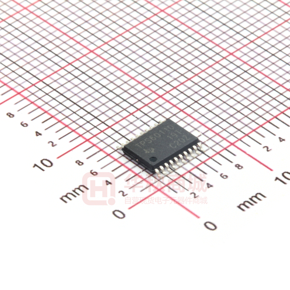

              SLVS215C − JUNE 1999 − REVISED AUGUST 2008 features applications D D D D D D D D D D D D Replaces DC/DC Converters With Inductors in − Battery-Powered Applications − Li-Ion Battery to 5-V Conversion − Portable Instruments − Battery-Powered Microprocessor Systems − Miniature Equipment − Backup-Battery Boost Converters − PDAs − Laptops − Handheld Instrumentation − Medical Instruments output voltage ripple 5.2 5.15 description The TPS60110 step-up, regulated charge pump generates a 5-V ±4% output voltage from a 2.7-V to 5.4-V input voltage (three alkaline, NiCd, or NiMH batteries; or, one lithium or lithium ion battery). Output current is 300 mA from a 3-V input. Only four external capacitors are needed to build a complete low-noise dc/dc converter. The push-pull operating mode of two single-ended charge pumps assures the low output voltage ripple as current is continuously transferred to the output. From a 3-V input, the TPS60110 can start into full load with loads as low as 16 Ω. The TPS60110 features either constant frequency mode to minimize noise and output voltage ripple or the power-saving pulse-skip mode to extend battery life at light loads. The TPS60110 switching frequency is 300 kHz. The logic shutdown function reduces the supply current to 1-µA (max) and disconnects the load from the input. Special current-control circuitry prevents excessive current from being drawn from the battery during start-up. This dc/dc converter requires no inductors and has low EMI. It is available in the small 20-pin TSSOP PowerPAD package (PWP). VO − Output Voltage − V D Up to 300-mA Output Current Less Than 10-mVpp Output Voltage Ripple No Inductors Required/Low EMI Regulated 5-V ±4% Output Only Four External Components Required Up to 90% Efficiency 2.7-V to 5.4-V Input Voltage Range 60-µA Quiescent Supply Current 0.05-µA Shutdown Current Load Isolated in Shutdown Space-Saving Thermally-Enhanced TSSOP PowerPAD Package Evaluation Module Available (TPS60110EVM−132) 5.1 5.05 5 SKIP =COM = CLK = 0 V VIN = 3.6 V IO = 300 mA CO = 22 µF + 10 µF X5R Ceramic 4.95 4.9 4.85 4.8 0 0.5 1 1.5 2 2.5 3 3.5 4 4.5 5 t − Time − µs typical operating circuit INPUT 2.7 V to 5.4 V CIN 15 µF + C1F 2.2 µF SKIP COM CLK IN IN OUT OUT TPS60110 FB C1+ C2+ C1− C2− ENABLE OFF/ON OUTPUT 5V 300 mA + CO 33 µF C2F 2.2 µF SYNC PGND GND Figure 1 Please be aware that an important notice concerning availability, standard warranty, and use in critical applications of Texas Instruments semiconductor products and disclaimers thereto appears at the end of this data sheet. PowerPAD is a trademark of Texas Instruments. Copyright  1999−2003 Texas Instruments Incorporated    !" # $%&" !#  '%()$!" *!"&+ *%$"# $ " #'&$$!"# '& ",& "&#  &-!# #"%&"# #"!*!* .!!"/+ *%$" '$&##0 *&# " &$&##!)/ $)%*& "&#"0  !)) '!!&"&#+ POST OFFICE BOX 655303 • DALLAS, TEXAS 75265 1               SLVS215C − JUNE 1999 − REVISED AUGUST 2008 PWP PACKAGE (TOP VIEW) 1 2 3 4 5 6 7 8 9 10 GND SYNC ENABLE FB OUT C1+ IN C1− PGND PGND 20 19 18 17 16 15 14 13 12 11 GND CLK COM SKIP OUT C2+ IN C2− PGND PGND Thermal Pad Figure 2. Bottom View of PWP Package, Showing the Thermal Pad AVAILABLE OPTIONS PACKAGE TSSOP† (PWP) TPS60110PWP † This package is available taped and reeled. To order this packaging option, add an R suffix to the part number (e.g., TPS60110PWPR). Terminal Functions TERMINAL NAME NO. I/O I DESCRIPTION CLK 19 Input for external clock signal. If the internal clock is used, connect this terminal to GND. C1+ 6 Positive terminal of the charge-pump capacitor C1F C1− 8 Negative terminal of the charge-pump capacitor C1F C2+ 15 Positive terminal of the charge-pump capacitor C2F C2− 13 COM 18 I Mode selection. When COM is logic low the charge pump operates in push-pull mode to minimize output ripple. When COM is connected to IN the regulator operates in single-ended mode requiring only one flying capacitor. ENABLE 3 I ENABLE Input. The device turns off, the output disconnects from the input, and the supply current decreases to 0.05 µA when ENABLE is a logic low. ENABLE High may only be applied when VIN is inside the recommended operating range. FB 4 I FEEDBACK input. Connect FB to OUT as close to the load as possible to achieve best regulation. Resistive divider is on-chip to match internal reference voltage of 1.22 V. Negative terminal of the charge-pump capacitor C2F GND 1, 20 IN 7, 14 I GROUND. Analog ground for internal reference and control circuitry. Connect to PGND through a short trace. Supply Input. Connect to an input supply in the 2.7-V to 5.4-V range. Bypass IN to GND with a (CO/2) µF capacitor. Connect both INs through a short trace. OUT 5, 16 O Regulated 5-V power output. Connect both OUTs through a short trace and bypass OUT to GND with the output filter capacitor CO. PGND 9−12 PGND power ground. Charge-pump current flows through this pin. Connect all PGNDs together. SKIP 17 I Mode selection. When SKIP is logic low, the charge pump operates in constant-frequency mode. Output ripple and noise are minimized in this mode. When SKIP is connect to IN, the device operates in pulse skip mode. Quiescent current is lowest in this mode. SYNC 2 I Selection for external clock signal. Connect to GND to use the internally generated clock signal. Connect to IN for external synchronization. In this case, the clock signal needs to be fed through CLK. PowerPAD 2 Must be soldered to achieve appropriate power dissipation. Should be connected to PGND. POST OFFICE BOX 655303 • DALLAS, TEXAS 75265               SLVS215C − JUNE 1999 − REVISED AUGUST 2008 absolute maximum ratings (unless otherwise noted)†‡ Input voltage range, VI (IN, OUT, ENABLE, SKIP, COM, CLK, FB, SYNC) . . . . . . . . . . . . . . . . −0.3 V to 5.5 V Differential input voltage, VID (C1+, C2+ to GND) . . . . . . . . . . . . . . . . . . . . . . . . . . . . . . −0.3 V to (VO + 0.3 V) Differential input voltage, VID (C1−, C2− to GND) . . . . . . . . . . . . . . . . . . . . . . . . . . . . . . −0.3 V to (VIN + 0.3 V) Continuous total power dissipation . . . . . . . . . . . . . . . . . . . . . . . . . . . . . . . . . . . . See Dissipation Rating Tables Continuous output current . . . . . . . . . . . . . . . . . . . . . . . . . . . . . . . . . . . . . . . . . . . . . . . . . . . . . . . . . . . . . . . . 400 mA Storage temperature range, Tstg . . . . . . . . . . . . . . . . . . . . . . . . . . . . . . . . . . . . . . . . . . . . . . . . . . . −55°C to 150°C Lead temperature 1,6 mm (1/16 inch) from case for 10s . . . . . . . . . . . . . . . . . . . . . . . . . . . . . . . . . . . . . . . 260°C Maximum junction temperature, TJ . . . . . . . . . . . . . . . . . . . . . . . . . . . . . . . . . . . . . . . . . . . . . . . . . . . . . . . . . 150°C † Stresses beyond those listed under “absolute maximum ratings” may cause permanent damage to the device. These are stress ratings only, and functional operation of the device at these or any other conditions beyond those indicated under “recommended operating conditions” is not implied. Exposure to absolute-maximum-rated conditions for extended periods may affect device reliability. ‡ VENABLE, VSKIP, VCOM, VCLK and VSYNC can exceed VIN up to the maximum rated voltage without increasing the leakage current drawn by these mode select inputs. PACKAGE DISSIPATION RATINGS PACKAGE TA ≤ 25°C 25 C POWER RATING DERATING FACTOR ABOVE TA = 25°C§ 70°C TA = 70 C POWER RATING 85°C TA = 85 C POWER RATING PWP 3W 30.3 mW/°C 1.66 W 1.21 W § The thermal resistance junction to ambient of the 20-pin TSSOP PowerPAD package RθJA = 33°C/W (soldered PowerPAD using thermal vias). PowerPAD packages are modeled and tested using PWB boards recommended in the PowerPAD Application Report, SLMA0002. PowerPAD packages are designed for board mounting with the die pad soldered to a copper pad patterned on the board. POST OFFICE BOX 655303 • DALLAS, TEXAS 75265 3               SLVS215C − JUNE 1999 − REVISED AUGUST 2008 electrical characteristics at CIN = 15 µF, C1F = C2F = 2.2 µF†, CO = 33 µF, TC = −40°C to 85°C, VIN = 3 V, VFB = VO, VENABLE = VIN, VSKIP = VIN or 0 V and VCOM = VCLK = VSYNC = 0 V (unless otherwise noted) PARAMETER VIN IO(MAX) TEST CONDITIONS Input voltage Output voltage VO(RIP) IO(LEAK) Output voltage ripple IQ Quiescent current (no-load input current) IDD(SDN) fOSC(int) Shutdown supply current fOSC(ext) External clock frequency Output leakage current 2.7 V < VIN < 3 V, VO(Start-Up) = 5 V, 3 V < VIN < 5 V, 0 < IO < 150 mA, TC = 25°C 0 < IO < 300 mA 5 V < VIN < 5.4 V, 0 < IO < 300 mA IO = 300 mA, VIN = 3.6 V, V(SKIP) = 0 V V(ENABLE) = 0 V V(SKIP) = VIN = 3.6 V V(SKIP) = 0 V, VIN = 3.6 V, VIN = 3.6 V Internal switching frequency Efficiency V(SYNC) = VIN, V(SYNC) = VIN, IO = 150 mA VINL Input voltage low, ENABLE, SKIP, COM, CLK, SYNC VIN = 2.7 V VINH Input voltage high, ENABLE, SKIP, COM, CLK, SYNC VIN = 5.4 V II(LEAK) Input leakage current, ENABLE, SKIP, COM, CLK, SYNC External clock duty cycle 5.4 5 5.2 4.8 5 5.2 4.8 5 10‡ 5.25 1 60 VIN = 2.7 V to 5.4 V VIN= 2.7V to 5.4 V 90 2.8 V mVPP µA µA mA 0.05 1 µA 200 300 400 kHz 400 600 800 kHz 20% 80% 0.7 × VIN 3 V < VIN < 5 V, IO = 150 mA, VIN = 3.6 V, VO = 0 V, V 80% V(ENABLE) = V(SKIP) = V(COM) = V(CLK) = V(SYNC) = V(GND) or VIN VO = 5 V, 1 mA < IO < 300 mA, TC = 25°C POST OFFICE BOX 655303 4.8 VIN = 3.6 V V(ENABLE) = 0 V UNIT mA 0.3 × VIN Short circuit current † Use only ceramic capacitors with X5R or X7R dielectric as flying capacitors. ‡ Achieved with CO = 22 µF + 10 µF X5R dielectric ceramic capacitor 4 MAX 300 VO Output line regulation TYP 2.7 Maximum output current Output load regulation MIN VO = 5 V, TC = 25°C TC = 25°C • DALLAS, TEXAS 75265 V V 0.01 0.002 0.1 µA %/mA 0.6 %/V 150 mA               SLVS215C − JUNE 1999 − REVISED AUGUST 2008 TYPICAL CHARACTERISTICS† EFFICIENCY vs OUTPUT CURRENT EFFICIENCY vs OUTPUT CURRENT 100 100 VIN = 2.7 V 90 V(SKIP) = 0 V VIN = 3 V 80 70 VIN = 3.6 V 60 Efficiency − % Efficiency − % VIN = 3 V 80 70 VIN = 3.3 V 50 40 40 20 20 10 V(SKIP) = VIN 1 VIN = 3.6 V 50 30 0 0.1 VIN = 3.3 V 60 30 10 10 100 0 1000 1 1000 IO − Output Current − mA Figure 4 Figure 3 QUIESCENT SUPPLY CURRENT vs INPUT VOLTAGE QUIESCENT SUPPLY CURRENT vs INPUT VOLTAGE 90 3.6 V(SKIP) = VIN I Q − Quiescent Supply Current − mA 85 80 75 70 65 60 55 50 45 40 2.5 100 10 IO − Output Current − mA I Q − Quiescent Supply Current − µ A VIN = 2.7 V 90 3.4 V(SKIP) = 0 V IO = 300 mA 3.2 3 2.8 2.6 2.4 2.2 2 1.8 3 3.5 4 4.5 5 5.5 1.6 2.5 VIN − Input Voltage − V 3 3.5 4 4.5 5 5.5 VIN − Input Voltage − V Figure 5 Figure 6 † TC = 25°C, VCOM = VSYNC = 0 V, CIN = 15 µF, C1F = C2F = 2.2 µF, CO = 33 µF, unless otherwise noted POST OFFICE BOX 655303 • DALLAS, TEXAS 75265 5               SLVS215C − JUNE 1999 − REVISED AUGUST 2008 TYPICAL CHARACTERISTICS† OUTPUT VOLTAGE vs OUTPUT CURRENT OUTPUT VOLTAGE vs OUTPUT CURRENT 5.3 5.3 V(SKIP) = 0 V V(SKIP) = VIN 5.2 VIN = 5.4 V VIN = 4 V 5.1 VO − Output Voltage − V VO − Output Voltage − V 5.2 VIN = 3.6 V 5 VIN = 3 V 4.9 VIN = 5.4 V VIN = 4 V VIN = 3.6 V 5.1 5 VIN = 3 V 4.9 VIN = 2.7 V VIN = 2.7 V 4.8 4.8 4.7 1 100 10 4.7 1000 1 Figure 8 OUTPUT VOLTAGE vs INPUT VOLTAGE OUTPUT VOLTAGE vs INPUT VOLTAGE 5.1 5.1 V(SKIP) = 0 V 5.08 IO = 300 mA VO − Output Voltage − V VO − Output Voltage − V 5.08 5.04 5.02 IO = 150 mA 5 IO = 1 mA to 10 mA 4.98 4.96 5.04 5.02 5 4.98 4.96 4.94 4.92 4.92 3 3.5 4 4.5 5 5.5 V(SKIP) = VIN IO = 300 mA 5.06 4.94 4.9 2.5 4.9 2.5 VIN − Input Voltage − V 3 3.5 4 Figure 10 † TC = 25°C, VCOM = VSYNC = 0 V, CIN = 15 µF, C1F = C2F = 2.2 µF, CO = 33 µF, unless otherwise noted POST OFFICE BOX 655303 4.5 VIN − Input Voltage − V Figure 9 6 1000 IO − Output Current − mA Figure 7 5.06 100 10 IO − Output Current − mA • DALLAS, TEXAS 75265 5 5.5               SLVS215C − JUNE 1999 − REVISED AUGUST 2008 TYPICAL CHARACTERISTICS† OUTPUT VOLTAGE vs TIME OUTPUT VOLTAGE vs TIME 5.07 V(SKIP) = 0 V VIN = 3.6 V IO = 150 mA CO = 22 µF + 10 µF X5R ceramic 5.04 5.03 5.02 5.01 0 2 Pulse-Skip Mode Constant Frequency Mode VO − Output Voltage − V VO − Output Voltage − V 5.05 6 4 5.03 5.01 V(SKIP) = VIN VIN = 3.6 V IO = 150 mA 4.99 10 8 5.05 0 10 20 t − Time − µs Figure 11 LOAD TRANSIENT RESPONSE VO − Output Voltage − V 5.04 5.03 5.02 I O − Output Current − mA 5.01 Constant Frequency Mode V(SKIP) = 0 V VIN = 3.6 V IO = 10 mA to 300 mA 200 0 0 2 4 6 8 10 12 14 16 18 20 I O − Output Current − mA VO − Output Voltage − V LOAD TRANSIENT RESPONSE 400 50 Figure 12 5.05 600 40 30 t − Time − µs 5.08 V(SKIP) = VIN = 3.6 V IO = 10 mA to 300 mA 5.06 Pulse-Skip Mode 5.04 5.02 5 600 400 200 0 0 2 4 6 8 10 12 14 16 18 20 t − Time − ms t − Time − ms Figure 13 Figure 14 † TC = 25°C, VCOM = VSYNC = 0 V, CIN = 15 µF, C1F = C2F = 2.2 µF, CO = 33 µF, unless otherwise noted POST OFFICE BOX 655303 • DALLAS, TEXAS 75265 7               SLVS215C − JUNE 1999 − REVISED AUGUST 2008 TYPICAL CHARACTERISTICS† LINE TRANSIENT RESPONSE VO − Output Voltage − V VO − Output Voltage − V LINE TRANSIENT RESPONSE 5.08 V(SKIP) = 0 V IO = 150 mA 5.06 Constant Frequency Mode 5.04 5.02 5.08 5.02 5 4 3 2 0 1 2 3 4 5 6 7 8 9 10 V IN − Input Voltage − V 5 5 4 3 2 0 1 2 3 4 5 6 7 8 9 10 t − Time − ms t − Time − ms Figure 16 Figure 15 FREQUENCY SPECTRUM CONSTANT FREQUENCY MODE‡ FREQUENCY SPECTRUM PULSE-SKIP MODE‡ 90 100 V(SKIP) = 0 V VIN = 3 V IO = 150 mA RBW = 300 Hz 80 70 V(SKIP) = VIN VIN = 3 V IO = 150 mA RBW = 300 Hz 80 60 Output − dB µ V Output − dB µ V Pulse-Skip Mode 5.04 5 V IN − Input Voltage − V V(SKIP) = VIN IO = 150 mA 5.06 50 40 60 40 30 20 20 10 0 0 0 2.5 7.5 5 10 0 2.5 5 f − Frequency − MHz f − Frequency − MHz Figure 17 Figure 18 † TC = 25°C, VCOM = VSYNC = 0 V, CIN = 15 µF, C1F = C2F = 2.2 µF, CO = 33 µF, unless otherwise noted ‡ Test circuit: TPS60110EVM−132 8 POST OFFICE BOX 655303 • DALLAS, TEXAS 75265 7.5 10               SLVS215C − JUNE 1999 − REVISED AUGUST 2008 TYPICAL CHARACTERISTICS† FREQUENCY SPECTRUM CONSTANT FREQUENCY MODE‡ FREQUENCY SPECTRUM PULSE-SKIP MODE‡ 90 90 V(SKIP) = 0 V VIN = 3 V IO = 10 mA RBW = 300 Hz 80 70 60 Output − dB µ V Output − dB µ V 70 V(SKIP) = VIN VIN = 3 V IO = 10 mA RBW = 300 Hz 80 50 40 60 50 40 30 30 20 20 10 10 0 0 0 2.5 5 7.5 10 0 2.5 f − Frequency − MHz 7.5 5 10 f − Frequency − MHz Figure 19 Figure 20 EFFICIENCY vs INPUT VOLTAGE START-UP TIMING 6 100 90 5 R0 = 16.5 Ω VIN = 3 V Efficiency − % 70 VO − Output Voltage − V 80 Skip = High 60 Skip = Low 50 40 30 20 4 3 Enable 2 OUTPUT 1 0 10 0 2.5 3 3.5 4 5 4.5 5.5 −1 0 200 400 600 800 1000 1200 t − Time −µs VIN − Input Voltage − V Figure 21 Figure 22 † TC = 25°C, VCOM = VSYNC = 0 V, CIN = 15 µF, C1F = C2F = 2.2 µF, CO = 33 µF, unless otherwise noted ‡ Test circuit: TPS60110EVM−132 POST OFFICE BOX 655303 • DALLAS, TEXAS 75265 9               SLVS215C − JUNE 1999 − REVISED AUGUST 2008 detailed description operating principle The TPS60110 charge pump provides a regulated 5-V output from a 2.7-V to 5.4-V input. It delivers a maximum load current of 300 mA. Designed specifically for space critical battery powered applications, the complete charge pump circuit requires only four external capacitors. The circuit can be optimized for highest efficiency at light loads or lowest output noise. The TPS60110 consists of an oscillator, a 1.22-V bandgap reference, an internal resistive feedback circuit, an error amplifier, high current MOSFET switches, a shutdown/start-up circuit, and a control circuit (Figure 23) CHARGE PUMP 1 IN 0° T11 OSCILLATOR T12 180° C1+ C1F T13 SKIP C1− T14 OUT COM CLK PGND CONTROL CIRCUIT SYNC FB − + CHARGE PUMP 2 IN T21 VREF + − T22 C2+ ENABLE SHUTDOWN/ START-UP CONTROL − T23 + + − T24 C2F C2− OUT 0.8 × VIN PGND GND Figure 23. Functional Block Diagram TPS60110 The oscillator runs at a 50% duty cycle. The device consists of two single-ended charge pumps which operate with 180° phase shift. Each single ended charge pump transfers charge into its transfer capacitor (CxF) in one half of the period. During the other half of the period (transfer phase), CxF is placed in series with the input to transfer its charge to CO. While one single-ended charge pump is in the charge phase, the other one is in the transfer phase. This operation specifies an almost constant output current which ensures a low output ripple. If the clock were to run continuously, this process would eventually generate an output voltage equal to two times the input voltage (hence the name doubler). In order to provide a regulated fixed output voltage of 5 V, the TPS60110 uses either pulse-skip mode or constant-frequency mode. Pulse-skip mode and constant-frequency mode are externally selected via the SKIP input pin. 10 POST OFFICE BOX 655303 • DALLAS, TEXAS 75265               SLVS215C − JUNE 1999 − REVISED AUGUST 2008 detailed description (continued) start-up procedure During start-up, i.e. when ENABLE is set from logic low to logic high, the switches T12 and T14 (charge pump 1), and the switches T22 and T24 (charge pump 2) are conducting to charge up the output capacitor until the output voltage VO reaches 0.8×VIN. When the start-up comparator detects this limit, the IC begins to operate in the mode selected with SKIP and COM. This start-up charging of the output capacitor specifies a short start-up time and eliminates the need for a Schottky diode between IN and OUT. pulse-skip mode In pulse-skip mode (SKIP = high), the error amplifier disables switching of the power stages when it detects an output higher than 5 V. The oscillator halts. The IC then skips switching cycles until the output voltage drops below 5 V. Then the error amplifier reactivates the oscillator and switching of the power stages starts again. The pulse-skip regulation mode minimizes operating current because it does not switch continuously and deactivates all functions except bandgap reference and error amplifier when the output is higher than 5 V. When switching is disabled from the error amplifier, the load is also isolated from the input. SKIP is a logic input and should not remain floating. The typical operating circuit of the TPS60110 in pulse skip mode is shown in Figure 1. constant-frequency mode When SKIP is low, the charge pump runs continuously at the frequency fOSC. The control circuit, fed from the error amplifier, controls the charge on C1F and C2F by driving the gates of the FETs T12/T13 and T22/T23, respectively. When the output voltage falls, the gate drive increases, resulting in a larger voltage across C1F and C2F. This regulation scheme minimizes output ripple. Since the device switches continuously, the output noise contains well-defined frequency components, and the circuit requires smaller external capacitors for a given output ripple. However, constant-frequency mode, due to higher operating current, is less efficient at light loads than pulse-skip mode. SKIP COM CLK INPUT 2.7 V to 5.4 V CIN 15 µF IN IN + C1F 2.2 µF C1+ C2+ C1− C2− ENABLE OFF/ON OUTPUT 5 V 300 mA OUT OUT TPS60110 FB + CO = 33 µF C2F 2.2 µF SYNC PGND GND Figure 24. Typical Operating Circuit TPS60110 in Constant Frequency Mode Table 1. Tradeoffs Between Operating Modes FEATURE PULSE-SKIP MODE (SKIP = High) Best light-load efficiency CONSTANT-FREQUENCY MODE (SKIP = Low) X Smallest external component size for a given output ripple X Output ripple amplitude Small amplitude Very small amplitude Output ripple frequency Variable Constant Very good Good Load regulation NOTE: Even in pulse-skip mode the output ripple amplitude is small if the push-pull operating mode is selected via COM. POST OFFICE BOX 655303 • DALLAS, TEXAS 75265 11               SLVS215C − JUNE 1999 − REVISED AUGUST 2008 detailed description (continued) push-pull operating mode In push-pull operating mode (COM = low), the two single-ended charge pumps operate with 180° phase shift. The oscillator signal has a 50% duty cycle. Each single-ended charge pump transfers charge into its transfer capacitor (CxF) in one-half of the period. During the other half of the period (transfer phase), CxF is placed in series with the input to transfer its charge to CO. While one single-ended charge pump is in the charge phase, the other one is in the transfer phase. This operation specifies an almost constant output current which ensures a low output ripple. COM is a logic input and should not remain floating. The typical operating circuit of the TPS60110 in push-pull mode is shown in Figure 1 and Figure 24. single-ended operating mode When COM is high, the device runs in single-ended operating mode. The two single-ended charge pumps operate in parallel without phase shift. They transfer charge into the transfer capacitor (CF) in one half of the period. During the other half of the period (transfer phase), CF is placed in series with the input to transfer its charge to CO. In single-ended operating mode only one transfer capacitor (CF = C1F + C2F) is required, resulting in less board space. SKIP COM CLK INPUT 2.7 V to 5.4 V IN IN CIN 15 µF + OUT OUT TPS60110 FB C1+ C2+ C1− C2− ENABLE OFF/ON OUTPUT 5 V 300 mA + CO = 33 µF SYNC PGND GND CF = 4.7 µF Figure 25. Typical Operating Circuit TPS60110 in Single-Ended Operating Mode Table 2. Tradeoffs Between Operating Modes FEATURE Output ripple amplitude PUSH-PULL MODE (COM = Low) SINGLE-ENDED MODE (COM = High) Small amplitude Large amplitude Smallest board space 12 X POST OFFICE BOX 655303 • DALLAS, TEXAS 75265               SLVS215C − JUNE 1999 − REVISED AUGUST 2008 detailed description (continued) shutdown Driving ENABLE low places the device in shutdown mode. This disables all switches, the oscillator, and control logic. The device typically draws 0.05-µA (1-µA max) of supply current in this mode. Leakage current drawn from the output is as low as 1 µA max. The device exits shutdown once ENABLE is high. The typical no-load shutdown exit time is 20 µs. When the device is in shutdown, the load is isolated from the input and the output is high impedance. external clock signal If the device operates at a user defined frequency, an external clock signal can be used. Therefore, SYNC needs to be connected to IN and the external oscillator signal can drive CLK. The maximum external frequency is limited to 800 kHz. The switching frequency of the converter is half of the external oscillator frequency. It is recommended to operate the charge pump in constant-frequency mode if an external clock signal is used so that the output noise contains only well-defined frequency components. External Clock SKIP COM CLK INPUT 2.7 V to 5.4 V IN IN CIN 15 µF + C1F 2.2 µF C1+ C2+ C1− C2− ENABLE OFF/ON OUTPUT 5 V 300 mA OUT OUT TPS60110 FB + CO = 33 µF C2F 2.2 µF SYNC PGND GND Figure 26. Typical Operating Circuit TPS60110 With External Synchronization POST OFFICE BOX 655303 • DALLAS, TEXAS 75265 13               SLVS215C − JUNE 1999 − REVISED AUGUST 2008 APPLICATION INFORMATION capacitor selection The TPS60110 requires only four external capacitors as shown in the basic application circuit. Their values are closely linked to the output current capacity, output noise requirements, and mode of operation. Generally, the transfer capacitors (CxF) is the smallest. The input capacitor improves system efficiency by reducing the input impedance and stabilizes the input current. CIN is recommended to be about two to four times as large as CxF. The output capacitor (CO) can be selected from 8-times to 50-times larger than CxF, depending on the mode of operation and ripple tolerance†. Tables 3 and 4 show capacitor values recommended for low quiescent-current operation (pulse-skip mode) and for low output voltage ripple operation (constant-frequency mode). A recommendation is given for smallest size. Table 3. Recommended Capacitor Values for Low Quiescent-Current Operation† (pulse-skip mode) VIN [V] CIN [µF] IO [mA] TANTALUM 3.6 225 3.6 225 3.6 300 3.6 300 CO [µF] CxF [µF] CERAMIC 15 TANTALUM 2.2 4.7 + 10, (X5R) 15 33 2.2 2.2 4.7 + 10, (X5R) CERAMIC 145 22 + 10, (X5R) 33 2.2 OUTPUT VOLTAGE RIPPLE VPP [mV] 55 135 22 + 10, (X5R) 75 † All measurements are done with additional 1-µF X7R ceramic capacitors at input and output. Table 4. Recommended Capacitor Values for Low Output Voltage Ripple Operation† (constant-frequency mode) VIN [V] CIN [µF] IO [mA] TANTALUM 3.6 225 3.6 225 3.6 300 3.6 300 CO [µF] CxF [µF] CERAMIC 15 TANTALUM 2.2 4.7 + 10, (X5R) 15 33 2.2 2.2 4.7 + 10, (X5R) CERAMIC 17 22 + 10, (X5R) 33 2.2 14 POST OFFICE BOX 655303 • DALLAS, TEXAS 75265 6 22 22 + 10, (X5R) † All measurements are done with additional 1-µF X7R ceramic capacitors at input and output. † In constant-frequency mode always select CO ≥ 33 µF OUTPUT VOLTAGE RIPPLE VPP [mV] 8               SLVS215C − JUNE 1999 − REVISED AUGUST 2008 APPLICATION INFORMATION For the TPS60110, the smallest board space size can be achieved using Sprague’s 595D-series tantalum capacitors for input and output. However, with the trend towards high capacitance ceramic capacitors in smaller size packages, these type of capacitors might soon become competitive in size. Table 5. Recommended Capacitors MANUFACTURER PART NUMBER CAPACITANCE TYPE Taiyo Yuden LMK212BJ105KG−T LMK212BJ225MG−T LMK316BJ475KL−T JMK316BJ106ML−T LMK432BJ226MM−T 1 µF 2.2 µF 4.7 µF 10 µF 22 µF Ceramic Ceramic Ceramic Ceramic Ceramic AVX 0805ZC105KAT2A 1206ZC225KAT2A TPSC156K020R0450 TPSC336K010R0375 1 µF 2.2 µF 15 µF 33 µF Ceramic Ceramic Tantalum Tantalum Sprague 595D156X06R3A2T 595D156X0016B2T 595D336X06R3A2T 595D336X0016B2T 595D336X0016C2T 15 µF 15 µF 33 µF 33 µF 33 µF Tantalum Tantalum Tantalum Tantalum Tantalum Kemet T494C156K010AS T494C336K010AS 15 µF 33 µF Tantalum Tantalum Table 6 lists the manufacturers of recommended capacitors. In most applications surface-mount tantalum capacitors will be the right choice. However, ceramic capacitors provides the lowest output voltage ripple due to their typically lower ESR. Table 6. Recommended Capacitor Manufacturers MANUFACTURER CAPACITOR TYPE INTERNET Taiyo Yuden X7R/X5R ceramic www.t−yuden.com AVX X7R/X5R ceramic TPS−series tantalum www.avxcorp.com Sprague 595D−series tantalum 593D−series tantalum www.vishay.com Kemet T494−series tantalum www.kemet.com power dissipation The power dissipated in the TPS60110 depends on output current and is approximated by: P DISS + I O ǒ2 VIN * VOǓ for I Q tt IO PDISS must be less than that allowed by the package rating. See the ratings for 20-PowerPAD package power-dissipation limits and deratings. POST OFFICE BOX 655303 • DALLAS, TEXAS 75265 15               SLVS215C − JUNE 1999 − REVISED AUGUST 2008 APPLICATION INFORMATION layout All capacitors should be soldered in close proximity to the IC. A PCB layout proposal for a two-layer board is given in Figure 27. Care has been taken to connect both single-ended charge pumps symmetrically to the load to achive optimized output voltage ripple performance. The proposed layout also provides improved thermal performance as the exposed leadframe is soldered to the PCB. The bottom layer of the PCB is a ground plain only. All ground areas on the PCB should be connected. Connect ground areas on top layer to the bottom layer via through hole connections. OUT GND GND CLK SYNC COM ENABLE SKIP C1+ C2+ GND C1− C2− GND GND IN Figure 27. Recommended PCB Layout for TPS60110 (top view) An evaluation module for the TPS60110 is available and can be ordered under literature code SLVP132 or under product code TPS60110EVM−132. 16 POST OFFICE BOX 655303 • DALLAS, TEXAS 75265               SLVS215C − JUNE 1999 − REVISED AUGUST 2008 APPLICATION INFORMATION applications proposals paralleling of two TPS60110 to deliver 600 mA The TPS60110 can be paralleled to yield higher load currents. The circuit of Figure 28 can deliver 600 mA at an output voltage of 5 V. It uses two TPS60110 devices in parallel. The devices can share the output capacitors, but each one requires its own transfer capacitors and input capacitor. For best performance, the paralleled devices should operate in the same mode (pulse-skip or constant frequency). INPUT 2.7 V to 5.4 V 10 µF + SKIP COM CLK IN IN 2.2 µF C1+ C2+ C1− C2− ENABLE OFF/ON SKIP COM CLK OUT OUT TPS60110 FB 15 µF 2.2 µF + 2.2 µF SYNC IN IN OUT OUT TPS60110 FB C1+ C2+ C1− C2− ENABLE PGND GND + OUTPUT 5V 300 mA 68 µF 2.2 µF SYNC PGND GND Figure 28. Paralleling of Two TPS60110 TPS60110 with LC output filter for ultra low ripple For applications where extremely low output ripple is required, a small LC filter is recommended. This is shown in Figure 29. The addition of a small inductor and filter capacitor will reduce the output ripple well below what could be achieved with capacitors alone. The corner frequency of 500 kHz was chosen above the 300 kHz switching frequency to avoid loop stability issues in case the feedback is taken from the output of the LC filter. Leaving the feedback (FB) connection point before the LC filter, the filter capacitance value can be increased to achieve even higher ripple attenuation without affecting stability margin. 0.1 µH SKIP COM CLK INPUT 2.7 V to 5.4 V CIN 15 µF IN IN + C1F 2.2 µF CO = 33 µF OUTPUT 5 V 300 mA 1 µF OUT OUT TPS60110 FB C1+ C2+ C1− C2− ENABLE OFF/ON + + C2F 2.2 µF SYNC PGND GND Figure 29. TPS60110 With LC Filter for Ultra Low Output Ripple Applications POST OFFICE BOX 655303 • DALLAS, TEXAS 75265 17               SLVS215C − JUNE 1999 − REVISED AUGUST 2008 APPLICATION INFORMATION related information application reports For more application information see: D PowerPAD Application Report (Literature Number: SLMA002) D TPS6010x/TPS6011x Charge Pump Application Report (Literature Number: SLVA070) device family products Other devices in this family are: 18 PART NUMBER LITERATURE NUMBER TPS60100 SLVS213 Regulated 3.3-V, 200-mA Low-Noise Charge Pump DC/DC Converter TPS60101 SLVS214 Regulated 3.3-V, 100-mA Low-Noise Charge Pump DC/DC Converter TPS60111 SLVS216 Regulated 5-V, 150-mA Low-Noise Charge Pump DC/DC Converter DESCRIPTION POST OFFICE BOX 655303 • DALLAS, TEXAS 75265 PACKAGE OPTION ADDENDUM www.ti.com 13-Aug-2021 PACKAGING INFORMATION Orderable Device Status (1) Package Type Package Pins Package Drawing Qty Eco Plan (2) Lead finish/ Ball material MSL Peak Temp Op Temp (°C) Device Marking (3) (4/5) (6) TPS60110PWP ACTIVE HTSSOP PWP 20 70 RoHS & Green NIPDAU Level-2-260C-1 YEAR -40 to 85 TPS60110 TPS60110PWPG4 ACTIVE HTSSOP PWP 20 70 RoHS & Green NIPDAU Level-2-260C-1 YEAR -40 to 85 TPS60110 TPS60110PWPR ACTIVE HTSSOP PWP 20 2000 RoHS & Green NIPDAU Level-2-260C-1 YEAR -40 to 85 TPS60110 TPS60110PWPRG4 ACTIVE HTSSOP PWP 20 2000 RoHS & Green NIPDAU Level-2-260C-1 YEAR -40 to 85 TPS60110 (1) The marketing status values are defined as follows: ACTIVE: Product device recommended for new designs. LIFEBUY: TI has announced that the device will be discontinued, and a lifetime-buy period is in effect. NRND: Not recommended for new designs. Device is in production to support existing customers, but TI does not recommend using this part in a new design. PREVIEW: Device has been announced but is not in production. Samples may or may not be available. OBSOLETE: TI has discontinued the production of the device. (2) RoHS: TI defines "RoHS" to mean semiconductor products that are compliant with the current EU RoHS requirements for all 10 RoHS substances, including the requirement that RoHS substance do not exceed 0.1% by weight in homogeneous materials. Where designed to be soldered at high temperatures, "RoHS" products are suitable for use in specified lead-free processes. TI may reference these types of products as "Pb-Free". RoHS Exempt: TI defines "RoHS Exempt" to mean products that contain lead but are compliant with EU RoHS pursuant to a specific EU RoHS exemption. Green: TI defines "Green" to mean the content of Chlorine (Cl) and Bromine (Br) based flame retardants meet JS709B low halogen requirements of
TPS60110PWPR
物料型号:TPS60110 器件简介:TPS60110是一款升压型、调节型电荷泵,能够从2.7V至5.4V的输入电压产生一个5V ±4%的输出电压,最大输出电流可达300mA。它不需要电感器,具有低电磁干扰(EMI),并且只需要四个外部组件即可构建一个低噪声的DC/DC转换器。
引脚分配:TPS60110有20个引脚,包括输入引脚(IN)、输出引脚(OUT)、使能引脚(ENABLE)、同步引脚(SYNC)、时钟输入引脚(CLK)、跳过模式引脚(SKIP)、共模选择引脚(COM)、反馈引脚(FB)等。
参数特性: - 输出电流:高达300mA - 输出电压纹波:小于10mVpp - 效率:高达90% - 静态供电电流:60µA - 关闭电流:0.05µA - 输入电压范围:2.7V至5.4V
功能详解: - TPS60110具有恒定频率模式和省电脉冲跳跃模式,以最小化噪声和输出电压纹波或延长电池寿命。 - 开关频率为300kHz。 - 逻辑关闭功能可以将供电电流降低到最大1µA,并断开负载与输入的连接。
应用信息: - 电池供电的微处理器 - 便携式设备 - 笔记本电脑 - 手持仪器 - 医疗仪器
