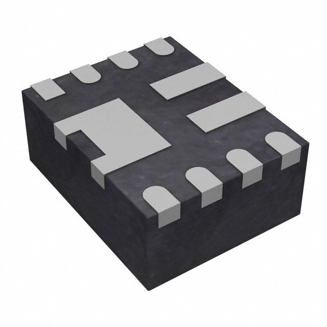

    TPS61089x是一款全集成同步升压转换器,具有2.7V至12V的宽输入电压范围,支持单节或双节锂离子/聚合物电池供电。该器件能够提供高达12.6V的输出电压,最大输出电流为7A。TPS61089x...
TPS61089RNRT 数据手册
TPS61089, TPS610891 SLVSD38C – NOVEMBER 2015 – REVISED AUGUST 2021 TPS61089x 12.6-V, 7-A Fully-Integrated Synchronous Boost Converters in 2.0-mm x 2.5-mm VQFN Package 1 Features • • • • • • • • • • • • • Input voltage range: 2.7 V to 12 V Output voltage range: 4.5 V to 12.6 V Up to 90% efficiency at VIN = 3.3 V, VOUT = 9 V, and IOUT = 2 A Resistor-programmable peak current limit up to 10 A for high pulse current Adjustable switching frequency: 200 kHz to 2.2 MHz 4-ms built-in soft start time PFM operation mode at light load (TPS61089) Forced PWM operation mode at light load (TPS610891) Internal output overvoltage protection at 13.2 V Cycle-by-cycle overcurrent protection Thermal shutdown 2.00-mm × 2.50-mm VQFN HotRod™ package Create a custom design using the TPS61089x with the WEBENCH® Power Designer 2 Applications • • • Bluetooth™ speaker Quick charge power bank Portable POS terminal solution for portable equipment. The TPS61089x features a wide input voltage range from 2.7 V to 12 V to support applications powered with single-cell or two-cell Lithium ion/polymer batteries. The TPS61089x has 7-A continuous switch current capability and provides output voltage up to 12.6 V. The TPS61089x uses adaptive constant off-time peak current control topology to regulate the output voltage. In moderate to heavy load condition, the TPS61089x works in the pulse width modulation (PWM) mode. In light load condition, the TPS61089 works in the pulse frequency modulation (PFM) mode to improve the efficiency, while the TPS610891 still works in the PWM mode to avoid application problems caused by low switching frequency. The switching frequency in PWM mode is adjustable from 200 kHz to 2.2 MHz. The TPS61089x also implements a built-in 4-ms soft start function and an adjustable peak switch current limit function. In addition, the device provides 13.2-V output overvoltage protection, cycle-by-cycle overcurrent protection, and thermal shutdown protection. The TPS61089x is available in an extremely compact size of a 2.0-mm × 2.5-mm 11-pin VQFN package. 3 Description Device Information Table The TPS61089x represents the TPS61089 and the TPS610891. The TPS61089x is a fully-integrated synchronous boost converter with a 19-mΩ main power switch and a 27-mΩ rectifier switch. The device provides a high-efficiency and small-size power (1) PART NUMBER PACKAGE(1) BODY SIZE (NOM) TPS61089x VQFN (11) 2.00 mm × 2.50 mm For all available packages, see the orderable addendum at the end of the data sheet. L1 VIN VOUT SW C4 R3 C1 VOUT C2 BOOT GND R1 FSW VIN FB EN COMP ON R2 OFF C6 VCC R5 ILIM C3 R4 C5 Typical Application Circuit An IMPORTANT NOTICE at the end of this data sheet addresses availability, warranty, changes, use in safety-critical applications, intellectual property matters and other important disclaimers. UNLESS OTHERWISE NOTED, this document contains PRODUCTION DATA. TPS61089, TPS610891 www.ti.com SLVSD38C – NOVEMBER 2015 – REVISED AUGUST 2021 Table of Contents 1 Features............................................................................1 2 Applications..................................................................... 1 3 Description.......................................................................1 4 Revision History.............................................................. 2 5 Device Comparison Table...............................................3 6 Pin Configuration and Functions...................................4 7 Specifications.................................................................. 5 7.1 Absolute Maximum Ratings........................................ 5 7.2 ESD Ratings............................................................... 5 7.3 Recommended Operating Conditions.........................5 7.4 Thermal Information....................................................5 7.5 Electrical Characteristics.............................................6 7.6 Typical Characteristics................................................ 7 8 Detailed Description........................................................9 8.1 Overview..................................................................... 9 8.2 Functional Block Diagram........................................... 9 8.3 Feature Description...................................................10 8.4 Device Functional Modes..........................................11 9 Application and Implementation.................................. 13 9.1 Application Information............................................. 13 9.2 Typical Application.................................................... 13 10 Power Supply Recommendations..............................21 11 Layout........................................................................... 22 11.1 Layout Guidelines................................................... 22 11.2 Layout Example...................................................... 22 12 Device and Documentation Support..........................24 12.1 Device Support....................................................... 24 12.2 Receiving Notification of Documentation Updates..24 12.3 Support Resources................................................. 24 12.4 Trademarks............................................................. 24 12.5 Electrostatic Discharge Caution..............................24 12.6 Glossary..................................................................24 13 Mechanical, Packaging, and Orderable Information.................................................................... 25 4 Revision History NOTE: Page numbers for previous revisions may differ from page numbers in the current version. Changes from Revision B (July 2016) to Revision C (August 2021) Page • Updated the numbering format for tables, figures and cross-references throughout the document. .................1 • Corrected grammar and numeric format throughout document..........................................................................1 • Added WEBENCH links......................................................................................................................................1 Changes from Revision A (April 2016) to Revision B (July 2016) Page • Changed x axis in .............................................................................................................................................. 7 • Changed x axis in .............................................................................................................................................. 7 2 Submit Document Feedback Copyright © 2021 Texas Instruments Incorporated Product Folder Links: TPS61089 TPS610891 TPS61089, TPS610891 www.ti.com SLVSD38C – NOVEMBER 2015 – REVISED AUGUST 2021 5 Device Comparison Table (1) PART NUMBER OPERATION MODE AT LIGHT LOAD TPS61089RNR PFM TPS610891RNR(1) Forced PWM Product Preview. Contact TI factory for more information. Submit Document Feedback Copyright © 2021 Texas Instruments Incorporated Product Folder Links: TPS61089 TPS610891 3 TPS61089, TPS610891 www.ti.com SLVSD38C – NOVEMBER 2015 – REVISED AUGUST 2021 SW 6 Pin Configuration and Functions FSW BOOT VCC VIN FB ILIM VOUT EN GND COMP Figure 6-1. 11-Pin VQFN With Thermal Pad RNR Package (Top View) Table 6-1. Pin Functions PIN NAME 4 NUMBER I/O DESCRIPTION FSW 1 I The switching frequency is programmed by a resister between this pin and the SW pin. VCC 2 O Output of the internal regulator. A ceramic capacitor of more than 1.0 µF is required between this pin and ground. FB 3 I Output voltage feedback COMP 4 O Output of the internal error amplifier. The loop compensation network should be connected between this pin and the GND pin. GND 5 PWR Ground VOUT 6 PWR Boost converter output EN 7 I Enable logic input. Logic high level enables the device. Logic low level disables the device and turns it into shutdown mode. ILIM 8 O Adjustable switching peak current limit. An external resister should be connected between this pin and the GND pin. VIN 9 I IC power supply input BOOT 10 O Power supply for high-side MOSFET gate driver. A capacitor must be connected between this pin and the SW pin SW 11 PWR The switching node pin of the converter. It is connected to the drain of the internal low-side power MOSFET and the source of the internal high-side power MOSFET. Submit Document Feedback Copyright © 2021 Texas Instruments Incorporated Product Folder Links: TPS61089 TPS610891 TPS61089, TPS610891 www.ti.com SLVSD38C – NOVEMBER 2015 – REVISED AUGUST 2021 7 Specifications 7.1 Absolute Maximum Ratings over operating free-air temperature (unless otherwise noted)(1) MIN MAX BOOT –0.3 SW + 7 VIN, SW, FSW, VOUT –0.3 14.5 EN, VCC, COMP –0.3 7 ILIM, FB –0.3 3.6 Operating junction temperature, TJ –40 150 °C Storage temperature, Tstg –65 150 °C Voltage at terminals(2) (1) (2) UNIT V Stresses beyond those listed under Absolute Maximum Ratings may cause permanent damage to the device. These are stress ratings only, which do not imply functional operation of the device at these or any other conditions beyond those indicated under Recommended Operating Conditions. Exposure to absolute-maximum-rated conditions for extended periods may affect device reliability. All voltage values are with respect to network ground terminal. 7.2 ESD Ratings VALUE V(ESD) (1) (2) Electrostatic discharge Human body model (HBM), per ANSI/ESDA/JEDEC JS-001, all pins (1) UNIT ±2000 Charged device model (CDM), per JEDEC specification JESD22-C101, all pins (2) V ±500 JEDEC document JEP155 states that 500-V HBM allows safe manufacturing with a standard ESD control process. JEDEC document JEP157 states that 250-V CDM allows safe manufacturing with a standard ESD control process. 7.3 Recommended Operating Conditions over operating free-air temperature range (unless otherwise noted) MIN VIN Input voltage range VOUT Output voltage range L Inductance, effective value CIN Input capacitance, effective value 10 CO Output capacitance, effective value 10 TJ Operating junction temperature NOM MAX 2.7 12 4.5 0.47 12.6 UNIT V V 2.2 10 µH 47 1000 µF 125 °C µF –40 7.4 Thermal Information TPS61089x THERMAL METRIC(1) RNR (VQFN) UNIT 11 PINS RθJA Junction-to-ambient thermal resistance 53.4 °C/W RθJC(top) Junction-to-case (top) thermal resistance 59.2 °C/W RθJB Junction-to-board thermal resistance 9.6 °C/W ψJT Junction-to-top characterization parameter 0.5 °C/W ψJB Junction-to-board characterization parameter 9.5 °C/W RθJC(bot) Junction-to-case (bottom) thermal resistance 0.7 °C/W RθJA(EVM) (2) Junction-to-ambient thermal resistance on EVM 39.2 °C/W (1) For more information about traditional and new thermal metrics, see the Semiconductor and IC Package Thermal Metrics application report. Submit Document Feedback Copyright © 2021 Texas Instruments Incorporated Product Folder Links: TPS61089 TPS610891 5 TPS61089, TPS610891 www.ti.com SLVSD38C – NOVEMBER 2015 – REVISED AUGUST 2021 (2) The EVM board is a 4-layer PCB of 76-mm x 52-mm size. The copper thickness of top layer and bottom layer is 2 oz. The copper thickness of inner layers is 1 oz. 7.5 Electrical Characteristics VIN = 2.7 V to 5.5 V, VOUT = 9 V, TJ = –40°C to 125°C. Typical values are at TJ = 25°C, unless otherwise noted. PARAMETER TEST CONDITIONS MIN TYP MAX UNIT POWER SUPPLY VIN Input voltage range 2.7 VIN rising 12 V 2.7 V 2.5 V VIN_UVLO Input voltage undervoltage lockout (UVLO) threshold VIN_HYS VIN UVLO hysteresis 200 mV VCC VCC regulation voltage ICC = 2 mA, VIN = 8 V 5.8 V VCC_UVLO VCC UVLO threshold VCC falling 2.1 V Quiescent current into VIN pin IC enabled, No load, VIN = 2.7 V to 5.5 V, VFB = 1.3 V, VOUT = 12 V, TJ ≤ 85°C 1 3 µA Quiescent current into VOUT pin IC enabled, No load, VIN = 2.7 V to 5.5 V, VFB = 1.3 V, VOUT = 12 V, TJ ≤ 85°C 100 180 µA Shutdown current into VIN pin IC disabled, VIN = 2.7 V to 5.5 V, TJ ≤ 85°C 1 3 µA 12.6 V 1.212 1.236 V IQ ISD VIN falling 2.4 OUTPUT VOUT Output voltage range 4.5 PWM mode VREF Reference voltage at FB pin IFB_LKG Leakage current into FB pin VFB = 1.2 V VOVP Output overvoltage protection threshold VOUT rising VOVP_HYS Output overvoltage protection hysteresis VOUT falling below VOVP tSS Soft startup time COUT(effective) = 47 µF, IOUT = 0 A 1.188 PFM mode 1.224 12.7 13.2 V 100 nA 13.6 V 0.25 2 4 V 6 ms ERROR AMPLIFIER ISINK COMP pin sink current VFB = VREF + 200 mV, VCOMP = 1.9 V 20 µA ISOURCE COMP pin source current VFB = VREF – 200 mV, VCOMP = 1.9 V 20 µA VCCLP_H High clamp voltage at the COMP pin VFB = 1 V, RILIM = 127 kΩ 2.3 V VCCLP_L Low clamp voltage at the COMP pin VFB = 1.4 V, RILIM = 127 kΩ 1.4 V GEA Error amplifier transconductance VCOMP = 1.9 V 190 µS POWER SWITCH RDS(on) High-side MOSFET on-resistance VCC = 6 V 27 44 mΩ Low-side MOSFET on-resistance VCC = 6 V 19 31 mΩ SWITCHING FREQUENCY fSW Switching frequency tON_min Minimum on time RFSW = 301 kΩ 500 RFSW = 46.4 kΩ 2000 VCC = 6 V kHz kHz 90 180 ns CURRENT LIMIT ILIM Peak switch current limit, TPS61089 VILIM Internal reference voltage at ILIM pin RILIM = 127 kΩ 7.3 8.1 8.9 A RILIM = 100 kΩ 9.0 10 11 A 1.212 V EN LOGIC INPUT VEN_H EN Logic high threshold VEN_L EN Logic Low threshold REN EN pulldown resistor 1.2 0.4 V V 800 kΩ 150 °C 20 °C PROTECTION 6 TSD Thermal shutdown threshold TJ rising TSD_HYS Thermal shutdown hysteresis TJ falling below TSD Submit Document Feedback Copyright © 2021 Texas Instruments Incorporated Product Folder Links: TPS61089 TPS610891 TPS61089, TPS610891 www.ti.com SLVSD38C – NOVEMBER 2015 – REVISED AUGUST 2021 7.6 Typical Characteristics 100 100 90 90 80 80 70 70 Efficiency (%) Efficiency (%) VIN = 3.6 V, VOUT = 9 V, TJ = 25°C, unless otherwise noted 60 50 40 30 40 20 VIN = 3 V VIN = 3.6 V VIN = 4.2 V 10 0.001 0.01 0.1 Output Current (A) TPS61089 1 VOUT = 5 V VOUT = 9 V VOUT = 12 V 10 0 0.0001 10 0.001 0.01 0.1 Output Current (A) D001 VOUT = 9 V TPS61089 Figure 7-1. Load Efficiency with Different Input Voltage 1 10 D001 VIN = 3.6 V Figure 7-2. Load Efficiency with Different Output Voltage 12 2500 10 2000 Frequency (kHz) Current Limit (A) 50 30 20 0 0.0001 60 8 6 4 1500 1000 500 2 0 100 0 150 200 250 300 Resistance (k:) 350 0 400 100 200 300 400 500 600 Resistance (k:) 700 800 900 D004 D003 TPS61089 Figure 7-4. Switching Frequency Setting Figure 7-3. Switching Peak Current Limit Setting 160 1.22 140 Quiescent Current (PA) Reference Voltage (V) 1.216 1.212 1.208 1.204 120 100 80 60 40 1.2 -40 -20 0 20 40 60 80 Temperature (°C) 100 120 140 20 -40 -20 D005 Figure 7-5. Reference Voltage vs Temperature 0 20 40 Temperature (°C) 60 80 100 D006 Figure 7-6. Quiescent Current vs Temperature Submit Document Feedback Copyright © 2021 Texas Instruments Incorporated Product Folder Links: TPS61089 TPS610891 7 TPS61089, TPS610891 www.ti.com SLVSD38C – NOVEMBER 2015 – REVISED AUGUST 2021 2 Shutdown Current (PA) 1.6 1.2 0.8 0.4 0 -40 -20 0 20 40 Temperature (°C) 60 80 100 D007 Figure 7-7. Shutdown Current vs Temperature 8 Submit Document Feedback Copyright © 2021 Texas Instruments Incorporated Product Folder Links: TPS61089 TPS610891 TPS61089, TPS610891 www.ti.com SLVSD38C – NOVEMBER 2015 – REVISED AUGUST 2021 8 Detailed Description 8.1 Overview The TPS61089x is a synchronous boost converter, integrating a 19-mΩ main power switch and a 27-mΩ rectifier switch with adjustable switch current up to 10 A. It is capable to output continuous power more than 18 W from input of a single cell Lithium-ion battery or two-cell Lithium-ion batteries in series. The TPS61089x operates at a quasi-constant frequency pulse-width modulation (PWM) at moderate to heavy load currents. At light load current, the TPS61089 operates in PFM mode and the TPS610891 operates in forced PWM (FPWM) mode. The PFM mode brings high efficiency over the entire load range, and the FPWM mode can avoid the acoustic noise and switching frequency interference at light load. The converter uses the constant off-time peak current mode control scheme, which provides excellent line and load transient response with minimal output capacitance. The external loop compensation brings flexibility to use different inductors and output capacitors. The TPS61089x supports adjustable switching frequency ranging from 200 kHz to 2.2 MHz. The device implements cycle-bycycle current limit to protect the device from overload conditions during boost switching. The current limit is set by an external resistor. 8.2 Functional Block Diagram L1 VIN C4 C1 SW BOOT VIN VOUT VOUT deadme control logic C2 Q VCC Shutdown LDO C3 R1 GND S R Comp Comp CLIMIT FSW FB Comp Gm R2 R3 Vref 1/K SW VIN COMP R5 EN C5 ON/ OFF Shutdown Control VOUT OVP VIN UVLO Shutdown Vref CLIMIT Thermal shutdown ILIM R4 Submit Document Feedback Copyright © 2021 Texas Instruments Incorporated Product Folder Links: TPS61089 TPS610891 9 TPS61089, TPS610891 SLVSD38C – NOVEMBER 2015 – REVISED AUGUST 2021 www.ti.com 8.3 Feature Description 8.3.1 Undervoltage Lockout (UVLO) An undervoltage lockout (UVLO) circuit stops the operation of the converter when the input voltage drops below the typical UVLO threshold of 2.5 V. A hysteresis of 200 mV is added so that the device cannot be enabled again until the input voltage goes up to 2.7 V. This function is implemented to prevent the device from malfunctioning when the input voltage is between 2.5 V and 2.7 V. 8.3.2 Enable and Disable When the input voltage is above maximal UVLO rising threshold of 2.7 V and the EN pin is pulled above the high threshold, the TPS61089x is enabled. When the EN pin is pulled below the low threshold, the TPS61089x goes into shutdown mode. The device stops switching in shutdown mode and consumes less than 3-µA current. Because of the body diode of the high-side rectifier FET, the input voltage goes through the body diode and appears at the VOUT pin at shutdown mode. 8.3.3 Soft Start The TPS61089x implements the soft start function to reduce the inrush current during start-up. The TPS61089x begins soft start when the EN pin is pulled to logic high voltage. The soft start time is typically 4 ms. 8.3.4 Adjustable Switching Frequency The TPS61089x features a wide adjustable switching frequency ranging from 200 kHz to 2.2 MHz. The switching frequency is set by a resistor connected between the FSW pin and the SW pin of the TPS61089x. Do not leave the FSW pin open. Use Equation 1 to calculate the resistor value required for a desired frequency. 4u( RFREQ 1 ¦SW tDELAY u VOUT ) 9IN CFREQ (1) where • • • • • • RFREQ is the resistance connected between the FSW pin and the SW pin CFREQ = 24 pF ƒSW is the desired switching frequency tDELAY = 86 ns VIN is the input voltage VOUT is the output voltage 8.3.5 Adjustable Peak Current Limit To avoid an accidental large peak current, an internal cycle-by-cycle current limit is adopted. The low-side switch turns off immediately as long as the peak switch current touches the limit. The peak inductor current can be set by selecting the correct external resistor value correlating with the required current limit. Use Equation 2 to calculate the correct resistor value for the TPS61089. ILIM = 1030000 RILIM (2) where • • RILIM is the resistance connected between the ILIM pin and ground ILIM is the switch peak current limit For a typical current limit of 8 A, the resistor value is 127 kΩ for the TPS61089. 8.3.6 Overvoltage Protection If the output voltage at the VOUT pin is detected above the overvoltage protection threshold of 13.2 V (typical value), the TPS61089x stops switching immediately until the voltage at the VOUT pin drops the hysteresis 10 Submit Document Feedback Copyright © 2021 Texas Instruments Incorporated Product Folder Links: TPS61089 TPS610891 www.ti.com TPS61089, TPS610891 SLVSD38C – NOVEMBER 2015 – REVISED AUGUST 2021 voltage lower than the output overvoltage protection threshold. This function prevents overvoltage on the output and secures the circuits connected to the output from excessive overvoltage. 8.3.7 Thermal Shutdown A thermal shutdown is implemented to prevent damage due to excessive heat and power dissipation. Typically, the thermal shutdown happens at the junction temperature of 150°C. When the thermal shutdown is triggered, the device stops switching until the junction temperature falls below typically 130°C, then the device starts switching again. 8.4 Device Functional Modes 8.4.1 Operation The TPS61089x synchronous boost converter operates at a quasi-constant frequency pulse width modulation (PWM) in moderate to heavy load condition. Based on the VIN to VOUT ratio, a circuit predicts the required off-time of the switching cycle. At the beginning of each switching cycle, the low-side N-MOSFET switch, shown in Section 8.2, is turned on, and the inductor current ramps up to a peak current that is determined by the output of the internal error amplifier. After the peak current is reached, the current comparator trips, and turns off the low-side N-MOSFET switch and the inductor current goes through the body diode of the high-side N-MOSFET in a dead-time duration. After the dead-time duration, the high-side N-MOSFET switch is turned on. Since the output voltage is higher than the input voltage, the inductor current decreases. The high-side switch is not turned off until the fixed off-time is reached. After a short dead-time duration, the low-side switch is turned on again and the switching cycle is repeated. In light load condition, the TPS61089 implements PFM mode for applications requiring high efficiency at light load. And the TPS610891 implements forced PWM mode for applications requiring fixed switching frequency to avoid unexpected switching noise interference. 8.4.1.1 Forced PWM Mode In forced PWM mode, the TPS610891 keeps the switching frequency unchanged in light load condition. When the load current decreases, the output of the internal error amplifier decreases as well to keep the inductor peak current down, delivering less power from input to output. When the output current further reduces, the current through the inductor will decrease to zero during the off-time. The high-side N-MOSFET is not turned off even if the current through the MOSFET is zero. Thus, the inductor current changes its direction after it runs to zero. The power flow is from output side to input side. The efficiency will be low in this mode. But with the fixed switching frequency, there is no audible noise and other problems which might be caused by low switching frequency in light load condition. 8.4.1.2 PFM Mode The TPS61089 improves the efficiency at light load with PFM mode. When the converter operates in light load condition, the output of the internal error amplifier decreases to make the inductor peak current down, delivering less power to the load. When the output current further reduces, the current through the inductor will decrease to zero during the off-time. Once the current through the high-side N-MOSFET is zero, the high-side MOSFET is turned off until the beginning of the next switching cycle. When the output of the error amplifier continuously goes down and reaches a threshold with respect to the peak current of ILIM / 10, the output of the error amplifier is clamped at this value and does not decrease any more. If the load current is smaller than what the TPS61089 delivers, the output voltage increases above the nominal setting output voltage. The TPS61089 extends its off time of the switching period to deliver less energy to the output and regulate the output voltage to 1.0% higher than the nominal setting voltage. With the PFM operation mode, the TPS61089 keeps the efficiency above 70% even when the load current decreases to 1 mA. At light load, the output voltage ripple is much smaller due to low peak inductor current. Refer to Figure 8-1. Submit Document Feedback Copyright © 2021 Texas Instruments Incorporated Product Folder Links: TPS61089 TPS610891 11 TPS61089, TPS610891 www.ti.com SLVSD38C – NOVEMBER 2015 – REVISED AUGUST 2021 Output Voltage PFM mode at light load 1.01 x VOUT_NOM VOUT_NOM PWM mode at heavy load Figure 8-1. Output Voltage in PWM Mode and PFM Mode 12 Submit Document Feedback Copyright © 2021 Texas Instruments Incorporated Product Folder Links: TPS61089 TPS610891 TPS61089, TPS610891 www.ti.com SLVSD38C – NOVEMBER 2015 – REVISED AUGUST 2021 9 Application and Implementation Note Information in the following applications sections is not part of the TI component specification, and TI does not warrant its accuracy or completeness. TI’s customers are responsible for determining suitability of components for their purposes, as well as validating and testing their design implementation to confirm system functionality. 9.1 Application Information The TPS61089x is designed for outputting voltage up to 12.6 V with 7-A continuous switch current capability to deliver more than 18-W power. The TPS61089x operates at a quasi-constant frequency pulse-width modulation (PWM) in moderate to heavy load condition. In light load condition, the TPS61089 operates in PFM mode and the TPS610891 operates in forced PWM mode. The PFM mode brings high efficiency over entire load range, while PWM mode can avoid the acoustic noise as the switching frequency is fixed. In PWM mode, the TPS61089x converter uses the adaptive constant off-time peak current control scheme, which provides excellent transient line and load response with minimal output capacitance. The TPS61089x can work with a different inductor and output capacitor combination by external loop compensation. It also supports adjustable switching frequency ranging from 200 kHz to 2.2 MHz. 9.2 Typical Application L1 1.8µH VIN = 3.0V to 4.35V C1 22µF VOUT = 9V SW C4 0.1µF BOOT R3 301k VOUT C2 3 x 22µF GND R1 681k FSW VIN FB EN COMP ON OFF VCC R2 107k C6 ILIM C3 2.2µF R4 127k R5 17.4k C5 4.7nF Figure 9-1. TPS61089x Single Cell Li-ion Battery to 9-V/2-A Output Converter 9.2.1 Design Requirements Table 9-1. Design Parameters DESIGN PARAMETERS EXAMPLE VALUES Input voltage range 3.0 to 4.35 V Output voltage 9V Output voltage ripple 100 mV peak to peak Output current rating 2A Operating frequency 500 kHz Operation mode at light load PFM Submit Document Feedback Copyright © 2021 Texas Instruments Incorporated Product Folder Links: TPS61089 TPS610891 13 TPS61089, TPS610891 www.ti.com SLVSD38C – NOVEMBER 2015 – REVISED AUGUST 2021 9.2.2 Detailed Design Procedure 9.2.2.1 Custom Design With WEBENCH® Tools Click here to create a custom design using the TPS61089x device with the WEBENCH® Power Designer. 1. Start by entering the input voltage (VIN), output voltage (VOUT), and output current (IOUT) requirements. 2. Optimize the design for key parameters such as efficiency, footprint, and cost using the optimizer dial. 3. Compare the generated design with other possible solutions from Texas Instruments. The WEBENCH Power Designer provides a customized schematic along with a list of materials with real-time pricing and component availability. In most cases, these actions are available: • Run electrical simulations to see important waveforms and circuit performance • Run thermal simulations to understand board thermal performance • Export customized schematic and layout into popular CAD formats • Print PDF reports for the design, and share the design with colleagues Get more information about WEBENCH tools at www.ti.com/WEBENCH. 9.2.2.2 Setting Switching Frequency The switching frequency is set by a resistor connected between the FSW pin and the SW pin of the TPS61089x. The resistor value required for a desired frequency can be calculated using Equation 3. 4u( RFREQ 1 ¦SW tDELAY u VOUT ) 9IN CFREQ (3) where • • • • • • RFREQ is the resistance connected between the FSW pin and the SW pin CFREQ = 24 pF ƒSW is the desired switching frequency tDELAY = 86 ns VIN is the input voltage VOUT is the output voltage 9.2.2.3 Setting Peak Current Limit The peak input current is set by selecting the correct external resistor value correlating to the required current limit. Use Equation 4 to calculate the correct resistor value: ILIM = 1030000 RILIM (4) where • • RILIM is the resistance connected between the ILIM pin and ground ILIM is the switching peak current limit For a typical current limit of 8 A, the resistor value is 127 kΩ. Considering the device variation and the tolerance over temperature, the minimum current limit at the worst case can be 0.8 A lower than the value calculated by Equation 4. The minimum current limit must be higher than the required peak switch current at the lowest input voltage and the highest output power to make sure the TPS61089x does not hit the current limit and still can regulate the output voltage in these conditions. 14 Submit Document Feedback Copyright © 2021 Texas Instruments Incorporated Product Folder Links: TPS61089 TPS610891 TPS61089, TPS610891 www.ti.com SLVSD38C – NOVEMBER 2015 – REVISED AUGUST 2021 9.2.2.4 Setting Output Voltage The output voltage is set by an external resistor divider (R1, R2 in TPS61089x Single Cell Li-ion Battery to 9-V/2-A Output Converter). Typically, a minimum current of 10 μA flowing through the feedback divider gives good accuracy and noise covering. A resistor of less than 120 kΩ is typically selected for low-side resistor R2. When the output voltage is regulated, the typical voltage at the FB pin is VREF. Thus, the value of R1 is calculated as: R1 (VOUT VREF ) u R2 VREF (5) 9.2.2.5 Inductor Selection Because the selection of the inductor affects the steady state operation of the power supply, transient behavior, loop stability, and boost converter efficiency, the inductor is the most important component in switching power regulator design. Three most important specifications to the performance of the inductor are the inductor value, DC resistance, and saturation current. The TPS61089x is designed to work with inductor values between 0.47 µH and 10 µH. A 0.47-µH inductor is typically available in a smaller or lower-profile package, while a 10-µH inductor produces lower inductor current ripple. If the boost output current is limited by the peak current protection of the IC, using a 10-µH inductor can maximize the controller’s output current capability. Inductor values can have ±20% or even ±30% tolerance with no current bias. When the inductor current approaches saturation level, its inductance can decrease 20% to 35% from the value at 0-A current depending on how the inductor vendor defines saturation. When selecting an inductor, make sure its rated current, especially the saturation current, is larger than its peak current during the operation. Follow Equation 6 to Equation 7 to calculate the peak current of the inductor. To calculate the current in the worst case, use the minimum input voltage, maximum output voltage, and maximum load current of the application. To leave enough design margin, TI recommends using the minimum switching frequency, the inductor value with –30% tolerance, and a low-power conversion efficiency for the calculation. In a boost regulator, calculate the inductor DC current as in Equation 6. IDC VOUT u IOUT VIN u K (6) where • • • • VOUT is the output voltage of the boost regulator IOUT is the output current of the boost regulator VIN is the input voltage of the boost regulator η is the power conversion efficiency Calculate the inductor current peak-to-peak ripple as in Equation 7. 1 IPP /u 1 VOUT VIN 1 u ¦SW VIN (7) where • • • • • IPP is the inductor peak-to-peak ripple L is the inductor value ƒSW is the switching frequency VOUT is the output voltage VIN is the input voltage Submit Document Feedback Copyright © 2021 Texas Instruments Incorporated Product Folder Links: TPS61089 TPS610891 15 TPS61089, TPS610891 www.ti.com SLVSD38C – NOVEMBER 2015 – REVISED AUGUST 2021 Therefore, the peak current, ILpeak, seen by the inductor is calculated with Equation 8. ILpeak IDC IPP 2 (8) Set the current limit of the TPS61089x higher than the peak current ILpeak. Then select the inductor with saturation current higher than the setting current limit. Boost converter efficiency is dependent on the resistance of its current path, the switching loss associated with the switching MOSFETs, and the core loss of the inductor. The TPS61089x has optimized the internal switch resistance. However, the overall efficiency is affected significantly by the DC resistance (DCR) of the inductor, equivalent series resistance (ESR) at the switching frequency, and the core loss. Core loss is related to the core material and different inductors have different core loss. For a certain inductor, larger current ripple generates higher DCR and ESR conduction losses and higher core loss. Usually, a data sheet of an inductor does not provide the ESR and core loss information. If needed, consult the inductor vendor for detailed information. Generally, TI would recommend an inductor with lower DCR and ESR. However, there is a tradeoff among the inductance of the inductor, DCR and ESR resistance, and its footprint. Furthermore, shielded inductors typically have higher DCR than unshielded inductors. Table 9-2 lists recommended inductors for the TPS61089x. Verify whether the recommended inductor can support the user's target application with the previous calculations and bench evaluation. In this application, the Sumida inductor CDMC8D28NP-1R8MC is selected for its small size and low DCR. Table 9-2. Recommended Inductors SATURATION CURRENT / HEAT RATING CURRENT (A) SIZE MAX (L × W × H mm) VENDOR 12.6 9.4 / 9.3 9.5 x 8.7 x 3.0 Sumida 7.2 14.0 / 11.0 7.3 x 7.2 x 4.0 WurthElektronik 12.5 13.0 / 9.0 7.3 × 7.2 × 4.0 WurthElektronik 9.0 16 / 13 11.2 × 10.3 × 3.0 Cyntec 12.5 12 / 10.5 7.4 × 6.8 × 5.0 Cyntec PART NUMBER L (µH) DCR MAX (mΩ) CDMC8D28NP-1R8MC 1.8 744311150 1.5 744311220 2.2 PIMB103T-2R2MS 2.2 PIMB065T-2R2MS 2.2 9.2.2.6 Input Capacitor Selection For good input voltage filtering, TI recommends low-ESR ceramic capacitors. The VIN pin is the power supply for the TPS61089x. A 0.1-μF ceramic bypass capacitor is recommended as close as possible to the VIN pin of the TPS61089x. The VCC pin is the output of the internal LDO. A ceramic capacitor of more than 1.0 μF is required at the VCC pin to get a stable operation of the LDO. For the power stage, because of the inductor current ripple, the input voltage changes if there is parasitic inductance and resistance between the power supply and the inductor. It is recommended to have enough input capacitance to make the input voltage ripple less than 100 mV. Generally, 10-μF input capacitance is sufficient for most applications. Note DC bias effect: High-capacitance ceramic capacitors have a DC bias effect, which has a strong influence on the final effective capacitance. Therefore, the right capacitor value must be chosen carefully. The differences between the rated capacitor value and the effective capacitance result from package size and voltage rating in combination with material. A 10-V rated 0805 capacitor with 10 μF can have an effective capacitance of less 5 μF at an output voltage of 5 V. 9.2.2.7 Output Capacitor Selection For small output voltage ripple, TI recommends a low-ESR output capacitor like a ceramic capacitor. Typically, three 22-μF ceramic output capacitors work for most applications. Higher capacitor values can be used to improve the load transient response. Take care when evaluating a capacitor’s derating under DC bias. The bias 16 Submit Document Feedback Copyright © 2021 Texas Instruments Incorporated Product Folder Links: TPS61089 TPS610891 TPS61089, TPS610891 www.ti.com SLVSD38C – NOVEMBER 2015 – REVISED AUGUST 2021 can significantly reduce capacitance. Ceramic capacitors can lose most of their capacitance at rated voltage. Therefore, leave margin on the voltage rating to ensure adequate effective capacitance. From the required output voltage ripple, use the following equations to calculate the minimum required effective capacitance CO: (VOUT Vripple _ dis VIN _ MIN ) u IOUT 9OUT u ¦SW u &O Vripple _ ESR (9) ILpeak u RESR (10) where • • • • • • • • Vripple_dis is output voltage ripple caused by charging and discharging of the output capacitor. Vripple_ESR is output voltage ripple caused by ESR of the output capacitor. VIN_MIN is the minimum input voltage of boost converter. VOUT is the output voltage. IOUT is the output current. ILpeak is the peak current of the inductor. ƒSW is the converter's switching frequency. RESR is the ESR of the output capacitors. 9.2.2.8 Loop Stability The TPS61089x requires external compensation, which allows the loop response to be optimized for each application. The COMP pin is the output of the internal error amplifier. An external compensation network comprised of resistor R5, ceramic capacitors C5 and C6 is connected to the COMP pin. The power stage small signal loop response of constant off time (COT) with peak current control can be modeled by Equation 11. GPS (S) 5O u § ¨1 ' © u 2 u Rsense ·§ · S S ¸¨ 1 ¸ u S u ¦ESRZ ¹ © u S u ¦RHPZ ¹ S 1 u S u ¦P (11) where • • • • • • D is the switching duty cycle RO is the output load resistance Rsense is the equivalent internal current sense resistor, which is 0.08 Ω ƒP is the pole's frequency ƒESRZ is the zero's frequency ƒRHPZ is the right-half-plane-zero's frequency The D, ƒP, ƒESRZ, and ƒRHPZ can be calculated by following equations: D 1 VIN u K VOUT (12) where • η is the power conversion efficiency ¦P 2 2S u RO u CO (13) where • CO is effective capacitance of the output capacitor Submit Document Feedback Copyright © 2021 Texas Instruments Incorporated Product Folder Links: TPS61089 TPS610891 17 TPS61089, TPS610891 SLVSD38C – NOVEMBER 2015 – REVISED AUGUST 2021 ¦ESRZ 1 2S u RESR u CO www.ti.com (14) where • RESR is the equivalent series resistance of the output capacitor ¦RHPZ RO u 1 D 2 (15) 2S u L The COMP pin is the output of the internal transconductance amplifier. Equation 16 shows the small signal transfer function of compensation network. Gc(S) GEA u REA u VREF u VOUT § ¨1 © § · S ¨1 ¸ u S u ¦COMZ ¹ © ·§ · S S ¸¨ 1 ¸ u S u ¦COMP1 ¹© u S u ¦COMP2 ¹ (16) where • • • • • • GEA is the amplifier’s transconductance REA is the amplifier’s output resistance VREF is the refernce voltage at the FB pin VOUT is the output voltage ƒCOMP1, ƒCOMP2 are the poles' frequency of the compensation network ƒCOMZ is the zero's frequency of the compensation network The next step is to choose the loop crossover frequency, ƒC. The higher in frequency that the loop gain stays above zero before crossing over, the faster the loop response is. It is generally accepted that the loop gain cross over no higher than the lower of either 1/10 of the switching frequency, ƒSW, or 1/5 of the RHPZ frequency, ƒRHPZ. At the crossover frequency, the loop gain is 1. Thus the value of R5 can be calculated by Equation 17, then set the values of C5 and C6 (in TPS61089x Single Cell Li-ion Battery to 9-V/2-A Output Converter) by Equation 18 and Equation 19. R5 S u 9OUT u 5sense u ¦C u &O ± ' u 9REF u *EA (17) where • ƒC is the selected crossover frequency The value of C5 can be set by Equation 18. C5 RO u CO 2R5 (18) The value of C6 can be set by Equation 19. C6 RESR u CO R5 (19) If the calculated value of C6 is less than 10 pF, it can be left open. 18 Submit Document Feedback Copyright © 2021 Texas Instruments Incorporated Product Folder Links: TPS61089 TPS610891 TPS61089, TPS610891 www.ti.com SLVSD38C – NOVEMBER 2015 – REVISED AUGUST 2021 Designing the loop for greater than 45° of phase margin and greater than 10-dB gain margin eliminates output votlage ringing during the line and load transient. 9.2.3 Application Curves Vout (AC) 100 mV/div Vout (AC) 20 mV/div Inductor Current 2 A/div Inductor Current 1 A/div SW 3 V/div SW 3 V/div VIN = 3.6 V VOUT = 9 V IOUT = 2 A Figure 9-2. Switching Waveforms in CCM VIN = 3.6 V EN 1 V/div Inductor Current 600 mA/div Vout 2 V/div VIN = 3.6 V IOUT = 200 mA Figure 9-3. Switching Waveforms in DCM Vout (AC) 10 mV/div SW 3 V/div VOUT = 9 V Inductor Current 2 A/div VOUT = 9 V IOUT = 20 mA Figure 9-4. Switching Waveforms in PFM Mode EN 1 V/div Figure 9-5. Start-up Waveforms Output Current 500 mA/div Vout 2 V/div Vout (AC) 500 mV/div Inductor Current 2 A/div VIN = 3.6 V Figure 9-6. Shutdown Waveforms VOUT = 9V IOUT = 1 A to 2 A Figure 9-7. Load Transient Submit Document Feedback Copyright © 2021 Texas Instruments Incorporated Product Folder Links: TPS61089 TPS610891 19 TPS61089, TPS610891 www.ti.com SLVSD38C – NOVEMBER 2015 – REVISED AUGUST 2021 Input Voltage 500 mV/div Vout (AC) 200 mV/div VIN = 3.3 V to 4.0 V VOUT = 9 V IOUT = 2 A Figure 9-8. Line Transient 20 Submit Document Feedback Copyright © 2021 Texas Instruments Incorporated Product Folder Links: TPS61089 TPS610891 TPS61089, TPS610891 www.ti.com SLVSD38C – NOVEMBER 2015 – REVISED AUGUST 2021 10 Power Supply Recommendations The device is designed to operate from an input voltage supply range between 2.7 V to 12 V. This input supply must be well regulated. If the input supply is located more than a few inches from the converter, additional bulk capacitance can be required in addition to the ceramic bypass capacitors. A typical choice is an electrolytic or tantalum capacitor with a value of 47 μF. Submit Document Feedback Copyright © 2021 Texas Instruments Incorporated Product Folder Links: TPS61089 TPS610891 21 TPS61089, TPS610891 www.ti.com SLVSD38C – NOVEMBER 2015 – REVISED AUGUST 2021 11 Layout 11.1 Layout Guidelines As for all switching power supplies, especially those running at high switching frequency and high currents, layout is an important design step. If layout is not carefully done, the regulator could suffer from instability and noise problems. To maximize efficiency, switching rise time and fall time are very fast. To prevent radiation of high-frequency noise (for example, EMI), proper layout of the high-frequency switching path is essential. Minimize the length and area of all traces connected to the SW pin, and always use a ground plane under the switching regulator to minimize interplane coupling. The input capacitor needs to be close to the VIN pin and GND pin to reduce the input supply current ripple. The most critical current path for all boost converters is from the switching FET, through the rectifier FET, then the output capacitors, and back to ground of the switching FET. This high current path contains nanosecond rise time and fall time, and should be kept as short as possible. Therefore, the output capacitor needs not only to be close to the VOUT pin, but also to the GND pin to reduce the overshoot at the SW pin and VOUT pin. 11.2 Layout Example trace on bottom layer ILIM VIN BOOT GND VOUT EN SW VOUT SW GND FB VCC FSW COMP L CIN VIN COUT GND Figure 11-1. Layout Example 11.2.1 Thermal Considerations The maximum IC junction temperature should be restricted to 125°C under normal operating conditions. Calculate the maximum allowable dissipation, PD(max), and keep the actual power dissipation less than or equal to PD(max). The maximum-power-dissipation limit is determined using Equation 20. PD(max) 125 TA RTJA (20) where • • 22 TA is the maximum ambient temperature for the application RθJA is the junction-to-ambient thermal resistance given in the Thermal Information table Submit Document Feedback Copyright © 2021 Texas Instruments Incorporated Product Folder Links: TPS61089 TPS610891 www.ti.com TPS61089, TPS610891 SLVSD38C – NOVEMBER 2015 – REVISED AUGUST 2021 The TPS61089x comes in a thermally-enhanced VQFN package. The pads underneath the package improve the thermal capabilities of the package. The real junction-to-ambient thermal resistance of the package greatly depends on the PCB type, layout, and pad connection. Using thick PCB copper and soldering the SW pin, VOUT pin, and GND pin to large copper plate enhances the thermal performance. Using more vias connects the ground plate on the top layer and bottom layer around the IC without solder mask also improves the thermal capability. Submit Document Feedback Copyright © 2021 Texas Instruments Incorporated Product Folder Links: TPS61089 TPS610891 23 TPS61089, TPS610891 www.ti.com SLVSD38C – NOVEMBER 2015 – REVISED AUGUST 2021 12 Device and Documentation Support 12.1 Device Support 12.1.1 Third-Party Products Disclaimer TI'S PUBLICATION OF INFORMATION REGARDING THIRD-PARTY PRODUCTS OR SERVICES DOES NOT CONSTITUTE AN ENDORSEMENT REGARDING THE SUITABILITY OF SUCH PRODUCTS OR SERVICES OR A WARRANTY, REPRESENTATION OR ENDORSEMENT OF SUCH PRODUCTS OR SERVICES, EITHER ALONE OR IN COMBINATION WITH ANY TI PRODUCT OR SERVICE. 12.1.2 Development Support 12.1.2.1 Custom Design With WEBENCH® Tools Click here to create a custom design using the TPS61089x device with the WEBENCH® Power Designer. 1. Start by entering the input voltage (VIN), output voltage (VOUT), and output current (IOUT) requirements. 2. Optimize the design for key parameters such as efficiency, footprint, and cost using the optimizer dial. 3. Compare the generated design with other possible solutions from Texas Instruments. The WEBENCH Power Designer provides a customized schematic along with a list of materials with real-time pricing and component availability. In most cases, these actions are available: • Run electrical simulations to see important waveforms and circuit performance • Run thermal simulations to understand board thermal performance • Export customized schematic and layout into popular CAD formats • Print PDF reports for the design, and share the design with colleagues Get more information about WEBENCH tools at www.ti.com/WEBENCH. 12.2 Receiving Notification of Documentation Updates To receive notification of documentation updates, navigate to the device product folder on ti.com. Click on Subscribe to updates to register and receive a weekly digest of any product information that has changed. For change details, review the revision history included in any revised document. 12.3 Support Resources TI E2E™ support forums are an engineer's go-to source for fast, verified answers and design help — straight from the experts. Search existing answers or ask your own question to get the quick design help you need. Linked content is provided "AS IS" by the respective contributors. They do not constitute TI specifications and do not necessarily reflect TI's views; see TI's Terms of Use. 12.4 Trademarks HotRod™ and TI E2E™ are trademarks of Texas Instruments. WEBENCH® is a registered trademark of Texas Instruments. All trademarks are the property of their respective owners. 12.5 Electrostatic Discharge Caution This integrated circuit can be damaged by ESD. Texas Instruments recommends that all integrated circuits be handled with appropriate precautions. Failure to observe proper handling and installation procedures can cause damage. ESD damage can range from subtle performance degradation to complete device failure. Precision integrated circuits may be more susceptible to damage because very small parametric changes could cause the device not to meet its published specifications. 12.6 Glossary TI Glossary 24 This glossary lists and explains terms, acronyms, and definitions. Submit Document Feedback Copyright © 2021 Texas Instruments Incorporated Product Folder Links: TPS61089 TPS610891 TPS61089, TPS610891 www.ti.com SLVSD38C – NOVEMBER 2015 – REVISED AUGUST 2021 13 Mechanical, Packaging, and Orderable Information The following pages include mechanical, packaging, and orderable information. This information is the most current data available for the designated devices. This data is subject to change without notice and revision of this document. For browser-based versions of this data sheet, refer to the left-hand navigation. Submit Document Feedback Copyright © 2021 Texas Instruments Incorporated Product Folder Links: TPS61089 TPS610891 25 PACKAGE OPTION ADDENDUM www.ti.com 11-Oct-2022 PACKAGING INFORMATION Orderable Device Status (1) Package Type Package Pins Package Drawing Qty Eco Plan (2) Lead finish/ Ball material MSL Peak Temp Op Temp (°C) Device Marking (3) Samples (4/5) (6) TPS61089RNRR ACTIVE VQFN-HR RNR 11 3000 RoHS & Green Call TI | NIPDAU Level-1-260C-UNLIM -40 to 85 ZGOI Samples TPS61089RNRT ACTIVE VQFN-HR RNR 11 250 RoHS & Green NIPDAU Level-1-260C-UNLIM -40 to 85 ZGOI Samples (1) The marketing status values are defined as follows: ACTIVE: Product device recommended for new designs. LIFEBUY: TI has announced that the device will be discontinued, and a lifetime-buy period is in effect. NRND: Not recommended for new designs. Device is in production to support existing customers, but TI does not recommend using this part in a new design. PREVIEW: Device has been announced but is not in production. Samples may or may not be available. OBSOLETE: TI has discontinued the production of the device. (2) RoHS: TI defines "RoHS" to mean semiconductor products that are compliant with the current EU RoHS requirements for all 10 RoHS substances, including the requirement that RoHS substance do not exceed 0.1% by weight in homogeneous materials. Where designed to be soldered at high temperatures, "RoHS" products are suitable for use in specified lead-free processes. TI may reference these types of products as "Pb-Free". RoHS Exempt: TI defines "RoHS Exempt" to mean products that contain lead but are compliant with EU RoHS pursuant to a specific EU RoHS exemption. Green: TI defines "Green" to mean the content of Chlorine (Cl) and Bromine (Br) based flame retardants meet JS709B low halogen requirements of
