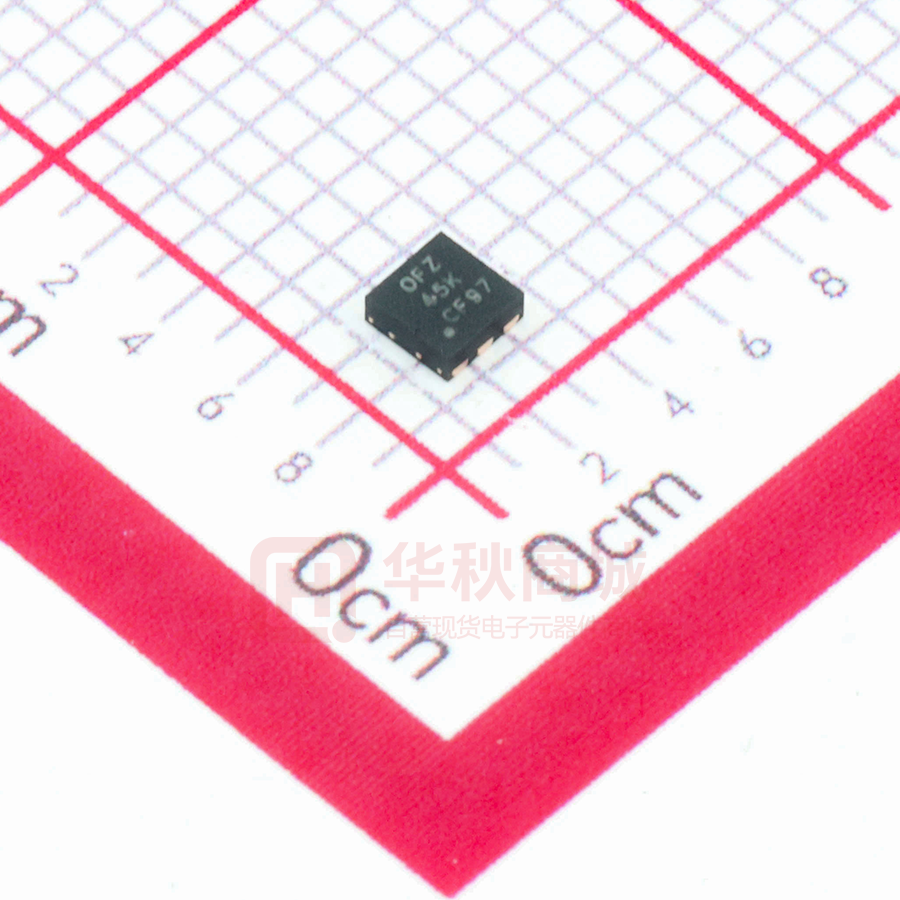

    TPS62122是一款高效同步降压转换器,支持2 V至15 V的宽输入电压范围,最大输出电流为75mA。该转换器采用先进的迟滞控制方案,提供高达96%的效率。在轻负载下,它进入脉冲频率调制(PFM)模...
TPS62122DRVR 数据手册
Sample & Buy Product Folder Support & Community Tools & Software Technical Documents Reference Design TPS62120, TPS62122 SLVSAD5A – JULY 2010 – REVISED AUGUST 2015 TPS6212x 15-V, 75-mA Highly Efficient Buck Converter 1 Features • • • • • • • • • • 1 • • • • Wide Input Voltage Range: 2 V to 15 V Up to 96% Efficiency Power Save Mode With 11-µA Quiescent Current Output Current 75 mA Output Voltage Range: 1.2 V to 5.5 V Up to 800-kHz Switch Frequency Synchronous Converter, No External Rectifier Low Output Ripple Voltage 100% Duty Cycle for Lowest Dropout Small SOT 8-Pin (TPS62120) and 2-mm × 2-mm DFN 6-Pin (TPS62122) Package Internal Soft Start Power Good Open Drain Output (TPS62120) Open-Drain Output for Output Discharge (TPS62120) 2.5-V Rising and 1.85-V Falling UVLO Thresholds The wide operating input voltage range of 2 V to 15 V supports energy harvesting, battery powered and as well 9-V or 12-V line powered applications. With its advanced hysteretic control scheme, the converter provides power save mode operation. At light loads the converter operates in pulse frequency modulation (PFM) mode and transitions automatically in pulse width modulation (PWM) mode at higher load currents. The power save mode maintains high efficiency over the entire load current range. The hysteretic control scheme is optimized for low output ripple voltage in PFM mode in order to reduce output noise to a minimum. The device consumes only 10µA quiescent current from VIN in PFM mode operation. In shutdown mode, the device is turned off. An open-drain power good output is available in the TPS62120 and indicates once the output voltage is in regulation. 2 Applications The TPS62120 has an additional SGND pin which is connected to GND during shutdown mode. This output can be used to discharge the output capacitor. • • • • The TPS6212x operates over an free air temperature range of –40°C to 85°C. The TPS62120 is available in a small 8-pin SOT-23 package and the TPS62122 in a 2 mm × 2 mm 6-pin DFN package. Low Power RF Applications Ultra Low Power Microprocessors Energy Harvesting Industrial Measuring Device Information(1) 3 Description The TPS6212x device is a highly efficient synchronous step-down DC-DC converter optimized for low-power applications. The device supports up to 75-mA output current and allows the use of tiny external inductors and capacitors. PART NUMBER TPS62120 2.90 mm × 1.63 mm TPS62122 SON (6) 2.00 mm × 2.00 mm (1) For all available packages, see the orderable addendum at the end of the data sheet. Efficiency vs Output Current VOUT = 1.8 V up to 75 mA L 22 mH VIN = 8 V R1 EN VIN = 5.5 V 90 SW 300 kW CIN 100 FB 4.7 mF Cff 22 pF R2 240 kW GND VOUT SGND PG COUT 4.7 mF 80 Efficiency - % VIN BODY SIZE (NOM) SOT-23 (8) Typical Application Schematic VIN = 2.5 V to 15 V PACKAGE TPS62120 VIN = 10 V VIN = 15 V VIN = 12 V 70 60 50 VO = 5 V, R pullup 100kW PWR GOOD L = 18 mH, LPS3015, CO = 4.7 mF 40 30 0.1 1 10 IO - Output Current - mA 100 1 An IMPORTANT NOTICE at the end of this data sheet addresses availability, warranty, changes, use in safety-critical applications, intellectual property matters and other important disclaimers. PRODUCTION DATA. TPS62120, TPS62122 SLVSAD5A – JULY 2010 – REVISED AUGUST 2015 www.ti.com Table of Contents 1 2 3 4 5 6 7 8 Features .................................................................. Applications ........................................................... Description ............................................................. Revision History..................................................... Device Comparison Table..................................... Pin Configuration and Functions ......................... Specifications......................................................... 1 1 1 2 3 3 4 7.1 7.2 7.3 7.4 7.5 7.6 4 4 4 5 5 7 Absolute Maximum Ratings ...................................... ESD Ratings.............................................................. Recommended Operating Conditions....................... Thermal Information .................................................. Electrical Characteristics........................................... Typical Characteristics .............................................. Detailed Description .............................................. 8 8.1 Overview ................................................................... 8 8.2 Functional Block Diagram ......................................... 8 8.3 Feature Description................................................... 9 8.4 Device Functional Modes........................................ 10 9 Application and Implementation ........................ 12 9.1 Application Information............................................ 12 9.2 Typical Applications ................................................ 12 9.3 System Examples ................................................... 20 10 Power Supply Recommendations ..................... 22 11 Layout................................................................... 22 11.1 Layout Guidelines ................................................. 22 11.2 Layout Examples................................................... 22 12 Device and Documentation Support ................. 24 12.1 12.2 12.3 12.4 12.5 12.6 Device Support...................................................... Related Links ........................................................ Community Resources.......................................... Trademarks ........................................................... Electrostatic Discharge Caution ............................ Glossary ................................................................ 24 24 24 24 24 24 13 Mechanical, Packaging, and Orderable Information ........................................................... 24 4 Revision History NOTE: Page numbers for previous revisions may differ from page numbers in the current version. Changes from Original (July 2010) to Revision A • 2 Page Added Pin Configuration and Functions section, Handling Rating table, Feature Description section, Device Functional Modes, Application and Implementation section, Power Supply Recommendations section, Layout section, Device and Documentation Support section, and Mechanical, Packaging, and Orderable Information section ................................................................................................................................................................................... 1 Submit Documentation Feedback Copyright © 2010–2015, Texas Instruments Incorporated Product Folder Links: TPS62120 TPS62122 TPS62120, TPS62122 www.ti.com SLVSAD5A – JULY 2010 – REVISED AUGUST 2015 5 Device Comparison Table (1) (2) PART NUMBER ACTIVE DISCHARGE SWITCH POWER GOOD VOUT TPS62120 (1) yes Open-Drain adjustable TPS62122 (2) no no adjustable The DCN package is available in tape on reel. Add R suffix to order quantities of 3000 parts per reel, T suffix for 250 parts per reel. The DRV package is available in tape on reel. Add R suffix to order quantities of 3000 parts per reel, T suffix for 250 parts per reel. 6 Pin Configuration and Functions SW 1 VOUT 2 FB 3 TH E ER XP M OS A ED L PA D DRV Package 6-Pin SON Top View 6 GND 5 VIN 4 EN DCN Package 8-Pin SOT-23 Top View VIN 1 8 VOUT GND 2 7 SW EN 3 6 PG SGND 4 5 FB Pin Functions PIN NAME I/O DESCRIPTION DFN SOT-23 EN 4 3 I Pulling this pin to high activates the device. Low level shuts it down. This pin must be terminated. FB 3 5 I This is the feedback pin for the regulator. Connect external resistor-divider to this pin. GND 6 2 PWR PG — 6 O This pin is available in TPS62120 only. Open-drain power good output. Connect this terminal through a pullup resistor to a voltage rail up to 5.5 V or leave it open. This pin can sink 500 µA. GND supply pin. SGND — 4 I This pin is available in TPS62120 only. Open-drain output which is turned on during shutdown mode (EN = 0) or VIN is below the UVLO threshold. The output connects the SGND pin to GND through an internal MOSFET with typical 370-Ω RDS(ON). When the device is enabled (EN = 1), this output is high impedance. To discharge the output capacitor during shutdown mode, connect this pin to VOUT (output capacitor) or leave it open. SW 1 7 O This is the switch pin and is connected to the internal MOSFET switches. Connect the inductor to this terminal. Do not tie this pin to VIN, VOUT or GND. VIN 5 1 PWR 2 8 I Exposed Thermal Pad — — VOUT — VIN power supply pin. This pin must be connected to the output capacitor. Exposed thermal pad available only in DRV package option. This pad must be connected to GND. Copyright © 2010–2015, Texas Instruments Incorporated Product Folder Links: TPS62120 TPS62122 Submit Documentation Feedback 3 TPS62120, TPS62122 SLVSAD5A – JULY 2010 – REVISED AUGUST 2015 www.ti.com 7 Specifications 7.1 Absolute Maximum Ratings Over operating free-air temperature range (unless otherwise noted) (1) Voltage at VIN (2) Voltage at SW PIN MIN MAX UNIT –0.3 17 V dynamically during switching t < 10 µs 17 V –0.3 6 –0.3 VIN +0.3, but ≤17 V Voltage on FB Pin –0.3 3.6 V Voltage at PG, VOUT, SGND (2) –0.3 6 V 0.5 mA Maximum operating junction temperature, TJ –40 125 °C Storage temperature, Tstg –65 150 °C VI Voltage at EN PIN (2) IIN (1) (2) static DC Current into PG pin Stresses beyond those listed under Absolute Maximum Ratings may cause permanent damage to the device. These are stress ratings only and functional operation of the device at these or any other conditions beyond those indicated under Recommended Operating Conditions is not implied. Exposure to absolute-maximum-rated conditions for extended periods may affect device reliability. All voltage values are with respect to network ground terminal GND. 7.2 ESD Ratings VALUE V(ESD) (1) (2) Electrostatic discharge Human body model (HBM), per ANSI/ESDA/JEDEC JS-001 (1) ±2000 Charged device model (CDM), per JEDEC specification JESD22-C101 (2) ±1000 UNIT V JEDEC document JEP155 states that 500-V HBM allows safe manufacturing with a standard ESD control process. JEDEC document JEP157 states that 250-V CDM allows safe manufacturing with a standard ESD control process. 7.3 Recommended Operating Conditions MIN Supply voltage VIN, device in operation Output current capability NOM 2 VIN = 2 V, VOUT = 1.8 V, DCRL = 0.7 Ω 25 VIN ≥ 2.5 V, VOUT = 1.8 V, DCRL = 0.7 Ω 75 MAX 15 UNIT V mA Effective inductance 10 22 Effective output capacitance 1.0 2 Output voltage 1.2 5.5 V –40 85 °C –40 125 °C Operating ambient temperature TA (1) , (unless otherwise noted) Operating junction temperature, TJ (1) 4 33 µH 33 µF In applications where high power dissipation and/or poor package thermal resistance is present, the maximum ambient temperature may have to be derated. Maximum ambient temperature (TA(max)) is dependent on the maximum operating junction temperature (TJ(max)), the maximum power dissipation of the device in the application (PD(max)), and the junction-to-ambient thermal resistance of the part/package in the application (RθJA), as given by the following equation: TA(max) = TJ(max) – (RθJA × PD(max)). Submit Documentation Feedback Copyright © 2010–2015, Texas Instruments Incorporated Product Folder Links: TPS62120 TPS62122 TPS62120, TPS62122 www.ti.com SLVSAD5A – JULY 2010 – REVISED AUGUST 2015 7.4 Thermal Information THERMAL METRIC (1) TPS62120 TPS62122 DCN [SOT-23] DRV [DFN] 8 PINS 6 PINS 114.4 °C/W UNIT RθJA Junction-to-ambient thermal resistance 259.7 RθJC(top) Junction-to-case(top) thermal resistance 114.1 73.7 °C/W RθJB Junction-to-board thermal resistance 185.8 201.9 °C/W ψJT Junction-to-top characterization parameter 21.6 0.8 °C/W ψJB Junction-to-board characterization parameter 121.6 94.9 °C/W RθJC(bot) Junction-to-case(bottom) thermal resistance n/a 122.7 °C/W (1) For more information about traditional and new thermal metrics, see the Semiconductor and IC PackageThermal Metrics application report, SPRA953 7.5 Electrical Characteristics VIN = 8 V, VOUT = 1.8 V, EN = VIN, TJ = –40°C to 85°C, typical values are at TJ = 25°C (unless otherwise noted), CIN = 4.7 µF, L = 22 µH, COUT = 4.7 µF PARAMETER TEST CONDITIONS MIN TYP MAX 2 15 UNIT SUPPLY Input voltage range (1) VIN IQ Device operating Quiescent current IOUT = 0 mA, device not switching, EN = VIN, regulator sleeps 11 IOUT = 0 mA, device switching, VIN = 8 V, VOUT = 1.8 V 13 IActive Active mode current consumption VIN = 5.5 V = VOUT, TJ = 25°C, high-side MOSFET switch fully turned on ISD Shutdown current EN = GND, VOUT = SW = 0 V, VIN = 3.6 V VUVLO Undervoltage lockout threshold V 18 µA 240 275 µA 0.3 1.2 µA Falling VIN 1.85 1.95 Rising VIN 2.5 2.61 0.8 1.1 V 0 50 nA (2) V ENABLE, THRESHOLD VIH TH Threshold for detecting high EN 2 V ≤ VIN ≤ 15 V, rising edge VIL TH HYS Threshold for detecting low EN 2 V ≤ VIN ≤ 15 V, falling edge IIN Input bias current, EN EN = GND or VIN 0.4 0.6 V POWER SWITCH VIN = 3.6 V High-side MOSFET ON-resistance 2.3 3.4 1.75 2.5 VIN = 3.6 V 1.3 2.5 VIN = 8 V 1.2 1.75 250 400 VIN = 8 V RDS(ON) Low-side MOSFET ON-resistance Ω ILIMF Forward current limit MOSFET highside VIN = 8 V, open loop TSD Thermal shutdown Increasing junction temperature 150 °C Thermal shutdown hysteresis Decreasing junction temperature 20 °C 700 ns 60 ns 0.8 V 200 mA REGULATOR tONmin Minimum ON time VIN = 3.6 V, VOUT = 1.8 V tOFFmin Minimum OFF time VIN = 3.6 V, VOUT = 1.8 V VREF Internal reference voltage VFB Feedback FB voltage comparator threshold Referred to 0.8-V internal reference Feedback FB voltage line regulation IOUT = 50 mA Input bias current FB VFB = 0.8 V IIN (1) (2) (3) (3) –2.5% 0% 2.5% 0.04 0 %/V 50 nA The typical required supply voltage for startup is 2.5 V. The part is functional down to the falling UVLO (undervoltage lockout) threshold. Shutdown current into VIN pin, includes internal leakage. VOUT +1 V ≤ VIN ; VOUT ≤ 5.5 V Copyright © 2010–2015, Texas Instruments Incorporated Product Folder Links: TPS62120 TPS62122 Submit Documentation Feedback 5 TPS62120, TPS62122 SLVSAD5A – JULY 2010 – REVISED AUGUST 2015 www.ti.com Electrical Characteristics (continued) VIN = 8 V, VOUT = 1.8 V, EN = VIN, TJ = –40°C to 85°C, typical values are at TJ = 25°C (unless otherwise noted), CIN = 4.7 µF, L = 22 µH, COUT = 4.7 µF PARAMETER TEST CONDITIONS MIN tStart Regulator start-up time Time from active EN to device starts switching, VIN = 2.6 V tRamp Output voltage ramp time Time to ramp up VOUT = 1.8 V, no load ILK_SW Leakage current into SW pin VOUT = VIN = VSW = 1.8 V, EN = GND, device in shutdown mode (4) TYP MAX 50 150 120 300 1 1.5 UNIT µs µA POWER GOOD OUTPUT (TPS62120) VTHPG Power good threshold voltage VOL Output low voltage VH ILKG TPGDL Rising VFB feedback voltage 93% 95% 97% Falling VFB feedback voltage 87% 90% 93% Current into PG pin I = 500 µA, VOUT > 1.5 V 165 mV Current into PG pin I = 100 µA, 1.2 V < VOUT < 1.5 V 50 Output high voltage Open drain output, external pull up resistor 5.5 V Leakage current into PG pin V(PG) = 1.8 V, EN = high, FB = 0.85 V 0 50 nA Leakage into VOUT pin V(OUT) = 1.8 V 0 50 nA Internal power good comparator delay time VOUT = 1.8 V 2 5 µs 50 nA SGND OPEN DRAIN OUTPUT (TPS62120) RDS(ON) NMOS drain source resistance SGND = 1.8 V, VIN = 2 V 370 ILKG Leakage current into SGND pin EN = VIN, SGND = 1.8 V 0 (4) 6 Ω Maximum value not production tested. Submit Documentation Feedback Copyright © 2010–2015, Texas Instruments Incorporated Product Folder Links: TPS62120 TPS62122 TPS62120, TPS62122 www.ti.com SLVSAD5A – JULY 2010 – REVISED AUGUST 2015 7.6 Typical Characteristics 3.5 20 16 TA = 85°C 2.5 Iq - Quiescent current - mA RDSon - Low side Switch Resistance - W 18 3 TA = 60°C TA = 25°C TA = -40°C 2 1.5 1 TA = 85°C 14 TA = 60°C 12 TA = 25°C 10 8 TA = -40°C 6 Device enabled and UVLO rising threshold has been tripped 4 0.5 2 0 0 0 2 4 6 8 10 VI - Input Voltage - V 12 14 0 16 2 4 6 8 10 VI - Input Voltage - V 800 TA = 60°C 1.2 1 TA = 25°C 0.8 TA = -40°C 0.6 500 0.2 100 6 8 10 VI - Input Voltage - V 12 14 VOUT = 3.3 V, 0 0 16 VIN = 12 V VIN = 15 V 10 20 30 40 50 IO - Output Current - mA 60 Figure 4. Switch Frequency vs Output Current IOUT (VOUT = 2 V) 900 VIN = 9 V L = 22 mH LQH3NPN, COUT = 4.7 mF VIN = 3 V 300 200 4 VIN = 9 V 400 0.4 2 VIN = 5 V 600 Figure 3. Shutdown Current vs VIN VOUT = 5.0 V, VIN = 7 V 800 700 L = 18 mH LPS3015, COUT = 4.7 mF VIN = 12 V 700 VIN = 5 V 600 f - Frequency - kHz f - Frequency - kHz 80 L = 18 mH LPS3015, COUT = 4.7 mF 700 f - Frequency - kHz ISD - Shutdown Current - mA TA = 85°C 1.4 VIN = 12 V 500 VIN = 15 V 400 300 400 300 100 100 20 30 40 50 IO - Output Current - mA 60 70 Figure 5. Switch Frequency vs Output Current IOUT (VOUT = 3.3 V) 80 VIN = 7 V 500 200 10 VIN = 9 V 600 200 0 0 70 VIN = 7 V VOUT = 2 V, 800 16 900 1.6 900 14 Figure 2. Quiescent Current vs VIN Figure 1. Low-Side Switch Resistance RDS(ON) vs VIN 1.8 0 0 12 0 0 VIN = 15 V 10 20 30 40 50 IO - Output Current - mA 60 70 80 Figure 6. Switch Frequency vs Output Current IOUT (VOUT = 5 V) Copyright © 2010–2015, Texas Instruments Incorporated Product Folder Links: TPS62120 TPS62122 Submit Documentation Feedback 7 TPS62120, TPS62122 SLVSAD5A – JULY 2010 – REVISED AUGUST 2015 www.ti.com 8 Detailed Description 8.1 Overview The TPS6212x synchronous step-down converter family uses an unique hysteretic PFM/PWM controller scheme which enables switching frequencies of up to 800 kHz, excellent transient response and AC load regulation at operation with small output capacitors. At high load currents the converter operates in quasi fixed frequency pulse width modulation (PWM) mode operation and at light loads in pulse frequency modulation (PFM) mode to maintain highest efficiency over the full load current range. In PFM mode, the device generates a single switch pulse to ramp the inductor current and charge the output capacitor, followed by a sleep period where most of the internal circuits are shutdown to achieve a quiescent current of typically 10 µA. During this time, the load current is supported by the output capacitor. The duration of the sleep period depends on the load current and the inductor peak current. A significant advantage of TPS6212x compared to other hysteretic controller topologies is its excellent DC and AC load regulation capability in combination with low output voltage ripple over the entire load range which makes this part well suited for audio and RF applications. 8.2 Functional Block Diagram VIN Voltage Reference VREF 0.80 V VIN UVLO Peak Current Limit Comparator VUVLO Limit High Side EN Softstart VIN PMOS Min. On Time VOUT Min. OFF Time Control Logic Gate Driver Anti Shoot-Through SW VREF NMOS VOUT FB Feedback Comparator Integrated Divider in fixed output voltage versions Note PG 1 PG FB VTHPG Thermal Shutdown ZeroCurrent Comparator GND Note 1 Output Discharge SGND /EN UVLO PG Comparator (1) 8 Function available in TPS62120 Submit Documentation Feedback Copyright © 2010–2015, Texas Instruments Incorporated Product Folder Links: TPS62120 TPS62122 TPS62120, TPS62122 www.ti.com SLVSAD5A – JULY 2010 – REVISED AUGUST 2015 8.3 Feature Description 8.3.1 Undervoltage Lockout The undervoltage lockout circuit prevents the device from misoperation at low input voltages. The circuit prevents the converter from turning on the high-side MOSFET switch or low-side MOSFET under undefined conditions. The UVLO threshold is set to 2.5 V typical for rising VIN and 1.85 V typical for falling VIN. The hysteresis between rising and falling UVLO threshold ensures proper start-up even with high-impedance sources. Fully functional operation is permitted for an input voltage down to the falling UVLO threshold level. The converter starts operation again once the input voltage trips the rising UVLO threshold level. 8.3.2 Enable and Shutdown The device starts operation when EN pin is set high and the input voltage VIN has tripped the UVLO threshold for rising VIN. It starts switching after the regulator start-up time tStart of typically 50 µs has expired and enters the soft start as previously described. For proper operation, the EN pin must be terminated and must not be left floating. EN pin low forces the device into shutdown, with a shutdown quiescent current of typically 0.3 µA. In this mode, the high-side and low-side MOSFET switches as well as the entire internal-control circuitry are switched off. In TPS62120 the internal N-MOSFET at pin SGND is activated and connects SGND to GND. 8.3.3 Power Good Output The Power Good Output is an open-drain output available in TPS62120. The circuit is active once the device is enabled. It is driven by an internal comparator connected to the FB voltage and internal reference. The PG output provides a high level (open-drain high impedance) once the feedback voltage exceeds typical 95% of its nominal value. The PG output is driven to low level once the feedback voltage falls below typical 90% of its nominal value. The PG output is high (high impedance) with an internal delay of typically 2 µs. A pullup resistor is needed to generate a high level and limit the current into the PG pin to 0.5 mA. The PG pin can be connected through pullup resistors to a voltage up to 5.5 V. The PG output is pulled low if the device is enabled but the input voltage is below the UVLO threshold or the device is turned into shutdown mode. 8.3.4 SGND Open-Drain Output This is an NMOS open-drain output with a typical RDS(ON) of 370 Ω and can be used to discharge the output capacitor. The internal NMOS connects SGND pin to GND once the device is in shutdown mode or VIN falls below the UVLO threshold during operation. SGND becomes high impedance once the device is enabled and VIN is above the UVLO threshold. If SGND is connected to the output, the output capacitor is discharged through SGND. 8.3.5 Thermal Shutdown As soon as the junction temperature, TJ, exceeds 150°C (typical) the device goes into thermal shutdown. In this mode, the high-side and low-side MOSFETs are turned off. The device continues its operation when the junction temperature falls below the thermal shutdown hysteresis. Copyright © 2010–2015, Texas Instruments Incorporated Product Folder Links: TPS62120 TPS62122 Submit Documentation Feedback 9 TPS62120, TPS62122 SLVSAD5A – JULY 2010 – REVISED AUGUST 2015 www.ti.com 8.4 Device Functional Modes 8.4.1 Soft Start The TPS6212x has an internal soft-start circuit which controls the ramp-up of the output voltage and limits the inrush current during start-up. This limits input voltage drop when a battery or a high-impedance power source is connected to the input of the converter. The soft-start system generates a monotonic ramp up of the output voltage with a ramp of typically 15 mV/µs and reaches an output voltage of 1.8 V in typically 170 µs after EN pin was pulled high. The TPS6212x is able to start into a prebiased output capacitor. The converter starts with the applied bias voltage and ramps the output voltage to its nominal value. During start-up the device can provide an output current of half of the high-side MOSFET switch current limit ILIMF. Large output capacitors and high load currents may exceed the current capability of the device during startup. In this case the start-up ramp of the output voltage will be slower. 8.4.2 Main Control Loop The feedback comparator monitors the voltage on the FB pin and compares it to an internal 800-mV reference voltage. The feedback comparator trips once the FB voltage falls below the reference voltage. A switching pulse is initiated and the high-side MOSFET switch is turned on. The switch remains turned on at least for the minimum on-time TONmin of typical 700 ns until the feedback voltage is above the reference voltage or the inductor current reaches the high-side MOSFET switch current limit ILIMF. Once the high-side MOSFET switch turns off, the lowside MOSFET switch is turned on and the inductor current ramps down. The switch is turned on at least for the minimum off time TOFFmin of typically 60 ns. The low-side MOSFET switch stays turned on until the FB voltage falls below the internal reference and trips the FB comparator again. This will turn on the high-side MOSFET switch for a new switching cycle. If the feedback voltage stays above the internal reference the low-side MOSFET switch is turned on until the zero current comparator trips and indicates that the inductor current has ramped down to zero. In this case, the load current is much lower than the average inductor current provided during one switching cycle. The regulator turns the low-side and high-side MOSFET switches off (high impedance state) and enters a sleep cycle with reduced quiescent current of typically 10 uA until the output voltage falls below the internal reference voltage and the feedback comparator trips again. This is called PFM mode and the switching frequency depends on the load current, input voltage, output voltage and the external inductor value. Once the high-side switch current limit comparator has tripped its threshold of ILIMF, the high-side MOSFET switch is turned off and the low-side MOSFET switch is turned on until the inductor current has ramped down to zero. The minimum on time TONmin for a single pulse can be estimated to: V TON = OUT ´ 1.3 μs VIN (1) Therefore the peak inductor current in PFM mode is approximately: (VIN - VOUT ) ´ T ILPFMpeak = ON L (2) The transition from PFM mode to PWM mode operation and back occurs at a load current of approximately 0.5 × ILPFMpeak. With: TON = High-side MOSFET switch on time [µs] VIN = Input voltage [V] VOUT = Output voltage [V] L = Inductance [µH] ILPFMpeak = PFM inductor peak current [mA] The maximum switch frequency can be estimated to: 10 Submit Documentation Feedback Copyright © 2010–2015, Texas Instruments Incorporated Product Folder Links: TPS62120 TPS62122 TPS62120, TPS62122 www.ti.com SLVSAD5A – JULY 2010 – REVISED AUGUST 2015 Device Functional Modes (continued) fSWmax » 1 = 770 kHz 1.3 μs (3) 8.4.3 100% Duty Cycle Low-Dropout Operation The device will increase the on time of the high-side MOSFET switch once the input voltage comes close to the output voltage in order to keep the output voltage in regulation. This will reduce the switch frequency. With further decreasing input voltage VIN the high-side MOSFET switch is turned on completely. In this case the converter provides a low input-to-output voltage difference. This is particularly useful in applications with widely variable supply voltage to achieve longest operation time by taking full advantage of the whole supply voltage span. The minimum input voltage to maintain regulation depends on the load current and output voltage, and can be calculated as: Vinmin = Voutmax + Ioutmax ´ (RDSONmax + R L ) where • • • • IOUTmax = maximum output current RDS(ON)max = maximum P-channel switch RDS(ON) RL = DC resistance of the inductor VOUTmax = nominal output voltage plus maximum output voltage tolerance (4) 8.4.4 Short-Circuit Protection The TPS6212x integrates a high-side MOSFET switch current limit ILIMF to protect the device against short circuit. The current in the high-side MOSFET switch is monitored by current limit comparator and once the current reaches the limit of ILIMF , the high-side MOSFET switch is turned off and the low-side MOSFET switch is turned on to ramp down the inductor current. The high-side MOSFET switch is turned on again once the zero current comparator trips and the inductor current has become zero. In this case, the output current is limited to half of the high-side MOSFET switch current limit 0.5 × ILIMF. Copyright © 2010–2015, Texas Instruments Incorporated Product Folder Links: TPS62120 TPS62122 Submit Documentation Feedback 11 TPS62120, TPS62122 SLVSAD5A – JULY 2010 – REVISED AUGUST 2015 www.ti.com 9 Application and Implementation NOTE Information in the following applications sections is not part of the TI component specification, and TI does not warrant its accuracy or completeness. TI’s customers are responsible for determining suitability of components for their purposes. Customers should validate and test their design implementation to confirm system functionality. 9.1 Application Information The TPS6212x device is a highly efficient synchronous step-down DC-DC converter optimized for low-power applications. With its wide input voltage range, the device also fits for energy harvesting applications to convert electrical power from electromagnetic transducers. 9.2 Typical Applications 9.2.1 TPS62120 With Open-Drain Output VIN = 2 V to 15 V TPS62120 VIN SW R1 EN CIN 4.7 µ F VOUT 1.2 V - 5 V up to 75mA L 18 mH/22 mH COUT 4.7 mF Cff FB R2 GND VOUT SGND PG Rpullup PWR GOOD L = 18 µ H LPS3015 Coilcraft 22 mH LQH3NPN Murata CIN: 4.7µF GRM21B series X5R (0805size) 25V Murata COUT: 4.7µF GRM188 sereis X5R (0603size) 6.3V Murata Figure 7. Standard Circuit for TPS62120 With Open-Drain Output 9.2.1.1 Design Requirements The device operates over an input voltage range from 2 V to 15V. The output voltage is adjustable using an external feedback divider network. The design guideline provides a component selection to operate the device within the Recommended Operating Conditions. 9.2.1.2 Detailed Design Procedure 9.2.1.2.1 Output Voltage Setting The output voltage can be calculated to: ( VOUT = VREF ´ 1 + R1 = (VV OUT REF R1 R2 ) with an internal reference voltage VREF typical 0.8 V ) - 1 ´ R2 (5) To minimize the current through the feedback divider network, R2 should be within the range of 82 kΩ to 360 kΩ. The sum of R1 and R2 should not exceed approximately 1 MΩ, to keep the network robust against noise. An external feedforward capacitor Cff is required for optimum regulation performance. R1 and Cff places a zero in the feedback loop. 12 Submit Documentation Feedback Copyright © 2010–2015, Texas Instruments Incorporated Product Folder Links: TPS62120 TPS62122 TPS62120, TPS62122 www.ti.com SLVSAD5A – JULY 2010 – REVISED AUGUST 2015 Typical Applications (continued) 1 = 25 kHz 2 ´ p ´ R1 ´ Cf f fz = (6) The value for Cff can be calculated as: 1 C ff = 2 ´ p ´ R1 ´ 25 kHz (7) Table 1 shows a selection of suggested values for the feedback divider network for most common output voltages. Table 1. Suggested Values for Feedback Divider Network VOLTAGE SETTING (V) 3.06 3.29 2.00 1.80 1.20 5.00 R1 [kΩ] 510 560 360 300 180 430 R2 [kΩ] 180 180 240 240 360 82 Cff [pF] 15 22 22 22 27 15 9.2.1.2.2 Output Filter Design (Inductor and Output Capacitor) The TPS6212x operates with effective inductance values in the range of 10 µH to 33 µH and with effective output capacitance in the range of 1 µF to 33 µF. The device is optimized to operate for an output filter of L = 22 µH and COUT = 4.7 µF. Larger or smaller inductor and capacitor values can be used to optimize the performance of the device for specific operation conditions. For more details, see Checking Loop Stability. 9.2.1.2.3 Inductor Selection The inductor value affects its peak-to-peak ripple current, the PWM-to-PFM transition point, the output voltage ripple, and the efficiency. The selected inductor has to be rated for its DC resistance and saturation current. The inductor ripple current (ΔIL) decreases with higher inductance and increases with higher VIN or VOUT and can be estimated according to Equation 8. Equation 9 calculates the maximum inductor current under static load conditions. The saturation current of the inductor should be rated higher than the maximum inductor current as calculated with Equation 9. This is recommended because during heavy load transient the inductor current will rise above the calculated value. A more conservative way is to select the inductor saturation current according to the high-side MOSFET switch current limit ILIMF. (VIN - VOUT ) DIL = ´ TON L (8) ΔI ILmax = Ioutmax + L 2 where • • • • TON = See Equation 1 L = Inductor value ΔIL = Peak-to-peak inductor ripple current ILmax = Maximum inductor current (9) In DC-DC converter applications, the efficiency is essentially affected by the inductor AC resistance (that is, quality factor) and by the inductor DCR value. To achieve high efficiency operation, care should be taken in selecting inductors featuring a quality factor above 25 at the switching frequency. Increasing the inductor value produces lower RMS currents, but degrades transient response. For a given physical inductor size, increased inductance usually results in an inductor with lower saturation current. The total losses of the coil consist of both the losses in the DC resistance (R(DC)) and the following frequencydependent components: • the losses in the core material (magnetic hysteresis loss, especially at high switching frequencies) • additional losses in the conductor from the skin effect (current displacement at high frequencies) • magnetic field losses of the neighboring windings (proximity effect) Copyright © 2010–2015, Texas Instruments Incorporated Product Folder Links: TPS62120 TPS62122 Submit Documentation Feedback 13 TPS62120, TPS62122 SLVSAD5A – JULY 2010 – REVISED AUGUST 2015 • www.ti.com radiation losses The following inductor series from different suppliers have been used with the TPS6212x converters. Table 2. List of Inductors INDUCTANCE (µH) DIMENSIONS (mm3) INDUCTOR TYPE 22 3 × 3 × 1.5 LQH3NPN Murata 18/22 3 × 3 × 1.5 LPS3015 Coilcraft SUPPLIER 9.2.1.2.4 Output Capacitor Selection The unique hysteretic PFM/PWM control scheme of the TPS6212x allows the use of ceramic capacitors. Ceramic capacitors with low ESR values have the lowest output voltage ripple and are recommended. The output capacitor requires either an X7R or X5R dielectric. Y5V and Z5U dielectric capacitors, aside from their wide variation in capacitance over temperature, become resistive at high frequencies. At light load currents the converter operates in power save mode and the output voltage ripple is dependent on the output capacitor value and the PFM peak inductor current. Higher output capacitor values minimize the voltage ripple in PFM mode and tighten DC output accuracy in PFM mode. 9.2.1.2.5 Input Capacitor Selection Because of the nature of the buck converter having a pulsating input current, a low ESR input capacitor is required for best input voltage filtering and minimizing the interference with other circuits caused by high input voltage spikes. For most applications a 4.7 µF to 10 µF ceramic capacitor is recommended. The voltage rating and DC bias characteristic of ceramic capacitors need to be considered. The input capacitor can be increased without any limit for better input voltage filtering. For specific applications like energy harvesting a tantalum or tantalum polymer capacitor can be used to achieve a specific DC-DC converter input capacitance. Tantalum capacitors provide much better DC bias performance compared to ceramic capacitors. In this case a 1-µF or 2.2-µF ceramic capacitor should be used in parallel to provide low ESR. Take care when using only small ceramic input capacitors. When a ceramic capacitor is used at the input and the power is being supplied through long wires, such as from a wall adapter, a load step at the output or VIN step on the input can induce large ringing at the VIN pin. This ringing can couple to the output and be mistaken as loop instability or could even damage the part by exceeding the maximum ratings. Table 3 shows a list of input and output capacitors. Table 3. List of Capacitors CAPACITANCE (µF) SIZE CAPACITOR TYPE USAGE SUPPLIER 4.7 0603 GRM188 series 6.3 V X5R COUT Murata 2.2 0603 GRM188 series 6.3 V X5R COUT Murata 4.7 0805 GRM21Bseries 25 V X5R CIN Murata 10 0805 GRM21Bseries 16 V X5R CIN Murata 8.2 B2 (3.5 × 2.8 × 1.9) 20TQC8R2M (20 V) CIN Sanyo 9.2.1.2.6 Checking Loop Stability The first step of circuit and stability evaluation is to look from a steady-state perspective at the following signals: • Switching node, SW • Inductor current, IL • Output ripple voltage, VO(AC) These are the basic signals that need to be measured when evaluating a switching converter. When the switching waveform shows large duty cycle jitter or the output voltage or inductor current shows oscillations, the regulation loop may be unstable. This is often a result of board layout and/or L-C combination. 14 Submit Documentation Feedback Copyright © 2010–2015, Texas Instruments Incorporated Product Folder Links: TPS62120 TPS62122 TPS62120, TPS62122 www.ti.com SLVSAD5A – JULY 2010 – REVISED AUGUST 2015 As a next step in the evaluation of the regulation loop, the load transient response is tested. During application of the load transient and the turn on of the high-side MOSFET switch, the output capacitor must supply all of the current required by the load. VOUT immediately shifts by an amount equal to ΔI(LOAD) × ESR, where ESR is the effective series resistance of COUT. ΔI(LOAD) begins to charge or discharge COUT generating a feedback error signal used by the regulator to return VOUT to its steady-state value. The results are most easily interpreted when the device operates in PWM mode. During this recovery time, VOUT can be monitored for settling time, overshoot or ringing that helps judge the converter’s stability. Without any ringing, the loop has usually more than 45° of phase margin. Because the damping factor of the circuitry is directly related to several resistive parameters (for example, MOSFET RDS(on)) which are temperature dependent, the loop stability analysis should be done over the input voltage range, load current range, and temperature range 9.2.1.3 Application Curves All graphs have been generated using the circuit as shown in Figure 7 unless otherwise noted. 100 100 IO = 10 mA VIN = 5.5 V 95 VO = 5 V, IO = 25 mA IO = 50 mA 90 VIN = 8 V 90 VIN = 10 V VIN = 15 V IO = 5 mA 85 VIN = 12 V Efficiency - % Efficiency - % 80 L = 18 mH, LPS3015 CO = 4.7mF 70 60 IO = 1 mA 80 75 IO = 0.1mA 70 65 50 VO = 5 V, 60 L = 18 mH, LPS3015, CO = 4.7 mF 40 30 0.1 55 50 1 10 IO - Output Current - mA 5 100 Figure 8. Efficiency vs Output Current IOUT (VOUT = 5 V) 6 7 8 9 10 11 VI - Input Voltage - V 13 14 15 Figure 9. Efficiency vs Input Voltage VIN (VOUT = 5 V) 100 100 IO = 25 mA 90 VO = 3.3 V, IO = 50 mA L = 18 mH, LPS3015, CO = 4.7 mF 90 IO = 10 mA VIN = 5 V VIN = 3.5 V 80 VIN = 9 V VIN = 12 V 70 IO = 5 mA 80 VIN = 7 V Efficiency - % Efficiency - % 12 VIN = 15 V 60 IO = 1 mA 70 IO = 0.1 mA 60 50 VO = 3.3 V, L = 18 mH, LPS3015, CO = 4.7 mF 40 30 0.1 50 40 1 10 IO - Output Current - mA 100 Figure 10. Efficiency vs Output Current IOUT (VOUT = 3.3 V) 3 4 5 6 7 8 9 10 VI - Input Voltage - V 11 12 13 14 15 Figure 11. Efficiency vs Input Voltage VIN (VOUT = 3.3 V) Copyright © 2010–2015, Texas Instruments Incorporated Product Folder Links: TPS62120 TPS62122 Submit Documentation Feedback 15 TPS62120, TPS62122 SLVSAD5A – JULY 2010 – REVISED AUGUST 2015 100 VIN = 3.5 V www.ti.com 100 VIN = 7 V VIN = 5 V IO = 25 mA 90 VO = 3 V, IO = 50 mA L = 18 mH, LPS3015, CO = 4.7 mF 90 80 IO = 1 mA 80 Efficiency - % Efficiency - % VIN = 9 V VIN = 12 V 70 VIN = 15 V 60 IO = 5 mA IO = 10 mA 70 IO = 0.1 mA 60 50 VO = 3 V, L = 18 mH, LPS3015, CO = 4.7 mF 40 30 0.1 1 10 IO - Output Current - mA 50 40 100 3 Figure 12. Efficiency vs Output Current IOUT (VOUT = 3 V) 100 VIN = 4 V 5 6 7 8 9 10 VI - Input Voltage - V 11 12 13 14 15 Figure 13. Efficiency vs Input Voltage VIN (VOUT = 3 V) 100 VIN = 2.5 V VO = 2 V, IO = 25 mA VIN = 6 V 90 4 IO = 50 mA L = 18 mH, LPS3015, CO = 4.7 mF 90 IO = 10 mA 80 VIN = 12 V VIN = 10 V VIN = 8 V Efficiency - % Efficiency - % 80 70 VIN = 15 V 60 IO = 1 mA IO = 5 mA 70 60 50 IO = 0.1 mA VO = 2 V, L = 18 mH, LPS3015, CO = 4.7 mF 40 30 0.1 1 10 IO - Output Current - mA 50 40 2 100 Figure 14. Efficiency vs Output Current IOUT (VOUT = 2 V) VIN = 5 V 90 VIN = 3 V 4 5 6 7 8 9 10 11 VI - Input Voltage - V 12 13 14 15 Figure 15. Efficiency vs Input Voltage VIN (VOUT = 2 V) 100 VIN = 4 V 3 100 VIN = 2 V VO = 1.2 V, 90 IO = 10 mA 80 IO = 25 mA L = 18 mH, LPS3015, CO = 4.7 mF IO = 50 mA 80 VIN = 8 V 60 Efficiency - % Efficiency - % 70 VIN = 10 V VIN = 12 V 50 VIN = 15 V 40 70 IO = 1 mA 50 30 VO = 1.2 V, 20 10 0 0.1 1 10 IO - Output Current - mA 30 100 Figure 16. Efficiency vs Output Current IOUT (VOUT = 1.2 V) 16 Submit Documentation Feedback IO = 0.1 mA 40 L = 18 mH, LPS3015, CO = 4.7 mF IO = 5 mA 60 20 2 3 4 5 6 7 8 9 10 11 VI - Input Voltage - V 12 13 14 15 Figure 17. Efficiency vs Input Voltage VIN (VOUT = 1.2 V) Copyright © 2010–2015, Texas Instruments Incorporated Product Folder Links: TPS62120 TPS62122 TPS62120, TPS62122 www.ti.com SLVSAD5A – JULY 2010 – REVISED AUGUST 2015 2.06 3.09 VOUT = 3 V, VIN = 15 V VIN = 12 V 3.03 VIN = 10 V 3 VIN = 3.5 V L = 18 mH LPS3015, COUT = 4.7 mF 2.04 VO - Output Voltage DC - V VO - Output Voltage DC - V 3.06 VOUT = 2 V, L = 18 mH LPS3015, COUT = 4.7 mF VIN = 4 V V = 5 V IN VIN = 7 V 2.97 2.94 VIN = 9 V 2.02 VIN = 12 V VIN = 15 V 2 VIN = 2.5 V V = 3 V V = 5 V IN IN VIN = 7 V 1.98 1.96 2.91 0.01 0.1 1 IO - Output Current - mA 10 100 Figure 18. 3.0-V Output Voltage DC Regulation 1.94 0.01 0.1 1 IO - Output Current - mA 10 100 Figure 19. 2.0-V Output Voltage DC Regulation 50 VOUT = 2 V, 45 L = 18 mH, COUT = 4.7 mF VO - Ripple Peak to Peak - mV 40 35 30 VIN = 7 V 25 VIN = 9 V VIN = 12 V VIN = 15 V 20 15 10 5 VIN = 2.5 V 0 0 10 VIN = 3 V 20 VIN = 5 V 30 40 50 IO - Output Current - mA 60 70 80 Figure 20. VOUT 2.0-V Output Ripple Voltage Peak to Peak Figure 21. Typical Operation IOUT 60mA Figure 22. Typical Operation IOUT 10mA Figure 23. Line Transient Response for 3-V Output Voltage Copyright © 2010–2015, Texas Instruments Incorporated Product Folder Links: TPS62120 TPS62122 Submit Documentation Feedback 17 TPS62120, TPS62122 SLVSAD5A – JULY 2010 – REVISED AUGUST 2015 www.ti.com Figure 24. Load Transient Response for 3-V Output Voltage Figure 25. AC Load Regulation Performance for 3-V Output Voltage VIN = 10V VIN = 5V VIN = 10V VIN = 3.3V 18 VIN = 5V Load = 68R L = 22uH (LQH32PN) COUT = 4.7uF (0603) VOUT = 1.8V VIN = 3.3V Load = 68R L = 22uH (LQH32PN) COUT = 10uF (0805) VOUT = 1.8V Figure 26. TPS62120 Spurious Output Noise COUT = 4.7 µF Figure 27. TPS62120 Spurious Output Noise COUT = 10 µF Figure 28. AC Load Regulation Performance for 1.8-V Output Voltage Figure 29. Output Discharge With SGND Pin Connected to VOUT Submit Documentation Feedback Copyright © 2010–2015, Texas Instruments Incorporated Product Folder Links: TPS62120 TPS62122 TPS62120, TPS62122 www.ti.com SLVSAD5A – JULY 2010 – REVISED AUGUST 2015 Figure 30. Startup VOUT = 3 V Figure 31. Power Good Output During Startup Figure 32. Startup VOUT 1.8 V Figure 33. Output Overload Protection Figure 34. Input Voltage Ramp Up/Down Figure 35. Startup From a High-Impedance Source Copyright © 2010–2015, Texas Instruments Incorporated Product Folder Links: TPS62120 TPS62122 Submit Documentation Feedback 19 TPS62120, TPS62122 SLVSAD5A – JULY 2010 – REVISED AUGUST 2015 www.ti.com 9.2.2 Standard Circuit for TPS62122 Beside the power good open drain output (PG pin) and the open drain output for output discharge (SGND pin) the TPS62122 provides the same functionality as the TPS62120. TPS62122 VIN = 2 V to 15 V VIN SW R1 EN CIN 4.7 µ F VOUT 1.2 V - 5 V up to 75mA L 18 mH/22 mH COUT 4.7 mF Cff FB R2 GND VOUT L = 18 µ H LPS3015 Coilcraft 22 mH LQH3NPN Murata CIN: 4.7µF GRM21B series X5R (0805size) 25V Murata COUT: 4.7µF GRM188 sereis X5R (0603size) 6.3V Murata Figure 36. Standard Circuit for TPS62122 9.3 System Examples The TPS6212x is operating with a wide input voltage range from 2 V to 15 V. An open-drain power good output and an additional SGND pin is available in the TPS62120 for output voltage regulation and to discharge the output capacitor. 9.3.1 TPS62120 1.8-V Output Voltage Configuration VOUT 1.8 V 25 mA TPS62120 VIN = 2 V to 15 V L 22 µH VIN CIN 4.7 µF EN SW R1 300 kW FB Cff 22pF COUT 4.7 µF R2 240 kW GND VOUT SGND PG Rpullup100 kW PWR GOOD Figure 37. TPS62120 1.8-V Output Voltage Configuration 20 Submit Documentation Feedback Copyright © 2010–2015, Texas Instruments Incorporated Product Folder Links: TPS62120 TPS62122 TPS62120, TPS62122 www.ti.com SLVSAD5A – JULY 2010 – REVISED AUGUST 2015 System Examples (continued) 9.3.2 TPS62120 3.06-V Output Voltage Configuration VOUT 3.06 V 75 mA TPS62120 VIN = 3.5 V to 15 V L 22 µH SW VIN R1 510 kW EN CIN 4.7 µF FB COUT 4.7 µF Cff 22 pF R2 180 kW GND VOUT Rpullup100 kW SGND PWR GOOD PG Figure 38. TPS62120 3.06-V Output Voltage Configuration 9.3.3 TPS62122 2.0-V Output Voltage Configuration VOUT = 2.0 V IOUT = 25 mA TPS62122 VIN = 2.1 V to 15 V L 22 µH SW VIN R1 360 kW EN CIN 4.7 µF FB Cff 22 pF COUT 4.7 µF R2 240 kW GND VOUT Figure 39. TPS62122 2.0-V Output Voltage Configuration 9.3.4 TPS62120 1.8-V VOUT Configuration Powered From a High-Impedance Source High Impedance Source VOUT 1.8 V 100 µA TPS62120 L 22 µH VIN SW 1 kW DC 12 V EN CIN 10 µF R1 300 kW FB Cff 22 pF COUT 4.7 µF R2 240 kW GND VOUT SGND PG Rpullup100 kW PWR GOOD Figure 40. TPS62120 1.8-V VOUT Configuration Powered From a High-Impedance Source Copyright © 2010–2015, Texas Instruments Incorporated Product Folder Links: TPS62120 TPS62122 Submit Documentation Feedback 21 TPS62120, TPS62122 SLVSAD5A – JULY 2010 – REVISED AUGUST 2015 www.ti.com 10 Power Supply Recommendations The TPS6212x device family has no special requirements for its input power supply. The output current of the input power supply needs to be rated according to the supply voltage, output voltage, and output current of the TPS6212x. 11 Layout 11.1 Layout Guidelines As for all switching power supplies, the layout is an important step in the design. Proper function of the device demands careful attention to PCB layout. Care must be taken in board layout to get the specified performance. If the layout is not carefully done, the regulator could show poor line and/or load regulation, stability issues, as well as EMI problems. It is critical to provide a low inductance, impedance ground path. Therefore, use wide and short traces for the main current paths. The input capacitor should be placed as close as possible to the IC pins as well as the inductor and output capacitor. Use a common Power GND node and a different node for the signal GND to minimize the effects of ground noise. Keep the common path to the GND PIN, which returns the small signal components and the high current of the output capacitors as short as possible to avoid ground noise. The FB divider network and the VOUT line must be connected to the output capacitor. The VOUT pin of the converter should be connected through a short trace to the output capacitor. The FB line must be routed away from noisy components and traces (for example, SW line). 11.2 Layout Examples 10.5 mm GND VIN VOUT COUT L CIN 7.9 mm GND R2 R1 CFF RPG EN PG SGND VOUT Figure 41. PCB Layout - DCN Package 22 Submit Documentation Feedback Copyright © 2010–2015, Texas Instruments Incorporated Product Folder Links: TPS62120 TPS62122 TPS62120, TPS62122 www.ti.com SLVSAD5A – JULY 2010 – REVISED AUGUST 2015 Layout Examples (continued) 11.1 mm GND VOUT 8.1 mm CFF R2 FB R1 VIN COUT EN FB CIN L GND Figure 42. PCB Layout - DRV Package Copyright © 2010–2015, Texas Instruments Incorporated Product Folder Links: TPS62120 TPS62122 Submit Documentation Feedback 23 TPS62120, TPS62122 SLVSAD5A – JULY 2010 – REVISED AUGUST 2015 www.ti.com 12 Device and Documentation Support 12.1 Device Support 12.1.1 Third-Party Products Disclaimer TI'S PUBLICATION OF INFORMATION REGARDING THIRD-PARTY PRODUCTS OR SERVICES DOES NOT CONSTITUTE AN ENDORSEMENT REGARDING THE SUITABILITY OF SUCH PRODUCTS OR SERVICES OR A WARRANTY, REPRESENTATION OR ENDORSEMENT OF SUCH PRODUCTS OR SERVICES, EITHER ALONE OR IN COMBINATION WITH ANY TI PRODUCT OR SERVICE. 12.2 Related Links The table below lists quick access links. Categories include technical documents, support and community resources, tools and software, and quick access to sample or buy. Table 4. Related Links PARTS PRODUCT FOLDER SAMPLE & BUY TECHNICAL DOCUMENTS TOOLS & SOFTWARE SUPPORT & COMMUNITY TPS62120 Click here Click here Click here Click here Click here TPS62122 Click here Click here Click here Click here Click here 12.3 Community Resources The following links connect to TI community resources. Linked contents are provided "AS IS" by the respective contributors. They do not constitute TI specifications and do not necessarily reflect TI's views; see TI's Terms of Use. TI E2E™ Online Community TI's Engineer-to-Engineer (E2E) Community. Created to foster collaboration among engineers. At e2e.ti.com, you can ask questions, share knowledge, explore ideas and help solve problems with fellow engineers. Design Support TI's Design Support Quickly find helpful E2E forums along with design support tools and contact information for technical support. 12.4 Trademarks E2E is a trademark of Texas Instruments. All other trademarks are the property of their respective owners. 12.5 Electrostatic Discharge Caution These devices have limited built-in ESD protection. The leads should be shorted together or the device placed in conductive foam during storage or handling to prevent electrostatic damage to the MOS gates. 12.6 Glossary SLYZ022 — TI Glossary. This glossary lists and explains terms, acronyms, and definitions. 13 Mechanical, Packaging, and Orderable Information The following pages include mechanical, packaging, and orderable information. This information is the most current data available for the designated devices. This data is subject to change without notice and revision of this document. For browser-based versions of this data sheet, refer to the left-hand navigation. 24 Submit Documentation Feedback Copyright © 2010–2015, Texas Instruments Incorporated Product Folder Links: TPS62120 TPS62122 PACKAGE OPTION ADDENDUM www.ti.com 10-Dec-2020 PACKAGING INFORMATION Orderable Device Status (1) Package Type Package Pins Package Drawing Qty Eco Plan (2) Lead finish/ Ball material MSL Peak Temp Op Temp (°C) Device Marking (3) (4/5) (6) TPS62120DCNR ACTIVE SOT-23 DCN 8 3000 RoHS & Green NIPDAU Level-1-260C-UNLIM -40 to 85 QTX TPS62120DCNT ACTIVE SOT-23 DCN 8 250 RoHS & Green NIPDAU Level-1-260C-UNLIM -40 to 85 QTX TPS62122DRVR ACTIVE WSON DRV 6 3000 RoHS & Green NIPDAU | NIPDAUAG Level-2-260C-1 YEAR -40 to 85 OFZ TPS62122DRVT ACTIVE WSON DRV 6 250 RoHS & Green NIPDAU | NIPDAUAG Level-2-260C-1 YEAR -40 to 85 OFZ (1) The marketing status values are defined as follows: ACTIVE: Product device recommended for new designs. LIFEBUY: TI has announced that the device will be discontinued, and a lifetime-buy period is in effect. NRND: Not recommended for new designs. Device is in production to support existing customers, but TI does not recommend using this part in a new design. PREVIEW: Device has been announced but is not in production. Samples may or may not be available. OBSOLETE: TI has discontinued the production of the device. (2) RoHS: TI defines "RoHS" to mean semiconductor products that are compliant with the current EU RoHS requirements for all 10 RoHS substances, including the requirement that RoHS substance do not exceed 0.1% by weight in homogeneous materials. Where designed to be soldered at high temperatures, "RoHS" products are suitable for use in specified lead-free processes. TI may reference these types of products as "Pb-Free". RoHS Exempt: TI defines "RoHS Exempt" to mean products that contain lead but are compliant with EU RoHS pursuant to a specific EU RoHS exemption. Green: TI defines "Green" to mean the content of Chlorine (Cl) and Bromine (Br) based flame retardants meet JS709B low halogen requirements of
