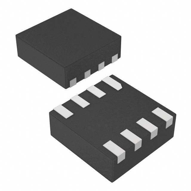

TPS62821DLCR
TPS62821DLCR
    BURR-BROWN(德州仪器)
    VFDFN8
    IC REG BUCK ADJ 1A 8VSON-HR
TPS62821DLCR 数据手册
Order Now Product Folder Support & Community Tools & Software Technical Documents TPS62821, TPS62822, TPS62823 SLVSDV6C – NOVEMBER 2017 – REVISED NOVEMBER 2019 TPS6282x 5.5-V, 1-A, 2-A, 3-A Step-Down Converter Family with 1% Accuracy 1 Features 3 Description • • The TPS6282x is an all-purpose and easy to use synchronous step-down DC-DC converter with a very low quiescent current of only 4 µA. It supplies up to 3A output current (TPS62823) from a 2.4-V to 5.5-V input voltage. Based on the DCS-Control™ topology it provides a fast transient response. 1 • • • • • • • • • • • • • • • • DCS-Control™ topology 26-mΩ/25-mΩ internal power switches (TPS62823) Up to 3-A output current (TPS62823) Very low quiescent current of 4 µA Switching frequency of typically 2.2 MHz 1% feedback voltage accuracy (full temp. range) Enable (EN) and power good (PG) Adjustable output voltage from 0.6 V to 4 V 100% duty-cycle mode Internal soft-start circuitry Seamless power save mode transition Undervoltage lockout Active output discharge Cycle-by-cycle current limit HICCUP short-circuit protection Over temperature protection CISPR11 class B compliant Create a custom design using the TPS62822 with the WEBENCH® Power Designer The internal reference allows to regulate the output voltage down to 0.6 V with a high feedback voltage accuracy of 1% over the junction temperature range of -40°C to 125°C. The 1-A, 2-A, 3-A scalable pin-topin and BOM-to-BOM compatible device family can be used with small 470-nH inductors. The TPS6282x include an automatically entered power save mode to maintain high efficiency down to very light loads. The device features a Power Good signal and an internal soft start circuit. It is able to operate in 100% mode. For fault protection, it incorporates a HICCUP current limit as well as a thermal shutdown. The TPS6282x are packaged in a 2 mm x 1.5 mm QFN-8 package. Device Information(1) PART NUMBER 2 Applications TPS62821DLC • • • • • • TPS62822DLC POL supply in portable/battery powered devices Factory and building automation Mobile computing, networking cards Solid state drive Data terminal, point of sale Servers, projectors, printers Typical Application Schematic space space space space 470nH 2.4 to 5.5V VIN EN 4.7µF PACKAGE BODY SIZE (NOM) QFN (8) 2.00 x 1.50 mm TPS62823DLC (1) For all available packages, see the orderable addendum at the end of the data sheet. space space Efficiency vs Output Current space VOUT/2A SW TPS62822 R1 Cff* 10µF VFB=0.6V PG FB ±1% R2 AGND * optional PGND Copyright © 2017, Texas Instruments Incorporated 1 An IMPORTANT NOTICE at the end of this data sheet addresses availability, warranty, changes, use in safety-critical applications, intellectual property matters and other important disclaimers. PRODUCTION DATA. TPS62821, TPS62822, TPS62823 SLVSDV6C – NOVEMBER 2017 – REVISED NOVEMBER 2019 www.ti.com Table of Contents 1 2 3 4 5 6 7 8 Features .................................................................. Applications ........................................................... Description ............................................................. Revision History..................................................... Device Comparison Table..................................... Pin Configuration and Functions ......................... Specifications......................................................... 1 1 1 2 3 3 4 7.1 7.2 7.3 7.4 7.5 7.6 4 4 4 4 5 6 Absolute Maximum Ratings ...................................... ESD Ratings ............................................................ Recommended Operating Conditions....................... Thermal Information .................................................. Electrical Characteristics........................................... Typical Characteristics .............................................. Detailed Description .............................................. 7 8.1 Overview ................................................................... 7 8.2 Functional Block Diagram ......................................... 7 8.3 Feature Description................................................... 8 8.4 Device Functional Modes.......................................... 8 9 Application and Implementation ........................ 10 9.1 Application Information............................................ 10 9.2 Typical Application ................................................. 10 10 Power Supply Recommendations ..................... 21 11 Layout................................................................... 21 11.1 Layout Guidelines ................................................. 21 11.2 Layout Example .................................................... 22 12 Device and Documentation Support ................. 23 12.1 12.2 12.3 12.4 12.5 12.6 12.7 Device Support .................................................... Related Links ........................................................ Receiving Notification of Documentation Updates Community Resources.......................................... Trademarks ........................................................... Electrostatic Discharge Caution ............................ Glossary ................................................................ 23 23 23 23 23 23 23 13 Mechanical, Packaging, and Orderable Information ........................................................... 23 4 Revision History NOTE: Page numbers for previous revisions may differ from page numbers in the current version. Changes from Revision B (May 2018) to Revision C • Page Added EMI Performance Curves ......................................................................................................................................... 17 Changes from Revision A (February 2018) to Revision B • Page Changed status for TPS62822 and TPS62823 to Production Data devices........................................................................ 23 Changes from Original (November 2017) to Revision A • 2 Page Changed status for TPS62821 to Production Data device................................................................................................... 23 Submit Documentation Feedback Copyright © 2017–2019, Texas Instruments Incorporated Product Folder Links: TPS62821 TPS62822 TPS62823 TPS62821, TPS62822, TPS62823 www.ti.com SLVSDV6C – NOVEMBER 2017 – REVISED NOVEMBER 2019 5 Device Comparison Table (1) Part Number Output Current Output Voltage TPS62821DLC 1A Adjustable TPS62822DLC 2A Adjustable TPS62823DLC 3A Adjustable (1) For fixed output voltage versions please contact your TI sales representative. 6 Pin Configuration and Functions space DLC Package 8 Pin (VQFN) Top View EN 1 8 PG FB 2 7 VIN AGND 3 6 SW NC 4 5 PGND space Pin Functions PIN NAME NO. I/O DESCRIPTION EN 1 I Enable input (High=Enabled, Low=Disabled). Do not leave floating. FB 2 I Output voltage feedback. Connect resistive voltage divider to this pin. AGND 3 NC 4 PGND 5 Power Power ground SW 6 Power Switch node, connected to the internal MOSFET switches. VIN 7 Power Supply voltage PG 8 O Signal ground. Internally connected to the PGND pin. Can be left floating. Internally not connected. Can be connected to VOUT, GND or left floating. Power good output. If unused, leave floating or connect to GND. Copyright © 2017–2019, Texas Instruments Incorporated Product Folder Links: TPS62821 TPS62822 TPS62823 Submit Documentation Feedback 3 TPS62821, TPS62822, TPS62823 SLVSDV6C – NOVEMBER 2017 – REVISED NOVEMBER 2019 www.ti.com 7 Specifications 7.1 Absolute Maximum Ratings (1) MIN MAX VIN, FB, EN, PG, NC -0.3 6 SW (DC) -0.3 SW (DC, in current limit) -1.0 SW (AC), less than 10ns (2) -2.5 10 1 mA Operating Junction Temperature Range, TJ -40 150 °C Storage temperature, Tstg -65 150 °C Pin Voltage Range VIN + 0.3 Power Good Sink Current (1) (2) UNIT V Stresses beyond those listed under Absolute Maximum Ratings may cause permanent damage to the device. These are stress ratings only, which do not imply functional operation of the device at these or any other conditions beyond those indicated under Recommended Operating Conditions. Exposure to absolute-maximum-rated conditions for extended periods may affect device reliability. While switching. 7.2 ESD Ratings VALUE V(ESD) (1) (2) Electrostatic discharge Human-body model (HBM), per ANSI/ESDA/JEDEC JS-001 (1) ±2000 Charged-device model (CDM), per JEDEC specification JESD22C101 (2) ±500 UNIT V JEDEC document JEP155 states that 500-V HBM allows safe manufacturing with a standard ESD control process. JEDEC document JEP157 states that 250-V CDM allows safe manufacturing with a standard ESD control process. 7.3 Recommended Operating Conditions MIN NOM MAX UNIT Supply Voltage Range, VIN 2.4 5.5 V Output Voltage Range, VOUT 0.6 4 V Maximum Output Current, IOUT TPS62821 1 TPS62822 2 TPS62823 3 Operating Junction Temperature, TJ -40 125 A °C 7.4 Thermal Information TPS6282x THERMAL METRIC (1) RθJA Junction-to-ambient thermal resistance DLC (VQFN) 8 PINS UNIT JEDEC PCB TPS6282xEVM-005 114.1 69.9 °C/W (2) °C/W RθJC(top) Junction-to-case (top) thermal resistance 90.2 n/a RθJB Junction-to-board thermal resistance 43.4 n/a (2) °C/W ψJT Junction-to-top characterization parameter 6.6 4.3 °C/W ψJB Junction-to-board characterization parameter 43.7 44.2 °C/W RθJC(bot) Junction-to-case (bottom) thermal resistance n/a n/a °C/W (1) (2) 4 For more information about traditional and new thermal metrics, see the Semiconductor and IC Package Thermal Metrics application report. Not applicable to an EVM. Submit Documentation Feedback Copyright © 2017–2019, Texas Instruments Incorporated Product Folder Links: TPS62821 TPS62822 TPS62823 TPS62821, TPS62822, TPS62823 www.ti.com SLVSDV6C – NOVEMBER 2017 – REVISED NOVEMBER 2019 7.5 Electrical Characteristics over operating junction temperature range (TJ=-40°C to 125°C) and VIN=2.4V to 5.5V. Typical values at VIN=5V and TJ=25°C (unless otherwise noted) PARAMETER TEST CONDITIONS MIN TYP MAX UNIT SUPPLY VIN Input Voltage range 2.4 IQ Operating Quiescent Current EN=High, IOUT=0A, device not switching ISD Shutdown Current EN=Low, TJ = -40°C to 85°C Undervoltage Threshold Falling Input Voltage VUVLO TSD 2.1 Undervoltage Hysteresis 5.5 V 4 10 µA 0.05 0.5 µA 2.2 2.3 V 160 Thermal Shutdown Threshold Rising Junction Temperature mV 150 Thermal Shutdown Hysteresis °C 20 CONTROL (EN, PG) VH High-Level Threshold Voltage (EN) 1.0 V VL Low-Level Threshold Voltage (EN) ILKG Input Leakage Current (EN, PG) EN = High, VPG = 5V tSS Soft-Start Time Time from EN=High to 95% of VOUT nominal VPGTL Power Good Lower Threshold Voltage Rising (VFB vs regulation target) 94% 96% Falling (VFB vs regulation target) 90% 92% 94% VPGTH Power Good Upper Threshold Voltage Rising (VFB vs regulation target) 108% 110% 112% Falling (VFB vs regulation target) 103% 105% 107% VPGL Power Good Logic Low Level Output IPG = -1mA Voltage tPGD Power Good delay 10 0.4 V 100 nA 1.25 ms 98% 0.4 rising 100 falling 20 PWM Mode Operation 2.2 TPS62821 35 TPS62822 35 TPS62823 26 V µs POWER SWITCH FSW RDS(on) Switching Frequency High-Side FET ON-Resistance Low-Side FET ON-Resistance ILIM High-Side FET Current Limit TPS62821,2,3 MHz mΩ 25 TPS62821 1.7 2.1 2.4 TPS62822 2.7 3.3 3.7 TPS62823 3.7 4.3 5.0 10 50 nA 594 600 606 mV 75 A OUTPUT ILKG_FB Input Leakage Current (FB) EN=High, VFB=0.6V VFB Feedback Voltage Accuracy PWM Mode IDIS Output Discharge Current EN=Low, VSW = 0.4V 400 mA DC Load Regulation PWM Mode Operation 0.2 %/A DC Line Regulation PWM Mode Operation 0.05 %/V Copyright © 2017–2019, Texas Instruments Incorporated Product Folder Links: TPS62821 TPS62822 TPS62823 Submit Documentation Feedback 5 TPS62821, TPS62822, TPS62823 SLVSDV6C – NOVEMBER 2017 – REVISED NOVEMBER 2019 www.ti.com .0 7.6 Typical Characteristics 6 Figure 1. Quiescent Current Figure 2. Shutdown Current Figure 3. High-Side Switch Resistance (TPS62821/2) Figure 4. High-Side Switch Resistance (TPS62823) Figure 5. Low-Side Switch Resistance (TPS62821/2/3) Figure 6. Active Output Discharge Current (EN=Low) Submit Documentation Feedback Copyright © 2017–2019, Texas Instruments Incorporated Product Folder Links: TPS62821 TPS62822 TPS62823 TPS62821, TPS62822, TPS62823 www.ti.com SLVSDV6C – NOVEMBER 2017 – REVISED NOVEMBER 2019 8 Detailed Description 8.1 Overview The TPS6282x are synchronous step-down converters based on the DCS-Control™ topology with an adaptive constant on-time control and a stabilized switching frequency. It operates in PWM (pulse width modulation) mode for medium to heavy loads and in PSM (power save mode) at light load conditions, keeping the output voltage ripple small. The nominal switching frequency is about 2.2MHz with a small and controlled variation over the input voltage range. As the load current decreases, the converter enters PSM, reducing the switching frequency to keep efficiency high over the entire load current range. Since combining both PWM and PSM within a single building block, the transition between modes is seamless and without effect on the output voltage. The devices offer both excellent dc voltage and fast load transient regulation, combined with a very low output voltage ripple. 8.2 Functional Block Diagram space VPGTH EN PG Control Logic VFB Soft-Start UVLO Thermal Shutdown VFB FB VPGTL Ramp VIN VSW VIN Peak Current Detect errAmp VREF HICCUP Comp AGND Modulator Gate Drive VSW SW TON VIN VSW Zero Current Detect NC VREF VREF SW Discharge PGND EN Copyright © 2017–2019, Texas Instruments Incorporated Product Folder Links: TPS62821 TPS62822 TPS62823 Submit Documentation Feedback 7 TPS62821, TPS62822, TPS62823 SLVSDV6C – NOVEMBER 2017 – REVISED NOVEMBER 2019 www.ti.com 8.3 Feature Description 8.3.1 Enable / Shutdown and Output Discharge The device starts operation, when Enable (EN) is set High. The input threshold levels are typically 0.9V for rising and 0.7V for falling signals. Do not leave EN floating. Shutdown is forced if EN is pulled Low with a shutdown current of typically 50nA. During shutdown, the internal power MOSFETs as well as the entire control circuitry are turned off and the output voltage is actively discharged through the SW pin by a current sink. Therefore, VIN must remain present for the discharge to function. 8.3.2 Soft-Start About 250µs after EN goes High, the internal soft-start circuitry controls the output voltage during startup. This avoids excessive inrush current and ensures a controlled output voltage rise time of about 1ms. It also prevents unwanted voltage drops from high-impedance power sources or batteries. TPS6282x can start into a pre-biased output. 8.3.3 Power Good (PG) The TPS6282x has a built in power good (PG) function. The PG pin goes high impedance, when the output voltage has reached its nominal value. Otherwise, including when disabled, in UVLO or in thermal shutdown, PG is Low (see Table 1). The PG function is formed with a window comparator, which has an upper and lower voltage threshold (see Electrical Characteristics). The PG pin is an open drain output that requires a pull-up resistor and can sink up to 1mA. If not used, the PG pin can be left floating or connected to GND. Table 1. Power Good Pin Logic PG Logic Status Device State Enable (EN=High) High Impedance VFB ≥ VPGTL and VFB ≤ VPGTH √ VFB ≤ VPGTL or VFB ≥ VPGTH √ √ Shutdown (EN=Low) UVLO Low √ 0.7 V < VIN < VUVLO Thermal Shutdown √ TJ > TSD Power Supply Removal VIN < 0.7 V √ At startup, PG transitions from low to floating about 100µs after the output voltage has reached regulation. Once in operation, PG has a deglitch delay of about 20µs before going low. When the output voltage returns to regulation, the same 100µs delay occurs. 8.3.4 Undervoltage Lockout (UVLO) The undervoltage lockout (UVLO) function prevents misoperation of the device, if the input voltage drops below the UVLO threshold. It is set to about 2.2V with a hysteresis of typically 160mV. 8.3.5 Thermal Shutdown The junction temperature (TJ) of the device is monitored by an internal temperature sensor. If TJ exceeds 150°C (typ.), the device goes in thermal shutdown with a hysteresis of typically 20°C. Once the TJ has decreased enough, the device resumes normal operation. 8.4 Device Functional Modes 8.4.1 Pulse Width Modulation (PWM) Operation At load currents larger than half the inductor ripple current, the device operates in pulse width modulation in continuous conduction mode (CCM). The PWM operation is based on an adaptive constant on-time control with stabilized switching frequency. To achieve a stable switching frequency in a steady state condition, the on-time is calculated as: space 8 Submit Documentation Feedback Copyright © 2017–2019, Texas Instruments Incorporated Product Folder Links: TPS62821 TPS62822 TPS62823 TPS62821, TPS62822, TPS62823 www.ti.com SLVSDV6C – NOVEMBER 2017 – REVISED NOVEMBER 2019 Device Functional Modes (continued) TON = VOUT × 450ns VIN (1) space With that, the typical switching frequency is about 2.2MHz. 8.4.2 Power Save Mode (PSM) Operation To maintain high efficiency at light loads, the device enters power save mode (PSM) at the boundary to discontinuous conduction mode (DCM). This happens when the output current becomes smaller than half of the inductor's ripple current. The device operates now with a fixed on-time and the switching frequency further decreases proportional to the load current. It can be calculated as: space fPSM = 2 × IOUT V éV - VOUT ù 2 × IN ê IN TON ú VOUT ë L û (2) space In PSM, the output voltage rises slightly above the nominal target, which can be minimized using larger output capacitance. At duty cycles larger than 90%, the device may not enter PSM. The device maintains output regulation in PWM mode. 8.4.3 Minimum Duty Cycle and 100% Mode Operation There is no limitation for small duty cycles, since even at very low duty cycles the switching frequency is reduced as needed to always ensure a proper regulation. If the output voltage level comes close to the input voltage, the device enters 100% mode. While the high-side switch is constantly turned on, the low-side switch is switched off. The difference between VIN and VOUT is determined by the voltage drop across the high-side FET and the dc resistance of the inductor. The minimum VIN that is needed to maintain a specific VOUT value is estimated as: space VIN (min) = VOUT + IOUT ( RDS(on ) + RDC(L) ) (3) space 8.4.4 Current Limit and Short Circuit Protection The peak switch current of TPS6282x is internally limited, cycle by cycle, to a maximum dc value as specified in Electrical Characteristics. This prevents the device from drawing excessive current in case of externally caused over current or short circuit condition. Due to an internal propagation delay of about 60ns, the actual ac peak current can exceed the static current limit during that time. If the current limit threshold is reached, the device delivers its maximum output current. Detecting this condition for 32 switching cycles (about 13µs), the device turns off the high-side MOSFET for about 100µs which allows the inductor current to decrease through the low-side MOSFET's body diode and then restarts again with a soft start cycle. As long as the overload condition is present, the device hiccups that way, limiting the output power. Copyright © 2017–2019, Texas Instruments Incorporated Product Folder Links: TPS62821 TPS62822 TPS62823 Submit Documentation Feedback 9 TPS62821, TPS62822, TPS62823 SLVSDV6C – NOVEMBER 2017 – REVISED NOVEMBER 2019 www.ti.com 9 Application and Implementation space NOTE Information in the following applications sections is not part of the TI component specification, and TI does not warrant its accuracy or completeness. TI’s customers are responsible for determining suitability of components for their purposes. Customers should validate and test their design implementation to confirm system functionality. space 9.1 Application Information The TPS6282x is a switched mode step-down converter, able to convert a 2.4-V to 5.5-V input voltage into a lower 0.6-V to 4-V output voltage, providing up to 3A continuous output current (TPS62823). It needs a very low amount of external components. Apart from the inductor and the output and input capacitors, additional parts are only needed to set the output voltage and to enable the Power Good (PG) feature. 9.2 Typical Application space 470nH 2.4 to 5.5V VOUT/2A SW VIN VPG C1 EN R3 TPS62822 R1 Cff* C2 C3* FB PG R2 AGND PGND Copyright © 2017, Texas Instruments Incorporated * optional Figure 7. A typical 2.4 to 5.5-V, 2-A Power Supply space 9.2.1 Design Requirements The following design guideline provides a range for the component selection to operate within the recommended operating conditions. Table 2 shows the components selection that was used for the measurements shown in the Application Curves. Table 2. List of Components REFERENCE DESCRIPTION MANUFACTURER IC 5.5-V, step-down converter L1 470 nH ±20%, 7.6mΩ DCR, 6.6A ISAT C1 4.7 µF ±20%, 6.3V, ceramic, 0603, X7R JMK107BB7475MA-T, Taiyo Yuden C2, C3 10 µF ±20%, 10V, ceramic, 0603, X7R GRM188Z71A106MA73D, MuRata Cff 120pF ±5%, 50V, 0603 GRM1885C1H121JA01D, MuRata R1, R2 Depending on VOUT, chip, 0603 Standard R3 100-kΩ, chip, 0603, 0.1W, 1% Standard 10 Submit Documentation Feedback TPS6282xDLC, Texas Instruments XFL4015-471MEB, Coilcraft Copyright © 2017–2019, Texas Instruments Incorporated Product Folder Links: TPS62821 TPS62822 TPS62823 TPS62821, TPS62822, TPS62823 www.ti.com SLVSDV6C – NOVEMBER 2017 – REVISED NOVEMBER 2019 9.2.2 Detailed Design Procedure 9.2.2.1 Custom Design With WEBENCH® Tools Click here to create a custom design using the TPS62822 device with the WEBENCH® Power Designer. 1. Start by entering the input voltage (VIN), output voltage (VOUT), and output current (IOUT) requirements. 2. Optimize the design for key parameters such as efficiency, footprint, and cost using the optimizer dial. 3. Compare the generated design with other possible solutions from Texas Instruments. The WEBENCH Power Designer provides a customized schematic along with a list of materials with real-time pricing and component availability. In most cases, these actions are available: • Run electrical simulations to see important waveforms and circuit performance • Run thermal simulations to understand board thermal performance • Export customized schematic and layout into popular CAD formats • Print PDF reports for the design, and share the design with colleagues Get more information about WEBENCH tools at www.ti.com/WEBENCH. 9.2.2.2 Setting the Adjustable Output Voltage Choose resistors R1 and R2 to set the output voltage within a range of 0.6V to 4V, according to Equation 4. To keep the feedback (FB) net robust from noise, set R2 equal to or lower than 120kΩ to have at least 5µA of current in the voltage divider. Lower values of FB resistors achieve better noise immunity, and lower light load efficiency, as explained in SLYT469. space §V R1 R2 u ¨ OUT © VFB · 1¸ ¹ §V R2 u ¨ OUT © 0.6V · 1¸ ¹ (4) space 9.2.2.3 Feed-forward Capacitor Selection A feedforward capacitor (CFF) is recommended in parallel with R1. Equation 5 calculates the CFF value. For the recommended 100k value for R2, a 120 pF feed forward capacitor is used. space Cff = 12ms R2 (5) space Figure 47 and Figure 48 show the results of a frequency domain analysis for both use cases, with and without a feed-forward capacitor. The larger unity gain frequency, caused by the feed forward capacitor, results in a significant improvement of the transient response. space 9.2.2.4 Output Filter Selection The TPS6282x is internally compensated and optimized for a range of output filter component values, which is specified in Table 3. Using these values simplifies the output filter component selection. Checked cells represent combinations that are proven for stability by simulation and lab test. Further combinations are possible, but should be checked for each individual application. Copyright © 2017–2019, Texas Instruments Incorporated Product Folder Links: TPS62821 TPS62822 TPS62823 Submit Documentation Feedback 11 TPS62821, TPS62822, TPS62823 SLVSDV6C – NOVEMBER 2017 – REVISED NOVEMBER 2019 www.ti.com Table 3. Recommended LC Output Filter Combinations (1) 4.7 µF 10 µF 2 x 10µF or 22 µF 47 µF 100 µF √ √ (3) 150 µF 0.33 µH √ 0.47 µH √ 1.0 µH (2) √ √ √ (3) √ (3) 1.5 µH (1) (2) (3) The values in the table are the nominal values of inductors and ceramic capacitors. The effective capacitance can vary depending on package size, voltage rating and dielectric material (typical variations are from +20% to -50%). This combination is recommended as the standard value for most of all applications. Cff is recommended for large COUT values. 9.2.2.5 Inductor Selection The TPS6282x is designed to work with inductors of 470nH nominal and can be used with 1µH inductors as well. The inductor has to be selected for adequate saturation current and a low dc resistance (DCR). The minimum inductor current rating, that is needed under static load conditions is calculated using Equation 6 and Equation 7. space I peak (max) = I L(min) = IOUT (max) + DI L(max) 2 (6) space DIL(max) V æ ç 1 - OUT ç VIN = VOUT ç ç L(min) × fSW ç è ö ÷ ÷ ÷ ÷ ÷ ø (7) space This calculation gives the minimum saturation current of the inductor needed and an additional margin is recommended to cover dynamic overshoot due to startup or load transients. Inductors are available in different dimensions. Choosing the smallest size might result in less efficiency due to larger DCR and ac losses. The following inductors have been tested with the TPS6282x: Table 4. List of Recommended Inductors TYPE Nominal INDUCTANCE (1) Saturation Current and DC Resistance max. ISAT [A] (3) Dimensions [mm] Manufacturer (2) max. RDC [mΩ] HTEN20161T-R47MDR 0.47 4.8 32 2.0 x 1.6 x 1.0 Cyntec HTEH20121T-R47MSR 0.47 4.6 25 2.0 x 1.2 x 1.0 Cyntec DFE201610E - R47M 0.47 4.8 32 2.0 x 1.6 x 1.0 muRata DFE201210S - R47M 0.47 4.8 32 2.0 x 1.2 x 1.0 muRata TFM201610ALM-R47MTAA 0.47 5.1 34 2.0 x 1.6 x 1.0 TDK TFM201610ALC-R47MTAA 0.47 5.2 25 2.0 x 1.6 x 1.0 TDK XFL4015-471ME 0.47 6.6 8.36 4.0 x 4.0 x 1.6 Coilcraft (1) (2) (3) Inductance Tolerance ±20% See Third-party Products disclaimer. ΔL/L≈30% 12 Submit Documentation Feedback Copyright © 2017–2019, Texas Instruments Incorporated Product Folder Links: TPS62821 TPS62822 TPS62823 TPS62821, TPS62822, TPS62823 www.ti.com SLVSDV6C – NOVEMBER 2017 – REVISED NOVEMBER 2019 9.2.2.6 Output Capacitor Selection The output voltage range of TPS6282x is 0.6V to 4V. While stability is a first criteria for the output filter selection (L and COUT), the output capacitor value also determines transient response behavior and ripple of VOUT. The recommended typical value for the output capacitor is 2x10µF (or 1x 22µF) and can be small ceramic capacitors with low equivalent series resistance (ESR). For lower VOUT (VOUT ≤ 2V) and where only moderate load transients are present, 10µF can be sufficient. In either case a minimum effective output capacitance of 5µF should be present. To keep low resistance and to get a narrow capacitance variation with temperature, it is recommended to use X7R or X5R dielectric. Using an even higher value has advantages like smaller voltage ripple and tighter output voltage accuracy in PSM. 9.2.2.7 Input Capacitor Selection For typical application, an input capacitor of 4.7µF is sufficient and recommended. A larger value reduces input current ripple further. The input capacitor buffers the input voltage for transient events and also decouples the converter from the supply. A low ESR ceramic capacitor is recommended for best filtering and should be placed between VIN and PGND as close as possible to those pins. In either case a minimum effective input capacitance of 3µF should be present. Copyright © 2017–2019, Texas Instruments Incorporated Product Folder Links: TPS62821 TPS62822 TPS62823 Submit Documentation Feedback 13 TPS62821, TPS62822, TPS62823 SLVSDV6C – NOVEMBER 2017 – REVISED NOVEMBER 2019 www.ti.com 9.2.3 Application Curves VIN=5V, VOUT=1.8V, TA=25°C, BOM = Table 2, (unless otherwise noted) 100% mode 100% mode Figure 8. Efficiency TPS62821 at VOUT=3.3V Figure 9. Efficiency TPS62821 at VOUT=3.3V 100% mode 100% mode Figure 10. Efficiency TPS62822 at VOUT=3.3V Figure 11. Efficiency TPS62822 at VOUT=3.3V 100% mode 100% mode Figure 12. Efficiency TPS62823 at VOUT=3.3V 14 Submit Documentation Feedback Figure 13. Efficiency TPS62823 at VOUT=3.3V Copyright © 2017–2019, Texas Instruments Incorporated Product Folder Links: TPS62821 TPS62822 TPS62823 TPS62821, TPS62822, TPS62823 www.ti.com SLVSDV6C – NOVEMBER 2017 – REVISED NOVEMBER 2019 Figure 14. Efficiency TPS62821 at VOUT=1.8V Figure 15. Efficiency TPS62821 at VOUT=1.8V Figure 16. Efficiency TPS62822 at VOUT=1.8V Figure 17. Efficiency TPS62822 at VOUT=1.8V Figure 18. Efficiency TPS62823 at VOUT=1.8V Figure 19. Efficiency TPS62823 at VOUT=1.8V Copyright © 2017–2019, Texas Instruments Incorporated Product Folder Links: TPS62821 TPS62822 TPS62823 Submit Documentation Feedback 15 TPS62821, TPS62822, TPS62823 SLVSDV6C – NOVEMBER 2017 – REVISED NOVEMBER 2019 16 www.ti.com Figure 20. Efficiency TPS62821 at VOUT=1V Figure 21. Efficiency TPS62821 at VOUT=1V Figure 22. Efficiency TPS62822 at VOUT=1V Figure 23. Efficiency TPS62822 at VOUT=1V Figure 24. Efficiency TPS62823 at VOUT=1V Figure 25. Efficiency TPS62823 at VOUT=1V Submit Documentation Feedback Copyright © 2017–2019, Texas Instruments Incorporated Product Folder Links: TPS62821 TPS62822 TPS62823 TPS62821, TPS62822, TPS62823 www.ti.com SLVSDV6C – NOVEMBER 2017 – REVISED NOVEMBER 2019 Figure 26. Efficiency TPS62821 at VOUT=0.6V Figure 27. Efficiency TPS62821 at VOUT=0.6V Figure 28. Efficiency TPS62822 at VOUT=0.6V Figure 29. Efficiency TPS62822 at VOUT=0.6V Figure 30. Efficiency TPS62823 at VOUT=0.6V Figure 31. Efficiency TPS62823 at VOUT=0.6V Copyright © 2017–2019, Texas Instruments Incorporated Product Folder Links: TPS62821 TPS62822 TPS62823 Submit Documentation Feedback 17 TPS62821, TPS62822, TPS62823 www.ti.com Figure 32. Output Voltage Accuracy (Load Regulation) Figure 33. Output Voltage Accuracy (Line Regulation) Figure 34. Switching Frequency vs Output Current Figure 35. Switching Frequency vs Input Voltage 70 65 60 55 50 45 40 35 30 25 20 15 10 5 30 Horizontal - QPK Vertical - QPK CISPR11 Group 1 Class B 3m QP Level (dBPV/m) Level (dBPV/m) SLVSDV6C – NOVEMBER 2017 – REVISED NOVEMBER 2019 40 50 6070 100 200 300 400500 Frequency (MHz) 700 1000 RLOAD = 2.20 Ω, VIN = 5.5 V (battery supply), VOUT = 1.8 V, EMI test board without filters Figure 36. TPS62821 Radiated Emission 18 Submit Documentation Feedback 70 65 60 55 50 45 40 35 30 25 20 15 10 5 30 Horizontal - QPK Vertical - QPK CISPR11 Group 1 Class B 3m QP 40 50 6070 100 200 300 400500 Frequency (MHz) 700 1000 RLOAD = 1.00 Ω, VIN = 5.5 V (battery supply), VOUT = 1.8 V, EMI test board without filters Figure 37. TPS62822 Radiated Emission Copyright © 2017–2019, Texas Instruments Incorporated Product Folder Links: TPS62821 TPS62822 TPS62823 TPS62821, TPS62822, TPS62823 Level (dBPV/m) www.ti.com 70 65 60 55 50 45 40 35 30 25 20 15 10 5 30 SLVSDV6C – NOVEMBER 2017 – REVISED NOVEMBER 2019 Horizontal - QPK Vertical - QPK CISPR11 Group 1 Class B 3m QP 40 50 6070 100 200 300 400500 Frequency (MHz) 700 1000 RLOAD = 0.68 Ω, VIN = 5.5 V (battery supply), VOUT = 1.8 V, EMI test board without filters COUT=2x10µF IOUT=1A Figure 39. Typical Operation PWM Figure 38. TPS62823 Radiated Emission COUT=2x10µF IOUT=0.1A Figure 40. Typical Operation PSM COUT=2x10µF COUT=2x10µF Figure 41. Startup into 0.6-Ohm (TPS62823) COUT=2x10µF Figure 42. Startup at No Load Figure 43. Active Output Discharge at load 1.8-Ohm Copyright © 2017–2019, Texas Instruments Incorporated Product Folder Links: TPS62821 TPS62822 TPS62823 Submit Documentation Feedback 19 TPS62821, TPS62822, TPS62823 SLVSDV6C – NOVEMBER 2017 – REVISED NOVEMBER 2019 COUT=2x10µF COUT=2x10µF Figure 44. Active Output Discharge at No Load COUT=2x10µF www.ti.com Cff=120pF Figure 45. Load Transient Response, 50mA to 1A, TPS62822 Cff=120pF Figure 46. Load Transient Response, 1A to 2A, TPS62822 COUT=2x10µF no CFF Figure 47. Frequency Response (TPS62823), IOUT=3A 20 Submit Documentation Feedback Copyright © 2017–2019, Texas Instruments Incorporated Product Folder Links: TPS62821 TPS62822 TPS62823 TPS62821, TPS62822, TPS62823 www.ti.com SLVSDV6C – NOVEMBER 2017 – REVISED NOVEMBER 2019 Figure 49. Overload Response of TPS62823 COUT=2x10µF CFF=120pF Figure 48. Frequency Response (TPS62823), IOUT=3A Figure 50. Overload Response of TPS62823 (Hiccup cycle) Figure 51. Device Temperature Rise on TPS62823 EVM at IOUT=3A 10 Power Supply Recommendations The TPS6282x is designed to operate from a 2.4-V to 5.5-V input voltage supply. The input power supply's output current needs to be rated according to the output voltage and the output current of the power rail application. 11 Layout 11.1 Layout Guidelines The recommended PCB layout for the TPS6282x is shown below. It ensures best electrical and optimized thermal performance considering the following important topics: - The input capacitor(s) must be placed as close as possible to the VIN and PGND pins of the device. This provides low resistive and inductive paths for the high di/dt input current. - The SW node connection from the IC to the inductor conducts alternating high currents. It should be kept short. Copyright © 2017–2019, Texas Instruments Incorporated Product Folder Links: TPS62821 TPS62822 TPS62823 Submit Documentation Feedback 21 TPS62821, TPS62822, TPS62823 SLVSDV6C – NOVEMBER 2017 – REVISED NOVEMBER 2019 www.ti.com Layout Guidelines (continued) - The VOUT regulation loop is closed with COUT and its ground connection. To avoid load regulation and EMI noise, the loop should be kept short. - The FB node is sensitive to dv/dt signals. Therefore the resistive divider should be placed close to the FB and AGND pins. For more detailed information about the actual EVM solution, see the EVM users guide. 11.2 Layout Example space space space VOUT L1 VIN C1 SW PGND GND NC AGND VIN PG EN FB GND C2 C3 R2 R1 Cff Figure 52. TPS6282x Board Layout 22 Submit Documentation Feedback Copyright © 2017–2019, Texas Instruments Incorporated Product Folder Links: TPS62821 TPS62822 TPS62823 TPS62821, TPS62822, TPS62823 www.ti.com SLVSDV6C – NOVEMBER 2017 – REVISED NOVEMBER 2019 12 Device and Documentation Support 12.1 Device Support 12.1.1 Third-Party Products Disclaimer TI'S PUBLICATION OF INFORMATION REGARDING THIRD-PARTY PRODUCTS OR SERVICES DOES NOT CONSTITUTE AN ENDORSEMENT REGARDING THE SUITABILITY OF SUCH PRODUCTS OR SERVICES OR A WARRANTY, REPRESENTATION OR ENDORSEMENT OF SUCH PRODUCTS OR SERVICES, EITHER ALONE OR IN COMBINATION WITH ANY TI PRODUCT OR SERVICE. 12.2 Related Links The table below lists quick access links. Categories include technical documents, support and community resources, tools and software, and quick access to order now. Table 5. Related Links PARTS PRODUCT FOLDER ORDER NOW TECHNICAL DOCUMENTS TOOLS & SOFTWARE SUPPORT & COMMUNITY TPS62821 Click here Click here Click here Click here Click here TPS62822 Click here Click here Click here Click here Click here TPS62823 Click here Click here Click here Click here Click here 12.3 Receiving Notification of Documentation Updates To receive notification of documentation updates, navigate to the device product folder on ti.com. In the upper right corner, click on Alert me to register and receive a weekly digest of any product information that has changed. For change details, review the revision history included in any revised document. 12.4 Community Resources TI E2E™ support forums are an engineer's go-to source for fast, verified answers and design help — straight from the experts. Search existing answers or ask your own question to get the quick design help you need. Linked content is provided "AS IS" by the respective contributors. They do not constitute TI specifications and do not necessarily reflect TI's views; see TI's Terms of Use. 12.5 Trademarks DCS-Control, E2E are trademarks of Texas Instruments. All other trademarks are the property of their respective owners. 12.6 Electrostatic Discharge Caution This integrated circuit can be damaged by ESD. Texas Instruments recommends that all integrated circuits be handled with appropriate precautions. Failure to observe proper handling and installation procedures can cause damage. ESD damage can range from subtle performance degradation to complete device failure. Precision integrated circuits may be more susceptible to damage because very small parametric changes could cause the device not to meet its published specifications. 12.7 Glossary SLYZ022 — TI Glossary. This glossary lists and explains terms, acronyms, and definitions. 13 Mechanical, Packaging, and Orderable Information The following pages include mechanical, packaging, and orderable information. This information is the most current data available for the designated devices. This data is subject to change without notice and revision of this document. For browser-based versions of this data sheet, refer to the left-hand navigation. Copyright © 2017–2019, Texas Instruments Incorporated Product Folder Links: TPS62821 TPS62822 TPS62823 Submit Documentation Feedback 23 PACKAGE OPTION ADDENDUM www.ti.com 10-Dec-2020 PACKAGING INFORMATION Orderable Device Status (1) Package Type Package Pins Package Drawing Qty Eco Plan (2) Lead finish/ Ball material MSL Peak Temp Op Temp (°C) Device Marking (3) (4/5) (6) TPS62821DLCR ACTIVE VSON-HR DLC 8 3000 RoHS & Green Call TI | NIPDAU Level-1-260C-UNLIM -40 to 125 A1 TPS62821DLCT ACTIVE VSON-HR DLC 8 250 RoHS & Green Call TI | NIPDAU Level-1-260C-UNLIM -40 to 125 A1 TPS62822DLCR ACTIVE VSON-HR DLC 8 3000 RoHS & Green Call TI | NIPDAU Level-1-260C-UNLIM -40 to 125 A2 TPS62822DLCT ACTIVE VSON-HR DLC 8 250 RoHS & Green Call TI | NIPDAU Level-1-260C-UNLIM -40 to 125 A2 TPS62823DLCR ACTIVE VSON-HR DLC 8 3000 RoHS & Green NIPDAU Level-1-260C-UNLIM -40 to 125 A3 TPS62823DLCT ACTIVE VSON-HR DLC 8 250 RoHS & Green NIPDAU Level-1-260C-UNLIM -40 to 125 A3 (1) The marketing status values are defined as follows: ACTIVE: Product device recommended for new designs. LIFEBUY: TI has announced that the device will be discontinued, and a lifetime-buy period is in effect. NRND: Not recommended for new designs. Device is in production to support existing customers, but TI does not recommend using this part in a new design. PREVIEW: Device has been announced but is not in production. Samples may or may not be available. OBSOLETE: TI has discontinued the production of the device. (2) RoHS: TI defines "RoHS" to mean semiconductor products that are compliant with the current EU RoHS requirements for all 10 RoHS substances, including the requirement that RoHS substance do not exceed 0.1% by weight in homogeneous materials. Where designed to be soldered at high temperatures, "RoHS" products are suitable for use in specified lead-free processes. TI may reference these types of products as "Pb-Free". RoHS Exempt: TI defines "RoHS Exempt" to mean products that contain lead but are compliant with EU RoHS pursuant to a specific EU RoHS exemption. Green: TI defines "Green" to mean the content of Chlorine (Cl) and Bromine (Br) based flame retardants meet JS709B low halogen requirements of
