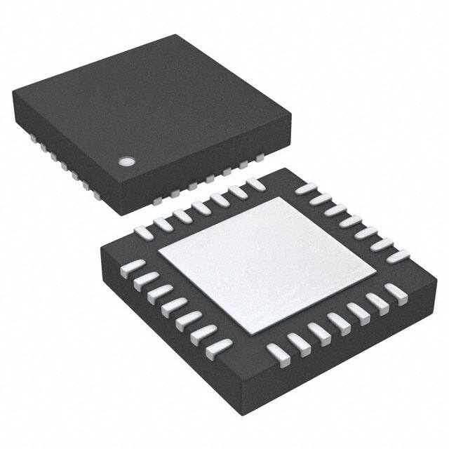

TPS65253 SLVSAW8 – JUNE 2011 www.ti.com 4.5-V TO 16-V INPUT, HIGH CURRENT, SYNCHRONOUS STEP DOWN DUAL BUCK CONVERTER WITH INTEGRATED FETS Check for Samples: TPS65253 FEATURES • 1 • • • • • • • • Wide Input Supply Voltage Range: 4.5 V - 16 V Output Range: 0.8 V to ~VIN-1 V Fully Integrated Dual Buck, 3.5-A/2.5-A Continuous Current (4-A/3-A Maximum Current) High Efficiency 300-kHz - 1.2-MHz Switching Frequency Set by External Resistor External Eenable/Sequencing Pins Adjustable Cycle-by-Cycle Current Limit Set by External Resistor Soft-Start Pins • • • • Current-Mode Control With Simple Compensation Circuit Power Good and Reset Generator Low Power Mode Set By External Signal Supervisory Circuit QFN Package, 28-Pin 5 mm x 5 mm RHD APPLICATIONS • • • • • • • DTV DSL Modems Cable Modems Set Top Boxes Car DVD Players Home Gateway and Access Point Networks Wireless Routers DESCRIPTION/ORDERING INFORMATION The TPS65253 features two synchronous wide input range high efficiency buck converters. The converters are designed to simplify product application while giving designers the options to optimize their usage according to the target application. The converters can operate in 5-, 9- and 12-V systems and have integrated power transistors. The output voltage can be set externally using a resistor divider to any value between 0.8 V and the input supply minus 1 V. Each converter features an enable pin that allows a delayed start-up for sequencing purposes, soft-start pin that allows adjustable soft-start time by choosing the soft-start capacitor, and a current limit (RLIMx) pin that enables designer to adjust current limit by selecting an external resistor and optimize the choice of inductor. The CMP pin allows optimizing transient versus dc accuracy response with a simple RC compensation. The switching frequency of the converters is set by an external resistor connected to ROSC pin. The switching regulators are designed to operate from 300 kHz to 1.2 MHz. The converters operate with 180° phase between then to minimize the input filter requirements. TPS65253 also features a low power mode enabled by an external signal, which allows for a reduction on the input power supplied to the system when the host processor is in stand-by (low activity) mode. TPS65253 features a supervisor circuit that monitors both converters and provides a PGOOD signal (End of Reset) with a 32-ms timer. TPS65253 is packaged in a small, thermally efficient 28-pin QFN package. ORDERING INFORMATION (1) (1) (2) TA PACKAGE (2) PART NUMBER TOP-SIDE MARKING -40°C to 85°C 28-Pin (QFN) - RHD TPS65253RHD TPS65253 For the most current packaging and ordering information, see the Package Option Addendum at the end of this document, or see the TI web site at www.ti.com. Package drawings, thermal data, and symbolization are available at www.ti.com/packaging. 1 Please be aware that an important notice concerning availability, standard warranty, and use in critical applications of Texas Instruments semiconductor products and disclaimers thereto appears at the end of this data sheet. PRODUCTION DATA information is current as of publication date. Products conform to specifications per the terms of the Texas Instruments standard warranty. Production processing does not necessarily include testing of all parameters. Copyright © 2011, Texas Instruments Incorporated TPS65253 SLVSAW8 – JUNE 2011 www.ti.com This integrated circuit can be damaged by ESD. Texas Instruments recommends that all integrated circuits be handled with appropriate precautions. Failure to observe proper handling and installation procedures can cause damage. ESD damage can range from subtle performance degradation to complete device failure. Precision integrated circuits may be more susceptible to damage because very small parametric changes could cause the device not to meet its published specifications. FUNCTIONAL BLOCK DIAGRAM PGOOD GENERATOR CV 7V PGOOD Vpullup V7V V3V REFERENCE OSC CV3V VIN1 VIN RLIM 1 CIN1 ROSC ROSC BST1 RLIM1 CBST1 LX1 LOW_P LOW_P CSS1 Light Load Power Saving BUCK1 RFB 1U FB1 SS1 CMP1 EN1 EN1 CIN2 RLIM2 CBST2 Vout Buck2 L2 LX2 RFB 2U FB2 SS2 EN2 CMP2 GND 2 RFB1L CRoll1 BUCK2 EN2 COUT1 BST2 LX2 CSS2 CC1 RC1 VIN2 RLIM 2 Vout Buck1 L1 LX1 RC2 CC2 COUT2 RFB2L CRoll2 Copyright © 2011, Texas Instruments Incorporated TPS65253 SLVSAW8 – JUNE 2011 www.ti.com TYPICAL APPLICATION R9 10kΩ C14 4.7nF Low Power Mode from HOST R10 100kΩ R8 69.8k C12 4.7nF EN2 RLIM2 SS2 CMP2 FB2 C16 4.7uF C13 4.7nF LOW_P V7V C15 10uF R6 12.7k V3V BST2 GND VIN2 PGOOD C11 47nF C10 10uF VIN2 R7 40.2k C8 22nF C9 44uF LX2 TPS65253 GND LX1 GND VIN1 FB1 ROSC BST1 1.2V EN1 LX1 RLIM1 GND SS1 3.3V CMP1 LX2 GND VIN1 C5 10nF R5 40.2k C6 22nF C7 44uF C4 47nF R4 80.6k R1 383k R2 5k C2 4.7nF C1 2.2nF Copyright © 2011, Texas Instruments Incorporated R3 59k C3 4.7nF 3 TPS65253 SLVSAW8 – JUNE 2011 www.ti.com PIN OUT V7V LOW_P FB2 CMP2 SS2 RLIM2 EN2 RHD PACKAGE (TOP VIEW) 21 20 19 18 17 16 15 V3V 22 14 BST2 GND 23 13 VIN2 12 LX2 PGOOD 24 PowerPAD GND 25 4 11 LX2 2 3 4 5 6 7 BST1 1 EN1 8 VIN1 RLIM1 GND 28 SS1 9 LX1 CMP1 GND 27 FB1 10 LX1 ROSC GND 26 Copyright © 2011, Texas Instruments Incorporated TPS65253 SLVSAW8 – JUNE 2011 www.ti.com TERMINAL FUNCTIONS NAME NO. I/O DESCRIPTION ROSC 1 I Oscillator set. This resistor sets the frequency of internal autonomous clock. FB1 2 I Feedback pin for Buck 1. Connect a divider set to 0.8 V from the output of the converter to ground. CMP1 3 O Compensation pin for Buck 1. Fit a series RC circuit to this pin to complete the compensation circuit of this converter. SS1 4 I Soft-start pin for Buck 1. Fit a small ceramic capacitor to this pin to set the converter soft-start time. RLIM1 5 I Current limit setting pin for Buck 1. Fit a resistor from this pin to ground to set the peak current limit on the output inductor. EN1 6 I Enable pin for Buck 1. A high signal on this pin enables the regulator Buck. For a delayed start-up add a small ceramic capacitor from this pin to ground. BST1 7 I Bootstrap capacitor for Buck 1. Fit a 47-nF ceramic capacitor from this pin to the switching node. VIN1 8 I Input supply for Buck 1. Fit a 10-µF ceramic capacitor close to this pin. LX1 9, 10 O Switching node for Buck 1 LX2 11, 12 O Switching node for Buck 2 VIN2 13 I Input supply for Buck 2. Fit a 10-µF ceramic capacitor close to this pin. BST2 14 I Bootstrap capacitor for Buck 1. Fit a 47-nF ceramic capacitor from this pin to the switching node. EN2 15 I Enable pin for Buck 2. A high signal on this pin enables the regulator Buck. For a delayed start-up add a small ceramic capacitor from this pin to ground. RLIM2 16 I Current limit setting pin for Buck 2. Fit a resistor from this pin to ground to set the peak current limit on the output inductor. SS2 17 I Soft-start pin for Buck 2. Fit a small ceramic capacitor to this pin to set the converter soft-start time. CMP2 18 O Compensation pin for Buck 2. Fit a series RC circuit to this pin to complete the compensation circuit of this converter. FB2 19 I Feedback pin for Buck 2. Connect a divider set to 0.8 V from the output of the converter to ground. LOW_P 20 I Low power operation mode (active high) input for TPS65253 V7V 21 O Internal supply. Connect a 4.7-µF to 10-µF ceramic capacitor from this pin to ground. V3V 22 O Internal supply. Connect a 3.3-µF to 10-µF ceramic capacitor from this pin to ground. GND 23, 25, 26, 27, 28 PGOOD 24 PowerPAD Copyright © 2011, Texas Instruments Incorporated Ground O Open drain power good output PowerPAD. Connect to system ground for electrical and thermal connection. 5 TPS65253 SLVSAW8 – JUNE 2011 www.ti.com ABSOLUTE MAXIMUM RATINGS (1) over operating free-air temperature range (unless otherwise noted) Voltage range at VIN1,VIN2, LX1, LX2 Voltage range at LX1, LX2 (maximum withstand voltage transient < 20 ns) (2) –0.3 to 18 V –3 to 18 V Voltage at BST1, BST2, referenced to LX pin –0.3 to 7 V Voltage at V7V, CMP1, CMP2 –0.3 to 7 V Voltage at V3V, RLIM1, RLIM2, EN1, EN2, SS1, SS2, FB1, FB2, PGOOD, ROSC, LOW_P –0.3 to 3.6 V Voltage at GND –0.3 to 0.3 V TJ Operating virtual junction temperature range –40 to 125 °C TSTG Storage temperature range –55 to 150 °C (1) (2) Stresses beyond those listed under "absolute maximum ratings" may cause permanent damage to the device. These are stress ratings only, and functional operation of the device at these or any other conditions beyond those indicated under "recommended operating conditions" is not implied. Exposure to absolute–maximum–rated conditions for extended periods may affect device reliability. Excessive parasitic inductance may cause deeper negative voltage for less than 20 ns. To minimize this undershoot tight board layout is recommended. RECOMMENDED OPERATING CONDITIONS over operating free-air temperature range (unless otherwise noted) MIN NOM MAX UNIT VIN Input operating voltage 4.5 16 V TA Junction temperature –40 85 °C ELECTROSTATIC DISCHARGE (ESD) PROTECTION MIN Human body model (HBM) Charge device model (CDM) MAX UNIT 2000 V 500 V PACKAGE DISSIPATION RATINGS (1) (1) 6 PACKAGE θJA (°C/W) TA = 25°C POWER RATING (W) TA = 55°C POWER RATING (W) RHD 34 (Simulated) 2.9 2 Based on JEDEC 51.5 HIGH K environment measured on a 76.2 x 114 x 0.6-mm board with the following layer arrangement: (a) Top layer: 2 Oz Cu, 6.7% coverage (b) Layer 2: 1 Oz Cu, 90% coverage (c) Layer 3: 1 Oz Cu, 90% coverage (d) Bottom layer: 2 Oz Cu, 20% coverage Copyright © 2011, Texas Instruments Incorporated TPS65253 SLVSAW8 – JUNE 2011 www.ti.com ELECTRICAL CHARACTERISTICS TA = –40°C to 85°C, VIN = 12 V, LO = 2.2 µH, fSW = 500 kHz (unless otherwise noted) PARAMETER TEST CONDITIONS MIN TYP MAX UNIT INPUT SUPPLY UVLO AND INTERNAL SUPPLY VOLTAGE VIN Input voltage range IDDSDN Shutdown EN pin = low for all converters 0.4 mA IDDQ Quiescent, low power disabled Converters enabled, no load Buck 1 = 1.2 V Buck 2 = 3.3 V 40 mA IDDQ_LOW_P Quiescent, low power enabled Converters enabled, no load Buck 1 = 1.2 V Buck 2 = 3.3 V 0.6 mA UVLOVIN VIN under voltage lockout UVLODEGLITCH 4.5 16 Rising VIN 4.22 Falling VIN 4.1 Both edges 110 µs 3.3 V Internal supply output voltage V3V External load for 3.15 V < V3V < 3.4 V External load for 5.8 V < V3V < 6.56 V V7VUVLO UVLO for internal V7V rail V7VUVLO_DEGLITCH V 10 Internal supply output voltage V7V V 6.25 VIN = 12 V V 25 Rising V7V 3.8 Falling V7V 3.6 Falling edge 110 mA mA V µs BUCK CONVERTERS (ENABLE CIRCUIT, CURRENT LIMIT, SOFT-START, SWITCHING FREQUENCY AND LOW POWER MODE) VIH_ENx Enable threshold high V3p3 = 3.2 V - 3.4 V, VENx rising VIL_ENx Enable treshold Low V3p3 = 3.2 V - 3.4 V, VENx falling ICHEN Pull up current enable pin tD Discharge time enable pins ISS Soft-start pin current source FSW_BK Converter switching frequency range RFSW Frequency setting resistor fSW_TOL Internal oscillator accuracy fSW = 800 kHz VIHLOW_P Low power mode threshold high V3p3 = 3.3 V VILLOW_P Low power mode treshold Low V3p3 = 3.3 V 0.66 x V3p3 V 0.33 x V3p3 Power-up 1.1 µA 10 ms µA 5 Set externally with resistor V 0.3 1.2 MHz 140 600 kΩ -10 10 % 0.66 x V3p3 V 0.33 x V3p3 V FEEDBACK, REGULATION, OUTPUT STAGE VIN = 12 V , TA = 25°C -1% 0.8 1% VIN = 4.5 V to 16 V -2% 0.8 2% 100 135 ns -10% 5 10% A -15% 4.25 15% A VFB Feedback voltage V tON_MIN Minimum on time (current sense blanking) ILIMIT1 Peak inductor current limit range VIN = 12 V, VOUT = 3.3 V, TJ = 25°C, LO = 2.2 µH, RLIM1 = 59 kΩ, RLIM2 = 69.8 kΩ ILIMIT2 Peak inductor current limit range VIN = 12 V, VOUT = 3.3 V, TJ = 25°C, LO = 2.2 µH, RLIM1 = 59 kΩ, RLIM2 = 69.8 kΩ H.S. Switch On resistance of high side FET on CH1 25°C, BOOT = 6.5 V 90 mΩ L.S. Switch On resistance of low side FET on CH1 25°C, VIN = 12 V 45 mΩ MOSFET (BUCK 1) Copyright © 2011, Texas Instruments Incorporated 7 TPS65253 SLVSAW8 – JUNE 2011 www.ti.com ELECTRICAL CHARACTERISTICS (continued) TA = –40°C to 85°C, VIN = 12 V, LO = 2.2 µH, fSW = 500 kHz (unless otherwise noted) PARAMETER TEST CONDITIONS MIN TYP MAX UNIT MOSFET (BUCK 2) H.S. Switch On resistance of high side FET on CH2 25°C, BOOT = 6.5 V 115 mΩ L.S. Switch On resistance of low side FET on CH2 25°C, VIN = 12 V 75 mΩ Error amplifier transconductance -2 µA < ICOMP < 2 µA 130 µ℧ CMP to ILX gm ILX = 0.5 A 12 A/V ERROR AMPLIFIER POWER GOOD RESET GENERATOR VUVBUCKX Threshold voltage for buck under voltage tUV_deglitch Deglitch time (both edges) tON_HICCUP Hiccup mode ON time tOFF_HICCUP Hiccup mode OFF time VOVBUCKX Threshold voltage for buck over voltage tRP minimum reset period Output falling 85 Output rising (PG will be asserted) 90 % 11 ms VUVBUCKX asserted 12 ms All converters disabled. Once tOFF_HICCUP elapses, all converters will go through sequencing again. 20 ms Output rising (high side FET will be forced off) 109 Output falling (high side FET will be allowed to switch ) 107 % Measured after the later of Buck 1 or Buck 2 power-up successfully 32 ms THERMAL SHUTDOWN TTRIP Thermal shut down trip point Rising temperature THYST Thermal shut down hysteresis Device re-starts TTRIP_DEGLITCH Thermal shut down deglitch 8 °C 160 °C 20 100 120 µs Copyright © 2011, Texas Instruments Incorporated TPS65253 SLVSAW8 – JUNE 2011 www.ti.com TYPICAL CHARACTERISTICS VIN = 12 V, fSW = 500 kHz, LO = 2.2 µH, DCR = 15 mΩ, CO = 44 µF (unless otherwise specified) Buck 1 Efficiency vs VOUT Buck 2 Efficiency vs VOUT 100 100 5V 90 5V 90 Efficiency (%) Efficiency (%) 3.3V 80 1.8V 1.2V 70 1.8V 1.2V 70 60 60 50 50 40 3.3V 80 40 0 1000 2000 3000 4000 0 1000 2000 Output Current (mA) Output Current (mA) Figure 1. Figure 2. Buck 1 (1.8 V) Efficiency vs VIN . Buck 2 (3.3 V) Efficiency vs VIN 100 3000 100 5V 90 12V 12V 80 Efficiency (%) 80 Efficiency (%) 90 5V 70 70 60 60 50 50 40 40 0 1000 2000 3000 4000 0 1000 2000 Output Current (mA) Output Current (mA) Figure 3. Figure 4. Buck 1 Load Regulation vs VOUT Buck 2 Load Regulation vs VOUT 0.35% 3000 0.50% 0.30% 0.40% 0.25% 1.2V 0.30% 0.20% 1.2V Error (%) Error (%) 0.15% 0.10% 3.3V 0.05% 0.20% 0.10% 3.3V 0.00% 0.00% 5V 5V -0.05% -0.10% -0.10% -0.15% -0.20% 0 1000 2000 Output Current (mA) Figure 5. Copyright © 2011, Texas Instruments Incorporated 3000 4000 0 1000 2000 3000 Output Current (mA) Figure 6. 9 TPS65253 SLVSAW8 – JUNE 2011 www.ti.com TYPICAL CHARACTERISTICS (continued) VIN = 12 V, fSW = 500 kHz, LO = 2.2 µH, DCR = 15 mΩ, CO = 44 µF (unless otherwise specified) Buck 1 Output Ripple vs VOUT Buck 2 Output Ripple vs VOUT 0.04 0.04 5V 5V 0.03 Ripple (Vpp) Ripple (Vpp) 0.03 3.3V 3.3V 0.02 0.02 1.2V 1.2V 0.01 0.01 0 1 2 3 0 4 1 2 Output Current (A) Output Current (A) Figure 7. Figure 8. Output Voltage (1.2 V) vs TA Output Voltage (1.8 V) vs TA 1.225 3 1.82 Output Voltage (V) Output Voltage (V) Buck1,85°C Buck1,85°C 1.2 Buck1,25°C Buck2,85°C Buck2,25°C Buck1,-40°C 1.8 Buck1,25°C Buck2,85°C Buck2,25°C Buck1,-40°C 1.78 Buck2,-40°C Buck2,-40°C 1.175 1.76 0 1 2 3 4 0 1 2 Output Current (A) Output Current (A) Figure 9. Figure 10. Output Voltage (3.3 V) vs TA Output Voltage (5 V) vs TA 3.4 3 4 5.1 Output Voltage (V) Output Voltage (V) 5.05 Buck1,85°C Buck2,85°C Buck2,25°C 3.35 Buck1,25°C Buck2,85°C Buck1,85°C Buck2,25°C 5 Buck1,25°C Buck2,-40°C Buck1,-40°C 4.95 Buck2,-40°C Buck1,-40°C 3.3 4.9 0 10 1 2 3 4 0 1 2 Output Current (A) Output Current (A) Figure 11. Figure 12. 3 4 Copyright © 2011, Texas Instruments Incorporated TPS65253 SLVSAW8 – JUNE 2011 www.ti.com TYPICAL CHARACTERISTICS (continued) VIN = 12 V, fSW = 500 kHz, LO = 2.2 µH, DCR = 15 mΩ, CO = 44 µF (unless otherwise specified) Details on Soft-Start, 1 ms/div Buck 1 (1.2 V) Ripple at Output Load of 4 A, 20 mV/div Figure 13. Figure 14. Buck 2 (3.3 V) Ripple at Output Load of 3 A, 20 mV/div Buck 1 Transient Load Response (1-A to 3-A Step), 30 mV/div Figure 15. Figure 16. Buck 2 Transient Load Response (0.75-A to 2.25-A Step), 30 mV/div Ripple With LOW_P = 1, Each Buck is Loaded With 10 mA, 100 mV/div Figure 17. Figure 18. Copyright © 2011, Texas Instruments Incorporated 11 TPS65253 SLVSAW8 – JUNE 2011 www.ti.com OVERVIEW TPS65253 is a power management IC with two step-down buck converters. Both high-side and low-side MOSFETs are integrated to provide fully synchronous conversion with higher efficiency. TPS65253 can support 4.5-V to 16-V input supply, high load current, 300-kHz to 1.2-MHz clocking. The buck converters have an optional PFM mode, which can improve power dissipation at light loads. Alternatively, the device implements a constant frequency mode by connecting the LOW_P pin to ground. The wide switching frequency of 300 kHz to 1.2 MHz allows for efficiency and size optimization. The switching frequency is adjustable by selecting a resistor to ground on the ROSC pin. Input ripple is reduced by 180° out-of-phase operation between Buck 1 and Buck 2. Both buck converters have peak current mode control which simplifies external frequency compensation. A traditional type II compensation network can stabilize the system and achieve fast transient response. Moreover, an optional capacitor in parallel with the upper resistor of the feedback divider provides one more zero and makes the crossover frequency over 100 kHz. Each buck converter has an individual current limit, which can be set up by a resistor to ground from the RLIMx pin. The adjustable current limiting enables high efficiency design with smaller and less expensive inductors. The device has two built-in LDO regulators. During a standby mode, the 3.3-V LDO and the 6.5-V LDO can be used to drive MCU and other active loads. By this, the system is able to turn of the two buck converters and improve the standby efficiency. The device has a power good comparator monitoring the output voltage. Each converter has its own soft-start and enable pin, which provide independent control and programmable soft-start. DETAILED DESCRIPTION Adjustable Switching Frequency To select the internal switching frequency, connect a resistor from ROSC to ground. Figure 19 shows the required resistance for a given switching frequency. 620 ROSC (kW) 520 420 320 220 120 300 400 500 600 700 800 900 1000 1100 1200 fSW (kHz) Figure 19. ROSC vs Switching Frequency ROSC(kW) = 174 · fSW -1.122 12 (1) Copyright © 2011, Texas Instruments Incorporated TPS65253 SLVSAW8 – JUNE 2011 www.ti.com Out-of-Phase Operation In order to reduce input ripple current, Buck 1 and Buck 2 operate 180° out-of-phase. This enables the system having less input ripple, then to lower component cost, save board space and reduce EMI. Startup and Sequencing If a delayed start-up is required on any of the buck converters fit a ceramic capacitor to the ENx pins. The delay added is ~1.7 ms per nF connected to the pin. Note that the EN pins have a weak 1-MΩ pull-up to the 3V3 rail. Figure 20 describes startup sequencing and PGOOD generation. VIN V7V V3V Internal EN EN threshold EN1 EN2 ENx rise time Dictated by C EN EN discharge time 10-12 ms PGOOD asserted BUCK1 Pre-biased output Pre-bias time 4-5 ms BUCK2 Soft -start time dictated by C ss Soft -start timer 10 ms PG timer 32 ms PGOOD Figure 20. Startup Sequence of Dual Bucks Soft-Start Time The device has an internal pull-up current source of 5 µA that charges an external soft-start capacitor to implement a slow start time. Equation 2 shows how to select a soft-start capacitor based on an expected slow start time. The voltage reference (VREF) is 0.8 V and the soft-start charge current (Iss) is 5 µA. The soft-start circuit requires 1 nF per around 160 µs to be connected at the SS pin. A 0.8-ms soft-start time is implemented for all converters fitting 4.7 nF to the relevant SS pin. ( ) Css(nF) Tss(ms) = VREF(V) · Iss(µA) (2) The Power Good circuit for the bucks has a 10-ms watchdog. Therefore the soft-start time should be lower than this value. It is recommended not to exceed 5 ms. Copyright © 2011, Texas Instruments Incorporated 13 TPS65253 SLVSAW8 – JUNE 2011 www.ti.com Adjusting the Output Voltage The output voltage is set with a resistor divider from the output node to the FB pin. It is recommended to use 1% tolerance or better divider resistors. In order to improve efficiency at light load, start with a value close to 40 kΩ for the R1 resistor and use Equation 3 to calculate R2. æ 0.8V ö R 2 = R1 × ç ÷ è VO - 0.8V ø (3) Vo TPS65253 R1 FB R2 0.8V + Figure 21. Voltage Divider Circuit 14 Copyright © 2011, Texas Instruments Incorporated TPS65253 SLVSAW8 – JUNE 2011 www.ti.com Loop Compensation TPS65253 is a current mode control DC/DC converter. The error amplifier is a transconductance of 130 µA/V. A typical compensation circuit could be type II (Rc and Cc) to have a phase margin above 45°, or type III (Rc and Cc and Cff to improve the converter transient response. Optional CRoll adds a high frequency pole to attenuate high-frequency noise when needed. It may also prevent noise coupling from other rails if there is possibility of cross coupling in between rails when layout is very compact. Vo iL RL Co Gps=12A/V RESR Cff R1 Current Sense I/V Gain FBx g M = 130u Vref = 0.8V CMPx R2 Rc CRoll Cc Figure 22. Loop Compensation Scheme To calculate the external compensation components follow the following steps: TYPE II CIRCUIT Select switching frequency that is appropriate for application depending on L, C sizes, output ripple, EMI concerns and etc. Switching frequencies around 500 kHz yield best trade off between performance and cost. When using smaller L and C, switching frequency can be increased. To optimize efficiency, switching frequency can be lowered. Use type III circuit for switching frequencies higher than 500 kHz. Select cross over frequency (fc) to be at least 1/5 to 1/10 of switching frequency (fs). Set and calculate Rc. Suggested fc = fs/10 RC = 2p × fc × Vo × Co g M × Vref × gm ps Calculate Cc by placing a compensation zero at or before the converter dominant pole 1 fp = CO × RL × 2p TYPE III CIRCUIT Cc = RL × Co Rc Suggested fc = fs/10 RC = 2p × fc × Vo × Co g M × Vref × gm ps Cc = RL × Co Rc Add CRoll if needed to remove large signal coupling to high impedance CMP node. Make sure that fpRoll = 1 2 × p × RC × CRoll CRoll = Re sr × Co RC CRoll = Re sr × Co RC is at least twice the cross over frequency. Calculate Cff compensation zero at low frequency to boost the phase margin at the crossover frequency. Make sure that the zero frequency (fzff) is smaller than equivalent soft-start frequency (1/Tss). Copyright © 2011, Texas Instruments Incorporated NA C ff = 1 2 × p × fz ff × R1 15 TPS65253 SLVSAW8 – JUNE 2011 www.ti.com Slope Compensation The device has a built-in slope compensation ramp. The slope compensation can prevent sub harmonic oscillations in peak current mode control. Input Capacitor Use at least 10-µF X7R/X5R ceramic capacitors at the input of the converter inputs. These capacitors should be connected as close as physically possible to the input pins of the converters. Bootstrap Capacitor The device has two integrated boot regulators and requires a small ceramic capacitor between the BST and LX pins to provide the gate drive voltage for the high side MOSFET. The value of the ceramic capacitor should be 0.047 µF. A ceramic capacitor with an X7R or X5R grade dielectric is recommended because of the stable characteristics over temperature and voltage. Power Good The PGOOD pin is an open drain output. The PGOOD pin is pulled low when any buck converter is pulled below 85% of the nominal output voltage. The PGOOD is pulled up when both buck converters’ outputs are more than 90% of its nominal output voltage. The default reset time is 32 ms. The polarity of the PGOOD is active high. Current Limit Protection The TPS65253 current limit trip is set by the following formula for Buck 1: 252 ILIM1(A) = RLIM1(kW) + 0.6 (4) and for Buck 2: 236 ILIM2(A) = RLIM2(kW) + 0.56 (5) All converters operate in hiccup mode: Once an over-current lasting more than 12 ms is sensed in any of the converters, they will shut down for 20 ms and then the start-up sequencing will be tried again. If the overload has been removed, the converter will ramp up and operate normally. If this is not the case the converter will see another over-current event and shuts-down again repeating the cycle (hiccup) until the failure is cleared. If an overload condition lasts for less than 12 ms, only the relevant converter affected will shut-down and re-start and no global hiccup mode will occur. Overvoltage Transient Protection The device incorporates an overvoltage transient protection (OVP) circuit to minimize voltage overshoot. The OVP feature minimizes the output overshoot by implementing a circuit to compare the FB pin voltage to OVTP threshold which is 109% of the internal voltage reference. If the FB pin voltage is greater than the OVTP threshold, the high side MOSFET is disabled preventing current from flowing to the output and minimizing output overshoot. When the FB voltage drops lower than the OVTP threshold which is 107%, the high side MOSFET is allowed to turn on the next clock cycle. Low Power Mode Operation By pulling high the Low_P pin all converters will operate in pulse-skipping mode, greatly reducing the overall power consumption at light and no load conditions. Although each buck converter has a skip comparator that makes sure regulation is not lost when a heavy load is applied and low power mode is enabled, system design needs to make sure that the LP pin is pulled low for continuous loading in excess of 100 mA. 16 Copyright © 2011, Texas Instruments Incorporated TPS65253 SLVSAW8 – JUNE 2011 www.ti.com When low power is implemented, the peak inductor current used to charge the output capacitor is: IN - VOUT ILIMIT = 0.25 · TSLEEP_CLK · V ¾ L (6) Where TSLEEP_CLK is half of the converter switching period, 2/fSW. The size of the additional ripple added to the output is: 1 · DVOUT = ¾ C ( VIN L · ILIMIT2 ILOAD - ¾ ¾· ¾ 2 VOUT · (VIN - VOUT) fSLEEP_CLK ) (7) And the peak output voltage during low power operation is (see Figure 23): DVOUT VOUT_PK = VOUT + ¾ 2 (8) VOUT_PK VOUT Figure 23. Peak Output Voltage During Low Power Operation Thermal Shutdown The device implements an internal thermal shutdown to protect itself if the junction temperature exceeds 160°C. The thermal shutdown forces the device to stop switching when the junction temperature exceeds thermal trip threshold. Once the die temperature decreases below 140°C, the device reinitiates the power up sequence. The thermal shutdown hysteresis is 20°C. 3.3-V and 6.5 LDO Regulators The following ceramic capacitor (X7R/X5R) should be connected as close as possible to the described pins: • 4.7 µF to 10 µF for V7V pin 21 • 3.3 µF or larger for V3V pin 229 Layout Recommendation Layout is a critical portion of PMIC designs. • Place tracing for output voltage and LX on the top layer and an inner power plane for VIN. • For best thermal performance, pins 25, 26, 27, and 28 should be connected to GND on the top PCB layer as well as inner GND plane by through-hole connections. • The top layer ground area should be connected to the internal ground layer(s) using vias at the input bypass capacitor, the output filter capacitor and directly under the TPS65253 device to provide a thermal path from the PowerPad land to ground. • For operation at full rated load, the top side ground area together with the internal ground plane, must provide adequate heat dissipating area. • There are several signals paths that conduct fast changing currents or voltages that can interact with stray inductance or parasitic capacitance to generate noise or degrade the power supplies performance. To help eliminate these problems, the VIN pin should be bypassed to ground with a low ESR ceramic bypass capacitor with X5R or X7R dielectric. Care should be taken to minimize the loop area formed by the bypass capacitor connections, the VIN pins, and the ground connections. Since the LX connection is the switching node, the output inductor should be located close to the LX pins, and the area of the PCB conductor minimized to prevent excessive capacitive coupling. • The output filter capacitor ground should use the same power ground trace as the VIN input bypass capacitor. Try to minimize this conductor length while maintaining adequate width. • The compensation should be as close as possible to the CMPx pins. The CMPx and ROSC pins are sensitive to noise so the components associated to these pins should be located as close as possible to the IC and routed with minimal lengths of trace. Copyright © 2011, Texas Instruments Incorporated 17 PACKAGE OPTION ADDENDUM www.ti.com 10-Dec-2020 PACKAGING INFORMATION Orderable Device Status (1) Package Type Package Pins Package Drawing Qty Eco Plan (2) Lead finish/ Ball material MSL Peak Temp Op Temp (°C) Device Marking (3) (4/5) (6) TPS65253RHDR ACTIVE VQFN RHD 28 3000 RoHS & Green NIPDAU Level-3-260C-168 HR -40 to 85 TPS 65253 TPS65253RHDT ACTIVE VQFN RHD 28 250 RoHS & Green NIPDAU Level-3-260C-168 HR -40 to 85 TPS 65253 (1) The marketing status values are defined as follows: ACTIVE: Product device recommended for new designs. LIFEBUY: TI has announced that the device will be discontinued, and a lifetime-buy period is in effect. NRND: Not recommended for new designs. Device is in production to support existing customers, but TI does not recommend using this part in a new design. PREVIEW: Device has been announced but is not in production. Samples may or may not be available. OBSOLETE: TI has discontinued the production of the device. (2) RoHS: TI defines "RoHS" to mean semiconductor products that are compliant with the current EU RoHS requirements for all 10 RoHS substances, including the requirement that RoHS substance do not exceed 0.1% by weight in homogeneous materials. Where designed to be soldered at high temperatures, "RoHS" products are suitable for use in specified lead-free processes. TI may reference these types of products as "Pb-Free". RoHS Exempt: TI defines "RoHS Exempt" to mean products that contain lead but are compliant with EU RoHS pursuant to a specific EU RoHS exemption. Green: TI defines "Green" to mean the content of Chlorine (Cl) and Bromine (Br) based flame retardants meet JS709B low halogen requirements of
TPS65253RHDR
### 物料型号 - 型号: TPS65253 - 封装: 28-Pin (QFN) - RHD - 制造商: Texas Instruments
### 器件简介 TPS65253是一款具有两个同步降压转换器的电源管理集成电路。它支持4.5V至16V的宽输入电压范围,并且具有高效率和高达3.5A/2.5A的连续电流。每个转换器都具有集成的功率晶体管,并且输出电压可以通过外部电阻分压器设置在0.8V至输入电压减1V之间。
### 引脚分配 - ROSC: 振荡器设置。此电阻设置内部自主时钟的频率。 - FB1/FB2: 反馈引脚,用于连接到转换器的输出以设置输出电压。 - CMP1/CMP2: 补偿引脚,用于完成转换器的补偿电路。 - SS1/SS2: 软启动引脚,通过连接小陶瓷电容设置转换器的软启动时间。 - RLIM1/RLIM2: 电流限制设置引脚,通过连接电阻到地设置输出电感的峰值电流限制。 - EN1/EN2: 使能引脚,高电平信号使能调节器。 - BST1/BST2: 启动电容,用于提供高侧MOSFET的门驱动电压。 - VIN1/VIN2: 输入电源引脚。 - LX1/LX2: 转换器的开关节点。 - LOW_P: 低功耗模式输入。 - V7V/V3V: 内部电源输出。 - PGOOD: 开漏电源良好输出。 - GND: 地。 - PowerPAD: 连接到系统地,用于电气和热连接。
### 参数特性 - 输入电压范围: 4.5V - 16V - 输出电压范围: 0.8V 至 VIN-1V - 连续电流: 3.5A/2.5A(最大电流4A/3A) - 开关频率: 300kHz - 1.2MHz,由外部电阻设置 - 软启动: 可调软启动时间 - 低功耗模式: 通过外部信号设置 - 封装: 28-Pin 5mm x 5mm QFN
### 功能详解 - 电流模式控制: 具有简单的补偿电路。 - 电源良好和复位发生器: 提供PGOOD信号。 - 低功耗模式: 通过外部信号激活,减少系统输入功率。 - 监控电路: 监控两个转换器并提供电源良好信号。
### 应用信息 - DTV - DSL调制解调器 - 有线电视调制解调器 - 机顶盒 - 汽车DVD播放器 - 家庭网关和接入点网络 - 无线路由器
### 封装信息 - 封装类型: VQFN - 引脚数: 28 - 封装尺寸: 5mm x 5mm - 热性能: 封装内含暴露的热垫,设计用于直接附着到外部散热器。
