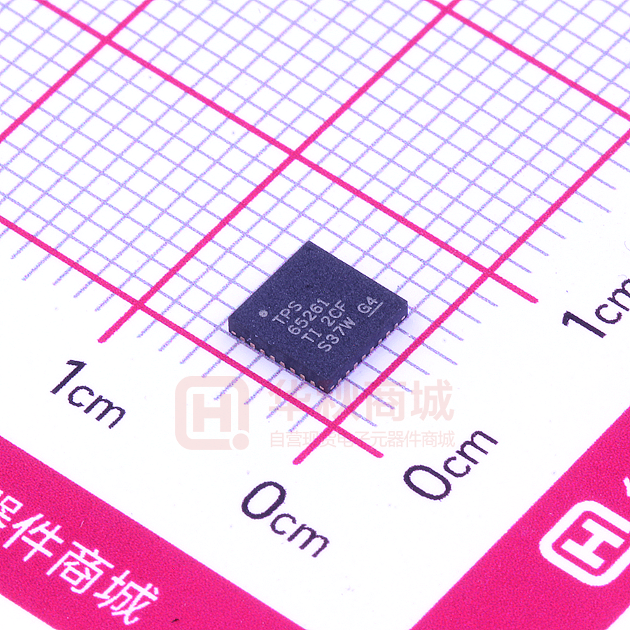

TPS65261RHBR
TPS65261RHBR
    BURR-BROWN(德州仪器)
    VQFN-32_5X5MM-EP
    是降压型-40℃~+85℃@(TA)3 降压可调0.6V~18V 4.5V~18V VQFN-32-EP(5x5)DC-DC转换器ROHS
TPS65261RHBR 数据手册
Sample & Buy Product Folder Support & Community Tools & Software Technical Documents TPS65261, TPS65261-1 SLVSCD3B – DECEMBER 2013 – REVISED MAY 2014 TPS6526x 4.5V to 18V Input Voltage, 3A/2A/2A Output Current Triple Synchronous Step-Down Converter 1 Features 3 Description • The TPS65261, TPS65261-1 is a monolithic triple synchronous step-down (buck) converter with 3A/2A/2A output currents. A wide 4.5V to 18V input supply voltage range encompasses the most intermediate bus voltages operating off 5V, 9V, 12V or 15V power bus. The converter, with constant frequency peak current mode, is designed to simplify its application while giving designers options to optimize the system according to targeted applications. The switching frequency of the converters can be adjusted from 250kHz to 2MHz with an external resistor. The 180° out-of-phase operation between Buck1 and Buck2, 3 (Buck2 and 3 run in phase) minimizes the input filter requirements. 1 • • • • • • • • • Operating Input Supply Voltage Range (4.5 V to 18 V) Feedback Reference Voltage 0.6V±1% Maximum Continuous Output Current 3A/2A/2A Adjustable Clock Frequency from 250kHz to 2MHz Dedicated Enable and Soft Start Pins for Each Buck Automatic Power-up/Power-down Sequence Pulse Skipping Mode (PSM) at Light Load (TPS65261 only) Output Voltage Power Good Indicator Input Voltage Power Failure Indicator Thermal Overloading Protection 2 Applications • • • • • • DTV Set Top Boxes Home Gateway and Access Point Networks Wireless Routers Surveillance POS Machine The TPS65261, TPS65261-1 features an automatic power sequence with connecting MODE pin to V7V and configuring EN1/2/3 pins. The device also features an open drain RESET signal to monitor power down. At light load, the TPS65261 automatically operates in pulse skipping mode (PSM) and the TPS65261-1 operates in force continuous current mode (FCC). PSM mode provides high efficiency by reducing switching losses at light loads and FCC mode reduces noise susceptibility and RF interference. The device features overvoltage protection, overcurrent and short-circuit protection and overtemperature protection. A power good pin asserts when any output voltages are out of regulation. Device Information (1) PART NUMBER TPS65261, TPS65261-1 (1) PACKAGE BODY SIZE (NOM) VQFN (32) 5.00 mm × 5.00 mm For all available packages, see the orderable addendum at the end of the datasheet. 4 Typical Application Vin Vout1 PVINx VIN 100 LX1 90 TPS65261 TPS65261-1 80 FB1 VDIV LX2 Vout2 PGOOD ENx FB2 MODE SSx ROSC Vout3 LX3 Efficiency (%) 70 RESET 60 50 40 30 20 VIN = 12 V VOUT = 3.3 V 0 0.01 10 AGND FB3 PGND TPS65261 0.1 Output Load (A) 1 C001 1 An IMPORTANT NOTICE at the end of this data sheet addresses availability, warranty, changes, use in safety-critical applications, intellectual property matters and other important disclaimers. PRODUCTION DATA. TPS65261, TPS65261-1 SLVSCD3B – DECEMBER 2013 – REVISED MAY 2014 www.ti.com Table of Contents 1 2 3 4 5 6 7 8 Features .................................................................. Applications ........................................................... Description ............................................................. Typical Application ................................................ Revision History..................................................... Pin Configuration and Functions ......................... Specifications......................................................... 1 1 1 1 2 3 4 7.1 7.2 7.3 7.4 7.5 7.6 4 5 5 5 6 8 Absolute Maximum Ratings ...................................... Handling Ratings ...................................................... Recommended Operating Conditions....................... Thermal Information .................................................. Electrical Characteristics........................................... Typical Characteristics .............................................. Detailed Description ............................................ 12 8.1 Overview ................................................................. 12 8.2 Functional Block Diagram ....................................... 13 8.3 Feature Description................................................. 13 8.4 Device Functional Modes........................................ 22 9 Application and Implementation ........................ 24 9.1 Application Information............................................ 24 9.2 Typical Application ................................................. 24 10 Power Supply Recommendations ..................... 34 11 Layout................................................................... 34 11.1 Layout Guidelines ................................................. 34 11.2 Layout Example .................................................... 35 12 Device and Documentation Support ................. 36 12.1 12.2 12.3 12.4 12.5 Documentation Support ....................................... Related Links ........................................................ Trademarks ........................................................... Electrostatic Discharge Caution ............................ Glossary ................................................................ 36 36 36 36 36 13 Mechanical, Packaging, and Orderable Information ........................................................... 36 5 Revision History Changes from Revision A (December 2013) to Revision B Page • Changed all text, tables and graphics to match the new data sheet template. ..................................................................... 1 • Changed Figure 70............................................................................................................................................................... 35 2 Submit Documentation Feedback Copyright © 2013–2014, Texas Instruments Incorporated TPS65261, TPS65261-1 www.ti.com SLVSCD3B – DECEMBER 2013 – REVISED MAY 2014 6 Pin Configuration and Functions EN2 EN1 VDIV VIN PVIN1 PGND1 LX1 BST1 RHB PACKAGE (TOP VIEW) 32 31 30 29 28 27 26 25 24 EN3 1 PGOOD 2 23 COMP1 RESET 3 22 FB1 MODE 4 21 AGND V7V 5 20 ROSC FB2 6 19 FB3 COMP2 7 18 COMP3 SS2 8 SS1 14 15 17 16 LX3 BST3 PVIN3 12 13 PGND3 LX2 11 PVIN2 10 PGND2 9 BST2 Thermal Pad SS3 (There is no electric signal down bonded to thermal pad inside IC. Exposed thermal pad must be soldered to PCB for optimal thermal performance.) Pin Functions PIN DESCRIPTION NO. NAME 1 EN3 2 PGOOD An open drain output, asserts low if output voltage of any buck beyond regulation range due to thermal shutdown, over-current, under-voltage or ENx shut down. 3 RESET Open drain power failure output signal. 4 MODE When high, an automatic power-up/power-down sequence is provided according to states of EN1, EN2 and EN3 pins. 5 V7V Internal LDO for gate driver and internal controller. Connect a 1µF capacitor from the pin to power ground 6 FB2 Feedback Kelvin sensing pin for buck2 output voltage. Connect this pin to buck2 resistor divider. 7 COMP2 Error amplifier output and Loop compensation pin for buck2. Connect a series resistor and capacitor to compensate the control loop of buck2 with peak current PWM mode. 8 SS2 Soft-start and tracking input for buck2. An internal 5µA pull-up current source is connected to this pin. The soft-start time can be programmed by connecting a capacitor between this pin and ground. 9 BST2 10 LX2 11 PGND2 Power ground connection of buck2. Connect PGND2 pin as close as practical to the (–) terminal of VIN2 input ceramic capacitor. 12 PVIN2 Input power supply for buck2. Connect PVIN2 pin as close as practical to the (+) terminal of an input ceramic capacitor (suggest 10µF). 13 PVIN3 Input power supply for buck3. Connect PVIN3 pin as close as practical to the (+) terminal of an input ceramic capacitor (suggest 10µF). 14 PGND3 Power ground connection of buck3. Connect PGND3 pin as close as practical to the (–) terminal of VIN3 input ceramic capacitor. 15 LX3 Enable for buck3. Float to enable. Can use this pin to adjust the input under-voltage lockout of buck3 with a resistor divider. Boot strapped supply to the high side floating gate driver in buck2. Connect a capacitor (recommend 47nF) from BST2 pin to LX2 pin. Switching node connection to the inductor and bootstrap capacitor for buck2. The voltage swing at this pin is from a diode voltage below the ground up to PVIN2 voltage. Switching node connection to the inductor and bootstrap capacitor for buck3. The voltage swing at this pin is from a diode voltage below the ground up to PVIN3 voltage. Copyright © 2013–2014, Texas Instruments Incorporated Submit Documentation Feedback 3 TPS65261, TPS65261-1 SLVSCD3B – DECEMBER 2013 – REVISED MAY 2014 www.ti.com Pin Functions (continued) PIN DESCRIPTION NO. NAME 16 BST3 17 SS3 Soft-start and tracking input for buck3. An internal 5µA pull-up current source is connected to this pin. The soft-start time can be programmed by connecting a capacitor between this pin and ground. 18 COMP3 Error amplifier output and Loop compensation pin for buck3. Connect a series resistor and capacitor to compensate the control loop of buck3 with peak current PWM mode. 19 FB3 20 ROSC Oscillator frequency programmable pin. Connect an external resistor to set the switching frequency. 21 AGND Analog ground common to buck controllers and other analog circuits. It must be routed separately from high current power grounds to the (–) terminal of bypass capacitor of input voltage VIN. 22 FB1 23 COMP1 Error amplifier output and Loop compensation pin for buck1. Connect a series resistor and capacitor to compensate the control loop of buck1 with peak current PWM mode. 24 SS1 Soft-start and tracking input for buck1. An internal 5µA pull-up current source is connected to this pin. The soft-start time can be programmed by connecting a capacitor between this pin and ground. 25 BST1 26 LX1 27 PGND1 Power ground connection of Buck1. Connect PGND1 pin as close as practical to the (–) terminal of VIN1 input ceramic capacitor. 28 PVIN1 Input power supply for buck1. Connect PVIN1 pin as close as practical to the (+) terminal of an input ceramic capacitor (suggest 10µF). Boot strapped supply to the high side floating gate driver in buck3. Connect a capacitor (recommend 47nF) from BST3 pin to LX3 pin. Feedback Kelvin sensing pin for buck3 output voltage. Connect this pin to buck3 resistor divider. Feedback Kelvin sensing pin for buck1 output voltage. Connect this pin to buck1 resistor divider. Boot strapped supply to the high side floating gate driver in buck1. Connect a capacitor (recommend 47nF) from BST1 pin to LX1 pin. Switching node connection to the inductor and bootstrap capacitor for buck1. The voltage swing at this pin is from a diode voltage below the ground up to PVIN1 voltage. 29 VIN 30 VDIV Buck controller power supply. Input voltage threshold for power failure detection of input voltage. 31 EN1 Enable for buck1. Float to enable. Can use this pin to adjust the input under-voltage lockout of buck1 with a resistor divider. 32 EN2 Enable for buck2. Float to enable. Can use this pin to adjust the input under-voltage lockout of buck2 with a resistor divider. PAD There is no electric signal down bonded to thermal pad inside IC. Exposed thermal pad must be soldered to PCB for optimal thermal performance. 7 Specifications 7.1 Absolute Maximum Ratings over operating free-air temperature range (unless otherwise noted) (1) MIN MAX PVIN1, PVIN2, PVIN3,VIN –0.3 20 V LX1, LX2, LX3 (Maximum withstand voltage transient < 20 ns) –1.0 20 V BST1, BST2, BST3 referenced to LX1, LX2, LX3 pins respectively –0.3 7 V EN1, EN2, EN3, PGOOD, V7V, MODE, RESET, VDIV –0.3 7 V FB1, FB2, FB3, COMP1 , COMP2, COMP3, SS1, SS2, SS3, ROSC –0.3 3.6 V AGND, PGND1, PGND2, PGND3 –0.3 0.3 V Operating junction temperature, TJ –40 125 °C (1) 4 UNIT Stresses beyond those listed under Absolute Maximum Ratings may cause permanent damage to the device. These are stress ratings only, which do not imply functional operation of the device at these or any other conditions beyond those indicated under Recommended Operating Conditions. Exposure to absolute-maximum-rated conditions for extended periods may affect device reliability. Submit Documentation Feedback Copyright © 2013–2014, Texas Instruments Incorporated TPS65261, TPS65261-1 www.ti.com SLVSCD3B – DECEMBER 2013 – REVISED MAY 2014 7.2 Handling Ratings Tstg V(ESD) (1) (2) MIN MAX UNIT –55 150 °C Human body model (HBM), per ANSI/ESDA/JEDEC JS-001, all pins (1) -2000 2000 Charged device model (CDM), per JEDEC specification JESD22-C101, all pins (2) -500 500 Storage temperature range Electrostatic discharge V JEDEC document JEP155 states that 500-V HBM allows safe manufacturing with a standard ESD control process. JEDEC document JEP157 states that 250-V CDM allows safe manufacturing with a standard ESD control process. 7.3 Recommended Operating Conditions over operating free-air temperature range (unless otherwise noted) MIN PVIN1, PVIN2, PVIN3,VIN NOM MAX 4.5 UNIT 18 V LX1, LX2, LX3 (Maximum withstand voltage transient < 20 ns) -0.8 18 V BST1, BST2, BST3 referenced to LX1, LX2, LX3 pins respectively -0.1 6.8 V EN1, EN2, EN3, PGOOD, V7V, MODE, RESET, VDIV -0.1 6.3 V FB1, FB2, FB3, COMP1 , COMP2, COMP3, SS1, SS2, SS3, ROSC -0.1 3 V TA Operating junction temperature -40 85 °C TJ Operating junction temperature -40 125 °C 7.4 Thermal Information THERMAL METRIC (1) TPS65261 RHB (32 PINS) RθJA Junction-to-ambient thermal resistance 31.6 RθJC(top) Junction-to-case (top) thermal resistance 23.4 RθJB Junction-to-board thermal resistance 6.1 ψJT Junction-to-top characterization parameter 0.2 ψJB Junction-to-board characterization parameter 6.1 RθJC(bot) Junction-to-case (bottom) thermal resistance 0.9 (1) UNIT °C/W For more information about traditional and new thermal metrics, see the IC Package Thermal Metrics application report, SPRA953. Copyright © 2013–2014, Texas Instruments Incorporated Submit Documentation Feedback 5 TPS65261, TPS65261-1 SLVSCD3B – DECEMBER 2013 – REVISED MAY 2014 www.ti.com 7.5 Electrical Characteristics TA = 25°C, VIN = 12 V, fSW = 600 kHz (unless otherwise noted) PARAMETER TEST CONDITIONS MIN TYP MAX UNIT INPUT SUPPLY VOLTAGE VIN Input voltage range 4.5 18 VIN rising 4 4.25 4.5 3.5 3.75 4 V V UVLO VIN under-voltage lockout VIN falling Hysteresis 500 mV IDDSDN Shutdown supply current EN1=EN2=EN3=MODE=0V 9.2 µA EN1=EN2=EN3=5V, FB1=FB2=FB3=0.8V 605 µA EN1=5V, EN2=EN3=0V, FB1=0.8V 330 µA EN2=5V, EN1=EN3=0V, FB2=0.8V 330 µA EN3=5V, EN1=EN2=0V, FB3=0.8V 330 µA IDDQ_NSW IDDQ_NSW1 IDDQ_NSW2 Input quiescent current without buck1/2/3 switching IDDQ_NSW3 V7V V7V LDO output voltage IOCP_V7V V7V LDO current limit V7V load current=0A 6 6.3 6.6 175 V mA FEEDBACK VOLTAGE REFERENCE VCOMP = 1.2 V, TJ = 25°C 0.596 0.6 0.605 V VCOMP = 1.2 V, TJ = -40°C to 125°C 0.594 0.6 0.606 V VFB Feedback voltage VLINEREG_BUCK Line regulation-DC IOUT1 = 1.5A, IOUT2 = 1A, IOUT3 = 1A 5V < PVINx < 18V VLOADREG_BUCK Load regulation-DC IOUTx = (10–100%) × IOUTx_max 0.002 %/V 0.02 %/A Buck1, Buck2, Buck3 VENXH EN1/2/3 high level input voltage 1.2 1.1 1.26 V VENXL EN1/2/3 low level input voltage 1.15 V IENX1 EN1/2/3 pull-up current ENx = 1V 3.6 µA IENX2 EN1/2/3 pull-up current ENx = 1.5V 6.6 µA IENhys Hysteresis current ISSX Soft start charging current TON_MIN Minimum on time 3 4.3 µA 5 6 µA 80 100 ns Gm_EA Error amplifier trans-conductance –2 µA < ICOMPX < 2 µA 300 µS Gm_PS1/2/3 COMP1/2/3 voltage to inductor current Gm ILX = 0.5 A 7.4 A/V ILIMIT1 Buck1 peak inductor current limit 4.33 5.1 6.02 A ILIMITSOURCE1 Buck1 low side source current limit 4.3 A ILIMITSINK1 Buck1 low side sink current limit 1.3 A ILIMIT2/3 Buck2/3 peak inductor current limit ILIMITSOURCE2/3 Buck2/3 low side source current limit ILIMITSINK2/3 Buck2/3 low side sink current limit THiccup_wait Over current wait time THiccup_re Hiccup time before re-start Rdson_HS1 Buck1 High-side switch resistance Rdson_LS1 Buck1 low-side switch resistance Rdson_HS2 2.6 3.1 2.7 1 3.73 A A A 256 cycles 8192 cycles VIN = 12V 100 mΩ VIN = 12V 65 mΩ Buck2 High-side switch resistance VIN = 12V 140 mΩ Rdson_LS2 Buck2 low-side switch resistance VIN = 12V 95 mΩ Rdson_HS3 Buck3 High-side switch resistance VIN = 12V 140 mΩ Rdson_LS3 Buck3 low-side switch resistance VIN = 12V 95 mΩ 6 Submit Documentation Feedback Copyright © 2013–2014, Texas Instruments Incorporated TPS65261, TPS65261-1 www.ti.com SLVSCD3B – DECEMBER 2013 – REVISED MAY 2014 Electrical Characteristics (continued) TA = 25°C, VIN = 12 V, fSW = 600 kHz (unless otherwise noted) PARAMETER TEST CONDITIONS MIN TYP MAX UNIT POWER GOOD, MODE, POWER SEQUENCE FBx under-voltage Falling 92.5 %VREF FBx under-voltage Rising 95 %VREF FBx over-voltage Rising 107.5 %VREF FBx over-voltage Falling Vth_PG Feedback voltage threshold 105 %VREF TDEGLITCH(PG)_F PGOOD falling edge deglitch time 128 cycles TRDEGLITCH(PG)_R PGOOD rising edge deglitch time 512 cycles IPG PGOOD pin leakage VLOW_PG PGOOD pin low voltage VMODEH MODE high level input voltage ISINK = 1 mA 1.2 1.1 0.05 µA 0.4 V 1.26 V VMODEL MODE low level input voltage 1.15 V IMODE1 MODE pull-up current MODE = 1V 3.6 µA IMODE2 MODE pull-up current MODE = 1.5V 6.6 µA Tpsdelay Delay time between bucks at automatic MODE = 1.5V power sequencing mode 1024 cycles POWER FAILURE DETECTOR VDIVth VDIV threshold IVDIV VDIV pull-up current IVDIVhys VDIV hysteresis current Tdeglitch_R RESET deglitch on the rising edge Tdeglitch_F RESET deglitch on the falling edge 1.18 1.23 1.26 V VDIV = 1V 1 µA VDIV = 1.5V 2 µA 1 µA 534 cycles 12 14 16 cycles 560 600 640 kHz 2000 kHz OSCILLATOR FSW FSW_range Switching frequency ROSC = 73.2 kΩ 250 THERMAL PROTECTION TTRIP_OTP THYST_OTP Thermal protection trip point Copyright © 2013–2014, Texas Instruments Incorporated Temperature rising Hysteresis 160 °C 20 °C Submit Documentation Feedback 7 TPS65261, TPS65261-1 SLVSCD3B – DECEMBER 2013 – REVISED MAY 2014 www.ti.com 7.6 Typical Characteristics 100 100 90 90 80 80 70 70 60 50 PSM 1.2V PSM Mode, Mode, Vout VO = =1.2 V 40 PSM 3.3V V PSM Mode, Mode, VO VO == 3.3 30 PSM 5.0V PSM Mode, Mode, VO VO == 5.0 V Efficiency (%) Efficiency (%) TA = 25°C, VIN = 12 V, VOUT1 = 1.2 V, VOUT2 = 3.3 V, VOUT3 = 1.8 V, fSW = 600 kHz (unless otherwise noted) FCC 1.2V FCC Mode, Mode, VO VO == 1.2 V 20 0.1 PSM 1.8V PSM Mode, Mode, Vout VO = =1.8 V 40 PSM 3.3V V PSM Mode, Mode, Vout VO = =3.3 30 PSM 5.0V PSM Mode, Mode, Vout VO = =5.0 V FCC 1.8V FCC Mode, Mode, Vout VO = =1.8 V FCC 3.3V FCC Mode, Mode, Vout VO = =3.3 V 10 FCC 5.0V V FCC Mode, Mode, VO VO == 5.0 0 0.01 50 20 FCC 3.3V FCC Mode, Mode, VO VO == 3.3 V 10 60 FCC 5.0V V FCC Mode, Mode, Vout VO = =5.0 0 0.01 1 Output Load (A) 0.1 Figure 1. BUCK 1 Efficiency C003 Figure 2. BUCK 2 Efficiency 1.220 3.33 1.215 3.32 1.210 Output Voltage (V) Output Voltage (V) 1 Output Load (A) C002 1.205 1.200 1.195 1.190 VIN=12V VIN = 12 V 1.180 0.0 0.5 1.0 1.5 2.0 2.5 3.30 3.29 3.28 VIN=5V VIN = 5 V 1.185 3.31 VIN=12V VIN = 12 V 3.27 3.0 Output Load (A) VIN=5V VIN = 5 V 0.0 0.2 0.4 0.6 0.8 1.0 1.2 1.4 1.6 1.8 2.0 Output Load (A) C004 VOUT = 1.2 V C005 VOUT = 3.3 V Figure 3. BUCK1, PSM Mode, Load Regulation Figure 4. BUCK2, PSM Mode, Load Regulation 1.820 1.210 1.206 1.810 Output Voltage (V) Output Voltage (V) 1.815 1.805 1.800 1.795 1.790 0.0 0.2 0.4 0.6 0.8 1.0 1.2 1.4 1.6 1.8 Output Load (A) VOUT = 1.8 V Figure 5. BUCK3, PSM Mode, Load Regulation 8 Submit Documentation Feedback IOUT=0.1A IOUT = 0.1 A IOUT=1.5A IOUT = 1.5 A VIN=12V VIN = 12 V 1.780 1.198 1.194 VIN=5V VIN = 5 V 1.785 1.202 IOUT = 3.0 A IOUT=3.0A 1.190 2.0 4 6 8 10 12 14 16 Input Voltage (V) C006 18 C007 VOUT = 1.2 V Figure 6. BUCK1, PSM Mode, Line Regulation Copyright © 2013–2014, Texas Instruments Incorporated TPS65261, TPS65261-1 www.ti.com SLVSCD3B – DECEMBER 2013 – REVISED MAY 2014 Typical Characteristics (continued) 3.300 1.810 3.298 1.806 Output Voltage (V) Output Voltage (V) TA = 25°C, VIN = 12 V, VOUT1 = 1.2 V, VOUT2 = 3.3 V, VOUT3 = 1.8 V, fSW = 600 kHz (unless otherwise noted) 3.296 3.294 IOUT=0.1A IOUT = 0.1 A 3.292 1.802 1.798 IOUT=0.1A IOUT = 0.1 A 1.794 IOUT=1A IOUT = 1.0 A IOUT=1A IOUT = 1.0 A IOUT = 2.0 A IOUT=2A 3.290 4 6 8 10 12 14 16 18 Input Voltage (V) IOUT = 2.0 A IOUT=2A 1.790 4 8 10 12 14 16 18 Input Voltage (V) VOUT = 3.3 V C009 VOUT = 1.8 V Figure 7. BUCK2, PSM MODE, LINE REGULATION Figure 8. BUCK3, PSM Mode, Line Regulation 640 0.606 Oscillator Frequency (kHz) 0.604 Voltage Reference (V) 6 C008 0.602 0.600 0.598 0.596 620 600 580 560 0.594 ±50 ±25 0 25 50 75 100 -50 125 Junction Temperature (ƒC) -25 0 25 50 75 100 Junction Temperature (°C) C011 125 C012 ROSC = 73.2 kΩ Figure 10. Oscillator Frequency vs Temperature Figure 9. Voltage Reference vs Temperature 4.4 4.2 13 En Pin On Pullup (A) Shutdown Quiescent Current (A) 15 11 9 4.0 3.8 3.6 3.4 7 3.2 5 3.0 ±50 ±25 0 25 50 75 100 125 Junction Temperature (ƒC) VIN = 12 V Figure 11. Shutdown Quiescent vs Temperature Copyright © 2013–2014, Texas Instruments Incorporated ±50 ±25 0 25 50 75 100 Junction Temperature (ƒC) C013 VIN = 12 V 125 C014 EN = 1 V Figure 12. EN Pin Pull-Up Current vs Temperature, EN=1.0V Submit Documentation Feedback 9 TPS65261, TPS65261-1 SLVSCD3B – DECEMBER 2013 – REVISED MAY 2014 www.ti.com Typical Characteristics (continued) TA = 25°C, VIN = 12 V, VOUT1 = 1.2 V, VOUT2 = 3.3 V, VOUT3 = 1.8 V, fSW = 600 kHz (unless otherwise noted) 7.4 1.28 EN Pin Threshold Raising (V) En Pin On Pullup (A) 7.2 7.0 6.8 6.6 6.4 6.2 6.0 1.24 1.20 1.16 1.12 ±50 ±25 0 25 50 75 100 Junction Temperature (ƒC) VIN = 12 V 125 ±50 EN = 1.5 V 50 75 100 125 C016 Figure 14. EN Pin Threshold Raising vs Temperature 5.4 Soft Start Current (mA) EN Pin Threshold Falling (V) 25 VIN = 12 V 1.23 1.19 1.15 1.11 1.07 5.2 5.0 4.8 4.6 ±50 ±25 0 25 50 75 100 Junction Temperature (ƒC) 125 ±50 ±25 0 25 50 75 100 Junction Temperature (ƒC) C017 VIN = 12 V 125 C018 VIN = 12 V Figure 15. EN Pin Threshold Falling vs Temperature Figure 16. SS Pin Charge Current vs Temperature 3.5 High Side Current Limit (A) 5.5 High Side Current Limit (A) 0 Junction Temperature (ƒC) Figure 13. EN Pin Pull-Up Current vs Temperature, EN=1.5V 5.3 5.1 4.9 4.7 3.3 3.1 2.9 2.7 ±50 ±25 0 25 50 75 Junction Temperature (ƒC) 100 125 Figure 17. Buck1 High-Side Current Limit vs Temperature Submit Documentation Feedback ±50 ±25 0 25 50 75 Junction Temperature (ƒC) C019 VIN = 12 V 10 ±25 C015 100 125 C020 VIN = 12 V Figure 18. Buck2 High-Side Current Limit vs Temperature Copyright © 2013–2014, Texas Instruments Incorporated TPS65261, TPS65261-1 www.ti.com SLVSCD3B – DECEMBER 2013 – REVISED MAY 2014 Typical Characteristics (continued) TA = 25°C, VIN = 12 V, VOUT1 = 1.2 V, VOUT2 = 3.3 V, VOUT3 = 1.8 V, fSW = 600 kHz (unless otherwise noted) 1.25 VDIV Pin Threshold (V) High Side Current Limit (A) 3.5 3.3 3.1 2.9 2.7 1.24 1.23 1.22 1.21 ±50 ±25 0 25 50 75 Junction Temperature (ƒC) 100 125 C021 ±50 ±25 0 25 50 75 100 Junction Temperature (ƒC) 125 C022 VIN = 12 V Figure 19. Buck3 High-Side Current Limit vs Temperature Copyright © 2013–2014, Texas Instruments Incorporated Figure 20. VDIV Pin Threshold vs Temperature Submit Documentation Feedback 11 TPS65261, TPS65261-1 SLVSCD3B – DECEMBER 2013 – REVISED MAY 2014 www.ti.com 8 Detailed Description 8.1 Overview The TPS65261, TPS65261-1 is a monolithic triple synchronous step-down (buck) converter with 3A/2A/2A output currents. A wide 4.5V to 18V input supply voltage range encompasses the most intermediate bus voltages operating off 5V, 9V, 12V or 15V power bus. The feedback voltage reference for each buck is 0.6V. Each buck is independent with dedicated enable, soft-start and loop compensation pins. The TPS65261, TPS65261-1 implements a constant frequency, peak current mode control that simplifies external loop compensation. The wide switching frequency of 250kHz to 2MHz allows optimizing system efficiency, filtering size and bandwidth. The switching frequency can be adjusted with an external resistor connected between ROSC pin and ground. The switching clock of buck1 is 180° out-of-phase operation from the clocks of buck2 and buck3 channels to reduce input current ripple, input capacitor size and power supply induced noise. The TPS65261, TPS65261-1 has been designed for safe monotonic startup into pre-biased loads. The default start up is when VIN is typically 4.5V. The ENx pin also can be used to adjust the input voltage under voltage lockout (UVLO) with an external resistor divider. In addition, the ENx pin has an internal 3.6uA current source, so the EN pin can be floating to automatically power up the converters. The TPS65261, TPS65261-1 reduces the external component count by integrating a bootstrap circuit. The bias voltage for the integrated high-side MOSFET is supplied by a capacitor between the BST and LX pin. A UVLO circuit monitors the bootstrap capacitor voltage VBST-VLX in each buck. When VBST-VLX voltage drops to the threshold, LX pin is pulled low to recharge the bootstrap capacitor. The TPS65261, TPS65261-1 can operate at 100% duty cycle as long as the bootstrap capacitor voltage is higher than the BOOT-LX UVLO threshold which is typically 2.1V. The TPS65261, TPS65261-1 features a PGOOD pin to supervise each output voltage of the buck converters. The TPS65261, TPS65261-1 has power good comparators with hysteresis, which monitor the output voltages through feedback voltages. When all bucks are in regulation range and power sequence is done, PGOOD is asserted to high. The SS (soft start/tracking) pin is used to minimize inrush currents or provide power supply sequencing during power up. A small value capacitor or resistor divider is connected to the pin for soft start or voltage tracking. At light loading, TPS65261 will automatically operate in pulse skipping mode (PSM) to save power. The TPS65261, TPS65261-1 is protected from overload and over temperature fault conditions. The converter minimizes excessive output overvoltage transients by taking advantage of the power good comparator. When the output is overvoltage, the high-side MOSFET is turned off until the internal feedback voltage is lower than 105% of the 0.6V reference voltage. The TPS65261, TPS65261-1 implements both high-side MOSFET overload protection and bidirectional low-side MOSFET overload protection to avoid inductor current runaway. If the over current condition has lasted for more than the OC wait time (256 clock cycles), the converter will shut down and re-start after the hiccup time (8192 clock cycles). The TPS65261, TPS65261-1 shuts down if the junction temperature is higher than the thermal shutdown trip point. When the junction temperature drops 20°C typically below the thermal shutdown trip point, the TPS65261, TPS65261-1 will be restarted under control of the soft start circuit automatically. 12 Submit Documentation Feedback Copyright © 2013–2014, Texas Instruments Incorporated TPS65261, TPS65261-1 www.ti.com SLVSCD3B – DECEMBER 2013 – REVISED MAY 2014 8.2 Functional Block Diagram ROSC VIN VIN BST1 VIN enable CLK2 PVIN1 clk OSC/Phase Shift CLK3 VIN V7V V3V CLK1 V7V LDO Bias V7V en_buck2 PGND1 PGND BUCK2 SS LX2 LX PGND2 PGND Comp 5 µA vfb Comp 5 µA SS1 MODE VIN BST2 BST MODE BUCK1 LX PVIN2 VIN en_buck1 BST LX1 V7V clk enable SS vfb SS2 FB2 FB1 COMP1 1 µA 1 µA VIN COMP2 1.23 V Power Failure deglitch VDIV RESET PGOOD en_buck3 Power Good 3.6 µA 3 µA 2K 6.3 V 3.6 µA V7V enable VIN PVIN3 BUCK3 MODE Comp 1.2 V vfb 3 µA LX3 LX PGND SS VIN BST3 BST FB1 FB2 FB3 MODE clk PGND3 5 µA SS3 FB3 EN1 en_buck1 6.3 V 1.2 V 2K State Machine 3 µA 3.6 µA en_buck2 en_buck3 EN2 COMP3 2K 6.3 V 1.2 V 3.6 µA OT 3 µA Over Temp AGND EN3 2K 6.3 V 1.2 V 8.3 Feature Description 8.3.1 Adjusting the Output Voltage The output voltage of each buck is set with a resistor divider from the output of buck to the FB pin. It is recommended to use 1% tolerance or better resistors. Vout R1 FB COMP R2 0.6 V Figure 21. Voltage Divider Circuit R2 = R1 ´ 0.6 Vout - 0.6 Copyright © 2013–2014, Texas Instruments Incorporated (1) Submit Documentation Feedback 13 TPS65261, TPS65261-1 SLVSCD3B – DECEMBER 2013 – REVISED MAY 2014 www.ti.com Feature Description (continued) To improve efficiency at light loads, consider using larger value resistors. If the values are too high, the regulator is more sensitive to noise. The recommended resistor values are shown in Table 1. Table 1. Output Resistor Divider Selection OUTPUT VOLTAGE (V) R1 (kΩ) R2 (kΩ) 1 10 15 1.2 10 10 1.5 15 10 1.8 20 10 2.5 31.6 10 3.3 45.3 10 3.3 22.6 4.99 5 73.2 10 5 36.5 4.99 8.3.2 Power Failure Detector The power failure detector monitors the voltage on VDIV, and sets open-drain output RESET low when VDIV is below 1.23V. There is deglitch on the rising edge, 534 frequency cycles. Figure 22 shows the power failure detector timing diagram. 1 µA VIN V7V Threshold_r Threshold_f VIN ih 1 µA R1 1.23 V VDIV V7V Power ip Failure RESET RESET R2 Delay Time 534 Cycles Figure 22. Power Failure Detector Timing Diagram 14 Submit Documentation Feedback Copyright © 2013–2014, Texas Instruments Incorporated TPS65261, TPS65261-1 www.ti.com SLVSCD3B – DECEMBER 2013 – REVISED MAY 2014 The thresholds can be calculated using Equation 2 and Equation 3. R1 ö æ Threshold _ r = Vref ç 1 + ÷ - Ip ´ R1  R2 è ø (2) R1 ö æ Threshold _ f = Vref ç 1 + ÷ - (IP + Ih )´ R1        R2 è ø (3) The divider resisters can be calculated using Equation 4 and Equation 5. Threshold _ r - Threshold _ f R1 =        Ih (4) Vref R2 =                  Threshold _ r - Vref ´ Ih + Ip Threshold _ r - Threshold _ f (5) Where Ih = 1µA, Ip = 1µA. 8.3.3 Enable and Adjusting Under-Voltage Lockout The EN1/2/3 pin provides electrical on/off control of the device. Once the EN1/2/3 pin voltage exceeds the threshold voltage, the device starts operation. If each ENx pin voltage is pulled below the threshold voltage, the regulator stops switching and enters low Iq state. The EN pin has an internal pull-up current source, allowing the user to float the EN pin to enable the device. If an application requires controlling the EN pin, use open drain or open collector output logic to interface with the pin. The device implements internal UVLO circuitry on the VIN pin. The device is disabled when the VIN pin voltage falls below the internal VIN UVLO threshold. The internal VIN UVLO threshold has a hysteresis of 500mV. If an application requires either a higher UVLO threshold on the VIN pin or a secondary UVLO on the PVINx in split rail applications, then the ENx pin can be configured as shown in Figure 23, Figure 24 and Figure 25. When using the external UVLO function, it is recommended to set the hysteresis to be greater than 500mV. The EN pin has a small pull-up current Ip which sets the default state of the pin to enable when no external components are connected. The pull-up current is also used to control the voltage hysteresis for the UVLO function since it increases by Ih once the EN pin crosses the enable threshold. The UVLO thresholds can be calculated using Equation 6 and Equation 7. æV ö VSTART ç ENFALLING ÷ - VSTOP V è ENRISING ø R1 = æ ö V IP ç 1 - ENFALLING ÷ + Ih VENRISING ø è (6) R2 = R1 ´ VENFALLING VSTOP - VENFALLILNG + R1 Ih + Ip ( ) (7) Where Ih = 3µA, IP = 3.6uA, VENSRISING = 1.2V, VENFALLING = 1.15V. VIN PVIN ih ih R1 R1 ip ip EN EN R2 R2 Figure 23. Adjustable VIN Under-voltage Lockout Copyright © 2013–2014, Texas Instruments Incorporated Figure 24. Adjustable PVIN Under-voltage Lockout, VIN>4.5V Submit Documentation Feedback 15 TPS65261, TPS65261-1 SLVSCD3B – DECEMBER 2013 – REVISED MAY 2014 www.ti.com PVIN VIN ih R1 ip EN R2 Figure 25. Adjustable VIN and PVIN Under-voltage Lockout 8.3.4 Soft-Start Time The voltage on the respective SS pin controls the start-up of the buck output. When the voltage on the SS pin is less than the internal 0.6V reference, the TPS65261, TPS65261-1 regulates the internal feedback voltage to the voltage on the SS pin instead of 0.6V. The SS pin can be used to program an external soft-start function or to allow output of the buck to track another supply during start-up. The device has an internal pull-up current source of 5µA (typical) that charges an external soft-start capacitor to provide a linear ramping voltage at the SS pin. The TPS65261, TPS65261-1 regulates the internal feedback voltage to the voltage on the SS pin, allowing VOUT to rise smoothly from 0V to its regulated voltage without inrush current. The soft-start time can be calculated approximately by Equation 8. Css(nF) ´ Vref(V) Tss  (ms ) = Iss(µA) (8) Many of the common power supply sequencing methods can be implemented using the SSx and ENx pins. Figure 26 shows the method implementing ratio-metric sequencing by connecting the SSx pins of three buck channels together. The regulator outputs ramp up and reach regulation at the same time. When calculating the soft-start time, the pull-up current source must be tripled in Equation 8. EN 31 EN threshold=1.2 V EN1 32 EN2 1 EN3 Vout3 = 3.3 V 24 SS1 Vout2 1.8 V 8 SS2 Vout1 1.2 V SS3 PGOOD 17 Css PGOOD Deglitch Time Tss = Css*0.6 V/15 µA Figure 26. Ratio Metric Power Up Using SSx Pins 16 Submit Documentation Feedback Copyright © 2013–2014, Texas Instruments Incorporated TPS65261, TPS65261-1 www.ti.com SLVSCD3B – DECEMBER 2013 – REVISED MAY 2014 Simultaneous power supply sequencing can be implemented by connecting capacitor to SSx pin, shown in Figure 27. The capacitors can be calculated using Equation 8 and Equation 9. Css1 Css2 Css3 = = Vout1 Vout2 Vout3 (9) EN 31 EN1 EN threshold = 1.2 V 32 EN2 1 EN3 Vout3 = 3.3 V 24 SS1 Css1 Vout2 1.8 V 8 SS2 Css2 Vout1 1.2 V 17 SS3 PGOOD Css3 PGOOD Deglitch Time Tss = Css3*0.6 V/5 µA Figure 27. Simultaneous Startup Sequence Using SSx Pins 8.3.5 Power Up Sequencing TPS65261, TPS65261-1 features a comprehensive sequencing circuit for the 3 bucks. If the MODE pin ties high to V7V, three buck start up and shutdown is in sequence according to different buck enable pin setup. If the MODE pin ties low to ground, three buck on/off is separately controlled by three enable pins. 8.3.5.1 External Power Sequencing The TPS65261, TPS65261-1 has a dedicated enable pin and soft-start pin for each converter. The converter enable pins are biased by a current source that allows for easy sequencing with the addition of an external capacitor. Disabling the converter with an active pull-down transistor on the ENs pin allows for a predictable power-down timing operation. Figure 28 shows the timing diagram of a typical buck power-up sequence by connecting a capacitor at ENx pin. Copyright © 2013–2014, Texas Instruments Incorporated Submit Documentation Feedback 17 TPS65261, TPS65261-1 SLVSCD3B – DECEMBER 2013 – REVISED MAY 2014 www.ti.com VIN EN Threshold V7V ENx Rise Time Dictated by C EN EN Threshold Charge C EN with 6.6 µA ENx Soft Start Rise Time Dictated by C SS Pre-Bias Startup PGOOD Deglitch Time VOUTx T = CSS *0.6 V/5 µA T = C EN *(1.2-0.4) V/3.6 µA T = C EN *0.4 V/1.4 µA PGOOD Figure 28. Startup Power Sequence 8.3.5.2 Automatic Power Sequencing The TPS65261, TPS65261-1 starts with a pre-defined power-up and power-down sequence when the MODE pin ties high to V7V. As shown in Table 2, the sequence is dictated by the different combinations of EN1 and EN2 status. EN3 is used to start/stop the converters. Buck2 and buck3 are identical converters and can be swapped in the system operation to allow for additional sequencing stages. Figure 29 shows the power sequencing when EN1 and EN2 are pulled up high. Table 2. Power Sequencing Automatic Power Sequencing Externally controlled sequencing 18 MODE EN1 EN2 High High High High Low High High High Low High Low Low Low Used to start/stop Used to start/stop buck1 buck2 Submit Documentation Feedback EN3 Used to start/stop bucks in sequence Start Sequencing Shutdown Sequencing Buck1→Buck2→Buck3 Buck3→Buck2→Buck1 Buck2→Buck1→Buck3 Buck3→Buck1→Buck2 Buck2→Buck3→Buck1 Buck1→Buck3→Buck2 Reserved Reserved Reserved Used to start/stop buck3 x x Copyright © 2013–2014, Texas Instruments Incorporated TPS65261, TPS65261-1 www.ti.com SLVSCD3B – DECEMBER 2013 – REVISED MAY 2014 VIN V7V MODE EN1 EN2 EN3 Buck1 Buck2 Buck3 PGOOD t1 t2 t3 t4 T psdelay = t1 = t2 = t3 = t4 = 1024*(1/fsw) Figure 29. Automatic Power Sequencing 8.3.6 V7V Low Dropout Regulator and Bootstrap Power for the high-side and low-side MOSFET drivers and most other internal circuitry is derived from the V7V pin. The internal built-in low dropout linear regulator (LDO) supplies 6.3V (typical) from VIN to V7V. A 1µF ceramic capacitor should be connected from V7V pin to power ground. If the input voltage, VIN, decreases to UVLO threshold voltage, the UVLO comparator detects the V7V pin voltage and forces the converter off. Each high-side MOSFET driver is biased from the floating bootstrap capacitor, CB, shown in Figure 30, which is normally recharged during each cycle through an internal low-side MOSFET or the body diode of a low-side MOSFET when the high-side MOSFET turns off. The boot capacitor is charged when the BST pin voltage is less than VIN and BST-LX voltage is below regulation. The recommended value of this ceramic capacitor is 47nF. A ceramic capacitor with an X7R or X5R grade dielectric with a voltage rating of 10V or higher is recommended because of the stable characteristics over temperature and voltage. Each low-side MOSFET driver is powered from the V7V pin directly. To improve drop out, the device is designed to operate at 100% duty cycle as long as the BST to LX pin voltage is greater than the BST-LX UVLO threshold, which is typically 2.1V. When the voltage between BST and LX drops below the BST-LX UVLO threshold, the high-side MOSFET is turned off and the low-side MOSFET is turned on allowing the boot capacitor to be recharged. Copyright © 2013–2014, Texas Instruments Incorporated Submit Documentation Feedback 19 TPS65261, TPS65261-1 SLVSCD3B – DECEMBER 2013 – REVISED MAY 2014 www.ti.com Figure 30. V7V Linear Dropout Regulator and Bootstrap Voltage Diagram 8.3.7 Out-of-Phase Operation In order to reduce input ripple current, the switch clock of buck1 is 180° out-of-phase from the clock of buck2 and buck3. This enables the system, having less input current ripple, to reduce the input capacitors’ size, cost and EMI. 8.3.8 Output Overvoltage Protection (OVP) The device incorporates an output overvoltage protection (OVP) circuit to minimize output voltage overshoot. When the output is overloaded, the error amplifier compares the actual output voltage to the internal reference voltage. If the FB pin voltage is lower than the internal reference voltage for a considerable time, the output of the error amplifier demands maximum output current. Once the condition is removed, the regulator output rises and the error amplifier output transitions to the steady state voltage. In some applications with small output capacitance, the load can respond faster than the error amplifier. This leads to the possibility of an output overshoot. Each buck compares the FB pin voltage to the OVP threshold. If the FB pin voltage is greater than the OVP threshold, the high-side MOSFET is turned off preventing current from flowing to the output and minimizing output overshoot. When the FB voltage drops lower than the OVP threshold, the high-side MOSFET turns on at the next clock cycle. 8.3.9 Slope Compensation In order to prevent the sub-harmonic oscillations when the device operates at duty cycles greater than 50%, the device adds built-in slope compensation, which is a compensating ramp to the switch current signal. 8.3.10 Overcurrent Protection The device is protected from over current conditions with cycle-by-cycle current limiting on both the high-side MOSFET and the low-side MOSFET. 20 Submit Documentation Feedback Copyright © 2013–2014, Texas Instruments Incorporated TPS65261, TPS65261-1 www.ti.com SLVSCD3B – DECEMBER 2013 – REVISED MAY 2014 8.3.10.1 High-side MOSFET Over Current Protection The device implements current mode control which uses the COMP pin voltage to control the turn off of the highside MOSFET and the turn on of the low-side MOSFET on a cycle-by-cycle basis. During each cycle, the switch current and the current reference generated by the COMP pin voltage are compared, when the peak switch current intersects the current reference, the high-side switch is turned off. 8.3.10.2 Low-side MOSFET Over Current Protection While the low-side MOSFET is turned on, its conduction current is monitored by the internal circuitry. During normal operation, the low-side MOSFET sources current to the load. At the end of every clock cycle, the low-side MOSFET sourcing current is compared to the internally set low-side sourcing current limit. If the low-side sourcing current is exceeded, the high-side MOSFET is not turned on and the low-side MOSFET stays on for the next cycle. The high-side MOSFET is turned on again when the low-side current is below the low-side sourcing current limit at the start of a cycle. The low-side MOSFET may also sink current from the load. If the low-side sinking current limit is exceeded, the low-side MOSFET is turned off immediately for the rest of that clock cycle. In this scenario both MOSFETs are off until the start of the next cycle. Furthermore, if an output overload condition (as measured by the COMP pin voltage) has lasted for more than the hiccup wait time which is programmed for 256 switching cycles shown in Figure 31, the device will shut down itself and restart after the hiccup time of 8192 cycles. The hiccup mode helps reduce the device power dissipation under severe overcurrent condition. OCP peak inductor current threshold OC limiting (waiting) time 256 cycles hiccup time 8192 cycles soft start time T=Css*0.6V/5uA Output over loading iL Inductor Current Soft-start is reset after OC waiting time ~2.1V OC fault removed, soft-start and output recovery SS 0.6V SS Pin Voltage Output hard short circuit Vout Output Voltage Figure 31. Over Current Protection 8.3.11 Power Good The PGOOD pin is an open drain output. Once feedback voltage of each buck is between 95% (rising) and 105% (falling) of the internal voltage reference, the PGOOD pin pull-down is de-asserted and the pin floats. It is recommended to use a pull-up resistor between the values of 10kΩ and 100kΩ to a voltage source that is 5.5V or less. The PGOOD is in a defined state once the VIN input voltage is greater than 1V, but with reduced current sinking capability. The PGOOD achieves full current sinking capability once the VIN input voltage is above UVLO threshold, which is 4.25V. Copyright © 2013–2014, Texas Instruments Incorporated Submit Documentation Feedback 21 TPS65261, TPS65261-1 SLVSCD3B – DECEMBER 2013 – REVISED MAY 2014 www.ti.com The PGOOD pin is pulled low when any feedback voltage of a buck is lower than 92.5% (falling) or greater than 107.5% (rising) of the nominal internal reference voltage. Also, the PGOOD is pulled low if the input voltage is under-voltage locked up, thermal shutdown is asserted, the EN pin is pulled low or the converter is in a soft-start period. 8.3.12 Adjustable Switching Frequency The ROSC pin can be used to set the switching frequency by connecting a resistor to GND. The switching frequency of the device is adjustable from 250KHz to 2MHz. To determine the ROSC resistance for a given switching frequency, use Equation 10 or the curve in Figure 32. To reduce the solution size, set the switching frequency as high as possible, but tradeoffs of the supply efficiency and minimum controllable on time should be considered. ƒosc (kHz ) = 39557 ´ R(kW )-0.975 (10) 200 175 ROSC (k 150 125 100 75 50 25 0 0 200 400 600 800 1000 1200 1400 1600 1800 2000 Switching Frequency (kHz) C010 Figure 32. ROSC versus Switching Frequency 8.3.13 Thermal Shutdown The internal thermal shutdown circuitry forces the device to stop switching if the junction temperature exceeds 160°C typically. The device reinitiates the power up sequence when the junction temperature drops below 140°C typically. 8.4 Device Functional Modes 8.4.1 Pulse Skipping MODE (PSM) The TPS65261 can enter high efficiency pulse skipping mode (PSM) operation at light load current. When a controller is enabled for PSM operation, the peak inductor current is sensed and compared with 230mA current typically. Since the integrated current comparator catches the peak inductor current only, the average load current entering PSM varies with applications and external output filters. In PSM, the sensed peak inductor current is clamped at 230mA. When a controller operates in PSM, the inductor current is not allowed to reverse. The reverse current comparator turns off the low-side MOSFET when the inductor current reaches zero, preventing it from reversing and going negative. Due to the delay in the circuit and current comparator tdly (typical 50ns at VIN = 12V), the real peak inductor current threshold to turn off high-side power MOSFET, could shift higher depending on inductor inductance and input/output voltages. The threshold of peak inductor current to turn off high-side power MOSFET can be calculated by Equation 11. Vin - Vout ILPEAK = 230 mA + ´ tdly (11) L 22 Submit Documentation Feedback Copyright © 2013–2014, Texas Instruments Incorporated TPS65261, TPS65261-1 www.ti.com SLVSCD3B – DECEMBER 2013 – REVISED MAY 2014 Device Functional Modes (continued) Once the charge accumulated on the Vout capacitor is more than loading need, COMP pin voltage drops to low voltage driven by the error amplifier. There is an internal comparator at the COMP pin. If COMP voltage is lower than 0.35V, the power stage stops switching to save power. 230 mA Turn off high-side Power MOSFET IL_Peak Inductor Peak Current Inductor Current Peak Current Sensing x1 Current Comparator Delay: tdly Figure 33. PSM Current Comparator Copyright © 2013–2014, Texas Instruments Incorporated Submit Documentation Feedback 23 TPS65261, TPS65261-1 SLVSCD3B – DECEMBER 2013 – REVISED MAY 2014 www.ti.com 9 Application and Implementation 9.1 Application Information The devices are triple synchronous step down dc/dc converters. They are typically used to convert a higher dc voltage to lower dc voltages with continuous available output current of 3A/2A/2A. The following design procedure can be used to select component values for the TPS65261 and TPS65261-1. This section presents a simplified discussion of the design process. 9.2 Typical Application C26 22pF R263 20K C15 22pF R153 19.5K R152 39K VIN 17 19 20 ROSC 21 AGND 22 FB1 EN1 LX2 2 1 R2 PULL R7 30K C5 1uF BST2 4.7uH 13 C13 10uF C152 22uF C101 22uF C102 22uF Vin C12 10uF L2 10 9 C151 22uF Vin 12 11 Vout3 +1.8V Max. 2A L3 R9 0 C9 47nF 4.7uH Vout2 +3.3V Max. 2A C72 22pF C71 2.2nF 100K R3 C16 47nF SS2 EN2 EN3 32 PGND2 VDIV R16 0 8 31 PGND3 14 PVIN2 COMP2 30 15 PVIN3 7 R30 20K 29 16 LX3 TPS65261 TPS65261-1 FB2 C29 1uF PVIN1 6 Vin R29 146K 28 V7V C28 10uF BST3 PGND1 5 27 C182 22pF LX1 MODE Vin 26 4.7uH BST1 4 C262 22uF 25 RESET C261 22uF R25 0 C25 47nF 3 L1 PGOOD Vout1 +1.2V Max. 3A COMP1 SS1 24 23 R23 20K C17 10nF C181 2.2nF R18 30K FB3 C232 22pF R20 73.2K 18 C231 3.3nF COMP3 C24 10nF SS3 R262 20K C8 10nF R102 39K RESET PGOOD 100K R103 8.67K C10 22pF Figure 34. Typical Application Schematic 24 Submit Documentation Feedback Copyright © 2013–2014, Texas Instruments Incorporated TPS65261, TPS65261-1 www.ti.com SLVSCD3B – DECEMBER 2013 – REVISED MAY 2014 Typical Application (continued) 9.2.1 Design Requirements This example details the design of triple synchronous step-down converter. A few parameters must be known in order to start the design process. These parameters are typically determined at the system level. For this example, we start with the following known parameters: Table 3. Design Parameters DESIGN PARAMETER EXAMPLE VALUE Vout1 1.2 V Iout1 3A Vout2 3.3 V Iout2 2A Vout3 1.8 V Iout3 2A Transient Response 1A Load Step ±5% Input Voltage 12 V normal, 4.5 V to 18 V Output Voltage Ripple ±1% Switching Frequency 600 kHz 9.2.2 Detailed Design Procedure 9.2.2.1 Output Inductor Selection To calculate the value of the output inductor, use Equation 12. LIR is a coefficient that represents the amount of inductor ripple current relative to the maximum output current. The inductor ripple current is filtered by the output capacitor. Therefore, choosing high inductor ripple currents impact the selection of the output capacitor since the output capacitor must have a ripple current rating equal to or greater than the inductor ripple current. In general, the inductor ripple value is at the discretion of the designer; however, LIR is normally from 0.1 to 0.3 for the majority of applications. V - Vout Vout L = inmax ´ Io ´ LIR Vin max ´ ƒ sw (12) For the output filter inductor, it is important that the RMS current and saturation current ratings not be exceeded. The RMS and peak inductor current can be found from Equation 14 and Equation 15. V - Vout Vout Iripple = inmax ´ L Vinmax ´ ƒ sw (13) æ Vout ´ (Vinmax - Vout ) ö çç ÷÷ Vinmax ´ L ´ ƒ sw è ø 2 ILrms = IO + 12 Iripple ILpeak = Iout + 2 2 (14) (15) The current flowing through the inductor is the inductor ripple current plus the output current. During power up, faults or transient load conditions, the inductor current can increase above the calculated peak inductor current level calculated above. In transient conditions, the inductor current can increase up to the switch current limit of the device. For this reason, the most conservative approach is to specify an inductor with a saturation current rating equal to or greater than the switch current limit rather than the peak inductor current. 9.2.2.2 Output Capacitor Selection There are three primary considerations for selecting the value of the output capacitor. The output capacitor determines the modulator pole, the output voltage ripple, and how the regulator responds to a large change in load current. The output capacitance needs to be selected based on the most stringent of these three criteria. Copyright © 2013–2014, Texas Instruments Incorporated Submit Documentation Feedback 25 TPS65261, TPS65261-1 SLVSCD3B – DECEMBER 2013 – REVISED MAY 2014 www.ti.com The desired response to a large change in the load current is the first criteria. The output capacitor needs to supply the load with current when the regulator cannot. This situation would occur if there are desired hold-up times for the regulator where the output capacitor must hold the output voltage above a certain level for a specified amount of time after the input power is removed. The regulator is also temporarily not able to supply sufficient output current if there is a large, fast increase in the current needs of the load such as a transition from no load to full load. The regulator usually needs two or more clock cycles for the control loop to see the change in load current and output voltage and adjust the duty cycle to react to the change. The output capacitor must be sized to supply the extra current to the load until the control loop responds to the load change. The output capacitance must be large enough to supply the difference in current for 2 clock cycles while only allowing a tolerable amount of drop in the output voltage. Equation 16 shows the minimum output capacitance necessary to accomplish this. 2 ´ DIout Co = ƒ sw ´ DVout (16) Where ΔIout is the change in output current, fsw is the regulators switching frequency and ΔVout is the allowable change in the output voltage. Equation 17 calculates the minimum output capacitance needed to meet the output voltage ripple specification. Where fsw is the switching frequency, Voripple is the maximum allowable output voltage ripple, and Ioripple is the inductor ripple current. 1 1 Co > ´ 8 ´ ƒ sw Voripple Ioripple (17) Equation 18 calculates the maximum ESR an output capacitor can have to meet the output voltage ripple specification. Voripple Resr < Ioripple (18) Additional capacitance de-ratings for aging, temperature and DC bias should be factored in, which increases this minimum value. Capacitors generally have limits to the amount of ripple current they can handle without failing or producing excess heat. An output capacitor that can support the inductor ripple current must be specified. Some capacitor data sheets specify the root mean square (RMS) value of the maximum ripple current. Equation 19 can be used to calculate the RMS ripple current the output capacitor needs to support. Icorms = Vout ´ (Vinmax - Vout ) 12 ´ Vinmax ´ L ´ ƒ sw (19) 9.2.2.3 Input Capacitor Selection The TPS65261, TPS65261-1 requires a high quality ceramic, type X5R or X7R, input decoupling capacitor of at least 10 µF of effective capacitance on the PVIN input voltage pins. In some applications, additional bulk capacitance may also be required for the PVIN input. The effective capacitance includes any DC bias effects. The voltage rating of the input capacitor must be greater than the maximum input voltage. The capacitor must also have a ripple current rating greater than the maximum input current ripple of The TPS65261, TPS65261-1. The input ripple current can be calculated using Equation 20. Iinrms = Iout ´ (Vinmin - Vout ) Vout ´ Vinmin Vinmin (20) The value of a ceramic capacitor varies significantly over temperature and the amount of DC bias applied to the capacitor. The capacitance variations due to temperature can be minimized by selecting a dielectric material that is stable over temperature. X5R and X7R ceramic dielectrics are usually selected for power regulator capacitors because they have a high capacitance to volume ratio and are fairly stable over temperature. The output capacitor must also be selected with the DC bias taken into account. The capacitance value of a capacitor decreases as the DC bias across a capacitor increases. The input capacitance value determines the input ripple voltage of the regulator. The input voltage ripple can be calculated using Equation 21. 26 Submit Documentation Feedback Copyright © 2013–2014, Texas Instruments Incorporated TPS65261, TPS65261-1 www.ti.com DVin = SLVSCD3B – DECEMBER 2013 – REVISED MAY 2014 Iout max ´ 0.25 Cin ´ ƒ sw (21) 9.2.2.4 Loop Compensation The TPS65261, TPS65261-1 incorporates a peak current mode control scheme. The error amplifier is a transconductance amplifier with a gain of 300 µS. A typical type II compensation circuit adequately delivers a phase margin between 60° and 90°. Cb adds a high frequency pole to attenuate high frequency noise when needed. To calculate the external compensation components, follow these steps. 1. Select switching frequency fsw that is appropriate for application depending on L and C sizes, output ripple, and EMI. Switching frequency between 500kHz to 1MHz gives best trade-off between performance and cost. To optimize efficiency, lower switching frequency is desired. 2. Set up cross over frequency, ƒc, which is typically between 1/5 and 1/20 of fsw. 3. RC can be determined by 2p ´ ƒc ´ Vo ´ Co RC = Gm _EA ´ Vref ´ Gm _PS (22) Where Gm_EA is the error amplifier gain (300µS), Gm_PS is the power stage voltage to current conversion gain (7.4A/V). æ ö 1 ÷. 4. Calculate CC by placing a compensation zero at or before the dominant pole ç ƒp = Co ´ RL ´ 2p ø è RL ´ Co CC = RC (23) 5. Optional Cb can be used to cancel the zero from the ESR associated with CO. ´ Co R Cb = ESR RC (24) LX VOUT iL Current Sense I/V Converter RESR RL Gm _ PS = 7.4 A/V Co R1 Vfb C1 FB COMP EA V ref = 0.6 V Rc R2 Gm _ EA = 300 µS Cb Cc Figure 35. DC/DC Loop Compensation Copyright © 2013–2014, Texas Instruments Incorporated Submit Documentation Feedback 27 TPS65261, TPS65261-1 SLVSCD3B – DECEMBER 2013 – REVISED MAY 2014 www.ti.com 9.2.3 Application Curves 28 Figure 36. BUCK1, Soft-Start with No Load Figure 37. BUCK1, Soft-Start with Full Load Figure 38. BUCK2, Soft-Start with No Load Figure 39. BUCK2, Soft-Start with Full Load Figure 40. BUCK3, Soft-Start with No Load Figure 41. BUCK3, Soft-Start with Full Load Submit Documentation Feedback Copyright © 2013–2014, Texas Instruments Incorporated TPS65261, TPS65261-1 www.ti.com SLVSCD3B – DECEMBER 2013 – REVISED MAY 2014 Figure 42. BUCK1, PSM Mode, Steady State Operation at Light Load Figure 43. BUCK1, Steady State Operation with Full Load Figure 44. BUCK2, PSM Mode, Steady State Operation at Light Load Figure 45. BUCK2, Steady State Operation with Full Load Figure 46. BUCK3, PSM Mode, Steady State Operation with Light Load Copyright © 2013–2014, Texas Instruments Incorporated Figure 47. BUCK3, Steady State Operation with Full Load Submit Documentation Feedback 29 TPS65261, TPS65261-1 SLVSCD3B – DECEMBER 2013 – REVISED MAY 2014 30 www.ti.com Figure 48. BUCK1, Load Transient, 0.75A to 1.5A SR=0.25A/µs Figure 49. BUCK1, Load Transient, 1.5A to 2.25A SR=0.25A/µs Figure 50. BUCK2, Load Transient, 0.5A to 1.0A SR=0.25A/µs Figure 51. BUCK2, Load Transient, 1.0A to 1.5A SR=0.25A/µs Figure 52. BUCK3, Load Transient, 0.5A to 1.0A SR=0.25A/µs Figure 53. BUCK3, Load Transient, 1.0A to 1.5A SR=0.25A/µs Submit Documentation Feedback Copyright © 2013–2014, Texas Instruments Incorporated TPS65261, TPS65261-1 www.ti.com SLVSCD3B – DECEMBER 2013 – REVISED MAY 2014 Figure 54. BUCK1, Over Current Protection Figure 55. BUCK1, Hiccup and Recovery Figure 56. BUCK2, Over Current Protection Figure 57. BUCK2, Hiccup and Recovery Figure 58. BUCK3, Over Current Protection Figure 59. BUCK3, Hiccup and Recovery Copyright © 2013–2014, Texas Instruments Incorporated Submit Documentation Feedback 31 TPS65261, TPS65261-1 SLVSCD3B – DECEMBER 2013 – REVISED MAY 2014 32 www.ti.com Figure 60. Automatic Power Sequencing, MODE=EN1=EN2=HIGH Figure 61. Automatic Power Sequencing, MODE=EN1=EN2=HIGH Figure 62. Automatic Power Sequencing, MODE=EN1= HIGH, EN2=LOW Figure 63. Automatic Power Sequencing, MODE=EN1=HIGH, EN2=LOW Figure 64. Automatic Power Sequencing, MODE=EN2=HIGH, EN1=LOW Figure 65. Automatic Power Sequencing, MODE=EN2=HIGH, EN1=LOW Submit Documentation Feedback Copyright © 2013–2014, Texas Instruments Incorporated TPS65261, TPS65261-1 www.ti.com SLVSCD3B – DECEMBER 2013 – REVISED MAY 2014 Figure 66. Trigger Voltage 1.23V, Reset vs VDIV VIN = 12 V Figure 67. Deglitch Time, Reset vs VDIV VOUT1 = 1.2 V/1.5 A VOUT2 = 3.3 V/1 A VOUT3 = 1.8 V/1 A EVM Condition 4 Layers, 64mm x 69mm, TA = 27.2°C VOUT1 = 1.2 V/3 A VOUT2 = 3.3 V/2 A VOUT3 = 1.8 V/2 A EVM Condition 4 Layers, 64mm x 69mm, TA = 27.2°C Figure 68. Thermal Signature of TPS65261EVM Figure 69. Thermal Signature of TPS65261EVM Copyright © 2013–2014, Texas Instruments Incorporated VIN = 12 V Submit Documentation Feedback 33 TPS65261, TPS65261-1 SLVSCD3B – DECEMBER 2013 – REVISED MAY 2014 www.ti.com 10 Power Supply Recommendations The devices are designed to operate from an input voltage supply range between 4.5 V and 18 V. This input power supply should be well regulated. If the input supply is located more than a few inches from the TPS65261 or TPS65261-1 converter additional bulk capacitance may be required in addition to the ceramic bypass capacitors. An electrolytic capacitor with a value of 47 μF is a typical choice. 11 Layout 11.1 Layout Guidelines The TPS65261, TPS65261-1 can be laid out on 2-layer PCB, illustrated in Figure 70. Layout is a critical portion of good power supply design. See Figure 70 for a PCB layout example. The top contains the main power traces for PVIN, VOUT, and LX. Also on the top layer are connections for the remaining pins of the TPS65261, TPS65261-1 and a large top side area filled with ground. The top layer ground area should be connected to the bottom layer ground using vias at the input bypass capacitor, the output filter capacitor and directly under the TPS65261, TPS65261-1 device to provide a thermal path from the exposed thermal pad land to ground. The bottom layer acts as ground plane connecting analog ground and power ground. For operation at full rated load, the top side ground area together with the bottom side ground plane must provide adequate heat dissipating area. There are several signals paths that conduct fast changing currents or voltages that can interact with stray inductance or parasitic capacitance to generate noise or degrade the power supplies performance. To help eliminate these problems, the PVIN pin should be bypassed to ground with a low ESR ceramic bypass capacitor with X5R or X7R dielectric. Care should be taken to minimize the loop area formed by the bypass capacitor connections, the PVIN pins and the ground connections. The VIN pin must also be bypassed to ground using a low ESR ceramic capacitor with X5R or X7R dielectric. Since the LX connection is the switching node, the output inductor should be located close to the LX pins, and the area of the PCB conductor minimized to prevent excessive capacitive coupling. The output filter capacitor ground should use the same power ground trace as the PVIN input bypass capacitor. Try to minimize this conductor length while maintaining adequate width. The small signal components should be grounded to the analog ground path. The FB and COMP pins are sensitive to noise so the resistors and capacitors should be located as close as possible to the IC and routed with minimal lengths of trace. The additional external components can be placed approximately as shown. 34 Submit Documentation Feedback Copyright © 2013–2014, Texas Instruments Incorporated TPS65261, TPS65261-1 www.ti.com SLVSCD3B – DECEMBER 2013 – REVISED MAY 2014 11.2 Layout Example VOUT1 SS3 FB3 COMP3 ROSC AGND FB1 SS1 COMP1 VOUT3 BST3 BST1 PGND3 PVIN1 PVIN3 VIN PVIN2 VDIV PGND2 EN1 LX2 EN2 BST2 SS2 COMP2 FB2 V7V MODE RESET PVIN EN3 VIN LX3 PGND1 PGOOD PVIN LX1 VOUT2 TOPSIDE GROUND AREA 0.010 in. Diameter Thermal VIA to Ground Plane VIA to Ground Plane Figure 70. PCB Layout Copyright © 2013–2014, Texas Instruments Incorporated Submit Documentation Feedback 35 TPS65261, TPS65261-1 SLVSCD3B – DECEMBER 2013 – REVISED MAY 2014 www.ti.com 12 Device and Documentation Support 12.1 Documentation Support 12.1.1 Related Parts PART NUMBER DESCRIPTION COMMENTS TPS65262 4.5V to 18V, triple buck with dual adjustable LDOs Triple buck 3A/1A/1A output current, dual LDOs 100mA/200mA output current, automatic power sequencing TPS65263 4.5V to 18V, triple buck with I2C interface Triple buck 3A/2A/2A output current, I2C controlled dynamic voltage scaling (DVS) TPS65651-1/2/3 4.5V to 18V, triple buck with different PGOOD deglitch time Triple buck 3A/2A/2A output current, support 1s, 32ms, 256ms PGOOD deglitch time, adjustable current limit setting by external resistor TPS65287 4.5V to 18V, triple buck with power switch and push button control Triple buck 3A/2A/2A output current, up to 2.1-A USB power with over current setting by external resistor, push button control for intelligent system power-on/power-off operation TPS65288 4.5V to 18V, triple buck with dual power switches Triple buck 3A/2A/2A output current, 2 USB power switches current limiting at typical 1.2A (0.8/1.0/1.4/1.6/1.8/2.0/2.2A available with manufacture trim options) 12.2 Related Links The table below lists quick access links. Categories include technical documents, support and community resources, tools and software, and quick access to sample or buy. Table 4. Related Links PARTS PRODUCT FOLDER SAMPLE & BUY TECHNICAL DOCUMENTS TOOLS & SOFTWARE SUPPORT & COMMUNITY TPS65261 Click here Click here Click here Click here Click here TPS65261-1 Click here Click here Click here Click here Click here 12.3 Trademarks All trademarks are the property of their respective owners. 12.4 Electrostatic Discharge Caution These devices have limited built-in ESD protection. The leads should be shorted together or the device placed in conductive foam during storage or handling to prevent electrostatic damage to the MOS gates. 12.5 Glossary SLYZ022 — TI Glossary. This glossary lists and explains terms, acronyms and definitions. 13 Mechanical, Packaging, and Orderable Information The following pages include mechanical, packaging, and orderable information. This information is the most current data available for the designated devices. This data is subject to change without notice and revision of this document. For browser-based versions of this data sheet, refer to the left-hand navigation. 36 Submit Documentation Feedback Copyright © 2013–2014, Texas Instruments Incorporated PACKAGE OPTION ADDENDUM www.ti.com 10-Dec-2020 PACKAGING INFORMATION Orderable Device Status (1) Package Type Package Pins Package Drawing Qty Eco Plan (2) Lead finish/ Ball material MSL Peak Temp Op Temp (°C) Device Marking (3) (4/5) (6) TPS65261-1RHBR ACTIVE VQFN RHB 32 3000 RoHS & Green NIPDAU Level-2-260C-1 YEAR -40 to 85 TPS 65261-1 TPS65261-1RHBT ACTIVE VQFN RHB 32 250 RoHS & Green NIPDAU Level-2-260C-1 YEAR -40 to 85 TPS 65261-1 TPS65261RHBR ACTIVE VQFN RHB 32 3000 RoHS & Green NIPDAU Level-2-260C-1 YEAR -40 to 85 TPS 65261 TPS65261RHBT ACTIVE VQFN RHB 32 250 RoHS & Green NIPDAU Level-2-260C-1 YEAR -40 to 85 TPS 65261 (1) The marketing status values are defined as follows: ACTIVE: Product device recommended for new designs. LIFEBUY: TI has announced that the device will be discontinued, and a lifetime-buy period is in effect. NRND: Not recommended for new designs. Device is in production to support existing customers, but TI does not recommend using this part in a new design. PREVIEW: Device has been announced but is not in production. Samples may or may not be available. OBSOLETE: TI has discontinued the production of the device. (2) RoHS: TI defines "RoHS" to mean semiconductor products that are compliant with the current EU RoHS requirements for all 10 RoHS substances, including the requirement that RoHS substance do not exceed 0.1% by weight in homogeneous materials. Where designed to be soldered at high temperatures, "RoHS" products are suitable for use in specified lead-free processes. TI may reference these types of products as "Pb-Free". RoHS Exempt: TI defines "RoHS Exempt" to mean products that contain lead but are compliant with EU RoHS pursuant to a specific EU RoHS exemption. Green: TI defines "Green" to mean the content of Chlorine (Cl) and Bromine (Br) based flame retardants meet JS709B low halogen requirements of
