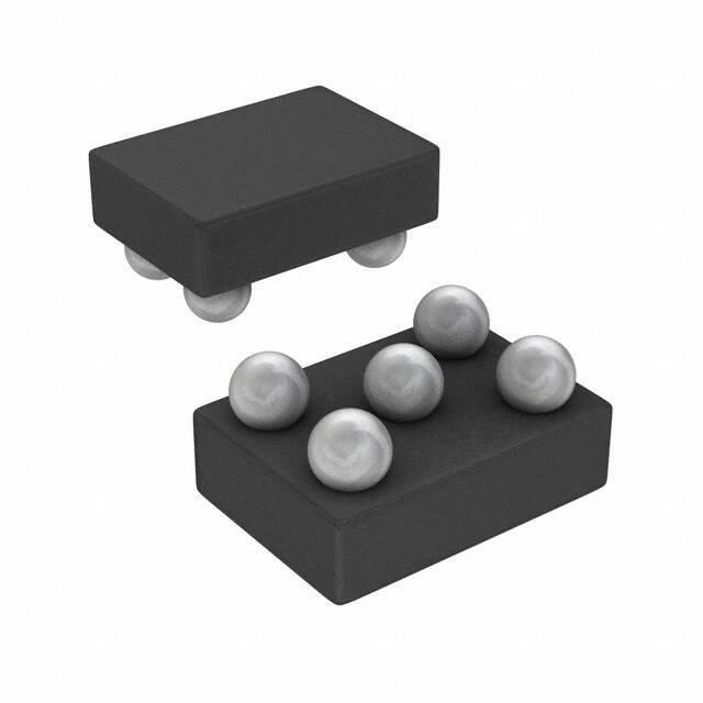

Product Folder Order Now Support & Community Tools & Software Technical Documents Reference Design TPS720 SBVS100E – JUNE 2008 – REVISED SEPTEMBER 2015 TPS720 350 mA, Ultra-Low VIN, RF Low-Dropout Linear Regulator With Bias Pin 1 Features • • • 1 • • • • • • • • • • 350-mA High-Performance LDO Low Quiescent Current: 38 μA Excellent Load Transient Response: ±15 mV for ILOAD = 0 mA to 350 mA in 1 μs Excellent Line Transient Response: ΔVOUT = ±2 mV for ΔVBIAS = ±600 mV in 1 μs ΔVOUT = ±200 μV for ΔVIN = ±400 mV in 1 μs Low Noise: 48 μVRMS (10 Hz to 100 kHz) 80 dB VIN PSRR (10 Hz to 10 kHz) 70 dB VBIAS PSRR (10 Hz to 10 kHz) Fast Start-Up Time: 140 μs Built-In Soft-Start With Monotonic VOUT Rise and Start-Up Current Limited to 100 mA + ILOAD Overcurrent and Thermal Protection Low Dropout: 110 mV at ILOAD = 350 mA Stable with 2.2-μF Output Capacitor Available in 1.33 mm × 0.96 mm DSBGA-5 and 2 mm × 2 mm SON-6 Packages The TPS720 supports a novel feature in which the output of the LDO regulates under light loads when the IN pin is left floating. The light-load drive current is sourced from VBIAS under this condition. This feature is particularly useful in power-saving applications where the DC-DC converter connected to the IN pin is disabled but the LDO is still required to regulate the voltage to a light load. The TPS720 is stable with ceramic capacitors and uses an advanced BICMOS fabrication process that yields a dropout of 110 mV at a 350-mA output load. The TPS720 has the unique feature of providing a monotonic VOUT rise (overshoot limited to 3%) with VIN inrush current limited to 100 mA + ILOAD with an output capacitor of 2.2 μF. The TPS720 uses a precision voltage reference and feedback loop to achieve overall accuracy of 2% over load, line, process, and temperature extremes. An ultra-small DSBGA package makes the TPS720 ideal for handheld applications. The TPS720 is also available in a SON-8 package. This family of devices is fully specified over the temperature range of TJ = –40°C to 125°C. 2 Applications • • • • Digital Cameras Cellular Camera Phones Wireless LAN Handheld Products Device Information(1) PART NUMBER TPS720 BODY SIZE (NOM) 1.36 mm × 0.96 mm SON (6) 2.00 mm × 2.00 mm (1) For all available packages, see the orderable addendum at the end of the data sheet. 3 Description Simplified Schematic The TPS720 family of dual rail, low-dropout linear regulators (LDOs) offers outstanding ac performance (PSRR, load and line transient response), while consuming a very low quiescent current of 38 μA. The VBIAS rail that powers the control circuit of the LDO draws very low current (on the order of the quiescent current of the LDO) and can be connected to any power supply that is equal to or greater than 1.4 V above the output voltage. The main power path is through VIN, which can be a lower voltage than VBIAS; it can be as low as VOUT + VDO, increasing the efficiency of the solution in many power-sensitive applications. For example, VIN can be an output of a high-efficiency, DC-DC step-down regulator. PACKAGE DSBGA (5) VBATT CBIAS BIAS Standalone dc/dc Converter or PMU 1.8 V IN OUT 1.3 V VCORE TPS720xx CIN EN GND COUT VEN 1 An IMPORTANT NOTICE at the end of this data sheet addresses availability, warranty, changes, use in safety-critical applications, intellectual property matters and other important disclaimers. PRODUCTION DATA. TPS720 SBVS100E – JUNE 2008 – REVISED SEPTEMBER 2015 www.ti.com Table of Contents 1 2 3 4 5 6 7 Features .................................................................. Applications ........................................................... Description ............................................................. Revision History..................................................... Pin Configuration and Functions ......................... Specifications......................................................... 1 1 1 2 3 3 6.1 6.2 6.3 6.4 6.5 6.6 3 4 4 4 5 7 Detailed Description ............................................ 12 7.1 7.2 7.3 7.4 8 Absolute Maximum Ratings ...................................... ESD Ratings.............................................................. Recommended Operating Conditions....................... Thermal Information .................................................. Electrical Characteristics........................................... Typical Characteristics .............................................. Overview ................................................................. Functional Block Diagram ....................................... Feature Description................................................. Device Functional Modes........................................ 12 12 12 13 Application and Implementation ........................ 14 8.1 Application Information............................................ 14 8.2 Typical Application .................................................. 15 9 Power Supply Recommendations...................... 17 10 Layout................................................................... 17 10.1 10.2 10.3 10.4 Layout Guidelines ................................................. Layout Example .................................................... Thermal Considerations ........................................ Power Dissipation ................................................. 17 17 17 18 11 Device and Documentation Support ................. 19 11.1 11.2 11.3 11.4 11.5 11.6 Device Support .................................................... Documentation Support ........................................ Community Resources.......................................... Trademarks ........................................................... Electrostatic Discharge Caution ............................ Glossary ................................................................ 19 19 19 19 19 19 12 Mechanical, Packaging, and Orderable Information ........................................................... 20 12.1 Package Mounting ................................................ 20 4 Revision History NOTE: Page numbers for previous revisions may differ from page numbers in the current version. Changes from Revision D (August 2009) to Revision E • Page Added ESD Ratings table, Feature Description section, Device Functional Modes, Application and Implementation section, Power Supply Recommendations section, Layout section, Device and Documentation Support section, and Mechanical, Packaging, and Orderable Information section ................................................................................................. 1 Changes from Revision C (September, 2008) to Revision D Page • Added electrical specifications for DRV package ................................................................................................................... 5 • Noted electrical specifications for YZU package .................................................................................................................... 5 2 Submit Documentation Feedback Copyright © 2008–2015, Texas Instruments Incorporated Product Folder Links: TPS720 TPS720 www.ti.com SBVS100E – JUNE 2008 – REVISED SEPTEMBER 2015 5 Pin Configuration and Functions DRV Package 6-Pin SON With Exposed Thermal Pad Top View OUT 1 NC 2 EN 3 Thermal Pad (1) 6 IN 5 GND 4 BIAS YZU Package 5-Pin DSBGA Top View C3 C1 BIAS EN B2 GND A3 A1 OUT (1) IN TI recommends connecting the SON (DRV) package thermal pad to ground. Pin Functions PIN I/O DESCRIPTION A3 O Output pin. A 2.2-μF ceramic capacitor is connected from this pin to ground, for stability and to provide load transients. See Input and Output Capacitor Requirements. 2 — — No connection. EN 3 C3 I Enable pin. A logic high signal on this pin turns the device on and regulates the voltage from IN to OUT. A logic low on this pin turns off the device. BIAS 4 C1 I Bias supply pin. TI recommends bypassing this input with a ceramic capacitor to ground for better transient performance. See Input and Output Capacitor Requirements. GND 5 B2 — IN 6 A1 I NAME DRV YZU OUT 1 NC Ground pin. Input pin. This pin can be a maximum of 4.5 V; VIN must not exceed VBIAS. Bypass this input with a ceramic capacitor to ground. See Input and Output Capacitor Requirements. 6 Specifications 6.1 Absolute Maximum Ratings At TJ = –40°C to 125°C (unless otherwise noted). All voltages are with respect to GND. (1) VIN (2) Input voltage (steady-state) VIN_PEAK (4) Peak transient input VBIAS Bias voltage VEN Enable voltage VOUT Output voltage IOUT Peak output current MIN MAX UNIT –0.3 VBIAS or 5 (3) V 5.5 V –0.3 6 V –0.3 6 V –0.3 5 V Internally limited Output short circuit duration Indefinite PDISS Total continuous power dissipation TJ Operating junction temperature –55 125 °C Tstg Storage temperature –55 150 °C (1) (2) (3) (4) See Thermal Information Stresses beyond those listed under Absolute Maximum Ratings may cause permanent damage to the device. These are stress ratings only, which do not imply functional operation of the device at these or any other conditions beyond those indicated under Recommended Operating Conditions. Exposure to absolute-maximum-rated conditions for extended periods may affect device reliability. To ensure proper operation of the device it is necessary that VIN ≤ VBIAS under all conditions. Whichever is less. For durations no longer than 1ms each, for a total of no more than 1000 occurrences over the lifetime of the device. Submit Documentation Feedback Copyright © 2008–2015, Texas Instruments Incorporated Product Folder Links: TPS720 3 TPS720 SBVS100E – JUNE 2008 – REVISED SEPTEMBER 2015 www.ti.com 6.2 ESD Ratings VALUE V(ESD) (1) (2) Electrostatic discharge Human-body model (HBM), per ANSI/ESDA/JEDEC JS-001 (1) ±2000 Charged-device model (CDM), per JEDEC specification JESD22C101 (2) ±500 Machine model (MM) ±100 UNIT V JEDEC document JEP155 states that 500-V HBM allows safe manufacturing with a standard ESD control process. JEDEC document JEP157 states that 250-V CDM allows safe manufacturing with a standard ESD control process. 6.3 Recommended Operating Conditions over operating junction-air temperature range (unless otherwise noted) MIN VIN Input voltage (steady-state) VBIAS Bias voltage VOUT Output voltage IOUT Peak output current CIN Input capacitance CBIAS Bias capacitance COUT (3) Output capacitance (1) (2) (3) NOM MAX UNIT 1.1 VBIAS or 4.5 (1) V 2.5 or or VOUT + 1.4 (2) 5.5 V 0.9 3.6 V 0 350 mA 1 µF 0.1 µF 2.2 µF Whichever is less Whichever is greater Maximum ESR should be less than 250 mΩ. 6.4 Thermal Information TPS720 THERMAL METRIC (1) DRV (SON) YZU (WSCP) 6 PINS 5 PINS UNIT 144.9 °C/W RθJA Junction-to-ambient thermal resistance 66.5 RθJC(top) Junction-to-case (top) thermal resistance 86.2 1.1 °C/W RθJB Junction-to-board thermal resistance 36.1 27.5 °C/W ψJT Junction-to-top characterization parameter 1.7 4.1 °C/W ψJB Junction-to-board characterization parameter 36.6 27.4 °C/W RθJC(bot) Junction-to-case (bottom) thermal resistance 7.4 N/A °C/W (1) 4 For more information about traditional and new thermal metrics, see the Semiconductor and IC Package Thermal Metrics application report, SPRA953. Submit Documentation Feedback Copyright © 2008–2015, Texas Instruments Incorporated Product Folder Links: TPS720 TPS720 www.ti.com SBVS100E – JUNE 2008 – REVISED SEPTEMBER 2015 6.5 Electrical Characteristics Over operating temperature range (TJ = –40°C to 125°C), VBIAS = (VOUT + 1.4 V ) or 2.5 V (whichever is greater); VIN ≥ VOUT + 0.5 V, IOUT = 1 mA, VEN = 1.1 V, COUT = 2.2 μF, unless otherwise noted. Typical values are at TJ = 25°C. PARAMETER TEST CONDITIONS MIN TYP MAX VIN Input voltage 1.1 (1) VBIAS or 4.5 (2) VBIAS Bias voltage 2.5 5.5 Output voltage (4) 0.9 3.6 –3 3 VOUT (3) ΔVOUT/ΔVIN Output accuracy Nominal TJ = 25°C Over VBIAS, VIN, IOUT, TJ = –40°C to 125°C VOUT + 1.4 V ≤ VBIAS ≤ 5.5 V, VOUT + 0.5 V ≤ VIN ≤ 4.5 V, 0 mA ≤ IOUT ≤ 350 mA –2% 2% Over VBIAS, VIN, IOUT, TJ = –40°C to 125°C DRV package only: VOUT + 1.4 V ≤ VBIAS ≤ 5.5 V, VOUT + 0.5 V ≤ VIN ≤ 4.5 V, 0 mA ≤ IOUT ≤ 350 mA, VOUT < 1.2 V –25 25 Over VBIAS, VIN, IOUT, TJ = –10°C to 85°C YZU package only: VOUT + 1.4 V ≤ VBIAS ≤ 5.5 V, VOUT + 0.5 V ≤ VIN ≤ 4.5 V, 0 mA ≤ IOUT ≤ 350 mA 1.6 V ≤ VOUT ≤ 3.3 V –1% 1% VIN floating VOUT + 1.4 V ≤ VBIAS ≤ 5.5 V, 0 μA ≤ IOUT ≤ 500 μA VIN line regulation ΔVOUT/ΔVBIAS VBIAS line regulation UNIT V V V mV mV ±1% VIN = (VOUT + 0.5 V) to 4.5 V, IOUT = 1 mA 16 μV/V VBIAS = (VOUT + 1.4 V) or 2.5 V (whichever is greater) to 5.5 V, IOUT = 1 mA 16 μV/V VIN line transient ΔVIN = 400 mV, tRISE = tFALL = 1 μs ±200 μV VBIAS line transient ΔVBIAS = 600 mV, tRISE = tFALL = 1 μs ±0.8 mV Load regulation 0 mA ≤ IOUT ≤ 350 mA (no load to full load) –15 μV/mA Load transient 0 mA ≤ IOUT ≤ 350 mA, tRISE = tFALL = 1 μs ±15 mV VDO_IN VIN dropout voltage (5) VIN = VOUT(NOM) – 0.1 V, (VBIAS – VOUT(NOM)) = 1.4 V, IOUT = 350 mA 110 VDO_BIAS VBIAS dropout voltage (6) VIN = VOUT(NOM) + 0.3 V, IOUT = 350 mA ICL Output current limit VOUT = 0.9 × VOUT(NOM) IGND Ground pin current ISHDN Shutdown current (IGND) ΔVOUT/ΔIOUT PSRR (1) (2) (3) (4) (5) (6) VIN power-supply rejection ratio 420 200 1.09 1.4 V 525 800 mA IOUT = 100 μA 38 IOUT = 0 mA to 350 mA 54 80 0.5 2 VEN ≤ 0.4 V, TJ = –40°C to 85°C VIN – VOUT ≥ 0.5 V, VBIAS = VOUT + 1.4 V, IOUT = 350 mA mV f = 10 Hz 85 f = 100 Hz 85 f = 1 kHz 85 f = 10 kHz 80 f = 100 kHz 70 f = 1 MHz 50 μA μA dB Performance specifications are ensured up to a minimum VIN = VOUT + 0.5 V. Whichever is less. Minimum VBIAS = (VOUT + 1.4 V) or 2.5 V (whichever is greater) and VIN= VOUT + 0.5 V. VO nominal value is factory programmable through the onchip EEPROM. Measured for devices with VOUT(NOM) ≥ 1.2 V. VBIAS – VOUT with VOUT = VOUT(NOM) – 0.1 V. Measured for devices with VOUT(NOM) ≥ 1.8 V. Submit Documentation Feedback Copyright © 2008–2015, Texas Instruments Incorporated Product Folder Links: TPS720 5 TPS720 SBVS100E – JUNE 2008 – REVISED SEPTEMBER 2015 www.ti.com Electrical Characteristics (continued) Over operating temperature range (TJ = –40°C to 125°C), VBIAS = (VOUT + 1.4 V ) or 2.5 V (whichever is greater); VIN ≥ VOUT + 0.5 V, IOUT = 1 mA, VEN = 1.1 V, COUT = 2.2 μF, unless otherwise noted. Typical values are at TJ = 25°C. PARAMETER PSRR VBIAS power-supply rejection ratio TEST CONDITIONS VIN – VOUT ≥ 0.5 V, VBIAS = VOUT + 1.4 V, IOUT = 350 mA MIN TYP f = 10 Hz 80 f = 100 Hz 80 f = 1 kHz 75 f = 10 kHz 65 f = 100 kHz 55 f = 1 MHz 35 VN Output noise voltage BW = 10 Hz to 100 kHz, VBIAS ≥ 2.5 V, VIN = VOUT + 0.5 V IVIN_INRUSH Inrush current on VIN VBIAS = (VOUT +1.4 V) or 2.5 V (whichever is greater), VIN = VOUT + 0.5 V tSTR Start-up time VOUT = 95% VOUT(NOM), IOUT = 350 mA, COUT = 2.2 μF VEN(HI) Enable pin high (enabled) 1.1 VEN(LO) Enable pin low (disabled) 0 IEN Enable pin current VEN = 5.5 V , VIN = 4.5 V, VBIAS = 5.5 V Undervoltage lockout VBIAS rising Hysteresis VBIAS falling 150 Shutdown, temperature increasing 160 Reset, temperature decreasing 140 UVLO TSD Thermal shutdown temperature TJ Operating junction temperature 6 2.41 UNIT dB 48 –40 Submit Documentation Feedback MAX μVRMS 100 + ILOAD mA 140 μs V 2.45 0.4 V 1 μA 2.49 V mV °C 125 °C Copyright © 2008–2015, Texas Instruments Incorporated Product Folder Links: TPS720 TPS720 www.ti.com SBVS100E – JUNE 2008 – REVISED SEPTEMBER 2015 6.6 Typical Characteristics Over operating temperature range (TJ = –40°C to 125°C), VBIAS = (VOUT + 1.4 V) or 2.5 V (whichever is greater); VIN = VOUT + 0.5 V, IOUT = 1 mA, VEN = 1.1 V, COUT = 2.2 μF, unless otherwise noted. Typical values are at TJ = 25°C. 1.40 1.40 1.38 1.38 1.36 1.36 -40°C 1.32 1.30 1.28 +105°C 1.26 1.32 1.30 1.28 +105°C +125°C 1.24 1.22 1.22 1.20 1.20 2.5 3.0 3.5 4.5 4.0 2.5 3.0 3.5 VIN (V) IOUT = 350 mA Figure 1. VIN Line Regulation (TPS72013YZU) 1.40 1.38 1.38 +85°C -10°C +25°C 1.34 1.36 -40°C 1.32 1.30 1.28 +105°C 1.26 1.30 1.28 +105°C +125°C 1.24 1.22 -40°C 1.32 1.26 +125°C 1.24 +85°C -10°C +25°C 1.34 VOUT (V) VOUT (V) Figure 2. VIN Line Regulation (TPS72013YZU) 1.40 1.36 4.5 4.0 VIN (V) IOUT = 0 mA 1.22 1.20 1.20 2.5 3.0 3.5 4.5 4.0 5.5 5.0 2.5 3.0 3.5 5.5 IOUT = 350 mA Figure 3. VBIAS Line Regulation (TPS72013YZU) Figure 4. VBIAS Line Regulation (TPS72013YZU) 1.40 1.40 1.38 1.38 +85°C -10°C +25°C 1.34 5.0 VBIAS (V) IOUT = 0 mA 1.36 4.5 4.0 VBIAS (V) 1.36 -40°C 1.32 1.30 1.28 +105°C 1.26 1.30 1.28 +105°C +125°C 1.24 1.22 -40°C 1.32 1.26 +125°C 1.24 +85°C +25°C -10°C 1.34 VOUT (V) VOUT (V) -40°C 1.26 +125°C 1.24 +85°C -10°C +25°C 1.34 VOUT (V) VOUT (V) +85°C -10°C +25°C 1.34 1.22 1.20 1.20 0 1 2 3 4 5 6 7 8 9 10 0 IOUT (mA) 50 100 150 200 250 300 350 IOUT (mA) Figure 5. Load Regulation Under Light Loads (TPS72013YZU) Figure 6. Load Regulation (TPS72013YZU) Submit Documentation Feedback Copyright © 2008–2015, Texas Instruments Incorporated Product Folder Links: TPS720 7 TPS720 SBVS100E – JUNE 2008 – REVISED SEPTEMBER 2015 www.ti.com Typical Characteristics (continued) Over operating temperature range (TJ = –40°C to 125°C), VBIAS = (VOUT + 1.4 V) or 2.5 V (whichever is greater); VIN = VOUT + 0.5 V, IOUT = 1 mA, VEN = 1.1 V, COUT = 2.2 μF, unless otherwise noted. Typical values are at TJ = 25°C. 1.40 1.40 TJ = +25°C 1.38 1.36 1.36 1.34 VBIAS = 3.0V 1.32 VBIAS = 4.0V 1.34 VBIAS = 5.0V VOUT (V) VOUT (mA) VBIAS = 2.7V 1.38 1.30 1.28 TJ = +125°C 1.32 1.30 TJ = -40°C 1.28 TJ = +25°C 1.26 1.26 1.24 VBIAS = 2.7V 1.22 VBIAS = 3.5V 0 0.5 1.0 1.5 2.0 2.5 3.0 TJ = +85°C 1.22 VBIAS = 5.5V 1.20 TJ = 0°C 1.24 VBIAS = 4.5V TJ = +105°C 1.20 4.0 3.5 0 0.1 0.2 0.3 0.4 IOUT (mA) Figure 7. Load Regulation With VIN Floating (TPS72013YZU) 0.7 0.8 0.9 1.0 1.15 +125°C +105°C 120 100 80 60 -10°C -40°C +25°C 40 VDO_BIAS = VBIAS - VOUT (V) 1.14 140 VDO_IN (mV) 0.6 Figure 8. Load Regulation With VIN Floating (TPS72013YZU) 160 +85°C 20 1.13 1.12 1.11 1.10 1.09 1.08 1.07 1.06 VOUT = VOUT(NOM) - 0.1 IOUT = 350mA 1.05 1.04 0 0 50 100 150 200 250 300 350 -40 -25 -10 5 20 IOUT (mA) 35 50 65 80 95 110 125 TJ (°C) Figure 9. VIN Dropout Voltage vs Output Current (TPS72013YZU) Figure 10. VBIAS Dropout Voltage vs Temperature (TPS72033YZU) 1.345 50 45 1.325 IOUT = 1mA 40 IOUT = 0mA 35 IOUT = 1mA 1.305 IGND (mA) VOUT (V) 0.5 IOUT (mA) 1.285 IOUT = 350mA 30 25 20 +125°C +105°C +85°C +25°C -10°C -40°C 15 1.265 10 5 1.245 0 -40 -25 -10 5 20 35 50 65 80 95 110 125 2.5 TJ (°C) 3.5 4.0 4.5 5.0 5.5 VBIAS (V) Figure 11. Output Voltage vs Temperature (TPS72013YZU) 8 3.0 Figure 12. Ground Pin Current vs VBIAS Input Voltage (TPS72013YZU) Submit Documentation Feedback Copyright © 2008–2015, Texas Instruments Incorporated Product Folder Links: TPS720 TPS720 www.ti.com SBVS100E – JUNE 2008 – REVISED SEPTEMBER 2015 Typical Characteristics (continued) Over operating temperature range (TJ = –40°C to 125°C), VBIAS = (VOUT + 1.4 V) or 2.5 V (whichever is greater); VIN = VOUT + 0.5 V, IOUT = 1 mA, VEN = 1.1 V, COUT = 2.2 μF, unless otherwise noted. Typical values are at TJ = 25°C. 70 60 IOUT = 350mA 60 +125°C +105°C +85°C 50 +25°C 40 IGND (mA) IGND (mA) 50 40 30 20 -40°C -10°C 20 30 10 10 0 0 0 50 100 150 200 250 350 300 -40 -25 -10 5 20 35 50 65 80 95 110 125 IOUT (mA) TJ (°C) Figure 13. Ground Pin Current vs Output Current (TPS72013YZU) Figure 14. Ground Pin Current vs Temperature (TPS72013YZU) 3.0 675 2.5 650 -10°C +25°C -40°C +25°C -10°C -40°C +85°C 1.5 +125°C ICL (mA) ISHDN (mA) 2.0 625 600 1.0 +85°C +105°C +105°C +125°C 575 0.5 0 550 2.5 3.0 3.5 4.5 4.0 5.0 5.5 2.5 3.0 3.5 VBIAS (V) Figure 15. Shutdown Current vs VBIAS Input Voltage (TPS72013YZU) 5.0 5.5 Figure 16. Current Limit vs VBIAS Input Voltage (TPS72013YZU) 675 120 -10°C +25°C 4.5 4.0 VBIAS (V) -40°C 100 650 (VIN - VOUT) = 0.5V (VBIAS - VOUT) = 1.4V IOUT = 0mA PSRR (dB) ICL (mA) 80 625 600 +85°C +105°C IOUT = 50mA 60 IOUT = 350mA 40 +125°C 575 20 550 0 2.5 3.0 3.5 4.5 4.0 10 VIN (V) 100 1k 10k 100k 1M 10M Frequency (Hz) Figure 17. Current Limit vs VIN Input Voltage (TPS72013YZU) Figure 18. VIN Power-Supply Ripple Rejection vs Frequency (TPS72015YZU) Submit Documentation Feedback Copyright © 2008–2015, Texas Instruments Incorporated Product Folder Links: TPS720 9 TPS720 SBVS100E – JUNE 2008 – REVISED SEPTEMBER 2015 www.ti.com Typical Characteristics (continued) Over operating temperature range (TJ = –40°C to 125°C), VBIAS = (VOUT + 1.4 V) or 2.5 V (whichever is greater); VIN = VOUT + 0.5 V, IOUT = 1 mA, VEN = 1.1 V, COUT = 2.2 μF, unless otherwise noted. Typical values are at TJ = 25°C. 100 100 IOUT = 350mA (VIN - VOUT) = 350mV 80 80 PSRR (dB) PSRR (dB) IOUT = 1mA 60 (VIN - VOUT) = 300mV 40 60 40 (VIN - VOUT) = 250mV IOUT = 350mA 20 20 (VIN - VOUT) = 0.5V (VBIAS - VOUT) = 1.4V 0 0 10 100 1k 10k 100k 1M 10M 10 100 1k Frequency (Hz) Figure 19. VIN Power-Supply Ripple Rejection vs Frequency (TPS72015YZU) Output Spectral Noise Density (mV/ÖHz) 10k 100k 1M 10M Frequency (Hz) Figure 20. VBIAS Power-Supply Ripple Rejection vs Frequency (TPS72015YZU) 10 VOUT = 1.3V IIN-PEAK = 110mA 1 IIN 50mA/div 0.1 EN 500mV/div 200mV/div VOUT 0.01 100 1k 100k 10k 20ms/div Frequency (Hz) VIN = 1.8 V IOUT = 0 mA Figure 21. Output Spectral Noise Density vs Frequency (TPS72015YZU) VOUT = 1.3 V VBIAS = 2.7 V Figure 22. VIN Inrush Current VOUT = 1.3V IIN-PEAK = 400mA 1mV/div VOUT IIN 200mA/div 2.0V EN 500mV/div 200mV/div 200mV/div VIN 1.6V VOUT 100ms/div 20ms/div VIN = 1.8 V IOUT = 350 mA VOUT = 1.3 V VBIAS = 2.7 V VIN VIN = 1.6 to 2 V Slew Rate = 1 V/μs VBIAS = 2.7 V Figure 24. VIN Line Transient Response Figure 23. VIN Inrush Current 10 VOUT = 1.3 V IOUT = 350 mA Submit Documentation Feedback Copyright © 2008–2015, Texas Instruments Incorporated Product Folder Links: TPS720 TPS720 www.ti.com SBVS100E – JUNE 2008 – REVISED SEPTEMBER 2015 Typical Characteristics (continued) Over operating temperature range (TJ = –40°C to 125°C), VBIAS = (VOUT + 1.4 V) or 2.5 V (whichever is greater); VIN = VOUT + 0.5 V, IOUT = 1 mA, VEN = 1.1 V, COUT = 2.2 μF, unless otherwise noted. Typical values are at TJ = 25°C. 1mV/div VOUT 10mV/div VOUT 3.3V 200mV/div 300mA VBIAS 2.7V 100mA/div IOUT 0mA 100ms/div VIN = 1.8 V VOUT = 1.3 V VBIAS Slew Rate = 600 m/μs 100ms/div VBIAS = 2.7 V to 3.3 V IOUT = 350 mA VIN = 1.8 V tRISE = 1 μs Figure 25. VBIAS Line Transient Response VOUT = 1.3 V VBIAS = 2.7 V Figure 26. Load Transient Response Submit Documentation Feedback Copyright © 2008–2015, Texas Instruments Incorporated Product Folder Links: TPS720 11 TPS720 SBVS100E – JUNE 2008 – REVISED SEPTEMBER 2015 www.ti.com 7 Detailed Description 7.1 Overview The TPS720 belongs to a family of new generation LDO regulators that use innovative circuitry to achieve ultrawide bandwidth and high loop gain, resulting in extremely high PSRR (up to 1 MHz) at very low headroom (VIN – VOUT). The implementation of the BIAS pin on the TPS720 vastly improves efficiency of low VOUT applications by allowing the use of a preregulated, low-voltage input supply. The TPS720 supports a novel feature in which the output of the LDO regulates under light loads (
