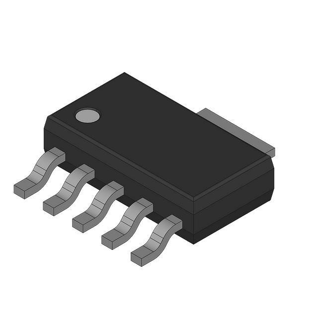

    TPS732 具有反向电流保护的无电容 NMOS 250mA 低压降稳压器
TPS73201DCQR 数据手册
Sample & Buy Product Folder Support & Community Tools & Software Technical Documents TPS732 SBVS037P – AUGUST 2003 – REVISED DECEMBER 2015 TPS732xx Capacitor-Free, NMOS, 250-mA Low-Dropout Regulator With Reverse Current Protection 1 Features 3 Description • The TPS732 family of low-dropout (LDO) voltage regulators uses an NMOS pass element in a voltagefollower configuration. This topology is stable using output capacitors with low equivalent series resistance (ESR), and even allows operation without a capacitor. The device also provides high reverse blockage (low reverse current) and ground pin current that is nearly constant over all values of output current. 1 • • • • • • • • • • Stable with No Output Capacitor or Any Value or Type of Capacitor Input Voltage Range: 1.7 V to 5.5 V Ultralow Dropout Voltage: 40 mV Typical at 250 mA Excellent Load Transient Response—With or Without Optional Output Capacitor NMOS Topology Provides Low Reverse Leakage Current Low Noise: 30 μVRMS Typical (10 kHz to 100 kHz) 0.5% Initial Accuracy 1% Overall Accuracy (Line, Load, and Temperature) Less Than 1-μA Maximum IQ in Shutdown Mode Thermal Shutdown and Specified Min and Max Current Limit Protection Available in Multiple Output Voltage Versions – Fixed Outputs of 1.2 V to 5 V – Adjustable Outputs from 1.2 V to 5.5 V – Custom Outputs Available The TPS732 uses an advanced BiCMOS process to yield high precision while delivering very low dropout voltages and low ground pin current. Current consumption, when not enabled, is less than 1 μA and ideal for portable applications. The extremely low output noise (30 μVRMS with 0.1-μF CNR) is ideal for powering VCOs. These devices are protected by thermal shutdown and foldback current limit. Device Information(1) PART NUMBER TPS732xx BODY SIZE (NOM) 2.90 mm × 1.60 mm SOT-223 (6) 6.50 mm × 3.50 mm SON (8) 3.00 mm × 3.00 mm (1) For all available packages, see the orderable addendum at the end of the data sheet. 2 Applications • • • • PACKAGE SOT-23 (5) Portable and Battery-Powered Equipment Post-Regulation for Switching Supplies Noise-Sensitive Circuitry such as VCOs Point-of-Load Regulation for DSPs, FPGAs, ASICs, and Microprocessors Typical Application Circuit for Fixed-Voltage Versions Optional VIN Optional IN VOUT OUT TPS732xx EN GND NR ON OFF Optional 1 An IMPORTANT NOTICE at the end of this data sheet addresses availability, warranty, changes, use in safety-critical applications, intellectual property matters and other important disclaimers. PRODUCTION DATA. TPS732 SBVS037P – AUGUST 2003 – REVISED DECEMBER 2015 www.ti.com Table of Contents 1 2 3 4 5 6 7 Features .................................................................. Applications ........................................................... Description ............................................................. Revision History..................................................... Pin Configuration and Functions ......................... Specifications......................................................... 1 1 1 2 3 4 6.1 6.2 6.3 6.4 6.5 6.6 6.7 4 4 4 5 6 6 7 Absolute Maximum Ratings ...................................... ESD Ratings ............................................................ Recommended Operating Conditions....................... Thermal Information .................................................. Electrical Characteristics........................................... Switching Characteristics .......................................... Typical Characteristics .............................................. Detailed Description ............................................ 12 7.1 7.2 7.3 7.4 Overview ................................................................. Functional Block Diagrams ..................................... Feature Description................................................. Device Functional Modes........................................ 12 12 13 15 8 Application and Implementation ........................ 16 8.1 Application Information............................................ 16 8.2 Typical Applications ................................................ 16 9 Power Supply Recommendations...................... 19 10 Layout................................................................... 19 10.1 Layout Guidelines ................................................. 19 10.2 Layout Examples................................................... 19 10.3 Thermal Considerations ........................................ 20 11 Device and Documentation Support ................. 22 11.1 11.2 11.3 11.4 11.5 11.6 11.7 Device Support...................................................... Documentation Support ....................................... Related Links ........................................................ Community Resources.......................................... Trademarks ........................................................... Electrostatic Discharge Caution ............................ Glossary ................................................................ 22 22 22 23 23 23 23 12 Mechanical, Packaging, and Orderable Information ........................................................... 23 4 Revision History NOTE: Page numbers for previous revisions may differ from page numbers in the current version. Changes from Revision O (August 2010) to Revision P Page • Changed Features bullet about NMOS topology; deleted "new"............................................................................................ 1 • Added ESD Ratings table, Feature Description section, Device Functional Modes, Application and Implementation section, Power Supply Recommendations section, Layout section, Device and Documentation Support section, and Mechanical, Packaging, and Orderable Information section ................................................................................................. 1 • Changed first paragraph of Description section; deleted description of NMOS topology as "new" ....................................... 1 • Changed Pin Configuration and Functions section; updated table format ............................................................................ 3 • Changed "free-air temperature" to "junction temperature" in Absolute Maximum Ratings condition statement ................... 4 • Changed Thermal Information table; updated thermal resistance values for all packages .................................................. 5 Changes from Revision N (August, 2009) to Revision O • Page Replaced the Dissipation Ratings table with the Thermal Information table .......................................................................... 6 Changes from Revision M (May, 2008) to Revision N Page • Changed Figure 10 ................................................................................................................................................................ 7 • Added paragraph about recommended start-up sequence to Internal Current Limit section .............................................. 14 • Added paragraph about current foldback and device start-up to Enable Pin and Shutdown section .................................. 14 2 Submit Documentation Feedback Copyright © 2003–2015, Texas Instruments Incorporated Product Folder Links: TPS732 TPS732 www.ti.com SBVS037P – AUGUST 2003 – REVISED DECEMBER 2015 5 Pin Configuration and Functions DBV Package 5-Pin SOT-23 Top View IN 1 GND 2 EN 3 DCQ Package 6-Pin SOT-223 Top View 5 OUT 4 NR/FB TAB IS GND 6 1 IN 2 3 4 5 GND EN OUT NR/FB DRB Package 8-Pin SON With Exposed Thermal Pad Top View OUT 1 8 IN N/C 2 7 N/C NR/FB 3 6 N/C GND 4 5 EN Pin Functions PIN NAME NO. SOT-23 SOT-223 I/O DESCRIPTION SON IN 1 1 8 I GND 2 3, 6 4, Pad — Input supply EN 3 5 5 I NR 4 4 3 — FB 4 4 3 I Adjustable voltage version only—this pin is the input to the control loop error amplifier, and is used to set the output voltage of the device. OUT 5 2 1 O Output of the regulator. There are no output capacitor requirements for stability. Ground Driving the enable pin (EN) high turns on the regulator. Driving this pin low puts the regulator into shutdown mode. Refer to the Shutdown section under Feature Description for more details. EN can be connected to IN if not used. Fixed voltage versions only—connecting an external capacitor to this pin bypasses noise generated by the internal bandgap, reducing output noise to very low levels. Submit Documentation Feedback Copyright © 2003–2015, Texas Instruments Incorporated Product Folder Links: TPS732 3 TPS732 SBVS037P – AUGUST 2003 – REVISED DECEMBER 2015 www.ti.com 6 Specifications 6.1 Absolute Maximum Ratings over operating junction temperature range (unless otherwise noted) Voltage Peak output current (1) MIN MAX VIN –0.3 6 VEN –0.3 6 VOUT –0.3 5.5 VNR, VFB –0.3 6 IOUT Indefinite Continuous total power dissipation (1) V Internally limited Output short-circuit duration Temperature UNIT See Power Dissipation Junction range ,TJ –55 150 Storage range, Tstg –65 150 °C Stresses beyond those listed under Absolute Maximum Ratings may cause permanent damage to the device. These are stress ratings only, which do not imply functional operation of the device at these or any other conditions beyond those indicated under Recommended Operating Conditions. Exposure to absolute-maximum-rated conditions for extended periods may affect device reliability. 6.2 ESD Ratings VALUE V(ESD) (1) (2) Electrostatic discharge Human body model (HBM), per ANSI/ESDA/JEDEC JS-001, all pins (1) ±2000 Charged device model (CDM), per JEDEC specification JESD22-C101, all pins (2) ±500 UNIT V JEDEC document JEP155 states that 500-V HBM allows safe manufacturing with a standard ESD control process. JEDEC document JEP157 states that 250-V CDM allows safe manufacturing with a standard ESD control process. 6.3 Recommended Operating Conditions over operating junction temperature range (unless otherwise noted). MIN VIN Input supply voltage range IOUT Output current TJ Operating junction temperature 4 Submit Documentation Feedback NOM MAX UNIT 1.7 5.5 V 0 250 mA –40 125 °C Copyright © 2003–2015, Texas Instruments Incorporated Product Folder Links: TPS732 TPS732 www.ti.com SBVS037P – AUGUST 2003 – REVISED DECEMBER 2015 6.4 Thermal Information TPS732 (3) THERMAL METRIC (1) (2) DRB [SON] DCQ [SOT223] DBV [SOT23] 8 PINS 6 PINS 5 PINS 205.9 RθJA Junction-to-ambient thermal resistance 58.3 53.1 RθJC(top) Junction-to-case (top) thermal resistance 93.8 35.2 119 RθJB Junction-to-board thermal resistance 72.8 7.8 35.4 ψJT Junction-to-top characterization parameter 2.7 2.9 12.7 ψJB Junction-to-board characterization parameter 25 7.7 34.5 RθJC(bot) Junction-to-case (bottom) thermal resistance 5 N/A N/A (1) (2) (3) UNIT °C/W For more information about traditional and new thermal metrics, see the IC Package Thermal Metrics application report, SPRA953. For thermal estimates of this device based on PCB copper area, see the TI PCB Thermal Calculator. Thermal data for the DRB, DCQ, and DRV packages are derived by thermal simulations based on JEDEC-standard methodology as specified in the JESD51 series. The following assumptions are used in the simulations: (a) i. DRB: The exposed pad is connected to the PCB ground layer through a 2 × 2 thermal via array. . ii. DCQ: The exposed pad is connected to the PCB ground layer through a 3 × 2 thermal via array. . iii. DBV: There is no exposed pad with the DBV package. (b) i. DRB: The top and bottom copper layers are assumed to have a 20% thermal conductivity of copper representing a 20% copper coverage. . ii. DCQ: Each of top and bottom copper layers has a dedicated pattern for 20% copper coverage. . iii. DBV: The top and bottom copper layers are assumed to have a 20% thermal conductivity of copper representing a 20% copper coverage. (c) These data were generated with only a single device at the center of a JEDEC high-K (2s2p) board with 3-inch × 3-inch copper area. To understand the effects of the copper area on thermal performance, see the Power Dissipation section of this data sheet. Submit Documentation Feedback Copyright © 2003–2015, Texas Instruments Incorporated Product Folder Links: TPS732 5 TPS732 SBVS037P – AUGUST 2003 – REVISED DECEMBER 2015 www.ti.com 6.5 Electrical Characteristics Over operating temperature range (TJ = –40°C to 125°C), VIN = VOUT(nom) + 0.5 V (1), IOUT = 10 mA, VEN = 1.7 V, and COUT = 0.1 μF, unless otherwise noted. Typical values are at TJ = 25°C. PARAMETER TEST CONDITIONS VIN Input voltage range (1) VFB Internal reference (TPS73201) MIN TJ = 25°C 1.198 Accuracy (1) (3) ΔVOUT(ΔVIN) Line regulation Nominal TJ = 25°C VIN, IOUT, and T VOUT + 0.5 V ≤ VIN ≤ 5.5 V; 10 mA ≤ IOUT ≤ 250 mA (1) UNIT 5.5 V 1.21 V 5.5 – VDO V –0.5% 0.5% –1% 1.2 MAX VFB Output voltage range (TPS73201) (2) VOUT TYP 1.7 ±0.5% VOUT(nom) + 0.5 V ≤ VIN ≤ 5.5 V 1% 0.01 %/V 1 mA ≤ IOUT ≤ 250 mA 0.002 %/mA 10 mA ≤ IOUT ≤ 250 mA 0.0005 %/mA ΔVOUT(ΔIOUT) Load regulation VDO Dropout voltage (4) (VIN = VOUT (nom) – 0.1 V) IOUT = 250 mA ZO(do) Output impedance in dropout 1.7 V ≤ VIN ≤ VOUT + VDO ICL Output current limit VOUT = 0.9 × VOUT(nom) ISC Short-circuit current VOUT = 0 V 300 IREV Reverse leakage current (5) (–IIN) VEN ≤ 0.5 V, 0 V ≤ VIN ≤ VOUT 0.1 10 IGND GND pin current IOUT = 10 mA (IQ) 400 550 IOUT = 250 mA 650 950 ISHDN Shutdown current (IGND) VEN ≤ 0.5 V, VOUT ≤ VIN ≤ 5.5, –40°C ≤ TJ ≤ 100°C 0.02 1 µA IFB FB pin current (TPS73201) 0.1 0.3 μA 40 250 425 58 PSRR Power-supply rejection ratio (ripple rejection) f = 10 kHz, IOUT = 250 mA 37 Vn Output noise voltage BW = 10Hz – 100kHz COUT = 10 μF, No CNR 27 × VOUT COUT = 10 μF, CNR = 0.01 μF 8.5 × VOUT VEN(high) EN pin high (enabled) VEN(low) EN pin low (shutdown) IEN(high) EN pin current (enabled) TSD Thermal shutdown temperature TJ Operating junction temperature 1.7 600 0 0.02 Shutdown Temp increasing 160 Reset Temp decreasing 140 –40 mA mA μA μA dB μVRMS VIN VEN = 5.5 V mV Ω 0.25 f = 100 Hz, IOUT = 250 mA (1) (2) (3) (4) (5) 150 V 0.5 V 0.1 μA °C 125 °C Minimum VIN = VOUT + VDO or 1.7 V, whichever is greater. TPS73201 is tested at VOUT = 2.5 V. Tolerance of external resistors not included in this specification. VDO is not measured for fixed output versions with VOUT(nom) < 1.8 V because minimum VIN = 1.7 V. Fixed-voltage versions only; refer to Application Information section for more information. 6.6 Switching Characteristics over operating free-air temperature range (unless otherwise noted) PARAMETER tSTR 6 Start-up time TEST CONDITIONS VOUT = 3 V, RL = 30 Ω COUT = 1 μF, CNR = 0.01 μF Submit Documentation Feedback MIN TYP 600 MAX UNIT μs Copyright © 2003–2015, Texas Instruments Incorporated Product Folder Links: TPS732 TPS732 www.ti.com SBVS037P – AUGUST 2003 – REVISED DECEMBER 2015 6.7 Typical Characteristics For all voltage versions at TJ = 25°C, VIN = VOUT(nom) + 0.5 V, IOUT = 10 mA, VEN = 1.7 V, and COUT = 0.1 μF, unless otherwise noted. 0.20 0.5 Referred to IOUT = 10 mA 0.4 0.2 0.1 0 -0.1 -0.2 Change in VOUT (%) -40 °C +25°C +125 °C 0.3 Change in VOUT (%) Referred to VIN = VOUT + 0.5 V at IOUT = 10 mA 0.15 0.10 +25 °C +125 °C 0.05 0 -0.05 -40 °C -0.10 -0.3 -0.15 -0.4 -0.20 -0.5 0 50 100 150 200 0 250 0.5 1.0 1.5 2.0 2.5 3.0 3.5 4.0 4.5 VIN - VOUT (V) IOUT (mA) Figure 1. Load Regulation Figure 2. Line Regulation 100 100 TPS73225DBV 80 80 TPS73225DBV IOUT = 250 mA VDO (mV) VDO (mV) +125 °C 60 +25 °C 40 60 40 20 20 -40 °C 0 -50 0 0 50 100 150 200 250 0 25 50 75 100 Temperature (°C) Figure 3. Dropout Voltage vs Output Current Figure 4. Dropout Voltage vs Temperature 30 18 IOUT = 10 mA 16 25 125 I OUT = 10 mA All Voltage Versions 14 Percent of Units (%) Percent of Units (%) -25 IOUT (mA) 20 15 10 12 10 8 6 4 5 2 0 -100 -90 -80 -70 -60 -50 -40 -30 -20 -10 0 10 20 30 40 50 60 70 80 90 100 -1.0 -0.9 -0.8 -0.7 -0.6 -0.5 -0.4 -0.3 -0.2 -0.1 0 0.1 0.2 0.3 0.4 0.5 0.6 0.7 0.8 0.9 1.0 0 VOUT Error (%) Worst Case dVOUT/dT (ppm/ °C) Figure 5. Output Voltage Accuracy Histogram Figure 6. Output Voltage Drift Histogram Submit Documentation Feedback Copyright © 2003–2015, Texas Instruments Incorporated Product Folder Links: TPS732 7 TPS732 SBVS037P – AUGUST 2003 – REVISED DECEMBER 2015 www.ti.com Typical Characteristics (continued) For all voltage versions at TJ = 25°C, VIN = VOUT(nom) + 0.5 V, IOUT = 10 mA, VEN = 1.7 V, and COUT = 0.1 μF, unless otherwise noted. 1000 800 900 700 800 600 700 600 I GND (mA) I GND (mA) IOUT = 250 mA 500 400 300 100 50 100 150 200 300 VIN = 5.5 V VIN = 4 V VIN = 2 V 100 0 0 400 200 VIN = 5.5 V VIN = 4 V VIN = 2 V 200 500 0 -50 250 -25 0 IOUT (mA) Figure 7. Ground Pin Current vs Output Current 50 75 100 125 Figure 8. Ground Pin Current vs Temperature 500 1 VENABLE = 0.5 V VIN = VOUT + 0.5 V 450 ICL 400 Output Current (mA) IGND (mA) 25 Temperature (°C) 0.1 350 300 ISC 250 200 150 100 50 0.01 -50 -25 0 25 50 75 100 TPS73233 0 -0.5 125 0 0.5 600 600 550 550 500 500 Current Limit (mA) Current Limit (mA) 1.5 2.0 2.5 3.0 3.5 Figure 10. Current Limit vs VOUT (Foldback) Figure 9. Ground Pin Current in Shutdown vs Temperature 450 400 350 300 450 400 350 300 250 1.5 2.0 2.5 3.0 3.5 4.0 4.5 5.0 5.5 250 -50 VIN (V) -25 0 25 50 75 100 125 Temperature (°C) Figure 11. Current Limit vs VIN 8 1.0 Output Voltage (V) Temperature (°C) Figure 12. Current Limit vs Temperature Submit Documentation Feedback Copyright © 2003–2015, Texas Instruments Incorporated Product Folder Links: TPS732 TPS732 www.ti.com SBVS037P – AUGUST 2003 – REVISED DECEMBER 2015 Typical Characteristics (continued) For all voltage versions at TJ = 25°C, VIN = VOUT(nom) + 0.5 V, IOUT = 10 mA, VEN = 1.7 V, and COUT = 0.1 μF, unless otherwise noted. 40 90 IOUT = 100 mA COUT = Any 70 IOUT = 1 mA COUT = 1 mF 35 30 IOUT = 1 mA COUT = 10mF 60 50 IO = 100 mA CO = 1mF IOUT = 1 mA C OUT = Any 40 PSRR (dB) Ripple Rejection (dB) 80 30 20 VIN = VOUT + 1 V 0 10 100 1k 10k 20 15 Frequency = 10 kHz COUT = 10 mF VOUT = 2.5 V IOUT = 100 mA 10 I OUT = 100 mA COUT = 10mF IOUT = Any COUT = 0mF 10 25 5 0 100k 1M 0 10M 0.2 0.4 0.6 0.8 1.0 1.2 1.4 1.6 1.8 2.0 VIN - VOUT (V) Frequency (Hz) Figure 14. PSRR (Ripple Rejection) vs (VIN – VOUT) Figure 13. PSRR (Ripple Rejection) vs Frequency 1 1 COUT = 0 mF 0.1 COUT = 10 mF eN (mV/√Hz) eN (mV/√Hz) C OUT = 1 mF COUT = 1mF 0.1 COUT = 0 mF COUT = 10mF IOUT = 150 mA 0.01 0.01 10 100 1k 10k 100k IOUT = 150 mA 10 100 1k 10k 100k Frequency (Hz) Frequency (Hz) Figure 15. Noise Spectral Density CNR = 0 µF Figure 16. Noise Spectral Density CNR = 0.01 µF 60 140 50 120 VOUT = 5.0 V VOUT = 5.0 V 100 30 VN (RMS) VN (RMS) 40 VOUT = 3.3 V 20 20 CNR = 0.01 mF 10 Hz < Frequency < 100 kHz 0.1 0 1 10 VOUT = 3.3 V 60 40 VOUT = 1.5 V 10 0 80 VOUT = 1.5 V COUT = 0 mF 10Hz < Frequency < 100 kHz 1p 10p 100p 1n COUT (mF) CNR (F) Figure 17. RMS Noise Voltage vs COUT Figure 18. RMS Noise Voltage vs CNR 10n Submit Documentation Feedback Copyright © 2003–2015, Texas Instruments Incorporated Product Folder Links: TPS732 9 TPS732 SBVS037P – AUGUST 2003 – REVISED DECEMBER 2015 www.ti.com Typical Characteristics (continued) For all voltage versions at TJ = 25°C, VIN = VOUT(nom) + 0.5 V, IOUT = 10 mA, VEN = 1.7 V, and COUT = 0.1 μF, unless otherwise noted. VIN = 3.8 V COUT = 0 mF IOUT = 250 mA 50 mV/tick VOUT COUT = 0 mF 50 mV/div VOUT COUT = 1 mF 50 mV/tick VOUT C OUT = 100mF COUT = 10 mF 50 mV/tick VOUT 50 mV/div VOUT dVIN 5.5 V 250 mA = 0.5 V/ms dt 50 mA/tick 4.5 V 1 V/div 10 mA VIN I OUT 10 ms/div 10 ms/div Figure 19. TPS73233 Load Transient Response RL = 1 kW COUT = 0 mF Figure 20. TPS73233 Line Transient Response RL = 20W COUT = 10mF VOUT R L = 20W 1 V/div C OUT = 1mF R L = 20W C OUT = 1mF 1 V/div RL = 1 kW COUT = 0 mF RL = 20W COUT = 10mF VOUT 2V 2V VEN 1 V/div 1 V/div 0V 0V VEN 100 ms/div 100 ms/div Figure 21. TPS73233 Turnon Response Figure 22. TPS73233 Turnoff Response 10 6 5 VIN 4 VOUT IENABLE (nA) Volts 3 2 1 1 0.1 0 -1 0.01 -50 -2 50 ms/div -25 0 25 50 75 100 125 Temperature (°C) . Figure 23. TPS73233 Power Up and Power Down 10 Submit Documentation Feedback Figure 24. IENABLE vs Temperature Copyright © 2003–2015, Texas Instruments Incorporated Product Folder Links: TPS732 TPS732 www.ti.com SBVS037P – AUGUST 2003 – REVISED DECEMBER 2015 Typical Characteristics (continued) 60 160 55 140 50 120 45 100 I FB (nA) VN (rms) For all voltage versions at TJ = 25°C, VIN = VOUT(nom) + 0.5 V, IOUT = 10 mA, VEN = 1.7 V, and COUT = 0.1 μF, unless otherwise noted. 40 60 35 30 25 80 VOUT = 2.5 V COUT = 0 mF R1 = 39.2 kW 10Hz < Frequency < 100 kHz 20 10p 100p 40 20 1n 10n 0 -50 -25 0 25 50 75 100 CFB (F) Temperature (°C) Figure 25. TPS73201 RMS Noise Voltage vs CFB Figure 26. TPS73201 IFB vs Temperature CFB = 10 nF R1 = 39.2 kW COUT = 0 mF 100 mV/div COUT = 0 mF VOUT 100 mV/div VOUT 100 mV/div VOUT = 2.5 V CFB = 10 nF VOUT COUT = 10 mF C OUT = 10 mF 100 mV/div 125 VOUT 4.5 V 3.5 V 250 mA VIN 10 mA IOUT 5 ms/div 10 ms/div Figure 27. TPS73201 Load Transient, Adjustable Version Figure 28. TPS73201 Line Transient, Adjustable Version Submit Documentation Feedback Copyright © 2003–2015, Texas Instruments Incorporated Product Folder Links: TPS732 11 TPS732 SBVS037P – AUGUST 2003 – REVISED DECEMBER 2015 www.ti.com 7 Detailed Description 7.1 Overview The TPS732 family of low-dropout linear regulators operates down to an input voltage of 1.7 V and supports output voltages down to 1.2 V while sourcing up to 500 mA of load current. This linear regulator uses an NMOS pass element with an integrated 4-MHz charge pump to provide a dropout voltage of less than 250 mV at full load current. This unique architecture also permits stable regulation over a wide range of output capacitors. In fact, the TPS732 family of devices does not require any output capacitor for stability. The increased insensitivity to the output capacitor value and type makes this family of linear regulators an ideal choice when powering a load where the effective capacitance is unknown. The TPS732 family of devices also features a noise reduction (NR) pin that allows for additional reduction of the output noise. With a noise reduction capacitor of 0.01 µF connected from the NR pin to GND, the TPS73215 output noise can be as low as 12.75 µVRMS. The low noise output featured by the TPS732 family makes the device well-suited for powering VCOs or any other noise-sensitive load. 7.2 Functional Block Diagrams IN 4MHz Charge Pump EN Thermal Protection Ref Servo 27kW Bandgap Error Amp Current Limit OUT 8kW GND R1 R1 + R2 = 80kW R2 NR Figure 29. Fixed-Voltage Version 12 Submit Documentation Feedback Copyright © 2003–2015, Texas Instruments Incorporated Product Folder Links: TPS732 TPS732 www.ti.com SBVS037P – AUGUST 2003 – REVISED DECEMBER 2015 Functional Block Diagrams (continued) IN Table 1. Standard 1% Resistor Values for Common Output Voltages 4MHz Charge Pump EN Thermal Protection Ref Servo 27kW Bandgap Error Amp GND 80kW 8kW R1 R2 1.2V Short Open 1.5V 23.2kW 95.3kW 1.8V 28.0kW 56.2kW 2.5V 39.2kW 36.5kW 2.8V 44.2kW 33.2kW 3.0V 46.4kW 30.9kW 3.3V 52.3kW 30.1kW NOTE: VOUT = (R1 + R2)/R2 ´ 1.204; R1úú R2 @ 19kW for best accuracy. OUT Current Limit VO R1 FB R2 Figure 30. Adjustable-Voltage Version 7.3 Feature Description 7.3.1 Output Noise A precision band-gap reference is used to generate the internal reference voltage, VREF. This reference is dominant noise source within the TPS732 and it generates approximately 32 µVRMS (10 Hz to 100 kHz) at reference output (NR). The regulator control loop gains up the reference noise with the same gain as reference voltage, so that the noise voltage of the regulator is approximately given by: æ R + R2 ö VOUT VN = 32mVRMS ´ ç 1 ÷÷ = 32mVRMS ´ ç R VREF 2 è ø Because the value of VREF is 1.2 V, this relationship reduces to: æ mV ö VN (mVRMS ) = 27 ç RMS ÷ ´ VOUT (V) è V ø the the the (1) (2) An internal 27-kΩ resistor in series with the noise reduction pin (NR) forms a low-pass filter for the voltage reference when an external noise reduction capacitor, CNR, is connected from NR to ground. For CNR = 10 nF, the total noise in the 10-Hz to 100-kHz bandwidth is reduced by a factor of approximately 3.2, giving the approximate relationship: æ mV ö VN (mVRMS ) = 8.5 ç RMS ÷ ´ VOUT (V) è V ø (3) for CNR = 10 nF. Submit Documentation Feedback Copyright © 2003–2015, Texas Instruments Incorporated Product Folder Links: TPS732 13 TPS732 SBVS037P – AUGUST 2003 – REVISED DECEMBER 2015 www.ti.com Feature Description (continued) This noise reduction effect is shown as RMS Noise Voltage vs CNR (Figure 18) in the Typical Characteristics section. The TPS73201 adjustable version does not have the NR pin available. However, connecting a feedback capacitor, CFB, from the output to the feedback pin (FB) reduces output noise and improve load transient performance. The TPS732 uses an internal charge pump to develop an internal supply voltage sufficient to drive the gate of the NMOS pass element above VOUT. The charge pump generates approximately 250 μV of switching noise at approximately 4 MHz; however, charge-pump noise contribution is negligible at the output of the regulator for most values of IOUT and COUT. 7.3.2 Internal Current Limit The TPS732 internal current limit helps protect the regulator during fault conditions. Foldback current limit helps to protect the regulator from damage during output short-circuit conditions by reducing current limit when VOUT drops below 0.5 V. See Figure 10 in the Typical Characteristics section for a graph of IOUT vs VOUT. Note from Figure 10 that approximately –0.2 V of VOUT results in a current limit of 0 mA. Therefore, if OUT is forced below –0.2 V before EN goes high, the device may not start up. In applications that work with both a positive and negative voltage supply, the TPS732 should be enabled first. 7.3.3 Enable Pin and Shutdown The enable pin (EN) is active high and is compatible with standard TTL-CMOS levels. A VEN below 0.5 V (maximum) turns the regulator off and drops the GND pin current to approximately 10 nA. When EN is used to shut down the regulator, all charge is removed from the pass transistor gate, and the output ramps back up to a regulated VOUT (see Figure 21). When shutdown capability is not required, EN can be connected to VIN. However, the pass gate may not be discharged using this configuration, and the pass transistor may be left on (enhanced) for a significant time after VIN has been removed. This scenario can result in reverse current flow (if the IN pin is low impedance) and faster ramp times upon power up. In addition, for VIN ramp times slower than a few milliseconds, the output may overshoot upon power up. Note that current limit foldback can prevent device start-up under some conditions. See the Internal Current Limit section. 7.3.4 Dropout Voltage The TPS732 uses an NMOS pass transistor to achieve extremely low dropout. When (VIN – VOUT) is less than the dropout voltage (VDO), the NMOS pass device is in its linear region of operation and the input-to-output resistance is the RDS(on) of the NMOS pass element. For large step changes in load current, the TPS732 requires a larger voltage drop from VIN to VOUT to avoid degraded transient response. The boundary of this transient dropout region is approximately twice the DC dropout. Values of (VIN – VOUT) above this line ensure normal transient response. Operating in the transient dropout region can cause an increase in recovery time. The time required to recover from a load transient is a function of the magnitude of the change in load current rate, the rate of change in load current, and the available headroom (VIN to VOUT voltage drop). Under worst-case conditions [full-scale instantaneous load change with (VIN – VOUT) close to DC dropout levels], the TPS732 can take a couple of hundred microseconds to return to the specified regulation accuracy. 14 Submit Documentation Feedback Copyright © 2003–2015, Texas Instruments Incorporated Product Folder Links: TPS732 TPS732 www.ti.com SBVS037P – AUGUST 2003 – REVISED DECEMBER 2015 Feature Description (continued) 7.3.5 Reverse Current The NMOS pass element of the TPS732 provides inherent protection against current flow from the output of the regulator to the input when the gate of the pass device is pulled low. To ensure that all charge is removed from the gate of the pass element, the EN pin must be driven low before the input voltage is removed. If this is not done, the pass element may be left on due to stored charge on the gate. After the EN pin is driven low, no bias voltage is needed on any pin for reverse current blocking. Reverse current is specified as the current flowing out of the IN pin due to voltage applied on the OUT pin. Additional current will flow into the OUT pin due to the 80-kΩ internal resistor divider to ground (see Figure 29 and Figure 30). For the TPS73201, reverse current may flow when VFB is more than 1 V above VIN. 7.4 Device Functional Modes 7.4.1 Normal Operation With 1.7 V ≤ VIN ≤ 5.5 V and VEN ≥ 1.7 V The TPS732 family requires an input voltage of at least 1.7 V to function properly and attempt to maintain regulation. When operating the device near 5.5 V, take care to suppress any transient spikes that may exceed the 6-V absolute maximum voltage rating. The device should never operate at a DC voltage greater than 5.5 V. Submit Documentation Feedback Copyright © 2003–2015, Texas Instruments Incorporated Product Folder Links: TPS732 15 TPS732 SBVS037P – AUGUST 2003 – REVISED DECEMBER 2015 www.ti.com 8 Application and Implementation NOTE Information in the following applications sections is not part of the TI component specification, and TI does not warrant its accuracy or completeness. TI’s customers are responsible for determining suitability of components for their purposes. Customers should validate and test their design implementation to confirm system functionality. 8.1 Application Information The TPS732 device belongs to a family of LDO regulators that use an NMOS pass transistor to achieve ultralow-dropout performance, reverse current blockage, and freedom from output capacitor constraints. These features, combined with low noise and an enable input, make the TPS732 ideal for portable applications. This regulator family offers a wide selection of fixed-output voltage versions and an adjustable-output version. All versions have thermal and overcurrent protection, including foldback current limit. 8.2 Typical Applications Figure 31 shows the basic circuit connections for the fixed-voltage models. Figure 32 gives the connections for the adjustable-voltage version (TPS73201). Optional input capacitor. May improve source impedance, noise, or PSRR. VIN Optional output capacitor. May improve load transient, noise, or PSRR. IN VOUT OUT TPS732xx EN GND NR ON OFF Optional bypass capacitor to reduce output noise. Figure 31. Typical Application Circuit for Fixed-Voltage Versions Optional input capacitor. May improve source impedance, noise, or PSRR. VIN IN Optional output capacitor. May improve load transient, noise, or PSRR. TPS73201 EN OFF VOUT OUT GND R1 CFB FB ON R2 VOUT = (R1 + R2) R2 x 1.204 Optional capacitor reduces output noise and improves transient response. Figure 32. Typical Application Circuit for Adjustable-Voltage Version 16 Submit Documentation Feedback Copyright © 2003–2015, Texas Instruments Incorporated Product Folder Links: TPS732 TPS732 www.ti.com SBVS037P – AUGUST 2003 – REVISED DECEMBER 2015 Typical Applications (continued) 8.2.1 Design Requirements For best accuracy, make the parallel combination of R1 and R2 approximately equal to 19 kΩ. This 19 kΩ, in addition to the internal 8-kΩ resistor, presents the same impedance to the error amp as the 27-kΩ bandgap reference output. This impedance helps compensate for leakages into the error amp terminals. 8.2.2 Detailed Design Procedure 8.2.2.1 Input and Output Capacitor Requirements Although an input capacitor is not required for stability, it is good analog design practice to connect a 0.1-μF to 1-μF, low ESR capacitor across the input supply near the regulator. This capacitor counteracts reactive input sources and improves transient response, noise rejection, and ripple rejection. A higher-value capacitor may be necessary if large, fast rise-time load transients are anticipated or the device is located several inches from the power source. The TPS732 does not require an output capacitor for stability and has maximum phase margin with no capacitor. It is designed to be stable for all available types and values of capacitors. In applications where multiple low ESR capacitors are in parallel, ringing may occur when the product of COUT and total ESR drops below 50 nΩF. Total ESR includes all parasitic resistances, including capacitor ESR and board, socket, and solder joint resistance. In most applications, the sum of capacitor ESR and trace resistance meets this requirement. 8.2.2.2 Transient Response The low open-loop output impedance provided by the NMOS pass element in a voltage follower configuration allows operation without an output capacitor for many applications. As with any regulator, the addition of a capacitor (nominal value 1 μF) from the OUT pin to ground reduces undershoot magnitude but increases its duration. In the adjustable version, the addition of a capacitor, CFB, from the OUT pin to the FB pin also improves the transient response. The TPS732 does not have active pulldown when the output is overvoltage. This feature allows applications that connect higher voltage sources, such as alternate power supplies, to the output. This feature also results in an output overshoot of several percent if the load current quickly drops to zero when a capacitor is connected to the output. The duration of overshoot can be reduced by adding a load resistor. The overshoot decays at a rate determined by output capacitor COUT and the internal/external load resistance. The rate of decay is given by: (Fixed voltage versions) VOUT dV / dt = COUT ´ 80kW P RLOAD (4) (Adjustable voltage version) VOUT dV / dt = COUT ´ 80kW P (R1 + R2 ) P RLOAD (5) Submit Documentation Feedback Copyright © 2003–2015, Texas Instruments Incorporated Product Folder Links: TPS732 17 TPS732 SBVS037P – AUGUST 2003 – REVISED DECEMBER 2015 www.ti.com Typical Applications (continued) 8.2.3 Application Curves RL = 1 kW COUT = 0 mF VOUT VIN = 3.8 V COUT = 0 mF 50 mV/tick VOUT R L = 20W 1 V/div C OUT = 1mF COUT = 1 mF 50 mV/tick RL = 20W COUT = 10mF 2V VEN VOUT COUT = 10 mF 50 mV/tick VOUT 1 V/div 250 mA 0V 50 mA/tick 10 mA 100 ms/div I OUT 10 ms/div Figure 33. TPS73233 Turnon Response Figure 34. TPS73233 Load Transient Response 60 CFB = 10 nF R1 = 39.2 kW 55 COUT = 0 mF 100 mV/div VN (rms) 50 VOUT 45 C OUT = 10 mF VOUT 100 mV/div 40 35 30 25 VOUT = 2.5 V COUT = 0 mF R1 = 39.2 kW 10Hz < Frequency < 100 kHz 20 10p 100p 250 mA 10 mA 1n 10n IOUT 10 ms/div CFB (F) Figure 35. TPS73201 RMS Noise Voltage vs CFB 18 Figure 36. TPS73201 Load Transient, Adjustable Version Submit Documentation Feedback Copyright © 2003–2015, Texas Instruments Incorporated Product Folder Links: TPS732 TPS732 www.ti.com SBVS037P – AUGUST 2003 – REVISED DECEMBER 2015 9 Power Supply Recommendations These devices are designed to operate from an input voltage supply range between 1.7 V and 5.5 V. The input voltage range provides adequate headroom in order for the device to have a regulated output. This input supply must be well regulated. If the input supply is noisy, additional input capacitors with low ESR can help improve the output noise performance. 10 Layout 10.1 Layout Guidelines To improve AC performance such as PSRR, output noise, and transient response, TI recommends designing the PCB with separate ground planes for VIN and VOUT, with each ground plane connected only at the GND pin of the device. In addition, the ground connection for the bypass capacitor should connect directly to the GND pin of the device. Solder pad footprint recommendations for the TPS732 are presented in Application Bulletin Solder Pad Recommendations for Surface-Mount Devices (SBFA015), available from the TI website at www.ti.com. 10.2 Layout Examples GND PLANE COUT VIN TPS736xxDRB VOUT CNR 1 8 N/C 2 7 N/C NR/FB 3 6 N/C 4 5 EN CIN GND PLANE Figure 37. Fixed Output Voltage Option Layout (DRB Package) Submit Documentation Feedback Copyright © 2003–2015, Texas Instruments Incorporated Product Folder Links: TPS732 19 TPS732 SBVS037P – AUGUST 2003 – REVISED DECEMBER 2015 www.ti.com Layout Examples (continued) GND PLANE COUT VOUT VIN TPS73601DRB CFF R1 N/C NR/FB R2 1 8 2 7 N/C 3 6 N/C 4 5 EN CIN GND PLANE Figure 38. Adjustable Output Voltage Option Layout (DRB Package) 10.3 Thermal Considerations Thermal protection disables the output when the junction temperature rises to approximately 160°C, allowing the device to cool. When the junction temperature cools to approximately 140°C, the output circuitry is again enabled. Depending on power dissipation, thermal resistance, and ambient temperature, the thermal protection circuit may cycle on and off. This limits the dissipation of the regulator, protecting it from damage due to overheating. Any tendency to activate the thermal protection circuit indicates excessive power dissipation or an inadequate heatsink. For reliable operation, junction temperature should be limited to 125°C maximum. To estimate the margin of safety in a complete design (including heatsink), increase the ambient temperature until the thermal protection is triggered; use worst-case loads and signal conditions. For good reliability, thermal protection should trigger at least 35°C above the maximum expected ambient condition of your application. This produces a worstcase junction temperature of 125°C at the highest expected ambient temperature and worst-case load. The internal protection circuitry of the TPS732 has been designed to protect against overload conditions. It was not intended to replace proper heatsinking. Continuously running the TPS732 into thermal shutdown will degrade device reliability. 20 Submit Documentation Feedback Copyright © 2003–2015, Texas Instruments Incorporated Product Folder Links: TPS732 TPS732 www.ti.com SBVS037P – AUGUST 2003 – REVISED DECEMBER 2015 Thermal Considerations (continued) 10.3.1 Power Dissipation The ability to remove heat from the die is different for each package type, presenting different considerations in the PCB layout. The PCB area around the device that is free of other components moves the heat from the device to the ambient air. Performance data for JEDEC low- and high-K boards are shown in the Thermal Information table. Using heavier copper increases the effectiveness in removing heat from the device. The addition of plated through-holes to heat-dissipating layers also improves the heat-sink effectiveness. Power dissipation depends on input voltage and load conditions. Power dissipation (PD) is equal to the product of the output current times the voltage drop across the output pass element (VIN to VOUT): PD = (VIN - VOUT ) ´ IOUT (6) Power dissipation can be minimized by using the lowest possible input voltage necessary to assure the required output voltage. Submit Documentation Feedback Copyright © 2003–2015, Texas Instruments Incorporated Product Folder Links: TPS732 21 TPS732 SBVS037P – AUGUST 2003 – REVISED DECEMBER 2015 www.ti.com 11 Device and Documentation Support 11.1 Device Support 11.1.1 Development Support 11.1.1.1 Evaluation Modules An evaluation module (EVM) is available to assist in the initial circuit performance evaluation using the TPS732. The TPS73201DRBEVM-518 evaluation module (and related user guide) can be requested at the Texas Instruments website through the product folders or purchased directly from the TI eStore. 11.1.1.2 Spice Models Computer simulation of circuit performance using SPICE is often useful when analyzing the performance of analog circuits and systems. A SPICE model for the TPS732 is available through the product folders under Simulation Models. 11.1.2 Device Nomenclature Table 1. Device Nomenclature (1) PRODUCT VOUT TPS732xx yyy z (1) XX is the nominal output voltage (for example, 25 = 2.5 V; 01 = Adjustable). YYY is the package designator. Z is the tape and reel quantity (R = 3000, T = 250). For the most current package and ordering information see the Package Option Addendum at the end of this document, or see the TI website at www.ti.com. 11.2 Documentation Support 11.2.1 Related Documentation • Regulating VOUT Below 1.2 V Using an External Reference, SLVA216 • Solder Pad Recommendations for Surface-Mount Devices, SBFA019 • TPS73x01DRBEVM-518 User's Guide, SBVU014 11.3 Related Links The table below lists quick access links. Categories include technical documents, support and community resources, tools and software, and quick access to sample or buy. Table 2. Related Links 22 PARTS PRODUCT FOLDER SAMPLE & BUY TECHNICAL DOCUMENTS TOOLS & SOFTWARE SUPPORT & COMMUNITY TPS73201 Click here Click here Click here Click here Click here TPS73213 Click here Click here Click here Click here Click here TPS73215 Click here Click here Click here Click here Click here TPS73216 Click here Click here Click here Click here Click here TPS73218 Click here Click here Click here Click here Click here TPS73219 Click here Click here Click here Click here Click here TPS73225 Click here Click here Click here Click here Click here TPS73230 Click here Click here Click here Click here Click here TPS73233 Click here Click here Click here Click here Click here TPS73250 Click here Click here Click here Click here Click here Submit Documentation Feedback Copyright © 2003–2015, Texas Instruments Incorporated Product Folder Links: TPS732 TPS732 www.ti.com SBVS037P – AUGUST 2003 – REVISED DECEMBER 2015 11.4 Community Resources The following links connect to TI community resources. Linked contents are provided "AS IS" by the respective contributors. They do not constitute TI specifications and do not necessarily reflect TI's views; see TI's Terms of Use. TI E2E™ Online Community TI's Engineer-to-Engineer (E2E) Community. Created to foster collaboration among engineers. At e2e.ti.com, you can ask questions, share knowledge, explore ideas and help solve problems with fellow engineers. Design Support TI's Design Support Quickly find helpful E2E forums along with design support tools and contact information for technical support. 11.5 Trademarks E2E is a trademark of Texas Instruments. All other trademarks are the property of their respective owners. 11.6 Electrostatic Discharge Caution These devices have limited built-in ESD protection. The leads should be shorted together or the device placed in conductive foam during storage or handling to prevent electrostatic damage to the MOS gates. 11.7 Glossary SLYZ022 — TI Glossary. This glossary lists and explains terms, acronyms, and definitions. 12 Mechanical, Packaging, and Orderable Information The following pages include mechanical, packaging, and orderable information. This information is the most current data available for the designated devices. This data is subject to change without notice and revision of this document. For browser-based versions of this data sheet, refer to the left-hand navigation. Submit Documentation Feedback Copyright © 2003–2015, Texas Instruments Incorporated Product Folder Links: TPS732 23 PACKAGE OPTION ADDENDUM www.ti.com 10-Dec-2022 PACKAGING INFORMATION Orderable Device Status (1) Package Type Package Pins Package Drawing Qty Eco Plan (2) Lead finish/ Ball material MSL Peak Temp Op Temp (°C) Device Marking (3) Samples (4/5) (6) TPS73201DBVR ACTIVE SOT-23 DBV 5 3000 RoHS & Green NIPDAU Level-1-260C-UNLIM -40 to 125 PJEQ Samples TPS73201DBVRG4 ACTIVE SOT-23 DBV 5 3000 RoHS & Green NIPDAU Level-1-260C-UNLIM -40 to 125 PJEQ Samples TPS73201DBVT ACTIVE SOT-23 DBV 5 250 RoHS & Green NIPDAU Level-1-260C-UNLIM -40 to 125 PJEQ Samples TPS73201DBVTG4 ACTIVE SOT-23 DBV 5 250 RoHS & Green NIPDAU Level-1-260C-UNLIM -40 to 125 PJEQ Samples TPS73201DCQ ACTIVE SOT-223 DCQ 6 78 RoHS & Green NIPDAU Level-2-260C-1 YEAR -40 to 125 PS73201 Samples TPS73201DCQR ACTIVE SOT-223 DCQ 6 2500 RoHS & Green SN Level-2-260C-1 YEAR -40 to 125 PS73201 Samples TPS73201DRBR ACTIVE SON DRB 8 3000 RoHS & Green NIPDAU | NIPDAUAG Level-2-260C-1 YEAR -40 to 125 PJEQ Samples TPS73201DRBRG4 ACTIVE SON DRB 8 3000 RoHS & Green Level-2-260C-1 YEAR -40 to 125 PJEQ Samples TPS73201DRBT ACTIVE SON DRB 8 250 RoHS & Green NIPDAU | NIPDAUAG Level-2-260C-1 YEAR -40 to 125 PJEQ Samples TPS73201DRBTG4 ACTIVE SON DRB 8 250 RoHS & Green NIPDAU Level-2-260C-1 YEAR -40 to 125 PJEQ Samples TPS73213DBVR ACTIVE SOT-23 DBV 5 3000 RoHS & Green NIPDAU Level-1-260C-UNLIM -40 to 125 BWD Samples TPS73213DBVT LIFEBUY SOT-23 DBV 5 250 RoHS & Green NIPDAU Level-1-260C-UNLIM -40 to 125 BWD TPS73215DBVR LIFEBUY SOT-23 DBV 5 3000 RoHS & Green NIPDAU Level-1-260C-UNLIM -40 to 125 T38 TPS73215DBVT LIFEBUY SOT-23 DBV 5 250 RoHS & Green NIPDAU Level-1-260C-UNLIM -40 to 125 T38 TPS73215DCQ ACTIVE SOT-223 DCQ 6 78 RoHS & Green NIPDAU Level-2-260C-1 YEAR -40 to 125 PS73215 Samples TPS73215DCQR ACTIVE SOT-223 DCQ 6 2500 RoHS & Green NIPDAU Level-2-260C-1 YEAR -40 to 125 PS73215 Samples TPS73216DBVT ACTIVE SOT-23 DBV 5 250 RoHS & Green NIPDAU Level-2-260C-1 YEAR -40 to 125 T50 Samples TPS73216DBVTG4 ACTIVE SOT-23 DBV 5 250 RoHS & Green NIPDAU Level-2-260C-1 YEAR -40 to 125 T50 Samples TPS73218DBVR ACTIVE SOT-23 DBV 5 3000 RoHS & Green NIPDAU Level-1-260C-UNLIM -40 to 125 T37 Samples TPS73218DBVRG4 ACTIVE SOT-23 DBV 5 3000 RoHS & Green NIPDAU Level-1-260C-UNLIM -40 to 125 T37 Samples TPS73218DBVT ACTIVE SOT-23 DBV 5 250 RoHS & Green NIPDAU Level-1-260C-UNLIM -40 to 125 T37 Samples Addendum-Page 1 NIPDAU PACKAGE OPTION ADDENDUM www.ti.com Orderable Device 10-Dec-2022 Status (1) Package Type Package Pins Package Drawing Qty Eco Plan (2) Lead finish/ Ball material MSL Peak Temp Op Temp (°C) Device Marking (3) Samples (4/5) (6) TPS73218DCQ ACTIVE SOT-223 DCQ 6 78 RoHS & Green NIPDAU Level-2-260C-1 YEAR -40 to 125 PS73218 Samples TPS73218DCQR ACTIVE SOT-223 DCQ 6 2500 RoHS & Green SN Level-2-260C-1 YEAR -40 to 125 PS73218 Samples TPS73219DBVR ACTIVE SOT-23 DBV 5 3000 RoHS & Green NIPDAU Level-1-260C-UNLIM -40 to 125 CGE Samples TPS73219DBVT ACTIVE SOT-23 DBV 5 250 RoHS & Green NIPDAU Level-1-260C-UNLIM -40 to 125 CGE Samples TPS73225DBVR ACTIVE SOT-23 DBV 5 3000 RoHS & Green NIPDAU Level-1-260C-UNLIM -40 to 125 T36 Samples TPS73225DBVT ACTIVE SOT-23 DBV 5 250 RoHS & Green NIPDAU Level-1-260C-UNLIM -40 to 125 T36 Samples TPS73225DBVTG4 ACTIVE SOT-23 DBV 5 250 RoHS & Green NIPDAU Level-1-260C-UNLIM -40 to 125 T36 Samples TPS73225DCQ ACTIVE SOT-223 DCQ 6 78 RoHS & Green NIPDAU Level-2-260C-1 YEAR -40 to 125 PS73225 Samples TPS73225DCQR ACTIVE SOT-223 DCQ 6 2500 RoHS & Green NIPDAU Level-2-260C-1 YEAR -40 to 125 PS73225 Samples TPS73230DBVR ACTIVE SOT-23 DBV 5 3000 RoHS & Green NIPDAU Level-1-260C-UNLIM -40 to 125 T39 Samples TPS73230DBVT ACTIVE SOT-23 DBV 5 250 RoHS & Green NIPDAU Level-1-260C-UNLIM -40 to 125 T39 Samples TPS73230DCQR ACTIVE SOT-223 DCQ 6 2500 RoHS & Green NIPDAU Level-2-260C-1 YEAR -40 to 125 PS73230 Samples TPS73233DBVR ACTIVE SOT-23 DBV 5 3000 RoHS & Green NIPDAU Level-1-260C-UNLIM -40 to 125 T40 Samples TPS73233DBVT ACTIVE SOT-23 DBV 5 250 RoHS & Green NIPDAU Level-1-260C-UNLIM -40 to 125 T40 Samples TPS73233DCQ ACTIVE SOT-223 DCQ 6 78 RoHS & Green NIPDAU Level-2-260C-1 YEAR -40 to 125 PS73233 Samples TPS73233DCQR ACTIVE SOT-223 DCQ 6 2500 RoHS & Green SN Level-2-260C-1 YEAR -40 to 125 PS73233 Samples TPS73250DBVR ACTIVE SOT-23 DBV 5 3000 RoHS & Green NIPDAU Level-1-260C-UNLIM -40 to 125 T41 Samples TPS73250DBVT ACTIVE SOT-23 DBV 5 250 RoHS & Green NIPDAU Level-1-260C-UNLIM -40 to 125 T41 Samples TPS73250DCQ LIFEBUY SOT-223 DCQ 6 78 RoHS & Green NIPDAU Level-2-260C-1 YEAR -40 to 125 PS73250 TPS73250DCQR LIFEBUY SOT-223 DCQ 6 2500 RoHS & Green NIPDAU Level-2-260C-1 YEAR -40 to 125 PS73250 (1) The marketing status values are defined as follows: ACTIVE: Product device recommended for new designs. LIFEBUY: TI has announced that the device will be discontinued, and a lifetime-buy period is in effect. Addendum-Page 2 PACKAGE OPTION ADDENDUM www.ti.com 10-Dec-2022 NRND: Not recommended for new designs. Device is in production to support existing customers, but TI does not recommend using this part in a new design. PREVIEW: Device has been announced but is not in production. Samples may or may not be available. OBSOLETE: TI has discontinued the production of the device. (2) RoHS: TI defines "RoHS" to mean semiconductor products that are compliant with the current EU RoHS requirements for all 10 RoHS substances, including the requirement that RoHS substance do not exceed 0.1% by weight in homogeneous materials. Where designed to be soldered at high temperatures, "RoHS" products are suitable for use in specified lead-free processes. TI may reference these types of products as "Pb-Free". RoHS Exempt: TI defines "RoHS Exempt" to mean products that contain lead but are compliant with EU RoHS pursuant to a specific EU RoHS exemption. Green: TI defines "Green" to mean the content of Chlorine (Cl) and Bromine (Br) based flame retardants meet JS709B low halogen requirements of
