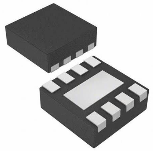

TPS73601DRBR
TPS73601DRBR
    BURR-BROWN(德州仪器)
    SON8_3X3MM_EP
    TPS736xx无帽,NMOS, 400毫安反向电流保护低压稳压器
TPS73601DRBR 数据手册
Sample & Buy Product Folder Support & Community Tools & Software Technical Documents TPS736 SBVS038U – SEPTEMBER 2003 – REVISED JANUARY 2015 TPS736xx Cap-Free, NMOS, 400-mA Low-Dropout Regulator with Reverse Current Protection 1 Features 3 Description • The TPS736xx family of low-dropout (LDO) linear voltage regulators uses a new topology: an NMOS pass element in a voltage-follower configuration. This topology is stable using output capacitors with low ESR, and even allows operation without a capacitor. It also provides high reverse blockage (low reverse current) and ground pin current that is nearly constant over all values of output current. 1 • • • • • • • • • • Stable with No Output Capacitor or Any Value or Type of Capacitor Input Voltage Range of 1.7 V to 5.5 V Ultra-Low Dropout Voltage: 75 mV typ Excellent Load Transient Response—with or without Optional Output Capacitor New NMOS Topology Delivers Low Reverse Leakage Current Low Noise: 30 μVRMS typ (10 Hz to 100 kHz) 0.5% Initial Accuracy 1% Overall Accuracy Over Line, Load, and Temperature Less Than 1 μA max IQ in Shutdown Mode Thermal Shutdown and Specified Min/Max Current Limit Protection Available in Multiple Output Voltage Versions – Fixed Outputs of 1.20 V to 5.0 V – Adjustable Output from 1.20 V to 5.5 V – Custom Outputs Available The TPS736xx uses an advanced BiCMOS process to yield high precision while delivering very low dropout voltages and low ground pin current. Current consumption, when not enabled, is under 1 μA and ideal for portable applications. The extremely low output noise (30 μVRMS with 0.1-μF CNR) is ideal for powering VCOs. These devices are protected by thermal shutdown and foldback current limit. Device Information(1) PART NUMBER TPS736xx BODY SIZE (NOM) SOT-23 (5) 2.90 mm x 1.60 mm SOT-223 (6) 6.50 mm x 3.50 mm VSON (8) 3.00 mm x 3.00 mm (1) For all available packages, see the orderable addendum at the end of the datasheet. 2 Applications • • • • PACKAGE Portable/Battery-Powered Equipment Post-Regulation for Switching Supplies Noise-Sensitive Circuitry such as VCOs Point of Load Regulation for DSPs, FPGAs, ASICs, and Microprocessors Typical Application Circuit for Fixed-Voltage Versions Optional VIN Optional IN VOUT OUT TPS736xx EN GND NR ON OFF Optional 1 An IMPORTANT NOTICE at the end of this data sheet addresses availability, warranty, changes, use in safety-critical applications, intellectual property matters and other important disclaimers. PRODUCTION DATA. TPS736 SBVS038U – SEPTEMBER 2003 – REVISED JANUARY 2015 www.ti.com Table of Contents 1 2 3 4 5 6 7 Features .................................................................. Applications ........................................................... Description ............................................................. Revision History..................................................... Pin Configuration and Functions ......................... Specifications......................................................... 1 1 1 2 3 4 6.1 6.2 6.3 6.4 6.5 6.6 4 4 4 5 6 7 Absolute Maximum Ratings ...................................... ESD Ratings ............................................................ Recommended Operating Conditions....................... Thermal Information .................................................. Electrical Characteristics........................................... Typical Characteristics .............................................. Detailed Description ............................................ 12 7.1 7.2 7.3 7.4 Overview ................................................................. Functional Block Diagram ....................................... Feature Description................................................. Device Functional Modes........................................ 12 12 13 14 8 Application and Implementation ........................ 15 8.1 Application Information............................................ 15 8.2 Typical Applications ................................................ 15 9 Power Supply Recommendations...................... 20 10 Layout................................................................... 20 10.1 10.2 10.3 10.4 10.5 Layout Guidelines ................................................. Layout Examples................................................... Power Dissipation ................................................. Thermal Protection................................................ Package Mounting ................................................ 20 20 21 22 22 11 Device and Documentation Support ................. 23 11.1 11.2 11.3 11.4 11.5 Device Support...................................................... Documentation Support ........................................ Trademarks ........................................................... Electrostatic Discharge Caution ............................ Glossary ................................................................ 23 23 23 23 23 12 Mechanical, Packaging, and Orderable Information ........................................................... 23 4 Revision History NOTE: Page numbers for previous revisions may differ from page numbers in the current version. Changes from Revision T (August 2010) to Revision U Page • Added ESD Ratings table, Feature Description section, Device Functional Modes, Application and Implementation section, Power Supply Recommendations section, Layout section, Device and Documentation Support section, and Mechanical, Packaging, and Orderable Information section ................................................................................................. 1 • Changed "free-air temperature" to "junction temperature" in Absolute Maximum Ratings condition statement ................... 4 • Changed "free-air temperature" to "junction temperature" in Recommended Operating Conditions condition statement ............................................................................................................................................................................... 4 • Changed Thermal Information table; updated thermal resistance values for all packages .................................................. 5 Changes from Revision S (August, 2009) to Revision T • Page Replaced Dissipation Ratings Table with Thermal Information Table.................................................................................... 4 Changes from Revision R (May, 2008) to Revision S Page • Changed Figure 10 ................................................................................................................................................................ 7 • Added paragraph about recommended start-up sequence to Internal Current Limit section .............................................. 14 • Added paragraph about current foldback and device start-up to Enable Pin and Shutdown section .................................. 14 2 Submit Documentation Feedback Copyright © 2003–2015, Texas Instruments Incorporated Product Folder Links: TPS736 TPS736 www.ti.com SBVS038U – SEPTEMBER 2003 – REVISED JANUARY 2015 5 Pin Configuration and Functions DBV Package 5-Pin SOT23 (Top View) IN 1 GND 2 EN 3 5 DCQ Package 6-Pin SOT223 (Top View) OUT 6 4 NR/FB 1 2 IN 3 4 GND OUT 5 EN NR/FB DRB Package 8-Pin VSON (Top View) 1 8 IN N/C 2 7 N/C OUT NR/FB 3 6 N/C GND 4 5 EN Pin Functions PIN NO. I/O DESCRIPTION SOT23 SOT22 3 VSON IN 1 1 8 I GND 2 3, 6 4, Pad — EN 3 5 5 I NR 4 4 3 — Fixed-voltage versions only. Connecting an external capacitor to this noise reduction pin bypasses noise generated by the internal bandgap, reducing output noise to very low levels. FB 4 4 3 I Adjustable-voltage version only. This pin is the input to the control loop error amplifier, and sets the output voltage of the device. OUT 5 2 1 O Output of the regulator. There are no output capacitor requirements for stability. NAME Input supply Ground Driving the enable pin (EN) high turns on the regulator. Driving this pin low puts the regulator into shutdown mode. Refer to the Shutdown section for more details. EN can be connected to IN if not used. Submit Documentation Feedback Copyright © 2003–2015, Texas Instruments Incorporated Product Folder Links: TPS736 3 TPS736 SBVS038U – SEPTEMBER 2003 – REVISED JANUARY 2015 www.ti.com 6 Specifications 6.1 Absolute Maximum Ratings over operating junction temperature range (unless otherwise noted) Voltage Peak output current (1) MIN MAX UNIT VIN –0.3 +6.0 V VEN –0.3 +6.0 V VOUT –0.3 +5.5 V VNR, VFB –0.3 +6.0 V IOUT Internally limited Output short-circuit duration Indefinite Continuous total power dissipation PDISS TJ Junction temperature range –55 150 °C Tstg Storage temperature range –65 150 °C (1) See Thermal Information Stresses beyond those listed under Absolute Maximum Ratings may cause permanent damage to the device. These are stress ratings only, which do not imply functional operation of the device at these or any other conditions beyond those indicated under Recommended Operating Conditions. Exposure to absolute-maximum-rated conditions for extended periods may affect device reliability. Electrical Characteristics Exposure to absolute maximum rated conditions for extended periods may affect device reliability 6.2 ESD Ratings VALUE V(ESD) (1) (2) Electrostatic discharge Human body model (HBM), per ANSI/ESDA/JEDEC JS-001, all pins (1) ±2000 Charged device model (CDM), per JEDEC specification JESD22-C101, all pins (2) ±500 UNIT V JEDEC document JEP155 states that 500-V HBM allows safe manufacturing with a standard ESD control process. JEDEC document JEP157 states that 250-V CDM allows safe manufacturing with a standard ESD control process. 6.3 Recommended Operating Conditions over operating junction temperature range (unless otherwise noted) MIN VIN Input supply voltage range IOUT Output current TJ Operating junction temperature 4 Submit Documentation Feedback NOM MAX UNIT 1.7 5.5 V 0 500 mA –40 125 °C Copyright © 2003–2015, Texas Instruments Incorporated Product Folder Links: TPS736 TPS736 www.ti.com SBVS038U – SEPTEMBER 2003 – REVISED JANUARY 2015 6.4 Thermal Information TPS736 (3) THERMAL METRIC RθJA (1) (2) Junction-to-ambient thermal resistance (4) (5) DRB/SON DCQ/SOT223 DBV/SOT23 8 PINS 6 PINS 5 PINS 52.8 118.7 221.9 RθJC(top) Junction-to-case (top) thermal resistance 60.4 64.9 74.9 RθJB Junction-to-board thermal resistance (6) 28.4 65.0 51.9 ψJT Junction-to-top characterization parameter (7) 2.1 14.0 2.8 ψJB Junction-to-board characterization parameter (8) 28.6 63.8 51.1 RθJC(bot) Junction-to-case (bottom) thermal resistance (9) 12.0 N/A N/A (1) (2) (3) (4) (5) (6) (7) (8) (9) UNIT °C/W For more information about traditional and new thermal metrics, see the IC Package Thermal Metrics application report, SPRA953. For thermal estimates of this device based on PCB copper area, see the TI PCB Thermal Calculator. Thermal data for the DRB, DCQ, and DRV packages are derived by thermal simulations based on JEDEC-standard methodology as specified in the JESD51 series. The following assumptions are used in the simulations: (a) i. DRB: The exposed pad is connected to the PCB ground layer through a 2x2 thermal via array. . ii. DCQ: The exposed pad is connected to the PCB ground layer through a 3x2 thermal via array. . iii. DBV: There is no exposed pad with the DBV package. (b) i. DRB: The top and bottom copper layers are assumed to have a 20% thermal conductivity of copper representing a 20% copper coverage. . ii. DCQ: Each of top and bottom copper layers has a dedicated pattern for 20% copper coverage. . iii. DBV: The top and bottom copper layers are assumed to have a 20% thermal conductivity of copper representing a 20% copper coverage. (c) These data were generated with only a single device at the center of a JEDEC high-K (2s2p) board with 3in × 3in copper area. To understand the effects of the copper area on thermal performance, see the Power Dissipation section of this data sheet. The junction-to-ambient thermal resistance under natural convection is obtained in a simulation on a JEDEC-standard, high-K board, as specified in JESD51-7, in an environment described in JESD51-2a. The junction-to-case (top) thermal resistance is obtained by simulating a cold plate test on the top of the package. No specific JEDECstandard test exists, but a close description can be found in the ANSI SEMI standard G30-88. The junction-to-board thermal resistance is obtained by simulating in an environment with a ring cold plate fixture to control the PCB temperature, as described in JESD51-8. The junction-to-top characterization parameter, ψJT, estimates the junction temperature of a device in a real system and is extracted from the simulation data to obtain θJA using a procedure described in JESD51-2a (sections 6 and 7). The junction-to-board characterization parameter, ψJB, estimates the junction temperature of a device in a real system and is extracted from the simulation data to obtain θJA using a procedure described in JESD51-2a (sections 6 and 7). The junction-to-case (bottom) thermal resistance is obtained by simulating a cold plate test on the exposed (power) pad. No specific JEDEC standard test exists, but a close description can be found in the ANSI SEMI standard G30-88. Submit Documentation Feedback Copyright © 2003–2015, Texas Instruments Incorporated Product Folder Links: TPS736 5 TPS736 SBVS038U – SEPTEMBER 2003 – REVISED JANUARY 2015 www.ti.com 6.5 Electrical Characteristics Over operating temperature range (TJ = –40°C to 125°C), VIN = VOUT(nom) + 0.5 V (1), IOUT = 10 mA, VEN = 1.7 V, and COUT = 0.1 μF, unless otherwise noted. Typical values are at TJ = 25°C. PARAMETER VIN Input voltage range (1) (2) VFB Internal reference (TPS73601) TEST CONDITIONS Nominal Accuracy (1) (4) over VIN, IOUT, and T (1) TYP 1.7 TJ = 25°C Output voltage range (TPS73601) (3) VOUT MIN TJ = 25°C VOUT + 0.5 V ≤ VIN ≤ 5.5 V; 10 mA ≤ IOUT ≤ 400 mA ΔVOUT(ΔVIN) Line regulation ΔVOUT(ΔIOUT) Load regulation VDO Dropout voltage (5) (VIN = VOUT(nom) – 0.1 V) IOUT = 400 mA ZO(do) Output impedance in dropout 1.7 V ≤ VIN ≤ VOUT + VDO MAX UNIT 5.5 V 1.210 V VFB 5.5 – VDO V –0.5 +0.5 1.198 –1.0% VO(nom) + 0.5 V ≤ VIN ≤ 5.5 V 1.20 ±0.5% +1.0% 0.01 1 mA ≤ IOUT ≤ 400 mA 0.002 10 mA ≤ IOUT ≤ 400 mA 0.0005 75 %/V %/mA 200 mV 800 mA 800 mA Ω 0.25 VOUT = 0.9 × VOUT(nom) 400 3.6 V ≤ VIN ≤ 4.2 V, 0°C ≤ TJ ≤ 70°C 500 650 ICL Output current limit ISC Short-circuit current VOUT = 0 V 450 IREV Reverse leakage current (6) (–IIN) VEN ≤ 0.5 V, 0 V ≤ VIN ≤ VOUT 0.1 10 IOUT = 10 mA (IQ) 400 550 IOUT = 400 mA 800 1000 VEN ≤ 0.5 V, VOUT ≤ VIN ≤ 5.5, –40°C ≤ TJ ≤ 100°C 0.02 1 μA 0.1 0.3 μA IGND GND pin current ISHDN Shutdown current (IGND) IFB FB pin current (TPS73601) PSRR Power-supply rejection ratio (ripple rejection) f = 100 Hz, IOUT = 400 mA 58 f = 10 kHz, IOUT = 400 mA 37 Vn Output noise voltage BW = 10Hz – 100KHz COUT = 10 μF, No CNR 27 × VOUT COUT = 10 μF, CNR = 0.01 μF 8.5 × VOUT tSTR Startup time VEN(high) EN pin high (enabled) VEN(low) EN pin low (shutdown) IEN(high) EN pin current (enabled) TSD Thermal shutdown temperature TJ Operating junction temperature (1) (2) (3) (4) (5) (6) 6 VOUT = 3 V, RL = 30 Ω COUT = 1 μF, CNR = 0.01 μF mA μVRMS μs VIN 0 VEN = 5.5 V 0.02 Shutdown, temperature increasing 160 Reset, temperature decreasing 140 –40 μA dB 600 1.7 μA V 0.5 V 0.1 μA °C 125 °C Minimum VIN = VOUT + VDO or 1.7 V, whichever is greater. For VOUT(nom) < 1.6 V, when VIN ≤ 1.6 V, the output locks to VIN and may result in a damaging over-voltage level on the output. To avoid this situation, disable the device before powering down the VIN. TPS73601 is tested at VOUT = 2.5 V. Tolerance of external resistors not included in this specification. VDO is not measured for fixed output versions with VOUT(nom) < 1.8 V. Fixed-voltage versions only; refer to Application Information section for more information. Submit Documentation Feedback Copyright © 2003–2015, Texas Instruments Incorporated Product Folder Links: TPS736 TPS736 www.ti.com SBVS038U – SEPTEMBER 2003 – REVISED JANUARY 2015 6.6 Typical Characteristics For all voltage versions, at TJ = 25°C, VIN = VOUT(nom) + 0.5 V, IOUT = 10 mA, VEN = 1.7 V, and COUT = 0.1 μF, unless otherwise noted. 0.20 0.5 Referred to IOUT = 10mA −40_C +25_C +125_ C Change in VOUT (%) 0.3 0.2 0.1 0 −0.1 −0.2 −0.3 Referred to VIN = VOUT + 0.5V at IOUT = 10mA 0.15 Change in VOUT (%) 0.4 0.10 0 −0.05 −40_ C −0.10 −0.15 −0.4 −0.20 −0.5 0 50 100 150 200 250 300 350 0 400 0.5 1.0 1.5 2.0 2.5 3.0 3.5 4.0 4.5 VIN − VOUT (V) IOUT (mA) Figure 1. Load Regulation Figure 2. Line Regulation 100 100 TPS73625DBV +125_ C 80 80 60 VDO (mV) VDO (mV) +25_ C +125_C 0.05 +25_ C 40 −40_C 20 50 100 150 200 250 300 60 40 20 0 −50 0 0 TPS73625DBV I OUT = 400mA 350 400 IOUT (mA) −25 0 25 50 75 100 125 Temperature (_ C) Figure 3. Dropout Voltage vs Output Current Figure 4. Dropout Voltage vs Temperature 30 18 IOUT = 10mA IOUT = 10mA All Voltage Versions 16 25 Percent of Units (%) Percent of Units (%) 14 20 15 10 12 10 8 6 4 5 2 0 −1.0 −0.9 −0.8 −0.7 −0.6 −0.5 −0.4 −0.3 −0.2 −0.1 0 0.1 0.2 0.3 0.4 0.5 0.6 0.7 0.8 0.9 1.0 −100 −90 −80 −70 −60 −50 −40 −30 −20 −10 0 10 20 30 40 50 60 70 80 90 100 0 VOUT Error (%) Worst Case dVOUT/dT (ppm/_C) Figure 5. Output Voltage Accuracy Histogram Figure 6. Output Voltage Drift Histogram Submit Documentation Feedback Copyright © 2003–2015, Texas Instruments Incorporated Product Folder Links: TPS736 7 TPS736 SBVS038U – SEPTEMBER 2003 – REVISED JANUARY 2015 www.ti.com Typical Characteristics (continued) For all voltage versions, at TJ = 25°C, VIN = VOUT(nom) + 0.5 V, IOUT = 10 mA, VEN = 1.7 V, and COUT = 0.1 μF, unless otherwise noted. 900 800 800 700 700 600 600 I GND (µA) 1000 900 IGND (µA) 1000 500 400 300 IOUT = 400mA 500 400 300 VIN = 5.5V VIN = 4V VIN = 2V 200 100 100 0 0 100 200 300 VIN = 5.5V VIN = 3V VIN = 2V 200 0 −50 400 −25 0 IOUT (mA) Figure 7. Ground Pin Current vs Output Current 50 75 100 125 Figure 8. Ground Pin Current vs Temperature 800 1 TPS73633 VENABLE = 0.5V VIN = VO + 0.5V 700 Output Current (mA) IGND (µA) 25 Temperature (_C) 0.1 ICL 600 500 ISC 400 300 200 100 0.01 −50 −25 0 25 50 75 100 0 -0.5 125 0 0.5 800 800 750 750 700 700 Current Limit (mA) Current Limit (mA) 1.5 2.0 2.5 3.0 3.5 Figure 10. Current Limit vs VOUT(Foldback) Figure 9. Ground Pin Current In Shutdown vs Temperature 650 600 550 500 450 650 600 550 500 450 400 1.5 2.0 2.5 3.0 3.5 4.0 4.5 5.0 5.5 400 −50 VIN (V) −25 0 25 50 75 100 125 Temperature (_C) Figure 11. Current Limit vs VIN 8 1.0 Output Voltage (V) Temperature (_C) Figure 12. Current Limit vs Temperature Submit Documentation Feedback Copyright © 2003–2015, Texas Instruments Incorporated Product Folder Links: TPS736 TPS736 www.ti.com SBVS038U – SEPTEMBER 2003 – REVISED JANUARY 2015 Typical Characteristics (continued) For all voltage versions, at TJ = 25°C, VIN = VOUT(nom) + 0.5 V, IOUT = 10 mA, VEN = 1.7 V, and COUT = 0.1 μF, unless otherwise noted. 90 40 IOUT = 100mA COUT = Any Ripple Rejection (dB) 70 IOUT = 1mA COUT = 1µF 35 30 IOUT = 1mA COUT = 10µF 60 50 IO = 100mA CO = 1µF IOUT = 1mA C OUT = Any 40 25 PSRR (dB) 80 20 15 30 20 IOUT = Any COUT = 0µF 10 VIN = VOUT + 1V 0 10 100 1k 10k Frequency = 10kHz COUT = 10mF VOUT = 2.5V IOUT = 100mA 10 I OUT = 100mA COUT = 10µF 5 0 100k 1M 0 10M 0.2 0.4 0.6 0.8 1.0 1.2 1.4 1.6 1.8 2.0 VIN - VOUT (V) Frequency (Hz) Figure 14. PSRR (Ripple Rejection) vs VIN – VOUT Figure 13. PSRR (Ripple Rejection) vs Frequency 1 1 COUT = 0µF 0.1 COUT = 10µF eN (µV/√Hz) eN (µV/√Hz) C OUT = 1µF COUT = 1µF 0.1 COUT = 0µF COUT = 10µF IOUT = 150mA IOUT = 150mA 0.01 0.01 10 100 1k 10k 100k 10 100 Frequency (Hz) 1k 10k 100k Frequency (Hz) Figure 15. Noise Spectral Density cNR = 0 μF Figure 16. Noise Spectral Density cNR = 0.01 μF 60 140 50 120 VOUT = 5.0V VOUT = 5.0V 100 30 VN (RMS) VN (RMS) 40 VOUT = 3.3V 80 VOUT = 3.3V 60 20 40 VOUT = 1.5V 10 0 20 CNR = 0.01µF 10Hz < Frequency < 100kHz 0.1 0 1 10 VOUT = 1.5V COUT = 0µF 10Hz < Frequency < 100kHz 1p 10p 100p 1n COUT (µF) CNR (F) Figure 17. RMS Noise Voltage vs COUT Figure 18. RMS Noise Voltage vs CNR 10n Submit Documentation Feedback Copyright © 2003–2015, Texas Instruments Incorporated Product Folder Links: TPS736 9 TPS736 SBVS038U – SEPTEMBER 2003 – REVISED JANUARY 2015 www.ti.com Typical Characteristics (continued) For all voltage versions, at TJ = 25°C, VIN = VOUT(nom) + 0.5 V, IOUT = 10 mA, VEN = 1.7 V, and COUT = 0.1 μF, unless otherwise noted. VIN = 3.8V COUT = 0µF 100mV/tick IOUT = 400mA VOUT COUT = 0µF 50mV/div COUT = 1µF 50mV/tick COUT = 10µF 20mV/tick VOUT VOUT VOUT COUT = 100µF 50mV/div VOUT dVIN 5.5V 400mA IOUT 50mA/tick 10mA 1V/div VIN 10µs/div 10µs/div Figure 19. TPS73633 Load Transient Response RL = 1kΩ CO UT = 0µF Figure 20. TPS73633 Line Transient Response R L = 20Ω C OUT = 10µF VOUT RL = 20Ω COUT = 1µF 1V/div R L = 20Ω C OUT = 1µF 1V/div R L = 1kΩ C OUT = 0µF RL = 20Ω COUT = 10µF VOUT 2V 2V VEN 1V/div 1V/div 0V 0V VEN 100µs/div 100µs/div Figure 21. TPS73633 Turn-On Response Figure 22. TPS73633 Turn-Off Response 10 6 5 4 VIN VOUT IENABLE (nA) 3 Volts = 0.5V/µs dt 4.5V 2 1 1 0.1 0 −1 −2 0.01 −50 50ms/div −25 0 25 50 75 100 125 Temperature (_ C) Figure 23. TPS73633 Power Up / Power Down 10 Submit Documentation Feedback Figure 24. IENABLE vs Temperature Copyright © 2003–2015, Texas Instruments Incorporated Product Folder Links: TPS736 TPS736 www.ti.com SBVS038U – SEPTEMBER 2003 – REVISED JANUARY 2015 Typical Characteristics (continued) 60 160 55 140 50 120 45 100 IFB (nA) VN (rms) For all voltage versions, at TJ = 25°C, VIN = VOUT(nom) + 0.5 V, IOUT = 10 mA, VEN = 1.7 V, and COUT = 0.1 μF, unless otherwise noted. 40 60 35 30 25 80 VOUT = 2.5V COUT = 0µF R1 = 39.2kΩ 10Hz < Frequency < 100kHz 20 10p 100p 40 20 1n 10n 0 −50 −25 0 25 50 75 100 CFB (F) Temperature (_C) Figure 25. TPS73601 RMS Noise Voltage vs CFB Figure 26. TPS73601 IFB vs Temperature CFB = 10nF R1 = 39.2kΩ COUT = 0µF 200mV/div VOUT COUT = 0µF 200mV/div VOUT = 2.5V CFB = 10nF 100mV/div COUT = 10µF 100mV/div COUT = 10µF 125 VOUT VOUT VOUT 4.5V 400mA 3.5V VIN 10mA IOUT 25µs/div 5µs/div Figure 27. TPS73601 Load Transient, Adjustable Version Figure 28. TPS73601 Line Transient, Adjustable Version Submit Documentation Feedback Copyright © 2003–2015, Texas Instruments Incorporated Product Folder Links: TPS736 11 TPS736 SBVS038U – SEPTEMBER 2003 – REVISED JANUARY 2015 www.ti.com 7 Detailed Description 7.1 Overview The TPS736xx family of low-dropout linear regulators operates down to an input voltage of 1.7 V and supports output voltages down to 1.2 V while sourcing up to 500 mA of load current. This linear regulator utilizes an NMOS pass element with an integrated 4-MHz charge pump to provide a dropout voltage of less than 200 mV at full load current. This unique architecture also permits stable regulation over a wide range of output capacitors. In fact, the TPS736xx family of devices does not require any output capacitor for stability. The increased insensitivity to the output capacitor value and type makes this family of linear regulators an ideal choice when powering a load where the effective capacitance is unknown. The TPS736xx family of devices also features a noise reduction (NR) pin that allows for additional reduction of the output noise. With a noise reduction capacitor of 0.01 µF connected from the NR pin to GND, the TPS73615 output noise can be as low as 12.75 µVRMS. The low noise output featured by the TPS736xx family makes it wellsuited for powering VCOs or any other noise sensitive load. 7.2 Functional Block Diagram IN 4MHz Charge Pump EN Thermal Protection Ref Servo 27kW Bandgap Error Amp Current Limit OUT 8kW GND R1 R1 + R2 = 80kW R2 NR Figure 29. Fixed-Voltage Version 12 Submit Documentation Feedback Copyright © 2003–2015, Texas Instruments Incorporated Product Folder Links: TPS736 TPS736 www.ti.com SBVS038U – SEPTEMBER 2003 – REVISED JANUARY 2015 Functional Block Diagram (continued) IN Standard 1% Resistor Values for Common Output Voltages 4MHz Charge Pump EN VO Thermal Protection Ref Servo 27kW Bandgap Error Amp OUT Current Limit GND 80kW 8kW R1 R1 R2 1.2V Short Open 1.5V 23.2kW 95.3kW 1.8V 28.0kW 56.2kW 2.5V 39.2kW 36.5kW 2.8V 44.2kW 33.2kW 3.0V 46.4kW 30.9kW 3.3V 52.3kW 30.1kW NOTE: VOUT = (R1 + R2)/R2 × 1.204; R1||R 2 @ 19kW for best accuracy. FB R2 Figure 30. Adjustable-Voltage Version 7.3 Feature Description 7.3.1 Output Noise A precision band-gap reference is used to generate the internal reference voltage, VREF. This reference is the dominant noise source within the TPS736xx and it generates approximately 32 μVRMS (10 Hz to 100 kHz) at the reference output (NR). The regulator control loop gains up the reference noise with the same gain as the reference voltage, so that the noise voltage of the regulator is approximately given by: (R1 ) R2) + 32mVRMS R2 V N + 32mVRMS VOUT VREF (1) Since the value of VREF is 1.2 V, this relationship reduces to: ǒmVV Ǔ RMS V N(mVRMS) + 27 V OUT(V) (2) for the case of no CNR. An internal 27-kΩ resistor in series with the noise reduction pin (NR) forms a low-pass filter for the voltage reference when an external noise reduction capacitor, CNR, is connected from NR to ground. For CNR = 10 nF, the total noise in the 10-Hz to 100-kHz bandwidth is reduced by a factor of ~3.2, giving the approximate relationship: ǒmVV Ǔ V N(mVRMS) + 8.5 RMS V OUT(V) (3) for CNR = 10 nF. This noise reduction effect is shown as RMS Noise Voltage vs CNR in the Typical Characteristics section. Submit Documentation Feedback Copyright © 2003–2015, Texas Instruments Incorporated Product Folder Links: TPS736 13 TPS736 SBVS038U – SEPTEMBER 2003 – REVISED JANUARY 2015 www.ti.com Feature Description (continued) The TPS73601 adjustable version does not have the NR pin available. However, connecting a feedback capacitor, CFB, from the output to the feedback pin (FB) reduces output noise and improves load transient performance. The TPS736xx uses an internal charge pump to develop an internal supply voltage sufficient to drive the gate of the NMOS pass element above VOUT. The charge pump generates ~250 μV of switching noise at ~4 MHz; however, charge-pump noise contribution is negligible at the output of the regulator for most values of IOUT and COUT. 7.3.2 Internal Current Limit The TPS736xx internal current limit helps protect the regulator during fault conditions. Foldback current limit helps to protect the regulator from damage during output short-circuit conditions by reducing current limit when VOUT drops below 0.5 V. See Figure 10 in the Typical Characteristics section. Note from Figure 10 that approximately –0.2 V of VOUT results in a current limit of 0 mA. Therefore, if OUT is forced below –0.2 V before EN goes high, the device may not start up. In applications that work with both a positive and negative voltage supply, the TPS736xx should be enabled first. 7.3.3 Enable Pin and Shutdown The enable pin (EN) is active high and is compatible with standard TTL-CMOS levels. VEN below 0.5 V (max) turns the regulator off and drops the GND pin current to approximately 10 nA. When EN is used to shutdown the regulator, all charge is removed from the pass transistor gate, and the output ramps back up to a regulated VOUT (see Figure 19). When shutdown capability is not required, EN can be connected to VIN. However, the pass gate may not be discharged using this configuration, and the pass transistor may be left on (enhanced) for a significant time after VIN has been removed. This scenario can result in reverse current flow (if the IN pin is low impedance) and faster ramp times upon power-up. In addition, for VIN ramp times slower than a few milliseconds, the output may overshoot upon power-up. Note that current limit foldback can prevent device start-up under some conditions. See the Internal Current Limit section for more information. 7.3.4 Reverse Current The NMOS pass element of the TPS736xx provides inherent protection against current flow from the output of the regulator to the input when the gate of the pass device is pulled low. To ensure that all charge is removed from the gate of the pass element, the EN pin must be driven low before the input voltage is removed. If this is not done, the pass element may be left on due to stored charge on the gate. After the EN pin is driven low, no bias voltage is needed on any pin for reverse current blocking. Note that reverse current is specified as the current flowing out of the IN pin due to voltage applied on the OUT pin. There is additional current flowing into the OUT pin due to the 80-kΩ internal resistor divider to ground (see Figure 29 and Figure 30). For the TPS73601, reverse current may flow when VFB is more than 1.0 V above VIN. 7.4 Device Functional Modes 7.4.1 Normal Operation with 1.7 V ≤ VIN ≤ 5.5 V and VEN ≥ 1.7 V The TPS736xx family requires an input voltage of at least 1.7 V to function properly and attempt to maintain regulation. Please note that if the device output voltage is greater than 1.5 V when the input voltage is at 1.7 V, the device is operating in dropout and regulation cannot be maintained. Due the NMOS architecture used in the TPS736xx devices, the dropout voltage is not a strong function of the input voltage. When operating the device near 5.5 V, take care to suppress any transient spikes that may exceed the 6.0-V absolute maximum voltage rating. The device should never operate at a dc voltage greater than 5.5 V. 14 Submit Documentation Feedback Copyright © 2003–2015, Texas Instruments Incorporated Product Folder Links: TPS736 TPS736 www.ti.com SBVS038U – SEPTEMBER 2003 – REVISED JANUARY 2015 8 Application and Implementation NOTE Information in the following applications sections is not part of the TI component specification, and TI does not warrant its accuracy or completeness. TI’s customers are responsible for determining suitability of components for their purposes. Customers should validate and test their design implementation to confirm system functionality. 8.1 Application Information The TPS736xx belongs to a family of new generation LDO regulators that use an NMOS pass transistor to achieve ultra-low-dropout performance, reverse current blockage, and freedom from output capacitor constraints. These features, combined with low noise and an enable input, make the TPS736xx ideal for portable applications. This regulator family offers a wide selection of fixed output voltage versions and an adjustable output version. All versions have thermal and over-current protection, including foldback current limit. 8.2 Typical Applications Figure 31 shows the basic circuit connections for the fixed voltage models. Figure 32 gives the connections for the adjustable output version (TPS73601). Optional input capacitor. May improve source impedance, noise, or PSRR. VIN Optional output capacitor. May improve load transient, noise, or PSRR. IN VOUT OUT TPS736xx EN GND NR ON OFF Optional bypass capacitor to reduce output noise. Figure 31. Typical Application Circuit for Fixed-Voltage Versions Optional input capacitor. May improve source impedance, noise, or PSRR. VIN IN Optional output capacitor. May improve load transient, noise, or PSRR. TPS73601 EN OFF VOUT OUT GND R1 CFB FB ON R2 VOUT = (R1 + R2) R2 x 1.204 Optional capacitor reduces output noise and improves transient response. Figure 32. Typical Application Circuit for Adjustable-Voltage Version Submit Documentation Feedback Copyright © 2003–2015, Texas Instruments Incorporated Product Folder Links: TPS736 15 TPS736 SBVS038U – SEPTEMBER 2003 – REVISED JANUARY 2015 www.ti.com Typical Applications (continued) 8.2.1 Design Requirements For this design example, use the parameters listed in Table 1 below as the input parameters. Table 1. Design Parameters (Fixed-Voltage Version) PARAMETER DESIGN REQUIREMENT Input voltage 5 V, ±3% Output voltage 3.3 V, ±1% Output current 500 mA (maximum), 20 mA (minimum) RMS noise, 10 Hz to 100 kHz < 30 μVRMS Ambient temperature 55°C (Maximum) Table 2. Design Parameters (Adjustable-Voltage Version) PARAMETER DESIGN REQUIREMENT Input voltage 5 V, ±3%, provided by the dc/dc converter switching at 1 MHz Output voltage 2.5 V, ±1% Output current 0.4 A (maximum), 10 mA (minimum) RMS noise, 10 Hz to 100 kHz < 35 μVRMS Ambient temperature 55°C (Maximum) 8.2.2 Detailed Design Procedure The first step when designing with a linear regulator is to examine the maximum load current along with the input and output voltage requirements to determine if the device thermal and dropout voltage requirements can be met. At 0.5 A, the dropout voltage of the TPS73633 is a maximum of 200 mV over temperature; thus, the dropout headroom is sufficient for operation over both input and output voltage accuracy. The maximum power dissipated in the linear regulator is the maximum voltage dropped across the pass element from the input to the output times the maximum load current. In this example, the maximum voltage drop across in the pass element is 5 V + 3% (5.15 V) minus 3.3 V – 1% (3.267 V) or 1.883 V. The power dissipated in the pass element is calculated by taking this voltage drop multiplied by the maximum load current. For this example, the maximum power dissipated in the linear regulator is 942 mW. Once the power dissipated in the linear regulator is known, the corresponding junction temperature rise can be calculated. To calculate the junction temperature rise above ambient, the power dissipated must be multiplied by the junction-to-ambient thermal resistance. For thermal resistance information please refer to Thermal Protection. For this example, using the DRB package, the maximum junction temperature rise is calculated to be 45°C. The maximum junction temperature rise is calculated by adding junction temperature rise to the maximum ambient temperature. In this example, the maximum junction temperature is 100°C. Keep in mind the maximum junction temperate must be below 125°C for reliable operation. Addition ground planes, added thermal vias, and air flow all help to lower the maximum junction temperature. Using the DCQ or DBV packages are not recommended for this application due to the excessive junction temperature rise that would be incurred. To get the noise level below 30 µVRMS, a noise reduction capacitance (CNR) of 10 nF is selected along with an output capacitance of 10 μF. Referencing the Output Noise section, the RMS noise can be calculated to be 28 µVRMS. Use of an input capacitor is optional. However, in systems where the input supply is located several inches away from the LDO, a small 0.1-µF input capacitor is recommended to negate the adverse effects that input supply inductance has on stability and ac performance. In the same way as with designing with a fixed output voltage, the first step is to examine the maximum load current along with the input and output voltage requirements to determine if the device thermal and dropout voltage requirements are met. At 0.4 A, the maximum dropout voltage can be approximated by assuming a linear characteristic of the dropout voltage with load current. The maximum dropout voltage can be estimated to be 200 mV times the ratio of the load current to specified dropout voltage load current. For this example, the dropout can be estimated to be 200 mV × 400 mA/500 mA or 160 mV. Since the input voltage is 5 V and the output voltage is 2.5 V, there is more than sufficient voltage headroom to avoid dropout and maintain good PSRR. 16 Submit Documentation Feedback Copyright © 2003–2015, Texas Instruments Incorporated Product Folder Links: TPS736 TPS736 www.ti.com SBVS038U – SEPTEMBER 2003 – REVISED JANUARY 2015 The maximum power dissipated in the linear regulator is the maximum voltage dropped across the pass element from the input to the output times the maximum load current. In this example, the maximum voltage drop across in the pass element is 5 V + 3% (5.15 V) minus 2.5 V – 1% (2.475 V) or 2.675 V. The power dissipated in the pass element is calculated by taking this voltage drop multiplied by the maximum load current. For this example, the maximum power dissipated in the linear regulator is 1.07 W. Once the power dissipated in the linear regulator is known, the corresponding junction temperature rise can be calculated. To calculate the junction temperature rise above ambient, the power dissipated must be multiplied by the junction-to-ambient thermal resistance. For thermal resistance information, refer to Thermal Information. For this example, using the DRB package, the maximum junction temperature rise is calculated to be 51°C. The maximum junction temperature rise is calculated by adding junction temperature rise to the maximum ambient temperature. In this example, the maximum junction temperature is 106°C. Keep in mind the maximum junction temperate must be below 125°C for reliable operation. Addition ground planes, added thermal vias, and air flow all help to lower the maximum junction temperature. Using the DCQ or DBV packages are not recommended for this application due to the excessive junction temperature rise that would be incurred. R1 and R2 can be calculated for any output voltage using the formula shown in Figure 32. Sample resistor values for common output voltages are shown in Figure 30. For best accuracy, make the parallel combination of R1 and R2 approximately equal to 19 kΩ. This 19 kΩ, in addition to the internal 8-kΩ resistor, presents the same impedance to the error amp as the 27-kΩ bandgap reference output. This impedance helps compensate for leakages into the error amp terminals. Using the values shown in Figure 40xx for a 2.5-V output results in a values of 39.2 kΩ for R1 and 36.5 kΩ for R2. To get the noise level below 35 µVRMS, a noise reduction capacitance (CFF) of 10 nF is selected. Figure 25 should be used as a reference when selecting optimal value for CFF. A 10-µF, low equivalent series resistance (ESR) ceramic X5R capacitor was used on the output of this design to minimize the output voltage droop during a low transient. Use of an input capacitor is optional. However, in systems where the input supply is located several inches away from the LDO, a small 0.1-µF input capacitor is recommended to negate the adverse effects that input supply inductance has on stability and ac performance. Refer to Input and Output Capacitor Requirements for additional information about input and output capacitor selection. 8.2.2.1 Input and Output Capacitor Requirements Although an input capacitor is not required for stability, it is good analog design practice to connect a 0.1-μF to 1-μF, low ESR capacitor across the input supply near the regulator. This capacitor counteracts reactive input sources and improves transient response, noise rejection, and ripple rejection. A higher-value capacitor may be necessary if large, fast rise-time load transients are anticipated or the device is located several inches from the power source. The TPS736xx does not require an output capacitor for stability and has maximum phase margin with no capacitor. It is designed to be stable for all available types and values of capacitors. In applications where multiple low ESR capacitors are in parallel, ringing may occur when the product of COUT and total ESR drops below 50 nΩF. Total ESR includes all parasitic resistances, including capacitor ESR and board, socket, and solder joint resistance. In most applications, the sum of capacitor ESR and trace resistance meets this requirement. Submit Documentation Feedback Copyright © 2003–2015, Texas Instruments Incorporated Product Folder Links: TPS736 17 TPS736 SBVS038U – SEPTEMBER 2003 – REVISED JANUARY 2015 www.ti.com 8.2.2.2 Dropout Voltage The TPS736xx uses an NMOS pass transistor to achieve extremely low dropout. When (VIN – VOUT) is less than the dropout voltage (VDO), the NMOS pass device is in its linear region of operation and the input-to-output resistance is the RDS(on) of the NMOS pass element. For large step changes in load current, the TPS736xx requires a larger voltage drop from VIN to VOUT to avoid degraded transient response. The boundary of this transient dropout region is approximately twice the dc dropout. Values of VIN – VOUT above this line ensure normal transient response. Operating in the transient dropout region can cause an increase in recovery time. The time required to recover from a load transient is a function of the magnitude of the change in load current rate, the rate of change in load current, and the available headroom (VIN to VOUT voltage drop). Under worst-case conditions [full-scale instantaneous load change with (VIN – VOUT) close to dc dropout levels], the TPS736xx can take a couple of hundred microseconds to return to the specified regulation accuracy. 8.2.2.3 Transient Response The low open-loop output impedance provided by the NMOS pass element in a voltage follower configuration allows operation without an output capacitor for many applications. As with any regulator, the addition of a capacitor (nominal value 1 μF) from the OUT pin to ground reduces undershoot magnitude but increase its duration. In the adjustable version, the addition of a capacitor, CFB, from the OUT pin to the FB pin also improves the transient response. The TPS736xx does not have active pull-down when the output is over-voltage. This feature allows applications that connect higher voltage sources, such as alternate power supplies, to the output. This feature also results in an output overshoot of several percent if load current quickly drops to zero when a capacitor is connected to the output. The duration of overshoot can be reduced by adding a load resistor. The overshoot decays at a rate determined by output capacitor COUT and the internal/external load resistance. The rate of decay is given by: (Fixed Voltage Version) dVńdt + C OUT VOUT 80kW ø R LOAD (4) (Adjustable Voltage Version) dVńdt + 18 C OUT V OUT 80kW ø (R 1 ) R 2) ø R LOAD Submit Documentation Feedback (5) Copyright © 2003–2015, Texas Instruments Incorporated Product Folder Links: TPS736 TPS736 www.ti.com SBVS038U – SEPTEMBER 2003 – REVISED JANUARY 2015 8.2.3 Application Curves RL = 1kΩ CO UT = 0µF 1V/div VOUT VIN = 3.8V COUT = 0µF 100mV/tick VOUT RL = 20Ω COUT = 1µF COUT = 1µF 50mV/tick RL = 20Ω COUT = 10µF 2V VEN COUT = 10µF 20mV/tick VOUT VOUT 1V/div 400mA 0V IOUT 50mA/tick 10mA 100µs/div 10µs/div Figure 33. TPS73633 Turn-On Response Figure 34. TPS73633 Load Transient Response 60 CFB = 10nF R1 = 39.2kΩ 55 VN (rms) COUT = 0µF 200mV/div 50 VOUT 45 40 30 25 COUT = 10µF 200mV/div 35 VOUT = 2.5V COUT = 0µF R1 = 39.2kΩ 10Hz < Frequency < 100kHz 20 10p 100p VOUT 400mA 10mA 1n IOUT 25µs/div 10n CFB (F) Figure 35. TPS73601 RMS Noise Voltage vs CFB Figure 36. TPS73601 Load Transient, Adjustable Version Submit Documentation Feedback Copyright © 2003–2015, Texas Instruments Incorporated Product Folder Links: TPS736 19 TPS736 SBVS038U – SEPTEMBER 2003 – REVISED JANUARY 2015 www.ti.com 9 Power Supply Recommendations This device is designed to operate with an input supply range of 1.7 V to 5.5 V. If the input supply is noisy, additional input capacitors with low ESR can help improve output noise performance. 10 Layout 10.1 Layout Guidelines To improve ac performance such as PSRR, output noise, and transient response, it is recommended that the board be designed with separate ground planes for VIN and VOUT, with each ground plane connected only at the GND pin of the device. In addition, the ground connection for the bypass capacitor should connect directly to the GND pin of the device. 10.2 Layout Examples GND PLANE COUT VIN TPS736xxDRB VOUT CNR 1 8 N/C 2 7 N/C NR/FB 3 6 N/C 4 5 EN CIN GND PLANE Figure 37. Fixed Output Voltage Option Layout (DRB Package) 20 Submit Documentation Feedback Copyright © 2003–2015, Texas Instruments Incorporated Product Folder Links: TPS736 TPS736 www.ti.com SBVS038U – SEPTEMBER 2003 – REVISED JANUARY 2015 Layout Examples (continued) GND PLANE COUT VOUT VIN TPS73601DRB CFF R1 N/C NR/FB R2 1 8 2 7 N/C 3 6 N/C 4 5 EN CIN GND PLANE Figure 38. Adjustable Output Voltage Option Layout (DRB Package) 10.3 Power Dissipation The ability to remove heat from the die is different for each package type, presenting different considerations in the PCB layout. The PCB area around the device that is free of other components moves the heat from the device to the ambient air. Performance data for JEDEC low- and high-K boards are shown in the Thermal Information table. Using heavier copper increases the effectiveness in removing heat from the device. The addition of plated through-holes to heat-dissipating layers also improves the heat-sink effectiveness. Power dissipation depends on input voltage and load conditions. Power dissipation (PD) is equal to the product of the output current times the voltage drop across the output pass element (VIN to VOUT): space P D + (VIN * VOUT) I OUT (6) Power dissipation can be minimized by using the lowest possible input voltage necessary to assure the required output voltage. Submit Documentation Feedback Copyright © 2003–2015, Texas Instruments Incorporated Product Folder Links: TPS736 21 TPS736 SBVS038U – SEPTEMBER 2003 – REVISED JANUARY 2015 www.ti.com 10.4 Thermal Protection Thermal protection disables the output when the junction temperature rises to approximately 160°C, allowing the device to cool. When the junction temperature cools to approximately 140°C, the output circuitry is again enabled. Depending on power dissipation, thermal resistance, and ambient temperature, the thermal protection circuit may cycle on and off. This limits the dissipation of the regulator, protecting it from damage due to overheating. Any tendency to activate the thermal protection circuit indicates excessive power dissipation or an inadequate heat sink. For reliable operation, junction temperature should be limited to 125°C maximum. To estimate the margin of safety in a complete design (including heat sink), increase the ambient temperature until the thermal protection is triggered; use worst-case loads and signal conditions. For good reliability, thermal protection should trigger at least 35°C above the maximum expected ambient condition of your application. This produces a worstcase junction temperature of 125°C at the highest expected ambient temperature and worst-case load. The internal protection circuitry of the TPS736xx has been designed to protect against overload conditions. It was not intended to replace proper heat sinking. Continuously running the TPS736xx into thermal shutdown degrades device reliability. 10.5 Package Mounting Solder pad footprint recommendations for the TPS736xx are presented in Application Note Solder Pad Recommendations for Surface-Mount Devices (SBFA015), available from the Texas Instruments web site at www.ti.com. 22 Submit Documentation Feedback Copyright © 2003–2015, Texas Instruments Incorporated Product Folder Links: TPS736 TPS736 www.ti.com SBVS038U – SEPTEMBER 2003 – REVISED JANUARY 2015 11 Device and Documentation Support 11.1 Device Support 11.1.1 Development Support 11.1.1.1 Evaluation Modules An evaluation module (EVM) is available to assist in the initial circuit performance evaluation using the TPS736xx. The TPS73601DRBEVM-518 evaluation module (and related user guide) can be requested at the Texas Instruments website through the product folders or purchased directly from the TI eStore. 11.1.1.2 Spice Models Computer simulation of circuit performance using SPICE is often useful when analyzing the performance of analog circuits and systems. A SPICE model for the TPS736 is available through the product folders under Simulation Models. 11.1.2 Device Nomenclature Table 3. Device Nomenclature (1) PRODUCT TPS736xx yyy z (1) VOUT XX is the nominal output voltage (for example, 25 = 2.5 V; 01 = Adjustable). YYY is the package designator. Z is the tape and reel quantity (R = 3000, T = 250). For the most current package and ordering information see the Package Option Addendum at the end of this document, or see the TI web site at www.ti.com. 11.2 Documentation Support 11.2.1 Related Documentation • Application note. Regulating VOUT Below 1.2 V Using an External Reference. Literature number SLVA216. • TPS73x01DRBEVM-518 User's Guide. Literature number SBVU014. 11.3 Trademarks All trademarks are the property of their respective owners. 11.4 Electrostatic Discharge Caution These devices have limited built-in ESD protection. The leads should be shorted together or the device placed in conductive foam during storage or handling to prevent electrostatic damage to the MOS gates. 11.5 Glossary SLYZ022 — TI Glossary. This glossary lists and explains terms, acronyms, and definitions. 12 Mechanical, Packaging, and Orderable Information The following pages include mechanical, packaging, and orderable information. This information is the most current data available for the designated devices. This data is subject to change without notice and revision of this document. For browser-based versions of this data sheet, refer to the left-hand navigation. Submit Documentation Feedback Copyright © 2003–2015, Texas Instruments Incorporated Product Folder Links: TPS736 23 PACKAGE OPTION ADDENDUM www.ti.com 14-Oct-2022 PACKAGING INFORMATION Orderable Device Status (1) Package Type Package Pins Package Drawing Qty Eco Plan (2) Lead finish/ Ball material MSL Peak Temp Op Temp (°C) Device Marking (3) Samples (4/5) (6) TPS73601DBVR ACTIVE SOT-23 DBV 5 3000 RoHS & Green NIPDAU Level-1-260C-UNLIM -40 to 125 PJFQ Samples TPS73601DBVRG4 ACTIVE SOT-23 DBV 5 3000 RoHS & Green NIPDAU Level-1-260C-UNLIM -40 to 125 PJFQ Samples TPS73601DBVT ACTIVE SOT-23 DBV 5 250 RoHS & Green NIPDAU Level-1-260C-UNLIM -40 to 125 PJFQ Samples TPS73601DBVTG4 ACTIVE SOT-23 DBV 5 250 RoHS & Green NIPDAU Level-1-260C-UNLIM -40 to 125 PJFQ Samples TPS73601DCQ ACTIVE SOT-223 DCQ 6 78 RoHS & Green SN Level-2-260C-1 YEAR -40 to 125 PS73601 Samples TPS73601DCQG4 ACTIVE SOT-223 DCQ 6 78 RoHS & Green NIPDAU Level-2-260C-1 YEAR -40 to 125 PS73601 Samples TPS73601DCQR ACTIVE SOT-223 DCQ 6 2500 RoHS & Green SN Level-2-260C-1 YEAR -40 to 125 PS73601 Samples TPS73601DRBR ACTIVE SON DRB 8 3000 RoHS & Green NIPDAU | NIPDAUAG Level-2-260C-1 YEAR -40 to 125 PJFQ Samples TPS73601DRBRG4 ACTIVE SON DRB 8 3000 RoHS & Green Level-2-260C-1 YEAR -40 to 125 PJFQ Samples TPS73601DRBT ACTIVE SON DRB 8 250 RoHS & Green NIPDAU | NIPDAUAG Level-2-260C-1 YEAR -40 to 125 PJFQ Samples TPS73601DRBTG4 ACTIVE SON DRB 8 250 RoHS & Green Level-2-260C-1 YEAR -40 to 125 PJFQ Samples TPS736125DRBR ACTIVE SON DRB 8 3000 RoHS & Green NIPDAU | NIPDAUAG Level-2-260C-1 YEAR -40 to 125 T49 Samples TPS736125DRBT ACTIVE SON DRB 8 250 RoHS & Green NIPDAU Level-2-260C-1 YEAR -40 to 125 T49 Samples TPS73615DBVR ACTIVE SOT-23 DBV 5 3000 RoHS & Green NIPDAU Level-1-260C-UNLIM -40 to 125 T44 Samples TPS73615DBVT ACTIVE SOT-23 DBV 5 250 RoHS & Green NIPDAU Level-1-260C-UNLIM -40 to 125 T44 Samples TPS73615DCQ ACTIVE SOT-223 DCQ 6 78 RoHS & Green NIPDAU Level-2-260C-1 YEAR -40 to 125 PS73615 Samples TPS73615DCQR ACTIVE SOT-223 DCQ 6 2500 RoHS & Green SN Level-2-260C-1 YEAR -40 to 125 PS73615 Samples TPS73615DCQRG4 ACTIVE SOT-223 DCQ 6 2500 RoHS & Green NIPDAU Level-2-260C-1 YEAR -40 to 125 PS73615 Samples TPS73615DRBR ACTIVE SON DRB 8 3000 RoHS & Green NIPDAU Level-2-260C-1 YEAR -40 to 125 T44 Samples TPS73615DRBT ACTIVE SON DRB 8 250 RoHS & Green NIPDAU Level-2-260C-1 YEAR -40 to 125 T44 Samples Addendum-Page 1 NIPDAU NIPDAU PACKAGE OPTION ADDENDUM www.ti.com Orderable Device 14-Oct-2022 Status (1) Package Type Package Pins Package Drawing Qty Eco Plan (2) Lead finish/ Ball material MSL Peak Temp Op Temp (°C) Device Marking (3) Samples (4/5) (6) TPS73615DRBTG4 ACTIVE SON DRB 8 250 RoHS & Green NIPDAU Level-2-260C-1 YEAR -40 to 125 T44 Samples TPS73616DBVR ACTIVE SOT-23 DBV 5 3000 RoHS & Green NIPDAU Level-1-260C-UNLIM -40 to 125 OCQ Samples TPS73616DBVT ACTIVE SOT-23 DBV 5 250 RoHS & Green NIPDAU Level-1-260C-UNLIM -40 to 125 OCQ Samples TPS73618DBVR ACTIVE SOT-23 DBV 5 3000 RoHS & Green NIPDAU Level-1-260C-UNLIM -40 to 125 T43 Samples TPS73618DBVRG4 ACTIVE SOT-23 DBV 5 3000 RoHS & Green NIPDAU Level-1-260C-UNLIM -40 to 125 T43 Samples TPS73618DBVT ACTIVE SOT-23 DBV 5 250 RoHS & Green NIPDAU Level-1-260C-UNLIM -40 to 125 T43 Samples TPS73618DBVTG4 ACTIVE SOT-23 DBV 5 250 RoHS & Green NIPDAU Level-1-260C-UNLIM -40 to 125 T43 Samples TPS73618DCQ ACTIVE SOT-223 DCQ 6 78 RoHS & Green NIPDAU Level-2-260C-1 YEAR -40 to 125 PS73618 Samples TPS73618DCQR ACTIVE SOT-223 DCQ 6 2500 RoHS & Green SN Level-2-260C-1 YEAR -40 to 125 PS73618 Samples TPS73618DCQRG4 ACTIVE SOT-223 DCQ 6 2500 RoHS & Green NIPDAU Level-2-260C-1 YEAR -40 to 125 PS73618 Samples TPS73619DRBR ACTIVE SON DRB 8 3000 RoHS & Green NIPDAUAG Level-2-260C-1 YEAR -40 to 125 BYY Samples TPS73619DRBT ACTIVE SON DRB 8 250 RoHS & Green NIPDAUAG Level-2-260C-1 YEAR -40 to 125 BYY Samples TPS73625DBVR ACTIVE SOT-23 DBV 5 3000 RoHS & Green NIPDAU Level-1-260C-UNLIM -40 to 125 T42 Samples TPS73625DBVRG4 ACTIVE SOT-23 DBV 5 3000 RoHS & Green NIPDAU Level-1-260C-UNLIM -40 to 125 T42 Samples TPS73625DBVT ACTIVE SOT-23 DBV 5 250 RoHS & Green NIPDAU Level-1-260C-UNLIM -40 to 125 T42 Samples TPS73625DBVTG4 ACTIVE SOT-23 DBV 5 250 RoHS & Green NIPDAU Level-1-260C-UNLIM -40 to 125 T42 Samples TPS73625DCQ ACTIVE SOT-223 DCQ 6 78 RoHS & Green NIPDAU Level-2-260C-1 YEAR -40 to 125 PS73625 Samples TPS73625DCQR ACTIVE SOT-223 DCQ 6 2500 RoHS & Green SN Level-2-260C-1 YEAR -40 to 125 PS73625 Samples TPS73630DBVR ACTIVE SOT-23 DBV 5 3000 RoHS & Green NIPDAU Level-1-260C-UNLIM -40 to 125 T45 Samples TPS73630DBVRG4 ACTIVE SOT-23 DBV 5 3000 RoHS & Green NIPDAU Level-1-260C-UNLIM -40 to 125 T45 Samples TPS73630DBVT ACTIVE SOT-23 DBV 5 250 RoHS & Green NIPDAU Level-1-260C-UNLIM -40 to 125 T45 Samples Addendum-Page 2 PACKAGE OPTION ADDENDUM www.ti.com Orderable Device 14-Oct-2022 Status (1) Package Type Package Pins Package Drawing Qty Eco Plan (2) Lead finish/ Ball material MSL Peak Temp Op Temp (°C) Device Marking (3) Samples (4/5) (6) TPS73630DBVTG4 ACTIVE SOT-23 DBV 5 250 RoHS & Green NIPDAU Level-1-260C-UNLIM -40 to 125 T45 Samples TPS73630DCQ ACTIVE SOT-223 DCQ 6 78 RoHS & Green NIPDAU Level-2-260C-1 YEAR -40 to 125 PS73630 Samples TPS73630DCQR ACTIVE SOT-223 DCQ 6 2500 RoHS & Green NIPDAU Level-2-260C-1 YEAR -40 to 125 PS73630 Samples TPS73632DBVR ACTIVE SOT-23 DBV 5 3000 RoHS & Green NIPDAU Level-1-260C-UNLIM -40 to 125 T53 Samples TPS73632DBVT ACTIVE SOT-23 DBV 5 250 RoHS & Green NIPDAU Level-1-260C-UNLIM -40 to 125 T53 Samples TPS73633DBVR ACTIVE SOT-23 DBV 5 3000 RoHS & Green NIPDAU Level-1-260C-UNLIM -40 to 125 T46 Samples TPS73633DBVRG4 ACTIVE SOT-23 DBV 5 3000 RoHS & Green NIPDAU Level-1-260C-UNLIM -40 to 125 T46 Samples TPS73633DBVT ACTIVE SOT-23 DBV 5 250 RoHS & Green NIPDAU Level-1-260C-UNLIM -40 to 125 T46 Samples TPS73633DBVTG4 ACTIVE SOT-23 DBV 5 250 RoHS & Green NIPDAU Level-1-260C-UNLIM -40 to 125 T46 Samples TPS73633DCQ ACTIVE SOT-223 DCQ 6 78 RoHS & Green NIPDAU Level-2-260C-1 YEAR -40 to 125 PS73633 Samples TPS73633DCQR ACTIVE SOT-223 DCQ 6 2500 RoHS & Green NIPDAU Level-2-260C-1 YEAR -40 to 125 PS73633 Samples TPS73633DRBR ACTIVE SON DRB 8 3000 RoHS & Green NIPDAU Level-2-260C-1 YEAR -40 to 125 T46 Samples TPS73633DRBT ACTIVE SON DRB 8 250 RoHS & Green NIPDAU Level-2-260C-1 YEAR -40 to 125 T46 Samples TPS73633DRBTG4 ACTIVE SON DRB 8 250 RoHS & Green NIPDAU Level-2-260C-1 YEAR -40 to 125 T46 Samples TPS73643DBVR ACTIVE SOT-23 DBV 5 3000 RoHS & Green NIPDAU Level-1-260C-UNLIM -40 to 125 T54 Samples TPS73643DBVRG4 ACTIVE SOT-23 DBV 5 3000 RoHS & Green NIPDAU Level-1-260C-UNLIM -40 to 125 T54 Samples TPS73643DBVT ACTIVE SOT-23 DBV 5 250 RoHS & Green NIPDAU Level-1-260C-UNLIM -40 to 125 T54 Samples (1) The marketing status values are defined as follows: ACTIVE: Product device recommended for new designs. LIFEBUY: TI has announced that the device will be discontinued, and a lifetime-buy period is in effect. NRND: Not recommended for new designs. Device is in production to support existing customers, but TI does not recommend using this part in a new design. PREVIEW: Device has been announced but is not in production. Samples may or may not be available. OBSOLETE: TI has discontinued the production of the device. Addendum-Page 3 PACKAGE OPTION ADDENDUM www.ti.com 14-Oct-2022 (2) RoHS: TI defines "RoHS" to mean semiconductor products that are compliant with the current EU RoHS requirements for all 10 RoHS substances, including the requirement that RoHS substance do not exceed 0.1% by weight in homogeneous materials. Where designed to be soldered at high temperatures, "RoHS" products are suitable for use in specified lead-free processes. TI may reference these types of products as "Pb-Free". RoHS Exempt: TI defines "RoHS Exempt" to mean products that contain lead but are compliant with EU RoHS pursuant to a specific EU RoHS exemption. Green: TI defines "Green" to mean the content of Chlorine (Cl) and Bromine (Br) based flame retardants meet JS709B low halogen requirements of
