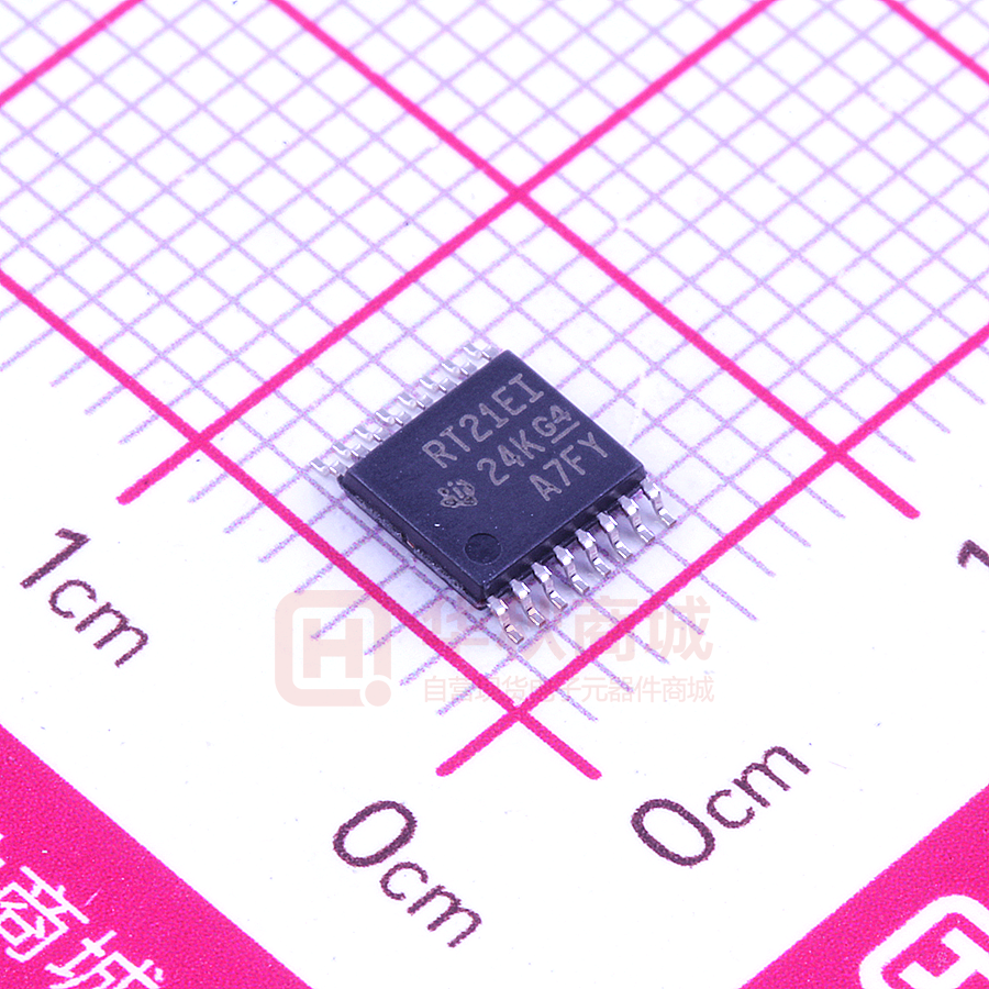

    TRSF3221E 具有 +/-15kV IEC ESD 保护的 3V 至 5.5V 单通道 RS-232 1Mbit/s 线路驱动器/接收器
TRSF3221EIPWR 数据手册
TRSF3221E SLLS822B – JULY 2007 – REVISED JULY 2021 TRSF3221E 3-V to 5.5-V Single-Channel RS-232 1-Mbit Line Driver and Receiver With ±15-kV IEC ESD Protection in Small Package 1 Features • • • • • • • • ESD protection for RS-232 pins – ±15-kV Human-body model (HBM) – ±8-kV IEC 61000-4-2 Contact discharge – ±15-kV IEC 61000-4-2 Air-gap discharge Operates with 3-V to 5.5-V VCC supply Operates up to 1 Mbit/s – Low-speed pin-compatible device (250 kbit/s) – TRS3221E Available in near chip-scale package, 16-pin VQFN (RGT, 82% smaller than TSSOP package) Low standby current: 1 μA typical External capacitors : 4 × 0.1 μF Accepts 5-V logic input with 3.3-V supply Auto-powerdown feature automatically disables drivers for power savings 2 Applications • • • • • • • • • Industrial PCs Wired networking Data center and enterprise computing Battery-powered systems PDAs Notebooks Laptops Palmtop PCs Hand-held equipment Flexible control options for power management are available when the serial port is inactive. The autopowerdown feature functions when FORCEON is low and FORCEOFF is high. During this mode of operation, if the TRSF3221E does not sense a valid RS-232 signal on the receiver input, the driver output is disabled. If FORCEOFF is set low and the enable (EN) input is high, both the driver and receiver are shut off, and the supply current is reduced to 1 μA. Disconnecting the serial port or turning off the peripheral drivers causes the auto-powerdown condition to occur. Auto-powerdown can be disabled when FORCEON and FORCEOFF are high. With auto-powerdown enabled, the device is activated automatically when a valid signal is applied to the receiver input. The INVALID output notifies the user if an RS-232 signal is present at the receiver input. INVALID is high (valid data) if the receiver input voltage is greater than 2.7 V or less than –2.7 V, or has been between –0.3 V and 0.3 V for less than 30 μs. INVALID is low (invalid data) if the receiver input voltage is between –0.3 V and 0.3 V for more than 30 μs. See Figure 7-5 for receiver input levels. Device Information PART NUMBER TRSF3221E 3 Description The TRSF3221E consists of one line driver, one line receiver, and a dual charge-pump circuit with ±15-kV IEC ESD protection pin to pin (serial-port connection pins, including GND). The TRSF3221E provides the electrical interface between an asynchronous communication controller and the serial-port connector. The charge pump and four small external capacitors allow operation from a single 3-V to 5.5-V supply. The TRSF3221E operates at data signaling rates up to 1 Mbit/s and a driver output slew rate of 24 V/μs to 150 V/μs. (1) PACKAGE(1) BODY SIZE (NOM) DB (SSOP) 6.20 mm x 5.30 mm PW (TSSOP) 5.00 mm x 4.40 mm RGT (VQFN) 3.00 mm x 3.00 mm For all available packages, see the orderable addendum at the end of the data sheet. DIN FORCEOFF FORCEON ROUT 13 11 DOUT 16 12 Auto-powerdown 9 10 8 1 INVALID RIN EN Logic Diagram (Positive Logic) An IMPORTANT NOTICE at the end of this data sheet addresses availability, warranty, changes, use in safety-critical applications, intellectual property matters and other important disclaimers. PRODUCTION DATA. TRSF3221E www.ti.com SLLS822B – JULY 2007 – REVISED JULY 2021 Table of Contents 1 Features............................................................................1 2 Applications..................................................................... 1 3 Description.......................................................................1 4 Revision History.............................................................. 2 5 Pin Configuration and Functions...................................3 6 Specifications.................................................................. 4 6.1 Absolute Maximum Ratings........................................ 4 6.2 ESD Ratings............................................................... 4 6.3 ESD Ratings, IEC Specifications................................ 4 6.4 Recommended Operating Conditions.........................5 6.5 Thermal Resistance Characteristics........................... 5 6.6 Electrical Characteristics.............................................5 6.7 Electrical Characteristics, Driver................................. 6 6.8 Switching Characteristics, Driver................................ 6 6.9 Electrical Characteristics, Receiver............................ 7 6.10 Switching Characteristics, Receiver..........................7 6.11 Electrical Characteristics, Auto-Powerdown............. 8 6.12 Switching Characteristics, Auto-Powerdown............ 8 6.13 Typical Characteristics.............................................. 8 7 Parameter Measurement Information............................ 9 8 Detailed Description......................................................12 8.1 Overview................................................................... 12 8.2 Functional Block Diagram......................................... 12 8.3 Feature Description...................................................12 8.4 Device Functional Modes..........................................13 9 Application and Implementation.................................. 14 9.1 Application Information............................................. 14 10 Power Supply Recommendations..............................15 11 Layout........................................................................... 16 11.1 Layout Guidelines................................................... 16 11.2 Layout Example...................................................... 16 12 Device and Documentation Support..........................17 12.1 Receiving Notification of Documentation Updates..17 12.2 Support Resources................................................. 17 12.3 Trademarks............................................................. 17 12.4 Electrostatic Discharge Caution..............................17 12.5 Glossary..................................................................17 13 Mechanical, Packaging, and Orderable Information.................................................................... 17 4 Revision History NOTE: Page numbers for previous revisions may differ from page numbers in the current version. Changes from Revision A (May 2021) to Revision B (July 2021) Page • Changed the Applications list............................................................................................................................. 1 • Changed the table note for the ESD Ratings - IEC Specifications table to make it also applicable to PW package.............................................................................................................................................................. 4 • Changed the thermal information for PW package.............................................................................................5 Changes from Revision * (August 2007) to Revision A (May 2021) Page • Added Device Information table, ESD Ratings table, Feature Description section, Device Functional Modes, Application and Implementation section, Power Supply Recommendations section, Layout section, Device and Documentation Support section, and Mechanical, Packaging, and Orderable Information section............ 1 2 Submit Document Feedback Copyright © 2021 Texas Instruments Incorporated Product Folder Links: TRSF3221E TRSF3221E www.ti.com SLLS822B – JULY 2007 – REVISED JULY 2021 2 15 3 14 4 13 5 12 6 11 7 10 8 9 FORCEOFF VCC GND DOUT FORCEON DIN INVALID ROUT C1- 1 C2+ 2 FORCEOFF 16 EN 1 V+ EN C1+ V+ C1− C2+ C2− V− RIN C1+ 5 Pin Configuration and Functions 16 15 14 13 12 VCC 11 GND Thermal Pad C2- 3 10 DOUT V- 4 9 FORCEON 6 7 ROUT INVALID 8 DIN 5 RIN DB or PW Package. 16 Pins (Top View) RGT, VSON Package, 16 Pins (Top View) Table 5-1. Pin Functions PIN NAME I/O(1) DESCRIPTION DB or PW RGT EN 1 14 -- C1+ 2 16 - Positive lead of C1 capacitor V+ 3 15 O Positive charge pump output for storage capacitor only C1- 4 1 - Negative lead of C1 capacitor C2+ 5 2 - Positive lead of C2 capacitor C2- 6 3 - Negative lead of C2 capacitor V- 7 4 O Negative charge pump output for storage capacitor only RIN 8 5 I RS232 line data input (from remote RS232 system) ROUT 9 6 O Logic data output (to UART) INVALID 10 7 DIN 11 8 I Logic data input (from UART) FORCEON 12 9 DOUT 13 10 O RS232 line data output (to remote RS232 system) GRD 14 11 - Ground VCC 15 12 - Supply Voltage, Connect to external 3-V to 5.5-V power supply FORCEOFF 16 13 Thermal Pad - Yes - Exposed thermal pad. Can be connected to GND or left floating. (1) Signal Types: I = Input, O = Output, I/O = Input or Output. Submit Document Feedback Copyright © 2021 Texas Instruments Incorporated Product Folder Links: TRSF3221E 3 TRSF3221E www.ti.com SLLS822B – JULY 2007 – REVISED JULY 2021 6 Specifications 6.1 Absolute Maximum Ratings over operating free-air temperature range (unless otherwise noted)See (1) Supply voltage range(2) VCC range(2) V+ Positive output supply voltage V– Negative output supply voltage range(2) V+ – V– Supply voltage Input voltage range VO Output voltage range TJ Operating virtual junction temperature Tstg Storage temperature range (2) MAX 6 V –0.3 7 V 0.3 –7 V 13 V difference(2) VI (1) MIN –0.3 Driver ( FORCEOFF, FORCEON, EN) –0.3 6 Receiver –25 25 –13.2 13.2 –0.3 VCC + 0.3 Driver Receiver ( INVALID) –65 UNIT V V 150 °C 150 °C Stresses beyond those listed under "absolute maximum ratings" may cause permanent damage to the device. These are stress ratings only, and functional operation of the device at these or any other conditions beyond those indicated under "recommended operating conditions" is not implied. Exposure to absolute-maximum-rated conditions for extended periods may affect device reliability. All voltages are with respect to network GND. 6.2 ESD Ratings VALUE V (ESD) (1) (2) Electrostatic discharge Human-body model (HBM), per ANSI/ESDA/JEDEC JS-001(1) UNIT ±3000 Charged-device model (CDM), per JEDEC specification JESD22-C101(2) V ±1500 JEDEC document JEP155 states that 500-V HBM allows safe manufacturing with a standard ESD control process. JEDEC document JEP157 states that 250-V CDM allows safe manufacturing with a standard ESD control process. 6.3 ESD Ratings, IEC Specifications PIN NAME TEST CONDITIONS HBM RIN, DOUT (1) 4 TYP UNIT ±15 IEC 61000-4-2 Contact Discharge(1) ±8 IEC 61000-4-2 Air-Gap Discharge(1) ±15 kV For the RGT and PW package only, a minimum of 1-µF capacitor is required between VCC and GND to meet the specified IEC-ESD level. Submit Document Feedback Copyright © 2021 Texas Instruments Incorporated Product Folder Links: TRSF3221E TRSF3221E www.ti.com SLLS822B – JULY 2007 – REVISED JULY 2021 6.4 Recommended Operating Conditions See Figure 9-1 and (1) VCC = 3.3 V Supply voltage VCC = 5 V VIH Driver and control high-level input voltage DIN, FORCEOFF, FORCEON, EN VIL Driver and control low-level input voltage DIN, FORCEOFF, FORCEON, EN VI Driver and control input voltage DIN, FORCEOFF, FORCEON VI Receiver input voltage TA (1) VCC = 3.3 V VCC = 5 V TRSF3221EI Operating free-air temperature TRSF3221EC MIN NOM MAX 3 3.3 3.6 4.5 5 5.5 UNIT 2 V V 2.4 0.8 V 0 5.5 V –25 25 V –40 85 0 70 °C Test conditions are C1–C4 = 0.1 μF at VCC = 3.3 V ± 0.3 V; C1 = 0.047 μF, C2–C4 = 0.33 μF at VCC = 5 V ± 0.5 V. 6.5 Thermal Resistance Characteristics TRSF3221E THERMAL METRIC(1) DB (SSOP) PW (TSSOP) RGT (VQFN) 16 Pins 16 Pins 16 Pins UNIT R θJA Junction-to-ambient thermal resistance 82 110.9 58.8 °C/W R θJC(top) Junction-to-case (top) thermal resistance 45.7 41.7 55.8 °C/W R θJB Junction-to-board thermal resistance 44.4 57.2 23.8 °C/W ψ JT Junction-to-top characterization parameter 11.0 4.2 1.7 °C/W ψ JB Junction-to-board characterization parameter 43.8 56.6 23.7 °C/W R θJC(bot) Junction-to-case (bottom) thermal resistance N/A N/A 9 °C/W (1) For more information about traditional and new thermal metrics, see the Semiconductor and IC package thermal metrics application report. 6.6 Electrical Characteristics over recommended ranges of supply voltage and operating free-air temperature (unless otherwise noted) (see Figure 9-1) TEST CONDITIONS(1) PARAMETER II ICC (1) (2) Input leakage current Supply current (TA = 25°C) FORCEOFF, FORCEON, EN MIN TYP(2) MAX ±0.01 ±1 μA 0.3 1 mA Auto-powerdown disabled No load, FORCEOFF and FORCEON at VCC Powered off No load, FORCEOFF at GND 1 10 Auto-powerdown enabled No load, FORCEOFF at VCC, FORCEON at GND, All RIN are open or grounded 1 10 UNIT μA Test conditions are C1–C4 = 0.1 μF at VCC = 3.3 V ± 0.3 V; C1 = 0.047 μF, C2–C4 = 0.33 μF at VCC = 5 V ± 0.5 V. All typical values are at VCC = 3.3 V or VCC = 5 V, and TA = 25°C. Submit Document Feedback Copyright © 2021 Texas Instruments Incorporated Product Folder Links: TRSF3221E 5 TRSF3221E www.ti.com SLLS822B – JULY 2007 – REVISED JULY 2021 6.7 Electrical Characteristics, Driver over recommended ranges of supply voltage and operating free-air temperature (unless otherwise noted) (see Figure 9-1) TEST CONDITIONS(1) PARAMETER MIN VOH High-level output voltage DOUT at RL = 3 kΩ to GND, DIN = GND 5 VOL Low-level output voltage DOUT at RL = 3 kΩ to GND, DIN = VCC –5 IIH High-level input current VI = VCC IIL Low-level input current VI at GND IOS Short-circuit output current(3) VCC = 3.6 V, VO = 0 V VCC = 5.5 V, VO = 0 V ro Output resistance VCC, V+, and V– = 0 V, VO = ±2 V Ioff Output leakage current FORCEOFF = GND (1) (2) (3) TYP(2) MAX 5.4 V –5.4 ±0.01 UNIT V ±1 μA ±0.01 ±1 μA ±35 ±60 ±35 ±90 300 10M mA Ω VO = ±12 V, VCC = 3 V to 3.6 V ±25 VO = ±10 V, VCC = 4.5 V to 5.5 V ±25 μA Test conditions are C1–C4 = 0.1 μF at VCC = 3.3 V ± 0.3 V; C1 = 0.047 μF, C2–C4 = 0.33 μF at VCC = 5 V ± 0.5 V. All typical values are at VCC = 3.3 V or VCC = 5 V, and TA = 25°C. Short-circuit durations must be controlled to prevent exceeding the device absolute power dissipation ratings, and not more than one output can be shorted at a time. 6.8 Switching Characteristics, Driver over recommended ranges of supply voltage and operating free-air temperature (unless otherwise noted) (see Figure 9-1) TEST CONDITIONS(1) PARAMETER Maximum data rate (see Figure 7-1 ) tsk(p) Pulse skew(3) SR(tr) Slew rate, transition region (see Figure 7-1) (1) (2) (3) 6 MIN CL = 1000 pF RL = 3 kΩ TYP(2) MAX UNIT 250 CL = 250 pF, VCC = 3 V to 4.5 V 1000 CL = 1000 pF, VCC = 4.5 V to 5.5 V 1000 CL = 250 pF RL = 3 kΩFigure 7-2 RGT Package CL = 150 pF to 2500 pF, RL = 3 kΩ to 7 kΩ, See Figure 7-2 DB or PW package VCC = 3.3 V, RL = 3 kΩ to 7 kΩ, CL = 150 pF to 1000 pF kbit/s 25 ns 100 18 150 V/μs Test conditions are C1–C4 = 0.1 μF at VCC = 3.3 V ± 0.3 V; C1 = 0.047 μF, C2–C4 = 0.33 μF at VCC = 5 V ± 0.5 V. All typical values are at VCC = 3.3 V or VCC = 5 V, and TA = 25°C. Pulse skew is defined as |tPLH – tPHL| of each channel of the same device. Submit Document Feedback Copyright © 2021 Texas Instruments Incorporated Product Folder Links: TRSF3221E TRSF3221E www.ti.com SLLS822B – JULY 2007 – REVISED JULY 2021 6.9 Electrical Characteristics, Receiver over recommended ranges of supply voltage and operating free-air temperature (unless otherwise noted) (see Figure 9-1) TEST CONDITIONS(1) PARAMETER VOH High-level output voltage IOH = –1 mA VOL Low-level output voltage IOL = 1.6 mA TYP(2) VCC – 0.6 V VCC – 0.1 V MAX 0.4 1.6 2.4 VCC = 5 V 1.9 2.4 Positive-going input threshold voltage VIT– Negative-going input threshold voltage Vhys Input hysteresis (VIT+ – VIT–) Ioff Output leakage current FORCEOFF = 0 V ri Input resistance VI = ±3 V to ±25 V VCC = 3.3 V 0.6 1.1 VCC = 5 V 0.8 1.4 UNIT V VCC = 3.3 V VIT+ (1) (2) MIN V V V 0.5 V ±0.05 ±10 μA 5 7 kΩ 3 Test conditions are C1–C4 = 0.1 μF at VCC = 3.3 V ± 0.3 V; C1 = 0.047 μF, C2–C4 = 0.33 μF at VCC = 5 V ± 0.5 V. All typical values are at VCC = 3.3 V or VCC = 5 V, and TA = 25°C. 6.10 Switching Characteristics, Receiver over recommended ranges of supply voltage and operating free-air temperature (unless otherwise noted) (see Figure 9-1) TEST CONDITIONS(1) PARAMETER TYP(2) UNIT tPLH Propagation delay time, low- to high-level output CL = 150 pF, See Figure 7-3 RGT package 100 DB or PW package 150 tPHL Propagation delay time, high- to low-level output CL = 150 pF, See Figure 7-3 RGT package 125 DB or PW package 150 ten Output enable time CL = 150 pF, RL = 3 kΩ, See Figure 7-4 200 ns tdis Output disable time CL = 150 pF, RL = 3 kΩ, See Figure 7-4 200 ns tsk(p) Pulse skew(3) See Figure 7-3 (1) (2) (3) RGT package 25 DB or PW package 50 ns ns ns Test conditions are C1–C4 = 0.1 μF at VCC = 3.3 V ± 0.3 V; C1 = 0.047 μF, C2–C4 = 0.33 μF at VCC = 5 V ± 0.5 V. All typical values are at VCC = 3.3 V or VCC = 5 V, and TA = 25°C. Pulse skew is defined as |tPLH – tPHL| of each channel of the same device. Submit Document Feedback Copyright © 2021 Texas Instruments Incorporated Product Folder Links: TRSF3221E 7 TRSF3221E www.ti.com SLLS822B – JULY 2007 – REVISED JULY 2021 6.11 Electrical Characteristics, Auto-Powerdown over recommended ranges of supply voltage and operating free-air temperature (unless otherwise noted) (see Figure 7-5) PARAMETER TEST CONDITIONS MIN VT+(valid) Receiver input threshold for INVALID high-level output voltage FORCEON = GND, FORCEOFF = VCC VT–(valid) Receiver input threshold for INVALID high-level output voltage FORCEON = GND, FORCEOFF = VCC –2.7 VT(invalid) Receiver input threshold for INVALID low-level output voltage FORCEON = GND, FORCEOFF = VCC –0.3 VOH INVALID high-level output voltage IOH = –1 mA, FORCEON = GND, FORCEOFF = VCC VOL INVALID low-level output voltage IOL = 1.6 mA, FORCEON = GND, FORCEOFF = VCC MAX UNIT 2.7 V V 0.3 VCC – 0.6 V V 0.4 V 6.12 Switching Characteristics, Auto-Powerdown over recommended ranges of supply voltage and operating free-air temperature (unless otherwise noted) (see Figure 7-5) TYP(1) PARAMETER tvalid Propagation delay time, low- to high-level output tinvalid Propagation delay time, high- to low-level output ten Supply enable time (1) UNIT 1 μs 30 μs 100 μs All typical values are at VCC = 3.3 V or VCC = 5 V, and TA = 25°C. 120 CL = 150pF CL = 250pF CL = 1000pF 110 Driver Pulse Skew (ns) 100 90 80 70 60 50 40 30 20 Receiver Low-to-High Propagation Delay (ns) 6.13 Typical Characteristics 120 -40 qC 25 qC 85 qC 115 110 105 100 95 90 85 80 75 3 10 3.25 3.5 3.75 4 4.25 4.5 VCC (V) 4.75 5 5.25 5.5 D002 0 3 3.25 3.5 3.75 4 4.25 4.5 VCC (V) 4.75 5 5.25 5.5 Figure 6-2. Receiver Path Low-to-High Propagation Delay vs TA and Supply Voltage (RGT Package) 150 -40 qC 25 qC 85 qC 145 140 Receiver Path Skew (| tpLH -tpHL |) (ns) Receiver High-to-Low Propagation Delay (ns) Figure 6-1. Driver Pulse Skew vs Load Capacitance and Supply Voltage at TA = 25 °C (RGT Package) D002_rx_tpLH.grf 135 130 125 120 115 110 105 100 95 3 3.25 3.5 3.75 4 4.25 4.5 VCC (V) 4.75 5 5.25 5.5 75 70 65 60 55 50 45 40 35 30 25 20 15 10 5 0 -40 qC 25 qC 85 qC 3 D003 D003_rx_tpHL.grf Figure 6-3. . Receiver Path High-to-Low Propagation Delay vs TA and Supply Voltage (RGT Package) 8 3.25 3.5 3.75 4 4.25 4.5 VCC (V) 4.75 5 5.25 5.5 D004 D004_rx_skew.grf Figure 6-4. Receiver Pulse Skew (|tpLH - tpHL|) vs TA and Supply Voltage (RGT Package) Submit Document Feedback Copyright © 2021 Texas Instruments Incorporated Product Folder Links: TRSF3221E TRSF3221E www.ti.com SLLS822B – JULY 2007 – REVISED JULY 2021 7 Parameter Measurement Information FORCEON 3V Generator (see Note B) 3V Input RS-232 Output 50 Ω RL tTHL CL (see Note A) 3V FORCEOFF TEST CIRCUIT 0V 3V 3V Output SR(tr) + tTLH −3 V −3 V 6V t THL or tTLH VOH VOL VOLTAGE WAVEFORMS NOTES: A. CL includes probe and jig capacitance. B. The pulse generator has the following characteristics: PRR = 250 kbit/s, ZO = 50 Ω, 50% duty cycle, tr ≤ 10 ns, tf ≤ 10 ns. Figure 7-1. Driver Slew Rate FORCEON 3V Generator (see Note B) 3V RS-232 Output 50 Ω RL Input 1.5 V 1.5 V 0V CL (see Note A) tPLH tPHL VOH 3V FORCEOFF 50% 50% Output VOL TEST CIRCUIT VOLTAGE WAVEFORMS NOTES: A. CL includes probe and jig capacitance. B. The pulse generator has the following characteristics: PRR = 250 kbit/s, ZO = 50 Ω, 50% duty cycle, tr ≤ 10 ns, tf ≤ 10 ns. Figure 7-2. Driver Pulse Skew EN = VCC 3V Input 1.5 V 1.5 V −3 V Output Generator (see Note B) 50 Ω tPHL CL (see Note A) tPLH VOH 50% Output 50% VOL TEST CIRCUIT VOLTAGE WAVEFORMS NOTES: A. CL includes probe and jig capacitance. B. The pulse generator has the following characteristics: ZO = 50 Ω, 50% duty cycle, tr ≤ 10 ns, tf ≤ 10 ns. Figure 7-3. Receiver Propagation Delay Times Submit Document Feedback Copyright © 2021 Texas Instruments Incorporated Product Folder Links: TRSF3221E 9 TRSF3221E www.ti.com SLLS822B – JULY 2007 – REVISED JULY 2021 3V Input VCC 1.5 V GND S1 0V tPZH (S1 at GND) tPHZ (S1 at GND) RL 3 V or 0 V 1.5 V VOH Output 50% Output CL (see Note A) EN Generator (see Note B) 0.3 V tPZL (S1 at VCC) tPLZ (S1 at VCC) 50 Ω 0.3 V Output 50% VOL TEST CIRCUIT NOTES: A. B. C. D. VOLTAGE WAVEFORMS CL includes probe and jig capacitance. The pulse generator has the following characteristics: ZO = 50 Ω, 50% duty cycle, tr ≤ 10 ns, tf ≤ 10 ns. tPLZ and tPHZ are the same as tdis. tPZL and tPZH are the same as ten. Figure 7-4. Receiver Enable and Disable Times 10 Submit Document Feedback Copyright © 2021 Texas Instruments Incorporated Product Folder Links: TRSF3221E TRSF3221E www.ti.com SLLS822B – JULY 2007 – REVISED JULY 2021 2.7 V EN = GND 3V 0V Receiver Input 0V ROUT Generator (see Note B) 2.7 V −2.7 V −2.7 V −3 V 50 Ω tvalid tinvalid VCC Autopowerdown INVALID INVALID Output CL = 30 pF (see Note A) FORCEOFF FORCEON DIN DOUT 50% VCC 50% VCC 0V ten V+ ≈V+ Supply Voltages 0.3 V VCC 0V 0.3 V V− ≈V− TEST CIRCUIT ÎÎÎÎÎÎÎÎÎÎÎ ÎÎÎÎÎÎÎÎÎÎÎ ÎÎÎÎÎÎÎÎÎÎÎ ÎÎÎÎÎÎÎÎÎÎÎ ÎÎÎÎÎÎÎÎÎÎÎ ÎÎÎÎÎÎÎÎÎÎÎ ÎÎÎÎÎÎÎÎÎÎÎ ÎÎÎÎÎÎÎÎÎÎÎ VOLTAGE WAVEFORMS Valid RS-232 Level, INVALID High 2.7 V Indeterminate 0.3 V 0V If Signal Remains Within This Region For More Than 30 µs, INVALID Is Low† −0.3 V Indeterminate −2.7 V Valid RS-232 Level, INVALID High † Auto-powerdown disables drivers and reduces supply current to 1 µA. NOTES: A. CL includes probe and jig capacitance. B. The pulse generator has the following characteristics: PRR = 5 kbit/s, ZO = 50 Ω, 50% duty cycle, tr ≤ 10 ns, tf ≤ 10 ns. Figure 7-5. INVALID Propagation Delay Times and Driver Enabling Time Submit Document Feedback Copyright © 2021 Texas Instruments Incorporated Product Folder Links: TRSF3221E 11 TRSF3221E www.ti.com SLLS822B – JULY 2007 – REVISED JULY 2021 8 Detailed Description 8.1 Overview The TRSF3221E consists of one line driver, one line receiver, and a dual charge-pump circuit with ±15-kV IEC ESD protection pin to pin (serial-port connection pins, including GND). The TRSF3221E provides the electrical interface between an asynchronous communication controller and the serial-port connector. The charge pump and four small external capacitors allow operation from a single 3-V to 5.5-V supply. The TRSF3221E operates at data signaling rates up to 1 Mbit/s and a driver output slew rate of 24 V/μs to 150 V/μs. Flexible control options for power management are available when the serial port is inactive. The autopowerdown feature functions when FORCEON is low and FORCEOFF is high. During this mode of operation, if the TRSF3221E does not sense a valid RS-232 signal on the receiver input, the driver output is disabled. If FORCEOFF is set low and the enable (EN) input is high, both the driver and receiver are shut off, and the supply current is reduced to 1 μA. Disconnecting the serial port or turning off the peripheral drivers causes the auto-powerdown condition to occur. Auto-powerdown can be disabled when FORCEON and FORCEOFF are high. With auto-powerdown enabled, the device is activated automatically when a valid signal is applied to the receiver input. The INVALID output notifies the user if an RS-232 signal is present at the receiver input. INVALID is high (valid data) if the receiver input voltage is greater than 2.7 V or less than –2.7 V, or has been between –0.3 V and 0.3 V for less than 30 μs. INVALID is low (invalid data) if the receiver input voltage is between –0.3 V and 0.3 V for more than 30 μs. Outputs are protected against shorts to ground. 8.2 Functional Block Diagram DIN FORCEOFF FORCEON ROUT 13 11 DOUT 16 12 Auto-powerdown 10 8 9 1 INVALID RIN EN Figure 8-1. Logic Diagram (Positive Logic) 8.3 Feature Description The power block increases, inverts, and regulates voltage at V+ and V– pins using a charge pump that requires four external capacitors. Auto-power-down feature for driver is controlled by FORCEON and FORCEOFF inputs. Receiver is controlled by EN input. When MAX3221E is unpowered, it can be safely connected to an active remote RS-232 device. The driver interfaces the standard logic level to RS232 voltage levels. The DIN input must be valid high or low. The receiver interfaces RS-232 levels to standard logic levels. An open input results in a high output on ROUT. RIN input includes an internal standard RS-232 load. A logic high input on the EN pin shuts down the receiver output. 12 Submit Document Feedback Copyright © 2021 Texas Instruments Incorporated Product Folder Links: TRSF3221E TRSF3221E www.ti.com SLLS822B – JULY 2007 – REVISED JULY 2021 8.4 Device Functional Modes Functional Tables, Each Driver INPUTS(1) DIN (1) FORCEON FORCEOFF VALID RIN RS-232 LEVEL OUTPUT DOUT DRIVER STATUS X X L X Z Powered off L H H X H H H H X L Normal operation with auto-powerdown disabled L L H Yes H H L H Yes L L L H No Z H L H No Z Normal operation with auto-powerdown enabled Powered off by auto-powerdown feature H = high level, L = low level, X = irrelevant, Z = high impedance Each Receiver INPUTS(1) RIN (1) EN VALID RIN RS-232 LEVEL OUTPUT ROUT L L X H H L X L X H X Z Open L No H H = high level, L = low level, X = irrelevant, Z = high impedance (off), Open = disconnected input or connected driver off Submit Document Feedback Copyright © 2021 Texas Instruments Incorporated Product Folder Links: TRSF3221E 13 TRSF3221E www.ti.com SLLS822B – JULY 2007 – REVISED JULY 2021 9 Application and Implementation Note Information in the following applications sections is not part of the TI component specification, and TI does not warrant its accuracy or completeness. TI’s customers are responsible for determining suitability of components for their purposes, as well as validating and testing their design implementation to confirm system functionality. 9.1 Application Information The TRSF3221E line driver and receiver is a specialized device for 3-V to 5.5-V RS-232 communication applications. This application is a generic implementation of this device with all required external components. For proper operation, add capacitors as shown in Table 9-1. 9.1.1 Typical Application ROUT and DIN connect to UART or general purpose logic lines. FORCEON and FORCEOFFmay be connected general purpose logic lines or tied to ground or VCC. INVALID may be connected to a general purpose logic line or left unconnected. RIN and DOUT lines connect to a RS-232 connector or cable. DIN, FORCEON, and FORCEOFF inputs must not be left unconnected. EN 1 16 2 VCC C1+ FORCEOFF 15 + 3 C1 + + − − V+ Autopowerdown C3(A) 4 GND C1− 5 13 6 C2− 7 11 V− 10 C4 + RIN 12 C2 − DOUT C2+ + − CBYPASS = 0.1 mF − 14 8 9 FORCEON DIN INVALID ROUT 5 kW A. B. C. C3 can be connected to VCC or GND. Resistor values shown are nominal. Nonpolarized ceramic capacitors are acceptable. If polarized tantalum or electrolytic capacitors are used, they must be connected as shown. Figure 9-1. Typical Operating Circuit and Capacitor Values Table 9-1. VCC vs Capacitor Values 14 VCC C1 C2, C3, C4 3.3 V ± 0.3 V 0.1 µF 0.1 µF 5 V ± 0.5 V 0.047 µF 0.33 µF 3 V to 5.5 V 0.1 µF 0.47 µF Submit Document Feedback Copyright © 2021 Texas Instruments Incorporated Product Folder Links: TRSF3221E TRSF3221E www.ti.com SLLS822B – JULY 2007 – REVISED JULY 2021 9.1.1.1 Design Requirements • • • Recommended VCC is 3.3 V or 5 V – 3 V to 5.5 V is also possible Maximum recommended bit rate is 1 Mbps Use capacitors as shown in Figure 9-1 and Table 9-1 9.1.1.2 Detailed Design Procedure For proper operation: • • DIN, FORCEOFF and FORCEON inputs must be connected to valid low or high logic levels Select capacitor values based on VCC level for best performance ROUT and DIN connect to UART or general purpose logic lines. FORCEON and FORCEOFF may be connected general purpose logic lines or tied to ground or VCC. INVALID may be connected to a general purpose logic line or left unconnected. RIN and DOUT lines connect to a RS232 connector or cable. DIN, FORCEON, and FORCEOFF inputs must not be left unconnected. 9.1.2 Application Performance Plot Figure 9-2. 1 Mbps Driver to Receiver Loopback Timing Waveform, VCC = 3.3 V 10 Power Supply Recommendations VCC must be between 3 V and 5.5 V. Charge pump capacitors must be chosen using VCC vs Capacitor Values. Submit Document Feedback Copyright © 2021 Texas Instruments Incorporated Product Folder Links: TRSF3221E 15 TRSF3221E www.ti.com SLLS822B – JULY 2007 – REVISED JULY 2021 11 Layout 11.1 Layout Guidelines Keep the external capacitor traces short. This is more important on C1 and C2 nodes, which have the fastest rise and fall times. 11.2 Layout Example Ground C3 1 EN 2 C1+ FORCEOFF 16 VCC 15 VCC 0.1 µF C1 3 V+ GND 14 4 C1- DOUT 13 5 C2+ FORCEON 12 6 C2- DIN 11 Ground C2 Ground 7 V- INVALID 10 C4 8 RIN ROUT 9 Figure 11-1. Layout Diagram 16 Submit Document Feedback Copyright © 2021 Texas Instruments Incorporated Product Folder Links: TRSF3221E TRSF3221E www.ti.com SLLS822B – JULY 2007 – REVISED JULY 2021 12 Device and Documentation Support 12.1 Receiving Notification of Documentation Updates To receive notification of documentation updates, navigate to the device product folder on ti.com. Click on Subscribe to updates to register and receive a weekly digest of any product information that has changed. For change details, review the revision history included in any revised document. 12.2 Support Resources TI E2E™ support forums are an engineer's go-to source for fast, verified answers and design help — straight from the experts. Search existing answers or ask your own question to get the quick design help you need. Linked content is provided "AS IS" by the respective contributors. They do not constitute TI specifications and do not necessarily reflect TI's views; see TI's Terms of Use. 12.3 Trademarks TI E2E™ is a trademark of Texas Instruments. All trademarks are the property of their respective owners. 12.4 Electrostatic Discharge Caution This integrated circuit can be damaged by ESD. Texas Instruments recommends that all integrated circuits be handled with appropriate precautions. Failure to observe proper handling and installation procedures can cause damage. ESD damage can range from subtle performance degradation to complete device failure. Precision integrated circuits may be more susceptible to damage because very small parametric changes could cause the device not to meet its published specifications. 12.5 Glossary TI Glossary This glossary lists and explains terms, acronyms, and definitions. 13 Mechanical, Packaging, and Orderable Information The following pages include mechanical, packaging, and orderable information. This information is the most current data available for the designated devices. This data is subject to change without notice and revision of this document. For browser-based versions of this data sheet, refer to the left-hand navigation. Submit Document Feedback Copyright © 2021 Texas Instruments Incorporated Product Folder Links: TRSF3221E 17 PACKAGE OPTION ADDENDUM www.ti.com 14-Oct-2022 PACKAGING INFORMATION Orderable Device Status (1) Package Type Package Pins Package Drawing Qty Eco Plan (2) Lead finish/ Ball material MSL Peak Temp Op Temp (°C) Device Marking (3) Samples (4/5) (6) TRSF3221ECDB ACTIVE SSOP DB 16 80 RoHS & Green NIPDAU Level-1-260C-UNLIM 0 to 70 RT21EC Samples TRSF3221ECDBR ACTIVE SSOP DB 16 2000 RoHS & Green NIPDAU Level-1-260C-UNLIM 0 to 70 RT21EC Samples TRSF3221ECPWR ACTIVE TSSOP PW 16 2000 RoHS & Green NIPDAU Level-1-260C-UNLIM 0 to 70 RT21EC Samples TRSF3221EIDBR ACTIVE SSOP DB 16 2000 RoHS & Green NIPDAU Level-1-260C-UNLIM -40 to 85 RT21EI Samples TRSF3221EIPWR ACTIVE TSSOP PW 16 2000 RoHS & Green NIPDAU Level-1-260C-UNLIM -40 to 85 RT21EI Samples TRSF3221EIRGTR ACTIVE VQFN RGT 16 3000 RoHS & Green NIPDAU Level-2-260C-1 YEAR -40 to 85 F3221 Samples (1) The marketing status values are defined as follows: ACTIVE: Product device recommended for new designs. LIFEBUY: TI has announced that the device will be discontinued, and a lifetime-buy period is in effect. NRND: Not recommended for new designs. Device is in production to support existing customers, but TI does not recommend using this part in a new design. PREVIEW: Device has been announced but is not in production. Samples may or may not be available. OBSOLETE: TI has discontinued the production of the device. (2) RoHS: TI defines "RoHS" to mean semiconductor products that are compliant with the current EU RoHS requirements for all 10 RoHS substances, including the requirement that RoHS substance do not exceed 0.1% by weight in homogeneous materials. Where designed to be soldered at high temperatures, "RoHS" products are suitable for use in specified lead-free processes. TI may reference these types of products as "Pb-Free". RoHS Exempt: TI defines "RoHS Exempt" to mean products that contain lead but are compliant with EU RoHS pursuant to a specific EU RoHS exemption. Green: TI defines "Green" to mean the content of Chlorine (Cl) and Bromine (Br) based flame retardants meet JS709B low halogen requirements of
