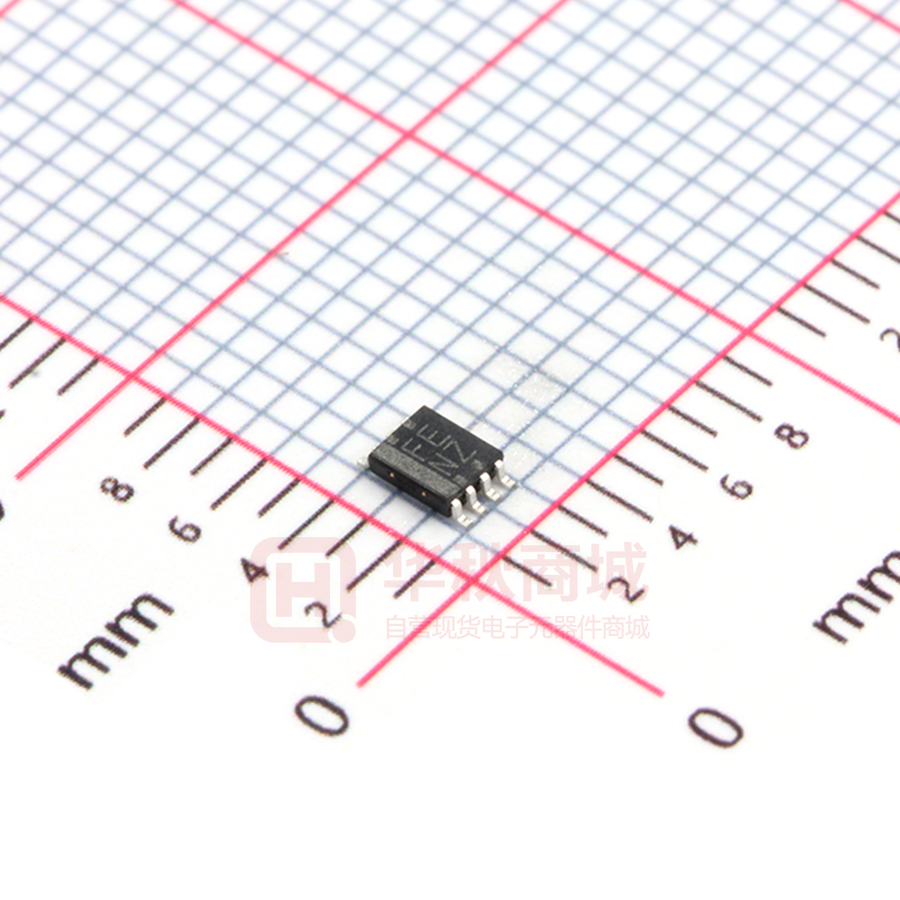

Product Folder Order Now Technical Documents Support & Community Tools & Software TXS0102 SCES640I – JANUARY 2007 – REVISED OCTOBER 2018 TXS0102 2-Bit Bidirectional Voltage-Level Translator for Open-Drain and Push-Pull Applications 1 Features 3 Description • • This two-bit non-inverting translator is a bidirectional voltage-level translator and can be used to establish digital switching compatibility between mixed-voltage systems. It uses two separate configurable powersupply rails, with the A ports supporting operating voltages from 1.65 V to 3.6 V while it tracks the VCCA supply, and the B ports supporting operating voltages from 2.3 V to 5.5 V while it tracks the VCCB supply. This allows the support of both lower and higher logic signal levels while providing bidirectional translation capabilities between any of the 1.8-V, 2.5-V, 3.3-V, and 5-V voltage nodes. 1 • • • • • • • No Direction-Control Signal Needed Maximum Data Rates – 24 Mbps (Push Pull) – 2 Mbps (Open Drain) Available in the Texas Instruments NanoStar™ Package 1.65 V to 3.6 V on A Port and 2.3 V to 5.5 V on B Port (VCCA ≤ VCCB) VCC Isolation Feature: If Either VCC Input Is at GND, Both Ports Are in the High-Impedance State No Power-Supply Sequencing Required: Either VCCA or VCCB Can Be Ramped First Ioff Supports Partial-Power-Down Mode Operation Latch-Up Performance Exceeds 100 mA Per JESD 78, Class II ESD Protection Exceeds JESD 22 – A Port: – 2500-V Human-Body Model (A114-B) – 250-V Machine Model (A115-A) – 1500-V Charged-Device Model (C101) – B Port: – 8-kV Human-Body Model (A114-B) – 250-V Machine Model (A115-A) – 1500-V Charged-Device Model (C101) 2 Applications • • • When the output-enable (OE) input is low, all I/Os are placed in the high-impedance state, which significantly reduces the power-supply quiescent current consumption. To ensure the high-impedance state during power up or power down, OE should be tied to GND through a pulldown resistor; the minimum value of the resistor is determined by the current-sourcing capability of the driver. Device Information(1) PART NUMBER PACKAGE BODY SIZE (NOM) TXS0102DCT SSOP (8) 2.95 mm × 2.80 mm TXS0102DCU VSSOP (8) 2.30 mm × 2.00 mm TXS0102DQE X2SON (8) 1.40 mm × 1.00 mm TXS0102DQM X2SON (8) 1.80 mm × 1.20 mm TXS0102YZP DSBGA (8) 1.90 mm × 0.90 mm (1) For all available packages, see the orderable addendum at the end of the data sheet. I2C / SMBus UART GPIO Typical Application Block Diagram for TXS0102 VCCA Processor VCCB Peripheral 1 An IMPORTANT NOTICE at the end of this data sheet addresses availability, warranty, changes, use in safety-critical applications, intellectual property matters and other important disclaimers. PRODUCTION DATA. TXS0102 SCES640I – JANUARY 2007 – REVISED OCTOBER 2018 www.ti.com Table of Contents 1 2 3 4 5 6 Features .................................................................. Applications ........................................................... Description ............................................................. Revision History..................................................... Pin Configuration and Functions ......................... Specifications......................................................... 6.1 6.2 6.3 6.4 6.5 6.6 6.7 6.8 6.9 6.10 6.11 6.12 7 8 1 1 1 2 3 4 Absolute Maximum Ratings ..................................... 4 ESD Ratings ............................................................ 4 Recommended Operating Conditions ...................... 5 Thermal Information .................................................. 5 Electrical Characteristics........................................... 6 Timing Requirements: VCCA = 1.8 V ±0.15 V............ 7 Timing Requirements: VCCA = 2.5 V ± 0.2 V ............ 7 Timing Requirements: VCCA = 3.3 V ± 0.3 V ............ 7 Switching Characteristics: VCCA = 1.8 V ± 0.15 V .... 8 Switching Characteristics: VCCA = 2.5 V ± 0.2 V .... 9 Switching Characteristics: VCCA = 3.3 V ± 0.3 V .. 10 Typical Characteristics .......................................... 11 Parameter Measurement Information ................ 12 Detailed Description ............................................ 14 8.1 8.2 8.3 8.4 9 Overview ................................................................. Functional Block Diagram ....................................... Feature Description................................................. Device Functional Modes........................................ 14 14 15 16 Application and Implementation ........................ 17 9.1 Application Information............................................ 17 9.2 Typical Application ................................................. 17 10 Power Supply Recommendations ..................... 19 11 Layout................................................................... 19 11.1 Layout Guidelines ................................................. 19 11.2 Layout Example .................................................... 19 12 Device and Documentation Support ................. 20 12.1 12.2 12.3 12.4 12.5 12.6 Documentation Support ....................................... Receiving Notification of Documentation Updates Community Resources.......................................... Trademarks ........................................................... Electrostatic Discharge Caution ............................ Glossary ................................................................ 20 20 20 20 20 20 13 Mechanical, Packaging, and Orderable Information ........................................................... 21 4 Revision History NOTE: Page numbers for previous revisions may differ from page numbers in the current version. Changes from Revision H (April 2018) to Revision I • Updated the VIH A-port I/O VCCA value in the Recommended Operating Conditions table From: "1.65 V to 3.6 V", To: "1.65 V to 1.95 V" .................................................................................................................................................................. 5 Changes from Revision G (January 2018) to Revision H • Page Page Updated TXS0102 Layout Example diagram ...................................................................................................................... 19 Changes from Revision F (August 2014) to Revision G Page • Changed part number in title of front page graphic from TXS010x to TXS0102 .................................................................. 1 • Changed value from 8 V to 8000 V in ESD Ratings table...................................................................................................... 4 • Changed unit from kV to V in ESD Ratings table................................................................................................................... 4 • Added typical value column in Electrical Characteristics table ............................................................................................. 6 • Changed part number in title of Figure 10 from TXS01xx to TXS0102................................................................................ 15 • Added title to TXS0102 Layout Example diagram .............................................................................................................. 19 2 Submit Documentation Feedback Copyright © 2007–2018, Texas Instruments Incorporated Product Folder Links: TXS0102 TXS0102 www.ti.com SCES640I – JANUARY 2007 – REVISED OCTOBER 2018 5 Pin Configuration and Functions DCT or DCU Package 8-Pin SSOP and VSSOP Top View B2 1 8 B1 GND 2 7 VCCB VCCA 3 6 OE A2 4 5 A1 DQE or DQM Package 8-Pin X2SON Top View VCCA A1 A2 GND 1 8 2 7 3 6 4 5 VCCB B1 B2 OE YZP Package 8-Pin DSBGA Bottom View A2 D1 4 5 D2 A1 VCCA C1 3 6 C2 OE GND B1 2 7 B2 VCCB B2 A1 1 8 A2 B1 Pin Functions PIN NAME TYPE (1) NO. DESCRIPTION DCT, DCU DQE, DQM YZP B2 1 6 A1 I/O Input/output B. Referenced to VCCB. GND 2 4 B1 — Ground VCCA 3 1 C1 P A-port supply voltage. 1.65 V ≤ VCCA ≤ 3.6 V and VCCA ≤ VCCB A2 4 3 D1 I/O Input/output A. Referenced to VCCA. A1 5 2 D2 I/O Input/output A. Referenced to VCCA. OE 6 5 C2 I Output enable (active High). Pull OE low to place all outputs in 3-state mode. Referenced to VCCA. VCCB 7 8 B2 P B-port supply voltage. 2.3 V ≤ VCCB ≤ 5.5 V B1 8 7 A2 I/O (1) Input/output B. Referenced to VCCB. I = input, O = output, I/O = input and output, P = power Submit Documentation Feedback Copyright © 2007–2018, Texas Instruments Incorporated Product Folder Links: TXS0102 3 TXS0102 SCES640I – JANUARY 2007 – REVISED OCTOBER 2018 www.ti.com 6 Specifications 6.1 Absolute Maximum Ratings over recommended operating free-air temperature range (unless otherwise noted) (1) Supply voltage range, VCCA Supply voltage range, VCCB Input voltage range, VI (2) Voltage range applied to any output in the high-impedance or power-off state, VO (2) Voltage range applied to any output in the high or low state, VO (2) (3) MIN MAX –0.5 4.6 V V –0.5 6.5 A port –0.5 4.6 B port –0.5 6.5 A port –0.5 4.6 B port –0.5 6.5 A port –0.5 VCCA + 0.5 B port –0.5 VCCB + 0.5 UNIT V V V Input clamp current, IIK VI < 0 –50 mA Output clamp current, IOK VO < 0 –50 mA ±50 mA ±100 mA 150 °C 150 °C Continuous output current, IO Continuous current through VCCA, VCCB, or GND Junction temperature, TJ Storage temperature, Tstg (1) (2) (3) –65 Stresses beyond those listed under Absolute Maximum Ratings may cause permanent damage to the device. These are stress ratings only, which do not imply functional operation of the device at these or any other conditions beyond those indicated under Recommended Operating Conditions. Exposure to absolute-maximum-rated conditions for extended periods may affect device reliability. The input and output negative-voltage ratings may be exceeded if the input and output current ratings are observed. The value of VCCA and VCCB are provided in the recommended operating conditions table. 6.2 ESD Ratings V(ESD) (1) (2) 4 Electrostatic discharge VALUE UNIT Human-body model (HBM), per ANSI/ESDA/JEDEC JS-001, all pins, A Port (1) ±2500 V Human-body model (HBM), per ANSI/ESDA/JEDEC JS-001, all pins, B Port (1) ±8000 V Charged-device model (CDM), per JEDEC specification JESD22-C101 (2) ±1500 V 250-V Machine Model (A115-A), all pins ±250 V JEDEC document JEP155 states that 500-V HBM allows safe manufacturing with a standard ESD control process. JEDEC document JEP157 states that 250-V CDM allows safe manufacturing with a standard ESD control process. Submit Documentation Feedback Copyright © 2007–2018, Texas Instruments Incorporated Product Folder Links: TXS0102 TXS0102 www.ti.com SCES640I – JANUARY 2007 – REVISED OCTOBER 2018 6.3 Recommended Operating Conditions VCCI is the supply voltage associated with the input port. VCCO is the supply voltage associated with the output port. VCCA Supply voltage VCCB Supply voltage MIN MAX 1.65 3.6 V 2.3 5.5 V VCCA = 1.65 V to 1.95 V VCCB = 2.3 V to 5.5 V VCCI – 0.2 VCCI VCCA = 1.65 V to 3.6 V VCCB = 2.3 V to 5.5 V VCCI – 0.4 VCCI B-port I/Os VCCA = 1.65 V to 3.6 V VCCB = 2.3 V to 5.5 V VCCI – 0.4 VCCI V OE input VCCA = 1.65 V to 3.6 V VCCB = 2.3 V to 5.5 V VCCA × 0.65 5.5 V A-port I/Os VCCA = 1.65 V to 3.6 V VCCB = 2.3 V to 5.5 V 0 0.15 V B-port I/Os VCCA = 1.65 V to 3.6 V VCCB = 2.3 V to 5.5 V 0 0.15 V OE input VCCA = 1.65 V to 3.6 V VCCB = 2.3 V to 5.5 V 0 VCCA × 0.35 V A-port I/Os push-pull driving VCCA = 1.65 V to 3.6 V VCCB = 2.3 V to 5.5 V 10 ns/V B-port I/Os push-pull driving VCCA = 1.65 V to 3.6 V VCCB = 2.3 V to 5.5 V 10 ns/V Control input VCCA = 1.65 V to 3.6 V VCCB = 2.3 V to 5.5 V 10 ns/V 85 °C (1) A-port I/Os High-level input voltage VIH VIL (2) Δt/Δv TA (1) (2) Low-level input voltage Input transition rise or fall rate UNIT V Operating free-air temperature –40 VCCA must be less than or equal to VCCB, and VCCA must not exceed 3.6 V. The maximum VIL value is provided to ensure that a valid VOL is maintained. The VOL value is VIL plus the voltage drop across the passgate transistor. 6.4 Thermal Information TXS0102 THERMAL METRIC (1) DCT DCU DQE DQM YZP 8 PINS 8 PINS 8 PINS 8 PINS 8 PINS UNIT RθJA Junction-to-ambient thermal resistance 182.6 199.1 199.3 239.3 105.8 °C/W RθJC(top) Junction-to-case (top) thermal resistance 113.3 72.4 26.4 106.7 1.6 °C/W RθJB Junction-to-board thermal resistance 94.9 77.8 78.6 130.4 10.8 °C/W ψJT Junction-to-top characterization parameter 39.4 6.2 5.9 8.2 3.1 °C/W ψJB Junction-to-board characterization parameter 93.9 77.4 78.0 130.2 10.8 °C/W RθJC(bot) Junction-to-case (bottom) thermal resistance — — — — — °C/W (1) For more information about traditional and new thermal metrics, see the Semiconductor and IC Package Thermal Metrics application report. Submit Documentation Feedback Copyright © 2007–2018, Texas Instruments Incorporated Product Folder Links: TXS0102 5 TXS0102 SCES640I – JANUARY 2007 – REVISED OCTOBER 2018 www.ti.com 6.5 Electrical Characteristics over recommended operating free-air temperature range (unless otherwise noted) (1) PARAMETER TEST CONDITIONS VCCA VCCB VOHA Port A output high voltage IOH = –20 µA VIB ≥ VCCB – 0.4 V 1.65 V to 3.6 V 2.3 V to 5.5 V VOLA Port A output low voltage IOL = 1 mA VIB ≤ 0.15 V 1.65 V to 3.6 V 2.3 V to 5.5 V VOHB Port B output high voltage 1.65 V to 3.6 V 2.3 V to 5.5 V VOLB Port B output low voltage 1.65 V to 3.6 V 2.3 V to 5.5 V II Input leakage current Ioff Partial power down current IOZ High-impedance state output A or B port current ICCA VCCA supply current ICCB VCCB supply current TA = 25°C MIN MIN TYP MAX VCCA × 0.67 VCCB × 0.67 OE 1.65 V to 3.6 V 2.3 V to 5.5 V ±1 ±2 A port 0V 0 V to 5.5 V ±1 ±2 B port 0 V to 3.6 V 0V ±1 ±2 ±1 ±2 VI = VO = open IO = 0 VI = VO = open IO = 0 V V 0.4 1.65 V to 3.6 V 2.3 V to 5.5 V UNIT V 0.4 1.65 V to VCCB 2.3 V to 5.5 V 2.4 3.6 V 0V 2.2 0V 5.5 V –1 1.65 V to VCCB 2.3 V to 5.5 V 12 3.6 V 0V –1 0V 5.5 V V µA µA µA 1 Combined supply current VI = VCCI or GND IO = 0 1.65 V to VCCB 2.3 V to 5.5 V CI Input capacitance OE 3.3 V 3.3 V 2.5 Input-to-output internal capacitance A or B port 3.3 V 3.3 V 10 Cio 6 TA = –40°C to +85°C TYP MAX ICCA + ICCB (1) (2) (3) (2) (3) A port 5 6 B port 6 7.5 14.4 µA 3.5 pF pF VCCI is the VCC associated with the input port. VCCO is the VCC associated with the output port VCCA must be less than or equal to VCCB, and VCCA must not exceed 3.6 V. Submit Documentation Feedback Copyright © 2007–2018, Texas Instruments Incorporated Product Folder Links: TXS0102 TXS0102 www.ti.com SCES640I – JANUARY 2007 – REVISED OCTOBER 2018 6.6 Timing Requirements: VCCA = 1.8 V ±0.15 V VCCB = 2.5 V ± 0.2 V MIN Data rate tw Pulse duration VCC = 3.3 V ± 0.3 V MAX Push-pull driving Open-drain driving (data inputs) VCC = 5 V ± 0.5 V MAX MIN MAX 21 22 24 2 2 2 Open-drain driving Push-pull driving (data inputs) MIN 47 45 41 500 500 UNIT Mbps ns 500 6.7 Timing Requirements: VCCA = 2.5 V ± 0.2 V VCCB = 2.5 V ± 0.2 V MIN Data rate tw Pulse duration MAX Push-pull driving Open-drain driving Push-pull driving (data inputs) Open-drain driving (data inputs) VCC = 3.3 V ± 0.3 V MIN VCC = 5 V ± 0.5 V MAX MIN MAX 20 22 24 2 2 2 50 45 41 500 500 UNIT Mbps ns 500 6.8 Timing Requirements: VCCA = 3.3 V ± 0.3 V VCC = 3.3 V ± 0.3 V MIN Data rate tw Pulse duration Push-pull driving VCC = 5 V ± 0.5 V MAX Open-drain driving (data inputs) MAX 23 24 2 2 Open-drain driving Push-pull driving (data inputs) MIN 43 41 500 500 UNIT Mbps ns Submit Documentation Feedback Copyright © 2007–2018, Texas Instruments Incorporated Product Folder Links: TXS0102 7 TXS0102 SCES640I – JANUARY 2007 – REVISED OCTOBER 2018 www.ti.com 6.9 Switching Characteristics: VCCA = 1.8 V ± 0.15 V over operating free-air temperature range (unless otherwise noted) PARAMETER tPHL TEST CONDITIONS VCCB = 2.5 V ±0.2 V MIN MAX MIN MAX MIN UNIT Propagation delay time low-to-high output A-to-B Propagation delay time high-to-low output B-to-A Propagation delay time low-to-high output B-to-A ten Enable time OE-to-A or B 200 200 200 ns tdis Disable time OE-to-A or B 50 40 35 ns trA Input rise time A port rise time Push-pull driving 3.2 9.5 2.3 9.3 2 7.6 Open-drain driving 38 165 30 132 22 95 Input rise time B port rise time Push-pull driving 4 10.8 2.7 9.1 2.7 7.6 34 145 23 106 10 58 Input fall time A port fall time Push-pull driving 2 5.9 1.9 6 1.7 13.3 Open-drain driving 4.4 6.9 4.3 6.4 4.2 6.1 Input fall time B port fall time Push-pull driving 2.9 13.8 2.8 16.2 2.8 16.2 Open-drain driving 6.9 13.8 7.5 16.2 7 16.2 tPHL tPLH trB tfA tfB tSK(O) Skew (time), output Maximum data rate 8 2.3 Push-pull driving Open-drain driving 45 Open-drain driving 1.9 Open-drain driving 36 5.3 45 175 2.6 208 1.1 4.4 27 0.7 140 1.2 198 ns 4 ns 0.5 27 0.7 102 0.7 21 22 24 2 2 2 Submit Documentation Feedback ns 4.7 4.5 36 10 7.5 4.5 5.3 Channel -to- channel skew Push-pull driving 260 9.6 6.8 7.1 4.4 Push-pull driving Open-drain driving 2.4 6.8 Push-pull driving Open-drain driving 8.8 5.4 MAX A-to-B Open-drain driving 5.3 VCCB = 3.3 V ±0.2 V Propagation delay time high-to-low output tPLH Push-pull driving VCCB = 3.3 V ±0.2 V ns ns ns ns ns ns Mbps Copyright © 2007–2018, Texas Instruments Incorporated Product Folder Links: TXS0102 TXS0102 www.ti.com SCES640I – JANUARY 2007 – REVISED OCTOBER 2018 6.10 Switching Characteristics: VCCA = 2.5 V ± 0.2 V over operating free-air temperature range (unless otherwise noted) PARAMETER VCCB = 2.5 V ±0.2 V TEST CONDITIONS MIN MAX MIN MAX MIN UNIT A-to-B tPLH Propagation delay time low-to-high output A-to-B tPHL Propagation delay time high-to-low output B-to-A tPLH Propagation delay time low-to-high output B-to-A ten Enable time OE-to-A or B 200 200 200 ns tdis Disable time OE-to-A or B 50 40 35 ns trA Input rise time A port rise time trB Input rise time B port rise time tfA Input fall time A port fall time tfB Input fall time B port fall time tSK(O) Skew (time), output 1.7 Push-pull driving Open-drain driving Push-pull driving Push-pull driving 36 4.7 170 2.1 206 2.6 4.2 27 140 190 1.2 4 27 103 7.4 2.6 6.6 1.8 5.6 3 149 28 121 24 89 Push-pull driving 3.2 8.3 2.9 7.2 2.4 6.1 Open-drain driving 35 151 24 112 12 64 Push-pull driving 1.9 5.7 1.9 5.5 1.8 5.3 Open-drain driving 4.4 6.9 4.3 6.2 4.2 5.8 Push-pull driving 2.2 7.8 2.4 6.7 2.6 6.6 Open-drain driving 5.1 8.8 5.4 9.4 5.4 10.4 Channel-to-channel skew 0.7 Push-pull driving Open-drain driving 0.7 0.7 20 22 24 2 2 2 Submit Documentation Feedback Copyright © 2007–2018, Texas Instruments Incorporated Product Folder Links: TXS0102 ns ns 1 2.8 Open-drain driving ns 4.3 1.6 37 5.8 4.4 3.6 2.5 44 Push-pull driving 250 6 3.8 4.1 3 1.8 Open-drain driving 2 3.5 43 Open-drain driving 6.3 3.7 MAX Propagation delay time high-to-low output Open-drain driving 3.2 VCCB = 5 V ± 0.5 V tPHL Maximum data rate Push-pull driving VCCB = 3.3 V ±0.3 V ns ns ns ns ns ns Mbps 9 TXS0102 SCES640I – JANUARY 2007 – REVISED OCTOBER 2018 www.ti.com 6.11 Switching Characteristics: VCCA = 3.3 V ± 0.3 V over operating free-air temperature range (unless otherwise noted) PARAMETER TEST CONDITIONS VCCB = 3.3 V ±0.2 V MIN Push-pull driving VCCB = 5 V ± 0.5 V MAX MIN UNIT tPHL Propagation delay time high-to-low output A-to-B tPLH Propagation delay time low-to-high output A-to-B tPHL Propagation delay time high-to-low output B-to-A tPLH Propagation delay time low-to-high output B-to-A ten Enable time OE-to-A or B 200 200 ns tdis Disable time OE-to-A or B 40 35 ns trA Input rise time A port rise time trB Input rise time B port rise time tfA Input fall time A port fall time tfB Input fall time B port fall time tSK(O) Skew (time), output 1.3 Push-pull driving Open-drain driving Open-drain driving 36 1.4 204 1 124 28 139 165 1 97 3 105 2.3 5.6 1.9 4.8 Open-drain driving 25 116 19 85 Push-pull driving 2.5 6.4 2.1 7.4 Open-drain driving 26 116 14 72 2 5.4 1.9 5 Open-drain driving 4.3 6.1 4.2 5.7 Push-pull driving 2.3 7.4 2.4 7.6 5 7.6 4.8 8.3 Open-drain driving Channel-to-channel skew 0.7 Push-pull driving Open-drain driving 0.7 23 24 2 2 Submit Documentation Feedback ns ns 2.6 Push-pull driving Push-pull driving ns 3.3 2.5 3 4.6 4.4 2.5 Push-pull driving Open-drain driving 4.2 3.1 4.2 Push-pull driving Maximum data rate 10 Open-drain driving 2.4 MAX ns ns ns ns ns ns Mbps Copyright © 2007–2018, Texas Instruments Incorporated Product Folder Links: TXS0102 TXS0102 www.ti.com SCES640I – JANUARY 2007 – REVISED OCTOBER 2018 6.12 Typical Characteristics Figure 1. Low-Level Output Voltage (VOL(Bx)) vs Low-Level Current (IOL(Bx)) Figure 2. Low-Level Output Voltage (VOL(Bx)) vs Low-Level Current (IOL(Bx)) Figure 3. Low-Level Output Voltage (VOL(Bx)) vs Low-Level Current (IOL(Bx)) Submit Documentation Feedback Copyright © 2007–2018, Texas Instruments Incorporated Product Folder Links: TXS0102 11 TXS0102 SCES640I – JANUARY 2007 – REVISED OCTOBER 2018 www.ti.com 7 Parameter Measurement Information Unless otherwise noted, all input pulses are supplied by generators having the following characteristics: • PRR 10 MHz • ZO = 50 W • dv/dt ≥ 1 V/ns NOTE All parameters and waveforms are not applicable to all devices. VCCI VCCO DUT IN OUT 1M 15 pF Figure 4. Data Rate, Pulse Duration, Propagation Delay, Output Rise And Fall Time Measurement Using A Push-Pull Driver VCCI VCCO DUT IN OUT 1M 15 pF Figure 5. Data Rate, Pulse Duration, Propagation Delay, Output Rise And Fall Time Measurement Using An Open-Drain Driver 2 x VCCO S1 50 k Open From Output Under Test 15 pF 50 k Figure 6. Load Circuit For Enable / Disable Time Measurement Table 1. Switch Configuration For Enable / Disable Timing TEST tPZL (1) , tPLZ S1 (2) 2 × VCCO tPHZ (2), tPZH (1) (1) (2) 12 Open tPZL and tPZH are the same as ten. tPLZ and tPHZ are the same as tdis. Submit Documentation Feedback Copyright © 2007–2018, Texas Instruments Incorporated Product Folder Links: TXS0102 TXS0102 www.ti.com SCES640I – JANUARY 2007 – REVISED OCTOBER 2018 tw VCCI Input VCCI / 2 VCCI / 2 0V (1) All input pulses are measured one at a time, with one transition per measurement. Figure 7. Voltage Waveforms Pulse Duration VCCI VCCI / 2 VCCI / 2 Input 0V TPLH TPHL 0.9 VCCO / 2 Output VOH VCCO VCCO / 2 VCCO 0.1 VOL tr A. tf All input pulses are measured one at a time, with one transition per measurement. Figure 8. Voltage Waveforms Propagation Delay Times Output Control (low-level enabling) VCCA VCCA / 2 VCCA / 2 0V tPLZ Output Waveform 1(1) S1 at x VCCO tPZL VCCO VCCO / 2 0.1 VCCO tPHZ tPZH Output Waveform 2(2) S1 at GND VOL 0.9 VOH VCCO VCCO / 2 0V (1) Waveform 1 is for an output with internal conditions such that the output is low, except when disabled by the output control. (2) Waveform 2 is for an output with internal conditions such that the ouput is high, except when disabled by the output control. Figure 9. Voltage Waveforms Enable And Disable Times Submit Documentation Feedback Copyright © 2007–2018, Texas Instruments Incorporated Product Folder Links: TXS0102 13 TXS0102 SCES640I – JANUARY 2007 – REVISED OCTOBER 2018 www.ti.com 8 Detailed Description 8.1 Overview The TXS0102 device is a directionless voltage-level translator specifically designed for translating logic voltage levels. The A port is able to accept I/O voltages ranging from 1.65 V to 3.6 V, while the B port can accept I/O voltages from 2.3 V to 5.5 V. The device is a pass-gate architecture with edge-rate accelerators (one-shots) to improve the overall data rate. 10-kΩ pullup resistors, commonly used in open-drain applications, have been conveniently integrated so that an external resistor is not needed. While this device is designed for open-drain applications, the device can also translate push-pull CMOS logic outputs. 8.2 Functional Block Diagram VCCA VCCB OE One Shot Accelerator One Shot Accelerator Gate Bias 10 NŸ 10 NŸ A1 B1 One Shot Accelerator One Shot Accelerator Gate Bias 10 NŸ A2 14 10 NŸ B2 Submit Documentation Feedback Copyright © 2007–2018, Texas Instruments Incorporated Product Folder Links: TXS0102 TXS0102 www.ti.com SCES640I – JANUARY 2007 – REVISED OCTOBER 2018 8.3 Feature Description 8.3.1 Architecture The TXS0102 architecture (see Figure 10) is an auto-direction-sensing based translator that does not require a direction-control signal to control the direction of data flow from A to B or from B to A. VCCA VCCB T1 One Oneshot shot One Oneshot shot R1 10k T2 R2 10k Gate Bias A B N2 Figure 10. Architecture of a TXS0102 Cell These two bidirectional channels independently determine the direction of data flow without a direction-control signal. Each I/O pin can be automatically reconfigured as either an input or an output, which is how this autodirection feature is realized. The TXS0102 device is part of TI's "Switch" type voltage translator family and employs two key circuits to enable this voltage translation: 1) An N-channel pass-gate transistor topology that ties the A-port to the B-port and 2) Output one-shot (O.S.) edge-rate accelerator circuitry to detect and accelerate rising edges on the A or B ports For bidirectional voltage translation, pull-up resistors are included on the device for dc current sourcing capability. The VGATE gate bias of the N-channel pass transistor is set at approximately one threshold voltage (VT) above the VCC level of the low-voltage side. Data can flow in either direction without guidance from a control signal. The O.S. rising-edge rate accelerator circuitry speeds up the output slew rate by monitoring the input edge for transitions, helping maintain the data rate through the device. During a low-to-high signal rising edge, the O.S. circuits turn on the PMOS transistors (T1, T2) to increase the current drive capability of the driver for approximately 30 ns or 95% of the input edge, whichever occurs first. This edge-rate acceleration provides high ac drive by bypassing the internal 10-kΩ pull-up resistors during the low-to-high transition to speed up the signal. The output resistance of the driver is decreased to approximately 50 Ω to 70 Ω during this acceleration phase. To minimize dynamic ICC and the possibility of signal contention, the user should wait for the O.S. circuit to turn off before applying a signal in the opposite direction. The worst-case duration is equal to the minimum pulse-width number provided in the Timing Requirements section of this data sheet. Submit Documentation Feedback Copyright © 2007–2018, Texas Instruments Incorporated Product Folder Links: TXS0102 15 TXS0102 SCES640I – JANUARY 2007 – REVISED OCTOBER 2018 www.ti.com Feature Description (continued) 8.3.2 Input Driver Requirements The continuous dc-current "sinking" capability is determined by the external system-level open-drain (or pushpull) drivers that are interfaced to the TXS0102 I/O pins. Since the high bandwidth of these bidirectional I/O circuits is used to facilitate this fast change from an input to an output and an output to an input, they have a modest dc-current "sourcing" capability of hundreds of micro-Amps, as determined by the internal 10-kΩ pullup resistors. The fall time (tfA, tfB) of a signal depends on the edge-rate and output impedance of the external device driving TXS0102 data I/Os, as well as the capacitive loading on the data lines. Similarly, the tPHL and max data rates also depend on the output impedance of the external driver. The values for tfA, tfB, tPHL, and maximum data rates in the data sheet assume that the output impedance of the external driver is less than 50 Ω. 8.3.3 Output Load Considerations TI recommends careful PCB layout practices with short PCB trace lengths to avoid excessive capacitive loading and to ensure that proper O.S. triggering takes place. PCB signal trace-lengths should be kept short enough such that the round trip delay of any reflection is less than the one-shot duration. This improves signal integrity by ensuring that any reflection sees a low impedance at the driver. The O.S. circuits have been designed to stay on for approximately 30 ns. The maximum capacitance of the lumped load that can be driven also depends directly on the one-shot duration. With very heavy capacitive loads, the one-shot can time-out before the signal is driven fully to the positive rail. The O.S. duration has been set to best optimize trade-offs between dynamic ICC, load driving capability, and maximum bit-rate considerations. Both PCB trace length and connectors add to the capacitance that the TXS0102 device output sees, so it is recommended that this lumped-load capacitance be considered to avoid O.S. retriggering, bus contention, output signal oscillations, or other adverse system-level affects. 8.3.4 Enable and Disable The TXS0102 device has an OE input that is used to disable the device by setting OE low, which places all I/Os in the Hi-Z state. The disable time (tdis) indicates the delay between the time when OE goes low and when the outputs are disabled (Hi-Z). The enable time (ten) indicates the amount of time the user must allow for the oneshot circuitry to become operational after OE is taken high. 8.3.5 Pullup or Pulldown Resistors on I/O Lines Each A-port I/O has an internal 10-kΩ pullup resistor to VCCA, and each B-port I/O has an internal 10-kΩ pullup resistor to VCCB. If a smaller value of pullup resistor is required, an external resistor must be added from the I/O to VCCA or VCCB (in parallel with the internal 10-kΩ resistors). Adding lower value pull-up resistors will effect VOL levels, however. The internal pull-ups of the TXS0102 are disabled when the OE pin is low. 8.4 Device Functional Modes The device has two functional modes, enabled and disabled. To disable the device set the OE input low, which places all I/Os in a high impedance state. Setting the OE input high will enable the device. 16 Submit Documentation Feedback Copyright © 2007–2018, Texas Instruments Incorporated Product Folder Links: TXS0102 TXS0102 www.ti.com SCES640I – JANUARY 2007 – REVISED OCTOBER 2018 9 Application and Implementation NOTE Information in the following applications sections is not part of the TI component specification, and TI does not warrant its accuracy or completeness. TI’s customers are responsible for determining suitability of components for their purposes. Customers should validate and test their design implementation to confirm system functionality. 9.1 Application Information The TXS0102 device can be used to bridge the digital-switching compatibility gap between two voltage nodes to successfully interface logic threshold levels found in electronic systems. It should be used in a point-to-point topology for interfacing devices or systems operating at different interface voltages with one another. Its primary target application use is for interfacing with open-drain drivers on the data I/Os such as I2C or 1-wire, where the data is bidirectional and no control signal is available. The device can also be used in applications where a pushpull driver is connected to the data I/Os, but the TXB0102 might be a better option for such push-pull applications. 9.2 Typical Application Figure 11. Typical Application Circuit 9.2.1 Design Requirements For this design example, use the parameters listed in Table 3. And make sure the VCCA ≤ VCCB. Table 2. Design Parameters DESIGN PARAMETER EXAMPLE VALUE Input voltage range 1.65 to 3.6 V Output voltage range 2.3 to 5.5 V Submit Documentation Feedback Copyright © 2007–2018, Texas Instruments Incorporated Product Folder Links: TXS0102 17 TXS0102 SCES640I – JANUARY 2007 – REVISED OCTOBER 2018 www.ti.com 9.2.2 Detailed Design Procedure To begin the design process, determine the following: • Input voltage range - Use the supply voltage of the device that is driving the TXS0102 device to determine the input voltage range. For a valid logic high the value must exceed the VIH of the input port. For a valid logic low the value must be less than the VIL of the input port. • Output voltage range - Use the supply voltage of the device that the TXS0102 device is driving to determine the output voltage range. - The TXS0102 device has 10-kΩ internal pullup resistors. External pullup resistors can be added to reduce the total RC of a signal trace if necessary. • An external pull down resistor decreases the output VOH and VOL. Use Equation 1 to calculate the VOH as a result of an external pull down resistor. VOH = VCCx × RPD / (RPD + 10 kΩ) Where: • VCCx is the supply voltage on either VCCA or VCCB • RPD is the value of the external pull down resistor 9.2.3 Application Curves Figure 12. Level-Translation of a 2.5-MHz Signal 18 Submit Documentation Feedback Copyright © 2007–2018, Texas Instruments Incorporated Product Folder Links: TXS0102 TXS0102 www.ti.com SCES640I – JANUARY 2007 – REVISED OCTOBER 2018 10 Power Supply Recommendations During operation, ensure that VCCA ≤ VCCB at all times. The sequencing of each power supply will not damage the device during the power up operation, so either power supply can be ramped up first. The output-enable (OE) input circuit is designed so that it is supplied by VCCA and when the (OE) input is low, all outputs are placed in the high-impedance state. To ensure the high-impedance state of the outputs during power up or power down, the OE input pin must be tied to GND through a pulldown resistor and must not be enabled until VCCA and VCCB are fully ramped and stable. The minimum value of the pulldown resistor to ground is determined by the currentsourcing capability of the driver. 11 Layout 11.1 Layout Guidelines To ensure reliability of the device, the following common printed-circuit board layout guidelines are recommended: • Bypass capacitors should be used on power supplies and should be placed as close as possible to the VCCA, VCCB pin, and GND pin. • Short trace lengths should be used to avoid excessive loading. • PCB signal trace-lengths must be kept short enough so that the round-trip delay of any reflection is less than the one-shot duration, approximately 30 ns, ensuring that any reflection encounters low impedance at the source driver. 11.2 Layout Example LEGEND Polygonal VIA to Power Plane Copper Pour VIA to GND Plane (Inner Layer) TXS0102DCTR 1 B2 B1 8 VCCB 7 OE 6 A1 5 To System 0.1 …F Bypass Capacitor 2 GND 0.1 µF 3 VCCA 4 A2 To System Bypass Capacitor Keep OE low until VCCA and VCCB are powered up To Controller To Controller Figure 13. TXS0102 Layout Example Submit Documentation Feedback Copyright © 2007–2018, Texas Instruments Incorporated Product Folder Links: TXS0102 19 TXS0102 SCES640I – JANUARY 2007 – REVISED OCTOBER 2018 www.ti.com 12 Device and Documentation Support 12.1 Documentation Support 12.1.1 Related Documentation For related documentation see the following: • Texas Instruments, A Guide to Voltage Translation With TXS-Type Translators application note • Texas Instruments, Factors Affecting VOL for TXS and LSF Auto-bidirectional Translation Devices application note • Texas Instruments, Biasing Requirements for TXS, TXB, and LSF Auto-Bidirectional Translators application note • Texas Instruments, Effects of pullup and pulldown resistors on TXS and TXB devices application note • Texas Instruments, Introduction to logic application note • Texas Instruments, TI Logic and Linear Products Guide selection and solution guides • Texas Instruments, Washing Machine Solutions Guide selection and solution guides • Texas Instruments, TI Smartphone Solutions Guide selection and solution guides 12.2 Receiving Notification of Documentation Updates To receive notification of documentation updates, navigate to the device product folder on ti.com. In the upper right corner, click on Alert me to register and receive a weekly digest of any product information that has changed. For change details, review the revision history included in any revised document. 12.3 Community Resources The following links connect to TI community resources. Linked contents are provided "AS IS" by the respective contributors. They do not constitute TI specifications and do not necessarily reflect TI's views; see TI's Terms of Use. TI E2E™ Online Community TI's Engineer-to-Engineer (E2E) Community. Created to foster collaboration among engineers. At e2e.ti.com, you can ask questions, share knowledge, explore ideas and help solve problems with fellow engineers. Design Support TI's Design Support Quickly find helpful E2E forums along with design support tools and contact information for technical support. 12.4 Trademarks NanoStar, E2E are trademarks of Texas Instruments. All other trademarks are the property of their respective owners. 12.5 Electrostatic Discharge Caution This integrated circuit can be damaged by ESD. Texas Instruments recommends that all integrated circuits be handled with appropriate precautions. Failure to observe proper handling and installation procedures can cause damage. ESD damage can range from subtle performance degradation to complete device failure. Precision integrated circuits may be more susceptible to damage because very small parametric changes could cause the device not to meet its published specifications. 12.6 Glossary SLYZ022 — TI Glossary. This glossary lists and explains terms, acronyms, and definitions. 20 Submit Documentation Feedback Copyright © 2007–2018, Texas Instruments Incorporated Product Folder Links: TXS0102 TXS0102 www.ti.com SCES640I – JANUARY 2007 – REVISED OCTOBER 2018 13 Mechanical, Packaging, and Orderable Information The following pages include mechanical, packaging, and orderable information. This information is the most current data available for the designated devices. This data is subject to change without notice and revision of this document. For browser-based versions of this data sheet, refer to the left-hand navigation. Submit Documentation Feedback Copyright © 2007–2018, Texas Instruments Incorporated Product Folder Links: TXS0102 21 PACKAGE OPTION ADDENDUM www.ti.com 28-Aug-2018 PACKAGING INFORMATION Orderable Device Status (1) Package Type Package Pins Package Drawing Qty Eco Plan Lead/Ball Finish MSL Peak Temp (2) (6) (3) Op Temp (°C) Device Marking (4/5) TXS0102DCTR ACTIVE SM8 DCT 8 3000 Green (RoHS & no Sb/Br) CU NIPDAU Level-1-260C-UNLIM -40 to 85 NFE Z TXS0102DCTRE4 ACTIVE SM8 DCT 8 3000 Green (RoHS & no Sb/Br) CU NIPDAU Level-1-260C-UNLIM -40 to 85 NFE Z TXS0102DCTT ACTIVE SM8 DCT 8 250 Green (RoHS & no Sb/Br) CU NIPDAU Level-1-260C-UNLIM -40 to 85 NFE Z TXS0102DCTTE4 ACTIVE SM8 DCT 8 250 Green (RoHS & no Sb/Br) CU NIPDAU Level-1-260C-UNLIM -40 to 85 NFE Z TXS0102DCTTG4 ACTIVE SM8 DCT 8 250 Green (RoHS & no Sb/Br) CU NIPDAU Level-1-260C-UNLIM -40 to 85 NFE Z TXS0102DCUR ACTIVE VSSOP DCU 8 3000 Green (RoHS & no Sb/Br) CU NIPDAU | CU SN Level-1-260C-UNLIM -40 to 85 (FE, NFEQ, NFER) NZ TXS0102DCURG4 ACTIVE VSSOP DCU 8 3000 Green (RoHS & no Sb/Br) CU NIPDAU Level-1-260C-UNLIM -40 to 85 NFER TXS0102DCUT ACTIVE VSSOP DCU 8 250 Green (RoHS & no Sb/Br) CU NIPDAU | CU SN Level-1-260C-UNLIM -40 to 85 (FE, NFEQ, NFER) NZ TXS0102DCUTG4 ACTIVE VSSOP DCU 8 250 Green (RoHS & no Sb/Br) CU NIPDAU Level-1-260C-UNLIM -40 to 85 NFER TXS0102DQER ACTIVE X2SON DQE 8 5000 Green (RoHS & no Sb/Br) CU NIPDAUAG Level-1-260C-UNLIM -40 to 85 2H TXS0102DQMR ACTIVE X2SON DQM 8 3000 Green (RoHS & no Sb/Br) CU NIPDAU Level-1-260C-UNLIM -40 to 85 (2H, 2H7) TXS0102YZPR ACTIVE DSBGA YZP 8 3000 Green (RoHS & no Sb/Br) SNAGCU Level-1-260C-UNLIM -40 to 85 (2H, 2H7, 2HN) (1) The marketing status values are defined as follows: ACTIVE: Product device recommended for new designs. LIFEBUY: TI has announced that the device will be discontinued, and a lifetime-buy period is in effect. NRND: Not recommended for new designs. Device is in production to support existing customers, but TI does not recommend using this part in a new design. PREVIEW: Device has been announced but is not in production. Samples may or may not be available. OBSOLETE: TI has discontinued the production of the device. (2) RoHS: TI defines "RoHS" to mean semiconductor products that are compliant with the current EU RoHS requirements for all 10 RoHS substances, including the requirement that RoHS substance do not exceed 0.1% by weight in homogeneous materials. Where designed to be soldered at high temperatures, "RoHS" products are suitable for use in specified lead-free processes. TI may reference these types of products as "Pb-Free". RoHS Exempt: TI defines "RoHS Exempt" to mean products that contain lead but are compliant with EU RoHS pursuant to a specific EU RoHS exemption. Addendum-Page 1 Samples PACKAGE OPTION ADDENDUM www.ti.com 28-Aug-2018 Green: TI defines "Green" to mean the content of Chlorine (Cl) and Bromine (Br) based flame retardants meet JS709B low halogen requirements of
TXS0102DCUR
1. 物料型号:文档中提到的物料型号为TXS0102。
2. 器件简介:TXS0102是一款双向电压电平转换器,无需方向控制信号,支持最大数据速率为24Mbps(推挽式)和2Mbps(开漏式)。它适用于1.65V至3.6V的A端口和2.3V至5.5V的B端口(VCCA ≤VCCB)。
3. 引脚分配: - DCT或DCU封装的引脚分配如下: - 1: B2(I/O B,参考VCCB) - 2: GND(地) - 3: VCCA(A端口供电电压) - 4: A2(I/O A,参考VCCA) - 5: A1(I/O A,参考VCCA) - 6: OE(输出使能,高电平有效,参考VCCA) - 7: VCCB(B端口供电电压) - 8: B1(I/O B,参考VCCB) - DQE或DQM封装的引脚分配略有不同,具体信息请参考文档中的“Pin Configuration and Functions”部分。
4. 参数特性:包括无方向控制信号、最大数据速率、宽电压范围、VCC隔离特性、无需电源序列、Ioff支持部分功耗降低模式、抗锁性能、ESD保护等。
5. 功能详解:TXS0102是一款双向非反相翻译器,用于建立混合电压系统的数字开关兼容性。它使用两个独立的可配置电源轨,A端口支持1.65V至3.6V的电压,B端口支持2.3V至5.5V的电压。当输出使能(OE)输入低电平时,所有I/O被置于高阻态,显著降低电源静态电流消耗。
6. 应用信息:适用于I2C/SMBus、UART、GPIO等应用。
7. 封装信息:文档列出了TXS0102的不同封装选项,包括SSOP(8)、VSSOP(8)、X2SON(8)、DSBGA(8)等,具体尺寸和标记请参考文档中的“Device Information”部分。
