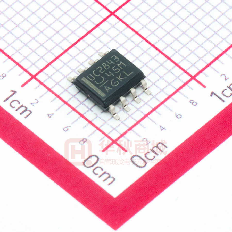

UC2843D8TR 数据手册
UC1842, UC2842, UC3842, UC1843, UC2843, UC3843 UC1844, UC2844, UC3844, UC1845, UC2845, UC3845 SLUS223G – APRIL 1997 – REVISED JULY 2022 UCx84x Current-Mode PWM Controllers The UCx84x family offers a variety of package options, temperature range options, choice of maximum duty cycle, and choice of turnon and turnoff thresholds and hysteresis ranges. Devices with higher turnon or turnoff hysteresis are ideal choices for offline power supplies, while the devices with a narrower hysteresis range are suited for DC-DC applications. The UC184x devices are specified for operation from –55°C to 125°C, the UC284x series is specified for operation from –40°C to 85°C, and the UC384x series is specified for operation from 0°C to 70°C. 1 Features • • • • • • • • • • • Optimized for off-line and DC-to-DC converters Low start-up current (< 1 mA) Automatic feedforward compensation Pulse-by-pulse current limiting Enhanced load-response characteristics Undervoltage lockout with hysteresis Double-pulse suppression High-current totem-pole output Internally trimmed bandgap reference Up to 500-kHz operation Error amplifier with low output resistance Device Information(1) 2 Applications • • Switching regulators of any polarity Transformer-coupled DC-DC converters 3 Description PART NUMBER PACKAGE (PIN) BODY SIZE (NOM) CDIP (8) 9.60 mm × 6.67 mm UC184x LCCC (20) 8.89 mm × 8.89 mm UC284x The UCx84x series of control integrated circuits provide the features that are necessary to implement off-line or DC-to-DC fixed-frequency current-mode control schemes, with a minimum number of external components. The internally implemented circuits include an undervoltage lockout (UVLO), featuring a start-up current of less than 1 mA, and a precision reference trimmed for accuracy at the error amplifier input. Other internal circuits include logic to ensure latched operation, a pulse-width modulation (PWM) comparator that also provides current-limit control, and a totem-pole output stage that is designed to source or sink high-peak current. The output stage, suitable for driving N-channel MOSFETs, is low when it is in the off state. UC384x (1) CFP (8) 9.21 mm × 5.97 mm SOIC (8) 4.90 mm × 3.91 mm SOIC (14) 8.65 mm × 3.91 mm PDIP (8) 9.81 mm × 6.35 mm SOIC (8) 4.90 mm × 3.91 mm SOIC (14) 8.65 mm × 3.91 mm PDIP (8) 9.81 mm × 6.35 mm CFP (8) 9.21 mm × 5.97 mm For all available packages, see the orderable addendum at the end of the datasheet. VIN VCC OUTPUT VREF ISENSE UC2843 VFB RT/CT GROUND COMP Copyright © 2016, Texas Instruments Incorporated Simplified Application An IMPORTANT NOTICE at the end of this data sheet addresses availability, warranty, changes, use in safety-critical applications, intellectual property matters and other important disclaimers. PRODUCTION DATA. UC1842, UC2842, UC3842, UC1843, UC2843, UC3843 UC1844, UC2844, UC3844, UC1845, UC2845, UC3845 www.ti.com SLUS223G – APRIL 1997 – REVISED JULY 2022 Table of Contents 1 Features............................................................................1 2 Applications..................................................................... 1 3 Description.......................................................................1 4 Revision History.............................................................. 2 5 Device Comparison Table...............................................3 6 Pin Configuration and Functions...................................3 7 Specifications.................................................................. 6 7.1 Absolute Maximum Ratings........................................ 6 7.2 ESD Ratings............................................................... 6 7.3 Recommended Operating Conditions.........................6 7.4 Thermal Information....................................................6 7.5 Electrical Characteristics.............................................7 7.6 Typical Characteristics................................................ 9 8 Detailed Description...................................................... 11 8.1 Overview................................................................... 11 8.2 Functional Block Diagrams....................................... 11 8.3 Feature Description...................................................12 8.4 Device Functional Modes..........................................20 9 Application and Implementation.................................. 21 9.1 Application Information............................................. 21 9.2 Typical Application.................................................... 21 10 Power Supply Recommendations..............................34 11 Layout........................................................................... 35 11.1 Layout Guidelines................................................... 35 11.2 Layout Example...................................................... 36 12 Device and Documentation Support..........................37 12.1 Receiving Notification of Documentation Updates..37 12.2 Support Resources................................................. 37 12.3 Trademarks............................................................. 37 12.4 Electrostatic Discharge Caution..............................37 12.5 Glossary..................................................................37 13 Mechanical, Packaging, and Orderable Information.................................................................... 37 4 Revision History NOTE: Page numbers for previous revisions may differ from page numbers in the current version. Changes from Revision F (April 2020) to Revision G (July 2022) Page • Updated the numbering format for tables, figures and cross-references throughout the document...................1 Changes from Revision E (January 2017) to Revision F (April 2020) Page • Changed UVLO Table updated ..........................................................................................................................7 2 Submit Document Feedback Copyright © 2022 Texas Instruments Incorporated Product Folder Links: UC1842 UC2842 UC3842 UC1843 UC2843 UC3843 UC1844 UC2844 UC3844 UC1845 UC2845 UC3845 UC1842, UC2842, UC3842, UC1843, UC2843, UC3843 UC1844, UC2844, UC3844, UC1845, UC2845, UC3845 www.ti.com SLUS223G – APRIL 1997 – REVISED JULY 2022 5 Device Comparison Table UVLO TURNON AT 16 V TURNOFF AT 10 V SUITABLE FOR OFF-LINE APPLICATIONS TURNON AT 8.4 V TURNOFF AT 7.6 V SUITABLE FOR DC-DC APPLICATIONS UC1842 UC1843 –55°C to 125°C UC2842 UC2843 –40°C to 85°C UC3842 UC3843 0°C to 70°C UC1844 UC1845 –55°C to 125°C UC2844 UC2845 –40°C to 85°C UC3844 UC3845 0°C to 70°C TEMPERATURE RANGE MAX DUTY CYCLE Up to 100% Up to 50% 6 Pin Configuration and Functions COMP 1 8 VREF VFB 2 7 VCC ISENSE 3 6 OUTPUT RT/CT 4 5 GROUND COMP 1 14 VREF NC 2 13 NC VFB 3 12 VCC NC 4 11 VC ISENSE 5 10 OUTPUT NC 6 9 GROUND RT/CT 7 8 PWRGND Figure 6-1. D, JG, and P Packages 8-Pin SOIC, CDIP, and PDIP Top View NC 2 1 20 19 NC COMP 3 VREF NC Figure 6-2. D and W Packages 14-Pin SOIC and CFP Top View NC 4 18 VCC VFB 5 17 VC NC 6 16 NC ISENSE 7 15 OUTPUT NC 8 14 NC GROUND NC PWRGND NC RT/CT 9 10 11 12 13 Figure 6-3. FK Package 20-Pin LCCC Top View Table 6-1. Pin Functions PIN NAME COMP SOIC, CDIP, PDIP (8) 1 SOIC, CFP (14) 1 Copyright © 2022 Texas Instruments Incorporated LCCC (20) 2 TYPE DESCRIPTION O Error amplifier compensation pin. Connect external compensation components to this pin to modify the error amplifier output. The error amplifier is internally current-limited so the user can command zero duty cycle by externally forcing COMP to GROUND. Submit Document Feedback Product Folder Links: UC1842 UC2842 UC3842 UC1843 UC2843 UC3843 UC1844 UC2844 UC3844 UC1845 UC2845 UC3845 3 UC1842, UC2842, UC3842, UC1843, UC2843, UC3843 UC1844, UC2844, UC3844, UC1845, UC2845, UC3845 www.ti.com SLUS223G – APRIL 1997 – REVISED JULY 2022 Table 6-1. Pin Functions (continued) PIN SOIC, CDIP, PDIP (8) SOIC, CFP (14) LCCC (20) TYPE GROUND 5 9 13 G Analog ground. For device packages without PWRGND, GROUND functions as both power ground and analog ground. PWRGND — 8 12 G Power ground. For device packages without PWRGND, GROUND functions as both power ground and analog ground ISENSE 3 5 7 I Primary-side current sense pin. Connect to current sensing resistor. The PWM uses this signal to terminate the OUTPUT switch conduction. A voltage ramp can be applied to this pin to run the device with a voltage-mode control configuration. NC — 2, 4, 6, 13 1, 3, 4, 6, 8, 9, 11, 14, 16, 19 — Do not connect O OUTPUT is the gate drive for the external MOSFET. OUTPUT is the output of the on-chip driver stage intended to directly drive a MOSFET. Peak currents of up to 1 A are sourced and sunk by this pin. OUTPUT is actively held low when VCC is below the turnon threshold. NAME OUTPUT 6 10 15 DESCRIPTION Fixed frequency oscillator set point. Connect timing resistor, RRT, to VREF and timing capacitor, CCT, to GROUND from this pin to set the switching frequency. For best performance, keep the timing capacitor lead to the device GROUND as short and direct as possible. If possible, use separate ground traces for the timing capacitor and all other functions. The frequency of the oscillator can be estimated with the following equations: RT/CT 4 7 10 I/O 1.72 fOSC = RRT × CCT (1) where fOSC is in Hertz, RRT is in Ohms and CCT is in Farads. Never use a timing resistor less than 5 kΩ. The frequency of the OUTPUT gate drive of the UCx842 and UCx843, fSW, is equal to fOSC at up to 100% duty cycle; the frequency of the UCx844 and UCx845 is equal to half of the fOSC frequency at up to 50% duty cycle. VC — 11 17 I Bias supply input for the output gate drive. For PWM controllers that do not have this pin, the gate driver is biased from the VCC pin. VC must have a bypass capacitor at least 10 times greater than the gate capacitance of the main switching FET used in the design. Analog controller bias input that provides power to the device. Total VCC current is the sum of the quiescent VCC current and the average OUTPUT current. Knowing the switching frequency and the MOSFET gate charge, Qg, the average OUTPUT current can be calculated from: VCC 7 12 18 I IOUTPUT = Q g × fSW (2) A bypass capacitor, typically 0.1 µF, connected directly to GROUND with minimal trace length, is required on this pin. An additional bypass capacitor at least 10 times greater than the gate capacitance of the main switching FET used in the design is also required on VCC. VFB 4 2 Submit Document Feedback 3 5 I Inverting input to the internal error amplifier. VFB is used to control the power converter voltage-feedback loop for stability. Copyright © 2022 Texas Instruments Incorporated Product Folder Links: UC1842 UC2842 UC3842 UC1843 UC2843 UC3843 UC1844 UC2844 UC3844 UC1845 UC2845 UC3845 UC1842, UC2842, UC3842, UC1843, UC2843, UC3843 UC1844, UC2844, UC3844, UC1845, UC2845, UC3845 www.ti.com SLUS223G – APRIL 1997 – REVISED JULY 2022 Table 6-1. Pin Functions (continued) PIN NAME VREF SOIC, CDIP, PDIP (8) 8 SOIC, CFP (14) 14 Copyright © 2022 Texas Instruments Incorporated LCCC (20) 20 TYPE O DESCRIPTION 5-V reference voltage. VREF is used to provide charging current to the oscillator timing capacitor through the timing resistor. It is important for reference stability that VREF is bypassed to GROUND with a ceramic capacitor connected as close to the pin as possible. A minimum value of 0.1-µF ceramic is required. Additional VREF bypassing is required for external loads on VREF. Submit Document Feedback Product Folder Links: UC1842 UC2842 UC3842 UC1843 UC2843 UC3843 UC1844 UC2844 UC3844 UC1845 UC2845 UC3845 5 UC1842, UC2842, UC3842, UC1843, UC2843, UC3843 UC1844, UC2844, UC3844, UC1845, UC2845, UC3845 www.ti.com SLUS223G – APRIL 1997 – REVISED JULY 2022 7 Specifications 7.1 Absolute Maximum Ratings over operating free-air temperature range (unless otherwise noted)(1) MIN MAX UNIT 30 V 6.3 V Low impedance source VVCC IVCC < 30 mA Self Limiting VVFB and VISENSE Analog input voltage VVC Input Voltage, Q and D Package only 30 V IOUTPUT Output drive current ±1 A ICOMP Error amplifier output sink current 10 mA EOUTPUT Output energy (capacitive load) 5 µJ TJ Junction temperature 150 °C Tstg Storage temperature 150 °C (1) –0.3 –65 Stresses beyond those listed under Absolute Maximum Ratings may cause permanent damage to the device. These are stress ratings only, which do not imply functional operation of the device at these or any other conditions beyond those indicated under Section 7.3. Exposure to absolute-maximum-rated conditions for extended periods may affect device reliability. 7.2 ESD Ratings VALUE V(ESD) (1) (2) Electrostatic discharge Human body model (HBM), per ANSI/ESDA/JEDEC JS-001, all pins(1) ±3000 Charged device model (CDM), per JEDEC specification JESD22-C101, all pins(2) ±3000 UNIT V JEDEC document JEP155 states that 500-V HBM allows safe manufacturing with a standard ESD control process. JEDEC document JEP157 states that 250-V CDM allows safe manufacturing with a standard ESD control process. 7.3 Recommended Operating Conditions over operating free-air temperature range (unless otherwise noted) MIN VVCC and VVC (1) Supply voltage VVFB VISENSE IVCC Supply current, externally limited IOUTPUT Average output current IVREF Reference output current fOSC Oscillator frequency TA Operating free-air temperature (1) TYP MAX 12 UNIT 28 V Input voltage 2.5 V Input voltage 1 V 25 mA 200 mA 100 –20 mA 500 kHz UC184x –55 125 UC284x –40 85 UC384x 0 70 °C These recommended voltages for VC and POWER GROUND apply only to the D package. 7.4 Thermal Information UCx84x THERMAL 6 METRIC(1) D (SOIC) D (SOIC) P (PDIP) FK (LCCC) 8 PINS 14 PINS 8 PINS 20 PINS UNIT RθJA Junction-to-ambient thermal resistance 104.8 78.2 53.7 — °C/W RθJC(top) Junction-to-case (top) thermal resistance 47.3 37.1 46.7 36.2 °C/W RθJB Junction-to-board thermal resistance 45.9 32.6 31 35.4 °C/W ψJT Junction-to-top characterization parameter 8.2 7.3 17.1 — °C/W ψJB Junction-to-bottom characterization parameter 45.2 32.4 30.9 — °C/W Submit Document Feedback Copyright © 2022 Texas Instruments Incorporated Product Folder Links: UC1842 UC2842 UC3842 UC1843 UC2843 UC3843 UC1844 UC2844 UC3844 UC1845 UC2845 UC3845 UC1842, UC2842, UC3842, UC1843, UC2843, UC3843 UC1844, UC2844, UC3844, UC1845, UC2845, UC3845 www.ti.com SLUS223G – APRIL 1997 – REVISED JULY 2022 7.4 Thermal Information (continued) UCx84x THERMAL RθJC(bottom) (1) METRIC(1) D (SOIC) D (SOIC) P (PDIP) FK (LCCC) 8 PINS 14 PINS 8 PINS 20 PINS — — — 4.1 Junction-to-case (bottom) thermal resistance UNIT °C/W For more information about traditional and new thermal metrics, see the Semiconductor and IC Package Thermal Metrics application report. 7.5 Electrical Characteristics over operating free-air temperature range (unless otherwise noted) –55°C ≤ TA ≤ 125°C for the UC184x; –40°C ≤ TA ≤ 85°C for the UC284x, 0°C ≤ TA ≤ 70°C for the UC384x, VVCC = 15 V(2); 0.1 µF capacitor from VCC to GROUND, 0.1 µF capacitor from VREF to GROUND, RRT = 10 kΩ; CCT = 3.3 nF, TJ = TA. PARAMETER TEST CONDITIONS MIN TYP MAX UC184x and UC284x 4.95 5 5.05 UC384x 4.9 5 5.1 6 20 UNIT REFERENCE SECTION VVREF Reference voltage IVREF = 1 mA, TJ = 25°C Line regulation 12 ≤ VCC ≤ 25 V Load regulation 1 ≤ IVREF ≤ 20 mA Temperature stability See (1) (3) Line, load, temperature (1) Output noise voltage 10 Hz ≤ fOSC ≤ 10 kHz, (1) Long term stability TA = 125°C, 1000 Hrs (1) Total output variation 6 25 mV 0.4 mV/°C 4.9 5.1 UC384x 4.82 5.18 Output short circuit 50 –30 mV 0.2 UC184x and UC284x TJ = 25°C V V μV 5 25 mV –100 –180 mA 52 57 kHz 0.2% 1% OSCILLATOR SECTION fOSC VRT/CT Initial accuracy TJ = 25°C(5) Voltage stability 12 ≤ VCC ≤ 25 V Temperature stability TMIN ≤ TA ≤ TMAX (1) 5% Amplitude Peak-to-peak (1) 1.7 47 V ERROR AMPLIFIER SECTION VVFB IVFB Input voltage VCOMP = 2.5 V Input bias current AVOL UC184x and UC284x 2.45 2.5 2.55 UC384x 2.42 2.5 2.58 UC184x and UC284x –1 UC384x –2 V µA 2 ≤ VCOMP ≤ 4 V 65 90 dB Unity gain bandwidth TJ = 25°C (1) 0.7 1 MHz PSRR Power supply rejection ratio 12 ≤ VCC ≤ 25 V 60 70 dB I(snk) COMP sink current VVFB = 2.7 V, VCOMP = 1.1 V 2 6 I(src) COMP source current VVFB = 2.3 V, VCOMP = 5 V –0.5 –0.8 VCOMP High High-level output voltage VVFB = 2.3 V, RL = 15-kΩ COMP to GROUND 5 6 VCOMP Low Low-level output voltage VVFB = 2.7 V, RL = 15-kΩ COMP to VREF 0.7 mA V 1.1 CURRENT SENSE SECTION Copyright © 2022 Texas Instruments Incorporated Submit Document Feedback Product Folder Links: UC1842 UC2842 UC3842 UC1843 UC2843 UC3843 UC1844 UC2844 UC3844 UC1845 UC2845 UC3845 7 UC1842, UC2842, UC3842, UC1843, UC2843, UC3843 UC1844, UC2844, UC3844, UC1845, UC2845, UC3845 www.ti.com SLUS223G – APRIL 1997 – REVISED JULY 2022 7.5 Electrical Characteristics (continued) over operating free-air temperature range (unless otherwise noted) –55°C ≤ TA ≤ 125°C for the UC184x; –40°C ≤ TA ≤ 85°C for the UC284x, 0°C ≤ TA ≤ 70°C for the UC384x, VVCC = 15 V(2); 0.1 µF capacitor from VCC to GROUND, 0.1 µF capacitor from VREF to GROUND, RRT = 10 kΩ; CCT = 3.3 nF, TJ = TA. PARAMETER TEST CONDITIONS MIN TYP MAX UNIT 2.85 3 3.15 V/V 0.9 1 1.1 V –2 –10 µA VISENSE stepped from 0 V to 2 V (1) 150 300 ns ISINK = 20 mA 0.1 0.4 ISINK = 200 mA 1.5 2.2 (4) (6) ACS Gain See VISENSE Maximum input signal VCOMP = 5 V (4) PSRR Power supply rejection ratio IISENSE Input bias current tDLY Delay to output 12 V ≤ VVCC ≤ 25 V (1) (4) 70 dB OUTPUT SECTION VOUT Low Low-level OUTPUT voltage VOUT High High-level OUTPUT voltage tRISE Rise time (1) COUTPUT = 1 nF, TJ = 25°C 50 150 ns tFALL Fall time (1) COUTPUT = 1 nF, TJ = 25°C, 50 150 ns 16 17 ISOURCE = 20 mA 13 13.5 ISOURCE = 200 mA 12 13.5 V V UNDERVOLTAGE LOCKOUT (UVLO) UC1842/4 and UC2842/4 VCCON Enable threshold UC3842/4 14.5 16 17.5 UCx843/5 7.8 8.4 9 UC1842/4 and UC2842/4 VCCOFF UVLO off threshold 15 9 10 11 UC3842/4 8.5 10 11.5 UCx843/5 7 7.6 8.2 UCx842/3 95% 97% 100% UC1844/5 and UC2844/5 46% 48% 50% UC3844/5 47% 48% 50% V V PWM DMAX DMIN Maximum duty cycle Minimum duty cycle 0% TOTAL STANDBY CURRENT IVCC Start-up current IVCC Operating supply current VVFB = VISENSE= 0 V VCC Zener voltage IVCC = 25 mA (1) (2) (3) (6) 8 1 11 17 34 mA V Specified by design. Not production tested. Adjust VCC above the start threshold before setting at 15 V Temperature stability, sometimes referred to as average temperature coefficient, is described by the equation: Temp Stability = (4) (5) 30 0.5 VREF:max ; F VREF:min ; TJ:max ; F TJ:min ; VREFmin and VREFmax are the maximum and minimum reference voltages measured over the appropriate temperature range. Note that the extremes in voltage do not necessarily occur at the extremes in temperature. Parameter measured at trip point of latch with VFB = 0 V. OUTPUT switching frequency, fSW, equals the oscillator frequency, fOSC, for the UCx842 and UCx843. OUTPUT switching frequency, fSW, is one half oscillator frequency, fOSC, for the UCx844 and UCx845. Gain defined as: A = ΔVCOMP/ΔVISENSE, 0 V ≤ VISENSE ≤ 0.8 V. Submit Document Feedback Copyright © 2022 Texas Instruments Incorporated Product Folder Links: UC1842 UC2842 UC3842 UC1843 UC2843 UC3843 UC1844 UC2844 UC3844 UC1845 UC2845 UC3845 UC1842, UC2842, UC3842, UC1843, UC2843, UC3843 UC1844, UC2844, UC3844, UC1845, UC2845, UC3845 www.ti.com SLUS223G – APRIL 1997 – REVISED JULY 2022 7.6 Typical Characteristics 1.1 VTH, Current Sense Input Threshold (V) 9.2 9 8.6 8.4 8.2 8 7.8 7.6 -25 0 25 50 75 Temperature (C) 100 125 0.5 0.4 0.3 0.2 TA = 125qC TA = 25qC TA = 55qC 0.1 1 60 150 100 40 50 20 0 0 -50 1000 10000 100000 1000000 Freq (Hz) D003 9 -2 8 -3 -6 7 Source Saturation at 25 C Source Saturation at -55 C 6 Sink Saturation at -55 C 5 Sink Saturation at 25 C 4 -7 3 -8 2 -9 1 -4 -5 0 Reference Voltage Delta (mV) 60 40 -75 100 200 300 400 500 600 IO, Output Load Current (mA) 700 0 800 D005 Figure 7-4. OUTPUT Saturation Voltage vs Load Current for VCC = 15 V with 5-ms Input Pulses -10 80 D005 10 160 100 6 0 0 120 5.5 -1 180 140 2.5 3 3.5 4 4.5 5 VO, Error Amp Output Voltage (V) -10 -100 1E+7 Figure 7-3. Error Amplifier Open-Loop Gain and Phase vs Frequency, VCC = 15 V, RL = 100 kΩ, and TA = 25 °C 2 Figure 7-2. Current Sense Input Threshold vs Error Amplifier Output Voltage for VCC = 15 V 200 Gain Phase 100 1.5 D001 80 Gain (dB) 0.6 150 100 ISC (mA) 0.7 0 -50 Figure 7-1. Oscillator Discharge Current vs Temperature for VCC = 15 V and VOSC = 2 V -20 10 0.8 Sink Saturation Voltage (V) 7.4 -75 Source Saturation Voltage (V) IDISCHARGE (mA) 8.8 1 0.9 Ta = 125 C Ta = 25 C Ta = -40 C -20 -30 -40 -50 -60 -50 -25 0 25 50 75 Temperature (C) 100 125 150 D006 Figure 7-5. VREF Short-Circuit Current vs Temperature for VCC = 15 V Copyright © 2022 Texas Instruments Incorporated 0 20 40 60 80 100 Source Current (mA) 120 140 160 D007 Figure 7-6. VREF Voltage vs Source Current Submit Document Feedback Product Folder Links: UC1842 UC2842 UC3842 UC1843 UC2843 UC3843 UC1844 UC2844 UC3844 UC1845 UC2845 UC3845 9 UC1842, UC2842, UC3842, UC1843, UC2843, UC3843 UC1844, UC2844, UC3844, UC1845, UC2845, UC3845 www.ti.com SLUS223G – APRIL 1997 – REVISED JULY 2022 7.6 Typical Characteristics (continued) 5.2 4 Source, TA = 25°C 5.15 Sink, TA = 25°C Saturation Voltage (V) VREF (V) 5.1 5.05 5 4.95 4.9 Source, TA = ±55°C 3 Sink, TA = ±55°C 2 1 4.85 4.8 -75 -50 -25 0 25 50 75 Temperature (C) 100 125 0 0.01 150 0.1 D008 1 Output Current (A) Figure 7-7. VREF Voltage vs Temperature Figure 7-8. Output Saturation 30 tDEADTIME (Ps) 10 5 1 0.5 0.3 1 5 10 CCT (nF) 50 100 D006 Figure 7-9. Dead Time vs Timing Capacitance, CCT Timing Resistance (NŸ) 100 50 20 CCT (nF) 10 100 47 22 10 4.7 2.2 1 5 2 1 100 1000 10 k 100 k 1M Frequency (Hz) Figure 7-10. Timing Resistance, RRT, vs Frequency 10 Submit Document Feedback Copyright © 2022 Texas Instruments Incorporated Product Folder Links: UC1842 UC2842 UC3842 UC1843 UC2843 UC3843 UC1844 UC2844 UC3844 UC1845 UC2845 UC3845 UC1842, UC2842, UC3842, UC1843, UC2843, UC3843 UC1844, UC2844, UC3844, UC1845, UC2845, UC3845 www.ti.com SLUS223G – APRIL 1997 – REVISED JULY 2022 8 Detailed Description 8.1 Overview The UCx84x series of control integrated circuits provide the features necessary to implement AC-DC or DC-toDC fixed-frequency current-mode control schemes with a minimum number of external components. Protection circuitry includes undervoltage lockout (UVLO) and current limiting. Internally implemented circuits include a start-up current of less than 1 mA, a precision reference trimmed for accuracy at the error amplifier input, logic to ensure latched operation, a pulse-width modulation (PWM) comparator that also provides current-limit control, and a totem-pole output stage designed to source or sink high-peak current. The output stage, suitable for driving N-channel MOSFETs, is low when it is in the off-state. Major differences between members of these series are the UVLO thresholds, acceptable ambient temperature range, and maximum duty-cycle. Typical UVLO thresholds of 16 V (ON) and 10 V (OFF) on the UCx842 and UCx844 devices make them ideally suited to off-line AC-DC applications. The corresponding typical thresholds for the UCx843 and UCx845 devices are 8.4 V (ON) and 7.6 V (OFF), making them ideal for use with regulated input voltages used in DC-DC applications. The UCx842 and UCx843 devices operate to duty cycles approaching 100%. The UCx844 and UCx845 obtain a duty-cycle range of 0% to 50% by the addition of an internal toggle flip-flop, which blanks the output off every other clock cycle. The UC184x-series devices are characterized for operation from –55°C to 125°C. UC284x-series devices are characterized for operation from −40°C to 85°C. The UC384x devices are characterized for operation from 0°C to 70°C. 8.2 Functional Block Diagrams VCC UVLO 34 V 5-V Reference EN GROUND VREF Internal Bias VC 2.5 V VREF Good Logic RT/CT VFB Osc OUTPUT S 2R + E/A PWRGND R R 1V PWM Latch PWM Comparator COMP ISENSE UCx842 UCx843 Copyright © 2016, Texas Instruments Incorporated Figure 8-1. UCx842 and UCx843 Block Diagram, No Toggle Copyright © 2022 Texas Instruments Incorporated Submit Document Feedback Product Folder Links: UC1842 UC2842 UC3842 UC1843 UC2843 UC3843 UC1844 UC2844 UC3844 UC1845 UC2845 UC3845 11 UC1842, UC2842, UC3842, UC1843, UC2843, UC3843 UC1844, UC2844, UC3844, UC1845, UC2845, UC3845 www.ti.com SLUS223G – APRIL 1997 – REVISED JULY 2022 VCC UVLO 34 V 5-V Reference EN GROUND VREF Internal Bias VC 2.5 V VREF Good Logic RT/CT Osc VFB S 2R + E/A OUTPUT T PWRGND R R 1V PWM Latch PWM Comparator COMP ISENSE UCx844 UCx845 Copyright © 2016, Texas Instruments Incorporated Figure 8-2. UCx844 and UCx845 Block Diagram, Toggle 8.3 Feature Description 8.3.1 Detailed Pin Description 8.3.1.1 COMP The error amplifier in the UCx84x family is an open collector in parallel with a current source, with a unity-gain bandwidth of 1 MHz. The COMP terminal can both source and sink current. The error amplifier is internally current-limited, so that one can command zero duty cycle by externally forcing COMP to GROUND. 8.3.1.2 VFB VFB is the inverting input of the error amplifier. VFB is used to control the power converter voltage-feedback loop for stability. For best stability, keep VFB lead length as short as possible and VFB stray capacitance as small as possible. 8.3.1.3 ISENSE The UCx84x current sense input connects to the PWM comparator. Connect ISENSE to the MOSFET source current sense resistor. The PWM uses this signal to terminate the OUTPUT switch conduction. A voltage ramp can be applied to this pin to run the device with a voltage mode control configuration or to add slope compensation. To prevent false triggering due to leading edge noises, an RC current sense filter may be required. The gain of the current sense amplifier is typically 3 V/V. 8.3.1.4 RT/CT RT/CT is the oscillator timing pin. For fixed frequency operation, set the timing capacitor charging current by connecting a resistor from VREF to RT/CT. Set the frequency by connecting timing capacitor from RT/CT to GROUND. For the best performance, keep the timing capacitor lead to GROUND as short and direct as possible. If possible, use separate ground traces for the timing capacitor and all other functions. The UCx84x’s oscillator allows for operation to 500 kHz. The device uses an external resistor to set the charging current for the external capacitor, which determines the oscillator frequency. The recommended range of timing 12 Submit Document Feedback Copyright © 2022 Texas Instruments Incorporated Product Folder Links: UC1842 UC2842 UC3842 UC1843 UC2843 UC3843 UC1844 UC2844 UC3844 UC1845 UC2845 UC3845 UC1842, UC2842, UC3842, UC1843, UC2843, UC3843 UC1844, UC2844, UC3844, UC1845, UC2845, UC3845 www.ti.com SLUS223G – APRIL 1997 – REVISED JULY 2022 resistor values is between 5 kΩ and 100 kΩ; the recommended range of timing capacitor values is between 1 nF and 100 nF. 1.72 fOSC = RRT × CCT (3) In this equation, the switching frequency, fSW is in Hz, RRT is in Ω, and CCT is in Farads. 8.3.1.5 GROUND GROUND is the signal and power returning ground. TI recommends separating the signal return path and the high current gate driver path so that the signal is not affected by the switching current. 8.3.1.6 OUTPUT The high-current bipolar totem-pole output of the UCx84x devices sinks or sources up to 1-A peak of current. The OUTPUT pin can directly drive a MOSFET. The OUTPUT of the UCx842 and UCx843 devices switches at the same frequency as the oscillator and can operate near 100% duty cycle. In the UCx844 and UCx845 devices, the switching frequency of OUTPUT is one-half that of the oscillator due to an internal T flipflop. This limits the maximum duty cycle in the UCx844 and UCx845 to < 50%. Schottky diodes may be necessary on the OUTPUT pin to prevent overshoot and undershoot due to high impedance to the supply rail and to ground, respectively. A bleeder resistor, placed between the gate and the source of the MOSFET, should be used to prevent activating the power switch with extraneous leakage currents during undervoltage lockout. An external clamp circuit may be necessary to prevent overvoltage stress on the MOSFET gate when VCC exceeds the gate voltage rating. 8.3.1.7 VCC VCC is the power input connection for this device. In normal operation, power VCC through a current-limiting resistor. Although quiescent VCC current is only 0.5 mA, the total supply current is higher, depending on the OUTPUT current. Total VCC current is the sum of quiescent VCC current and the average OUTPUT current. Knowing the operating frequency and the MOSFET gate charge (Qg), average OUTPUT current can be calculated from Equation 4. IOUTPUT = Q g × fSW (4) The UCx84x has a VCC supply voltage clamp of 34 V typical, but the absolute maximum value for VCC from a low-impedance source is 30 V. For applications that have a higher input voltage than the recommended VCC voltage, place a resistor in series with VCC to increase the source impedance. The maximum value of this resistor is calculated with Equation 5. R VCC :max ; = VIN :min ; F VVCC :max ; IVCC + kQ g × fSW o (5) In Equation 5, VIN(min) is the minimum voltage that is used to supply VCC, VVCC(max) is the maximum VCC clamp voltage and IVCC is the IC supply current without considering the gate driver current and Qg is the external power MOSFET gate charge and fSW is the switching frequency. The turnon and turnoff thresholds for the UCx84x family are significantly different: 16 V and 10 V for the UCx842 and UCx844; 8.4 V and 7.6 V for the UCx843 and UCx855. To ensure against noise related problems, filter VCC with an electrolytic and bypass with a ceramic capacitor to ground. Keep the capacitors close to the IC pins. 8.3.1.8 VREF VREF is the voltage reference for the error amplifier and also for many other internal circuits in the IC. The high-speed switching logic uses VREF as the logic power supply. The 5-V reference tolerance is ±2% for the UCx84x family. The output short-circuit current is 30 mA. For reference stability and to prevent noise problems with high-speed switching transients, bypass VREF to ground with a ceramic capacitor close to the IC package. Copyright © 2022 Texas Instruments Incorporated Submit Document Feedback Product Folder Links: UC1842 UC2842 UC3842 UC1843 UC2843 UC3843 UC1844 UC2844 UC3844 UC1845 UC2845 UC3845 13 UC1842, UC2842, UC3842, UC1843, UC2843, UC3843 UC1844, UC2844, UC3844, UC1845, UC2845, UC3845 www.ti.com SLUS223G – APRIL 1997 – REVISED JULY 2022 A minimum of 0.1-µF ceramic capacitor is required. Additional VREF bypassing is required for external loads on the reference. An electrolytic capacitor may also be used in addition to the ceramic capacitor. When VCC is greater than 1 V and less than the UVLO threshold, a 5-kΩ resistor pulls VREF to ground. VREF can be used as a logic output indicating power-system status because when VCC is lower than the UVLO threshold, VREF is held low. 8.3.2 Pulse-by-Pulse Current Limiting Pulse-by-pulse limiting is inherent in the current mode control scheme. An upper limit on the peak current can be established by simply clamping the error voltage. Accurate current limiting allows optimization of magnetic and power semiconductor elements while ensuring reliable supply operation. 8.3.3 Current-Sense An external series resistor, RCS, senses the current and converts this current into a voltage that becomes the input to the ISENSE pin. The ISENSE pin is the noninverting input to the PWM comparator. The ISENSE input is compared to a signal proportional to the error amplifier output voltage; the gain of the current sense amplifier is typically 3 V/V. The peak ISENSE current is determined by Equation 6: ISENSE = VISENSE R CS (6) The typical value for VISENSE is 1 V. A small RC filter, RCSF and CCSF, may be required to suppress switch transients caused by the reverse recovery of a secondary side diode or equivalent capacitive loading in addition to parasitic circuit impedances. The time constant of this filter should be considerably less than the switching period of the converter. Error Amplifier COMP 2R R ISENSE RCSF RCS 1V PWM Comparator ISENSE CCSF GROUND Copyright © 2016, Texas Instruments Incorporated Figure 8-3. Current-Sense Circuit Schematic 8.3.4 Error Amplifier With Low Output Resistance The error amplifier output is an open collector in parallel with a current source. With a low output resistance, various impedance networks may be used on the compensation pin input for error amplifier feedback. The error amplifier output, COMP, is frequently used as a control port for secondary-side regulation by using an external secondary-side adjustable voltage regulator, such as a TL431, to send an error signal across the secondary-to-primary isolation boundary through an opto-isolator, in this configuration connect the COMP pin directly to the opto-isolator feedback. On the primary side, the inverting input to the UCx48x error amplifier, VFB, should be connected to GROUND. With VFB tied to GROUND, the error amplifier output, COMP, is forced to its 14 Submit Document Feedback Copyright © 2022 Texas Instruments Incorporated Product Folder Links: UC1842 UC2842 UC3842 UC1843 UC2843 UC3843 UC1844 UC2844 UC3844 UC1845 UC2845 UC3845 UC1842, UC2842, UC3842, UC1843, UC2843, UC3843 UC1844, UC2844, UC3844, UC1845, UC2845, UC3845 www.ti.com SLUS223G – APRIL 1997 – REVISED JULY 2022 high state and sources current, typically 0.8 mA. The opto-isolator must overcome the source current capability to control the COMP pin below the error amplifier output high level, VOH. For primary-side regulation, configure the inverting input to the error amplifier, VFB, with a resistor divider to provide a signal that is proportional to the converter output voltage being regulated. Add the voltage loop compensation components between VFB and COMP. The internal noninverting input to the error amplifier is trimmed to 2.5 V. For best stability, keep VFB lead length as short as possible and minimize the stray capacitance on VFB. The internal resistor divider on COMP is maintained at an R:2R ratio, the specific values of these internal resistors should not be critical in any application. 0.5 mA 2.5 V + 2R Error Amplifier R ZI s VFB ZF 1V PWM Comparator COMP ISENSE Error amplifier can source or sink up to 0.5 mA. Figure 8-4. Error-Amplifier Configuration Schematic 8.3.5 Undervoltage Lockout The UCx84x devices feature undervoltage lockout protection circuits for controlled operation during power-up and power-down sequences. The UVLO circuit insures that VCC is adequate to make the UCx84x fully operational before enabling the output stage. Undervoltage lockout thresholds for the UCx842, UCx843, UCx844, and UCx845 devices are optimized for two groups of applications: off-line power supplies and DC-DC converters. The 6-V hysteresis in the UCx842 and UCx844 devices prevents VCC oscillations during power sequencing. This wider VCCON to VCCOFF range, make these devices ideally suited to off-line AC input applications. The UCx843 and UCx845 controllers have a much narrower VCCON to VCCOFF hysteresis and may be used in DC to DC applications where the input is considered regulated. Start-up current is less than 1 mA for efficient bootstrapping from the rectified input of an off-line converter, as illustrated by Figure 8-7. During normal circuit operation, VCC is developed from auxiliary winding NA with D BIAS and C VCC. At start-up, however, CVCC must be charged to 16 V through RSTART. With a start-up current of 1 mA, RSTART can be as large as 100 kΩ and still charge CVCC when VAC = 90 V RMS (low line). Power dissipation in RSTART would then be less than 350 mW even under high line (VAC= 130 V RMS) conditions. During UVLO the IC draws less than 1 mA of supply current. Once crossing the turnon threshold the IC supply current increases to a maximum of 17 mA, typically 11 mA, During undervoltage lockout, the output driver is biased to a high impedance state and sinks minor amounts of current. A bleeder resistor, placed between the gate and the source of the MOSFET should be used to prevent activating the power switch with extraneous leakage currents during undervoltage lockout. Copyright © 2022 Texas Instruments Incorporated Submit Document Feedback Product Folder Links: UC1842 UC2842 UC3842 UC1843 UC2843 UC3843 UC1844 UC2844 UC3844 UC1845 UC2845 UC3845 15 UC1842, UC2842, UC3842, UC1843, UC2843, UC3843 UC1844, UC2844, UC3844, UC1845, UC2845, UC3845 www.ti.com SLUS223G – APRIL 1997 – REVISED JULY 2022 VCC < 17 mA ON/OFF Command to rest of device 7 IVCC UCx842 UCx843 UCx844 UCx845 VON (V) 16 8.4 VOFF (V) 10 7.6 < 1 mA VOFF VON VVCC Figure 8-6. UVLO ON and OFF Profile Copyright © 2016, Texas Instruments Incorporated Figure 8-5. UVLO Threshold NP NS RSTART NA DBIAS IVCC • 1mA VAC CIN VCC OUTPUT CVCC 0.1 PF GROUND RCS Figure 8-7. Providing Power to UCx84x 8.3.6 Oscillator The oscillator allows for up to 500-kHz switching frequency. The OUTPUT gate drive is the same frequency as the oscillator in the UCx842 and UCx843 devices and can operate near 100% duty cycle. In the UCx844 and UCx845 devices, the frequency of OUTPUT is one-half that of the oscillator due to an internal T flipflop that blanks the output off every other clock cycle, resulting in a maximum duty cycle for these devices of < 50% of the switching frequency. An external resistor, RRT, connected from VREF to RT/CT sets the charging current for the timing capacitor, CCT, which is connected from RT/CT to GROUND. An RRT value greater than 5 kΩ is recommended on RT/CT to set the positive ramp time of the internal oscillator. Using a value of 5 kΩ or greater for RRT maintains a favorable ratio between the internal impedance and the external oscillator set resistor and results in minimal change in frequency over temperature. Using a value of less the recommended minimum value may result in frequency drift over temperature, part tolerances, or process variations. The peak-to-peak amplitude of the oscillator waveform is 1.7 V in UCx84x devices. The UCx842 and UCx843 have a maximum duty cycle of approximately 100%, whereas the UCx844 and UCx845 are clamped to 50% maximum by an internal toggle flip flop. This duty cycle clamp is advantageous in most flyback and forward converters. For optimum IC performance the dead-time should not exceed 15% of the oscillator clock period. The discharge current, typically 6 mA at room temperature, sets the dead time, see Figure 7-9. During the discharge, or dead time, the internal clock signal blanks the output to the low state. This limits the maximum duty cycle DMAX to: 16 Submit Document Feedback Copyright © 2022 Texas Instruments Incorporated Product Folder Links: UC1842 UC2842 UC3842 UC1843 UC2843 UC3843 UC1844 UC2844 UC3844 UC1845 UC2845 UC3845 UC1842, UC2842, UC3842, UC1843, UC2843, UC3843 UC1844, UC2844, UC3844, UC1845, UC2845, UC3845 www.ti.com SLUS223G – APRIL 1997 – REVISED JULY 2022 DMAX = 1 F :t DEADTIME × fOSC ; (7) Equation 8 applies to UCx842 and UCx843 units because the OUTPUT switches at the same frequency as the oscillator and the maximum duty cycle can be as high as 100%. DMAX = 1 F lt DEADTIME × fOSC p 2 (8) Equation 8 applies to UCx844 and UCx845 units because the OUTPUT switches at half the frequency as the oscillator and the maximum duty cycle can be as high as 50%. When the power transistor turns off, a noise spike is coupled to the oscillator RT/CT terminal. At high duty cycles, the voltage at RT/CT is approaching its threshold level (approximately 2.7 V, established by the internal oscillator circuit) when this spike occurs. A spike of sufficient amplitude prematurely trips the oscillator. To minimize the noise spike, choose CCT as large as possible, remembering that dead time increases with CCT. It is recommended that CCT never be less than approximately 1000 pF. Often the noise which causes this problem is caused by the OUTPUT being pulled below ground at turnoff by external parasitics. This is particularly true when driving MOSFETs. A Schottky diode clamp from GROUND to OUTPUT prevents such output noise from feeding to the oscillator. VREF RRT RT/CT CCT GROUND Copyright © 2016, Texas Instruments Incorporated 1.72 For RRT > 5 kΩ: fOSC = RRT × CCT Figure 8-8. Oscillator Section Schematic 8.3.7 Synchronization The simplest method to force synchronization uses the timing capacitor, CCT, in near standard configuration. Rather than bring CCT to ground directly, a small resistor is placed in series with CCT to ground. This resistor serves as the input for the sync pulse which raises the CCT voltage above the oscillator’s internal upper threshold. The PWM is allowed to run at the frequency set by RRT and CCT until the sync pulse appears. This scheme offers several advantages including having the local ramp available for slope compensation. The UC3842/3/4/5 oscillator must be set to a lower frequency than the sync pulse stream, typically 20% with a 0.5-V pulse applied across the resistor. Copyright © 2022 Texas Instruments Incorporated Submit Document Feedback Product Folder Links: UC1842 UC2842 UC3842 UC1843 UC2843 UC3843 UC1844 UC2844 UC3844 UC1845 UC2845 UC3845 17 UC1842, UC2842, UC3842, UC1843, UC2843, UC3843 UC1844, UC2844, UC3844, UC1845, UC2845, UC3845 www.ti.com SLUS223G – APRIL 1997 – REVISED JULY 2022 VREF RRT RT/CT CCT SYNC 24 O GROUND Figure 8-9. Synchronizing the Oscillator 8.3.8 Shutdown Technique The PWM controller (see Figure 8-10) can be shut down by two methods: either raise the voltage at ISENSE above 1 V or pull the COMP terminal below a voltage two diode drops above ground. Either method causes the output of the PWM comparator to be high (see Figure 8-10). The PWM latch is reset dominant so that the output remains low until the next clock cycle after the shutdown condition at the COMP or ISENSE terminal is removed. In one example, an externally latched shutdown can be accomplished by adding an SCR that resets by cycling VCC below the lower UVLO threshold. At this point, the reference turns off, allowing the SCR to reset. 1 kO VREF COMP SHUTDOWN 30 O SHUTDOWN ISENSE 500 O To Current Sense Resistor Figure 8-10. Shutdown Techniques 8.3.9 Slope Compensation A fraction of the oscillator ramp can be summed resistively with the current-sense signal to provide slope compensation for converters requiring duty cycles over 50% (see Figure 8-11). Note that capacitor CCSF forms a filter with RCSF to suppress the leading-edge switch spikes. 18 Submit Document Feedback Copyright © 2022 Texas Instruments Incorporated Product Folder Links: UC1842 UC2842 UC3842 UC1843 UC2843 UC3843 UC1844 UC2844 UC3844 UC1845 UC2845 UC3845 UC1842, UC2842, UC3842, UC1843, UC2843, UC3843 UC1844, UC2844, UC3844, UC1845, UC2845, UC3845 www.ti.com SLUS223G – APRIL 1997 – REVISED JULY 2022 UCx842 UCx843 VREF 0.1 µF RRT RT/CT CCT RRAMP RCSF ISENSE ISENSE RCS CCSF Copyright © 2016, Texas Instruments Incorporated Figure 8-11. Slope Compensation 8.3.10 Soft Start Upon power up, it is desirable to gradually widen the PWM pulse width starting at zero duty cycle. The UCx84x devices do not have internal soft-start control, but this can be easily implemented externally with three components. An R/C network is used to provide the time constant to control the error amplifier output. A transistor is also used to isolate the components from the normal operation of either node. It also minimizes the loading effects on the RT/CT time constant by amplification through the transistors gain. VREF RSS COMP CSS Figure 8-12. Soft-Start Circuitry 8.3.11 Voltage Mode In duty cycle control (voltage mode), pulse width modulation is attained by comparing the error amplifier output to an artificial ramp. The oscillator timing capacitor CCT is used to generate a sawtooth waveform on both current or voltage mode ICs. To use the UCx84x in a voltage mode configuration, this sawtooth waveform will be input to the current sense input, ISENSE, for comparison to the error voltage at the PWM comparator. This sawtooth is used to determine pulse width instead of the actual primary current in this method. Loop compensation is similar to that of voltage mode controllers with subtle differences due to the low output resistance voltage amplifier in the UCx84x as opposed to a transconductance (current) type amplifier used in traditional voltage Copyright © 2022 Texas Instruments Incorporated Submit Document Feedback Product Folder Links: UC1842 UC2842 UC3842 UC1843 UC2843 UC3843 UC1844 UC2844 UC3844 UC1845 UC2845 UC3845 19 UC1842, UC2842, UC3842, UC1843, UC2843, UC3843 UC1844, UC2844, UC3844, UC1845, UC2845, UC3845 www.ti.com SLUS223G – APRIL 1997 – REVISED JULY 2022 mode controllers. For further reference on topologies and compensation, consult Closing the Feedback Loop (SLUP068). VREF 1N4148 2N2907 RT/CT 2N2222 2.7 k ISENSE 1k CCT Figure 8-13. Current Mode PWM Used as a Voltage Mode PWM 8.4 Device Functional Modes 8.4.1 Normal Operation During normal operating mode, the IC can be used in peak current mode or voltage mode control. When the converter is operating in peak current mode, the controller regulates the converter's peak current and duty cycle. When the IC is used in voltage mode control, the controller regulates the power converter's duty cycle. The regulation of the system's peak current and duty cycle can be achieved with the use of the integrated error amplifier and external feedback circuitry. 8.4.2 UVLO Mode During the system start-up, VCC voltage starts to rise from 0 V. Before the VCC voltage reaches its corresponding turn on threshold, the IC is operating in UVLO mode. In this mode, the VREF pin voltage is not generated. When VCC is above 1 V and below the turnon threshold, the VREF pin is actively pulled low through a 5-kΩ resistor. This way, VREF can be used as a logic signal to indicate UVLO mode. If the bias voltage to VCC drops below the UVLO-off threshold, PWM switching stops and VREF returns to 0 V. The device can be restarted by applying a voltage greater than the UVLO-on threshold to the VCC pin. 20 Submit Document Feedback Copyright © 2022 Texas Instruments Incorporated Product Folder Links: UC1842 UC2842 UC3842 UC1843 UC2843 UC3843 UC1844 UC2844 UC3844 UC1845 UC2845 UC3845 UC1842, UC2842, UC3842, UC1843, UC2843, UC3843 UC1844, UC2844, UC3844, UC1845, UC2845, UC3845 www.ti.com SLUS223G – APRIL 1997 – REVISED JULY 2022 9 Application and Implementation Note Information in the following applications sections is not part of the TI component specification, and TI does not warrant its accuracy or completeness. TI’s customers are responsible for determining suitability of components for their purposes, as well as validating and testing their design implementation to confirm system functionality. 9.1 Application Information The UCx84x controllers are peak current mode pulse width modulators. These controllers have an onboard amplifier and can be used in isolated and non-isolated power supply design. There is an onboard totem pole gate driver capable of delivering 1 A of peak current. This is a high-speed PWM capable of operating at switching frequencies up to 500 kHz. 9.1.1 Open-Loop Test Fixture The following application is an open-loop laboratory test fixture. This circuit demonstrates the setup and use of the UCx84x devices and their internal circuitry. In the open-loop laboratory test fixture (see Figure 9-1), high peak currents associated with loads necessitate careful grounding techniques. Timing and bypass capacitors should be connected close to the GROUND terminal in a single-point ground. The transistor and 5-kΩ potentiometer sample the oscillator waveform and apply an adjustable ramp to the ISENSE terminal. VREF R1 4.7 NŸ UCx842 100 NŸ 1 VREF 8 VCC 1 NŸ E/A Adjust COMP 2 VFB VCC 7 1 NŸ 5 NŸ 3 ISENSE OUTPUT 6 0.1 PF ISENSE Adjust 4.7 NŸ OUTPUT 0.1 PF 4 RT/CT GROUND 5 GROUND CRTCT Copyright © 2016, Texas Instruments Incorporated Figure 9-1. Open-Loop Laboratory Test Fixture 9.2 Typical Application A typical application for the UC2842 in an off-line flyback converter is shown in Figure 9-2. The UC2842 uses an inner current control loop that contains a small current sense resistor which senses the primary inductor current ramp. This current sense resistor transforms the inductor current waveform to a voltage signal that is input directly into the primary side PWM comparator. This inner loop determines the response to input voltage changes. An outer voltage control loop involves comparing a portion of the output voltage to a reference voltage at the input of an error amplifier. When used in an off-line isolated application, the voltage feedback of the Copyright © 2022 Texas Instruments Incorporated Submit Document Feedback Product Folder Links: UC1842 UC2842 UC3842 UC1843 UC2843 UC3843 UC1844 UC2844 UC3844 UC1845 UC2845 UC3845 21 UC1842, UC2842, UC3842, UC1843, UC2843, UC3843 UC1844, UC2844, UC3844, UC1845, UC2845, UC3845 www.ti.com SLUS223G – APRIL 1997 – REVISED JULY 2022 isolated output is accomplished using a secondary-side error amplifier and adjustable voltage reference, such as the TL431. The error signal crosses the primary to secondary isolation boundary using an opto-isolator whose collector is connected to the VREF pin and the emitter is connected to VFB. The outer voltage control loop determines the response to load changes. DCLAMP ~ VIN = 85 VAC to 265 VAC ± DBRIDGE CSS CSNUB 10 nF RSNUB 50 k DOUT + CIN 180 µF ~ RSTART 100 k NS NP DBIAS VOUT 12 V, 4A COUT 2200 µF RVCC 22 NA CVCC 120 µF RSS LP =1.5 mH NP:NS = 10 NP:NA = 10 UC2842 RCOMPp 10 k 1 COMP CCOMPp 10 nF VREF 8 2 VFB 3 RRT 15.4 k VCC 7 ISENSE QSW 4 RT/CT CRAMP 10 nF RG 10 OUTPUT 6 GROUND 5 CVCCbp 0.1 µF CCT 1000 pF CVREF 1 µF RBLEEDER 10 k RCSF 4.2 k RRAMP 24.9 k CCSF 100 pF RP Not Populated RCS 0.75 RLED 1.3 k RTLbias 1k OPTOCOUPLER 10 V RFBG 4.99 k RCOMPz 88.7 k RFBU 9.53 k CCOMPz 0.01 µF ROPTO 1k TL431 RFBB 2.49 k Copyright © 2016, Texas Instruments Incorporated Figure 9-2. Typical Application Design Example Schematic 9.2.1 Design Requirements Table 9-1 illustrates a typical set of performance requirements for an off-line flyback converter capable of providing 48 W at 12-V output voltage from a universal AC input. The design uses peak primary current control in a continuous current mode PWM converter. Table 9-1. Performance Requirements PARAMETER TEST CONDITIONS MIN NOM MAX UNIT 85 115/230 265 VRMS 47 50/60 63 Hz 11.75 12 12.25 V VIN Input Voltage fLINE Line Frequency VOUT Output Voltage IOUT(min) ≤ IOUT ≤ IOUT(max) VRIPPLE Output Ripple Voltage IOUT(min) ≤ IOUT ≤ IOUT(max) IOUT Output Current fSW Switching Frequency 100 η Efficiency 85% 22 Submit Document Feedback 100 0 4 mVpp A kHz Copyright © 2022 Texas Instruments Incorporated Product Folder Links: UC1842 UC2842 UC3842 UC1843 UC2843 UC3843 UC1844 UC2844 UC3844 UC1845 UC2845 UC3845 UC1842, UC2842, UC3842, UC1843, UC2843, UC3843 UC1844, UC2844, UC3844, UC1845, UC2845, UC3845 www.ti.com SLUS223G – APRIL 1997 – REVISED JULY 2022 9.2.2 Detailed Design Procedure This procedure outlines the steps to design an off-line universal input continuous current mode (CCM) flyback converter using the UC2842. See Figure 9-2 for component names referred to in the design procedure. 9.2.2.1 Input Bulk Capacitor and Minimum Bulk Voltage Bulk capacitance may consist of one or more capacitors connected in parallel, often with some inductance between them to suppress differential-mode conducted noise. The value of the input capacitor sets the minimum bulk voltage; setting the bulk voltage lower by using minimal input capacitance results in higher peak primary currents leading to more stress on the MOSFET switch, the transformer, and the output capacitors. Setting the bulk voltage higher by using a larger input capacitor results in higher peak current from the input source and the capacitor itself will be physically larger. Compromising between size and component stresses determines the acceptable minimum input voltage. The total required value for the primary-side bulk capacitance, CIN, is selected based upon the power level of the converter, POUT, the efficiency target, η, the minimum input voltage, VIN(min), and is chosen to maintain an acceptable minimum bulk voltage level, VBULK(min), using Equation 9. CIN = 2 × PIN × F0.25 + VBULK (min ) 1 × arcsin F GG N ¾2 × VIN (min ) 2 2 k2 × VIN (min ) F VBULK (min ) o × fLINE (min ) (9) In this equation, VIN(min) is the RMS value of the minimum AC input voltage, 85 VRMS, whose minimum line frequency is denoted as fLINE(min), equal to 47 Hz. Based on the CIN equation, to achieve a minimum bulk voltage of 75 V, assuming 85% converter efficiency, the bulk capacitor should be larger than 126 µF; 180 µF was chosen for the design, taking into consideration component tolerances and efficiency estimation. 9.2.2.2 Transformer Turns Ratio and Maximum Duty Cycle The transformer design starts with selecting a suitable switching frequency for the given application. The UC2842 is capable of switching up to 500 kHz but considerations such as overall converter size, switching losses, core loss, system compatibility, and interference with communication frequency bands generally determine an optimum frequency that should be used. For this off-line converter, the switching frequency, fSW, is selected to be 110 kHz as a compromise to minimize the transformer size and the EMI filter size, and still have acceptable losses. The transformer primary to secondary turns ratio, NPS, can be selected based on the desired MOSFET voltage rating and the secondary diode voltage rating. Because the maximum input voltage is 265 VRMS, the peak bulk input voltage can be calculated as shown in Equation 10. VBULK (max ) = ¾2 × VIN (max ) N 375 V (10) To minimize the cost of the system, a readily available 650-V MOSFET is selected. Derating the maximum voltage stress on the drain to 80% of its rated value and allowing for a leakage inductance voltage spike of up to 30% of the maximum bulk input voltage, the reflected output voltage should be less than 130 V as shown in Equation 11. VREFLECTED 0.8 u VDS(rated) 1.3 u VBULK(max) 130.2 V (11) The maximum primary to secondary transformer turns ratio, NPS, for a 12 V output can be selected as NPS = VREFLECTED = 10.85 VOUT (12) A turns ratio of NPS = 10 is used in the design example. Copyright © 2022 Texas Instruments Incorporated Submit Document Feedback Product Folder Links: UC1842 UC2842 UC3842 UC1843 UC2843 UC3843 UC1844 UC2844 UC3844 UC1845 UC2845 UC3845 23 UC1842, UC2842, UC3842, UC1843, UC2843, UC3843 UC1844, UC2844, UC3844, UC1845, UC2845, UC3845 www.ti.com SLUS223G – APRIL 1997 – REVISED JULY 2022 The auxiliary winding is used to supply bias voltage to the UC2842. Maintaining the bias voltage above the VCC minimum operating voltage after turn on is required for stabile operation. The minimum VCC operating voltage for the UC2842 version of the controller is 10 V. The auxiliary winding is selected to support a 12-V bias voltage so that it is above the minimum operating level but still keeps the losses low in the IC. The primary to auxiliary turns ratio, NPA, can be calculated from Equation 13: NPA = NPS × VOUT = 10 VBIAS (13) The output diode experiences a voltage stress that is equal to the output voltage plus the reflected input voltage: VDIODE = VBULK :max ; + VOUT = 49.5 V NPS (14) To allow for voltage spikes due to ringing, a Schottky diode with a rated blocking voltage of greater than 60 V is recommended for this design. The forward voltage drop, VF, of this diode is estimated to be equal to 0.6 V To avoid high peak currents, the flyback converter in this design operates in continuous conduction mode. Once NPS has been determined, the maximum duty cycle, DMAX, can be calculated using the transfer function for a CCM flyback converter: DMAX 1 VOUT + VF p×l p =l NPS 1 F DMAX VBULK :min ; DMAX NPS u VOUT VF VBULK(min) NPS u VOUT VF (15) 0.627 (16) Because the maximum duty cycle exceeds 50%, and the design is an off-line (AC-input) application, the UC2842 is best suited for this application. 9.2.2.3 Transformer Inductance and Peak Currents For this design example, the transformer magnetizing inductance is selected based upon the CCM condition. An inductance value that allows the converter to stay in CCM over a wider operating range before transitioning into discontinuous current mode is used to minimize losses due to otherwise high currents and also to decrease the output ripple. The design of the transformer in this example sizes the inductance so the converter enters CCM operation at approximately 10% load and minimum bulk voltage to minimize output ripple. The inductor, LP for a CCM flyback can be calculated using Equation 17. 2 LP = 1 × 2 2 NPS × VOUT p VBULK :min ; + NPS × VOUT 0.1 × PIN × fSW kVBULK :min ; o × l (17) In Equation 17, the input power, PIN, is estimated by dividing the maximum output power, POUT, by the target efficiency, η, and fSW is the switching frequency; for the UC2842 the switching frequency is equal to the oscillator frequency and is set to 110 kHz. Therefore, the transformer inductance should be approximately 1.8 mH; a 1.5-mH inductance is chosen as the magnetizing inductance value for this design. Based on calculated inductor value and the switching frequency, the current stress of the MOSFET and output diode can be calculated. The peak current in the primary-side MOSFET of a CCM flyback can be calculated as shown in Equation 18. 24 Submit Document Feedback Copyright © 2022 Texas Instruments Incorporated Product Folder Links: UC1842 UC2842 UC3842 UC1843 UC2843 UC3843 UC1844 UC2844 UC3844 UC1845 UC2845 UC3845 UC1842, UC2842, UC3842, UC1843, UC2843, UC3843 UC1844, UC2844, UC3844, UC1845, UC2845, UC3845 www.ti.com SLUS223G – APRIL 1997 – REVISED JULY 2022 IPK MOSFET NPS × VOUT VBULK (min ) VBULK :min ; + :NPS × VOUT ; PIN = +n × r NPS × VOUT 2 × Lm fSW VBULK :min ; × VBULK :min ; + :NPS × VOUT ; (18) The MOSFET peak current is 1.36 A. The RMS current of the MOSFET is calculated to be 0.97 A as shown in Equation 19. Therefore, IRFB9N65A is selected to be used as the primary-side switch. IRM S MOSFET DMAX 2 × IPK MOSFET × VBULK (min ) VBULK (min ) 2 DMAX 3 p FF ×l G + kDMAX × IPK MOSFET 2 o =¨ LP × fSW LP × fSW 3 (19) The output diode peak current is equal to the MOSFET peak current reflected to the secondary side. IPK DIODE = NPS × IPK MOSFET = 13.634 A (20) The diode average current is equal to the total output current, 4 A; combined with a required 60-V rating and 13.6-A peak current requirement, a 48CTQ060-1 is selected for the output diode. 9.2.2.4 Output Capacitor The total output capacitance is selected based upon the output voltage ripple requirement. In this design, 0.1% voltage ripple is assumed. Based on the 0.1% ripple requirement, the capacitor value can be selected using Equation 21. NPS × VOUT VBULK :min ; + NPS × VOUT = 1865 JF 0.001 × VOUT × fSW IOUT × COUT R (21) To design for device tolerances, a 2200-µF capacitor was selected. 9.2.2.5 Current Sensing Network The current sensing network consists of the primary-side current sensing resistor, RCS, filtering components RCSF and CCSF, and optional RP. Typically, the direct current sense signal contains a large amplitude leading edge spike associated with the turnon of the main power MOSFET, reverse recovery of the output rectifier, and other factors including charging and discharging of parasitic capacitances. Therefore, CCSF and RCSF form a low-pass filter that provides immunity to suppress the leading edge spike. For this converter, CCSF is chosen to be 100 pF. Without RP, RCS sets the maximum peak current in the transformer primary based on the maximum amplitude of the ISENSE pin, which is specified to be 1 V. To achieve 1.36-A primary side peak current, a 0.75-Ω resistor is chosen for RCS. The high current sense threshold of ISENSE helps to provide better noise immunity to the system but also results in higher losses in the current sense resistor. These current sense losses can be minimized by injecting an offset voltage into the current sense signal using RP. RP and RCSF form a resistor divider network from the current sense signal to the device’s reference voltage, VREF, which adds an offset to the current sense voltage. This technique still achieves current mode control with cycle-by-cycle over-current protection. To calculate required offset value (VOFFSET), use Equation 22. VOFFSET = R CSF × VREF R CSF + R P (22) Once RP is added, adjust the current sense resistor, RCS, accordingly. Copyright © 2022 Texas Instruments Incorporated Submit Document Feedback Product Folder Links: UC1842 UC2842 UC3842 UC1843 UC2843 UC3843 UC1844 UC2844 UC3844 UC1845 UC2845 UC3845 25 UC1842, UC2842, UC3842, UC1843, UC2843, UC3843 UC1844, UC2844, UC3844, UC1845, UC2845, UC3845 www.ti.com SLUS223G – APRIL 1997 – REVISED JULY 2022 9.2.2.6 Gate Drive Resistor RG is the gate driver resistor for the power switch, QSW. The selection of this resistor value must be done in conjunction with EMI compliance testing and efficiency testing. Using a larger resistor value for RG slows down the turnon and turnoff of the MOSFET. A slower switching speed reduces EMI but also increases the switching loss. A trade-off between switching loss and EMI performance must be carefully performed. For this design, a 10-Ω resistor was chosen for the gate drive resistor. 9.2.2.7 VREF Capacitor A precision 5-V reference voltage performs several important functions. The reference voltage is divided down internally to 2.5 V and connected to the error amplifier’s noninverting input for accurate output voltage regulation. Other duties of the reference voltage are to set internal bias currents and thresholds for functions such as the oscillator upper and lower thresholds. Therefore, the reference voltage must be bypassed with a ceramic capacitor (CVREF), a 1-µF, 16-V ceramic capacitor was selected for this converter. Placement of this capacitor on the physical printed-circuit board layout must be as close as possible to the respective VREF and GROUND pins. 9.2.2.8 RT/CT The internal oscillator uses a timing capacitor (CCT) and a timing resistor (RRT) to program the oscillator frequency and maximum duty cycle. The operating frequency can be programmed based the curves in Section 9.2.3, where the timing resistor can be found once the timing capacitor is selected. It is best for the timing capacitor to have a flat temperature coefficient, typical of most COG or NPO type capacitors. For this converter, 15.4 kΩ and 1000 pF were selected for RRT and CCT to operate at 110-kHz switching. 9.2.2.9 Start-Up Circuit At start-up, the IC gets its power directly from the high-voltage bulk, through a high-voltage resistor RSTART. The selection of the start-up resistor is the trade-off between power loss and start-up time. The current flowing through RSTART at the minimum input voltage must be higher than the VCC current under UVLO conditions (1 mA at its maximum value). A resistance of 100-kΩ was chosen for RSTART, providing 1 mA of start-up current at low-line conditions. The start-up resistor is physically comprised of two 50-kΩ resistors in series to meet the high voltage requirements and power rating at high-line. After VCC is charged up above the UVLO-on threshold, the UC2842 starts to consume full operating current. The VCC capacitor is required to provide enough energy to prevent its voltage from dropping below the UVLOoff threshold during start-up, before the output is able to reach its regulated level. A large bulk capacitance would hold more energy but would result in slower start-up time. In this design, a 120-µF capacitor is chosen to provide enough energy and maintain a start-up time of approximately 2 seconds. 9.2.2.10 Voltage Feedback Compensation Feedback compensation, also called closed-loop control, can reduce or eliminate steady state error, reduce the sensitivity of the system to parametric changes, change the gain or phase of a system over some desired frequency range, reduce the effects of small signal load disturbances and noise on system performance, and create a stable system from an unstable system. A system is stable if its response to a perturbation is that the perturbation eventually dies out. A peak current mode flyback uses an outer voltage feedback loop to stabilize the converter. To adequately compensate the voltage loop, the open-loop parameters of the power stage must be determined. 9.2.2.10.1 Power Stage Poles and Zeroes The first step in compensating a fixed frequency flyback is to verify if the converter is continuous conduction mode (CCM) or discontinuous conduction mode (DCM). If the primary inductance, LP, is greater than the inductance for DCM/CCM boundary mode operation, called the critical inductance, or LPcrit, then the converter operates in CCM: LP > LPcrit , then CCM 26 Submit Document Feedback (23) Copyright © 2022 Texas Instruments Incorporated Product Folder Links: UC1842 UC2842 UC3842 UC1843 UC2843 UC3843 UC1844 UC2844 UC3844 UC1845 UC2845 UC3845 UC1842, UC2842, UC3842, UC1843, UC2843, UC3843 UC1844, UC2844, UC3844, UC1845, UC2845, UC3845 www.ti.com SLUS223G – APRIL 1997 – REVISED JULY 2022 2 R OUT × :NPS ;2 VIN p = ×l 2 × fSW VIN + VOUT × NPS LPcrit (24) For the entire input voltage range, the selected inductor has value larger than the critical inductor. Therefore, the converter operates in CCM and the compensation loop requires design based on CCM flyback equations. The current-to-voltage conversion is done externally with the ground-referenced current sense resistor, RCS, and the internal resistor divider of 2R/R which sets up the internal current sense gain, ACS = 3. Note that the exact value of these internal resistors is not critical but the IC provides tight control of the resistor divider ratio, so regardless of the actual resistor value variations their relative value to each other is maintained. The DC open-loop gain, GO, of the fixed-frequency voltage control loop of a peak current mode control CCM flyback converter shown in Equation 25 is approximated by first using the output load, ROUT, the primary to secondary turns ratio, NPS, the maximum duty cycle, D, calculated in Equation 25. GO = R OUT × NPS 1 × 2 :1 F D; R CS × ACS + :2 × M; + 1 RL (25) In Equation 25, D is calculated with Equation 26, τL is calculated with Equation 27, and M is calculated with Equation 28. D= NPS × VOUT VBULKmin + :NPS × VOUT ; RL = M= (26) 2 × LP × fSW R OUT × :NPS ;2 (27) VOUT × NPS VBULKmin (28) For this design, a converter with an output voltage VOUT of 12 V, and 48 W relates to an output load, ROUT, equal to 3 Ω at full load. With a maximum duty cycle calculated to be 0.627, a current sense resistance, RCS, of 0.75 Ω, and a primary to secondary turns-ratio, NPS, of 10, the open-loop gain calculates to 3.082, or 9.776 dB. A CCM flyback has two zeroes that are of interest. The ESR and the output capacitance contribute a left-half plane zero, ωESRz, to the power stage, and the frequency of this zero, fESRz, are calculated with Equation 30. XESRz = R ESR 1 × COUT (29) 1 fESRz = 2 × N × R ESR × COUT (30) The fESRz zero for an output capacitance of 2200 µF and a total ESR of 43 mΩ is located at 1.682 kHz. CCM flyback converters have a zero in the right-half plane, RHP, in their transfer function. A RHP zero has the same 20 dB/decade rising gain magnitude with increasing frequency just like a left-half plane zero, but it adds a 90° phase lag instead of lead. This phase lag tends to limit the overall loop bandwidth. The frequency location, fRHPz, of the RHP zero, ωRHPz, is a function of the output load, the duty cycle, the primary inductance, LP, and the primary to secondary side turns ratio, NPS. XRHPz R OUT × :1 F D;2 × :NPS ;2 = LP × D Copyright © 2022 Texas Instruments Incorporated (31) Submit Document Feedback Product Folder Links: UC1842 UC2842 UC3842 UC1843 UC2843 UC3843 UC1844 UC2844 UC3844 UC1845 UC2845 UC3845 27 UC1842, UC2842, UC3842, UC1843, UC2843, UC3843 UC1844, UC2844, UC3844, UC1845, UC2845, UC3845 www.ti.com SLUS223G – APRIL 1997 – REVISED JULY 2022 fRHPz = R OUT × :1 F D;2 × :NPS ;2 2 × N × LP × D (32) The right-half plane zero frequency increases with higher input voltage and lighter load. Generally, the design requires consideration of the worst case of the lowest right-half plane zero frequency and the converter must be compensated at the minimum input and maximum load condition. With a primary inductance of 1.5 mH, at 75-V DC input, the RHP zero frequency, fRHPz, is equal to 7.07 kHz at maximum duty cycle, full load. The power stage has one dominate pole, ωP1, which is in the region of interest, located at a lower frequency, fP1, which is related to the duty cycle, D, the output load, and the output capacitance, calculated with Equation 34. There is also a double pole placed at half the switching frequency of the converter, fP2 calculated with Equation 36. For this example, pole fP1 is located at 40.37 Hz and fP2 is at 55 kHz. XP1 fP1 :1 F D;3 +1+D RL = R OUT × COUT (33) :1 F D;3 +1+D RL = 2 × N × R OUT × COUT (34) XP2 = N × fSW (35) fSW 2 (36) fP2 = 9.2.2.10.2 Slope Compensation Slope compensation is the large signal sub-harmonic instability that can occur with duty cycles that may extend beyond 50% where the rising primary side inductor current slope may not match the falling secondary side current slope. The sub-harmonic oscillation would result in an increase in the output voltage ripple and may even limit the power handling capability of the converter. The target of slope compensation is to achieve an ideal quality coefficient, QP , to be equal to 1 at half of the switching frequency. The QP is calculated with Equation 37. QP = 1 N × >MC × :1 F D; F 0.5? (37) In Equation 37, D is the primary side switch duty cycle and MC is the slope compensation factor, which is defined with Equation 38. MC = Se +1 Sn (38) In Equation 38, Se is the compensation ramp slope and the Sn is the inductor rising slope. The optimal goal of the slope compensation is to achieve QP equal to 1; upon rearranging Equation 38 the ideal value of slope compensation factor is determined: Mideal 1 + 0.5 N = 1FD (39) For this design to have adequate slope compensation, MC must be 2.193 when D reaches it maximum value of 0.627. 28 Submit Document Feedback Copyright © 2022 Texas Instruments Incorporated Product Folder Links: UC1842 UC2842 UC3842 UC1843 UC2843 UC3843 UC1844 UC2844 UC3844 UC1845 UC2845 UC3845 UC1842, UC2842, UC3842, UC1843, UC2843, UC3843 UC1844, UC2844, UC3844, UC1845, UC2845, UC3845 www.ti.com SLUS223G – APRIL 1997 – REVISED JULY 2022 The inductor rising slope, Sn, at the ISENSE pin is calculated with Equation 40. Sn = VINmin × R CS V = 0.038 Js LP (40) The compensation slope, Se, is calculated with Equation 41. Se = :MC F 1; × Sn = 44.74 mV Js (41) The compensation slope is added into the system through RRAMP and RCSF. The CRAMP is an AC-coupling capacitor that allows the voltage ramp of the oscillator to be used without adding an offset to the current sense; select a value to approximate high frequency short circuit, such as 10 nF as a starting point and make adjustments if required. The RRAMP and RCSF resistors form a voltage divider from the oscillator charge slope and this proportional ramp is injected into the ISENSE pin to add slope compensation. Choose the value of RRAMP to be much larger than the RRT resistor so that it does not load down the internal oscillator and result in a frequency shift. The oscillator charge slope is calculated using the peak-to-peak voltage of the RT/CT sawtooth waveform, VOSCpp, equal to 1.7 V, and the minimum on-time, as shown in Equation 43. D t ONmin = SOSC = fSW (42) VOSCpp 1.7 V mV = = 298 5.7 Js Js t ONmin (43) To achieve a 44.74-mV/µs compensation slope, RCSF resistor is calculated with Equation 44. In this design, RRAMP is selected as 24.9 kΩ, a 4.2-kΩ resistor was selected for RCSF. R CSF = R RAMP SOSC F1 Se (44) 9.2.2.10.3 Open-Loop Gain Once the power stage poles and zeros are calculated and the slope compensation is determined, the power stage open-loop gain and phase of the CCM flyback converter can be plotted as a function of frequency. The power stage transfer function can be characterized with Equation 45. HOPEN :s; = G0 × l1 + s:f; s:f; p × l1 F p 1 XESRz XRHPz × s:f; s:f; s:f;2 1+ 1 + + XP1 XP2 × Q P :XP2 ;2 (45) The bode for the open-loop gain and phase can be plotted by using Equation 46. GainOPEN :s; = 20 × log: HOPEN :s; ; (46) (see Figure 9-3 and Figure 9-4). Copyright © 2022 Texas Instruments Incorporated Submit Document Feedback Product Folder Links: UC1842 UC2842 UC3842 UC1843 UC2843 UC3843 UC1844 UC2844 UC3844 UC1845 UC2845 UC3845 29 UC1842, UC2842, UC3842, UC1843, UC2843, UC3843 UC1844, UC2844, UC3844, UC1845, UC2845, UC3845 www.ti.com SLUS223G – APRIL 1997 – REVISED JULY 2022 10 0 5 -45 Phase (q) Gain (dB) 0 -5 -10 -15 -90 -135 -20 -180 -25 1 10 100 1000 frequency (Hz) 10000 100000 D001 Figure 9-3. Converter Open-Loop Bode Plot - Gain 1 10 100 1000 frequency (Hz) 10000 100000 D002 Figure 9-4. Converter Open-Loop Bode Plot Phase 9.2.2.10.4 Compensation Loop The design of the compensation loop involves selecting the appropriate components so that the required gain, poles, and zeros can be designed to result in a stabile system over the entire operating range. There are three distinct portions of the loop: the TL431, the opto-coupler, and the error amplifier. Each of these stages is combined with the power stage to result in a stable robust system. For good transient response, the bandwidth of the finalized design should be as large as possible. The bandwidth of a CCM flyback, fBW, is limited to ¼ of the RHP zero frequency, or approximately 1.77 kHz using Equation 47. fBW = fRHPz 4 (47) The gain of the open-loop power stage at fBW can be calculated using Equation 46 or can be observed on the Bode plot (Figure 9-3 ) and is equal to –19.55 dB and the phase at fBW is equal to –58°. The secondary side portion of the compensation loop begins with establishing the regulated steady state output voltage. To set the regulated output voltage, a TL431 adjustable precision shunt regulator is ideally suited for use on the secondary side of isolated converters due to its accurate voltage reference and internal op amp. The resistors used in the divider from the output terminals of the converter to the TL431 REF pin are selected based upon the desired power consumption. Because the REF input current for the TL431 is only 2 µA, selecting the resistors for a divider current, IFB_REF, of 1 mA results in minimal error. The top divider resistor, RFBU, is calculated using Equation 48: R FBU = VOUT F REFTL431 IFB _REF (48) The TL431 reference voltage, REFTL431, has a typical value of 2.495 V. A 9.53-kΩ resistor is chosen for RFBU. To set the output voltage to 12 V, 2.49 kΩ is used for RFBB. R FBB = REFTL431 × R FBU VOUT F REFTL431 (49) For good phase margin, a compensator zero, fCOMPz, is needed and should be placed at 1/10th the desired bandwidth: 30 Submit Document Feedback Copyright © 2022 Texas Instruments Incorporated Product Folder Links: UC1842 UC2842 UC3842 UC1843 UC2843 UC3843 UC1844 UC2844 UC3844 UC1845 UC2845 UC3845 UC1842, UC2842, UC3842, UC1843, UC2843, UC3843 UC1844, UC2844, UC3844, UC1845, UC2845, UC3845 www.ti.com SLUS223G – APRIL 1997 – REVISED JULY 2022 fCOMPz = fBW 10 (50) XCOMPz = 2 × N × fCOMPz (51) With this converter, fCOMPz should be set at approximately 177 Hz. A series resistor, RCOMPz, and capacitor, CCOMPz, placed across the TL431 cathode to REF sets the compensator zero location. Setting CCOMPz to 0.01 µF, RCOMPz is calculated using Equation 52: R COMPz = XCOMPz 1 × CCOMPz (52) Using a standard value of 88.7 kΩ for RZ and a 0.01 µF for CZ results in a zero placed at 179 Hz. Referring to Figure 9-2, RTLbias provides cathode current to the TL431 from the regulated voltage provided from the Zener diode, DREG. For robust performance, 10 mA is provided to bias the TL431 by way of the 10-V Zener and 1-kΩ resistor is used for RTLbias. The gain of the TL431 portion of the compensation loop can be written as: GTL431 :s; = lR COMPz + 1 1 p× R FBU s(f) × CZCOMPz (53) A compensation pole is needed at the frequency of right half plane zero or the ESR zero, whichever is lowest. Based previous the analysis, the right half plane zero, fRHPz, is located at 7.07 kHz and the ESR zero, fESRz, is at 1.68 kHz; therefore, for this design, the compensation pole must be put at 1.68 kHz. The opto-coupler contains a parasitic pole that is difficult to characterize over frequency so the opto-coupler is set up with a pulldown resistor, ROPTO equal to 1 kΩ, which moves the parasitic opto-coupler pole further out and beyond the range of interest for this design. The required compensation pole can be added to the primary side error amplifier using RCOMPp and CCOMPp. Choosing RCOMPp as 10 kΩ, the required value of CCOMPp is determined using Equation 54. CCOMPp = 1 2 × N × fESRz × R COMPp = 9.46 nF (54) A 10-nF capacitor is used for CCOMPp setting the compensation pole at 1.59 kHz. Adding a DC gain to the primary side error amplifier may be required to obtain the required bandwidth and helps to adjust the loop gain as needed. Using a 4.99 kΩ for RFBG sets the DC gain on the error amplifier to 2. At this point the gain transfer function of the error amplifier stage, GEA(s), of the compensation loop can be characterized: GEA :s; = l R COMPp 1 p×F G 1 + s:f; × CCOMPp × R COMPp R FBG (55) Using an opto-coupler whose current transfer ratio (CTR) is typically at 100% in the frequency range of interest so that CTR = 1, the transfer function of the opto-coupler stage, GOPTO(s), is equal to: GOPTO (s) = CTR × R OPTO R LED (56) The bias resistor, RLED, to the internal diode of the opto-coupler, and the pulldown resistor on the opto emitter, ROPTO, sets the gain across the isolation boundary. ROPTO has already been set to 1 kΩ but the value of RLED has not yet been determined. Copyright © 2022 Texas Instruments Incorporated Submit Document Feedback Product Folder Links: UC1842 UC2842 UC3842 UC1843 UC2843 UC3843 UC1844 UC2844 UC3844 UC1845 UC2845 UC3845 31 UC1842, UC2842, UC3842, UC1843, UC2843, UC3843 UC1844, UC2844, UC3844, UC1845, UC2845, UC3845 www.ti.com SLUS223G – APRIL 1997 – REVISED JULY 2022 The total closed-loop gain, GTOTAL(s), is the combination of the open-loop power stage, Ho(s), the opto gain, GOPTO(s), the error amplifier gain, GEA(s), and the gain of the TL431 stage, GTL431(s): GTOTAL :s; = HOPEN :s; × GOPTO :s; × GEA :s; × GTL431 :s; (57) The required value for RLED can be selected to achieve the desired crossover frequency, fBW. By setting the total loop gain equal to 1 at the desired crossover frequency and rearranging Equation 57, the optimal value for RLED can be determined, as shown in Equation 58. R LED Q HOPEN :s; × CTR × COPTO × GEA :s; × GTL431 :s; (58) A 1.3-kΩ resistor suits the requirement for RLED. Based on the compensation loop structure, the entire compensation loop transfer function is written as Equation 59. GCLOSED :s; = HOPEN :s; × l ×n R COMPz R COMPp CTR × R OPTO 1 p×l p×F G R LED R FBG 1 + ks × CCOMPp × R COMPp o 1 A +@ s × CCOMPz r R FBU (59) The final closed-loop bode plots are show in Figure 9-5 and Figure 9-6. The converter achieves a crossover frequency of approximately 1.8 kHz and has a phase margin of approximately 67o. TI recommends checking the loop stability across all the corner cases including component tolerances to ensure system stability. 80 0 60 -45 Degrees (q) Gain (dB) 40 20 -90 0 -135 -20 -180 -40 1 10 100 1000 frequency (Hz) 10000 100000 D003 Figure 9-5. Converter Closed-Loop Bode Plot – Gain 32 Submit Document Feedback 1 10 100 1000 frequency (Hz) 10000 100000 D001 D004 Figure 9-6. Converter Closed-Loop Bode Plot – Phase Copyright © 2022 Texas Instruments Incorporated Product Folder Links: UC1842 UC2842 UC3842 UC1843 UC2843 UC3843 UC1844 UC2844 UC3844 UC1845 UC2845 UC3845 UC1842, UC2842, UC3842, UC1843, UC2843, UC3843 UC1844, UC2844, UC3844, UC1845, UC2845, UC3845 www.ti.com SLUS223G – APRIL 1997 – REVISED JULY 2022 9.2.3 Application Curves Figure 9-7. Primary Side MOSFET Drain to Source Voltage at 240-V AC Input (100 V/div) Figure 9-8. Primary Side MOSFET Drain to Source Voltage at 120-V AC Input (100 V/div) Figure 9-9. Output Voltage During 0.9-A to 2.7-A Load Transient (CH1: Output Voltage AC Coupled, 200 mV/div; CH4: Output Current, 1 A/div) Figure 9-10. Output Voltage Ripple at Full Load (100 mV/div) Figure 9-11. Output Voltage Behavior at Full Load Start-Up (5 V/div) Copyright © 2022 Texas Instruments Incorporated Submit Document Feedback Product Folder Links: UC1842 UC2842 UC3842 UC1843 UC2843 UC3843 UC1844 UC2844 UC3844 UC1845 UC2845 UC3845 33 UC1842, UC2842, UC3842, UC1843, UC2843, UC3843 UC1844, UC2844, UC3844, UC1845, UC2845, UC3845 www.ti.com SLUS223G – APRIL 1997 – REVISED JULY 2022 10 Power Supply Recommendations It is important to bypass the ICs supply (VCC) and reference voltage (VREF) pins with a 0.1-µF to 1-µF ceramic capacitor to ground. The capacitors must be placed as close to the actual pin connections as possible for optimal noise filtering. A second, larger filter capacitor may also be required in offline applications to hold the supply voltage (VCC) above the UVLO turnoff threshold during start-up. To prevent false triggering due to leading edge noises, an RC current sense filter may be required on ISENSE. Keep the time constant of the RC filter well below the minimum on-time pulse width. Schottky diodes may be necessary on the OUTPUT pin to prevent overshoot and undershoot due to the high impedance to the supply rail and to ground, respectively. A bleeder resistor, placed between the gate and the source of the MOSFET should be used to prevent activating the power switch with extraneous leakage currents during undervoltage lockout. To prevent noise problems with high-speed switching transients, bypass VREF to ground with a ceramic capacitor close to the IC package. A minimum of 0.1-µF ceramic capacitor is required. Additional VREF bypassing is required for external loads on the reference. An electrolytic capacitor may also be used in addition to the ceramic capacitor. 34 Submit Document Feedback Copyright © 2022 Texas Instruments Incorporated Product Folder Links: UC1842 UC2842 UC3842 UC1843 UC2843 UC3843 UC1844 UC2844 UC3844 UC1845 UC2845 UC3845 UC1842, UC2842, UC3842, UC1843, UC2843, UC3843 UC1844, UC2844, UC3844, UC1845, UC2845, UC3845 www.ti.com SLUS223G – APRIL 1997 – REVISED JULY 2022 11 Layout 11.1 Layout Guidelines 11.1.1 Feedback Traces Try to run the feedback trace as far from the inductor and noisy power traces as possible. Be as direct as possible with the feedback trace and somewhat thick. These two sometimes involve a trade-off, but keeping it away from EMI and other noise sources is the more critical of the two. If possible, run the feedback trace on the side of the PCB opposite of the inductor with a ground plane separating the two. 11.1.2 Bypass Capacitors When using a low value ceramic bypass capacitor, it should be located as close to the VCC pin of the device as possible. This eliminates as much trace inductance effects as possible and gives the internal device rail a cleaner voltage supply. Using surface mount capacitors also reduces lead length and lessens the chance of noise coupling into the effective antenna created by through-hole components. 11.1.3 Compensation Components For best stability, external compensation components should be placed close to the IC. Keep VFB lead length as short as possible and VFB stray capacitance as small as possible. Surface mount components are recommended here as well for the same reasons discussed for the filter capacitors. These should not be located very close to traces with high switching noise. 11.1.4 Traces and Ground Planes Make all of the power (high current) traces as short, direct, and thick as possible. It is good practice on a standard PCB board to make the traces an absolute minimum of 15 mils (0.381 mm) per Ampere. The inductor, output capacitors, and output diode should be as close to each other possible. This helps reduce the EMI radiated by the power traces due to the high switching currents through them. This also reduces lead inductance and resistance as well, which in turn reduces noise spikes, ringing, and resistive losses that produce voltage errors. The grounds of the IC, input capacitors, output capacitors, and output diode (if applicable) should be connected close together directly to a ground plane. It would also be a good idea to have a ground plane on both sides of the PCB. This reduces noise as well by reducing ground loop errors as well as by absorbing more of the EMI radiated by the inductor. For multi-layer boards with more than two layers, a ground plane can be used to separate the power plane (where the power traces and components are) and the signal plane (where the feedback and compensation and components are) for improved performance. On multi-layer boards the use of vias is required to connect traces and different planes. It is good practice to use one standard via per 200 mA of current if the trace needs to conduct a significant amount of current from one plane to the other. Arrange the components so that the switching current loops curl in the same direction. Due to the way switching regulators operate, there are two power states. One state when the switch is on and one when the switch is off. During each state there is a current loop made by the power components that are currently conducting. Place the power components so that during each of the two states the current loop is conducting in the same direction. This prevents magnetic field reversal caused by the traces between the two half-cycles and reduces radiated EMI. Copyright © 2022 Texas Instruments Incorporated Submit Document Feedback Product Folder Links: UC1842 UC2842 UC3842 UC1843 UC2843 UC3843 UC1844 UC2844 UC3844 UC1845 UC2845 UC3845 35 UC1842, UC2842, UC3842, UC1843, UC2843, UC3843 UC1844, UC2844, UC3844, UC1845, UC2845, UC3845 www.ti.com SLUS223G – APRIL 1997 – REVISED JULY 2022 11.2 Layout Example MOSFET Heatsink Track To FBead D ½ PRI Winding RSNUB CSNUB Track To CCT Aux Cap 1 CVCC1 ROPTO 22AWG Jumper Wires E K OPTO-ISOLATOR C A PCB Bottom-side View Copyright © 2016, Texas Instruments Incorporated Figure 11-1. UCx84x Layout Example 36 Submit Document Feedback Copyright © 2022 Texas Instruments Incorporated Product Folder Links: UC1842 UC2842 UC3842 UC1843 UC2843 UC3843 UC1844 UC2844 UC3844 UC1845 UC2845 UC3845 UC1842, UC2842, UC3842, UC1843, UC2843, UC3843 UC1844, UC2844, UC3844, UC1845, UC2845, UC3845 www.ti.com SLUS223G – APRIL 1997 – REVISED JULY 2022 12 Device and Documentation Support 12.1 Receiving Notification of Documentation Updates To receive notification of documentation updates, navigate to the device product folder on ti.com. Click on Subscribe to updates to register and receive a weekly digest of any product information that has changed. For change details, review the revision history included in any revised document. 12.2 Support Resources TI E2E™ support forums are an engineer's go-to source for fast, verified answers and design help — straight from the experts. Search existing answers or ask your own question to get the quick design help you need. Linked content is provided "AS IS" by the respective contributors. They do not constitute TI specifications and do not necessarily reflect TI's views; see TI's Terms of Use. 12.3 Trademarks TI E2E™ is a trademark of Texas Instruments. All trademarks are the property of their respective owners. 12.4 Electrostatic Discharge Caution This integrated circuit can be damaged by ESD. Texas Instruments recommends that all integrated circuits be handled with appropriate precautions. Failure to observe proper handling and installation procedures can cause damage. ESD damage can range from subtle performance degradation to complete device failure. Precision integrated circuits may be more susceptible to damage because very small parametric changes could cause the device not to meet its published specifications. 12.5 Glossary TI Glossary This glossary lists and explains terms, acronyms, and definitions. 13 Mechanical, Packaging, and Orderable Information The following pages include mechanical, packaging, and orderable information. This information is the most current data available for the designated devices. This data is subject to change without notice and revision of this document. For browser-based versions of this data sheet, see the left-hand navigation. Copyright © 2022 Texas Instruments Incorporated Submit Document Feedback Product Folder Links: UC1842 UC2842 UC3842 UC1843 UC2843 UC3843 UC1844 UC2844 UC3844 UC1845 UC2845 UC3845 37 PACKAGE OPTION ADDENDUM www.ti.com 17-Nov-2022 PACKAGING INFORMATION Orderable Device Status (1) Package Type Package Pins Package Drawing Qty Eco Plan (2) Lead finish/ Ball material MSL Peak Temp Op Temp (°C) Device Marking (3) Samples (4/5) (6) 5962-8670401PA ACTIVE CDIP JG 8 1 Non-RoHS & Green SNPB N / A for Pkg Type -55 to 125 8670401PA UC1842 Samples 5962-8670401VPA ACTIVE CDIP JG 8 1 Non-RoHS & Green SNPB N / A for Pkg Type -55 to 125 8670401VPA UC1842 Samples 5962-8670401XA ACTIVE LCCC FK 20 1 Non-RoHS & Green SNPB N / A for Pkg Type -55 to 125 59628670401XA UC1842L/ 883B 5962-8670402PA ACTIVE CDIP JG 8 1 Non-RoHS & Green SNPB N / A for Pkg Type -55 to 125 8670402PA UC1843 5962-8670402XA ACTIVE LCCC FK 20 1 Non-RoHS & Green SNPB N / A for Pkg Type -55 to 125 59628670402XA UC1843L/ 883B 5962-8670403PA ACTIVE CDIP JG 8 1 Non-RoHS & Green SNPB N / A for Pkg Type -55 to 125 8670403PA UC1844 5962-8670403VXA ACTIVE LCCC FK 20 1 Non-RoHS & Green SNPB N / A for Pkg Type -55 to 125 59628670403VXA UC1844L QMLV 5962-8670403XA ACTIVE LCCC FK 20 1 Non-RoHS & Green SNPB N / A for Pkg Type -55 to 125 59628670403XA UC1844L/ 883B 5962-8670404DA ACTIVE CFP W 14 1 Non-RoHS & Green SNPB N / A for Pkg Type 5962-8670404PA ACTIVE CDIP JG 8 1 Non-RoHS & Green SNPB N / A for Pkg Type 5962-8670404VPA ACTIVE CDIP JG 8 1 Non-RoHS & Green SNPB N / A for Pkg Type 5962-8670404VXA ACTIVE LCCC FK 20 1 Non-RoHS & Green SNPB N / A for Pkg Type Addendum-Page 1 -55 to 125 -55 to 125 Samples Samples Samples Samples Samples Samples 5962-8670404DA UC1845W/883B Samples 8670404PA UC1845 Samples 8670404VPA UC1845 Samples 59628670404VXA UC1845L QMLV Samples PACKAGE OPTION ADDENDUM www.ti.com 17-Nov-2022 Orderable Device Status (1) Package Type Package Pins Package Drawing Qty Eco Plan (2) Lead finish/ Ball material MSL Peak Temp Op Temp (°C) Device Marking (3) Samples (4/5) (6) 5962-8670404XA ACTIVE LCCC FK 20 1 Non-RoHS & Green SNPB N / A for Pkg Type -55 to 125 59628670404XA UC1845L/ 883B UC1842J ACTIVE CDIP JG 8 1 Non-RoHS & Green SNPB N / A for Pkg Type -55 to 125 UC1842J Samples UC1842J883B ACTIVE CDIP JG 8 1 Non-RoHS & Green SNPB N / A for Pkg Type -55 to 125 8670401PA UC1842 Samples UC1842L883B ACTIVE LCCC FK 20 1 Non-RoHS & Green SNPB N / A for Pkg Type -55 to 125 59628670401XA UC1842L/ 883B UC1842W ACTIVE CFP W 14 1 Non-RoHS & Green SNPB N / A for Pkg Type -55 to 125 UC1842W Samples UC1843J ACTIVE CDIP JG 8 50 Non-RoHS & Green SNPB N / A for Pkg Type -55 to 125 UC1843J Samples UC1843J883B ACTIVE CDIP JG 8 1 Non-RoHS & Green SNPB N / A for Pkg Type -55 to 125 8670402PA UC1843 Samples UC1843L ACTIVE LCCC FK 20 1 Non-RoHS & Green SNPB N / A for Pkg Type -55 to 125 UC1843L Samples UC1843L883B ACTIVE LCCC FK 20 1 Non-RoHS & Green SNPB N / A for Pkg Type -55 to 125 59628670402XA UC1843L/ 883B UC1844J ACTIVE CDIP JG 8 1 Non-RoHS & Green SNPB N / A for Pkg Type -55 to 125 UC1844J Samples UC1844J883B ACTIVE CDIP JG 8 1 Non-RoHS & Green SNPB N / A for Pkg Type -55 to 125 8670403PA UC1844 Samples UC1844L883B ACTIVE LCCC FK 20 1 Non-RoHS & Green SNPB N / A for Pkg Type -55 to 125 59628670403XA UC1844L/ 883B UC1845J ACTIVE CDIP JG 8 1 Non-RoHS & Green SNPB N / A for Pkg Type -55 to 125 UC1845J Samples UC1845J883B ACTIVE CDIP JG 8 1 Non-RoHS & Green SNPB N / A for Pkg Type -55 to 125 8670404PA UC1845 Samples Addendum-Page 2 Samples Samples Samples Samples PACKAGE OPTION ADDENDUM www.ti.com 17-Nov-2022 Orderable Device Status (1) Package Type Package Pins Package Drawing Qty Eco Plan (2) Lead finish/ Ball material MSL Peak Temp Op Temp (°C) Device Marking (3) Samples (4/5) (6) UC1845L ACTIVE LCCC FK 20 1 Non-RoHS & Green SNPB N / A for Pkg Type -55 to 125 UC1845L UC1845L883B ACTIVE LCCC FK 20 1 Non-RoHS & Green SNPB N / A for Pkg Type -55 to 125 59628670404XA UC1845L/ 883B UC1845W ACTIVE CFP W 14 1 Non-RoHS & Green SNPB N / A for Pkg Type -55 to 125 UC1845W Samples UC1845W883B ACTIVE CFP W 14 1 Non-RoHS & Green SNPB N / A for Pkg Type 5962-8670404DA UC1845W/883B Samples UC2842D ACTIVE SOIC D 14 50 RoHS & Green NIPDAU Level-1-260C-UNLIM -40 to 85 UC2842D Samples UC2842D8 ACTIVE SOIC D 8 75 RoHS & Green NIPDAU Level-1-260C-UNLIM -40 to 85 UC2842 Samples UC2842D8G4 ACTIVE SOIC D 8 75 RoHS & Green NIPDAU Level-1-260C-UNLIM -40 to 85 UC2842 Samples UC2842D8TR ACTIVE SOIC D 8 2500 RoHS & Green NIPDAU Level-1-260C-UNLIM -40 to 85 UC2842 Samples UC2842DTR ACTIVE SOIC D 14 2500 RoHS & Green NIPDAU Level-1-260C-UNLIM -40 to 85 UC2842D Samples UC2842N ACTIVE PDIP P 8 50 RoHS & Green NIPDAU N / A for Pkg Type -40 to 85 UC2842N Samples UC2842NG4 ACTIVE PDIP P 8 50 RoHS & Green NIPDAU N / A for Pkg Type -40 to 85 UC2842N Samples UC2843D ACTIVE SOIC D 14 50 RoHS & Green NIPDAU Level-1-260C-UNLIM -40 to 85 UC2843D Samples UC2843D8 ACTIVE SOIC D 8 75 RoHS & Green NIPDAU Level-1-260C-UNLIM -40 to 85 UC2843 Samples UC2843D8G4 ACTIVE SOIC D 8 75 RoHS & Green NIPDAU Level-1-260C-UNLIM -40 to 85 UC2843 Samples UC2843D8TR ACTIVE SOIC D 8 2500 RoHS & Green NIPDAU Level-1-260C-UNLIM -40 to 85 UC2843 Samples UC2843D8TRG4 ACTIVE SOIC D 8 2500 RoHS & Green NIPDAU Level-1-260C-UNLIM -40 to 85 UC2843 Samples UC2843DG4 ACTIVE SOIC D 14 50 RoHS & Green NIPDAU Level-1-260C-UNLIM -40 to 85 UC2843D Samples UC2843DTR ACTIVE SOIC D 14 2500 RoHS & Green NIPDAU Level-1-260C-UNLIM -40 to 85 UC2843D Samples UC2843N ACTIVE PDIP P 8 50 RoHS & Green NIPDAU N / A for Pkg Type -40 to 85 UC2843N Samples Addendum-Page 3 Samples Samples PACKAGE OPTION ADDENDUM www.ti.com 17-Nov-2022 Orderable Device Status (1) Package Type Package Pins Package Drawing Qty Eco Plan (2) Lead finish/ Ball material MSL Peak Temp Op Temp (°C) Device Marking (3) Samples (4/5) (6) UC2843NG4 ACTIVE PDIP P 8 50 RoHS & Green NIPDAU N / A for Pkg Type -40 to 85 UC2843N Samples UC2844D ACTIVE SOIC D 14 50 RoHS & Green NIPDAU Level-1-260C-UNLIM -40 to 85 UC2844D Samples UC2844D8 ACTIVE SOIC D 8 75 RoHS & Green NIPDAU Level-1-260C-UNLIM -40 to 85 UC2844 Samples UC2844D8G4 ACTIVE SOIC D 8 75 RoHS & Green NIPDAU Level-1-260C-UNLIM -40 to 85 UC2844 Samples UC2844D8TR ACTIVE SOIC D 8 2500 RoHS & Green NIPDAU Level-1-260C-UNLIM -40 to 85 UC2844 Samples UC2844DG4 ACTIVE SOIC D 14 50 RoHS & Green NIPDAU Level-1-260C-UNLIM -40 to 85 UC2844D Samples UC2844DTR ACTIVE SOIC D 14 2500 RoHS & Green NIPDAU Level-1-260C-UNLIM -40 to 85 UC2844D Samples UC2844N ACTIVE PDIP P 8 50 RoHS & Green NIPDAU N / A for Pkg Type -40 to 85 UC2844N Samples UC2844NG4 ACTIVE PDIP P 8 50 RoHS & Green NIPDAU N / A for Pkg Type -40 to 85 UC2844N Samples UC2845D ACTIVE SOIC D 14 50 RoHS & Green NIPDAU Level-1-260C-UNLIM -40 to 85 UC2845D Samples UC2845D8 ACTIVE SOIC D 8 75 RoHS & Green NIPDAU Level-1-260C-UNLIM -40 to 85 UC2845 Samples UC2845D8G4 ACTIVE SOIC D 8 75 RoHS & Green NIPDAU Level-1-260C-UNLIM -40 to 85 UC2845 Samples UC2845D8TR ACTIVE SOIC D 8 2500 RoHS & Green NIPDAU Level-1-260C-UNLIM -40 to 85 UC2845 Samples UC2845D8TRG4 ACTIVE SOIC D 8 2500 RoHS & Green NIPDAU Level-1-260C-UNLIM -40 to 85 UC2845 Samples UC2845DG4 ACTIVE SOIC D 14 50 RoHS & Green NIPDAU Level-1-260C-UNLIM -40 to 85 UC2845D Samples UC2845DTR ACTIVE SOIC D 14 2500 RoHS & Green NIPDAU Level-1-260C-UNLIM -40 to 85 UC2845D Samples UC2845N ACTIVE PDIP P 8 50 RoHS & Green NIPDAU N / A for Pkg Type -40 to 85 UC2845N Samples UC2845NG4 ACTIVE PDIP P 8 50 RoHS & Green NIPDAU N / A for Pkg Type -40 to 85 UC2845N Samples UC3842D ACTIVE SOIC D 14 50 RoHS & Green NIPDAU Level-1-260C-UNLIM 0 to 70 UC3842D Samples UC3842D8 ACTIVE SOIC D 8 75 RoHS & Green NIPDAU Level-1-260C-UNLIM 0 to 70 UC3842 Samples UC3842D8TR ACTIVE SOIC D 8 2500 RoHS & Green NIPDAU Level-1-260C-UNLIM 0 to 70 UC3842 Samples Addendum-Page 4 PACKAGE OPTION ADDENDUM www.ti.com 17-Nov-2022 Orderable Device Status (1) Package Type Package Pins Package Drawing Qty Eco Plan (2) Lead finish/ Ball material MSL Peak Temp Op Temp (°C) Device Marking (3) Samples (4/5) (6) UC3842DTR ACTIVE SOIC D 14 2500 RoHS & Green NIPDAU Level-1-260C-UNLIM 0 to 70 UC3842D Samples UC3842N ACTIVE PDIP P 8 50 RoHS & Green NIPDAU N / A for Pkg Type 0 to 70 UC3842N Samples UC3842NG4 ACTIVE PDIP P 8 50 RoHS & Green NIPDAU N / A for Pkg Type 0 to 70 UC3842N Samples UC3843D ACTIVE SOIC D 14 50 RoHS & Green NIPDAU Level-1-260C-UNLIM 0 to 70 UC3843D Samples UC3843D8 ACTIVE SOIC D 8 75 RoHS & Green NIPDAU Level-1-260C-UNLIM 0 to 70 UC3843 Samples UC3843D8G4 ACTIVE SOIC D 8 75 RoHS & Green NIPDAU Level-1-260C-UNLIM 0 to 70 UC3843 Samples UC3843D8TR ACTIVE SOIC D 8 2500 RoHS & Green NIPDAU Level-1-260C-UNLIM 0 to 70 UC3843 Samples UC3843D8TRG4 ACTIVE SOIC D 8 2500 RoHS & Green NIPDAU Level-1-260C-UNLIM 0 to 70 UC3843 Samples UC3843DG4 ACTIVE SOIC D 14 50 RoHS & Green NIPDAU Level-1-260C-UNLIM 0 to 70 UC3843D Samples UC3843DTR ACTIVE SOIC D 14 2500 RoHS & Green NIPDAU Level-1-260C-UNLIM 0 to 70 UC3843D Samples UC3843N ACTIVE PDIP P 8 50 RoHS & Green NIPDAU N / A for Pkg Type 0 to 70 UC3843N Samples UC3843NG4 ACTIVE PDIP P 8 50 RoHS & Green NIPDAU N / A for Pkg Type 0 to 70 UC3843N Samples UC3844D ACTIVE SOIC D 14 50 RoHS & Green NIPDAU Level-1-260C-UNLIM 0 to 70 UC3844D Samples UC3844D8 ACTIVE SOIC D 8 75 RoHS & Green NIPDAU Level-1-260C-UNLIM 0 to 70 UC3844 Samples UC3844D8TR ACTIVE SOIC D 8 2500 RoHS & Green NIPDAU Level-1-260C-UNLIM 0 to 70 UC3844 Samples UC3844DTR ACTIVE SOIC D 14 2500 RoHS & Green NIPDAU Level-1-260C-UNLIM 0 to 70 UC3844D Samples UC3844DTRG4 ACTIVE SOIC D 14 2500 RoHS & Green NIPDAU Level-1-260C-UNLIM 0 to 70 UC3844D Samples UC3844N ACTIVE PDIP P 8 50 RoHS & Green NIPDAU N / A for Pkg Type 0 to 70 UC3844N Samples UC3844NG4 ACTIVE PDIP P 8 50 RoHS & Green NIPDAU N / A for Pkg Type 0 to 70 UC3844N Samples UC3845AJ ACTIVE CDIP JG 8 1 Non-RoHS & Green SNPB N / A for Pkg Type 0 to 70 UC3845AJ Samples UC3845D ACTIVE SOIC D 14 50 RoHS & Green NIPDAU Level-1-260C-UNLIM 0 to 70 UC3845D Samples Addendum-Page 5 PACKAGE OPTION ADDENDUM www.ti.com 17-Nov-2022 Orderable Device Status (1) Package Type Package Pins Package Drawing Qty Eco Plan (2) Lead finish/ Ball material MSL Peak Temp Op Temp (°C) Device Marking (3) Samples (4/5) (6) UC3845D8 ACTIVE SOIC D 8 75 RoHS & Green NIPDAU Level-1-260C-UNLIM 0 to 70 UC3845 Samples UC3845D8G4 ACTIVE SOIC D 8 75 RoHS & Green NIPDAU Level-1-260C-UNLIM 0 to 70 UC3845 Samples UC3845D8TR ACTIVE SOIC D 8 2500 RoHS & Green NIPDAU Level-1-260C-UNLIM 0 to 70 UC3845 Samples UC3845D8TRG4 ACTIVE SOIC D 8 2500 RoHS & Green NIPDAU Level-1-260C-UNLIM 0 to 70 UC3845 Samples UC3845DG4 ACTIVE SOIC D 14 50 RoHS & Green NIPDAU Level-1-260C-UNLIM 0 to 70 UC3845D Samples UC3845DTR ACTIVE SOIC D 14 2500 RoHS & Green NIPDAU Level-1-260C-UNLIM 0 to 70 UC3845D Samples UC3845N ACTIVE PDIP P 8 50 RoHS & Green NIPDAU N / A for Pkg Type 0 to 70 UC3845N Samples UC3845NG4 ACTIVE PDIP P 8 50 RoHS & Green NIPDAU N / A for Pkg Type 0 to 70 UC3845N Samples (1) The marketing status values are defined as follows: ACTIVE: Product device recommended for new designs. LIFEBUY: TI has announced that the device will be discontinued, and a lifetime-buy period is in effect. NRND: Not recommended for new designs. Device is in production to support existing customers, but TI does not recommend using this part in a new design. PREVIEW: Device has been announced but is not in production. Samples may or may not be available. OBSOLETE: TI has discontinued the production of the device. (2) RoHS: TI defines "RoHS" to mean semiconductor products that are compliant with the current EU RoHS requirements for all 10 RoHS substances, including the requirement that RoHS substance do not exceed 0.1% by weight in homogeneous materials. Where designed to be soldered at high temperatures, "RoHS" products are suitable for use in specified lead-free processes. TI may reference these types of products as "Pb-Free". RoHS Exempt: TI defines "RoHS Exempt" to mean products that contain lead but are compliant with EU RoHS pursuant to a specific EU RoHS exemption. Green: TI defines "Green" to mean the content of Chlorine (Cl) and Bromine (Br) based flame retardants meet JS709B low halogen requirements of
UC2843D8TR
物料型号: - UC184x系列:包括UC1842、UC1843、UC1844、UC1845等,适用于-55°C至125°C的温度范围。 - UC284x系列:包括UC2842、UC2843、UC2844、UC2845等,适用于-40°C至85°C的温度范围。 - UC384x系列:包括UC3842、UC3843、UC3844、UC3845等,适用于0°C至70°C的温度范围。
器件简介: - UCx84x系列控制集成电路提供了实现离线或DC-DC固定频率电流模式控制方案所需的特性,只需最少数量的外部组件。
引脚分配: - 引脚包括VREF(参考电压引脚)、COMP(错误放大器补偿引脚)、VCC(电源引脚)、VFB(内部误差放大器反相输入引脚)、ISENSE(电流感测引脚)、OUTPUT(用于驱动外部MOSFET的输出引脚)等。
参数特性: - 工作频率高达500 kHz。 - 低启动电流(小于1 mA)。 - 内部实现的电路包括欠压锁定(UVLO)和电流限制控制。 - 具有高达1 A的高峰值电流的推拉输出阶段。
功能详解: - 错误放大器具有低输出阻抗,可以源和汇电流。 - 电流感测输入连接到PWM比较器,用于终止输出开关的导通。 - 内部带隙参考为误差放大器和其他内部电路提供稳定的参考电压。
应用信息: - 适用于任何极性的开关调节器和变压器耦合的DC-DC转换器。
封装信息: - 提供多种封装选项,包括CDIP(8)、LCCC(20)、CFP(8)、SOIC(8)、SOIC(14)和PDIP(8)等。
