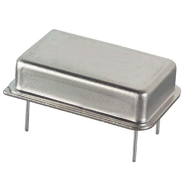

    有源晶振 2.4576MHz 5V 0℃~+70℃
ECS-100A-024 数据手册
ECS-100 SERIES CLOCK OSCILLATOR The ECS-100 clock oscillator is fully compatible with TTL circuitry. The metal package with pin #7 case ground acts as shielding to minimize radiation. FEATURES • 10 TTL output load • Low cost • Wide frequency range • Industry standard footprint • Resistance weld package • 3.3V operation (optional) PART NUMBERING GUIDE PART NUMBER * ECS-100A ECS-100B ECS-100C FREQUENCY STABILITY ±100 PPM ±50 PPM ±25 PPM * Complete part number to include frequency. i.e. ECS-100A-100 (100 = 10.000MHz) OPERATING CONDITIONS/ELECTRICAL CHARACTERISTICS PARAMETERS FREQUENCY RANGE (f o) OPERATING TEMP. RANGE (T OPR) STORAGE TEMP. RANGE (T STG) FREQUENCY STABILITY FREQUENCY RANGE 1.000 ~ 150.000 1.000 ~ 150.000 1.000 ~ 150.000 1.000 ~ 150.000 1.000 ~ 7.999 8.000 ~ 23.999 24.000 ~ 69.999 70.000 ~ 150.000 1.000 ~ 7.999 8.000 ~ 150.000 1.000 ~ 24.999 25.000 ~ 69.999 70.000 ~ 150.000 1.000 ~ 24.999 25.000 ~ 69.999 70.000 ~ 150.000 1.000 ~ 24.999 25.000 ~ 150.000 70.000 ~ 150.000 1.000 ~ 150.000 1.000 ~ 150.000 1.000 ~ 150.000 1.000 ~ 3.499 3.500 ~ 3.999 4.000 ~ 5.999 6.000 ~ 19.999 20.000 ~ 150.000 1.000 ~ 150.000 INPUT CURRENT (I DD) OUTPUT SYMMETRY RISE TIME (T R) FALL TIME (T F) OUTPUT VOLTAGE OUTPUT CURRENT (V OL) (V OL) (V OH) (I OL) (I OH) OUTPUT LOAD START-UP TIME (T S) SUPPLY VOLTAGE CONDITIONS All conditions* max. load max. load max. load max. load 1.4V level 1.4V level 0.4V ~ 2.4V 0.5V ~ 2.4V 0.5V ~ 2.4V 2.4V ~ 0.4V 2.4V ~ 0.5V 2.4V ~ 0.5V I OL = 20 mA I OL = 20 mA I OH = 1 mA V OL = 0.5 V V OH = 2.4 V MINIMUM 1.000 0 -55 -100 TYPICAL 45 40 50 ±3 50 ±3 MAXIMUM 150.000 +70 +125 +100 15 30 70 80 55 60 10 5 4 10 5 4 0.4 0.5 2.4 20 1.0 10 20 35 30 20 15 – +5.0 ±0.25 UNITS MHz ˚C ˚C PPM mA mA mA mA % % nS nS nS nS nS nS V V V mA mA TTL mS mS mS mS mS V DC * Inclusive of 25˚C tolerance, operating temperature range, input voltage change, load change, aging, shock and vibration. PACKAGE DIMENSIONS (mm) TF 20.86 max TR 1 7 14 8 13.2 max Ø0.45 7.62 ± 0.2 0.8 ±0.2 6.35 ±1.0 5.08 1 LEVEL 1.4V DC 0.4V DC (0.5V DC) 0 LEVEL 15.24 Figure 1) ECS-100 Series Side and Bottom views 2.4V DC 0 VDC 40% min 60% max PIN CONNECTIONS #1 NC #7 CASE GND #8 OUTPUT #14 +5 V DC Figure 3) Pin Connections Figure 2) Output Wave Form ECS, INC. INTERNATIONAL 1105 S. RIDGEVIEW, OLATHE, KS 66062 • 913-782-7787 • 800-237-1041 • FAX 913-782-6991 • WWW.ECSXTAL.COM OSCILLATORS 32 OSCILLATORS
ECS-100A-024
物料型号:ECS-100系列 器件简介:该振荡器与TTL电路完全兼容,金属封装带有接地的第7号引脚,起到屏蔽作用以最小化辐射。 引脚分配:1号引脚为空脚(NC),7号引脚为外壳地(CASE GND),8号引脚为输出(OUTPUT),14号引脚为+5VDC。 参数特性:包括频率范围1.000~150.000MHz,工作温度范围0~+70°C,存储温度范围-55~+125°C,频率稳定性从-100到+100PPM,输入电流从15mA到80mA不等,输出对称性、上升时间、下降时间、输出电压和电流等电气特性。 功能详解:文档提供了详细的电气特性表,包括频率范围、工作温度范围、存储温度范围、频率稳定性、输入电流、输出对称性、上升时间、下降时间、输出电压和电流、输出负载和启动时间等。 应用信息:文档没有明确提供应用信息,但根据其特性,ECS-100系列时钟振荡器适用于需要与TTL电路兼容的电子设备。 封装信息:提供了封装的尺寸图,最大长度20.86mm,最大宽度13.2mm,引脚直径Ø0.45mm,总长度15.24mm。
