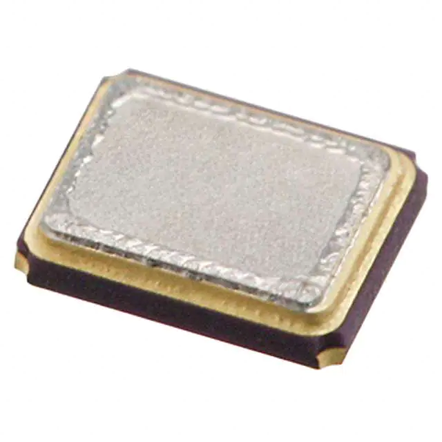

ECX-33Q SMD CRYSTAL The ECX-33Q is a miniature SMD Crystal with a 3.2 x 2.5 mm footprint. AEC-Q200 Qualified. Request a Sample OPERATING CONDITIONS / ELECTRICAL CHARACTERISTICS ECX-33Q SMD CRYSTAL PARAMETERS CONDITIONS ECX-33Q MIN Frequency 54.000 MHz @ +25°C ± 30 ppm -55 ~ +125°C (DU Option) ± 100 ppm Shunt Capacitance Co 7 pF Load Capacitance Specify in P/N Series pF 100 μW -55 +125 °C -55 +125 °C ±5 ppm Fundamental Frequency Tolerance* Frequency Stability* Low Profile 3.2 x 2.5 mm Footprint RoHS Compliant AEC-Q200 Qualified Drive Level Operating Temperature* Storage Temperature DIMENSIONS (mm) MAX 8.000 Mode of Oscillation     TYP UNITS 6 DL Topr (DU Option) Tstg Aging (First Year) 20 @ +25°C ±3°C Frequency (MHz) 8.000 ~ 9.999 10.000 ~ 15.999 16.000 ~ 19.999 20.000 ~ 23.999 24.000 ~ 54.000 Pad Connections 1 In/Out 2 Gnd 3 Out/In 4 Gnd Figure 1) Top, Side, and Bottom Crystal is symmetrical, pad 1 & 3 are interchangeable. Chamfer on the bottom pad has no electrical significance. ESR Ω Max. 500 100 80 60 40 Figure 2) Suggested land pattern PART NUMBERING GUIDE: Example ECS-200-20-33Q-DU-TR ECS - FREQUENCY ABBREVIATION ECS 200 = 20.000 MHz See P/N Guide LOAD CAPACITANCE 20 = 20 pF 10 = 10 pF S = Series * Specify available options in P/N. † Contact ECS for availability over extended temp range. †† JES-TR & JEN-TR 3K/Reel PACKAGE AVAILABLE OPTIONS Tolerance 33Q = ECX-33Q Blank = ±30 ppm A = ± 25 ppm J = ± 20 ppm R = ± 15 ppm C = ± 10 ppm Stability D= ±100 ppm E = ± 50 ppm G = ± 30 ppm H = ± 25 ppm T = ± 20 ppm † W = ±15 ppm † K = ± 10 ppm † PACKAGING Temp Range L = -10 ~ +70°C M = -20 ~ +70°C Y = -30 ~ +85°C N = -40 ~ +85°C P = -40 ~ +105°C S = -40 ~ +125°C U = -55 ~ +125°C TR =1K†† TR3=3K Qty/Reel Rev.2022 15351 West 109th Street | Lenexa, KS 66219 | Phone: 913.782.7787 | Fax: 913.782.6991 | www.ecsxtal.com ECX-33Q SMD CRYSTAL POCKET TAPE DIMENSIONS (mm) SOLDER PROFILE Peak solder Temp +260°C Max 10 sec Max. 2 Cycles Max. MSL 1, Lead Finish Au DEVELOPED FREQUENCIES Abbreviation Frequency (MHZ) 80 8.000 100 10.000 120 12.000 122.8 12.288 130 13.000 135.6 13.560 143 14.31818 147.4 14.7456 160 16.000 163.8 16.384 184 18.432 196.6 19.6608 200 20.000 221 22.1184 240 24.000 245.7 24.576 250 25.000 260 26.000 270 27.000 286.3 28.63636 300 30.000 320 32.000 330 33.000 400 40.000 Figure 1) Suggested Reflow Profile 15351 West 109th Street | Lenexa, KS 66219 | Phone: 913.782.7787 | Fax: 913.782.6991 | www.ecsxtal.com

物料型号:ECX-33Q
器件简介:ECX-33Q是一款小型化的SMD晶体振荡器,尺寸为3.2 x 2.5 mm,符合RoHS标准,并通过AEC-Q200认证。
引脚分配:1号引脚为输入/输出,2号和4号引脚为地,3号引脚为输出/输入。晶体是对称的,1号和3号引脚可以互换。
参数特性: - 频率范围:8.000 MHz至54.000 MHz - 振荡模式:基频 - 频率容差:±30 ppm(25°C时) - 频率稳定性:-55°C至+125°C(DU选项)时为±100 ppm - 并联电容:7 pF - 负载电容:根据型号指定,范围6 pF至20 pF - 驱动电平:100 μW - 工作温度范围:-55°C至+125°C(DU选项) - 存储温度:-55°C至+125°C - 首年老化率:±5 ppm
功能详解:文档提供了详细的电气特性表,包括不同频率下的等效串联电阻(ESR)最大值,以及建议的回流焊接温度曲线。
应用信息:适用于需要小型化和高性能振荡器的应用。
封装信息:ECX-33Q封装的尺寸精度为3.2±0.1 mm x 2.5±0.1 mm,高度为0.9 mm。
