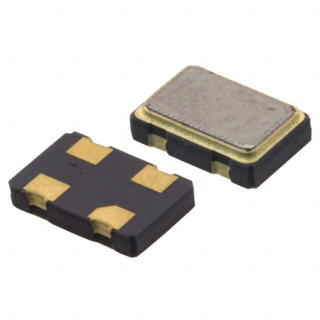

ECS-3518/3525 SMD Clock Oscillator ECS-3518 (1.8V) and ECS-3525 (2.5V) subminiature SMD oscillators, ideal for today’s high density applications. Request a Sample OPERATING CONDITIONS / ELECTRICAL CHARACTERISTICS ECS-3518/3525 Parameters ECS-3518 (+1.8V) Conditions MIN Frequency Range Operating Temperature • Output Symmetry Rise and Fall Times TYP MAX Units 125.00 1.544 125.00 MHz 0 +70 0 +70 °C Extended (N Option) -40 +85 -40 +85 °C VDD +1.62 -55 Frequency Stability* Input Current MIN 1.544 Supply Voltage 1.8V or 2.5V Versions 3.2 x 5.0 mm Footprint Extended Temp Range Option PbFree/RoHS Compliant ECS-3525 (+2.5V) MAX Standard Storage Temperature • • • TYP +1.8 +125 -55 +1.98 +2.25 +2.5 +125 °C +2.75 VDC Option A ±100 ±100 PPM Option B ±50 ±50 PPM Option C ±25 ±25 PPM 1.544 ~ 9.999 MHz 6 7 mA 10.000 ~ 34.999 MHz 7 8 mA 35.000 ~ 49.999 MHz 15 20 mA 50.000 ~ 125.000 MHz 25 30 mA @50% VCC Level 40/60 40/60 % @50% VCC Level (T Option) 45/55 45/55 % 10% VDD to 90% Level 5 6 ns VCC *10% VDC “0” Level VOL “1” Level VOH Output Load VCC *10% VCC *90% HCMOS Startup Time VCC *90% VDC 30 30 pF 10 10 ms * Note: Inclusive of 25°C tolerance, operating temperature, range, input voltage change, load change, shock, aging and vibration. Part Numbering Guide: ECS-3525-200-AN-TR ECS ECS - Series 3518 = +1.8V 3525 = +2.5V - Frequency Abbreviations - 200 = 20 MHz Stability A = ±100 ppm B = ±50 ppm C = ±25 ppm - Temperature - Blank = -0 ~ 70°C M = -20 ~ +70°C N = -40 ~ +85°C Output Symmetry Blank = 40/60 STD T = 45/55 - Packaging TR = Tape & Reel 1K/Reel 15351 West 109th Street | Lenexa, KS 66219 | Phone: 913.782.7787 | Fax: 913.782.6991 | www.ecsxtal.com ECS-3518/3525 SMD Clock Oscillator Package Dimensions (mm) Figure 2) Land Pattern Figure 1) Top, Side, and Bottom views Pad Connections Tri-State Control Voltage #1 Tri-State Pad 1 Pad 3 #2 Ground Open Oscillation #3 Output 1 Level Oscillation #4 VCC 0 Level High Impedance Figure 3) Suggested Reflow Profile 15351 West 109th Street | Lenexa, KS 66219 | Phone: 913.782.7787 | Fax: 913.782.6991 | www.ecsxtal.com ECS-3518/3525 SMD Clock Oscillator Tape Dimensions (mm) Package Data Item Description Lid Metal Base Ceramic Sealing Seam Weld Terminal Tungsten (Metalized) Plating Gold/Nickel (Surface)/(Under) RoHS Compliant (PbFree) MSL 1 Figure 4) Pocket Tape Dimensions 15351 West 109th Street | Lenexa, KS 66219 | Phone: 913.782.7787 | Fax: 913.782.6991 | www.ecsxtal.com

物料型号:ECS-3518(1.8V版本)和ECS-3525(2.5V版本)
器件简介:这些是超小型SMD振荡器,适用于高密度应用,符合RoHS标准。
引脚分配: - #1:三态控制 - #2:地 - #3:输出 - #4:VCC(电源)
参数特性: - 频率范围:1.544 MHz至125.00 MHz - 工作温度:标准为0°C至+70°C,扩展温度范围为-40°C至+85°C - 存储温度:-55°C至+125°C - 供电电压:1.62V至1.98V(ECS-3518)和2.25V至2.75V(ECS-3525) - 频率稳定性:±100 PPM(选项A)、±50 PPM(选项B)、±25 PPM(选项C) - 输入电流:根据频率不同,范围在6 mA至30 mA之间 - 输出对称性:40/60%(标准)或45/55%(T选项) - 上升和下降时间:5 ns至6 ns - 输出电平:“0”电平为VCC的10%,“1”电平为VCC的90% - 输出负载:HCMOS,30 pF - 启动时间:10 ms
功能详解:振荡器具有三态控制功能,可以通过Pad 1和Pad 3的电平来控制振荡或高阻抗状态。
应用信息:适用于需要小型化和高密度的电子设备。
封装信息:提供卷带封装,每卷1000个单位。
