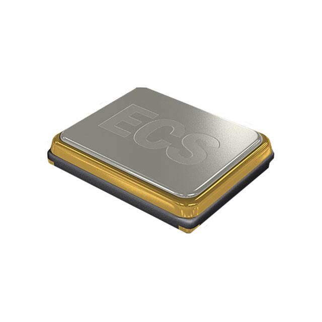

ECS-384-CDX-1983
ECS-384-CDX-1983
    CALIBER
    SMD2016_4P
    无源晶振 40Ω 10pF ±10ppm 38.4MHz -40℃~+125℃ SMD2016_4P
ECS-384-CDX-1983 数据手册
CRYSTAL SPECIFICATION Manufacturer: ECS Inc. International Manufacturer P/N: ECS-384-CDX-1983 Customer: Customer P/N: Customer Approval : ECS Inc. International Tel: (913)-782-7787 Fax: (913)-782-6991 Website: www.ecsxtal.com Sales: sales@ecsxtal.com Engineering: engineering@ecsxtal.com Date: 04-24-2020 Approved By: B. Slatten Checked By: D. Kelly Designer: Address: 15351 W. 109th Street A. Anderson Lenexa Kansas 66219 Rev. 1 Description of Revision History New Publication Date 04-24-2020 Designer A. Anderson Checked By D. Kelly CRYSTAL SPECIFICATION 1. Description : Quartz Crystal 2. Nominal Frequency : 38.400000 MHz 3. Center Frequency : 38.400000 MHz 4. Dimension & Drawing No. : ECX-1637B 5. Oscillation Mode : Fundamental 6. Cutting Mode : AT cut 7. Packing Style : Tape & Reel 8. Measurement Instrument : S&A 250B(Measured FL) 9. Electrical Characteristics : [1] Operating Conditions : Item Symbol MIN. Operating Temperature Range Topt -40 Storage Temperature Range Tstg -55 Load Capacitance CL Drive Level DL TYP. MAX. Unit 125 ℃ 125 10 Condition ℃ pF 100 µW MAX. Unit Condition [2] Frequency Stability : Item Symbol MIN. TYP. Tolerance dF/Fo -10 10 ppm Refer to Center Frequency @25±3℃ Stability Over Temperature dF/F25 -40 40 ppm Refer to Operating Temperature Aging dF/F25 -1 1 ppm First Year dF/Fo: Frequency Deviation Refer to Center Frequency dF/F25: Frequency Deviation Refer to 25 ℃ Frequency [3] Electrical Performance : Item Symbol Equivalent Series Resistance MIN. TYP. ESR Shunt Capacitance C0 Insulation Resistance IR MAX. Unit 40 Ω 1.5 500 Condition @Series pF MΩ @DC 100 Volt 10. Marking : Laser E384x 1983 x = Variable ECS Inc. internal lot 11. Remark : *Compliant with EU RoHS 2015/863 * MSL 1 ■ Note 1. General cleaning solutions or ultrasonic cleaning method may be used to clean our products. However, under certain circumstances, ultrasonic cleaning machine could generate resonance at the oscillation frequency of our products and thus deteriorate the electrical characteristics in devices, and even damage the overall structure of devices. Therefore, verification test is recommended before cleaning. 2. Avoid mounting and processing by Ultrasonic welding this method has a possibility of an excessive vibration spreading inside the crystal products and becoming the cause of characteristic deterioration and not oscillating. Dimensions: Top, Side and Bottom View Unit: mm Land Pattern: (Reference) RELIABILITY SPECIFICATION 1. ENVIRONMENTAL PERFORMANCE ITEM 1. HIGH TEMPERATURE STORAGE CONDITION STORED AT 85±2℃ FOR 1000±12H. (If Customer's temperature request is higher than the standard, Temperature test must be done for customer requirements.) THEN 25±2℃ OVER 2H BEFORE TESTING. 2. LOW TEMPERATURE STORAGE STORED AT –40±2℃ FOR 500±12H. (If Customer's temperature request is lower than the standard, Temperature test must be done for customer requirements.) THEN 25±2℃ OVER 2H BEFORE TESTING. 3. HIGH TEMP. & HUMIDITY STORED AT 60±2℃ AND HUMIDITY 90~95% FOR 500±12 H. THEN 25±2℃ OVER 2H BEFORE TESTING. 4. TEMPERATURE CYCLE THE CRYSTAL UNIT SHALL BE SUBJECTED TO 1000 SUCCESSIVE CHANGE OF TEMPERATURE CYCLES, THEN 25 ±2℃ OVER 2 H BEFORE TESTING, EACH CYCLE AS BELLOW: TEMPERATURE DURATION 1. -40+0/-6℃ 30±3 MINUTES 2. 25℃±2℃ 2~3 MINUTES 3. 125+4/-0℃ 30 ±3 MINUTES 4. 25℃±2℃ 2~3 MINUTES 2. MECHANICAL PERFORMANCE ITEM CONDITION 5. SOLDERABILITY THE LEAD IS IMMERSED IN A 260±5℃ SOLDER BATH WITHIN 2±0.6 SECONDS. 6. RESISTANCE TO SOLDERING HEAT 7. FREE FALL 8. VIBRATION REFLOW CHART AS ATTACH SHEET. TWICE PASS. FREE DROPPING FROM 75 cm HEIGHT 3 TIMES ON A HARD WOODEN BOARD. FREQUENCY:10~55Hz, AMPLITUDE (TOTAL EXCURSION):1.5mm±15%, 9. GROSS LEAK SWEEP TIME:1MIN, 3 DIRECTION(X, Y, Z) EACH FOR 2 Hrs. STANDARD SAMPLE FOR AUTOMATIC GROSS LEAK DETECTOR, TEST PRESSURE: 0.2 Mpa 10. FINE LEAK HELIUM BOMBING 5.0~5.5 Kgf / cm² FOR 2 HOURS. ◆ 11. TERMINAL STRENGTH SHALL BE PRESSURIZED AT A SPEED OF APPROX.0.5mm/sec IN THE DIRECTION INDICATED BY THE ARROW UNTIL THE BENDING WIDTH REACHES 3mm AND HELD FOR 5 SECONDS. 12. STICKING TENDENCY A R0.5 JIG SHALL BE USED TO APPLY A 10N DEAD LOAD IN THE DIRECTION INDICATED BY THE ARROW TO THE ELEMENT AND RETAIN IT FOR 10 SECONDS. 13. ELEMENT ASSEMBLY STRENGTH A R0.5 PRESSURIZED BAR SHALL BE USED TO APPLY A 10N LOAD IN THE CENTER OF ELEMENT AND RETAIN IT FOR 10 SECONDS. SUGGESTED REFLOW PROFILE ◆ PACKING Unit: mm 1. CARRIER TYPE
