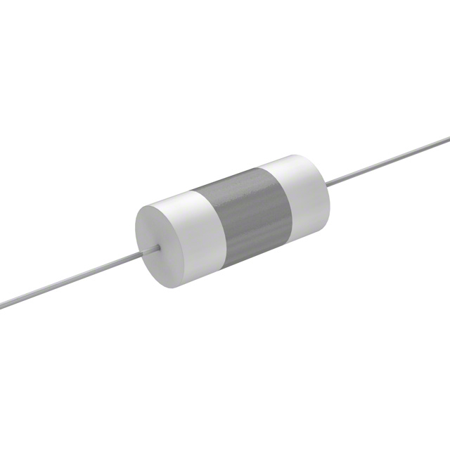

    插件,D9xL20.5mm
    薄膜电容 轴向 68nF ±5% Ф9.00 x 20.50mm
150683J630GC 数据手册
Type 150 Axial Leaded Metallized Polyester Flame Retardant Wrap and Fill Axial Leaded Capacitors The Type 150 series axial lead metallized polyester non inductive capacitors are available in bulk or on tape and reel for automatic insertion. Type 150 is a general purpose capacitor for use in blocking, bypass, decoupling, smoothing and some timing applications. Highlights • • • • Available on tape and reel or bulk Epoxy end fill meets UL94V-0 Non inductively wound Flame retardant outer wrap meets UL510 • Non polar Specifications Capacitance Range 0.001 µF to 10.0 µF Capacitance Tolerance ±5%, ±10%, ±20% Rated Voltage 63 to 1000 Vdc Operating Temperature Range –55 ºC to +125 ºC (derate linearly to 50% rated voltage at 125 ºC) Maximum DC Leakage Current After 2 minutes, with rated voltage at +20 ºC 6.3 to 100 Vdc I = .01CV or 3 µA Max (whichever is greater) ≥ 160 Vdc after 3 min, with rated voltage at +20 ºC I = .03CV or 10 µA Max (whichever is greater) C = Capacitance in (µF) V = Rated voltage I = Leakage current in µA Dielectric Withstand Voltage 1.6 x rated voltage for 2 s @ +25 ºC ±5 ºC Dissipation Factor @ 120 Hz, +25 ºC tgδ x 10–4 at +25 ºC ±5 ºC C ≤0.1 0.1 µF 1 µF 100 — — Insulation Resistance 10,000 MΩ x µF, 30,000 MΩ Min. Self Inductance 1 nH max. per 1 mm lead and body length Life Test Damp Heat Test Soldering Long Term Storage Stability 1000 hrs @ 85 ºC 1.25 x Vn 95% RH @ +45 ºC for 21 days 260 ºC ±5 ºC for 10 s ±1 s ΔC/C ≤ ±3% after 2 years Maximum Pulse Rise Time dv/dt and Pulse Characteristic (Wo) V/n 50 - 63 100 250 400 630 L Max 16.5 19 - 20.5 26.5 - 5.28 4 2 1.5 31.5 - 33 1 504 252 189 126 5 3 2 1 1,000 600 400 300 10 7 4 2.5 5,000 3,500 2,000 1,250 13.5 10 6.5 4 10,800 8,000 5,200 3,200 20 15 10 6 25,200 18,900 12,600 7,500 Regulatory Information CDE Cornell Dubilier • 1605 E. Rodney French Blvd. • New Bedford, MA 02744 • Phone: (508)996-8561 • Fax: (508)996-3830 • www.cde.com Type 150 Axial Leaded Metallized Polyester Outline Drawing Tape and Reel Specifications L Max Inches Distance Between Lead Spacing (Body Lengty) mm Inches mm Reel Flanges Inches mm Class ≤.433 ≤11 2.06 52.4 3 75 1 .551 - .808 14 - 20.5 2.5 63.6 3.4 86 2 ≥1.03 ≥26 2.87 73 3.7 95 3 Ød ±.003 ±0.076 mm Tinned Copper Leads ^Add class number (1, 2, or 3) to catalog number to indicate tape and reel Diameter Quantity per Reel Inches mm 0.197 5 3,000 .236 thru .256 6.0 trhu 6.5 1,200 0.276 7 1,100 .315 thru .346 8 thru 8.5 800 .354 thru .413 9 thru 10.5 500 .433 thru .512 11 thru 13 300 .551 thru .571 14 thru 14.5 200 >.571 >14.5 Not available 1.58” ±0.2 (40 ±5 mm) 1.58” ±0.2 (40 ±5 mm) L Max. D Max. Ratings Catalog Cap Part Number (µF) Inches Max D L Millimeters Max Ød D L Ød 63 Vdc 150154*63AA^ 0.150 0.197 0.433 0.024 5.0 11.0 0.6 Catalog Cap Inches Max Millimeters Max Part Number (µF) D L Ød D L Ød 150274*100CB^ 0.270 0.256 0.650 0.024 6.5 16.5 0.6 150334*100EB^ 0.330 0.315 0.650 0.031 8.0 16.5 0.8 150154*63BB^ 0.150 0.236 0.650 0.024 6.0 16.5 0.6 150394*100EB^ 0.390 0.315 0.650 0.031 8.0 16.5 0.8 150184*63AA^ 0.180 0.197 0.433 0.024 5.0 11.0 0.6 150474*100DC^ 0.470 0.276 0.807 0.031 7.0 20.5 0.8 150184*63BB^ 0.180 0.236 0.650 0.024 6.0 16.5 0.6 150564*100EC^ 0.560 0.315 0.807 0.031 8.0 20.5 0.8 150224*63BB^ 0.220 0.236 0.650 0.024 6.0 16.5 0.6 150684*100FC^ 0.680 0.335 0.807 0.031 8.5 20.5 0.8 150274*63BB^ 0.270 0.236 0.650 0.024 6.0 16.5 0.6 150824*100HC^ 0.820 0.374 0.807 0.031 9.5 20.5 0.8 150334*63BB^ 0.330 0.236 0.650 0.024 6.0 16.5 0.6 150105*100IC^ 1.000 0.394 0.807 0.031 10.0 20.5 0.8 100 Vdc 150394*63CB^ 0.390 0.256 0.650 0.024 6.5 16.5 0.6 150474*63DB^ 0.470 0.276 0.650 0.024 7.0 16.5 0.6 150155*100IE^ 1.500 0.394 1.102 0.031 10.0 28.0 0.8 150564*63DB^ 0.560 0.276 0.650 0.024 7.0 16.5 0.6 150225*100LE^ 2.200 0.453 1.102 0.031 11.5 28.0 0.8 150684*63DC^ 0.680 0.276 0.807 0.024 7.0 20.5 0.6 150335*100PE^ 3.300 0.531 1.102 0.031 13.5 28.0 0.8 150824*63EC^ 0.820 0.315 0.807 0.031 8.0 20.5 0.8 150475*100RF^ 4.700 0.591 1.299 0.031 15.0 33.0 0.8 150105*63EC^ 1.000 0.315 0.807 0.031 8.0 20.5 0.8 150685*100WF^ 6.800 0.689 1.299 0.031 17.5 33.0 0.8 150155*63HC^ 1.500 0.374 0.807 0.031 9.5 20.5 0.8 150106*100YF^ 10.000 0.807 1.299 0.031 20.5 33.0 0.8 150225*63HE^ 2.200 0.374 1.102 0.031 9.5 28.0 0.8 150335*63KE^ 3.300 0.433 1.102 0.031 11.0 28.0 0.8 150475*63ME^ 4.700 0.492 1.102 0.031 12.5 28.0 150685*63QF^ 6.800 0.571 1.299 0.031 14.5 33.0 150106*63TF^ 10.000 0.610 1.299 0.031 15.5 150683*100AA^ 0.068 0.197 0.433 0.024 150683*100BB^ 0.068 0.236 0.650 150823*100AA^ 0.082 0.197 150823*100BB^ 0.082 0.236 150104*100AA^ 0.100 150104*100BB^ 150124*100BB^ 250 Vdc 150123*250AA^ 0.012 0.197 0.433 0.024 5.0 11.0 0.6 0.8 150123*250BB^ 0.012 0.236 0.650 0.024 6.0 16.5 0.6 0.8 150153*250AA^ 0.015 0.197 0.433 0.024 5.0 11.0 0.6 33.0 0.8 150153*250BB^ 0.015 0.236 0.650 0.024 6.0 16.5 0.6 150183*250AA^ 0.018 0.197 0.433 0.024 5.0 11.0 0.6 5.0 11.0 0.6 150183*250BB^ 0.018 0.236 0.650 0.024 6.0 16.5 0.6 0.024 6.0 16.5 0.6 150223*250AA^ 0.022 0.197 0.433 0.024 5.0 11.0 0.6 0.433 0.024 5.0 11.0 0.6 150223*250BB^ 0.022 0.236 0.650 0.024 6.0 16.5 0.6 0.650 0.024 6.0 16.5 0.6 150273*250AA^ 0.027 0.197 0.433 0.024 5.0 11.0 0.6 0.197 0.433 0.024 5.0 11.0 0.6 150273*250BB^ 0.027 0.236 0.650 0.024 6.0 16.5 0.6 0.100 0.236 0.650 0.024 6.0 16.5 0.6 * Indicates capacitance tolerance 0.120 0.236 0.650 0.024 6.0 16.5 0.6 J = ±5%, K = ±10%, M = ±20% 150154*100BB^ 0.150 0.236 0.650 0.024 6.0 16.5 0.6 See tape & reel specifications to determine which class applies. 150184*100CB^ 0.180 0.256 0.650 0.024 6.5 16.5 0.6 Part Number highlighted in yellow, available until stock is depleted. 150224*100CB^ 0.220 0.256 0.650 0.024 6.5 16.5 0.6 100 Vdc ^If ordering tape and reel, insert 1, 2, or 3. Replacement part number with “BB” case size. Part Number highlighted in green - OBSOLETE Part number highlighted in light yellow, available until stock is depleted, no replacement CDE Cornell Dubilier • 1605 E. Rodney French Blvd. • New Bedford, MA 02744 • Phone: (508)996-8561 • Fax: (508)996-3830 • www.cde.com Type 150 Axial Leaded Metallized Polyester Catalog Cap Part Number (µF) D Inches Max 150333*250AA^ 0.0330 150333*250BB^ Millimeters Max Catalog Cap Part Number (µF) D L Ød D L Ød 150683*400DC^ 0.0680 0.276 0.807 0.024 7.0 20.5 0.6 150823*400EC^ 0.0820 0.315 0.807 0.031 8.0 20.5 0.8 150104*400EC^ 0.1000 0.315 0.807 0.031 8.0 20.5 0.8 0.6 150124*400EC^ 0.1200 0.315 0.807 0.031 8.0 20.5 0.8 0.6 150154*400GC^ 0.1500 0.354 0.807 0.031 9.0 20.5 0.8 11.0 0.6 150184*400EE^ 0.1800 0.315 1.102 0.031 8.0 28.0 0.8 L Ød D L Ød 0.197 0.433 0.024 5.0 11.0 0.6 0.0330 0.236 0.650 0.024 6.0 16.5 0.6 150393*250AA^ 0.0390 0.197 0.433 0.024 5.0 11.0 150393*250BB^ 0.0390 0.236 0.650 0.024 6.0 16.5 150473*250AA^ 0.0470 0.197 0.433 0.024 5.0 250 Vdc Inches Max Millimeters Max 150473*250BB^ 0.0470 0.236 0.650 0.024 6.0 16.5 0.6 150224*400FE^ 0.2200 0.335 1.102 0.031 8.5 28.0 0.8 150563*250AA^ 0.0560 0.197 0.433 0.024 5.0 11.0 0.6 150274*400GE^ 0.2700 0.354 1.102 0.031 9.0 28.0 0.8 150563*250BB^ 0.0560 0.236 0.650 0.024 6.0 16.5 0.6 150334*400IE^ 0.3300 0.394 1.102 0.031 10.0 28.0 0.8 150683*250BB^ 0.0680 0.236 0.650 0.024 6.0 16.5 0.6 150394*400JE^ 0.3900 0.413 1.102 0.031 10.5 28.0 0.8 150823*250BB^ 0.0820 0.236 0.650 0.024 6.0 16.5 0.6 150474*400LF^ 0.4700 0.453 1.299 0.031 11.5 33.0 0.8 150104*250CB^ 0.1000 0.256 0.650 0.024 6.5 16.5 0.6 150564*400LF^ 0.5600 0.453 1.299 0.031 11.5 33.0 0.8 150124*250DB^ 0.1200 0.276 0.650 0.024 7.0 16.5 0.6 150684*400MF^ 0.6800 0.492 1.299 0.031 12.5 33.0 0.8 150154*250EB^ 0.1500 0.315 0.650 0.031 8.0 16.5 0.8 150824*400PF^ 0.8200 0.531 1.299 0.031 13.5 33.0 0.8 150184*250EB^ 0.1800 0.315 0.650 0.031 8.0 16.5 0.8 150105*400QF^ 1.0000 0.571 1.299 0.031 14.5 33.0 0.8 150224*250FB^ 0.2200 0.335 0.650 0.031 8.5 16.5 0.8 150155*400WF^ 1.5000 0.689 1.299 0.031 17.5 33.0 0.8 150274*250EC^ 0.2700 0.315 0.807 0.031 8.0 20.5 0.8 150225*400YF^ 2.2000 0.807 1.299 0.031 20.5 33.0 0.8 150334*250FC^ 0.3300 0.335 0.807 0.031 8.5 20.5 0.8 630 Vdc 150394*250GC^ 0.3900 0.354 0.807 0.031 9.0 20.5 0.8 150102*630AA^ 0.0010 0.197 0.433 0.024 5.0 11.0 0.6 150474*250HC^ 0.4700 0.374 0.807 0.031 9.5 20.5 0.8 150102*630BB^ 0.0010 0.236 0.650 0.024 6.0 16.5 0.6 150564*250IC^ 0.5600 0.394 0.807 0.031 10.0 20.5 0.8 150122*630AA^ 0.0012 0.197 0.433 0.024 5.0 11.0 0.6 150684*250GE^ 0.6800 0.354 1.102 0.031 9.0 28.0 0.8 150122*630BB^ 0.0012 0.236 0.650 0.024 6.0 16.5 0.6 150824*250HE^ 0.8200 0.374 1.102 0.031 9.5 28.0 0.8 150152*630AA^ 0.0015 0.197 0.433 0.024 5.5 11.0 0.6 150105*250JE^ 1.0000 0.413 1.102 0.031 10.5 28.0 0.8 150152*630BB^ 0.0015 0.236 0.650 0.024 6.0 16.5 0.6 150155*250ME^ 1.5000 0.492 1.102 0.031 12.5 28.0 0.8 150182*630AA^ 0.0018 0.197 0.433 0.024 5.5 11.0 0.6 150225*250PF^ 2.2000 0.531 1.299 0.031 13.5 33.0 0.8 150182*630BB^ 0.0018 0.236 0.650 0.024 6.0 16.5 0.6 150335*250TF^ 3.3000 0.610 1.299 0.031 15.5 33.0 0.8 150222*630AA^ 0.0022 0.197 0.433 0.024 5.5 11.0 0.6 150475*250XF^ 4.7000 0.728 1.299 0.031 18.5 33.0 0.8 150222*630BB^ 0.0022 0.236 0.650 0.024 6.0 16.5 0.6 150685*250ZF^ 6.8000 0.845 1.299 0.031 21.5 33.0 0.8 150272*630AA^ 0.0027 0.197 0.433 0.024 5.5 11.0 0.6 150272*630BB^ 0.0027 0.236 0.650 0.024 6.0 16.5 0.6 400 Vdc 150822*400AA^ 0.0082 0.197 0.433 0.024 5.0 11.0 0.6 150332*630AA^ 0.0033 0.197 0.433 0.024 5.5 11.0 0.6 150822*400BB^ 0.0082 0.236 0.650 0.024 6.0 16.5 0.6 150332*630BB^ 0.0033 0.236 0.650 0.024 6.0 16.5 0.6 150103*400AA^ 0.0100 0.197 0.433 0.024 5.0 11.0 0.6 150392*630AA^ 0.0039 0.197 0.433 0.024 5.5 11.0 0.6 150103*400BB^ 0.0100 0.236 0.650 0.024 6.0 16.5 0.6 150392*630BB^ 0.0039 0.236 0.650 0.024 6.0 16.5 0.6 150123*400AA^ 0.0120 0.197 0.433 0.024 5.0 11.0 0.6 150472*630AA^ 0.0047 0.197 0.433 0.024 5.5 11.0 0.6 150123*400BB^ 0.0120 0.236 0.650 0.024 6.0 16.5 0.6 150472*630BB^ 0.0047 0.236 0.650 0.024 6.0 16.5 0.6 150153*400BB^ 0.0150 0.236 0.650 0.024 6.0 16.5 0.6 150562*630AA^ 0.0056 0.197 0.433 0.024 5.5 11.0 0.6 150183*400BB^ 0.0180 0.236 0.650 0.024 6.0 16.5 0.6 150562*630BB^ 0.0056 0.236 0.650 0.024 6.0 16.5 0.6 150223*400BB^ 0.0220 0.236 0.650 0.024 6.0 16.5 0.6 * Indicates capacitance tolerance 150273*400BB^ 0.0270 0.236 0.650 0.024 6.0 16.5 0.6 J = ±5%, K = ±10%, M = ±20% 150333*400BB^ 0.0330 0.236 0.650 0.024 6.0 16.5 0.6 See tape & reel specifications to determine which class applies. 150393*400CB^ 0.0390 0.256 0.650 0.024 6.5 16.5 0.6 Part Number highlighted in yellow, available until stock is depleted. 150473*400DB^ 0.0470 0.276 0.650 0.024 7.0 16.5 0.6 Replacement part number with “BB” case size. 150563*400EB^ 0.0560 0.315 0.650 0.024 8.0 16.5 0.6 Part Number highlighted in green - OBSOLETE ^If ordering tape and reel, insert 1, 2, or 3. Part number highlighted in light yellow, available until stock is depleted, no replacement CDE Cornell Dubilier • 1605 E. Rodney French Blvd. • New Bedford, MA 02744 • Phone: (508)996-8561 • Fax: (508)996-3830 • www.cde.com Type 150 Axial Leaded Metallized Polyester Catalog Cap Part Number (µF) Inches Max D L Millimeters Max Ød D L Ød Catalog Cap Part Number (µF) 630 Vdc Inches Max D Millimeters Max L Ød D L Ød 1000 Vdc 150682*630AA^ 0.0068 0.197 0.433 0.024 5.5 11.0 0.6 150102*1000CB^ 0.0010 0.256 0.650 0.024 6.5 16.5 0.6 150682*630BB^ 0.0068 0.236 0.650 0.024 6.0 16.5 0.6 150152*1000CB^ 0.0015 0.256 0.650 0.024 6.5 16.5 0.6 150822*630BB^ 0.0082 0.236 0.650 0.024 6.0 16.5 0.6 150222*1000CB^ 0.0022 0.256 0.650 0.024 6.5 16.5 0.6 150103*630BB^ 0.0100 0.236 0.650 0.024 6.0 16.5 0.6 150332*1000CB^ 0.0033 0.256 0.650 0.024 6.5 16.5 0.6 150123*630BB^ 0.0120 0.236 0.650 0.024 6.0 16.5 0.6 150472*1000DB^ 0.0047 0.276 0.650 0.024 7.0 16.5 0.6 150153*630BB^ 0.0150 0.236 0.650 0.024 6.0 16.5 0.6 150682*1000EB^ 0.0068 0.315 0.650 0.031 8.0 16.5 0.8 150183*630CB^ 0.0180 0.256 0.650 0.024 6.5 16.5 0.6 150103*1000DC^ 0.0100 0.276 0.807 0.024 7.0 20.5 0.6 150223*630DB^ 0.0220 0.276 0.650 0.024 7.0 16.5 0.6 150153*1000FC^ 0.0150 0.335 0.807 0.031 8.5 20.5 0.8 150273*630CC^ 0.0270 0.256 0.807 0.024 6.5 20.5 0.6 150223*1000HC^ 0.0220 0.374 0.807 0.031 9.5 20.5 0.8 150333*630EC^ 0.0330 0.315 0.807 0.031 8.0 20.5 0.8 150333*1000FE^ 0.0330 0.335 1.102 0.031 8.5 28 0.8 150393*630EC^ 0.0390 0.315 0.807 0.031 8.0 20.5 0.8 150473*1000HE^ 0.0470 0.374 1.102 0.031 9.5 28 0.8 150473*630EC^ 0.0470 0.315 0.807 0.031 8.0 20.5 0.8 150683*1000KE^ 0.0680 0.433 1.102 0.031 11.0 28 0.8 150563*630FC^ 0.0560 0.335 0.807 0.031 8.5 20.5 0.8 150104*1000NE^ 0.1000 0.512 1.102 0.031 13.0 28 0.8 150683*630GC^ 0.0680 0.354 0.807 0.031 9.0 20.5 0.8 150154*1000OF^ 0.1500 0.551 1.299 0.031 14.0 33 0.8 150823*630HC^ 0.0820 0.374 0.807 0.031 9.5 20.5 0.8 150224*1000WF^ 0.2200 0.689 1.299 0.031 17.5 33 0.8 150104*630FE^ 0.1000 0.335 1.102 0.031 8.5 28.0 0.8 150334*1000YF^ 0.3300 0.807 1.299 0.031 20.5 33 0.8 150124*630GE^ 0.1200 0.354 1.102 0.031 9.0 28.0 0.8 150474*1000Z1F^ 0.4700 0.945 1.299 0.031 24.0 33 0.8 150154*630IE^ 0.1500 0.394 1.102 0.031 10.0 28.0 0.8 150184*630JE^ 0.1800 0.413 1.102 0.031 10.5 28.0 0.8 150224*630LE^ 0.2200 0.453 1.102 0.031 11.5 28.0 0.8 * Indicates capacitance tolerance 150274*630ME^ 0.2700 0.492 1.102 0.031 12.5 28.0 0.8 J = ±5%, K = ±10%, M = ±20% 150334*630NF^ 0.3300 0.512 1.299 0.031 13.0 33.0 0.8 See tape & reel specifications to determine which class applies. 150394*630QF^ 0.3900 0.571 1.299 0.031 14.5 33.0 0.8 Part Number highlighted in yellow, available until stock is depleted. 150474*630RF^ 0.4700 0.591 1.299 0.031 15.0 33.0 0.8 Replacement part number with “BB” case size. 150564*630TF^ 0.5600 0.610 1.299 0.031 15.5 33.0 0.8 Part Number highlighted in green - OBSOLETE 150684*630WF^ 0.6800 0.689 1.299 0.031 17.5 33.0 0.8 150824*630XF^ 0.8200 0.728 1.299 0.031 18.5 33.0 0.8 150105*630YF^ 1.0000 0.807 1.299 0.031 20.5 33.0 0.8 ^If ordering tape and reel, insert 1, 2, or 3. Notice and Disclaimer: All product drawings, descriptions, specifications, statements, information and data (collectively, the “Information”) in this datasheet or other publication are subject to change. The customer is responsible for checking, confirming and verifying the extent to which the Information contained in this datasheet or other publication is applicable to an order at the time the order is placed. All Information given herein is believed to be accurate and reliable, but it is presented without any guarantee, warranty, representation or responsibility of any kind, expressed or implied. Statements of suitability for certain applications are based on the knowledge that the Cornell Dubilier company providing such statements (“Cornell Dubilier”) has of operating conditions that such Cornell Dubilier company regards as typical for such applications, but are not intended to constitute any guarantee, warranty or representation regarding any such matter – and Cornell Dubilier specifically and expressly disclaims any guarantee, warranty or representation concerning the suitability for a specific customer application, use, storage, transportation, or operating environment. The Information is intended for use only by customers who have the requisite experience and capability to determine the correct products for their application. Any technical advice inferred from this Information or otherwise provided by Cornell Dubilier with reference to the use of any Cornell Dubilier products is given gratis (unless otherwise specified by Cornell Dubilier), and Cornell Dubilier assumes no obligation or liability for the advice given or results obtained. Although Cornell Dubilier strives to apply the most stringent quality and safety standards regarding the design and manufacturing of its products, in light of the current state of the art, isolated component failures may still occur. Accordingly, customer applications which require a high degree of reliability or safety should employ suitable designs or other safeguards (such as installation of protective circuitry or redundancies or other appropriate protective measures) in order to ensure that the failure of an electrical component does not result in a risk of personal injury or property damage. Although all product-related warnings, cautions and notes must be observed, the customer should not assume that all safety measures are indicated in such warnings, cautions and notes, or that other safety measures may not be required. CDE Cornell Dubilier • 1605 E. Rodney French Blvd. • New Bedford, MA 02744 • Phone: (508)996-8561 • Fax: (508)996-3830 • www.cde.com

物料型号:Type 150系列轴向引线金属化聚酯非感性电容器。
器件简介:该系列电容器适用于自动插入的散装或胶带和卷轴形式,主要用于阻塞、旁路、去耦、平滑以及一些定时应用。
引脚分配:文档中未明确提供引脚分配信息,但通常轴向电容器的引脚分配是线性的,两端分别为电容器的正负极。
参数特性: - 电容范围:0.001 µF 至 10.0 µF - 电容公差:±5%, ±10%, ±20% - 额定电压:63至1000 Vdc - 工作温度范围:-55ºC至+125ºC(在125ºC时线性降低至额定电压的50%) - 最大直流漏电流:根据电压等级不同,漏电流计算公式为 I = .01CV 或 3 µA(取较大值) - 介质耐压:1.6倍额定电压,持续2秒 @ +25ºC ±5ºC - 损耗因子:@ 120 Hz, +25ºC,以10^-4为单位
功能详解:电容器具有阻燃外包装和非极性特性,环氧端填充符合UL94V-0标准,自感非常小,每1毫米引线和体长最大1纳亨。
应用信息:适用于自动插入的散装或胶带和卷轴形式,适用于多种电子应用,包括电源滤波、信号去耦等。
封装信息:提供了详细的封装规格,包括最大长度、引脚间距、卷轴间距离等,以及胶带和卷轴的规格。
