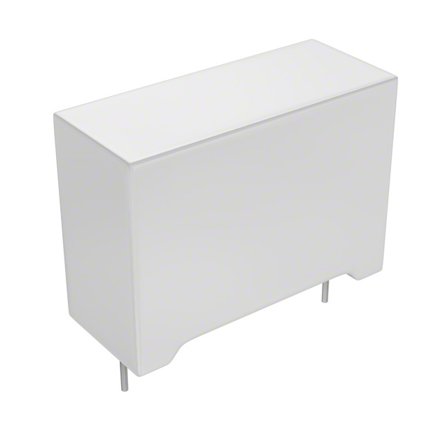

Type 171 Radial Leaded Metallized Polypropylene Radial Box Metallized Polypropylene Capacitors Type 171 radial leaded, box, metallized polypropylene capacitors are available in five pitch sizes and have a flame retardant case and epoxy encapsulant that meets UL94V-0. The Type 171 is an excellent choice for applications requiring low dielectric losses, high insulation resistance in an AC or DC environment. The polypropylene direlectric gives this capacitor excellent pulse rise time (dv/dt) performance. Highlights • • • • High dv/dt Low leakage Radial leaded (7.5, 10, 15, 22.5, 27.5 mm pitch) Flame retardant case and encapsulant meets UL94V-0 • Non-inductively wound Specifications Capacitance Range 0.0022 to 3.3 µF Capacitance Tolerance ±5%, ±10%, ±20% Rated Voltage 160 to 630 Vdc (90 to 250 Vac, 60 Hz) Operating Temperature Range –55 ºC to +105 ºC (derate linearly to 50% rated voltage from 85 ºC to 105 ºC) Dielectric Withstand Voltage 1.6 x rated voltage for 2 s @ +25 ºC ±5 ºC Dissipation Factor @ 120 Hz, +25 ºC tgδ x 10–4 at +25 ºC ±5 ºC kHz C ≤0.1 µF 0.1 µF 1 µF ≤6 — — Pitch (mm) 7.5 10 15 22.5 27.5 L (nH) ≈ 8 9 10 18 18 2000 hrs @ 85 ºC 1.25 x Vn 95% RH @ +40 ºC for 56 days 260 ºC ±5 ºC for 10 s ±1 s ΔC/C ≤ ±0.5% after 2 years Maximum Pulse Rise Time dv/dt (V/µ) Lead Spacing (Pitch) Vn 7.5 10 15 22.5 27.5 160 250 400 630 5.5 15 35 55 4 11 20 30 2 7 10 15 1.5 4 5.5 8 1 3 5 7 If the working voltage (V) is less than the nominal voltage (Vn), the capacitor can work at higher dv/dt . In this case, the maximum value allowed is obtained by multiplying the above value (See table dv/dt) with the ratio Vn/V Regulatory Information CDE Cornell Dubilier • 1605 E. Rodney French Blvd. • New Bedford, MA 02744 • Phone: (508)996-8561 • Fax: (508)996-3830 • www.cde.com Type 171 Radial Leaded Metallized Polypropylene Outline Drawing T L Max Max H Max .217 ±.039 (5.5 ±1.0 mm) S ±0.016 (±0.4 mm) Ød ±0.003 (±0.076 mm) Ratings Cap (µF) Inches (mm) Catolog Part Number L Max T Max H Max S (Pitch) Ød IRMS (Amps) ESR (mΩ) 20 kHz to 100 kHz 25 ºC 45 ºC 85 ºC 160 Vdc / 90 Vac 60 Hz 0.033 171333*160B-F 0.413 (10.5) 0.157 (4.0) 0.374 (9.5) 0.295 (7.5) 0.024 (0.6) 0.047 171473*160B-F 0.413 (10.5) 0.157 (4.0) 0.374 (9.5) 0.295 (7.5) 0.024 (0.6) 0.047 171473*160C-F 0.512 (13.0) 0.157 (4.0) 0.374 (9.5) 0.394 (10) 0.024 (0.6) 0.068 171683*160C7-F 0.413 (10.5) 0.197 (5.0) 0.433 (11.0) 0.295 (7.5) 0.024 (0.6) 0.068 171683*160D-F 0.512 (13.0) 0.197 (5.0) 0.433 (11.0) 0.394 (10.0) 0.024 (0.6) 0.1 171104*160C7-F 0.413 (10.5) 0.197 (5.0) 0.433 (11.0) 0.295 (7.5) 0.024 (0.6) 0.1 171104*160E-F 0.512 (13.0) 0.236 (6.0) 0.472 (12.0) 0.394 (10.0) 0.024 (0.6) 0.15 171154*160D7-F 0.413 (10.5) 0.236 (6.0) 0.472 (12.0) 0.295 (7.5) 0.024 (0.6) 0.15 171154*160E-F 0.512 (13.0) 0.236 (6.0) 0.472 (12.0) 0.394 (10) 0.024 (0.6) 0.22 171224*160F-F 0.709 (18.0) 0.197 (5.0) 0.433 (11.0) 0.591 (15.0) 0.031 (0.8) 0.33 171334*160G-F 0.709 (18.0) 0.236 (6.0) 0.472 (12.0) 0.591 (15.0) 0.031 (0.8) 0.47 171474*160H-F 0.709 (18.0) 0.295 (7.5) 0.531 (13.5) 0.591 (15.0) 0.031 (0.8) 37 3.7 3.1 1.4 0.68 171684*160L -F 1.043 (26.5) 0.236 (6.0) 0.591 (15.0) 0.886 (22.5) 0.031 (0.8) 33 4.1 3.5 1.6 1.0 171105*160N-F 1.043 (26.5) 0.335 (8.5) 0.669 (17.0) 0.886 (22.5) 0.031 (0.8) 26 5.5 4.7 2.6 1.5 171155*160O-F 1.043 (26.5) 0.394 (10.0) 0.748 (19.0) 0.886 (22.5) 0.031 (0.8) 20 6.1 5.1 3.1 2.2 171225*160P-F 1.26 (32.0) 0.433 (11.0) 0.787 (20.0) 1.083 (27.5) 0.031 (0.8) 18 6.3 5.7 3.3 3.3 171335*160Q-F 1.26 (32.0) 0.512 (13.0) 0.886 (22.5) 1.083 (27.5) 0.031 (0.8) 16 7.4 6.4 3.6 Not applicable. These capacitance values are not customarily used in switchedmode power supplies 250 Vdc / 90 Vac 60 Hz 0.015 171153*250B-F 0.413 (10.5) 0.157 (4.0) 0.374 (9.5) 0.295 (7.5) 0.024 (0.6) 0.022 171223*250B-F 0.413 (10.5) 0.157 (4.0) 0.374 (9.5) 0.295 (7.5) 0.024 (0.6) 0.022 171223*250C-F 0.512 (13.0) 0.157 (4.0) 0.374 (9.5) 0.394 (10) 0.024 (0.6) 0.033 171333*250C-F 0.512 (13.0) 0.157 (4.0) 0.374 (9.5) 0.394 (10) 0.024 (0.6) 0.047 171473*250D-F 0.512 (13.0) 0.197 (5.0) 0.433 (11.0) 0.394 (10) 0.024 (0.6) 0.068 171683*250E-F 0.512 (13.0) 0.236 (6.0) 0.472 (12.0) 0.394 (10) 0.024 (0.6) Not applicable. These capacitance values are not customarily used in switchedmode power supplies * indicates capacitance tolereance, J = ±5%, K = ±10%, M = ±20% CDE Cornell Dubilier • 1605 E. Rodney French Blvd. • New Bedford, MA 02744 • Phone: (508)996-8561 • Fax: (508)996-3830 • www.cde.com Type 171 Radial Leaded Metallized Polypropylene Ratings Cap (µF) 0.10 0.15 0.22 0.33 0.47 0.68 1.0 1.5 Catolog Part Number 171104*250F-F 171154*250G-F 171224*250H-F 171334*250L-F 171474*250M-F 171684*250Q-F 171105*250P-F 171155*250Q-F Inches (mm) L Max 0.709 (18.0) 0.709 (18.0) 0.709 (18.0) 1.043 (26.5) 1.043 (26.5) 1.26 (32.0) 1.26 (32.0) 1.26 (32.0) 0.0068 0.010 0.010 0.015 0.022 0.033 0.047 0.068 0.10 0.15 0.22 0.33 0.47 0.68 171682*400B-F 171103*400B-F 171103*400C-F 171153*400D-F 171223*400D-F 171333*400E-F 171473*400F-F 171683*400G-F 171104*400H-F 171154*400I-F 171224*400N-F 171334*400O-F 171474*400P-F 171684*400Q-F 0.413 (10.5) 0.413 (10.5) 0.512 (13.0) 0.512 (13.0) 0.512 (13.0) 0.512 (13.0) 0.709 (18.0) 0.709 (18.0) 0.709 (18.0) 0.709 (18.0) 1.043 (26.5) 1.043 (26.5) 1.26 (32.0) 1.26 (32.0) 0.0022 0.0022 0.0033 0.0033 0.0047 0.0047 0.0068 0.010 0.015 0.022 0.033 0.047 0.068 0.10 0.15 0.22 0.33 171222*630B-F 171222*630C-F 171332*630B-F 171332*630C-F 171472*630B-F 171472*630C-F 171682*630D-F 171103*630D-F 171153*630E-F 171223*630F-F 171333*630G-F 171473*630H-F 171683*630I-F 171104*630N-F 171154*630O-F 171224*630P-F 171334*630Q-F 0.413 (10.5) 0.512 (13.0) 0.413 (10.5) 0.512 (13.0) 0.413 (10.5) 0.512 (13.0) 0.512 (13.0) 0.512 (13.0) 0.512 (13.0) 0.709 (18.0) 0.709 (18.0) 0.709 (18.0) 0.709 (18.0) 1.043 (26.5) 1.043 (26.5) 1.26 (32.0) 1.26 (32.0) T Max H Max S (Pitch) 250 Vdc / 90 Vac 60 Hz 0.197 (5.0) 0.433 (11.0) 0.591 (15.0) 0.236 (6.0) 0.472 (12.0) 0.591 (15.0) 0.295 (7.5) 0.531 (13.5) 0.591 (15.0) 0.236 (6.0) 0.591 (15.0) 0.886 (22.5) 0.276 (7.0) 0.650 (16.5) 0.886 (22.5) 0.512 (13.0) 0.886 (22.5) 1.083 (27.5) 0.433 (11.0) 0.787 (20.0) 1.083 (27.5) 0.512 (13.0) 0.886 (22.5) 1.083 (27.5) 400 Vdc / 220 Vac 60 Hz 0.157 (4.0) 0.374 (9.5) 0.295 (7.5) 0.157 (4.0) 0.374 (9.5) 0.295 (7.5) 0.157 (4.0) 0.374 (9.5) 0.394 (10.0) 0.197 (5.0) 0.433 (11.0) 0.394 (10.0) 0.197 (5.0) 0.433 (11.0) 0.394 (10.0) 0.236 (6.0) 0.472 (12.0) 0.394 (10.0) 0.197 (5.0) 0.433 (11.0) 0.591 (15.0) 0.236 (6.0) 0.472 (12.0) 0.591 (15.0) 0.295 (7.5) 0.531 (13.5) 0.591 (15.0) 0.335 (8.5) 0.571 (14.5) 0.591 (15.0) 0.335 (8.5) 0.669 (17.0) 0.886 (22.5) 0.394 (10.0) 0.748 (19.0) 0.886 (22.5) 0.433 (11.0) 0.787 (20.0) 1.083 (27.5) 0.512 (13.0) 0.886 (22.5) 1.083 (27.5) 630 Vdc / 250 Vac 60 Hz 0.157 (4.0) 0.374 (9.5) 0.295 (7.5) 0.157 (4.0) 0.374 (9.5) 0.394 (10.0) 0.157 (4.0) 0.374 (9.5) 0.295 (7.5) 0.157 (4.0) 0.374 (9.5) 0.394 (10.0) 0.157 (4.0) 0.374 (9.5) 0.295 (7.5) 0.157 (4.0) 0.374 (9.5) 0.394 (10.0) 0.197 (5.0) 0.433 (11.0) 0.394 (10.0) 0.197 (5.0) 0.433 (11.0) 0.394 (10.0) 0.236 (6.0) 0.472 (12.0) 0.394 (10.0) 0.197 (5.0) 0.433 (11.0) 0.591 (15.0) 0.236 (6.0) 0.472 (12.0) 0.591 (15.0) 0.295 (7.5) 0.531 (13.5) 0.591 (15.0) 0.335 (8.5) 0.571 (14.5) 0.591 (15.0) 0.335 (8.5) 0.669 (17.0) 0.886 (22.5) 0.394 (10.0) 0.748 (19.0) 0.886 (22.5) 0.433 (11.0) 0.787 (20.0) 1.083 (27.5) 0.512 (13.0) 0.886 (22.5) 1.083 (27.5) Ød 0.031 (0.8) 0.031 (0.8) 0.031 (0.8) 0.031 (0.8) 0.031 (0.8) 0.031 (0.8) 0.031 (0.8) 0.031 (0.8) ESR (mΩ) IRMS (Amps) 20 kHz to 100 kHz 25 ºC 45 ºC 85 ºC Not applicable 35 32 28 26 3.8 4 4.4 5.1 3.6 3.8 4.4 4.9 1.7 1.9 3.2 3.5 0.024 (0.6) 0.024 (0.6) 0.024 (0.6) 0.024 (0.6) 0.024 (0.6) Not applicable. These 0.024 (0.6) capacitance values are not 0.031 (0.8) customarily used in switchedmode power supplies 0.031 (0.8) 0.031 (0.8) 0.031 (0.8) 0.031 (0.8) 0.031 (0.8) 0.031 (0.8) 32 5.7 5 2.2 0.031 (0.8) 30 5.7 5.5 2.4 0.024 (0.6) 0.024 (0.6) 0.024 (0.6) 0.024 (0.6) 0.024 (0.6) 0.024 (0.6) 0.024 (0.6) These 0.024 (0.6) Not applicable. capacitance values are not 0.024 (0.6) customarily used in switched0.031 (0.8) mode power supplies 0.031 (0.8) 0.031 (0.8) 0.031 (0.8) 0.031 (0.8) 0.031 (0.8) 0.031 (0.8) 0.031 (0.8) * indicates capacitance tolereance, J = ±5%, K = ±10%, M = ±20% CDE Cornell Dubilier • 1605 E. Rodney French Blvd. • New Bedford, MA 02744 • Phone: (508)996-8561 • Fax: (508)996-3830 • www.cde.com Type 171 Radial Leaded Metallized Polypropylene Notice and Disclaimer: All product drawings, descriptions, specifications, statements, information and data (collectively, the “Information”) in this datasheet or other publication are subject to change. The customer is responsible for checking, confirming and verifying the extent to which the Information contained in this datasheet or other publication is applicable to an order at the time the order is placed. All Information given herein is believed to be accurate and reliable, but it is presented without any guarantee, warranty, representation or responsibility of any kind, expressed or implied. Statements of suitability for certain applications are based on the knowledge that the Cornell Dubilier company providing such statements (“Cornell Dubilier”) has of operating conditions that such Cornell Dubilier company regards as typical for such applications, but are not intended to constitute any guarantee, warranty or representation regarding any such matter – and Cornell Dubilier specifically and expressly disclaims any guarantee, warranty or representation concerning the suitability for a specific customer application, use, storage, transportation, or operating environment. The Information is intended for use only by customers who have the requisite experience and capability to determine the correct products for their application. Any technical advice inferred from this Information or otherwise provided by Cornell Dubilier with reference to the use of any Cornell Dubilier products is given gratis (unless otherwise specified by Cornell Dubilier), and Cornell Dubilier assumes no obligation or liability for the advice given or results obtained. Although Cornell Dubilier strives to apply the most stringent quality and safety standards regarding the design and manufacturing of its products, in light of the current state of the art, isolated component failures may still occur. Accordingly, customer applications which require a high degree of reliability or safety should employ suitable designs or other safeguards (such as installation of protective circuitry or redundancies or other appropriate protective measures) in order to ensure that the failure of an electrical component does not result in a risk of personal injury or property damage. Although all product-related warnings, cautions and notes must be observed, the customer should not assume that all safety measures are indicated in such warnings, cautions and notes, or that other safety measures may not be required. CDE Cornell Dubilier • 1605 E. Rodney French Blvd. • New Bedford, MA 02744 • Phone: (508)996-8561 • Fax: (508)996-3830 • www.cde.com

物料型号:Type 171
器件简介:Type 171是一种径向引线、盒式、金属化聚丙烯电容器,具有阻燃外壳和环氧树脂封装,符合UL94V-0标准。适用于需要低介电损耗、高绝缘电阻的交流或直流环境。
引脚分配:有7.5、10、15、22.5、27.5毫米引脚间距的型号。
参数特性: - 电容范围:0.0022至3.3微法拉 - 电容公差:±5%、±10%、±20% - 额定电压:160至630伏直流(90至250伏交流,60赫兹) - 工作温度范围:-55°C至+105°C(从85°C至105°C线性降低至额定电压的50%) - 介质耐压:1.6倍额定电压,持续2秒,温度为+25°C±5°C - 损耗角正切:在120赫兹、+25°C±5°C时,不同电容值有不同的值
功能详解: - 高dv/dt性能 - 低漏电流 - 非感性绕制 - 符合UL94V-0标准的阻燃外壳和封装
应用信息:适用于需要高dv/dt性能和低漏电流的应用场合。
封装信息:提供了详细的外形尺寸和额定值,包括最大长度、最大厚度、最大高度、引脚间距、直径等。
制造商信息:CDE Cornell Dubilier Electronics
