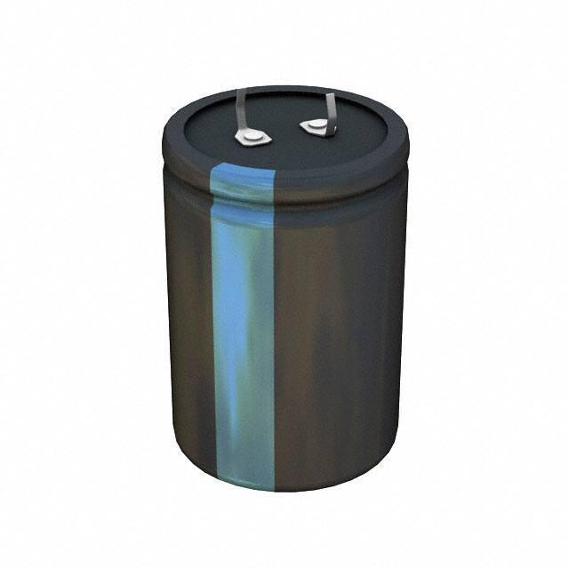

Type 380LQ 85 ºC Compact, High-Capacitance Snap-in 27% Smaller for Same Capacitance Type 380LQ is on average 27% smaller and more than 10 mm shorter than Type 380LX. This is achieved with a new can-closure method that permits installing capacitor elements into smaller cans. Approaching the capability of the 380LX, the new 380LQ enables you to shrink equipment size and retain the original performance. Highlights • New, more capacitance per case • Compare to Type 380LX • New, lower voltages down to 16 V Operating Temperature: Rated Voltage: Capacitance: Leakage Current: Ripple Current Multipliers: –40 °C to + 85 °C ≤ 315 Vdc –25 °C to + 85 °C ≥ 350 Vdc 16 to 450 Vdc 82 µF to 100,000 µF ± 20% ≤3 √CV µA, 4 mA max, 5 minutes Ambient Temperature 45 ºC 1.50 Frequency Freq. Hz 16 – 100 WV 160 – 450 WV 10 kHz 50 Hz 60 Hz 120 Hz 500 Hz 1 kHz & Up 0.93 0.75 0.95 0.80 1.00 1.00 1.05 1.20 1.08 1.25 1.15 1.40 60 ºC 1.46 70 ºC 1.30 85 ºC 1.00 Specifications Complies with the EU Directive 2002/95/EC requirement restricting the use of Lead (Pb), Mercury (Hg), Cadmium (Cd), Hexavalent chromium (Cr(VI)), PolyBrominated Biphenyls (PBB) and PolyBrominated Diphenyl Ethers (PBDE). Load LifeTest: EIA Ripple Life: Shelf Life: 2000 h at full load at 85 °C ∆ Capacitance ± 20% ESR 200% of limit DCL 100% of limit 2000 h at 85 °C, full load per EIA IS-749 ∆ Capacitance –20% ESR 200% of limit DCL 100% of limit 1000 h at 85 °C ∆ Capacitance ± 20% ESR 200% of limit DCL 100% of limit 10 to 55 Hz, 0.06" and 10 g max, 2 h each plane Vibration: CDM Cornell Dubilier • 140 Technology Place • Liberty, SC 29657 • Phone: (864)843-2277 • Fax: (864)843-3800 • www.cde.com Type 380LQ 85 ºC Compact, High-Capacitance Snap-in Outline Drawing Insulated Case Dimensions Case Code H01 H02 H03 H04 H45 H05 J01 J02 J03 J04 J45 J05 DIAMETER D mm 22 22 22 22 22 22 25 25 25 25 25 25 inches 0.87 0.87 0.87 0.87 0.87 0.87 0.98 0.98 0.98 0.98 0.98 0.98 LENGTH L mm 25 30 35 40 45 50 25 30 35 40 45 50 inches 0.98 1.18 1.38 1.57 1.77 1.97 0.98 1.18 1.38 1.57 1.77 1.97 Typical Weight (grams) 16 19 22 24 28 31 20 24 27 31 35 38 Case Code K01 K02 K03 K04 K45 K05 A01 A02 A03 A04 A45 A05 DIAMETER D mm 30 30 30 30 30 30 35 35 35 35 35 35 inches 1.18 1.18 1.18 1.18 1.18 1.18 1.38 1.38 1.38 1.38 1.38 1.38 LENGTH L mm 25 30 35 40 45 50 25 30 35 40 45 50 inches 0.98 1.18 1.38 1.57 1.77 1.97 0.98 1.18 1.38 1.57 1.77 1.97 Typical Weight (grams) 30 35 40 44 49 53 42 48 54 60 67 74 Part Numbering System 380LQ 561 M 160 H01 2 Type Capacitance 561 = 560 µF 392 = 3900 µF Tolerance M = ±20% Typical Performance Curves 16 = 016 450 = 450 V Rated Voltage Case Code Insulation 2=PVC CDM Cornell Dubilier • 140 Technology Place • Liberty, SC 29657 • Phone: (864)843-2277 • Fax: (864)843-3800 • www.cde.com Type 380LQ 85 ºC Compact, High-Capacitance Snap-in Ratings Cap. (µF) Catalog Part Number ESR Max @ 25º C 120 Hz 20 kHz (Ω) (Ω) 16 Vdc (20 Vdc Surge) 12000 15000 18000 18000 22000 22000 27000 27000 27000 33000 33000 33000 33000 39000 39000 47000 47000 47000 56000 56000 68000 68000 82000 100000 8200 12000 12000 15000 15000 18000 18000 18000 22000 22000 22000 22000 27000 27000 33000 33000 33000 39000 39000 47000 380LQ123M016H012 380LQ153M016H022 380LQ183M016H032 380LQ183M016J012 380LQ223M016H042 380LQ223M016J022 380LQ273M016H452 380LQ273M016J032 380LQ273M016K012 380LQ333M016H052 380LQ333M016J042 380LQ333M016K022 380LQ333M016A012 380LQ393M016J452 380LQ393M016K032 380LQ473M016J052 380LQ473M016K042 380LQ473M016A022 380LQ563M016K452 380LQ563M016A032 380LQ683M016K052 380LQ683M016A042 380LQ823M016A452 380LQ104M016A052 380LQ822M025H012 380LQ123M025H022 380LQ123M025J012 380LQ153M025H032 380LQ153M025J022 380LQ183M025H042 380LQ183M025J032 380LQ183M025K012 380LQ223M025H452 380LQ223M025J042 380LQ223M025K022 380LQ223M025A012 380LQ273M025J452 380LQ273M025K032 380LQ333M025J052 380LQ333M025K042 380LQ333M025A022 380LQ393M025K452 380LQ393M025A032 380LQ473M025K052 0.069 0.055 0.046 0.046 0.038 0.038 0.031 0.031 0.031 0.025 0.025 0.025 0.025 0.024 0.024 0.023 0.023 0.023 0.022 0.022 0.021 0.021 0.020 0.019 0.081 0.055 0.055 0.044 0.044 0.037 0.037 0.037 0.030 0.030 0.030 0.030 0.025 0.025 0.020 0.020 0.020 0.020 0.020 0.019 0.059 0.047 0.039 0.039 0.032 0.032 0.026 0.026 0.026 0.021 0.021 0.021 0.021 0.020 0.020 0.019 0.019 0.019 0.019 0.018 0.018 0.018 0.018 0.018 0.065 0.044 0.044 0.035 0.035 0.029 0.029 0.029 0.024 0.024 0.024 0.024 0.020 0.020 0.016 0.016 0.016 0.016 0.016 0.016 4.52 5.26 5.57 5.57 6.10 6.10 6.31 6.31 6.31 6.84 6.84 6.84 6.84 6.94 6.94 7.47 7.47 7.47 8.73 8.73 9.05 9.05 9.49 10.18 3.57 4.10 4.10 4.63 4.63 5.47 5.47 5.47 6.10 6.10 6.10 6.10 6.21 6.21 6.84 6.84 6.84 7.36 7.36 8.00 5.20 6.05 6.41 6.41 7.02 7.02 7.26 7.26 7.26 7.87 7.87 7.87 7.87 7.98 7.98 8.59 8.59 8.59 10.04 10.04 10.41 10.41 10.91 11.71 4.11 4.72 4.72 5.32 5.32 6.29 6.29 6.29 7.02 7.02 7.02 7.02 7.14 7.14 7.87 7.87 7.87 8.46 8.46 9.20 22 x 25 22 x 30 22 x 35 25 x 25 22 x 40 25 x 30 22 x 45 25 x 25 30 x 25 22 x 50 25 x 40 30 x 30 35 x 25 25 x 45 30 x 35 25 x 50 30 x 40 35 x 30 30 x 45 35 x 35 30 x 50 35 x 40 35 x 45 35 x 50 22 x 25 22 x 30 25 x 25 22 x 35 25 x 30 22 x 40 25 x 35 30 x 25 22 x 45 25 x 40 30 x 30 35 x 25 25 x 45 30 x 35 25 x 50 30 x 40 35 x 30 30 x 45 35 x 35 30 x 50 3300 4700 4700 5600 6800 6800 6800 8200 8200 10000 10000 10000 10000 12000 12000 12000 15000 15000 18000 5600 8200 8200 10000 10000 12000 12000 12000 15000 15000 18000 18000 18000 22000 22000 22000 27000 27000 33000 33000 39000 47000 Ripple Amps Nominal @ 85 ºC Size 120 Hz 20 kHz D x L (A) (A) (mm) Cap. (µF) 47000 56000 68000 Catalog Part Number 380LQ473M025A042 380LQ563M025A452 380LQ683M025A052 380LQ562M035H012 380LQ822M035H022 380LQ822M035J012 380LQ103M035H032 380LQ103M035J022 380LQ123M035H042 380LQ123M035J032 380LQ123M035K012 380LQ153M035H452 380LQ153M035J042 380LQ183M035J452 380LQ183M035K022 380LQ183M035A012 380LQ223M035J052 380LQ223M035K032 380LQ223M035A022 380LQ273M035K452 380LQ273M035A032 380LQ333M035K052 380LQ333M035A042 380LQ393M035A452 380LQ473M035A052 380LQ332M050H012 380LQ472M050H022 380LQ472M050J012 380LQ562M050H032 380LQ682M050H042 380LQ682M050J022 380LQ682M050K012 380LQ822M050H452 380LQ822M050J032 380LQ103M050H052 380LQ103M050J042 380LQ103M050K022 380LQ103M050A012 380LQ123M050J452 380LQ123M050K032 380LQ123M050A022 380LQ153M050K042 380LQ153M050A032 380LQ183M050K452 ESR Max Ripple Amps Nominal @ 25º C @ 85 ºC Size 120 Hz 20 kHz 120 Hz 20 kHz D x L (Ω) (Ω) (A) (A) (mm) 0.019 0.019 0.018 0.104 0.071 0.071 0.058 0.058 0.048 0.048 0.048 0.039 0.039 0.032 0.032 0.032 0.026 0.026 0.026 0.021 0.021 0.018 0.018 0.017 0.017 0.151 0.106 0.106 0.089 0.073 0.073 0.073 0.061 0.061 0.05 0.05 0.05 0.05 0.041 0.041 0.041 0.033 0.033 0.028 0.015 0.016 0.016 0.078 0.053 0.053 0.044 0.044 0.036 0.036 0.036 0.029 0.029 0.024 0.024 0.024 0.020 0.020 0.020 0.016 0.016 0.013 0.014 0.014 0.014 0.113 0.079 0.079 0.067 0.055 0.055 0.055 0.045 0.045 0.037 0.037 0.037 0.037 0.031 0.031 0.031 0.025 0.025 0.021 8.00 8.91 9.79 3.36 4.00 4.00 4.42 4.42 5.05 5.05 5.05 5.57 5.57 5.68 5.68 5.68 6.10 6.10 6.10 6.84 6.84 7.15 7.15 7.91 8.56 2.73 3.03 3.03 3.42 3.85 3.85 3.85 4.41 4.41 4.97 4.97 4.97 4.97 5.58 5.58 5.58 6.44 6.44 6.94 9.20 10.25 11.26 3.86 4.60 4.60 5.08 5.08 5.81 5.81 5.81 6.41 6.41 6.53 6.53 6.53 7.02 7.02 7.02 7.87 7.87 8.22 8.22 9.10 9.84 3.14 3.48 3.48 3.93 4.43 4.43 4.43 5.07 5.07 5.72 5.72 5.72 5.72 6.42 6.42 6.42 7.41 7.41 7.98 35 x 40 35 x 45 35 x 50 22 x 25 22 x 30 25 x 25 22 x 35 25 x 30 22 x 40 25 x 35 30 x 25 22 x 45 25 x 40 25 x 45 30 x 30 35 x 25 25 x 50 30 x 35 35 x 30 30 x 45 35 x 35 30 x 50 35 x 40 35 x 45 35 x 50 22 x 25 22 x 30 25 x 25 22 x 35 22 x 40 25 x 30 30 x 25 22 x 45 25 x 35 22 x 50 25 x 40 30 x 30 35 x 25 25 x 45 30 x 35 35 x 30 30 x 40 35 x 35 30 x 45 35 Vdc (44 Vdc Surge) 25 Vdc (32 Vdc Surge) 50 Vdc (63 Vdc Surge) CDM Cornell Dubilier • 140 Technology Place • Liberty, SC 29657 • Phone: (864)843-2277 • Fax: (864)843-3800 • www.cde.com Type 380LQ 85 ºC Compact, High-Capacitance Snap-in Cap. (µF) 27000 2200 3300 3300 3900 3900 4700 5600 5600 6800 6800 6800 8200 8200 8200 10000 10000 12000 12000 15000 18000 18000 1500 1800 2200 2200 2700 2700 3300 3300 3300 3900 3900 3900 4700 4700 5600 5600 5600 6800 6800 8200 8200 Catalog Part Number 380LQ273M050A052 380LQ222M063H012 380LQ332M063H022 380LQ332M063J012 380LQ392M063H032 380LQ392M063J022 380LQ472M063H042 380LQ562M063H452 380LQ562M063J042 380LQ682M063J452 380LQ682M063K022 380LQ682M063A012 380LQ822M063J052 380LQ822M063K032 380LQ822M063A022 380LQ103M063K042 380LQ103M063A032 380LQ123M063K452 380LQ123M063A042 380LQ153M063A452 380LQ183M063A052 380LQ183M063A052 380LQ152M080H012 380LQ182M080H022 380LQ222M080H032 380LQ222M080J012 380LQ272M080H042 380LQ272M080J022 380LQ332M080H452 380LQ332M080J032 380LQ332M080K012 380LQ392M080H052 380LQ392M080J042 380LQ392M080A012 380LQ472M080H452 380LQ472M080K022 380LQ562M080J052 380LQ562M080K032 380LQ562M080A022 380LQ682M080K452 380LQ682M080A032 380LQ822M080K052 380LQ822M080A042 ESR Max Ripple Amps Nominal @ 85 ºC Size @ 25º C 120 Hz 20 kHz 120 Hz 20 kHz D x L (A) (A) (mm) (Ω) (Ω) 0.018 0.188 0.126 0.126 0.106 0.106 0.088 0.074 0.074 0.061 0.061 0.061 0.051 0.051 0.051 0.041 0.041 0.035 0.035 0.028 0.023 0.023 0.221 0.184 0.151 0.151 0.123 0.123 0.100 0.100 0.100 0.085 0.085 0.085 0.071 0.071 0.059 0.059 0.059 0.049 0.049 0.040 0.040 0.015 0.141 0.094 0.094 0.080 0.080 0.066 0.056 0.056 0.046 0.046 0.046 0.038 0.038 0.038 0.031 0.031 0.026 0.026 0.021 0.018 0.018 0.166 0.138 0.113 0.113 0.092 0.092 0.075 0.075 0.075 0.064 0.064 0.064 0.053 0.053 0.044 0.044 0.044 0.037 0.037 0.030 0.030 8.96 2.52 4.10 4.10 4.44 4.44 4.86 5.36 5.36 5.84 5.84 5.84 6.00 6.00 6.00 6.52 6.52 7.15 7.15 7.91 8.55 8.55 2.26 2.52 2.73 2.73 2.78 2.78 3.21 3.21 3.21 3.59 3.59 3.59 4.09 4.09 4.55 4.55 4.55 5.16 5.16 5.83 5.83 10.30 2.90 4.72 4.72 5.11 5.11 5.59 6.16 6.16 6.72 6.72 6.72 6.90 6.90 6.90 7.50 7.50 8.22 8.22 9.10 9.83 9.83 2.60 2.90 3.14 3.14 3.20 3.20 3.69 3.69 3.69 4.13 4.13 4.13 4.70 4.70 5.23 5.23 5.23 5.93 5.93 6.70 6.70 35 x 50 1000 22 x 25 22 x 30 25 x 25 22 x 35 25 x 30 22 x 40 22 x 45 25 x 40 25 x 45 30 x 30 35 x 25 25 x 50 30 x 35 35 x 30 30 x 40 35 x 35 30 x 45 35 x 40 35 x 45 35 x 50 35 x 50 22 x 25 22 x 30 22 x 35 25 x 25 22 x 40 25 x 30 22 x 45 25 x 35 30 x 25 22 x 50 25 x 40 35 x 25 25 x 45 30 x 30 25 x 50 30 x 35 35 x 30 30 x 45 35 x 35 30 x 50 35 x 40 560 680 820 1000 1000 1200 1200 1200 1500 1500 1500 1500 1800 1800 1800 2200 2200 2700 2700 3300 1200 1500 1800 1800 2200 2200 2200 2700 2700 2700 2700 3300 3300 3900 3900 3900 4700 4700 5600 5600 6800 8200 63 Vdc (79 Vdc Surge) Cap. (µF) Catalog Part Number ESR Max Ripple Amps Nominal @ 25º C @ 85 ºC Size 120 Hz 20 kHz 120 Hz 20 kHz D x L (Ω) (Ω) (A) (A) (mm) 0.332 0.276 0.221 0.184 0.184 0.151 0.151 0.151 0.123 0.123 0.123 0.123 0.100 0.100 0.085 0.085 0.085 0.071 0.071 0.059 0.059 0.049 0.040 0.355 0.293 0.243 0.199 0.199 0.166 0.166 0.166 0.133 0.133 0.133 0.133 0.111 0.120 0.111 0.090 0.098 0.074 0.080 0.070 0.216 0.180 0.144 0.120 0.120 0.098 0.098 0.098 0.080 0.080 0.080 0.080 0.065 0.065 0.055 0.055 0.055 0.046 0.046 0.041 0.038 0.034 0.030 0.160 0.132 0.109 0.090 0.090 0.075 0.075 0.075 0.060 0.060 0.060 0.060 0.050 0.054 0.050 0.041 0.049 0.033 0.040 0.035 1.96 2.31 2.57 2.84 2.84 3.14 3.14 3.14 3.71 3.71 3.71 3.71 4.06 4.06 4.54 4.54 4.54 5.13 5.13 5.75 5.75 6.60 7.29 2.25 2.50 2.75 3.00 3.00 3.25 3.25 3.25 3.73 3.73 3.73 3.73 4.20 4.20 4.20 4.78 4.78 5.45 5.45 5.75 2.25 2.66 2.96 3.27 3.27 3.61 3.61 3.61 4.27 4.27 4.27 4.27 4.67 4.67 5.22 5.22 5.22 5.90 5.90 6.61 6.61 7.59 8.38 3.15 3.50 3.85 4.20 4.20 4.55 4.55 4.55 5.22 5.22 5.22 5.22 5.88 5.88 5.88 6.69 6.69 7.63 7.63 8.05 22 x 25 25 x 25 22 x 30 22 x 35 25 x 30 22 x 45 25 x 35 30 x 25 22 x 50 25 x 40 30 x 30 35 x 25 25 x 45 30 x 35 25 x 50 30 x 40 35 x 30 30 x 45 35 x 35 30 x 50 35 x 40 35 x 45 35 x 50 22 x 25 22 x 30 22 x 35 22 x 40 25 x 30 22 x 45 25 x 35 30 x 25 22 x 50 25 x 40 30 x 30 35 x 25 25 x 45 30 x 35 35 x 30 30 x 40 35 x 35 30 x 45 35 x 40 35 x 45 100 Vdc (125 Vdc Surge) 380LQ102M100H012 380LQ122M100J012 380LQ152M100H022 380LQ182M100H032 380LQ182M100J022 380LQ222M100H452 380LQ222M100J032 380LQ222M100K012 380LQ272M100H052 380LQ272M100J042 380LQ272M100K022 380LQ272M100A012 380LQ332M100J452 380LQ332M100K032 380LQ392M100J052 380LQ392M100K042 380LQ392M100A022 380LQ472M100K452 380LQ472M100A032 380LQ562M100K052 380LQ562M100A042 380LQ682M100A452 380LQ822M100A052 380LQ561M160H012 380LQ681M160H022 380LQ821M160H032 380LQ102M160H042 380LQ102M160J022 380LQ122M160H452 380LQ122M160J032 380LQ122M160K012 380LQ152M160H052 380LQ152M160J042 380LQ152M160K022 380LQ152M160A012 380LQ182M160J452 380LQ182M160K032 380LQ182M160A022 380LQ222M160K042 380LQ222M160A032 380LQ272M160K452 380LQ272M160A042 380LQ332M160A452 80 Vdc (100 Vdc Surge) 160 Vdc (200 Vdc Surge) CDM Cornell Dubilier • 140 Technology Place • Liberty, SC 29657 • Phone: (864)843-2277 • Fax: (864)843-3800 • www.cde.com Type 380LQ 85 ºC Compact, High-Capacitance Snap-in ESR Max @ 25º C Cap. (µF) 1000 1200 1200 1200 1200 1500 1500 1500 1800 1800 1800 2200 2200 2700 2700 3300 390 470 560 560 680 680 820 820 820 1000 1000 1000 1000 1200 1200 1200 1500 1500 1500 1800 1800 2200 2200 2700 270 330 390 390 470 470 560 Catalog Part Number 380LQ102M180K012 380LQ122M180H052 380LQ122M180J042 380LQ122M180K022 380LQ122M180A012 380LQ152M180J452 380LQ152M180K032 380LQ152M180A022 380LQ182M180J052 380LQ182M180K042 380LQ182M180A022 380LQ222M180K452 380LQ222M180A042 380LQ272M180K052 380LQ272M180A452 380LQ332M180A052 120 Hz 20 kHz Ripple Amps @ 85 ºC 120 Hz 20 kHz (A) 4.20 4.63 4.63 4.63 4.63 5.36 5.36 5.36 6.05 6.05 6.05 6.89 6.89 7.73 7.73 8.05 2.35 2.59 3.40 3.40 3.75 3.75 4.10 4.10 4.10 4.55 4.55 4.55 4.55 4.90 4.90 4.90 5.42 5.42 5.42 6.05 6.05 6.89 6.89 7.63 1.83 2.45 2.67 2.67 2.95 2.95 3.15 Nominal Size DxL (mm) 30 x 25 22 x 50 25 x 40 30 x 30 35 x 25 25 x 45 30 x 35 35 x 30 25 x 50 30 x 40 35 x 30 30 x 45 35 x 40 30 x 50 35 x 45 35 x 50 22 x 25 22 x 30 22 x 30 25 x 25 22 x 35 25 x 30 22 x 40 25 x 30 30 x 25 22 x 45 25 x 35 30 x 30 35 x 25 22 x 50 25 x 40 30 x 30 25 x 50 30 x 35 35 x 30 30 x 45 35 x 35 30 x 50 35 x 40 35 x 50 22 x 25 22 x 30 22 x 30 25 x 25 22 x 35 25 x 30 22 x 40 Cap. (µF) 560 560 680 680 680 680 820 820 820 820 1000 1000 1000 1200 1200 1500 1500 1800 2200 Catalog ESR Max @ 25º C 120 Hz 20 kHz Part Number (Ω) (Ω) 380LQ561M250J022 0.355 0.160 380LQ561M250K012 0.355 0.160 380LQ681M250H452 0.293 0.132 380LQ681M250J032 0.293 0.132 380LQ681M250K012 0.293 0.132 380LQ681M250K022 0.293 0.132 380LQ821M250H052 0.243 0.109 380LQ821M250J042 0.243 0.109 380LQ821M250K022 0.243 0.109 380LQ821M250A012 0.243 0.121 380LQ102M250J452 0.199 0.090 380LQ102M250K032 0.199 0.090 380LQ102M250A022 0.199 0.090 380LQ122M250K042 0.166 0.075 380LQ122M250A032 0.166 0.083 380LQ152M250K052 0.133 0.066 380LQ152M250A042 0.133 0.066 0.055 380LQ182M250A452 0.111 380LQ222M250A052 0.105 0.052 315 Vdc (385 Vdc Surge) 180 380LQ181M315H012 1.105 0.553 220 380LQ221M315H022 0.904 0.452 270 380LQ271M315H022 0.737 0.368 330 380LQ331M315H042 0.603 0.301 330 380LQ331M315J022 0.603 0.301 330 380LQ331M315K012 0.603 0.301 390 380LQ391M315H452 0.510 0.255 390 380LQ391M315J032 0.510 0.255 390 390LQ391M315K022 0.510 0.255 470 380LQ471M315H052 0.423 0.212 470 380LQ471M315J042 0.423 0.212 470 380LQ471M315K022 0.423 0.212 470 380LQ471M315A012 0.423 0.233 560 380LQ561M315J452 0.355 0.178 560 380LQ561M315K032 0.355 0.178 560 380LQ561M315A022 0.355 0.195 680 380LQ681M35K042 0.293 0.148 680 380LQ681M315A032 0.293 0.146 820 380LQ821M315K452 0.243 0.121 820 380LQ821M315A042 0.243 0.121 1000 380LQ102M315K052 0.199 0.090 1000 380LQ102M315A452 0.199 0.109 350 Vdc (400 Vdc Surge) 150 380LQ151M350H012 1.328 0.663 180 380LQ181M350H022 1.105 0.553 220 380LQ221M350H032 0.904 0.452 270 380LQ271M350H042 0.737 0.368 270 380LQ271M350J022 0.737 0.368 330 380LQ331M350H452 0.603 0.301 330 380LQ331M350J032 0.603 0.301 Ripple Amps @ 85 ºC 120 Hz (A) 2.25 2.25 2.50 2.50 2.30 2.50 2.77 2.77 2.77 2.77 3.32 3.32 3.32 3.53 3.53 4.04 4.04 4.55 5.00 1.21 1.41 1.60 1.82 1.82 1.82 2.01 2.01 2.01 2.27 2.27 2.27 2.27 2.56 2.56 2.56 2.87 2.87 3.25 3.25 3.63 3.63 1.12 1.22 1.44 1.66 1.66 1.88 1.88 20 kHz (A) 3.15 3.15 3.50 3.50 3.20 3.50 3.88 3.88 3.88 3.88 4.65 4.65 4.65 4.94 4.94 5.66 5.66 6.37 7.00 1.69 1.97 2.24 2.55 2.55 2.55 2.81 2.81 2.81 3.18 3.18 3.18 3.18 3.58 3.58 3.58 4.02 4.55 4.55 4.55 5.08 5.08 1.57 1.71 2.02 2.32 2.32 2.63 2.63 Nominal Size DxL (mm) 25 x 30 30 x 25 22 x 45 25 x 35 30 x 25 30 x 30 22 x 50 25 x 40 30 x 30 35 x 25 25 x 45 30 x 35 35 x 30 30 x 40 35 x 35 30 x 50 35 x 40 35 x 45 35 x 50 22 x 25 22 x 30 22 x 30 22 x 40 25 x 30 30 x 25 22 x 45 25 x 35 30 x 30 22 x 50 25 x 40 30 x 30 35 x 25 25 x 45 30 x 35 35 x 30 30 x 40 35 x 35 30 x 45 35 x 40 30 x 50 35 x 45 22 x 25 22 x 30 22 x 35 22 x 40 25 x 30 22 x 45 25 x 35 (Ω) (Ω) (A) 0.199 0.090 3.00 0.166 0.075 3.31 0.166 0.075 3.31 0.166 0.075 3.31 0.166 0.075 3.31 0.133 0.060 3.83 0.133 0.060 3.83 0.133 0.060 3.83 0.120 0.054 4.32 0.120 0.054 4.32 0.120 0.054 4.32 0.098 0.049 4.92 0.098 0.049 4.92 0.086 0.043 5.52 0.086 0.043 5.52 0.080 0.040 5.75 200 Vdc (250 Vdc Surge) 380LQ391M200H012 0.510 0.230 1.68 380LQ471M200H022 0.423 0.190 1.85 380LQ561M200H022 0.355 0.160 2.43 380LQ561M200J012 0.355 0.160 2.43 380LQ681M200H032 0.293 0.132 2.68 380LQ681M200J022 0.293 0.132 2.68 380LQ821M200H042 0.243 0.109 2.93 380LQ821M200J022 0.243 0.109 2.93 380LQ821M200K012 0.243 0.109 2.93 380LQ102M200H452 0.199 0.090 3.25 380LQ102M200J032 0.199 0.090 3.25 0.090 3.25 380LQ102M200K022 0.199 3.25 380LQ102M200A012 0.232 0.116 380LQ122M200H052 0.166 0.075 3.50 380LQ122M200J042 0.166 0.075 3.50 380LQ122M200K022 0.166 0.075 3.50 380LQ152M200J052 0.133 0.060 3.87 380LQ152M200K032 0.144 0.065 3.87 380LQ152M200A022 0.144 0.065 3.87 380LQ182M200K452 0.160 0.080 4.32 380LQ182M200A032 0.120 0.060 4.32 380LQ222M200K052 0.098 0.049 4.92 380LQ222M200A042 0.105 0.053 4.92 380LQ272M200A052 0.086 0.043 5.45 250 Vdc (300 Vdc Surge) 380LQ271M250H012 0.737 0.332 1.31 380LQ331M250H022 0.603 0.271 1.75 380LQ391M250H022 0.510 0.230 1.91 380LQ391M250J012 0.510 0.230 1.91 380LQ471M250H032 0.423 0.190 2.11 380LQ471M250J022 0.423 0.190 2.11 380LQ561M250H042 0.355 0.160 2.25 CDM Cornell Dubilier • 140 Technology Place • Liberty, SC 29657 • Phone: (864)843-2277 • Fax: (864)843-3800 • www.cde.com Type 380LQ 85 ºC Compact, High-Capacitance Snap-in ESR Max @ 25º C Cap. (µF) 390 390 390 390 470 470 470 560 560 560 680 680 820 820 1000 120 150 180 180 220 220 220 270 270 270 330 330 330 330 390 390 390 470 470 470 560 560 680 680 680 820 820 Catalog Part Number 380LQ391M350H052 380LQ391M350J042 380LQ391M350K022 380LQ391M350A012 380LQ471M350J452 380LQ471M350K032 380LQ471M350A022 380LQ561M350J050 380LQ561M350K042 380LQ561M350A022 380LQ681M350K452 380LQ681M350A032 380LQ821M350K052 380LQ821M350A452 380LQ102M350A052 Ripple Amps @ 85 ºC Nominal Size DxL (mm) 22 x 50 25 x 40 30 x 30 35 x 25 25 x 45 30 x 35 35 x 30 25 x 50 30 x 40 35 x 30 30 x 45 35 x 35 30 x 50 35 x 45 35 x 50 22 x 25 22 x 30 22 x 30 22 x 35 22 x 35 22 x 40 25 x 30 22 x 45 25 x 35 30 x 30 22 x 50 25 x 40 30 x 30 35 x 25 25 x 45 30 x 35 35 x 30 25 x 50 30 x 40 35 x 30 30 x 45 35 x 35 30 x 50 35 x 40 35 x 45 35 x 45 35 x 50 Cap. (µF) 150 150 180 220 220 220 270 270 330 330 390 390 390 470 470 560 560 680 82 100 120 150 150 180 180 220 220 220 220 220 270 270 270 330 330 330 330 390 390 470 470 560 560 680 Catalog Part Number ESR Max @ 25º C Ripple Amps @ 85 ºC Nominal Size DxL (mm) 22 x 30 25 x 25 22 x 35 22 x 40 25 x 35 30 x 25 22 x 45 25 x 40 25 x 45 30 x 30 25 x 50 30 x 35 35 x 30 30 x 40 35 x 35 30 x 45 35 x 40 35 x 45 22 x 25 22 x 25 22 x 30 22 x 35 25 x 30 22 x 40 25 x 30 22 x 45 25 x 35 25 x 40 30 x 30 35 x 25 22 x 50 25 x 40 30 x 30 25 x 50 30 x 35 30 x 40 35 x 30 30 x 40 35 x 35 30 x 45 35 x 40 30 x 50 35 x 45 35 x 50 120 Hz 20 kHz 120 Hz 20 kHz (Ω) (Ω) (A) (A) 0.510 0.510 0.510 0.510 0.423 0.423 0.423 0.355 0.355 0.355 0.293 0.293 0.243 0.243 0.199 0.255 0.255 0.255 0.255 0.211 0.211 0.211 0.178 0.178 0.178 0.146 0.146 0.121 0.121 0.109 2.06 2.06 2.06 2.06 2.40 2.40 2.40 2.60 2.60 2.60 2.96 2.96 3.25 3.25 3.54 2.88 2.88 2.88 2.88 3.36 3.36 3.36 3.64 3.64 3.64 4.14 4.14 4.55 4.55 4.96 1.43 1.62 1.80 2.02 1.90 2.09 2.09 2.34 2.34 2.34 2.66 2.66 2.66 2.66 2.98 2.98 2.98 3.35 3.35 3.35 3.77 3.77 4.14 3.80 4.14 4.15 4.55 120 Hz 20 kHz 120 Hz 20 kHz (Ω) (Ω) (A) (A) 1.65 1.65 1.95 2.10 2.10 2.10 2.40 2.40 2.75 2.75 3.05 3.05 3.05 3.40 3.40 3.85 3.85 4.35 1.16 1.30 1.46 1.67 1.67 1.89 1.89 2.17 2.00 2.17 2.17 2.17 2.49 2.49 2.49 2.81 2.60 2.81 2.81 3.14 3.14 3.54 3.54 3.95 3.95 4.25 420 Vdc (470 Vdc Surge) 380LQ151M420H022 1.330 0.660 1.20 380LQ151M420J012 1.330 0.660 1.20 380LQ181M420H032 1.100 0.550 1.40 380LQ221M420H042 0.904 0.452 1.50 380LQ221M420J032 0.904 0.452 1.50 380LQ221M420K012 0.904 0.452 1.50 380LQ271M420H452 0.737 0.368 1.75 380LQ271M420J042 0.737 0.368 1.75 380LQ331M420J452 0.603 0.302 1.95 380LQ331M420K022 0.603 0.302 1.95 380LQ391M420J052 0.510 0.255 2.15 380LQ391M420K032 0.510 0.255 2.15 380LQ391M420A022 0.510 0.255 2.15 380LQ471M420K042 0.423 0.212 2.45 380LQ471M420A032 380LQ561M420K452 380LQ561M420A042 380LQ681M420A452 0.423 0.355 0.355 0.293 0.212 0.178 0.178 0.146 2.45 2.75 2.75 3.10 400 Vdc (450 Vdc Surge) 380LQ121M400H012 1.658 0.830 1.02 380LQ151M400H022 1.326 0.660 1.16 380LQ181M400H022 1.105 0.552 1.30 380LQ181M400H032 380LQ221M400H032 380LQ221M400H042 380LQ221M400J022 380LQ271M400J032 1.105 0.904 0.904 0.904 0.737 0.552 0.452 0.452 0.452 0.368 0.368 0.368 0.301 0.301 0.301 0.301 0.255 0.255 0.255 0.212 0.212 0.212 0.178 0.178 0.148 0.148 0.148 0.122 0.122 1.44 1.40 1.49 1.49 1.67 1.67 1.67 1.90 1.90 1.90 1.90 2.13 2.13 2.13 2.39 2.39 2.39 2.69 2.69 2.96 2.70 2.96 2.95 3.25 450 Vdc (500 Vdc Surge) 380LQ820M450H012 2.426 1.213 0.83 380LQ101M450H012 1.990 0.995 0.93 380LQ121M450H022 1.656 0.829 1.04 380LQ151M450H032 1.326 380LQ151M450J022 380LQ181M450J022 380LQ221M450J032 380LQ221M450J042 1.326 1.105 0.904 0.904 380LQ181M450H042 1.105 380LQ221M450H452 0.904 0.663 0.663 0.553 0.553 0.452 0.452 0.452 0.452 0.452 0.368 0.368 0.368 0.302 0.302 0.302 0.302 0.255 0.255 0.212 0.212 0.178 0.178 0.146 1.19 1.19 1.35 1.35 1.55 1.45 1.55 1.55 1.55 1.78 1.78 1.78 2.01 1.90 2.01 2.01 2.24 2.24 2.53 2.53 2.82 2.82 3.00 380LQ271M400H452 0.737 380LQ271M400K022 0.737 380LQ331M400H052 0.603 380LQ331M400J042 0.603 380LQ331M400K022 0.603 380LQ331M400A012 0.603 380LQ391M400J452 0.510 380LQ391M400K032 0.510 380LQ391M400A022 0.510 380LQ471M400J052 0.423 380LQ471M400K042 0.423 380LQ471M400A022 0.423 380LQ561M400K452 0.355 380LQ561M400A032 0.355 380LQ681M400K052 0.293 380LQ681M400A042 0.293 380LQ681M400A452 0.293 380LQ821M400A452 0.243 380LQ821M400A052 0.243 380LQ221M450K022 0.904 380LQ221M450A012 0.904 380LQ271M450H052 0.737 380LQ271M450J042 380LQ331M450J052 0.737 0.603 380LQ271M450K022 0.737 380LQ331M450K032 0.603 380LQ331M450K042 0.603 380LQ331M450A022 0.603 380LQ391M450K042 0.510 380LQ391M450A032 0.510 380LQ471M450K452 0.423 380LQ471M450A042 0.423 380LQ561M450K052 0.355 380LQ561M450A452 0.355 380LQ681M450A052 0.293 CDM Cornell Dubilier • 140 Technology Place • Liberty, SC 29657 • Phone: (864)843-2277 • Fax: (864)843-3800 • www.cde.com
