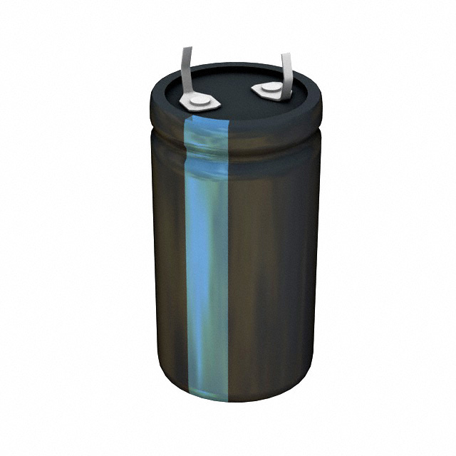

380LX152M100H042 数据手册
Type 380LX / 382LX 85 °C High Capacitance, Snap-In Aluminum 2, 4 and 5 pin styles available The excellent value of Type 380L/LX capacitors finds application in switching power supply input and output circuits and even motor drives where the high surface area of multiple units in parallel approaches the ripple capability of our Type 520C computer-grade capacitor. Type 380LX delivers more capacitance per can size while Type 380L available in the largest case sizes gives lower ESR for the same capacitance. Types 382L and 382LX give the choice of 4 or 5 leads for stable, reverse proof mounting. Highlights Specifications - Latest available ratings, worldwide - Top performance in power supplies and motor drives - Big selection of 49 case sizes - 2, 4 and 5 leads available Temperature Range –40 °C to +85 °C ≤ 250 Vdc –25 °C to +85 °C ≥ 315 Vdc Rated Voltage Range 16 Vdc to 600 Vdc Capacitance Range 33 µF to 270,000 µF Capacitance Tolerance ± 20% Leakage Current ≤3√CV µA at 5 min Ambient Temperature Ripple Current Multipliers 45 ºC 60 ºC 70 ºC 85 ºC 0 - 500 Vdc 1.50 1.40 1.30 1.00 501- 600 Vdc 1.90 1.90 1.80 1.00 Frequency 50 Hz 60 Hz 120 Hz 500 kHz 1 kHz 16 - 100 Vdc 10 kHz 0.93 0.95 1.00 1.05 1.08 1.15 160 - 450 Vdc 0.75 0.80 1.00 1.20 1.25 1.40 500 - 600 Vdc 0.70 0.75 1.00 1.20 1.25 1.30 Low Temperature Characteristics Impedance ratio: Z–20⁰C ∕ Z+25⁰C @120Hz ≤ 8 (16–50 Vdc) ≤ 4 (63–100 Vdc) ≤ 3 (150–600 Vdc) Endurance Life Test 3,000 h @ full load at +85 °C ∆ Capacitance ±20% ESR 200% of limit DCL 100% of limit Shelf Life Test 0 - 500 Vdc 1,000 h @ 85 °C ∆ Capacitance ±20% ESR 200% of limit DCL 100% of limit 501 - 600 Vdc 500 h @ 85 °C ∆ Capacitance ±20% ESR 200% of limit DCL 100% of limit Vibration 10 to 55 Hz, 0.06” and 10 g max, 2 h in each plane Regulatory Information CDM Cornell Dubilier • 140 Technology Place • Liberty, SC 29657 • Phone: (864)843-2277 • Fax: (864)843-3800 Type 380LX / 382LX 85 °C High Capacitance, Snap-In Aluminum 2, 4 and 5 pin styles available Part Numbering System 382LX 272 M 200 Type Cap Tolerance Voltage M = ±20% 200 = 200 Vdc N05 2 V Case 380L / LX (2 pins) 272 = 2700 µF Code Insulation # of pins 2 = PVC Blank = 2 pins / 4 pins snap-in 6.3mm L or PET(PET after 12/19 382L / LX (4 or 5 pins) 333 = 33000 µF A = 2 pins snap-in 4.0mm L VS = 5 pins snap-in 6.3mm L Outline Drawings Two Pins 380L/LX (22 through 40 mm diameter) Dimensions shown are in mm V = 5 pins standoff Sleeving is PVC or PET (PET for all date codes after December 2019) Available in 2, 4 and 5 pins Top of Capacitor Body ± Four Pins 382L/LX (35, 40 and 45mm diameter) 2.0max. 6.3 1 4.0 +0.2 0.8 -0.1 1.5 0.2 6.3 mm pinlength length 6.3 pin Available in 2 2 and and 4 4 pins pins Available in +0.2 0.8 -0.1 3.5 Top of Capacitor Body 4.0 2.0max. 1.5 0.2 pin length 4.04.0 mm pin length option (add “A” to end of part#) L ± 2 max. Five Pins 382L/LX (40 and 50mm diameter) Available in 5 pins 0.7 Top of Capacitor Body 1.5 0.1 3.75 0.1 0.6 min. 5 pin Standoff pin style (add “V” to end of part#) L ± 2 max. Connection Terminal 40 mm Dia. 50 mm Dia. A dummy negative (–) B dummy dummy C positive (+) positive (+) D dummy positive (+) – negative (–) negative (–) Notes: * Use dummy terminals for mechanical support only. Make no electrical connection because they resistively connect through the electrolyte to the negative terminal. ** Safety Vent may be on the bottom or on the side of the can. CDM Cornell Dubilier • 140 Technology Place • Liberty, SC 29657 • Phone: (864)843-2277 • Fax: (864)843-3800 Type 380LX / 382LX 85 °C High Capacitance, Snap-In Aluminum 2, 4 and 5 pin styles available Insulated Case Dimensions DIAMETER “D” Case Code LENGTH “L” Typical Weight mm inches mm inches (grams) H20 22 0.87 20 0.79 14 H01 22 0.87 25 0.98 16 H02 22 0.87 30 1.18 H03 22 0.87 35 H04 22 0.87 40 H45 22 0.87 H05 22 0.87 J20 25 J01 J02 DIAMETER “D” Case Code LENGTH “L” Typical Weight mm inches mm inches (grams) A04 35 1.38 40 1.57 62 A45 35 1.38 45 1.77 67 19 A05 35 1.38 50 1.97 74 1.38 22 A55 35 1.38 55 2.17 80 1.57 24 A06 35 1.38 63 2.48 88 45 1.77 28 A07 35 1.38 70 2.76 98 50 1.97 31 A08 35 1.38 80 3.15 112 0.98 20 0.79 16 A10 35 1.38 105 4.13 144 25 0.98 25 0.98 20 N04 40 1.57 40 1.57 82 25 0.98 30 1.18 24 N05 40 1.57 50 1.97 105 J03 25 0.98 35 1.38 27 N06 40 1.57 63 2.48 130 J04 25 0.98 40 1.57 31 N08 40 1.57 80 3.15 185 J45 25 0.98 45 1.77 35 N10 40 1.57 105 4.13 265 J05 25 0.98 50 1.97 38 B05 50 1.97 50 1.97 136 K20 30 1.18 20 0.79 25 B06 50 1.97 63 2.48 168 K01 30 1.18 25 0.98 30 B08 50 1.97 80 3.15 239 K02 30 1.18 30 1.18 35 B09 50 1.97 92 3.62 241 K03 30 1.18 35 1.38 40 B10 50 1.97 105 4.13 325 K04 30 1.18 40 1.57 44 K45 30 1.18 45 1.77 48 K05 30 1.18 50 1.97 53 A20 35 1.38 20 0.79 35 A01 35 1.38 25 0.98 42 A02 35 1.38 30 1.18 48 A03 35 1.38 35 1.38 54 Typical Performance Curves Type 380L/LX Operating Life in Kilohours vs Ripple Current Expected Operating Life, kh 1000 45 ºC 100 55 ºC 65 ºC 75 ºC 10 85 ºC 1 0 0.1 0.2 0.3 0.4 0.5 0.6 0.7 0.8 0.9 1 1.1 1.2 1.3 1.4 1.5 Rated Ripple-Current Multiple CDM Cornell Dubilier • 140 Technology Place • Liberty, SC 29657 • Phone: (864)843-2277 • Fax: (864)843-3800 Type 380LX / 382LX 85 °C High Capacitance, Snap-In Aluminum 2, 4 and 5 pin styles available Typical Performance Curves Life Test Data 380LX151M400J02 Capacitance, DF, Leakage Current Life Test Data 380LX222M100J042 Capacitance, DF, Leakage Current 60 Capacitance, DF, Leakage Current Leakage (uADC) 40 30 20 DF (%) 10 0 Cap Change (%) -10 50 Leakage (uADC) 40 30 20 DF (%) 10 0 Cap Change (%) -10 500 1000 1500 Hours @ Rated Max Temp, Voltage, Ripple 0 2000 500 1000 1500 Hours @ Rated Max Temp, Voltage, Ripple Life Test Data 380LX331M450K052 Capacitance, DF, Leakage Current 60 50 Leakage (uADC) 40 30 20 DF (%) 10 Cap Change (%) 0 0 500 1000 1500 2000 Hours @ Rated Max Temp, Voltage, Ripple Life Test Data 380L222M050K012 Capacitance, DF, Leakage Current 18 Capacitance, DF, Leakage Current 0 Capacitance, DF, Leakage Current Capacitance, DF, Leakage Current 50 16 Leakage (uADC) 14 12 10 8 DF (%) 6 4 2 Cap Change (%) 0 -2 0 500 1000 1500 Hours @ Rated Max Temp, Voltage, Ripple 2000 CDM Cornell Dubilier • 140 Technology Place • Liberty, SC 29657 • Phone: (864)843-2277 • Fax: (864)843-3800 2000 Type 380LX / 382LX 85 °C High Capacitance, Snap-In Aluminum 2, 4 and 5 pin styles available Cap. (uF) Max. ESR @ +25°C Catalog Part Number Ripple Amps Nominal @ +85°C Size 120 Hz 20 kHz 120 Hz 20 kHz DxL (ohms) (ohms) (mm) (A) (A) Cap. (uF) 380LX472M016H012 0.160 0.135 Catalog Part Number Ripple Amps Nominal @ +25°C @ +85°C Size 120 Hz 20 kHz 120 Hz 20 kHz DxL (ohms) (ohms) (A) (A) (mm) 25 Vdc (32 Vdc Surge) 16 Vdc (20 Vdc Surge) 4700 Max. ESR 1.77 2.00 22 x 25 6800 380LX682M025H022 0.078 0.063 2.63 3.01 22 x 30 380LX682M025J012 0.078 0.063 3.50 4.00 25 x 25 380LX822M025H022 0.081 0.065 2.86 3.29 22 x 30 6800 380LX682M016H012 0.075 0.063 2.60 2.99 22 x 25 6800 6800 380LX682M016J202 0.110 0.092 1.80 2.10 25 x 20 8200 8200 380LX822M016H012 0.090 0.078 3.10 3.60 22 x 25 8200 380LX822M025J012 0.065 0.049 3.60 4.10 25 x 25 10000 380LX103M016H012 0.075 0.062 2.90 3.30 22 x 25 10000 380LX103M025H032 0.058 0.046 3.80 4.30 22 x 35 10000 0.143 0.118 3.80 4.30 25 x 25 10000 380LX103M025J022 0.058 0.046 3.80 4.30 25 x 30 380LX123M025J022 0.055 0.044 4.10 4.72 25 x 30 380LX103M016J012 12000 380LX123M016H022 0.062 0.059 3.13 3.60 22 x 30 12000 12000 380LX123M016J012 0.062 0.052 4.50 5.20 25 x 25 15000 380LX153M025J032 0.044 0.035 4.63 5.32 25 x 35 15000 380LX153M016H032 0.055 0.047 3.69 4.24 22 x 35 15000 380LX153M025K022 0.040 0.030 4.60 5.30 30 x 30 18000 380LX183M016H032 0.046 0.039 3.98 4.58 22 x 35 18000 380LX183M025J042 0.037 0.029 5.47 6.29 25 x 40 22000 380LX223M016H042 0.038 0.032 4.52 5.20 22 x 40 18000 380LX183M025K032 0.035 0.028 5.50 6.30 30 x 35 380LX223M025J452 0.030 0.024 6.10 7.00 25 x 45 27000 380LX273M016J452 0.031 0.025 6.30 7.30 25 x 45 22000 27000 380LX273M016K022 0.028 0.023 4.70 5.41 30 x 30 22000 380LX223M025J052 0.030 0.023 6.10 7.00 25 x 50 33000 380LX333M016J052 0.025 0.021 6.80 7.80 25 x 50 22000 380LX223M025K042 0.030 0.023 6.10 7.00 30 x 40 33000 380LX333M016K032 0.025 0.021 6.84 7.87 30 x 35 27000 380LX273M025K042 0.025 0.020 6.21 7.14 30 x 40 33000 380LX333M016K042 0.025 0.021 6.80 7.90 30 x 40 27000 380LX273M025K452 0.023 0.020 6.20 7.10 30 x 45 380LX273M025A032 0.023 0.020 6.20 7.10 35 x 35 33000 380LX333M016A022 0.025 0.021 6.80 7.90 35 x 30 27000 39000 380LX393M016K042 0.024 0.020 6.94 7.98 30 x 40 33000 380LX333M025K452 0.020 0.017 6.84 7.87 30 x 45 39000 380LX393M016A032 0.022 0.018 6.95 8.00 35 x 35 33000 380LX333M025K052 0.030 0.016 6.84 7.90 30 x 50 47000 380LX473M016K452 0.023 0.019 7.47 8.59 30 x 45 33000 382L333M025N042 0.026 0.016 7.30 8.00 40 x 40 47000 380LX473M016K052 0.020 0.017 7.50 8.60 30 x 50 39000 380LX393M025A452 0.020 0.017 7.40 8.50 35 x 45 382LX393M025N042 0.020 0.018 8.00 9.20 40 x 40 47000 380LX473M016A042 0.022 0.020 7.50 8.60 35 x 40 39000 56000 380LX563M016A452 0.020 0.019 8.73 10.04 35 x 45 47000 380LX473M025A052 0.019 0.015 8.00 9.20 35 x 50 56000 382LX563M016N042 0.022 0.021 9.00 10.40 40 x 40 56000 382LX563M025N052 0.016 0.015 9.00 10.30 40 x 50 68000 380LX683M016A452 0.021 0.018 9.05 10.41 35 x 45 56000 382L563M025N062 0.015 0.009 9.50 10.30 40 x 63 68000 380LX683M016A052 0.018 0.017 9.00 10.40 35 x 50 68000 382LX683M025N062 0.017 0.015 10.25 11.80 40 x 63 382LX823M025B052V 0.016 0.015 12.29 14.13 50 x 50 380LX823M016A052 0.020 0.018 9.49 10.91 35 x 50 82000 82000 382LX823M016N052 0.016 0.015 10.30 11.80 40 x 50 100000 380LX104M025A102 0.010 0.008 9.50 12.00 35 x 105 100000 380LX104M016A082 0.015 0.014 11.00 12.70 35 x 80 100000 382LX104M025N082 0.012 0.011 12.00 13.40 40 x 80 100000 382LX104M016N062 0.018 0.017 11.40 13.00 40 x 63 100000 382LX104M025B062V 0.014 0.013 13.45 15.47 50 x 63 120000 380LX124M016A082 0.015 0.014 11.50 12.50 35 x 80 120000 382LX124M025B082V 0.012 0.011 15.29 17.58 50 x 80 0.011 0.010 14.07 16.18 40 x 105 82000 120000 382LX124M016N082 0.017 0.016 12.40 14.30 40 x 80 150000 382LX154M025N102 120000 382LX124M016B052V 0.014 0.013 13.17 15.15 50 x 50 150000 382LX154M025B092V 0.011 0.010 16.01 18.41 150000 382LX154M016B062V 0.012 0.011 14.40 16.56 50 x 63 180000 382LX184M025B102V 0.010 0.009 16.89 19.42 50 x 105 180000 382LX184M016N102 0.013 0.012 14.85 17.08 40 x 105 180000 382LX184M016B082V 0.011 0.010 15.69 18.04 50 x 92 35 Vdc (44 Vdc Surge) 50 x 80 2200 380LX222M035H012 0.166 0.125 1.50 1.75 22 x 25 380LX332M035H012 0.110 0.085 2.30 2.60 22 x 25 220000 382LX224M016B092V 0.010 0.009 16.73 19.24 50 x 92 3300 270000 382LX274M016B102V 0.009 0.008 17.79 20.46 50 x 105 3900 380LX392M035H012 0.095 0.070 2.70 3.10 22 x 25 4700 380LX472M035H022 0.080 0.060 3.30 3.70 22 x 30 3300 380LX332M025H012 0.161 0.130 1.70 1.90 22 x 25 4700 380LX472M035J012 0.080 0.060 3.30 3.70 25 x 25 4700 380LX472M025H012 0.110 0.090 2.40 2.75 22 x 25 5600 380LX562M035H022 0.083 0.063 3.40 3.90 22 x 30 22 x 25 5600 380LX562M035J012 0.083 0.063 3.40 3.90 25 x 25 25 Vdc (32 Vdc Surge) 5600 380LX562M025H012 0.110 0.090 2.40 2.75 CDM Cornell Dubilier • 140 Technology Place • Liberty, SC 29657 • Phone: (864)843-2277 • Fax: (864)843-3800 Type 380LX / 382LX 85 °C High Capacitance, Snap-In Aluminum 2, 4 and 5 pin styles available Cap. (uF) Catalog Part Number Max. ESR Ripple Amps Nominal Max. ESR Ripple Amps Nominal @ +25°C @ +85°C Size @ +25°C @ +85°C Size 120 Hz 20 kHz 120 Hz 20 kHz DxL (ohms) (ohms) (A) (A) (mm) Cap. (uF) Catalog Part Number 120 Hz 20 kHz 120 Hz 20 kHz (ohms) (ohms) 35 Vdc (44 Vdc Surge) DxL (A) (A) (mm) 50 Vdc (63 Vdc Surge) 6800 380LX682M035J022 0.073 0.055 2.60 2.99 25 x 30 5600 380LX562M050J032 0.060 0.045 3.40 3.90 25 x 35 8200 380LX822M035J022 0.071 0.053 3.26 3.75 25 x 30 5600 380LX562M050K022 0.060 0.045 3.40 3.90 30 x 30 8200 *380LX822M035J032 0.057 0.043 4.00 4.60 25 x 35 6800 380LX682M050H452 0.073 0.055 3.85 4.43 22 x 45 10000 380LX103M035H452 0.050 0.037 4.40 5.10 22 x 45 8200 380LX822M050J452 0.067 0.050 4.40 5.10 25 x 45 10000 380LX103M035J022 0.058 0.044 4.42 5.08 25 x 30 8200 380LX822M050K032 0.067 0.050 4.40 5.10 30 x 35 10000 380LX103M035A012 0.050 0.037 4.40 5.10 35 x 25 10000 380LX103M050J052 0.040 0.030 5.00 5.70 25 x 50 12000 380LX123M035J042 0.048 0.036 5.05 5.81 25 x 40 10000 380LX103M050K042 0.040 0.030 5.00 5.70 30 x 40 15000 380LX153M035J052 0.036 0.027 5.60 6.40 25 x 50 10000 380LX103M050A022 0.040 0.030 5.00 5.70 35 x 30 15000 380LX153M035K042 0.036 0.027 5.60 6.40 30 x 40 12000 380LX123M050K452 0.033 0.025 5.60 6.40 30 x 45 15000 380LX153M035A022 0.036 0.027 5.60 6.40 35 x 30 12000 380LX123M050A032 0.041 0.031 5.58 6.42 35 x 35 18000 380LX183M035K452 0.480 0.037 5.70 6.50 30 x 45 15000 380LX153M050A452 0.027 0.020 6.40 7.40 35 x 45 18000 380LX183M035A032 0.480 0.037 5.70 6.50 35 x 35 18000 380LX183M050A452 0.028 0.021 6.94 7.98 35 x 45 22000 380LX223M035K452 0.026 0.020 6.10 7.02 30 x 45 18000 382LX183M050N042 0.023 0.017 6.94 7.98 40 x 40 22000 380LX223M035A042 0.026 0.020 6.10 7.00 35 x 40 22000 380L223M050A052 0.023 0.018 7.57 8.71 35 x 50 27000 380LX273M035A452 0.021 0.017 6.80 7.90 35 x 45 22000 380LX223M050A052 0.025 0.020 7.60 8.71 35 x 50 27000 380LX273M035A052 0.021 0.016 6.84 7.87 35 x 50 27000 380L273M050A052 0.018 0.015 8.96 10.03 35 x 50 33000 380LX333M035A052 0.018 0.014 7.15 8.22 35 x 50 27000 382LX273M050N052 0.018 0.015 8.10 9.30 40 x 50 39000 380LX393M035A052 0.017 0.014 7.91 9.10 35 x 50 27000 382L273M050N062 0.018 0.009 9.00 9.60 40 x 63 39000 382LX393M035N052 0.017 0.014 8.00 9.20 40 x 50 33000 380LX333M050A082 0.015 0.012 9.20 10.60 35 x 80 47000 380LX473M035A552 0.014 0.014 8.56 9.84 35 x 55 33000 382LX333M050N062 0.018 0.014 9.10 10.50 40 x 63 47000 382LX473M035N062 0.016 0.013 9.60 11.00 40 x 63 33000 382LX333M050B052V 0.018 0.014 10.48 12.05 50 x 50 47000 380LX473M050A102 0.014 0.011 10.27 11.81 35 x 105 56000 382LX563M035N082 0.015 0.012 10.30 11.90 40 x 80 47000 382LX473M050B062V 0.013 0.010 11.54 13.27 50 x 63 56000 382LX563M035B052V 0.015 0.012 10.94 12.58 50 x 50 56000 382LX563M050N102 0.012 0.009 11.47 13.19 40 x 105 68000 380LX683M035A102 0.010 0.008 9.50 11.00 35 x 105 56000 382LX563M050B082V 0.012 0.009 12.46 14.33 50 x 80 68000 382LX683M035B062V 0.013 0.011 11.93 13.72 50 x 63 68000 382LX683M050B092V 0.011 0.009 13.17 15.15 50 x 92 82000 382LX823M035N102 0.012 0.009 12.02 13.82 40 x 105 82000 382LX823M050B102V 0.011 0.008 13.87 15.95 50 x 105 82000 382LX823M035B082V 0.012 0.010 13.06 15.02 50 x 80 100000 382LX104M035B092V 0.011 0.009 13.97 16.07 50 x 92 1000 380LX102M063H012 0.332 0.250 1.20 1.40 22 x 25 120000 382LX124M035B102V 0.010 0.008 14.86 17.09 50 x 105 1500 380LX152M063H012 0.221 0.167 1.70 2.00 22 x 25 50 Vdc (63 Vdc Surge) 63 Vdc (79 Vdc Surge) 2200 380LX222M063J012 0.151 0.114 2.50 2.90 25 x 25 1500 380LX152M050H012 0.220 0.170 1.25 1.45 22 x 25 2700 380LX272M063H042 0.126 0.094 2.72 3.13 22 x 40 2200 380LX222M050H012 0.150 0.115 1.80 2.10 22 x 25 3300 380LX332M063J022 0.106 0.080 3.13 3.60 25 x 30 2700 380LX272M050H012 0.154 0.115 2.20 2.60 22 x 25 3900 380LX392M063J022 0.106 0.080 3.13 3.60 25 x 30 3300 380LX332M050H012 0.151 0.113 2.41 2.77 22 x 25 4700 380LX472M063J032 0.080 0.060 3.99 4.56 25 x 35 3300 380LX332M050H022 0.100 0.075 2.70 3.10 22 x 30 4700 380LX472M063K022 0.080 0.060 4.90 5.60 30 x 30 3300 380LX332M050J012 0.100 0.075 2.70 3.10 25 x 25 4700 380LX472M063A012 0.080 0.060 4.90 5.60 35 x 25 3900 380LX392M050J012 0.085 0.065 2.80 3.20 25 x 25 5600 380LX562M063K022 0.070 0.050 4.11 4.72 30 x 30 4700 380LX472M050H032 0.070 0.055 3.00 3.50 22 x 35 6800 380LX682M063J052 0.060 0.045 5.80 6.70 25 x 50 4700 380LX472M050J012 0.080 0.060 2.10 2.40 25 x 25 6800 380LX682M063K042 0.060 0.045 5.80 6.70 30 x 40 4700 380LX472M050J022 0.070 0.055 3.00 3.50 25 x 30 8200 380LX822M063A032 0.050 0.040 6.00 6.90 35 x 35 4700 380LX472M050K012 0.070 0.055 3.00 3.50 30 x 25 10000 380LX103M063A042 0.033 0.025 6.50 7.50 35 x 40 *denotes discontinued part CDM Cornell Dubilier • 140 Technology Place • Liberty, SC 29657 • Phone: (864)843-2277 • Fax: (864)843-3800 Type 380LX / 382LX 85 °C High Capacitance, Snap-In Aluminum 2, 4 and 5 pin styles available Cap. (uF) Catalog Part Number Max. ESR Ripple Amps @ +25°C @ +85°C Size 120 Hz 20 kHz 120 Hz 20 kHz DxL (ohms) (ohms) (mm) (A) (A) Max. ESR Nominal Cap. (uF) 63 Vdc (79 Vdc Surge) Catalog Part Number @ +25°C Ripple Amps Nominal @ +85°C Size 120 Hz 20 kHz 120 Hz 20 kHz DxL (ohms) (ohms) (A) (A) (mm) 50 x 50 80 Vdc (100 Vdc Surge) 10000 382L103M063N042 0.028 0.017 6.60 7.20 40 x 40 18000 382LX183M080B052V 0.023 0.017 10.00 11.50 12000 380LX123M063K052 0.035 0.026 7.15 8.22 30 x 50 22000 380LX223M080A102 0.015 0.011 9.86 11.34 35 x 105 12000 382LX123M063N042 0.035 0.028 7.15 8.22 40 x 40 22000 382LX223M080B062V 0.019 0.014 11.08 12.74 15000 380LX153M063A052 0.028 0.021 7.91 9.10 35 x 50 27000 382LX273M080N102 0.015 0.012 11.35 13.05 40 x 105 18000 380LX183M063A082 0.023 0.012 9.40 10.80 35 x 80 27000 382LX273M080B082V 0.015 0.012 12.33 14.18 50 x 80 18000 382LX183M063N062 0.028 0.022 9.25 10.60 40 x 63 33000 382LX333M080B092V 0.014 0.010 13.37 15.38 50 x 92 27000 380LX273M063A102 0.015 0.012 10.38 11.94 35 x 105 39000 382LX393M080B102V 0.013 0.010 14.34 16.49 50 x 105 27000 382LX273M063N082 0.018 0.015 10.00 11.50 40 x 80 27000 382LX273M063B052V 0.018 0.015 10.86 12.49 50 x 50 470 380LX471M100H012 0.450 0.300 1.10 1.30 22 x 25 33000 382LX333M063N102 0.015 0.012 11.76 13.52 40 x 105 560 380LX561M100H012 0.400 0.250 1.30 1.50 22 x 25 33000 382LX333M063B062V 0.017 0.013 11.57 13.42 50 x 63 680 380LX681M100H012 0.100 0.250 1.30 1.50 22 x 25 47000 382LX473M063B082V 0.013 0.010 12.78 14.70 50 x 80 1000 380LX102M100H022 0.220 0.150 2.00 2.30 22 x 30 51000 382LX513M063B092V 0.012 0.010 13.34 15.34 50 x 92 1000 380LX102M100J012 0.220 0.150 2.00 2.30 25 x 25 56000 382LX563M063B102V 0.012 0.009 13.93 16.02 50 x 105 1200 380LX122M100H032 0.195 0.125 1.80 2.70 22 x 35 1500 380LX152M100H042 0.155 0.100 2.60 3.00 22 x 40 80 Vdc (100 Vdc Surge) 50 x 63 100 Vdc (125 Vdc Surge) 680 380LX681M080H012 0.390 0.295 1.00 1.20 22 x 25 1800 380LX182M100H042 0.140 0.090 2.80 3.30 22 x 40 1000 380LX102M080H012 0.265 0.200 1.50 1.75 22 x 25 2200 380LX222M100J042 0.121 0.080 3.14 3.61 25 x 40 1200 380LX122M080H022 0.235 0.176 1.80 2.10 22 x 30 2700 380LX272M100J452 0.104 0.068 3.70 4.30 25 x 45 1500 380LX152M080H022 0.177 0.134 2.30 2.60 22 x 30 2700 380LX272M100A022 0.092 0.060 3.71 4.27 35 x 30 1500 380LX152M080K202 0.200 0.150 1.40 1.60 30 x 20 3300 380LX332M100J052 0.090 0.060 4.10 4.70 25 x 50 1800 380LX182M080J032 0.147 0.109 2.50 2.90 25 x 35 3300 380LX332M100K042 0.090 0.060 4.10 4.70 30 x 40 2200 380LX222M080H452 0.121 0.092 2.70 3.10 22 x 45 3300 380LX332M100A022 0.100 0.065 4.07 4.68 35 x 30 2200 380LX222M080K012 0.121 0.092 2.70 3.10 30 x 25 3900 380LX392M100K452 0.080 0.050 4.50 5.20 30 x 45 2700 380LX272M080J042 0.123 0.092 2.78 3.20 25 x 40 3900 380LX392M100K052 0.085 0.055 4.54 5.22 30 x 50 3300 380LX332M080J042 0.100 0.075 3.21 3.69 25 x 40 4700 380LX472M100K052 0.071 0.046 5.13 5.90 30 x 50 3300 380LX332M080K022 0.085 0.065 3.20 3.70 30 x 30 4700 380LX472M100A042 0.070 0.050 5.10 5.90 35 x 40 3900 380LX392M080J452 0.080 0.060 3.60 4.10 25 x 45 5600 380LX562M100A052 0.059 0.041 5.75 6.61 35 x 50 3900 380LX392M080K042 0.085 0.064 3.59 4.13 30 x 40 5600 382LX562M100N042 0.060 0.045 5.80 6.60 40 x 40 4700 380LX472M080J052 0.065 0.050 4.10 4.70 25 x 50 6800 380LX682M100A052 0.049 0.034 6.60 7.59 35 x 50 4700 380LX472M080K042 0.071 0.053 4.09 4.70 30 x 40 6800 382L682M100N052 0.026 0.017 7.40 7.90 40 x 50 5600 380LX562M080K452 0.059 0.044 4.55 5.23 30 x 45 8200 382LX822M100N052 0.040 0.030 7.30 8.40 40 x 50 5600 380LX562M080A032 0.055 0.040 4.60 5.20 35 x 35 8200 382L822M100N062 0.021 0.013 8.40 9.10 40 x 63 6800 380LX682M080K052 0.049 0.037 5.16 5.93 30 x 50 10000 380LX103M100A082 0.033 0.025 8.70 9.60 35 x 80 6800 380LX682M080A042 0.045 0.035 5.20 5.90 35 x 40 10000 382LX103M100N062 0.033 0.025 8.00 9.20 40 x 63 8200 380LX822M080A052 0.040 0.030 5.80 6.70 35 x 50 10000 382LX103M100B052V 0.033 0.025 8.82 10.14 50 x 50 8200 382LX822M080N042 0.040 0.030 5.83 6.70 40 x 40 12000 380LX123M100A102 0.028 0.021 8.57 9.86 35 x 105 10000 380LX103M080A052 0.033 0.025 6.40 7.34 35 x 50 12000 382LX123M100N082 0.028 0.021 8.65 10.00 40 x 80 12000 380L123M080A072 0.020 0.012 8.10 9.00 35 x 70 15000 382LX153M100N102 0.022 0.017 10.12 11.64 40 x 105 12000 382L123M080N052 0.025 0.016 7.50 8.00 40 x 50 15000 382LX153M100B062V 0.022 0.017 10.07 11.58 50 x 63 15000 380L153M080A082 0.017 0.010 8.80 9.60 35 x 80 18000 382LX183M100B082V 0.018 0.014 11.00 12.65 50 x 80 15000 382L153M080N062 0.020 0.013 8.50 9.20 40 x 63 22000 382LX223M100B092V 0.015 0.011 11.76 13.52 50 x 92 18000 382L183M080N082 0.014 0.009 10.30 10.80 40 x 80 27000 382LX273M100B102V 0.014 0.010 12.53 14.41 50 x 105 CDM Cornell Dubilier • 140 Technology Place • Liberty, SC 29657 • Phone: (864)843-2277 • Fax: (864)843-3800 Type 380LX / 382LX 85 °C High Capacitance, Snap-In Aluminum 2, 4 and 5 pin styles available Max. ESR Cap. (uF) Catalog Part Number @ +25°C Ripple Amps Nominal @ +85°C Size 120 Hz 20 kHz 120 Hz 20 kHz DxL (ohms) (ohms) (A) (A) (mm) Cap. (uF) 160 Vdc (200 Vdc Surge) Catalog Part Number Max. ESR Ripple Amps Nominal @ +25°C @ +85°C Size 120 Hz 20 kHz 120 Hz 20 kHz DxL (ohms) (ohms) (A) (A) (mm) 200 Vdc (250 Vdc Surge) 220 380LX221M160H012 0.850 0.420 0.90 1.25 22 x 25 390 380LX391M200H022 0.510 0.230 1.68 2.35 22 x 30 270 380LX271M160H012 0.700 0.340 1.20 1.65 22 x 25 390 380LX391M200J012 0.470 0.210 1.70 2.40 25 x 25 330 380LX331M160H012 0.600 0.310 1.50 2.00 22 x 25 470 380LX471M200J022 0.420 0.190 1.90 2.60 25 x 30 390 380LX391M160H012 0.470 0.240 1.60 2.30 22 x 25 470 380LX471M200A202 0.460 0.210 1.30 1.80 35 x 20 470 380LX471M160H022 0.420 0.220 1.86 2.66 22 x 30 560 380LX561M200H042 0.360 0.160 2.18 3.08 22 x 40 560 380LX561M160H032 0.360 0.180 2.25 3.15 22 x 35 680 380LX681M200H452 0.290 0.130 2.70 3.80 22 x 45 680 380LX681M160H042 0.296 0.130 2.36 2.39 22 x 40 680 380LX681M200J032 0.270 0.120 2.70 3.80 25 x 35 820 380LX821M160J042 0.243 0.109 2.75 3.85 25 x 40 680 380LX681M200K022 0.270 0.120 2.70 3.80 30 x 30 1000 380LX102M160J042 0.220 0.110 3.00 4.20 25 x 40 820 380LX821M200H452 0.243 0.124 2.90 4.10 22 x 45 1200 380LX122M160K032 0.210 0.115 3.25 4.55 30 x 35 820 380LX821M200J042 0.240 0.110 2.60 3.60 25 x 40 1800 380LX182M160K052 0.140 0.085 4.20 5.90 30 x 50 820 380LX821M200K022 0.220 0.100 2.90 4.10 30 x 30 2700 380LX272M160A052 0.086 0.043 5.30 7.42 35 x 50 1000 380LX102M200J452 0.199 0.090 3.25 4.55 25 x 45 2700 382LX272M160N042 0.080 0.045 5.50 7.60 40 x 40 1000 380LX102M200K022 0.199 0.102 3.30 4.60 30 x 30 4700 382L472M160N082 0.036 0.020 6.60 8.50 40 x 80 1000 380LX102M200K032 0.216 0.097 3.20 4.50 30 x 35 5600 382LX562M160N082 0.040 0.020 8.30 11.70 40 x 80 1200 380LX122M200J052 0.144 0.072 3.87 5.42 25 x 50 5600 382LX562M160B052V 0.040 0.020 8.25 9.50 50 x 50 1200 380LX122M200K042 0.166 0.075 3.50 4.90 30 x 40 6800 380LX682M160N102 0.038 0.021 8.90 12.46 40 x 105 1200 380LX122M200A022 0.166 0.075 3.50 4.90 35 x 30 8200 382LX822M160B062V 0.026 0.015 8.90 12.50 50 x 63 1500 380LX152M200K452 0.144 0.072 3.87 5.42 30 x 45 10000 382LX103M160N102 0.022 0.012 9.90 13.80 40 x 105 1500 380LX152M200A032 0.144 0.072 3.87 5.42 35 x 35 10000 382LX103M160B082V 0.022 0.012 9.80 13.70 50 x 80 1800 380LX182M200K052 0.120 0.060 4.32 6.05 30 x 50 12000 382LX123M160B092V 0.018 0.010 12.90 18.10 50 x 92 1800 380LX182M200A042 0.120 0.060 4.32 6.05 35 x 40 15000 382LX153M160B102V 0.014 0.008 14.10 19.70 50 x 105 2200 380LX222M200A452 0.098 0.054 4.92 6.89 35 x 45 2200 382LX222M200N042 0.098 0.054 4.92 6.89 40 x 40 330 380LX331M180H012 0.603 0.308 1.50 2.00 22 x 25 2700 380LX272M200A062 0.080 0.045 5.50 7.70 35 x 63 390 380LX391M180H022 0.510 0.230 1.68 2.35 22 x 30 2700 382LX272M200N052 0.080 0.045 5.40 7.60 40 x 50 470 380LX471M180H022 0.423 0.190 1.91 2.67 22 x 30 3300 380LX332M200A082 0.065 0.037 6.40 9.00 35 x 80 560 380LX561M180H042 0.355 0.160 2.25 3.15 22 x 40 3300 382LX332M200N062 0.065 0.037 6.30 8.90 40 x 63 680 380LX681M180J032 0.293 0.132 2.22 3.11 25 x 35 3900 380LX392M200A082 0.055 0.030 6.60 9.25 35 x 80 820 380LX821M180K022 0.240 0.120 2.80 3.90 30 x 30 3900 382LX392M200N062 0.055 0.030 6.80 9.50 40 x 63 1000 380LX102M180J052 0.220 0.100 3.00 4.20 25 x 50 3900 382LX392M200B052V 0.055 0.030 8.22 9.45 50 x 50 1200 380LX122M180J052 0.170 0.080 3.31 4.63 25 x 50 4700 382LX472M200N082 0.046 0.025 8.38 11.73 40 x 80 1500 380LX152M180K052 0.130 0.070 3.80 5.40 30 x 50 4700 382LX472M200B062V 0.046 0.025 9.32 13.05 50 x 63 1800 380LX182M180K052 0.120 0.050 4.32 6.05 30 x 50 5600 380LX562M200N102 0.040 0.020 8.90 12.46 40 x 105 2200 380LX222M180A052 0.090 0.050 4.90 6.90 35 x 50 6800 382LX682M200N102 0.032 0.017 8.65 12.11 40 x 105 2700 382L272M180N062 0.051 0.027 5.00 6.50 40 x 63 6800 382LX682M200B082V 0.032 0.017 11.41 15.97 50 x 80 4700 382L472M180N082 0.036 0.020 6.60 8.50 40 x 80 7500 382LX752M200B092V 0.029 0.016 12.28 17.19 50 x 92 8200 382LX822M200B102V 0.026 0.014 13.16 18.42 50 x 105 180 Vdc (225 Vdc Surge) 200 Vdc (250 Vdc Surge) 150 380LX151M200H012 1.330 0.600 0.65 0.90 22 x 25 220 380LX221M200H012 0.900 0.420 1.00 1.45 22 x 25 120 380LX121M250H012 1.660 0.850 0.50 0.60 22 x 25 270 380LX271M200H012 0.730 0.300 1.40 2.00 22 x 25 150 380LX151M250H012 1.330 0.460 1.00 1.25 22 x 25 330 380LX331M200H022 0.600 0.270 1.60 2.20 22 x 30 180 380LX181M250H012 1.110 0.550 1.10 1.50 22 x 25 330 380LX331M200J012 0.470 0.210 1.70 2.40 25 x 25 220 380LX221M250H012 0.900 0.450 1.30 1.70 22 x 25 250 Vdc (300 Vdc Surge) CDM Cornell Dubilier • 140 Technology Place • Liberty, SC 29657 • Phone: (864)843-2277 • Fax: (864)843-3800 Type 380LX / 382LX 85 °C High Capacitance, Snap-In Aluminum 2, 4 and 5 pin styles available Cap. (uF) Catalog Part Number Max. ESR Ripple Amps @ +25°C @ +85°C Nominal Size 120 Hz 20 kHz 120 Hz 20 kHz DxL (ohms) (ohms) (mm) (A) (A) Cap. (uF) 250 Vdc (300 Vdc Surge) 380LX271M250H022 0.620 0.250 1.30 1.80 22 x 30 330 380LX331M250H042 0.600 0.300 1.66 2.32 22 x 40 330 380LX331M250J022 0.550 0.220 1.80 2.50 25 x 30 390 380LX391M250J032 0.510 0.260 1.91 2.67 25 x 35 470 380LX471M250J032 0.420 0.190 2.11 2.95 25 x 35 470 380LX471M250J042 0.039 1.550 2.10 3.00 25 x 40 560 380LX561M250J032 0.360 0.160 2.25 3.15 25 x 35 560 380LX561M250K022 0.326 0.130 2.30 3.20 30 x 30 680 380LX681M250J452 0.270 0.110 2.50 3.50 25 x 45 680 380LX681M250K032 0.268 0.107 2.50 3.50 30 x 35 820 380LX821M250K042 0.222 0.089 2.80 3.90 30 x 40 820 380LX821M250A022 0.222 0.089 2.80 3.90 35 x 30 1000 380LX102M250K452 0.182 0.073 3.32 4.65 30 x 45 1000 380LX102M250A032 0.182 0.073 3.32 4.65 35 x 35 1200 380LX122M250A042 0.166 0.083 3.53 4.94 35 x 40 1500 380LX152M250A052 0.133 0.068 4.00 5.70 35 x 50 1500 382LX152M250N042 0.133 0.066 4.04 5.66 40 x 40 1800 380LX182M250A062 0.110 0.055 4.50 6.30 35 x 63 1800 382LX182M250N052 0.110 0.055 4.50 6.30 40 x 50 1800 382L182M250N062 0.062 0.030 4.80 6.40 40 x 63 2200 380LX222M250A062 0.090 0.045 4.70 6.60 35 x 63 2200 380LX222M250A082 0.090 0.045 4.90 6.90 35 x 80 2200 382LX222M250N062 0.090 0.045 4.90 6.90 40 x 63 2700 380LX272M250A082 0.074 0.037 5.60 7.90 35 x 80 2700 382LX272M250N062 0.074 0.037 5.80 8.10 40 x 63 2700 382L272M250N082 0.043 0.021 6.30 8.40 40 x 80 0.074 0.037 6.77 7.79 50 x 50 3300 382LX332M250N082 0.060 0.030 7.00 9.80 40 x 80 3300 382LX332M250B062V 0.060 0.030 7.79 10.91 50 x 63 3900 382LX392M250N082 0.051 0.026 7.35 10.30 40 x 80 3900 380LX392M250N102 0.060 0.040 7.47 10.46 40 x 105 4700 382LX472M250N102 0.042 0.021 8.88 12.43 40 x 105 4700 382LX472M250B082V 0.042 0.021 9.65 13.51 50 x 80 5600 382LX562M250B092V 0.036 0.018 10.80 15.12 50 x 92 6800 382LX682M250B102V 0.029 0.015 12.16 17.02 50 x 105 315 Vdc (365 Vdc Surge) 100 380LX101M315H012 1.930 1.020 Ripple Amps @ +25°C @ +85°C Nominal Size 120 Hz 20 kHz 120 Hz 20 kHz DxL (ohms) (ohms) (A) (A) (mm) 315 Vdc (365 Vdc Surge) 270 2700 382LX272M250B052V Catalog Part Number Max. ESR 0.90 1.30 22 x 25 120 380LX121M315H012 1.660 0.860 1.00 1.40 22 x 25 150 380LX151M315H022 1.330 0.600 1.10 1.60 22 x 30 180 380LX181M315H022 1.110 0.550 1.21 1.69 22 x 30 220 380LX221M315H032 0.900 0.450 1.41 1.97 22 x 35 270 380LX271M315J032 0.740 0.370 1.60 2.24 25 x 35 270 380LX271M315K022 0.737 0.376 1.60 2.20 30 x 30 330 380LX331M315J042 0.600 0.300 1.82 2.55 25 x 40 330 380LX331M315K022 0.603 0.308 1.80 2.50 30 x 30 390 380LX391M315J042 0.510 0.260 2.01 2.81 25 x 40 390 380LX391M315K032 0.510 0.260 2.00 2.80 30 x 35 390 380LX391M315A022 0.510 0.260 2.00 2.80 35 x 30 470 380LX471M315K042 0.423 0.216 2.30 3.20 30 x 40 470 380LX471M315A032 0.423 0.216 2.30 3.20 35 x 35 560 380LX561M315K452 0.355 0.181 2.60 3.60 30 x 45 560 380LX561M315A032 0.355 0.181 2.60 3.60 35 x 35 680 380LX681M315A452 0.293 0.149 2.90 4.00 35 x 45 820 380LX821M315A052 0.243 0.124 3.30 4.60 35 x 50 1000 380L102M315A062 0.218 0.129 2.70 3.60 35 x 63 1200 380L122M315A072 0.182 0.107 3.20 4.20 35 x 70 1200 382L122M315N052 0.202 0.122 2.90 3.90 40 x 50 1500 380L152M315A082 0.153 0.090 3.60 4.80 35 x 80 1500 382L152M315N062 0.162 0.098 3.40 4.50 40 x 63 1800 382L182M315N082 0.113 0.069 4.50 6.00 40 x 80 82 380LX820M350H012 2.430 1.240 0.83 1.16 22 x 25 100 380LX101M350H022 1.990 1.020 0.70 1.10 22 x 30 120 380LX121M350H022 1.660 0.750 1.00 1.40 22 x 30 150 380LX151M350H022 1.330 0.600 1.10 1.60 22 x 30 180 380LX181M350H022 1.110 0.500 1.20 1.70 22 x 30 220 380LX221M350H042 0.900 0.410 1.44 2.00 22 x 40 270 380LX271M350H452 0.740 0.380 1.66 2.32 22 x 45 270 380LX271M350K022 0.614 0.215 1.66 2.32 30 x 30 330 380LX331M350J042 0.600 0.300 1.88 2.63 25 x 40 330 380LX331M350K032 0.500 0.180 1.90 2.60 30 x 35 330 380LX331M350A022 0.500 0.180 1.90 2.60 35 x 30 390 380LX391M350J452 0.510 0.230 1.80 2.50 25 x 45 390 380LX391M350K042 0.425 0.149 2.06 2.88 30 x 40 390 380LX391M350A022 0.425 0.149 2.06 2.88 35 x 30 470 380LX471M350K052 0.390 0.140 2.40 3.40 30 x 50 470 380LX471M350A032 0.390 0.140 2.40 3.40 35 x 35 560 380LX561M350K052 0.326 0.114 2.60 3.64 30 x 50 560 380LX561M350A042 0.326 0.114 2.60 3.64 35 x 40 680 380LX681M350A452 0.293 0.117 2.96 4.14 35 x 45 680 382LX681M350N042 0.293 0.117 3.00 4.10 40 x 40 820 380LX821M350A052 0.243 0.097 3.55 4.97 35 x 50 1000 380LX102M350A062 0.250 0.110 3.80 5.30 35 x 63 1000 382LX102M350N052 0.250 0.110 3.80 5.30 40 x 50 350 Vdc (400 Vdc Surge) CDM Cornell Dubilier • 140 Technology Place • Liberty, SC 29657 • Phone: (864)843-2277 • Fax: (864)843-3800 Type 380LX / 382LX 85 °C High Capacitance, Snap-In Aluminum 2, 4 and 5 pin styles available Max. ESR Cap. (uF) Catalog Part Number @ +25°C Ripple Amps Nominal @ +85°C Size 120 Hz 20 kHz 120 Hz 20 kHz DxL (ohms) (ohms) (A) (A) (mm) Max. ESR Cap. (uF) 350 Vdc (400 Vdc Surge) Catalog Part Number @ +25°C Ripple Amps Nominal @ +85°C Size 120 Hz 20 kHz 120 Hz 20 kHz DxL (ohms) (ohms) (A) (A) (mm) 400 Vdc (450 Vdc Surge) 1200 380LX122M350A082 0.210 0.095 4.40 6.20 35 x 80 1000 1200 382LX122M350N062 0.210 0.095 4.40 6.20 40 x 63 1200 382LX122M350B052V 0.207 0.093 5.18 5.96 50 x 50 1500 382LX152M350B062V 0.166 0.075 6.01 8.41 1800 380LX182M350A102 0.140 0.060 5.79 8.11 1800 382LX182M350N082 0.138 0.062 5.85 8.20 40 x 80 1800 382LX182M350B082V 0.138 0.062 6.89 9.65 2200 382LX222M350N102 0.113 0.051 6.91 9.67 2200 382LX222M350B092V 0.113 0.051 7.79 2700 382LX272M350B102V 0.092 0.041 8.80 382LX102M400B052V 0.199 0.080 4.76 5.47 50 x 50 1200 380LX122M400A082 0.152 0.053 4.52 6.33 35 x 80 1200 382LX122M400N062 0.152 0.053 4.52 6.33 40 x 63 50 x 63 1200 382LX122M400B062V 0.166 0.066 5.47 7.66 50 x 63 35 x 105 1500 380LX152M400A102 0.120 0.040 5.44 7.62 35 x 105 1500 382LX152M400N082 0.122 0.043 5.50 7.70 40 x 80 50 x 80 1500 382LX152M400B082V 0.133 0.053 6.47 9.06 50 x 80 40 x 105 1800 382LX182M400N102 0.101 0.035 6.53 9.14 40 x 105 10.91 50 x 92 1800 382LX182M400B092V 0.111 0.044 7.35 10.29 50 x 92 12.32 50 x 105 2200 382LX222M400B102V 0.090 0.036 8.43 11.80 50 x 105 400 Vdc (450 Vdc Surge) 420 Vdc (470 Vdc Surge) 47 380LX470M400H012 4.500 1.600 0.30 0.42 22 x 25 82 380LX820M420H012 2.430 0.850 0.80 1.15 22 x 25 68 380LX680M400H012 2.930 1.000 0.35 0.50 22 x 25 100 380LX101M420H022 1.820 0.820 0.90 1.30 22 x 30 82 380LX820M400H012 2.440 0.850 0.70 0.95 22 x 25 120 380LX121M420H022 1.660 0.750 0.90 1.30 22 x 30 100 380LX101M400H012 1.990 0.900 0.90 1.30 22 x 25 150 380LX151M420H042 1.330 0.600 1.15 1.60 22 x 40 100 380LX101M400H022 1.650 0.580 0.90 1.30 22 x 30 180 380LX181M420H042 1.110 0.500 1.45 2.00 22 x 40 100 380LX101M400J012 1.650 0.580 0.90 1.30 25 x 25 180 380LX181M420K022 1.100 0.390 1.45 2.00 30 x 30 120 380LX121M400H022 1.660 0.750 1.00 1.40 22 x 30 220 380LX221M420H452 0.900 0.410 1.50 2.10 22 x 45 150 380LX151M400H032 1.330 0.460 1.20 1.60 22 x 35 220 380LX221M420K022 0.900 0.320 1.50 2.10 30 x 30 150 380LX151M400J022 1.100 0.390 1.20 1.60 25 x 30 270 380LX271M420J452 0.740 0.330 1.70 2.30 25 x 45 180 380LX181M400J032 1.100 0.500 1.30 1.85 25 x 35 270 380LX271M420K032 0.740 0.260 1.70 2.30 30 x 35 220 380LX221M400J022 0.900 0.450 1.49 2.09 25 x 30 270 380LX271M420A022 0.740 0.260 1.70 1.93 35 x 30 220 380LX221M400K022 0.750 0.260 1.50 2.10 30 x 30 330 380LX331M420K452 0.600 0.210 1.90 2.68 30 x 45 270 380LX271M400J452 0.680 0.240 1.70 2.30 25 x 45 330 380LX331M420A032 0.600 0.210 1.90 2.68 35 x 35 270 380LX271M400K022 0.740 0.370 1.67 2.34 30 x 30 390 380LX391M420K052 0.500 0.180 2.10 3.00 30 x 50 270 380LX271M400K032 0.680 0.240 1.70 2.30 30 x 35 390 380LX391M420A042 0.500 0.180 2.10 3.00 35 x 40 270 380LX271M400A022 0.680 0.240 1.70 2.30 35 x 30 470 380LX471M420A452 0.420 0.150 2.40 3.35 35 x 45 330 380LX331M400K042 0.550 0.200 1.90 2.70 30 x 40 560 380LX561M420A052 0.355 0.125 2.70 3.80 35 x 50 330 380LX331M400A022 0.550 0.200 1.90 2.70 35 x 30 330 380LX331M400A032 0.502 0.201 1.40 1.90 35 x 35 33 380LX330M450H012 6.030 2.400 0.40 0.57 22 x 25 390 380LX391M400J452 0.470 0.160 2.10 3.00 25 x 45 47 380LX470M450H202 4.230 1.690 0.30 0.40 22 x 20 390 380LX391M400K452 0.470 0.160 2.10 3.00 30 x 45 56 380LX560M450H012 3.550 1.600 0.70 1.00 22 x 25 390 380LX391M400A032 0.470 0.160 2.10 3.00 35 x 35 68 380LX680M450H012 2.930 1.020 0.80 1.10 22 x 25 470 380LX471M400A042 0.388 0.136 2.39 3.35 35 x 40 82 380LX820M450H012 2.000 0.810 0.80 1.20 22 x 25 560 380LX561M400A452 0.326 0.114 2.69 3.77 35 x 45 82 380LX820M450H022 2.430 1.210 0.83 1.16 22 x 30 560 382LX561M400N042 0.326 0.114 2.70 3.80 40 x 40 100 380LX101M450H022 1.990 0.790 0.90 1.30 22 x 30 680 380LX681M400A052 0.270 0.095 3.00 4.20 35 x 50 120 380LX121M450H022 1.659 0.661 1.00 1.50 22 x 30 680 382LX681M400N052 0.270 0.095 3.40 4.70 40 x 50 120 380LX121M450H032 1.660 0.750 0.90 1.35 22 x 35 820 380LX821M400A062 0.222 0.078 3.55 4.97 35 x 63 120 380LX121M450J012 1.380 0.550 1.00 1.50 25 x 25 820 382LX821M400N052 0.222 0.078 3.40 4.70 40 x 50 150 380LX151M450H032 1.330 0.590 1.18 1.66 22 x 35 1000 380L102M400A082 0.179 0.099 3.60 4.80 35 x 80 150 380LX151M450K022 1.100 0.440 1.20 1.70 30 x 30 1000 382LX102M400N062 0.199 0.127 4.20 5.80 40 x 63 180 380LX181M450J032 1.110 0.380 1.20 1.75 25 x 35 450 Vdc (500 Vdc Surge) CDM Cornell Dubilier • 140 Technology Place • Liberty, SC 29657 • Phone: (864)843-2277 • Fax: (864)843-3800 Type 380LX / 382LX 85 °C High Capacitance, Snap-In Aluminum 2, 4 and 5 pin styles available Cap. (uF) Catalog Part Number Max. ESR Ripple Amps Nominal Max. ESR Ripple Amps Nominal @ +25°C @ +85°C Size @ +25°C @ +85°C Size 120 Hz 20 kHz 120 Hz 20 kHz DxL (ohms) (ohms) (A) (A) (mm) Cap. (uF) Catalog Part Number 120 Hz 20 kHz 120 Hz 20 kHz DxL (ohms) (ohms) (A) (A) (mm) 500 Vdc (550 Vdc Surge) 450 Vdc (500 Vdc Surge) 180 380LX181M450K012 0.921 0.368 1.40 1.90 30 x 25 100 380LX101M500K022 2.013 1.208 1.10 1.50 30 x 30 180 380LX181M450K022 0.921 0.368 1.35 1.89 30 x 30 100 380LX101M500A012 2.013 1.208 1.10 1.50 35 x 25 *380LX121M500H052 1.678 1.007 1.13 1.58 22 x 50 220 380LX221M450H452 0.754 0.301 1.40 2.00 22 x 45 120 220 380LX221M450J452 0.750 0.300 1.40 2.00 25 x 45 120 380LX121M500J042 1.678 1.007 1.13 1.58 25 x 40 380LX121M500K022 1.678 1.007 1.13 1.58 30 x 30 220 380LX221M450J052 0.754 0.301 1.55 2.17 25 x 50 120 220 380LX221M450K032 0.754 0.301 1.55 2.17 30 x 35 120 380LX121M500K032 1.678 1.007 1.40 1.90 30 x 35 380LX121M500A022 1.678 1.007 1.40 1.90 35 x 30 220 380LX221M450A022 0.904 0.461 1.60 2.20 35 x 30 120 270 380LX271M450K452 0.680 0.270 1.80 2.50 30 x 45 150 380LX151M500J452 1.105 0.442 1.29 1.80 25 x 45 150 380LX151M500J052 0.945 0.585 1.40 1.90 25 x 50 150 380LX151M500K032 1.105 0.442 1.29 1.80 30 x 35 150 380LX151M500K042 0.926 0.562 1.60 2.20 30 x 40 150 380LX151M500A012 1.342 0.805 1.29 1.80 35 x 25 180 380LX181M500J052 0.920 0.368 1.38 1.93 25 x 50 180 380LX181M500K042 0.920 0.368 1.38 1.93 30 x 40 180 380LX181M500A022 1.119 0.617 1.38 1.93 35 x 30 180 380LX181M500A032 1.119 0.617 1.60 2.20 35 x 35 220 380LX221M500K452 0.754 0.339 1.50 2.10 30 x 45 220 380LX221M500K052 0.654 0.397 2.00 2.70 30 x 50 220 380LX221M500A032 0.915 0.549 1.50 2.10 35 x 35 220 380LX221M500A042 0.915 0.549 1.90 2.50 35 x 40 270 380LX271M500A042 0.746 0.447 1.76 2.46 35 x 40 270 380LX271M500A052 0.746 0.447 2.30 3.10 35 x 50 270 382L271M500N042 0.746 0.447 2.40 3.20 40 x 40 330 380LX331M500A452 0.610 0.366 1.99 2.79 35 x 45 330 382LX331M500N042 0.610 0.366 2.16 3.00 40 x 40 270 380LX271M450A022 0.680 0.270 1.80 2.50 35 x 30 330 380LX331M450K052 0.550 0.250 2.00 2.80 30 x 50 330 380LX331M450A032 0.553 0.221 2.01 2.81 35 x 35 390 380LX391M450A452 0.510 0.260 2.20 3.10 35 x 45 470 380LX471M450A452 0.423 0.233 2.53 3.54 35 x 45 470 382LX471M450N042 0.423 0.233 2.53 3.54 40 x 40 560 380LX561M450A052 0.355 0.171 2.50 3.50 35 x 50 560 380LX561M450A062 0.355 0.195 2.90 4.10 35 x 63 680 380L681M450A072 0.226 0.120 3.20 4.20 35 x 70 680 382LX681M450N052 0.290 0.160 3.15 4.40 40 x 50 680 382L681M450N062 0.201 0.109 3.40 4.50 40 x 63 820 380LX821M450A082 0.243 0.133 3.80 5.30 35 x 80 820 382LX821M450N062 0.243 0.133 3.70 5.20 40 x 63 820 382LX821M450B052V 0.263 0.145 4.31 4.96 50 x 50 1000 382LX102M450N082 0.216 0.119 4.20 5.90 40 x 80 1000 382LX102M450B062V 0.216 0.119 4.96 6.94 50 x 63 1200 380LX122M450A102 0.170 0.090 4.80 6.72 35 x 105 390 380LX391M500A052 0.516 0.310 2.22 3.11 35 x 50 1200 382LX122M450N082 0.166 0.091 4.85 6.80 40 x 80 390 380LX391M500A062 0.516 0.310 2.70 3.60 35 x 63 1200 382LX122M450B082V 0.180 0.099 5.71 7.99 50 x 80 390 382L391M500N052 0.516 0.310 2.90 3.90 40 x 50 1500 382LX152M450N102 0.133 0.073 5.81 8.13 40 x 105 470 380LX471M500A062 0.428 0.257 2.58 3.61 35 x 63 1500 382LX152M450B092V 0.144 0.079 6.55 9.17 50 x 92 470 380LX471M500A072 0.428 0.257 3.20 4.20 35 x 70 1800 382LX182M450B102V 0.120 0.066 7.38 10.30 50 x 105 470 382LX471M500N052 0.428 0.257 2.70 3.78 40 x 50 500 Vdc (550 Vdc Surge) 470 382L471M500N062 0.428 0.257 3.40 4.50 40 x 63 33 *380LX330M500H012 4.420 2.652 0.60 0.80 22 x 25 560 380LX561M500A082 0.360 0.216 3.60 4.80 35 x 80 47 *380LX470M500H012 3.500 2.100 0.63 0.88 22 x 25 560 382LX561M500N062 0.360 0.216 3.11 4.35 40 x 63 56 *380LX560M500H022 2.980 1.788 0.70 0.98 22 x 30 560 382LX561M500B052V 0.360 0.216 3.52 4.05 50 x 50 68 *380LX680M500H032 2.720 1.632 0.78 1.09 22 x 35 680 380LX681M500A082 0.296 0.178 3.21 4.49 35 x 80 68 380LX680M500J012 2.720 1.632 0.78 1.09 25 x 25 680 382L681M500N082 0.296 0.178 4.50 6.00 40 x 80 82 *380LX820M500H042 2.455 1.473 0.88 1.23 22 x 40 680 382LX681M500B062V 0.296 0.178 4.07 5.70 50 x 63 82 380LX820M500J022 2.455 1.473 0.88 1.23 25 x 30 820 380LX821M500A102 0.246 0.147 3.97 5.56 35 x 105 82 380LX820M500K012 2.455 1.473 0.90 1.20 30 x 25 820 382LX821M500N082 0.246 0.147 3.88 5.43 40 x 80 100 *380LX101M500H452 2.013 1.208 0.99 1.39 22 x 45 1000 382LX102M500B082V 0.199 0.121 5.05 7.07 50 x 80 100 380LX101M500J032 2.013 1.208 0.99 1.39 25 x 35 1200 382LX122M500N102 0.168 0.101 5.90 8.26 40 x 105 100 380LX101M500J042 2.013 1.208 1.10 1.50 25 x 40 1200 382LX122M500B092V 0.168 0.101 5.74 8.04 50 x 92 1500 382LX152M500B102V 0.134 0.081 6.65 9.31 50 x 105 *denotes discontinued part CDM Cornell Dubilier • 140 Technology Place • Liberty, SC 29657 • Phone: (864)843-2277 • Fax: (864)843-3800 Type 380LX / 382LX 85 °C High Capacitance, Snap-In Aluminum 2, 4 and 5 pin styles available Cap. (µF) Max. ESR @ 25 °C 120 Hz 20 kHz (ohms) Catalog Part Number Ripple Amps @ 85 °C Nominal 120 Hz 20 kHz Size D x L (ohms) (mm) Cap. (µF) 550 Vdc (600 Vdc Surge) Max. ESR @ 25 °C 120 Hz 20 kHz (ohms) Catalog Part Number Ripple Amps @ 85 °C Nominal 120 Hz 20 kHz Size D x L (ohms) (mm) 600 Vdc (650 Vdc Surge) 180 380LX181M550A032 1.026 0.798 0.88 1.36 35 x 35 150 380LX151M600A032 1.319 1.026 0.79 1.27 35 x 35 230 380LX231M550A042 0.803 0.625 1.03 1.59 35 x 40 200 380LX201M600A042 1.032 0.803 0.92 1.48 35 x 40 260 380LX261M550A452 0.703 0.547 1.14 1.75 35 x 45 230 380LX231M600A452 0.903 0.703 1.02 1.63 35 x 45 330 380LX331M550A052 0.562 0.437 1.30 2.01 35 x 50 280 380LX281M600A052 0.723 0.562 1.17 1.87 35 x 50 Notice and Disclaimer: All product drawings, descriptions, specifications, statements, information and data (collectively, the “Information”) in this datasheet or other publication are subject to change. The customer is responsible for checking, confirming and verifying the extent to which the Information contained in this datasheet or other publication is applicable to an order at the time the order is placed. All Information given herein is believed to be accurate and reliable, but it is presented without any guarantee, warranty, representation or responsibility of any kind, expressed or implied. Statements of suitability for certain applications are based on the knowledge that the Cornell Dubilier company providing such statements (“Cornell Dubilier”) has of operating conditions that such Cornell Dubilier company regards as typical for such applications, but are not intended to constitute any guarantee, warranty or representation regarding any such matter – and Cornell Dubilier specifically and expressly disclaims any guarantee, warranty or representation concerning the suitability for a specific customer application, use, storage, transportation, or operating environment. The Information is intended for use only by customers who have the requisite experience and capability to determine the correct products for their application. Any technical advice inferred from this Information or otherwise provided by Cornell Dubilier with reference to the use of any Cornell Dubilier products is given gratis (unless otherwise specified by Cornell Dubilier), and Cornell Dubilier assumes no obligation or liability for the advice given or results obtained. Although Cornell Dubilier strives to apply the most stringent quality and safety standards regarding the design and manufacturing of its products, in light of the current state of the art, isolated component failures may still occur. Accordingly, customer applications which require a high degree of reliability or safety should employ suitable designs or other safeguards (such as installation of protective circuitry or redundancies or other appropriate protective measures) in order to ensure that the failure of an electrical component does not result in a risk of personal injury or property damage. Although all product-related warnings, cautions and notes must be observed, the customer should not assume that all safety measures are indicated in such warnings, cautions and notes, or that other safety measures may not be required. CDM Cornell Dubilier • 140 Technology Place • Liberty, SC 29657 • Phone: (864)843-2277 • Fax: (864)843-3800

物料型号: - 型号包括380LX和382LX系列,具有不同的电容值和额定电压。
器件简介: - 这些是85°C高电容快插式铝电解电容器,适用于开关电源输入输出电路,甚至电机驱动,其中多个单元并联时的高表面积接近520C计算机级电容器的纹波能力。
引脚分配: - 380LX和382LX提供2、4和5种引脚样式,具体引脚分配根据型号和封装而变化。
参数特性: - 电容值范围从33μF到270,000μF。 - 额定电压范围从16Vdc到600Vdc。 - 电容公差为±20%。 - 漏电流为3CV A在5分钟内。
功能详解: - Type 380LX在相同尺寸下提供更多电容,而Type 380L在最大尺寸下提供更低的ESR。 - Type 382L和382LX提供4或5个引脚,用于稳定、防反接的安装。
应用信息: - 这些电容器广泛应用于电源供应器和电机驱动器中。
封装信息: - 提供49种尺寸选择,包括2、4和5引脚的快插式封装。
