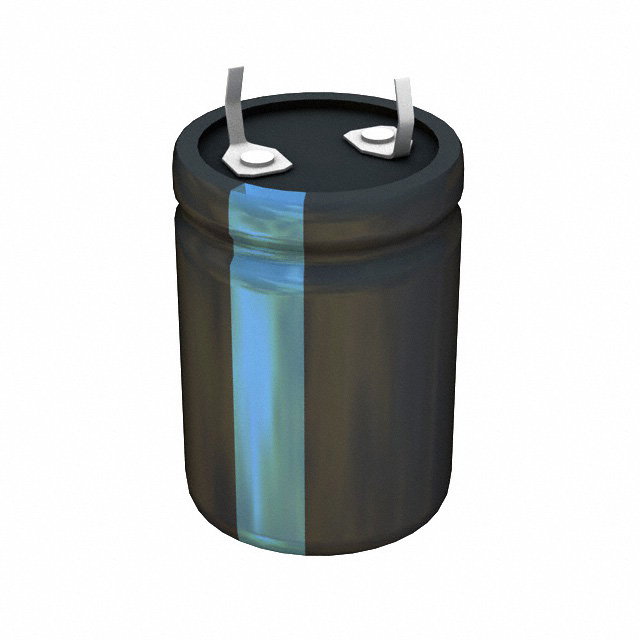

380LX332M050H022 数据手册
2-pin Types: 380L and 380LX. 4-pin or 5-pin Types: 382L and 382LX Types 380L, 382L, 380LX & 382LX, 85 ºC High-Capacitance Snap-In The excellent value of Type 380L/LX capacitors finds application in switching power supply input and output circuits and even motor drives where the high surface area of multiple units in parallel approaches the ripple capability of our Type 520C computer-grade capacitor. Type 380LX delivers more capacitance per can size while Type 380L available in the largest case sizes gives lower ESR for the same capacitance. Types 382L and 382LX give the choice of 4 or 5 leads for stable, reverse proof mounting. Highlights • Latest available ratings, worldwide • Top performance in power supplies and motor drives • Big selection of 46 case sizes • 2, 4 and 5 leads available Specifications Operating Temperature: Rated Voltage: Capacitance: Leakage Current: Ripple Current Multipliers: –40 °C to 85 °C up to 300 V, –25 °C to 85 °C ≥315 V 16 Vdc to 500 Vdc 33 µF to 270,000 µF ±20% ≤3√CV µA at 5 min. Ambient Temperature 45 °C 1.5 60 °C 1.4 70 °C 1.3 85 °C 1.0 Frequency 50 Hz 16-100 Vdc 160-450 Vdc 0.93 0.75 60 Hz 0.95 0.80 120 Hz 1.00 1.00 500 Hz 2 kHz 1.05 1.20 1.08 1.25 10 kHz & up 1.15 1.40 Complies with the EU Directive 2002/95/EC requirement restricting the use of Lead (Pb), Mercury (Hg), Cadmium (Cd), Hexavalent chromium (Cr(VI)), PolyBrominated Biphenyls (PBB) and PolyBrominated Diphenyl Ethers (PBDE). EIA Ripple Life: 3,000 h @ full load at +85 °C per EIA IS-749 ∆Capacitance ±20% ESR 200% of limit DCL 100% of limit Load Life Test: 3,000 h @ full load at +85 °C ∆Capacitance ±20% ESR 200% of limit DCL 100% of limit Shelf Life: 1,000 h @ 85 °C ∆Capacitance ±20% ESR 200% of limit DCL 100% of limit Vibration: 10 to 55 Hz, 0.06” and 10 g max, 2 h in each plane CDM Cornell Dubilier • 140 Technology Place • Liberty, SC 29657 • Phone: (864)843-2277 • Fax: (864)843-3800 • www.cde.com Types 380L, 382L, 380LX & 382LX, 85 ºC High-Capacitance Snap-In Outline Drawings Two Pins 380L/LX (22 through 40mm diameter) Four Pins 382L/LX (35 and 40mm diameter) Five Pins 382L/382LX (40 and 50mm diameter) Connection Terminal A B C D – 40 mm Dia. dummy dummy positive (+) dummy negative (–) 50 mm Dia. negative (–) dummy positive (+) positive (+) negative (–) V Terminal Standoff Pin Dimensions Notes: * Use dummy terminals for mechanical support only. Make no electrical connection because they resistively connect through the electrolyte to the negative terminal. ** Safety Vent may be on the bottom or on the side of the can. CDM Cornell Dubilier • 140 Technology Place • Liberty, SC 29657 • Phone: (864)843-2277 • Fax: (864)843-3800 • www.cde.com Insulated Case Dimensions Case Code H20 H01 H02 H03 H04 H45 H05 J20 J01 J02 J03 J04 J45 J05 K20 K01 K02 K03 K04 K45 K05 DIAMETER "D" mm 22 22 22 22 22 22 22 25 25 25 25 25 25 25 30 30 30 30 30 30 30 inches 0.87 0.87 0.87 0.87 0.87 0.87 0.87 0.98 0.98 0.98 0.98 0.98 0.98 0.98 1.18 1.18 1.18 1.18 1.18 1.18 1.18 Types 380L, 382L, 380LX & 382LX, 85 ºC High-Capacitance Snap-In LENGTH "L" mm 20 25 30 35 40 45 50 20 25 30 35 40 45 50 20 25 30 35 40 45 50 0.79 0.98 1.18 1.38 1.57 1.77 1.97 0.79 0.98 1.18 1.38 1.57 1.77 1.97 0.79 0.98 1.18 1.38 1.57 1.77 1.97 Typical Weight 14 16 19 22 24 28 31 16 20 24 27 31 35 38 25 30 35 40 44 48 53 Case Code A20 A01 A02 A03 A04 A45 A05 A06 A07 A08 A10 N04 N05 N06 N08 N10 B05 B06 B08 B09 B10 DIAMETER "D" mm 35 35 35 35 35 35 35 35 35 35 35 40 40 40 40 40 50 50 50 50 50 inches 1.38 1.38 1.38 1.38 1.38 1.38 1.38 1.38 1.38 1.38 1.38 1.57 1.57 1.57 1.57 1.57 1.97 1.97 1.97 1.97 1.97 LENGTH "L" mm 20 25 30 35 40 45 50 63 70 80 105 40 50 63 80 105 50 63 80 92 105 0.79 0.98 1.18 1.38 1.57 1.77 1.97 2.48 2.76 3.15 4.13 1.57 1.97 2.48 3.15 4.13 1.97 2.48 3.15 3.62 4.13 Typical Weight 35 42 48 54 62 67 74 88 98 112 144 82 105 130 185 265 136 168 239 241 325 inches (grams) inches (grams) Part Numbering System 382LX 272 M 200 N05 2 V 380L (2 pins) 272 = 2700 µF 380LX (2 pins) 333 = 33000 µF 382L (4 or 5 pins) 382LX (4 or 5 pins) Type Capacitance Tolerance M = ±20% Rated Voltage Vdc Case Code Insulation 382L & LX 2 = PVC # of pins Typical Performance Curves blank = 4 pins (35 or 40 mm dia) V = 5 pins (40 or 50 mm dia) CDM Cornell Dubilier • 140 Technology Place • Liberty, SC 29657 • Phone: (864)843-2277 • Fax: (864)843-3800 • www.cde.com Types 380L, 382L, 380LX & 382LX, 85 ºC High-Capacitance Snap-In Ratings Max. ESR Cap. (µF) Catalog Part Number Ω@ 25 °C 120 Hz20 kHz 16 Vdc (20 Vdc Surge) 4700 380LX472M016H202 4700 380LX472M016H012 6800 380LX682M016H012 6800 380LX682M016J202 8200 380LX822M016H012 10000 380LX103M016H022 10000 380LX103M016J012 10000 380LX103M016K202 12000 380LX123M016H022 12000 380LX123M016J012 15000 380LX153M016H032 15000 380LX153M016J022 15000 380LX153M016A202 18000 380LX183M016H042 18000 380LX183M016J022 22000 380LX223M016H452 22000 380LX223M016J032 22000 380LX223M016K022 27000 380LX273M016J452 27000 380LX273M016K032 33000 380LX333M016J052 33000 380LX333M016K042 33000 380LX333M016A022 39000 380LX393M016K452 39000 380LX393M016A032 0.160 0.160 0.110 0.110 0.090 0.075 0.075 0.084 0.062 0.062 0.054 0.054 0.055 0.045 0.045 0.038 0.038 0.038 0.031 0.031 0.025 0.025 0.025 0.022 0.022 0.135 0.135 0.092 0.092 0.078 0.062 0.062 0.070 0.052 0.052 0.045 0.045 0.048 0.040 0.040 0.032 0.032 0.032 0.025 0.025 0.021 0.021 0.021 0.018 0.018 1.60 1.77 2.60 1.80 3.10 3.80 3.80 2.40 4.50 4.50 5.30 5.30 3.20 5.60 5.60 6.10 6.10 6.10 6.30 6.30 6.80 6.80 6.80 6.95 6.95 1.80 2.00 3.00 2.10 3.60 4.30 4.30 2.80 5.20 5.20 6.00 6.00 3.70 6.40 6.40 7.00 7.00 7.00 7.30 7.30 7.80 7.90 7.90 8.00 8.00 22 x 20 22 x 25 22 x 25 25 x 20 22 x 25 22 x 30 25 x 25 30 x 20 22 x 30 25 x 25 22 x 35 25 x 30 35 x 20 22 x 40 25 x 30 22 x 45 25 x 35 30 x 30 25 x 45 30 x 35 25 x 50 30 x 40 35 x 30 30 x 45 35 x 35 3300 3300 4700 4700 5600 6800 6800 380LX332M025H202 380LX332M025H012 380LX472M025H012 380LX472M025J202 380LX562M025H012 380LX682M025H022 380LX682M025J012 47000 380LX473M016K052 47000 380LX473M016A042 56000 380LX563M016A452 56000 382LX563M016N042 68000 380LX683M016A052 82000 380LX823M016A062 82000 382LX823M016N052 100000 380LX104M016A082 100000 382LX104M016N062 120000 380LX124M016A102 120000 382LX124M016N082 120000 382LX124M016B052V 150000 382LX154M016B062V 180000 382LX184M016N102 180000 382LX184M016B082V 220000 382LX224M016B092V 270000 382LX274M016B102V Ripple Amps Max. @ 85 °C 120 Hz 20 kHz Nom. DxL (mm) Cap. (µF) Catalog Part Number Max. ESR Ω@ 25 °C 120 Hz20 kHz 16 Vdc (20 Vdc Surge) 0.020 0.022 0.020 0.022 0.018 0.016 0.016 0.015 0.018 0.014 0.017 0.014 0.012 0.013 0.011 0.010 0.009 0.177 0.161 0.110 0.125 0.095 0.078 0.078 0.017 0.020 0.018 0.021 0.017 0.015 0.015 0.014 0.017 0.013 0.016 0.013 0.011 0.012 0.010 0.009 0.008 0.140 0.130 0.090 0.100 0.075 0.063 0.063 7.50 7.50 8.70 9.00 9.00 10.00 10.30 11.00 11.40 12.81 12.40 13.17 14.40 14.85 15.69 16.73 17.79 1.60 1.70 2.40 1.80 2.90 3.50 3.50 8.60 8.60 10.00 10.40 10.40 11.50 11.80 12.70 13.00 14.73 14.30 15.15 16.56 17.08 18.04 19.24 20.46 1.80 1.90 2.75 2.10 3.30 4.00 4.00 30 x 50 35 x 40 35 x 45 40 x 40 35 x 50 35 x 63 40 x 50 35 x 80 40 x 63 35 x 105 40 x 80 50 x 50 50 x 63 40 x 105 50 x 80 50 x 92 50 x 105 22 x 20 22 x 25 22 x 25 25 x 20 22 x 25 22 x 30 25 x 25 Ripple Amps Max. @ 85 °C 120 Hz 20 kHz Nom. DxL (mm) 25 Vdc (32 Vdc Surge) CDM Cornell Dubilier • 140 Technology Place • Liberty, SC 29657 • Phone: (864)843-2277 • Fax: (864)843-3800 • www.cde.com Types 380L, 382L, 380LX & 382LX, 85 ºC High-Capacitance Snap-In Max. ESR Cap. (µF) Catalog Part Number Ω@ 25 °C 120 Hz20 kHz 25 Vdc (32 Vdc Surge) 6800 380LX682M025K202 8200 380LX822M025H022 8200 380LX822M025J012 10000 380LX103M025H032 10000 380LX103M025J022 10000 380LX103M025K012 10000 380LX103M025A202 12000 380LX123M025H042 12000 380LX123M025J032 12000 380LX123M025K022 15000 380LX153M025H052 15000 380LX153M025J042 15000 380LX153M025K022 18000 380LX183M025J452 18000 380LX183M025K032 22000 380LX223M025J052 22000 380LX223M025K042 27000 380LX273M025K452 27000 380LX273M025A03 33000 380LX333M025K052 33000 380LX333M025A042 33000 382L333M025N042 39000 380LX393M025A452 39000 382LX393M025N042 47000 380LX473M025A052 47000 380L473M025A062 56000 380L563M025A072 56000 382L563M025N062 56000 380LX563M025A062 56000 382LX563M025N052 68000 380LX683M025A082 68000 382LX683M025N062 82000 382LX823M025B052V 100000 380LX104M025A102 100000 382LX104M025B062V 100000 382LX104M025N082 120000 382LX124M025B082V 150000 382LX154M025N102 150000 382LX154M025B092V 180000 382LX184M025B102V 2200 380LX222M035H202 2200 380LX222M035H012 3300 380LX332M035H012 3300 380LX332M035J202 3900 380LX392M035H012 4700 380LX472M035H022 0.078 0.065 0.065 0.058 0.058 0.058 0.060 0.050 0.050 0.050 0.040 0.040 0.040 0.035 0.035 0.030 0.030 0.023 0.023 0.020 0.020 0.026 0.020 0.020 0.017 0.017 0.015 0.015 0.015 0.016 0.013 0.017 0.016 0.010 0.014 0.012 0.012 0.011 0.011 0.010 0.211 0.166 0.110 0.120 0.095 0.080 0.063 0.049 0.049 0.046 0.046 0.046 0.050 0.040 0.040 0.040 0.030 0.030 0.030 0.028 0.028 0.023 0.023 0.020 0.020 0.017 0.017 0.016 0.017 0.018 0.015 0.009 0.008 0.009 0.013 0.015 0.011 0.015 0.015 0.008 0.013 0.011 0.011 0.010 0.010 0.009 0.160 0.125 0.085 0.090 0.070 0.060 2.30 3.60 3.60 3.80 3.80 3.80 2.70 4.10 4.10 4.10 4.60 4.60 4.60 5.50 5.50 6.10 6.10 6.20 6.20 6.80 6.80 7.30 7.40 8.00 8.00 8.30 9.10 9.50 8.60 9.00 10.40 10.25 12.29 11.97 13.45 12.00 15.29 14.07 16.01 16.89 1.40 1.50 2.30 1.70 2.70 3.30 2.60 4.10 4.10 4.30 4.30 4.30 3.10 4.70 4.70 4.70 5.30 5.30 5.30 6.30 6.30 7.00 7.00 7.10 7.10 7.90 7.90 8.00 8.50 9.20 9.20 9.50 10.30 10.30 9.90 10.30 12.00 11.80 14.13 13.77 15.47 13.40 17.58 16.18 18.41 19.42 1.60 1.75 2.60 2.00 3.10 3.70 30 x 20 22 x 30 25 x 25 22 x 35 25 x 30 30 x 25 35 x 20 22 x 40 25 x 35 30 x 30 22 x 50 25 x 40 30 x 30 25 x 45 30 x 35 25 x 50 30 x 40 30 x 45 35 x 35 30 x 50 35 x 40 40 x 40 35 x 45 40 x 40 35 x 50 35 x 63 35 x 70 40 x 63 35 x 63 40 x 50 35 x 80 40 x 63 50 x 50 35 x 105 50 x 63 40 x 80 50 x 80 40 x 105 50 x 92 50 x 105 22 x 20 22 x 25 22 x 25 25 x 20 22 x 25 22 x 30 Ripple Amps Max. @ 85 °C 120 Hz20 kHz Nom. DxL (mm) Cap. (µF) Catalog Part Number Max. ESR Ω@ 25 °C 120 Hz20 kHz 35 Vdc (44 Vdc Surge) 4700 380LX472M035J012 4700 380LX472M035K202 5600 380LX562M035H022 5600 380LX562M035J012 6800 380LX682M035H032 6800 380LX682M035A202 6800 380LX682M035J022 8200 380LX822M035H042 8200 380LX822M035J032 10000 380LX103M035H452 10000 380LX103M035J042 10000 380LX103M035K022 10000 380LX103M035A012 12000 380LX123M035J452 12000 380LX123M035K032 12000 380LX123M035A022 15000 380LX153M035J052 15000 380LX153M035K042 15000 380LX153M035A022 18000 380LX183M035K452 18000 380LX183M035A032 22000 380LX223M035K052 22000 380LX223M035A042 27000 380LX273M035A452 27000 382LX273M035N042 33000 380LX333M035A052 33000 380L333M035A062 39000 380LX393M035A062 39000 380L393M035A072 39000 382LX393M035N052 47000 380LX473M035A082 47000 382LX473M035N062 56000 382LX563M035B052V 56000 382LX563M035N082 68000 380LX683M035A102 68000 382LX683M035B062V 82000 382LX823M035N102 82000 382LX823M035B082V 100000 382LX104M035B092V 120000 382LX124M035B102V 1500 380LX152M050H202 1500 380LX152M050H012 2200 380LX222M050H012 2200 380LX222M050J202 2700 380LX272M050H012 3300 380LX332M050H022 0.080 0.090 0.083 0.083 0.068 0.070 0.069 0.057 0.057 0.050 0.050 0.050 0.050 0.044 0.044 0.044 0.036 0.036 0.036 0.030 0.030 0.026 0.026 0.021 0.021 0.018 0.018 0.015 0.015 0.017 0.015 0.016 0.015 0.015 0.010 0.013 0.012 0.012 0.011 0.010 0.255 0.220 0.150 0.175 0.125 0.100 0.060 0.066 0.063 0.063 0.051 0.053 0.051 0.043 0.043 0.037 0.037 0.037 0.037 0.033 0.033 0.033 0.027 0.027 0.027 0.023 0.023 0.020 0.020 0.017 0.017 0.014 0.009 0.012 0.008 0.014 0.011 0.013 0.012 0.012 0.008 0.011 0.009 0.010 0.009 0.008 0.200 0.170 0.115 0.130 0.095 0.075 3.30 2.00 3.40 3.40 3.70 2.40 3.70 4.00 4.00 4.40 4.40 4.40 4.40 5.10 5.10 5.10 5.60 5.60 5.60 5.70 5.70 6.10 6.10 6.80 6.80 7.15 7.80 7.90 8.60 8.00 9.50 9.60 10.94 10.30 10.62 11.93 12.02 13.06 13.97 14.86 1.20 1.25 1.80 1.40 2.20 2.70 3.70 2.30 3.90 3.90 4.20 2.80 4.20 4.60 4.60 5.10 5.10 5.10 5.10 5.80 5.80 5.80 6.40 6.40 6.40 6.50 6.50 7.00 7.00 7.90 7.90 8.22 8.70 9.10 9.50 9.20 10.90 11.00 12.58 11.90 12.21 13.72 13.82 15.02 16.07 17.09 1.40 1.45 2.10 1.60 2.60 3.10 25 x 25 30 x 20 22 x 30 25 x 25 22 x 35 35 x 20 25 x 30 22 x 40 25 x 35 22 x 45 25 x 40 30 x 30 35 x 25 25 x 45 30 x 35 35 x 30 25 x 50 30 x 40 35 x 30 30 x 45 35 x 35 30 x 50 35 x 40 35 x 45 40 x 40 35 x 50 35 x 63 35 x 63 35 x 70 40 x 50 35 x 80 40 x 63 50 x 50 40 x 80 35 x 105 50 x 63 40 x 105 50 x 80 50 x 92 50 x 105 22 x 20 22 x 25 22 x 25 25 x 20 22 x 25 22 x 30 Ripple Amps Max. @ 85 °C 120 Hz20 kHz Nom. DxL (mm) 35 Vdc (44 Vdc Surge) 50 Vdc (63 Vdc Surge) CDM Cornell Dubilier • 140 Technology Place • Liberty, SC 29657 • Phone: (864)843-2277 • Fax: (864)843-3800 • www.cde.com Types 380L, 382L, 380LX & 382LX, 85 ºC High-Capacitance Snap-In Max. ESR Cap. (µF) Catalog Part Number Ω@ 25 °C 120 Hz20 kHz Ripple Amps Max. @ 85 °C 120 Hz20 kHz Nom. DxL (mm) Cap. (µF) Catalog Part Number Max. ESR Ω@ 25 °C 120 Hz20 kHz 63 Vdc (79 Vdc Surge) 2.70 1.70 2.80 2.80 3.00 3.00 3.00 2.10 3.40 3.40 3.40 3.90 3.90 3.90 4.40 4.40 5.00 5.00 5.00 5.60 5.60 6.40 6.40 7.80 6.90 6.94 8.60 7.60 9.30 9.00 8.30 8.10 9.20 9.10 10.48 11.54 10.27 11.47 12.46 13.17 13.87 1.20 1.20 1.70 1.30 2.50 3.10 2.00 3.20 3.20 3.50 3.50 3.50 2.40 3.90 3.90 3.90 4.40 4.40 4.40 5.10 5.10 5.70 5.70 5.70 6.40 6.40 7.40 7.40 8.70 7.90 7.98 9.50 8.70 10.10 9.60 9.60 9.30 10.60 10.50 12.05 13.27 11.81 13.19 14.33 15.15 15.95 1.40 1.40 2.00 1.50 2.90 25 x 25 30 x 20 22 x 30 25 x 25 22 x 35 25 x 30 30 x 25 35 x 20 22 x 40 25 x 35 30 x 30 22 x 50 25 x 40 30 x 30 25 x 45 30 x 35 25 x 50 30 x 40 35 x 30 30 x 45 35 x 35 30 x 50 35 x 40 35 x 63 35 x 45 40 x 40 35 x 70 35 x 50 35 x 80 40 x 63 35 x 63 40 x 50 35 x 80 40 x 63 50 x 50 50 x 63 35 x 105 40 x 105 50 x 80 50 x 92 50 x 105 680 22 x 20 22 x 25 22 x 25 25 x 20 22 x 30 680 1000 1000 1200 1500 2200 2200 2700 2700 3300 3300 3300 3300 3900 3900 3900 4700 4700 4700 4700 5600 5600 5600 6800 6800 6800 8200 8200 380LX222M063J012 380LX222M063K202 380LX272M063H032 380LX272M063J022 380LX332M063H042 380LX332M063J022 380LX332M063K012 380LX332M063A202 380LX392M063H452 380LX392M063J032 380LX392M063K022 380LX472M063H052 380LX472M063J042 380LX472M063K022 380LX472M063A012 380LX562M063A022 380LX562M063J452 380LX562M063K032 380LX682M063J052 380LX682M063K042 380LX682M063A022 380LX822M063K452 380LX822M063A032 0.151 0.170 0.123 0.123 0.110 0.110 0.110 0.125 0.100 0.100 0.100 0.080 0.080 0.080 0.080 0.070 0.070 0.070 0.060 0.060 0.060 0.050 0.050 0.028 0.033 0.019 0.028 0.035 0.016 0.028 0.023 0.028 0.018 0.015 0.015 0.114 0.130 0.093 0.093 0.080 0.080 0.080 0.095 0.075 0.075 0.075 0.060 0.060 0.060 0.060 0.050 0.050 0.050 0.045 0.045 0.045 0.040 0.040 0.017 0.025 0.010 0.021 0.028 0.009 0.021 0.012 0.022 0.015 0.012 0.015 0.012 0.013 0.010 0.010 0.009 0.330 0.295 0.200 0.225 0.170 0.134 2.50 1.50 3.70 3.70 4.10 4.10 4.10 1.70 4.40 4.40 4.40 4.90 4.90 4.90 4.90 5.40 5.40 5.40 5.80 5.80 5.80 6.00 6.00 6.60 6.50 7.70 7.20 7.15 8.50 7.70 9.40 9.25 10.00 10.38 10.86 11.76 11.57 12.78 13.34 13.93 1.00 1.00 1.50 1.20 1.80 2.30 2.90 1.70 4.30 4.30 4.70 4.70 4.70 2.00 5.10 5.10 5.10 5.60 5.60 5.60 5.60 6.20 6.20 6.20 6.70 6.70 6.70 6.90 6.90 7.20 7.50 8.60 8.30 8.22 9.40 8.90 10.80 10.60 11.50 11.94 12.49 13.52 13.42 14.70 15.34 16.02 1.20 1.20 1.75 1.40 2.10 2.60 25 x 25 30 x 20 22 x 35 25 x 30 22 x 40 25 x 30 30 x 25 35 x 20 22 x 45 25 x 35 30 x 30 22 x 50 25 x 40 30 x 30 35 x 25 35 x 30 25 x 45 30 x 35 25 x 50 30 x 40 35 x 30 30 x 45 35 x 35 40 x 40 35 x 40 35 x 63 35 x 50 40 x 40 35 x 70 35 x 63 35 x 80 40 x 63 40 x 80 35 x 105 50 x 50 40 x 105 50 x 63 50 x 80 50 x 92 50 x 105 22 x 20 22 x 25 22 x 25 25 x 20 22 x 25 22 x 30 Ripple Amps Max. @ 85 °C 120 Hz20 kHz Nom. DxL (mm) 50 Vdc (63 Vdc Surge) 3300 3300 3900 3900 4700 4700 4700 4700 5600 5600 5600 6800 6800 6800 8200 8200 10000 10000 10000 12000 12000 15000 15000 18000 18000 18000 22000 22000 27000 27000 27000 27000 33000 33000 33000 47000 47000 56000 56000 68000 82000 1000 1000 1500 1500 2200 380LX332M050J012 380LX332M050K202 380LX392M050H022 380LX392M050J012 380LX472M050H032 380LX472M050J022 380LX472M050K012 380LX472M050A202 380LX562M050H042 380LX562M050J032 380LX562M050K022 380LX682M050H052 380LX682M050J042 380LX682M050K022 380LX822M050J452 380LX822M050K032 380LX103M050J052 380LX103M050K042 380LX103M050A022 380LX123M050K452 380LX123M050A032 380LX153M050K052 380LX153M050A042 380L183M050A062 380LX183M050A452 382LX183M050N042 380L223M050A072 380LX223M050A052 380L273M050A082 382L273M050N062 380LX273M050A062 382LX273M050N052 380LX333M050A082 382LX333M050N062 382LX333M050B052V 382LX473M050B062V 380LX473M050A102 382LX563M050N102 382LX563M050B082V 382LX683M050B092V 382LX823M050B102V 380LX102M063H202 380LX102M063H012 380LX152M063H012 380LX152M063J202 380LX222M063H022 0.100 0.117 0.085 0.085 0.070 0.070 0.070 0.080 0.060 0.060 0.060 0.050 0.050 0.050 0.040 0.040 0.040 0.040 0.040 0.033 0.033 0.027 0.027 0.018 0.022 0.023 0.015 0.020 0.013 0.018 0.018 0.018 0.015 0.018 0.018 0.013 0.014 0.012 0.012 0.011 0.011 0.380 0.332 0.221 0.250 0.151 0.075 0.090 0.065 0.065 0.055 0.055 0.055 0.060 0.045 0.045 0.045 0.040 0.040 0.040 0.030 0.030 0.030 0.030 0.030 0.025 0.025 0.020 0.020 0.010 0.017 0.017 0.008 0.016 0.008 0.009 0.015 0.015 0.012 0.014 0.014 0.010 0.011 0.009 0.009 0.009 0.008 0.290 0.250 0.167 0.190 0.114 10000 382L103M063N042 10000 380LX103M063A042 12000 380L123M063A062 12000 380LX123M063A052 12000 382LX123M063N042 15000 380L153M063A072 15000 380LX153M063A062 18000 380LX183M063A082 18000 382LX183M063N062 27000 382LX273M063N082 27000 380LX273M063A102 33000 382LX333M063N102 27000 382LX273M063B052V 0.018 33000 382LX333M063B062V 0.017 47000 382LX473M063B082V 0.013 51000 382LX513M063B092V 0.012 56000 382LX563M063B102V 0.012 380LX681M080H202 380LX681M080H012 380LX102M080H012 380LX102M080J202 380LX122M080H012 380LX152M080H022 0.450 0.390 0.265 0.300 0.220 0.177 80 Vdc (100 Vdc Surge) 63 Vdc (79 Vdc Surge) CDM Cornell Dubilier • 140 Technology Place • Liberty, SC 29657 • Phone: (864)843-2277 • Fax: (864)843-3800 • www.cde.com Types 380L, 382L, 380LX & 382LX, 85 ºC High-Capacitance Snap-In Max. ESR Cap. (µF) Catalog Part Number Ω@ 25 °C 120 Hz20 kHz 80 Vdc (100 Vdc Surge) 1500 1500 1800 1800 2200 2200 2200 2200 2700 2700 2700 3300 3300 3300 3900 3900 4700 4700 5600 5600 6800 6800 8200 8200 10000 12000 12000 15000 15000 18000 18000 22000 22000 27000 27000 33000 39000 470 470 560 680 680 1000 1000 1000 380LX152M080J012 380LX152M080K202 380LX182M080H032 380LX182M080J022 380LX222M080H042 380LX222M080J022 380LX222M080K012 380LX222M080A202 380LX272M080H452 380LX272M080J032 380LX272M080K022 380LX332M080H052 380LX332M080J042 380LX332M080K022 380LX392M080J452 380LX392M080K032 380LX472M080J052 380LX472M080K042 380LX562M080K452 380LX562M080A032 380LX682M080K052 380LX682M080A042 380LX822M080A052 382LX822M080N042 380LX103M080A062 380L123M080A072 382L123M080N052 380L153M080A082 382L153M080N062 382L183M080N082 380LX223M080A102 382LX273M080N102 0.177 0.200 0.147 0.147 0.121 0.121 0.121 0.135 0.098 0.098 0.098 0.085 0.085 0.085 0.080 0.080 0.065 0.065 0.055 0.055 0.045 0.045 0.040 0.040 0.033 0.020 0.025 0.017 0.020 0.014 0.015 0.015 0.134 0.150 0.109 0.109 0.092 0.092 0.092 0.100 0.075 0.075 0.075 0.065 0.065 0.065 0.060 0.060 0.050 0.050 0.040 0.040 0.035 0.035 0.030 0.030 0.025 0.012 0.016 0.010 0.013 0.009 0.017 0.011 0.014 0.012 0.012 0.010 0.010 0.300 0.300 0.250 0.210 0.295 0.150 0.150 0.165 2.30 1.40 2.50 2.50 2.70 2.70 2.70 1.70 2.80 2.80 2.80 3.20 3.20 3.20 3.60 3.60 4.10 4.10 4.60 4.60 5.20 5.20 5.80 5.83 6.40 8.10 7.50 8.80 8.50 10.30 10.00 9.86 11.08 11.35 12.33 13.37 14.34 1.00 1.10 1.30 1.60 1.10 2.00 2.00 1.20 2.60 1.60 2.90 2.90 3.10 3.10 3.10 2.00 3.20 3.20 3.20 3.70 3.70 3.70 4.10 4.10 4.70 4.70 5.20 5.20 5.90 5.90 6.70 6.70 7.34 9.00 8.00 9.60 9.20 10.80 11.50 11.34 12.74 13.05 14.18 15.38 16.49 1.20 1.30 1.50 1.85 1.30 2.30 2.30 1.40 25 x 25 30 x 20 22 x 35 25 x 30 22 x 40 25 x 30 30 x 25 35 x 20 22 x 45 25 x 35 30 x 30 22 x 50 25 x 40 30 x 30 25 x 45 30 x 35 25 x 50 30 x 40 30 x 45 35 x 35 30 x 50 35 x 40 35 x 50 40 x 40 35 x 63 35 x 70 40 x 50 35 x 80 40 x 63 40 x 80 50 x 50 35 x 105 50 x 63 40 x 105 50 x 80 50 x 92 50 x 105 22 x 20 22 x 25 22 x 25 22 x 25 25 x 20 22 x 30 25 x 25 30 x 20 220 220 270 270 1200 1200 1500 1500 1500 1500 1800 1800 1800 2200 2200 2200 2200 2700 2700 2700 3300 3300 3900 3900 4700 4700 5600 5600 6800 6800 6800 8200 8200 8200 8200 10000 10000 10000 12000 12000 15000 15000 18000 22000 27000 Ripple Amps Max. @ 85 °C 120 Hz 20 kHz Nom. DxL (mm) Cap. (µF) Catalog Part Number Max. ESR Ω@ 25 °C 120 Hz20 kHz Ripple Amps Max. @ 85 °C 120 Hz20 kHz Nom. DxL (mm) 100 Vdc (125 Vdc Surge) 380LX122M100H032 380LX122M100J022 380LX152M100H042 380LX152M100J022 380LX152M100K012 380LX152M100A202 380LX182M100H452 380LX182M100J032 380LX182M100K022 380LX222M100H052 380LX222M100J042 380LX222M100K022 380LX222M100A012 380LX272M100J452 380LX272M100K032 380LX272M100A022 380LX332M100J052 380LX332M100K042 380LX392M100K452 380LX392M100A032 380LX472M100K052 380LX472M100A042 382LX562M100N042 380LX562M100A452 380LX682M100A052 380L682M100A062 382L682M100N052 380LX822M100A062 380L822M100A072 382LX822M100N052 382L822M100N062 380LX103M100A082 382LX103M100N062 382LX103M100B052V 382LX123M100N082 380LX123M100A102 382LX153M100N102 382LX153M100B062V 382LX183M100B082V 382LX223M100B092V 382LX273M100B102V 380LX221M160H202 380LX221M160H012 380LX271M160H012 380LX271M160J202 0.195 0.180 0.155 0.155 0.155 0.177 0.130 0.140 0.140 0.121 0.121 0.121 0.121 0.104 0.104 0.104 0.090 0.090 0.080 0.080 0.070 0.070 0.060 0.060 0.050 0.024 0.026 0.040 0.021 0.040 0.021 0.033 0.033 0.033 0.028 0.028 0.022 0.022 0.018 0.015 0.014 1.000 0.850 0.700 0.800 0.125 0.120 0.100 0.100 0.100 0.120 0.085 0.090 0.090 0.080 0.080 0.080 0.078 0.068 0.068 0.068 0.060 0.060 0.050 0.050 0.050 0.050 0.045 0.040 0.040 0.014 0.017 0.030 0.012 0.030 0.013 0.025 0.025 0.025 0.021 0.021 0.017 0.017 0.014 0.011 0.010 0.500 0.420 0.340 0.400 2.30 2.30 2.60 2.60 2.60 1.50 2.80 2.80 2.80 3.10 3.10 3.10 3.14 3.70 3.70 3.70 4.10 4.10 4.50 4.50 5.10 5.10 5.80 5.80 6.60 7.20 7.40 7.00 8.00 7.30 8.40 8.70 8.00 8.82 8.65 8.57 10.12 10.07 11.00 11.76 12.53 0.80 0.90 1.20 0.90 2.70 2.70 3.00 3.00 3.00 1.70 3.30 3.30 3.30 3.60 3.60 3.60 3.61 4.30 4.30 4.30 4.70 4.70 5.20 5.20 5.90 5.90 6.60 6.60 7.60 8.10 7.90 8.10 8.90 8.40 9.10 9.60 9.20 10.14 10.00 9.86 11.64 11.58 12.65 13.52 14.41 1.10 1.25 1.65 1.20 22 x 35 25 x 30 22 x 40 25 x 30 30 x 25 35 x 20 22 x 45 25 x 35 30 x 30 22 x 50 25 x 40 30 x 30 35 x 25 25 x 45 30 x 35 35 x 30 25 x 50 30 x 40 30 x 45 35 x 35 30 x 50 35 x 40 40 x 40 35 x 45 35 x 50 35 x 63 40 x 50 35 x 63 35 x 70 40 x 50 40 x 63 35 x 80 40 x 63 50 x 50 40 x 80 35 x 105 40 x 105 50 x 63 50 x 80 50 x 92 50 x 105 22 x 20 22 x 25 22 x 25 25 x 20 382LX183M080B052V 0.023 382LX223M080B062V 0.019 382LX273M080B082V 0.015 382LX333M080B092V 0.014 382LX393M080B102V 0.013 380LX471M100H202 380LX471M100H012 380LX561M100H012 380LX681M100H012 380LX681M100J202 380LX102M100H022 380LX102M100J012 380LX102M100K202 0.450 0.450 0.400 0.320 0.390 0.220 0.220 0.250 100 Vdc (125 Vdc Surge) 160 Vdc (200 Vdc Surge) CDM Cornell Dubilier • 140 Technology Place • Liberty, SC 29657 • Phone: (864)843-2277 • Fax: (864)843-3800 • www.cde.com Types 380L, 382L, 380LX & 382LX, 85 ºC High-Capacitance Snap-In Max. ESR Cap. (µF) Catalog Part Number Ω@ 25 °C 120 Hz20 kHz 160 Vdc (200 Vdc Surge) 330 390 390 390 390 470 470 560 560 560 680 680 680 820 820 820 820 380LX331M160H012 380LX391M160H012 380LX391M160H022 380LX391M160J012 380LX391M160K202 380LX471M160H022 380LX471M160J012 380LX561M160H022 380LX561M160J012 380LX561M160A202 380LX681M160H032 380LX681M160J022 380LX681M160K012 380LX821M160H042 380LX821M160H452 380LX821M160J032 380LX821M160K012 0.603 0.470 0.470 0.470 0.600 0.423 0.423 0.355 0.355 0.420 0.293 0.293 0.293 0.260 0.260 0.260 0.260 0.220 0.220 0.220 0.210 0.210 0.210 0.170 0.170 0.166 0.140 0.140 0.105 0.115 0.090 0.080 0.065 0.065 0.055 0.055 0.036 0.040 0.040 0.032 0.026 0.022 0.022 0.018 0.014 0.308 0.240 0.240 0.240 0.300 0.216 0.216 0.178 0.178 0.210 0.146 0.146 0.149 0.130 0.130 0.130 0.130 0.110 0.110 0.110 0.115 0.115 0.115 0.090 0.090 0.091 0.085 0.085 0.053 0.075 0.060 0.045 0.040 0.040 0.030 0.030 0.020 0.020 0.020 0.017 0.015 0.012 0.012 0.010 0.008 1.50 1.60 1.60 1.60 1.10 2.10 2.10 2.25 2.25 1.30 2.50 2.50 2.50 2.50 2.80 2.80 2.75 3.00 3.00 3.00 3.25 3.25 3.25 3.70 3.70 3.73 4.20 4.20 4.78 4.78 5.50 5.50 6.30 6.30 7.30 7.30 6.60 8.30 8.25 9.10 8.90 9.90 9.80 12.90 14.10 2.00 2.30 2.30 2.30 1.50 3.00 3.00 3.15 3.15 1.80 3.50 3.50 3.50 3.50 3.90 3.90 3.85 4.20 4.20 4.20 4.55 4.55 4.55 5.20 5.20 5.22 5.90 5.90 6.69 6.69 7.60 7.60 8.80 8.80 10.20 10.20 8.50 11.70 9.50 12.70 12.50 13.80 13.70 18.10 19.70 22 x 25 22 x 25 22 x 30 25 x 25 30 x 20 22 x 30 25 x 25 22 x 30 25 x 25 35 x 20 22 x 35 25 x 30 30 x 25 22 x 40 22 x 45 25 x 35 30 x 25 22 x 45 25 x 40 30 x 30 25 x 50 30 x 35 35 x 30 25 x 50 30 x 35 35 x 30 30 x 50 35 x 35 30 x 50 35 x 40 35 x 50 40 x 40 35 x 63 40 x 50 35 x 80 40 x 63 40 x 80 40 x 80 50 x 50 35 x 105 50 x 63 40 x 105 50 x 80 50 x 92 50 x105 150 380LX151M200H202 150 380LX151M200H012 220 380LX221M200H012 220 380LX221M200J202 270 380LX271M200H012 330 380LX331M200H012 330 380LX331M200K202 390 380LX391M200H022 390 380LX391M200J012 470 380LX471M200H032 470 380LX471M200J022 470 380LX471M200K012 470 380LX471M200A202 560 380LX561M200H042 560 380LX561M200J022 560 380LX561M200K012 680 380LX681M200H452 330 380LX331M180H012 390 380LX391M180H022 390 380LX391M180J012 470 380LX471M180H032 470 380LX471M180J012 560 380LX561M180H032 560 380LX561M180J022 680 380LX681M180H042 680 380LX681M180J032 680 380LX681M180K022 820 380LX821M180H452 820 380LX821M180J042 820 380LX821M180K022 1000 380LX102M180J452 1000 380LX102M180K032 1200 380LX122M180J052 1200 380LX122M180K042 1200 380LX122M180A032 1500 380LX152M180K452 1500 380LX152M180A042 1800 380LX182M180K052 1800 380LX182M180A042 2200 380LX222M180A052 2700 382L272M180N062 2700 380L272M180A072 3300 380L332M180A082 4700 382L472M180N082 Ripple Amps Max. @ 85 °C 120 Hz20 kHz Nom. DxL (mm) Cap. (µF) Catalog Part Number Max. ESR Ω@ 25 °C 120 Hz20 kHz 180 Vdc (225 Vdc Surge) 0.603 0.510 0.510 0.423 0.423 0.355 0.355 0.293 0.293 0.293 0.243 0.243 0.243 0.199 0.199 0.166 0.166 0.166 0.133 0.133 0.111 0.111 0.090 0.051 0.054 0.046 0.036 0.308 0.260 0.260 0.216 0.216 0.181 0.181 0.149 0.149 0.149 0.124 0.124 0.124 0.102 0.102 0.085 0.085 0.085 0.068 0.068 0.057 0.057 0.046 0.027 0.027 0.023 0.020 1.80 1.20 1.20 2.10 2.10 2.30 2.30 2.50 2.50 2.50 2.80 2.80 2.80 3.00 3.00 3.30 3.30 3.30 3.80 3.80 4.30 4.30 4.90 5.00 4.80 5.40 6.60 2.50 1.60 1.60 2.90 2.90 3.20 3.20 3.50 3.50 3.50 3.90 3.90 3.90 4.20 4.20 4.60 4.60 4.60 5.40 5.40 6.00 6.00 6.90 6.50 6.20 7.10 8.50 22 x 25 22 x 30 25 x 25 22 x 35 25 x 25 22 x 35 25 x 30 22 x 40 25 x 35 30 x 30 22 x 45 25 x 40 30 x 30 25 x 45 30 x 35 25 x 50 30 x 40 35 x 35 30 x 45 35 x 40 30 x 50 35 x 40 35 x 50 40 x 63 35 x 70 35 x 80 40 x 80 Ripple Amps Max. @ 85 °C 120 Hz20 kHz Nom. DxL (mm) 1000 380LX102M160H452 1000 380LX102M160J042 1000 380LX102M160K022 1200 380LX122M160J052 1200 380LX102M160K032 1200 380LX122M160A022 1500 380LX152M160J052 1500 380LX152M160K032 1500 380LX152M160A022 1800 380LX182M160K052 1800 380LX182M160A032 2200 380LX222M160K052 2200 380LX222M160A042 2700 380LX272M160A052 2700 382LX272M160N042 3300 380LX332M160A062 3300 380LX332M160N052 3900 380LX392M160A082 3900 380LX392M160N062 4700 382L472M160N082 5600 382LX562M160N082 5600 382LX562M160B052V 6800 380LX682M160A102 8200 382LX822M160B062V 10000 382LX103M160N102 10000 382LX103M160B082V 12000 382LX123M160B092V 15000 382LX153M160B092V 200 Vdc (250 Vdc Surge) 1.330 1.220 0.083 0.905 0.610 0.550 0.603 0.470 0.470 0.390 0.390 0.423 0.460 0.330 0.330 0.330 0.270 0.600 0.550 0.380 0.410 0.280 0.250 0.308 0.210 0.210 0.180 0.180 0.216 0.210 0.150 0.150 0.150 0.120 0.65 0.70 1.00 0.90 1.40 1.60 1.00 1.70 1.70 1.90 1.90 1.90 1.30 2.40 2.43 2.40 2.70 0.90 1.00 1.45 1.20 2.00 2.20 1.40 2.40 2.40 2.60 2.60 2.60 1.80 3.40 3.40 3.40 3.80 22 x 20 22 x 25 22 x 25 25 x 20 22 x 25 22 x 25 30 x 20 22 x 30 25 x 25 22 x 35 25 x 30 30 x 25 35 x 20 22 x 40 25 x 30 30 x 25 22 x 45 CDM Cornell Dubilier • 140 Technology Place • Liberty, SC 29657 • Phone: (864)843-2277 • Fax: (864)843-3800 • www.cde.com Types 380L, 382L, 380LX & 382LX, 85 ºC High-Capacitance Snap-In Max. ESR Cap. (µF) 680 680 820 820 820 1000 1000 1000 1200 1200 1500 1500 1800 1800 2200 2200 2700 2700 3300 3300 3900 3900 3900 4700 4700 5600 6800 6800 7500 8200 120 120 150 150 180 220 220 270 270 330 330 330 330 390 390 Catalog Part Number 380LX681M200J032 380LX681M200K022 380LX821M200J452 380LX821M200K022 380LX821M200A012 380LX102M200J452 380LX102M200K032 380LX102M200A022 380LX122M200K042 380LX122M200A022 380LX152M200K452 380LX152M200A032 380LX182M200K052 380LX182M200A042 380LX222M200A452 382LX222M200N042 380LX272M200A062 382LX272M200N052 380LX332M200A082 382LX332M200N062 380LX392M200A082 382LX392M200N062 382LX392M200B052V 382LX472M200N082 382LX472M200B062V 380LX562M200A102 382LX682M200N102 382LX682M200B082V 382LX752M200B092V 382LX822M200B102V 380LX121M250H202 380LX121M250H012 380LX151M250H012 380LX151M250J202 380LX181M250H012 380LX221M250H012 380LX221M250K202 380LX271M250H022 380LX271M250J012 380LX331M250H032 380LX331M250J022 380LX331M250K012 380LX331M250A202 380LX391M250H042 380LX391M250J022 Ω@ 25 °C 120 Hz20 kHz 200 Vdc (250 Vdc Surge) 0.270 0.270 0.220 0.220 0.243 0.199 0.199 0.199 0.166 0.166 0.144 0.144 0.120 0.120 0.098 0.098 0.080 0.080 0.065 0.065 0.055 0.055 0.055 0.046 0.046 0.038 0.032 0.032 0.029 0.026 1.658 1.520 1.220 1.326 0.920 0.754 0.830 0.620 0.620 0.550 0.550 0.550 0.550 0.510 0.468 0.120 0.120 0.100 0.100 0.124 0.090 0.090 0.102 0.075 0.075 0.072 0.072 0.060 0.060 0.054 0.054 0.045 0.045 0.037 0.037 0.030 0.030 0.030 0.025 0.025 0.021 0.017 0.017 0.016 0.014 0.846 0.610 0.490 0.530 0.370 0.301 0.330 0.250 0.250 0.220 0.220 0.220 0.220 0.260 0.187 2.70 2.70 2.90 2.90 2.90 3.25 3.25 3.30 3.50 3.50 3.87 3.87 4.32 4.32 4.92 4.92 5.50 5.40 6.40 6.30 6.60 6.80 8.22 8.38 9.32 8.90 8.65 11.41 12.28 13.16 .50 .71 .90 .70 1.10 1.17 .90 1.30 1.30 1.80 1.80 1.80 1.10 1.90 1.91 3.80 3.80 4.10 4.10 4.10 4.55 4.55 4.60 4.90 4.90 5.42 5.42 6.05 6.05 6.89 6.89 7.70 7.60 9.00 8.90 9.25 9.50 9.45 11.73 13.05 12.46 12.11 15.97 17.19 18.42 .60 1.00 1.25 .90 1.50 1.64 1.20 1.80 1.80 2.50 2.50 2.50 1.50 2.70 2.67 25 x 35 30 x 30 25 x 45 30 x 30 35 x 25 25 x 45 30 x 35 35 x 30 30 x 40 35 x 30 30 x 45 35 x 35 30 x 50 35 x 40 35 x 45 40 x 40 35 x 63 40 x 50 35 x 80 40 x 63 35 x 80 40 x63 50 x 50 40 x 80 50 x 63 35 x 105 40 x 105 50 x 80 50 x 92 50 x 105 22 x 20 22 x 25 22 x 25 25 x 20 22 x 25 22 x 25 30 x 20 22 x 30 25 x 25 22 x 35 25 x 30 30 x 25 35 x 20 22 x 40 25 x 30 100 120 120 150 150 180 180 180 220 220 390 470 470 470 560 560 560 680 680 680 820 820 Ripple Amps Max. @ 85 °C 120 Hz20 kHz Nom. DxL (mm) Cap. (µF) Catalog Part Number 380LX391M250K012 380LX471M250H452 380LX471M250J032 380LX471M250K012 380LX561M250J042 380LX561M250K022 380LX561M250A012 380LX681M250J452 380LX681M250K032 380LX681M250A022 380LX821M250K042 380LX821M250A022 Max. ESR Ω@ 25 °C 120 Hz20 kHz 0.510 0.390 0.390 0.353 0.326 0.326 0.326 0.268 0.268 0.293 0.222 0.222 0.182 0.182 0.166 0.133 0.133 0.110 0.110 0.062 0.090 0.090 0.090 0.074 0.074 0.043 0.074 0.060 0.060 0.051 0.051 0.042 0.042 0.036 0.029 1.989 1.658 1.658 1.326 1.326 1.105 1.105 1.105 0.904 0.904 0.260 0.155 0.155 0.141 0.130 0.130 0.130 0.107 0.107 0.149 0.089 0.089 0.073 0.073 0.083 0.068 0.066 0.055 0.055 0.030 0.045 0.045 0.045 0.037 0.037 0.021 0.037 0.030 0.030 0.026 0.026 0.021 0.021 0.018 0.015 1.015 0.856 0.856 0.677 0.677 0.546 0.546 0.546 0.461 0.461 250 Vdc (300 Vdc Surge) 1.90 2.10 2.10 2.10 2.30 2.30 2.30 2.50 2.50 2.50 2.80 2.80 3.32 3.32 3.53 4.00 4.04 4.50 4.50 4.80 4.70 4.90 4.90 5.60 5.80 6.30 6.77 7.00 7.79 7.47 7.35 8.88 9.65 10.80 12.16 .90 1.00 1.00 1.10 1.10 1.20 1.20 1.20 1.40 1.40 2.70 3.00 3.00 3.00 3.20 3.20 3.20 3.50 3.50 3.50 3.90 3.90 4.65 4.65 4.94 5.70 5.66 6.30 6.30 6.40 6.60 6.90 6.90 7.90 8.10 8.40 7.79 9.80 10.91 10.46 10.30 12.43 13.51 15.12 17.02 1.30 1.40 1.40 1.60 1.60 1.70 1.70 1.70 2.00 2.00 30 x 25 22 x 45 25 x 35 30 x 25 25 x 40 30 x 30 35 x 25 25 x 45 30 x 35 35 x 30 30 x 40 35 x 30 30 x 45 35 x 35 35 x 40 35 x 50 40 x 40 35 x 63 40 x 50 40 x 63 35 x 63 35 x 80 40 x 63 35 x 80 40 x 63 40 x 80 50 x 50 40 x 80 50 x 63 35 x 105 40 x 80 40 x 105 50 x 80 50 x 92 50 x 105 22 x 25 22 x 30 25 x 25 22 x 30 25 x 25 22 x 35 25 x 30 30 x 25 22 x 40 25 x 35 Ripple Amps Max. @ 85 °C 120 Hz 20 kHz Nom. DxL (mm) 1000 380LX102M250K452 1000 380LX102M250A032 1200 380LX122M250A042 1500 380LX152M250A052 1500 382LX152M250N042 1800 380LX182M250A062 1800 382LX182M250N052 1800 382L182M250N062 2200 380LX222M250A062 2200 380LX222M250A082 2200 382LX222M250N062 2700 380LX272M250A082 2700 382LX272M250N062 2700 382L272M250N082 2700 382LX272M250B052V 3300 382LX332M250N082 3300 382LX332M250B062V 3900 380LX392M250A102 3900 382LX392M250N082 4700 382LX472M250N102 4700 382LX472M250B082V 5600 382LX562M250B092V 6800 382LX682M250B102V 380LX101M315H012 380LX121M315H022 380LX121M315J012 380LX151M315H022 380LX151M315J012 380LX181M315H032 380LX181M315J022 380LX181M315K012 380LX221M315H042 380LX221M315J032 250 Vdc (300 Vdc Surge) 315 Vdc (365 Vdc Surge) CDM Cornell Dubilier • 140 Technology Place • Liberty, SC 29657 • Phone: (864)843-2277 • Fax: (864)843-3800 • www.cde.com Types 380L, 382L, 380LX & 382LX, 85 ºC High-Capacitance Snap-In Max. ESR Cap. (µF) Catalog Part Number Ω@ 25 °C 120 Hz20 kHz 315 Vdc (365 Vdc Surge) 220 270 270 270 330 330 330 390 390 390 470 470 560 560 680 820 1000 1200 1200 1500 1500 1800 82 100 120 120 150 150 150 180 180 180 220 220 220 220 270 270 270 270 330 330 330 390 390 380LX221M315K012 380LX271M315H452 380LX271M315J042 380LX271M315K022 380LX331M315J452 380LX331M315K022 380LX331M315A012 380LX391M315J052 380LX391M315K032 380LX391M315A022 380LX471M315K042 380LX471M315A032 380LX561M315K452 380LX561M315A032 380LX681M315A452 380LX821M315A052 380L102M315A062 380L122M315A072 382L122M315N052 380L152M315A082 382L152M315N062 382L182M315N082 380LX820M350H012 380LX101M350H022 380LX121M350H022 380LX121M350J012 380LX151M350H032 380LX151M350J012 380LX151M350K012 380LX181M350H042 380LX181M350J022 380LX181M350K012 380LX221M350H452 380LX221M350J032 380LX221M350K012 380LX221M350A012 380LX271M350J042 380LX271M350K022 380LX271M350A012 380LX271M350A012 380LX331M350J052 380LX331M350K032 380LX331M350A022 380LX391M350J052 380LX391M350K042 0.904 0.737 0.737 0.737 0.603 0.603 0.603 0.510 0.510 0.510 0.423 0.423 0.355 0.355 0.293 0.243 0.218 0.182 0.202 0.153 0.162 0.113 2.022 1.660 1.382 1.382 1.110 1.110 1.110 0.920 0.920 0.920 0.750 0.750 0.750 0.750 0.614 0.614 0.614 0.614 0.500 0.500 0.500 0.425 0.425 0.461 0.376 0.376 0.376 0.308 0.308 0.308 0.260 0.260 0.260 0.216 0.216 0.181 0.181 0.149 0.124 0.129 0.107 0.122 0.090 0.098 0.069 0.708 0.580 0.484 0.484 0.390 0.390 0.390 0.320 0.320 0.320 0.260 0.260 0.260 0.260 0.215 0.215 0.215 0.215 0.180 0.180 0.180 0.149 0.149 1.40 1.60 1.60 1.60 1.80 1.80 1.80 2.00 2.00 2.00 2.30 2.30 2.60 2.60 2.90 3.30 2.70 3.20 2.90 3.60 3.40 4.50 0.83 0.90 1.00 1.00 1.10 1.10 1.10 1.20 1.22 1.20 1.44 1.44 1.44 1.44 1.66 1.66 1.66 1.70 1.90 1.90 1.90 2.06 2.06 2.00 2.20 2.20 2.20 2.50 2.50 2.50 2.80 2.80 2.80 3.20 3.20 3.60 3.60 4.00 4.60 3.60 4.20 3.90 4.80 4.50 6.00 1.16 1.30 1.40 1.40 1.60 1.60 1.60 1.70 1.70 1.70 2.00 2.00 2.00 2.00 2.32 2.32 2.32 2.30 2.60 2.60 2.60 2.88 2.88 30 x 25 22 x 45 25 x 40 30 x 30 25 x 45 30 x 30 35 x 25 25 x 50 30 x 35 35 x 30 30 x 40 35 x 35 30 x 45 35 x 35 35 x 45 35 x 50 35 x 63 35 x 70 40 x 50 35 x 80 40 x 63 40 x 80 22 x 25 22 x 30 22 x 30 25 x 25 22 x 35 25 x 25 30 x 25 22 x 40 25 x 30 30 x 25 22 x 45 25 x 35 30 x 25 35 x 25 25 x 40 30 x 30 35 x 25 35 x 25 25 x 50 30 x 35 35 x 30 25 x 50 30 x 40 47 47 68 68 82 100 100 100 120 120 150 150 150 150 180 180 220 220 220 270 270 270 330 330 390 390 470 470 560 560 680 680 820 1000 1000 1200 1200 1200 1500 1800 1800 1800 2200 2200 2700 Ripple Amps Max. @ 85 °C 120 Hz20 kHz Nom. DxL (mm) Cap. (µF) Catalog Part Number Max. ESR Ω@ 25 °C 120 Hz20 kHz 350 Vdc (400 Vdc Surge) 380LX391M350A022 380LX471M350K052 380LX471M350A032 380LX561M350K052 380LX561M350A042 380LX681M350A452 382LX681M350N042 380LX821M350A052 380LX102M350A062 382LX102M350N052 380LX122M350A082 382LX122M350N062 382LX122M350B052V 382LX152M350B062V 380LX182M350A102 382LX182M350N082 382LX182M350B082V 382LX222M350N102 382LX222M350B092V 382LX272M350B102V 380LX470M400H202 380LX470M400H012 380LX680M400H012 380LX680M400J202 380LX820M400H012 380LX101M400H022 380LX101M400J012 380LX101M400K202 380LX121M400H032 380LX121M400J012 380LX151M400H042 380LX151M400J022 380LX151M400K012 380LX151M400A202 380LX181M400H452 380LX181M400J022 380LX221M400H052 380LX221M400J042 380LX221M400K022 380LX271M400J452 380LX271M400K032 380LX271M400A022 380LX331M400K042 380LX331M400A022 380LX391M400K452 0.425 0.390 0.390 0.326 0.326 0.293 0.293 0.243 0.250 0.250 0.210 0.210 0.207 0.166 0.138 0.138 0.138 0.113 0.113 0.092 3.530 3.530 2.440 2.930 2.000 1.650 1.650 1.990 1.380 1.380 1.100 1.100 1.100 1.330 0.920 0.920 0.750 0.750 0.750 0.680 0.680 0.680 0.550 0.550 0.470 0.149 0.140 0.140 0.114 0.114 0.117 0.117 0.097 0.110 0.110 0.095 0.095 0.093 0.075 0.062 0.062 0.062 0.051 0.051 0.041 1.240 1.240 0.850 1.000 0.710 0.580 0.580 0.700 0.490 0.490 0.390 0.390 0.390 0.470 0.320 0.320 0.260 0.260 0.260 0.240 0.240 0.240 0.200 0.200 0.160 2.06 2.40 2.40 2.60 2.60 2.96 3.00 3.55 3.80 3.80 4.40 4.40 5.18 6.01 5.79 5.85 6.89 6.91 7.79 8.80 0.25 0.47 0.70 0.35 0.80 0.90 0.90 0.50 1.00 1.02 1.20 1.20 1.20 0.60 1.40 1.40 1.50 1.50 1.50 1.70 1.70 1.70 1.90 1.90 2.10 2.88 3.40 3.40 3.64 3.64 4.14 4.10 4.97 5.30 5.30 6.20 6.20 5.96 8.41 8.11 8.20 9.65 9.67 10.91 12.32 0.35 0.66 0.97 0.50 1.20 1.30 1.30 0.70 1.40 1.43 1.60 1.60 1.60 0.80 2.00 2.00 2.10 2.10 2.10 2.30 2.30 2.30 2.70 2.70 3.00 35 x 30 30 x 50 35 x 35 30 x 50 35 x 40 35 x 45 40 x 40 35 x 50 35 x 63 40 x 50 35 x 80 40 x 63 50 x 50 50 x 63 35 x 105 40 x 80 50 x 80 40 x 105 50 x 92 50 x 105 22 x 20 22 x 25 22 x 25 25 x 20 22 x 25 22 x 30 25 x 25 30 x 20 22 x 35 25 x 25 22 x 40 25 x 30 30 x 25 35 x 20 22 x 45 25 x 30 22 x 50 25 x 40 30 x 30 25 x 45 30 x 35 35 x 30 30 x 40 35 x 30 30 x 45 Ripple Amps Max. @ 85 °C 120 Hz20 kHz Nom. DxL (mm) 400 Vdc (450 Vdc Surge) 350 Vdc (400 Vdc Surge) CDM Cornell Dubilier • 140 Technology Place • Liberty, SC 29657 • Phone: (864)843-2277 • Fax: (864)843-3800 • www.cde.com Types 380L, 382L, 380LX & 382LX, 85 ºC High-Capacitance Snap-In Max. ESR Cap. (µF) Catalog Part Number Ω@ 25 °C 120 Hz20 kHz 400 Vdc (450 Vdc Surge) 390 380LX391M400A032 470 380LX471M400A042 560 380LX561M400A452 560 382LX561M400N042 680 380LX681M400A052 680 382LX681M400N052 820 380LX821M400A062 820 382LX821M400N052 1000 380L102M400A082 1000 382LX102M400N062 1000 382LX102M400B052V 1200 380LX122M400A082 1200 382LX122M400N062 1200 382LX122M400B062V 1500 380LX152M400A102 1500 382LX152M400N082 1500 382LX152M400B082V 1800 382LX182M400N102 1800 382LX182M400B092V 2200 382LX222M400B102V 0.470 0.388 0.326 0.326 0.270 0.270 0.222 0.222 0.179 0.199 0.199 0.152 0.152 0.166 0.122 0.122 0.133 0.101 0.111 0.090 0.160 0.136 0.114 0.114 0.095 0.095 0.078 0.078 0.099 0.127 0.080 0.053 0.053 0.066 0.043 0.043 0.053 0.035 0.044 0.036 2.10 2.39 2.69 2.70 3.00 3.40 3.55 3.40 3.60 4.20 4.76 4.52 4.52 5.47 5.44 5.50 6.47 6.53 7.35 8.43 3.00 3.35 3.77 3.80 4.20 4.70 4.97 4.70 4.80 5.80 5.47 6.33 6.33 7.66 7.62 7.70 9.06 9.14 10.29 11.80 35 x 35 35 x 40 35 x 45 40 x 40 35 x 50 40 x 50 35 x 63 40 x 50 35 x 80 40 x 63 50 x 50 35 x 80 40 x 63 50 x 63 35 x 105 40 x 80 50 x 80 40 x 105 50 x 92 50 x 105 33 33 47 47 56 68 68 82 82 380LX330M450H202 380LX330M450H012 380LX470M450H012 380LX470M450J202 380LX560M450H012 380LX680M450H022 380LX680M450K202 380LX820M450H022 380LX820M450J012 Ripple Amps Max. @ 85 °C 120 Hz20 kHz Nom. DxL (mm) Cap. (µF) Catalog Part Number Max. ESR Ω@ 25 °C 120 Hz20 kHz 450 Vdc (500 Vdc Surge) 6.029 6.029 4.230 4.230 3.000 2.926 2.926 2.000 2.000 1.660 1.660 1.989 1.989 1.380 1.380 1.380 1.100 1.100 1.100 0.921 0.921 0.921 0.754 0.754 0.904 0.680 0.680 0.550 0.553 0.510 0.423 0.423 0.355 0.355 0.226 0.290 0.201 0.243 0.243 0.263 0.216 0.216 0.166 0.166 2.400 2.400 1.690 1.690 1.190 1.170 1.170 0.810 0.810 0.660 0.660 1.015 1.015 0.550 0.550 0.550 0.440 0.440 0.440 0.368 0.368 0.368 0.301 0.301 0.461 0.270 0.270 0.250 0.221 0.260 0.233 0.233 0.171 0.195 0.120 0.160 0.109 0.133 0.133 0.145 0.119 0.119 0.091 0.091 0.20 0.40 0.59 0.30 0.70 0.80 0.40 0.80 0.80 0.90 0.90 0.90 0.50 1.00 1.00 1.00 1.20 1.20 1.20 1.35 1.35 1.40 1.55 1.55 1.60 1.80 1.80 2.00 2.01 2.20 2.53 2.53 2.50 2.90 3.20 3.15 3.40 3.70 3.80 4.31 4.20 4.96 4.80 4.85 0.30 0.57 0.83 0.40 1.00 1.10 0.50 1.20 1.20 1.30 1.30 1.30 0.70 1.50 1.50 1.50 1.70 1.70 1.70 1.89 1.89 1.90 2.17 2.17 2.20 2.50 2.50 2.80 2.81 3.10 3.54 3.54 3.50 4.10 4.20 4.40 4.50 5.20 5.30 4.96 5.90 6.94 6.72 6.80 22 x 20 22 x 25 22 x 25 25 x 20 22 x 25 22 x 30 30 x 20 22 x 30 25 x 25 22 x 35 25 x 30 30 x 25 35 x 20 22 x 40 25 x 30 30 x 25 22 x 50 25 x 40 30 x 30 25 x 40 30 x 30 35 x 25 25 x 45 30 x 35 35 x 30 30 x 45 35 x 30 30 x 50 35 x 35 35 x 45 35 x 45 40 x 40 35 x 50 35 x 63 35 x 70 40 x 50 40 x 63 40 x 63 35 x 80 50 x 50 40 x 80 50 x 63 35 x 105 40 x 80 Ripple Amps Max. @ 85 °C 120 Hz20 kHz Nom. DxL (mm) 100 380LX101M450H032 100 380LX101M450J022 100 380LX101M450K012 100 380LX101M450A202 120 380LX121M450H042 120 380LX121M450J022 120 380LX121M450K012 150 380LX151M450H052 150 380LX151M450J042 150 380LX151M450K022 180 380LX181M450J042 180 380LX181M450K022 420 Vdc (470 Vdc Surge) 82 380LX820M420H022 2.430 2.000 2.000 1.660 1.660 1.330 1.330 1.330 1.100 1.100 1.100 0.900 0.900 0.900 0.740 0.740 0.740 0.600 0.600 0.500 0.500 0.420 0.355 0.850 0.700 0.700 0.590 0.590 0.450 0.450 0.450 0.390 0.390 0.390 0.320 0.320 0.320 0.260 0.260 0.260 0.210 0.210 0.180 0.180 0.150 0.125 0.80 0.90 0.90 1.00 1.00 1.15 1.15 1.15 1.45 1.45 1.45 1.50 1.50 1.50 1.70 1.70 1.70 1.90 1.90 2.10 2.10 2.40 2.70 1.15 1.30 1.30 1.40 1.40 1.60 1.60 1.60 2.00 2.00 2.00 2.10 2.10 2.10 2.30 2.30 1.93 2.68 2.68 3.00 3.00 3.35 3.80 22 x 30 22 x 30 25 x 25 22 x 35 25 x 30 22 x 40 25 x 30 30 x 25 22 x 45 25 x 35 30 x 30 25 x 45 30 x 30 35 x 25 25 x 50 30 x 35 35 x 30 30 x 45 35 x 35 30 x 50 35 x 40 35 x 45 35 x 50 180 380LX181M450A012 220 380LX221M450J452 220 380LX221M450K032 220 380LX221M450A022 270 380LX271M450K452 270 380LX271M450A022 330 380LX331M450K052 330 380LX331M450A032 390 380LX391M450A452 470 380LX471M450A452 470 382LX471M450N042 560 380LX561M450A052 560 380LX561M450A062 680 380L681M450A072 680 382LX681M450N052 680 382L681M450N062 820 382LX821M450N062 820 380LX821M450A082 820 382LX821M450B052V 1000 382LX102M450N082 1000 382LX102M450B062V 1200 380LX122M450A102 1200 382LX122M450N082 100 380LX101M420H022 100 380LX101M420J012 120 380LX121M420H032 120 380LX121M420J022 150 380LX151M420H042 150 380LX151M420J022 150 380LX151M420K012 180 380LX181M420J012 180 380LX181M420J032 180 380LX181M420K022 220 380LX221M420J452 220 380LX221M420K022 220 380LX221M420A012 270 380LX271M420J052 270 380LX271M420K032 270 380LX271M420A022 330 380LX331M420K452 330 380LX331M420A032 390 380LX391M420K052 390 380LX391M420A042 470 380LX471M420A452 560 380LX561M420A052 CDM Cornell Dubilier • 140 Technology Place • Liberty, SC 29657 • Phone: (864)843-2277 • Fax: (864)843-3800 • www.cde.com Types 380L, 382L, 380LX & 382LX, 85 ºC High-Capacitance Snap-In Max. ESR Cap. (µF) Catalog Part Number Ω@ 25 °C 120 Hz20 kHz 450 Vdc (500 Vdc Surge) 1200 382LX122M450B082V 1500 382LX152M450N102 1500 382LX152M450B092V 1800 382LX182M450B102V 0.180 0.133 0.144 0.120 0.099 0.073 0.079 0.066 5.71 5.81 6.55 7.38 7.99 8.13 9.17 10.30 50 x 80 40 x 105 50 x 92 50 x 105 180 380LX181M500A022 180 380LX181M500A032 220 380LX221M500K452 220 380LX221M500K052 220 380LX221M500A032 0.60 0.63 0.70 0.78 0.78 0.88 0.88 0.90 0.99 0.99 1.10 1.10 1.10 1.13 1.13 1.13 1.40 1.40 1.29 1.40 1.29 1.60 1.29 1.38 1.38 0.80 0.88 0.98 1.09 1.09 1.23 1.23 1.20 1.39 1.39 1.50 1.50 1.50 1.58 1.58 1.58 1.90 1.90 1.80 1.90 1.80 2.20 1.80 1.93 1.93 22 x 25 22 x 25 22 x 30 22 x 35 25 x 25 22 x 40 25 x 30 30 x 25 22 x 45 25 x 35 25 x 40 30 x 30 35 x 25 22 x 50 25 x 40 30 x 30 30 x 35 35 x 30 25 x 45 25 x 50 30 x 35 30 x 40 35 x 25 25 x 50 30 x 40 220 380LX221M500A042 270 380LX271M500A042 270 380LX271M500A052 270 382L271M500N042 330 380LX331M500A452 330 382LX331M500N042 390 380LX391M500A052 390 380LX391M500A062 390 382L391M500N052 470 380LX471M500A062 470 380LX471M500A072 470 382LX471M500N052 470 382L471M500N062 560 380LX561M500A082 560 382LX561M500N062 560 382LX561M500B052V 680 382L681M500N082 680 380LX681M500A082 680 382LX681M500B062V 820 380LX821M500A102 820 382LX821M500N082 1000 382LX102M500B082V 1200 382LX122M500N102 1200 382LX122M500B092V 1500 382LX152M500B102V Ripple Amps Max. @ 85 °C 120 Hz20 kHz Nom. DxL (mm) Cap. (µF) Catalog Part Number Max. ESR Ω@ 25 °C 120 Hz20 kHz 500 Vdc (550 Vdc Surge) 0.921 0.920 0.754 0.654 0.754 0.749 0.614 0.529 0.549 0.502 0.502 0.425 0.423 0.388 0.353 0.353 0.353 0.311 0.295 0.326 0.355 0.218 0.244 0.293 0.202 0.222 0.199 0.152 0.166 0.144 0.388 0.555 0.339 0.397 0.339 0.456 0.278 0.322 0.342 0.251 0.276 0.234 0.257 0.242 0.194 0.215 0.194 0.194 0.179 0.179 0.195 0.135 0.134 0.161 0.111 0.122 0.109 0.084 0.091 0.079 1.38 1.60 1.50 2.00 1.50 1.90 1.76 2.30 2.40 1.99 2.16 2.22 2.70 2.90 2.58 3.20 2.70 3.40 3.60 3.11 3.52 4.50 3.21 4.07 3.97 3.88 5.05 5.90 5.74 6.65 1.93 2.20 2.10 2.70 2.10 2.50 2.46 3.10 3.20 2.79 3.00 3.11 3.60 3.90 3.61 4.20 3.78 4.50 4.80 4.35 4.05 6.00 4.49 5.70 5.56 5.43 7.07 8.26 8.04 9.31 35 x 30 35 x 35 30 x 45 30 x 50 35 x 35 35 x 40 35 x 40 35 x 50 40 x 40 35 x 45 40 x 40 35 x 50 35 x 63 40 x 50 35 x 63 35 x 70 40 x 50 40 x 63 35 x 80 40 x 63 50 x 50 40 x 80 35 x 80 50 x 63 35 x 105 40 x 80 50 x 80 40 x 105 50 x 92 50 x 105 Ripple Amps Max. @ 85 °C 120 Hz20 kHz Nom. DxL (mm) 500 Vdc (550 Vdc Surge) 33 47 56 68 68 82 82 82 380LX330M500H012 380LX470M500H012 380LX560M500H022 380LX680M500H032 380LX680M500J012 380LX820M500H042 380LX820M500J022 380LX820M500K012 3.850 3.500 2.980 2.438 2.438 2.022 2.022 1.960 1.658 1.658 1.340 1.440 1.580 1.382 1.382 1.382 1.130 1.160 1.105 0.945 1.105 0.926 1.105 0.920 0.920 2.353 1.410 1.184 0.975 0.975 0.809 0.809 1.186 0.663 0.663 0.828 0.871 0.962 0.553 0.553 0.553 0.683 0.707 0.442 0.585 0.442 0.562 0.442 0.368 0.368 100 380LX101M500H452 100 380LX101M500J032 100 380LX101M500J042 100 380LX101M500K022 100 380LX101M500A012 120 380LX121M500H052 120 380LX121M500J042 120 380LX121M500K022 120 380LX121M500K032 120 380LX121M500A022 150 380LX151M500J452 150 380LX151M500J052 150 380LX151M500K032 150 380LX151M500K042 150 380LX151M500A012 180 380LX181M500J052 180 380LX181M500K042 CDM Cornell Dubilier • 140 Technology Place • Liberty, SC 29657 • Phone: (864)843-2277 • Fax: (864)843-3800 • www.cde.com
