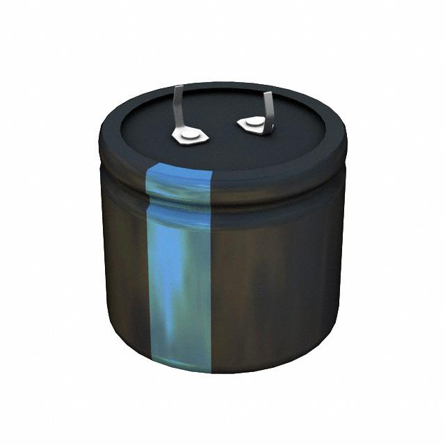

Type 381LQ 105 °C Compact, High-Ripple Snap-in 23% Smaller for Same Capacitance Type 381LQ is on average 23% smaller and more than 5 mm shorter than Type 381LX. This is achieved with a new can closure method that permits installing capacitor elements into smaller cans. Approaching the robust capability of the 381L the new 381LQ enables you to shrink equipment size and retain the original performance. Highlights • • New, more capacitance per case Compare to Type 381L . Specifications Operating Temperature: Rated Voltage: Capacitance: Leakage Current: Ripple Current Multipliers: –40 °C to +105 °C, ≤315 Vdc –25 °C to +105 °C, ≥350 Vdc 10 to 450 Vdc 100 µF to 100,000 µF ±20% ≤3 √CV µA, 5 minutes Ambient Temperature 45 °C 2.35 60 °C 2.20 50 Hz 10-100 Vdc 160-450 Vdc 0.93 0.75 70 °C 2.00 60 Hz 0.95 0.80 85 °C 1.70 120 Hz 1.00 1.00 105 °C 1.00 500 Hz 1.05 1.20 1 kHz 1.08 1.25 10 kHz & up 1.15 1.40 Frequency Load Life: EIA Ripple Life: Shelf Life: Complies with the EU Directive 2002/95/EC requirement restricting the use of Lead (Pb), Mercury (Hg), Cadmium (Cd), Hexavalent chromium (Cr(VI)), PolyBrominated Biphenyls (PBB) and PolyBrominated Diphenyl Ethers (PBDE). Vibration: 2000 h at full load at 105 °C ∆Capacitance ±20% ESR 200% of limit DCL 100% of limit 8000 h at 85 °C per EIA IS-749 with 105 ºC ripple current. ∆Capacitance ±20% ESR 200% of limit CL 100% of limit 1000 h at 105 °C, ∆Capacitance ± 20% ESR 200% of limit DCL 100% of limit 10 to 55 Hz, 0.06” and 10 g max, 2 h each plane CDM Cornell Dubilier • 140 Technology Place • Liberty, SC 29657 • Phone: (864)843-2277 • Fax: (864)843-3800 • www.cde.com Type 381LQ 105 °C Compact, High-Ripple Snap-in Outline Drawing Insulated Case Dimensions DIAMETER Case H01 H02 H03 H04 H45 H05 J01 J02 J03 J04 J45 J05 22 22 22 22 22 22 25 25 25 25 25 25 D 0.87 0.87 0.87 0.87 0.87 0.87 0.98 0.98 0.98 0.98 0.98 0.98 25 30 35 40 45 50 25 30 35 40 45 50 LENGTH L 0.98 1.18 1.38 1.57 1.77 1.97 0.98 1.18 1.38 1.57 1.77 1.97 Typical Weight 16 19 22 24 28 31 20 24 27 31 35 38 Case Code mm K01 K02 K03 K04 K45 K05 A01 A02 A03 A04 A45 A05 30 30 30 30 30 30 35 35 35 35 35 35 DIAMETER D inches 1.18 1.18 1.18 1.18 1.18 1.18 1.38 1.38 1.38 1.38 1.38 1.38 mm 25 30 35 40 45 50 25 30 35 40 45 50 LENGTH L 0.98 1.18 1.38 1.57 1.77 1.97 0.98 1.18 1.38 1.57 1.77 1.97 Typical Weight 30 35 40 44 49 53 42 48 54 60 67 74 Code mm inches mm inches (grams) inches (grams) Part Numbering System 381LQ Type 471 Capacitance 471 = 470 µF 332 = 3300 µF M Tolerance M = ±20% 160 Rated Voltage 160 = 160 V 450 = 450 V HO1 Case Code 2 Insulation 2 = PVC CDM Cornell Dubilier • 140 Technology Place • Liberty, SC 29657 • Phone: (864)843-2277 • Fax: (864)843-3800 • www.cde.com Type 381LQ 105 °C Compact, High-Ripple Snap-in Typical Performance Curves µ) Ratings ESR Max @ 25 ºC 120 Hz 20 kHz (Ω) (Ω) 10 Vdc (13 Vdc Surge) 12000 18000 18000 22000 22000 27000 27000 27000 33000 33000 39000 39000 39000 47000 47000 47000 56000 56000 68000 68000 82000 100000 381LQ123M010H012 381LQ183M010H022 381LQ183M010H012 381LQ223M010H032 381LQ223M010J022 381LQ273M010H042 381LQ273M010J032 381LQ273M010K012 381LQ333M010H452 381LQ333M010J042 381LQ393M010J452 381LQ393M010K022 381LQ393M010A012 381LQ473M010J052 381LQ473M010K032 381LQ473M010A022 381LQ563M010K042 381LQ563M010A032 381LQ683M010K452 381LQ683M010A042 381LQ823M010A452 381LQ104M010A052 0.076 0.051 0.051 0.041 0.041 0.034 0.034 0.034 0.028 0.028 0.026 0.026 0.026 0.024 0.024 0.024 0.023 0.023 0.022 0.022 0.021 0.020 0.065 0.043 0.043 0.035 0.035 0.029 0.029 0.029 0.023 0.023 0.022 0.023 0.022 0.021 0.022 0.021 0.021 0.020 0.020 0.019 0.019 0.019 2.20 2.40 2.40 2.60 2.60 3.10 3.10 3.10 3.40 3.40 3.70 3.70 3.70 4.20 4.20 4.20 5.00 5.00 5.40 5.40 6.10 6.90 2.53 2.76 2.76 2.99 2.99 3.57 3.57 3.57 3.91 3.91 4.26 4.26 4.26 4.83 4.83 4.83 5.75 5.75 6.21 6.21 7.02 7.94 22 x 25 22 x 30 25 x 25 22 x 35 25 x 30 22 x 40 25 x 35 30 x 25 22 x 45 25 x 40 25 x 45 30 x 30 35 x 25 25 x 50 30 x 35 35 x 30 30 x 40 35 x 35 30 x 45 35 x 40 35 x 45 35 x 50 10000 12000 12000 15000 18000 18000 22000 22000 22000 27000 27000 27000 27000 33000 33000 33000 39000 39000 47000 47000 56000 56000 Ripple Amps Nominal @ 105 ºC Size 120 Hz 20 kHz DxL (A) (A) (mm) ESR Max @ 25 ºC 120 Hz 20 kHz (Ω) (Ω) 16 Vdc (20 Vdc Surge) 381LQ103M016H012 381LQ123M016H022 381LQ123M016J012 381LQ153M016H032 381LQ183M016H042 381LQ183M016J022 381LQ223M016H452 381LQ223M016J032 381LQ223M016H012 381LQ273M016H052 381LQ273M016J042 381LQ273M016K022 381LQ273M016A012 381LQ333M016J452 381LQ333M016K032 381LQ333M016A022 381LQ393M016K042 381LQ393M016A032 381LQ473M016K452 381LQ473M016A042 381LQ563M016K052 381LQ563M016A452 0.075 0.062 0.062 0.050 0.041 0.041 0.034 0.034 0.034 0.028 0.028 0.028 0.028 0.023 0.023 0.023 0.022 0.022 0.016 0.021 0.020 0.020 0.063 0.053 0.053 0.042 0.035 0.035 0.029 0.029 0.029 0.023 0.023 0.023 0.023 0.019 0.019 0.020 0.018 0.020 0.014 0.019 0.018 0.018 2.60 2.90 2.90 3.20 3.50 3.50 3.80 3.80 3.80 4.20 4.20 4.20 4.20 4.70 4.70 4.70 5.10 5.10 5.50 5.50 6.00 6.00 2.99 3.34 3.34 3.68 4.03 4.03 4.37 4.37 4.37 4.83 4.83 4.83 4.83 5.41 5.41 5.41 5.87 5.87 6.33 6.33 6.90 6.90 22 x 25 22 x 30 25 x 25 22 x 35 22 x 40 25 x 30 22 x 45 25 x 35 30 x 25 22 x 50 25 x 40 30 x 30 35 x 25 25 x 45 30 x 35 35 x 30 30 x 40 35 x 35 30 x 45 35 x 40 30 x 50 35 x 45 Ripple Amps @ 105 ºC 120 Hz 20 kHz (A) (A) Nominal Size DxL (mm) Cap. (µF) Catalog Part Number Cap. (µF) Catalog Part Number CDM Cornell Dubilier • 140 Technology Place • Liberty, SC 29657 • Phone: (864)843-2277 • Fax: (864)843-3800 • www.cde.com Type 381LQ 105 °C Compact, High-Ripple Snap-in ESR Max @ 25 ºC 120 Hz 20 kHz (Ω) (Ω) 25 Vdc (32 Vdc Surge) 6800 8200 8200 10000 12000 12000 15000 15000 15000 18000 18000 18000 18000 22000 22000 22000 27000 27000 33000 33000 39000 39000 47000 4700 5600 5600 6800 8200 8200 10000 10000 10000 12000 12000 12000 15000 15000 15000 18000 18000 22000 22000 27000 381LQ682M025H012 381LQ822M025H022 381LQ822M025J012 381LQ103M025H032 381LQ123M025H042 381LQ123M025J022 381LQ153M025H452 381LQ153M025J032 381LQ153M025K012 381LQ183M025H052 381LQ183M025J042 381LQ183M025K022 381LQ183M025A012 381LQ223M025J452 381LQ223M025K032 381LQ223M025A022 381LQ273M025K042 381LQ273M025A032 381LQ333M025K452 381LQ333M025A042 381LQ393M025K052 381LQ393M025A452 381LQ473M025A052 381LQ472M035H012 381LQ562M035H022 381LQ562M035J012 381LQ682M035H032 381LQ822M035H042 381LQ822M035J022 381LQ103M035H452 381LQ103M035J032 381LQ103M035K012 381LQ123M035J042 381LQ123M035K022 381LQ123M035A012 381LQ153M035J452 381LQ153M035K022 381LQ153M035A032 381LQ183M035K042 381LQ183M035A032 381LQ223M035K452 381LQ223M035A042 381LQ273M035K052 0.085 0.071 0.071 0.058 0.048 0.048 0.039 0.039 0.039 0.032 0.032 0.032 0.032 0.026 0.026 0.026 0.021 0.021 0.018 0.018 0.017 0.017 0.017 0.106 0.089 0.089 0.073 0.061 0.061 0.050 0.050 0.050 0.041 0.041 0.041 0.033 0.033 0.033 0.028 0.028 0.023 0.023 0.018 0.064 0.053 0.053 0.044 0.036 0.036 0.029 0.029 0.029 0.024 0.024 0.024 0.024 0.020 0.020 0.020 0.016 0.016 0.013 0.014 0.013 0.014 0.014 0.079 0.067 0.067 0.055 0.045 0.045 0.037 0.037 0.037 0.031 0.031 0.031 0.025 0.025 0.025 0.021 0.021 0.017 0.017 0.014 2.40 2.70 2.70 3.00 3.20 3.20 3.60 3.60 3.60 3.90 3.90 3.90 3.90 4.30 4.30 4.30 4.80 4.80 5.50 5.50 5.80 5.80 6.30 2.20 2.40 2.40 2.60 2.90 2.90 3.20 3.20 3.20 3.50 3.50 3.50 3.90 3.90 3.90 4.30 4.30 5.00 5.00 5.30 2.76 3.11 3.11 3.45 3.68 3.68 4.14 4.14 4.14 4.49 4.49 4.49 4.49 4.95 4.95 4.95 5.52 5.52 6.33 6.33 6.67 6.67 7.25 2.53 2.76 2.76 2.99 3.34 3.34 3.68 3.68 3.68 4.03 4.03 4.03 4.49 4.49 4.49 4.95 4.95 5.75 5.75 6.10 22 x 25 22 x 30 25 x 25 22 x 35 22 x 40 25 x 30 22 x 45 25 x 35 30 x 25 22 x 50 25 x 40 30 x 30 35 x 25 25 x 45 30 x 35 35 x 30 30 x 40 35 x 35 30 x 45 35 x 40 30 x 50 35 x 45 35 x 50 22 x 25 22 x 30 25 x 25 22 x 35 22 x 40 25 x 30 22 x 45 25 x 35 30 x 25 25 x 40 30 x 30 35 x 25 25 x 45 30 x 35 35 x 30 30 x 40 35 x 35 30 x 45 35 x 40 30 x 50 2200 2700 2700 3300 3900 3900 3900 4700 4700 5600 5600 5600 5600 6800 2700 3300 3900 3900 4700 4700 5600 5600 4700 4700 5600 5600 5600 6800 6800 6800 6800 8200 8200 10000 10000 10000 12000 12000 15000 15000 18000 Ripple Amps @ 105 ºC 120 Hz 20 kHz (A) (A) Nominal Size DxL (mm) ESR Max @ 25 ºC 120 Hz 20 kHz (Ω) (Ω) 0.018 0.015 0.154 0.126 0.106 0.106 0.088 0.088 0.074 0.074 0.088 0.088 0.074 0.074 0.074 0.061 0.061 0.061 0.061 0.051 0.051 0.041 0.041 0.041 0.035 0.035 0.028 0.028 0.023 0.151 0.123 0.123 0.100 0.085 0.085 0.085 0.071 0.071 0.059 0.059 0.059 0.059 0.049 0.014 0.012 0.115 0.094 0.080 0.080 0.066 0.066 0.056 0.056 0.066 0.066 0.056 0.056 0.056 0.046 0.046 0.046 0.046 0.038 0.038 0.031 0.031 0.031 0.026 0.028 0.021 0.022 0.018 0.113 0.092 0.092 0.075 0.064 0.064 0.064 0.053 0.053 0.044 0.044 0.044 0.044 0.037 Ripple Amps @ 105 ºC 120 Hz 20 kHz (A) (A) 5.30 5.90 1.80 2.00 2.20 2.20 2.50 2.50 2.80 2.80 2.50 2.50 2.80 2.80 2.80 3.30 3.30 3.30 3.30 3.60 3.60 4.00 4.00 4.00 4.50 4.50 4.80 4.80 5.60 2.00 2.20 2.20 2.50 2.70 2.70 2.70 3.00 3.00 3.30 3.30 3.30 3.30 3.60 6.10 6.79 2.07 2.30 2.53 2.53 2.88 2.88 3.22 3.22 2.88 2.88 3.22 3.22 3.22 3.80 3.80 3.80 3.80 4.14 4.14 4.60 4.60 4.60 5.18 5.18 5.52 5.52 6.44 2.30 2.53 2.53 2.88 3.11 3.11 3.11 3.45 3.45 3.80 3.80 3.80 3.80 4.14 Nominal Size DxL (mm) 35 x 45 35 x 50 22 x 25 22 x 30 22 x 35 25 x 25 22 x 40 25 x 30 22 x 45 25 x 35 22 x 40 25 x 30 22 x 45 25 x 35 30 x 25 22 x 50 25 x 40 30 x 30 35 x 25 25 x 45 30 x 35 25 x 50 30 x 40 35 x 30 30 x 45 35 x 35 30 x 50 35 x 40 35 x 45 22 x 25 22 x 30 25 x 25 22 x 35 22 x 40 25 x 30 30 x 25 22 x 45 25 x 35 22 x 50 25 x 40 30 x 30 35 x 25 25 x 45 Cap. (µF) Catalog Part Number Cap. (µF) 27000 33000 Catalog Part Number 381LQ273M035A452 381LQ333M035A052 381LQ272M050H012 381LQ332M050H022 381LQ392M050H032 381LQ392M050J012 381LQ472M050H042 381LQ472M050J022 381LQ562M050H452 381LQ562M050J032 381LQ472M050H042 381LQ472M050J022 381LQ562M050H452 381LQ562M050J032 381LQ562M050K012 381LQ682M050H052 381LQ682M050J042 381LQ682M050K022 381LQ682M050A012 381LQ822M050J452 381LQ822M050K032 381LQ103M050J052 381LQ103M050K042 381LQ103M050A022 381LQ123M050K452 381LQ123M050A032 381LQ153M050K052 381LQ153M050A042 381LQ183M050A452 381LQ222M063H012 381LQ272M063H022 381LQ272M063J012 381LQ332M063H032 381LQ392M063H042 381LQ392M063J022 381LQ392M063K012 381LQ472M063H452 381LQ472M063J032 381LQ562M063H052 381LQ562M063J042 381LQ562M063K022 381LQ562M063A012 381LQ682M063J452 50 Vdc (63 Vdc Surge) 35 Vdc (44 Vdc Surge) 63 Vdc (79 Vdc Surge) CDM Cornell Dubilier • 140 Technology Place • Liberty, SC 29657 • Phone: (864)843-2277 • Fax: (864)843-3800 • www.cde.com Type 381LQ 105 °C Compact, High-Ripple Snap-in ESR Max @ 25 ºC 120 Hz 20 kHz (Ω) (Ω) 80 Vdc (100 Vdc Surge) 6800 6800 8200 8200 10000 10000 12000 12000 15000 1200 1500 1500 1800 2200 2200 2700 2700 2700 3300 3300 3300 3300 3900 3900 4700 4700 4700 5600 5600 6800 6800 8200 820 1200 1200 1500 1500 1800 1800 1800 2200 2200 2200 2200 381LQ682M063K032 381LQ682M063A022 381LQ822M063K042 381LQ822M063A032 381LQ103M063K452 381LQ103M063A042 381LQ123M063K052 381LQ123M063A452 381LQ153M063A052 381LQ122M080H012 381LQ152M080H022 381LQ152M080J012 381LQ182M080H032 381LQ222M080H042 381LQ222M080J022 381LQ272M080H452 381LQ272M080J032 381LQ272M080K012 381LQ332M080H052 381LQ332M080J042 381LQ332M080K022 381LQ332M080A012 381LQ392M080J452 381LQ392M080K032 381LQ472M080J052 381LQ472M080K042 381LQ472M080A022 381LQ562M080K452 381LQ562M080A032 381LQ682M080K052 381LQ682M080A042 381LQ822M080A452 381LQ821M100H012 381LQ122M100H022 381LQ122M100J012 381LQ152M100H032 381LQ152M100J022 381LQ182M100H042 381LQ182M100J032 381LQ182M100K012 381LQ222M100H452 381LQ222M100J042 381LQ222M100K022 381LQ222M100A012 0.049 0.049 0.040 0.040 0.033 0.033 0.028 0.028 0.022 0.235 0.188 0.188 0.157 0.128 0.128 0.104 0.104 0.104 0.085 0.085 0.085 0.085 0.072 0.072 0.060 0.060 0.060 0.050 0.050 0.041 0.041 0.034 0.303 0.207 0.207 0.166 0.166 0.138 0.138 0.138 0.113 0.113 0.113 0.113 0.037 0.037 0.030 0.030 0.025 0.025 0.021 0.022 0.018 0.176 0.141 0.141 0.117 0.096 0.096 0.078 0.078 0.078 0.064 0.064 0.064 0.064 0.054 0.054 0.045 0.045 0.045 0.038 0.038 0.031 0.032 0.027 0.197 0.135 0.135 0.108 0.108 0.090 0.090 0.090 0.073 0.073 0.073 0.073 3.60 3.60 3.90 3.90 4.40 4.40 4.80 4.80 5.40 1.50 1.70 1.70 1.80 2.10 2.10 2.40 2.40 2.40 2.60 2.60 2.60 2.60 3.00 3.00 3.30 3.30 3.30 3.70 3.70 3.90 3.90 4.50 1.40 1.80 1.80 2.10 2.10 2.30 2.30 2.30 2.60 2.60 2.60 2.60 4.14 4.14 4.49 4.49 5.06 5.06 5.52 5.52 6.21 1.73 1.96 1.96 2.07 2.42 2.42 2.76 2.76 2.76 2.99 2.99 2.99 2.99 3.45 3.45 3.80 3.80 3.80 4.26 4.26 4.49 4.49 5.18 1.61 2.07 2.07 2.42 2.42 2.65 2.65 2.65 2.99 2.99 2.99 2.99 30 x 35 35 x 30 30 x 40 35 x 35 30 x 45 35 x 40 30 x 50 35 x 45 35 x 50 22 x 25 22 x 30 25 x 25 22 x 35 22 x 40 25 x 30 22 x 45 25 x 35 30 x 25 22 x 50 25 x 40 30 x 30 35 x 25 25 x 45 30 x 35 25 x 50 30 x 40 35 x 30 30 x 45 35 x 35 30 x 50 35 x 40 35 x 45 22 x 25 22 x 30 25 x 25 22 x 35 25 x 30 22 x 40 25 x 35 30 x 25 22 x 45 25 x 40 30 x 30 35 x 25 560 560 680 680 820 820 820 1000 1000 470 560 680 680 820 820 1000 1000 1000 1200 1200 1200 1200 1500 1500 1500 1800 1800 1800 2200 2200 2700 2700 3300 Ripple Amps @ 105 ºC 120 Hz 20 kHz (A) (A) Nominal Size DxL (mm) ESR Max @ 25 ºC 120 Hz 20 kHz (Ω) (Ω) 0.092 0.092 0.075 0.075 0.075 0.064 0.064 0.053 0.053 0.044 0.037 0.423 0.355 0.293 0.293 0.243 0.243 0.199 0.199 0.216 0.166 0.166 0.166 0.180 0.133 0.133 0.155 0.110 0.110 0.120 0.090 0.098 0.080 0.086 0.070 0.355 0.355 0.293 0.293 0.243 0.243 0.243 0.199 0.199 0.060 0.060 0.049 0.049 0.049 0.043 0.043 0.038 0.037 0.031 0.027 0.190 0.160 0.132 0.132 0.109 0.109 0.090 0.090 0.108 0.075 0.075 0.075 0.090 0.060 0.060 0.077 0.055 0.055 0.060 0.045 0.049 0.040 0.043 0.042 0.160 0.160 0.132 0.132 0.109 0.109 0.109 0.090 0.090 Ripple Amps @ 105 ºC 120 Hz 20 kHz (A) (A) 2.90 2.90 3.20 3.20 3.20 3.60 3.60 3.80 3.80 4.20 4.70 1.40 1.50 1.70 1.70 2.00 2.00 2.20 2.20 2.20 2.30 2.30 2.30 2.30 2.50 2.50 2.50 2.70 2.70 2.70 2.90 2.90 3.10 3.10 3.30 1.50 1.50 1.70 1.70 2.00 2.00 2.00 2.20 2.20 3.34 3.34 3.68 3.68 3.68 4.14 4.14 4.37 4.37 4.83 5.41 1.96 2.10 2.38 2.38 2.80 2.80 3.08 3.08 3.08 3.22 3.22 3.22 3.22 3.50 3.50 3.50 3.78 3.78 3.78 4.06 4.06 4.34 4.34 4.62 2.10 2.10 2.38 2.38 2.80 2.80 2.80 3.08 3.08 Nominal Size DxL (mm) 25 x 45 30 x 35 25 x 50 30 x 40 35 x 30 30 x 45 35 x 35 30 x 50 35 x 40 35 x 45 35 x 50 22 x 25 22 x 30 22 x 30 25 x 25 22 x 35 25 x 30 22 x 40 25 x 35 30 x 25 22 x 45 25 x 40 30 x 30 35 x 25 25 x 45 30 x 35 35 x 30 25 x 50 30 x 40 35 x 30 30 x 45 35 x 35 30 x 50 35 x 40 35 x 50 22 x 30 25 x 25 22 x 35 25 x 30 22 x 40 25 x 30 30 x 25 22 x 45 25 x 40 Cap. (µF) Catalog Part Number Cap. (µF) 2700 2700 3300 3300 3300 3900 3900 4700 4700 5600 6800 Catalog Part Number 381LQ272M100J452 381LQ272M100K032 381LQ332M100J052 381LQ332M100K042 381LQ332M100A022 381LQ392M100K452 381LQ392M100A032 381LQ472M100K052 381LQ472M100A042 381LQ562M100A452 381LQ682M100A052 381LQ471M160H012 381LQ561M160H022 381LQ681M160H022 381LQ681M160J012 381LQ821M160H032 381LQ821M160J022 381LQ102M160H042 381LQ102M160J032 381LQ102M160K012 381LQ122M160H452 381LQ122M160J042 381LQ122M160K022 381LQ122M160A012 381LQ152M160J452 381LQ152M160K032 381LQ152M160A022 381LQ182M160J052 381LQ182M160K042 381LQ182M160A022 381LQ222M160K452 381LQ222M160A032 381LQ272M160K052 381LQ272M160A042 381LQ332M160A052 381LQ561M180H022 381LQ561M180J012 381LQ681M180H032 381LQ681M180J022 381LQ821M180H042 381LQ821M180J022 381LQ821M180K012 381LQ102M180H452 381LQ102M180J042 160 Vdc (200 Vdc Surge) 100 Vdc (125 Vdc Surge) 180 Vdc (225 Vdc Surge) CDM Cornell Dubilier • 140 Technology Place • Liberty, SC 29657 • Phone: (864)843-2277 • Fax: (864)843-3800 • www.cde.com Type 381LQ 105 °C Compact, High-Ripple Snap-in Cap. (µF) 1000 1000 1200 1200 1500 1500 1500 1800 1800 2200 2200 2700 390 470 560 680 680 820 820 820 1000 1000 1000 1000 1200 1200 1200 1500 1500 1800 1800 2200 2200 270 330 330 390 390 470 470 470 560 560 560 Catalog Part Number 381LQ102M108K022 381LQ102M180A012 381LQ122M180J452 381LQ122M180K032 381LQ152M180J052 381LQ152M180K042 381LQ152M180A022 381LQ182M180K452 381LQ182M180A032 381LQ222M180K052 381LQ222M180A042 381LQ272M180A052 381LQ391M200H012 381LQ471M200H022 381LQ561M200H022 381LQ681M200H042 381LQ681M200J022 381LQ821M200H452 381LQ821M200J032 381LQ821M200K012 381LQ102M200H052 381LQ102M200J452 381LQ102M200K022 381LQ102M200A012 381LQ122M200J052 381LQ122M200K032 381LQ122M200A022 381LQ152M200K042 381LQ152M200A022 381LQ182M200K452 381LQ182M200A042 381LQ222M200K052 381LQ222M200A452 381LQ271M250H012 381LQ331M250H022 381LQ331M250J012 381LQ391M250H032 381LQ391M250J012 381LQ471M250H042 381LQ471M250J022 381LQ471M250K012 381LQ561M250H452 381LQ561M250J032 381LQ561M250K012 ESR Max @ 25 ºC 120 Hz 20 kHz (Ω) (Ω) 0.199 0.216 0.166 0.166 0.133 0.133 0.155 0.110 0.129 0.090 0.098 0.086 0.510 0.423 0.355 0.293 0.293 0.243 0.243 0.243 0.199 0.199 0.199 0.216 0.166 0.166 0.180 0.133 0.114 0.110 0.129 0.090 0.096 0.614 0.502 0.502 0.425 0.425 0.353 0.353 0.353 0.296 0.296 0.296 0.090 0.097 0.075 0.075 0.060 0.060 0.077 0.050 0.064 0.041 0.049 0.043 0.230 0.190 0.160 0.132 0.132 0.109 0.109 0.109 0.090 0.090 0.090 0.097 0.075 0.075 0.090 0.060 0.072 0.050 0.084 0.041 0.044 0.276 0.226 0.226 0.191 0.191 0.159 0.159 0.159 0.133 0.133 0.133 Ripple Amps @ 105 ºC 120 Hz 20 kHz (A) (A) 2.20 2.20 2.30 2.30 2.50 2.50 2.50 2.70 2.70 2.90 2.90 3.10 1.31 1.45 1.67 1.75 1.75 2.04 2.04 2.04 2.30 2.30 2.30 2.30 2.65 2.65 2.65 2.80 2.80 3.08 3.08 3.48 3.48 1.10 1.20 1.20 1.30 1.30 1.40 1.40 1.40 1.50 1.50 1.50 3.08 3.08 3.22 3.22 3.50 3.50 3.50 3.78 3.78 4.06 4.06 4.34 1.83 2.03 2.34 2.45 2.45 2.86 2.86 2.86 3.22 3.22 3.22 3.22 3.71 3.71 3.71 3.92 3.92 4.31 4.31 4.87 4.87 1.54 1.68 1.68 1.82 1.82 1.96 1.96 1.96 2.10 2.10 2.10 Nominal Size DxL (mm) 30 x 30 35 x 25 25 x 45 30 x 35 25 x 50 30 x 40 35 x 30 30 x 45 35 x 35 30 x 50 35 x 40 35 x 50 150 22 x 25 22 x 30 22 x 30 22 x 40 25 x 30 22 x 45 25 x 35 30 x 25 22 x 50 25 x 45 30 x 30 35 x 25 25 x 50 30 x 35 35 x 30 30 x 40 35 x 30 30 x 45 35 x 40 30 x 50 35 x 45 22 x 25 22 x 30 25 x 25 22 x 35 25 x 25 22 x 40 25 x 30 30 x 25 22 x 45 25 x 35 30 x 25 120 150 180 180 220 220 270 270 330 330 390 390 470 180 220 270 330 330 330 390 390 390 470 470 560 560 560 680 680 820 820 1000 Cap. (µF) 680 680 680 680 820 820 820 1000 1200 1500 1800 Catalog Part Number 381LQ681M250H052 381LQ681M250J042 381LQ681M250K022 381LQ681M250A012 381LQ821M250J452 381LQ821M250K032 381LQ821M250A022 381LQ102M250K042 381LQ122M250K452 381LQ152M250A452 381LQ182M250A052 381LQ151M315H012 381LQ181M315H022 381LQ221M315H022 381LQ271M315J022 381LQ331M315H452 381LQ331M315J032 381LQ331M315K012 381LQ391M315J042 381LQ391M315K022 381LQ391M315A012 381LQ471M315J452 381LQ471M315K032 381LQ561M315J052 381LQ561M315K042 381LQ561M315A022 381LQ681M315K452 381LQ681M315A032 381LQ821M315K052 381LQ821M315A042 381LQ102M315A452 381LQ121M350H012 381LQ151M350H022 381LQ181M350H022 381LQ181M350J012 381LQ221M350H032 381LQ221M350J022 381LQ271M350J032 381LQ271M350K012 381LQ331M350J042 381LQ331M350K022 381LQ391M350J452 381LQ391M350K032 381LQ471M350J052 ESR Max @ 25 ºC 120 Hz 20 kHz (Ω) (Ω) 0.244 0.244 0.244 0.244 0.202 0.202 0.202 0.166 0.138 0.110 0.092 1.105 0.921 0.754 0.614 0.502 0.502 0.502 0.425 0.425 0.425 0.353 0.353 0.296 0.296 0.296 0.244 0.244 0.202 0.202 0.166 1.382 1.105 0.921 0.921 0.754 0.754 0.614 0.614 0.502 0.502 0.425 0.425 0.353 0.110 0.110 0.110 0.110 0.091 0.091 0.091 0.075 0.062 0.050 0.041 0.497 0.414 0.339 0.276 0.226 0.226 0.226 0.191 0.191 0.191 0.159 0.159 0.133 0.133 0.133 0.116 0.116 0.091 0.091 0.075 0.622 0.497 0.414 0.414 0.339 0.339 0.276 0.276 0.226 0.226 0.191 0.191 0.159 Ripple Amps @ 105 ºC 120 Hz 20 kHz (A) (A) 1.70 1.70 1.70 1.70 2.00 2.00 2.00 2.20 2.30 2.50 2.70 0.82 0.90 1.00 1.10 1.20 1.20 1.20 1.30 1.30 1.30 1.40 1.40 1.50 1.50 1.50 1.70 1.70 2.00 2.00 2.30 0.75 0.82 0.90 0.90 1.00 1.00 1.10 1.10 1.20 1.20 1.30 1.30 1.40 2.38 2.38 2.38 2.38 2.80 2.80 2.80 3.08 3.22 3.50 3.78 1.15 1.26 1.40 1.54 1.68 1.68 1.68 1.82 1.82 1.82 1.96 1.96 2.10 2.10 2.10 2.38 2.38 2.80 2.80 3.22 1.05 1.15 1.26 1.26 1.40 1.40 1.54 1.54 1.68 1.68 1.82 1.82 1.96 Nominal Size DxL (mm) 22 x 50 25 x 40 30 x 30 35 x 25 25 x 45 30 x 35 35 x 30 30 x 40 30 x 45 35 x 45 35 x 50 22 x 25 22 x 30 22 x 30 25 x 30 22 x 45 25 x 35 30 x 25 25 x 40 30 x 30 35 x 25 25 x 45 30 x 35 25 x 50 30 x 40 35 x 30 30 x 45 35 x 35 30 x 50 35 x 40 35 x 45 22 x 25 22 x 30 22 x 30 25 x 25 22 x 35 25 x 30 25 x 35 30 x 25 25 x 40 30 x 30 25 x 45 30 x 35 25 x 50 315 Vdc (365 Vdc Surge) 200 Vdc (250 Vdc Surge) 350 Vdc (400 Vdc Surge) 250 Vdc (300 Vdc Surge) CDM Cornell Dubilier • 140 Technology Place • Liberty, SC 29657 • Phone: (864)843-2277 • Fax: (864)843-3800 • www.cde.com Type 381LQ 105 °C Compact, High-Ripple Snap-in Cap. (µF) 470 560 560 680 680 820 100 120 150 180 180 220 220 220 270 270 270 270 330 330 330 390 390 390 470 470 560 Catalog Part Number 381LQ471M350A022 381LQ561M350K452 381LQ561M350A032 381LQ681M350K052 381LQ681M350A042 381LQ821M350A452 381LQ101M400H012 381LQ121M400H022 381LQ151M400H022 381LQ181M400H032 381LQ181M400J022 381LQ221M400H452 381LQ221M400J032 381LQ221M400K012 381LQ271M400H052 381LQ271M400J042 381LQ271M400K022 381LQ271M400A012 381LQ331M400J452 381LQ331M400K032 381LQ331M400A022 381LQ391M400J052 381LQ391M400K042 381LQ391M400A022 381LQ471M400K452 381LQ471M400A032 381LQ561M400K052 ESR Max @ 25 ºC 120 Hz 20 kHz (Ω) (Ω) 0.353 0.296 0.296 0.244 0.244 0.202 1.824 1.520 1.216 1.013 1.013 0.829 0.829 0.829 0.675 0.675 0.675 0.675 0.553 0.553 0.553 0.468 0.468 0.468 0.388 0.388 0.326 0.159 0.133 0.133 0.110 0.110 0.091 0.821 0.684 0.547 0.458 0.458 0.373 0.373 0.373 0.304 0.304 0.304 0.304 0.249 0.249 0.249 0.210 0.210 0.210 0.175 0.175 0.147 Ripple Amps @ 105 ºC 120 Hz 20 kHz (A) (A) 1.40 1.50 1.50 1.70 1.70 1.90 0.70 0.75 0.88 0.95 0.95 1.10 1.10 1.10 1.22 1.22 1.22 1.22 1.44 1.44 1.44 1.55 1.55 1.55 1.68 1.68 1.90 1.96 2.10 2.10 2.38 2.38 2.66 0.98 1.05 1.23 1.33 1.33 1.54 1.54 1.54 1.71 1.71 1.71 1.71 2.02 2.02 2.02 2.17 2.17 2.17 2.35 2.35 2.66 Nominal Size DxL (mm) 35 x 30 30 x 45 35 x 35 30 x 50 35 x 40 35 x 45 22 x 25 22 x 30 22 x 30 22 x 35 25 x 30 22 x 45 25 x 35 30 x 25 22 x 50 25 x 40 30 x 30 35 x 25 25 x 45 30 x 35 35 x 30 25 x 50 30 x 40 35 x 30 30 x 45 35 x 35 30 x 50 100 100 120 120 150 150 150 180 180 180 220 220 220 270 270 270 330 330 390 470 560 390 390 470 560 Cap. (µF) 560 680 Catalog Part Number 381LQ561M400A042 381LQ681M400A452 381LQ101M450H022 381LQ101M450J012 381LQ121M450H032 381LQ121M450J022 381LQ151M450H042 381LQ151M450J022 381LQ151M450K012 381LQ181M450H452 381LQ181M450J042 381LQ181M450K022 381LQ221M450J452 381LQ221M450K022 381LQ221M450A012 381LQ271M450J052 381LQ271M450K042 381LQ271M450A022 381LQ331M450K452 381LQ331M450A032 381LQ391M450A042 381LQ471M450A452 381LQ561M450A052 381LQ391M450K052 381LQ391M450A042 381LQ471M450A452 381LQ561M450A052 ESR Max @ 25 ºC 120 Hz 20 kHz (Ω) (Ω) 0.326 0.268 1.824 1.824 1.520 1.520 1.216 1.216 1.216 1.013 1.013 1.013 0.829 0.829 0.829 0.675 0.675 0.675 0.553 0.553 0.468 0.388 0.326 0.680 0.468 0.388 0.326 0.147 0.121 0.821 0.821 0.684 0.684 0.547 0.547 0.547 0.456 0.456 0.456 0.373 0.373 0.373 0.304 0.304 0.304 0.249 0.249 0.210 0.175 0.147 0.210 0.210 0.175 0.147 Ripple Amps @ 105 ºC 120 Hz 20 kHz (A) (A) 1.90 2.12 0.64 0.64 0.72 0.72 0.79 0.79 0.79 0.87 0.87 0.87 1.00 1.00 1.00 1.19 1.19 1.19 1.38 1.38 1.55 1.74 1.90 1.55 1.55 1.74 1.90 2.66 2.97 0.90 0.90 1.01 1.01 1.11 1.11 1.11 1.22 1.22 1.22 1.40 1.40 1.40 1.67 1.67 1.67 1.93 1.93 2.17 2.44 2.66 2.17 2.17 2.44 2.66 Nominal Size DxL (mm) 35 x 40 35 x 45 22 x 30 25 x 25 22 x 35 25 x 30 22 x 40 25 x 30 30 x 25 22 x 45 25 x 40 30 x 30 25 x 45 30 x 30 35 x 25 25 x 50 30 x 40 35 x 30 30 x 45 35 x 35 35 x 40 35 x 45 35 x 50 30 x 50 35 x 40 35 x 45 35 x 50 450 Vdc (500 Vdc Surge) 400 Vdc (450 Vdc Surge) CDM Cornell Dubilier • 140 Technology Place • Liberty, SC 29657 • Phone: (864)843-2277 • Fax: (864)843-3800 • www.cde.com
