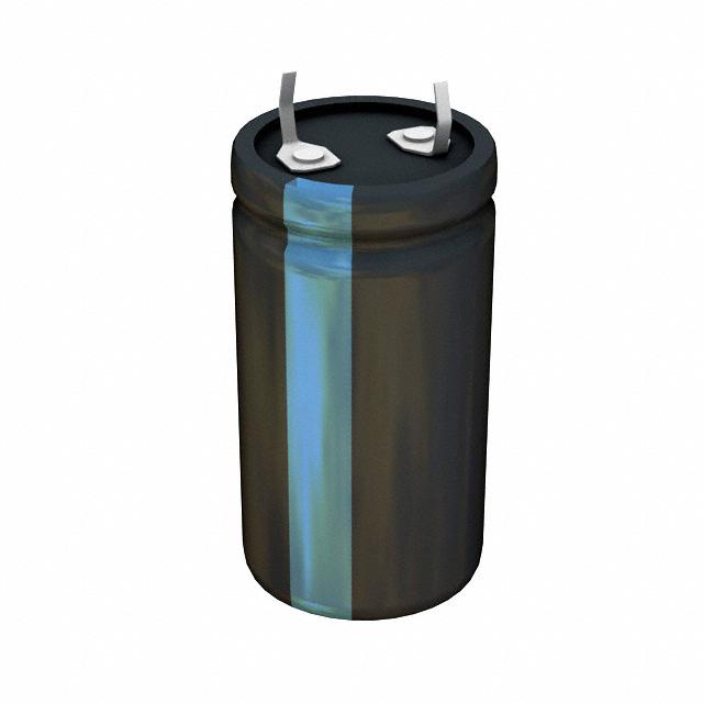

Type 381LR 105 °C Ultra-High-Ripple Snap-in 25% More Ripple Current Capability Compared to standard 105 °C snap-ins like the Type 381L/LX Type 381LR can handle an extra 25% ripple current or more. This remarkable capability stems from advances in electrolyte that give extremely low ESR values.In high ripple current applications like motor drives you can save by using fewer capacitors. Highlights • • • • Operating Temperature: Rated Voltage: Capacitance: Leakage Current: Ripple Current Multipliers: The right choice for motor drive bus capacitors The right choice for UPS bus capacitors Compare to Type 381L Up to 2 times the ripple current –40 °C to + 105 °C ≤ 315 Vdc –25 °C to + 105 °C ≥ 350 Vdc 200 to 450 Vdc 56 µF to 2,200 µF ± 20% ≤3 √CV µA, 4 mA max, 5 minutes Ambient Temperature 45 ºC 60 ºC 70 ºC 85 ºC 2.35 Frequency 50Hz 0.75 60 Hz 0.80 120 Hz 1.00 500 Hz 1.20 1 kHz 1.25 10 kHz & up 1.40 2.20 2.00 1.70 Specifications 105 ºC 1.00 EIA Ripple Life: Load LifeTest: Shelf Life: Vibration: 10,000 h at 85 °C, full load per EIA IS-749 ∆ Capacitance ±20% ESR 200% of limit DCL 100% of limit 3000 h at full load at 105 °C ∆Capacitance 20% ESR 200% of limit DCL 100% of limit 1000 h at 105 °C ∆Capacitance 20% ESR 200% of limit DCL 100% of limit 10 to 55 Hz, 0.06" and 10 g max, 2 h each plane CDM Cornell Dubilier • 140 Technology Place • Liberty, SC 29657 • Phone: (864)843-2277 • Fax: (864)843-3800 • www.cde.com Type 381LR 105 °C Ultra-High-Ripple Snap-in Outline Drawing Insulated Case Dimensions Case Code H01 H02 H03 H04 H45 H05 J01 J02 J03 J04 J45 J05 DIAMETER D LENGTH L mm 25 30 35 40 45 50 25 30 35 40 45 50 inches 0.98 1.18 1.38 1.57 1.77 1.97 0.98 1.18 1.38 1.57 1.77 1.97 Typical Weight (grams) 16 19 22 24 28 31 20 24 27 31 35 38 Case Code K01 K02 K03 K04 K45 K05 A01 A02 A03 A04 A45 A05 mm 22 22 22 22 22 22 25 25 25 25 25 25 inches 0.87 0.87 0.87 0.87 0.87 0.87 0.98 0.98 0.98 0.98 0.98 0.98 DIAMETER D mm 30 30 30 30 30 30 35 35 35 35 35 35 inches 1.18 1.18 1.18 1.18 1.18 1.18 1.38 1.38 1.38 1.38 1.38 1.38 LENGTH L mm 25 30 35 40 45 50 25 30 35 40 45 50 inches 0.98 1.18 1.38 1.57 1.77 1.97 0.98 1.18 1.38 1.57 1.77 1.97 Typical Weight (grams) 30 35 40 44 49 53 42 48 54 60 67 74 Part Numbering System 380LR 271 M 200 H01 2 Type Capacitance 271 = 270 µF 222 = 2200 µF Tolerance M = ±20% Typical Performance Curves 160 = 160 V 450 = 450 V Rated Voltage Case Code Insulation 2=PVC CDM Cornell Dubilier • 140 Technology Place • Liberty, SC 29657 • Phone: (864)843-2277 • Fax: (864)843-3800 • www.cde.com Type 381LR 105 °C Ultra-High-Ripple Snap-in Ratings Cap. (µF) 270 330 390 390 470 470 560 560 560 680 680 680 820 820 820 820 1000 1000 1000 1200 1200 1500 1500 1800 2200 220 270 270 330 330 390 390 390 470 470 470 560 560 560 680 680 680 820 820 1000 1000 1200 1500 82 100 100 120 120 150 150 150 180 180 180 220 220 220 Catalog Part Number 381LR271M200H012 381LR331M200H022 381LR391M200H022 381LR391M200J012 381LR471M200H032 381LR471M200J022 381LR561M200H042 381LR561M200J022 381LR561M200K012 381LR681M200H452 381LR681M200J032 381LR681M200K022 381LR821M200H052 381LR821M200J042 381LR821M200K022 381LR821M200A012 381LR102M200J452 381LR102M200K032 381LR102M200A022 381LR122M200K042 381LR122M200A032 381LR152M200K052 381LR152M200A042 381LR182M200A452 381LR222M200A052 381LR221M250H022 381LR271M250H022 381LR271M250J012 381LR331M250H032 381LR331M250J022 381LR391M250H042 381LR391M250J022 381LR391M250K012 381LR471M250H452 381LR471M250J032 381LR471M250K022 381LR561M250J042 381LR561M250K022 381LR561M250A012 381LR681M250J452 381LR681M250K032 381LR681M250A022 381LR821M250K042 381LR821M250A032 381LR102M250K052 381LR102M250A042 381LR122M250A452 381LR152M250A052 381LR820M400H012 381LR101M400H022 381LR101M400J012 381LR121M400H032 381LR121M400J022 381LR151M400H042 381LR151M400J022 381LR151M400K012 381LR181M400H452 381LR181M400J032 381LR181M400K022 381LR221M400H052 381LR221M400J042 381LR221M400K022 ESR Max @ 25º C 120 Hz 20 kHz (Ω) (Ω) Ripple Amps @ 105 ºC 120 Hz 20 kHz (A) (A) 1.42 1.56 1.71 1.71 1.85 1.85 2.14 2.14 2.14 2.42 2.42 2.42 2.63 2.63 2.63 2.63 2.84 2.84 2.84 3.13 3.13 3.56 3.56 3.84 4.12 1.28 1.42 1.42 1.64 1.64 1.72 1.72 1.72 1.85 1.85 1.85 2.14 2.14 2.14 2.42 2.42 2.42 2.63 2.63 2.84 2.84 3.13 3.56 0.8 0.91 0.91 1.02 1.02 1.07 1.07 1.07 1.12 1.12 1.12 1.42 1.42 1.42 2.03 2.23 2.44 2.44 2.64 2.64 3.05 3.05 3.05 3.45 3.45 3.45 3.76 3.76 3.76 3.76 4.06 4.06 4.06 4.47 4.47 5.06 5.06 5.48 5.89 1.83 2.03 2.03 2.34 2.34 2.45 2.45 2.45 2.64 2.64 2.64 3.05 3.05 3.05 3.45 3.45 3.45 3.76 3.76 4.06 4.06 4.47 5.06 1.14 1.3 1.3 1.46 1.46 1.53 1.53 1.53 1.6 1.6 1.6 2.03 2.03 2.03 Nominal Size DxL (mm) Cap. (µF) 220 270 270 270 330 330 390 390 470 560 68 82 82 100 100 120 120 150 150 150 180 180 180 180 220 22 X 30 22 X 30 25 X 25 22 X 35 25 X 30 22 X 40 25 X 30 30 X 25 22 X 45 25 X 35 30 X 30 25 X 40 30 X 30 35 X 25 25 X 45 30 X 35 35 X 30 30 X 40 35 X 35 30 X 50 35 X 40 35 X 45 35 X 50 22 X 25 22 X 30 25 X 25 22 X 35 25 X 30 22 X 40 25 X 30 30 X 25 22 X 45 25 X 35 30 X 30 22 X 50 25 X 40 30 X 30 56 68 68 82 82 100 100 120 120 120 150 150 150 150 180 180 180 180 220 220 220 270 270 330 330 390 470 220 220 270 270 270 330 330 390 390 470 Catalog Part Number 381LR221M400A012 381LR271M400J452 381LR271M400K032 381LR271M400A022 381LR331M400K042 381LR331M400A022 381LR391M400K452 381LR391M400A032 381LR471M400A042 381LR561M400A452 381LR680M420H012 381LR820M420H022 381LR820M420J012 38L1R101M420H022 381LR101M420J012 381LR121M420H032 381LR121M420J022 381LR151M420H042 381LR151M420J032 381LR151M420K012 381LR181M420H452 381LR181M420J042 381LR181M420K022 381LR181M420A012 381LR221M420J452 381LR221M420K032 381LR221M420A022 381LR271M420J052 381LR271M420K042 381LR271M420A022 381LR331M420K452 381LR331M420A032 381LR391M420K052 381LR391M420A042 381LR471M420A452 381LR560M450H012 381LR680M450H022 381LR680M450J012 381LR820M450H022 381LR820M450J012 381LR101M450H032 381LR101M450J022 381LR121M450H042 381LR121M450J032 381LR121M450K012 381LR151M450H452 381LR151M450J042 381LR151M450K022 381LR151M450A012 381LR181M450H052 381LR181M450J042 381LR181M450K022 381LR181M450A012 381LR221M450J452 381LR221M450K032 381LR221M450A022 381LR271M450K042 381LR271M450A032 381LR331M450K052 381LR331M450A042 381LR391M450A042 381LR471M450A052 RoHS Compliant ESR Max @ 25º C 120 Hz 20 kHz (Ω) (Ω) Ripple Amps @ 105 ºC 120 Hz 20 kHz (A) (A) 1.42 1.56 1.56 1.56 1.71 1.71 1.85 1.85 2.01 2.35 0.76 0.8 0.8 0.91 0.91 1.02 1.02 1.07 1.07 1.07 1.12 1.12 1.12 1.12 1.42 1.42 1.42 1.68 1.68 1.68 1.78 1.78 1.91 1.91 2.23 0.67 0.76 0.76 0.8 0.8 0.91 0.91 1.02 1.02 1.02 1.07 1.07 1.07 1.07 1.12 1.12 1.12 1.12 1.42 1.42 1.42 1.72 1.72 1.85 1.85 1.97 2.47 2.03 2.23 2.23 2.23 2.44 2.44 2.64 2.64 2.87 3.36 1.08 1.14 1.14 1.3 1.3 1.46 1.46 1.53 1.53 1.53 1.6 1.6 1.6 1.6 2.03 2.03 2.03 2.4 2.4 2.4 2.54 2.54 2.73 2.73 3.18 0.95 1.08 1.08 1.14 1.14 1.3 1.3 1.46 1.46 1.46 1.53 1.53 1.53 1.53 1.6 1.6 1.6 1.6 2.03 2.03 2.03 2.45 2.45 2.64 2.64 2.82 3.53 Nominal Size DxL (mm) 200 Vdc (250 Vdc Surge) 0.553 0.452 0.383 0.383 0.317 0.317 0.266 0.266 0.266 0.219 0.219 0.219 0.182 0.182 0.182 0.182 0.149 0.149 0.149 0.124 0.124 0.099 0.099 0.083 0.066 0.678 0.553 0.553 0.452 0.452 0.383 0.383 0.383 0.317 0.317 0.317 0.266 0.266 0.266 0.219 0.219 0.219 0.182 0.182 0.149 0.149 0.124 0.099 1.617 1.326 1.326 1.105 1.105 1.105 1.105 1.105 0.737 0.737 0.737 0.603 0.603 0.603 0.249 0.203 0.172 0.172 0.143 0.143 0.120 0.120 0.120 0.099 0.099 0.099 0.082 0.082 0.082 0.082 0.067 0.067 0.067 0.062 0.062 0.050 0.050 0.041 0.040 0.305 0.249 0.249 0.203 0.203 0.172 0.172 0.172 0.143 0.143 0.143 0.120 0.120 0.120 0.099 0.099 0.099 0.082 0.082 0.067 0.067 0.062 0.050 0.728 0.597 0.597 0.497 0.497 0.387 0.387 0.387 0.322 0.322 0.322 0.271 0.271 0.271 22 X 25 22 X 30 22 X 30 25 X 25 22 X 35 25 X 30 22 X 40 25 X 30 30 X 25 22 X 45 25 X 35 30 X 30 22 X 50 25 X 40 30 X 30 35 X 25 25 X 45 30 X 35 35 X 30 30 X 40 35 X 35 30 X 50 35 X 40 35 X 45 35 X 50 400 Vdc (450 Vdc Surge) 0.603 0.491 0.491 0.491 0.402 0.402 0.34 0.34 0.282 0.237 1.95 1.617 1.617 1.326 1.326 1.105 1.105 0.884 0.884 0.884 0.737 0.737 0.737 0.737 0.603 0.603 0.603 0.491 0.491 0.491 0.402 0.402 0.34 0.34 0.282 2.368 1.95 1.95 1.617 1.617 1.326 1.326 1.105 1.105 1.105 0.884 0.884 0.884 0.884 0.737 0.737 0.737 0.737 0.603 0.603 0.603 0.491 0.491 0.402 0.402 0.34 0.282 0.271 0.221 0.221 0.221 0.181 0.181 0.153 0.153 0.127 0.107 0.878 0.728 0.728 0.597 0.597 0.497 0.497 0.398 0.398 0.398 0.332 0.332 0.332 0.332 0.271 0.271 0.271 0.221 0.221 0.221 0.181 0.181 0.153 0.153 0.127 1.066 0.878 0.878 0.728 0.728 0.597 0.597 0.497 0.497 0.497 0.396 0.396 0.396 0.396 0.332 0.332 0.332 0.332 0.271 0.271 0.271 0.221 0.221 0.181 0.181 0.153 0.127 35 X 25 25 X 45 30 X 35 35 X 30 30 X 40 35 X 30 30 X 45 35 X 35 35 X 40 35 X 45 22 X 25 22 X 30 25 X 25 22 X 30 25 X 25 22 X 35 25 X 30 22 X 40 25 X 35 30 X 25 22 X 45 25 X 40 30 X 30 35 X 25 25 X 45 30 X 35 35 X 30 25 X 50 30 X 40 35 X 30 30 X 45 35 X 35 30 X 50 35 X 40 35 X 45 22 X 25 22 X 30 25 X 25 22 X 30 25 X 25 22 X 35 25 X 30 22 X 40 25 X 35 30 X 25 22 X 45 25 X 40 30 X 30 35 X 25 22 X 50 25 X 40 30 X 30 35 X 25 25 X 45 30 X 35 35 X 30 30 X 40 35 X 35 30 X 50 35 X 40 35 X 40 35 X 50 420 Vdc (470 Vdc Surge) 250 Vdc (300 Vdc Surge) 450 Vdc (500 Vdc Surge) 400 Vdc (450 Vdc Surge) CDM Cornell Dubilier • 140 Technology Place • Liberty, SC 29657 • Phone: (864)843-2277 • Fax: (864)843-3800 • www.cde.com
