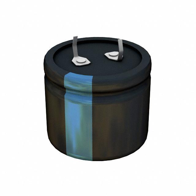

    CAP ALUM 180UF 20% 350V SNAP
381LX181M350K012 数据手册
Type 381LX / 383LX 105 °C High Ripple, Snap-In Aluminum High Ripple, Long Life, 2, 4 and 5 pin styles available Adding longer-life and more ripple capability to the excellent value of Type 380L/LX capacitors, the 381L/LX readily handles tough switching power supply input and output circuits and motor-drive bus capacitor applications where the high surface area of multiple units in parallel equals the ripple capability of our Type 520C inverter-grade capacitor. Type 381LX delivers more capacitance per can size while Type 381L gives lower ESR for the same capacitance rating. Type 383L/LX has 4 or 5 leads for stable, reverse-proof mounting. Highlights Specifications - Top performance in power supplies and motor drives - 4 times the life of Type 380L/LX - 2, 4 and 5 leads available - Big selection of 42 case sizes Temperature Range –40 °C to + 105 °C ≤ 250 Vdc –25 °C to + 105 °C ≥ 315 Vdc Rated Voltage Range 10 Vdc to 600 Vdc Capacitance Range 33 µF to 150,000 µF Capacitance Tolerance ± 20% Leakage Current ≤3 √CV µA, 4 mA max, 5 minutes Ripple Current Multipliers Ambient Temperature 45 ºC 60 ºC 70 ºC 85 ºC 105 ºC 381L, 383L 0-450 Vdc 2.70 2.60 2.50 2.10 1.00 381LX, 383LX 0-450Vdc 2.35 2.20 2.00 1.70 1.00 381LX, 383LX 500-600 Vdc 1.90 1.90 1.80 1.70 1.00 Frequency 50Hz 60Hz 120Hz 500Hz 1KHz 10KHz 10-100vdc 0.93 0.95 1.00 1.05 1.08 1.15 160-450Vdc 0.75 0.80 1.00 1.20 1.25 1.40 500-600Vdc 0.70 0.75 1.00 1.20 1.25 1.30 Low Temperature Characteristics Impedance ratio: Z–20⁰C ∕ Z+25⁰C @120Hz ≤ 10 (10 Vdc) ≤ 8 (16–50 Vdc) ≤ 4 (63–100 Vdc) ≤ 3 (150–450 Vdc) Endurance Life Test 3000 h at full load at 105 °C ∆ Capacitance ±20% ESR 200% of limit DCL 100% of limit Shelf Life Test 0 - 500 Vdc 1,000 h @ 105 °C ∆ Capacitance ±20% ESR 200% of limit DCL 100% of limit 501 - 600 Vdc 500 h @ 105 °C ∆ Capacitance ±20% ESR 200% of limit DCL 100% of limit Vibration 10 to 55 Hz, 0.06” and 10 g max, 2 h each plane Regulatory Information CDM Cornell Dubilier • 140 Technology Place • Liberty, SC 29657 • Phone: (864)843-2277 • Fax: (864)843-3800 Type 381LX / 383LX 105 °C High Ripple, Snap-In Aluminum High Ripple, Long Life, 2,4 and 5 pin styles available 383LX 272 M 200 Type Cap Tolerance N08 2 V Case 381L / LX (2 pins) 100 = 10 µF M = ±20% Voltage Code 200 = 200 Vdc 383L / LX (4 or 5 pins) 101 = 100 µF Insulation # of pins 2 = PVC Blank = 2 pins / 4 pins snap-in 6.3mm L or PET (PET 272 = 2700 µF after 12/19) Dimensions shown are in mm Outline Drawings Two Pins 381L/LX (22 through 40 mm diameter) A = 2 pins / 4 pins snap-in 4.0mm L VS = 5 pins snap-in 6.3mm L V = 5 pins standoff Sleeving is PVC or PET (PET for all date codes after December 2019) Available in 2, 4 and 5 pins L ± 2 max. 1.5 0.2 Top of Capacitor Body Four Pins 383L/LX (35 and 40 mm diameter) 2.0max. 6.3 1 4.0 +0.2 0.8 -0.1 6.3 mm pin length Available in 2 and 4 pins +0.2 0.8 -0.1 3.5 Top of Capacitor Body 4.0 2.0max. 1.5 0.2 4.0 mm pin length option (add “A” to end of part#) L ± 2 max. Five Pins 383L/LX (40 and 50 mm diameter) Available in 5 pins 0.7 Top of Capacitor Body 1.5 0.1 3.75 0.1 0.6 min. 5 pin Standoff pin style (add “V” to end of part#) L ± 2 max. Connection Terminal A B C D – 40 mm Dia. dummy dummy positive (+) dummy negative (–) 50 mm Dia. negative (–) dummy positive (+) positive (+) negative (–) Notes: * Use dummy terminals for mechanical support only. Make no electrical connection because they resistively connect through the electrolyte to the negative terminal. ** Safety Vent may be on the bottom or on the side of the can. CDM Cornell Dubilier • 140 Technology Place • Liberty, SC 29657 • Phone: (864)843-2277 • Fax: (864)843-3800 Type 381LX / 383LX 105 °C High Ripple, Snap-In Aluminum High Ripple, Long Life, 2,4 and 5 pin styles available Insulated Case Dimensions Typical Weight DIAMETER “D” Case Code LENGTH “L” Typical Weight mm inches mm inches (grams) mm inches mm inches (grams) H20 22 0.87 20 0.79 14 A04 35 1.38 40 1.57 62 H01 22 0.87 25 0.98 16 A45 35 1.38 45 1.77 67 H02 22 0.87 30 1.18 19 A05 35 1.38 50 1.97 74 H03 22 0.87 35 1.38 22 A55 35 1.38 55 2.17 80 H04 22 0.87 40 1.57 24 A06 35 1.38 63 2.48 88 H45 22 0.87 45 1.77 28 A07 35 1.38 70 2.76 98 H05 22 0.87 50 1.97 31 A08 35 1.38 80 3.15 112 J20 25 0.98 20 0.79 16 A10 35 1.38 105 4.13 144 J01 25 0.98 25 0.98 20 N04 40 1.57 40 1.57 82 J02 25 0.98 30 1.18 24 N05 40 1.57 50 1.97 105 J03 25 0.98 35 1.38 27 N06 40 1.57 63 2.48 130 J04 25 0.98 40 1.57 31 N08 40 1.57 80 3.15 185 J45 25 0.98 45 1.77 35 N10 40 1.57 105 4.13 265 J05 25 0.98 50 1.97 38 B05 50 1.97 50 1.97 136 K20 30 1.18 20 0.79 25 B06 50 1.97 63 2.48 168 K01 30 1.18 25 0.98 30 B08 50 1.97 80 3.15 239 K02 30 1.18 30 1.18 35 B09 50 1.97 92 3.62 241 K03 30 1.18 35 1.38 40 B10 50 1.97 105 4.13 325 K04 30 1.18 40 1.57 44 K45 30 1.18 45 1.77 48 K05 30 1.18 50 1.97 53 A20 35 1.38 20 0.79 35 A01 35 1.38 25 0.98 42 A02 35 1.38 30 1.18 48 A03 35 1.38 35 1.38 54 Life Test Data 220 µF/250V Capacitance, DF, Leakage Current 60 Typical Performance Curves Life Test Data 381LX221M250J012 Capacitance, DF, Leakage Current Δ Capacitance and DF (%) 160 40 140 DCL 30 120 100 20 Type 381L/LX Operating Life in Kilohours vs Ripple Current 1000 95 ºC 1 0.3 0.4 0.5 0.6 0.7 0.8 1000 1500 2000 Life Test Data 381LX680M450J022 Capacitance, DF, Leakage Current 50 105 ºC 0.2 500 Hours @ Rated Max Temp, Voltage, Ripple Life Test Data 68 µF/450V Capacitance, DF, Leakage Current 60 0.9 Rated Ripple-Current Multiple 1 1.1 1.2 1.3 1.4 1.5 Δ Capacitance and DF (%) Expected Operating Life, kh 0 85 ºC 0.1 20 0 75 ºC 0 40 C 0 65 ºC 10 60 -10 55 ºC 100 80 DF 10 45 ºC 200 180 50 DCL(µA) (uA) DCL LENGTH “L” 140 120 40 100 DCL 30 80 20 60 DF 10 40 C 0 20 -10 0 0 500 1000 1500 Hours @ Rated Max Temp, Voltage, Ripple CDM Cornell Dubilier • 140 Technology Place • Liberty, SC 29657 • Phone: (864)843-2277 • Fax: (864)843-3800 2000 DCL(µA) (µA) DCL DIAMETER “D” Case Code Type 381LX / 383LX 105 °C High Ripple, Snap-In Aluminum High Ripple, Long Life, 2,4 and 5 pin styles available Ratings Cap. (µF) Max. ESR @ +25°C Catalog Part Number Ripple Amps @ +105°C 120 Hz 20 kHz 120 Hz 20 kHz (ohms) (ohms) (A) (A) Nominal Size DxL (mm) Max. ESR @ +25°C Ripple Amps @ +105°C Nominal Size Cap. (µF) Catalog Part Number 383LX473M016N042 0.020 0.018 5.50 6.33 40 x 40 381LX563M016A452 0.020 0.018 6.00 6.90 35 x 45 120 Hz (ohms) 20 kHz 120 Hz 20 kHz (ohms) (A) (A) DxL (mm) 16 Vdc (20 Vdc Surge) 10 Vdc (13 Vdc Surge) 4700 381LX472M010H012 0.159 0.135 0.85 0.98 22 x 25 47000 6800 381LX682M010H012 0.111 0.093 1.30 1.50 22 x 25 56000 10000 381LX103M010H012 0.075 0.063 1.80 2.10 22 x 25 68000 381LX683M016A452 0.020 0.018 6.50 7.50 35 x 45 12000 381LX123M010H012 0.076 0.065 2.20 2.63 22 x 25 68000 383LX683M016N052 0.015 0.014 7.30 8.40 40 x 50 15000 381LX153M010H012 0.076 0.065 2.20 2.53 22 x 25 82000 383LX823M016N062 0.017 0.013 7.70 8.80 40 x 63 381LX104M016A082 0.015 0.013 8.00 9.20 35 x 80 381LX124M016A082 0.015 0.013 8.50 9.50 35 x 80 18000 381LX183M010H022 0.051 0.043 2.40 2.76 22 x 30 100000 22000 381LX223M010H032 0.041 0.035 2.60 2.99 22 x 35 120000 27000 381LX273M010J032 0.034 0.029 3.10 3.57 25 x 35 120000 383LX124M016N082 0.014 0.012 8.80 10.10 40 x 80 33000 381LX333M010J042 0.028 0.023 3.40 3.91 25 x 40 120000 383LX124M016B052V 0.015 0.014 9.02 10.37 50 x 50 39000 381LX393M010K032 0.026 0.023 3.70 4.26 30 x 35 150000 383LX154M016N102 0.013 0.012 9.88 11.36 40 x 105 383LX154M016B062V 0.014 0.013 10.15 11.67 50 x 63 50 x 80 39000 381LX393M010A022 0.025 0.020 3.70 4.30 35 x 30 150000 47000 381LX473M010K032 0.024 0.022 4.20 4.83 30 x 35 180000 383LX184M016B082V 0.013 0.012 11.02 12.67 56000 381LX563M010K042 0.023 0.021 5.00 5.75 30 x 40 220000 383LX224M016B092V 0.012 0.011 11.71 13.47 50 x 92 68000 381LX683M010K452 0.022 0.019 5.40 6.21 30 x 45 250000 383LX254M016B102V 0.011 0.010 12.31 14.16 50 x 105 68000 383LX683M010N042 0.023 0.022 5.40 6.20 40 x 40 381LX222M025H202 0.240 0.180 1.30 1.50 22 x 20 25 Vdc (32 Vdc Surge) 82000 383LX823M010N052 0.018 0.017 7.40 8.50 40 x 50 2200 120000 383L124M010N062 0.012 0.008 7.10 8.60 40 x 63 3300 381LX332M025H012 0.160 0.120 1.60 1.80 22 x 25 150000 383L154M010N082 0.009 0.006 8.90 10.60 40 x 80 4700 381LX472M025H012 0.105 0.080 2.00 2.30 22 x 25 5600 381LX562M025H012 0.090 0.070 2.20 2.50 22 x 25 22 x 25 6800 381LX682M025H022 0.085 0.064 2.40 2.76 22 x 30 381LX682M025J012 0.070 0.055 2.40 2.80 25 x 25 16 Vdc (20 Vdc Surge) 3300 381LX332M016H012 0.213 0.170 1.30 1.50 4700 381LX472M016H012 0.150 0.120 1.60 1.80 22 x 25 6800 6800 381LX682M016H012 0.090 0.067 2.20 2.50 22 x 25 8200 381LX822M025H022 0.071 0.053 2.70 3.11 22 x 30 6800 381LX682M016J202 0.110 0.092 1.80 2.10 25 x 20 10000 381LX103M025J022 0.058 0.044 3.00 3.45 25 x 30 8200 381LX822M016H012 0.110 0.092 1.80 2.10 22 x 25 12000 381LX123M025J022 0.048 0.036 3.20 3.68 25 x 30 10000 381LX103M016H012 0.075 0.063 2.60 2.99 22 x 25 12000 381LX123M025A012 0.044 0.033 3.20 3.70 35 x 25 381LX153M025J032 0.039 0.029 3.60 4.14 25 x 35 381LX103M016J012 0.120 0.086 2.60 3.00 25 x 25 15000 12000 381LX123M016H022 0.062 0.053 2.90 3.34 22 x 30 15000 381LX153M025J452 0.036 0.031 3.60 4.10 25 x 45 15000 381LX153M016J022 0.046 0.307 3.20 3.70 25 x 30 15000 381LX153M025A022 0.036 0.031 3.60 4.10 35 x 30 15000 381LX153M016J032 0.080 0.064 3.20 3.70 25 x 35 18000 381LX183M025J042 0.032 0.024 3.90 4.49 25 x 40 15000 381LX153M016K022 0.080 0.064 3.20 3.70 30 x 30 18000 381LX183M025J052 0.030 0.027 3.90 4.50 25 x 50 381LX223M025J452 0.026 0.020 4.30 4.95 25 x 45 10000 18000 381LX183M016H032 0.041 0.035 3.50 4.03 22 x 35 22000 22000 381LX223M016H042 0.034 0.029 3.80 4.37 22 x 40 22000 381LX223M025K452 0.025 0.022 4.30 4.90 30 x 45 22000 381LX223M016J452 0.033 0.028 3.80 4.40 25 x 45 22000 381LX223M025A032 0.030 0.026 4.30 4.90 35 x 35 27000 381LX273M016H052 0.028 0.023 4.20 4.83 22 x 50 27000 381LX273M025K042 0.021 0.019 4.80 5.50 30 x 40 27000 0.030 0.025 4.20 4.80 25 x 50 27000 383L273M025N042 0.020 0.013 4.60 5.60 40 x 40 381LX333M025K452 0.018 0.014 5.50 6.33 30 x 45 383LX333M025N042 0.018 0.016 5.50 6.33 40 x 40 381LX273M016J052 27000 381LX273M016K022 0.028 0.023 4.20 4.83 30 x 30 33000 33000 381LX333M016K032 0.023 0.020 4.70 5.41 30 x 35 33000 33000 381LX333M016K452 0.023 0.020 4.70 5.40 30 x 45 39000 383L393M025N052 0.015 0.010 5.80 7.00 40 x 50 39000 381LX393M016K042 0.022 0.020 5.10 5.87 30 x 40 47000 381LX473M025A052 0.017 0.015 6.50 4.25 35 x 50 47000 381LX473M016K452 0.021 0.019 5.50 6.33 30 x 45 47000 383LX473M025N052 0.015 0.014 6.50 7.40 40 x 50 35 x 45 47000 383L473M025N062 0.012 0.008 6.90 8.30 40 x 63 56000 383LX563M025N062 0.015 0.012 7.20 8.25 40 x 63 47000 381LX473M016A452 0.020 0.018 5.50 6.30 CDM Cornell Dubilier • 140 Technology Place • Liberty, SC 29657 • Phone: (864)843-2277 • Fax: (864)843-3800 Type 381LX / 383LX 105 °C High Ripple, Snap-In Aluminum High Ripple, Long Life, 2,4 and 5 pin styles available Cap. (µF) Catalog Part Number Max. ESR @ +25°C Ripple Amps @ +105°C 120 Hz 20 kHz 120 Hz 20 kHz (ohms) (ohms) (A) (A) Nominal Size DxL (mm) Cap. (µF) 383L683M025N082 0.009 0.007 Ripple Amps @ +105°C 120 Hz 20 kHz 120 Hz 20 kHz (ohms) (ohms) (A) (A) Nominal Size DxL (mm) 35 Vdc (44 Vdc Surge) 25 Vdc (32 Vdc Surge) 68000 Catalog Part Number Max. ESR @ +25°C 8.70 10.20 40 x 80 100000 383LX104M035B102V 0.013 0.010 11.75 13.51 50 x 105 50 Vdc (63 Vdc Surge) 82000 383LX823M025N082 0.014 0.011 8.70 10.00 40 x 80 82000 383LX823M025B052V 0.016 0.015 9.20 10.58 50 x 50 1000 381LX102M050H202 0.260 0.200 0.90 1.00 22 x 20 100000 383LX104M025N102 0.012 0.010 9.76 11.22 40 x 105 1500 381LX152M050H012 0.155 0.120 1.25 1.45 22 x 25 100000 383LX104M025B062V 0.015 0.013 10.02 11.52 50 x 63 1800 381LX182M050H012 0.129 0.097 1.50 1.70 22 x 25 120000 383LX124M025B082V 0.013 0.012 10.93 12.57 50 x 80 2200 381LX222M050H012 0.129 0.097 1.50 1.70 22 x 25 150000 383LX154M025B092V 0.012 0.011 11.70 13.46 50 x 92 2700 381LX272M050H012 0.154 0.115 1.80 2.07 22 x 25 180000 383LX184M025B102V 0.010 0.009 12.42 14.28 50 x 105 2700 381LX272M050J012* 0.086 0.064 1.80 2.10 25 x 25 3300 381LX332M050H012 0.126 0.094 2.00 2.30 22 x 25 35 Vdc (44 Vdc Surge) 1500 381LX152M035H012 0.287 0.216 1.10 1.30 22 x 25 3300 381LX332M050J022 0.070 0.053 2.00 2.30 25 x 30 2200 381LX222M035H012 0.200 0.150 1.40 1.60 22 x 25 3900 381LX392M050J012 0.106 0.080 2.20 2.53 25 x 25 3300 381LX332M035H012 0.121 0.091 1.90 2.20 22 x 25 3900 381LX392M050K012 0.065 0.050 2.20 2.50 30 x 25 3300 381LX332M035K202 0.130 0.100 1.70 2.00 30 x 20 4700 381LX472M050J022 0.053 0.040 2.50 2.90 25 x 30 3900 381LX392M035H012 0.110 0.080 2.00 2.30 22 x 25 4700 381LX472M050A012 0.053 0.040 2.50 2.90 35 x 25 4700 381LX472M035H022 0.090 0.070 2.20 2.50 22 x 30 5600 381LX562M050J032 0.074 0.056 2.80 3.22 25 x 35 4700 381LX472M035J012 0.090 0.070 2.20 2.50 25 x 25 5600 381LX562M050A022 0.050 0.038 2.80 3.20 35 x 30 5600 381LX562M035H032 0.071 0.054 2.40 2.80 22 x 35 6800 381LX682M050H452 0.061 0.046 3.30 3.80 22 x 45 5600 381LX562M035J012 0.041 0.054 2.40 2.80 25 x 25 6800 381LX682M050A022 0.046 0.035 3.30 3.80 35 x 30 6800 381LX682M035J022 0.073 0.055 2.60 2.99 25 x 30 8200 381LX822M050K452 0.051 0.038 3.60 4.10 30 x 45 6800 381LX682M035K022 0.059 0.045 2.60 3.00 30 x 30 8200 381LX822M050A032 0.040 0.030 3.60 4.10 35 x 35 8200 381LX822M035J022 0.049 0.037 2.90 3.30 25 x 30 10000 381LX103M050J052 0.041 0.031 4.00 4.60 25 x 50 8200 381LX822M035A012 0.049 0.037 2.90 3.30 35 x 25 10000 381LX103M050K052 0.033 0.025 4.00 4.60 30 x 50 10000 381LX103M035J032 0.050 0.037 3.20 3.68 25 x 35 10000 381LX103M050A042 0.033 0.025 4.00 4.60 35 x 40 10000 381LX103M035J452 0.040 0.030 3.20 3.70 25 x 45 12000 381LX123M050A452 0.028 0.021 4.50 5.20 35 x 45 10000 381LX103M035A022 0.040 0.030 3.20 3.70 35 x 30 12000 383L123M050N042 0.029 0.018 3.80 4.80 40 x 40 12000 381LX123M035J042 0.041 0.031 3.50 4.03 25 x 40 15000 381LX153M050K452 0.028 0.022 4.80 5.52 30 x 45 12000 381LX123M035J052 0.033 0.025 3.50 4.00 25 x 50 15000 383LX153M050N042 0.022 0.018 4.80 5.52 40 x 40 12000 381LX123M035A022 0.033 0.025 3.50 4.00 35 x 30 15000 383L153M050N052 0.021 0.013 4.90 6.10 40 x 50 15000 381LX153M035K042 0.033 0.025 3.90 4.49 30 x 40 18000 381LX183M050A452 0.023 0.018 5.60 6.44 35 x 45 15000 381LX153M035K452 0.030 0.020 3.90 4.50 30 x 45 18000 383L183M050N062 0.017 0.011 5.80 7.20 40 x 63 15000 381LX153M035A032 0.030 0.020 3.90 4.50 35 x 35 22000 383LX223M050N052 0.016 0.013 5.10 5.90 40 x 50 18000 381LX183M035K452 0.028 0.021 4.30 4.95 30 x 45 27000 383LX273M050N062 0.015 0.012 6.05 6.96 40 x 63 22000 381LX223M035A052 0.023 0.017 5.00 5.80 35 x 50 27000 383L273M050N082 0.013 0.009 7.40 9.00 40 x 80 22000 383LX223M035N042 0.023 0.017 5.00 5.75 40 x 40 33000 383LX333M050B052V 0.018 0.014 7.75 8.91 50 x 50 27000 381LX273M035A052 0.018 0.014 5.30 6.10 35 x 50 39000 383LX393M050N082 0.013 0.010 6.20 7.10 40 x 80 27000 383LX273M035N052 0.020 0.015 5.45 6.25 40 x 50 39000 383LX393M050B062V 0.016 0.013 8.40 9.66 50 x 63 33000 383L333M035N062 0.019 0.014 6.60 7.60 40 x 63 47000 383LX473M050N102 0.012 0.010 8.18 9.41 40 x 105 39000 381LX393M035A052 0.017 0.014 6.50 7.50 35 x 50 47000 383LX473M050B082V 0.014 0.011 9.19 10.57 50 x 80 47000 383L473M035N082 0.018 0.013 7.80 9.00 40 x 80 56000 383LX563M050B092V 0.012 0.009 9.79 11.26 50 x 92 47000 383LX473M035B052V 0.021 0.016 8.25 9.49 50 x 50 68000 383LX683M050B102V 0.011 0.009 10.40 12.00 50 x 105 56000 383LX563M035B062V 0.019 0.014 9.07 10.43 50 x 63 68000 383LX683M035N102 0.016 0.012 9.27 10.66 40 x 105 68000 383LX683M035B082V 0.017 0.013 10.07 11.58 50 x 80 82000 383LX823M035B092V 0.015 0.011 10.89 12.52 50 x 92 *Denotes Discontinued Part CDM Cornell Dubilier • 140 Technology Place • Liberty, SC 29657 • Phone: (864)843-2277 • Fax: (864)843-3800 Type 381LX / 383LX 105 °C High Ripple, Snap-In Aluminum High Ripple, Long Life, 2,4 and 5 pin styles available Max. ESR Cap. (µF) @ +25°C Catalog Part Number Ripple Amps @ +105°C Nominal Max. ESR Ripple Amps Nominal Size @ +25°C @ +105°C Size 120 Hz 20 kHz DxL 120 Hz 20 kHz 120 Hz 20 kHz DxL (ohms) (ohms) (mm) (A) (A) Cap. (µF) 381LX681M063H012 0.410 0.310 120 Hz 20 kHz (ohms) (ohms) (A) (A) (mm) 80 Vdc (100 Vdc Surge) 63 Vdc (79 Vdc Surge) 680 Catalog Part Number 0.90 1.00 22 x 25 470 381LX471M080H012 0.390 0.270 0.80 0.90 22 x 25 680 381LX681M080H012 0.270 0.190 1.00 1.15 22 x 25 820 381LX821M080H012 0.222 0.145 1.20 1.40 22 x 25 1000 381LX102M063H012 0.280 0.210 1.18 1.35 22 x 25 1200 381LX122M063H012 0.235 0.180 1.40 1.60 22 x 25 1000 381LX102M080H012 0.222 0.145 1.20 1.40 22 x 25 381LX102M080J012* 0.182 0.120 1.30 1.50 25 x 25 1500 381LX152M063H012 0.235 0.180 1.50 1.70 22 x 25 1000 1800 381LX182M063H022 0.157 0.117 1.70 1.96 22 x 30 1200 381LX122M080H022 0.235 0.176 1.50 1.73 22 x 30 381LX152M080H032 0.188 0.141 1.70 1.96 22 x 35 381LX182M080J032* 0.147 0.080 1.80 2.10 25 x 35 1800 381LX182M063J012 0.123 0.092 2.20 2.53 25 x 25 1500 2200 381LX222M063H022 0.143 0.110 1.50 1.70 22 x 30 1800 2700 381LX272M063H042 0.123 0.092 2.20 2.53 22 x 40 1800 381LX182M080K012 0.111 0.080 1.80 2.10 30 x 25 381LX222M080H452 0.121 0.092 2.10 2.40 22 x 45 2700 381LX272M063K012 0.105 0.080 2.20 2.50 30 x 25 2200 3300 381LX332M063J022 0.090 0.070 2.50 2.90 25 x 30 2200 381LX222M080A012 0.090 0.063 2.10 2.40 35 x 25 381LX272M080J042 0.104 0.078 2.40 2.76 25 x 40 381LX332M080J052 0.065 0.049 2.60 3.00 25 x 50 3300 381LX332M063A012 0.090 0.070 2.50 2.90 35 x 25 2700 3900 381LX392M063J022 0.085 0.064 2.70 3.11 25 x 30 3300 3900 381LX392M063J452 0.080 0.060 2.70 3.10 25 x 45 3300 381LX332M080K042 0.100 0.075 2.60 3.00 30 x 40 381LX332M080A022 0.065 0.049 2.60 3.00 35 x 30 4700 381LX472M063K042 0.063 0.048 3.00 3.50 30 x 40 3300 5600 381LX562M063K042 0.059 0.044 3.30 3.80 30 x 40 3900 381LX392M080K042 0.072 0.054 3.00 3.45 30 x 40 381LX472M080K042 0.060 0.045 3.30 3.80 30 x 40 5600 381LX562M063K452 0.055 0.040 3.30 3.80 30 x 45 4700 5600 381LX562M063A032 0.055 0.040 3.30 3.80 35 x 35 4700 381LX472M080K052 0.048 0.036 3.30 3.80 30 x 50 6800 381LX682M063J052 0.050 0.040 3.60 4.10 25 x 50 4700 381LX472M080A042 0.048 0.036 3.30 3.80 35 x 40 381LX562M080A052 0.072 0.054 3.00 3.45 35 x 50 6800 381LX682M063K042 0.049 0.037 3.60 4.14 30 x 40 5600 6800 381LX682M063K052 0.050 0.040 3.60 4.10 30 x 50 5600 383L562M080N042 0.035 0.022 3.50 4.40 40 x 40 381LX682M080A052 0.041 0.031 3.90 4.50 35 x 50 8200 381LX822M063J052 0.040 0.030 3.90 4.50 25 x 50 6800 8200 381LX822M063A452 0.040 0.030 3.90 4.50 35 x 45 6800 383LX682M080N042 0.041 0.031 3.90 4.49 40 x 40 8200 383L822M063N042 0.031 0.018 3.70 4.80 40 x 40 8200 383L822M080N052 0.025 0.016 4.40 5.60 40 x 50 383L103M080N062 0.021 0.013 5.30 6.70 40 x 63 10000 381LX103M063K452 0.033 0.028 4.40 5.10 30 x 45 10000 10000 381LX103M063K052 0.033 0.028 4.40 5.10 30 x 50 12000 383LX123M080B052V 0.035 0.026 6.03 6.93 50 x 50 383L153M080N082 0.015 0.010 6.80 8.40 40 x 80 50 x 63 12000 381LX123M063K052 0.030 0.025 4.40 5.06 30 x 50 15000 12000 383LX123M063N042 0.030 0.028 4.52 5.20 40 x 40 15000 383LX153M080B062V 0.028 0.021 6.65 7.65 12000 383L123M063N052 0.022 0.013 4.70 6.10 40 x 50 18000 383LX183M080B082V 0.026 0.019 7.29 8.38 50 x 80 383LX223M080N102 0.019 0.014 6.95 7.99 40 x 105 15000 381LX153M063A052 0.024 0.023 4.90 5.70 35 x 50 22000 15000 383LX153M063N052 0.027 0.023 4.80 5.50 40 x 50 22000 383LX223M080B092V 0.022 0.016 7.83 9.00 50 x 92 27000 383LX273M080B102V 0.018 0.014 8.38 9.64 50 x 105 15000 383L153M063N062 0.018 0.011 5.70 7.20 40 x 63 18000 381LX183M063A082 0.022 0.019 5.80 6.70 35 x 80 18000 383LX183M063N062 0.023 0.020 5.40 6.20 40 x 63 330 381LX331M100H012 0.653 0.392 0.80 1.20 22 x 25 381LX471M100H012 0.390 0.230 0.92 1.40 22 x 25 22000 22000 100 Vdc (125 Vdc Surge) 0.013 0.009 7.20 9.00 40 x 80 470 383LX223M063B052V 0.019 0.016 6.76 7.77 50 x 50 560 381LX561M100H012 0.300 0.180 1.10 1.30 22 x 25 381LX681M100H012 0.300 0.180 1.10 1.30 22 x 25 381LX821M100H012 0.303 0.197 1.40 1.60 22 x 25 383L223M063N082 27000 383LX273M063N082 0.017 0.014 6.60 7.60 40 x 80 680 27000 383LX273M063B062V 0.017 0.014 7.34 8.44 50 x 63 820 33000 383LX333M063B082V 0.015 0.013 8.00 9.20 50 x 80 820 381LX821M100J012 0.202 0.120 1.40 2.10 25 x 25 381LX102M100H022 0.182 0.110 1.70 2.55 22 x 30 39000 383LX393M063N102 0.014 0.012 7.53 8.66 40 x 105 1000 39000 383LX393M063B092V 0.014 0.012 8.48 9.75 50 x 92 1200 381LX122M100H022 0.195 0.125 1.85 2.70 22 x 30 50 x 105 1200 381LX122M100H032* 0.195 0.125 1.85 2.70 22 x 35 47000 383LX473M063B102V 0.012 0.010 8.99 10.34 *Denotes Discontinued Part CDM Cornell Dubilier • 140 Technology Place • Liberty, SC 29657 • Phone: (864)843-2277 • Fax: (864)843-3800 Type 381LX / 383LX 105 °C High Ripple, Snap-In Aluminum High Ripple, Long Life, 2,4 and 5 pin styles available Cap. (µF) Catalog Part Number Max. ESR Ripple Amps Nominal @ +25°C @ +105°C Size 120 Hz 20 kHz 120 Hz 20 kHz DxL (ohms) (ohms) (mm) (A) (A) Cap. (µF) Catalog Part Number Max. ESR Ripple Amps @ +25°C @ +105°C Nominal Size 120 Hz 20 kHz 120 Hz 20 kHz DxL (ohms) (ohms) (A) (A) (mm) 180 Vdc (225 Vdc Surge) 100 Vdc (125 Vdc Surge) 1500 381LX152M100H042 0.155 0.100 2.30 2.80 22 x 40 560 381LX561M180H042 0.355 0.181 1.50 2.10 22 x 40 1500 381LX152M100K012 0.155 0.100 2.30 2.80 30 x 25 680 381LX681M180J032 0.293 0.149 1.70 2.38 25 x 35 381LX821M180K022 0.243 0.124 2.00 2.80 30 x 30 1500 381LX152M100A012 0.155 0.100 2.30 2.80 35 x 40 820 1800 381LX182M100J042 0.138 0.090 2.30 2.65 25 x 40 1000 381LX102M180J052 0.216 0.097 2.20 3.08 25 x 50 2200 381LX222M100J042 0.121 0.080 2.60 2.99 25 x 40 1200 381LX122M180K452 0.166 0.085 2.30 3.20 30 x 45 381LX152M180K052 0.133 0.068 2.50 3.50 30 x 50 2200 381LX222M100J452 0.090 0.060 2.60 3.90 25 x 45 1500 2700 381LX272M100A022 0.092 0.060 2.90 3.34 35 x 30 1800 381LX182M180A452 0.111 0.050 2.70 3.80 35 x 45 383L182M180N052 0.059 0.033 3.10 4.20 40 x 50 3300 381LX332M100K052 0.075 0.053 3.20 4.80 30 x 50 1800 3300 381LX332M100A042 0.075 0.053 3.20 4.80 35 x 40 2200 381LX222M180A052 0.090 0.046 2.90 4.10 35 x 50 3900 381LX392M100K052 0.064 0.043 3.60 4.14 30 x 50 2200 383L222M180N062 0.048 0.027 3.70 4.90 40 x 63 3300 383L332M180N082 0.035 0.020 4.80 6.30 40 x 80 381LX101M200H012 1.660 0.750 0.50 0.70 22 x 25 4700 381LX472M100A052 0.053 0.040 3.80 5.70 35 x 50 4700 383LX472M100N042 0.053 0.040 3.80 5.70 40 x 40 200 Vdc (250 Vdc Surge) 5600 381LX562M100A052 0.044 0.033 4.10 4.70 35 x 50 100 5600 383L562M100N062 0.027 0.012 4.60 6.50 40 x 63 150 381LX151M200H012 1.100 0.500 0.70 0.95 22 x 25 6800 383LX682M100N052 0.037 0.027 4.60 5.30 40 x 50 220 381LX221M200H012 0.754 0.339 1.00 1.40 22 x 25 381LX271M200H012 0.730 0.300 1.10 1.50 22 x 25 8200 383LX822M100N062 0.030 0.023 5.00 5.77 40 x 63 270 8200 383L822M100N082 0.020 0.009 6.00 8.20 40 x 80 270 381LX271M200J012 0.614 0.276 1.10 1.50 25 x 25 381LX331M200H022 0.603 0.308 1.25 1.79 22 x 30 8200 383LX822M100B052V 0.030 0.023 6.14 7.06 50 x 50 330 10000 381LX103M100A082 0.033 0.025 6.38 7.34 35 x 80 330 381LX331M200J012 0.603 0.308 1.20 1.70 25 x 25 12000 383LX123M100N082 0.021 0.016 6.44 7.40 40 x 80 390 381LX391M200H022 0.510 0.230 1.30 1.80 22 x 30 381LX471M200J022 0.423 0.190 1.40 2.00 25 x 30 12000 383LX123M100B062V 0.022 0.017 7.17 8.25 50 x 63 470 15000 383LX153M100N102 0.017 0.012 7.37 8.48 40 x 105 470 381LX471M200K012 0.353 0.159 1.40 2.00 30 x 25 381LX561M200H042 0.355 0.160 1.50 2.10 22 x 40 381LX561M200J022 0.355 0.160 1.50 2.10 25 x 30 15000 383LX153M100B082V 0.019 0.014 8.01 9.21 50 x 80 560 18000 383LX183M100B092V 0.017 0.012 8.64 9.94 50 x 92 560 22000 383LX223M100B102V 0.015 0.011 9.32 10.72 50 x 105 680 381LX681M200J042 0.293 0.132 1.70 2.40 25 x 40 680 381LX681M200K022 0.244 0.110 1.70 2.40 30 x 30 22 x 30 820 381LX821M200H452 0.263 0.118 2.00 2.80 22 x 45 381LX821M200J042 0.243 0.109 2.04 2.92 25 x 40 381LX821M200K022 0.263 0.118 2.00 2.80 30 x 30 160 Vdc (200 Vdc Surge) 470 381LX471M160H022 0.423 0.190 1.40 2.00 560 381LX561M160H032 0.355 0.160 1.50 2.10 22 x 35 820 680 381LX681M160H042 0.293 0.132 1.70 2.40 22 x 40 820 820 381LX821M160J042 0.243 0.109 2.00 2.80 25 x 40 1000 381LX102M200J052 0.216 0.108 2.20 3.10 25 x 50 381LX102M200K032 0.216 0.108 2.20 3.10 30 x 35 1000 381LX102M160J042 0.216 0.108 2.20 3.08 25 x 40 1000 1200 381LX122M160K032 0.180 0.090 2.30 3.20 30 x 35 1000 381LX102M200K452 0.216 0.108 2.20 3.10 30 x 45 381LX102M200A022 0.216 0.108 2.20 3.10 35 x 30 381LX122M200K042 0.193 0.097 2.30 3.20 30 x 40 1500 381LX152M160K452 0.155 0.077 2.50 3.50 30 x 45 1000 1800 381LX182M160K452 0.111 0.055 2.70 3.78 30 x 45 1200 2200 381LX222M160K052 0.098 0.049 2.90 4.06 30 x 50 1200 381LX122M200K052 0.193 0.097 2.30 3.20 30 x 50 381LX122M200A032 0.193 0.097 2.30 3.20 35 x 35 2200 383LX222M160N042 0.100 0.060 2.90 4.10 40 x 40 1200 2700 383L272M160N062 0.045 0.027 3.80 5.00 40 x 63 1500 381LX152M200K052 0.155 0.077 2.50 3.50 30 x 50 40 x 40 1500 381LX152M200A042 0.155 0.077 2.50 3.50 35 x 40 1800 381LX182M200A452 0.129 0.077 2.70 3.80 35 x 45 22 x 25 1800 383LX182M200N042 0.129 0.077 2.70 3.78 40 x 40 383L182M200N052 0.063 0.033 3.00 4.10 40 x 50 381LX222M200A052 0.105 0.063 2.90 4.00 35 x 50 3300 383LX332M160N052 0.070 0.040 3.40 4.70 180 Vdc (225 Vdc Surge) 270 381LX271M180H012 0.737 0.376 1.10 1.50 330 381LX331M180H022 0.603 0.308 1.20 1.70 22 x 30 1800 390 381LX391M180J012 0.510 0.260 1.30 1.80 25 x 25 2200 470 381LX471M180H032 0.423 0.216 1.40 2.00 22 x 35 CDM Cornell Dubilier • 140 Technology Place • Liberty, SC 29657 • Phone: (864)843-2277 • Fax: (864)843-3800 Type 381LX / 383LX 105 °C High Ripple, Snap-In Aluminum High Ripple, Long Life, 2,4 and 5 pin styles available Cap. (µF) Catalog Part Number Max. ESR Ripple Amps @ +25°C @ +105°C Nominal Size 120 Hz 20 kHz 120 Hz 20 kHz DxL (ohms) (ohms) (A) (A) (mm) Cap. (µF) 200 Vdc (250 Vdc Surge) Catalog Part Number Max. ESR Ripple Amps @ +25°C @ +105°C Nominal Size 120 Hz 20 kHz 120 Hz 20 kHz DxL (ohms) (ohms) (A) (A) (mm) 250 Vdc (300 Vdc Surge) 2200 383L222M200N062 0.051 0.027 3.60 4.90 40 x 63 1800 383L182M250N062 0.066 0.025 3.10 5.10 40 x 63 2700 383LX272M200N052 0.086 0.052 3.55 4.97 40 x 50 2700 383L272M200N082 0.032 0.018 4.60 6.20 40 x 80 2200 381LX222M250A082 0.096 0.064 3.75 5.25 35 x 80 2200 383LX222M250N062 0.098 0.064 3.70 5.15 40 x 63 3300 381LX332M200A082 0.065 0.039 4.50 6.33 35 x 80 2200 383L222M250N082 0.043 0.017 4.00 6.40 40 x 80 3300 383LX332M200N062 0.700 0.040 4.40 3300 383LX332M200B052V 0.075 0.045 5.20 6.20 40 x 63 2200 383LX222M250B052V 0.098 0.064 4.35 6.09 50 x 50 7.28 50 x 50 2700 383LX272M250N082 0.092 0.047 3.10 4.30 40 x 80 3900 383LX392M200B062V 0.064 0.038 4700 383LX472M200N082 0.050 0.030 5.90 8.26 50 x 63 2700 383LX272M250B062V 0.080 0.052 4.98 6.97 50 x 63 5.75 8.10 40 x 80 3300 383LX332M250N082 0.065 0.042 4.86 6.80 40 x 80 4700 383LX472M200B082V 0.053 0.032 6.82 9.55 50 x 80 3900 383LX392M250N102 0.055 0.036 5.61 7.85 40 x 105 5600 383LX562M200N102 5600 383LX562M200B092V 0.041 0.025 6.76 9.46 40 x 105 3900 383LX392M250B082V 0.055 0.036 6.10 8.54 50 x 80 0.044 0.027 7.68 10.75 50 x 92 4300 383LX432M250B092V 0.050 0.033 6.67 9.34 50 x 92 6800 383LX682M200B102V 0.034 0.020 8.71 12.19 50 x 105 4700 383LX472M250B102V 0.046 0.030 7.03 9.84 50 x 105 250 Vdc (300 Vdc Surge) 315 Vdc (365 Vdc Surge) 68 381LX680M250H202 2.926 1.493 0.40 0.60 22 x 20 82 381LX820M315H012 2.430 1.240 0.60 0.90 22 x 25 68 381LX680M250H012 2.440 1.220 0.40 0.60 22 x 25 100 381LX101M315H012 1.990 1.020 0.70 1.00 22 x 25 100 381LX101M250H012 1.660 0.830 0.55 0.78 22 x 25 120 381LX121M315H012 1.660 0.850 0.80 1.10 22 x 25 150 381LX151M250H012 1.327 0.465 0.79 0.11 22 x 25 150 381LX151M315H022 1.330 0.600 0.82 1.15 22 x 30 180 381LX181M250H012 1.106 0.553 0.88 1.23 22 x 25 180 381LX181M315H022 1.110 0.550 0.90 1.25 22 x 30 220 381LX221M250H012 0.905 0.452 1.00 1.40 22 x 25 220 381LX221M315H032 0.900 0.410 0.98 1.37 22 x 35 270 381LX271M250H022 0.737 0.332 1.18 1.69 22 x 30 220 381LX221M315K022 0.904 0.461 1.00 1.40 30 x 30 330 381LX331M250H022 0.502 0.251 1.20 1.70 22 x 30 270 381LX271M315J032 0.740 0.330 1.10 1.54 25 x 35 270 381LX271M315K022 0.737 0.376 1.10 1.50 30 x 30 330 381LX331M250J022 0.502 0.251 1.20 1.70 25 x 30 270 381LX271M315K032 0.737 0.376 1.10 1.50 30 x 35 390 381LX391M250J032 0.510 0.229 1.49 2.12 25 x 35 270 381LX271M315A022 0.737 0.376 1.10 1.50 35 x 30 470 381LX471M250J032 0.423 0.191 1.40 1.96 25 x 35 330 381LX331M315J042 0.600 0.270 1.20 1.68 25 x 40 470 381LX471M250K022 0.353 0.176 1.40 2.00 30 x 30 330 381LX331M315K032 0.603 0.308 1.20 1.70 30 x 35 560 381LX561M250J032 0.355 0.160 1.80 2.57 25 x 35 330 381LX331M315K042 0.603 0.308 1.20 1.70 30 x 40 560 381LX561M250K032 0.296 0.148 1.50 2.10 30 x 35 330 381LX331M315A022 0.603 0.308 1.20 1.70 35 x 30 560 381LX561M250A012 0.296 0.148 1.50 2.10 35 x 25 390 381LX391M315K452 0.510 0.260 1.30 1.80 30 x 45 680 381LX681M250J052 0.244 0.134 1.70 2.38 25 x 50 390 381LX391M315A032 0.510 0.260 1.30 1.80 35 x 35 680 381LX681M250K042 0.244 0.134 1.70 2.38 30 x 40 470 381LX471M315K452 0.423 0.216 1.40 2.00 30 x 45 680 381LX681M250A022 0.244 0.134 1.70 2.38 35 x 30 470 381LX471M315K052 0.423 0.216 1.40 2.00 30 x 50 820 381LX821M250K452 0.202 0.111 2.00 2.80 30 x 45 470 381LX471M315A032 0.423 0.216 1.40 2.00 35 x 35 820 381LX821M250A032 0.202 0.111 2.00 2.80 35 x 35 470 381LX471M315A042 0.423 0.216 1.40 2.00 35 x 40 1000 381LX102M250K052 0.199 0.109 2.20 3.10 30 x 50 560 381LX561M315K052 0.355 0.181 1.50 2.10 30 x 50 1000 381LX102M250A042 0.199 0.109 2.20 3.10 35 x 40 560 381LX561M315A042 0.355 0.181 1.50 2.10 35 x 40 1000 381LX102M250A452 0.166 0.099 2.30 3.20 35 x 45 560 381LX561M315A452 0.355 0.181 1.50 2.10 35 x 45 1200 381LX122M250A452 0.166 0.099 2.30 3.20 35 x 45 680 381LX681M315A452 0.293 0.149 1.70 2.40 35 x 45 1200 383LX122M250N042 0.180 0.117 2.66 3.72 40 x 40 680 381LX681M315A052 0.293 0.149 1.70 2.40 35 x 50 1200 383L122M250N052 0.081 0.031 2.60 4.30 40 x 50 820 381LX821M315A052 0.242 0.030 2.00 2.80 35 x 50 1500 381LX152M250A052 0.144 0.093 2.50 3.50 35 x 50 820 383L821M315N052 0.190 0.130 1.70 2.10 40 x 50 1800 383LX182M250N052 0.120 0.078 3.25 4.55 40 x 50 1200 383L122M315N062 0.150 0.110 2.10 2.50 40 x 63 1500 383L152M315N082 0.110 0.055 2.70 3.20 40 x 80 CDM Cornell Dubilier • 140 Technology Place • Liberty, SC 29657 • Phone: (864)843-2277 • Fax: (864)843-3800 Type 381LX / 383LX 105 °C High Ripple, Snap-In Aluminum High Ripple, Long Life, 2,4 and 5 pin styles available Cap. (µF) Catalog Part Number Max. ESR Ripple Amps Nominal @ +25°C @ +105°C Size 120 Hz 20 kHz 120 Hz 20 kHz DxL (ohms) (ohms) (mm) (A) (A) Max. ESR Cap. (µF) Catalog Part Number @ +25°C Ripple Amps Nominal @ +105°C Size 120 Hz 20 kHz 120 Hz 20 kHz DxL (ohms) (ohms) (A) (A) (mm) 400 Vdc (450 Vdc Surge) 350 Vdc (400 Vdc Surge) 82 381LX820M350H012 2.430 1.240 0.60 0.90 22 x 25 150 381LX151M400H022 0.921 0.322 0.90 1.30 22 x 30 100 381LX101M350H022 1.990 1.020 0.70 1.00 22 x 30 150 381LX151M400H032 1.330 0.460 0.80 1.10 22 x 35 381LX151M400J012 1.110 0.870 0.80 1.10 25 x 25 120 381LX121M350H022 1.660 0.750 0.75 1.05 22 x 30 150 150 381LX151M350H022 1.330 0.600 0.77 1.08 22 x 30 180 381LX181M400J022 0.921 0.322 0.90 1.30 25 x 30 381LX181M400J032 1.110 0.500 0.95 1.33 25 x 35 180 381LX181M350H032 1.110 0.500 0.87 1.22 22 x 35 180 220 381LX221M350H042 0.900 0.410 1.00 1.40 22 x 40 180 381LX181M400K022 0.921 0.322 0.90 1.30 30 x 30 270 381LX271M350H452 0.740 0.380 1.10 1.50 22 x 45 220 381LX221M400H452 0.614 0.215 1.20 1.70 22 x 45 381LX221M400K022 0.754 0.264 1.10 1.50 30 x 30 270 381LX271M350K022 0.737 0.376 1.10 1.50 30 x 30 220 330 381LX331M350K042 0.603 0.308 1.20 1.70 30 x 40 220 381LX221M400A012 0.754 0.264 1.10 1.50 35 x 25 381LX271M400J052 0.614 0.215 1.20 1.70 25 x 50 330 381LX331M350A022 0.603 0.308 1.20 1.70 35 x 30 270 390 381LX391M350K452 0.510 0.260 1.30 1.80 30 x 45 270 381LX271M400K032 0.614 0.215 1.20 1.70 30 x 35 390 381LX391M350A022 0.510 0.260 1.30 1.80 35 x 30 270 381LX271M400A022 0.614 0.215 1.20 1.70 35 x 30 381LX331M400K452 0.502 0.201 1.40 1.90 30 x 45 470 381LX471M350K052 0.423 0.216 1.40 2.00 30 x 50 330 470 381LX471M350A042 0.423 0.216 1.40 2.00 35 x 40 330 381LX331M400A032 0.502 0.201 1.40 1.90 35 x 35 381LX391M400J452 0.425 0.170 1.55 2.20 25 x 45 560 381LX561M350A452 0.355 0.181 1.50 2.10 35 x 45 390 560 383L561M350N042 0.299 0.205 1.30 1.50 40 x 40 390 381LX391M400K052 0.425 0.170 1.55 2.20 30 x 50 680 381LX681M350A052 0.293 0.149 1.70 2.40 35 x 50 390 381LX391M400A042 0.425 0.170 1.55 2.20 35 x 40 381LX471M400A452 0.353 0.141 1.80 2.50 35 x 45 680 383LX681M350N042 0.317 0.127 2.30 3.22 40 x 40 470 820 381LX821M350A062 0.303 0.155 2.70 3.70 35 x 63 470 383LX471M400N042 0.353 0.141 1.80 2.50 40 x 40 381LX561M400A052 0.296 0.118 1.80 2.50 35 x 50 383LX681M400N052 0.244 0.098 2.20 3.00 40 x 50 820 383LX821M350N052 0.303 0.155 2.70 3.70 40 x 50 560 1000 383L102M350N062 0.170 0.117 2.00 2.40 40 x 63 680 1000 383LX102M350B052V 0.216 0.066 3.56 4.96 50 x 50 820 381LX821M400A062 0.202 0.081 2.44 3.42 35 x 63 383LX821M400B052V 0.202 0.081 3.20 4.40 50 x 50 1200 381LX122M350A082 0.207 0.106 3.20 4.50 35 x 80 820 1200 383LX122M350N062 0.207 0.106 3.20 4.50 40 x 63 1000 381LX102M400A082 0.202 0.081 3.00 4.20 35 x 80 383LX102M400N062 0.202 0.081 3.00 4.20 40 x 63 381LX122M400A102 0.138 0.055 3.80 5.30 35 x 105 1500 381LX152M350A102 0.144 0.057 4.78 6.69 35 x 105 1000 1500 383LX152M350N082 0.166 0.085 3.80 5.25 40 x 80 1200 1500 383LX152M350B062V 0.144 0.057 4.16 5.82 50 x 63 1200 383LX122M400N082 0.138 0.055 3.80 5.30 40 x 80 383LX122M400B062V 0.152 0.061 4.20 5.90 50 x 63 1800 383LX182M350N102 0.120 0.048 5.23 7.32 40 x 105 1200 1800 383LX182M350B082V 0.120 0.048 5.69 7.97 50 x 80 1500 383LX152M400N102 0.111 0.044 4.80 6.70 40 x 105 383LX152M400B082V 0.122 0.049 5.20 7.30 50 x 80 2000 383LX202M350B092V 0.108 0.043 6.34 8.88 50 x 92 1500 2200 383LX222M350B102V 0.098 0.039 6.60 9.30 50 x 105 1600 383LX162M400B092V 0.114 0.046 5.60 8.00 50 x 92 1800 383LX182M400B102V 0.101 0.041 6.48 9.10 50 x 105 400 Vdc (450 Vdc Surge) 420 Vdc (470 Vdc Surge) 33 381LX330M400H202 5.020 1.760 0.20 0.30 22 x 20 47 381LX470M400H012 4.500 1.600 0.30 0.42 22 x 25 100 381LX101M420H022 1.820 0.820 0.65 0.90 22 x 30 381LX121M420H022 1.660 0.750 0.70 1.00 22 x 30 56 381LX560M400H012 3.530 1.240 0.47 0.66 22 x 25 120 68 381LX680M400H012 2.927 1.020 0.45 0.60 22 x 25 150 381LX151M420H042 1.330 0.600 0.79 1.11 22 x 40 68 381LX680M400J012 1.950 0.683 0.60 0.80 25 x 25 180 381LX181M420H042 1.110 0.500 0.87 1.22 22 x 40 381LX181M420K022 1.000 0.450 0.88 1.20 30 x 30 82 381LX820M400H012* 2.440 0.850 0.55 0.80 22 x 25 180 100 381LX101M400H022 1.658 0.580 0.50 0.70 22 x 30 220 381LX221M420H452 0.900 0.410 1.05 1.50 22 x 45 381LX221M420K022 0.750 0.260 1.10 1.50 30 x 30 100 381LX101M400J012 1.658 0.580 0.70 1.00 25 x 25 220 120 381LX121M400J012 1.100 0.387 0.80 1.10 25 x 25 270 381LX271M420J452 0.740 0.330 1.19 1.67 25 x 45 120 381LX121M400J022* 1.100 0.387 0.80 1.10 25 x 30 270 381LX271M420K032 0.610 0.210 1.20 1.70 30 x 35 *Denotes Discontinued Part CDM Cornell Dubilier • 140 Technology Place • Liberty, SC 29657 • Phone: (864)843-2277 • Fax: (864)843-3800 Type 381LX / 383LX 105 °C High Ripple, Snap-In Aluminum High Ripple, Long Life, 2,4 and 5 pin styles available Cap. (µF) Catalog Part Number Max. ESR Ripple Amps Nominal Max. ESR Ripple Amps Nominal @ +25°C @ +105°C Size @ +25°C @ +105°C Size 120 Hz 20 kHz 120 Hz 20 kHz DxL (ohms) (ohms) (mm) (A) (A) Cap. (µF) 420 Vdc (470 Vdc Surge) Catalog Part Number 120 Hz 20 kHz 120 Hz 20 kHz DxL (ohms) (ohms) (A) (A) (mm) 450 Vdc (500 Vdc Surge) 270 381LX271M420A022 0.610 0.210 1.20 1.70 35 x 30 390 383LX391M450N042 0.425 0.170 1.68 2.35 40 x 40 330 381LX331M420K452 0.500 0.200 1.35 1.90 30 x 45 470 381LX471M450A052 0.353 0.123 1.70 2.40 35 x 50 330 381LX331M420A032 0.502 0.200 1.35 1.90 35 x 35 470 383LX471M450N042 0.350 0.140 1.75 2.45 40 x 40 390 381LX391M420K052 0.420 0.170 1.55 2.18 30 x 50 560 381LX561M450A062 0.296 0.104 2.20 3.00 35 x 63 390 381LX391M420A042 0.420 0.170 1.55 2.18 35 x 40 680 383L681M450A082 0.188 0.124 2.00 2.50 35 x 80 470 381LX471M420A452 0.350 0.141 1.75 2.45 35 x 45 680 383LX681M450N062 0.244 0.085 2.50 3.50 40 x 63 470 383LX471M420N042 0.350 0.141 1.78 2.45 40 x 40 680 383LX681M450B052V 0.244 0.085 2.90 4.06 50 x 50 560 381LX561M420A052 0.300 0.120 1.80 2.50 35 x 50 820 383LX821M450A082 0.202 0.071 2.70 3.80 35 x 80 680 383LX681M420N052 0.250 0.100 2.10 2.95 40 x 50 820 383LX821M450B062V 0.222 0.078 3.42 4.79 50 x 63 1000 383LX102M450N082 0.166 0.058 3.50 4.90 40 x 80 450 Vdc (500 Vdc Surge) 56 381LX560M450H012 3.530 1.240 0.47 0.66 22 x 25 1200 383LX122M450N102 0.138 0.048 4.33 6.06 40 x 105 68 381LX680M450H012 2.930 1.020 0.53 0.73 22 x 25 1200 383LX122M450B082V 0.152 0.053 4.70 6.58 50 x 80 82 381LX820M450H022 2.430 1.090 0.64 0.91 22 x 30 1300 383LX132M450B092V 0.140 0.049 5.16 7.25 50 x 92 100 381LX101M450H022 1.990 0.710 0.65 0.90 22 x 30 1500 383LX152M450B102V 0.122 0.043 6.03 8.44 50 x 105 100 381LX101M450J022* 1.660 0.580 0.65 0.90 25 x 30 120 381LX121M450H032 1.660 0.750 0.70 1.00 22 x 35 190 381LX191M500A032 0.866 0.703 1.02 1.55 35 x 35 150 381LX151M450H032 1.330 0.590 0.80 1.10 22 x 35 240 381LX241M500A042 0.678 0.550 1.19 1.81 35 x 40 150 381LX151M450K022 1.100 0.390 0.80 1.10 30 x 30 270 381LX271M500A452 0.593 0.481 1.31 2.00 35 x 45 180 381LX181M450J032 1.110 0.380 0.90 1.20 25 x 35 340 381LX341M500A052 0.475 0.385 1.50 2.29 35 x 50 180 381LX181M450K032 0.920 0.320 0.90 1.20 30 x 35 220 381LX221M450J052 0.750 0.260 1.00 1.40 25 x 50 150 381LX151M550A032 1.195 0.923 0.85 1.36 35 x 35 220 381LX221M450K042 0.750 0.260 1.00 1.40 30 x 40 200 381LX201M550A042 0.935 0.723 1.00 1.59 35 x 40 220 381LX221M450A022 0.750 0.260 1.00 1.40 35 x 30 230 381LX231M550A452 0.818 0.632 1.10 1.75 35 x 45 220 381LX221M450A042 0.500 0.176 1.40 1.90 35 x 40 280 381LX281M550A052 0.655 0.506 1.26 2.00 35 x 50 270 381LX271M450K452 0.614 0.246 1.20 1.70 30 x 45 270 381LX271M450A032 0.614 0.246 1.20 1.70 35 x 35 140 381LX141M600A032 1.319 1.044 1.40 2.49 35 x 35 330 381LX331M450K052 0.502 0.201 1.40 1.90 30 x 50 180 381LX181M600A042 1.032 0.817 1.64 2.91 35 x 40 330 381LX331M450A042 0.502 0.176 1.40 1.90 35 x 40 210 381LX211M600A452 0.903 0.715 1.80 3.21 35 x 45 390 381LX391M450A452 0.425 0.150 1.60 2.20 35 x 45 260 381LX261M600A052 0.723 0.572 2.07 3.68 35 x 50 500 Vdc (550 Vdc Surge) 550 Vdc (600 Vdc Surge) 600 Vdc (650 Vdc Surge) *Denotes Discontinued Part CDM Cornell Dubilier • 140 Technology Place • Liberty, SC 29657 • Phone: (864)843-2277 • Fax: (864)843-3800 Notice and Disclaimer: All product drawings, descriptions, specifications, statements, information and data (collectively, the “Information”) in this datasheet or other publication are subject to change. The customer is responsible for checking, confirming and verifying the extent to which the Information contained in this datasheet or other publication is applicable to an order at the time the order is placed. All Information given herein is believed to be accurate and reliable, but it is presented without any guarantee, warranty, representation or responsibility of any kind, expressed or implied. Statements of suitability for certain applications are based on the knowledge that the Cornell Dubilier company providing such statements (“Cornell Dubilier”) has of operating conditions that such Cornell Dubilier company regards as typical for such applications, but are not intended to constitute any guarantee, warranty or representation regarding any such matter – and Cornell Dubilier specifically and expressly disclaims any guarantee, warranty or representation concerning the suitability for a specific customer application, use, storage, transportation, or operating environment. The Information is intended for use only by customers who have the requisite experience and capability to determine the correct products for their application. Any technical advice inferred from this Information or otherwise provided by Cornell Dubilier with reference to the use of any Cornell Dubilier products is given gratis (unless otherwise specified by Cornell Dubilier), and Cornell Dubilier assumes no obligation or liability for the advice given or results obtained. Although Cornell Dubilier strives to apply the most stringent quality and safety standards regarding the design and manufacturing of its products, in light of the current state of the art, isolated component failures may still occur. Accordingly, customer applications which require a high degree of reliability or safety should employ suitable designs or other safeguards (such as installation of protective circuitry or redundancies or other appropriate protective measures) in order to ensure that the failure of an electrical component does not result in a risk of personal injury or property damage. Although all product-related warnings, cautions and notes must be observed, the customer should not assume that all safety measures are indicated in such warnings, cautions and notes, or that other safety measures may not be required.
381LX181M350K012
物料型号: Type 381LX / 383LX
器件简介: - 这些是105°C高纹波,快插式铝电解电容器。 - 381LX/383LX型号提供了更长的寿命和更高的纹波能力。 - 适用于苛刻的开关电源输入输出电路和电机驱动总线电容器应用。
引脚分配: - 有2、4和5引脚样式可供选择。 - 40 mm和50 mm直径的电容器有用于机械支持的假端子,不应用于电气连接。
参数特性: - 工作温度范围:-40°C至+105°C。 - 额定电压范围:从250Vdc至600Vdc。 - 电容范围:从33μF至150,000μF。 - 电容公差:±20%。 - 漏电流:根据规格,最大值为4 mA(5分钟内)。
功能详解: - 在电源和电机驱动应用中提供顶级性能。 - 寿命是Type 380L/LX的4倍。 - 提供42种外壳尺寸选择。
应用信息: - 主要应用于开关电源和电机驱动的输入输出电路。
封装信息: - 提供2针、4针和5针的封装样式。 - 有多种外壳尺寸和引脚长度选项。
额外信息: - 电容器还经过了振动测试和寿命测试,以确保其可靠性和耐用性。 - 制造商还提供了详细的端子连接说明和安全通风口位置信息。
