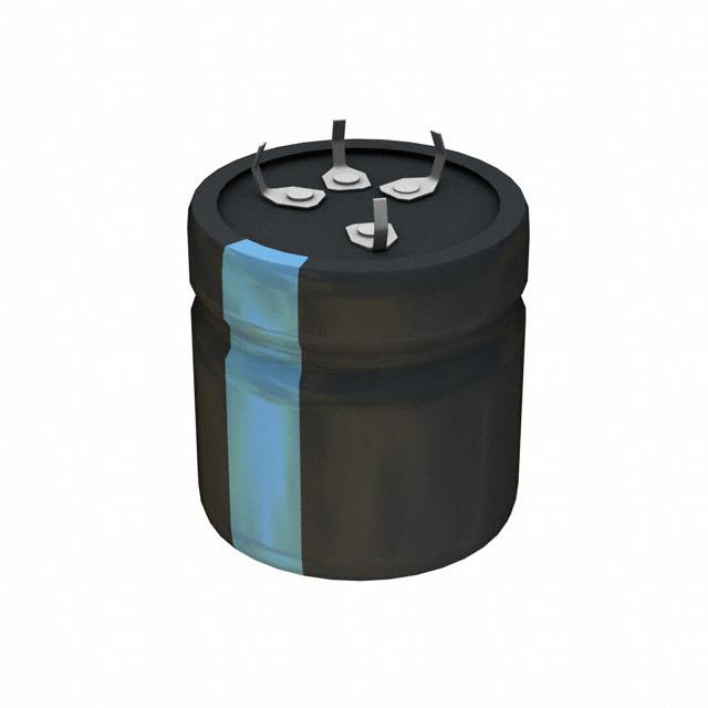

    22000 µF 35 V 铝电解电容器 径向,罐 - 卡入式 - 4 引线 27 毫欧 @ 120Hz 105°C 时为 3000 小时
383LX223M035N042 数据手册
2-pin Types: 381L and 381LX. 4-pin or 5-pin Types: 383L and 383LX Types 381L, 383L, 381LX & 383LX 105 ºC High-Ripple Snap-In Adding longer-life and more ripple capability to the excellent value of Type 380L/LX capacitors, the 381L/LX readily handles tough switching power supply input and output circuits and motor-drive bus capacitor applications where the high surface area of multiple units in parallel equals the ripple capability of our Type 520C inverter-grade capacitor. Type 381LX delivers more capacitance per can size while Type 381L gives lower ESR for the same capacitance rating. Type 383L gives the choice of 4 or 5 leads for stable, reverseproof mounting. Type 383LX has 5 leads available. Highlights • • • • Operating Temperature: Rated Voltage: Capacitance: Leakage Current: Top performance in power supplies and motor drives 4 times the life of Type 380L/LX 2, 4 and 5 leads available Big selection of 42 case sizes –40 °C to +105 °C up to 315 Vdc, –25 °C 350 Vdc and up 10 to 450 Vdc 33 µF to 150,000 µF ±20% ≤3√CV µA Ambient Temperature 45 °C 381L 381LX, 383 LX 2.70 2.35 60 °C 2.60 2.20 70 °C 2.50 2.00 85 °C 2.10 1.70 105°C 1.00 1.00 Specifications Ripple Current Multipliers: Frequency 50 Hz 10-100 Vdc 160-450 Vdc 0.93 0.75 60 Hz 0.95 0.80 120 Hz 1.00 1.00 500 Hz 1.05 1.20 1 kHz 1.08 1.25 5 kHz & up 1.15 1.40 EIA Ripple Life: Load Life Test: Complies with the EU Directive 2002/95/EC requirement restricting the use of Lead (Pb), Mercury (Hg), Cadmium (Cd), Hexavalent chromium (Cr(VI)), PolyBrominated Biphenyls (PBB) and PolyBrominated Diphenyl Ethers (PBDE). Shelf Life: Vibration: 12,000 h @ 85 °C, Full load as per EIA IS-749 ∆Capacitance ±20% ESR 200% of limit DCL 100% of limit 3,000 h @ 105 ºC, Full load ∆Capacitance ±10% ESR 125% of limit DCL 100% of limit 1,000 h @ 105 °C ∆Capacitance ±20% DF 200% of limit DCL 100% of limit 10 to 55 Hz, 0.06” and 10 g max, 2 h in each plane CDM Cornell Dubilier • 140 Technology Place • Liberty, SC 29657 • Phone: (864)843-2277 • Fax: (864)843-3800 • www.cde.com Types 381L, 383L, 381LX & 383LX 105 ºC High-Ripple Snap-In Outline Drawings Two Pins 381L/LX (22 through 40 mm diameter) Four Pins 383L/LX (35 and 40mm diameter) Five Pins 383L/LX (40 and 50mm diameter) V Terminal Standoff Pin Dimensions Connection Terminal A B C D – 40 mm Dia. dummy dummy positive (+) dummy negative (–) 50 mm Dia. negative (–) dummy positive (+) positive (+) negative (–) Notes: * Use dummy terminals for mechanical support only. Make no electrical connection because they resistively connect through the electrolyte to the negative terminal. ** Safety Vent may be on the bottom or on the side of the can. CDM Cornell Dubilier • 140 Technology Place • Liberty, SC 29657 • Phone: (864)843-2277 • Fax: (864)843-3800 • www.cde.com Insulated Case Dimensions Case Code H20 H01 H02 H03 H04 H45 H05 J20 J01 J02 J03 J04 J045 J05 K20 K01 K02 K03 K04 K45 K05 Types 381L, 383L, 381LX & 383LX 105 ºC High-Ripple Snap-In DIAMETER “D” mm inches 22 22 22 22 22 22 22 25 25 25 25 25 25 25 30 30 30 30 30 30 30 0.87 0.87 0.87 0.87 0.87 0.87 0.87 0.98 0.98 0.98 0.98 0.98 0.98 0.98 1.18 1.18 1.18 1.18 1.18 1.18 1.18 LENGTH “L” mm inches 20 25 30 35 40 45 50 20 25 30 35 40 45 50 20 25 30 35 40 45 50 0.79 0.98 1.18 1.38 1.57 1.77 1.97 0.79 0.98 1.18 1.38 1.57 1.77 1.97 0.79 0.98 1.18 1.38 1.57 1.77 1.97 Typical Weight (grams) 14 16 19 22 24 28 31 16 20 24 27 31 35 38 25 30 35 40 44 48 53 Case Code A20 A01 A02 A03 A04 A45 A05 A06 A07 A08 A10 N04 N05 N06 N08 N10 B05 B06 B08 B09 B10 DIAMETER “D” mm inches 35 35 35 35 35 35 35 35 35 35 35 40 40 40 40 40 50 50 50 50 50 1.38 1.38 1.38 1.38 1.38 1.38 1.38 1.38 1.38 1.38 1.38 1.57 1.57 1.57 1.57 1.57 1.97 1.97 1.97 1.97 1.97 LENGTH “L” mm inches 20 25 30 35 40 45 50 63 70 80 105 40 50 63 80 105 50 63 80 92 105 0.79 0.98 1.18 1.38 1.57 1.77 1.97 2.48 2.76 3.15 4.13 1.57 1.97 2.48 3.15 4.13 1.97 2.48 3.15 3.62 4.13 Typical Weight (grams) 35 42 48 54 62 67 74 88 98 112 144 82 105 130 185 265 136 168 239 241 325 Part Numbering System 383LX Type 472 Capacitance M Tolerance 200 Rated Voltage Vdc N08 Case Code 2 Insulation 2 PVC V 5-pin Option 381L (2 pins) 381LX (2 pins) 383L (4 or 5 pins) 383LX (4 or 5 pins) M = ±20% 100 = 10 µF 101 = 100 µF 492 = 4900 µF 433= 43,000 µF (383L/LX, 40 or 50 mm dia) blank = 4 pins V = 5 pins Typical Performance Curves CDM Cornell Dubilier • 140 Technology Place • Liberty, SC 29657 • Phone: (864)843-2277 • Fax: (864)843-3800 • www.cde.com Types 381L, 383L, 381LX & 383LX 105 ºC High-Ripple Snap-In Ratings ESR Max @ 25 ºC 120 Hz 20 kHz (Ω) (Ω) Ripple Amps @ 105 ºC 120 Hz 20 kHz (A) (A) Nominal Size DxL (mm) ESR Max Ripple Amps Nominal @ 25 ºC @ 105 ºC Size 120 Hz 20 kHz 120 Hz 20 kHz DxL (Ω) (Ω) (A) (A) (mm) Cap. (µF) Catalog Part Number Cap. (µF) Catalog Part Number 4700 6800 10000 12000 15000 15000 18000 18000 22000 22000 22000 27000 27000 27000 27000 33000 33000 33000 39000 39000 39000 47000 47000 56000 56000 68000 68000 82000 82000 100000 120000 120000 150000 3300 3300 4700 4700 6800 6800 8200 10000 10000 10000 12000 12000 12000 15000 15000 15000 18000 18000 18000 18000 381LX472M010H012 0.159 0.135 .85 0.093 1.30 381LX682M010H012 0.111 381LX103M010H012 0.075 0.063 1.80 381LX123M010H022 0.061 0.053 2.20 381LX153M010H032 0.055 0.045 2.30 381LX153M010J012 0.055 0.045 2.30 381LX183M010H042 0.044 0.038 2.40 381LX183M010J022 0.044 0.038 2.40 381LX223M010H452 0.040 0.032 2.60 381LX223M010J032 0.040 0.032 2.60 381LX223M010K012 0.040 0.032 2.60 381LX273M010H052 0.033 0.028 3.10 381LX273M010J042 0.033 0.028 3.10 381LX273M010K022 0.033 0.028 3.10 381LX273M010A012 0.033 0.028 3.10 381LX333M010J452 0.030 0.023 3.40 381LX333M010K032 0.030 0.023 3.40 381LX333M010A022 0.030 0.023 3.40 381LX393M010J052 0.025 0.020 3.70 381LX393M010K042 0.025 0.020 3.70 381LX393M010A022 0.025 0.020 3.70 381LX473M010K452 0.023 0.020 4.20 381LX473M010A032 0.023 0.020 4.20 381LX563M010K052 0.022 0.019 5.00 381LX563M010A042 0.022 0.019 5.00 381LX683M010A052 0.021 0.020 5.50 383LX683M010N042 0.023 0.022 5.40 381L823M010A062 0.013 0.008 6.30 383LX823M010N052 0.018 0.017 7.40 0.007 7.30 381L104M010A072 0.011 381L124M010A082 0.010 0.006 8.20 383L124M010N062 0.012 0.008 7.10 383L154M010N082 0.009 0.006 8.90 16 Vdc (20 Vdc Surge) 381LX332M016H202 0.216 0.170 1.30 381LX332M016H012 0.176 0.141 1.30 381LX472M016H012 0.123 0.099 1.52 381LX472M016J202 0.150 0.120 1.60 381LX682M016H012 0.088 0.067 2.20 381LX682M016K202 0.105 0.080 1.80 381LX822M016H022 0.070 0.055 2.40 381LX103M016H022 0.070 0.050 2.60 381LX103M016J012 0.070 0.050 2.60 381LX103M016A202 0.070 0.057 2.40 381LX123M016H032 0.055 0.044 2.90 381LX123M016J022 0.055 0.044 2.90 381LX123M016K012 0.055 0.044 2.90 381LX153M016H042 0.046 0.037 3.20 381LX153M016J032 0.046 0.037 3.20 381LX153M016K022 0.046 0.037 3.20 381LX183M016H452 0.040 0.034 3.50 381LX183M016J042 0.040 0.034 3.50 381LX183M016K022 0.040 0.034 3.50 381LX183M016A012 0.040 0.034 3.50 .98 1.50 2.10 2.50 2.60 2.60 2.80 2.80 3.00 3.00 3.00 3.60 3.60 3.60 3.60 3.90 3.90 3.90 4.30 4.30 4.30 4.80 4.80 5.80 5.80 6.30 6.20 7.90 8.50 9.00 10.00 8.60 10.60 1.50 1.50 1.75 1.80 2.50 2.10 2.80 3.00 3.00 2.80 3.30 3.30 3.30 3.70 3.70 3.70 4.00 4.00 4.00 4.00 22 x 25 22 x 25 22 x 25 22 x 30 22 x 35 25 x 25 22 x 40 25 x 30 22 x 45 25 x 35 30 x 25 22 x 50 25 x 40 30 x 30 35 x 25 25 x 45 30 x 35 35 x 30 25 x 50 30 x 40 35 x 30 30 x 45 35 x 35 30 x 50 35 x 40 35 x 50 40 x 40 35 x 63 40 x 50 35 x 70 35 x 80 40 x 63 40 x 80 22 x 20 22 x 25 22 x 25 25 x 20 22 x 25 30 x 20 22 x 30 22 x 30 25 x 25 35 x 20 22 x 35 25 x 30 30 x 25 22 x 40 25 x 35 30 x 30 22 x 45 25 x 40 30 x 30 35 x 25 22000 22000 27000 27000 27000 33000 33000 39000 39000 47000 47000 56000 68000 68000 68000 82000 82000 100000 120000 120000 120000 150000 150000 180000 220000 250000 2200 2200 3300 3300 4700 4700 5600 6800 6800 6800 8200 8200 8200 10000 10000 10000 12000 12000 12000 12000 15000 15000 15000 18000 18000 18000 22000 381LX223M016K032 0.033 0.028 3.80 381LX223M016A022 0.033 0.028 3.80 381LX273M016J052 0.030 0.025 4.20 381LX273M016K042 0.030 0.025 4.20 381LX273M016A022 0.030 0.025 4.20 381LX333M016K452 0.023 0.020 4.70 381LX333M016A032 0.023 0.020 4.70 381LX393M016K052 0.022 0.020 5.10 381LX393M016A042 0.022 0.020 5.10 381LX473M016A452 0.020 0.018 5.50 383LX473M016N042 0.020 0.018 5.50 381LX563M016A052 0.019 0.017 6.00 381LX683M016A062 0.017 0.015 6.60 381L683M016A072 0.012 0.007 7.10 383LX683M016N052 0.015 0.014 7.30 381L823M016A082 0.010 0.007 8.00 383LX823M016N062 0.017 0.013 7.70 381LX104M016A082 0.015 0.013 8.00 381LX124M016A102 0.014 0.012 8.71 383LX124M016N082 0.014 0.012 8.80 383LX124M016B052V 0.015 0.014 9.02 383LX154M016N102 0.013 0.012 9.88 383LX154M016B062V 0.014 0.013 10.15 383LX184M016B082V 0.013 0.012 11.02 383LX224M016B092V 0.012 0.011 11.71 383LX254M016B102V 0.011 0.010 12.31 25 Vdc (32 Vdc Surge) 381LX222M025H202 0.240 0.180 1.30 381LX222M025H012 0.240 0.180 1.30 381LX332M025H012 0.160 0.120 1.60 381LX332M025J202 0.160 0.120 1.60 381LX472M025H012 0.105 0.080 2.00 381LX472M025K202 0.110 0.085 1.80 381LX562M025H022 0.090 0.070 2.20 381LX682M025H022 0.070 0.055 2.40 381LX682M025J012 0.070 0.055 2.40 381LX682M025A202 0.080 0.060 2.30 381LX822M025H032 0.060 0.045 2.70 381LX822M025J022 0.060 0.045 2.70 381LX822M025K012 0.060 0.045 2.70 381LX103M025H042 0.050 0.040 3.00 381LX103M025J032 0.050 0.040 3.00 381LX103M025K022 0.050 0.040 3.00 381LX123M025H452 0.044 0.033 3.20 381LX123M025J042 0.044 0.033 3.20 381LX123M025K022 0.044 0.033 3.20 381LX123M025A012 0.044 0.033 3.20 381LX153M025J452 0.036 0.031 3.60 381LX153M025K032 0.036 0.031 3.60 381LX153M025A022 0.036 0.031 3.60 381LX183M025J052 0.030 0.027 3.90 381LX183M025K042 0.030 0.027 3.90 381LX183M025A032 0.030 0.027 3.90 381LX223M025K452 0.025 0.022 4.30 4.40 4.40 4.80 4.80 4.80 5.40 5.40 5.90 5.90 6.30 6.33 6.90 7.60 9.00 8.40 10.00 8.80 9.20 10.02 10.10 10.37 11.36 11.67 12.67 13.47 14.16 1.50 1.50 1.80 1.80 2.30 2.10 2.50 2.80 2.80 2.60 3.10 3.10 3.10 3.50 3.50 3.50 3.68 3.70 3.70 3.70 4.10 4.10 4.10 4.50 4.50 4.50 4.90 30 x 35 35 x 30 25 x 50 30 x 40 35 x 30 30 x 45 35 x 35 30 x 50 35 x 40 35 x 45 40 x 40 35 x 50 35 x 63 35 x 70 40 x 50 35 x 80 40 x 63 35 x 80 35 x 105 40 x 80 50 x 50 40 x 105 50 x 63 50 x 80 50 x 92 50 x 105 22 x 20 22 x 25 22 x 25 25 x 20 22 x 25 30 x 20 22 x 30 22 x 30 25 x 25 35 x 20 22 x 35 25 x 30 30 x 25 22 x 40 25 x 35 30 x 30 22 x 45 25 x 40 30 x 30 35 x 25 25 x 45 30 x 35 35 x 30 25 x 50 30 x 40 35 x 35 30 x 45 CDM Cornell Dubilier • 140 Technology Place • Liberty, SC 29657 • Phone: (864)843-2277 • Fax: (864)843-3800 • www.cde.com Types 381L, 383L, 381LX & 383LX 105 ºC High-Ripple Snap-In ESR Max Ripple Amps @ 25 ºC @ 105 ºC 120 Hz 20 kHz 120 Hz 20 kHz (Ω) (Ω) (A) (A) Nominal Size DxL (mm) ESR Max Ripple Amps @ 25 ºC @ 105 ºC 120 Hz 20 kHz 120 Hz 20 kHz (Ω) (Ω) (A) (A) Nominal Size DxL (mm) Cap. (µF) Catalog Part Number Cap. (µF) Catalog Part Number 27000 27000 33000 33000 39000 39000 47000 47000 47000 47000 56000 56000 68000 82000 82000 82000 100000 100000 120000 150000 180000 1500 1500 2200 2200 3300 3300 3900 4700 4700 4700 5600 5600 5600 6800 6800 6800 8200 8200 8200 8200 10000 10000 10000 12000 12000 12000 15000 15000 18000 22000 22000 27000 381LX273M025A452 0.021 0.019 4.80 383L273M025N042 0.020 0.013 4.60 381LX333M025A052 0.018 0.016 5.50 383LX333M025N042 0.018 0.016 5.50 381L393M025A062 0.014 0.009 6.10 383L393M025N052 0.015 0.010 5.80 381LX473M025A062 0.017 0.015 6.50 381L473M025A072 0.012 0.008 7.10 383LX473M025N052 0.015 0.014 6.50 383L473M025N062 0.012 0.008 6.90 381L563M025A082 0.010 0.007 7.90 383LX563M025N062 0.015 0.012 7.20 383L683M025N082 0.009 0.007 8.70 381LX823M025A102 0.013 0.012 8.58 383LX823M025N082 0.014 0.011 8.70 383LX823M025B052V 0.016 0.015 9.20 383LX104M025N102 0.012 0.010 9.76 383LX104M025B062V 0.015 0.013 10.02 383LX124M025B082V 0.013 0.012 10.93 383LX154M025B092V 0.012 0.011 11.70 383LX184M025B102V 0.010 0.009 12.42 35 Vdc (44 Vdc Surge) 381LX152M035H202 0.287 0.216 1.10 381LX152M035H012 0.287 0.216 1.10 381LX222M035H012 0.200 0.150 1.40 381LX222M035J202 0.200 0.150 1.40 381LX332M035H012 0.121 0.091 1.90 381LX332M035K202 0.130 0.100 1.70 381LX392M035H022 0.110 0.080 2.00 381LX472M035H032 0.090 0.070 2.20 381LX472M035J012 0.090 0.070 2.20 381LX472M035A202 0.095 0.070 2.00 381LX562M035H032 0.071 0.054 2.40 381LX562M035J022 0.071 0.054 2.40 381LX562M035K012 0.071 0.054 2.40 381LX682M035H042 0.059 0.045 2.60 381LX682M035J032 0.059 0.045 2.60 381LX682M035K022 0.059 0.045 2.60 381LX822M035H052 0.049 0.037 2.90 381LX822M035J042 0.049 0.037 2.90 381LX822M035K022 0.049 0.037 2.90 381LX822M035A012 0.049 0.037 2.90 381LX103M035J452 0.040 0.030 3.20 381LX103M035K032 0.040 0.030 3.20 381LX103M035A022 0.040 0.030 3.20 381LX123M035J052 0.033 0.025 3.50 381LX123M035K042 0.033 0.025 3.50 381LX123M035A022 0.033 0.025 3.50 381LX153M035K452 0.030 0.020 3.90 381LX153M035A032 0.030 0.020 3.90 381LX183M035A042 0.030 0.021 4.30 381LX223M035A052 0.023 0.017 5.00 383LX223M035N042 0.023 0.017 5.00 381LX273M035A062 0.025 0.018 5.50 5.50 5.60 6.30 6.33 7.60 7.00 7.50 8.70 7.40 8.30 9.70 8.25 10.20 9.87 10.00 10.58 11.22 11.52 12.57 13.46 14.28 1.30 1.30 1.60 1.60 2.20 2.00 2.30 2.50 2.50 2.30 2.80 2.80 2.80 3.00 3.00 3.00 3.30 3.30 3.30 3.30 3.70 3.70 3.70 4.00 4.00 4.00 4.50 4.50 4.90 5.80 5.75 6.40 35 x 45 40 x 40 35 x 50 40 x 40 35 x 63 40 x 50 35 x 63 35 x 70 40 x 50 40 x 63 35 x 80 40 x 63 40 x 80 35 x 105 40 x 80 50 x 50 40 x 105 50 x 63 50 x 80 50 x 92 50 x 105 22 x 20 22 x 25 22 x 25 25 x 20 22 x 25 30 x 20 22 x 30 22 x 35 25 x 25 35 x 20 22 x 35 25 x 30 30 x 25 22 x 40 25 x 35 30 x 30 22 x 50 25 x 40 30 x 30 35 x 25 25 x 45 30 x 35 35 x 30 25 x 50 30 x 40 35 x 30 30 x 45 35 x 35 35 x 40 35 x 50 40 x 40 35 x 63 33000 33000 39000 47000 47000 47000 56000 68000 68000 82000 100000 1000 1000 1500 1500 1800 2200 2200 2700 2700 3300 3300 3300 3900 3900 3900 4700 4700 4700 4700 5600 5600 5600 5600 6800 6800 6800 8200 8200 10000 10000 12000 12000 15000 15000 15000 15000 18000 18000 18000 22000 22000 27000 381L333M035A072 0.014 0.009 6.40 383L333M035N062 0.019 0.014 6.60 381LX393M035A082 0.019 0.014 6.50 381LX473M035A102 0.017 0.013 8.07 383L473M035N082 0.018 0.013 7.80 383LX473M035B052V 0.021 0.016 8.25 383LX563M035B062V 0.019 0.014 9.07 383LX683M035N102 0.016 0.012 9.27 383LX683M035B082V 0.017 0.013 10.07 383LX823M035B092V 0.015 0.011 10.89 383LX104M035B102V 0.013 0.010 11.75 50 Vdc (63 Vdc Surge) 381LX102M050H202 0.260 0.200 .90 381LX102M050H012 0.230 0.170 .90 381LX152M050H012 0.155 0.120 1.25 381LX152M050J202 0.177 0.130 1.20 381LX182M050H012 0.129 0.097 1.50 381LX222M050H022 0.105 0.080 1.70 381LX222M050K202 0.121 0.090 1.40 381LX272M050H022 0.086 0.064 1.80 381LX272M050J012 0.086 0.064 1.80 381LX332M050H032 0.070 0.053 2.00 381LX332M050J022 0.070 0.053 2.00 381LX332M050A202 0.085 0.064 1.70 381LX392M050H042 0.065 0.050 2.20 381LX392M050J032 0.065 0.050 2.20 381LX392M050K012 0.065 0.050 2.20 381LX472M050H452 0.053 0.040 2.50 381LX471M050J042 0.053 0.040 2.50 381LX472M050K022 0.053 0.040 2.50 381LX472M050A012 0.053 0.040 2.50 381LX562M050H052 0.050 0.038 2.80 381LX562M050J042 0.050 0.038 2.80 381LX562M050K032 0.050 0.038 2.80 381LX562M050A022 0.050 0.038 2.80 381LX682M050J052 0.046 0.035 3.30 381LX682M050K042 0.046 0.035 3.30 381LX682M050A022 0.046 0.035 3.30 381LX822M050K452 0.040 0.030 3.60 381LX822M050A032 0.040 0.030 3.60 381LX103M050K052 0.033 0.025 4.00 381LX103M050A042 0.033 0.025 4.00 381LX123M050A452 0.028 0.021 4.50 383L123M050N042 0.029 0.018 3.80 381LX153M050A052 0.022 0.018 4.80 381L153M050A062 0.020 0.012 5.10 383LX153M050N042 0.022 0.018 4.80 383L153M050N052 0.021 0.013 4.90 381L183M050A072 0.017 0.010 5.90 383L183M050N062 0.017 0.011 5.80 381LX183M050A062 0.028 0.022 5.30 381L223M050A082 0.014 0.009 6.70 383LX223M050N052 0.016 0.013 5.10 381LX273M050A082 0.015 0.012 6.20 8.10 7.60 7.50 9.28 9.00 9.49 10.43 10.66 11.58 12.52 13.51 1.00 1.00 1.45 1.40 1.70 2.00 1.60 2.10 2.10 2.30 2.30 2.00 2.50 2.50 2.50 2.90 2.90 2.90 2.90 3.20 3.20 3.20 3.20 3.80 3.80 3.80 4.10 4.10 4.60 4.60 5.20 4.80 5.50 6.50 5.52 6.10 7.50 7.20 6.00 8.40 5.90 7.10 35 x 70 40 x 63 35 x 80 35 x 105 40 x 80 50 x 50 50 x 63 40 x 105 50 x 80 50 x 92 50 x 105 22 x 20 22 x 25 22 x 25 25 x 20 22 x 25 22 x 30 30 x 20 22 x 30 25 x 25 22 x 35 25 x 30 35 x 20 22 x 40 25 x 35 30 x 25 22 x 45 25 x 40 30 x 30 35 x 25 22 x 50 25 x 40 30 x 35 35 x 30 25 x 50 30 x 40 35 x 30 30 x 45 35 x 35 30 x 50 35 x 40 35 x 45 40 x 40 35 x 50 35 x 63 40 x 40 40 x 50 35 x 70 40 x 63 35 x 63 35 x 80 40 x 50 35 x 80 CDM Cornell Dubilier • 140 Technology Place • Liberty, SC 29657 • Phone: (864)843-2277 • Fax: (864)843-3800 • www.cde.com Types 381L, 383L, 381LX & 383LX 105 ºC High-Ripple Snap-In ESR Max Ripple Amps @ 25 ºC @ 105 ºC 120 Hz 20 kHz 120 Hz 20 kHz (Ω) (Ω) (A) (A) Nominal Size DxL (mm) ESR Max Ripple Amps @ 25 ºC @ 105 ºC 120 Hz 20 kHz 120 Hz 20 kHz (Ω) (Ω) (A) (A) Nominal Size DxL (mm) Cap. (µF) Catalog Part Number Cap. (µF) Catalog Part Number 27000 33000 33000 39000 39000 47000 47000 56000 68000 680 680 1000 1000 1200 1500 1500 1800 1800 2200 2200 2200 2700 2700 2700 3300 3300 3300 3300 3900 3900 3900 4700 4700 4700 5600 5600 6800 6800 8200 8200 10000 12000 12000 12000 12000 15000 15000 15000 18000 18000 22000 22000 383L273M050N082 0.013 0.009 7.40 9.00 381LX333M050A102 0.013 0.010 7.23 8.31 383LX333M050B052V 0.018 0.014 7.75 8.91 383LX393M050N082 0.013 0.010 6.20 7.10 383LX393M050B062V 0.016 0.013 8.40 9.66 383LX473M050N102 0.012 0.010 8.18 9.41 383LX473M050B082V 0.014 0.011 9.19 10.57 383LX563M050B092V 0.012 0.009 9.79 11.26 383LX683M050B102V 0.011 0.009 10.40 12.00 63 Vdc (79 Vdc Surge) 381LX681M063H202 0.463 0.350 .90 1.00 381LX681M063H012 0.410 0.310 .90 1.00 381LX102M063H012 0.280 0.210 1.18 1.35 381LX102M063J202 0.315 0.240 1.20 1.40 381LX122M063H012 0.235 0.180 1.40 1.60 381LX152M063H022 0.190 0.140 1.50 1.70 381LX152M063K202 0.210 0.160 1.30 1.50 381LX182M063H022 0.157 0.117 1.70 1.96 381LX182M063J012 0.157 0.117 1.70 2.00 381LX222M063H032 0.130 0.096 2.00 2.30 381LX222M063J022 0.130 0.096 2.00 2.30 381LX222M063A202 0.143 0.110 1.50 1.70 381LX272M063H042 0.105 0.080 2.20 2.50 381LX272M063J032 0.105 0.080 2.20 2.50 381LX272M063K012 0.105 0.080 2.20 2.50 381LX332M063H052 0.090 0.070 2.50 2.90 381LX332M063J042 0.090 0.070 2.50 2.90 381LX332M063K022 0.090 0.070 2.50 2.90 381LX332M063A012 0.090 0.070 2.50 2.90 381LX392M063J452 0.080 0.060 2.70 3.10 381LX392M063K032 0.080 0.060 2.70 3.10 381LX392M063A022 0.080 0.060 2.70 3.10 381LX472M063J052 0.063 0.048 3.00 3.50 381LX472M063K042 0.063 0.048 3.00 3.50 381LX472M063A022 0.063 0.048 3.00 3.50 381LX562M063K452 0.055 0.040 3.30 3.80 381LX562M063A032 0.055 0.040 3.30 3.80 381LX682M063K052 0.050 0.040 3.60 4.10 381LX682M063A042 0.050 0.040 3.60 4.10 381LX822M063A452 0.040 0.030 3.90 4.50 383L822M063N042 0.031 0.018 3.70 4.80 381LX103M063A052 0.033 0.028 4.40 5.10 381LX123M063A052 0.030 0.025 4.40 5.10 381L123M063A062 0.029 0.012 4.20 6.50 383LX123M063N042 0.030 0.028 4.52 5.20 383L123M063N052 0.022 0.013 4.70 6.10 381LX153M063A062 0.024 0.021 4.90 5.70 383LX153M063N052 0.027 0.023 4.80 5.50 383L153M063N062 0.018 0.011 5.70 7.20 381LX183M063A082 0.022 0.019 5.80 6.70 383LX183M063N062 0.023 0.020 5.40 6.20 383L223M063N082 0.013 0.009 7.20 9.00 383LX223M063B052V 0.019 0.016 6.76 7.77 40 x 80 35 x 105 50 x 50 40 x 80 50 x 63 40 x 105 50 x 80 50 x 92 50 x105 22 x 20 22 x 25 22 x 25 25 x 20 22 x 25 22 x 30 30 x 20 22 x 30 25 x 25 22 x 35 25 x 30 35 x 20 22 x 40 25 x 35 30 x 25 22 x 50 25 x 40 30 x 30 35 x 25 25 x 45 30 x 35 35 x 30 25 x 50 30 x 40 35 x 30 30 x 45 35 x 35 30 x 50 35 x 40 35 x 45 40 x 40 35 x 50 35 x 50 35 x 63 40 x 40 40 x 50 35 x 63 40 x 50 40 x 63 35 x 80 40 x 63 40 x 80 50 x 50 27000 27000 33000 39000 39000 47000 470 470 680 680 820 1000 1000 1000 1200 1200 1500 1500 1500 1800 1800 1800 2200 2200 2200 2200 2700 2700 2700 3300 3300 3300 3900 3900 4700 4700 5600 5600 6800 6800 8200 8200 10000 10000 12000 12000 15000 15000 15000 18000 22000 22000 27000 383LX273M063N082 0.017 0.014 6.60 383LX273M063B062V 0.017 0.014 7.34 383LX333M063B082V 0.015 0.013 8.00 383LX393M063N102 0.014 0.012 7.53 383LX393M063B092V 0.014 0.012 8.48 383LX473M063B102V 0.012 0.010 8.99 80 Vdc (100 Vdc Surge) 381LX471M080H202 0.460 0.300 .80 381LX471M080H012 0.390 0.270 .80 381LX681M080H012 0.270 0.190 1.00 381LX681M080J202 0.317 0.206 1.00 381LX821M080H012 0.222 0.145 1.20 381LX102M080H022 0.182 0.120 1.30 381LX102M080J012 0.182 0.120 1.30 381LX102M080K202 0.220 0.140 1.20 381LX122M080H022 0.170 0.120 1.50 381LX122M080J012 0.170 0.120 1.50 381LX152M080H032 0.133 0.093 1.70 381LX152M080J022 0.133 0.093 1.70 381LX152M080A202 0.155 0.110 1.40 381LX182M080H042 0.111 0.080 1.80 381LX182M080J032 0.111 0.080 1.80 381LX182M080K012 0.111 0.080 1.80 381LX222M080H452 0.090 0.063 2.10 381LX222M080J032 0.090 0.063 2.10 381LX222M080K022 0.090 0.063 2.10 381LX222M080A012 0.090 0.063 2.10 381LX272M080J452 0.074 0.055 2.40 381LX272M080K032 0.074 0.055 2.40 381LX272M080A022 0.074 0.055 2.40 381LX332M080J052 0.065 0.049 2.60 381LX332M080K042 0.065 0.049 2.60 381LX332M080A022 0.065 0.049 2.60 381LX392M080K452 0.060 0.044 3.00 381LX392M080A032 0.060 0.044 3.00 381LX472M080K052 0.048 0.036 3.30 381LX472M080A042 0.048 0.036 3.30 381LX562M080A452 0.050 0.038 3.70 383L562M080N042 0.035 0.022 3.50 381LX682M080A052 0.041 0.031 3.90 383LX682M080N042 0.041 0.031 3.90 381L822M080A062 0.024 0.014 4.60 383L822M080N052 0.025 0.016 4.40 381L103M080A072 0.020 0.012 5.40 383L103M080N062 0.021 0.013 5.30 381L123M080A082 0.017 0.011 6.10 383LX123M080B052V 0.035 0.026 6.03 381LX153M080A102 0.024 0.018 6.13 383L153M080N082 0.015 0.010 6.80 383LX153M080B062V 0.028 0.021 6.65 383LX183M080B082V 0.026 0.019 7.29 383LX223M080N102 0.019 0.014 6.95 383LX223M080B092V 0.022 0.016 7.83 383LX273M080B102V 0.018 0.014 8.38 7.60 8.44 9.20 8.66 9.75 10.34 .90 .90 1.15 1.20 1.40 1.50 1.50 1.40 1.70 1.70 2.00 2.00 1.60 2.10 2.10 2.10 2.40 2.40 2.40 2.40 2.80 2.80 2.80 3.00 3.00 3.00 3.50 3.50 3.80 3.80 4.30 4.40 4.50 4.49 5.90 5.60 6.90 6.70 7.70 6.93 7.05 8.40 7.65 8.38 7.99 9.00 9.64 40 x 80 50 x 63 50 x 80 40 x 105 50 x 92 50 x 105 22 x 20 22 x 25 22 x 25 25 x 20 22 x 25 22 x 30 25 x 25 30 x 20 22 x 30 25 x 25 22 x 35 25 x 30 35 x 20 22 x 40 25 x 35 30 x 25 22 x 45 25 x 35 30 x 30 35 x 25 25 x 45 30 x 35 35 x 30 25 x 50 30 x 40 35 x 30 30 x 45 35 x 35 30 x 50 35 x 40 35 x 45 40 x 40 35 x 50 40 x 40 35 x 63 40 x 50 35 x 70 40 x 63 35 x 80 50 x 50 35 x 105 40 x 80 50 x 63 50 x 80 40 x 105 50 x 92 50 x 105 CDM Cornell Dubilier • 140 Technology Place • Liberty, SC 29657 • Phone: (864)843-2277 • Fax: (864)843-3800 • www.cde.com Types 381L, 383L, 381LX & 383LX 105 ºC High-Ripple Snap-In ESR Max Ripple Amps @ 25 ºC @ 105 ºC 120 Hz 20 kHz 120 Hz 20 kHz (Ω) (Ω) (A) (A) Nominal Size DxL (mm) ESR Max Ripple Amps @ 25 ºC @ 105 ºC 120 Hz 20 kHz 120 Hz 20 kHz (Ω) (Ω) (A) (A) Nominal Size DxL (mm) Cap. (µF) Catalog Part Number Cap. (µF) Catalog Part Number 330 330 470 470 560 680 820 820 1000 1000 1000 1200 1200 1200 1500 1500 1500 1500 1800 1800 1800 2200 2200 2200 2700 2700 3300 3300 3900 4700 4700 4700 5600 5600 5600 6800 6800 8200 8200 8200 8200 10000 12000 12000 15000 15000 18000 22000 150 150 220 220 270 381LX331M100H202 0.653 0.392 .80 381LX331M100H012 0.550 0.330 .80 381LX471M100H012 0.390 0.230 .92 381LX471M100J202 0.460 0.275 1.00 381LX561M100H012 0.300 0.180 1.10 381LX681M100K202 0.317 0.190 1.10 381LX821M100H022 0.202 0.120 1.40 381LX821M100J012 0.202 0.120 1.40 381LX102M100H032 0.182 0.110 1.70 381LX102M100J022 0.182 0.110 1.70 381LX102M100A202 0.216 0.130 1.20 381LX122M100H042 0.152 0.091 1.80 381LX122M100J032 0.152 0.091 1.80 381LX122M100K012 0.152 0.091 1.80 381LX152M100H452 0.122 0.073 2.10 381LX152M100J042 0.122 0.073 2.10 381LX152M100K022 0.122 0.073 2.10 381LX152M100A012 0.122 0.073 2.10 381LX182M100J452 0.111 0.072 2.30 381LX182M100K032 0.111 0.072 2.30 381LX182M100A022 0.111 0.072 2.30 381LX222M100J052 0.090 0.060 2.60 381LX222M100K042 0.090 0.060 2.60 381LX222M100A022 0.090 0.060 2.60 381LX272M100K452 0.080 0.052 2.90 381LX272M100A032 0.080 0.052 2.90 381LX332M100K052 0.075 0.053 3.20 381LX332M100A042 0.075 0.053 3.20 381LX392M100A452 0.064 0.045 3.60 381LX472M100A052 0.053 0.040 3.80 381L472M100A062 0.032 0.013 4.00 383LX472M100N042 0.053 0.040 3.80 381LX562M100A062 0.044 0.033 4.10 381L562M100A072 0.027 0.011 4.70 383L562M100N062 0.027 0.012 4.60 381L682M100A082 0.023 0.010 5.30 383LX682M100N052 0.037 0.027 4.60 381LX822M100A082 0.030 0.023 5.15 383LX822M100N062 0.030 0.023 5.00 383L822M100N082 0.020 0.009 6.00 383LX822M100B052V 0.030 0.023 6.14 381LX103M100A102 0.025 0.019 6.38 383LX123M100N082 0.021 0.016 6.44 383LX123M100B062V 0.022 0.017 7.17 383LX153M100N102 0.017 0.012 7.37 383LX153M100B082V 0.019 0.014 8.01 383LX183M100B092V 0.017 0.012 8.64 383LX223M100B102V 0.015 0.011 9.32 160 Vdc (200 Vdc Surge) 381LX151M160H202 1.437 0.647 .55 381LX151M160H012 1.220 0.550 .60 381LX221M160H012 0.830 0.370 .90 381LX221M160J202 0.980 0.441 .80 381LX271M160H012 0.675 0.304 1.10 1.20 1.20 1.40 1.50 1.30 1.70 2.10 2.10 2.55 2.55 1.80 2.70 2.70 2.70 3.15 3.15 3.15 3.15 3.45 3.45 3.45 3.90 3.90 3.90 4.35 4.35 4.80 4.80 5.40 5.70 5.80 5.70 4.70 6.70 6.50 7.50 5.30 5.90 5.77 8.20 7.06 7.34 7.40 8.25 8.48 9.21 9.94 10.72 .77 .85 1.25 1.10 1.50 22 x 20 22 x 25 22 x 25 25 x 20 22 x 25 30 x 20 22 x 30 25 x 25 22 x 35 25 x 30 35 x 20 22 x 40 25 x 35 30 x 25 22 x 45 25 x 40 30 x 30 35 x 25 25 x 45 30 x 35 35 x 30 25 x 50 30 x 40 35 x 30 30 x 45 35 x 35 30 x 50 35 x 40 35 x 45 35 x 50 35 x 63 40 x 40 35 x 63 35 x 70 40 x 63 35 x 80 40 x 50 35 x 80 40 x 63 40 x 80 50 x 50 35 x 105 40 x 80 50 x 63 40 x 105 50 x 80 50 x 92 50 x 105 22 x 20 22 x 25 22 x 25 25 x 20 22 x 25 330 390 390 470 470 560 560 560 680 680 820 820 820 1000 1000 1000 1000 1200 1200 1200 1500 1500 1800 1800 2200 2200 2200 2700 2700 2700 3300 3300 3900 220 270 330 330 390 390 470 470 470 560 560 560 560 680 680 680 680 680 820 820 381LX331M160K202 0.553 0.249 1.00 381LX391M160H022 0.553 0.249 1.30 381LX391M160J012 0.553 0.249 1.30 381LX471M160H022 0.423 0.190 1.40 381LX471M160A202 0.459 0.206 1.10 381LX561M160H032 0.355 0.160 1.50 381LX561M160J022 0.385 0.173 1.50 381LX561M160K012 0.385 0.173 1.50 381LX681M160H042 0.293 0.132 1.70 381LX681M160J022 0.293 0.132 1.70 381LX821M160H452 0.243 0.109 2.00 381LX821M160J032 0.243 0.109 2.00 381LX821M160K022 0.263 0.118 2.00 381LX102M160H052 0.199 0.090 2.20 381LX102M160J042 0.199 0.090 2.20 381LX102M160K022 0.199 0.090 2.20 381LX102M160A012 0.199 0.090 2.20 381LX122M160J452 0.180 0.090 2.30 381LX122M160K032 0.180 0.090 2.30 381LX122M160A022 0.180 0.090 2.30 381LX152M160K042 0.144 0.072 2.50 381LX152M160A022 0.144 0.072 2.50 381LX182M160K452 0.129 0.064 2.70 381LX182M160A032 0.129 0.064 2.70 381LX222M160A452 0.105 0.063 2.90 381L222M160A062 0.050 0.027 3.30 383LX222M160N042 0.100 0.060 2.90 381LX272M160A052 0.086 0.052 3.10 381L272M160A072 0.043 0.023 3.80 383L272M160N062 0.045 0.027 3.80 381L332M160A082 0.037 0.020 3.80 383LX332M160N052 0.070 0.040 3.40 383L392M160A082 0.029 0.017 4.90 180 Vdc (225 Vdc Surge) 381LX221M180H012 0.904 0.461 1.00 381LX271M180H012 0.737 0.376 1.10 381LX331M180H022 0.603 0.308 1.20 381LX331M180J012 0.603 0.308 1.20 381LX391M180H022 0.510 0.260 1.30 381LX391M180J012 0.510 0.260 1.30 381LX471M180H032 0.423 0.216 1.40 381LX471M180J022 0.423 0.216 1.40 381LX471M180K012 0.423 0.216 1.40 381LX561M180H042 0.355 0.181 1.50 381LX561M180J022 0.355 0.181 1.50 381LX561M180J032 0.355 0.181 1.50 381LX561M180K012 0.355 0.181 1.50 381LX681M180H452 0.293 0.149 1.70 381LX681M180H052 0.293 0.149 1.70 381LX681M180J032 0.293 0.149 1.70 381LX681M180J042 0.293 0.149 1.70 381LX681M180K022 0.293 0.149 1.70 381LX821M180H052 0.243 0.124 2.00 381LX821M180J042 0.243 0.124 2.00 1.40 1.80 1.80 2.00 1.60 2.10 2.10 2.10 2.40 2.40 2.80 2.80 2.80 3.10 3.10 3.10 3.10 3.20 3.20 3.20 3.50 3.50 3.80 3.80 4.10 4.50 4.10 4.40 5.20 5.00 5.90 4.70 6.30 1.40 1.50 1.70 1.70 1.80 1.80 2.00 2.00 2.00 2.10 2.10 2.10 2.10 2.40 2.40 2.40 2.40 2.40 2.80 2.80 30 x 20 22 x 30 25 x 25 22 x 30 35 x 20 22 x 35 25 x 30 30 x 25 22 x 40 25 x 30 22 x 45 25 x 35 30 x 30 22 x 50 25 x 40 30 x 30 35 x 25 25 x 45 30 x 35 35 x 30 30 x 40 35 x 30 30 x 45 35 x 35 35 x 45 35 x 63 40 x 40 35 x 50 35 x 70 40 x 63 35 x 80 40 x 40 40 x 80 22 x 25 22 x 25 22 x 30 25 x 25 22 x 30 25 x 25 22 x 35 25 x 30 30 x 25 22 x 40 25 x 30 25 x 35 30 x 25 22 x 45 22 x 50 25 x 35 25 x 40 30 x 30 22 x 50 25 x 40 CDM Cornell Dubilier • 140 Technology Place • Liberty, SC 29657 • Phone: (864)843-2277 • Fax: (864)843-3800 • www.cde.com Types 381L, 383L, 381LX & 383LX 105 ºC High-Ripple Snap-In ESR Max Ripple Amps @ 25 ºC @ 105 ºC 120 Hz 20 kHz 120 Hz 20 kHz (Ω) (Ω) (A) (A) Nominal Size DxL (mm) ESR Max Ripple Amps @ 25 ºC @ 105 ºC 120 Hz 20 kHz 120 Hz 20 kHz (Ω) (Ω) (A) (A) Nominal Size DxL (mm) Cap. (µF) Catalog Part Number Cap. (µF) Catalog Part Number 820 820 1000 1000 1000 1000 1200 1200 1200 1200 1500 1500 1500 1500 1800 1800 1800 2200 2200 2200 2700 3300 100 100 150 150 220 220 270 270 330 330 330 390 390 470 470 470 560 560 560 680 680 680 820 820 820 1000 1000 1000 1200 1200 1500 381LX821M180K022 0.243 0.124 2.00 381LX821M180K032 0.243 0.124 2.00 381LX102M180J452 0.199 0.102 2.20 381LX102M180K032 0.199 0.102 2.20 381LX102M180K042 0.199 0.102 2.20 381LX102M180A022 0.199 0.102 2.20 381LX122M180J052 0.166 0.085 2.30 381LX122M180K042 0.166 0.085 2.30 381LX122M180K452 0.166 0.085 2.30 381LX122M180A022 0.166 0.085 2.30 381LX152M180K452 0.133 0.068 2.50 381LX152M180K052 0.133 0.068 2.50 381LX152M180A032 0.133 0.068 2.50 381LX152M180A042 0.133 0.068 2.50 381L182M180A062 0.055 0.028 3.20 383L182M180N052 0.059 0.033 3.10 381LX182M180A452 0.111 0.028 2.70 381L222M180A072 0.046 0.024 3.70 383L222M180N062 0.048 0.027 3.70 381LX222M180A052 0.090 0.046 2.90 381L272M180A082 0.039 0.021 4.30 383L332M180N082 0.035 0.020 4.80 200 Vdc (250 Vdc Surge) 381LX101M200H202 1.989 0.895 .50 381LX101M200H012 1.660 0.750 .50 381LX151M200H012 1.100 0.500 .70 381LX151M200J202 1.326 0.600 .70 381LX221M200H012 0.754 0.339 1.00 381LX221M200K202 0.904 0.407 .90 381LX271M200H022 0.614 0.276 1.10 381LX271M200J012 0.614 0.276 1.10 381LX331M200H022 0.603 0.308 1.20 381LX331M200J012 0.603 0.308 1.20 381LX331M200A202 0.603 0.271 1.10 381LX391M200H022 0.510 0.230 1.30 381LX391M200J012 0.510 0.230 1.30 381LX471M200H032 0.423 0.190 1.40 381LX471M200J022 0.423 0.190 1.40 381LX471M200K012 0.353 0.159 1.40 381LX561M200H042 0.355 0.160 1.50 381LX561M200J022 0.355 0.160 1.50 381LX561M200K012 0.355 0.160 1.50 381LX681M200H452 0.293 0.132 1.70 381LX681M200J032 0.293 0.132 1.70 381LX681M200K022 0.244 0.110 1.70 381LX821M200J452 0.263 0.118 2.00 381LX821M200K022 0.263 0.118 2.00 381LX821M200A012 0.263 0.118 2.00 381LX102M200J052 0.216 0.108 2.20 381LX102M200K032 0.216 0.108 2.20 381LX102M200A022 0.216 0.108 2.20 381LX122M200K042 0.193 0.097 2.30 381LX122M200A032 0.193 0.097 2.30 381LX152M200K052 0.155 0.077 2.50 2.80 2.80 3.10 3.10 3.10 3.10 3.20 3.20 3.20 3.20 3.50 3.50 3.50 3.50 4.50 4.20 3.80 5.20 4.90 4.10 5.90 6.30 .70 .70 .95 .90 1.40 1.20 1.50 1.50 1.70 1.70 1.50 1.80 1.80 2.00 2.00 2.00 2.10 2.10 2.10 2.40 2.40 2.40 2.80 2.80 2.80 3.10 3.10 3.10 3.20 3.20 3.50 30 x 30 30 x 35 25 x 45 30 x 35 30 x 40 35 x 30 25 x 50 30 x 40 30 x 45 35 x 30 30 x 45 30 x 50 35 x 35 35 x 40 35 x 63 40 x 50 35 x 45 35 x 70 40 x 63 35 x 50 35 x 80 40 x 80 22 x 20 22 x 25 22 x 25 25 x 20 22 x 25 30 x 20 22 x 30 25 x 25 22 x 30 25 x 25 35 x 20 22 x 30 25 x 25 22 x 35 25 x 30 30 x 25 22 x 40 25 x 30 30 x 25 22 x 45 25 x 35 30 x 30 25 x 45 30 x 30 35 x 25 25 x 50 30 x 35 35 x 30 30 x 40 35 x 35 30 x 50 1800 1800 1800 1800 2200 2200 2200 2700 2700 2700 3300 3300 3300 3900 4700 4700 4700 5600 5600 6800 68 68 100 100 150 150 180 220 220 220 270 270 270 330 330 330 390 390 390 470 470 470 560 560 560 680 680 680 680 820 820 1000 1000 381LX182M200A452 0.129 0.077 2.70 381L182M200A062 0.055 0.028 3.20 383LX182M200N042 0.129 0.077 2.70 383L182M200N052 0.063 0.033 3.00 381LX222M200A052 0.105 0.063 2.90 381L222M200A082 0.042 0.021 4.10 383L222M200N062 0.051 0.027 3.60 381LX272M200A062 0.080 0.047 3.65 383LX272M200N052 0.086 0.052 3.55 383L272M200N082 0.032 0.018 4.60 381LX332M200A082 0.065 0.039 4.50 383LX332M200N062 0.700 0.040 4.40 383LX332M200B052V 0.075 0.045 5.20 383LX392M200B062V 0.064 0.038 5.90 381LX472M200A102 0.046 0.028 5.70 383LX472M200N082 0.050 0.030 5.75 383LX472M200B082V 0.053 0.032 6.82 383LX562M200N102 0.041 0.025 6.76 383LX562M200B092V 0.044 0.027 7.68 383LX682M200B102V 0.034 0.020 8.71 250 Vdc (300 Vdc Surge) 381LX680M250H202 2.926 1.493 .40 381LX680M250H012 2.440 1.220 .40 381LX101M250H012 1.660 0.830 .55 381LX101M250J202 1.989 1.015 .50 381LX151M250H012 1.330 0.660 .65 381LX151M250K202 1.110 0.553 .75 381LX181M250H012 0.921 0.461 .90 381LX221M250H022 0.754 0.377 1.00 381LX221M250J012 0.754 0.377 1.00 381LX221M250A202 0.904 0.452 .90 381LX271M250H032 0.614 0.307 1.10 381LX271M250J022 0.614 0.307 1.10 381LX271M250K012 0.614 0.307 1.10 381LX331M250H042 0.502 0.251 1.20 381LX331M250J022 0.502 0.251 1.20 381LX331M250K012 0.502 0.251 1.20 381LX391M250H452 0.425 0.213 1.30 381LX391M250J032 0.425 0.213 1.30 381LX391M250K012 0.425 0.213 1.30 381LX471M250H052 0.353 0.176 1.40 381LX471M250J042 0.353 0.176 1.40 381LX471M250K022 0.353 0.176 1.40 381LX561M250J452 0.296 0.148 1.50 381LX561M250K032 0.296 0.148 1.50 381LX561M250A012 0.296 0.148 1.50 381LX681M250J052 0.244 0.134 1.70 381LX681M250K042 0.244 0.134 1.70 381LX681M250A022 0.244 0.134 1.70 381L681M250A052 0.293 0.149 1.80 381LX821M250K452 0.202 0.111 2.00 381LX821M250A032 0.202 0.111 2.00 381LX102M250K052 0.199 0.109 2.20 381LX102M250A042 0.199 0.109 2.20 3.80 4.50 3.78 4.10 4.00 5.80 4.90 5.11 4.97 6.20 6.33 6.20 7.28 8.26 7.98 8.10 9.55 9.46 10.75 12.19 .60 .60 .78 .70 .90 1.05 1.26 1.40 1.40 1.20 1.50 1.50 1.50 1.70 1.70 1.70 1.80 1.80 1.80 2.00 2.00 2.00 2.10 2.10 2.10 2.38 2.38 2.38 2.50 2.80 2.80 3.10 3.10 35 x 45 35 x 63 40 x 40 40 x 50 35 x 50 35 x 80 40 x 63 35 x 63 40 x 50 40 x 80 35 x 80 40 x 63 50 x 50 50 x 63 35 x 105 40 x 80 50 x 80 40 x 105 50 x 92 50 x 105 22 x 20 22 x 25 22 x 25 25 x 20 22 x 25 30 x 20 22 x 25 22 x 30 25 x 25 35 x 20 22 x 35 25 x 30 30 x 25 22 x 40 25 x 30 30 x 25 22 x 45 25 x 35 30 x 25 22 x 50 25 x 40 30 x 30 25 x 45 30 x 35 35 x 25 25 x 50 30 x 40 35 x 30 35 x 50 30 x 45 35 x 35 30 x 50 35 x 40 CDM Cornell Dubilier • 140 Technology Place • Liberty, SC 29657 • Phone: (864)843-2277 • Fax: (864)843-3800 • www.cde.com Types 381L, 383L, 381LX & 383LX 105 ºC High-Ripple Snap-In Cap. (µF) Catalog Part Number ESR Max Ripple Amps @ 25 ºC @ 105 ºC 120 Hz 20 kHz 120 Hz 20 kHz (Ω) (Ω) (A) (A) Nominal Size DxL (mm) Cap. (µF) Catalog Part Number ESR Max Ripple Amps @ 25 ºC @ 105 ºC 120 Hz 20 kHz 120 Hz 20 kHz (Ω) (Ω) (A) (A) Nominal Size DxL (mm) 1200 1200 1500 1500 1800 1800 1800 2200 2200 2200 2200 2700 2700 2700 3300 3900 3900 4300 4700 82 100 120 120 150 150 150 180 180 180 180 220 220 220 220 220 270 270 270 270 270 270 270 330 330 330 330 330 390 390 470 470 470 470 383LX122M250N042 0.180 0.117 2.66 383L122M250N052 0.081 0.031 2.60 381LX152M250A052 0.144 0.093 2.50 381L152M250A072 0.066 0.021 3.10 381L182M250A082 0.057 0.018 3.60 383LX182M250N052 0.120 0.078 3.25 383L182M250N062 0.066 0.025 3.10 381LX222M250A082 0.096 0.064 3.75 383LX222M250N062 0.098 0.064 3.70 383L222M250N082 0.043 0.017 4.00 383LX222M250B052V 0.098 0.064 4.35 381LX272M250A102 0.080 0.052 4.80 383LX272M250N082 0.092 0.047 3.10 383LX272M250B062V 0.080 0.052 4.98 383LX332M250N082 0.065 0.042 4.86 383LX392M250N102 0.055 0.036 5.61 383LX392M250B082V 0.055 0.036 6.10 383LX432M250B092V 0.050 0.033 6.67 383LX472M250B102V 0.046 0.030 7.03 315 Vdc (365 Vdc Surge) 381LX820M315H012 2.426 1.238 .60 381LX101M315H022 1.989 1.015 .70 381LX121M315H022 1.658 0.846 .80 381LX121M315J012 1.658 0.846 .80 381LX151M315H032 1.326 0.677 .80 381LX151M315J022 1.326 0.677 .80 381LX151M315K012 1.326 0.677 .80 381LX181M315H042 1.105 0.564 .90 381LX181M315J022 1.105 0.564 .90 381LX181M315J032 1.105 0.564 .90 381LX181M315K012 1.105 0.564 .90 381LX221M315H452 0.904 0.461 1.00 381LX221M315J032 0.904 0.461 1.00 381LX221M315J042 0.904 0.461 1.00 381LX221M315K012 0.904 0.461 1.00 381LX221M315K022 0.904 0.461 1.00 381LX271M315H052 0.737 0.376 1.10 381LX271M315J042 0.737 0.376 1.10 381LX271M315J452 0.737 0.376 1.10 381LX271M315K022 0.737 0.376 1.10 381LX271M315K032 0.737 0.376 1.10 381L271M315K042 0.737 0.376 1.10 381LX271M315A022 0.737 0.376 1.10 381LX331M315J452 0.603 0.308 1.20 381LX331M315J052 0.603 0.308 1.20 381LX331M315K032 0.603 0.308 1.20 381LX331M315K042 0.603 0.308 1.20 381LX331M315A022 0.603 0.308 1.20 381LX391M315K452 0.510 0.260 1.30 381LX391M315A032 0.510 0.260 1.30 381LX471M315K452 0.423 0.216 1.40 381LX471M315K052 0.423 0.216 1.40 381LX471M315A032 0.423 0.216 1.40 381LX471M315A042 0.423 0.216 1.40 3.72 4.30 3.50 5.50 6.30 4.55 5.10 5.25 5.15 6.40 6.09 6.72 4.30 6.97 6.80 7.85 8.54 9.34 9.84 .90 1.00 1.10 1.10 1.10 1.10 1.10 1.30 1.30 1.30 1.30 1.40 1.40 1.40 1.40 1.40 1.50 1.50 1.50 1.50 1.50 1.50 1.50 1.70 1.70 1.70 1.70 1.70 1.80 1.80 2.00 2.00 2.00 2.00 40 x 40 40 x 50 35 x 50 35 x 70 35 x 80 40 x 50 40 x 63 35 x 80 40 x 63 40 x 80 50 x 50 35 x 105 40 x 80 50 x 63 40 x 80 40 x 105 50 x 80 50 x 92 50 x 105 22 x 25 22 x 30 22 x 30 25 x 25 22 x 35 25 x 30 30 x 25 22 x 40 25 x 30 25 x 35 30 x 25 22 x 45 25 x 35 25 x 40 30 x 25 30 x 30 22 x 50 25 x 40 25 x 45 30 x 30 30 x 35 30 x 40 35 x 30 25 x 45 25 x 50 30 x 35 30 x 40 35 x 30 30 x 45 35 x 35 30 x 45 30 x 50 35 x 35 35 x 40 560 560 680 680 820 820 820 1000 1200 1200 1500 82 100 100 120 120 150 150 150 180 180 180 220 220 220 270 270 270 330 330 330 390 390 470 470 560 560 680 680 820 820 1000 1000 1000 1200 1200 1500 1500 1500 1800 1800 2000 2200 381LX561M315A042 0.355 0.181 1.50 381LX561M315A452 0.355 0.181 1.50 381LX681M315A452 0.293 0.149 1.70 381LX681M315A052 0.293 0.149 1.70 381L821M315A062 0.180 0.130 1.70 383L821M315N052 0.190 0.130 1.70 381LX821M315A052 0.242 0.030 2.00 381L102M315A072 0.150 0.110 2.00 381L122M315A082 0.130 0.089 2.30 383L122M315N062 0.150 0.110 2.10 383L152M315N082 0.110 0.055 2.70 350 Vdc (400 Vdc Surge) 381LX820M350H012 2.426 1.238 .60 381LX101M350H022 1.989 1.015 .70 381LX101M350J012 1.989 1.015 .70 381LX121M350H022 1.658 0.846 .80 381LX121M350J012 1.658 0.846 .80 381LX151M350H032 1.326 0.677 .80 381LX151M350J022 1.326 0.677 .80 381LX151M350K012 1.326 0.677 .80 381LX181M350H042 1.105 0.564 .90 381LX181M350J022 1.105 0.564 .90 381LX181M350K012 1.105 0.564 .90 381LX221M350H452 0.904 0.461 1.00 381LX221M350J032 0.904 0.461 1.00 381LX221M350K022 0.904 0.461 1.00 381LX271M350J452 0.737 0.376 1.10 381LX271M350K022 0.737 0.376 1.10 381LX271M350A012 0.737 0.376 1.10 381LX331M350J052 0.603 0.308 1.20 381LX331M350K042 0.603 0.308 1.20 381LX331M350A022 0.603 0.308 1.20 381LX391M350K452 0.510 0.260 1.30 381LX391M350A022 0.510 0.260 1.30 381LX471M350K052 0.423 0.216 1.40 381LX471M350A042 0.423 0.216 1.40 381LX561M350A452 0.355 0.181 1.50 383L561M350N042 0.299 0.205 1.30 381LX681M350A052 0.293 0.149 1.70 383LX681M350N042 0.317 0.127 2.30 381LX821M350A062 0.303 0.155 2.70 383LX821M350N052 0.303 0.155 2.70 381L102M350A072 0.173 0.117 1.90 383L102M350N062 0.170 0.117 2.00 383LX102M350B052V 0.216 0.066 3.56 381LX122M350A082 0.207 0.106 3.20 383LX122M350N062 0.207 0.106 3.20 381LX152M350A102 0.144 0.057 4.78 383LX152M350N082 0.166 0.085 3.80 383LX152M350B062V 0.144 0.057 4.16 383LX182M350N102 0.120 0.048 5.23 383LX182M350B082V 0.120 0.048 5.69 383LX202M350B092V 0.108 0.043 6.34 383LX222M350B102V 0.098 0.039 6.60 2.10 2.10 2.40 2.40 2.10 2.10 2.80 2.50 2.80 2.50 3.20 .90 1.00 1.00 1.10 1.10 1.10 1.10 1.10 1.30 1.30 1.30 1.40 1.40 1.40 1.50 1.50 1.50 1.70 1.70 1.70 1.80 1.80 2.00 2.00 2.10 1.50 2.40 3.22 3.70 3.70 2.30 2.40 4.96 4.50 4.50 6.69 5.25 5.82 7.32 7.97 8.88 9.30 35 x 40 35 x 45 35 x 45 35 x 50 35 x 63 40 x 50 35 x 50 35 x 70 35 x 80 40 x 63 40 x 80 22 x 25 22 x 30 25 x 25 22 x 30 25 x 25 22 x 35 25 x 30 30 x 25 22 x 40 25 x 30 30 x 25 22 x 45 25 x 35 30 x 30 25 x 45 30 x 30 35 x 25 25 x 50 30 x 40 35 x 30 30 x 45 35 x 30 30 x 50 35 x 40 35 x 45 40 x 40 35 x 50 40 x 40 35 x 63 40 x 50 35 x 70 40 x 63 50 x 50 35 x 80 40 x 63 35 x 105 40 x 80 50 x 63 40 x 105 50 x 80 50 x 92 50 x 105 CDM Cornell Dubilier • 140 Technology Place • Liberty, SC 29657 • Phone: (864)843-2277 • Fax: (864)843-3800 • www.cde.com Types 381L, 383L, 381LX & 383LX 105 ºC High-Ripple Snap-In Cap. (µF) Catalog Part Number ESR Max Ripple Amps @ 25 ºC @ 105 ºC 120 Hz 20 kHz 120 Hz 20 kHz (Ω) (Ω) (A) (A) Nominal Size DxL (mm) Cap. (µF) Catalog Part Number ESR Max Ripple Amps @ 25 ºC @ 105 ºC 120 Hz 20 kHz 120 Hz 20 kHz (Ω) (Ω) (A) (A) Nominal Size DxL (mm) 33 33 47 47 56 68 68 68 82 82 100 100 100 120 120 120 150 150 150 180 180 180 180 220 220 220 270 270 270 330 330 390 390 470 470 560 680 820 820 820 1000 1000 1200 1200 1200 1500 1500 1600 1800 100 100 120 120 150 150 150 180 381LX330M400H202 5.024 1.760 .20 381LX330M400H012 4.500 1.600 .30 381LX470M400H012 2.800 1.000 .43 381LX470M400J202 3.530 1.240 .30 381LX560M400H012 2.360 0.830 .50 381LX680M400H022 1.950 0.683 .60 381LX680M400J012 1.950 0.683 .60 381LX680M400K202 2.440 0.853 .40 381LX820M400H022 2.022 0.071 .60 381LX820M400J012 1.620 0.570 .60 381LX101M400H022 1.658 0.580 .70 381LX101M400J012 1.658 0.580 .70 381LX101M400A202 1.658 0.580 .50 381LX121M400H032 1.380 0.484 .80 381LX121M400J022 1.380 0.484 .80 381LX121M400K012 1.110 0.387 .80 381LX151M400H042 1.110 0.387 .80 381LX151M400J022 1.110 0.387 .80 381LX151M400K012 1.110 0.387 .80 381LX181M400H452 0.921 0.322 .90 381LX181M400J032 0.921 0.322 .90 381LX181M400K022 0.921 0.322 .90 381LX181M400A012 0.737 0.258 .90 381LX221M400J452 0.754 0.264 1.10 381LX221M400K022 0.754 0.264 1.10 381LX221M400A012 0.754 0.264 1.10 381LX271M400J052 0.614 0.215 1.20 381LX271M400K032 0.614 0.215 1.20 381LX271M400A022 0.614 0.215 1.20 381LX331M400K452 0.502 0.201 1.40 381LX331M400A032 0.502 0.201 1.40 381LX391M400K052 0.425 0.170 1.55 381LX391M400A042 0.425 0.170 1.55 381LX471M400A452 0.353 0.141 1.80 383LX471M400N042 0.353 0.141 1.80 381LX561M400A052 0.296 0.118 1.80 383LX681M400N052 0.244 0.098 2.20 381LX821M400A062 0.202 0.081 2.44 383LX821M400B052 0.202 0.081 2.58 383LX821M400B052V 0.202 0.081 3.20 381LX102M400A082 0.202 0.081 3.00 383LX102M400N062 0.202 0.081 3.00 381LX122M400A102 0.138 0.055 3.80 383LX122M400N082 0.138 0.055 3.80 383LX122M400B062V 0.152 0.061 4.20 383LX152M400N102 0.111 0.044 4.80 383LX152M400B082V 0.122 0.049 5.20 383LX162M400B092V 0.114 0.046 5.60 383LX182M400B102V 0.101 0.041 6.48 420 Vdc (470 Vdc Surge) 381LX101M420H022 1.820 0.820 .65 381LX101M420J012 1.820 0.820 .65 381LX121M420H032 1.500 0.680 .70 381LX121M420J022 1.500 0.680 .70 381LX151M420H042 1.220 0.550 .80 381LX151M420J022 1.220 0.550 .80 381LX151M420K012 1.220 0.550 .80 381LX181M420H452 1.000 0.450 .88 .30 .42 .60 .40 .70 .80 .80 .50 .90 .90 1.00 1.00 .70 1.10 1.10 1.10 1.10 1.10 1.10 1.30 1.30 1.30 1.30 1.50 1.50 1.50 1.70 1.70 1.70 1.90 1.90 2.20 2.20 2.50 2.50 2.50 3.00 3.42 3.61 4.40 4.20 4.20 5.30 5.30 5.90 6.70 7.30 8.00 9.10 .90 .90 1.00 1.00 1.10 1.10 1.10 1.20 22 x 20 22 x 25 22 x 25 25 x 20 22 x 25 22 x 30 25 x 25 30 x 20 22 x 30 25 x 25 22 x 30 25 x 25 35 x 20 22 x 35 25 x 30 30 x 25 22 x 40 25 x 30 30 x 25 22 x 45 25 x 35 30 x 30 35 x 25 25 x 45 30 x 30 35 x 25 25 x 50 30 x 35 35 x 30 30 x 45 35 x 35 30 x 50 35 x 40 35 x 45 40 x 40 35 x 50 40 x 50 35 x 63 40 x 50 50 x 50 35 x 80 40 x 63 35 x 105 40 x 80 50 x 63 40 x 105 50 x 80 50 x 92 50 x 105 22 x 30 25 x 25 22 x 35 25 x 30 22 x 40 25 x 30 30 x 25 22 x 45 180 220 220 220 270 270 270 330 330 390 390 470 470 560 680 56 68 68 82 82 100 100 100 120 120 120 150 150 150 150 180 180 220 220 220 270 270 330 330 390 390 470 470 560 560 680 680 680 820 820 1000 1000 1200 1200 1300 1500 381LX181M420K022 1.000 0.450 .88 381LX221M420J452 0.750 0.260 1.10 381LX221M420K022 0.750 0.260 1.10 381LX221M420A012 0.750 0.260 1.10 381LX271M420J052 0.610 0.210 1.20 381LX271M420K032 0.610 0.210 1.20 381LX271M420A022 0.610 0.210 1.20 381LX331M420K452 0.500 0.200 1.35 381LX331M420A032 0.502 0.200 1.35 381LX391M420K052 0.420 0.170 1.55 381LX391M420A042 0.420 0.170 1.55 381LX471M420A452 0.350 0.141 1.75 383LX471M420N042 0.350 0.141 1.78 381LX561M420A052 0.300 0.120 1.80 383LX681M420N052 0.250 0.100 2.10 450 Vdc (500 Vdc Surge) 381LX560M450H012 2.366 0.947 .40 381LX680M450H022 1.950 0.780 .50 381LX680M450J012 1.950 0.780 .50 381LX820M450H022 3.235 1.651 .60 381LX820M450J012 2.022 0.708 .56 381LX101M450H032 1.660 0.580 .65 381LX101M450J022 1.660 0.580 .65 381LX101M450K012 1.660 0.580 .65 381LX121M450H042 1.382 0.484 .70 381LX121M450J032 1.382 0.484 .70 381LX121M450K012 1.382 0.484 .70 381LX151M450H052 1.100 0.390 .80 381LX151M450J042 1.100 0.390 .80 381LX151M450K022 1.100 0.390 .80 381LX151M450A012 1.100 0.390 .80 381LX181M450J452 0.920 0.320 .90 381LX181M450K032 0.920 0.320 .90 381LX221M450J052 0.750 0.260 1.00 381LX221M450K042 0.750 0.260 1.00 381LX221M450A022 0.750 0.260 1.00 381LX271M450K452 0.614 0.246 1.20 381LX271M450A032 0.614 0.246 1.20 381LX331M450K052 0.502 0.201 1.40 381LX331M450A042 0.502 0.176 1.40 381LX391M450A452 0.425 0.150 1.60 383LX391M450N042 0.425 0.170 1.68 381LX471M450A052 0.353 0.123 1.70 383LX471M450N042 0.350 0.140 1.75 381LX561M450A062 0.296 0.104 2.20 383LX561M450N052 0.296 0.104 2.20 383L681M450A082 0.188 0.124 2.00 383LX681M450N062 0.244 0.085 2.50 383LX681M450B052V 0.244 0.085 2.90 383LX821M450A082 0.202 0.071 2.70 383LX821M450B062V 0.222 0.078 3.42 381LX102M450A102 0.166 0.058 3.47 383LX102M450N082 0.166 0.058 3.50 383LX122M450N102 0.138 0.048 4.33 383LX122M450B082V 0.152 0.053 4.70 383LX132M450B092V 0.140 0.049 5.16 383LX152M450B102V 0.122 0.043 6.03 1.20 1.50 1.50 1.50 1.70 1.70 1.70 1.90 1.90 2.18 2.18 2.45 2.45 2.50 2.95 .56 .70 .70 .80 .78 .90 .90 .90 1.00 1.00 1.00 1.10 1.10 1.10 1.10 1.20 1.20 1.40 1.40 1.40 1.70 1.70 1.90 1.90 2.20 2.35 2.40 2.45 3.00 3.00 2.50 3.50 4.06 3.80 4.79 4.86 4.90 6.06 6.58 7.25 8.44 30 x 30 25 x 45 30 x 30 35 x 25 25 x 50 30 x 35 35 x 30 30 x 45 35 x 35 30 x 50 35 x 40 35 x 45 40 x 40 35 x 50 40 x 50 22 x 25 22 x 30 25 x 25 22 x 30 25 x 25 22 x 35 25 x 30 30 x 25 22 x 40 25 x 35 30 x 25 22 x 50 25 x 40 30 x 30 35 x 25 25 x 45 30 x 35 25 x 50 30 x 40 35 x 30 30 x 45 35 x 35 30 x 50 35 x 40 35 x 45 40 x 40 35 x 50 40 x 40 35 x 70 40 x 50 35 x 80 40 x 63 50 x 50 35 x 80 50 x 63 35 x 105 40 x 80 40 x 105 50 x 80 50 x 92 50 x 105 CDM Cornell Dubilier • 140 Technology Place • Liberty, SC 29657 • Phone: (864)843-2277 • Fax: (864)843-3800 • www.cde.com
