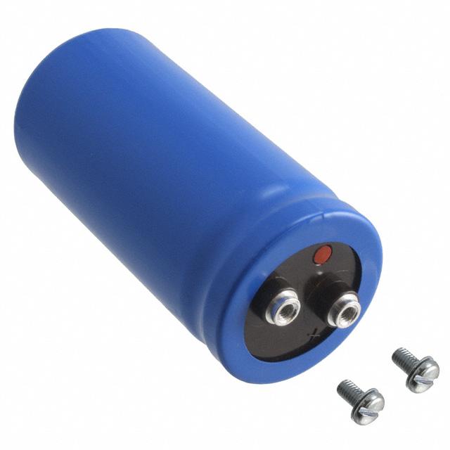

    1800 µF 450 V 铝电解电容器 径向,Can - 螺丝端子 78 毫欧 95°C 时为 5000 小时
500C182T450BF2B 数据手册
click here to see hardware and mounting options Type 500C 95 °C Long Life, Screw Terminal, Aluminum Long Life, High Capacitance Screw Terminal Type Type 500C capacitors are designed for mainframe computers and other long life UPS and power supply filter applications. They deliver nearly as much capacitance as the Type DCMC capacitors, but with two times the life expectancy. They are an excellent choice for high ripple applications. The extended cathode foil of the 500C assures cool operation with heat flow from the capacitor element to the can. Highlights Specifications - Long-life, High-Capacitance - Better for Power-supply and UPS systems - Thermal-Pak™ extended cathode construction Temperature Range –40 °C to +95 °C Rated Voltage Range 6.3 Vdc to 550 Vdc Capacitance Range 100 µF to 2.6 F Capacitance Tolerance –10% +75% ≤ 100 Vdc –10% +50% ≥ 160 Vdc Leakage Current ≤3 √CV µA, 4 mA max, 5 minutes Ripple Current Multipliers Ambient Temperature 45 ºC 55 ºC 65 ºC 75 ºC 85 ºC 2.00 1.82 1.59 1.33 1.00 Frequency 1 3/8” & 1 3/4” Diameters 6.3 to 160 V 200 to 350 V 400 to 500 V 2” & 2 1/2” Diameters 6.3 to 160 V 200 to 350 V 400 to 550 V 3” & 3 1/2” Diameters 6.3 to 160 V 200 to 350 V 400 to 550 V 50 60 120 360 1 5 10 kHz Hz Hz Hz Hz kHz kHz & up 0.91 0.93 1.00 1.06 1.08 1.10 1.10 0.76 0.81 1.00 1.24 1.36 1.43 1.44 0.76 0.81 1.00 1.24 1.37 1.44 1.45 0.93 0.95 1.00 1.04 1.06 1.06 1.07 0.78 0.83 1.00 1.20 1.29 1.34 1.35 0.77 0.82 1.00 1.22 1.33 1.39 1.40 0.95 0.97 1.00 1.03 1.04 1.04 1.04 0.84 0.88 1.00 1.12 1.17 1.20 1.20 0.79 0.84 1.00 1.18 1.26 1.31 1.32 Low Temperature Characteristics Impedance ratio: Z–20⁰C ∕ Z+25⁰C ≤ 20 (6.3–10 Vdc) ≤ 8 (16–50 Vdc) ≤ 4 (63–100 Vdc) ≤ 3 (150–550 Vdc) Endurance Life Test 5000 h at full load at 85 °C ∆ Capacitance ±20% ESR 200% of limit DCL 100% of limit Shelf Life Test 500 h at 95 °C Capacitance 100% of limit ESR 100% of limit DCL 100% of limit Vibration 10 to 55 Hz, 0.06” and 10 g max, 1.5 h each of 2 axes Regulatory Information CDM Cornell Dubilier • 140 Technology Place • Liberty, SC 29657 • Phone: (864)843-2277 • Fax: (864)843-3800 Type 500C 95 °C Long Life, Screw Terminal, Aluminum Long Life, High Capacitance Screw Terminal Type Part Numbering System 500C 492 T 200 CB 2 B Type Capacitance Tolerance Voltage Case Code Insulation 100 = 10 µF M = ±20% 6R3 = 6.3 Vdc 0= None 101 = 100 µF U = –10%+75% 063 = 63 Vdc 1= Polyester 492 = 4900 µF T = –10%+50% 200 = 200 Vdc 2= PVC 433= 43,000 µF Terminal A = Low Post B = High Post D = High Current, Low Post E = High Current, High Post F or M = M5 Post G = M6 Low Post H = M6 High Post Standard insulation is 0.008-in PVC sleeve with 0.01-in polypropylene end disk. Polyester insulation is not available for 3.5 inch diameter units. Outline Drawing D S Can Style Blank= Standard Can S= Stud Bottom P= Stud with Thermal Pad + S Stud Dimensions H +0 -.062 (+0 -1.57) L Case Stud P± 0.039” Diam. Thread (±1.0 mm) 1.375 M8 0.470” (12.0) 1.750 M8 0.470” (12.0) 2.000 M12 0.630” (16.0) 2.500 M12 0.630” (16.0) 3.000 M12 0.630” (16.0) 3.500 M12 0.630” (16.0) P Stud (Optional) NOTE: With the stud-mount feature, a thermally-conductive disk can be inserted in the bottom flush with the outer insulating sleeve.This reduces the thermal resistance through the can bottom by 0.3 °C/W. Can Style P. Terminal Dimensions For Case Post Diameter H max min Full Thread Torque Terminal Style Diameters Code in mm in mm Thread in mm in∙lb N∙m Low Post 1⅜ to 3 A 0.314 8.0 0.094 2.4 10–32 0.218 5.5 25 2.82 High Post 1⅜ to 3 B 0.314 8.0 0.281 7.1 10–32 0.375 9.5 25 2.82 High Current, Low 2½ to 3½ D 0.684 17.4 0.125 3.2 ¼–28 0.344 8.7 50 5.65 High Current, High 2½ to 3½ E 0.684 17.4 0.281 7.1 ¼–28 0.469 11.9 60 6.78 M5 Post, Small 1⅜ to 2 M 0.314 8.0 0.281 7.1 M5 0.375 9.5 25 2.82 M5 Post 2½ & 3 F 0.512 13.0 0.230 5.8 M5 0.344 8.7 25 2.82 M6 Low Post 2½ to 3½ G 0.684 17.4 0.125 3.2 M6 0.344 8.7 50 5.65 M6 High Post 2½ to 3½ H 0.684 17.4 0.281 7.1 M6 0.469 11.9 60 6.78 NOTE: Only high post and M5 post terminals are available at 550 Vdc as they meet the required creepage distance. CDM Cornell Dubilier • 140 Technology Place • Liberty, SC 29657 • Phone: (864)843-2277 • Fax: (864)843-3800 Type 500C 95 °C Long Life, Screw Terminal, Aluminum Long Life, High Capacitance Screw Terminal Type Uninsulated Case Dimensions For insulated case, add 0.024”(0.610 mm) to “D”and 0.030”(0.762 mm) to length. Diam. (D) Length (L) Terminals (S) Case Code ±.031 Inches ±.78 mm ±.062 Inches ±1.57 mm ±0.015 Inches ±.38 mm Typical Weight oz g AK 1.375 34.93 1.625 41.28 0.50 12.70 1.9 54 AA 1.375 34.93 2.125 53.98 0.50 12.70 2.0 57 AH 1.375 34.93 2.625 66.68 0.50 12.70 2.7 77 AB 1.375 34.93 3.125 79.38 0.50 12.70 3.3 94 AJ 1.375 34.93 3.625 92.08 0.50 12.70 3.8 108 AC 1.375 34.93 4.125 104.78 0.50 12.70 4.4 125 AD 1.375 34.93 4.625 117.48 0.50 12.70 5.1 145 AE 1.375 34.93 5.125 130.18 0.50 12.70 6.8 193 AF 1.375 34.93 5.625 142.88 0.50 12.70 8.1 230 EA 1.750 44.45 2.125 53.98 0.75 19.05 2.7 76 EH 1.750 44.45 2.625 66.68 0.75 19.05 3.8 108 EB 1.750 44.45 3.125 79.38 0.75 19.05 5.1 145 EJ 1.750 44.45 3.625 92.08 0.75 19.05 6.8 193 EC 1.750 44.45 4.125 104.78 0.75 19.05 8.1 230 ED 1.750 44.45 4.625 117.48 0.75 19.05 9.0 255 EE 1.750 44.45 5.125 130.18 0.75 19.05 9.5 269 EF 1.750 44.45 5.625 142.88 0.75 19.05 10.5 298 BA 2.000 50.80 2.125 53.98 0.88 22.23 5.4 153 BH 2.000 50.80 2.625 66.68 0.88 22.23 6.1 173 BB 2.000 50.80 3.125 79.38 0.88 22.23 6.8 193 BJ 2.000 50.80 3.625 92.08 0.88 22.23 8.2 232 BC 2.000 50.80 4.125 104.78 0.88 22.23 9.5 269 BD 2.000 50.80 4.625 117.48 0.88 22.23 10.3 292 BE 2.000 50.80 5.125 130.18 0.88 22.23 10.7 303 BF 2.000 50.80 5.625 142.88 0.88 22.23 13.0 369 CH 2.500 63.50 2.625 66.68 1.13 28.58 9.2 261 CB 2.500 63.50 3.125 79.38 1.13 28.58 10.4 295 CJ 2.500 63.50 3.625 92.08 1.13 28.58 12.7 361 CC 2.500 63.50 4.125 104.78 1.13 28.58 15.0 425 CD 2.500 63.50 4.625 117.48 1.13 28.58 17.2 488 CE 2.500 63.50 5.125 130.18 1.13 28.58 19.3 547 CF 2.500 63.50 5.625 142.88 1.13 28.58 21.4 607 DB 3.000 76.20 3.125 79.38 1.25 31.75 16.7 473 DJ 3.000 76.20 3.625 92.08 1.25 31.75 20.0 567 DC 3.000 76.20 4.125 104.78 1.25 31.75 22.2 629 DD 3.000 76.20 4.625 117.48 1.25 31.75 25.5 723 DE 3.000 76.20 5.125 130.18 1.25 31.75 30.0 850 904 DF 3.000 76.20 5.625 142.88 1.25 31.75 31.9 DP 3.000 76.20 5.875 149.23 1.25 31.75 32.8 931 DN 3.000 76.20 7.625 193.68 1.25 31.75 39.5 1119 DG 3.000 76.20 8.625 219.08 1.25 31.75 43.3 1227 FC 3.500 88.90 4.125 104.78 1.25 31.75 30.0 850 FD 3.500 88.90 4.625 117.48 1.25 31.75 34.4 976 FE 3.500 88.90 5.125 130.18 1.25 31.75 40.5 1148 FF 3.500 88.90 5.625 142.88 1.25 31.75 43.1 1221 FP 3.500 88.90 5.875 149.23 1.25 31.75 44.3 1257 FN 3.500 88.90 7.625 193.68 1.25 31.75 53.3 1512 FG 3.500 88.90 8.625 219.08 1.25 31.75 58.5 1658 CDM Cornell Dubilier • 140 Technology Place • Liberty, SC 29657 • Phone: (864)843-2277 • Fax: (864)843-3800 Type 500C 95 °C Long Life, Screw Terminal, Aluminum Long Life, High Capacitance Screw Terminal Type Ratings Cap. (µF) 27000 55000 66000 87000 96000 110000 120000 120000 130000 140000 150000 160000 170000 190000 190000 200000 230000 250000 250000 270000 300000 310000 340000 350000 360000 410000 420000 450000 500000 510000 580000 620000 680000 740000 760000 880000 980000 1100000 1100000 1100000 1200000 1400000 1600000 ESR Max. Ripple Max. @ 25 °C @ 85°C Catalog Part Number 120 Hz 120 Hz (mΩ) (A) 6.3 Vdc (8 Vdc Surge) 500C273U6R3AK2B 46.9 4.70 500C553U6R3AA2B 26.5 6.90 500C663U6R3AH2B 18.8 8.90 500C873U6R3AB2B 14.7 10.70 500C963U6R3EA2B 18.8 9.60 500C114U6R3AJ2B 12.8 12.10 500C124U6R3EH2B 14.3 11.80 500C124U6R3BA2B 14.2 12.00 500C134U6R3AC2B 11.0 13.70 500C144U6R3BH2B 9.9 15.50 500C154U6R3AD2B 9.8 15.20 500C164U6R3EB2B 11.0 14.30 500C174U6R3AE2B 8.9 16.50 500C194U6R3AF2B 8.3 17.80 500C194U6R3EJ2B 9.1 16.60 500C204U6R3BB2B 7.8 18.40 500C234U6R3EC2B 7.9 18.70 500C254U6R3BJ2B 6.5 21.40 500C254U6R3CH2B 6.9 21.20 500C274U6R3ED2B 7.0 20.60 500C304U6R3BC2B 5.6 24.10 500C314U6R3EE2B 6.4 22.40 500C344U6R3CB2B 5.3 25.80 500C354U6R3EF2B 6.0 24.00 500C364U6R3BD2B 5.0 26.60 500C414U6R3BE2B 4.5 28.80 500C424U6R3CJ2B 4.3 29.90 500C454U6R3BF2D 4.2 30.90 500C504U6R3DB2D 4.1 32.90 500C514U6R3CC2D 3.8 33.40 500C584U6R3CD2D 3.4 36.80 500C624U6R3DJ2D 3.3 38.20 500C684U6R3CE2D 3.1 40.00 500C744U6R3DC2D 2.9 42.50 500C764U6R3CF2D 2.8 42.90 500C884U6R3DD2D 2.6 46.70 500C984U6R3DE2D 2.4 50.60 500C115U6R3DF2D 2.4 51.30 500C115U6R3FC2D 3.0 46.40 500C115U6R3FD2D 2.6 51.00 500C125U6R3DP2D 2.4 52.00 500C145U6R3FE2D 2.4 55.40 500C165U6R3FF2D 2.4 56.10 Nominal Size DxL (inches) Cap. (µF) 1 3/8 x 1 5/8 1 3/8 x 2 1/8 1 3/8 x 2 5/8 1 3/8 x 3 1/8 1 3/4 x 2 1/8 1 3/8 x 3 5/8 1 3/4 x 2 5/8 2 x 2 1/8 1 3/8 x 4 1/8 2 x 2 5/8 1 3/8 x 4 5/8 1 3/4 x 3 1/8 1 3/8 x 5 1/8 1 3/8 x 5 5/8 1 3/4 x 3 5/8 2 x 3 1/8 1 3/4 x 4 1/8 2 x 3 5/8 2 1/2 x 2 5/8 1 3/4 x 4 5/8 2 x 4 1/8 1 3/4 x 5 1/8 2 1/2 x 3 1/8 1 3/4 x 5 5/8 2 x 4 5/8 2 x 5 1/8 2 1/2 x 3 5/8 2 x 5 5/8 3 x 3 1/8 2 1/2 x 4 1/8 2 1/2 x 4 5/8 3 x 3 5/8 2 1/2 x 5 1/8 3 x 4 1/8 2 1/2 x 5 5/8 3 x 4 5/8 3 x 5 1/8 3 x 5 5/8 3 1/2 x 4 1/8 3 1/2 x 4 5/8 3 x 5 7/8 3 1/2 x 5 1/8 3 1/2 x 5 5/8 1600000 1700000 1800000 2300000 2600000 22000 39000 52000 70000 71000 87000 95000 100000 100000 120000 130000 130000 140000 160000 160000 160000 190000 200000 200000 220000 240000 250000 270000 280000 280000 320000 340000 360000 400000 410000 480000 500000 550000 600000 610000 700000 800000 ESR Max. Ripple Max. @ 25 °C @ 85°C Nominal Size Catalog Part Number 120 Hz 120 Hz DxL (mΩ) (A) (inches) 6.3 Vdc (8 Vdc Surge) 500C165U6R3DN2D 2.6 55.90 3 x 7 5/8 500C175U6R3FP2D 2.4 57.00 3 1/2 x 5 7/8 500C185U6R3DG2D 2.4 58.60 3 x 8 5/8 500C235U6R3FN2D 2.4 61.70 3 1/2 x 7 5/8 500C265U6R3FG2D 2.4 64.40 3 1/2 x 8 5/8 10 Vdc (12 Vdc Surge) 500C223U010AK2B 46.9 4.70 1 3/8 x 1 5/8 500C393U010AA2B 26.5 6.90 1 3/8 x 2 1/8 500C523U010AH2B 20.1 8.60 1 3/8 x 2 5/8 500C703U010AB2B 15.5 10.50 1 3/8 x 3 1/8 500C713U010EA2B 18.8 9.60 1 3/4 x 2 1/8 500C873U010AJ2B 12.8 12.10 1 3/8 x 3 5/8 500C953U010EH2B 14.3 11.80 1 3/4 x 2 5/8 500C104U010AC2B 11.0 13.70 1 3/8 x 4 1/8 500C104U010BA2B 17.6 10.70 2 x 2 1/8 500C124U010AD2B 9.8 15.20 1 3/8 x 4 5/8 500C134U010EB2B 11.0 14.30 1 3/4 x 3 1/8 500C134U010BH2B 13.4 13.30 2 x 2 5/8 500C144U010AE2B 8.9 16.50 1 3/8 x 5 1/8 500C164U010AF2B 8.3 17.80 1 3/8 x 5 5/8 500C164U010EJ2B 9.1 16.60 1 3/4 x 3 5/8 500C164U010BB2B 10.5 16.00 2 x 3 1/8 500C194U010EC2B 7.9 18.70 1 3/4 x 4 1/8 500C204U010BJ2B 8.7 18.50 2 x 3 5/8 500C204U010CH2B 8.8 18.90 2 1/2 x 2 5/8 500C224U010ED2B 7.0 20.60 1 3/4 x 4 5/8 500C244U010BC2B 7.5 20.80 2 x 4 1/8 500C254U010EE2B 6.4 22.40 1 3/4 x 5 1/8 500C274U010CB2B 6.7 22.90 2 1/2 x 3 1/8 500C284U010EF2B 6.0 24.00 1 3/4 x 5 5/8 500C284U010BD2B 6.7 22.90 2 x 4 5/8 500C324U010BE2B 6.1 24.80 2 x 5 1/8 500C344U010CJ2B 5.5 26.50 2 1/2 x 3 5/8 500C364U010BF2B 5.7 26.50 2 x 5 5/8 500C404U010DB2D 4.1 32.90 3 x 3 1/8 500C414U010CC2B 4.8 29.60 2 1/2 x 4 1/8 500C484U010CD2D 4.3 32.60 2 1/2 x 4 5/8 500C504U010DJ2D 3.3 38.20 3 x 3 5/8 500C554U010CE2D 3.9 35.30 2 1/2 x 5 1/8 500C604U010DC2D 2.9 42.50 3 x 4 1/8 500C614U010CF2D 3.6 37.90 2 1/2 x 5 5/8 500C704U010DD2D 2.6 46.70 3 x 4 5/8 500C804U010DE2D 2.4 50.60 3 x 5 1/8 CDM Cornell Dubilier • 140 Technology Place • Liberty, SC 29657 • Phone: (864)843-2277 • Fax: (864)843-3800 Type 500C 95 °C Long Life, Screw Terminal, Aluminum Long Life, High Capacitance Screw Terminal Type Cap. (µF) 830000 870000 930000 970000 1100000 1200000 1300000 1300000 1500000 1700000 2000000 15000 27000 36000 48000 49000 61000 66000 71000 73000 85000 88000 90000 97000 110000 110000 110000 130000 140000 140000 150000 170000 180000 190000 200000 200000 220000 230000 250000 280000 280000 320000 350000 ESR Max. Ripple Max. @ 25 °C @ 85°C Catalog Part Number 120 Hz 120 Hz (mΩ) (A) 500C834U010FC2D 2.9 47.30 500C874U010DF2D 2.3 53.00 500C934U010DP2D 2.3 53.30 500C974U010FD2D 2.8 49.60 500C115U010FE2D 2.5 54.50 500C125U010FF2D 2.2 59.00 500C135U010FP2D 2.1 60.80 500C135U010DN2D 2.1 60.10 500C155U010DG2D 2.1 63.70 500C175U010FN2D 1.8 73.40 500C205U010FG2D 1.5 80.50 16 Vdc (20 Vdc Surge) 500C153U016AK2B 46.9 4.7 500C273U016AA2B 26.5 6.9 500C363U016AH2B 20.1 8.6 500C483U016AB2B 15.5 10.5 500C493U016EA2B 18.8 9.6 500C613U016AJ2B 12.8 12.1 500C663U016EH2B 15.3 11.4 500C713U016BA2B 17.6 10.7 500C733U016AC2B 11.0 13.7 500C853U016AD2B 9.8 15.20 500C883U016EB2B 12.5 13.50 500C903U016BH2B 13.4 13.30 500C973U016AE2B 8.9 16.50 500C114U016AF2B 8.3 17.80 500C114U016EJ2B 10.9 15.20 500C114U016BB2B 10.5 16.00 500C134U016EC2B 9.7 16.90 500C144U016BJ2B 8.7 18.50 500C144U016CH2B 8.8 18.90 500C154U016ED2B 8.8 18.50 500C174U016BC2B 7.5 20.80 500C184U016EE2B 8.2 19.90 500C194U016CB2B 6.7 22.90 500C204U016EF2B 7.8 21.10 500C204U016BD2B 6.7 22.90 500C224U016BE2B 6.1 24.80 500C234U016CJ2B 5.5 26.50 500C254U016BF2B 5.7 26.50 500C284U016CC2B 5.0 29.20 500C284U016DB2D 4.2 32.40 500C324U016CD2D 4.6 31.40 500C354U016DJ2D 3.6 36.80 Nominal Size DxL (inches) 3 1/2 x 4 1/8 3 x 5 5/8 3 x 5 7/8 3 1/2 x 4 5/8 3 1/2 x 5 1/8 3 1/2 x 5 5/8 3 1/2 x 5 7/8 3 x 7 5/8 3 x 8 5/8 3 1/2 x 7 5/8 3 1/2 x 8 5/8 1 3/8 x 1 5/8 1 3/8 x 2 1/8 1 3/8 x 2 5/8 1 3/8 x 3 1/8 1 3/4 x 2 1/8 1 3/8 x 3 5/8 1 3/4 x 2 5/8 2 x 2 1/8 1 3/8 x 4 1/8 1 3/8 x 4 5/8 1 3/4 x 3 1/8 2 x 2 5/8 1 3/8 x 5 1/8 1 3/8 x 5 5/8 1 3/4 x 3 5/8 2 x 3 1/8 1 3/4 x 4 1/8 2 x 3 5/8 2 1/2 x 2 5/8 1 3/4 x 4 5/8 2 x 4 1/8 1 3/4 x 5 1/8 2 1/2 x 3 1/8 1 3/4 x 5 5/8 2 x 4 5/8 2 x 5 1/8 2 1/2 x 3 5/8 2 x 5 5/8 2 1/2 x 4 1/8 3 x 3 1/8 2 1/2 x 4 5/8 3 x 3 5/8 Cap. (µF) 370000 420000 420000 490000 550000 600000 610000 640000 700000 800000 870000 870000 920000 1000000 1300000 1500000 11000 18000 26000 33000 34000 39000 43000 47000 ESR Max. Ripple Max. @ 25 °C @ 85°C Catalog Part Number 120 Hz 120 Hz (mΩ) (A) 500C374U016CE2D 4.4 33.40 500C424U016CF2D 4.2 35.20 500C424U016DC2D 3.3 40.20 500C494U016DD2D 3.1 42.80 500C554U016DE2D 2.8 46.20 500C604U016FC2D 2.9 47.30 500C614U016DF2D 2.8 48.10 500C644U016DP2D 2.8 48.80 500C704U016FD2D 2.8 49.70 500C804U016FE2D 2.5 54.40 500C874U016FF2D 2.4 56.70 500C874U016DN2D 2.6 54.10 500C924U016FP2D 2.4 57.30 500C105U016DG2D 2.6 57.10 500C135U016FN2D 2.3 63.10 500C155U016FG2D 2.3 66.40 25 Vdc (30 Vdc Surge) 500C113U025AK2B 37.1 5.30 500C183U025AA2B 23.6 7.40 500C263U025AH2B 16.9 9.40 500C333U025EA2B 21.8 8.90 500C343U025AB2B 17.1 10.00 500C393U025EH2B 19.4 10.20 500C433U025AJ2B 17.7 10.30 500C473U025BA2B 21.8 9.70 Nominal Size DxL (inches) 2 1/2 x 5 1/8 2 1/2 x 5 5/8 3 x 4 1/8 3 x 4 5/8 3 x 5 1/8 3 1/2 x 4 1/8 3 x 5 5/8 3 x 5 7/8 3 1/2 x 4 5/8 3 1/2 x 5 1/8 3 1/2 x 5 5/8 3 x 7 5/8 3 1/2 x 5 7/8 3 x 8 5/8 3 1/2 x 7 5/8 3 1/2 x 8 5/8 1 3/8 x 1 5/8 1 3/8 x 2 1/8 1 3/8 x 2 5/8 1 3/4 x 2 1/8 1 3/8 x 3 1/8 1 3/4 x 2 5/8 1 3/8 x 3 5/8 2 x 2 1/8 51000 500C513U025AC2B 16.3 11.30 1 3/8 x 4 1/8 53000 500C533U025BH2B 16.5 12.00 2 x 2 5/8 54000 500C543U025EB2B 15.2 12.20 1 3/4 x 3 1/8 60000 500C603U025AD2B 15.4 12.10 1 3/8 x 4 5/8 69000 500C693U025AE2B 14.4 13.00 1 3/8 x 5 1/8 69000 500C693U025BB2B 12.2 14.80 2 x 3 1/8 70000 500C703U025EJ2B 12.8 14.10 1 3/4 x 3 5/8 77000 500C773U025AF2B 13.4 14.00 1 3/8 x 5 5/8 82000 500C823U025CH2B 9.5 18.10 2 1/2 x 2 5/8 86000 500C863U025EC2B 11.2 15.70 1 3/4 x 4 1/8 89000 500C893U025BJ2B 9.8 17.40 2 x 3 5/8 100000 500C104U025ED2B 10.2 17.10 1 3/4 x 4 5/8 110000 500C114U025BC2B 8.3 19.70 2 x 4 1/8 110000 500C114U025CB2B 7.6 21.50 2 1/2 x 3 1/8 120000 500C124U025EE2B 9.6 18.40 1 3/4 x 5 1/8 130000 500C134U025EF2B 9.1 19.50 1 3/4 x 5 5/8 130000 500C134U025BD2B 7.3 21.90 2 x 4 5/8 150000 500C154U025BE2B 6.6 23.90 2 x 5 1/8 150000 500C154U025CJ2B 6.4 24.60 2 1/2 x 3 5/8 CDM Cornell Dubilier • 140 Technology Place • Liberty, SC 29657 • Phone: (864)843-2277 • Fax: (864)843-3800 Type 500C 95 °C Long Life, Screw Terminal, Aluminum Long Life, High Capacitance Screw Terminal Type Cap. (µF) 170000 170000 180000 210000 220000 250000 270000 280000 320000 370000 390000 420000 440000 460000 530000 600000 610000 630000 710000 870000 1000000 6600 11000 16000 20000 21000 24000 26000 26000 32000 33000 34000 37000 42000 43000 43000 48000 51000 53000 55000 62000 67000 ESR Max. Ripple Max. @ 25 °C @ 85°C Catalog Part Number 120 Hz 120 Hz (mΩ) (A) 500C174U025BF2B 6.1 25.70 500C174U025DB2B 5.0 29.70 500C184U025CC2B 5.8 27.00 500C214U025CD2B 5.2 29.50 500C224U025DJ2D 4.3 31.10 500C254U025CE2D 5.0 33.60 500C274U025DC2D 3.9 36.90 500C284U025CF2D 4.6 33.70 500C324U025DD2D 3.5 40.00 500C374U025DE2D 3.3 42.70 500C394U025FC2D 3.8 40.90 500C424U025DF2D 3.2 44.90 500C444U025DP2D 3.1 46.50 500C464U025FD2D 3.5 44.40 500C534U025FE2D 3.2 47.40 500C604U025FF2D 3.1 50.20 500C614U025DN2D 3.1 50.20 500C634U025FP2D 2.9 51.80 500C714U025DG2D 3.0 52.80 500C874U025FN2D 3.0 55.60 500C105U025FG2D 2.9 58.30 35 Vdc (40 Vdc Surge) 500C662U035AK2B 41.7 5.00 500C113U035AA2B 26.7 6.90 500C163U035AH2B 19.5 8.70 500C203U035EA2B 22.3 8.80 500C213U035AB2B 19.4 9.30 500C243U035EH2B 19.2 10.20 500C263U035AJ2B 19.7 9.80 500C263U035BA2B 24.5 9.10 500C323U035AC2B 18.7 10.50 500C333U035BH2B 20.1 10.80 500C343U035EB2B 15.5 12.10 500C373U035AD2B 16.7 11.60 500C423U035AE2B 14.8 12.90 500C433U035EJ2B 13.2 13.80 500C433U035BB2B 15.9 13.00 500C483U035AF2B 13.5 14.00 500C513U035CH2B 14.8 14.50 500C533U035EC2B 11.8 15.30 500C553U035BJ2B 13.2 15.00 500C623U035ED2B 10.6 16.80 500C673U035BC2B 11.6 16.70 Nominal Size DxL (inches) 2 x 5 5/8 3 x 3 1/8 2 1/2 x 4 1/8 2 1/2 x 4 5/8 3 x 3 5/8 2 1/2 x 5 1/8 3 x 4 1/8 2 1/2 x 5 5/8 3 x 4 5/8 3 x 5 1/8 3 1/2 x 4 1/8 3 x 5 5/8 3 x 5 7/8 3 1/2 x 4 5/8 3 1/2 x 5 1/8 3 1/2 x 5 5/8 3 x 7 5/8 3 1/2 x 5 7/8 3 x 8 5/8 3 1/2 x 7 5/8 3 1/2 x 8 5/8 1 3/8 x 1 5/8 1 3/8 x 2 1/8 1 3/8 x 2 5/8 1 3/4 x 2 1/8 1 3/8 x 3 1/8 1 3/4 x 2 5/8 1 3/8 x 3 5/8 2 x 2 1/8 1 3/8 x 4 1/8 2 x 2 5/8 1 3/4 x 3 1/8 1 3/8 x 4 5/8 1 3/8 x 5 1/8 1 3/4 x 3 5/8 2 x 3 1/8 1 3/8 x 5 5/8 2 1/2 x 2 5/8 1 3/4 x 4 1/8 2 x 3 5/8 1 3/4 x 4 5/8 2 x 4 1/8 Cap. (µF) 71000 72000 80000 82000 91000 92000 100000 110000 110000 130000 140000 150000 170000 170000 200000 230000 240000 260000 270000 280000 330000 370000 380000 390000 440000 540000 630000 4500 7600 11000 14000 14000 16000 17000 18000 ESR Max. Ripple Max. @ 25 °C @ 85°C Catalog Part Number 120 Hz 120 Hz (mΩ) (A) 500C713U035CB2B 11.5 17.50 500C723U035EE2B 9.8 18.20 500C803U035BD2B 10.5 18.20 500C823U035EF2B 9.4 19.20 500C913U035CJ2B 9.4 20.30 500C923U035BE2B 9.8 19.50 500C104U035BF2B 9.4 20.70 500C114U035CC2B 8.2 22.60 500C114U035DB2B 6.9 25.30 500C134U035CD2B 7.4 24.80 500C144U035DJ2B 5.7 29.10 500C154U035CE2B 6.8 26.80 500C174U035CF2B 6.1 29.20 500C174U035DC2D 5.2 32.00 500C204U035DD2D 4.7 34.80 500C234U035DE2D 4.4 37.20 500C244U035FC2D 4.9 36.00 500C264U035DF2D 4.0 39.90 500C274U035DP2D 3.9 41.30 500C284U035FD2D 4.5 39.00 500C334U035FE2D 4.0 42.60 500C374U035FF2D 3.6 46.00 500C384U035DN2D 3.8 45.30 500C394U035FP2D 3.5 47.50 500C444U035DG2D 3.6 48.10 500C544U035FN2D 3.4 52.10 500C634U035FG2D 3.3 55.20 50 Vdc (65 Vdc Surge) 500C452U050AK2B 47.9 4.70 500C762U050AA2B 30.9 6.40 500C113U050AH2B 21.8 8.30 500C143U050AB2B 20.9 9.00 500C143U050EA2B 22.8 8.70 500C163U050EH2B 20.2 10.00 500C173U050BA2B 25.3 9.00 500C183U050AJ2B 17.8 10.30 Nominal Size DxL (inches) 2 1/2 x 3 1/8 1 3/4 x 5 1/8 2 x 4 5/8 1 3/4 x 5 5/8 2 1/2 x 3 5/8 2 x 5 1/8 2 x 5 5/8 2 1/2 x 4 1/8 3 x 3 1/8 2 1/2 x 4 5/8 3 x 3 5/8 2 1/2 x 5 1/8 2 1/2 x 5 5/8 3 x 4 1/8 3 x 4 5/8 3 x 5 1/8 3 1/2 x 4 1/8 3 x 5 5/8 3 x 5 7/8 3 1/2 x 4 5/8 3 1/2 x 5 1/8 3 1/2 x 5 5/8 3 x 7 5/8 3 1/2 x 5 7/8 3 x 8 5/8 3 1/2 x 7 5/8 3 1/2 x 8 5/8 1 3/8 x 1 5/8 1 3/8 x 2 1/8 1 3/8 x 2 5/8 1 3/8 x 3 1/8 1 3/4 x 2 1/8 1 3/4 x 2 5/8 2 x 2 1/8 1 3/8 x 3 5/8 21000 500C213U050AC2B 17.3 11.00 1 3/8 x 4 1/8 22000 500C223U050BH2B 20.8 10.70 2 x 2 5/8 23000 500C233U050EB2B 15.6 12.10 1 3/4 x 3 1/8 25000 500C253U050AD2B 16.8 11.60 1 3/8 x 4 5/8 29000 500C293U050AE2B 15.1 12.70 1 3/8 x 5 1/8 29000 500C293U050EJ2B 13.5 13.60 1 3/4 x 3 5/8 29000 500C293U050BB2B 16.3 12.80 2 x 3 1/8 32000 500C323U050AF2B 13.8 13.80 1 3/8 x 5 5/8 CDM Cornell Dubilier • 140 Technology Place • Liberty, SC 29657 • Phone: (864)843-2277 • Fax: (864)843-3800 Type 500C 95 °C Long Life, Screw Terminal, Aluminum Long Life, High Capacitance Screw Terminal Type Cap. (µF) 34000 36000 37000 42000 46000 48000 49000 54000 55000 62000 62000 70000 72000 75000 89000 92000 100000 110000 120000 130000 150000 150000 170000 180000 180000 200000 230000 250000 260000 300000 340000 400000 3400 5800 8200 11000 11000 12000 13000 14000 15000 ESR Max. Ripple Max. @ 25 °C @ 85°C Catalog Part Number 120 Hz 120 Hz (mΩ) (A) 500C343U050CH2B 15.1 14.40 500C363U050EC2B 12.0 15.20 500C373U050BJ2B 13.6 14.80 500C423U050ED2B 10.8 16.60 500C463U050BC2B 11.9 16.50 500C483U050CB2B 12.0 17.10 500C493U050EE2B 9.8 18.10 500C543U050BD2B 10.8 18.00 500C553U050EF2B 9.5 19.10 500C623U050BE2B 10.0 19.40 500C623U050CJ2B 10.3 19.40 500C703U050BF2B 9.5 20.50 500C723U050DB2B 9.1 22.00 500C753U050CC2B 8.9 21.80 500C893U050CD2B 7.9 24.00 500C923U050DJ2B 7.7 25.10 500C104U050CE2B 7.2 26.00 500C114U050DC2B 6.9 27.60 500C124U050CF2B 6.7 27.90 500C134U050DD2D 6.1 30.40 500C154U050DE2D 5.9 32.00 500C154U050FC2D 6.4 31.70 500C174U050DF2D 5.6 33.80 500C184U050DP2D 5.4 35.00 500C184U050FD2D 5.7 34.70 500C204U050FE2D 5.4 36.80 500C234U050FF2D 5.0 39.00 500C254U050FP2D 5.0 40.00 500C264U050DN2D 5.0 42.00 500C304U050DG2D 4.0 45.00 500C344U050FN2D 4.0 47.00 500C404U050FG2D 4.0 51.00 63 Vdc (75 Vdc Surge) 500C342U063AK2B 60.6 4.10 500C582U063AA2B 39.0 5.70 500C822U063AH2B 27.4 7.40 500C113U063AB2B 25.2 8.20 500C113U063EA2B 27.9 7.90 500C123U063EH2B 25.6 8.80 500C133U063BA2B 28.0 8.50 500C143U063AJ2B 23.7 8.90 500C153U063BH2B 22.6 10.20 Nominal Size DxL (inches) 2 1/2 x 2 5/8 1 3/4 x 4 1/8 2 x 3 5/8 1 3/4 x 4 5/8 2 x 4 1/8 2 1/2 x 3 1/8 1 3/4 x 5 1/8 2 x 4 5/8 1 3/4 x 5 5/8 2 x 5 1/8 2 1/2 x 3 5/8 2 x 5 5/8 3 x 3 1/8 2 1/2 x 4 1/8 2 1/2 x 4 5/8 3 x 3 5/8 2 1/2 x 5 1/8 3 x 4 1/8 2 1/2 x 5 5/8 3 x 4 5/8 3 x 5 1/8 3 1/2 x 4 1/8 3 x 5 5/8 3 x 5 7/8 3 1/2 x 4 5/8 3 1/2 x 5 1/8 3 1/2 x 5 5/8 3 1/2 x 5 7/8 3 x 7 5/8 3 x 8 5/8 3 1/2 x 7 5/8 3 1/2 x 8 5/8 1 3/8 x 1 5/8 1 3/8 x 2 1/8 1 3/8 x 2 5/8 1 3/8 x 3 1/8 1 3/4 x 2 1/8 1 3/4 x 2 5/8 2 x 2 1/8 1 3/8 x 3 5/8 2 x 2 5/8 Cap. (µF) 16000 17000 19000 20000 22000 22000 24000 25000 26000 27000 32000 32000 34000 37000 38000 42000 43000 44000 49000 50000 53000 62000 65000 72000 79000 82000 93000 110000 110000 120000 130000 130000 150000 170000 180000 180000 210000 250000 290000 2700 ESR Max. Ripple Max. @ 25 °C @ 85°C Catalog Part Number 120 Hz 120 Hz (mΩ) (A) 63 Vdc (75 Vdc Surge) 500C163U063AC2B 20.4 10.10 500C173U063EB2B 19.5 10.80 500C193U063AD2B 18.1 11.20 500C203U063BB2B 18.1 12.10 500C223U063AE2B 16.4 12.20 500C223U063EJ2B 16.2 12.50 500C243U063CH2B 26.8 10.80 500C253U063AF2B 15.1 13.20 500C263U063BJ2B 15.1 14.00 500C273U063EC2B 14.2 14.00 500C323U063ED2B 12.8 15.30 500C323U063BC2B 13.3 15.60 500C343U063CB2B 19.3 13.50 500C373U063EE2B 11.8 16.50 500C383U063BD2B 12.1 17.00 500C423U063EF2B 11.2 17.60 500C433U063CJ2B 17.1 15.10 500C443U063BE2B 11.3 18.30 500C493U063BF2B 10.7 19.40 500C503U063DB2B 14.9 17.20 500C533U063CC2B 13.7 17.50 500C623U063CD2B 11.8 19.60 500C653U063DJ2B 12.1 20.00 500C723U063CE2B 11.0 21.10 500C793U063DC2B 10.8 22.10 500C823U063CF2B 10.5 22.30 500C933U063DD2B 9.9 23.90 500C114U063DE2B 8.8 26.30 500C114U063FC2D 9.9 25.40 500C124U063DF2B 7.9 28.50 500C134U063DP2B 7.5 29.60 500C134U063FD2D 9.0 27.60 500C154U063FE2D 7.9 30.30 500C174U063FF2D 7.2 32.80 500C184U063DN2D 6.5 35.00 500C184U063FP2D 6.8 34.00 500C214U063DG2D 5.7 38.30 500C254U063FN2D 5.8 40.20 500C294U063FG2D 5.2 43.90 75 Vdc (95 Vdc Surge) 500C272U075AK2B 76.2 3.70 Nominal Size DxL (inches) 1 3/8 x 4 1/8 1 3/4 x 3 1/8 1 3/8 x 4 5/8 2 x 3 1/8 1 3/8 x 5 1/8 1 3/4 x 3 5/8 2 1/2 x 2 5/8 1 3/8 x 5 5/8 2 x 3 5/8 1 3/4 x 4 1/8 1 3/4 x 4 5/8 2 x 4 1/8 2 1/2 x 3 1/8 1 3/4 x 5 1/8 2 x 4 5/8 1 3/4 x 5 5/8 2 1/2 x 3 5/8 2 x 5 1/8 2 x 5 5/8 3 x 3 1/8 2 1/2 x 4 1/8 2 1/2 x 4 5/8 3 x 3 5/8 2 1/2 x 5 1/8 3 x 4 1/8 2 1/2 x 5 5/8 3 x 4 5/8 3 x 5 1/8 3 1/2 x 4 1/8 3 x 5 5/8 3 x 5 7/8 3 1/2 x 4 5/8 3 1/2 x 5 1/8 3 1/2 x 5 5/8 3 x 7 5/8 3 1/2 x 5 7/8 3 x 8 5/8 3 1/2 x 7 5/8 3 1/2 x 8 5/8 1 3/8 x 1 5/8 CDM Cornell Dubilier • 140 Technology Place • Liberty, SC 29657 • Phone: (864)843-2277 • Fax: (864)843-3800 Type 500C 95 °C Long Life, Screw Terminal, Aluminum Long Life, High Capacitance Screw Terminal Type Cap. (µF) 4300 6400 8300 8600 9800 10000 11000 11000 13000 14000 15000 16000 17000 18000 19000 19000 21000 21000 25000 25000 26000 29000 30000 33000 34000 34000 39000 40000 42000 49000 51000 57000 62000 64000 74000 85000 85000 96000 100000 100000 ESR Max. Ripple Max. @ 25 °C @ 85°C Catalog Part Number 120 Hz 120 Hz (mΩ) (A) 75 Vdc (95 Vdc Surge) 500C432U075AA2B 50.7 5.00 500C642U075AH2B 35.0 6.50 500C832U075EA2B 55.6 5.60 500C862U075AB2B 34.0 7.10 500C982U075EH2B 47.3 6.50 500C103U075BA2B 34.8 7.70 500C113U075AJ2B 31.1 7.80 500C113U075BH2B 27.5 9.30 500C133U075AC2B 28.2 8.60 500C143U075EB2B 34.1 8.20 500C153U075AD2B 24.5 9.60 500C163U075BB2B 21.4 11.20 500C173U075AE2B 22.5 10.40 500C183U075EJ2B 26.9 9.70 500C193U075AF2B 20.4 11.30 500C193U075CH2B 30.0 10.20 500C213U075EC2B 22.3 11.10 500C213U075BJ2B 18.0 12.80 500C253U075ED2B 19.2 12.50 500C253U075BC2B 15.6 14.40 500C263U075CB2B 21.6 12.70 500C293U075EE2B 16.9 13.80 500C303U075BD2B 13.9 15.80 500C333U075EF2B 15.2 15.10 500C343U075BE2B 12.8 17.10 500C343U075CJ2B 17.8 14.80 500C393U075BF2B 12.0 18.30 500C403U075DB2B 18.0 15.60 500C423U075CC2B 15.1 16.70 500C493U075CD2B 13.5 18.40 500C513U075DJ2B 14.4 18.30 500C573U075CE2B 12.0 20.20 500C623U075DC2B 12.9 20.20 500C643U075CF2B 11.2 21.50 500C743U075DD2B 11.8 21.90 500C853U075DE2B 10.4 24.10 500C853U075FC2D 11.8 23.20 500C963U075DF2B 9.4 26.20 500C104U075DP2B 8.9 27.20 500C104U075FD2D 10.7 25.30 Nominal Size DxL (inches) 1 3/8 x 2 1/8 1 3/8 x 2 5/8 1 3/4 x 2 1/8 1 3/8 x 3 1/8 1 3/4 x 2 5/8 2 x 2 1/8 1 3/8 x 3 5/8 2 x 2 5/8 1 3/8 x 4 1/8 1 3/4 x 3 1/8 1 3/8 x 4 5/8 2 x 3 1/8 1 3/8 x 5 1/8 1 3/4 x 3 5/8 1 3/8 x 5 5/8 2 1/2 x 2 5/8 1 3/4 x 4 1/8 2 x 3 5/8 1 3/4 x 4 5/8 2 x 4 1/8 2 1/2 x 3 1/8 1 3/4 x 5 1/8 2 x 4 5/8 1 3/4 x 5 5/8 2 x 5 1/8 2 1/2 x 3 5/8 2 x 5 5/8 3 x 3 1/8 2 1/2 x 4 1/8 2 1/2 x 4 5/8 3 x 3 5/8 2 1/2 x 5 1/8 3 x 4 1/8 2 1/2 x 5 5/8 3 x 4 5/8 3 x 5 1/8 3 1/2 x 4 1/8 3 x 5 5/8 3 x 5 7/8 3 1/2 x 4 5/8 120000 500C124U075FE2D 9.4 27.80 3 1/2 x 5 1/8 130000 500C134U075FF2D 8.4 30.20 3 1/2 x 5 5/8 140000 500C144U075DN2D 7.7 32.10 3 x 7 5/8 Cap. (µF) 140000 160000 190000 220000 1600 2500 3800 4900 5100 5100 5800 6300 7300 7600 8100 8900 10000 10000 10000 11000 12000 13000 13000 15000 16000 17000 17000 19000 20000 22000 22000 25000 25000 27000 32000 33000 36000 40000 41000 47000 54000 55000 62000 ESR Max. Ripple Max. @ 25 °C @ 85°C Catalog Part Number 120 Hz 120 Hz (mΩ) (A) 500C144U075FP2D 8.1 31.30 500C164U075DG2D 6.8 35.10 500C194U075FN2D 6.9 36.80 500C224U075FG2D 6.2 40.20 100 Vdc (125 Vdc Surge) 500C162U100AK2B 98.4 3.30 500C252U100AA2B 60.2 4.60 500C382U100AH2B 42.7 5.90 500C492U100EA2B 62.0 5.30 500C512U100AB2B 38.2 6.70 500C512U100BA2B 51.8 6.30 500C582U100EH2B 52.8 6.20 500C632U100AJ2B 33.0 7.60 500C732U100BH2B 37.8 7.90 500C762U100AC2B 30.7 8.20 500C812U100EB2B 38.0 7.70 500C892U100AD2B 29.0 8.80 500C103U100AE2B 28.3 9.30 500C103U100EJ2B 29.9 9.20 500C103U100BB2B 30.6 9.30 500C113U100AF2B 27.6 9.70 500C123U100CH2B 33.7 9.60 500C133U100EC2B 24.8 10.60 500C133U100BJ2B 22.3 11.50 500C153U100ED2B 21.2 11.90 500C163U100BC2B 19.9 12.80 500C173U100EE2B 18.7 13.10 500C173U100CB2B 23.4 12.30 500C193U100BD2B 17.7 14.10 500C203U100EF2B 16.8 14.30 500C223U100BE2B 15.6 15.50 500C223U100CJ2B 19.1 14.30 500C253U100BF2B 14.9 16.40 500C253U100DB2B 19.9 14.90 500C273U100CC2B 16.5 16.00 500C323U100CD2B 14.7 17.60 500C333U100DJ2B 16.4 17.20 500C363U100CE2B 13.4 19.10 500C403U100DC2B 14.4 19.10 500C413U100CF2B 12.5 20.40 500C473U100DD2B 13.0 20.90 500C543U100DE2B 12.0 22.50 500C553U100FC2D 13.4 21.80 500C623U100DF2B 11.2 23.90 Nominal Size DxL (inches) 3 1/2 x 5 7/8 3 x 8 5/8 3 1/2 x 7 5/8 3 1/2 x 8 5/8 1 3/8 x 1 5/8 1 3/8 x 2 1/8 1 3/8 x 2 5/8 1 3/4 x 2 1/8 1 3/8 x 3 1/8 2 x 2 1/8 1 3/4 x 2 5/8 1 3/8 x 3 5/8 2 x 2 5/8 1 3/8 x 4 1/8 1 3/4 x 3 1/8 1 3/8 x 4 5/8 1 3/8 x 5 1/8 1 3/4 x 3 5/8 2 x 3 1/8 1 3/8 x 5 5/8 2 1/2 x 2 5/8 1 3/4 x 4 1/8 2 x 3 5/8 1 3/4 x 4 5/8 2 x 4 1/8 1 3/4 x 5 1/8 2 1/2 x 3 1/8 2 x 4 5/8 1 3/4 x 5 5/8 2 x 5 1/8 2 1/2 x 3 5/8 2 x 5 5/8 3 x 3 1/8 2 1/2 x 4 1/8 2 1/2 x 4 5/8 3 x 3 5/8 2 1/2 x 5 1/8 3 x 4 1/8 2 1/2 x 5 5/8 3 x 4 5/8 3 x 5 1/8 3 1/2 x 4 1/8 3 x 5 5/8 CDM Cornell Dubilier • 140 Technology Place • Liberty, SC 29657 • Phone: (864)843-2277 • Fax: (864)843-3800 Type 500C 95 °C Long Life, Screw Terminal, Aluminum Long Life, High Capacitance Screw Terminal Type Cap. (µF) 65000 65000 74000 84000 89000 94000 110000 120000 140000 750 1200 1500 2100 2300 2400 2700 2700 3300 3500 3800 3900 4500 4900 4900 5100 5500 6000 6300 7100 7700 7700 8200 9100 9300 9900 10000 11000 12000 12000 14000 ESR Max. Ripple Max. @ 25 °C @ 85°C Catalog Part Number 120 Hz 120 Hz (mΩ) (A) 100 Vdc (125 Vdc Surge) 500C653U100DP2B 11.1 24.40 500C653U100FD2D 12.1 23.80 500C743U100FE2D 10.9 25.90 500C843U100FF2D 10.2 27.50 500C893U100FP2D 10.0 28.10 500C943U100DN2D 9.2 29.40 500C114U100DG2D 8.2 32.10 500C124U100FN2D 8.3 33.70 500C144U100FG2D 7.3 36.80 160 Vdc (200 Vdc) 500C751T160AK2B 150.0 2.60 500C122T160AA2B 93.0 3.70 500C152T160AH2B 70.5 4.60 500C212T160AB2B 58.5 5.40 500C232T160EA2B 62.0 5.30 500C242T160BA2B 70.5 5.40 500C272T160AJ2B 50.2 6.10 500C272T160EH2B 52.8 6.20 500C332T160AC2B 42.9 7.00 500C352T160BH2B 46.5 7.10 500C382T160EB2B 38.0 7.70 500C392T160AD2B 37.7 7.70 500C452T160AE2B 34.7 8.40 500C492T160EJ2B 29.9 9.20 500C492T160BB2B 33.5 8.90 500C512T160AF2B 32.2 9.00 500C552T160CH2B 30.1 10.20 500C602T160EC2B 24.8 10.60 500C632T160BJ2B 26.4 10.60 500C712T160ED2B 21.2 11.90 500C772T160BC2B 21.9 12.20 500C772T160CB2B 21.3 12.80 500C822T160EE2B 18.7 13.10 500C912T160BD2B 18.8 13.60 500C932T160EF2B 16.8 14.30 500C992T160CJ2B 17.0 15.10 500C103T160BE2B 16.6 15.00 500C113T160DB2B 14.7 17.30 500C123T160BF2B 14.9 16.40 500C123T160CC2B 14.1 17.30 500C143T160CD2B 11.9 19.60 Nominal Size DxL (inches) Cap. (µF) 3 x 5 7/8 3 1/2 x 4 5/8 3 1/2 x 5 1/8 3 1/2 x 5 5/8 3 1/2 x 5 7/8 3 x 7 5/8 3 x 8 5/8 3 1/2 x 7 5/8 3 1/2 x 8 5/8 15000 16000 18000 19000 21000 25000 25000 28000 29000 29000 34000 38000 40000 41000 47000 56000 65000 1 3/8 x 1 5/8 1 3/8 x 2 1/8 1 3/8 x 2 5/8 1 3/8 x 3 1/8 1 3/4 x 2 1/8 2 x 2 1/8 1 3/8 x 3 5/8 1 3/4 x 2 5/8 1 3/8 x 4 1/8 2 x 2 5/8 1 3/4 x 3 1/8 1 3/8 x 4 5/8 1 3/8 x 5 1/8 1 3/4 x 3 5/8 2 x 3 1/8 1 3/8 x 5 5/8 2 1/2 x 2 5/8 1 3/4 x 4 1/8 2 x 3 5/8 1 3/4 x 4 5/8 2 x 4 1/8 2 1/2 x 3 1/8 1 3/4 x 5 1/8 2 x 4 5/8 1 3/4 x 5 5/8 2 1/2 x 3 5/8 2 x 5 1/8 3 x 3 1/8 2 x 5 5/8 2 1/2 x 4 1/8 2 1/2 x 4 5/8 540 770 970 1400 1500 1600 1700 1700 2100 2200 2400 2500 2900 3100 3100 3300 3500 3800 4000 4500 4900 4900 5200 ESR Max. Ripple Max. @ 25 °C @ 85°C Catalog Part Number 120 Hz 120 Hz (mΩ) (A) 160 Vdc (200 Vdc) 500C153T160DJ2B 11.5 20.50 500C163T160CE2B 10.7 21.30 500C183T160DC2B 9.6 23.40 500C193T160CF2B 9.6 23.20 500C213T160DD2B 8.2 26.20 500C253T160DE2B 7.3 28.90 500C253T160FC2D 9.2 26.40 500C283T160DF2D 6.5 31.40 500C293T160DP2D 6.2 32.60 500C293T160FD2D 7.9 29.50 500C343T160FE2D 6.9 32.40 500C383T160FF2D 6.2 35.10 500C403T160FP2D 5.9 36.50 500C413T160DN2D 5.1 39.80 500C473T160DG2D 4.3 44.00 500C563T160FN2D 4.9 44.30 500C653T160FG2D 4.2 48.80 200 Vdc (250 Vdc Surge) 500C541T200AK2B 206.0 2.30 500C771T200AA2B 140.0 3.00 500C971T200AH2B 101.0 3.90 500C142T200AB2B 78.5 4.60 500C152T200EA2B 79.1 4.70 500C162T200BA2B 82.0 5.00 500C172T200AJ2B 63.9 5.40 500C172T200EH2B 62.5 5.70 500C212T200AC2B 51.7 6.30 500C222T200BH2B 61.0 6.20 500C242T200EB2B 48.4 6.90 500C252T200AD2B 43.2 7.20 500C292T200AE2B 37.8 8.00 500C312T200EJ2B 37.9 8.20 500C312T200BB2B 46.1 7.60 500C332T200AF2B 33.4 8.90 500C352T200CH2B 42.2 8.60 500C382T200EC2B 31.3 9.40 500C402T200BJ2B 36.2 9.00 500C452T200ED2B 26.8 10.60 500C492T200BC2B 28.5 10.60 500C492T200CB2B 31.2 10.60 500C522T200EE2B 23.5 11.70 Nominal Size DxL (inches) 3 x 3 5/8 2 1/2 x 5 1/8 3 x 4 1/8 2 1/2 x 5 5/8 3 x 4 5/8 3 x 5 1/8 3 1/2 x 4 1/8 3 x 5 5/8 3 x 5 7/8 3 1/2 x 4 5/8 3 1/2 x 5 1/8 3 1/2 x 5 5/8 3 1/2 x 5 7/8 3 x 7 5/8 3 x 8 5/8 3 1/2 x 7 5/8 3 1/2 x 8 5/8 1 3/8 x 1 5/8 1 3/8 x 2 1/8 1 3/8 x 2 5/8 1 3/8 x 3 1/8 1 3/4 x 2 1/8 2 x 2 1/8 1 3/8 x 3 5/8 1 3/4 x 2 5/8 1 3/8 x 4 1/8 2 x 2 5/8 1 3/4 x 3 1/8 1 3/8 x 4 5/8 1 3/8 x 5 1/8 1 3/4 x 3 5/8 2 x 3 1/8 1 3/8 x 5 5/8 2 1/2 x 2 5/8 1 3/4 x 4 1/8 2 x 3 5/8 1 3/4 x 4 5/8 2 x 4 1/8 2 1/2 x 3 1/8 1 3/4 x 5 1/8 CDM Cornell Dubilier • 140 Technology Place • Liberty, SC 29657 • Phone: (864)843-2277 • Fax: (864)843-3800 Type 500C 95 °C Long Life, Screw Terminal, Aluminum Long Life, High Capacitance Screw Terminal Type Cap. (µF) 5800 5900 6200 6700 7600 7600 7600 9000 9800 10000 12000 12000 14000 15000 16000 18000 19000 20000 21000 24000 25000 26000 31000 35000 40000 380 680 830 1100 1100 1200 1300 1400 1700 1700 1800 2000 2300 2300 2400 2600 2600 ESR Max. Ripple Max. @ 25 °C @ 85°C Catalog Part Number 120 Hz 120 Hz (mΩ) (A) 200 Vdc (250 Vdc Surge) 500C582T200BD2B 24.4 12.00 500C592T200EF2B 21.0 12.80 500C622T200CJ2B 22.3 13.20 500C672T200BE2B 21.7 13.20 500C762T200BF2B 19.6 14.30 500C762T200CC2B 20.3 14.40 500C762T200DB2B 30.3 12.10 500C902T200CD2B 17.3 16.20 500C982T200DJ2B 23.7 14.30 500C103T200CE2B 15.8 17.60 500C123T200CF2B 13.7 19.40 500C123T200DC2B 19.7 16.30 500C143T200DD2B 16.9 18.30 500C153T200FC2B 17.1 19.30 500C163T200FG2B 14.8 20.20 500C183T200DF2B 13.3 22.00 500C193T200DP2B 15.3 20.70 500C203T200FD2B 12.7 23.30 500C213T200FE2D 13.4 23.30 500C243T200FF2D 12.0 25.30 500C253T200FP2D 11.5 26.30 500C263T200DN2B 11.7 26.40 500C313T200DG2B 9.6 29.60 500C353T200FN2D 9.3 32.10 500C403T200FG2D 7.9 35.50 250 Vdc (300 Vdc Surge) 500C381T250AK2B 260.0 2.00 500C681T250AA2B 156.0 2.90 500C831T250AH2B 119.0 3.50 500C112T250AB2B 87.5 4.40 500C112T250EA2B 99.1 4.20 500C122T250BA2B 94.6 4.60 500C132T250EH2B 82.8 4.90 500C142T250AJ2B 69.5 5.20 500C172T250AC2B 57.8 6.00 500C172T250BH2B 65.7 6.00 500C182T250EB2B 61.1 6.10 500C202T250AD2B 51.5 6.60 500C232T250AE2B 44.1 7.40 500C232T250EJ2B 48.5 7.20 500C242T250BB2B 46.2 7.60 500C262T250AF2B 38.4 8.30 500C262T250CH2B 51.6 7.80 Nominal Size DxL (inches) Cap. (µF) 2 x 4 5/8 1 3/4 x 5 5/8 2 1/2 x 3 5/8 2 x 5 1/8 2 x 5 5/8 2 1/2 x 4 1/8 3 x 3 1/8 2 1/2 x 4 5/8 3 x 3 5/8 2 1/2 x 5 1/8 2 1/2 x 5 5/8 3 x 4 1/8 3 x 4 5/8 3 1/2 x 4 1/8 3 x 5 1/8 3 x 5 5/8 3 x 5 7/8 3 1/2 x 4 5/8 3 1/2 x 5 1/8 3 1/2 x 5 5/8 3 1/2 x 5 7/8 3 x 7 5/8 3 x 8 5/8 3 1/2 x 7 5/8 3 1/2 x 8 5/8 2800 3100 3300 3700 3800 3800 4300 4500 4700 5200 5600 5800 5900 6900 7200 7900 8800 9000 10000 11000 12000 13000 14000 15000 15000 17000 18000 21000 24000 25000 29000 1 3/8 x 1 5/8 1 3/8 x 2 1/8 1 3/8 x 2 5/8 1 3/8 x 3 1/8 1 3/4 x 2 1/8 2 x 2 1/8 1 3/4 x 2 5/8 1 3/8 x 3 5/8 1 3/8 x 4 1/8 2 x 2 5/8 1 3/4 x 3 1/8 1 3/8 x 4 5/8 1 3/8 x 5 1/8 1 3/4 x 3 5/8 2 x 3 1/8 1 3/8 x 5 5/8 2 1/2 x 2 5/8 290 520 630 870 870 1000 1100 1100 1300 1300 1400 ESR Max. Ripple Max. @ 25 °C @ 85°C Catalog Part Number 120 Hz 120 Hz (mΩ) (A) 250 Vdc (300 Vdc Surge) 500C282T250EC2B 40.4 8.30 500C312T250BJ2B 38.1 8.80 500C332T250ED2B 34.7 9.30 500C372T250CB2B 32.0 10.50 500C382T250EE2B 30.5 10.30 500C382T250BC2B 31.4 10.10 500C432T250EF2B 27.3 11.20 500C452T250BD2B 26.9 11.40 500C472T250CJ2B 25.0 12.40 500C522T250BE2B 23.6 12.60 500C562T250DB2B 27.6 12.60 500C582T250CC2B 20.7 14.30 500C592T250BF2B 21.0 13.80 500C692T250CD2B 17.7 16.10 500C722T250DJ2B 21.6 15.00 500C792T250CE2B 15.5 17.70 500C882T250DC2B 17.6 17.30 500C902T250CF2B 13.8 19.40 500C103T250DD2B 16.3 18.60 500C113T250FC2D 19.5 18.10 500C123T250DE2B 14.3 20.60 500C133T250FD2D 17.2 19.90 500C143T250DF2B 12.0 23.20 500C153T250DP2B 11.5 23.90 500C153T250FE2D 15.1 22.00 500C173T250FF2D 13.2 24.20 500C183T250FP2D 12.8 24.80 500C213T250DN2D 9.6 30.90 500C243T250DG2D 7.0 34.60 500C253T250FN2D 10.5 30.00 500C293T250FG2D 9.2 33.00 300 Vdc (350 Vdc Surge) 500C291T300AK2B 418.0 1.60 500C521T300AA2B 231.0 2.30 500C631T300AH2B 189.0 2.80 500C871T300AB2B 138.0 3.50 500C871T300EA2B 139.0 3.50 500C102T300BA2B 131.0 3.90 500C112T300AJ2B 107.0 4.20 500C112T300EH2B 117.0 4.10 500C132T300AC2B 90.4 4.80 500C132T300BH2B 103.0 4.80 500C142T300EB2B 84.5 5.20 Nominal Size DxL (inches) 1 3/4 x 4 1/8 2 x 3 5/8 1 3/4 x 4 5/8 2 1/2 x 3 1/8 1 3/4 x 5 1/8 2 x 4 1/8 1 3/4 x 5 5/8 2 x 4 5/8 2 1/2 x 3 5/8 2 x 5 1/8 3 x 3 1/8 2 1/2 x 4 1/8 2 x 5 5/8 2 1/2 x 4 5/8 3 x 3 5/8 2 1/2 x 5 1/8 3 x 4 1/8 2 1/2 x 5 5/8 3 x 4 5/8 3 1/2 x 4 1/8 3 x 5 1/8 3 1/2 x 4 5/8 3 x 5 5/8 3 x 5 7/8 3 1/2 x 5 1/8 3 1/2 x 5 5/8 3 1/2 x 5 7/8 3 x 7 5/8 3 x 8 5/8 3 1/2 x 7 5/8 3 1/2 x 8 5/8 1 3/8 x 1 5/8 1 3/8 x 2 1/8 1 3/8 x 2 5/8 1 3/8 x 3 1/8 1 3/4 x 2 1/8 2 x 2 1/8 1 3/8 x 3 5/8 1 3/4 x 2 5/8 1 3/8 x 4 1/8 2 x 2 5/8 1 3/4 x 3 1/8 CDM Cornell Dubilier • 140 Technology Place • Liberty, SC 29657 • Phone: (864)843-2277 • Fax: (864)843-3800 Type 500C 95 °C Long Life, Screw Terminal, Aluminum Long Life, High Capacitance Screw Terminal Type Cap. (µF) 1600 1800 1800 1900 2000 2200 2200 2400 2600 2900 2900 3000 3400 3500 3700 4000 4100 4500 4500 5200 5300 6100 6400 6900 7500 8700 8900 9800 10000 10000 12000 13000 14000 15000 17000 19000 22000 200 320 470 630 720 ESR Max. Ripple Max. @ 25 °C @ 85°C Catalog Part Number 120 Hz 120 Hz (mΩ) (A) 300 Vdc (350 Vdc Surge) 500C162T300AD2B 77.4 5.40 500C182T300AE2B 65.7 6.10 500C182T300EJ2B 68.3 6.10 500C192T300BB2B 71.1 6.10 500C202T300AF2B 60.3 6.60 500C222T300EC2B 56.7 7.00 500C222T300CH2B 60.5 7.20 500C242T300BJ2B 55.5 7.30 500C262T300ED2B 48.5 7.90 500C292T300BC2B 45.7 8.40 500C292T300CB2B 46.5 8.70 500C302T300EE2B 42.5 8.70 500C342T300EF2B 37.9 9.50 500C352T300BD2B 38.9 9.50 500C372T300CJ2B 38.1 10.10 500C402T300BE2B 34.0 10.50 500C412T300DB2B 42.8 10.10 500C452T300BF2B 30.2 11.50 500C452T300CC2B 29.9 11.90 500C522T300DJ2B 34.0 11.90 500C532T300CD2B 25.5 13.40 500C612T300CE2B 22.2 14.80 500C642T300DC2B 26.2 14.20 500C692T300CF2B 19.8 16.20 500C752T300DD2B 23.6 15.50 500C872T300DE2B 20.5 17.20 500C892T300FC2D 21.0 17.40 500C982T300DF2B 18.0 18.90 500C103T300DP2B 17.0 19.70 500C103T300FD2D 18.2 19.40 500C123T300FE2D 16.0 21.30 500C133T300FF2D 14.3 23.20 500C143T300FP2D 13.5 24.20 500C153T300DN2B 13.2 24.90 500C173T300DG2B 10.8 27.90 500C193T300FN2D 11.0 29.50 500C223T300FG2D 9.3 32.60 350 Vdc (400 Vdc Surge) 500C201T350AK2B 605.0 1.30 500C321T350AA2B 379.0 1.80 500C471T350AH2B 253.0 2.40 500C631T350AB2B 190.0 3.00 500C721T350EA2B 177.0 3.10 Nominal Size DxL (inches) Cap. (µF) 1 3/8 x 4 5/8 1 3/8 x 5 1/8 1 3/4 x 3 5/8 2 x 3 1/8 1 3/8 x 5 5/8 1 3/4 x 4 1/8 2 1/2 x 2 5/8 2 x 3 5/8 1 3/4 x 4 5/8 2 x 4 1/8 2 1/2 x 3 1/8 1 3/4 x 5 1/8 1 3/4 x 5 5/8 2 x 4 5/8 2 1/2 x 3 5/8 2 x 5 1/8 3 x 3 1/8 2 x 5 5/8 2 1/2 x 4 1/8 3 x 3 5/8 2 1/2 x 4 5/8 2 1/2 x 5 1/8 3 x 4 1/8 2 1/2 x 5 5/8 3 x 4 5/8 3 x 5 1/8 3 1/2 x 4 1/8 3 x 5 5/8 3 x 5 7/8 3 1/2 x 4 5/8 3 1/2 x 5 1/8 3 1/2 x 5 5/8 3 1/2 x 5 7/8 3 x 7 5/8 3 x 8 5/8 3 1/2 x 7 5/8 3 1/2 x 8 5/8 770 790 790 950 970 990 1100 1300 1300 1300 1400 1500 1600 1600 1800 2000 2100 2100 2300 2400 2700 2700 2900 3100 3300 3700 3900 4500 4600 5100 5400 6200 6400 7000 7500 7500 8700 9800 10000 10000 12000 15000 17000 1 3/8 x 1 5/8 1 3/8 x 2 1/8 1 3/8 x 2 5/8 1 3/8 x 3 1/8 1 3/4 x 2 1/8 ESR Max. Ripple Max. @ 25 °C @ 85°C Catalog Part Number 120 Hz 120 Hz (mΩ) (A) 350 Vdc (400 Vdc Surge) 500C771T350EH2B 162.0 3.50 500C791T350AJ2B 153.0 3.50 500C791T350BA2B 168.0 3.50 500C951T350AC2B 127.0 4.00 500C971T350BH2B 132.0 4.20 500C991T350EB2B 125.0 4.30 500C112T350AD2B 110.0 4.50 500C132T350AE2B 96.3 5.00 500C132T350EJ2B 97.3 5.10 500C132T350BB2B 101.0 5.10 500C142T350AF2B 85.9 5.50 500C152T350CH2B 86.9 6.00 500C162T350EC2B 79.9 5.90 500C162T350BJ2B 79.2 6.10 500C182T350ED2B 67.8 6.60 500C202T350BC2B 65.1 7.00 500C212T350EE2B 59.1 7.40 500C212T350CB2B 61.0 7.60 500C232T350BD2B 55.4 8.00 500C242T350EF2B 52.4 8.10 500C272T350BE2B 48.3 8.80 500C272T350CJ2B 48.5 8.90 500C292T350DB2B 54.0 9.00 500C312T350BF2B 42.8 9.70 500C332T350CC2B 39.9 10.30 500C372T350DJ2B 41.7 10.80 500C392T350CD2B 34.0 11.60 500C452T350CE2B 29.6 12.80 500C462T350DC2B 34.7 12.30 500C512T350CF2B 26.2 14.10 500C542T350DD2B 29.6 13.90 500C622T350DE2B 25.8 15.30 500C642T350FC2D 29.9 14.60 500C702T350DF2B 22.9 16.70 500C752T350DP2B 21.7 17.40 500C752T350FD2D 25.7 16.30 500C872T350FE2D 22.5 18.00 500C982T350FF2D 20.0 19.60 500C103T350DN2B 17.1 21.80 500C103T350FP2D 18.9 20.40 500C123T350DG2B 14.2 24.30 500C153T350FN2D 14.9 25.40 500C173T350FG2D 12.4 28.30 Nominal Size DxL (inches) 1 3/4 x 2 5/8 1 3/8 x 3 5/8 2 x 2 1/8 1 3/8 x 4 1/8 2 x 2 5/8 1 3/4 x 3 1/8 1 3/8 x 4 5/8 1 3/8 x 5 1/8 1 3/4 x 3 5/8 2 x 3 1/8 1 3/8 x 5 5/8 2 1/2 x 2 5/8 1 3/4 x 4 1/8 2 x 3 5/8 1 3/4 x 4 5/8 2 x 4 1/8 1 3/4 x 5 1/8 2 1/2 x 3 1/8 2 x 4 5/8 1 3/4 x 5 5/8 2 x 5 1/8 2 1/2 x 3 5/8 3 x 3 1/8 2 x 5 5/8 2 1/2 x 4 1/8 3 x 3 5/8 2 1/2 x 4 5/8 2 1/2 x 5 1/8 3 x 4 1/8 2 1/2 x 5 5/8 3 x 4 5/8 3 x 5 1/8 3 1/2 x 4 1/8 3 x 5 5/8 3 x 5 7/8 3 1/2 x 4 5/8 3 1/2 x 5 1/8 3 1/2 x 5 5/8 3 x 7 5/8 3 1/2 x 5 7/8 3 x 8 5/8 3 1/2 x 7 5/8 3 1/2 x 8 5/8 CDM Cornell Dubilier • 140 Technology Place • Liberty, SC 29657 • Phone: (864)843-2277 • Fax: (864)843-3800 Type 500C 95 °C Long Life, Screw Terminal, Aluminum Long Life, High Capacitance Screw Terminal Type Cap. (µF) 160 250 380 500 570 610 630 630 750 780 790 880 1000 1000 1000 1100 1200 1200 1300 1500 1600 1700 1700 1900 1900 2100 2100 2300 2400 2600 3000 3100 3500 3600 4000 4300 4900 5100 5600 5900 6000 6900 7800 ESR Max. Ripple Max. @ 25 °C @ 85°C Catalog Part Number 120 Hz 120 Hz (mΩ) (A) 400 Vdc (450 Vdc Surge) 500C161T400AK2B 652.0 1.30 500C251T400AA2B 408.0 1.80 500C381T400AH2B 273.0 2.30 500C501T400AB2B 205.0 2.90 500C571T400EA2B 189.0 3.00 500C611T400EH2B 174.0 3.40 500C631T400AJ2B 164.0 3.40 500C631T400BA2B 179.0 3.40 500C751T400AC2B 137.0 3.90 500C781T400BH2B 142.0 4.10 500C791T400EB2B 134.0 4.10 500C881T400AD2B 118.0 4.40 500C102T400AE2B 104.0 4.90 500C102T400EJ2B 105.0 4.90 500C102T400BB2B 109.0 5.00 500C112T400AF2B 92.4 5.30 500C122T400EC2B 85.8 5.70 500C122T400CH2B 93.1 5.80 500C132T400BJ2B 85.0 5.90 500C152T400ED2B 72.9 6.40 500C162T400BC2B 69.8 6.80 500C172T400EE2B 63.4 7.10 500C172T400CB2B 65.3 7.30 500C192T400EF2B 56.2 7.80 500C192T400BD2B 59.3 7.70 500C212T400BE2B 51.7 8.50 500C212T400CJ2B 52.0 8.60 500C232T400DB2B 57.5 8.80 500C242T400BF2B 45.9 9.30 500C262T400CC2B 42.8 9.90 500C302T400DJ2B 44.9 10.40 500C312T400CD2B 35.6 11.30 500C352T400CE2B 31.7 12.40 500C362T400DC2B 37.0 11.90 500C402T400CF2B 31.5 12.80 500C432T400DD2B 28.1 14.20 500C492T400DE2B 27.4 14.80 500C512T400FC2D 31.9 14.10 500C562T400DF2B 24.4 16.20 500C592T400DP2B 23.1 16.90 500C602T400FD2D 27.4 15.80 500C692T400FE2D 500C782T400FF2D 23.9 21.2 17.50 19.00 Nominal Size DxL (inches) 1 3/8 x 1 5/8 1 3/8 x 2 1/8 1 3/8 x 2 5/8 1 3/8 x 3 1/8 1 3/4 x 2 1/8 1 3/4 x 2 5/8 1 3/8 x 3 5/8 2 x 2 1/8 1 3/8 x 4 1/8 2 x 2 5/8 1 3/4 x 3 1/8 1 3/8 x 4 5/8 1 3/8 x 5 1/8 1 3/4 x 3 5/8 2 x 3 1/8 1 3/8 x 5 5/8 1 3/4 x 4 1/8 2 1/2 x 2 5/8 2 x 3 5/8 1 3/4 x 4 5/8 2 x 4 1/8 1 3/4 x 5 1/8 2 1/2 x 3 1/8 1 3/4 x 5 5/8 2 x 4 5/8 2 x 5 1/8 2 1/2 x 3 5/8 3 x 3 1/8 2 x 5 5/8 2 1/2 x 4 1/8 3 x 3 5/8 2 1/2 x 4 5/8 2 1/2 x 5 1/8 3 x 4 1/8 2 1/2 x 5 5/8 3 x 4 5/8 3 x 5 1/8 3 1/2 x 4 1/8 3 x 5 5/8 3 x 5 7/8 3 1/2 x 4 5/8 3 1/2 x 5 1/8 3 1/2 x 5 5/8 ESR Max. Ripple Max. @ 25 °C @ 85°C Catalog Part Number 120 Hz 120 Hz (mΩ) (A) 8200 500C822T400DN2B 18.2 21.20 8300 500C832T400FP2D 20.1 19.80 9500 500C952T400DG2B 15.1 23.60 11000 500C113T400FN2D 15.8 24.70 13000 500C133T400FG2D 13.1 27.50 450 Vdc (500 Vdc Surge) 140 500C141T450AK2B 797.0 1.10 220 500C221T450AA2B 438.0 1.70 330 500C331T450AH2B 337.0 2.10 420 500C421T450EA2B 264.0 2.60 440 500C441T450AB2B 253.0 2.60 520 500C521T450EH2B 213.0 3.10 550 500C551T450AJ2B 203.0 3.10 550 500C551T450BA2B 228.0 3.00 660 500C661T450AC2B 169.0 3.50 670 500C671T450EB2B 165.0 3.70 680 500C681T450BH2B 178.0 3.60 760 500C761T450AD2B 146.0 3.90 870 500C871T450AE2B 128.0 4.40 870 500C871T450EJ2B 131.0 4.40 870 500C871T450BB2B 137.0 4.40 980 500C981T450AF2B 114.0 4.80 1100 500C112T450EC2B 107.0 5.10 1100 500C112T450BJ2B 109.0 5.20 1100 500C112T450CH2B 116.0 5.20 1300 500C132T450ED2B 91.1 5.70 1400 500C142T450EE2B 79.2 6.40 1400 500C142T450BC2B 89.5 6.00 1500 500C152T450CB2B 81.1 6.60 1600 500C162T450EF2B 70.2 7.00 1600 500C162T450BD2B 76.0 6.80 1900 500C192T450BE2B 66.1 7.50 1900 500C192T450CJ2B 66.5 7.60 2100 500C212T450BF2B 58.6 8.30 2100 500C212T450DB2B 63.8 8.30 2400 500C242T450CC2B 54.7 8.80 2700 500C272T450DJ2B 49.8 9.90 2800 500C282T450CD2B 46.4 9.90 3200 500C322T450CE2B 40.4 11.00 3300 500C332T450DC2B 38.2 11.80 3600 500C362T450CF2B 35.4 12.10 3900 500C392T450DD2B 35.7 12.60 Cap. (µF) Nominal Size DxL (inches) 3 x 7 5/8 3 1/2 x 5 7/8 3 x 8 5/8 3 1/2 x 7 5/8 3 1/2 x 8 5/8 1 3/8 x 1 5/8 1 3/8 x 2 1/8 1 3/8 x 2 5/8 1 3/4 x 2 1/8 1 3/8 x 3 1/8 1 3/4 x 2 5/8 1 3/8 x 3 5/8 2 x 2 1/8 1 3/8 x 4 1/8 1 3/4 x 3 1/8 2 x 2 5/8 1 3/8 x 4 5/8 1 3/8 x 5 1/8 1 3/4 x 3 5/8 2 x 3 1/8 1 3/8 x 5 5/8 1 3/4 x 4 1/8 2 x 3 5/8 2 1/2 x 2 5/8 1 3/4 x 4 5/8 1 3/4 x 5 1/8 2 x 4 1/8 2 1/2 x 3 1/8 1 3/4 x 5 5/8 2 x 4 5/8 2 x 5 1/8 2 1/2 x 3 5/8 2 x 5 5/8 3 x 3 1/8 2 1/2 x 4 1/8 3 x 3 5/8 2 1/2 x 4 5/8 2 1/2 x 5 1/8 3 x 4 1/8 2 1/2 x 5 5/8 3 x 4 5/8 4500 500C452T450DE2B 30.9 14.00 3 x 5 1/8 4600 500C462T450FC2D 30.3 14.50 3 1/2 x 4 1/8 CDM Cornell Dubilier • 140 Technology Place • Liberty, SC 29657 • Phone: (864)843-2277 • Fax: (864)843-3800 Type 500C 95 °C Long Life, Screw Terminal, Aluminum Long Life, High Capacitance Screw Terminal Type ESR Max. Ripple Max. @ 25 °C @ 85°C Catalog Part Number 120 Hz 120 Hz (mΩ) (A) 450 Vdc (500 Vdc Surge) 5100 500C512T450DF2B 27.4 15.30 5400 500C542T450DP2B 26.0 15.90 5400 500C542T450FD2D 25.7 16.30 6300 500C632T450FE2D 22.4 18.00 7100 500C712T450FF2D 19.9 19.70 7500 500C752T450FP2D 18.8 20.50 7500 500C752T450DN2B 20.3 20.00 8700 500C872T450DG2B 16.8 22.40 9700 500C972T450FN2D 15.1 25.20 11000 500C113T450FG2D 12.7 28.00 500 Vdc (550 Vdc Surge) 100 500C101T500AK2B 1224.0 0.90 170 500C171T500AA2B 722.0 1.30 230 500C231T500AH2B 546.0 1.70 260 500C261T500EA2B 498.0 1.90 310 500C311T500AB2B 410.0 2.00 320 500C321T500BA2B 393.0 2.30 370 500C371T500EH2B 347.0 2.40 380 500C381T500AJ2B 328.0 2.40 460 500C461T500AC2B 293.0 2.70 470 500C471T500BH2B 274.0 2.90 480 500C481T500EB2B 265.0 2.90 530 500C531T500AD2B 261.0 2.90 610 500C611T500AE2B 231.0 3.30 620 500C621T500EJ2B 202.0 3.50 650 500C651T500BB2B 200.0 3.70 690 500C691T500AF2B 195.0 3.70 760 500C761T500EC2B 169.0 4.00 770 500C771T500CH2B 171.0 4.30 840 500C841T500BJ2B 156.0 4.40 890 500C891T500ED2B 143.0 4.60 960 500C961T500BC2B 136.0 4.90 1000 500C102T500EE2B 125.0 5.10 1100 500C112T500BD2B 115.0 5.50 1100 500C112T500CB2B 122.0 5.40 Cap. (µF) Nominal Size DxL (inches) Cap. (µF) 3 x 5 5/8 3 x 5 7/8 3 1/2 x 4 5/8 3 1/2 x 5 1/8 3 1/2 x 5 5/8 3 1/2 x 5 7/8 3 x 7 5/8 3 x 8 5/8 3 1/2 x 7 5/8 3 1/2 x 8 5/8 1200 1300 1400 1500 1600 1700 2000 2100 2200 2400 2400 2800 3300 3400 3700 3900 4000 4600 5200 5400 5500 6300 7600 8800 1 3/8 x 1 5/8 1 3/8 x 2 1/8 1 3/8 x 2 5/8 1 3/4 x 2 1/8 1 3/8 x 3 1/8 2 x 2 1/8 1 3/4 x 2 5/8 1 3/8 x 3 5/8 1 3/8 x 4 1/8 2 x 2 5/8 1 3/4 x 3 1/8 1 3/8 x 4 5/8 1 3/8 x 5 1/8 1 3/4 x 3 5/8 2 x 3 1/8 1 3/8 x 5 5/8 1 3/4 x 4 1/8 2 1/2 x 2 5/8 2 x 3 5/8 1 3/4 x 4 5/8 2 x 4 1/8 1 3/4 x 5 1/8 2 x 4 5/8 2 1/2 x 3 1/8 1400 1700 1900 2200 2300 2500 2900 3400 3700 5100 ESR Max. Ripple Max. @ 25 °C @ 85°C Catalog Part Number 120 Hz 120 Hz (mΩ) (A) 500 Vdc (550 Vdc Surge) 500C122T500EF2B 110.0 5.60 500C132T500BE2B 100.0 6.10 500C142T500CJ2B 95.1 6.40 500C152T500BF2B 88.9 6.70 500C162T500DB2B 86.4 7.10 500C172T500CC2B 78.1 7.40 500C202T500CD2B 66.3 8.30 500C212T500DJ2B 67.4 8.50 500C222T500CE2B 61.1 8.90 500C242T500CF2B 54.7 9.70 500C242T500DC2B 55.4 9.80 500C282T500DD2B 48.1 10.90 500C332T500DE2B 43.1 11.80 500C342T500FC2D 40.1 12.60 500C372T500DF2B 37.5 13.10 500C392T500DP2B 35.5 13.60 500C402T500FD2D 34.1 14.20 500C462T500FE2D 30.0 15.60 500C522T500FF2D 28.0 16.60 500C542T500DN2B 27.9 17.10 500C552T500FP2D 26.0 17.40 500C632T500DG2B 23.1 19.10 500C762T500FN2D 20.5 21.80 500C882T500FG2D 16.7 24.40 550 Vdc (600 Vdc Surge) 500C142T550CC2B 170.5 4.90 500C172T550CD2B 132.6 5.90 500C192T550CE2B 111.7 6.80 500C222T550DC2B 90.4 7.80 500C232T550CF2B 86.5 7.80 500C252T550DD2B 79.6 8.40 500C292T550DE2B 64.0 9.70 500C342T550DF2F 54.6 10.90 500C372T550DP2B 50.2 12.24 500C512T550DN2B 36.4 16.22 Nominal Size DxL (inches) 1 3/4 x 5 5/8 2 x 5 1/8 2 1/2 x 3 5/8 2 x 5 5/8 3 x 3 1/8 2 1/2 x 4 1/8 2 1/2 x 4 5/8 3 x 3 5/8 2 1/2 x 5 1/8 2 1/2 x 5 5/8 3 x 4 1/8 3 x 4 5/8 3 x 5 1/8 3 1/2 x 4 1/8 3 x 5 5/8 3 x 5 7/8 3 1/2 x 4 5/8 3 1/2 x 5 1/8 3 1/2 x 5 5/8 3 x 7 5/8 3 1/2 x 5 7/8 3 x 8 5/8 3 1/2 x 7 5/8 3 1/2 x 8 5/8 2 1/2 x 4 1/8 2 1/2 x 4 5/8 2 1/2 x 5.125 3 x 4 1/8 2 1/2 x 5 5/8 3 x 4 5/8 3 x 5 1/8 3 x 5 5/8 3 x 5 7/8 3 x 7 5/8 CDM Cornell Dubilier • 140 Technology Place • Liberty, SC 29657 • Phone: (864)843-2277 • Fax: (864)843-3800 Type 500C 95 °C Long Life, Screw Terminal, Aluminum Long Life, High Capacitance Screw Terminal Type Typical Performance Curves Impedance vs Frequency @ +25 ⁰C 10 ESR 0.1 Ratio to 25 ⁰C Value 1 Impedance (Ω) Temperature Characteristics - 29,000 µF 50 Vdc 100 8000 µF 150 Vdc 10 Impedance 1 Capacitance 0.01 140,000 µF 10 Vdc 0.1 0.001 100 1,000 10,000 100,000 1,000,000 Frequency (Hz) -50 10,000,000 -40 -20 -10 0 10 20 30 40 50 60 70 80 90 100 110 Temperature (⁰C) Temperature Characteristics - 98,000 µF 10 Vdc 100 100 -30 Temperature Characteristics - 4,200 µF 100 Vdc ESR Ratio to 25 ⁰C Value Ratio to 25 ⁰C Value ESR 10 Impedance 1 10 Impedance 1 Capacitance Capacitance 0.1 -50 -40 -30 -20 -10 0 10 20 30 40 50 60 70 80 0.1 90 100 110 -50 Temperature (⁰C) –20 C –40 ºC 0.6 -10 0 10 –30 ºC 45 ºC 0.4 100 30 40 50 60 70 80 90 100 110 –40 ºC –30 ºC 10 –20 ºC 0 ºC 1 25 ºC 45 ºC 0.2 65 ºC 85 ºC 0.1 0 10 100 1000 10000 100000 10 1000000 100 Expected Operating Life, Years 100 10 –40 ºC 1 –30 ºC –20 ºC 0.1 10000 100000 1000000 Type 500C Operating Life in Years vs Ripple Current 100.0 Type 500C Impedance vs Temperature and Frequency, 2700 µF, 420 V 1000 Frequency (Hz) Frequency (Hz) Ratio to 25 ºC, 120 Hz Value 20 65 ºC 25 ºC 0 ºC 0.8 -20 Type 500C ESR vs Temperature and Frequency, 2700 µF, 420 V 1000 Ratio to 25 ºC, 120 Hz Value Ratio to 25 ºC, 120 Hz Value 85 ºC 1 -30 Temperature (⁰C) Type 500C Capacitance vs Temperature, Frequency, 2700 µF, 420 V 1.2 -40 45 ºC 55 ºC 10.0 65 ºC 75 ºC 85 ºC 95 ºC 1.0 0 ºC 45 ºC 0.01 10 100 1000 25 ºC 65 ºC 10000 Frequency (Hz) 85 ºC 100000 1000000 0.1 0 0.1 0.2 0.3 0.4 0.5 0.6 0.7 0.8 0.9 Rated Ripple-Current Multiple 1 1.1 1.2 1.3 CDM Cornell Dubilier • 140 Technology Place • Liberty, SC 29657 • Phone: (864)843-2277 • Fax: (864)843-3800 1.4 1.5 Notice and Disclaimer: All product drawings, descriptions, specifications, statements, information and data (collectively, the “Information”) in this datasheet or other publication are subject to change. The customer is responsible for checking, confirming and verifying the extent to which the Information contained in this datasheet or other publication is applicable to an order at the time the order is placed. All Information given herein is believed to be accurate and reliable, but it is presented without any guarantee, warranty, representation or responsibility of any kind, expressed or implied. Statements of suitability for certain applications are based on the knowledge that the Cornell Dubilier company providing such statements (“Cornell Dubilier”) has of operating conditions that such Cornell Dubilier company regards as typical for such applications, but are not intended to constitute any guarantee, warranty or representation regarding any such matter – and Cornell Dubilier specifically and expressly disclaims any guarantee, warranty or representation concerning the suitability for a specific customer application, use, storage, transportation, or operating environment. The Information is intended for use only by customers who have the requisite experience and capability to determine the correct products for their application. Any technical advice inferred from this Information or otherwise provided by Cornell Dubilier with reference to the use of any Cornell Dubilier products is given gratis (unless otherwise specified by Cornell Dubilier), and Cornell Dubilier assumes no obligation or liability for the advice given or results obtained. Although Cornell Dubilier strives to apply the most stringent quality and safety standards regarding the design and manufacturing of its products, in light of the current state of the art, isolated component failures may still occur. Accordingly, customer applications which require a high degree of reliability or safety should employ suitable designs or other safeguards (such as installation of protective circuitry or redundancies or other appropriate protective measures) in order to ensure that the failure of an electrical component does not result in a risk of personal injury or property damage. Although all product-related warnings, cautions and notes must be observed, the customer should not assume that all safety measures are indicated in such warnings, cautions and notes, or that other safety measures may not be required.
