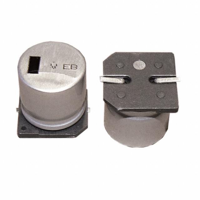

    33 µF 200 V 铝电解电容器 径向,Can - SMD 105°C 时为 5000 小时
AEB336M2DP44T-F 数据手册
Type AEB SMT Aluminum Electrolytic Capacitors - High Voltage, 105 °C Low Impedance and Long Life for High Voltage, High Ripple Current Applications Type AEB capacitors are it for high voltage applications like input bus capacitors in board mounted miniature AC/DC supplies. The AEB’s low impedance in ratings up to 450 Vdc, and long life, make it ideal for power supply input and other high voltage applications. The vertical, cylindrical cases make easy automatic mounting and reflow soldering. Highlights � +105 °C, Up to 5000 Hour Load Life � Capacitance Range: 2.2 µF to 100 µF � Voltage Range: 160 Vdc to 450 Vdc Specifications Operating Temperature: Rated Voltage: Capacitance: Capacitance Tolerance: Life Test: 5000 h @ +105 °C, L — S Cases 4000 h @ +105 °C, K Case 3000 h @ +105 ºC, J Case ∆ Capacitance ± 20% DF: ≤ 200% of limit DCL: ≤ 100% of limit –20 °C to +105 °C 160, 200, 250, 350, 400, 450 Vdc 2.2 µF to 100 µF ±20% @ 120 Hz and +20 °C Shelf Test: 1000 h @ 105 °C ∆ Capacitance ± 20% DF: ≤ 200% of limit DCL: ≤ 100% of limit AEB Series Marking Outline Drawing Case Dimensions Case Code J K L P U R S D ±0.5 10.0 10.0 12.5 16.0 16.0 18.0 18.0 L ±0.5 13.5 16.5 16.5 16.5 21.5 16.5 21.5 A ±0.2 10.3 10.3 13.5 17.0 17.0 19.0 19.0 H (max) 12 12 15 19 19 21 21 I (ref) 3.5 3.5 4.7 6.7 6.7 6.7 6.7 W 0.9 ±0.2 0.9 ±0.2 0.9 ±0.3 1.2 ±0.3 1.2 ±0.3 1.2 ±0.3 1.2 ±0.3 P (ref) 4.6 4.6 4.4 6.7 6.7 6.7 6.7 K (mm) 0.7 ± 0.2 0.7 ± 0.2 0.7 ± 0.3 0.7 ± 0.3 0.7 ± 0.3 0.7 ± 0.3 0.7 ± 0.3 Cornell Dubilier • 1605 E. Rodney French Blvd. • New Bedford, MA 02744 • Phone: (508)996-8561 • Fax: (508)996-3830 • www.cde.com Type AEB SMT Aluminum Electrolytic Capacitors - High Voltage, 105 °C Ratings Max. Max. Cap (µF) Catalog Part Number DCL 2 min (µA) 10.0 33.0 47.0 68.0 68.0 100.0 22.0 33.0 47.0 68.0 100.0 10.0 22.0 33.0 47.0 68.0 10.0 22.0 33.0 47.0 3.3 4.7 10.0 22.0 33.0 2.2 3.3 4.7 10.0 22.0 AEB106M2CJ32T-F AEB336M2CL32T-F AEB476M2CP44T-F AEB686M2CU44T-F AEB686M2CR44T-F AEB107M2CS44T-F AEB226M2DL32T-F AEB336M2DP44T-F AEB476M2DR44T-F AEB686M2DU44T-F AEB107M2DS44T-F AEB106M2EK32T-F AEB226M2EP44T-F AEB336M2ER44T-F AEB476M2EU44T-F AEB686M2ES44T-F AEB106M2VP44T-F AEB226M2VR44T-F AEB336M2VU44T-F AEB476M2VS44T-F AEB335M2GJ32T-F AEB475M2GK32T-F AEB106M2GP44T-F AEB226M2GU44T-F AEB336M2GS44T-F AEB225M2WJ32T-F AEB335M2WK32T-F AEB475M2WL32T-F AEB106M2WR44T-F AEB226M2WS44T-F 106 327 461 663 663 970 274 406 574 826 1210 160 340 505 715 1030 220 472 703 997 89 123 250 538 802 69 99 137 280 604 Dissipation Factor @ 120 Hz 20 °C 160 Vdc 0.15 0.15 0.15 0.15 0.15 0.15 200 Vdc 0.15 0.15 0.15 0.15 0.15 250 Vdc 0.15 0.15 0.15 0.15 0.15 350 Vdc 0.20 0.20 0.20 0.20 400 Vdc 0.24 0.24 0.24 0.24 0.24 450 Vdc 0.24 0.24 0.24 0.24 0.24 11.00 7.00 4.80 3.00 1.80 29 41 49 310 560 10 x 13.5 10 x 16.5 12.5 x 16.5 18 x 16.5 18 x 21.5 8.00 5.50 3.60 2.20 1.20 40 50 250 410 600 10 x 13.5 10 x 16.5 16 x 16.5 16 x 21.5 18 x 21.5 3.20 1.60 1.20 1.00 270 350 480 670 16 x 16.5 18 x 16.5 16 x 21.5 18 x 21.5 2.50 1.60 0.85 0.70 0.60 88 560 560 710 990 10 x 16.5 16 x 16.5 18 x 16.5 16 x 21.5 18 x 21.5 1.80 1.40 0.80 0.55 0.50 470 600 600 750 1060 12.5 x 16.5 16 x 16.5 18 x 16.5 16 x 21.5 18 x 21.5 3.00 1.80 1.40 0.55 0.80 0.50 70 470 600 750 750 1060 10 x 13.5 12.5 x 16.5 16 x 16.5 16 x 21.5 18 x 16.5 18 x 21.5 Max. @ 100 20 °C (Ω) Max. @ 105 °C 100 kHz (mA) Impedance Ripple Current RoHS Compliant Size (mm) Quantity DxL Reel 250 150 125 75 125 75 150 125 125 75 75 200 125 125 75 75 125 125 75 75 250 200 125 75 75 250 200 150 125 75 Part Numbering System AEB Type 106 Capacitance 105 = 1.0 µF 106 = 10.0 µF 107 = 100.0 µF M Capacitance Tolerance M = ±20% 2C Voltage Code 2C = 160 Vdc 2D = 200 Vdc 2E = 250 Vdc 2V = 350 Vdc 2G = 400 Vdc 2W = 450 Vdc J Case Code 32T Packaging Information 32 = Carrier tape Width (mm) T = Tape & Reel B = bulk -F RoHS Compliant Cornell Dubilier • 1605 E. Rodney French Blvd. • New Bedford, MA 02744 • Phone: (508)996-8561 • Fax: (508)996-3830 • www.cde.com Type AEB SMT Aluminum Electrolytic Capacitors - High Voltage, 105 °C Typical Performance Curves Cornell Dubilier • 1605 E. Rodney French Blvd. • New Bedford, MA 02744 • Phone: (508)996-8561 • Fax: (508)996-3830 • www.cde.com Type AEB SMT Aluminum Electrolytic Capacitors - High Voltage, 105 °C Cornell Dubilier • 1605 E. Rodney French Blvd. • New Bedford, MA 02744 • Phone: (508)996-8561 • Fax: (508)996-3830 • www.cde.com Type AEB SMT Aluminum Electrolytic Capacitors - High Voltage, 105 °C Cornell Dubilier • 1605 E. Rodney French Blvd. • New Bedford, MA 02744 • Phone: (508)996-8561 • Fax: (508)996-3830 • www.cde.com
