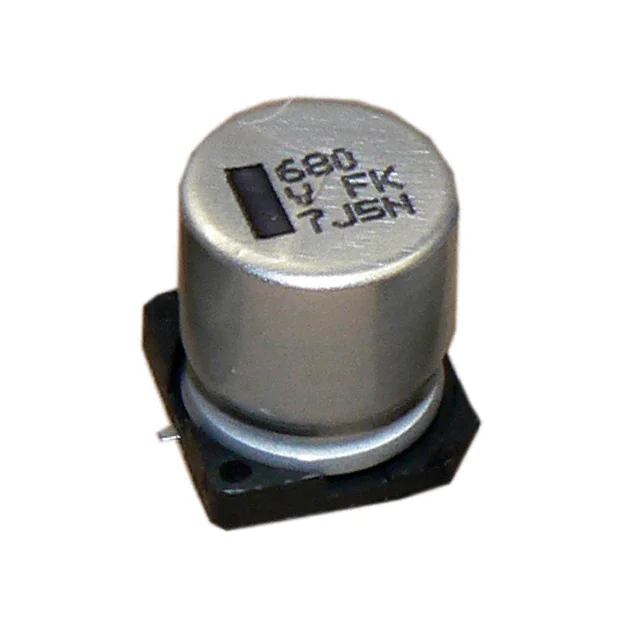

Type AFK –55 °C to 105 °C SMT Aluminum Electrolytic Capacitors - Lowest E.S.R., 105 °C Low Impedance and Long-Life for Filtering, Bypassing and Power Supply Decoupling Type AFK Capacitors are the best and by a wide margin. With 40% to 60% lower impedance, 30% to 50% smaller case size and more than twice the life compared to low-ESR type AFC, the Type AFK also excels at cold performance down to –55 °C. In addition, this terrific low-impedance performance, approaching low-ESR tantalum capacitors, is at a significant cost savings compared to tantalum. The vertical cylindrical cases facilitate automatic mounting and reflow soldering into the same footprint of like-rated tantalum capacitors except without the need for voltage derating. Highlights • +105 °C, Up to 5000 Hour Load Life • Capacitance Range: 3.3 µF to 6800 µF • Voltage Range: 6.3 Vdc to 100 Vdc • AEC-Q200 Compliant Specifications Capacitance Range 1.0 µF to 1500 µF Capacitance Tolerance ±20% @ 120 Hz and +20 °C Rated Voltage 6.3, 10, 16, 25, 35, 50, 63, 80 & 100 Vdc Operating Temperature Range –55 °C to +105 °C Leakage Current I = 0.01 CV or 3 (µA) whichever is greater after 2 minutes Dissipation Factor 6.3V 10 V 16 V 25 V 35 V 50 V 63 V 80 V 100 V 0.26 0.19 0.16 0.14 0.12 0.1 0.08 0.08 0.07 Add 0.02 per 1000 µF for values greater that 1000 µF Ripple Curent Multipliers (Frequency) Frequency 50/60 Hz 120 Hz 1 kHz 10 kHz 100 kHz 0.70 .0.75 0.90 0.95 1.00 Load Life 2000 h @ 105 °C, 4.0 — 10.0 mm dia. 5000 h @ 105 °C, 12.5 — 18.0 mm dia. ∆ Capacitance ±30% DF: ≤ 200% of limit DCL: ≤ 100% of limit Shelf Life 1000 h @ 105 °C ∆ Capacitance ±30% DF: ≤ 200% of limit DCL: ≤ 100% of limit Regulatory Information AFK Series Marking Capacitance (µF) Voltage j A C E V H J K 2A 220 6.3Vdc 10Vdc 16Vdc 25Vdc 35Vdc 50Vdc 63Vdc 80Vdc 100Vdc K 0.3 mm Max. Series A I FK D H P I Case Dimensions Case Outline Drawing D ± 0.5 Lot No. L W L A ± 0.2 Code H I (max) (ref) W P K (ref) (mm) B 4.0 5.8 ± 0.3 4.3 5.5 1.8 0.65 ±0.1 1.0 0.35 +0.15/–0.20 C 5.0 5.8 ± 0.3 5.3 6.5 2.2 0.65 ±0.1 1.5 0.35 +0.15/–0.20 D 6.3 5.8 ± 0.3 6.6 7.8 2.6 0.65 ±0.1 1.8 0.35 +0.15/–0.20 X 6.3 7.7 ± 0.3 6.6 7.8 2.6 0.65 ±0.1 1.8 0.35 +0.15/–0.20 E 8.0 6.2 ± 0.3 8.3 9.5 3.4 0.65 ±0.1 2.2 0.35 +0.15/–0.20 F 8.0 10.2 ± 0.3 8.3 10.0 3.4 0.90 ±0.2 3.1 0.70 ±0.20 G 10.0 10.2 ± 0.3 10.3 12.0 3.5 0.90 ±0.2 4.6 0.70 ±0.20 H 12.5 13.5 ± 0.5 13.5 15.0 4.7 0.90 ±0.3 4.4 0.70 ±0.30 P 16.0 16.5 ± 0.5 17.0 19.0 5.5 1.2 ±0.3 6.7 0.70 ±0.30 R 18.0 16.5 ± 0.5 19.0 21.0 6.7 1.2 ±0.3 6.7 0.70 ±0.30 Cornell Dubilier • 1605 E. Rodney French Blvd. • New Bedford, MA 02744 • Phone: (508)996-8564 • Fax: (508)996-3830 • www.cde.com T Type AFK –55 °C to 105 °C SMT Aluminum Electrolytic Capacitors - Lowest E.S.R., 105 °C Ratings Table Cap (µF) Catalog Part Number Max. DCL 2 min (µA) Max. Dissipation Factor @120 Hz/20 °C Max. ESR @100 kHz/20 °C (Ω ) Max. Impedance Ripple Current @ 100 kHz/20 °C @ 100 kHz/105 °C (Ω) (mA) Case Code Size DxL (mm) Quantity per Reel 6.3 Vdc ( 8 Vdc Surge ) 22 AFK226M06B12T-F 3.0 0.26 1.350 1.350 90 B 4 x 5.8 2000 47 AFK476M06B12T-F 3.0 0.26 1.350 1.350 47 AFK476M06C12T-F 3.0 0.26 0.700 0.700 90 B 4 x 5.8 2000 160 C 5 x 5.8 1000 100 AFK107M06C12T-F 6.3 0.26 0.700 0.700 160 100 AFK107M06D16T-F 6.3 0.26 0.360 0.360 240 C 5 x 5.8 1000 D 6.3 x 5.8 1000 220 AFK227M06D16T-F 13.9 0.26 0.360 0.360 240 330 AFK337M06X16T-F 20.8 0.26 0.340 0.340 280 D 6.3 x 5.8 1000 X 6.3 x 7.7 900 330 AFK337M06E16T-F 20.8 0.26 0.260 0.260 300 470 AFK477M06F24T-F 29.6 0.26 0.160 0.160 600 E 8 x 6.2 1000 F 8 x 10.2 500 1000 AFK108M06F24T-F 63.0 0.26 0.160 0.160 600 1500 AFK158M06G24T-F 94.5 0.26 0.080 0.080 850 F 8 x 10.2 500 G 10 x 10.2 500 3300 AFK338M06H32T-F 207.9 0.30 0.060 0.060 1100 6800 AFK688M06P44T-F 428.4 0.36 0.035 0.035 1800 H 12.5 x 13.5 200 P 16 x 16.5 125 22 AFK226M10B12T-F 3.0 0.19 1.350 1.350 90 B 4 x 5.8 2000 33 AFK336M10B12T-F 3.3 0.19 1.350 1.350 33 AFK336M10C12T-F 3.3 0.19 0.700 0.700 90 B 4 x 5.8 2000 160 C 5 x 5.8 1000 150 AFK157M10D16T-F 15.0 0.19 0.360 0.360 220 AFK227M10X16T-F 22.0 0.19 0.340 0.340 240 D 6.3 x 5.8 1000 280 X 6.3 x 7.7 900 220 AFK227M10E16T-F 22.0 0.19 0.260 330 AFK337M10F24T-F 33.0 0.19 0.160 0.260 300 E 8 x 6.2 1000 0.160 600 F 8 x 10.2 500 470 AFK477M10F24T-F 47.0 0.19 680 AFK687M10F24T-F 68.0 0.19 0.160 0.160 600 F 8 x 10.2 500 0.160 0.160 600 F 8 x 10.2 500 1000 AFK108M10G24T-F 100.0 2200 AFK228M10H32T-F 220.0 0.19 0.080 0.080 850 G 10 x 10.2 500 0.21 0.060 0.060 1100 H 12.5 x 13.5 200 4700 AFK478M10P44T-F 6800 AFK688M10R44T-F 470.0 0.25 0.035 0.035 1800 P 16 x 16.5 125 680.0 0.29 0.033 0.033 2060 R 18 x 16.5 125 10 AFK106M16B12T-F 3.0 0.16 1.350 1.350 90 B 4 x 5.8 2000 22 AFK226M16B12T-F 3.5 0.16 1.350 1.350 90 B 4 x 5.8 2000 22 AFK226M16C12T-F 3.5 0.16 0.700 0.700 160 C 5 x 5.8 1000 47 AFK476M16C12T-F 7.5 0.16 0.700 0.700 160 C 5 x 5.8 1000 47 AFK476M16D16T-F 7.5 0.16 0.360 0.360 240 D 6.3 x 5.8 1000 10 Vdc ( 13 Vdc Surge ) 16 Vdc ( 20 Vdc Surge ) 68 AFK686M16D16T-F 10.9 0.19 0.360 0.360 240 D 6.3 x 5.8 1000 100 AFK107M16D16T-F 16.0 0.16 0.360 0.360 240 D 6.3 x 5.8 1000 150 AFK157M16X16T-F 24.0 0.16 0.340 0.340 280 X 6.3 x 7.7 900 220 AFK227M16X16T-F 35.2 0.16 0.340 0.340 280 X 6.3 x 7.7 900 220 AFK227M16E16T-F 35.2 0.16 0.260 0.260 300 E 8 x 6.2 1000 330 AFK337M16F24T-F 52.8 0.16 0.160 0.160 600 F 8 x 10.2 500 470 AFK477M16F24T-F 75.2 0.16 0.160 0.160 600 F 8 x 10.2 500 680 AFK687M16G24T-F 108.8 0.16 0.080 0.080 850 G 10 x 10.2 500 1500 AFK158M16H32T-F 240.0 0.16 0.060 0.060 1100 H 12.5 x 13.5 200 3300 AFK338M16P44T-F 528.0 0.20 0.035 0.035 1800 P 16 x 16.5 125 4700 AFK478M16R44T-F 752.0 0.22 0.033 0.033 2060 R 18 x 16.5 125 Cornell Dubilier • 1605 E. Rodney French Blvd. • New Bedford, MA 02744 • Phone: (508)996-8564 • Fax: (508)996-3830 • www.cde.com C m Type AFK –55 °C to 105 °C SMT Aluminum Electrolytic Capacitors - Lowest E.S.R., 105 °C Cap (µF) Catalog Part Number Max. DCL 2 min (µA) Max. Dissipation Factor @120 Hz/20 °C Max. ESR @100 kHz/20 °C (Ω ) Max. Impedance Ripple Current @ 100 kHz/20 °C @ 100 kHz/105 °C Case (Ω) (mA) Code Size DxL (mm) Quantity per Reel 25 Vdc ( 31 Vdc Surge ) 10 AFK106M25B12T-F 3.0 0.14 1.350 1.350 90 B 4 x 5.8 2000 22 AFK226M25C12T-F 5.5 0.14 0.700 0.700 160 C 5 x 5.8 1000 33 AFK336M25C12T-F 8.3 0.14 0.700 0.700 160 C 5 x 5.8 1000 33 AFK336M25D16T-F 8.3 0.14 0.360 0.360 240 D 6.3 x 5.8 1000 47 AFK476M25D16T-F 11.8 0.14 0.360 0.360 240 D 6.3 x 5.8 1000 68 AFK686M25D16T-F 17.0 0.14 0.360 0.360 240 D 6.3 x 5.8 1000 100 AFK107M25X16T-F 25.0 0.14 0.340 0.340 280 X 6.3 x 7.7 900 100 AFK107M25E16T-F 25.0 0.14 0.260 0.260 300 E 8 x 6.2 1000 150 AFK157M25F24T-F 37.5 0.14 0.160 0.160 600 F 8 x 10.2 500 220 AFK227M25F24T-F 55.0 0.14 0.160 0.160 600 F 8 x 10.2 500 330 AFK337M25F24T-F 82.5 0.14 0.160 0.160 600 F 8 x 10.2 500 470 AFK477M25G24T-F 117.5 0.14 0.080 0.080 850 G 10 x 10.2 500 1000 AFK108M25H32T-F 250.0 0.14 0.060 0.060 1100 H 12.5 x 13.5 200 1500 AFK158M25P44T-F 375.0 0.14 0.035 0.035 1800 P 16 x 16.5 125 2200 AFK228M25P44T-F 550.0 0.16 0.035 0.035 1800 P 16 x 16.5 125 3300 AFK338M25R44T-F 825.0 0.18 0.033 0.033 2060 R 18 x 16.5 125 4.7 AFK475M35B12T-F 3.0 0.12 1.350 1.350 90 B 4 x 5.8 2000 10 AFK106M35B12T-F 3.5 0.12 1.350 1.350 90 B 4 x 5.8 2000 10 AFK106M35C12T-F 3.5 0.12 0.700 0.700 160 C 5 x 5.8 1000 35 Vdc ( 44 Vdc Surge ) 22 AFK226M35C12T-F 7.7 0.12 0.700 0.700 160 C 5 x 5.8 1000 33 AFK336M35D16T-F 11.6 0.12 0.360 0.360 240 D 6.3 x 5.8 1000 47 AFK476M35D16T-F 16.5 0.12 0.360 0.360 240 D 6.3 x 5.8 1000 68 AFK686M35X16T-F 23.8 0.12 0.340 0.340 280 X 6.3 x 7.7 900 100 AFK107M35X16T-F 35.0 0.12 0.340 0.340 280 X 6.3 x 7.7 900 100 AFK107M35F24T-F 35.0 0.12 0.160 0.160 600 F 8 x 10.2 500 150 AFK157M35F24T-F 52.5 0.12 0.160 0.160 600 F 8 x 10.2 500 220 AFK227M35F24T-F 77.0 0.12 0.160 0.160 600 F 8 x 10.2 500 330 AFK337M35G24T-F 115.5 0.12 0.080 0.080 850 G 10 x 10.2 500 470 AFK477M35H32T-F 164.5 0.12 0.060 0.060 1100 H 12.5 x 13.5 200 680 AFK687M35H32T-F 238.0 0.12 0.060 0.060 1100 H 12.5 x 13.5 200 1000 AFK108M35P44T-F 350.0 0.12 0.035 0.035 1800 P 16 x 16.5 125 1500 AFK158M35P44T-F 525.0 0.12 0.035 0.035 1800 P 16 x 16.5 125 4.7 AFK475M50B12T-F 3.0 0.10 2.900 2.900 60 B 4 x 5.8 2000 10 AFK106M50C12T-F 5.0 0.10 1.520 1.520 85 C 5 x 5.8 1000 10 AFK106M50D16T-F 5.0 0.10 0.880 0.880 165 D 6.3 x 5.8 1000 22 AFK226M50D16T-F 11.0 0.10 0.880 0.880 165 D 6.3 x 5.8 1000 33 AFK336M50X16T-F 16.5 0.10 0.680 0.680 195 X 6.3 x 7.7 900 33 AFK336M50E16T-F 16.5 0.10 0.680 0.680 195 E 8 x 6.2 1000 47 AFK476M50X16T-F 23.5 0.10 0.680 0.680 195 X 6.3 x 7.7 900 47 AFK476M50E16T-F 23.5 0.10 0.680 0.680 195 E 8 x 6.2 1000 100 AFK107M50F24T-F 50.0 0.10 0.340 0.340 350 F 8 x 10.2 500 50 Vdc ( 63 Vdc Surge ) Cornell Dubilier • 1605 E. Rodney French Blvd. • New Bedford, MA 02744 • Phone: (508)996-8564 • Fax: (508)996-3830 • www.cde.com T Type AFK –55 °C to 105 °C SMT Aluminum Electrolytic Capacitors - Lowest E.S.R., 105 °C Cap (µF) Catalog Part Number Max. Max. DCL Dissipation 2 min Factor (µA) @120 Hz/20 °C Max. ESR @100 kHz/20 °C (Ω ) Impedance @ 100 kHz/20 °C (Ω) Max. Ripple Current @ 100 kHz/105 °C (mA) Case Code Size DxL (mm) Quantity per Reel 50 Vdc ( 63 Vdc Surge ) 150 AFK157M50G24T-F 75.0 0.10 0.180 0.180 670 G 10 x 10.2 500 220 AFK227M50G24T-F 110.0 0.10 0.180 0.180 670 G 10 x 10.2 500 330 AFK337M50H32T-F 165.0 0.10 0.120 0.120 900 H 12.5 x 13.5 200 390 AFK397M50H32T-F 195.0 0.10 0.120 0.120 900 H 12.5 x 13.6 200 470 AFK477M50P44T-F 235.0 0.10 0.073 0.073 1610 P 16 x 16.5 125 560 AFK567M50P44T-F 280.0 0.10 0.073 0.073 1610 P 16 x 16.5 125 680 AFK687M50P44T-F 340.0 0.10 0.073 0.073 1610 P 16 x 16.5 125 1000 AFK108M50P44T-F 500.0 0.10 0.073 0.073 1610 P 16 x 16.5 125 63 Vdc ( 75 Vdc Surge ) 4.7 AFK475M63C12T-F 3.0 0.08 3.000 3.000 50 C 5 x 5.8 1000 10 AFK106M63D16T-F 6.3 0.08 1.500 1.500 80 D 6.3 x 5.8 1000 22 AFK226M63X16T-F 13.9 0.08 1.200 1.200 120 X 6.3 x 7.7 900 22 AFK226M63E16T-F 13.9 0.08 1.200 1.200 120 E 8 x 6.2 1000 33 AFK336M63F24T-F 20.8 0.08 0.650 0.650 250 F 8 x 10.2 500 47 AFK476M63F24T-F 29.6 0.08 0.650 0.650 250 F 8 x 10.2 500 68 AFK686M63G24T-F 42.8 0.08 0.350 0.350 400 G 10 x 10.2 500 100 AFK107M63G24T-F 63.0 0.08 0.350 0.350 400 G 10 x 10.2 500 150 AFK157M63H32T-F 94.5 0.08 0.160 0.160 800 H 12.5 x 13.5 200 220 AFK227M63H32T-F 138.6 0.08 0.160 0.160 800 H 12.5 x 13.5 200 470 AFK477M63P44T-F 296.1 0.08 0.082 0.082 1410 P 16 x 16.5 125 680 AFK687M63R44T-F 428.4 0.08 0.080 0.080 1690 R 18 x 16.5 125 R 80 Vdc ( 100 Vdc Surge ) 3.3 AFK335M80C12T-F 3.0 0.08 5.00 5.00 25 C 5 x 5.8 1000 4.7 AFK475M80D16T-F 3.8 0.08 3.00 3.00 40 D 6.3 x 5.8 1000 10.0 AFK106M80X16T-F 8.0 0.08 2.40 2.40 60 X 6.3 x 7.7 900 10.0 AFK106M80E16T-F 8.0 0.08 2.40 2.40 60 E 8 x 6.2 1000 22.0 AFK226M80F24T-F 17.6 0.08 1.30 1.30 130 F 8 x 10.2 500 33.0 AFK336M80F24T-F 26.4 0.08 1.30 1.30 130 F 8 x 10.2 500 47.0 AFK476M80G24T-F 37.6 0.08 0.70 0.70 200 G 10 x 10.2 500 68.0 AFK686M80H32T-F 54.4 0.08 0.32 0.32 500 H 12.5 x 13.5 200 100.0 AFK107M80H32T-F 80.0 0.08 0.32 0.32 500 H 12.5 x 13.5 200 150.0 AFK157M80H32T-F 120.0 0.08 0.32 0.32 500 H 12.5 x 13.5 200 330.0 AFK337M80P44T-F 264.0 0.08 0.17 0.17 793 P 16 x 16.5 125 470.0 AFK477M80R44T-F 376.0 0.08 0.15 0.15 917 R 18 x 16.5 125 22.0 AFK226M2AF24T-F 22.0 0.07 1.30 1.30 130 F 8 x 10.2 500 33.0 AFK336M2AG24T-F 33.0 0.07 0.70 0.70 200 G 10 x 10.2 500 47.0 AFK476M2AH32T-F 47.0 0.07 0.32 0.32 500 H 12.5 x 13.5 200 68.0 AFK686M2AH32T-F 68.0 0.07 0.32 0.32 500 H 12.5 x 13.5 200 100.0 AFK107M2AP44T-F 100.0 0.07 0.17 0.17 793 P 16 x 16.5 125 150.0 AFK157M2AP44T-F 150.0 0.07 0.17 0.17 793 P 16 x 16.5 125 220.0 AFK227M2AR44T-F 220.0 0.07 0.15 0.15 917 R 18 x 16.5 125 330.0 AFK337M2AR44T-F 330.0 0.07 0.15 0.15 917 R 18 x 16.5 125 100 Vdc (125 Vdc Surge ) Cornell Dubilier • 1605 E. Rodney French Blvd. • New Bedford, MA 02744 • Phone: (508)996-8564 • Fax: (508)996-3830 • www.cde.com C m Type AFK –55 °C to 105 °C SMT Aluminum Electrolytic Capacitors - Lowest E.S.R., 105 °C Part Numbering System AFK 106 M Type Capacitance 105 = 1.0 µF 106 = 10.0 µF 16 B Capacitance Voltage Code Tolerance 06 = 6.3 Vdc 35 = 35 Vdc M = ±20% 12T Case Packaging Code Code 12 = Carrier tape 10 = 10 Vdc 50 = 50 Vdc Width (mm) 107 = 100.0 µF 16 = 16 Vdc 63 = 63 Vdc T = Tape & Reel 108 = 1000.0 µF 25 = 25 Vdc 80 = 80 Vdc B = Bulk –F RoHS Compliant 2A = 100 Vdc Reflow Solder Reflow Solder AFK Type SMT Electrolytics Diameter Peak Temperature Duration at Peak Time ≥200°C Number of Reflows 4 - 6.3mm 250°C 5s 60s 1 8 - 10mm 235°C 5s 60s 1 12.5 - 18mm 230°C 5s 20s 1 Cornell Dubilier • 1605 E. Rodney French Blvd. • New Bedford, MA 02744 • Phone: (508)996-8564 • Fax: (508)996-3830 • www.cde.com Ratio to 25°C, 120 Hz V Type Capacitance Capacitance Voltage Code Case Packaging Code 105 = 1.0 µF Tolerance 06 = 6.3 Vdc 35 = 35 Vdc Code 12 = Carrier tape 1 105 RoHS 0.8 Compliant 85°C 65°C 45°C 25°C . T AFK16 –55 105 °CT = Tape & Reel 107 = 100.0 Type µF = 16 Vdc °C 63 =to 63 Vdc 25 = 25 Vdc 80 = 80 Vdc B = Bulk 108 = 1000.0 µF SMT Aluminum Electrolytic Capacitors - Lowest E.S.R., 105 °C 2A = 100 Vdc 106 = 10.0 µF M = ±20% 10 = 10 Vdc 50 = 50 Vdc Width (mm) 0.6 0°C 0.4 –20°C –40°C 0.2 Typical Performance Curves Typical Performance Curves –55°C 0 10 100 Capacitance vs. Temperature and Frequency 10,000 1.4 105°C 1.2 85°C 65°C 45°C 25°C 0.8 . 0.6 Ratio to 25°C, 120 Hz Value 1 105 0°C 0.4 1,000,000 100 µF @ 16 Vdc (6.3 X 5.8 mm) 1.2 1 100,000 Capacitance vs. Temperature & Frequency 3300µF/6.3Vdc (12.5 x 13.5 mm) Ratio to 25°C, 120 Hz Value 1,000 –20°C 85°C 65°C 45° 0.8 0.6 25°C 0°C 0.4 –20°C –40°C 0.2 Type AFK –55 °C to 105 °C SMT Aluminum Electrolytic Capacitors - Lowest E.S.R., 105 °C Frequency (Hz) –40°C 0.2 –55°C 0 0 10 100 1,000 10,000 100,000 –55°C 10 100 1,000 10,000 100,000 1,000,000 1,000,000 Cornell Dubilier • 1605 E. Rodney French Blvd. • New Bedford, MA 02744 • Phone: (508)996-8564 • Fax: (508)996-3830 • www.cde Capacitance vs. Temperature Typical Performance Curves& Frequency 100 µF @ 16 Vdc (6.3 X 5.8 mm) ESR vs. Temperature and Frequency 1.2 100 1 100 µF @ 16 Vdc (6.3 X 5.8 mm) 100 65°C 45° Corn 0.8 Ratio to 25°C, 120 Hz Value Ratio to 25°C, 120 Hz Value Ratio to 25°C, 120 Hz Value ESR vs. Temperature and Frequency 105°C 3300 µF @6.3 Vdc (12.5 85°C X 13.5 mm) –55°C 0.6 25°C 10 0°C 0.4 –20°C –40°C 0.2 –40°C –20°C –55°C 0 1 10 100 1,000 10,000 Frequency (Hz) 105° 0°C 100,000 25°C 45°C 1,000,000 –55°C 10 –40°C –20°C 0°C 1 25°C 45°C 65°C 85°C 65°C Cornell Dubilier • 1605 E. Rodney French Blvd. • New Bedford, MA 02744 • Phone: (508)996-8564 • Fax: (508)996-3830 • www.cde.com. 0.1 10 100 1,000 10,000 100,000 Frequency (Hz) 0.1 1,000,000 85°C 10 Impedance vs Temperature and Frequency 10 –55°C –40°C –20°C 0°C 0.1 105°C 85°C 25°C 65°C 45°C Ratio to 25°C, 120 Hz Value Ratio to 25°C, 120 Hz Value 10 1 100 1000 10000 100000 105°C 10,000 100,000 Frequency (Hz) 1,000,000 100 µF @ 16 Vdc (6.3 X 5.8 mm) 1 –55°C –40°C –20°C 0.1 0°C 25°C 45°C 0.01 0.001 0.01 10 1,000 Impedance vs. Temperature and Frequency 3300 µF /6.3 V (12.5 x13.5mm) 100 100 1000000 Frequency (Hz) 65°C 10 100 1,000 10,000 Frequency (Hz) 85°C 105°C 100,000 1,000,000 Dissipation Factor vs. Cornell Dubilier • 1605 E. Rodney French Blvd. • New Bedford, MA 02744 • Phone: (508)996-8564 Temperature • Fax: (508)996-3830 • www.cde.com Capacitance Change vs. Time 5 (AFK Series Typical Performance) 3 47 µF @ 6.3 Vdc (4 X 5.8 mm) 22 µF @ 6.3 Vdc (4 x 5.4 mm) 100 µF @ 6.3 Vdc (6.3 X 5.8 mm) 0 1000 µF @ 6.3 Vdc (8 X 10.2 mm) 1500 µF @ 6.3 Vdc (10 x 10.2 mm) z) (%) 100 µF @ 6.3 Vdc ( 6.3 x 5.4 mm) 2 C 0 0 m 1 Ratio to 25°C, 120 Hz V Ratio to 25°C, 120 Hz –55°C –55°C –40°C –20°C 0.1 Type AFK –55 °C to 105 °C SMT Aluminum Electrolytic Capacitors - Lowest E.S.R., 105 °C –40°C –20°C 0°C 0.1 105°C 85°C Typical Performance Curves 25°C 65°C 45°C 0°C 25°C 0.001 0.01 10 100 1000 10000 100000 45°C 0.01 1000000 65°C 10 100 Frequency (Hz) (AFK Series Typical Performance) 10,000 3 1,000,000 47 µF @ 6.3 Vdc (4 X 5.8 mm) 100 µF @ 6.3 Vdc (6.3 X 5.8 mm) 100 µF @ 6.3 Vdc ( 6.3 x 5.4 mm) 1000 µF @ 6.3 Vdc (8 X 10.2 mm) 1500 µF @ 6.3 Vdc (10 x 10.2 mm) D.F. (@ 120 Hz) Capacitance Change (%) 100,000 Frequency (Hz) 22 µF @ 6.3 Vdc (4 x 5.4 mm) 0 105°C Dissipation Factor vs. Temperature Capacitance Change vs. Time 5 1,000 85°C -5 -10 2 1 -15 -20 0 500 1000 1500 2000 Time (Hours) 2500 3000 3500 0 -60 -10 40 90 140 Temperature (°C) Cornell Dubilier • 1605 E. Rodney French Blvd. • New Bedford, MA 02744 • Phone: (508)996-8564 • Fax: (508)996-3830 • www.cde.com. Notice and Disclaimer: All product drawings, descriptions, specifications, statements, information and data (collectively, the “Information”) in this datasheet or other publication are subject to change. The customer is responsible for checking, confirming and verifying the extent to which the Information contained in this datasheet or other publication is applicable to an order at the time the order is placed. All Information given herein is believed to be accurate and reliable, but it is presented without any guarantee, warranty, representation or responsibility of any kind, expressed or implied. Statements of suitability for certain applications are based on the knowledge that the Cornell Dubilier company providing such statements (“Cornell Dubilier”) has of operating conditions that such Cornell Dubilier company regards as typical for such applications, but are not intended to constitute any guarantee, warranty or representation regarding any such matter – and Cornell Dubilier specifically and expressly disclaims any guarantee, warranty or representation concerning the suitability for a specific customer application, use, storage, transportation, or operating environment. The Information is intended for use only by customers who have the requisite experience and capability to determine the correct products for their application. Any technical advice inferred from this Information or otherwise provided by Cornell Dubilier with reference to the use of any Cornell Dubilier products is given gratis (unless otherwise specified by Cornell Dubilier), and Cornell Dubilier assumes no obligation or liability for the advice given or results obtained. Although Cornell Dubilier strives to apply the most stringent quality and safety standards regarding the design and manufacturing of its products, in light of the current state of the art, isolated component failures may still occur. Accordingly, customer applications which require a high degree of reliability or safety should employ suitable designs or other safeguards (such as installation of protective circuitry or redundancies or other appropriate protective measures) in order to ensure that the failure of an electrical component does not result in a risk of personal injury or property damage. Although all product-related warnings, cautions and notes must be observed, the customer should not assume that all safety measures are indicated in such warnings, cautions and notes, or that other safety measures may not be required. Cornell Dubilier • 1605 E. Rodney French Blvd. • New Bedford, MA 02744 • Phone: (508)996-8564 • Fax: (508)996-3830 • www.cde.com

物料型号:AFK系列,这是一系列SMT(表面贴装技术)铝电解电容器。
器件简介:AFK系列电容器以其最低的等效串联电阻(E.S.R.)、105°C的低阻抗和长寿命而著称,适用于滤波、旁路和电源去耦。与低E.S.R.型AFC相比,AFK系列在-55°C至105°C的温度范围内具有更低的阻抗、更小的尺寸和更长的使用寿命。
引脚分配:文档中没有明确提到引脚分配,但提到了这些电容器适用于自动贴装和回流焊接。
参数特性: - 容量范围:1.0μF至1500F - 容量公差:+20%@120 Hz和+20°C - 额定电压:6.3Vdc至100Vdc - 工作温度范围:-55°C至+105°C - 漏电流:1μA至3μA,取决于电容值 - 损耗因子和纹波电流乘数:根据电压等级和频率,损耗因子和纹波电流乘数有所不同
功能详解: - 这些电容器设计用于在宽广的温度范围内提供稳定的性能。 - 它们具有长寿命,105°C下可达2000至5000小时的负载寿命。 - 符合AEC-Q200标准,适用于汽车电子应用。
应用信息:适用于电源去耦、滤波和旁路等应用,特别是在需要高可靠性和稳定性的场合。
封装信息:提供了不同尺寸的电容器封装,包括直径和长度的详细尺寸,以及每个卷的电容器数量。
