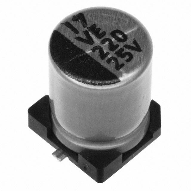

    33 µF 50 V 铝电解电容器 径向,Can - SMD 6 欧姆 @ 120Hz 105°C 时为 5000 小时
AVEK336M50F24T-F 数据手册
Type AVEK –55 °C to +105 °C Very Long Life - 5000 Hours - SMT Aluminum Electrolytic Capacitors For Filtering, Bypassing and Power Supply Decoupling Type AVEK Capacitors are rated for 5000 hours at 105 ºC with low impedance characteristics. They are ideal for high density PC board packaging. The Type AVEK offers a low in-place-cost for a high quality performer. The vertical cylindrical cases facilitate automatic mounting and reflow soldering into the same footprint of like-rated tantalum capacitors except without the need for voltage derating. Type AVEK is RoHS compliant. Highlights • +105 °C, Up to 5000 Hours Load Life • Capacitance Range: 0.1 µF to 470 µF • Voltage Range: 6.3 Vdc to 50 Vdc –55 °C to +105 °C 6.3, 10, 16, 25, 35, 50 Vdc 0.1µF to 470 µF ±20% @ 120 Hz and +20 °C I = 0.01 CV or 3 (µA) whichever is greater after 2 minutes C = rated capacitance in µF, V = rated DC working voltage Freq. (Hz) Under 16 25 ~ 35 50 ~ 63 100 50, 60 0.8 0.8 0.8 0.7 6.3 0.32 0.30 120 1 1 1 1 10 0.28 0.26 1k 1.15 1.25 1.35 1.35 16 0.24 0.22 6.3 4 8 10 3 5 10 k up 1.25 1.4 1.5 1.5 25 0.18 0.16 16 2 4 35 0.15 0.13 25 2 3 35 2 3 50 0.14 0.12 50 2 3 Specifications Operating Temperature: Rated Voltage: Capacitance: Capacitance Tolerance: Leakage Current: Ripple Current Multiplier: Vdc Dissipation Factor: (Tan δ at 120 Hz, 20 ºC) Low Temperature Characteristic (at 120 Hz): Rated Voltage 4 ~ 6.3 Ø 8 ~ 10 Ø Rated Voltage Impedance Ratio Z(–25 ºC) / Z(+20 ºC) Z(–40 ºC) / Z(+20 ºC) Load Life Test: Test Time 6.3 V Capacitance 10 ~ 16 V Change 25 ~ 50 V Dissipation Factor 6.3 ~ 16 V 25 ~ 50 V 2,000 Hours ( 4 ~ 6.3 Ø ) Within ±30% of initial value Within ±25% of initial value Within ±20% of initial value < 300% of specified value < 200% of specified value Within specified value 5,000 Hrs ( 8 ~ 10 Ø ) Within ±30% of initial value Within ±30% of initial value Within ±30% of initial value < 300% of specified value < 300% of specified value Within specified value C omplies with the EU Directive 2002/95/EC requirement restricting the use of Lead (Pb), Mercury (Hg), Cadmium (Cd), Hexavalent chromium (Cr(VI)), PolyBrominated Biphenyls (PBB) and PolyBrominated Diphenyl Ethers (PBDE). Leakage Current Shelf LifeTest: Test time: 1000 hours; test limits are the same as those for life test. CDE Cornell Dubilier • 1605 E. Rodney French Blvd. • New Bedford, MA 02744 • Phone: (508)996-8564 • Fax: (508)996-3830 • www.cde.com Type AVEK –55 °C to +105 °C Very Long Life - 5000 Hours - SMT Aluminum Electrolytic Capacitors Outline Drawing, Case Code & Dimensions Table ØD ±.05 B ± 0.2 Case Ø D .04 ±0.2 L A B 4.3 5.3 6.3 8.4 C W (mm) P ±0.2 (mm) 1.0 1.5 2.0 3.1 4.7 Code (mm) (mm) (mm) (mm) (mm) B C D F G 4.0 5.7 ±0.3 4.3 5.0 5.7 ±0.3 5.3 6.3 5.7 ±0.3 6.3 8.0 10 ±0.5 8.4 2.0 0.5 to 0.8 2.3 0.5 to 0.8 2.7 0.5 to 0.8 3.0 0.7 to 1.1 3.3 0.7 to 1.1 A ± 0.2 L W .03 Max C ±0.2 Part Numbering System AVEK Type AVEK 106 M P C ±0.2 10.0 10 ±0.5 10.4 10.4 25 Voltage Code 06 = 6.3 Vdc 25 = 25 Vdc 10 = 10 Vdc 35 = 35 Vdc 16 = 16 Vdc 50 = 50 Vdc C Case Code 12T Packaging Code 12 = Carrier Tape Width (mm) T = Tape & Reel –F RoHS Compliant Capacitance Capacitance Tolerance 104 = .1 µF 475 = 4.7 µF 106 = 10.0 µF 227 = 220 µF M = ±20% Ratings Table Catalog Part Number Max DCL 2 min. (µA) 3.0 3.0 3.0 6.3 13.9 20.8 29.6 3.0 3.0 3.3 4.7 10.0 22.0 33.0 47.0 Max DF 120 Hz 20 ºC Max ESR 120 Hz 20 ºC (ohms) 6.3 Vdc ( 8 Vdc Surge) 24.1 16.1 11.3 5.3 2.3 1.5 1.1 10 Vdc ( 13 Vdc Surge) 46.4 21.1 14.1 9.9 4.3 2.0 1.3 0.9 Max Ripple Current 120 Hz 105 °C (mA) 13 30 36 61 178 178 324 13 30 30 43 178 178 324 324 Case Code Size DxL (mm) 4 x 5.7 5 x 5.7 5 x 5.7 6.3 x 5.7 8 x 10 8 x 10 10 x 10 4 x 5.7 5 x 5.7 5 x 5.7 6.3 x 5.7 8 x 10 8 x 10 10 x 10 10 x 10 Quantity per Reel (each) 2000 1000 1000 1000 500 500 500 2000 1000 1000 1000 500 500 500 500 Cap (µF) 22 33 47 100 220 330 470 10 22 33 47 100 220 330 470 AVEK226M06B12T-F AVEK336M06C12T-F AVEK476M06C12T-F AVEK107M06D16T-F AVEK227M06F24T-F AVEK337M06F24T-F AVEK477M06G24T-F AVEK106M10B12T-F AVEK226M10C12T-F AVEK336M10C12T-F AVEK476M10D16T-F AVEK107M10F24T-F AVEK227M10F24T-F AVEK337M10G24T-F AVEK477M10G24T-F 0.32 0.32 0.32 0.32 0.30 0.30 0.30 0.28 0.28 0.28 0.28 0.26 0.26 0.26 0.26 B C C D F F G B C C D F F G G CDE Cornell Dubilier • 1605 E. Rodney French Blvd. • New Bedford, MA 02744 • Phone: (508)996-8564 • Fax: (508)996-3830 • www.cde.com Type AVEK –55 °C to +105 °C Very Long Life - 5000 Hours - SMT Aluminum Electrolytic Capacitors Catalog Part Number Max DCL 2 min. (µA) 3.0 3.0 3.5 5.3 7.5 16.0 35.2 52.8 75.2 3.0 3.0 5.5 8.3 11.8 25.0 55.0 82.5 3.0 3.5 7.7 11.6 16.5 35.0 77.0 3.0 3.0 3.0 3.0 3.0 3.0 3.0 3.0 5.0 11.0 16.5 23.5 50.0 Max DF 120 Hz 20 ºC Max ESR 120 Hz 20 ºC ( ohms ) 16 Vdc ( 20 Vdc Surge) 84.7 39.8 18.1 12.1 8.5 3.6 1.7 1.1 0.8 25 Vdc (31 Vdc Surge) 63.5 29.8 13.6 9.0 5.6 2.7 1.2 0.8 35 Vdc (44 Vdc Surge) 52.9 24.9 11.3 6.5 4.6 2.2 1.0 50 Vdc (63 Vdc Surge) 2321.0 1055.0 703.3 493.8 232.1 105.5 70.3 49.4 23.2 9.0 6.0 4.2 2.0 Max Ripple Current 120 Hz 105 °C (mA) 13 16 30 40 50 178 178 324 324 13 23 38 48 178 178 240 324 13 25 50 178 178 324 324 2 3 4 5 10 16 18 22 30 178 178 178 160 Case Code Size DxL (mm) 4 x 5.7 4 x 5.7 5 x 5.7 6.3 x 5.7 6.3 x 5.7 8 x 10 8 x 10 10 x 10 10 x 10 4 x 5.7 5 x 5.7 6.3 x 5.7 6.3 x 5.7 8 x 10 8 x 10 8 x 10 10 x 10 4 x 5.7 5 x 5.7 6.3 x 5.7 8 x 10 8 x 10 10 x 10 10 x 10 4 x 5.7 4 x 5.7 4 x 5.7 4 x 5.7 4 x 5.7 4 x 5.7 4 x 5.7 5 x 5.7 6.3 x 5.7 8 x 10 8 x 10 8 x 10 10 x 10 Quantity per Reel (each) 2000 2000 1000 1000 1000 500 500 500 500 2000 1000 1000 1000 500 500 500 500 2000 1000 1000 500 500 500 500 2000 2000 2000 2000 2000 2000 2000 1000 1000 500 500 500 500 Cap (µF) 4.7 10 22 33 47 100 220 330 470 4.7 10 22 33 47 100 220 330 4.7 10 22 33 47 100 220 .10 .22 .33 .47 1.0 2.2 3.3 4.7 10.0 22.0 33.0 47.0 100.0 AVEK475M16B12T-F AVEK106M16B12T-F AVEK226M16C12T-F AVEK336M16D16T-F AVEK476M16D16T-F AVEK107M16F24T-F AVEK227M16F24T-F AVEK337M16G24T-F AVEK477M16G24T-F AVEK475M25B12T-F AVEK106M25C12T-F AVEK226M25D16T-F AVEK336M25D16T-F AVEK476M25F24T-F AVEK107M25F24T-F AVEK227M25F24T-F AVEK337M25G24T-F AVEK475M35B12T-F AVEK106M35C12T-F AVEK226M35D16T-F AVEK336M35F24T-F AVEK476M35F24T-F AVEK107M35G24T-F AVEK227M35G24T-F AVEK104M50B12T-F AVEK224M50B12T-F AVEK334M50B12T-F AVEK474M50B12T-F AVEK105M50B12T-F AVEK225M50B12T-F AVEK335M50B12T-F AVEK475M50C12T-F AVEK106M50D16T-F AVEK226M50F24T-F AVEK336M50F24T-F AVEK476M50F24T-F AVEK107M50G24T-F 0.24 0.24 0.24 0.24 0.24 0.22 0.22 0.22 0.22 0.18 0.18 0.18 0.18 0.16 0.16 0.16 0.16 0.15 0.15 0.15 0.13 0.13 0.13 0.13 0.14 0.14 0.14 0.14 0.14 0.14 0.14 0.14 0.14 0.12 0.12 0.12 0.12 B B C D D F F G G B C D D F F F G B C D F F G G B B B B B B B C D F F F G CDE Cornell Dubilier • 1605 E. Rodney French Blvd. • New Bedford, MA 02744 • Phone: (508)996-8564 • Fax: (508)996-3830 • www.cde.com
