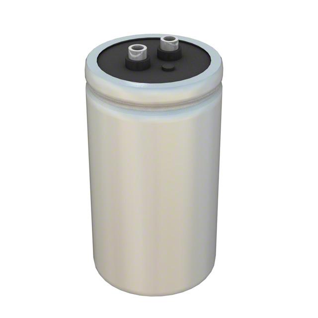

    螺栓,D44.45xL79.38mm
    2000 µF 75 V 铝电解电容器 径向,Can - 螺丝端子 39 毫欧 @ 120Hz 85°C 时为 2000 小时
CG202U075U3C 数据手册
Type CG Reliable Screw Terminal Aluminum Electrolytic Capacitor 85 ºC, Screw Terminal Capacitors Type CG screw terminal, aluminum electrolytic capacitors have excellent reliability and are good for 2000 hours at 85 ºC at full rated voltage. Highlights • • • High reliability at 85 ºC Screw Terminal Long Life Specifications 40 to 160,000 µF 10 to 450 WVdc –10% +75% (10 - 150 WVdc) –10% +50% (151 - 450 WVdc) Operating Temperature: –40 ºC to +85 ºC Ripple Current Multipliers: Ambient Temperature Capacitance Range: Voltage Range: Capacitance Tolerance: 25 ºC 2.00 35 ºC 1.88 45 ºC 1.72 55 ºC 1.58 65 ºC 1.42 85 ºC 1.00 Rated Voltage 10 to 75 76 to 250 251 to 450 120 Hz 1.000 1.000 1.000 Ripple Multiplier 400 Hz 1.050 1.075 1.080 1000 Hz 2500 Hz 1.085 1.125 1.130 1.135 1.155 1.175 10 kHz 1.150 1.210 1.230 DC Leakage Current: Click here to see: Hardware & Mounting Options QA Stability Test: Click here to see: Mechanical Details I = 3 √CV after 5 minutes Not to exceed 4.0 mA C = Capacitance in µF V = Rated Voltage I = Leakage current in mA Apply WVdc for 2000 h @ 85 ºC • Capacitance change ±15% from initial limits • DC leakage current: 200% of limit • ESR: 175% of limit Ratings Typical Catalog Cap (µF) 160,000 2,500 6,500 10,500 CG164U010X5L CG252U016R2C CG652U016R2C CG1052U016V3C Part Number ESR 120 Hz (Ω) 0.006 0.047 0.039 0.027 Max Ripple 120 Hz +85 ºC (A) RMS 27.1 3.9 4.3 7.6 Dia. Length Cap (µF) 12,000 18,000 1.375 1.375 2.000 2.125 2.125 3.125 21,000 27,000 40,000 CG123U016R3C CG183U016R4C CG213U016U3C CG273U016V3C CG403U016V4C (Inches) (Inches) 3 5.625 Catalog Part Number Typical ESR 120 Hz (Ω) 0.024 0.018 0.012 0.012 0.009 Max Ripple 120 Hz +85 ºC (A) RMS 6.4 8.3 10.5 11.4 14.7 Dia. Length (Inches) (Inches) 1.375 1.375 1.750 2.000 2.000 3.125 4.125 3.125 3.125 4.125 10 WVdc ( 15 Vdc Surge ) 16 WVdc ( 20 Vdc Surge ) 16 WVdc ( 20 Vdc Surge ) CDE Cornell Dubilier • 1605 E. Rodney French Blvd. • New Bedford, MA 02744 • Phone: (508)996-8561 • Fax: (508)996-3830 • www.cde.com Type CG Reliable Screw Terminal Aluminum Electrolytic Capacitor Ratings Typical Max Ripple Catalog Cap (µF) 1,500 2,800 3,300 4,500 6,000 6,300 8,500 9,200 10,000 13,000 20,000 20,000 32,000 CG152U025R2C CG282U025R3C CG332U025R2C CG452U025U3C CG602U025V3C CG632U025R3C CG852U025V4C CG922U025R4C CG103U025U3C CG133U025V3C CG203U025V4C CG203U025X4C CG323U025W4C Part Number ESR 120 Hz (Ω) .058 0.036 0.043 0.006 0.029 0.028 0.022 0.022 0.026 0.024 0.019 0.019 0.010 0.005 0.063 0.039 0.051 0.030 0.025 0.021 0.020 0.018 0.011 0.006 0.072 0.058 0.044 0.033 0.037 0.036 0.035 0.026 0.026 0.029 0.017 0.023 0.022 0.013 0.013 0.009 0.010 0.006 0.005 0.085 0.072 0.053 0.037 0.045 0.039 0.036 0.035 120 Hz +85 ºC (A) RMS 3.5 5.2 4.1 14.8 7.3 5.9 9.4 7.5 7.1 8.0 10.1 12.9 15.9 25.2 3.4 5.0 3.8 5.7 7.9 11.0 9.1 10.4 15.2 23.0 3.2 3.5 4.7 6.1 6.0 5.2 6.7 6.9 8.6 6.7 9.6 10.5 8.7 12.2 15.6 16.8 20.5 22.5 29.0 2.9 3.2 4.3 5.8 4.7 5.8 6.6 6.1 Dia. Length Typical Catalog Cap (µF) 3,300 3,450 4,900 7,900 8,200 11,000 12,500 400 1,000 1,300 1,700 2,250 2,500 3,600 4,000 1.375 1.375 1.375 1.375 2.000 2.500 1.750 2.000 2.500 3.000 1.375 1.375 1.375 1.375 1.750 1.375 2.000 1.375 2.000 1.750 2.000 2.500 1.750 2.000 3.000 2.500 3.000 3.000 3.000 1.375 1.375 1.375 1.375 1.375 1.750 2.000 1.750 2.125 3.125 2.125 3.125 3.125 4.125 4.125 4.125 4.125 4.125 2.125 2.125 3.125 4.125 3.125 3.125 3.125 4.125 4.125 3.125 3.125 4.125 4.125 4.125 4.125 4.125 5.625 4.125 5.625 2.125 2.125 3.125 4.125 3.125 3.125 3.125 3.125 Max Ripple 120 Hz +85 ºC (A) RMS 8.4 8.5 11.3 14.5 16.3 18.8 21.8 2.0 4.3 4.5 5.7 7.3 8.0 11.3 11.5 2.1 3.1 6.1 9.2 9.4 17.0 1.6 3.2 3.0 3.9 4.8 7.8 9.7 13.2 1.5 3.1 4.1 4.6 14.2 4.0 1.0 1.4 2.1 2.4 3.3 8.1 3.0 0.5 1.0 2.4 Dia. Length (Inches) (Inches) 2.000 2.000 2.000 2.500 3.000 3.000 3.000 1.375 1.375 1.750 1.750 2.000 2.000 2.500 2.500 1.375 1.375 2.000 2.500 3.000 3.000 1.375 1.375 1.750 2.000 2.000 2.500 3.000 3.000 1.375 1.375 2.000 2.000 3.000 2.000 1.375 1.375 1.375 2.000 2.000 3.000 2.000 1.375 1.375 2.000 3.125 4.125 4.125 4.125 4.125 4.125 5.625 2.125 4.125 3.125 4.125 4.125 4.125 4.125 4.125 2.125 3.125 4.125 4.125 4.125 3.625 2.125 4.125 3.125 3.125 4.125 4.125 4.125 5.625 2.125 4.125 3.125 4.125 5.625 3.125 2.125 3.125 4.125 3.125 4.125 5.625 4.125 2.125 4.125 4.125 ESR 120 Hz (Ω) Part Number (Inches) (Inches) 1.375 1.375 1.375 1.750 2.000 1.375 2.000 1.375 1.750 2.000 2.000 3.000 2.500 3.000 2.125 3.125 2.125 3.125 3.125 3.125 4.125 4.125 3.125 3.125 4.125 4.125 4.125 4.125 25 WVdc ( 40 Vdc Surge ) 75 WVdc ( 100 Vdc Surge ) CG332U075V3C CG3451U075V4C CG492U075V4C CG792U075W4C CG822U075X4C CG113U075X4C CG1252U075X5L CG401U100R2C CG102U100R4C CG132U100U3C CG172U100W4C CG2251U100V4C CG252U100V4C CG362U100W4C CG402U100W4C CG2750U150R2C CG501U150R3C CG1551U150V4C CG252U150W4C CG362U150X4C CG562U150X3L CG181T200R2C CG451T200R4C CG551T200U3C CG751T200V3C CG102T200V4C CG1651T200W4C CG2451T200X4C CG382T200X5L CG141T250R2C CG3750T250R4C CG601T250V3C CG801T250V4C CG302T250X5L CG5250T300V3C CG101T350R2C CG181T350R3C CG251T350R4C CG401T350V3C CG551T350V4C CG202T350X5L CG3250T400V4C CG400T450R2C CG111T450R4C CG241T450V4C 0.022 0.027 0.015 0.012 0.012 0.009 0.009 0.180 0.068 0.066 0.050 0.036 0.030 0.020 0.019 0.170 0.103 0.052 0.030 0.022 0.014 0.280 0.120 0.150 0.102 0.085 0.050 0.034 0.023 0.310 0.130 0.091 0.072 0.020 0.095 0.720 0.500 0.290 0.260 0.180 0.061 0.220 3.240 1.220 0.330 100 WVdc ( 135 Vdc Surge ) 48,000 CG483U025X4C 1,100 2,100 2,300 4,300 9,500 11,000 11,000 14,000 22,000 33,000 800 1,500 1,500 2,000 2,500 2,900 3,300 4,300 4,500 5,000 6,500 7,300 7,400 9,500 10,000 15,000 16,500 22,000 33,000 600 800 1,000 1,500 1,500 2,000 2,500 2,600 CG112U035R2C CG212U035R3C CG232U035R2C CG432U035R3C CG952U035V3C CG113U035W4C CG113U035U4C CG143U035V4C CG223U035W4C CG333U035X4C CG801U050R2C CG152U050R2C CG152U050R3C CG202U050R4C CG252U050U3C CG292U050R3C CG332U050V3C CG432U050R4C CG452U050V4C CG502U050U3C CG652U050V3C CG732U050W4C CG742U050U4C CG952U050V4C CG103U050X4C CG153U050W4C CG1652U050X5L CG223U050X4C CG333U050X5L CG601U075R2C CG801U075R2C CG102U075R3C CG152U075R4C CG152U075R3C CG202U075U3C CG252U075V3C CG262U075U3C 35 WVdc ( 50 Vdc Surge ) 150 WVdc ( 185 Vdc Surge ) 275 500 1,550 2,500 3,600 5,600 180 450 550 750 1,000 1,650 2,450 3,800 140 375 600 800 3,000 525 100 180 250 400 550 2,000 325 40 110 240 200 WVdc ( 250 Vdc Surge ) 50 WVdc ( 75 Vdc Surge ) 250 WVdc ( 300 Vdc Surge ) 300 WVdc ( 350 Vdc Surge ) 350 WVdc ( 400 Vdc Surge ) 75 WVdc ( 100 Vdc Surge ) 400 WVdc ( 475 Vdc Surge ) 450 WVdc ( 525 Vdc Surge ) CDE Cornell Dubilier • 1605 E. Rodney French Blvd. • New Bedford, MA 02744 • Phone: (508)996-8561 • Fax: (508)996-3830 • www.cde.com
