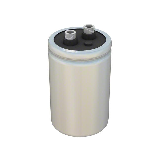

    4500 µF 35 V 铝电解电容器 径向,Can - 螺丝端子 24 毫欧 @ 120Hz 85°C 时为 1000 小时
CGO452M035L 数据手册
Type CGO Ultra Low ESR Screw Terminal Aluminum Electrolytic Extremely Low ESR, Low Voltage, Screw Terminal Capacitors T O N Type CGO low voltage, low ESR, screw terminal aluminum electrolytic capacitors have extremely low ESR and are suitable for output filtering in switch mode power supply applications. R O EC Highlights ED D EN M M • Extremely low ESR • Low voltage • Screw Terminal • 35 mm diameter RoHS Compliant Specifications FO Capacitance Range: 2,800 to 45,000 µF Voltage Range: 5 to 55 WVdc Capacitance Tolerance: ±20% Operating Temperature: –40 to +85 ºC Ripple Current Multipliers: The maximum ripple current at 85 ºC and 20 kHz for CGO capacitors is shown in the standard Ratings Tables. Maximum ripple current may be adjusted by the multipliers in the tables below. R EW N N IG ES D S Ambient Temperature / Ripple Multiplier +45 ºC +55 ºC +65 ºC +75 ºC +85 ºC 2.15 1.93 1.73 1.50 1.30 1.00 E SE +35 ºC D Frequency / Ripple Multiplier C Rated M .84 .85 1000 Hz 2500 Hz .86 .87 10 kHz .95 R I ≤ 1.5 √CV after 5 minutes C = Capacitance in µF V = Rated Voltage I = Leakage current in µA L IB SS PO DC Leakage Current: 400 Hz FO 5 to 55 120 Hz C Voltage E QA Stability Test: Apply WVdc for 1000 h @ 85 ºC Capacitance change ≤15% from initial limits DC leakage current meets initial limits ESR ≤175% of initial measured value T EN EM AC L EP R Click here to see: Hardware & Mounting Options Click here to see: Mechanical Details CDE Cornell Dubilier • 1605 E. Rodney French Blvd. • New Bedford, MA 02744 • Phone: (508)996-8561 • Fax: (508)996-3830 • www.cde.com Type CGO Ultra Low ESR Screw Terminal Aluminum Electrolytic Ratings Max Catalog Part Number (µF) Ripple 120 Hz 20 kHz 20 kHz (Ω) T O N Cap Typical ESR R (Ω) Max Catalog Dia. Length (A) RMS (In.) (In.) EC M O 0.016 0.009 Ripple Cap Part Number 120 Hz 20 kHz 20 kHz (µF) (Ω) 5 WVdc ( 6 Vdc Surge ) 18000 CGO183M005L Typical ESR (Ω) Dia. Length (A) RMS (In.) (In.) 28 WVdc ( 32 Vdc Surge ) 9.8 1.375 2.125 7.5 WVdc ( 9 Vdc Surge ) .0158 0.010 9.4 1.375 2.125 21000 CGO213M7R5L 0.013 0.008 10.9 1.375 2.625 27000 CGO273M7R5L 0.011 0.007 12.7 1.375 3.125 33000 CGO333M7R5L 0.009 0.006 14.2 1.375 3.625 39000 CGO393M7R5L 0.009 0.006 15.5 1.375 4.125 45000 CGO453M7R5L 0.008 0.005 17.5 1.375 4.625 ED D EN M 15000 CGO153M7R5L FO R EW N 10 WVdc ( 12 Vdc Surge ) 6300 CGO632M028L 0.021 0.012 8.3 1.375 2.125 8800 CGO882M028L 0.017 0.010 9.9 1.375 2.625 8900 CGO892M028L 0.017 0.010 10.1 1.375 2.625 14000 CGO143M028L 0.012 0.008 13.1 1.375 3.625 35 WVdc ( 40 Vdc Surge ) 4,500 CGO452M035L 0.024 0.012 8.2 1.375 2.125 6300 CGO632M035L 0.019 0.010 9.8 1.375 2.625 8100 CGO812M035L 0.015 0.009 11.5 1.375 3.125 0.018 0.010 9.3 1.375 2.125 10000 CGO103M035L 0.013 0.008 13.0 1.375 3.625 19000 CGO193M010L 0.013 0.008 10.9 1.375 2.625 14000 CGO143M035L 0.010 0.006 16.1 1.375 4.625 16 WVdc ( 18 Vdc Surge ) ES D 14000 CGO143M010L .0167 0.010 9.3 1.375 2.125 14000 CGO143M016L 0.008 0.006 10.9 1.375 2.625 18000 CGO183M016L 0.011 0.007 12.6 1.375 3.125 22000 CGO223M016L 0.010 0.006 14.2 1.375 3.625 N S 45 WVdc ( 50 Vdc Surge ) 3800 CGO382M045L 0.032 0.018 8.1 1.375 2.125 4600 CGO462M045L 0.024 0.013 9.7 1.375 2.625 10000 CGO103M045L 0.022 0.013 15.6 1.375 4.625 E SE 20 WVdc ( 22 Vdc Surge ) IG 10000 CGO103M016L 2800 55 WVdc ( 64 Vdc Surge ) 7.5 1.375 2.125 CGO392M055L 0.023 0.012 9.0 1.375 2.625 CGO502M055L 0.019 0.010 10.6 1.375 3.125 10000 CGO103M055L 0.011 0.006 17.2 1.375 5.625 .0142 0.009 10.8 1.375 2.625 16000 CGO163M020L 0.012 0.007 12.6 1.375 3.125 3900 20000 CGO203M020L 0.010 0.007 14.1 1.375 3.625 5000 22000 CGO223M020L 0.009 0.006 15.4 1.375 4.125 27000 CGO273M020L 0.008 0.005 17.4 1.375 4.625 34000 CGO343M020L 0.007 0.005 19.6 1.375 5.625 CGO282M055L .0302 0.015 C D 12000 CGO123M020L C M R FO E L IB SS PO T EN EM AC L EP R CDE Cornell Dubilier • 1605 E. Rodney French Blvd. • New Bedford, MA 02744 • Phone: (508)996-8561 • Fax: (508)996-3830 • www.cde.com T O N Notice and Disclaimer: All product drawings, descriptions, specifications, statements, information and data (collectively, the “Information”) in this datasheet or other publication are subject to change. The customer is responsible for checking, confirming and verifying the extent to which the Information contained in this datasheet or other publication is applicable to an order at the time the order is placed. All Information given herein is believed to be accurate and reliable, but it is presented without any guarantee, warranty, representation or responsibility of any kind, expressed or implied. Statements of suitability for certain applications are based on the knowledge that the Cornell Dubilier company providing such statements (“Cornell Dubilier”) has of operating conditions that such Cornell Dubilier company regards as typical for such applications, but are not intended to constitute any guarantee, warranty or representation regarding any such matter – and Cornell Dubilier specifically and expressly disclaims any guarantee, warranty or representation concerning the suitability for a specific customer application, use, storage, transportation, or operating environment. The Information is intended for use only by customers who have the requisite experience and capability to determine the correct products for their application. Any technical advice inferred from this Information or otherwise provided by Cornell Dubilier with reference to the use of any Cornell Dubilier products is given gratis (unless otherwise specified by Cornell Dubilier), and Cornell Dubilier assumes no obligation or liability for the advice given or results obtained. Although Cornell Dubilier strives to apply the most stringent quality and safety standards regarding the design and manufacturing of its products, in light of the current state of the art, isolated component failures may still occur. Accordingly, customer applications which require a high degree of reliability or safety should employ suitable designs or other safeguards (such as installation of protective circuitry or redundancies or other appropriate protective measures) in order to ensure that the failure of an electrical component does not result in a risk of personal injury or property damage. Although all product-related warnings, cautions and notes must be observed, the customer should not assume that all safety measures are indicated in such warnings, cautions and notes, or that other safety measures may not be required. ED D EN M M O EC R FO R EW N N IG AC ES D S E SE C D C M R FO E L IB SS PO T EN EM AC L EP R 4
