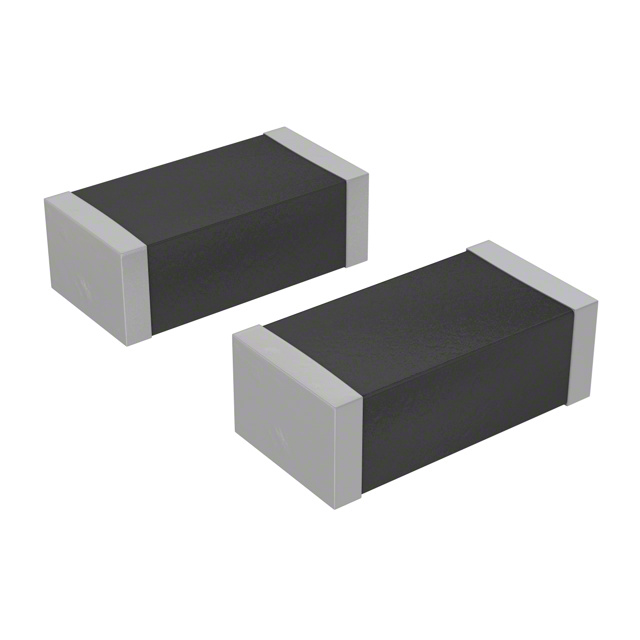

    薄膜电容 1206 22nF ±2% 3.20 x 1.60mm
FCP1206C223G-H1 数据手册
Type FCP Surface Mount Film Capacitors Stable Stacked Metallized Film (PPS) Chips for Reflow Soldering The Type FCP’s combination of high capacitance density and excellent high frequency response makes it a great choice for wireless and instrumentation applications. Type FCP stacked metallized polyphenelene sulfide (PPS) film capacitors offer high capacitance per unit volume, stable capacitance and DF over a wide temperature range, and excellent high frequency performance. Type FCP capacitors conform to standard EIA 0603, 0805, 1206, 1210, 1913 & 2416 surface mount case sizes and are packaged on tape and reel. Specifications Highlights - Stacked metallized polyphenylene sulfide (PPS) film. High operating temperature to +125 ºC High capacitance per unit volume Excellent high frequency performance Typical ΔC from –55 ºC to 105 ºC ≤ ±1.5% Stable cap and DF over wide temperature range Capacitance Range 100 pF to 0.22 µF (1kHz at ≤5 Vrms) Capacitance Tolerance ±5% (J) Standard, ±2% (G) Optional Rated Voltage 16 Vdc and 50 Vdc Dissipation Factor (Tan δ) 0.6% Max. (1 kHz at ≤5 Vrms) Operating Temperature Range –55 ºC to +125 ºC (See Voltage derating chart for 0.12 - 0.22 µF above 105 ºC) Dielectric Strength 150% of rated Vdc for 60 s Insulation Resistance 3000 MΩ Min. at 20 ºC, after 60 s (16 Vdc rated, test 10 Vdc; 50 Vdc rated, test 50 Vdc) Construction Stacked metallized polyphenylene sulfide (PPS) film. Terminations are lead free with a Sn-Ag-Cu solder finish. Life Test Capacitors subjected to 1000 hours of maximum rated temperature and 125% of the rated voltage will not have any significant visual damage, thecapacitance will be within ±2% of the initial measured value, DF will be a maximum of 0.66%, and IR will be a minimum of 1000 Megohms. Moisture Resistance Capacitors subjected to 1000 h at 40 °C and 90% to 95% RH and rated voltage will not have any significant visual damage, will withstand 1.3 times the rated voltage for one minute, the capacitance will be within ±2% of the initial measured value, DF will be a maximum of 0.9%, and IR will be a minimum of 1000 Megohms. Regulatory Information Cornell Dubilier • 1605 E. Rodney French Blvd. • New Bedford, MA 02744 • Phone: (508)996-8564 • Fax: (508)996-3830 • www.cde.com Type FCP Surface Mount Film Capacitors Stable Stacked Metallized Film (PPS) Chips for Reflow Soldering Ratings Capacitance 16 Vdc 50 Vdc Catalog Case Catalog Case Part Number Code Part Number Code (µF) (nF) (pF) .00010 .10 100 FCP0603C101J-K1 FCP0805H101J-J1 .00012 .12 120 FCP0603C121J-K1 FCP0805H121J-J1 .00015 .15 150 FCP0603C151J-K1 FCP0805H151J-J1 .00018 .18 180 FCP0603C181J-K1 FCP0805H181J-J1 .00022 .22 220 FCP0603C221J-K1 FCP0805H221J-J1 .00027 .27 270 FCP0603C271J-K1 FCP0805H271J-J1 .00033 .33 330 FCP0603C331J-K1 FCP0805H331J-J1 .00039 .39 390 FCP0603C391J-K1 FCP0805H391J-J1 .00047 .47 470 FCP0603C471J-K1 .00056 .56 560 FCP0603C561J-K1 .00068 .68 680 FCP0603C681J-K1 FCP0805H681J-J1 0603 FCP0805H471J-J1 FCP0805H561J-J1 .00082 .82 820 FCP0603C821J-K1 FCP0805H821J-J1 .0010 1.00 1000 FCP0603C102J-K1 FCP0805H102J-J1 .0012 1.20 1200 FCP0603C122J-K1 FCP0805H122J-J1 .0015 1.50 1500 FCP0603C152J-K1 FCP0805H152J-J1 .0018 1.80 1800 FCP0603C182J-K1 FCP0805H182J-J1 .0022 2.20 2200 FCP0603C222J-K1 FCP0805H222J-J1 .0027 2.70 2700 FCP0603C272J-K1 FCP0805H272J-J1 .0033 3.30 3300 FCP0805C332J-J1 FCP1206H332J-H1 .0039 3.90 3900 FCP0805C392J-J1 FCP1206H392J-H1 .0047 4.70 4700 FCP0805C472J-J1 FCP1206H472J-H1 .0056 5.60 5600 FCP0805C562J-J1 .0068 6.80 6800 FCP0805C682J-J1 FCP1206H682J-H1 .0082 8.20 8200 FCP0805C822J-J2 FCP1206H822J-H2 .010 10 10000 FCP0805C103J-J2 FCP1206H103J-H2 .012 12 12000 FCP1206C123J-H1 FCP1210H123J-G1 .015 15 15000 FCP1206C153J-H1 FCP1210H153J-G1 .018 18 18000 FCP1206C183J-H1 FCP1210H183J-G2 .022 22 22000 FCP1206C223J-H1 .027 27 27000 FCP1206C273J-H2 .033 33 33000 FCP1206C333J-H2 FCP1210H333J-G3 .039 39 39000 FCP1206C393J-H3 FCP1210H393J-G3 .047 47 47000 FCP1206C473J-H3 FCP1913H473J-E1 .056 56 56000 FCP1210C563J-G2 FCP1913H563J-E1 .068 68 68000 FCP1210C683J-G2 .082 82 82000 FCP1210C823J-G3 .100 100 100000 FCP1210C104J-G3 .12 120 120000 FCP2416H124J-D1 .15 150 150000 FCP2416H154J-D1 .18 180 180000 FCP2416H184J-D3 .22 220 220000 FCP2416H224J-D4 805 1206 1210 FCP1206H562J-H1 FCP1210H223J-G2 0805 1206 1210 FCP1210H273J-G2 FCP1913H683J-E1 1913 FCP1913H823J-E2 FCP1913H104J-E2 2416 Cornell Dubilier • 1605 E. Rodney French Blvd. • New Bedford, MA 02744 • Phone: (508)996-8564 • Fax: (508)996-3830 • www.cde.com Type FCP Surface Mount Film Capacitors Stable Stacked Metallized Film (PPS) Chips for Reflow Soldering Typical Temperature Characteristics Insulation Resistance 1000 1000Megohms Typical Frequency Characteristics 100 to 1000 pF 100 0.01 µF 0.1 µF 10 0.22 µF 1 -60 -40 -20 0 20 40 60 80 100 120 140 Temperature (°C) Cornell Dubilier • 1605 E. Rodney French Blvd. • New Bedford, MA 02744 • Phone: (508)996-8564 • Fax: (508)996-3830 • www.cde.com Type FCP Surface Mount Film Capacitors Stable Stacked Metallized Film (PPS) Chips for Reflow Soldering Outline Dimensions For packaging codes/dimensions please click here for Application Guide Case Code Outline Dimensions (in.) Case Code (metric) L ±0.2 Outline Dimensions (mm) L ±0.008 W T±0.008 t W T±0.2 t 0603 0.063 0.032±0.006 0.028±0.006 0.014±0.008 1608 1.6 0.80±0.15 0.70±0.15 0.35±0.2 0805 0.079 0.049±0.008 0.018±0.010 2012 2.0 1.25±0.2 0.035 0.043 0.035 1206 1210 1913 0.126 0.126 0.189 0.063±0.008 0.098±0.008 0.130±0.012 0.043 0.236 0.161±0.012 1.1 0.45±0.25 0.9 0.026±0.012 3216 3.2 1.6±0.2 1.1 K1 J1 J2 H1 0.65±0.3 H2 0.059 1.5 H3 0.043 1.1 G1 0.059 0.026±0.012 3225 3.2 2.5±0.2 1.5 0.083 2.1 0.059 1.5 0.083 0.031±0.012 4833 4.8 3.3±0.3 0.075 2416 0.9 Packaging Code 0.098 2.1 0.65±0.3 G3 0.80±0.3 1.9 0.031±0.012 6041 6.0 4.1±0.3 0.110 2.5 2.8 G2 E1 E2 D1 0.80±0.3 D3 D4 10000 dv/dt (V/us) 1000 50V FCP 100 16V FCP 10 1 0.00010 0.00100 0.01000 0.10000 1.00000 Capacitance (uF) Cornell Dubilier • 1605 E. Rodney French Blvd. • New Bedford, MA 02744 • Phone: (508)996-8564 • Fax: (508)996-3830 • www.cde.com Type FCP Surface Mount Film Capacitors Stable Stacked Metallized Film (PPS) Chips for Reflow Soldering FCP 0805 50 Vdc Rating Vrms and Arms vs. Frequency 0.15 100 100 pF to 2700 pF 2700 pF 2200 pF Arms Vrms 0.10 10 1800 pF 0.05 1200 pF 820 pF 560 pF 1 10 100 100 pF 0.00 1000 10 100 Frequency (kHz) 1000 Frequency (kHz) FCP 1206 50 Vdc Rating Vrms and Arms vs. Frequency 0.50 100 0.40 Arms Vrms 3300 pF to 0.010 uF 10 .01 uF 8200 pF 0.30 6800 pF 5600 pF 0.20 4700 pF 3300 pF 0.10 0.00 1 10 100 Frequency (kHz) 1000 10 100 1000 Frequency (kHz) Cornell Dubilier • 1605 E. Rodney French Blvd. • New Bedford, MA 02744 • Phone: (508)996-8564 • Fax: (508)996-3830 • www.cde.com Type FCP Surface Mount Film Capacitors Stable Stacked Metallized Film (PPS) Chips for Reflow Soldering FCP 1210 50 Vdc Rating Vrms and Arms vs. Frequency 100 1.50 .039 uF .033 uF .027 uF .022 uF .018 uF .015 uF .012 uF Arms Vrms 1.00 .012 uF .015 uF .022 uF .027 uF .033 uF .039 uF 0.50 10 0.00 10 100 1000 10 100 Frequency (kHz) 1000 Frequency (kHz) FCP 1913 & 2416 50 Vdc Rating Vrms and Arms vs. Frequency 1.50 100 0.22 uF 0.18 uF 0.15 uF 0.12 uF Vrms 0.10 uF 0.082 uF 1.00 Arms 0.068 uF 0.056 uF 0.047 uF 30Vrms 0.047 uF 0.056 uF 0.068 uF 0.082 uF 0.10 uF 0.12 uF 0.15 uF 0.18 uF 0.22 uF 10 10 Frequency (kHz) 0.50 0.00 10 100 Frequency (kHz) 100 Maximum AC Voltage FCP 16Vdc Series Vrms 100 100pF - 0.1 µF 11 Vrms 10 1 10 100 Frequency (kHz) 1000 The capacitor surface temperature should not exceed 125 ºC. Cornell Dubilier • 1605 E. Rodney French Blvd. • New Bedford, MA 02744 • Phone: (508)996-8564 • Fax: (508)996-3830 • www.cde.com Type FCP Surface Mount Film Capacitors Stable Stacked Metallized Film (PPS) Chips for Reflow Soldering Typical Applications In PLL circuit applications, FCP SMT film capacitor advantages are tight tolerance on the capacitance value, stable capacitance with temperature, faster lock-up times, and no noise due to piezoelectric effects. Cornell Dubilier • 1605 E. Rodney French Blvd. • New Bedford, MA 02744 • Phone: (508)996-8564 • Fax: (508)996-3830 • www.cde.com Notice and Disclaimer: All product drawings, descriptions, specifications, statements, information and data (collectively, the “Information”) in this datasheet or other publication are subject to change. The customer is responsible for checking, confirming and verifying the extent to which the Information contained in this datasheet or other publication is applicable to an order at the time the order is placed. All Information given herein is believed to be accurate and reliable, but it is presented without any guarantee, warranty, representation or responsibility of any kind, expressed or implied. Statements of suitability for certain applications are based on the knowledge that the Cornell Dubilier company providing such statements (“Cornell Dubilier”) has of operating conditions that such Cornell Dubilier company regards as typical for such applications, but are not intended to constitute any guarantee, warranty or representation regarding any such matter – and Cornell Dubilier specifically and expressly disclaims any guarantee, warranty or representation concerning the suitability for a specific customer application, use, storage, transportation, or operating environment. The Information is intended for use only by customers who have the requisite experience and capability to determine the correct products for their application. Any technical advice inferred from this Information or otherwise provided by Cornell Dubilier with reference to the use of any Cornell Dubilier products is given gratis (unless otherwise specified by Cornell Dubilier), and Cornell Dubilier assumes no obligation or liability for the advice given or results obtained. Although Cornell Dubilier strives to apply the most stringent quality and safety standards regarding the design and manufacturing of its products, in light of the current state of the art, isolated component failures may still occur. Accordingly, customer applications which require a high degree of reliability or safety should employ suitable designs or other safeguards (such as installation of protective circuitry or redundancies or other appropriate protective measures) in order to ensure that the failure of an electrical component does not result in a risk of personal injury or property damage. Although all product-related warnings, cautions and notes must be observed, the customer should not assume that all safety measures are indicated in such warnings, cautions and notes, or that other safety measures may not be required.
FCP1206C223G-H1
物料型号:Type FCP
器件简介: - 采用堆叠的金属化聚苯硫醚(PPS)薄膜制成,具有高电容密度和优异的高频响应。 - 适用于无线和仪器设备应用。
引脚分配:符合EIA标准0603, 0805, 1206, 1210, 1913 & 2416表面贴装封装尺寸。
参数特性: - 电容范围:100 pF至0.22 uF - 电容公差:标准5%,可选±2% - 额定电压:16 Vdc和50Vdc - 损耗因子(DF):最大0.6% (1 kHz, ≤5 Vrms) - 工作温度范围:-55°C至+125°C - 介质强度:额定Vdc的150%持续60秒 - 结构:无铅端子,Sn-Ag-Cu焊料完成
功能详解: - 电容器在1000小时内经受最大额定温度和125%的额定电压,电容变化在+2%以内,DF最大0.66%,绝缘电阻至少1000兆欧。 - 经过1000小时40°C和90%至95%RH以及额定电压的测试,电容变化在±2%以内,DF最大0.9%,绝缘电阻至少1000兆欧。
应用信息: - 适用于xDSL电话线路的滤波电容、手机、蓝牙、数据通信卡的PLL电路等。
封装信息:提供了不同尺寸的封装代码和尺寸,以及包装代码。
