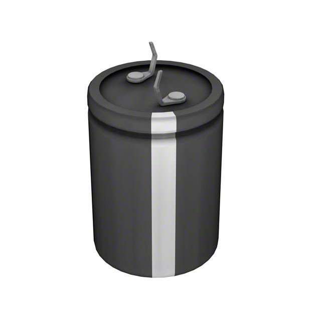

Type LP 105 ºC Snap-In Aluminum Electrolytic Capacitors Stable ESR, Long Life, Snap-In Type LP radial snap-in aluminum electrolytic capacitors are small in size and are rated for low voltage applications. Their durable construction guarantees a long life while operating up to 105 ºC with a stable ESR. These features make the Type LP ideal for use in switch-mode power supplies. Highlights • • • Capacitance Range: Voltage Range: Capacitance tolerance: Operating Temperature Range: Dissipation Factor: High Reliability 105 ºC 22 to 35 mm diameter with 10 mm lead spacing Specifications 100 to 47,000 µF 16 to 250 Vdc ±20% –40 ºC to +105 ºC DF at 120 Hz, +25 ºC Vdc DF % 16 30 25 - 35 25 50 - 63 20 100- 250 15 DC Leakage Test: For values that are >1000 µF, the DF (%) increases 2% for every additional 1000 µF I = .02CV C = capacitance in µF V = rated voltage I = leakage current in µA Rated Vdc 10 to 50 0.90 1.00 1.00 1.00 Ripple Multipliers 60 Hz 100 Hz 300 Hz 1000 Hz 10 kHz 100 kHz 1.03 1.07 1.15 1.65 2.25 2.55 Voltage/Frequency Ripple Multipliers: 1.05 1.13 1.25 1.10 1.19 1.35 1.10 1.20 1.40 63 to 100 0.85 160 to 250 0.80 Temperature Ripple Multipliers: Temperature +85 ºC +65 ºC +45 ºC Ripple Multiplier The maximum ripple current at 105 ºC and 120 Hz are the Ratings Table. Adjust to other temperature and frequencies using the tables here. Complies with the EU Directive 2002/95/EC requirement restricting the use of Lead (Pb), Mercury (Hg), Cadmium (Cd), Hexavalent chromium (Cr(VI)), PolyBrominated Biphenyls (PBB) and PolyBrominated Diphenyl Ethers (PBDE). Load Life Test: 1,000 h @ full load at +105 ºC per EIA IS-749 ∆ Capacitance ±20% ESR 200% of limit DCL 100% of limit Shelf Life: 500 h @ 105 ºC, capacitance, ≤200% ESR and DC ±20%, initial requirements Vibration: 10 to 55 Hz, 0.06” and 10 g max, 2 h in each plane CDE Cornell Dubilier • 1605 E. Rodney French Blvd. • New Bedford, MA 02744 • Phone: (508)996-8561 • Fax: (508)996-3830 • www.cde.com Type LP 105 ºC Snap-In Aluminum Electrolytic Capacitors Part Numbering System LP Type LP 332 Cap 821 = 820 µF 332 = 3300 µF 103 = 10,000 µF M Tolerance M = ±20% 025 Voltage 025 = 25 Vdc 250 = 250 Vdc A1 Case Code Polarity P = Polarized Length 30 A3 C3 E3 H3 25 mm 22 25 30 (in) (0.87) (1.00) (1.18) (1.38) A1 C1 E1 H1 35 A5 C5 E5 H5 P 3 Insulating Sleeve 3 = PVC 50 A9 C9 E9 H9 Diameter mm 40 A7 C7 E7 H7 (in) 45 A4 C4 E4 H4 (1.00) (1.18) (1.38) (1.57) (1.77) (2.00) Outline Drawing (Arrow Indicates Ground Lead) 35 Ratings Cap (µF) 4,700 5,600 8,200 12,000 15,000 22,000 27,000 33,000 47,000 2,700 3,300 3,300 4,700 5,600 5,600 6,800 10,000 12,000 15,000 22,000 Catalog Part Number Max ESR Max Ripple @ 120 Hz @ 120 Hz +25 ºC +105 ºC (Ω) (A) 16 Vdc; 20 Vdc Surge 0.141 1.20 0.120 1.43 0.081 1.82 0.055 2.38 0.046 3.00 0.030 3.53 0.025 4.27 0.020 5.00 0.020 6.80 25 Vdc; 32 Vdc Surge 0.180 1.000 0.151 1.160 0.150 1.143 0.106 1.480 0.090 1.857 0.089 1.730 0.073 1.940 0.050 3.333 0.041 2.970 0.033 3.360 0.023 4.857 Size (Inches) D L 0.866 0.984 0.866 1.181 1.378 1.181 1.378 1.378 1.181 0.984 0.866 0.984 0.984 1.181 0.984 0.984 1.378 1.378 1.181 1.378 0.984 0.984 1.378 1.181 1.181 1.575 1.575 1.969 1.969 0.984 0.984 0.984 0.984 0.984 1.181 1.378 1.181 1.181 1.575 1.969 (Dimension in Millimeters) Size (mm) D L 22 25 22 30 35 30 35 35 30 25 22 25 25 30 25 25 35 35 30 35 25 25 35 30 30 40 40 50 50 25 25 25 25 25 30 35 30 30 40 50 Cap (µF) 1,800 2,700 3,900 5,600 6,800 6,800 8,200 10,000 12,000 15,000 1,200 1,500 2,200 2,200 3,300 3,300 3,300 3,900 4,700 Catalog Part Number LP472M016A1P3 LP562M016C1P3 LP822M016A5P3 LP123M016E3P3 LP153M016H3P3 LP223M016E7P3 LP273M016H7P3 LP333M016H9P3 LP473M016E9P3 LP272M025C1P3 LP332M025A1P3 LP332M025C1P3 LP472M025C1P3 LP562M025E1P3 LP562M025C3P3 LP682M025C5P3 LP103M025H3P3 LP123M025H3P3 LP153M025E7P3 LP223M025H9P3 LP182M035A1P3 LP272M035C1P3 LP392M035E1P3 LP562M035E3P3 LP682M035E5P3 LP682M035C7P3 LP822M035H3P3 LP103M035E7P3 LP123M035H7P3 LP153M035H9P3 LP122M050A1P3 LP152M050A1P3 LP222M050A5P3 LP222M050E1P3 LP332M050E3P3 LP332M050C5P3 LP332M050C3P3 LP392M050C7P3 LP472M050H3P3 Max ESR Max Ripple @ 120 Hz @ 120 Hz +25 ºC +105 ºC (Ω) (A) 35 Vdc; 44 Vdc Surge 0.188 1.040 0.155 1.257 0.108 1.571 0.074 2.050 0.060 2.286 0.061 2.320 0.051 2.690 0.041 3.000 0.035 3.590 0.028 4.000 50 Vdc; 63 Vdc Surge 0.280 0.860 0.225 0.983 0.151 1.330 0.150 1.429 0.101 0.176 0.101 1.710 0.101 1.710 0.085 1.970 0.071 2.270 Size (Inches) D L 0.866 0.984 1.181 1.181 1.181 0.984 1.378 1.181 1.378 1.378 0.866 0.866 0.866 1.181 1.181 0.984 0.984 0.984 1.378 0.984 0.984 0.984 1.181 1.378 1.575 1.181 1.575 1.575 1.969 0.984 0.984 1.378 0.984 1.181 1.378 1.181 1.575 1.181 Size (mm) D L 22 25 30 30 30 25 35 30 35 35 22 22 22 30 30 25 25 25 35 25 25 25 30 35 40 30 40 40 50 25 25 35 25 30 35 30 40 30 CDE Cornell Dubilier • 1605 E. Rodney French Blvd. • New Bedford, MA 02744 • Phone: (508)996-8561 • Fax: (508)996-3830 • www.cde.com Type LP 105 ºC Snap-In Aluminum Electrolytic Capacitors Max ESR Catalog Part Number Max ESR Max Ripple @ 120 Hz @ 120 Hz +25 ºC +105 ºC (Ω) (A) 50 Vdc; 63 Vdc Surge 0.059 2.60 0.049 3.16 0.049 3.16 0.040 3.43 63 Vdc; 75 Vdc Surge 0.300 0.77 0.210 0.99 0.138 1.34 0.140 1.37 0.113 1.55 0.076 1.20 0.053 2.84 0.037 3.36 100 Vdc; 125 Vdc Surge 0.3 0.98 0.113 2.03 0.092 2.32 0.092 2.32 200 Vdc; 250 Vdc Surge 1.650 0.509 1.650 0.509 1.400 0.571 1.100 0.646 1.100 0.646 1.130 0.660 0.920 0.790 0.920 0.790 0.750 0.886 0.640 0.980 0.540 1.143 Size (Inches) D L 1.378 1.181 1.181 1.378 0.866 0.984 0.866 1.181 1.181 1.378 1.181 1.378 1.181 1.378 1.378 1.378 0.984 0.866 0.984 0.984 1.181 0.866 1.181 0.984 1.181 0.984 1.181 1.378 1.575 1.969 1.969 0.984 0.984 1.575 0.984 1.181 1.181 1.969 1.969 0.984 1.575 1.969 1.575 0.984 0.984 0.984 0.984 0.984 1.181 0.984 1.181 1.181 1.378 1.378 Size (mm) DL 35 30 30 35 22 25 22 30 30 35 30 35 30 35 35 35 25 22 25 25 30 22 30 25 30 25 30 35 40 50 50 25 25 40 25 30 30 50 50 25 40 50 40 25 25 25 25 25 30 25 30 30 35 35 Catalog Cap (µF) 470 470 560 680 680 680 820 820 1,000 1,000 1200 1,200 1,500 1,800 100 150 180 220 270 330 390 470 470 560 680 680 820 1,000 1,200 LP471M200E1P3 LP471M200H3P3 LP561M200H3P3 LP681M200E3P3 LP681M200E5P3 LP681M200H1P3 LP821M200H7P3 LP821M200H3P3 LP102M200H9P3 LP102M200H5P3 LP122M200E9P3 LP122M200H5P3 LP152M200H4P3 LP182M200H9P3 LP101M250A1P3 LP151M250C1P3 LP181M250C3P3 LP221M250E1P3 LP271M250C3P3 LP331M250E3P3 LP391M250H3P3 LP471M250E7P3 LP471M250H1P3 LP561M250H3P3 LP681M250E9P3 LP681M250H5P3 LP821M250H7P3 LP102M250H4P3 LP122M250H9P3 Part Number @ 120 Hz +25 ºC (Ω) 0.540 0.540 0.440 0.370 0.370 0.370 0.300 0.300 0.250 0.250 0.165 0.165 0.134 0.112 2.500 1.660 1.400 1.130 0.922 0.750 0.640 0.530 0.530 0.347 0.370 0.370 0.243 0.200 0.165 Max Ripple @ 120 Hz +105 ºC (A) 1.140 1.143 1.310 1.520 1.510 1.510 1.750 1.750 2.114 2.114 2.810 2.740 3.330 3.800 0.410 0.540 0.686 0.710 0.840 0.914 1.090 1.260 1.260 1.800 1.920 2.070 2.400 2.720 3.100 D Size (Inches) L Size (mm) D L 25 30 30 30 35 25 40 30 50 35 50 35 45 50 25 25 30 25 30 30 30 40 25 30 50 35 40 45 50 Cap (µF) 5,600 6,800 6,800 8,200 820 1,200 1,800 1,800 2,200 3,300 4,700 6,800 820 2,200 2,700 2,700 150 150 180 220 220 220 270 270 330 390 470 LP562M050H5P3 LP682M050E7P3 LP682M050E9P3 LP822M050H9P3 LP821M063A1P3 LP122M063C1P3 LP182M063A7P3 LP182M063E1P3 LP222M063E3P3 LP332M063H3P3 LP472M063E9P3 LP682M063H9P3 LP821M100E1P3 LP222M100H7P3 LP272M100H9P3 LP272M100H7P3 LP151M200C1P3 LP151M200A1P3 LP181M200C1P3 LP221M200C1P3 LP221M200E1P3 LP221M200A3P3 LP271M200E1P3 LP271M200C3P3 LP331M200E3P3 LP391M200C5P3 LP471M200E5P3 200 Vdc; 250 Vdc Surge 1.181 0.984 30 1.378 1.181 35 1.378 1.181 35 1.181 1.181 30 1.181 1.378 30 1.378 0.984 35 1.378 1.575 35 1.378 1.181 35 1.378 1.969 35 1.378 1.378 35 1.181 1.969 30 1.378 1.378 35 1.378 1.772 35 1.378 1.969 35 0.866 0.984 22 0.984 0.984 25 0.984 1.181 25 1.181 0.984 30 0.984 1.181 25 1.181 1.181 30 1.378 1.181 35 1.181 1.575 30 1.378 0.984 35 1.378 1.181 35 1.181 1.969 30 1.378 1.378 35 1.378 1.575 35 1.378 1.772 35 1.378 1.969 35 250 Vdc; 300 Vdc Surge CDE Cornell Dubilier • 1605 E. Rodney French Blvd. • New Bedford, MA 02744 • Phone: (508)996-8561 • Fax: (508)996-3830 • www.cde.com
