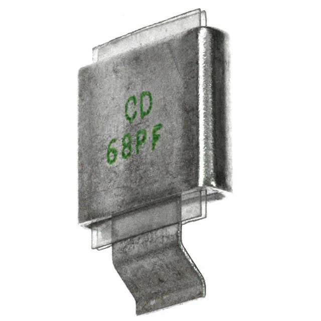

Types MCM and MIN SMT Clad RF Capacitors Multilayer High Power, High Temperature Mica and PTFE Capacitors Types MCM and MIN SMT clad PTFE and mica capacitors are top performers for high power applications requiring low inductance at high frequencies and can operate at temperatures up to 200 ºC and voltages to 1000 Vdc. Choosing from 16 different configurations offers easy mounting with options for surface mount as well as through-hole and mechanical assembly. To assure high current capability in the smallest capacitors, low-capacitance ratings use polytetrafluorethylene (PTFE) that has ultra-low dielectric absorption - better than polypropylene, polystyrene and NPO ceramic. l si ze Highlights act ua • 200 ºC rated with no voltage derating • Wave solderable • No cracking or delaminating • CTE ≈ 18 ppm/ºC compatible with FR4 PCBs • Highly thermal conductive package • Gull-wing terminal minimizes stress • Typical 100 pF ESR, 100 pF ▲ 0091,2 ▲ 010 ▲ ▲ Most Popular Series, other's (751) = 751 F = ±1 % > 33 pF 102 = 1000 G = ±2% > 11 pF J = ±5% > 11 pF available, consult factory 1 Surface mount and T&R 2 1kV Style A = ±1 pF 2 - 200 pF Capacitance Temperature Range Characteristic C 1 pF to 20 pF ±200 ppm/ºC D 21 pF to 56 pF ±100 ppm/ºC E 57 pF to 1500 pF –20 to +100 ppm/ºC *TC code letter is left blank for PTFE items RoHS Packaging –T = Tape Blank = Bulk Compliant Blank = Not specified F = Compliant K = ±10% > 11 pF Measured at 1 MHz for ≤1000 pF and 1 kHz for >1000 pF CDE Cornell Dubilier • 1605 E. Rodney French Blvd. • New Bedford, MA 02744 • Phone: (508)996-8561 • Fax: (508)996-3830 • www.cde.com 2 Types MCM and MIN SMT Clad RF Capacitors Typical Performance Data click here to see additional rating charts ESR vs. Frequency for 470 pF 1 ESR (Ω) 0.1 0.01 0.001 1 10 100 f(MHz) 1000 10000 Current Rating (IRMS) for 470 pF at 60 ºC Rise RMS Current (Amps) 100 10 1 1 10 100 f(MHz) 1000 10000 CDE Cornell Dubilier • 1605 E. Rodney French Blvd. • New Bedford, MA 02744 • Phone: (508)996-8561 • Fax: (508)996-3830 • www.cde.com 3 Types MCM and MIN SMT Clad RF Capacitors Types MCM and MIN SMT Clad RF Capacitors Q vs. Frequency 470 pF @ 25 ºC 100000 Porcelain (2525) 10000 1000 MCM01 (≈4640) Q MC (1812) MC (2220) Q 100 Porcelain (3838) MCH (3838) 10 1 1 10 100 1000 10000 f (MHz) MCM01-009 (�4640) 1000 Vdc MC22FF471J 1000 Vdc Porcelain (2525) 1.5 kVdc MCH (3838) 2.5 kVdc Porcelain (3838) 2.5 kVdc MC18FD471J 500 Vdc Impedance |Z| vs. Frequency for 470 pF @ 25 ºC 1000 Impedance Z vs. Frequency for 470 pF @ 25 ºC 1000 100 |Z| (Ω ) Porcelain (3838) 10 MCM01 (≈4640) MC (1812) MCH (3838) 100 MC (2220) Z (� ) 1 Porcelain (3838) 1 10 MC (1812) MCH (3838) Porcelain (2525) 0.1 1 10 100 MCM01 (�4640) 1000 f (MHz) 10000 MC (2220) 1 MCM01-009 (�4640) 1000 Vdc Porcelain (2525) 1.5 kVdc MC22FF471J 1000 Vdc MCH (3838) 2.5 kVdc Porcelain (2525) 0.1 Porcelain (3838) 2.5 kVdc MC18FD471J 500 Vdc 1 10 100 1000 10000 CDE Cornell Dubilier • 1605 E. Rodney French Blvd. • New Bedford, MA 02744 • Phone: (508)996-8561 • Fax: (508)996-3830 • www.cde.com f (MHz) 4 MCM01-009 (�4640) 1000 Vdc Porcelain (2525) 1.5 kVdc Porcelain (3838) 2.5 kVdc MC22FF471J 1000 Vdc MCH (3838) 2.5 kVdc MC18FD471J 500 Vdc CDE Cornell Dubilier • 1605 E. Rodney French Blvd. • New Bedford, MA 02744 • Phone: (508)996-8561 • Fax: (508)996-3830 • www.cde.com 4 Types MCM and MIN SMT Clad RF Capacitors Outline Drawings for Popular Items MCM01-001 MIN02-002 . .093” DIA. .312” .187” .207”.163” .100” .218" .218” .203” .042” “T” .207” .010” ±.001” .020” .604” MAX. .460” MAX .365” “T” “T” (thickness) depending on capacitance value = .065 to .125±.015 .400” .010” ±.001 “T” (thickness) depending on capacitance value= .110 to .165±.015 MCM01-009 MCM01-010 0.605" .156” REF .400” ±.010 0.365" Max. .500” MAX 0.203" 0.400" 0.460" Max. “T” 0.145" Max. .100” .200” 0.400" “T” (thickness) depending on capacitance value= .110 to .165±.015 Terminal A .138” REF .010” .020” .090” .001” .001” .170” .173” .210” For single plate construction .150” 270 pF or less .062” DIA. 2 Holes For Terminal “A” 0.030" “T” .185” .081” DIA. 2 Holes “T” (thickness) depending on capacitance value= .110 to .165±.015 “T” varies with capacitance CDE Cornell Dubilier • 1605 E. Rodney French Blvd. • New Bedford, MA 02744 • Phone: (508)996-8561 • Fax: (508)996-3830 • www.cde.com 5 Types MCM and MIN SMT Clad RF Capacitors Standard Minimum Quantities Tape Specifications Bulk Pack: 100 pieces per bag Reel Pack: 500 pieces per reel Tape Dimensions (mm) Case MIN02-002 < 150 pF MIN02-002 ≥ 150 pF W A B P1 F t 16 5.56 8.18 8 7.5 2.16 16 5.66 8.10 8 7.5 3.20 Note: 24 mm tape for MCM01-009 and 32 mm tape for MCM01-004 are available upon request. Solder Profile Reflow Soldering Method 300 Specifications: Case and Terminal Material: Silver plated, copper flashed, brass 220 - 260 ºC Temperature ºC Lead free finish Peak 230 - 260 ºC 260 200 10 sec. max. 150 100 50 Pre-Heat 0 30 50 Soldering Cooling 190 150 200 Time (seconds) Wave Soldering Method 300 Peak 230 - 260 ºC Temperature ºC 250 220 - 260 ºC 200 5 sec. max. 150 100 50 0 Pre-Heat 0 20 Cooling Soldering 70 80 90 Time (seconds) CDE Cornell Dubilier • 1605 E. Rodney French Blvd. • New Bedford, MA 02744 • Phone: (508)996-8561 • Fax: (508)996-3830 • www.cde.com 6 7-9-2008 fixed graphs Types MCM and MIN SMT Clad RF Capacitors Notice and Disclaimer: All product drawings, descriptions, specifications, statements, information and data (collectively, the “Information”) in this datasheet or other publication are subject to change. The customer is responsible for checking, confirming and verifying the extent to which the Information contained in this datasheet or other publication is applicable to an order at the time the order is placed. All Information given herein is believed to be accurate and reliable, but it is presented without any guarantee, warranty, representation or responsibility of any kind, expressed or implied. Statements of suitability for certain applications are based on the knowledge that the Cornell Dubilier company providing such statements (“Cornell Dubilier”) has of operating conditions that such Cornell Dubilier company regards as typical for such applications, but are not intended to constitute any guarantee, warranty or representation regarding any such matter – and Cornell Dubilier specifically and expressly disclaims any guarantee, warranty or representation concerning the suitability for a specific customer application, use, storage, transportation, or operating environment. The Information is intended for use only by customers who have the requisite experience and capability to determine the correct products for their application. Any technical advice inferred from this Information or otherwise provided by Cornell Dubilier with reference to the use of any Cornell Dubilier products is given gratis (unless otherwise specified by Cornell Dubilier), and Cornell Dubilier assumes no obligation or liability for the advice given or results obtained. Although Cornell Dubilier strives to apply the most stringent quality and safety standards regarding the design and manufacturing of its products, in light of the current state of the art, isolated component failures may still occur. Accordingly, customer applications which require a high degree of reliability or safety should employ suitable designs or other safeguards (such as installation of protective circuitry or redundancies or other appropriate protective measures) in order to ensure that the failure of an electrical component does not result in a risk of personal injury or property damage. Although all product-related warnings, cautions and notes must be observed, the customer should not assume that all safety measures are indicated in such warnings, cautions and notes, or that other safety measures may not be required. CDE Cornell Dubilier • 1605 E. Rodney French Blvd. • New Bedford, MA 02744 • Phone: (508)996-8561 • Fax: (508)996-3830 • www.cde.com 7

1. 物料型号:文档中提到了两种型号的射频电容器,分别是MCM和MIN,它们是用于高功率应用的多层高功率、高温的PTFE和云母电容器。
2. 器件简介:这些电容器适用于需要在高频下具有低电感的高功率应用,并且可以在高达200°C的温度和高达1000Vdc的电压下工作。
3. 引脚分配:文档中提到了多种配置选项,包括表面贴装和通孔安装,以及机械组装。
4. 参数特性: - 电容范围:MCM为1至1500pF,MIN为1至350pF。 - 电压等级:MCM为300至1000Vdc,MIN为300Vdc。 - 温度范围:-55°C至+200°C,无电压降额。 - 介质强度:额定电压的200%,持续5秒。 - 绝缘电阻:在25°C时不低于1000 MΩ•µF。
5. 功能详解:文档强调了这些电容器的多个特点,包括200°C的额定温度、波峰焊接能力、无裂纹或分层、与FR4 PCB兼容的热膨胀系数、高热导性封装、减少应力的鸥翼形端子、低ESR和低ESL等。
6. 应用信息:这些电容器适用于射频功率放大器、激光器、移动无线电、等离子发生器、MRI线圈、射频医疗设备、陆地移动天线等多种应用。
