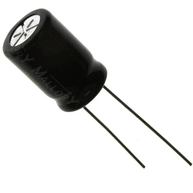

Type SEK 105 ºC Radial Leaded Aluminum Electrolytic Capacitors Long Life, Aluminum Electrolytic Type SEK is a radial leaded aluminum electrolytic capacitor with a +105 º C, long life rating. The volumetic efficient high CV product of the SEK makes it ideal for high density packaging in general purpose, coupling, decoupling, bypass and filtering circuit applications. Highlights • • • • • +105 ºC Long life High CV product General purpose applications Available in T&R and ammo pack Specifications Capacitance Range 0.47 to 15,000 µF Capacitance Tolerance ±20% Rated Voltage 6.3 to 450 Vdc Operating Temperature Range –55 ºC to +105 ºC; 6.3 to 100 Vdc –40 ºC to +105 ºC; 160 to 400 Vdc –25 ºC to +105 ºC; 450 Vdc Maximum DC Leakage Current After 2 minutes, with rated voltage at +20 ºC 6.3 to 100 Vdc I = .01CV or 3 µA Max (whichever is greater) ≥ 160 Vdc after 3 min, with rated voltage at +20 ºC I = .03CV or 10 µA Max (whichever is greater) C = Capacitance in (µF) V = Rated voltage I = Leakage current in µA Dissipation Factor @ 120 Hz, +25 ºC WV (V) 6.3 10 16 25 35 50 63 80 100 160-250 350-450 DF(%) 26 22 18 16 14 12 10 10 10 15 20 For capacitors whose capacitance value exceeds 1000 µF, the value of DF (%) is increased 2% for every additional 1000 µF. Ripple Multipliers for Voltage and Temperature: Rated Ripple Multipliers WVDC 60Hz 120Hz 1kHz 10kHz 6 to 25 0.80 1.0 1.1 1.2 35 to 100 0.75 1.0 1.3 1.4 160 to 250 0.70 1.0 1.4 1.6 350 to 400 0.60 1.0 1.5 1.8 Ambient Ripple Temperature Multiplier +105 ºC 1.00 +85 ºC 1.50 +70 ºC 1.80 Load Life Test Apply WVDC for 2000 hours at +105 ºC Capacitance change within 20% of initial limit DF not to exceed 200% of initial requirement Leakage current not to exceed 200% of initial Shelf Life Test 1000 hrs @105 ºC with no voltage applied Cap change within ±20% of initial values DF not to exceed 200% of initial requirement DC leakage current meets initial requirement Regulatory Information CDE Cornell Dubilier • 1605 E. Rodney French Blvd. • New Bedford, MA 02744 • Phone: (508)996-8561 • Fax: (508)996-3830 • www.cde.com Type SEK 105 ºC Radial Leaded Aluminum Electrolytic Capacitors Outline Drawing Outline Dimensions (Millimeters) Sleeving is PVC PET (PET for all date PVC Sleeve or PET (PET for allor date codes after October 2017)codes after December 2019) PVC L 15 Min. Case vented on diameters 6.3 and greater 5 + S 0.5 + d 0.05 D Vinyl sleeve adds .5 Max. to diameter and 2.0 Max. to length Part Numbering System Type Capacitance Rated Capacitance Tolerance Voltage (µF) (%) (Vdc) 100 M 100 3R0 = 3 K = ±10 6R3 = 6.3 A = Tape & Ammo 1 = Lead cut 100 = 10 M = ±20 010 = 10 E = Different Characteristic 2 = Lead form 100 = 100 R = Tape & Reel 4 = Lead crimp & cut (form) S = Standard T = Standard SEK 101 = 100 102 = 1000 Lead Packaging Configuration S T Temperature Characteristics 200 100 20 %C 50 1F 50V 10 0 %DF 100F 25V -10 100F 25V 10 5 -20 -40 1 0 40 80 Temperature C Capacitance Change Ratio 1F 50V -40 0 40 80 Temperature C Dissipation Factor Change Load Life Characteristics 100 10 %C 470F 25V 0 -10 40 50 %DF 30 20 100F 160V -20 0 250 500 Time In Hours 750 Capacitance Change Ratio 470F 25V 10 1000 100F 160V 0 250 500 Time In Hours 750 Dissipation Factor Change 1000 %LC 10 5 1 470F 25V 100F 160V 0 250 500 Time In Hours 750 1000 Leakage Current Change CDE Cornell Dubilier • 1605 E. Rodney French Blvd. • New Bedford, MA 02744 • Phone: (508)996-8561 • Fax: (508)996-3830 • www.cde.com Type SEK 105 ºC Radial Leaded Aluminum Electrolytic Capacitors Ratings Cap Max ESR Max Ripple Catalog 120 Hz 120 Hz Part Number 25 ºC 105 ºC Diameter Length Lead Space Lead Dia. (Ω) (mA) (D) (L) (S) (d) (µF) Size in. (mm) 6.3 Vdc (8 Volts Surge) 100 SEK101M6R3ST 3.45 100 .197 (5.0) .433 (11.0) .079 (2.0) .0197 (0.5) 220 SEK221M6R3ST 1.57 165 .248 (6.3) .433 (11.0) .098 (2.5) .0197 (0.5) 330 SEK331M6R3ST 1.05 200 .248 (6.3) .453 (11.5) .098 (2.5) .0197 (0.5) 470 SEK471M6R3ST 0.73 280 .315 (8.0) .453 (11.5) .138 (3.5) .0236 (0.6) 1000 SEK102M6R3ST 0.35 470 .394 (10.0) .512 (13.0) .197 (5.0) .0236 (0.6) 2200 SEK222M6R3ST 0.17 930 .394 (10.0) .827 (21.0) .197 (5.0) .0236 (0.6) 3300 SEK332M6R3ST 0.12 1100 .512 (13.0) .827 (21.0) .197 (5.0) .0236 (0.6) 4700 SEK472M6R3ST 0.10 1320 .630 (16.0) .984 (26.0) .295 (7.5) .0315 (0.8) 6800 SEK682M6R3ST 0.07 1490 .630 (16.0) .984 (25.0) .295 (7.5) .0315 (0.8) 10000 SEK103M6R3ST 0.06 1830 .630 (16.0) 1.26 (32.0) .295 (7.5) .0315 (0.8) 15000 SEK153M6R3ST 0.05 2280 .709 (18.0) 1.40 (36.0) .295 (7.5) .0315 (0.8) 10 Vdc (13 Volts Surge) 47 SEK470M010ST 6.21 75 .197 (5.0) .433 (11.0) .079 (2.0) .0197 (0.5) 100 SEK101M010ST 2.92 110 .197 (5.0) .433 (11.0) .079 (2.0) .0197 (0.5) 220 SEK221M010ST 1.33 180 .248 (6.3) .433 (11.0) .098 (2.5) .0197 (0.5) 330 SEK331M010ST 0.88 255 .315 (8.0) .453 (11.5) .138 (3.5) .0236 (0.6) 470 SEK471M010ST 0.62 305 .315 (8.0) .453 (11.5) .138 (3.5) .0236 (0.6) 1000 SEK102M010ST 0.29 570 .394 (10.0) .630 (16.0) .197 (5.0) .0236 (0.6) 2200 SEK222M010ST 0.14 1010 .512 (13.0) .827 (21.0) .197 (5.0) .0236 (0.6) 3300 SEK332M010ST 0.10 1220 .512 (13.0) .984 (25.0) .197 (5.0) .0236 (0.6) 4700 SEK472M010ST 0.08 1410 .630 (16.0) .984 (25.0) .295 (7.5) .0315 (0.8) 6800 SEK682M010ST 0.07 1610 .630 (16.0) 1.26 (32.0) .295 (7.5) .0315 (0.8) 10000 SEK103M010ST 0.05 1980 .709 (18.0) 1.40 (36.0) .295 (7.5) .0315 (0.8) 15000 SEK153M010ST 0.04 3330 .709 (18.0) 1.65 (42.0) .295 (7.5) .0315 (0.8) 16 Vdc (20 Volts Surge) 33 SEK330M016ST 7.24 70 .197 (5.0) .433 (11.0) .079 (2.0) .0197 (0.5) 47 SEK470M016ST 5.08 85 .197 (5.0) .433 (11.0) .079 (2.0) .0197 (0.5) 100 SEK101M016ST 2.39 135 .248 (6.3) .433 (11.0) .098 (2.5) .0197 (0.5) 220 SEK221M016ST 1.09 235 .315 (8.0) .453 (11.5) .138 (3.5) .0236 (0.6) 330 SEK331M016ST 0.72 285 .315 (8.0) .433 (11.0) .138 (3.5) .0236 (0.6) 470 SEK471M016ST 0.51 395 .394 (10.0) .512 (13.0) .197 (5.0) .0236 (0.6) 1000 SEK102M016ST 0.24 700 .394 (10.0) .827 (21.0) .197 (5.0) .0236 (0.6) 2200 SEK222M016ST 0.12 1150 .512 (13.0) .827 (21.0) .197 (5.0) .0236 (0.6) 3300 SEK332M016ST 0.09 1350 .512 (13.0) .984 (26.0) .197 (5.0) .0236 (0.6) 4700 SEK472M016ST 0.07 1560 .630 (16.0) 1.26 (32.0) .295 (7.5) .0315 (0.8) 6800 SEK682M016ST 0.06 1790 .709 (18.0) 1.40 (36.0) .295 (7.5) .0315 (0.8) 10000 SEK103M016ST 0.05 2884 .709 (18.0) 1.65 (42.0) .295 (7.5) .0315 (0.8) 25 Vdc (32 Volts Surge) 10 SEK100M025ST 21.23 50 .197 (5.0) .433 (11.0) .079 (2.0) .0197 (0.5) 22 SEK220M025ST 9.65 60 .197 (5.0) .433 (11.0) .079 (2.0) .0197 (0.5) 33 SEK330M025ST 6.43 75 .197 (5.0) .433 (11.0) .079 (2.0) .0197 (0.5) 47 SEK470M025ST 4.52 90 .197 (5.0) .433 (11.0) .079 (2.0) .0197 (0.5) 100 SEK101M025ST 2.12 145 .248 (6.3) .433 (11.0) .098 (2.5) .0197 (0.5) 220 SEK221M025ST 0.97 250 .315 (8.0) .433 (11.0) .138 (3.5) .0236 (0.6) 330 SEK331M025ST 0.64 355 .394 (10.0) .512 (13.0) .197 (5.0) .0236 (0.6) CDE Cornell Dubilier • 1605 E. Rodney French Blvd. • New Bedford, MA 02744 • Phone: (508)996-8561 • Fax: (508)996-3830 • www.cde.com Type SEK 105 ºC Radial Leaded Aluminum Electrolytic Capacitors Cap Max ESR Max Ripple Catalog 120 Hz 120 Hz Part Number 25 ºC 105 ºC Diameter Length Lead Space Lead Dia. (Ω) (mA) (D) (L) (S) (d) (µF) Size in. (mm) 25 Vdc (32 Volts Surge) 470 SEK471M025ST 0.45 470 .394 (10.0) .630 (16.0) .197 (5.0) .0236 (0.6) 1000 SEK102M025ST 0.21 855 .512 (13.0) .827 (21.0) .197 (5.0) .0236 (0.6) 2200 SEK222M025ST 0.11 1230 .512 (13.0) .984 (26.0) .197 (5.0) .0236 (0.6) 3300 SEK332M025ST 0.08 1450 .630 (16.0) 1.26 (32.0) .295 (7.5) .0315 (0.8) 4700 SEK472M025ST 0.07 1690 .709 (18.0) 1.40 (36.0) .295 (7.5) .0315 (0.8) 6800 SEK682M025ST 0.05 2856 .709 (18.0) 1.65 (42.0) .295 (7.5) .0315 (0.8) 35 Vdc (44 Volts Surge) 22 SEK220M035ST 8.44 65 .197 (5.0) .433 (11.0) .079 (2.0) .0197 (0.5) 33 SEK330M035ST 47 SEK470M035ST 5.63 85 .197 (5.0) .433 (11.0) .079 (2.0) .0197 (0.5) 3.95 115 .248 (6.3) .433 (11.0) .098 (2.5) 100 .0197 (0.5) SEK101M035ST 1.86 190 .315 (8.0) .453 (11.5) .138 (3.5) .0236 (0.6) 220 SEK221M035ST 0.84 315 .394 (10.0) .512 (13.0) .197 (5.0) .0236 (0.6) 330 SEK331M035ST 0.56 440 .394 (10.0) .630 (16.0) .197 (5.0) .0236 (0.6) 470 SEK471M035ST 0.40 580 .512 (13.0) .787 (20.0) .197 (5.0) .0236 (0.6) 1000 SEK102M035ST 0.19 995 .512 (13.0) .827 (21.0) .197 (5.0) .0236 (0.6) 2200 SEK222M035ST 0.10 1450 .630 (16.0) 1.26 (32.0) .295 (7.5) .0315 (0.8) 3300 SEK332M035ST 0.07 1660 .709 (18.0) 1.40 (36.0) .295 (7.5) .0315 (0.8) 4700 SEK472M035ST 0.06 2674 .709 (18.0) 1.65 (42.0) .295 (7.5) .0315 (0.8) 0.47 SEKR47M050ST 338.80 7.0 .197 (5.0) .433 (11.0) .079 (2.0) .0197 (0.5) 1.0 SEK010M050ST 159.24 12.0 .197 (5.0) .433 (11.0) .079 (2.0) .0197 (0.5) 2.2 SEK2R2M050ST 72.38 18.0 .197 (5.0) .433 (11.0) .079 (2.0) .0197 (0.5) 3.3 SEK3R3M050ST 48.25 25.0 .197 (5.0) .433 (11.0) .079 (2.0) .0197 (0.5) 4.7 SEK4R7M050ST 33.88 30.0 .197 (5.0) .433 (11.0) .079 (2.0) .0197 (0.5) 10 SEK100M050ST 15.92 50.0 .197 (5.0) .433 (11.0) .079 (2.0) .0197 (0.5) 22 SEK220M050ST 7.24 75.0 .197 (5.0) .433 (11.0) .079 (2.0) .0197 (0.5) 33 SEK330M050ST 4.83 105.0 .248 (6.3) .433 (11.0) .098 (2.5) .0197 (0.5) 47 SEK470M050ST 3.39 125.0 .248 (6.3) .453 (11.5) .098 (2.5) .0197 (0.5) 100 SEK101M050ST 1.59 210.0 .315 (8.0) .433 (11.0) .138 (3.5) .0236 (0.6) 220 SEK221M050ST 0.72 400.0 .394 (10.0) .630 (16.0) .197 (5.0) .0236 (0.6) 330 SEK331M050ST 0.48 535.0 .394 (10.0) .827 (21.0) .197 (5.0) .0236 (0.6) 470 SEK471M050ST 0.34 730.0 .512 (13.0) .827 (21.0) .197 (5.0) .0236 (0.6) 1000 SEK102M050ST 0.16 1110.0 .630 (16.0) .984 (25.0) .295 (7.5) .0315 (0.8) 2200 SEK222M050ST 0.08 1530.0 .709 (18.0) 1.40 (36.0) .295 (7.5) .0315 (0.8) 3300 SEK332M050ST 0.47 2478.0 .709 (18.0) 1.65 (42.0) .295 (7.5) .0315 (0.8) 50 Vdc (63 Volts Surge) 63 Vdc (79 Volts Surge) 4.7 SEK4R7M063ST 28.23 34 .197 (5.0) .433 (11.0) .079 (2.0) .0197 (0.5) 10 SEK100M063ST 13.27 55 .197 (5.0) .433 (11.0) .079 (2.0) .0197 (0.5) 22 SEK220M063ST 6.03 90 .248 (6.3) .433 (11.0) .098 (2.5) .0197 (0.5) 33 SEK330M063ST 4.02 110 .248 (6.3) .433 (11.0) .098 (2.5) .0197 (0.5) 47 SEK470M063ST 2.82 155 .315 (8.0) .433 (11.0) .138 (3.5) .0236 (0.6) 100 SEK101M063ST 1.33 260 .394 (10.0) .512 (13.0) .197 (5.0) .0236 (0.6) 220 SEK221M063ST 0.60 460 .394 (10.0) .827 (21.0) .197 (5.0) .0236 (0.6) 330 SEK331M063ST 0.40 650 .512 (13.0) .827 (21.0) .197 (5.0) .0236 (0.6) 470 SEK471M063ST 0.28 800 .512 (13.0) .984 (26.0) .197 (5.0) .0236 (0.6) Parts highlighted in yellow are obsolete. CDE Cornell Dubilier • 1605 E. Rodney French Blvd. • New Bedford, MA 02744 • Phone: (508)996-8561 • Fax: (508)996-3830 • www.cde.com Type SEK 105 ºC Radial Leaded Aluminum Electrolytic Capacitors Cap Max ESR Max Ripple Catalog 120 Hz 120 Hz Part Number 25 ºC 105 ºC Diameter Length Lead Space Lead Dia. (mA) (D) (L) (S) (d) (µF) (Ω) Size in. (mm) 100 Vdc (125 Volts Surge) 0.47 SEKR47M100ST 282.33 10 .197 (5.0) .433 (11.0) .079 (2.0) .0197 (0.5) 1.0 SEK010M100ST 132.70 15 .197 (5.0) .433 (11.0) .079 (2.0) .0197 (0.5) 2.2 SEK2R2M100ST 60.32 22 .197 (5.0) .433 (11.0) .079 (2.0) .0197 (0.5) 3.3 SEK3R3M100ST 40.21 29 .197 (5.0) .433 (11.0) .079 (2.0) .0197 (0.5) 4.7 SEK4R7M100ST 28.23 37 .197 (5.0) .433 (11.0) .079 (2.0) .0197 (0.5) 10.0 SEK100M100ST 13.27 65 .248 (6.3) .433 (11.0) .098 (2.5) .0197 (0.5) 22.0 SEK220M100ST 6.03 115 .315 (8.0) .433 (11.0) .138 (3.5) .0236 (0.6) 33.0 SEK330M100ST 4.02 160 .394 (10.0) .512 (13.0) .197 (5.0) .0236 (0.6) 47.0 SEK470M100ST 2.82 210 .394 (10.0) .630 (16.0) .197 (5.0) .0236 (0.6) 100.0 SEK101M100ST 1.33 385 .512 (13.0) .787 (20.0) .197 (5.0) .0236 (0.6) 220.0 SEK221M100ST 0.60 590 .630 (16.0) .984 (25.0) .295 (7.5) .0315 (0.8) 330.0 SEK331M100ST 0.40 720 .630 (16.0) .984 (25.0) .295 (7.5) .0315 (0.8) 470.0 SEK471M100ST 0.28 875 .630 (16.0) 1.26 (32.0) .295 (7.5) .0315 (0.8) 0.47 SEKR47M160ST 423.50 12 .248 (6.3) .433 (11.0) .098 (2.5) .0197 (0.5) 1.0 SEK010M160ST 199.04 17 .248 (6.3) .433 (11.0) .098 (2.5) .0197 (0.5) 2.2 SEK2R2M160ST 90.47 25 .248 (6.3) .433 (11.0) .098 (2.5) .0197 (0.5) 3.3 SEK3R3M160ST 60.32 36 .248 (6.3) .433 (11.0) .098 (2.5) .0197 (0.5) 4.7 SEK4R7M160ST 42.35 43 .248 (6.3) .433 (11.0) .098 (2.5) .0197 (0.5) 10 SEK100M160ST 19.90 70 .315 (8.0) .433 (11.0) .138 (3.5) .0236 (0.6) 22 SEK220M160ST 9.05 130 .394 (10.0) .630 (16.0) .197 (5.0) .0236 (0.6) 33 SEK330M160ST 6.03 180 .394 (10.0) .827 (21.0) .197 (5.0) .0236 (0.6) 47 SEK470M160ST 4.23 270 .512 (13.0) .827 (21.0) .197 (5.0) .0236 (0.6) 100 SEK101M160ST 1.99 330 .512 (13.0) .984 (26.0) .197 (5.0) .0236 (0.6) 220 SEK221M160ST 0.90 500 .630 (16.0) 1.42 (36.0) .295 (7.5) .0315 (0.8) 330 SEK331M160ST 0.60 850 .709 (18.0) 1.65 (42.0) .295 (7.5) .0315 (0.8) 0.47 SEKR47M200ST 423.50 12 .248 (6.3) .433 (11.0) .098 (2.5) .0197 (0.5) 1.0 SEK010M200ST 199.04 17 .248 (6.3) .433 (11.0) .098 (2.5) .0197 (0.5) 2.2 SEK2R2M200ST 90.47 25 .248 (6.3) .453 (11.5) .098 (2.5) .0197 (0.5) 3.3 SEK3R3M200ST 60.32 36 .248 (6.3) .453 (11.5) .098 (2.5) .0197 (0.5) 4.7 SEK4R7M200ST 42.35 50 .315 (8.0) .433 (11.0) .138 (3.5) .0236 (0.6) 10 SEK100M200ST 19.90 80 .394 (10.0) .512 (13.0) .197 (5.0) .0236 (0.6) 22 SEK220M200ST 9.05 140 .394 (10.0) .827 (21.0) .197 (5.0) .0236 (0.6) 33 SEK330M200ST 6.03 190 .512 (13.0) .827 (21.0) .197 (5.0) .0236 (0.6) 160 Vdc (200 Volts Surge) 200 Vdc (250 Volts Surge) 47 SEK470M200ST 4.23 220 .512 (13.0) .827 (21.0) .197 (5.0) .0236 (0.6) 100 SEK101M200ST 1.99 335 .630 (16.0) .984 (25.0) .295 (7.5) .0315 (0.8) 220 SEK221M200ST 0.90 515 .709 (18.0) 1.65 (42.0) .295 (7.5) .0315 (0.8) 0.47 SEKR47M250ST 423.50 12 .248 (6.3) .433 (11.0) .098 (2.5) .0197 (0.5) 1.0 SEK010M250ST 199.04 17 .248 (6.3) .433 (11.0) .098 (2.5) .0197 (0.5) 2.2 SEK2R2M250ST 90.47 29 .248 (6.3) .453 (11.5) .098 (2.5) .0197 (0.5) 3.3 SEK3R3M250ST 60.32 42 .315 (8.0) .433 (11.0) .138 (3.5) .0236 (0.6) 4.7 SEK4R7M250ST 42.35 50 .315 (8.0) .433 (11.0) .138 (3.5) .0236 (0.6) 250 Vdc (300 Volts Surge) Parts highlighted in yellow are obsolete. CDE Cornell Dubilier • 1605 E. Rodney French Blvd. • New Bedford, MA 02744 • Phone: (508)996-8561 • Fax: (508)996-3830 • www.cde.com Type SEK 105 ºC Radial Leaded Aluminum Electrolytic Capacitors Cap Max ESR Max Ripple Catalog 120 Hz 120 Hz Part Number 25 ºC 105 ºC Diameter Length Lead Space Lead Dia. (mA) (D) (L) (S) (d) (µF) (Ω) Size in. (mm) 250 Vdc (300 Volts Surge) 22 SEK220M250ST 9.05 155 .512 (13.0) .827 (21.0) .197 (5.0) .0236 (0.6) 33 SEK330M250ST 6.03 190 .512 (13.0) .827 (21.0) .197 (5.0) .0236 (0.6) 47 SEK470M250ST 4.23 230 .512 (13.0) .984 (26.0) .197 (5.0) .0236 (0.6) 100 SEK101M250ST 1.99 340 .630 (16.0) 1.26 (32.0) .295 (7.5) .0315 (0.8) 350 Vdc (400 Volts Surge) 0.47 SEKR47M350ST 564.67 14 .315 (8.0) .433 (11.0) .138 (3.5) .0236 (0.6) 1.0 SEK010M350ST 265.39 20 .315 (8.0) .433 (11.0) .138 (3.5) .0236 (0.6) 2.2 SEK2R2M350ST 120.63 35 .315 (8.0) .453 (11.5) .138 (3.5) .0236 (0.6) 3.3 SEK3R3M350ST 80.42 47 .394 (10.0) .512 (13.0) .197 (5.0) .0236 (0.6) 4.7 SEK4R7M350ST 56.47 55 .394 (10.0) .512 (13.0) .197 (5.0) .0236 (0.6) 10 SEK100M350ST 26.54 95 .394 (10.0) .827 (21.0) .197 (5.0) .0236 (0.6) 22 SEK220M350ST 12.06 165 .512 (13.0) .984 (26.0) .197 (5.0) .0236 (0.6) 33 SEK330M350ST 8.04 195 .512 (13.0) .984 (25.0) .197 (5.0) .0236 (0.6) 47 SEK470M350ST 5.65 240 .630 (16.0) 1.42 (36.0) .295 (7.5) .0315 (0.8) 100 SEK101M350ST 2.65 360 .709 (18.0) 1.65 (42.0) .295 (7.5) .0315 (0.8) 400 Vdc (450 Volts Surge) 0.47 SEKR47M400ST 564.67 14 .315 (8.0) .433 (11.0) .138 (3.5) .0236 (0.6) 1.0 SEK010M400ST 265.39 20 .315 (8.0) .433 (11.0) .138 (3.5) .0236 (0.6) 2.2 SEK2R2M400ST 120.63 35 .394 (10.0) .512 (13.0) .197 (5.0) .0236 (0.6) 3.3 SEK3R3M400ST 80.42 50 .394 (10.0) .512 (13.0) .197 (5.0) .0236 (0.6) 4.7 SEK4R7M400ST 56.47 58 .394 (10.0) .630 (16.0) .197 (5.0) .0236 (0.6) 10 SEK100M400ST 26.54 100 .512 (13.0) .787 (20.0) .197 (5.0) .0236 (0.6) 22 SEK220M400ST 12.06 170 .512 (13.0) .984 (26.0) .197 (5.0) .0236 (0.6) 33 SEK330M400ST 8.04 205 .630 (16.0) 1.26 (32.0) .295 (7.5) .0315 (0.8) 47 SEK470M400ST 5.65 255 .709 (18.0) 1.40 (36.0) .295 (7.5) .0315 (0.8) 450 Vdc (500 Volts Surge) 0.47 SEKR47M450ST 564.67 14 .315 (8.0) .433 (11.0) .138 (3.5) .0236 (0.6) 1.0 SEK010M450ST 265.39 20 .315 (8.0) .433 (11.0) .138 (3.5) .0236 (0.6) 2.2 SEK2R2M450ST 120.63 35 .394 (10.0) .512 (13.0) .197 (5.0) .0236 (0.6) 3.3 SEK3R3M450ST 80.42 50 .394 (10.0) .512 (13.0) .197 (5.0) .0236 (0.6) 4.7 SEK4R7M450ST 56.47 58 .394 (10.0) .630 (16.0) .197 (5.0) .0236 (0.6) 10 SEK100M450ST 26.54 100 .512 (13.0) .827 (21.0) .197 (5.0) .0236 (0.6) 22 SEK220M450ST 12.06 170 .512 (13.0) .984 (26.0) .197 (5.0) .0236 (0.6) 33 SEK330M450ST 8.04 205 .630 (16.0) 1.26 (32.0) .295 (7.5) .0315 (0.8) Parts highlighted in yellow are obsolete. CDE Cornell Dubilier • 1605 E. Rodney French Blvd. • New Bedford, MA 02744 • Phone: (508)996-8561 • Fax: (508)996-3830 • www.cde.com Type SEK 105 ºC Radial Leaded Aluminum Electrolytic Capacitors Taping & Packaging Fig. 1 - Formed Taping P2 h P D P2 h P D A P1 H Fig. 2 - Straight Taping (5Φ, 6.3Φ, 8Φ) F H1 P1 H A F t H0 t W0 W d P0 W0 W D0 Fig. 3- Straight Taping (Under 10Φ, 12Φ, 13Φ) P2 P2 h P D A P1 H D0 Fig. 4- Straight Taping (16Φ, 18Φ) h P D d P0 F A P1 H F t t W0 W d P0 W0 W D0 d P0 D0 Standard Lead Spacing of Taped Components is 5mm Other Lead Spacing is Available by Special Order Code D Tolerance Item Capacitor Diameter D (mm) 4 5 6.3 8 10 (12 L) 10 (16 L) 10 (20 L) 12, 13 16 A d P P0 P1 P2 F W W0 H H0 D0 t ih ±0.5 Min. ±0.75 ±0.5 ±0.2 ±0.2 Max. 1.0 ±0.05 ±1.0 ±0.2 ±0.7 ±1.3 4 ~ 6.3 7.0 0.45 12.7 12.7 3.85 6.35 +0.8 -0.2 5.0 18.0 12.5 18.5 16.0 4.0 0.7 2.0 5~8 12.5 0.5 12.7 12.7 3.85 6.35 5.0 18.0 12.5 18.5 16.0 4.0 0.7 2.0 5, 6.3 12.5 0.5 12.7 12.7 5.1 6.35 2.5 18.0 12.5 18.5 4.0 0.7 2.0 8 12.5 0.5 12.7 12.7 4.6 6.35 3.5 18.0 12.5 18.5 4.0 0.7 2.0 10 12, 13 16, 18 21.0 26.0 26.0 0.6 0.6 0.8 12.7 15.0 30.0 12.7 15.0 15.0 3.85 5.0 3.75 6.35 7.5 7.5 5.0 5.0 7.5 18.0 18.0 18.0 12.5 12.5 12.5 18.5 18.5 18.0 4.0 4.0 4.0 0.7 0.7 0.7 2.0 2.0 2.0 0.5 Ammo Pack Box Dimensions (mm) A±5 B Max 250 340 250 340 290 340 250 340 290 340 350 340 340 340 340 340 340 340 C±3 Quantity Per Ammo Pack Box 54 54 54 54 54 59 71 71 71 3000 2,000 2,000 1,000 600 600 600 400 300 1 2 3 4 Tape And Reel Quantities Case Diameter Reel Reel Qty. D ( mm) Width (Pcs.) Ammo Pack A C Fig. B Ammo Pack boxes are shipped 5 to the outer packing carton 4 5 6 8 10 (12L) 10 (16L) 12, 13 16 44 44 44 44 44 50 - - 1500 1200 1000 800 600 600 - CDE Cornell Dubilier • 1605 E. Rodney French Blvd. • New Bedford, MA 02744 • Phone: (508)996-8561 • Fax: (508)996-3830 • www.cde.com Type SEK 105 ºC Radial Leaded Aluminum Electrolytic Capacitors Notice and Disclaimer: All product drawings, descriptions, specifications, statements, information and data (collectively, the “Information”) in this datasheet or other publication are subject to change. The customer is responsible for checking, confirming and verifying the extent to which the Information contained in this datasheet or other publication is applicable to an order at the time the order is placed. All Information given herein is believed to be accurate and reliable, but it is presented without any guarantee, warranty, representation or responsibility of any kind, expressed or implied. Statements of suitability for certain applications are based on the knowledge that the Cornell Dubilier company providing such statements (“Cornell Dubilier”) has of operating conditions that such Cornell Dubilier company regards as typical for such applications, but are not intended to constitute any guarantee, warranty or representation regarding any such matter – and Cornell Dubilier specifically and expressly disclaims any guarantee, warranty or representation concerning the suitability for a specific customer application, use, storage, transportation, or operating environment. The Information is intended for use only by customers who have the requisite experience and capability to determine the correct products for their application. Any technical advice inferred from this Information or otherwise provided by Cornell Dubilier with reference to the use of any Cornell Dubilier products is given gratis (unless otherwise specified by Cornell Dubilier), and Cornell Dubilier assumes no obligation or liability for the advice given or results obtained. Although Cornell Dubilier strives to apply the most stringent quality and safety standards regarding the design and manufacturing of its products, in light of the current state of the art, isolated component failures may still occur. Accordingly, customer applications which require a high degree of reliability or safety should employ suitable designs or other safeguards (such as installation of protective circuitry or redundancies or other appropriate protective measures) in order to ensure that the failure of an electrical component does not result in a risk of personal injury or property damage. Although all product-related warnings, cautions and notes must be observed, the customer should not assume that all safety measures are indicated in such warnings, cautions and notes, or that other safety measures may not be required. CDE Cornell Dubilier • 1605 E. Rodney French Blvd. • New Bedford, MA 02744 • Phone: (508)996-8561 • Fax: (508)996-3830 • www.cde.com

物料型号:Type SEK 105 ºC Radial Leaded Aluminum Electrolytic Capacitors
器件简介:Type SEK是一种径向引线铝电解电容器,具有+105 ºC的长寿命等级。SEK的体积效率高CV产品使其非常适合用于一般用途、耦合、去耦、旁路和滤波电路应用的高密度封装。
引脚分配:文档中未明确提供引脚分配信息,但通常径向引线的电容器会有两根引线从电容器的顶部引出。
参数特性: - 电容范围:0.47F至15,000F - 电容公差:±20% - 额定电压:6.3Vdc至450Vdc - 工作温度范围:-55°C至+105°C(取决于额定电压) - 最大直流漏电流:依据额定电压和电容值不同而有所差异 - 耗散因数(DF):在120 Hz, +25°C条件下,依据电容和额定电压不同而有所差异
功能详解:SEK电容器适用于高密度封装,可用于多种电路应用,包括一般用途、耦合、去耦、旁路和滤波。
应用信息:适用于一般用途、耦合、去耦、旁路和滤波电路。
封装信息:提供了详细的外形尺寸图和尺寸数据,包括电容器的直径、长度、引脚间距和引脚直径。此外,还提供了胶带和包装信息,包括成型胶带、直胶带的图示和尺寸,以及弹药包装盒的尺寸和每个盒子的数量。
