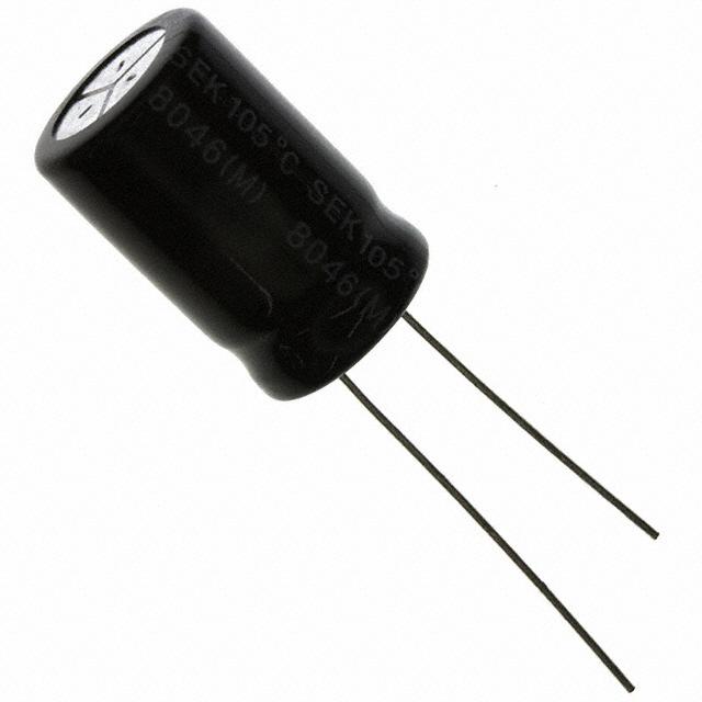

Type SEK 105 ºC Radial Leaded Aluminum Electrolytic Capacitors Long Life, Aluminum Electrolytic Type SEK is a radial leaded aluminum electrolytic capacitor with a +105 º C, long life rating. The volumetic efficient high CV product of the SEK makes it ideal for high density packaging in general purpose, coupling, decoupling, bypass and filtering circuit applications. Highlights • • • • • Capacitance Range: Voltage Range: Capacitance Tolerance: Operating Temperature Range: Specifications +105 ºC Long life High CV product General purpose applications Available in T&R and ammo pack 0.47 to 15,000 µF 6.3 to 450 Vdc ±20% –55 ºC to +105 ºC; 6.3 to 100 Vdc –40 ºC to +105 ºC; 160 to 400 Vdc –25 ºC to +105 ºC; 450 Vdc DC Leakage Current: After 2 minutes, +20 ºC at rated voltage 6.3 to 100 Vdc I = .01CV or 3 µA Max ≥ 160 Vdc after 3 min, +20 ºC at rated voltage I = .03CV or 10 µA Max C = Capacitance in (µF) V = Rated voltage Dissipation Factor @ 120 Hz, +25 ºC: WV (V) 6.3 10 16 25 35 50 63 80 100 160-250 350-450 DF(%) 26 22 18 16 14 12 10 10 10 15 20 Ripple Multipliers for Voltage and Temperature: For capacitors whose capacitance value exceeds 1000 µF, the value of (DF)% is increased 2% for every additional Rated WVDC 6 to 25 35 to 100 160 to 250 350 to 400 Ambient +105 ºC +85 ºC +70 ºC Ripple Multipliers 60Hz 0.80 0.75 0.70 0.60 Ripple 1.00 1.50 1.80 120Hz 1.0 1.0 1.0 1.0 1kHz 1.1 1.3 1.4 1.5 10kHz 1.2 1.4 1.6 1.8 Temperature Multiplier Load Life: Apply WVDC for 2000 hours at +105 ºC Shelf Life: 1000 hrs with no voltage applied Capacitance change within 20% of initial limit DF not to exceed 200% of initial requirement Leakage current not to exceed 200% of initial Cap change within ±20% of initial Values DF 200% of initial requirements DC leakage current meets initial requirement CDE Cornell Dubilier • 1605 E. Rodney French Blvd. • New Bedford, MA 02744 • Phone: (508)996-8561 • Fax: (508)996-3830 • www.cde.com Type SEK 105 ºC Radial Leaded Aluminum Electrolytic Capacitors Outline Drawing Outline Dimensions (Millimeters) d 0.05 PVC Sleeve + + S 0.5 L 15 Min. 5 D Case vented on diameters 6.3 and greater Vinyl sleeve adds .5 Max. to diameter and 2.0 Max. to length Part Numbering System Capacitance Type Capacitance Tolerance (µF) SEK 100 3R0 = 3 100 = 10 101 = 100 102 = 1000 (%) M K = ±10 M = ±20 Rated Voltage (Vdc) 100 6R3 = 6.3 010 = 10 100 = 100 S A = Tape & Ammo E = Different Characteristic R = Tape & Reel S = Standard 1 = Lead cut 2 = Lead form 4 = Lead crimp & cut (form) T = Standard T Packaging Lead Configuration Temperature Characteristics 200 20 10 %C 0 -10 -20 -40 0 40 80 Temperature C 1 -40 0 40 80 Temperature C 1F 50V %DF 100F 25V 10 5 1F 50V 100 50 100F 25V Capacitance Change Ratio Dissipation Factor Change Load Life Characteristics 100 10 %C 0 -10 -20 0 100F 160V 250 500 Time In Hours 750 1000 470F 25V 40 %DF 30 20 10 0 250 500 Time In Hours 470F 25V 100F 160V 750 1000 %LC 10 5 1 0 470F 25V 100F 160V 250 500 Time In Hours 750 1000 50 Capacitance Change Ratio Dissipation Factor Change Leakage Current Change CDE Cornell Dubilier • 1605 E. Rodney French Blvd. • New Bedford, MA 02744 • Phone: (508)996-8561 • Fax: (508)996-3830 • www.cde.com Type SEK 105 ºC Radial Leaded Aluminum Electrolytic Capacitors Ratings Max ESR Max Ripple Catalog Cap (µF) 100 220 330 470 1000 2200 3300 4700 6800 10000 15000 47 100 220 330 470 1000 2200 3300 4700 6800 10000 15000 33 47 100 220 330 470 1000 2200 3300 4700 6800 10000 10 22 33 47 100 220 330 SEK101M6R3ST SEK221M6R3ST SEK331M6R3ST SEK471M6R3ST SEK102M6R3ST SEK222M6R3ST SEK332M6R3ST SEK472M6R3ST SEK682M6R3ST SEK103M6R3ST SEK153M6R3ST SEK470M010ST SEK101M010ST SEK221M010ST SEK331M010ST SEK471M010ST SEK102M010ST SEK222M010ST SEK332M010ST SEK472M010ST SEK682M010ST SEK103M010ST SEK153M010ST SEK330M016ST SEK470M016ST SEK101M016ST SEK221M016ST SEK331M016ST SEK471M016ST SEK102M016ST SEK222M016ST SEK332M016ST SEK472M016ST SEK682M016ST SEK103M016ST SEK100M025ST SEK220M025ST SEK330M025ST SEK470M025ST SEK101M025ST SEK221M025ST SEK331M025ST Part Number 120 Hz 25 ºC (Ω) 3.45 1.57 1.05 0.73 0.35 0.17 0.12 0.10 0.07 0.06 0.05 6.21 2.92 1.33 0.88 0.62 0.29 0.14 0.10 0.08 0.07 0.05 0.04 7.24 5.08 2.39 1.09 0.72 0.51 0.24 0.12 0.09 0.07 0.06 0.05 21.23 9.65 6.43 4.52 2.12 0.97 0.64 120 Hz 105 ºC (mA) 100 165 200 280 470 930 1100 1320 1490 1830 2280 75 110 180 255 305 570 1010 1220 1410 1610 1980 3330 70 85 135 235 285 395 700 1150 1350 1560 1790 2884 50 60 75 90 145 250 355 Diameter (D) .197 (5.0) .248 (6.3) .248 (6.3) .315 (8.0) .394 (10.0) .394 (10.0) .512 (13.0) .630 (16.0) .630 (16.0) .630 (16.0) .709 (18.0) .197 (5.0) .197 (5.0) .248 (6.3) .315 (8.0) .315 (8.0) .394 (10.0) .512 (13.0) .512 (13.0) .630 (16.0) .630 (16.0) .709 (18.0) .709 (18.0) .197 (5.0) .197 (5.0) .248 (6.3) .315 (8.0) .315 (8.0) .394 (10.0) .394 (10.0) .512 (13.0) .512 (13.0) .630 (16.0) .709 (18.0) .709 (18.0) .197 (5.0) .197 (5.0) .197 (5.0) .197 (5.0) .248 (6.3) .315 (8.0) .394 (10.0) Size in. (mm) Length (L) .433 (11.0) .433 (11.0) .453 (11.5) .453 (11.5) .512 (13.0) .827 (21.0) .827 (21.0) .984 (26.0) .984 (25.0) 1.26 (32.0) 1.40 (36.0) .433 (11.0) .433 (11.0) .433 (11.0) .453 (11.5) .453 (11.5) .630 (16.0) .827 (21.0) .984 (25.0) .984 (25.0) 1.26 (32.0) 1.40 (36.0) 1.65 (42.0) .433 (11.0) .433 (11.0) .433 (11.0) .453 (11.5) .433 (11.0) .512 (13.0) .827 (21.0) .827 (21.0) .984 (26.0) 1.26 (32.0) 1.40 (36.0) 1.65 (42.0) .433 (11.0) .433 (11.0) .433 (11.0) .433 (11.0) .433 (11.0) .433 (11.0) .512 (13.0) Lead Space (S) .079 (2.0) .098 (2.5) .098 (2.5) .138 (3.5) .197 (5.0) .197 (5.0) .197 (5.0) .197 (5.0) .295 (7.5) .295 (7.5) .295 (7.5) .079 (2.0) .079 (2.0) .098 (2.5) .138 (3.5) .138 (3.5) .197 (5.0) .197 (5.0) .197 (5.0) .295 (7.5) .295 (7.5) .295 (7.5) .295 (7.5) .079 (2.0) .079 (2.0) .098 (2.5) .138 (3.5) .138 (3.5) .197 (5.0) .197 (5.0) .197 (5.0) .197 (5.0) .295 (7.5) .295 (7.5) .295 (7.5) .079 (2.0) .079 (2.0) .079 (2.0) .079 (2.0) .098 (2.5) .138 (3.5) .197 (5.0) Lead Dia. (d) .0197 (0.5) .0197 (0.5) .0197 (0.5) .0236 (0.6) .0236 (0.6) .0236 (0.6) .0236 (0.6) .0236 (0.6) .0315 (0.8) .0315 (0.8) .0315 (0.8) .0197 (0.5) .0197 (0.5) .0197 (0.5) .0236 (0.6) .0236 (0.6) .0236 (0.6) .0236 (0.6) .0236 (0.6) .0315 (0.8) .0315 (0.8) .0315 (0.8) .0315 (0.8) .0197 (0.5) .0197 (0.5) .0197 (0.5) .0236 (0.6) .0236 (0.6) .0236 (0.6) .0236 (0.6) .0236 (0.6) .0236 (0.6) .0315 (0.8) .0315 (0.8) .0315 (0.8) .0197 (0.5) .0197 (0.5) .0197 (0.5) .0197 (0.5) .0197 (0.5) .0236 (0.6) .0236 (0.6) RoHS Compliant 6.3 Vdc (8 Volts Surge) 10 Vdc (13 Volts Surge) 16 Vdc (20 Volts Surge) 25 Vdc (32 Volts Surge) CDE Cornell Dubilier • 1605 E. Rodney French Blvd. • New Bedford, MA 02744 • Phone: (508)996-8561 • Fax: (508)996-3830 • www.cde.com Type SEK 105 ºC Radial Leaded Aluminum Electrolytic Capacitors Ratings Max ESR Max Ripple Catalog Cap (µF) 470 1000 2200 3300 4700 6800 22 33 47 100 220 330 470 1000 2200 3300 4700 0.47 1.0 2.2 3.3 4.7 10 22 33 47 100 220 330 470 1000 2200 3300 4.7 10 22 33 47 100 220 330 470 1000 SEK471M025ST SEK102M025ST SEK222M025ST SEK332M025ST SEK472M025ST SEK682M025ST SEK220M035ST SEK330M035ST SEK470M035ST SEK101M035ST SEK221M035ST SEK331M035ST SEK471M035ST SEK102M035ST SEK222M035ST SEK332M035ST SEK472M035ST SEKR47M050ST SEK010M050ST SEK2R2M050ST SEK3R3M050ST SEK4R7M050ST SEK100M050ST SEK220M050ST SEK330M050ST SEK470M050ST SEK101M050ST SEK221M050ST SEK331M050ST SEK471M050ST SEK102M050ST SEK222M050ST SEK332M050ST SEK4R7M063ST SEK100M063ST SEK220M063ST SEK330M063ST SEK470M063ST SEK101M063ST SEK221M063ST SEK331M063ST SEK471M063ST SEK102M063ST Part Number 120 Hz 25 ºC (Ω) 0.45 0.21 0.11 0.08 0.07 0.05 8.44 5.63 3.95 1.86 0.84 0.56 0.40 0.19 0.10 0.07 0.06 338.80 159.24 72.38 48.25 33.88 15.92 7.24 4.83 3.39 1.59 0.72 0.48 0.34 0.16 0.08 0.47 28.23 13.27 6.03 4.02 2.82 1.33 0.60 0.40 0.28 0.13 120 Hz 105 ºC (mA) 470 855 1230 1450 1690 2856 65 85 115 190 315 440 580 995 1450 1660 2674 7.0 12.0 18.0 25.0 30.0 50.0 75.0 105.0 125.0 210.0 400.0 535.0 730.0 1110.0 1530.0 2478.0 34 55 90 110 155 260 460 650 800 1200 Diameter (D) Size in. (mm) Length (L) Lead Space Lead Dia. (S) .197 (5.0) .197 (5.0) .197 (5.0) .295 (7.5) .295 (7.5) .295 (7.5) .079 (2.0) .079 (2.0) .098 (2.5) .138 (3.5) .197 (5.0) .197 (5.0) .197 (5.0) .197 (5.0) .295 (7.5) .295 (7.5) .295 (7.5) .079 (2.0) .079 (2.0) .079 (2.0) .079 (2.0) .079 (2.0) .079 (2.0) .079 (2.0) .098 (2.5) .098 (2.5) .138 (3.5) .197 (5.0) .197 (5.0) .197 (5.0) .295 (7.5) .295 (7.5) .295 (7.5) .079 (2.0) .079 (2.0) .098 (2.5) .098 (2.5) .098 (2.5) .197 (5.0) .197 (5.0) .197 (5.0) .197 (5.0) .295 (7.5) (d) .0236 (0.6) .0236 (0.6) .0236 (0.6) .0315 (0.8) .0315 (0.8) .0315 (0.8) .0197 (0.5) .0197 (0.5) .0197 (0.5) .0236 (0.6) .0236 (0.6) .0236 (0.6) .0236 (0.6) .0236 (0.6) .0315 (0.8) .0315 (0.8) .0315 (0.8) .0197 (0.5) .0197 (0.5) .0197 (0.5) .0197 (0.5) .0197 (0.5) .0197 (0.5) .0197 (0.5) .0197 (0.5) .0197 (0.5) .0236 (0.6) .0236 (0.6) .0236 (0.6) .0236 (0.6) .0315 (0.8) .0315 (0.8) .0315 (0.8) .0197 (0.5) .0197 (0.5) .0197 (0.5) .0197 (0.5) .0236 (0.6) .0236 (0.6) .0236 (0.6) .0236 (0.6) .0236 (0.6) .0315 (0.8) 25 Vdc (32 Volts Surge) .394 (10.0) .630 (16.0) .512 (13.0) .827 (21.0) .512 (13.0) .984 (26.0) .630 (16.0) 1.26 (32.0) .709 (18.0) 1.40 (36.0) .709 (18.0) 1.65 (42.0) .197 (5.0) .197 (5.0) .248 (6.3) .315 (8.0) .433 (11.0) .433 (11.0) .433 (11.0) .453 (11.5) 35 Vdc (44 Volts Surge) .394 (10.0) .512 (13.0) .394 (10.0) .630 (16.0) .512 (13.0) .787 (20.0) .512 (13.0) .827 (21.0) .630 (16.0) 1.26 (32.0) .709 (18.0) 1.40 (36.0) .709 (18.0) 1.65 (42.0) .197 (5.0) .197 (5.0) .197 (5.0) .197 (5.0) .197 (5.0) .197 (5.0) .197 (5.0) .248 (6.3) .248 (6.3) .315 (8.0) .433 (11.0) .433 (11.0) .433 (11.0) .433 (11.0) .433 (11.0) .433 (11.0) .433 (11.0) .433 (11.0) .453 (11.5) .433 (11.0) 50 Vdc (63 Volts Surge) .394 (10.0) .630 (16.0) .394 (10.0) .827 (21.0) .512 (13.0) .827 (21.0) .630 (16.0) .984 (25.0) .709 (18.0) 1.40 (36.0) .709 (18.0) 1.65 (42.0) .197 (5.0) .197 (5.0) .248 (6.3) .248 (6.3) .315 (8.0) .433 (11.0) .433 (11.0) .433 (11.0) .433 (11.0) .433 (11.0) 63 Vdc (79 Volts Surge) .394 (10.0) .512 (13.0) .394 (10.0) .827 (21.0) .512 (13.0) .827 (21.0) .512 (13.0) .984 (26.0) .630 (16.0) 1.26 (32.0) CDE Cornell Dubilier • 1605 E. Rodney French Blvd. • New Bedford, MA 02744 • Phone: (508)996-8561 • Fax: (508)996-3830 • www.cde.com Type SEK 105 ºC Radial Leaded Aluminum Electrolytic Capacitors Ratings Max ESR Max Ripple Catalog Cap (µF) 0.47 1.0 2.2 3.3 4.7 10.0 22.0 33.0 47.0 100.0 220.0 330.0 470.0 0.47 1.0 2.2 3.3 4.7 10 22 33 47 100 220 330 0.47 1.0 2.2 3.3 4.7 10 22 33 47 100 220 0.47 1.0 2.2 3.3 4.7 10.0 SEKR47M100ST SEK010M100ST SEK2R2M100ST SEK3R3M100ST SEK4R7M100ST SEK100M100ST SEK220M100ST SEK330M100ST SEK470M100ST SEK101M100ST SEK221M100ST SEK331M100ST SEK471M100ST SEKR47M160ST SEK010M160ST SEK2R2M160ST SEK3R3M160ST SEK4R7M160ST SEK100M160ST SEK220M160ST SEK330M160ST SEK470M160ST SEK101M160ST SEK221M160ST SEK331M160ST SEKR47M200ST SEK010M200ST SEK2R2M200ST SEK3R3M200ST SEK4R7M200ST SEK100M200ST SEK220M200ST SEK330M200ST SEK470M200ST SEK101M200ST SEK221M200ST SEKR47M250ST SEK010M250ST SEK2R2M250ST SEK3R3M250ST SEK4R7M250ST SEK100M250ST Part Number 120 Hz 25 ºC (Ω) 282.33 132.70 60.32 40.21 28.23 13.27 6.03 4.02 2.82 1.33 0.60 0.40 0.28 423.50 199.04 90.47 60.32 42.35 19.90 9.05 6.03 4.23 1.99 0.90 0.60 423.50 199.04 90.47 60.32 42.35 19.90 9.05 6.03 4.23 1.99 0.90 423.50 199.04 90.47 60.32 42.35 19.90 120 Hz 105 ºC (mA) 10 15 22 29 37 65 115 160 210 385 590 720 875 12 17 25 36 43 70 130 180 270 330 500 850 12 17 25 36 50 80 140 190 220 335 515 12 17 29 42 50 88 Diameter (D) Size in. (mm) Length (L) Lead Space (S) .079 (2.0) .079 (2.0) .079 (2.0) .079 (2.0) .079 (2.0) .098 (2.5) .138 (3.5) .197 (5.0) .197 (5.0) .197 (5.0) .295 (7.5) .295 (7.5) .295 (7.5) .098 (2.5) .098 (2.5) .098 (2.5) .098 (2.5) .098 (2.5) .138 (3.5) .197 (5.0) .197 (5.0) .197 (5.0) .197 (5.0) .295 (7.5) .295 (7.5) .098 (2.5) .098 (2.5) .098 (2.5) .098 (2.5) .138 (3.5) .197 (5.0) .197 (5.0) .197 (5.0) .197 (5.0) .295 (7.5) .295 (7.5) .098 (2.5) .098 (2.5) .098 (2.5) .138 (3.5) .138 (3.5) .197 (5.0) Lead Dia. (d) .0197 (0.5) .0197 (0.5) .0197 (0.5) .0197 (0.5) .0197 (0.5) .0197 (0.5) .0236 (0.6) .0236 (0.6) .0236 (0.6) .0236 (0.6) .0315 (0.8) .0315 (0.8) .0315 (0.8) .0197 (0.5) .0197 (0.5) .0197 (0.5) .0197 (0.5) .0197 (0.5) .0236 (0.6) .0236 (0.6) .0236 (0.6) .0236 (0.6) .0236 (0.6) .0315 (0.8) .0315 (0.8) .0197 (0.5) .0197 (0.5) .0197 (0.5) .0197 (0.5) .0236 (0.6) .0236 (0.6) .0236 (0.6) .0236 (0.6) .0236 (0.6) .0315 (0.8) .0315 (0.8) .0197 (0.5) .0197 (0.5) .0197 (0.5) .0236 (0.6) .0236 (0.6) .0236 (0.6) 100 Vdc (125 Volts Surge) .197 (5.0) .433 (11.0) .197 (5.0) .433 (11.0) .197 (5.0) .433 (11.0) .197 (5.0) .433 (11.0) .197 (5.0) .433 (11.0) .248 (6.3) .315 (8.0) .433 (11.0) .433 (11.0) .394 (10.0) .512 (13.0) .394 (10.0) .630 (16.0) .512 (13.0) .787 (20.0) .630 (16.0) .984 (25.0) .630 (16.0) .984 (25.0) .630 (16.0) 1.26 (32.0) .248 (6.3) .248 (6.3) .248 (6.3) .248 (6.3) .248 (6.3) .315 (8.0) .433 (11.0) .433 (11.0) .433 (11.0) .433 (11.0) .433 (11.0) .433 (11.0) 160 Vdc (200 Volts Surge) .394 (10.0) .630 (16.0) .394 (10.0) .827 (21.0) .512 (13.0) .827 (21.0) .512 (13.0) .984 (26.0) .630 (16.0) 1.38 (35.0) .709 (18.0) 1.65 (42.0) .248 (6.3) .248 (6.3) .248 (6.3) .248 (6.3) .315 (8.0) .433 (11.0) .433 (11.0) .453 (11.5) .453 (11.5) .433 (11.0) 200 Vdc (250 Volts Surge) .394 (10.0) .512 (13.0) .394 (10.0) .827 (21.0) .512 (13.0) .827 (21.0) .512 (13.0) .827 (21.0) .630 (16.0) .984 (25.0) .709 (18.0) 1.65 (42.0) .248 (6.3) .248 (6.3) .248 (6.3) .315 (8.0) .315 (8.0) .433 (11.0) .433 (11.0) .453 (11.5) .433 (11.0) .433 (11.0) 250 Vdc (300 Volts Surge) .394 (10.0) .630 (16.0) CDE Cornell Dubilier • 1605 E. Rodney French Blvd. • New Bedford, MA 02744 • Phone: (508)996-8561 • Fax: (508)996-3830 • www.cde.com Type SEK 105 ºC Radial Leaded Aluminum Electrolytic Capacitors Ratings Max ESR Max Ripple Catalog Cap (µF) 22 33 47 100 0.47 1.0 2.2 3.3 4.7 10 22 33 47 100 0.47 1.0 2.2 3.3 4.7 10 22 33 47 0.47 1.0 2.2 3.3 4.7 10 22 33 47 SEK220M250ST SEK330M250ST SEK470M250ST SEK101M250ST SEKR47M350ST SEK010M350ST SEK2R2M350ST SEK3R3M350ST SEK4R7M350ST SEK100M350ST SEK220M350ST SEK330M350ST SEK470M350ST SEK101M350ST SEKR47M400ST SEK010M400ST SEK2R2M400ST SEK3R3M400ST SEK4R7M400ST SEK100M400ST SEK220M400ST SEK330M400ST SEK470M400ST SEKR47M450ST SEK010M450ST SEK2R2M450ST SEK3R3M450ST SEK4R7M450ST SEK100M450ST SEK220M450ST SEK330M450ST SEK470M450ST Part Number 120 Hz 25 ºC (Ω) 9.05 6.03 4.23 1.99 564.67 265.39 120.63 80.42 56.47 26.54 12.06 8.04 5.65 2.65 564.67 265.39 120.63 80.42 56.47 26.54 12.06 8.04 5.65 564.67 265.39 120.63 80.42 56.47 26.54 12.06 8.04 5.65 120 Hz 105 ºC (mA) 155 190 230 340 14 20 35 47 55 95 165 195 240 360 14 20 35 50 58 100 170 205 255 14 20 35 50 58 100 170 205 255 Diameter (D) .512 (13.0) .512 (13.0) .512 (13.0) .630 (16.0) .315 (8.0) .315 (8.0) .394 (10.0) .394 (10.0) .394 (10.0) .394 (10.0) .512 (13.0) .512 (13.0) .630 (16.0) .709 (18.0) .315 (8.0) .315 (8.0) .394 (10.0) .394 (10.0) .394 (10.0) .512 (13.0) .512 (13.0) .630 (16.0) .709 (18.0) .315 (8.0) .315 (8.0) .394 (10.0) .394 (10.0) .394 (10.0) .512 (13.0) .512 (13.0) .630 (16.0) .709 (18.0) Size in. (mm) Length (L) .827 (21.0) .827 (21.0) .984 (26.0) 1.26 (32.0) .433 (11.0) .433 (11.0) .453 (11.5) .512 (13.0) .512 (13.0) .827 (21.0) .984 (26.0) .984 (25.0) 1.38 (35.0) 1.65 (42.0) .433 (11.0) .433 (11.0) .512 (13.0) .512 (13.0) .630 (16.0) .787 (20.0) .984 (26.0) 1.26 (32.0) 1.40 (36.0) .433 (11.0) .433 (11.0) .512 (13.0) .512 (13.0) .630 (16.0) .827 (21.0) .984 (26.0) 1.26 (32.0) 1.40 (36.0) Lead Space (S) .197 (5.0) .197 (5.0) .197 (5.0) .295 (7.5) .138 (3.5) .138 (3.5) .138 (3.5) .197 (5.0) .197 (5.0) .197 (5.0) .197 (5.0) .295 (7.5) .295 (7.5) .295 (7.5) .138 (3.5) .138 (3.5) .197 (5.0) .197 (5.0) .197 (5.0) .197 (5.0) .197 (5.0) .295 (7.5) .295 (7.5) .138 (3.5) .138 (3.5) .197 (5.0) .197 (5.0) .197 (5.0) .197 (5.0) .197 (5.0) .295 (7.5) .295 (7.5) Lead Dia. (d) .0236 (0.6) .0236 (0.6) .0236 (0.6) .0315 (0.8) .0236 (0.6) .0236 (0.6) .0236 (0.6) .0236 (0.6) .0236 (0.6) .0236 (0.6) .0236 (0.6) .0315 (0.8) .0315 (0.8) .0315 (0.8) .0236 (0.6) .0236 (0.6) .0236 (0.6) .0236 (0.6) .0236 (0.6) .0236 (0.6) .0236 (0.6) .0315 (0.8) .0315 (0.8) .0236 (0.6) .0236 (0.6) .0236 (0.6) .0236 (0.6) .0236 (0.6) .0236 (0.6) .0236 (0.6) .0315 (0.8) .0315 (0.8) 250 Vdc (300 Volts Surge) 350 Vdc (400 Volts Surge) 400 Vdc (450 Volts Surge) 450 Vdc (500 Volts Surge) CDE Cornell Dubilier • 1605 E. Rodney French Blvd. • New Bedford, MA 02744 • Phone: (508)996-8561 • Fax: (508)996-3830 • www.cde.com
