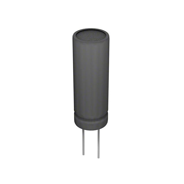

    470 µF 63 V 铝电解电容器 径向,Can 250 毫欧 85°C 时为 2000 小时
SK471M063ST 数据手册
Type SK 85 ºC Radial Leaded Aluminum Electrolytic Capacitors 2000 Hour Long Life, General Purpose Aluminum Electrolytic Type SK is a radial leaded aluminum electrolytic capacitor with a +85 ºC, 2000 hour long life rating. The SK is a high CV rated product and is ideal for general purpose applications such as stereo radio, TV, computers and other consumer electronic products. MA SK LL OR Y Highlights • • • • Capacitance Range: Voltage Range: Capacitance Tolerance: Operating Temperature Range: DC Leakage Current: Specifications +85 ºC 2000 hours - long life High CV Available in T&R and ammo pack 0.47 to 15,000 µF 6.3 to 450 Vdc ±20% –40 ºC to +85 ºC; 6.3 to 100 Vdc –25 ºC to +85 ºC; 160 to 450 Vdc 6.3 to 100 Vdc; after 2 min; +20 ºC at rated voltage I = ≤.01CV or 3 µA Max ≥100 Vdc; after 3 min; +20 ºC at rated voltage I = ≤.03CV or 10 µA Max C = Capacitance in (µF) V = Rated voltage I = Leakage current in µA WV (V) DF(%) 6.3 10 16 25 35 50 63 100 160-250 350-450 24 20 16 14 12 10 10 10 20 24 Dissipation Factor @ 120 Hz, +20 ºC: Ripple Multipliers for Voltage and Temperature: For capacitance values > 1000 µF, the DF (%) value is increased 2% for every additional 1000 µF Rated WVDC 6 to 25 35 to 100 160 to 250 Ambient +85 ºC +75 ºC +65 ºC Ripple Multipliers 60Hz 0.85 0.75 0.70 Ripple 1.00 1.14 1.25 120Hz 1.0 1.0 1.0 1kHz 1.1 1.3 1.4 Temperature Multiplier Load Life: Apply WVDC for 2000 hours at +85 ºC Shelf Life: 1000 hrs at +85 ºC with no voltage applied Capacitance change within 20% of initial limit DF not to exceed 200% of initial requirement Leakage current meets initial limits Cap change within 20% of initial values DF ≤ 200% of initial requirements DC leakage current meets initial measured value CDE Cornell Dubilier • 1605 E. Rodney French Blvd. • New Bedford, MA 02744 • Phone: (508)996-8561 • Fax: (508)996-3830 • www.cde.com Type SK 105 ºC Radial Leaded Aluminum Electorlytic Capacitors Outline Drawing Outline Dimensions (Millimeters) PVC Sleeve d 0.05 S + 0.5 + L 15 Min. 5 D Case vented on diameters 6.3 and greater Vinyl sleeve adds .5 Max. to diameter and 2.0 Max. to length Part Numbering System SK 100 M Capacitance Type Capacitance Tolerance (µF) (%) 100 Rated Voltage (Vdc) Packaging S T Lead Configuration SK 1R0 = 1 100 = 10 101 = 100 102 = 1000 K = ±10 M = ±20 6R3 = 6.3 010 = 10 A = Tape & Ammo E = Different Characteristic S = Standard 1 = Lead cut 2 = Lead form 4 = Lead crimp & cut (form) T = Standard 100 = 100 R = Tape & Reel Temperature Characteristics 200 100 20 10 %C 0 100 F 25V -10 -20 -40 0 40 80 Temperature gC 1 -40 0 40 80 Temperature gC 1 F 50V % DF 10 5 1 F 50V 50 100 F 25V Capacitance Change Ratio Dissipation Factor Change Load Life Characteristics 10 10 %C 0 -10 -20 0 100 F 25V 500 1000 1500 Time In Hours 2000 1 F 50V 30 % DF 20 10 0 0 1 F 50V 500 1000 1500 Time In Hours 2000 100 F 25V % LC 1 0.5 1 F 50V 0.1 0 500 1000 1500 Time In Hours 2000 5 100 F 25V Capacitance Change Ratio Dissipation Factor Change Leakage Current Change CDE Cornell Dubilier • 1605 E. Rodney French Blvd. • New Bedford, MA 02744 • Phone: (508)996-8561 • Fax: (508)996-3830 • www.cde.com Type SK 85 ºC Radial Leaded Aluminum Electorlytic Capacitors Ratings Max ESR Max Ripple Catalog Cap (µF) 100 220 330 470 1000 2200 3300 4700 6800 10000 15000 33 47 100 220 330 470 1000 2200 3300 4700 6800 10000 15000 22 33 47 100 220 330 470 1000 2200 3300 4700 6800 10000 10 22 33 47 100 SK101M6R3ST SK221M6R3ST SK331M6R3ST SK471M6R3ST SK102M6R3ST SK222M6R3ST SK332M6R3ST SK472M6R3ST SK682M6R3ST SK103M6R3ST SK153M6R3ST SK330M010ST SK470M010ST SK101M010ST SK221M010ST SK331M010ST SK471M010ST SK102M010ST SK222M010ST SK332M010ST SK472M010ST SK682M010ST SK103M010ST SK153M010ST SK220M016ST SK330M016ST SK470M016ST SK101M016ST SK221M016ST SK331M016ST SK471M016ST SK102M016ST SK222M016ST SK332M016ST SK472M016ST SK682M016ST SK103M016ST SK100M025ST SK220M025ST SK330M025ST SK470M025ST SK101M025ST Part Number 120 Hz +25 ºC (Ω) 2.92 1.33 0.88 0.62 0.29 0.14 0.10 0.08 0.07 0.05 0.04 7.64 5.36 2.52 1.15 0.76 0.54 0.25 0.14 0.10 0.08 0.07 0.05 0.04 9.65 6.43 4.52 2.12 0.97 0.64 0.45 0.21 0.14 0.10 0.08 0.07 0.05 18.57 8.44 5.63 3.95 1.85 120 Hz +85 ºC (mA) 130 240 300 380 580 1050 1250 1700 1900 2250 2680 80 95 180 250 330 400 630 1100 1400 1800 2150 2500 2950 75 110 130 185 320 360 470 790 1350 1700 2100 2500 2700 50 90 110 130 185 Diameter (D) Size in. (mm) Length (L) Lead Space Lead Dia. (S) .079 (2.0) .098 (2.5) .098 (2.5) .138 (3.5) .197 (5.0) .197 (5.0) .197 (5.0) .197 (5.0) .295 (7.5) .295 (7.5) .295 (7.5) .079 (2.0) .079 (2.0) .079 (2.0) .098 (2.5) .138 (3.5) .138 (3.5) .197 (5.0) .197 (5.0) .197 (5.0) .295 (7.5) .295 (7.5) .295 (7.5) .295 (7.5) .079 (2.0) .079 (2.0) .079 (2.0) .098 (2.5) .138 (3.5) .138 (3.5) .197 (5.0) .197 (5.0) .197 (5.0) .197 (5.0) .295 (7.5) .295 (7.5) .295 (7.5) .079 (2.0) .079 (2.0) .079 (2.0) .079 (2.0) .098 (2.5) (d) .0197 (0.5) .0197 (0.5) .0197 (0.5) .0236 (0.6) .0236 (0.6) .0236 (0.6) .0236 (0.6) .0236 (0.6) .0315 (0.8) .0315 (0.8) .0315 (0.8) .0197 (0.5) .0197 (0.5) .0197 (0.5) .0197 (0.5) .0236 (0.6) .0236 (0.6) .0236 (0.6) .0236 (0.6) .0236 (0.6) .0315 (0.8) .0315 (0.8) .0315 (0.8) .0315 (0.8) .0197 (0.5) .0197 (0.5) .0197 (0.5) .0197 (0.5) .0236 (0.6) .0236 (0.6) .0236 (0.6) .0236 (0.6) .0236 (0.6) .0236 (0.6) .0315 (0.8) .0315 (0.8) .0315 (0.8) .0197 (0.5) .0197 (0.5) .0197 (0.5) .0197 (0.5) .0197 (0.5) RoHS Compliant 6.3 Vdc (8 Volts Surge) .197 (5.0) .433 (11.0) .248 (6.3) .433 (11.0) .248 (6.3) .433 (11.0) .315 (8.0) .453 (11.5) .394 (10.0) .512 (13.0) .394 (10.0) .827 (21.0) .512 (13.0) .827 (21.0) .512 (13.0) .984 (26.0) .630 (16.0) .984 (25.0) .630 (16.0) 1.26 (32.0) .630 (16.0) 1.38 (35.0) .197 (5.0) .433 (11.0) .197 (5.0) .433 (11.0) .197 (5.0) .433 (11.0) .248 (6.3) .433 (11.0) .315 (8.0) .433 (11.0) .315 (8.0) .433 (11.0) .394 (10.0) .630 (16.0) .394 (10.0) .827 (21.0) .512 (13.0) .827 (21.0) .630 (16.0) .984 (25.0) .630 (16.0) 1.26 (32.0) .709 (18.0) 1.38 (35.0) .709 (18.0) 1.65 (42.0) .197 (5.0) .433 (11.0) .197 (5.0) .433 (11.0) .197 (5.0) .433 (11.0) .248 (6.3) .433 (11.0) .315 (8.0) .453 (11.5) .315 (8.0) .453 (11.5) .394 (10.0) .512 (13.0) .394 (10.0) .827 (21.0) .512 (13.0) .827 (21.0) .512 (13.0) .984 (26.0) .630 (16.0) 1.26 (32.0) .709 (18.0) 1.38 (35.0) .709 (18.0) 1.65 (42.0) .197 (5.0) .433 (11.0) .197 (5.0) .433 (11.0) .197 (5.0) .433 (11.0) .197 (5.0) .433 (11.0) .248 (6.3) .433 (11.0) 10 Vdc (13 Volts Surge) 16 Vdc (20 Volts Surge) 25 Vdc (32 Volts Surge) CDE Cornell Dubilier • 1605 E. Rodney French Blvd. • New Bedford, MA 02744 • Phone: (508)996-8561 • Fax: (508)996-3830 • www.cde.com Type SK 105 ºC Radial Leaded Aluminum Electorlytic Capacitors Ratings Max ESR Max Ripple Catalog Cap (µF) 220 330 470 1,000 2,200 3,300 4,700 6,800 10 22 33 47 100 220 330 470 1,000 2,200 3,300 4,700 0.47 1.0 2.2 3.3 4.7 10 22 33 47 100 220 330 470 1,000 2,200 3,300 0.5 1.0 2.2 3.3 4.7 10.0 SK221M025ST SK331M025ST SK471M025ST SK102M025ST SK222M025ST SK332M025ST SK472M025ST SK682M025ST SK100M035ST SK220M035ST SK330M035ST SK470M035ST SK101M035ST SK221M035ST SK331M035ST SK471M035ST SK102M035ST SK222M035ST SK332M035ST SK472M035ST SKR47M050ST SK010M050ST SK2R2M050ST SK3R3M050ST SK4R7M050ST SK100M050ST SK220M050ST SK330M050ST SK470M050ST SK101M050ST SK221M050ST SK331M050ST SK471M050ST SK102M050ST SK222M050ST SK332M050ST SKR47M063ST SK010M063ST SK2R2M063ST SK3R3M063ST SK4R7M063ST SK100M063ST Part Number 120 Hz +25 ºC (Ω) 0.84 0.56 0.39 0.18 0.14 0.10 0.08 0.06 15.92 7.23 4.82 3.38 1.59 0.72 0.48 0.33 0.15 0.14 0.10 0.08 282.33 132.70 60.32 40.21 28.23 13.27 6.03 4.02 2.82 1.33 0.60 0.40 0.28 0.13 0.14 0.10 254.10 119.43 54.28 36.19 25.41 11.94 120 Hz +85 ºC (mA) 320 420 540 950 1550 1950 2360 2550 60 95 115 140 230 370 490 640 1100 1800 2220 2400 5 10 23 35 40 65 100 125 150 250 440 580 760 1350 2090 2320 5 10 29 40 45 70 Diameter (D) .315 (8.0) Size in. (mm) Length (L) .453 (11.5) Lead Space Lead Dia. (S) .138 (3.5) .197 (5.0) .197 (5.0) .197 (5.0) .197 (5.0) .295 (7.5) .295 (7.5) .295 (7.5) .079 (2.0) .079 (2.0) .079 (2.0) .098 (2.5) .138 (3.5) .197 (5.0) .197 (5.0) .197 (5.0) .197 (5.0) .295 (7.5) .295 (7.5) .295 (7.5) .079 (2.0) .079 (2.0) .079 (2.0) .079 (2.0) .079 (2.0) .079 (2.0) .079 (2.0) .098 (2.5) .098 (2.5) .138 (3.5) .197 (5.0) .197 (5.0) .197 (5.0) .295 (7.5) .295 (7.5) .295 (7.5) .079 (2.0) .079 (2.0) .079 (2.0) .079 (2.0) .079 (2.0) .079 (2.0) (d) .0236 (0.6) .0236 (0.6) .0236 (0.6) .0236 (0.6) .0236 (0.6) .0315 (0.8) .0315 (0.8) .0315 (0.8) .0197 (0.5) .0197 (0.5) .0197 (0.5) .0197 (0.5) .0236 (0.6) .0236 (0.6) .0236 (0.6) .0236 (0.6) .0236 (0.6) .0315 (0.8) .0315 (0.8) .0315 (0.8) .0197 (0.5) .0197 (0.5) .0197 (0.5) .0197 (0.5) .0197 (0.5) .0197 (0.5) .0197 (0.5) .0197 (0.5) .0197 (0.5) .0236 (0.6) .0236 (0.6) .0236 (0.6) .0236 (0.6) .0236 (0.6) .0236 (0.6) .0236 (0.6) .0197 (0.5) .0197 (0.5) .0197 (0.5) .0197 (0.5) .0197 (0.5) .0197 (0.5) 25 Vdc (32 Volts Surge) .394 (10.0) .512 (13.0) .394 (10.0) .630 (16.0) .512 (13.0) .827 (21.0) .512 (13.0) .984 (26.0) .630 (16.0) 1.26 (32.0) .709 (18.0) 1.38 (35.0) .709 (18.0) 1.65 (42.0) .197 (5.0) .197 (5.0) .197 (5.0) .248 (6.3) .315 (8.0) .433 (11.0) .433 (11.0) .433 (11.0) .433 (11.0) .453 (11.5) 35 Vdc (44 Volts Surge) .394 (10.0) .512 (13.0) .394 (10.0) .630 (16.0) .394 (10.0) .827 (21.0) .512 (13.0) .827 (21.0) .630 (16.0) 1.26 (32.0) .709 (18.0) 1.38 (35.0) .709 (18.0) 1.65 (42.0) .197 (5.0) .197 (5.0) .197 (5.0) .197 (5.0) .197 (5.0) .197 (5.0) .197 (5.0) .248 (6.3) .248 (6.3) .315 (8.0) .433 (11.0) .433 (11.0) .433 (11.0) .433 (11.0) .433 (11.0) .433 (11.0) .433 (11.0) .433 (11.0) .433 (11.0) .433 (11.0) 50 Vdc (63 Volts Surge) .394 (10.0) .630 (16.0) .394 (10.0) .827 (21.0) .512 (13.0) .827 (21.0) .630 (16.0) .984 (25.0) .709 (18.0) 1.38 (35.0) .709 (18.0) 1.65 (42.0) .197 (5.0) .197 (5.0) .197 (5.0) .197 (5.0) .197 (5.0) .197 (5.0) .433 (11.0) .433 (11.0) .433 (11.0) .433 (11.0) .433 (11.0) .433 (11.0) 63 Vdc (79 Volts Surge) * Note max leakage current ≥100 Vdc is measured at 3 minutes CDE Cornell Dubilier • 1605 E. Rodney French Blvd. • New Bedford, MA 02744 • Phone: (508)996-8561 • Fax: (508)996-3830 • www.cde.com Type SK 85 ºC Radial Leaded Aluminum Electorlytic Capacitors Ratings Max ESR Max Ripple Catalog Cap (µF) 22 33 47 100 220 330 470 1,000 0.47 1 2.2 3.3 4.7 10 22 33 47 100 220 330 470 0.47 1.0 2.2 3.3 4.7 10 22 33 47 100 220 330 0.5 1.0 2.2 3.3 4.7 10 22 33 47 SK220M063ST SK330M063ST SK470M063ST SK101M063ST SK221M063ST SK331M063ST SK471M063ST SK102M063ST SKR47M100ST SK010M100ST SK2R2M100ST SK3R3M100ST SK4R7M100ST SK100M100ST SK220M100ST SK330M100ST SK470M100ST SK101M100ST SK221M100ST SK331M100ST SK471M100ST SKR47M160ST SK010M160ST SK2R2M160ST SK3R3M160ST SK4R7M160ST SK100M160ST SK220M160ST SK330M160ST SK470M160ST SK101M160ST SK221M160ST SK331M160ST SKR47M200ST SK010M200ST SK2R2M200ST SK3R3M200ST SK4R7M200ST SK100M200ST SK220M200ST SK330M200ST SK470M200ST Part Number 120 Hz +25 ºC (Ω) 5.43 3.62 2.54 1.19 0.54 0.36 0.25 0.12 225.87 106.16 48.25 32.17 22.59 10.62 4.83 3.22 2.26 1.06 0.48 0.32 0.23 423.50 199.04 90.47 60.32 42.35 19.90 9.05 6.03 4.23 1.99 0.90 0.60 423.50 199.04 90.47 60.32 42.35 19.90 9.05 6.03 4.23 120 Hz +85 ºC (mA) 115 140 190 300 490 680 880 1550 10 21 30 40 50 75 130 170 230 400 710 860 1100 12.0 17.0 26.0 35.0 40.0 65.0 110.0 150.0 180.0 300.0 510.0 600.0 12 17 26 35 45 70 110 160 180 Diameter (D) Size in. (mm) Length (L) Lead Space (S) .098 (2.5) .098 (2.5) .138 (3.5) .197 (5.0) .197 (5.0) .197 (5.0) .197 (5.0) .295 (7.5) .079 (2.0) .079 (2.0) .079 (2.0) .079 (2.0) .079 (2.0) .098 (2.5) .138 (3.5) .197 (5.0) .197 (5.0) .197 (5.0) .295 (7.5) .295 (7.5) .295 (7.5) .098 (2.5) .098 (2.5) .098 (2.5) .098 (2.5) .098 (2.5) .138 (3.5) .197 (5.0) .197 (5.0) .197 (5.0) .197 (5.0) .295 (7.5) .295 (7.5) .098 (2.5) .098 (2.5) .098 (2.5) .098 (2.5) .138 (3.5) .197 (5.0) .197 (5.0) .197 (5.0) .197 (5.0) Lead Dia. (d) .0197 (0.5) .0197 (0.5) .0236 (0.6) .0236 (0.6) .0236 (0.6) .0236 (0.6) .0236 (0.6) .0315 (0.8) .0197 (0.5) .0197 (0.5) .0197 (0.5) .0197 (0.5) .0197 (0.5) .0197 (0.5) .0236 (0.6) .0236 (0.6) .0236 (0.6) .0236 (0.6) .0315 (0.8) .0315 (0.8) .0315 (0.8) .0197 (0.5) .0197 (0.5) .0197 (0.5) .0197 (0.5) .0197 (0.5) .0197 (0.5) .0236 (0.6) .0236 (0.6) .0236 (0.6) .0236 (0.6) .0315 (0.8) .0315 (0.8) .0197 (0.5) .0197 (0.5) .0197 (0.5) .0197 (0.5) .0236 (0.6) .0236 (0.6) .0236 (0.6) .0236 (0.6) .0236 (0.6) 63 Vdc (79 Volts Surge) .248 (6.3) .433 (11.0) .248 (6.3) .433 (11.0) .315 (8.0) .433 (11.0) .394 (10.0) .512 (13.0) .394 (10.0) .827 (21.0) .512 (13.0) .827 (21.0) .512 (13.0) .984 (26.0) .630 (16.0) 1.26 (32.0) .197 (5.0) .433 (11.0) .197 (5.0) .433 (11.0) .197 (5.0) .433 (11.0) .197 (5.0) .433 (11.0) .197 (5.0) .433 (11.0) .248 (6.3) .433 (11.0) .315 (8.0) .433 (11.0) .394 (10.0) .512 (13.0) .394 (10.0) .630 (16.0) .512 (13.0) .827 (21.0) .630 (16.0) .984 (25.0) .630 (16.0) .984 (25.0) .630 (16.0) 1.26 (32.0) .248 (6.3) .433 (11.0) .248 (6.3) .433 (11.0) .248 (6.3) .433 (11.0) .248 (6.3) .433 (11.0) .248 (6.3) .433 (11.0) .315 (8.0) .433 (11.0) .394 (10.0) .630 (16.0) .394 (10.0) .827 (21.0) .512 (13.0) .827 (21.0) .512 (13.0) .984 (26.0) .630 (16.0) 1.42 (36.0) .709 (18.0) 1.65 (42.0) .248 (6.3) .433 (11.0) .248 (6.3) .433 (11.0) .248 (6.3) .433 (11.0) .248 (6.3) .433 (11.0) .315 (8.0) .433 (11.0) .394 (10.0) .512 (13.0) .394 (10.0) .827 (21.0) .512 (13.0) .827 (21.0) .512 (13.0) .827 (21.0) 100 Vdc (125 Volts Surge) 160 Vdc (200 Volts Surge) 200 Vdc (250 Volts Surge) * Note max leakage current ≥100 Vdc is measured at 3 minutes CDE Cornell Dubilier • 1605 E. Rodney French Blvd. • New Bedford, MA 02744 • Phone: (508)996-8561 • Fax: (508)996-3830 • www.cde.com Type SK 105 ºC Radial Leaded Aluminum Electorlytic Capacitors Ratings Max ESR Max Ripple Catalog Cap (µF) 100 220 0.47 1.0 2.2 3.3 4.7 10 22 33 47 100 0.47 1.0 2.2 3.3 4.7 10 22 33 47 100 0.5 1.0 2.2 3.3 4.7 10 22 33 47 0.47 1.0 2.2 3.3 4.7 10 22 33 47 SK101M200ST SK221M200ST SKR47M250ST SK010M250ST SK2R2M250ST SK3R3M250ST SK4R7M250ST SK100M250ST SK220M250ST SK330M250ST SK470M250ST SK101M250ST SKR47M350ST SK010M350ST SK2R2M350ST SK3R3M350ST SK4R7M350ST SK100M350ST SK220M350ST SK330M350ST SK470M350ST SK101M350ST SKR47M400ST SK010M400ST SK2R2M400ST SK3R3M400ST SK4R7M400ST SK100M400ST SK220M400ST SK330M400ST SK470M400ST SKR47M450ST SK010M450ST SK2R2M450ST SK3R3M450ST SK4R7M450ST SK100M450ST SK220M450ST SK330M450ST SK470M450ST Part Number 120 Hz +25 ºC (Ω) 1.99 0.90 423.50 199.04 90.47 60.32 42.35 19.90 9.05 6.03 4.23 1.99 564.67 265.39 120.63 80.42 56.47 26.54 12.06 8.04 5.65 2.65 564.67 265.39 120.63 80.42 56.47 26.54 12.06 8.04 5.65 564.67 265.39 120.63 80.42 56.47 26.54 12.06 8.04 5.65 120 Hz +85 ºC (mA) 330 520 12 17 30 35 45 70 130 160 210 310 14 18 28 35 40 70 110 140 220 360 14 18 28 32 41 70 120 140 160 14 19 29 35 50 75 110 150 230 Diameter (D) Size in. (mm) Length (L) Lead Space Lead Dia. (S) .295 (7.5) .295 (7.5) .098 (2.5) .098 (2.5) .098 (2.5) .138 (3.5) .138 (3.5) .197 (5.0) .197 (5.0) .197 (5.0) .197 (5.0) .295 (7.5) .138 (3.5) .138 (3.5) .138 (3.5) .197 (5.0) .197 (5.0) .197 (5.0) .197 (5.0) .197 (5.0) .295 (7.5) .295 (7.5) .138 (3.5) .138 (3.5) .138 (3.5) .197 (5.0) .197 (5.0) .197 (5.0) .197 (5.0) .295 (7.5) .295 (7.5) .138 (3.5) .138 (3.5) .197 (5.0) .197 (5.0) .197 (5.0) .197 (5.0) .295 (7.5) .295 (7.5) .295 (7.5) (d) .0315 (0.8) .0315 (0.8) .0197 (0.5) .0197 (0.5) .0197 (0.5) .0236 (0.6) .0236 (0.6) .0236 (0.6) .0236 (0.6) .0236 (0.6) .0236 (0.6) .0315 (0.8) .0236 (0.6) .0236 (0.6) .0236 (0.6) .0236 (0.6) .0236 (0.6) .0236 (0.6) .0236 (0.6) .0236 (0.6) .0315 (0.8) .0315 (0.8) .0236 (0.6) .0236 (0.6) .0236 (0.6) .0236 (0.6) .0236 (0.6) .0236 (0.6) .0236 (0.6) .0315 (0.8) .0315 (0.8) .0236 (0.6) .0236 (0.6) .0236 (0.6) .0236 (0.6) .0236 (0.6) .0236 (0.6) .0315 (0.8) .0315 (0.8) .0315 (0.8) 200 Vdc (250 Volts Surge) .630 (16.0) .984 (25.0) .709 (18.0) 1.65 (42.0) .248 (6.3) .433 (11.0) .248 (6.3) .433 (11.0) .248 (6.3) .433 (11.0) .315 (8.0) .433 (11.0) .315 (8.0) .433 (11.0) .394 (10.0) .630 (16.0) .512 (13.0) .827 (21.0) .512 (13.0) .827 (21.0) .512 (13.0) .984 (26.0) .630 (16.0) 1.26 (32.0) .315 (8.0) .433 (11.0) .315 (8.0) .433 (11.0) .315 (8.0) .433 (11.0) .394 (10.0) .512 (13.0) .394 (10.0) .512 (13.0) .394 (10.0) .827 (21.0) .512 (13.0) .827 (21.0) .512 (13.0) .984 (26.0) .630 (16.0) .984 (25.0) .709 (18.0) 1.42 (36.0) .315 (8.0) .433 (11.0) .315 (8.0) .433 (11.0) .315 (8.0) .433 (11.0) .394 (10.0) .512 (13.0) .394 (10.0) .630 (16.0) .512 (13.0) .827 (21.0) .512 (13.0) .984 (26.0) .630 (16.0) .984 (25.0) .630 (16.0) 1.26 (32.0) .315 (8.0) .433 (11.0) .315 (8.0) .453 (11.5) .394 (10.0) .512 (13.0) .394 (10.0) .630 (16.0) .394 (10.0) .709 (18.0) .512 (13.0) .827 (21.0) .630 (16.0) .984 (25.0) .630 (16.0) 1.42 (36.0) .630 (16.0) 1.57 (40.0) 250 Vdc (300 Volts Surge) 350 Vdc (400 Volts Surge) 400 Vdc (450 Volts Surge) 450 Vdc (500 Volts Surge) CDE Cornell Dubilier • 1605 E. Rodney French Blvd. • New Bedford, MA 02744 • Phone: (508)996-8561 • Fax: (508)996-3830 • www.cde.com
