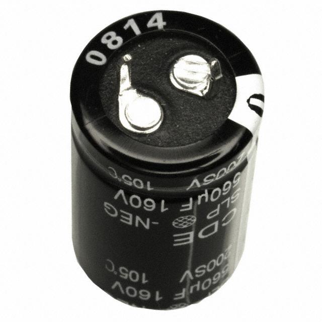

    2200 µF 63 V 铝电解电容器 径向,Can - 卡入式 181 欧姆 @ 120Hz 105°C 时为 3000 小时
SLP222M063A5P3 数据手册
Type SLP 105 ºC Aluminum Electrolytic Snap-In Capacitors Long Life (3000 h) Wide Range Snap-In Type SLP can operate at 105 ºC at rated voltage for 3000 h. This aluminum electrolytic snap-in capacitor offers a wide range of voltages and capacitance values to fit most DC filtering and switching power supply applications. The SLP is the best value package compared to the other snap-in series. Highlights • • • • • • • 3000 h ripple load life at rated voltage 105 ºC rated Small case size with high capacitance Best for switching power supplies 22 mm to 35 mm diameter, 10 mm lead spacing Best value snap-in type High ripple current Specifications Operating Temperature Range: –40 ºC to 105 ºC (10 Vdc~100 Vdc) –25 ºC to 105 ºC (160 Vdc~250 Vdc) Voltage Range: 10 Vdc to 250 Vdc Capacitance Range: 180 µF to 56,000 µF Capacitance Tolerance: ±20% Leakage Current: ≤ 3 √CV (µA) Ripple Current Multipliers: 2.00 Ambient Temperature / Multiplier 20 to 45 ºC 65 ºC 1.89 85 ºC 1.52 105 ºC 1.00 Frequency / Multiplier Voltage 10 - 100 Vdc 160 - 250 Vdc 60 Hz 0.90 0.80 120 Hz 1.00 1.00 1 kHz 1.15 1.25 10 kHz & Up 1.25 1.47 Complies with the EU Directive 2002/95/EC requirement restricting the use of Lead (Pb), Mercury (Hg), Cadmium (Cd), Hexavalent chromium (Cr(VI)), PolyBrominated Biphenyls (PBB) and PolyBrominated Diphenyl Ethers (PBDE). To apply multipliers, see ratings tables for ripple current values Ripple Life: 3,000 h @ full load @ 105 ºC Δ Capacitance ±20% or initial value ESR ≤200% of limit Leakage current = initial value DCL 100 % of limit Load Life Test: 3000 h at rated voltage at 105 ºC Δ Capacitance ±20% or initial value DF ≤200% of specified value Leakage current = initial value There shall be no leakage of electrolyte CDE Cornell Dubilier • 1605 E. Rodney French Blvd. • New Bedford, MA 02744 • Phone: (508)996-8561 • Fax: (508)996-3830 • www.cde.com Type SLP 105 ºC Aluminum Electrolytic Snap-In Capacitors Specifications Shelf Life: Capacitor stored @ no voltage for 1 kh @ 105 ºC Δ Capacitance ±20% or initial value DF ≤200% of specified value Leakage current = initial value There shall be no leakage of electrolyte Vibration: 2 h applied in 3 mutually perpendicular directions: Vibration frequency range: 10 Hz to 55 Hz for one minute. Peak to peak amplitude: 1.5 mm Outline Drawings Insulation Disk Polarity Bar 1.5 +0.2/-0.1 0.8 +0.2/-0.1 10.0 ± 0.1 +0.2 -0.1 L ± 2.0 V in y l S le e v e 6.3 ± 1.0 3.5 0.8 2.0± 0.01 Dia. 6.3 ± 1.0 D + 1.0 Max. PC Board Hole Dimensions Part Numbering System SLP Type SLP 332 Cap 821 = 820 µF 332 = 3300 µF 103 = 10,000 µF M Tolerance M = ±20% 025 Voltage 025 = 25 Vdc 250 = 250 Vdc Diameter 25 mm 22 25 30 35 (in) (0.87) (1.00) (1.18) (1.38) A1 C1 E1 H1 Length 30 A3 C3 E3 H3 35 A5 C5 E5 H5 (1.00) (1.18) (1.38) mm 40 (1.57) A7 C7 E7 H7 (in) 45 (1.77) A4 C4 E4 H4 50 (2.00) A9 C9 E9 H9 A1 Case Code P Polarity P = Polarized 3 Insulating Sleeve 3 = PVC CDE Cornell Dubilier • 1605 E. Rodney French Blvd. • New Bedford, MA 02744 • Phone: (508)996-8561 • Fax: (508)996-3830 • www.cde.com Type SLP 105 ºC Aluminum Electrolytic Snap-In Capacitors Ratings Cap μF 10000 12000 12000 15000 15000 18000 18000 22000 22000 27000 27000 33000 33000 39000 39000 47000 47000 56000 6800 8200 10000 10000 12000 12000 15000 15000 15000 18000 18000 18000 22000 22000 22000 27000 27000 27000 33000 33000 39000 39000 47000 47000 3300 4700 5600 6800 6800 8200 8200 8200 10000 Catalog Part Number 3000 h @ 105 ºC Max ESR 120 Hz/25°C Max Ripple 120 Hz/105°C (Arms) 1.80 2.20 2.20 2.30 2.30 2.52 2.40 2.60 2.60 3.19 3.10 3.40 3.40 3.79 3.70 4.26 4.20 5.00 2.20 2.40 2.60 2.60 2.90 2.90 3.20 3.25 3.11 3.50 3.50 3.50 3.80 3.80 3.80 4.20 4.20 4.20 4.70 4.70 4.90 5.10 5.27 5.50 1.70 2.00 2.20 2.40 2.40 2.70 2.70 2.70 3.00 Nominal Size (DxL) (mm) 22 x 25 22 x 30 25 x 25 22 x 35 25 x 25 22 x 40 25 x 30 22 x 45 25 x 35 22 x 50 25 x 40 25 x 45 35 x 30 30 x 40 35 x 30 30 x 45 35 x 35 35 x 40 22 x 25 22 x 30 22 x 30 25 x 25 22 x 35 25 x 30 22 x 40 25 x 35 30 x 25 22 x 45 25 x 40 30 x 30 25 x 45 30 x 30 35 x 30 25 x 50 30 x 35 35 x 30 30 x 40 35 x 35 30 x 45 35 x 40 30 x 50 35 x 45 22 x 25 22 x 25 22 x 30 22 x 30 25 x 25 22 x 35 25 x 30 30 x 25 22 x 40 (Ω) 10 Vdc (13 Vdc Surge) SLP103M010A1P3 0.073 SLP123M010A3P3 0.061 SLP123M010C1P3 0.061 SLP153M010A5P3 0.049 SLP153M010C1P3 0.049 SLP183M010A7P3 0.041 SLP183M010C3P3 0.041 SLP223M010A4P3 0.033 SLP223M010C5P3 0.033 SLP273M010A9P3 0.027 SLP273M010C7P3 0.027 SLP333M010C4P3 0.022 SLP333M010H3P3 0.022 SLP393M010E7P3 0.019 SLP393M010H3P3 0.019 SLP473M010E4P3 0.016 SLP473M010H5P3 0.016 SLP563M010H7P3 0.013 16 Vdc (20 Vdc Surge) SLP682M016A1P3 0.098 SLP822M016A3P3 0.081 SLP103M016A3P3 0.066 SLP103M016C1P3 0.066 SLP123M016A5P3 0.055 SLP123M016C3P3 0.055 SLP153M016A7P3 0.044 SLP153M016C5P3 0.044 SLP153M016E1P3 0.044 SLP183M016A4P3 0.037 SLP183M016C7P3 0.037 SLP183M016E3P3 0.037 SLP223M016C4P3 0.030 SLP223M016E3P3 0.030 SLP223M016H3P3 0.030 SLP273M016C9P3 0.025 SLP273M016E5P3 0.025 SLP273M016H3P3 0.025 SLP333M016E7P3 0.020 SLP333M016H5P3 0.020 SLP393M016E4P3 0.017 SLP393M016H7P3 0.017 SLP473M016E9P3 0.014 SLP473M016H4P3 0.014 25 Vdc (32 Vdc Surge) SLP332M025A1P3 0.181 SLP472M025A1P3 0.127 SLP562M025A3P3 0.107 SLP682M025A3P3 0.088 SLP682M025C1P3 0.088 SLP822M025A5P3 0.073 SLP822M025C3P3 0.073 SLP822M025E1P3 0.073 SLP103M025A7P3 0.060 CDE Cornell Dubilier • 1605 E. Rodney French Blvd. • New Bedford, MA 02744 • Phone: (508)996-8561 • Fax: (508)996-3830 • www.cde.com Type SLP 105 ºC Aluminum Electrolytic Snap-In Capacitors Cap μF 10000 10000 12000 12000 15000 15000 15000 18000 18000 22000 22000 27000 33000 3900 4700 4700 4700 5600 5600 6800 6800 6800 8200 8200 8200 10000 10000 10000 10000 12000 12000 12000 15000 15000 18000 22000 22000 1800 2200 2700 2700 3300 3300 3900 3900 3900 4700 4700 4700 5600 5600 5600 Catalog Part Number 3000 h @ 105 ºC Max ESR 120 Hz/25°C Max Ripple 120 Hz/105°C (Arms) 3.00 3.00 3.20 3.20 3.60 3.60 3.60 3.90 3.90 4.30 4.30 4.80 5.55 2.00 2.20 2.20 2.53 2.40 2.40 2.60 2.60 2.78 2.90 2.90 2.90 3.04 3.20 3.20 3.04 3.50 3.50 3.50 3.90 3.90 4.51 5.24 5.48 1.50 1.70 1.80 1.80 2.00 2.00 2.23 2.20 2.20 2.50 2.43 2.50 2.80 2.80 2.76 Nominal Size (DxL) (mm) 25 x 35 30 x 30 22 x 50 25 x 40 25 x 45 30 x 35 35 x 30 30 x 40 35 x 35 30 x 45 35 x 35 35 x 45 35 x 50 22 x 30 22 x 35 25 x 25 25 x 35 22 x 35 25 x 30 22 x 40 25 x 35 30 x 25 22 x 50 25 x 40 30 x 30 25 x 40 25 x 45 30 x 35 25 x 40 25 x 50 30 x 40 35 x 30 30 x 45 35 x 35 35 x 40 35 x 45 35 x 50 22 x 25 22 x 30 22 x 30 25 x 25 22 x 35 25 x 30 22 x 40 25 x 30 30 x 25 22 x 45 25 x 35 30 x 30 22 x 50 25 x 40 30 x 30 (Ω) 25 Vdc (32 Vdc Surge) SLP103M025C5P3 0.060 SLP103M025E3P3 0.060 SLP123M025A9P3 0.050 SLP123M025C7P3 0.050 SLP153M025C4P3 0.040 SLP153M025E5P3 0.040 SLP153M025H3P3 0.040 SLP183M025E7P3 0.033 SLP183M025H5P3 0.033 SLP223M025E4P3 0.027 SLP223M025H5P3 0.027 SLP273M025H4P3 0.022 SLP333M025H9P3 0.018 35 Vdc (44 Vdc Surge) SLP392M035A3P3 0.136 SLP472M035A5P3 0.113 SLP472M035C1P3 0.113 SLP472M035C5P3 0.113 SLP562M035A5P3 0.095 SLP562M035C3P3 0.095 SLP682M035A7P3 0.078 SLP682M035C5P3 0.078 SLP682M035E1P3 0.078 SLP822M035A9P3 0.065 SLP822M035C7P3 0.065 SLP822M035E3P3 0.065 SLP103M035C7P3 0.053 SLP103M035C4P3 0.053 SLP103M035E5P3 0.053 SLP103M035C7P3 0.053 SLP123M035C9P3 0.044 SLP123M035E7P3 0.044 SLP123M035H3P3 0.044 SLP153M035E4P3 0.035 SLP153M035H5P3 0.035 SLP183M035H7P3 0.029 SLP223M035H4P3 0.024 SLP223M035H9P3 0.024 50 Vdc (63 Vdc Surge) SLP182M050A1P3 0.258 SLP222M050A3P3 0.211 SLP272M050A3P3 0.172 SLP272M050C1P3 0.172 SLP332M050A5P3 0.141 SLP332M050C3P3 0.141 SLP392M050A7P3 0.119 SLP392M050C3P3 0.119 SLP392M050E1P3 0.119 SLP472M050A4P3 0.099 SLP472M050C5P3 0.099 SLP472M050E3P3 0.099 SLP562M050A9P3 0.083 SLP562M050C7P3 0.083 SLP562M050E3P3 0.083 CDE Cornell Dubilier • 1605 E. Rodney French Blvd. • New Bedford, MA 02744 • Phone: (508)996-8561 • Fax: (508)996-3830 • www.cde.com Type SLP 105 ºC Aluminum Electrolytic Snap-In Capacitors Cap μF 6800 6800 6800 8200 8200 10000 10000 12000 15000 1200 1500 1800 1800 2200 2200 2700 2700 2700 3300 3300 3300 3900 3900 4700 4700 4700 5600 5600 6800 6800 8200 10000 10000 1000 1200 1500 1500 1800 1800 2200 2200 2200 2700 2700 2700 3300 3300 3300 Catalog Part Number 3000 h @ 105 ºC Max ESR 120 Hz/25°C Max Ripple 120 Hz/105°C (Arms) 3.30 3.30 3.30 3.71 3.85 4.51 4.49 4.56 4.80 1.40 1.50 1.70 1.70 2.00 2.00 2.20 2.20 2.20 2.60 2.39 2.50 2.57 2.70 3.00 3.00 3.00 3.22 3.30 3.86 3.84 4.43 5.11 4.89 1.19 1.50 1.59 1.59 1.79 1.71 2.03 2.10 1.98 2.39 2.35 2.35 2.64 2.61 2.60 Nominal Size (DxL) (mm) 25 x 45 30 x 35 35 x 30 30 x 40 35 x 35 30 x 50 35 x 40 35 x 45 35 x 50 22 x 25 22 x 30 22 x 30 25 x 25 22 x 35 25 x 30 22 x 40 25 x 35 30 x 25 22 x 45 25 x 35 30 x 30 25 x 40 30 x 35 25 x 50 30 x 40 35 x 30 30 x 40 35 x 35 30 x 50 35 x 40 35 x 45 35 x 50 35 x 45 22 x 25 22 x 30 22 x 30 25 x 25 22 x 35 25 x 30 22 x 40 25 x 35 30 x 25 22 x 45 25 x 40 30 x 30 25 x 45 30 x 35 35 x 30 (Ω) 50 Vdc (63 Vdc Surge) SLP682M050C4P3 0.068 SLP682M050E5P3 0.068 SLP682M050H3P3 0.068 SLP822M050E7P3 0.057 SLP822M050H5P3 0.057 SLP103M050E9P3 0.046 SLP103M050H7P3 0.046 SLP123M050H4P3 0.039 SLP153M050H9P3 0.031 63 Vdc (79 Vdc Surge) SLP122M063A1P3 0.332 SLP152M063A3P3 0.265 SLP182M063A3P3 0.221 SLP182M063C1P3 0.221 SLP222M063A5P3 0.181 SLP222M063C3P3 0.181 SLP272M063A7P3 0.147 SLP272M063C5P3 0.147 SLP272M063E1P3 0.147 SLP332M063A4P3 0.121 SLP332M063C5P3 0.121 SLP332M063E3P3 0.121 SLP392M063C7P3 0.102 SLP392M063E5P3 0.102 SLP472M063C9P3 0.085 SLP472M063E7P3 0.085 SLP472M063H3P3 0.085 SLP562M063E7P3 0.071 SLP562M063H5P3 0.071 SLP682M063E9P3 0.059 SLP682M063H7P3 0.059 SLP822M063H4P3 0.049 SLP103M063H9P3 0.040 SLP103M063H4P3 0.040 80 Vdc (100 Vdc Surge) SLP102M080A1P3 0.332 SLP122M080A3P3 0.276 SLP152M080A3P3 0.221 SLP152M080C1P3 0.221 SLP182M080A5P3 0.184 SLP182M080C3P3 0.184 SLP222M080A7P3 0.151 SLP222M080C5P3 0.151 SLP222M080E1P3 0.151 SLP272M080A4P3 0.123 SLP272M080C7P3 0.123 SLP272M080E3P3 0.123 SLP332M080C4P3 0.101 SLP332M080E5P3 0.101 SLP332M080H3P3 0.101 CDE Cornell Dubilier • 1605 E. Rodney French Blvd. • New Bedford, MA 02744 • Phone: (508)996-8561 • Fax: (508)996-3830 • www.cde.com Type SLP 105 ºC Aluminum Electrolytic Snap-In Capacitors Cap μF 3900 3900 3900 4700 4700 5600 5600 6800 8200 680 820 1000 1000 1200 1200 1500 1500 1500 1500 1800 1800 1800 2200 2200 2200 2700 2700 2700 3300 3300 3900 3900 4700 5600 330 390 470 470 560 560 680 680 680 820 820 820 1000 1000 1200 1200 1200 1500 Catalog Part Number Max ESR 120 Hz/25°C Max Ripple 120 Hz/105°C (Arms) 2.92 2.82 2.97 3.34 3.38 3.80 3.80 3.90 4.20 1.09 1.40 1.47 1.45 1.69 1.68 1.97 1.98 1.95 2.09 2.23 2.20 2.20 2.53 2.55 2.60 2.82 2.86 2.90 3.30 3.25 3.60 3.67 3.80 4.05 1.20 1.30 1.55 1.55 1.67 1.67 1.82 1.85 1.82 2.04 2.04 2.04 2.40 2.25 2.62 2.49 2.49 2.84 Nominal Size (DxL) (mm) 25 x 50 30 x 40 35 x 30 30 x 45 35 x 35 30 x 50 35 x 40 35 x 45 35 x 50 22 x 25 22 x 30 22 x 30 25 x 25 22 x 35 25 x 30 22 x 40 25 x 35 30 x 25 30 x 30 22 x 45 25 x 40 30 x 30 25 x 45 30 x 35 35 x 30 25 x 50 30 x 40 35 x 35 30 x 45 35 x 35 30 x 50 35 x 40 35 x 45 35 x 50 22 x 25 22 x 30 22 x 30 25 x 25 22 x 35 25 x 30 22 x 40 25 x 35 30 x 25 22 x 45 25 x 40 30 x 30 25 x 45 30 x 35 25 x 50 30 x 40 35 x 30 30 x 45 3000 h @ 105 ºC (Ω) SLP392M080C9P3 0.085 SLP392M080E7P3 0.085 SLP392M080H3P3 0.085 SLP472M080E4P3 0.071 SLP472M080H5P3 0.071 SLP562M080E9P3 0.059 SLP562M080H7P3 0.059 SLP682M080H4P3 0.049 SLP822M080H9P3 0.040 100 Vdc (125 Vdc Surge) SLP681M100A1P3 0.390 SLP821M100A3P3 0.324 SLP102M100A3P3 0.265 SLP102M100C1P3 0.265 SLP122M100A5P3 0.221 SLP122M100C3P3 0.221 SLP152M100A7P3 0.177 SLP152M100C5P3 0.177 SLP152M100E1P3 0.177 SLP152M100E3P3 0.177 SLP182M100A4P3 0.147 SLP182M100C7P3 0.147 SLP182M100E3P3 0.147 SLP222M100C4P3 0.121 SLP222M100E5P3 0.121 SLP222M100H3P3 0.121 SLP272M100C9P3 0.098 SLP272M100E7P3 0.098 SLP272M100H5P3 0.098 SLP332M100E4P3 0.080 SLP332M100H5P3 0.080 SLP392M100E9P3 0.068 SLP392M100H7P3 0.068 SLP472M100H4P3 0.056 SLP562M100H9P3 0.047 160 Vdc (200Vdc Surge) SLP331M160A1P3 0.603 SLP391M160A3P3 0.510 SLP471M160A3P3 0.423 SLP471M160C1P3 0.423 SLP561M160A5P3 0.355 SLP561M160C3P3 0.355 SLP681M160A7P3 0.293 SLP681M160C5P3 0.293 SLP681M160E1P3 0.293 SLP821M160A4P3 0.243 SLP821M160C7P3 0.243 SLP821M160E3P3 0.243 SLP102M160C4P3 0.199 SLP102M160E5P3 0.199 SLP122M160C9P3 0.166 SLP122M160E7P3 0.166 SLP122M160H3P3 0.166 SLP152M160E4P3 0.133 CDE Cornell Dubilier • 1605 E. Rodney French Blvd. • New Bedford, MA 02744 • Phone: (508)996-8561 • Fax: (508)996-3830 • www.cde.com Type SLP 105 ºC Aluminum Electrolytic Snap-In Capacitors Cap μF 1500 1800 1800 2200 270 330 390 390 470 470 560 560 560 680 680 680 820 820 820 1000 1000 1000 1200 1200 1500 1500 1800 2200 220 220 270 330 330 330 390 390 470 470 470 470 560 560 560 680 680 680 680 820 820 820 1000 1000 Catalog Part Number 3000 h @ 105 ºC Max ESR 120 Hz/25°C Max Ripple 120 Hz/105°C (Arms) 2.84 3.32 3.00 3.50 1.00 1.20 1.35 1.35 1.50 1.50 1.67 1.67 1.67 1.78 1.78 1.78 2.04 2.04 2.04 2.30 2.30 2.30 2.55 2.55 2.90 2.90 3.30 3.65 0.99 1.07 1.10 1.25 1.25 1.35 1.35 1.35 1.50 1.50 1.60 1.50 1.67 1.70 1.67 1.78 1.72 1.82 1.78 2.10 2.04 2.04 2.42 2.30 Nominal Size (DxL) (mm) 35 x 35 30 x 50 35 x 40 35 x 45 22 x 25 22 x 30 22 x 30 25 x 25 22 x 35 25 x 30 22 x 40 25 x 30 30 x 25 22 x 45 25 x 35 30 x 30 22 x 50 25 x 40 30 x 30 25 x 45 30 x 35 35 x 30 30 x 40 35 x 35 30 x 45 35 x 40 35 x 45 35 x 50 22 x 25 22 x 30 22 x 25 22 x 30 25 x 25 25 x 30 22 x 35 25 x 30 22 x 40 25 x 30 25 x 35 30 x 25 22 x 45 25 x 35 30 x 25 22 x 50 25 x 35 25 x 40 30 x 30 25 x 45 30 x 35 35 x 30 25 x 50 30 x 40 (Ω) 160 Vdc (200Vdc Surge) SLP152M160H5P3 0.133 SLP182M160E9P3 0.111 SLP182M160H7P3 0.111 SLP222M160H4P3 0.090 180 Vdc (225Vdc Surge) SLP271M180A1P3 0.737 SLP331M180A3P3 0.603 SLP391M180A3P3 0.510 SLP391M180C1P3 0.510 SLP471M180A5P3 0.423 SLP471M180C3P3 0.423 SLP561M180A7P3 0.355 SLP561M180C3P3 0.355 SLP561M180E1P3 0.355 SLP681M180A4P3 0.293 SLP681M180C5P3 0.293 SLP681M180E3P3 0.293 SLP821M180A9P3 0.243 SLP821M180C7P3 0.243 SLP821M180E3P3 0.243 SLP102M180C4P3 0.199 SLP102M180E5P3 0.199 SLP102M180H3P3 0.199 SLP122M180E7P3 0.166 SLP122M180H5P3 0.166 SLP152M180E4P3 0.133 SLP152M180H7P3 0.133 SLP182M180H4P3 0.111 SLP222M180H9P3 0.090 200 Vdc (250 Vdc Surge) SLP221M200A1P3 0.905 SLP221M200A3P3 0.905 SLP271M200A1P3 0.737 SLP331M200A3P3 0.603 SLP331M200C1P3 0.603 SLP331M200C3P3 0.603 SLP391M200A5P3 0.603 SLP391M200C3P3 0.510 SLP471M200A7P3 0.423 SLP471M200C3P3 0.423 SLP471M200C5P3 0.423 SLP471M200E1P3 0.423 SLP561M200A4P3 0.355 SLP561M200C5P3 0.355 SLP561M200E1P3 0.355 SLP681M200A9P3 0.293 SLP681M200C5P3 0.293 SLP681M200C7P3 0.293 SLP681M200E3P3 0.293 SLP821M200C4P3 0.243 SLP821M200E5P3 0.243 SLP821M200H3P3 0.243 SLP102M200C9P3 0.199 SLP102M200E7P3 0.199 CDE Cornell Dubilier • 1605 E. Rodney French Blvd. • New Bedford, MA 02744 • Phone: (508)996-8561 • Fax: (508)996-3830 • www.cde.com Type SLP 105 ºC Aluminum Electrolytic Snap-In Capacitors Cap μF 1000 1200 1200 1200 1500 1800 1800 220 270 330 330 390 390 470 470 470 560 560 560 560 680 680 680 820 820 820 1000 1000 1200 1500 180 180 220 220 270 270 330 330 330 330 390 390 390 470 470 470 560 560 680 680 680 820 820 1000 1000 1200 1500 Catalog Part Number Max ESR 120 Hz/25°C Max Ripple 120 Hz/105°C (Arms) 2.30 2.65 2.65 2.49 3.08 3.48 3.31 1.00 1.15 1.25 1.25 1.40 1.40 1.51 1.44 1.50 1.70 1.64 1.70 1.71 1.84 1.93 1.89 2.08 2.19 2.16 2.50 2.44 2.79 3.22 0.88 0.95 1.00 1.08 1.18 1.27 1.30 1.30 1.35 1.15 1.49 1.49 1.49 1.65 1.65 1.65 1.80 1.80 2.03 2.00 2.00 2.30 2.30 2.70 2.69 3.09 3.61 Nominal Size (DxL) (mm) 35 x 35 30 x 45 35 x 35 35 x 30 35 x 40 35 x 45 35 x 40 22 x 25 22 x 30 22 x 35 25 x 25 22 x 35 25 x 30 22 x 40 25 x 30 30 x 25 22 x 45 25 x 35 30 x 30 35 x 25 25 x 40 30 x 35 35 x 30 25 x 45 30 x 40 35 x 30 30 x 45 35 x 35 35 x 40 35 x 45 22 x 25 25 x 25 22 x 30 25 x 25 22 x 35 25 x 30 22 x 40 25 x 30 30 x 25 22 x 30 22 x 45 25 x 35 30 x 30 22 x 50 25 x 40 30 x 30 25 x 45 30 x 35 25 x 50 30 x 40 35 x 30 30 x 45 35 x 35 30 x 50 35 x 40 35 x 45 35 x 50 3000 h @ 105 ºC (Ω) 200 Vdc (250 Vdc Surge) SLP102M200H5P3 0.199 SLP122M200E4P3 0.166 SLP122M200H5P3 0.166 SLP122M200H3P3 0.166 SLP152M200H7P3 0.133 SLP182M200H4P3 0.111 SLP182M200H7P3 0.111 220 Vdc (270 Vdc Surge) SLP221M220A1P3 0.905 SLP271M220A3P3 0.737 SLP331M220A5P3 0.603 SLP331M220C1P3 0.603 SLP391M220A5P3 0.510 SLP391M220C3P3 0.510 SLP471M220A7P3 0.423 SLP471M220C3P3 0.423 SLP471M220E1P3 0.423 SLP561M220A4P3 0.355 SLP561M220C5P3 0.355 SLP561M220E3P3 0.355 SLP561M220H1P3 0.355 SLP681M220C7P3 0.293 SLP681M220E5P3 0.293 SLP681M220H3P3 0.293 SLP821M220C4P3 0.243 SLP821M220E7P3 0.243 SLP821M220H3P3 0.243 SLP102M220E4P3 0.199 SLP102M220H5P3 0.199 SLP122M220H7P3 0.166 SLP152M220H4P3 0.133 250 Vdc (300 Vdc Surge) SLP181M250A1P3 1.106 SLP181M250C1P3 1.106 SLP221M250A3P3 0.905 SLP221M250C1P3 0.905 SLP271M250A5P3 0.737 SLP271M250C3P3 0.737 SLP331M250A7P3 0.603 SLP331M250C3P3 0.603 SLP331M250E1P3 0.603 SLP331M250A3P3 0.603 SLP391M250A4P3 0.510 SLP391M250C5P3 0.510 SLP391M250E3P3 0.510 SLP471M250A9P3 0.423 SLP471M250C7P3 0.423 SLP471M250E3P3 0.423 SLP561M250C4P3 0.355 SLP561M250E5P3 0.355 SLP681M250C9P3 0.293 SLP681M250E7P3 0.293 SLP681M250H3P3 0.293 SLP821M250E4P3 0.243 SLP821M250H5P3 0.243 SLP102M250E9P3 0.199 SLP102M250H7P3 0.199 SLP122M250H4P3 0.166 SLP152M250H9P3 0.144 CDE Cornell Dubilier • 1605 E. Rodney French Blvd. • New Bedford, MA 02744 • Phone: (508)996-8561 • Fax: (508)996-3830 • www.cde.com
