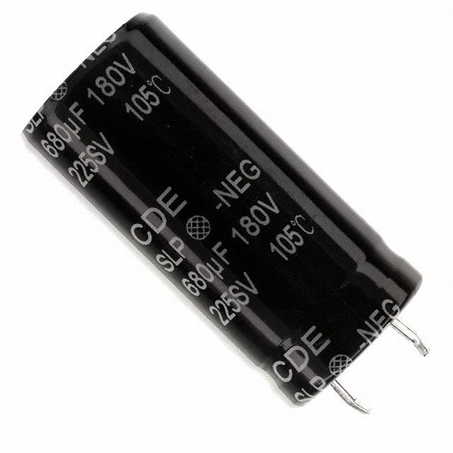

    22000 µF 10 V 铝电解电容器 径向,Can - 卡入式 33 毫欧 @ 120Hz 105°C 时为 3000 小时
SLP223M010A4P3 数据手册
Type SLP 105 °C Snap-In Aluminum Electrolytic Best Value 105 °C Snap-In Type Type SLP is the best value package snap-in series for 105 ºC, 3000 h operation. This series is the most cost-effective choice for DC filtering and power supply applications where high temperature, long life and high ripple capability are needed. Highlights - 3000 h ripple load life at rated voltage - 105 ºC rated - Small case size with high capacitance - Best for switching power supplies - 22 mm to 35 mm diameter, 10 mm lead spacing - Best value snap-in type - High ripple current –40 ºC to +105 ºC ≤ 100 Vdc –25 ºC to +105 ºC ≥ 160 Vdc 10 Vdc to 450 Vdc 47 µF to 56,000 µF ±20% ≤ 3 √CV µA at 5 minutes Ambient Temperature 20 ºC - 45 ºC 2.00 Frequency Voltage 10 - 100 Vdc 160 - 450 Vdc Low Temperature Characteristics 60 Hz 120 Hz 1 kHz 0.90 0.80 1.00 1.00 1.15 1.25 10 kHz & Up 1.25 1.47 65 ºC 1.89 85 ºC 1.52 105 ºC 1.00 Specifications Temperature Range Rated Voltage Range Capacitance Range Capacitance Tolerance Leakage Current Ripple Current Multipliers To apply multipliers, see ratings tables for ripple current values Impedance ratio: Z–20⁰C ∕ Z+25⁰C ≤ 10 (10 Vdc) ≤ 8 (16–50 Vdc) ≤ 4 (63–100 Vdc) ≤ 3 (150–450 Vdc) 3,000 h @ full load @ 105 ºC Δ Capacitance ±20% ESR ≤200% of limit DCL 100 % of limit 1,000 h @ full load @ 105 ºC Δ Capacitance ±20% ESR ≤150% of limit DCL 100 % of limit 10 Hz to 55 Hz , 0.06” and 10g max 2 h for each plane RoHS Compliant Endurance Life Shelf Life Vibration CDM Cornell Dubilier • 140 Technology Place • Liberty, SC 29657 • Phone: (864)843-2277 • Fax: (864)843-3800 Best Value 105 °C Snap-In Type Part Numbering System SLP 562 M Type SLP 105 °C Snap-In Aluminum Electrolytic 025 A1 Case Type SLP Cap 821 = 820 µF 332 = 3300 µF 103 = 10,000 µF Tolerance M = ±20% Voltage 025 = 25 Vdc 250 = 250 Vdc Diameter 25 mm 22 25 (in) (0.87) (1.00) (1.18) (1.38) A1 C1 E1 H1 30 A3 C3 E3 H3 Code Polarity P = Polarized Length 35 A5 C5 E5 H5 (1.00) (1.18) (1.38) mm 40 (1.57) A7 C7 E7 H7 P 3 Insulating Sleeve 3 = PVC (in) 45 (1.77) A4 C4 E4 H4 50 (2.00) A9 C9 E9 H9 Outline Drawing 30 35 Ratings 3000 h @ 105 ºC Cap (μF) 10000 12000 12000 15000 15000 18000 18000 22000 22000 27000 27000 33000 33000 39000 39000 47000 47000 56000 6800 8200 10000 Catalog Part Number SLP103M010A1P3 SLP123M010A3P3 SLP123M010C1P3 SLP153M010A5P3 SLP153M010C1P3 SLP183M010A7P3 SLP183M010C3P3 SLP223M010A4P3 SLP223M010C5P3 SLP273M010A9P3 SLP273M010C7P3 SLP333M010C4P3 SLP333M010H3P3 SLP393M010E7P3 SLP393M010H3P3 SLP473M010E4P3 SLP473M010H5P3 SLP563M010H7P3 SLP682M016A1P3 SLP822M016A3P3 SLP103M016A3P3 (Ω) 120 Hz 20kHz 0.073 0.061 0.061 0.049 0.049 0.041 0.041 0.033 0.033 0.027 0.027 0.022 0.022 0.019 0.019 0.016 0.016 0.013 0.098 0.081 0.066 0.055 0.046 0.046 0.037 0.037 0.031 0.031 0.025 0.025 0.020 0.020 0.017 0.017 0.014 0.014 0.012 0.012 0.010 0.074 0.061 0.050 10 Vdc (13 Vdc Surge) 1.80 2.20 2.20 2.30 2.30 2.52 2.40 2.60 2.60 3.19 3.10 3.40 3.40 3.79 3.70 4.26 4.20 5.00 2.20 2.40 2.60 2.25 2.75 2.75 2.88 2.88 3.15 3.00 3.25 3.25 3.99 3.88 4.25 4.25 4.74 4.63 5.33 5.25 6.25 2.75 3.00 3.25 22 x 25 22 x 30 25 x 25 22 x 35 25 x 25 22 x 40 25 x 30 22 x 45 25 x 35 22 x 50 25 x 40 25 x 45 35 x 30 30 x 40 35 x 30 30 x 45 35 x 35 35 x 40 22 x 25 22 x 30 22 x 30 (Arms) 120 Hz 20kHz (mm) Additional Voltages and Sizes available at www.cde.com/catalogs/SLP.pdf Max 25 °C ESR Max 105 °C Ripple Nominal Size (DxL) Cap (μF) 10000 12000 12000 15000 15000 15000 18000 18000 18000 22000 22000 22000 27000 27000 27000 33000 33000 39000 39000 47000 47000 3000 h @ 105 ºC Catalog Part Number SLP103M016C1P3 SLP123M016A5P3 SLP123M016C3P3 SLP153M016A7P3 SLP153M016C5P3 SLP153M016E1P3 SLP183M016A4P3 SLP183M016C7P3 SLP183M016E3P3 SLP223M016C4P3 SLP223M016E3P3 SLP223M016H3P3 SLP273M016C9P3 SLP273M016E5P3 SLP273M016H3P3 SLP333M016E7P3 SLP333M016H5P3 SLP393M016E4P3 SLP393M016H7P3 SLP473M016E9P3 SLP473M016H4P3 Max 25 °C ESR Max 105 °C Ripple Nominal (Ω) 16 Vdc (20 Vdc Surge) 0.066 0.055 0.055 0.044 0.044 0.044 0.037 0.037 0.037 0.030 0.030 0.030 0.025 0.025 0.025 0.020 0.020 0.017 0.017 0.014 0.014 0.050 0.041 0.041 0.033 0.033 0.033 0.028 0.028 0.028 0.023 0.023 0.023 0.019 0.019 0.019 0.015 0.015 0.013 0.013 0.011 0.011 2.60 2.90 2.90 3.20 3.25 3.11 3.50 3.50 3.50 3.80 3.80 3.80 4.20 4.20 4.20 4.70 4.70 4.90 5.10 5.27 5.50 3.25 3.63 3.63 4.00 4.06 3.89 4.38 4.38 4.38 4.75 4.75 4.75 5.25 5.25 5.25 5.88 5.88 6.13 6.38 6.59 6.88 25 x 25 22 x 35 25 x 30 22 x 40 25 x 35 30 x 25 22 x 45 25 x 40 30 x 30 25 x 45 30 x 30 35 x 30 25 x 50 30 x 35 35 x 30 30 x 40 35 x 35 30 x 45 35 x 40 30 x 50 35 x 45 (Arms) 20kHz Size (DxL) (mm) 120 Hz 20kHz 120 Hz 16 Vdc (20 Vdc Surge) CDE Cornell Dubilier • 1605 E. Rodney French Blvd. • New Bedford, MA 02744 • Phone: (508)996-8561 • Fax: (508)996-3830 Type SLP 105 °C Snap-In Aluminum Electrolytic Best Value 105 °C Snap-In Type 3000 h @ 105 ºC Max 25 °C ESR Cap (μF) 3300 4700 5600 6800 6800 8200 8200 8200 10000 10000 10000 12000 12000 15000 15000 15000 18000 18000 22000 22000 27000 33000 3900 4700 4700 4700 5600 5600 6800 6800 6800 8200 8200 8200 10000 10000 10000 12000 12000 12000 15000 15000 Catalog Part Number SLP332M025A1P3 SLP472M025A1P3 SLP562M025A3P3 SLP682M025A3P3 SLP682M025C1P3 SLP822M025A5P3 SLP822M025C3P3 SLP822M025E1P3 SLP103M025A7P3 SLP103M025C5P3 SLP103M025E3P3 SLP123M025A9P3 SLP123M025C7P3 SLP153M025C4P3 SLP153M025E5P3 SLP153M025H3P3 SLP183M025E7P3 SLP183M025H5P3 SLP223M025E4P3 SLP223M025H5P3 SLP273M025H4P3 SLP333M025H9P3 SLP392M035A3P3 SLP472M035A5P3 SLP472M035C1P3 SLP472M035C5P3 SLP562M035A5P3 SLP562M035C3P3 SLP682M035A7P3 SLP682M035C5P3 SLP682M035E1P3 SLP822M035A9P3 SLP822M035C7P3 SLP822M035E3P3 SLP103M035C4P3 SLP103M035E5P3 SLP103M035C7P3 SLP123M035C9P3 SLP123M035E7P3 SLP123M035H3P3 SLP153M035E4P3 SLP153M035H5P3 (Ω) 120 Hz 20kHz 0.181 0.127 0.107 0.088 0.088 0.073 0.073 0.073 0.060 0.060 0.060 0.050 0.050 0.040 0.040 0.040 0.033 0.033 0.027 0.027 0.022 0.018 0.136 0.113 0.113 0.113 0.095 0.095 0.078 0.078 0.078 0.065 0.065 0.065 0.053 0.053 0.053 0.044 0.044 0.044 0.035 0.035 0.136 0.095 0.080 0.066 0.066 0.055 0.055 0.055 0.045 0.045 0.045 0.038 0.038 0.030 0.030 0.030 0.025 0.025 0.020 0.020 0.017 0.014 0.102 0.085 0.085 0.085 0.071 0.071 0.059 0.059 0.059 0.049 0.049 0.049 0.040 0.040 0.040 0.033 0.033 0.033 0.026 0.026 25 Vdc (32 Vdc Surge) 1.70 2.00 2.20 2.40 2.40 2.70 2.70 2.70 3.00 3.00 3.00 3.20 3.20 3.60 3.60 3.60 3.90 3.90 4.30 4.30 4.80 5.55 2.00 2.20 2.20 2.53 2.40 2.40 2.60 2.60 2.78 2.90 2.90 2.90 3.20 3.20 3.04 3.50 3.50 3.50 3.90 3.90 2.13 2.50 2.75 3.00 3.00 3.38 3.38 3.38 3.75 3.75 3.75 4.00 4.00 4.50 4.50 4.50 4.88 4.88 5.38 5.38 6.00 6.94 2.50 2.75 2.75 3.16 3.00 3.00 3.25 3.25 3.48 3.63 3.63 3.63 4.00 4.00 3.80 4.38 4.38 4.38 4.88 4.88 22 x 25 22 x 25 22 x 30 22 x 30 25 x 25 22 x 35 25 x 30 30 x 25 22 x 40 25 x 35 30 x 30 22 x 50 25 x 40 25 x 45 30 x 35 35 x 30 30 x 40 35 x 35 30 x 45 35 x 35 35 x 45 35 x 50 22 x 30 22 x 35 25 x 25 25 x 35 22 x 35 25 x 30 22 x 40 25 x 35 30 x 25 22 x 50 25 x 40 30 x 30 25 x 45 30 x 35 25 x 40 25 x 50 30 x 40 35 x 30 30 x 45 35 x 35 1200 1500 1800 1800 2200 2200 2700 2700 2700 3300 3300 3300 3900 3900 SLP122M063A1P3 SLP152M063A3P3 SLP182M063A3P3 SLP182M063C1P3 SLP222M063A5P3 SLP222M063C3P3 SLP272M063A7P3 SLP272M063C5P3 SLP272M063E1P3 SLP332M063A4P3 SLP332M063C5P3 SLP332M063E3P3 SLP392M063C7P3 SLP392M063E5P3 1800 2200 2700 2700 3300 3300 3900 3900 3900 4700 4700 4700 5600 5600 5600 6800 6800 6800 8200 8200 10000 10000 12000 15000 SLP182M050A1P3 SLP222M050A3P3 SLP272M050A3P3 SLP272M050C1P3 SLP332M050A5P3 SLP332M050C3P3 SLP392M050A7P3 SLP392M050C3P3 SLP392M050E1P3 SLP472M050A4P3 SLP472M050C5P3 SLP472M050E3P3 SLP562M050A9P3 SLP562M050C7P3 SLP562M050E3P3 SLP682M050C4P3 SLP682M050E5P3 SLP682M050H3P3 SLP822M050E7P3 SLP822M050H5P3 SLP103M050E9P3 SLP103M050H7P3 SLP123M050H4P3 SLP153M050H9P3 18000 22000 22000 SLP183M035H7P3 SLP223M035H4P3 SLP223M035H9P3 Additional Voltages and Sizes available at www.cde.com/catalogs/SLP.pdf Max 105 °C Ripple Nominal (Arms) 120 Hz 20kHz Size (DxL) (mm) Cap (μF) 3000 h @ 105 ºC Catalog Part Number Max 25 °C ESR Max 105 °C Ripple Nominal (Ω) 120 Hz 20kHz 0.029 0.024 0.024 0.258 0.211 0.172 0.172 0.141 0.141 0.119 0.119 0.119 0.099 0.099 0.099 0.083 0.083 0.083 0.068 0.068 0.068 0.057 0.057 0.046 0.046 0.039 0.031 0.332 0.265 0.221 0.221 0.181 0.181 0.147 0.147 0.147 0.121 0.121 0.121 0.102 0.102 0.022 0.018 0.018 0.194 0.158 0.129 0.129 0.106 0.106 0.089 0.089 0.089 0.074 0.074 0.074 0.062 0.062 0.062 0.051 0.051 0.051 0.043 0.043 0.035 0.035 0.029 0.023 0.249 0.199 0.166 0.166 0.136 0.136 0.110 0.110 0.110 0.091 0.091 0.091 0.077 0.077 35 Vdc (44 Vdc Surge) 4.51 5.24 5.48 1.50 1.70 1.80 1.80 2.00 2.00 2.23 2.20 2.20 2.50 2.43 2.50 2.80 2.80 2.76 3.30 3.30 3.30 3.71 3.85 4.51 4.49 4.56 4.80 1.40 1.50 1.70 1.70 2.00 2.00 2.20 2.20 2.20 2.60 2.39 2.50 2.57 2.70 5.64 6.55 6.85 1.88 2.13 2.25 2.25 2.50 2.50 2.79 2.75 2.75 3.13 3.04 3.13 3.50 3.50 3.45 4.13 4.13 4.13 4.64 4.81 5.64 5.61 5.70 6.00 1.75 1.88 2.13 2.13 2.50 2.50 2.75 2.75 2.75 3.25 2.99 3.13 3.21 3.38 35 x 40 35 x 45 35 x 50 22 x 25 22 x 30 22 x 30 25 x 25 22 x 35 25 x 30 22 x 40 25 x 30 30 x 25 22 x 45 25 x 35 30 x 30 22 x 50 25 x 40 30 x 30 25 x 45 30 x 35 35 x 30 30 x 40 35 x 35 30 x 50 35 x 40 35 x 45 35 x 50 22 x 25 22 x 30 22 x 30 25 x 25 22 x 35 25 x 30 22 x 40 25 x 35 30 x 25 22 x 45 25 x 35 30 x 30 25 x 40 30 x 35 (Arms) 120 Hz 20kHz Size (DxL) (mm) 50 Vdc (63 Vdc Surge) 35 Vdc (44 Vdc Surge) 63 Vdc (79 Vdc Surge) CDE Cornell Dubilier • 1605 E. Rodney French Blvd. • New Bedford, MA 02744 • Phone: (508)996-8561 • Fax: (508)996-3830 Type SLP 105 °C Snap-In Aluminum Electrolytic Best Value 105 °C Snap-In Type Cap (μF) 4700 4700 4700 5600 5600 6800 6800 8200 10000 10000 1000 1200 1500 1500 1800 1800 2200 2200 2200 2700 2700 2700 3300 3300 3300 3900 3900 3900 4700 4700 5600 5600 6800 8200 680 820 1000 1000 1200 1200 1500 Catalog Part Number SLP472M063C9P3 SLP472M063E7P3 SLP472M063H3P3 SLP562M063E7P3 SLP562M063H5P3 SLP682M063E9P3 SLP682M063H7P3 SLP822M063H4P3 SLP103M063H9P3 SLP103M063H4P3 SLP102M080A1P3 SLP122M080A3P3 SLP152M080A3P3 SLP152M080C1P3 SLP182M080A5P3 SLP182M080C3P3 SLP222M080A7P3 SLP222M080C5P3 SLP222M080E1P3 SLP272M080A4P3 SLP272M080C7P3 SLP272M080E3P3 SLP332M080C4P3 SLP332M080E5P3 SLP332M080H3P3 SLP392M080C9P3 SLP392M080E7P3 SLP392M080H3P3 SLP472M080E4P3 SLP472M080H5P3 SLP562M080E9P3 SLP562M080H7P3 SLP682M080H4P3 SLP822M080H9P3 SLP681M100A1P3 SLP821M100A3P3 SLP102M100A3P3 SLP102M100C1P3 SLP122M100A5P3 SLP122M100C3P3 SLP152M100A7P3 (Ω) 120 Hz 20kHz 0.085 0.085 0.085 0.071 0.071 0.059 0.059 0.049 0.040 0.040 0.332 0.276 0.221 0.221 0.184 0.184 0.151 0.151 0.151 0.123 0.123 0.123 0.101 0.101 0.101 0.085 0.085 0.085 0.071 0.071 0.059 0.059 0.049 0.040 0.390 0.324 0.265 0.265 0.221 0.221 0.177 0.064 0.064 0.064 0.053 0.053 0.044 0.044 0.037 0.030 0.030 0.249 0.207 0.166 0.166 0.138 0.138 0.113 0.113 0.113 0.092 0.092 0.092 0.076 0.076 0.076 0.064 0.064 0.064 0.053 0.053 0.044 0.044 0.037 0.030 0.293 0.243 0.199 0.199 0.166 0.166 0.133 63 Vdc (79 Vdc Surge) 3.00 3.00 3.00 3.22 3.30 3.86 3.84 4.43 5.11 4.89 1.19 1.50 1.59 1.59 1.79 1.71 2.03 2.10 1.98 2.39 2.35 2.35 2.64 2.61 2.60 2.92 2.82 2.97 3.34 3.38 3.80 3.80 3.90 4.20 1.09 1.40 1.47 1.45 1.69 1.68 1.97 3.75 3.75 3.75 4.03 4.13 4.83 4.80 5.54 6.39 6.11 1.49 1.88 1.99 1.99 2.24 2.14 2.54 2.63 2.48 2.99 2.94 2.94 3.30 3.26 3.25 3.65 3.53 3.71 4.18 4.23 4.75 4.75 4.88 5.25 1.36 1.75 1.84 1.81 2.11 2.10 2.46 25 x 50 30 x 40 35 x 30 30 x 40 35 x 35 30 x 50 35 x 40 35 x 45 35 x 50 35 x 45 22 x 25 22 x 30 22 x 30 25 x 25 22 x 35 25 x 30 22 x 40 25 x 35 30 x 25 22 x 45 25 x 40 30 x 30 25 x 45 30 x 35 35 x 30 25 x 50 30 x 40 35 x 30 30 x 45 35 x 35 30 x 50 35 x 40 35 x 45 35 x 50 22 x 25 22 x 30 22 x 30 25 x 25 22 x 35 25 x 30 22 x 40 270 330 390 470 470 560 560 680 680 680 820 820 820 1000 1000 1200 1200 1200 1500 1500 1800 1800 2200 1500 1500 1500 1800 1800 1800 2200 2200 2200 2700 2700 2700 3300 3300 3900 3900 4700 5600 Additional Voltages and Sizes available at www.cde.com/catalogs/SLP.pdf 3000 h @ 105 ºC Max 25 °C ESR Max 105 °C Ripple Nominal (Arms) 120 Hz 20kHz Size (DxL) (mm) Cap (μF) 3000 h @ 105 ºC Catalog Part Number SLP152M100C5P3 SLP152M100E1P3 SLP152M100E3P3 SLP182M100A4P3 SLP182M100C7P3 SLP182M100E3P3 SLP222M100C4P3 SLP222M100E5P3 SLP222M100H3P3 SLP272M100C9P3 SLP272M100E7P3 SLP272M100H5P3 SLP332M100E4P3 SLP332M100H5P3 SLP392M100E9P3 SLP392M100H7P3 SLP472M100H4P3 SLP562M100H9P3 SLP331M160A1P3 SLP391M160A3P3 SLP471M160A3P3 SLP471M160C1P3 SLP561M160A5P3 SLP561M160C3P3 SLP681M160A7P3 SLP681M160C5P3 SLP681M160E1P3 SLP821M160A4P3 SLP821M160C7P3 SLP821M160E3P3 SLP102M160C4P3 SLP102M160E5P3 SLP122M160C9P3 SLP122M160E7P3 SLP122M160H3P3 SLP152M160E4P3 SLP152M160H5P3 SLP182M160E9P3 SLP182M160H7P3 SLP222M160H4P3 SLP271M180A1P3 Max 25 °C ESR Max 105 °C Ripple Nominal (Ω) 100 Vdc (125 Vdc Surge) 0.177 0.177 0.177 0.147 0.147 0.147 0.121 0.121 0.121 0.098 0.098 0.098 0.080 0.080 0.068 0.068 0.056 0.047 0.603 0.510 0.423 0.423 0.355 0.355 0.293 0.293 0.293 0.243 0.243 0.243 0.199 0.199 0.166 0.166 0.166 0.133 0.133 0.111 0.111 0.090 0.737 0.133 0.133 0.133 0.110 0.110 0.110 0.091 0.091 0.091 0.074 0.074 0.074 0.060 0.060 0.051 0.051 0.042 0.035 0.452 0.383 0.317 0.317 0.266 0.266 0.220 0.220 0.220 0.182 0.182 0.182 0.149 0.149 0.125 0.125 0.125 0.100 0.100 0.083 0.083 0.068 0.553 1.98 1.95 2.09 2.23 2.20 2.20 2.53 2.55 2.60 2.82 2.86 2.90 3.30 3.25 3.60 3.67 3.80 4.05 1.20 1.30 1.55 1.55 1.67 1.67 1.82 1.85 1.82 2.04 2.04 2.04 2.40 2.25 2.62 2.49 2.49 2.84 2.84 3.32 3.00 3.50 1.00 2.48 2.44 2.61 2.79 2.75 2.75 3.16 3.19 3.25 3.53 3.58 3.63 4.13 4.06 4.50 4.59 4.75 5.06 1.76 1.91 2.28 2.28 2.45 2.45 2.68 2.72 2.68 3.00 3.00 3.00 3.53 3.31 3.85 3.66 3.66 4.17 4.17 4.88 4.41 5.15 1.47 25 x 35 30 x 25 30 x 30 22 x 45 25 x 40 30 x 30 25 x 45 30 x 35 35 x 30 25 x 50 30 x 40 35 x 35 30 x 45 35 x 35 30 x 50 35 x 40 35 x 45 35 x 50 22 x 25 22 x 30 22 x 30 25 x 25 22 x 35 25 x 30 22 x 40 25 x 35 30 x 25 22 x 45 25 x 40 30 x 30 25 x 45 30 x 35 25 x 50 30 x 40 35 x 30 30 x 45 35 x 35 30 x 50 35 x 40 35 x 45 22 x 25 (Arms) 20kHz Size (DxL) (mm) 120 Hz 20kHz 120 Hz 80 Vdc (100 Vdc Surge) 160 Vdc (200Vdc Surge) 100 Vdc (125 Vdc Surge) 180 Vdc (225Vdc Surge) CDE Cornell Dubilier • 1605 E. Rodney French Blvd. • New Bedford, MA 02744 • Phone: (508)996-8561 • Fax: (508)996-3830 Type SLP 105 °C Snap-In Aluminum Electrolytic Best Value 105 °C Snap-In Type Cap (μF) 330 390 390 470 470 560 560 560 680 680 680 820 820 820 1000 1000 1000 1200 1200 1500 1500 1800 2200 220 220 270 330 330 330 390 390 470 470 470 470 560 560 560 680 680 680 680 Catalog Part Number SLP331M180A3P3 SLP391M180A3P3 SLP391M180C1P3 SLP471M180A5P3 SLP471M180C3P3 SLP561M180A7P3 SLP561M180C3P3 SLP561M180E1P3 SLP681M180A4P3 SLP681M180C5P3 SLP681M180E3P3 SLP821M180A9P3 SLP821M180C7P3 SLP821M180E3P3 SLP102M180C4P3 SLP102M180E5P3 SLP102M180H3P3 SLP122M180E7P3 SLP122M180H5P3 SLP152M180E4P3 SLP152M180H7P3 SLP182M180H4P3 SLP222M180H9P3 SLP221M200A1P3 SLP221M200A3P3 SLP271M200A1P3 SLP331M200A3P3 SLP331M200C1P3 SLP331M200C3P3 SLP391M200A5P3 SLP391M200C3P3 SLP471M200A7P3 SLP471M200C3P3 SLP471M200C5P3 SLP471M200E1P3 SLP561M200A4P3 SLP561M200C5P3 SLP561M200E1P3 SLP681M200A9P3 SLP681M200C5P3 SLP681M200C7P3 SLP681M200E3P3 (Ω) 120 Hz 20kHz 0.603 0.510 0.510 0.423 0.423 0.355 0.355 0.355 0.293 0.293 0.293 0.243 0.243 0.243 0.199 0.199 0.199 0.166 0.166 0.133 0.133 0.111 0.090 0.905 0.905 0.737 0.603 0.603 0.603 0.510 0.510 0.423 0.423 0.423 0.423 0.355 0.355 0.355 0.293 0.293 0.293 0.293 0.452 0.383 0.383 0.317 0.317 0.266 0.266 0.266 0.220 0.220 0.220 0.182 0.182 0.182 0.149 0.149 0.149 0.125 0.125 0.100 0.100 0.083 0.068 0.679 0.679 0.553 0.452 0.452 0.452 0.383 0.383 0.317 0.317 0.317 0.317 0.266 0.266 0.266 0.220 0.220 0.220 0.220 180 Vdc (225Vdc Surge) 1.20 1.35 1.35 1.50 1.50 1.67 1.67 1.67 1.78 1.78 1.78 2.04 2.04 2.04 2.30 2.30 2.30 2.55 2.55 2.90 2.90 3.30 3.65 0.99 1.07 1.10 1.25 1.25 1.35 1.35 1.35 1.50 1.50 1.60 1.50 1.67 1.70 1.67 1.78 1.72 1.82 1.78 1.76 1.98 1.98 2.21 2.21 2.45 2.45 2.45 2.62 2.62 2.62 3.00 3.00 3.00 3.38 3.38 3.38 3.75 3.75 4.26 4.26 4.85 5.37 1.46 1.57 1.62 1.84 1.84 1.98 1.98 1.98 2.21 2.21 2.35 2.21 2.45 2.50 2.45 2.62 2.53 2.68 2.62 22 x 30 22 x 30 25 x 25 22 x 35 25 x 30 22 x 40 25 x 30 30 x 25 22 x 45 25 x 35 30 x 30 22 x 50 25 x 40 30 x 30 25 x 45 30 x 35 35 x 30 30 x 40 35 x 35 30 x 45 35 x 40 35 x 45 35 x 50 22 x 25 22 x 30 22 x 25 22 x 30 25 x 25 25 x 30 22 x 35 25 x 30 22 x 40 25 x 30 25 x 35 30 x 25 22 x 45 25 x 35 30 x 25 22 x 50 25 x 35 25 x 40 30 x 30 180 180 220 220 270 270 220 270 330 330 390 390 470 470 470 560 560 560 560 680 680 680 820 820 820 1000 1000 1200 1500 820 820 820 1000 1000 1000 1200 1200 1200 1500 1800 1800 Additional Voltages and Sizes available at www.cde.com/catalogs/SLP.pdf 3000 h @ 105 ºC Max 25 °C ESR Max 105 °C Ripple Nominal (Arms) 120 Hz 20kHz Size (DxL) (mm) Cap (μF) 3000 h @ 105 ºC Catalog Part Number SLP821M200C4P3 SLP821M200E5P3 SLP821M200H3P3 SLP102M200C9P3 SLP102M200E7P3 SLP102M200H5P3 SLP122M200E4P3 SLP122M200H5P3 SLP122M200H3P3 SLP152M200H7P3 SLP182M200H4P3 SLP182M200H7P3 SLP221M220A1P3 SLP271M220A3P3 SLP331M220A5P3 SLP331M220C1P3 SLP391M220A5P3 SLP391M220C3P3 SLP471M220A7P3 SLP471M220C3P3 SLP471M220E1P3 SLP561M220A4P3 SLP561M220C5P3 SLP561M220E3P3 SLP561M220H1P3 SLP681M220C7P3 SLP681M220E5P3 SLP681M220H3P3 SLP821M220C4P3 SLP821M220E7P3 SLP821M220H3P3 SLP102M220E4P3 SLP102M220H5P3 SLP122M220H7P3 SLP152M220H4P3 SLP181M250A1P3 SLP181M250C1P3 SLP221M250A3P3 SLP221M250C1P3 SLP271M250A5P3 SLP271M250C3P3 Max 25 °C ESR Max 105 °C Ripple Nominal (Ω) 200 Vdc (250 Vdc Surge) 0.243 0.243 0.243 0.199 0.199 0.199 0.166 0.166 0.166 0.133 0.111 0.111 0.905 0.737 0.603 0.603 0.510 0.510 0.423 0.423 0.423 0.355 0.355 0.355 0.355 0.293 0.293 0.293 0.243 0.243 0.243 0.199 0.199 0.166 0.133 1.106 1.106 0.905 0.905 0.737 0.737 0.182 0.182 0.182 0.149 0.149 0.149 0.125 0.125 0.125 0.100 0.083 0.083 0.679 0.553 0.452 0.452 0.383 0.383 0.317 0.317 0.317 0.266 0.266 0.266 0.266 0.220 0.220 0.220 0.182 0.182 0.182 0.149 0.149 0.125 0.100 0.830 0.830 0.679 0.679 0.553 0.553 2.10 2.04 2.04 2.42 2.30 2.30 2.65 2.65 2.49 3.08 3.48 3.31 1.00 1.15 1.25 1.25 1.40 1.40 1.51 1.44 1.50 1.70 1.64 1.70 1.71 1.84 1.93 1.89 2.08 2.19 2.16 2.50 2.44 2.79 3.22 0.88 0.95 1.00 1.08 1.18 1.27 3.09 3.00 3.00 3.56 3.38 3.38 3.90 3.90 3.66 4.53 5.12 4.87 1.47 1.69 1.84 1.84 2.06 2.06 2.22 2.12 2.21 2.50 2.41 2.50 2.51 2.70 2.84 2.78 3.06 3.22 3.18 3.68 3.59 4.10 4.73 1.29 1.40 1.47 1.59 1.73 1.87 25 x 45 30 x 35 35 x 30 25 x 50 30 x 40 35 x 35 30 x 45 35 x 35 35 x 30 35 x 40 35 x 45 35 x 40 22 x 25 22 x 30 22 x 35 25 x 25 22 x 35 25 x 30 22 x 40 25 x 30 30 x 25 22 x 45 25 x 35 30 x 30 35 x 25 25 x 40 30 x 35 35 x 30 25 x 45 30 x 40 35 x 30 30 x 45 35 x 35 35 x 40 35 x 45 22 x 25 25 x 25 22 x 30 25 x 25 22 x 35 25 x 30 (Arms) 20kHz Size (DxL) (mm) 120 Hz 20kHz 120 Hz 220 Vdc (270 Vdc Surge) 200 Vdc (250 Vdc Surge) 250 Vdc (300 Vdc Surge) CDE Cornell Dubilier • 1605 E. Rodney French Blvd. • New Bedford, MA 02744 • Phone: (508)996-8561 • Fax: (508)996-3830 Type SLP 105 °C Snap-In Aluminum Electrolytic Best Value 105 °C Snap-In Type Cap (μF) 330 330 330 330 390 390 390 470 470 470 560 560 680 680 680 820 820 1000 1000 1200 1500 120 150 150 180 180 220 220 220 270 270 270 330 330 330 390 390 390 470 470 560 560 680 Catalog Part Number SLP331M250A7P3 SLP331M250C3P3 SLP331M250E1P3 SLP331M250A3P3 SLP391M250A4P3 SLP391M250C5P3 SLP391M250E3P3 SLP471M250A9P3 SLP471M250C7P3 SLP471M250E3P3 SLP561M250C4P3 SLP561M250E5P3 SLP681M250C9P3 SLP681M250E7P3 SLP681M250H3P3 SLP821M250E4P3 SLP821M250H5P3 SLP102M250E9P3 SLP102M250H7P3 SLP122M250H4P3 SLP152M250H9P3 SLP121M315A1P3 SLP151M315A3P3 SLP151M315C1P3 SLP181M315A5P3 SLP181M315C3P3 SLP221M315A7P3 SLP221M315C3P3 SLP221M315E1P3 SLP271M315A4P3 SLP271M315C5P3 SLP271M315E1P3 SLP331M315A9P3 SLP331M315C7P3 SLP331M315E3P3 SLP391M315C4P3 SLP391M315E5P3 SLP391M315H3P3 SLP471M315E7P3 SLP471M315H3P3 SLP561M315E4P3 SLP561M315H5P3 SLP681M315H7P3 (Ω) 120 Hz 20kHz 0.603 0.603 0.603 0.603 0.510 0.510 0.510 0.423 0.423 0.423 0.355 0.355 0.293 0.293 0.293 0.243 0.243 0.199 0.199 0.166 0.133 2.765 2.212 2.212 1.843 1.843 1.508 1.508 1.508 1.229 1.229 1.229 1.005 1.005 1.005 0.851 0.851 0.851 0.706 0.706 0.592 0.592 0.488 0.452 0.452 0.452 0.452 0.383 0.383 0.383 0.317 0.317 0.317 0.266 0.266 0.220 0.220 0.220 0.182 0.182 0.149 0.149 0.125 0.100 2.074 1.659 1.659 1.382 1.382 1.131 1.131 1.131 0.922 0.922 0.922 0.754 0.754 0.754 0.638 0.638 0.638 0.530 0.530 0.444 0.444 0.366 250 Vdc (300 Vdc Surge) 1.30 1.30 1.35 1.15 1.49 1.49 1.49 1.65 1.65 1.65 1.80 1.80 2.03 2.00 2.00 2.30 2.30 2.70 2.69 3.09 3.61 0.75 0.82 0.82 0.92 0.93 1.04 1.04 1.04 1.16 1.16 1.16 1.33 1.33 1.33 1.47 1.47 1.47 1.70 1.70 2.05 2.05 2.17 1.91 1.91 1.98 1.69 2.19 2.19 2.19 2.43 2.43 2.43 2.65 2.65 2.98 2.94 2.94 3.38 3.38 3.97 3.95 4.54 5.31 1.10 1.21 1.21 1.35 1.37 1.53 1.53 1.53 1.71 1.71 1.71 1.96 1.96 1.96 2.16 2.16 2.16 2.50 2.50 3.01 3.01 3.19 22 x 40 25 x 30 30 x 25 22 x 30 22 x 45 25 x 35 30 x 30 22 x 50 25 x 40 30 x 30 25 x 45 30 x 35 25 x 50 30 x 40 35 x 30 30 x 45 35 x 35 30 x 50 35 x 40 35 x 45 35 x 50 22 x 25 22 x 30 25 x 25 22 x 35 25 x 30 22 x 40 25 x 30 30 x 25 22 x 45 25 x 35 30 x 25 22 x 50 25 x 40 30 x 30 25 x 45 30 x 35 35 x 30 30 x 40 35 x 30 30 x 45 35 x 35 35 x 40 68 82 100 120 150 150 180 180 220 270 270 330 330 390 390 470 560 100 120 120 150 150 180 180 180 220 220 220 270 270 270 330 330 330 390 390 390 470 470 560 560 680 Additional Voltages and Sizes available at www.cde.com/catalogs/SLP.pdf 3000 h @ 105 ºC Max 25 °C ESR Max 105 °C Ripple Nominal (Arms) 120 Hz 20kHz Size (DxL) (mm) Cap (μF) 820 3000 h @ 105 ºC Catalog Part Number SLP821M315H4P3 SLP101M350A1P3 SLP121M350A3P3 SLP121M350C1P3 SLP151M350A5P3 SLP151M350C3P3 SLP181M350A7P3 SLP181M350C3P3 SLP181M350E1P3 SLP221M350A4P3 SLP221M350C5P3 SLP221M350E3P3 SLP271M350A9P3 SLP271M350C7P3 SLP271M350E3P3 SLP331M350C4P3 SLP331M350E5P3 SLP331M350H3P3 SLP391M350C9P3 SLP391M350E7P3 SLP391M350H5P3 SLP471M350E4P3 SLP471M350H5P3 SLP561M350E9P3 SLP561M350H7P3 SLP681M350H4P3 SLP680M385A1P3 SLP820M385A3P3 SLP101M385A3P3 SLP121M385A5P3 SLP151M385A7P3 SLP151M385E1P3 SLP181M385A4P3 SLP181M385E3P3 SLP221M385E3P3 SLP271M385E7P3 SLP271M385H3P3 SLP331M385E4P3 SLP331M385H5P3 SLP391M385E9P3 SLP391M385H7P3 SLP471M385H4P3 SLP561M385H9P3 0.405 3.317 2.765 2.765 2.212 2.212 1.843 1.843 1.843 1.508 1.508 1.508 1.229 1.229 1.229 1.005 1.005 1.005 0.851 0.851 0.851 0.706 0.706 0.592 0.592 0.488 4.879 4.046 3.317 2.765 2.212 2.212 1.843 1.843 1.508 1.229 1.229 1.005 1.005 0.851 0.851 0.706 0.592 Max 25 °C ESR Max 105 °C Ripple Nominal (Ω) 120 Hz 20kHz 0.304 2.488 2.074 2.074 1.659 1.659 1.382 1.382 1.382 1.131 1.131 1.131 0.922 0.922 0.922 0.754 0.754 0.754 0.638 0.638 0.638 0.530 0.530 0.444 0.444 0.366 3.659 3.035 2.488 2.074 1.659 1.659 1.382 1.382 1.131 0.922 0.922 0.754 0.754 0.638 0.638 0.530 0.444 (Arms) 120 Hz 2.20 0.69 0.75 0.75 0.82 0.83 0.92 0.92 0.90 1.05 1.04 1.02 1.16 1.18 1.17 1.29 1.34 1.22 1.51 1.51 1.47 1.65 1.69 1.85 1.90 2.20 0.45 0.52 0.58 0.68 0.79 0.75 0.94 0.88 1.00 1.14 1.10 1.31 1.32 1.48 1.48 1.76 1.95 20kHz 3.23 1.01 1.10 1.10 1.21 1.22 1.35 1.35 1.32 1.54 1.53 1.50 1.71 1.73 1.72 1.90 1.97 1.79 2.22 2.22 2.16 2.43 2.48 2.72 2.79 3.23 0.66 0.76 0.85 1.00 1.16 1.10 1.38 1.29 1.47 1.68 1.62 1.93 1.94 2.18 2.18 2.59 2.87 Size (DxL) (mm) 35 x 45 22 x 25 22 x 30 25 x 25 22 x 35 25 x 30 22 x 40 25 x 30 30 x 25 22 x 45 25 x 35 30 x 30 22 x 50 25 x 40 30 x 30 25 x 45 30 x 35 35 x 30 25 x 50 30 x 40 35 x 35 30 x 45 35 x 35 30 x 50 35 x 40 35 x 45 22 x 25 22 x 30 22 x 30 22 x 35 22 x 40 30 x 25 25 x 45 30 x 30 30 x 30 30 x 40 35 x 30 30 x 45 35 x 35 30 x 50 35 x 40 35 x 45 35 x 50 350 Vdc (400 Vdc Surge) 315 Vdc (365 Vdc Surge) 385 Vdc (435 Vdc Surge) CDE Cornell Dubilier • 1605 E. Rodney French Blvd. • New Bedford, MA 02744 • Phone: (508)996-8561 • Fax: (508)996-3830 Type SLP 105 °C Snap-In Aluminum Electrolytic Best Value 105 °C Snap-In Type Cap (μF) 47 68 82 100 100 120 120 150 150 150 150 180 180 220 220 220 220 220 270 270 270 330 330 330 390 390 470 560 680 68 82 82 100 100 120 120 120 150 150 150 180 180 180 180 Catalog Part Number SLP470M400A1P3 SLP680M400A1P3 SLP820M400A1P3 SLP101M400A3P3 SLP101M400C1P3 SLP121M400A5P3 SLP121M400C3P3 SLP151M400A7P3 SLP151M400C5P3 SLP151M400E1P3 SLP151M400C3P3 SLP181M400A4P3 SLP181M400E3P3 SLP221M400A9P3 SLP221M400C5P3 SLP221M400C7P3 SLP221M400E3P3 SLP221M400E5P3 SLP271M400C9P3 SLP271M400E5P3 SLP271M400H3P3 SLP331M400E4P3 SLP331M400H3P3 SLP331M400E5P3 SLP391M400E4P3 SLP391M400H5P3 SLP471M400H7P3 SLP561M400H4P3 SLP681M400H4P3 SLP680M420A1P3 SLP820M420A1P3 SLP820M420C1P3 SLP101M420A3P3 SLP101M420C1P3 SLP121M420A5P3 SLP121M420C3P3 SLP121M420E1P3 SLP151M420A7P3 SLP151M420C5P3 SLP151M420E1P3 SLP181M420A4P3 SLP181M420C7P3 SLP181M420E3P3 SLP181M420H1P3 (Ω) 400 Vdc (450 Vdc Surge) 7.058 4.879 4.046 3.317 3.317 2.765 2.765 2.212 2.212 2.212 2.212 1.843 1.843 1.508 1.508 1.508 1.508 1.508 1.229 1.229 1.229 1.005 1.005 1.005 0.851 0.851 0.706 0.592 0.488 4.879 4.046 4.046 3.317 3.317 2.765 2.765 2.765 2.212 2.212 2.212 1.843 1.843 1.843 1.843 5.294 3.659 3.035 2.488 2.488 2.074 2.074 1.659 1.659 1.659 1.659 1.382 1.382 1.131 1.131 1.131 1.131 1.131 0.922 0.922 0.922 0.754 0.754 0.754 0.638 0.638 0.530 0.444 0.366 3.659 3.035 3.035 2.488 2.488 2.074 2.074 2.074 1.659 1.659 1.659 1.382 1.382 1.382 1.382 0.42 0.50 0.64 0.70 0.70 0.75 0.75 0.88 0.89 0.88 0.83 0.98 0.98 1.10 1.04 1.10 1.10 1.28 1.29 1.22 1.22 1.55 1.44 1.39 1.60 1.60 1.90 2.12 2.34 0.55 0.64 0.58 0.70 0.70 0.75 0.75 0.78 0.88 0.88 0.88 0.95 0.97 0.96 0.94 0.62 0.74 0.94 1.03 1.03 1.10 1.10 1.29 1.31 1.29 1.22 1.44 1.44 1.62 1.53 1.62 1.62 1.88 1.90 1.79 1.79 2.28 2.12 2.04 2.35 2.35 2.79 3.12 3.44 0.81 0.94 0.85 1.03 1.03 1.10 1.10 1.15 1.29 1.29 1.29 1.40 1.43 1.41 1.38 22 x 25 22 x 25 22 x 25 22 x 30 25 x 25 22 x 35 25 x 30 22 x 40 25 x 35 30 x 25 25 x 30 22 x 45 30 x 30 22 x 50 25 x 35 25 x 40 30 x 30 35 x 35 25 x 50 30 x 35 35 x 30 30 x 45 35 x 30 30 x 35 30 x 45 35 x 35 35 x 40 35 x 45 35 x 45 22 x 25 22 x 25 25 x 25 22 x 30 25 x 25 22 x 35 25 x 30 30 x 25 22 x 40 25 x 35 30 x 25 22 x 45 25 x 40 30 x 30 35 x 25 47 56 68 68 82 82 100 100 100 100 100 120 120 120 150 150 150 150 180 180 220 220 220 220 270 270 330 330 330 390 470 470 560 220 220 220 270 270 270 330 330 390 390 470 Additional Voltages and Sizes available at www.cde.com/catalogs/SLP.pdf 3000 h @ 105 ºC Max 25 °C ESR Max 105 °C Ripple Nominal (Arms) 20kHz Size (DxL) (mm) Cap (μF) 120 Hz 20kHz 120 Hz 3000 h @ 105 ºC Catalog Part Number SLP221M420C4P3 SLP221M420E5P3 SLP221M420H1P3 SLP271M420C9P3 SLP271M420E7P3 SLP271M420H3P3 SLP331M420E4P3 SLP331M420H5P3 SLP391M420E9P3 SLP391M420H7P3 SLP471M420H4P3 SLP470M450A1P3 SLP560M450A1P3 SLP680M450A3P3 SLP680M450C1P3 SLP820M450A3P3 SLP820M450C1P3 SLP101M450A5P3 SLP101M450C3P3 SLP101M450E1P3 SLP101M450C7P3 SLP101M450A3P3 SLP121M450A7P3 SLP121M450C3P3 SLP121M450E1P3 SLP151M450A4P3 SLP151M450C5P3 SLP151M450E3P3 SLP151M450C3P3 SLP181M450C7P3 SLP181M450E3P3 SLP221M450C4P3 SLP221M450E5P3 SLP221M450H3P3 SLP221M450E3P3 SLP271M450E7P3 SLP271M450H5P3 SLP331M450E9P3 SLP331M450H5P3 SLP331M450H7P3 SLP391M450H7P3 SLP471M450H4P3 SLP471M450H9P3 SLP561M450H9P3 Max 25 °C ESR Max 105 °C Ripple Nominal (Ω) 120 Hz 20kHz 1.508 1.508 1.508 1.229 1.229 1.229 1.005 1.005 0.851 0.851 0.706 7.060 5.924 4.879 4.879 4.046 4.046 3.317 3.317 3.317 3.317 3.317 2.765 2.765 2.765 2.212 2.212 2.212 2.121 1.843 1.843 1.508 1.508 1.508 1.508 1.229 1.229 1.005 1.005 1.005 0.851 0.706 0.706 0.590 1.131 1.131 1.131 0.922 0.922 0.922 0.754 0.754 0.638 0.638 0.530 5.295 4.443 3.659 3.659 3.035 3.035 2.488 2.488 2.488 2.488 2.488 2.074 2.074 2.074 1.659 1.659 1.659 1.591 1.382 1.382 1.131 1.131 1.131 1.131 0.922 0.922 0.754 0.754 0.754 0.638 0.530 0.530 0.443 420 Vdc (470 Vdc Surge) 1.13 1.10 1.10 1.37 1.25 1.22 1.49 1.45 1.67 1.66 1.90 0.40 0.50 0.53 0.53 0.64 0.64 0.69 0.69 0.72 0.78 0.65 0.80 0.80 0.80 0.88 0.88 0.88 0.82 1.00 1.00 1.12 1.12 1.12 1.05 1.28 1.28 1.45 1.37 1.45 1.55 1.77 1.85 2.00 1.66 1.62 1.62 2.01 1.84 1.79 2.19 2.13 2.45 2.44 2.79 0.59 0.74 0.78 0.78 0.94 0.94 1.01 1.01 1.06 1.15 0.96 1.18 1.18 1.18 1.29 1.29 1.29 1.21 1.47 1.47 1.65 1.65 1.65 1.54 1.88 1.88 2.13 2.01 2.13 2.28 2.60 2.72 2.94 25 x 45 30 x 35 35 x 25 25 x 50 30 x 40 35 x 30 30 x 45 35 x 35 30 x 50 35 x 40 35 x 45 22 x 25 22 x 25 22 x 30 25 x 25 22 x 30 25 x 25 22 x 35 25 x 30 30 x 25 25 x 40 22 x 30 22 x 40 25 x 30 30 x 25 22 x 45 25 x 35 30 x 30 25 x 30 25 x 40 30 x 30 25 x 45 30 x 35 35 x 30 30 x 30 30 x 40 35 x 35 30 x 50 35 x 35 35 x 40 35 x 40 35 x 45 35 x 50 35 x 50 (Arms) 120 Hz 20kHz Size (DxL) (mm) 450 Vdc (500 Vdc Surge) 420 Vdc (470 Vdc Surge) CDE Cornell Dubilier • 1605 E. Rodney French Blvd. • New Bedford, MA 02744 • Phone: (508)996-8561 • Fax: (508)996-3830 Type SLP 105 °C Snap-In Aluminum Electrolytic Best Value 105 °C Snap-In Type Typical Performance Curves Type SLP Capacitance vs Frequency at Temperatures 330 µF 350 V 1.2 105 ºC 85 ºC 65 ºC 45 ºC 25 ºC 1.2 Type SLP Capacitance vs Frequency at Temperatures 1200 µF 200 V 105 ºC 85 ºC 65 ºC 45 ºC 25 ºC 0 ºC –20 ºC Ratio to 25 °C, 120 Hz Value 1 0.8 Ratio to 25 ºC, 120 Hz Value 0 ºC –20 ºC 1 0.8 0.6 0.6 –40 ºC 0.4 0.4 0.2 –40 ºC 0.2 0 10 100 1000 10000 100000 1000000 0 10 100 1000 10000 100000 1000000 Frequency (Hz) Frequency (Hz) Type SLP ESR vs Frequency at Temperatures 330 µF 350 V 1000 100 Type SLP ESR vs Frequency at Temperatures 1200 µF 200 V Ratio to 25 °C, 120 Hz Value 100 Ratio to 25 ºC, 120 Hz Value –40 ºC 10 –20 ºC 10 –40 ºC –20 ºC 0 ºC 0 ºC 1 1 25 ºC 45 ºC 65 ºC 25 ºC 45 ºC 65 ºC 85 ºC 105 C 0.1 10 100 1000 10000 Frequency (Hz) 85 ºC 105 ºC 100000 1000000 0.1 10 100 1000 10000 Frequency (Hz) 100000 1000000 100 Type SLP Impedance vs Frequency at Temperatures 330 µF 350 V 100 Type SLP Impedance vs Frequency at Temperatures 1200 µF 200 V Ratio to 25 ºC, 120 Hz Value 10 Ratio to 25 ºC, 120 Hz Value 10 –40 ºC 1 –20 ºC 0 ºC 0.1 25 ºC 45 ºC 65 ºC 0.01 10 100 1000 85 ºC 10000 105 ºC 100000 –40 ºC 1 –20 ºC 0.1 0 ºC 25 ºC 45 ºC 65 ºC 85 ºC 105 ºC 10 100 1000 10000 100000 1000000 0.01 1000000 Frequency (Hz) Frequency (Hz) CDE Cornell Dubilier • 1605 E. Rodney French Blvd. • New Bedford, MA 02744 • Phone: (508)996-8561 • Fax: (508)996-3830
